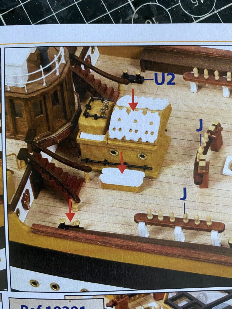

Gregory in the case of the Amerigo Vespucci there are several “houses” that are to be built and glued in position on the deck. The photos are the type of items I will be gluing to the finished deck.
I’m sure a lot of instructions call for that kind of construction, but it’s fairly easy to do something like glue a small diameter dowel to the inside corners and place holes where needed in the deck.

Thanks again Gregory. I have used pinning solutions for fife rails and similar things. Small  diameter dowels is an excellent idea.  Yes please provide other examples you use. Always interested in adding new ideas to my notebook.
  A solid hull isn't needed to drill into for secure fastening of fife rails, etc. - as long as there is a reasonably thick sub-deck below deck planking.  Where the sub-deck provided is on the thin side, additional material (say, basswood sheet cut to fit) can be glued between bulkheads flush with their tops to create a sub sub-deck to glue the sub-deck to.  There are few things to spoil your day after a model is finished (other than dropping it or breaking the bowsprit) than for a fife rail to break loose (one that was merely glued to the deck planks).
As a side-comments (an perhaps in the case of a kit one cannot do much about this), deckshouse do not sit on the planking. Rather, they are anchored into the structure of the ship through the coamings and the deck-planks are running up to them.
So true Johnny. It has always been a practice of mine to anchor the fife rails and any other feature that will have pressure on it. The Amerigo Vespucci I am building, and asked about, is my second wood model. Before this one I built the OcCre Endeavour. So I am fine tuning my wood building techniques.
Wefakck what you say is very true and something I had not thought of.  That is how the instructions should have been. I suspect they did not think the average builder could nicely fit the planks around the structures. The three deck sections are to be planked, varnished, glued in place, and then start building and adding features. I may consider carefully removing the planking under the structures.
