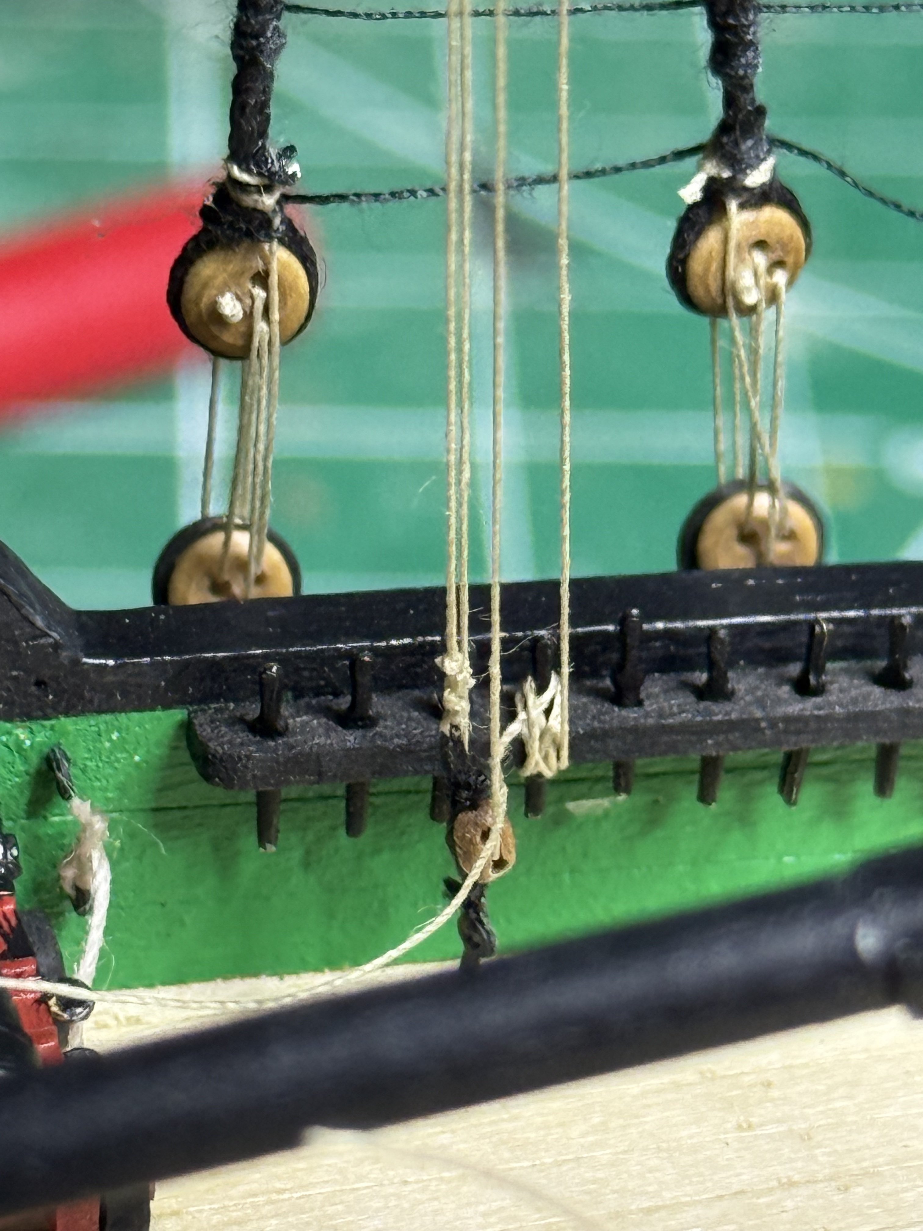

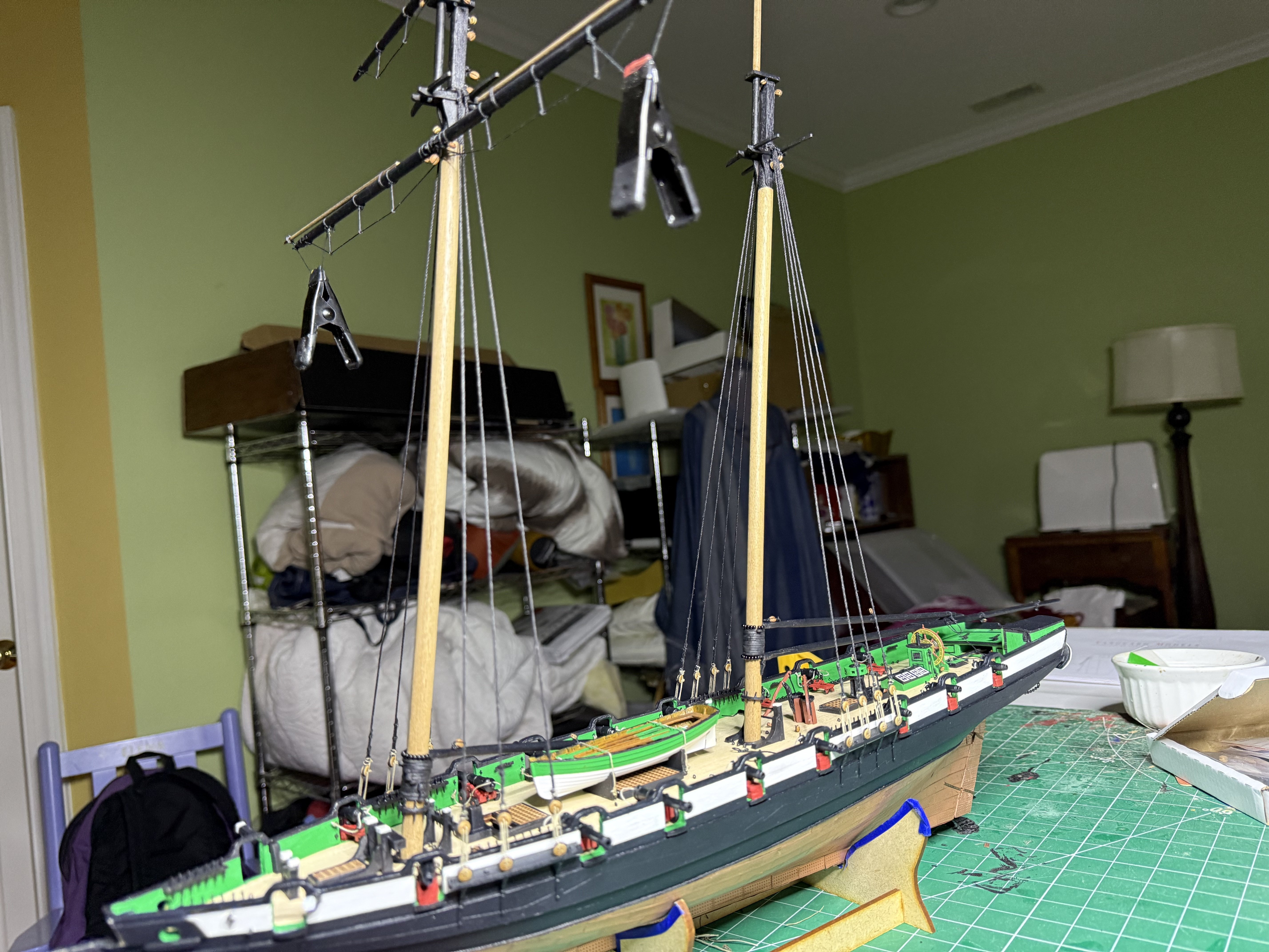

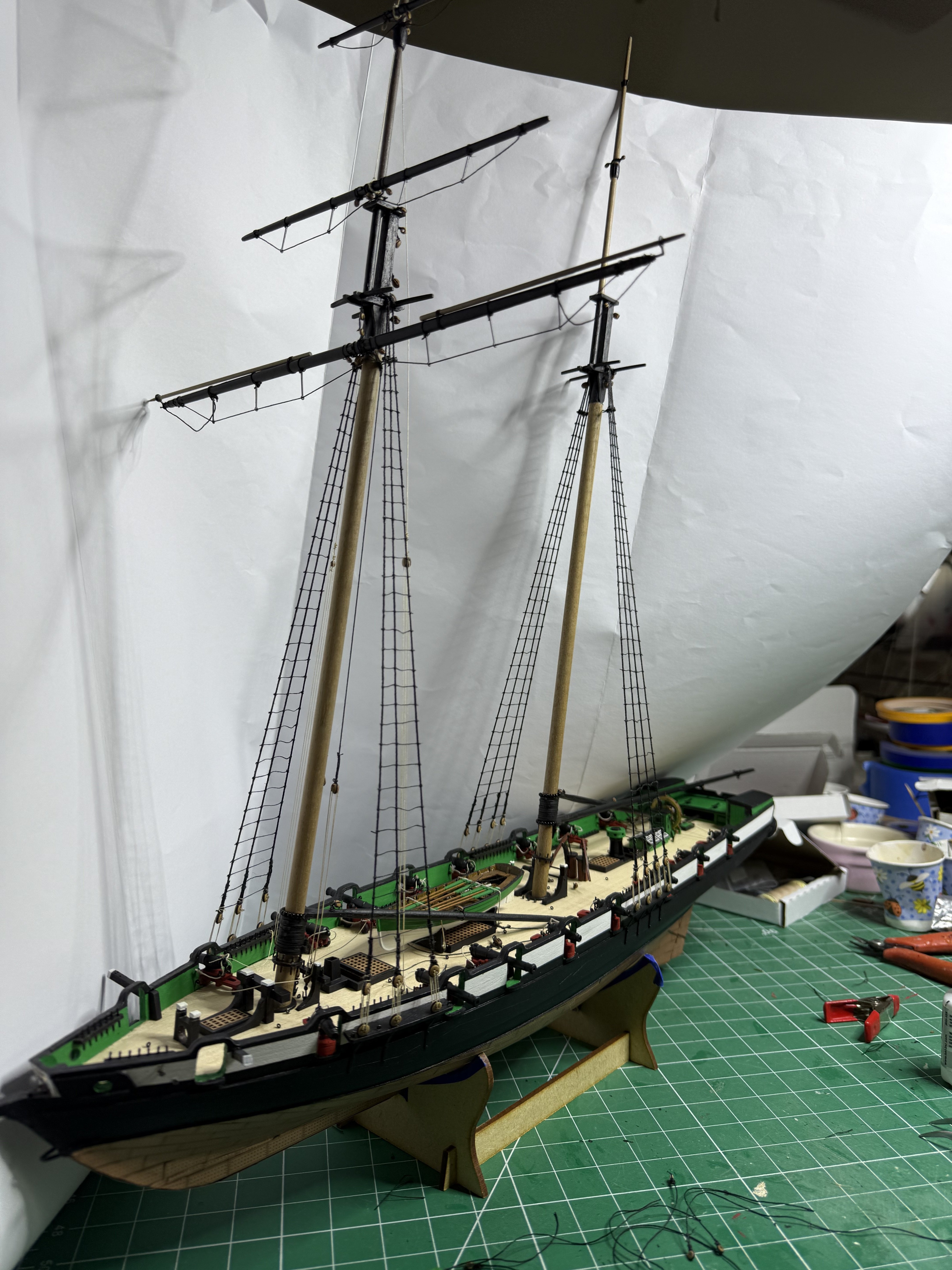

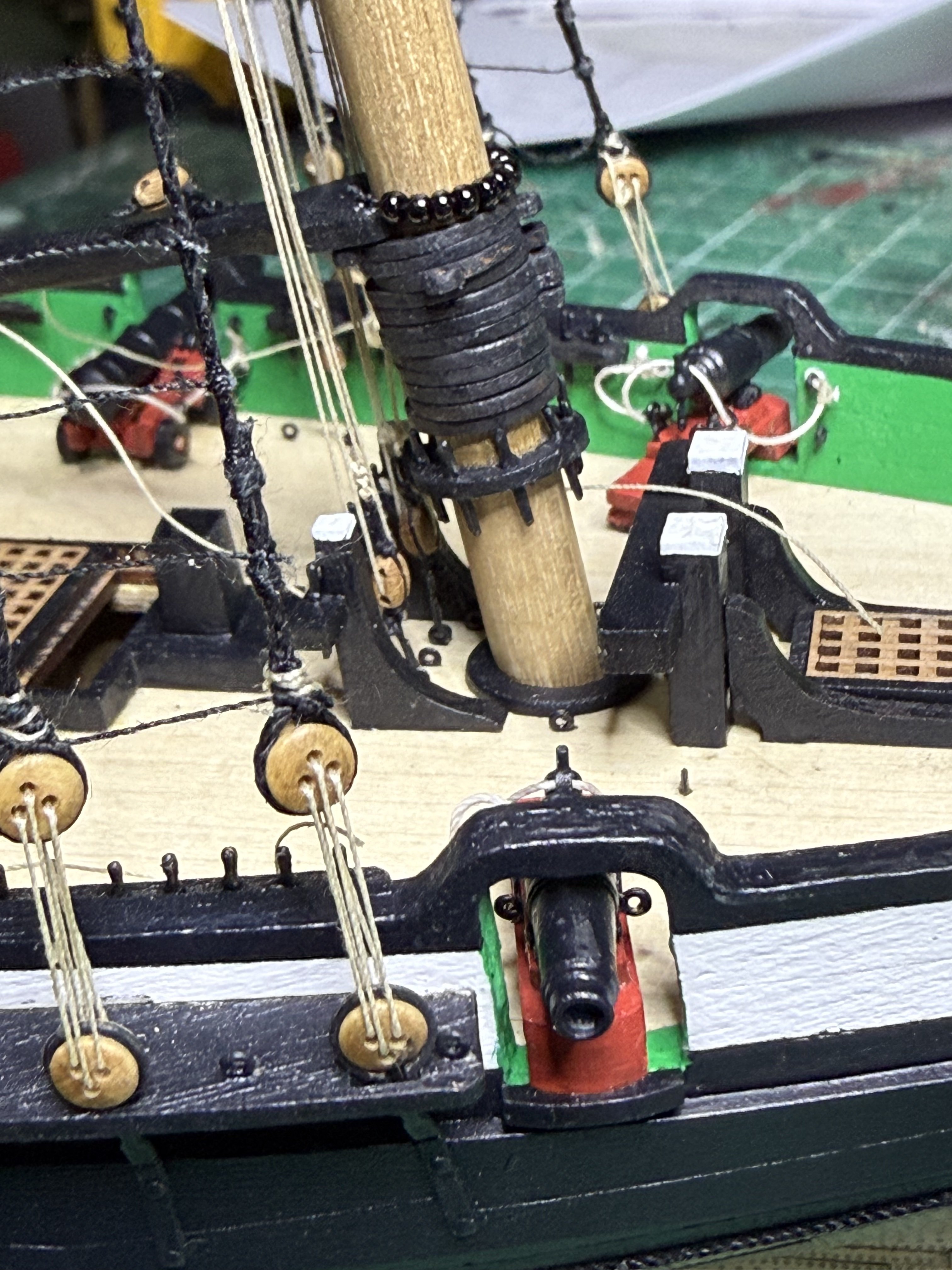

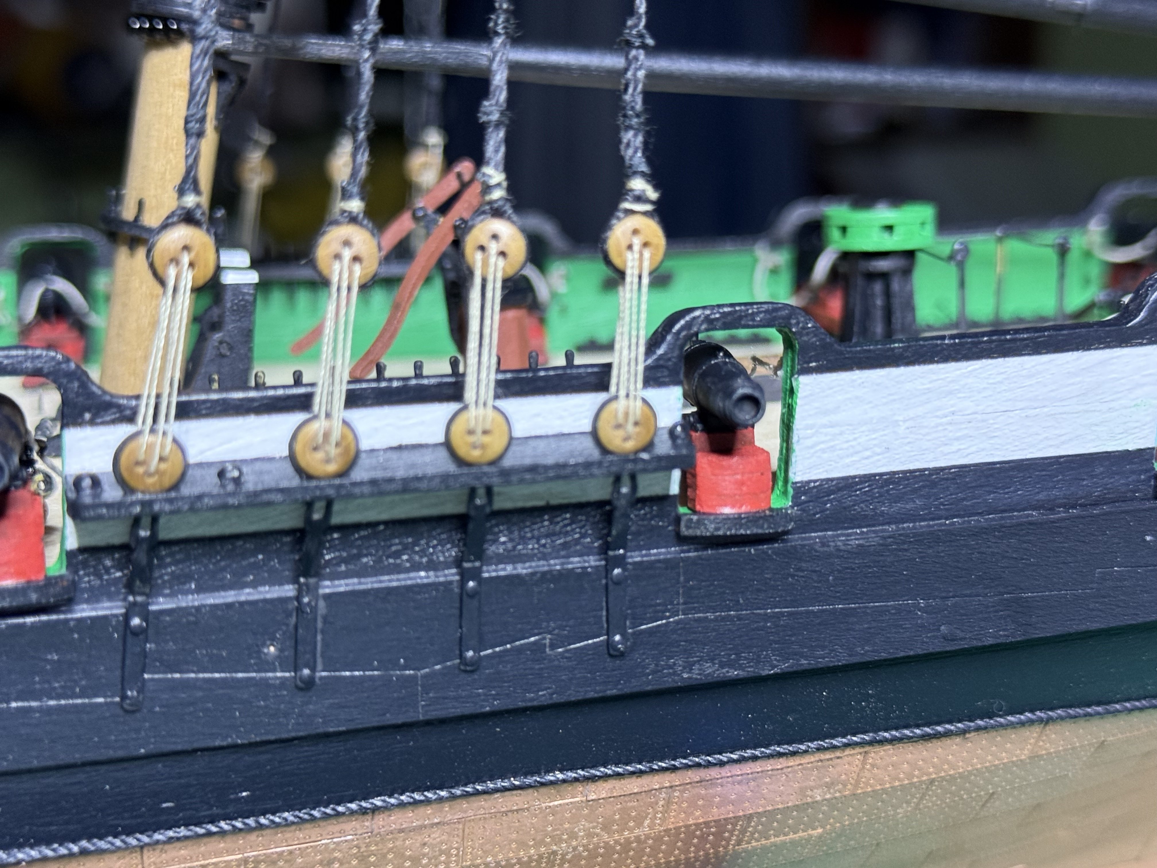

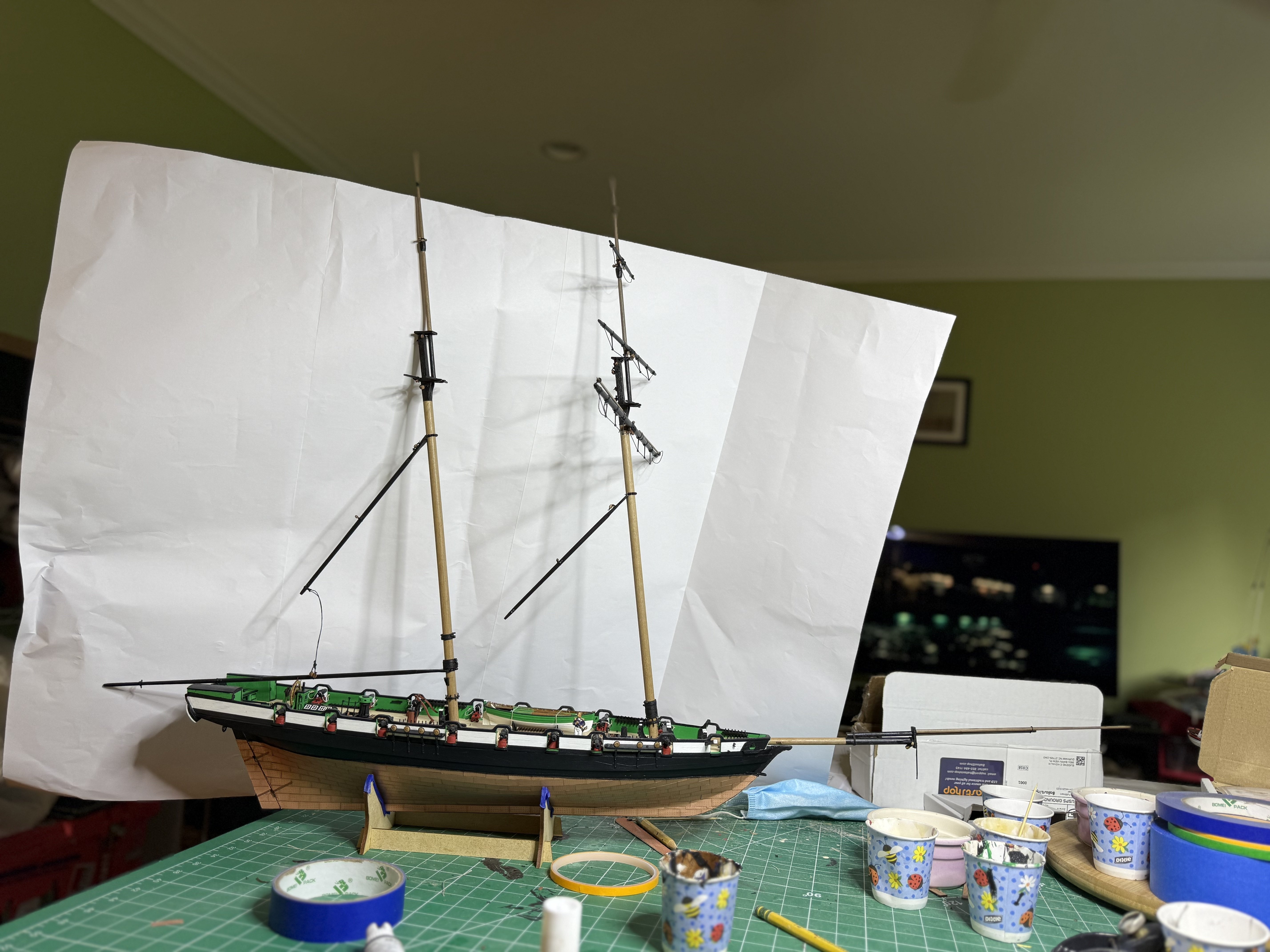

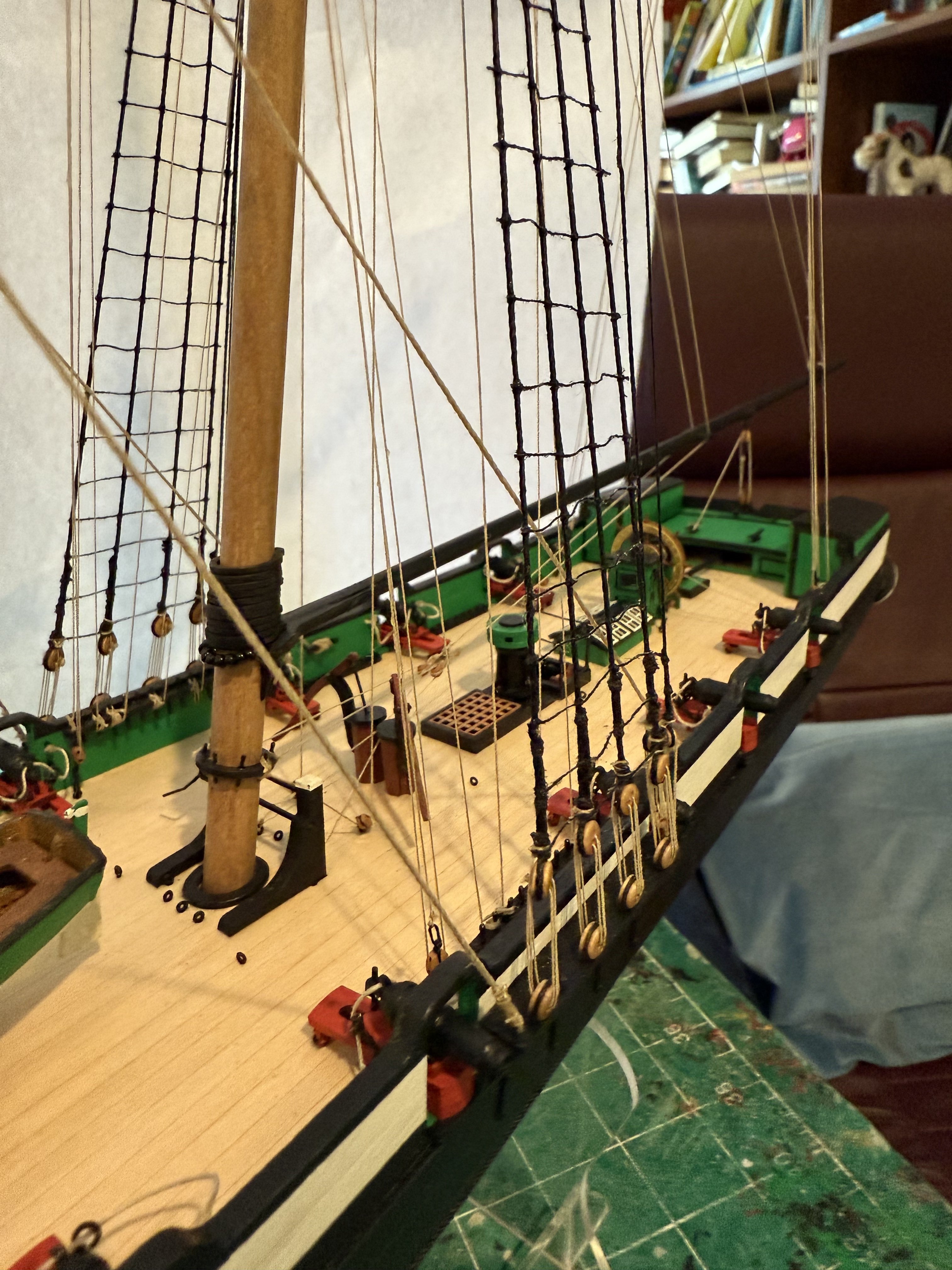

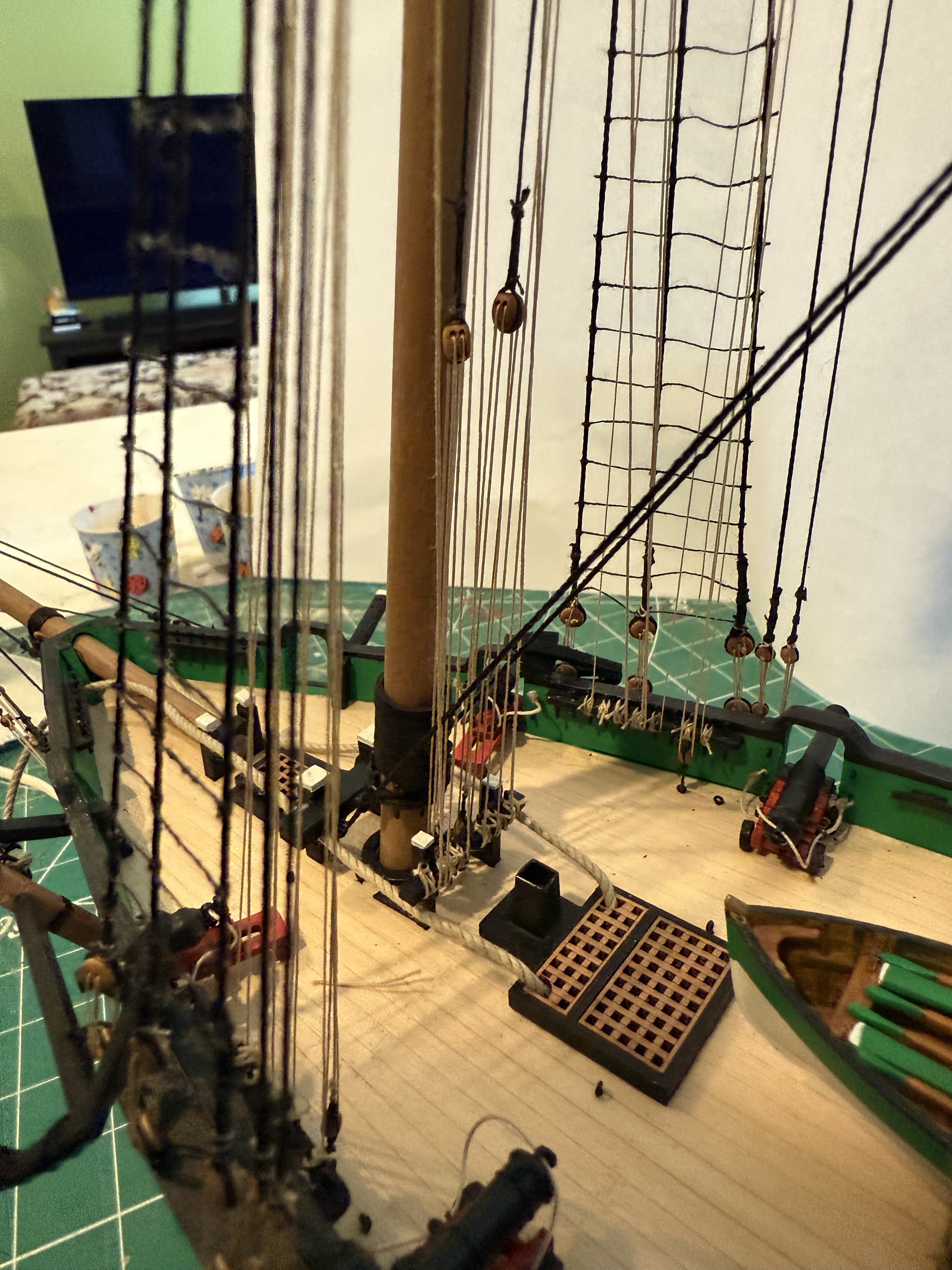

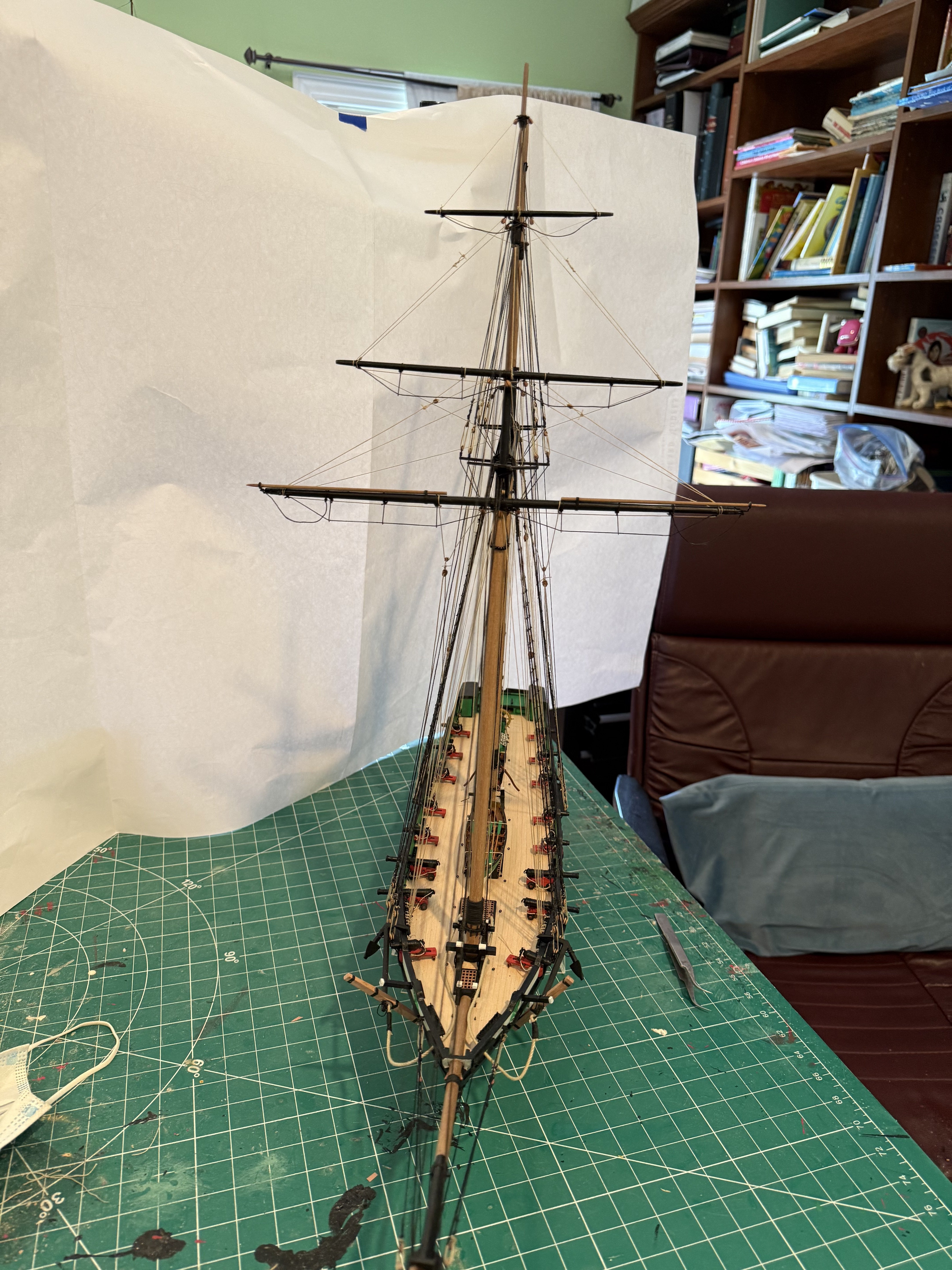

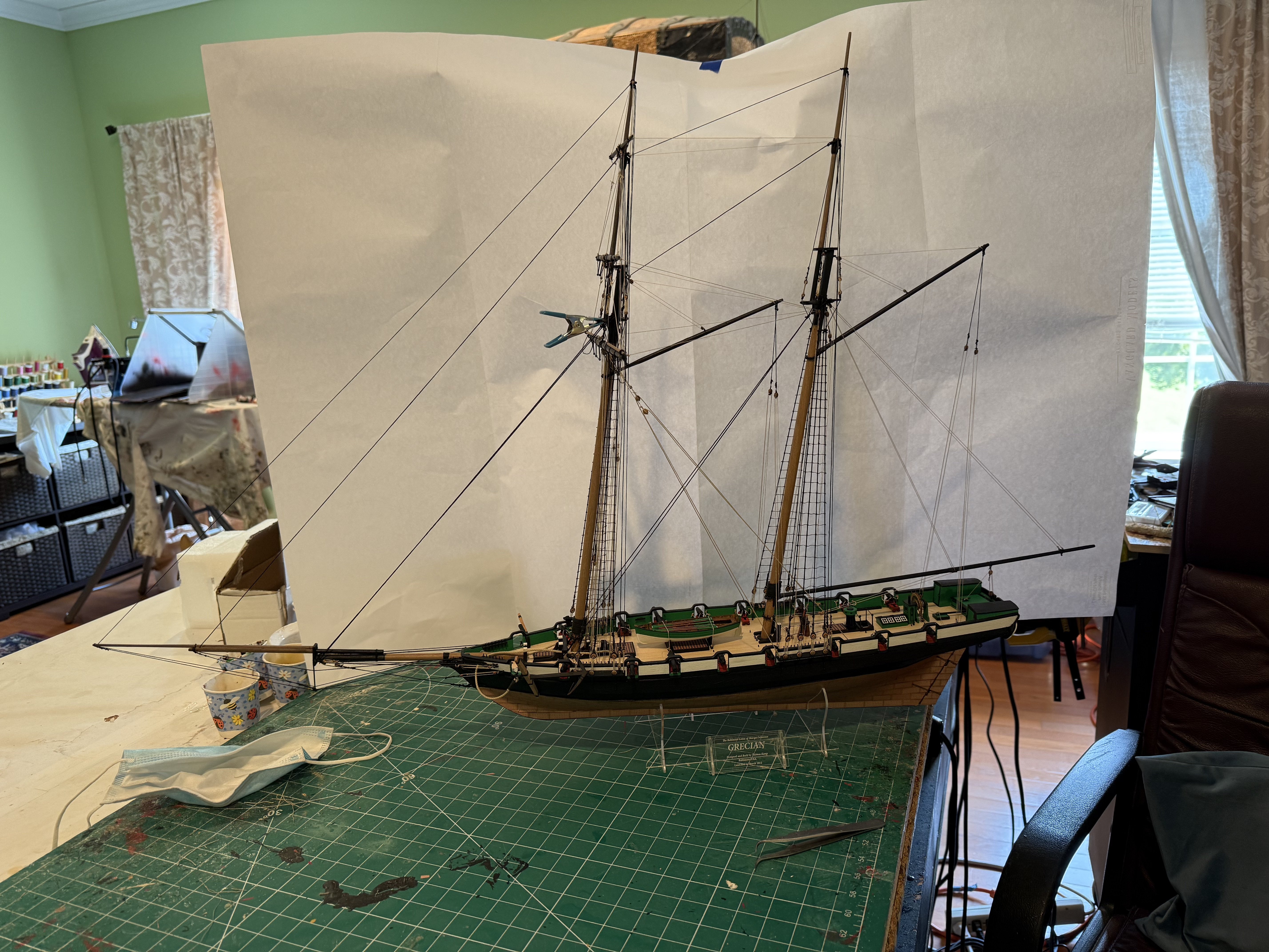

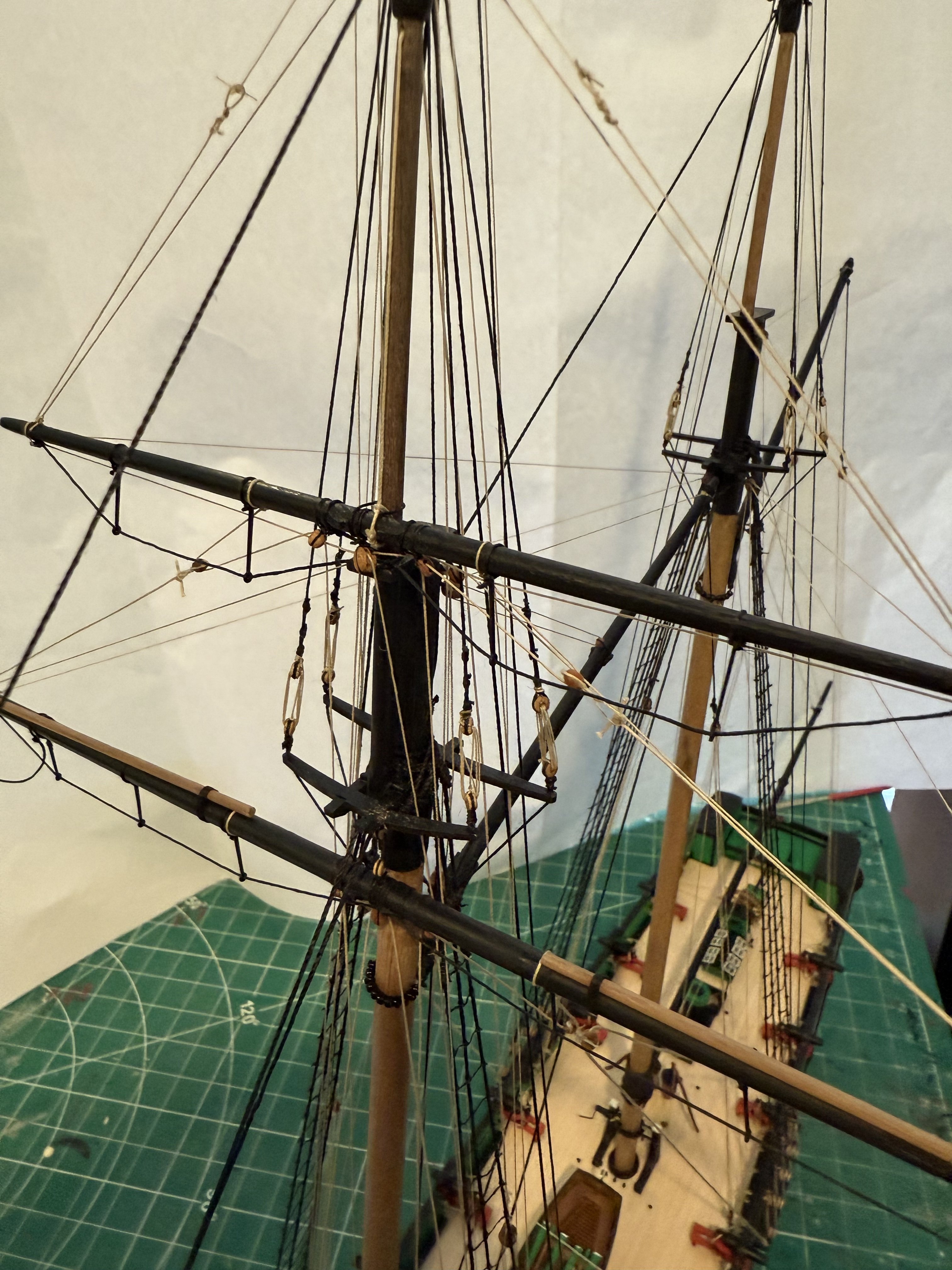

Shrouds done. I tend to do the first on each side measuring the distance from bottom of the lower deadeye to top of the upper. Here 2 cm. Then I eyeball the rest based on the first one.IMG_0331_HEIC.thumb.jpg.ef33887320b180b48430699fda75a236.jpgIMG_0330.thumb.jpg.cea03db0e307334ec39e10bae5027720.jpg

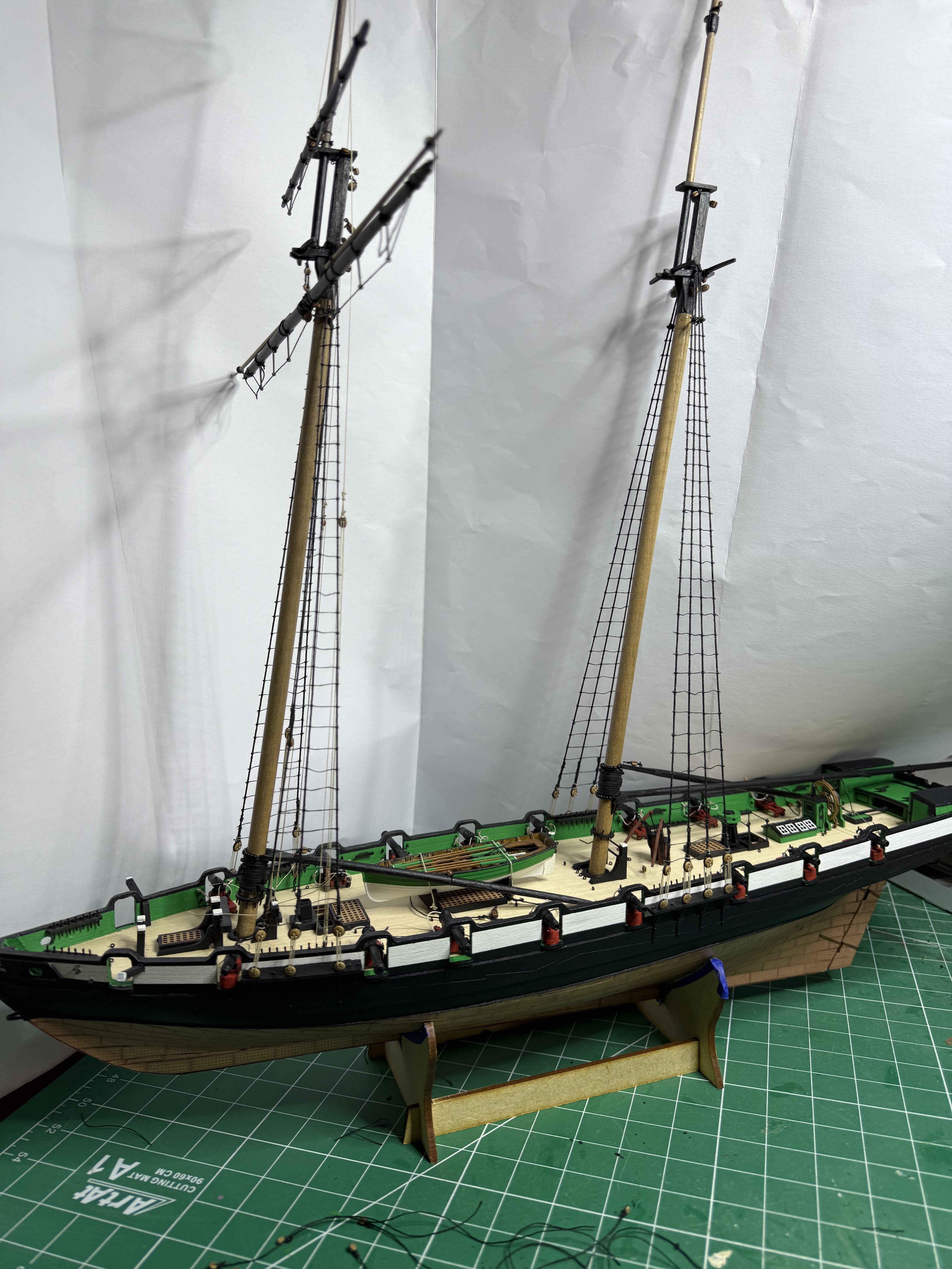

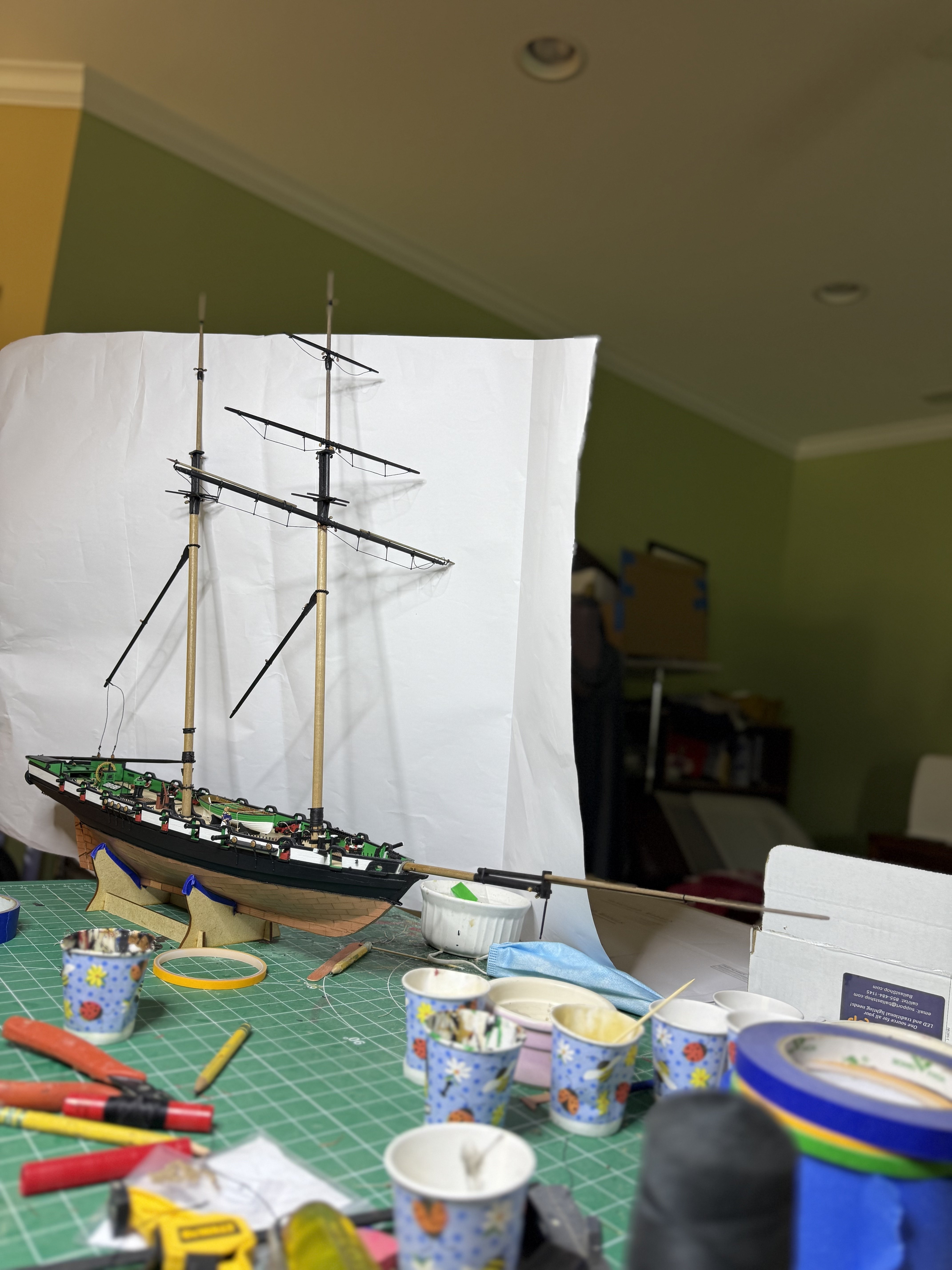

442 knots later, the ratlines are done.   After finishing one side, as I do the other I insert a plank every 5 rows to make sure things are staying even.

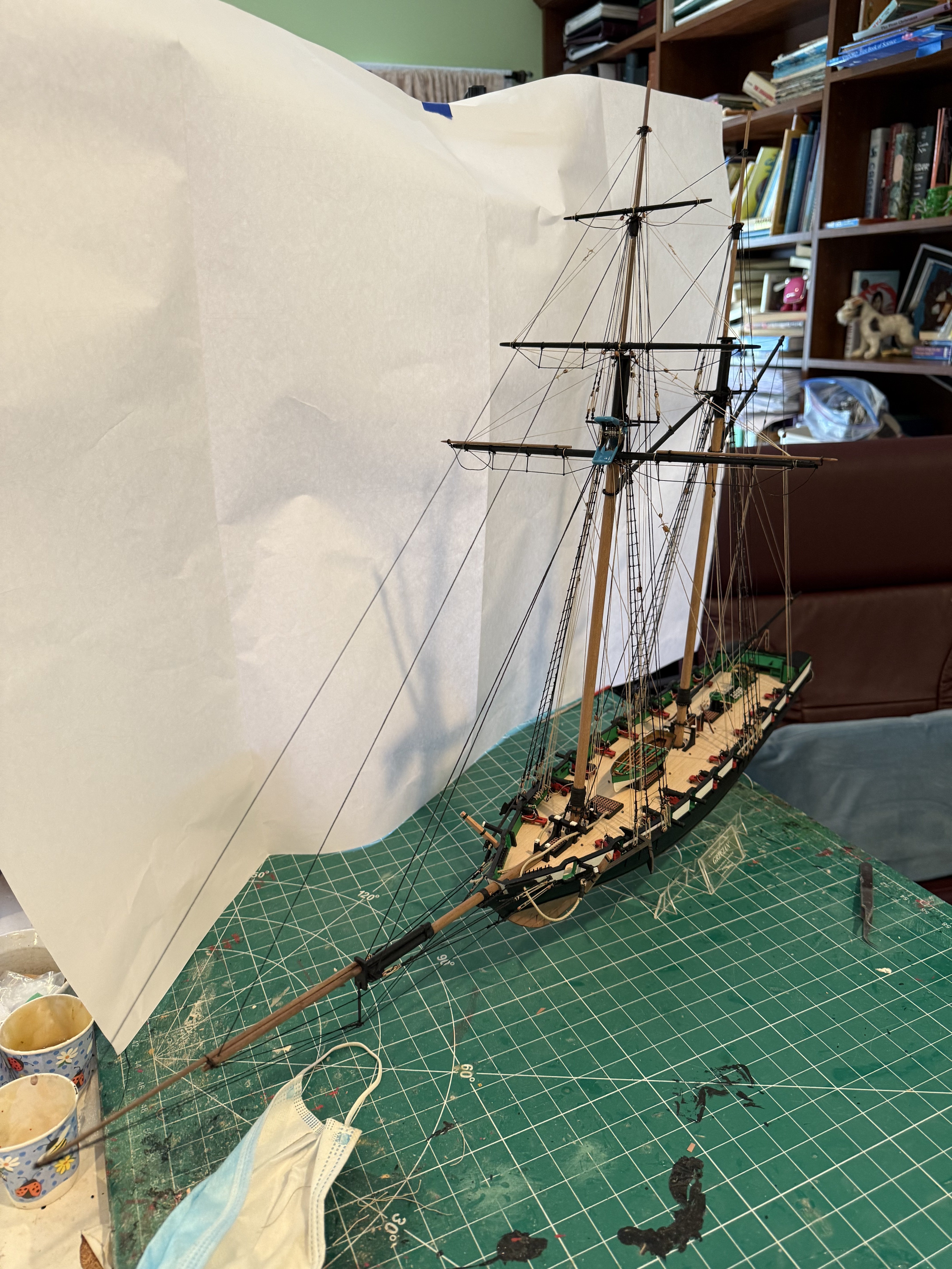

IMG_0332.thumb.jpg.6a19063c86bf97b52d7451a8feaf15e7.jpgIMG_0335.thumb.jpg.276f21e915f97157cb71305caa76536e.jpgIMG_0334.thumb.jpg.03eddf7968d0fbdcd650cdcda4871a74.jpgIMG_0333.thumb.jpg.b2226eee47f8305bcc1dec57935ee1a5.jpg

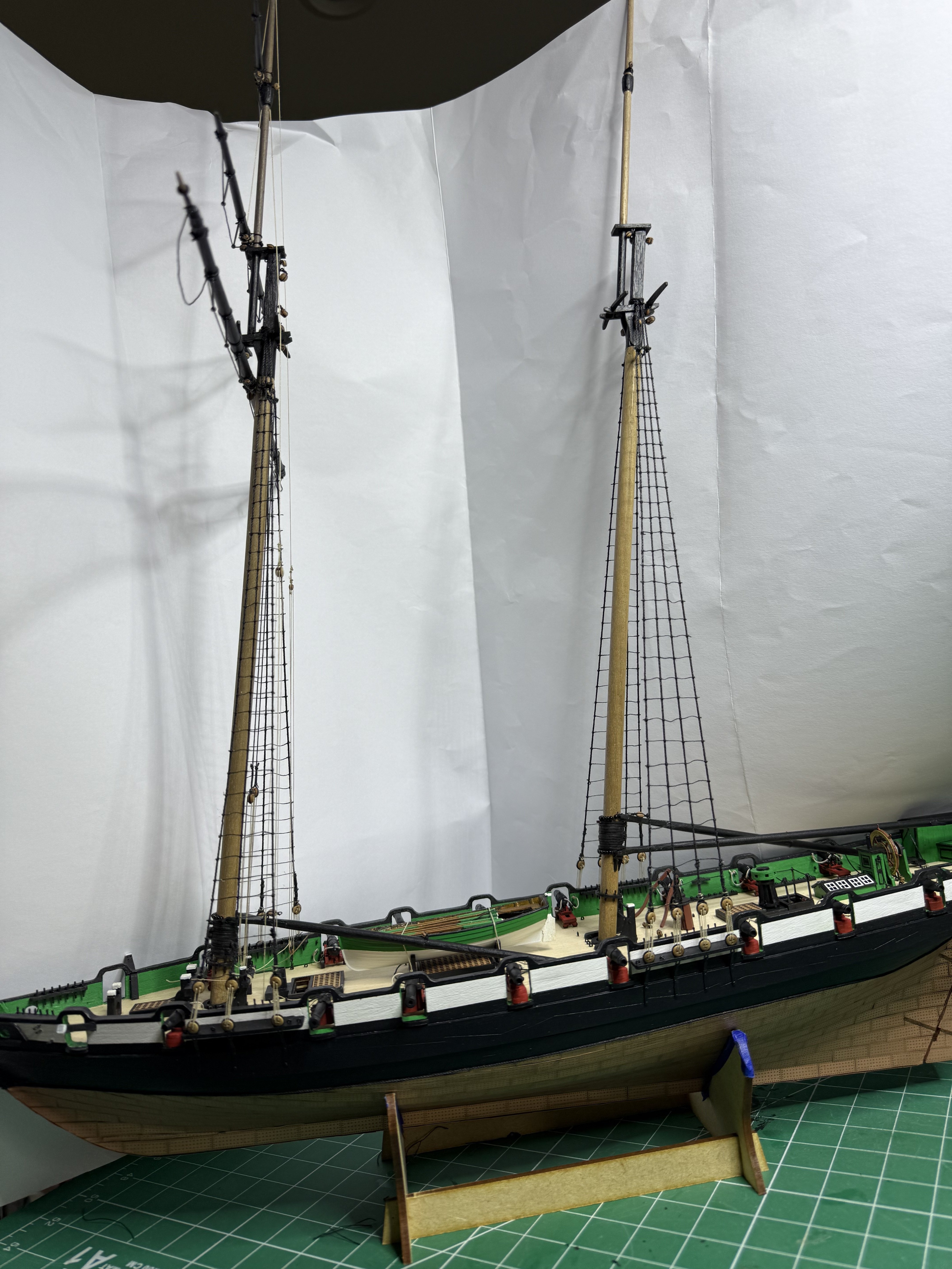

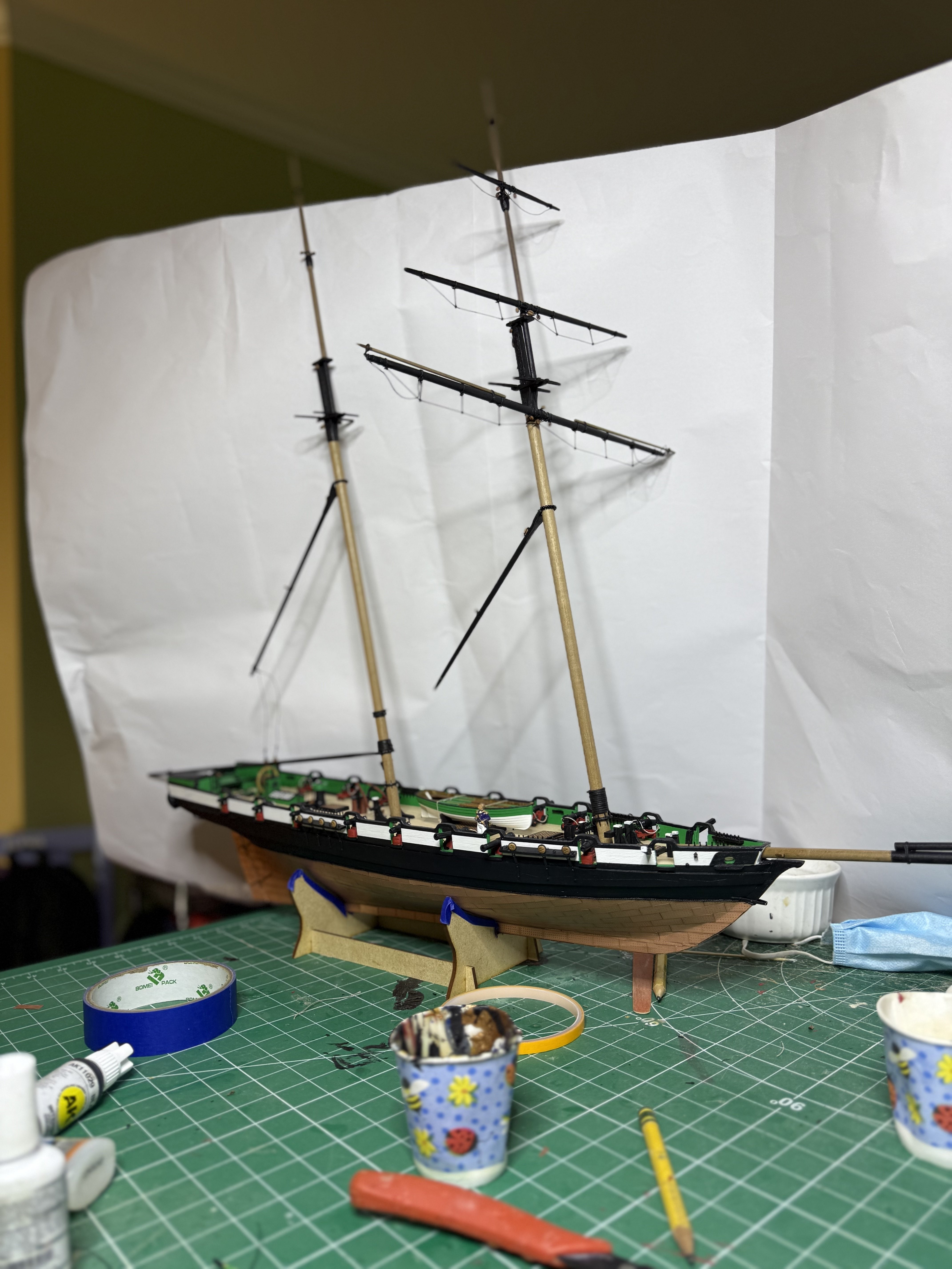

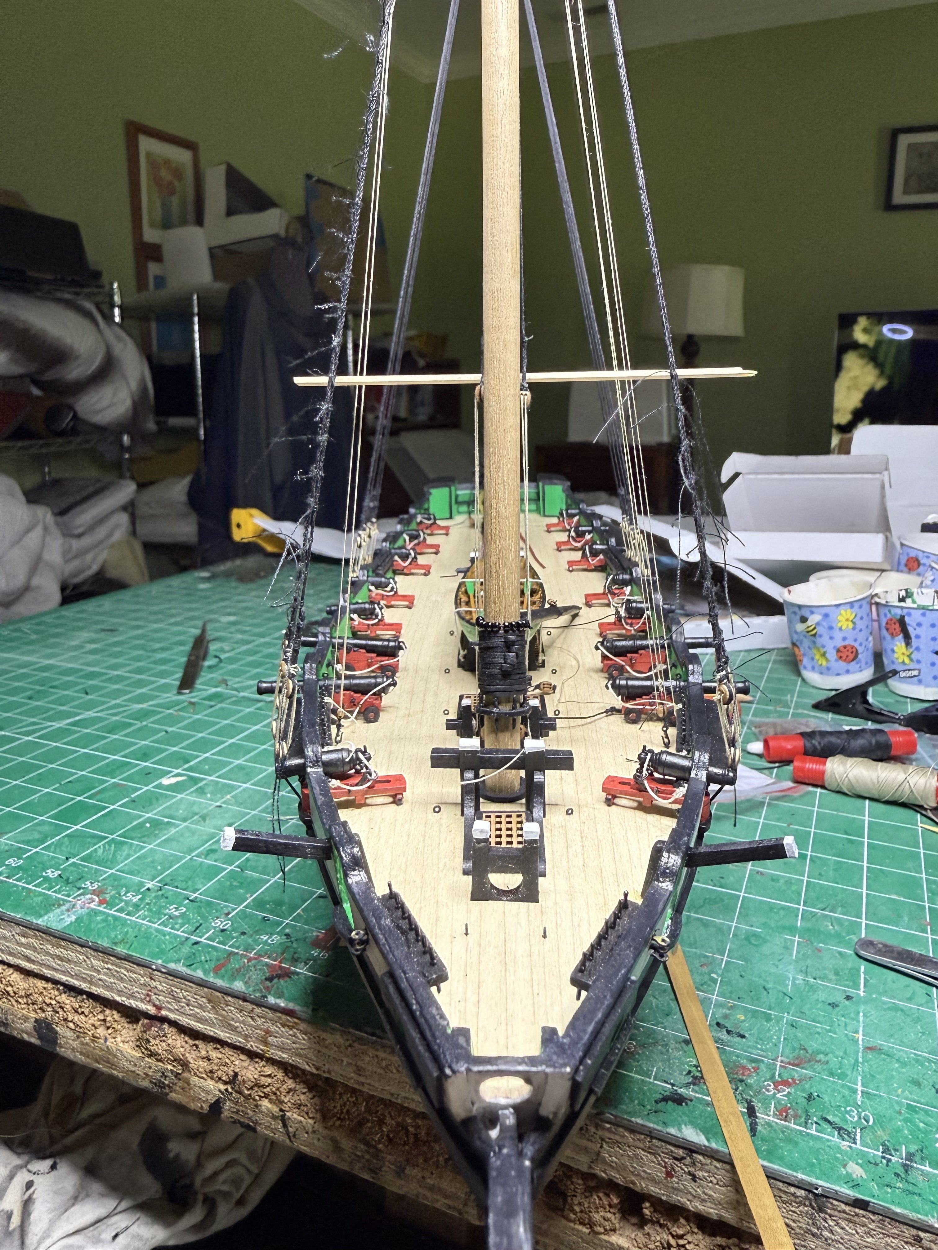

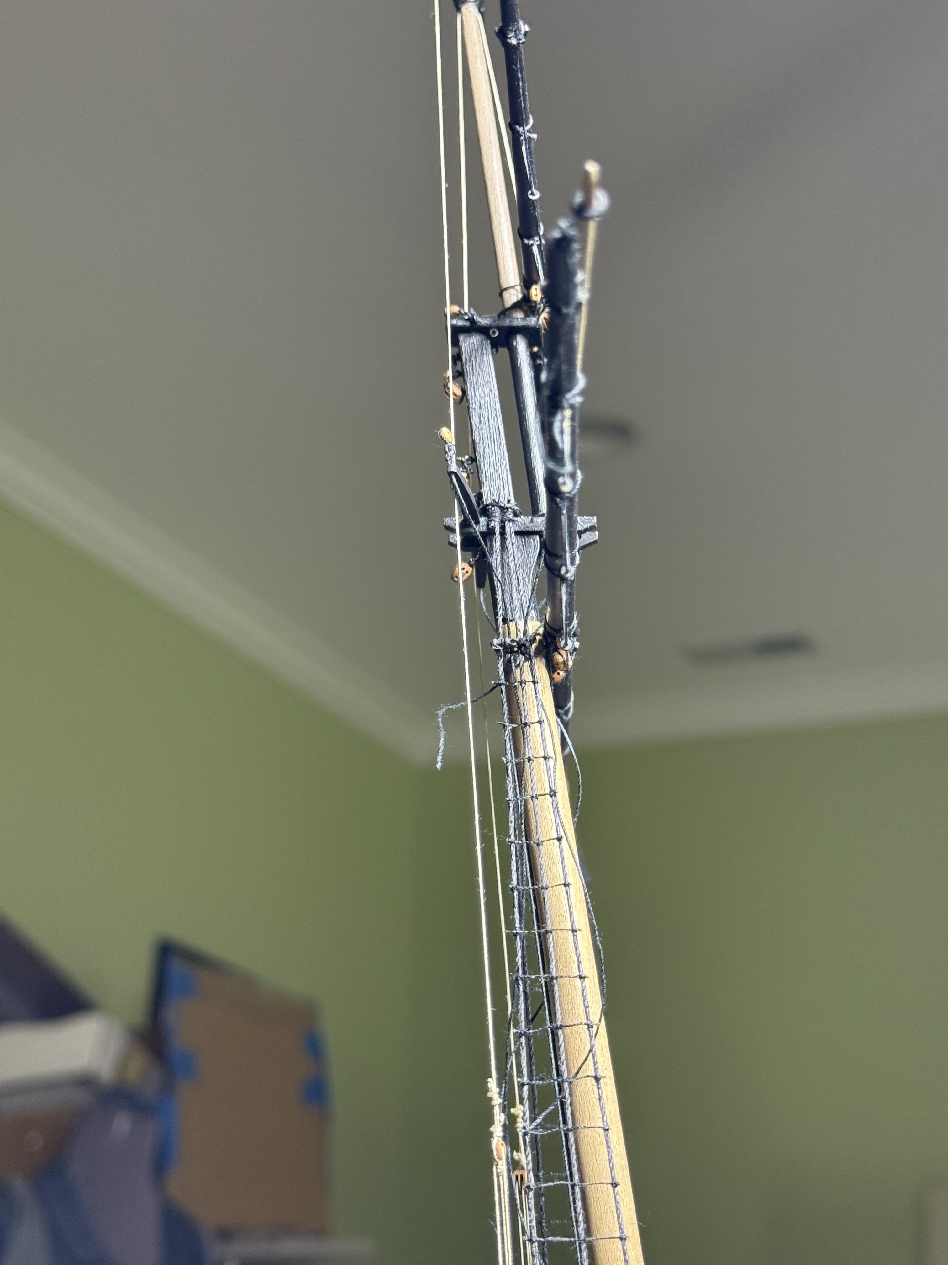

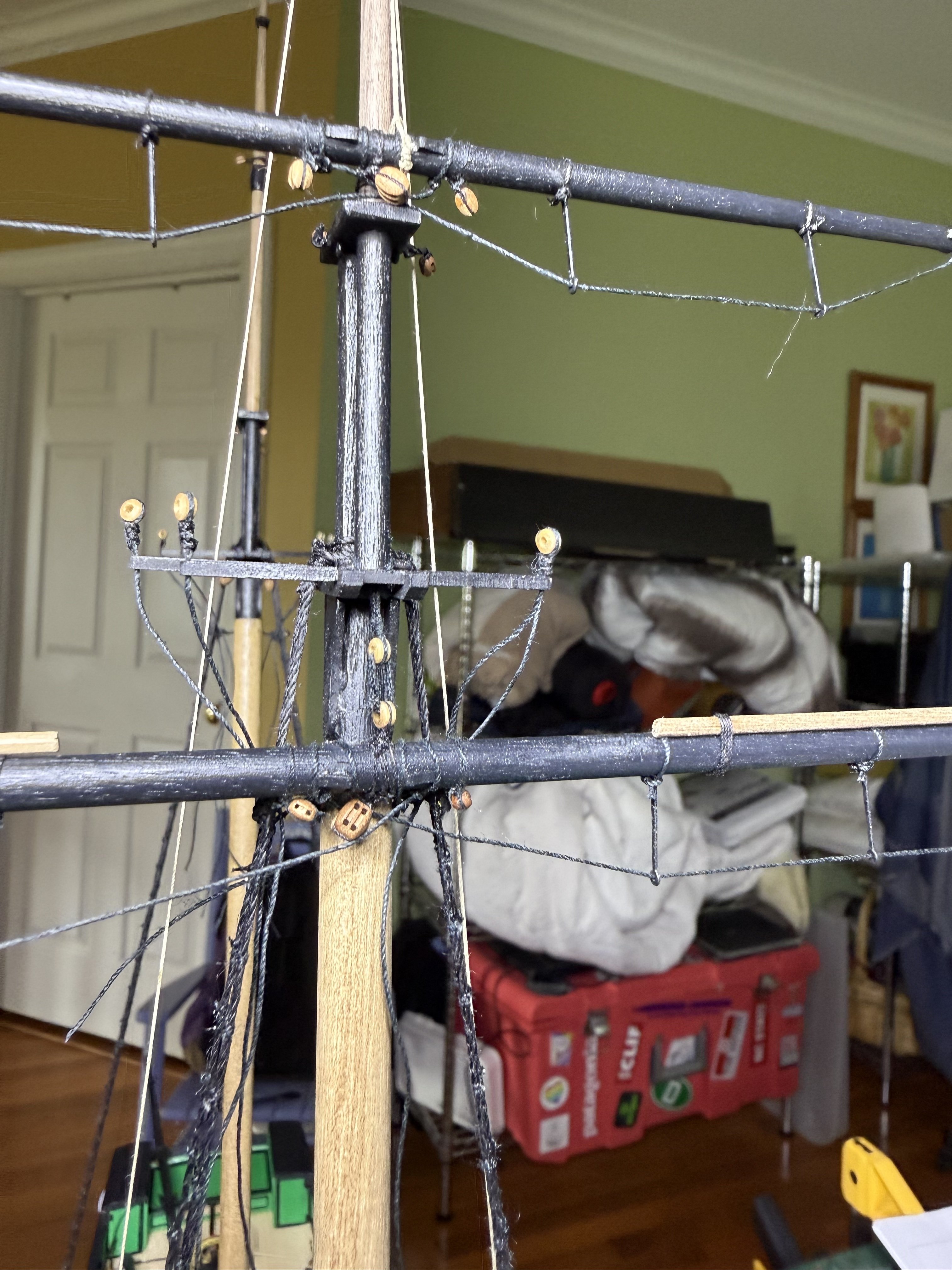

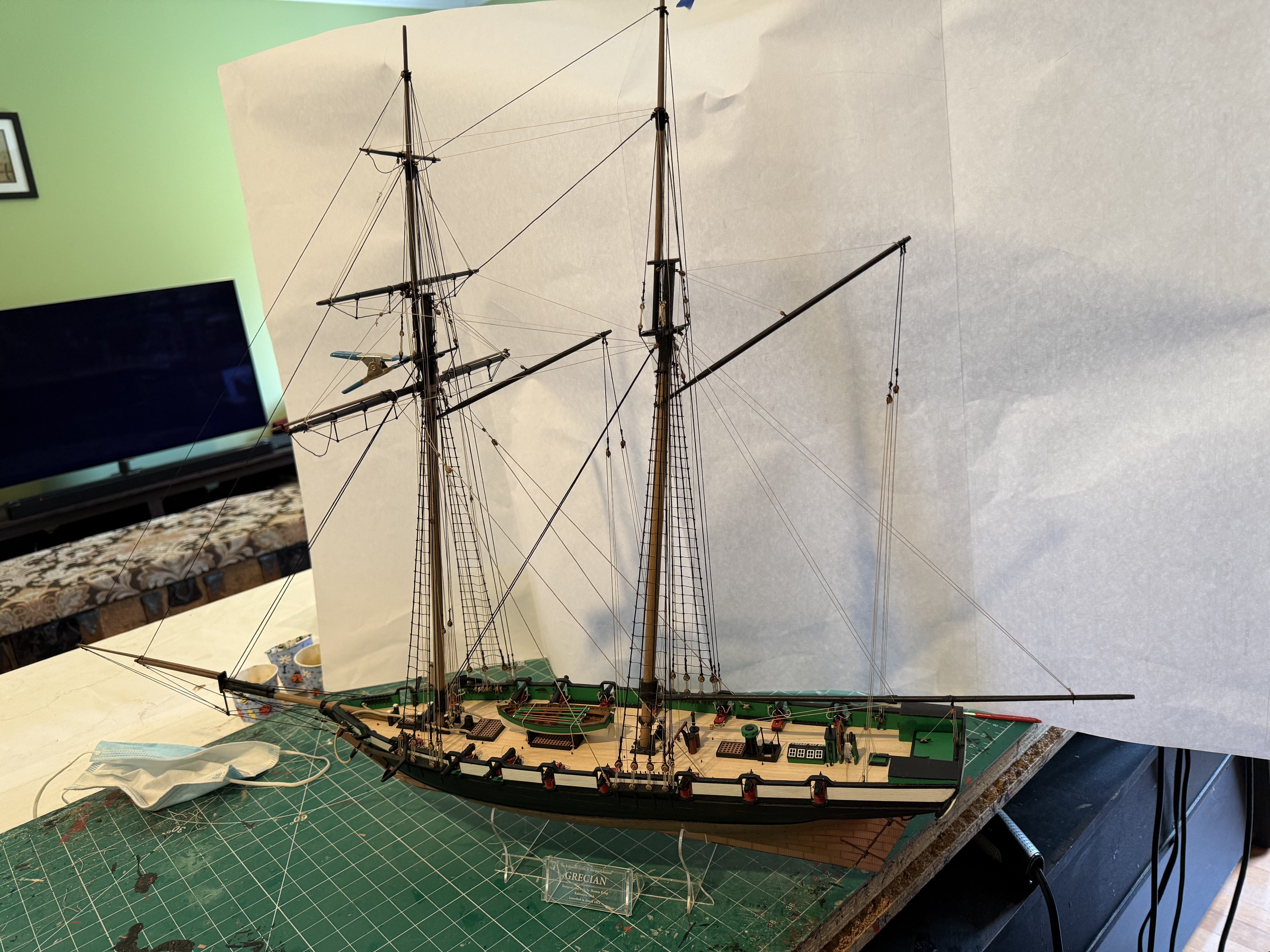

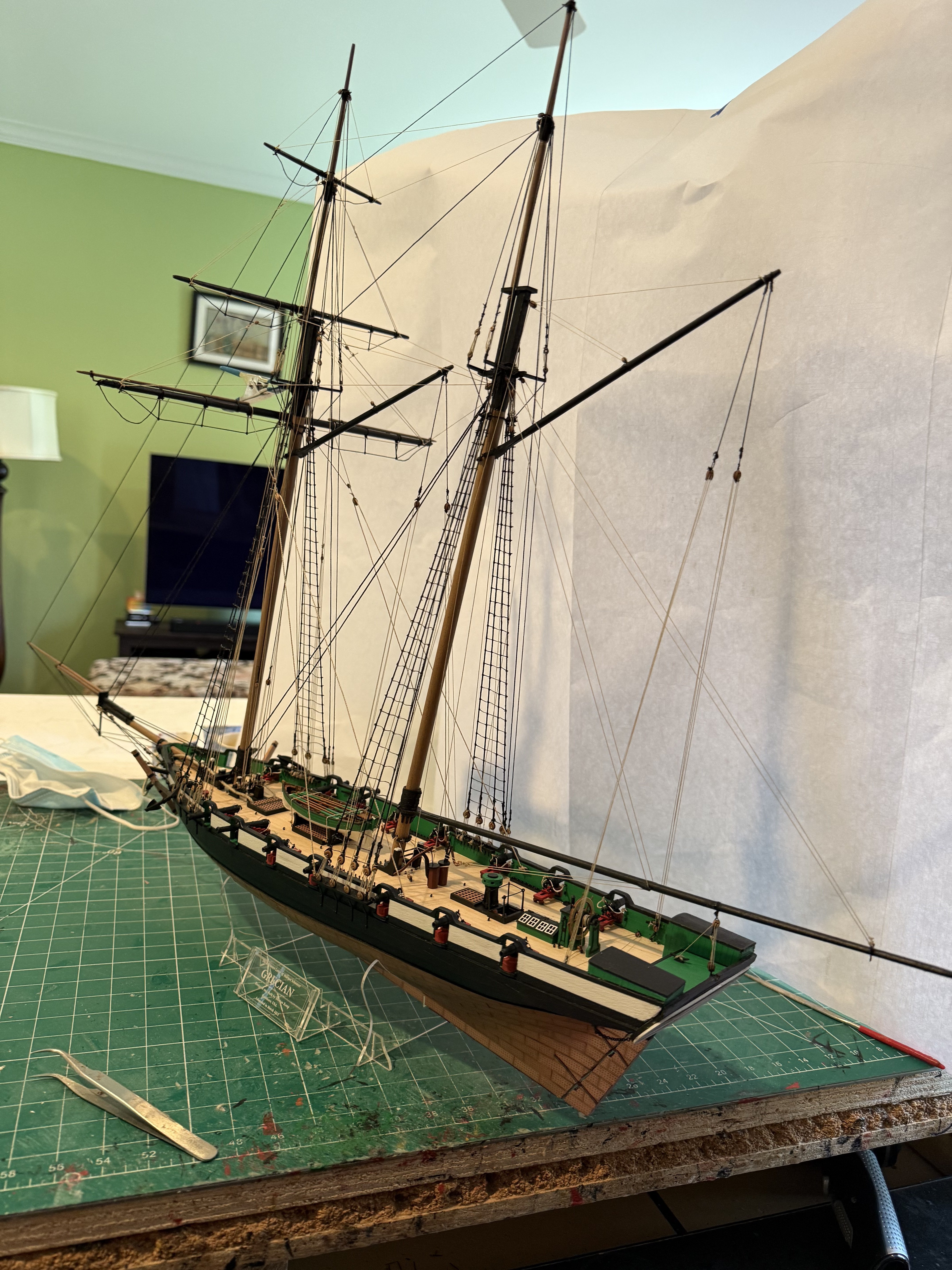

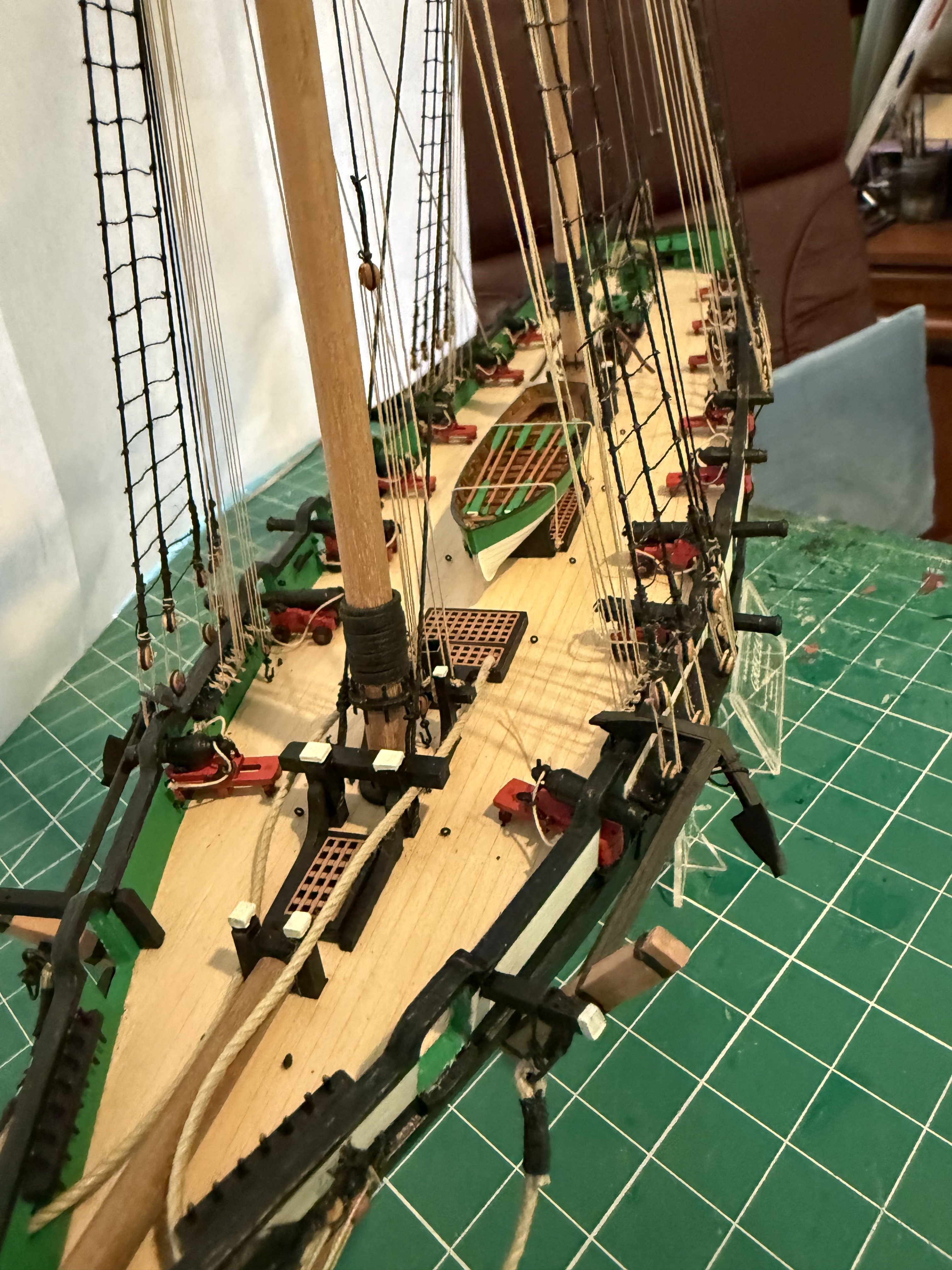

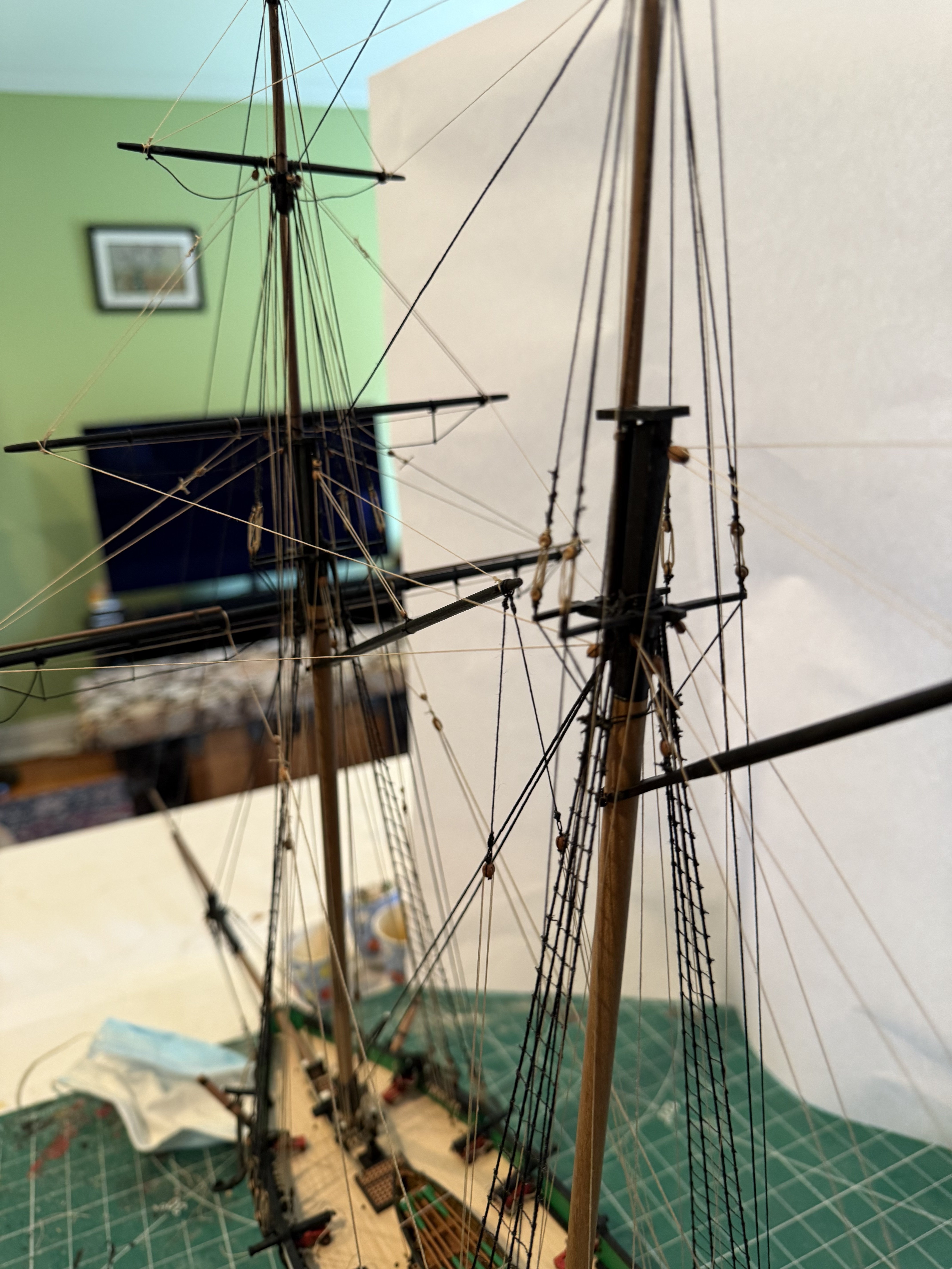

Also installed the halliards onto the yards. you can also see the upper rings used instead of deadeyes inserted into their holes.
IMG_0339.thumb.jpg.5dcb6c4bcddcfce2911becf92949ac75.jpgIMG_0340.thumb.jpg.4c724d018cfbccde1112bb95fc2a83f9.jpgIMG_0338.thumb.jpg.28be6187f6c3804623d9804fb2a9c3b6.jpgIMG_0337.thumb.jpg.4eb9b74d24beb53ffb05b64dafa81748.jpgIMG_0336.thumb.jpg.88ead6f7e145aaca4e22529f81dec3e8.jpg

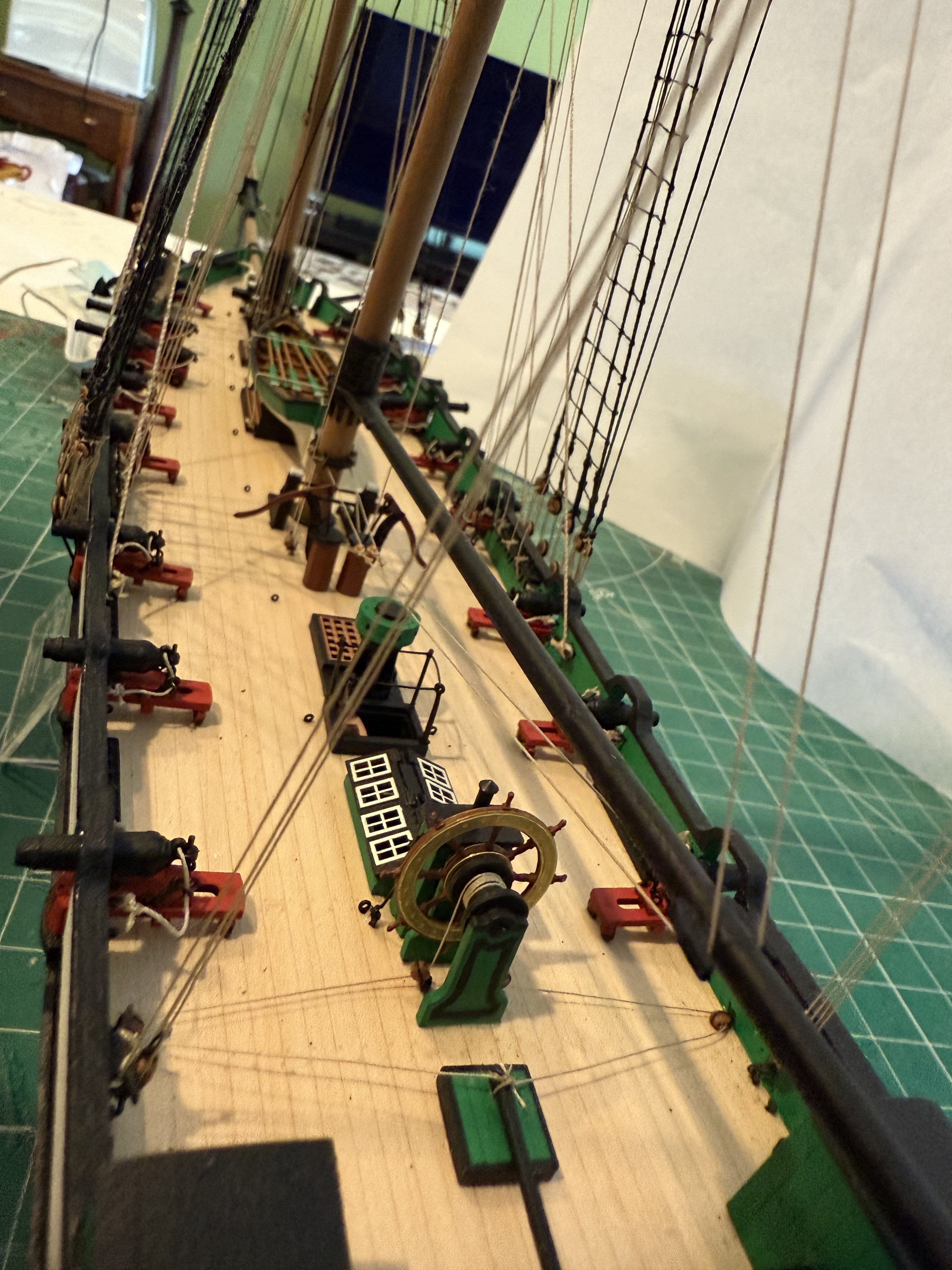

Thanks. Yes , if you tour the USS constitution in Boston harbour the inner bulwarks are green.

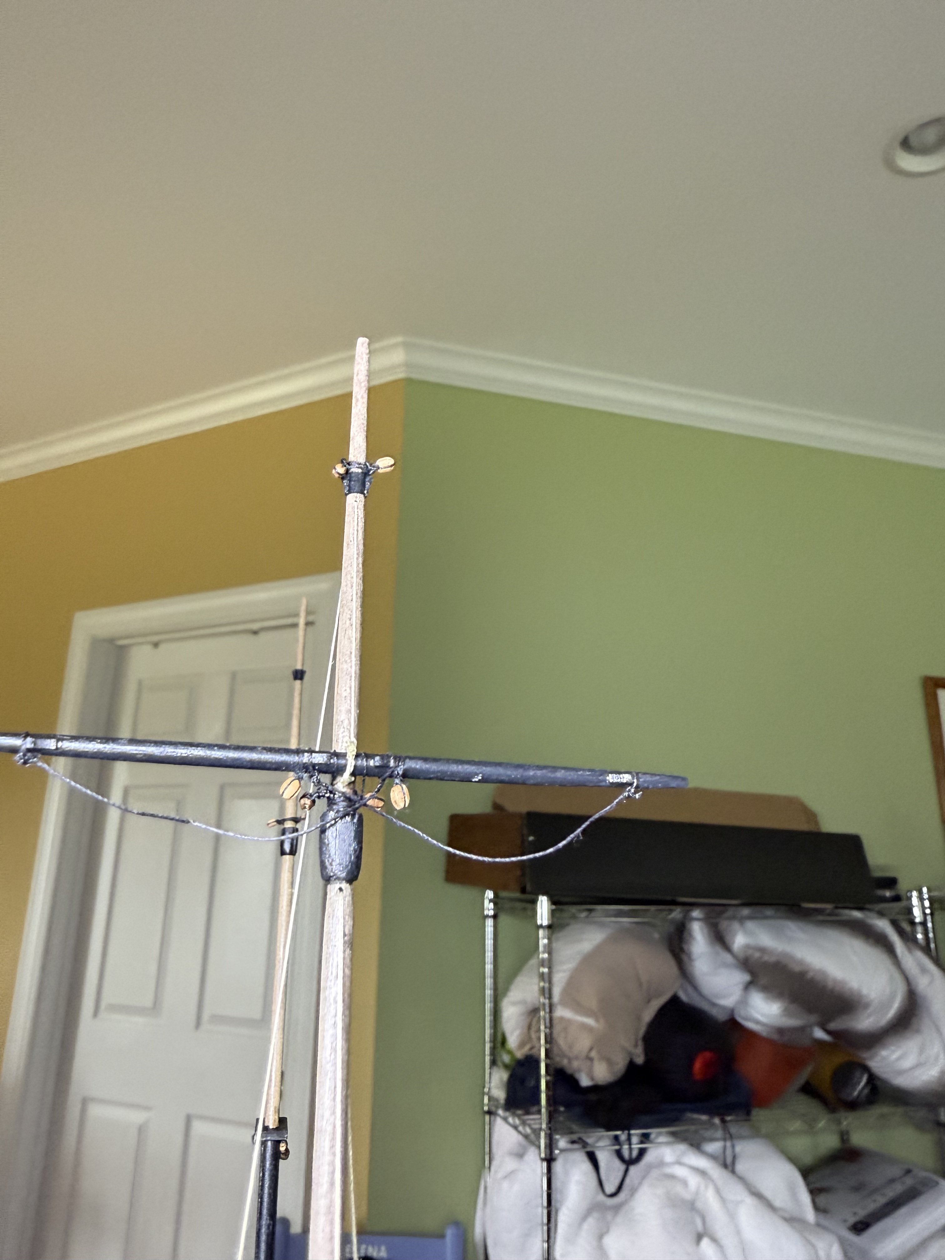

What are the lines you have coming down to cleats on both sides of the boom and then forward to blocks? The standing parts of the tackles are attached to a ring bolt on deck, pass between the bitts to the blocks, with the running parts belayed to pins on the mast ring.
If the boom is swung outboard the tackles will foul the bitts.
It was common for the standing parts of tackles on lines from the boom to belay to ring bolts under the boom jaws, and the running parts to cleats on the boom. This way the lines move with the boom and do not foul anything.
Phil
Current build: USS Cape MSI-2
What you are seeing is the main boom topping lift. The is one on each side as per Chris' rigging instructions

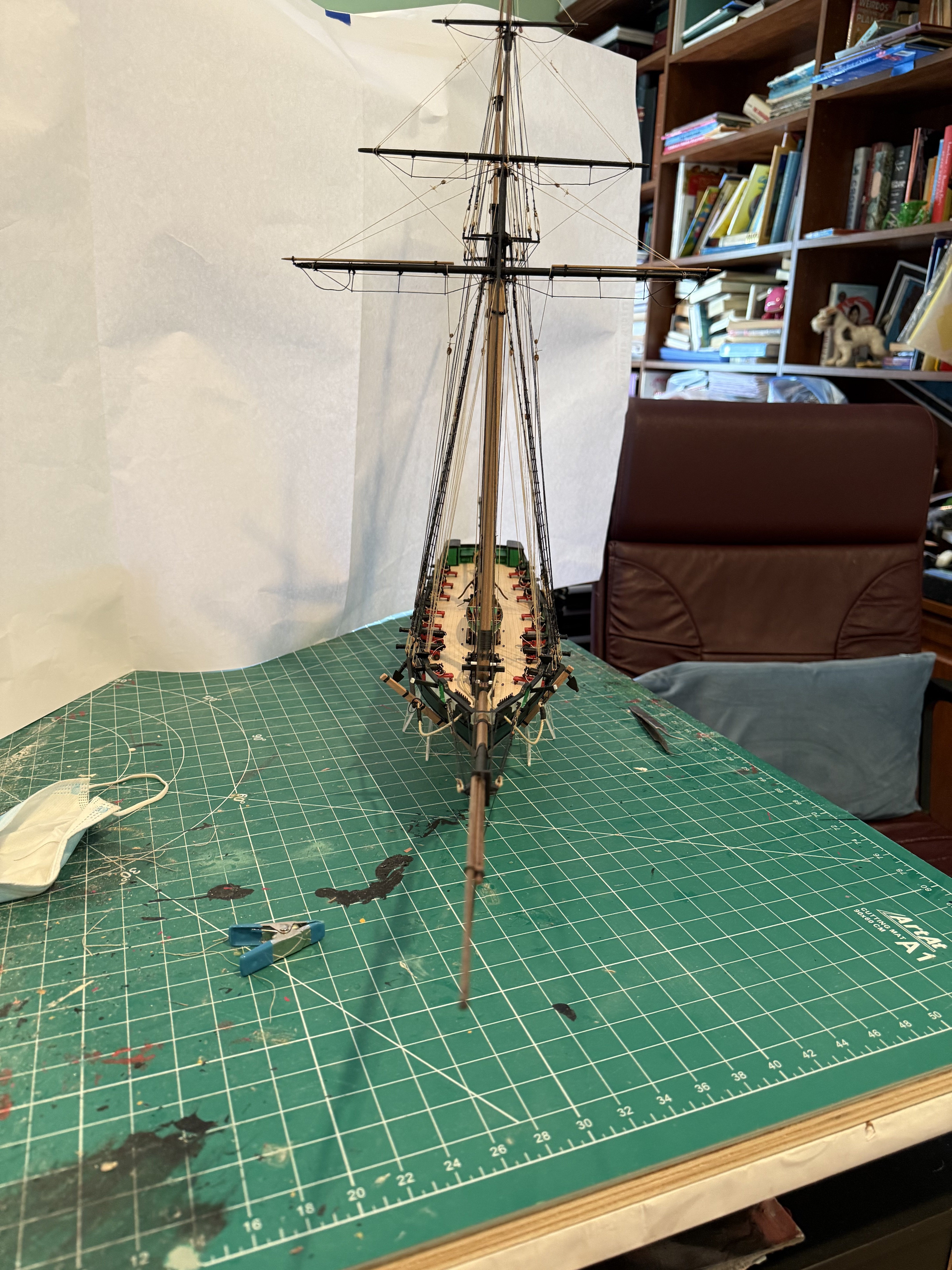

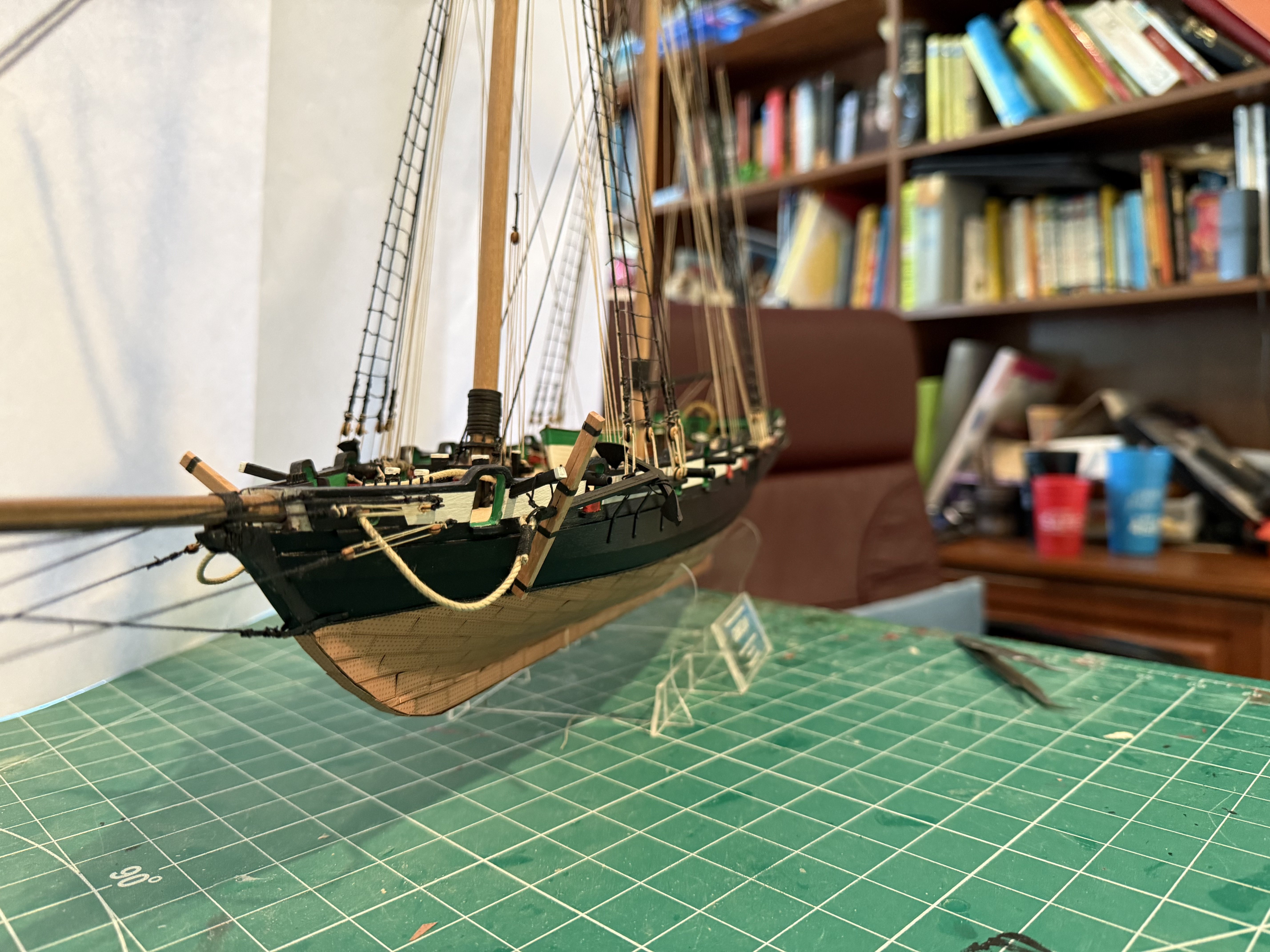

Grecian now complete
IMG_0381.thumb.jpg.a704bcab64b8e0e2b12b28c225db15ff.jpgIMG_0385.thumb.jpg.e0722028c10e98485877ca04bdc00b1a.jpgIMG_0386.thumb.jpg.93d3ee28cde62f76841ac75e3ec663db.jpgIMG_0383.thumb.jpg.303012e4587582fce8e07d7c8f5e2338.jpgIMG_0382.thumb.jpg.e8e4aa4c6cfcfca200768f646426af4a.jpgIMG_0390.thumb.jpg.ac9bfc7326c45f53b7da10511704f055.jpgIMG_0391.thumb.jpg.a5c9a92ee06a70e4a96887a49eee29cf.jpgIMG_0392.thumb.jpg.ffafe3cb87b456057e71fd8ee629b238.jpgIMG_0389.thumb.jpg.fd443a77e5ef5f837c05d8adfb4dae64.jpgIMG_0388.thumb.jpg.c392a333ff3bc7a3820b336c19dad44c.jpgIMG_0387.thumb.jpg.4220b6a389d044b733cedc5c8f9f0ea3.jpg

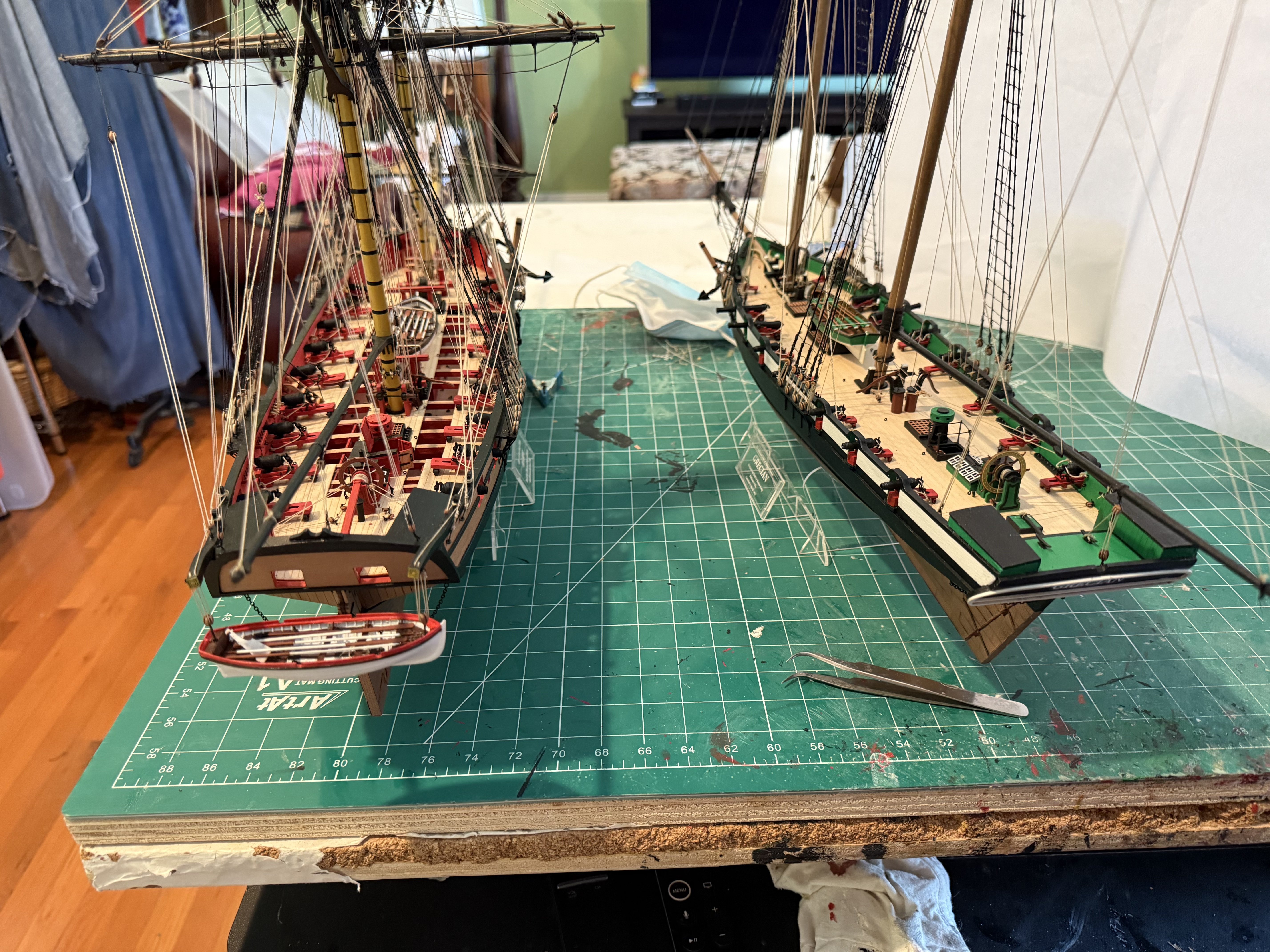

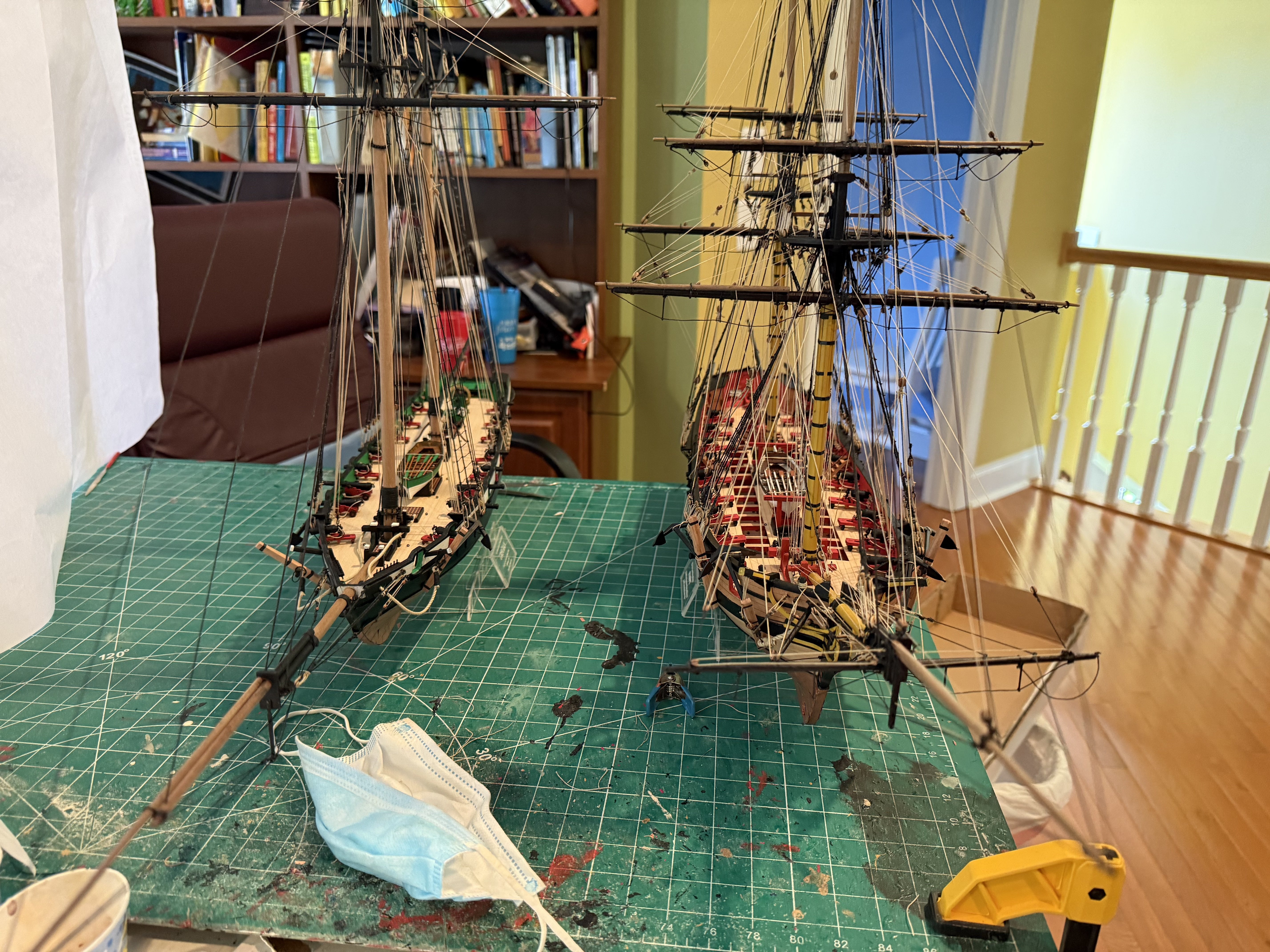

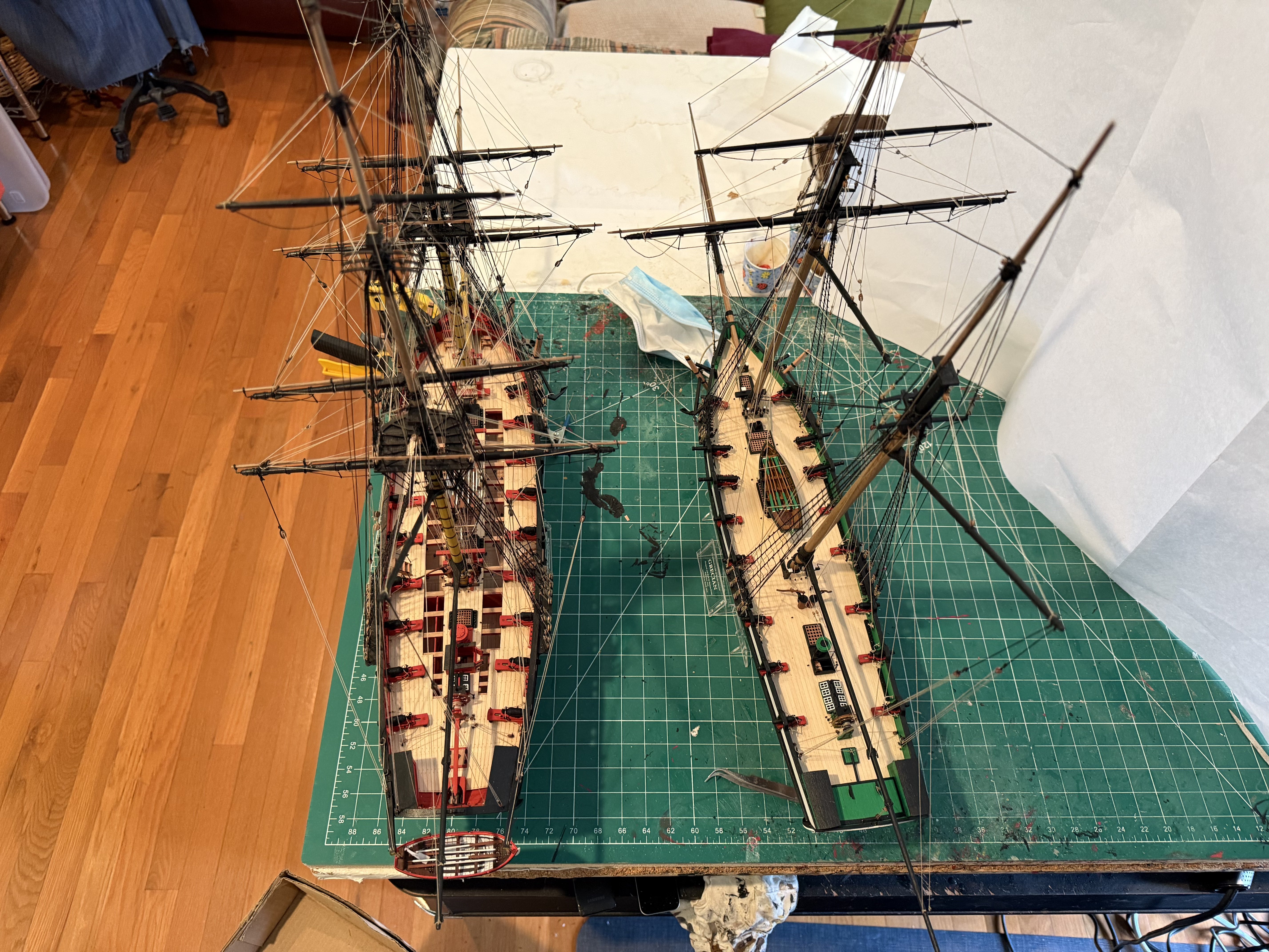

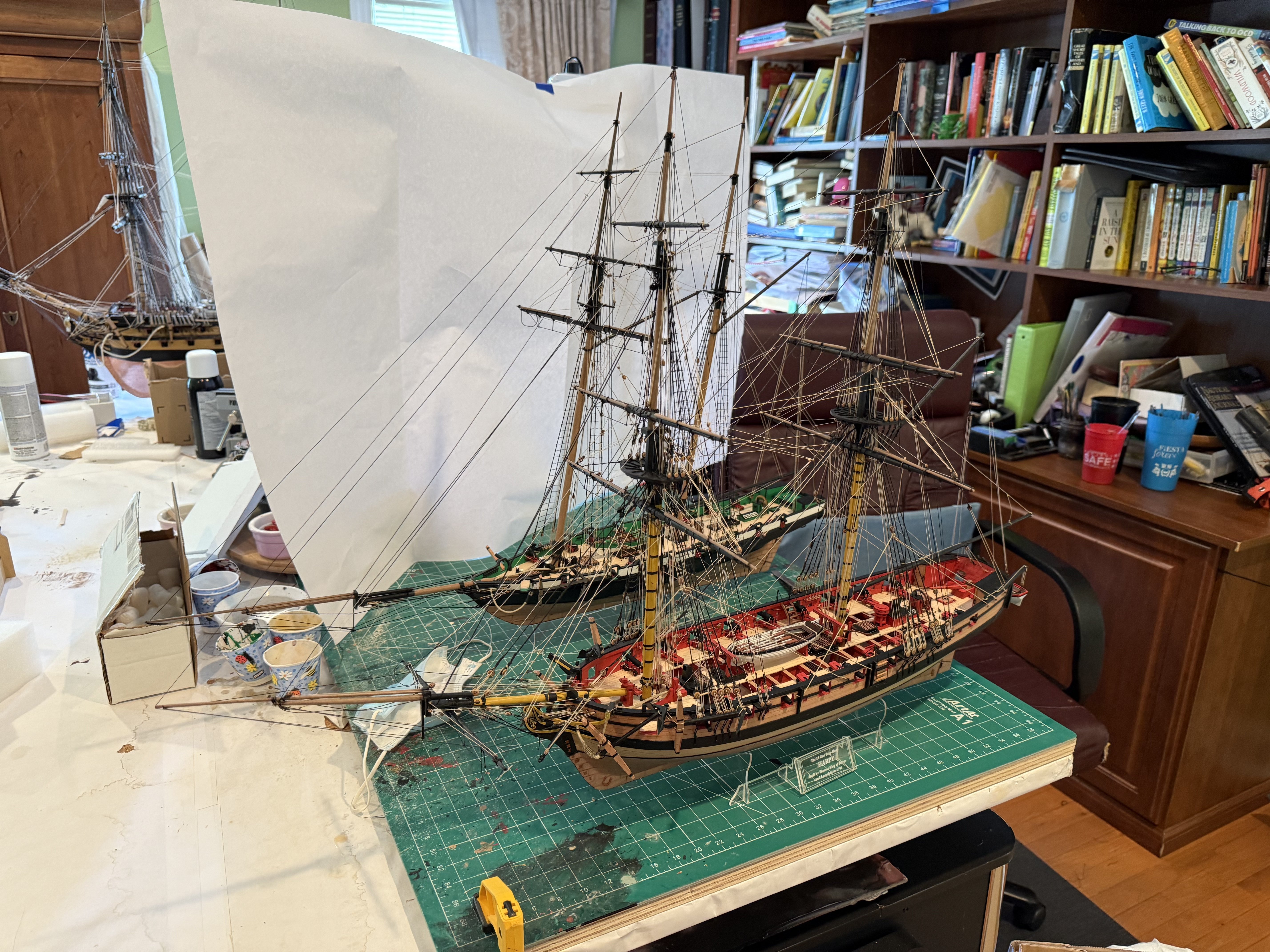

Next to my last project, Harpy. Same scale but much less beamy. In the background you can see Agamemnon, same scale 1:64
IMG_0394.thumb.jpg.6f2ffb28cf2fa7822e1569d04ee9ae19.jpgIMG_0395.thumb.jpg.99bf41991eb44cfe2db89126af68442a.jpgIMG_0396.thumb.jpg.4fc7e4aeff9b09077ed05289e2cb5a02.jpgIMG_0397.thumb.jpg.46441f212e12f0931f0a2136fecc7464.jpg
My next project will take some time
Great job ECK, as always, and thanks for the comparison photos!   It's an eye opener to see these ships side-by-side.  With your collection of high-quality builds it would be wonderful, though undoubtedly a lot of effort for you, to make a photo shoot of everything together that you have in 1:64.
Perhaps you could even think about making a big diorama in your garage!  (Just kidding!)   But Victory will make an excellent flagship for that fleet.

Congratulations!  Grecian is a beauty.  Wonderful work.
Her and Harpy side by side is just fabulous.  Thanks for sharing them together like that.
