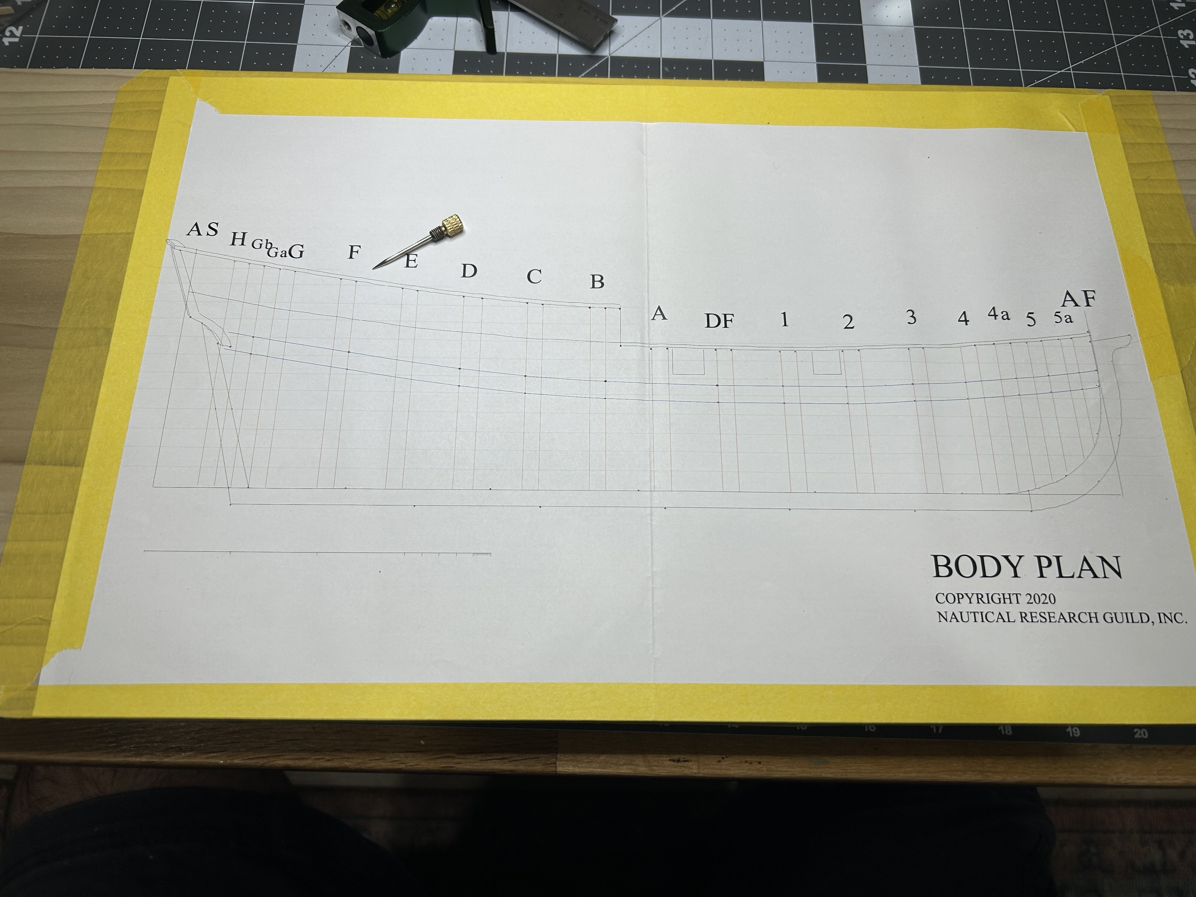

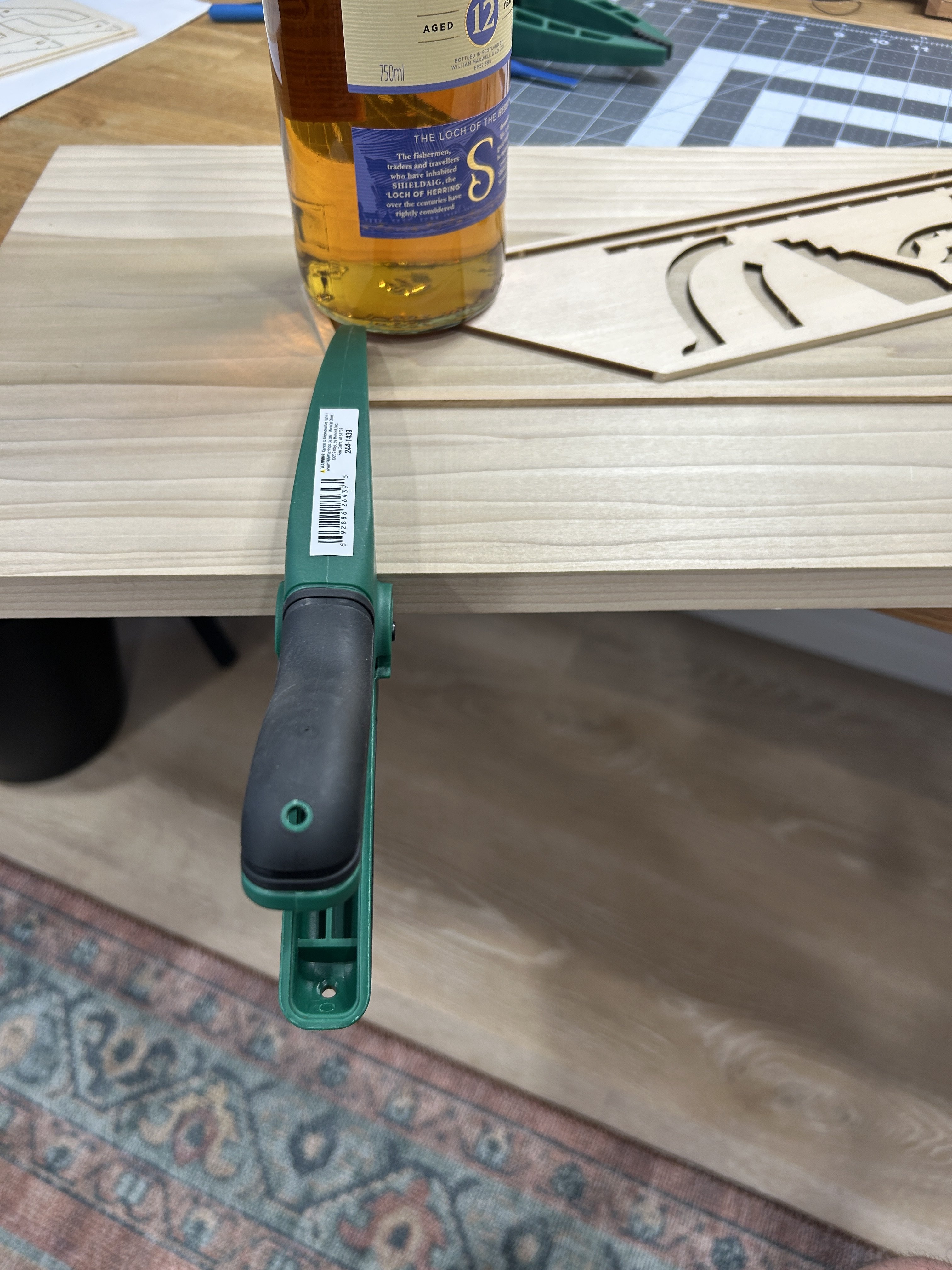

The instructions have you glue the print to the foam board.  Since my board will be the permanent display board I didn't want to glue the plan to it, but I needed to find a way to transfer critical points to the board I was using.  I taped the plan to the board and used a small awl to transfer critical points to the building board.
I then connected the dots to have some reference points for gluing the various parts to the building board.  I then removed material from the keel, keelson, stem, deadwood and other related parts to create the rabbet.  After creating the rabbet, I glued the parts to the building board using the small marks made with the awl to get everything placed properly.  The board I used is big enough to accommodate a frame that I intended to add after the half hull was compete, so there was a significant distance to the edge and some parts of the model and clamping created some challenges.  I was able to get creative with a bottle of scotch to get a strong bond to the building board.  I used Titebond Wood Glue for almost everything on this model.

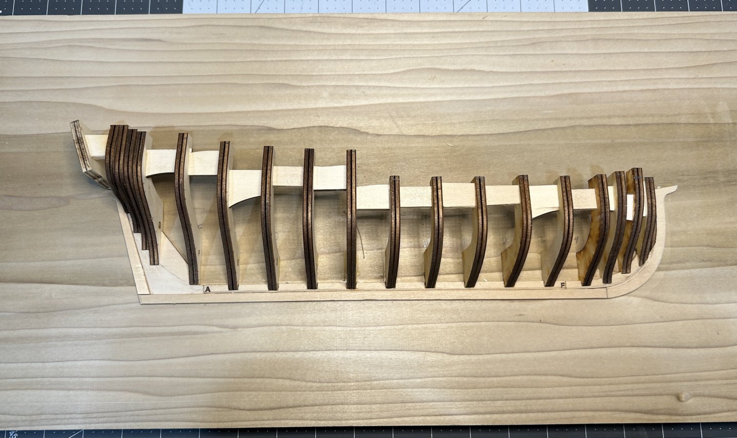

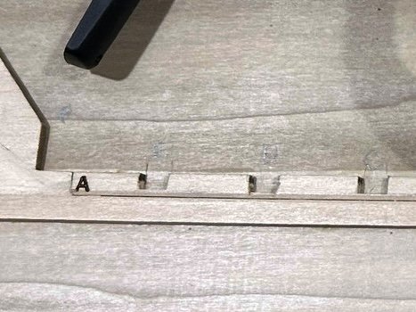

After gluing the keelson to the building board, I used some micro chisels purchased from Lee Valley Tools to deepen the notches that the bulkhead will fit into.

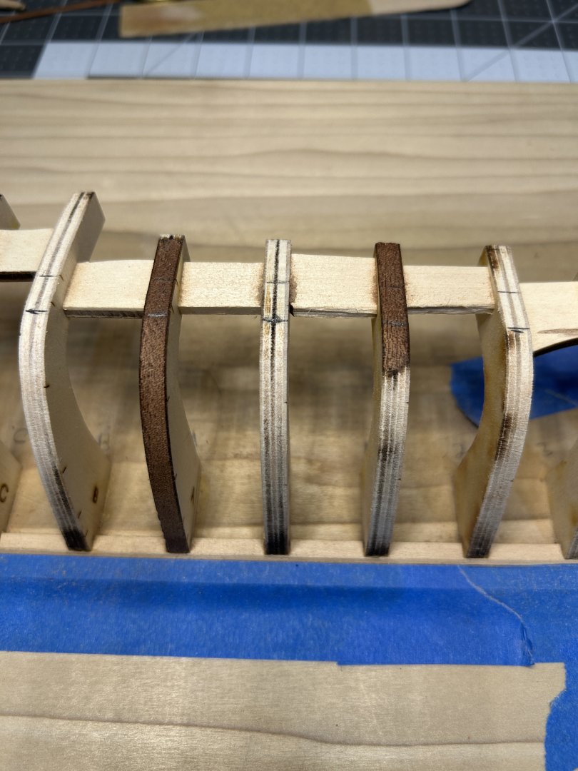

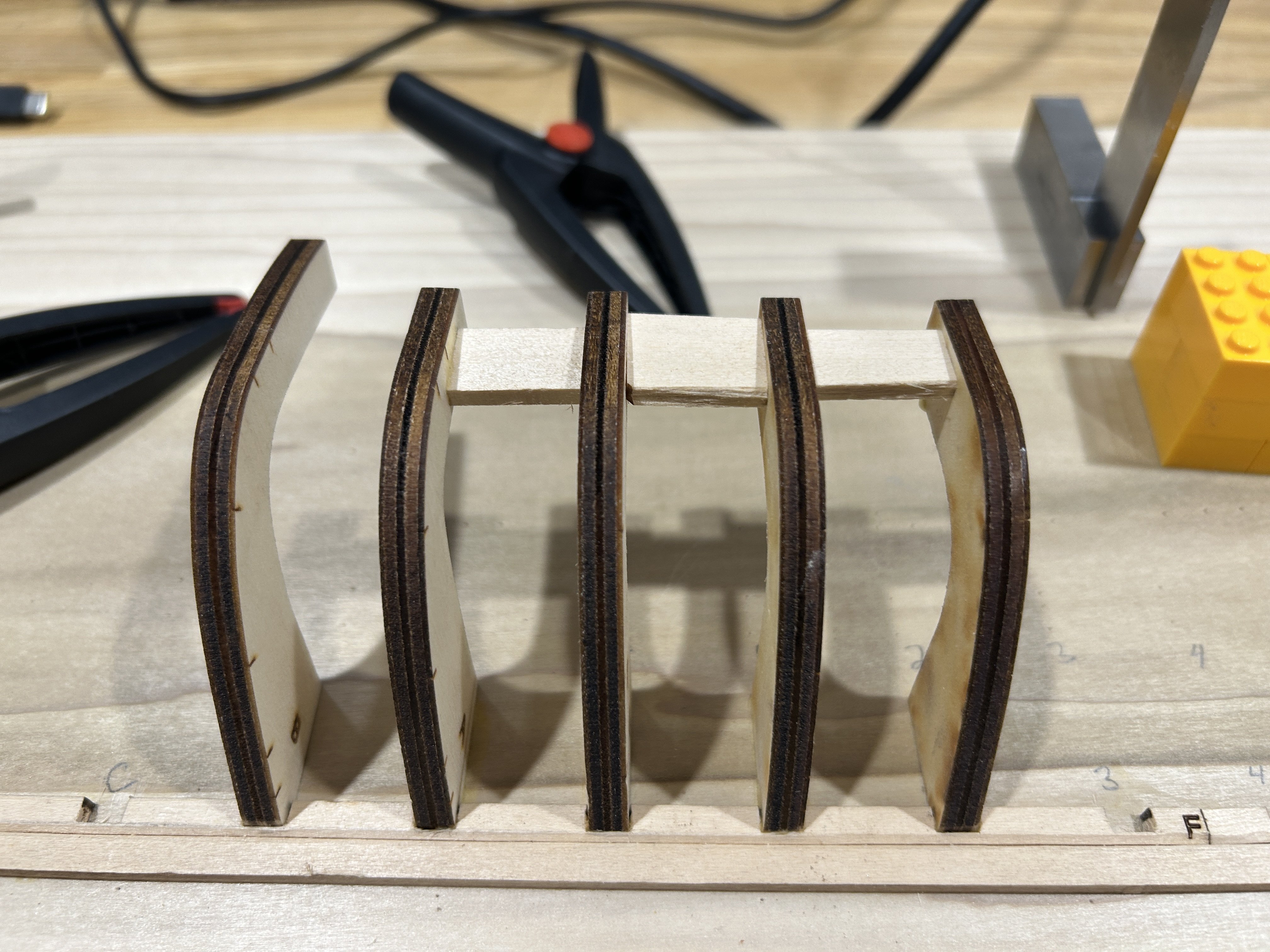

I used a machinists square, legos and a few other items to keep the bulkheads square.  I was a little skeptical of how good of a bond I would get to the building board since there was no downward clamping pressure where the two items met.  I was pleasantly surprise at how secure the bond is.

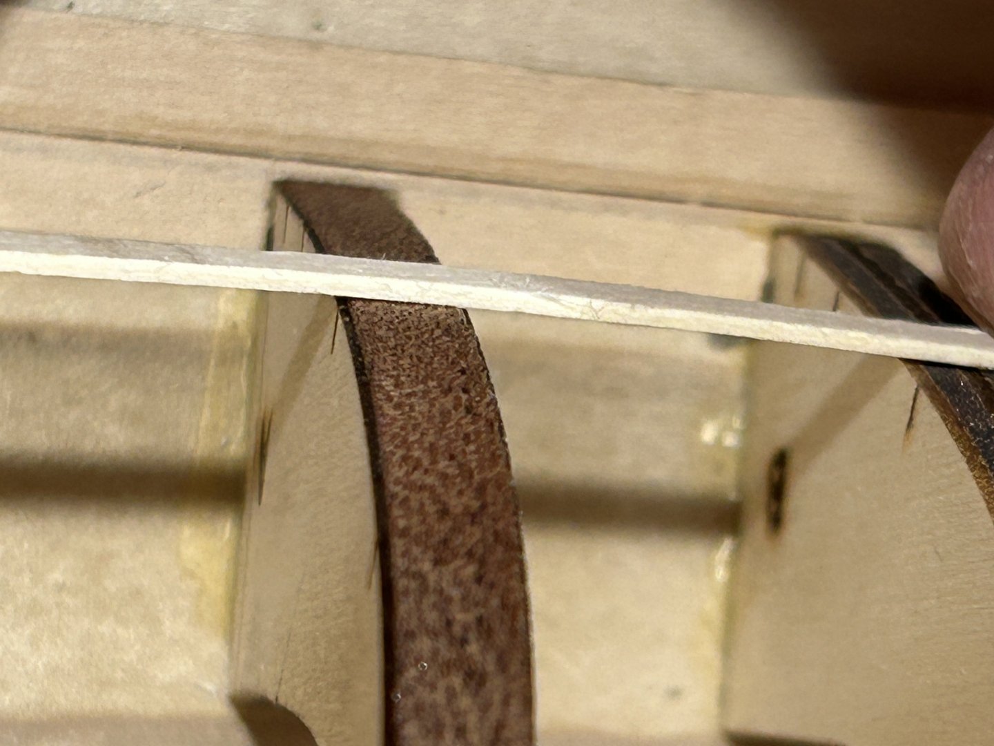

The kit came with laser cut pieces to glue between the bulkheads for added strength and stability.  I found these were just a bit on the small side to use.  At first I worried that it was because my bulkheads were not square, but I never ran into a situation when they were too big, so I decided they must just be a little too small.   I used scrap wood to create the parts needed.

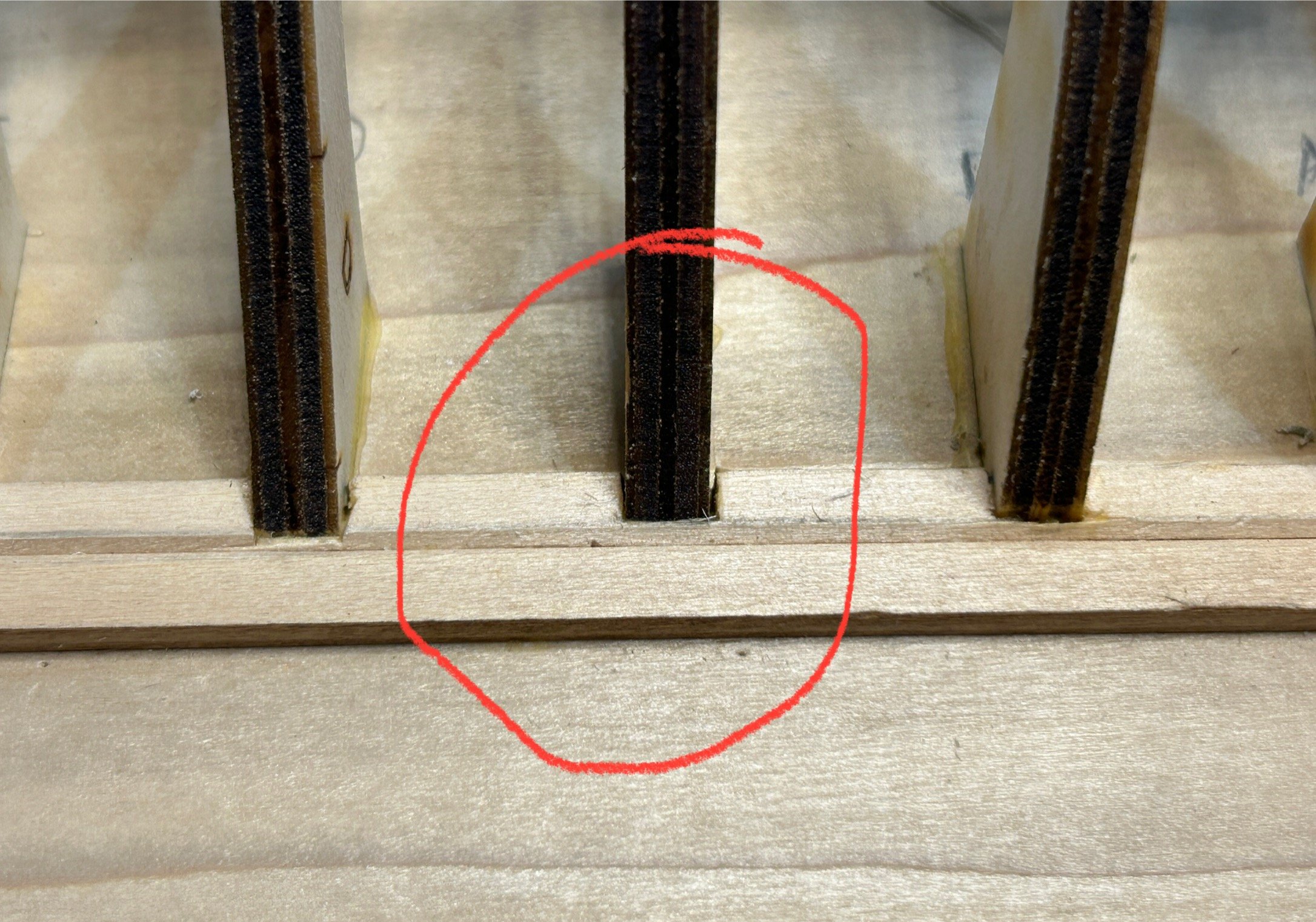

It became obvious that some of my bulkheads would require shims.   In at least one case it was because I didn’t make a deep enough cut in the keelson.

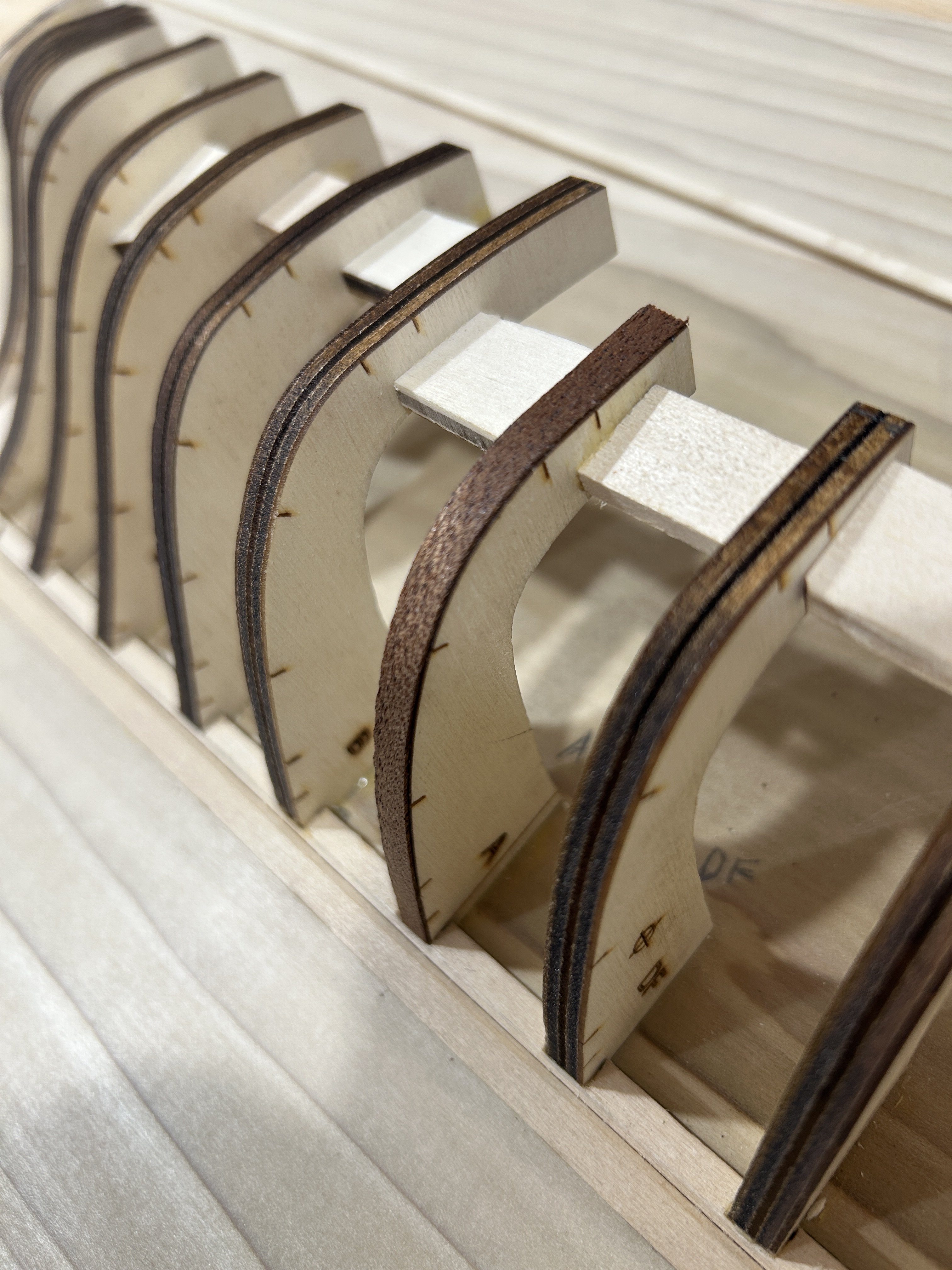

I had some .6 mm sapeli left over from my Occre builds, and dimensionally it worked great.  It is so flexible it fit around curve of the bulkhead easily.   The only issue I ran into is the dark color made pencil marks difficult to see.
Next up is fairing the hull.

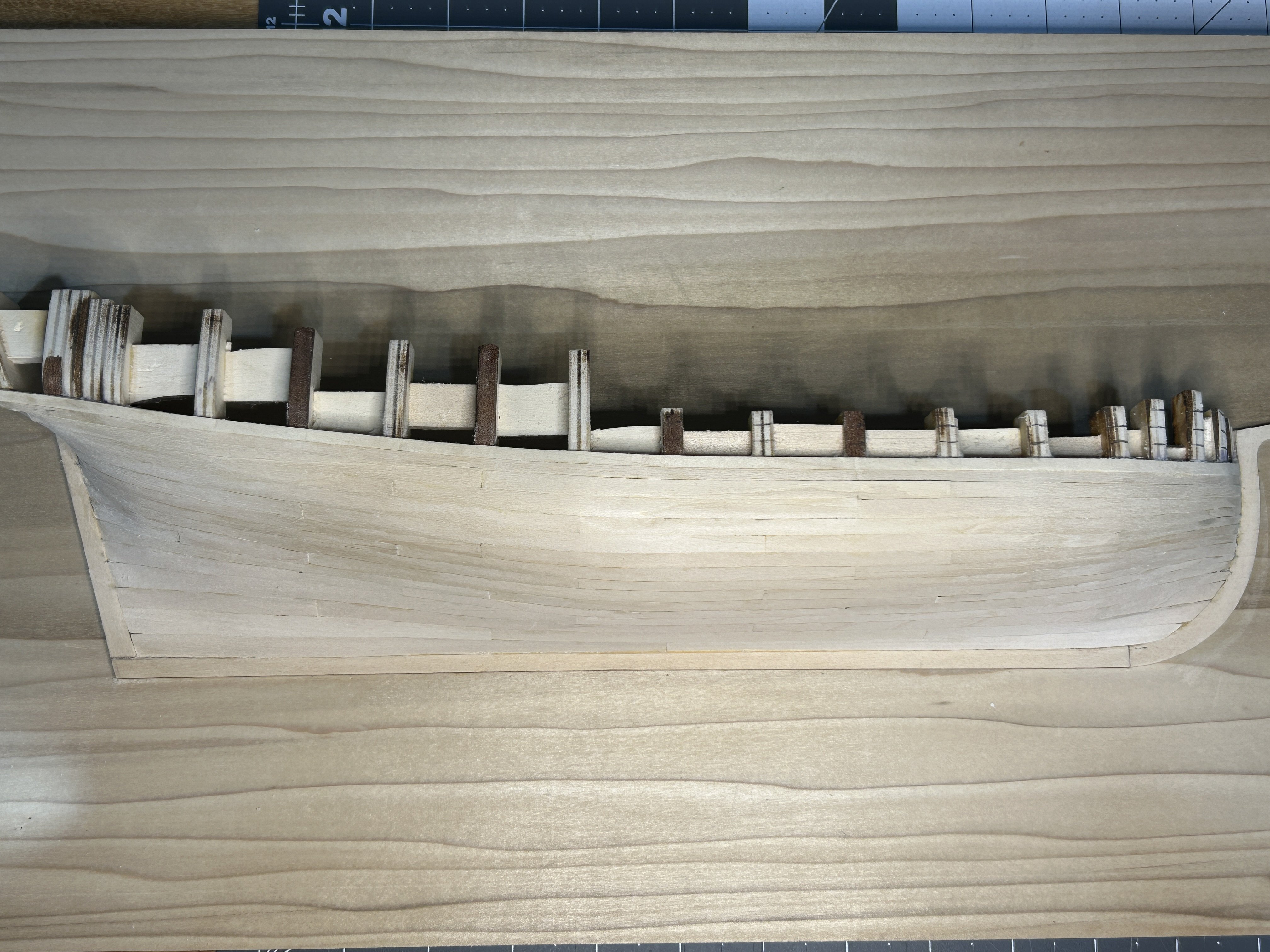

For fairing the hull I made some sanding sticks out of some paint stir sticks and some smaller ones out tongue depressors.   Those in conjunction with this flexible sanding tool were used to fair the hull.

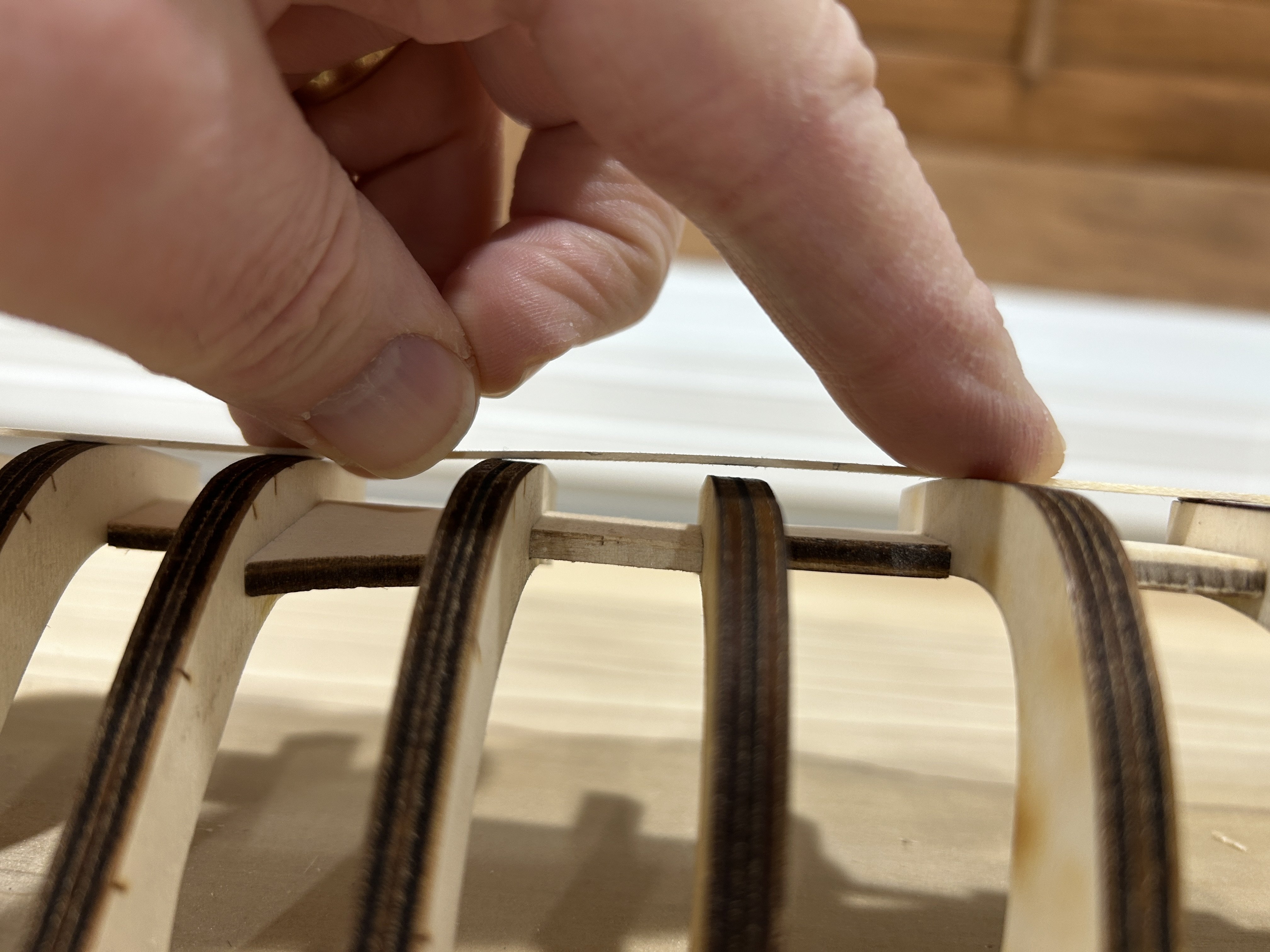

I think fairing a hull is the least enjoyable yet most important steps in building a model.   I found I needed to work in small amounts over several days.   Frequent checking with a plank and patience are the keys.   I shimmed a couple more bulkheads to get things right.

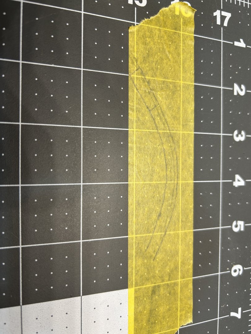

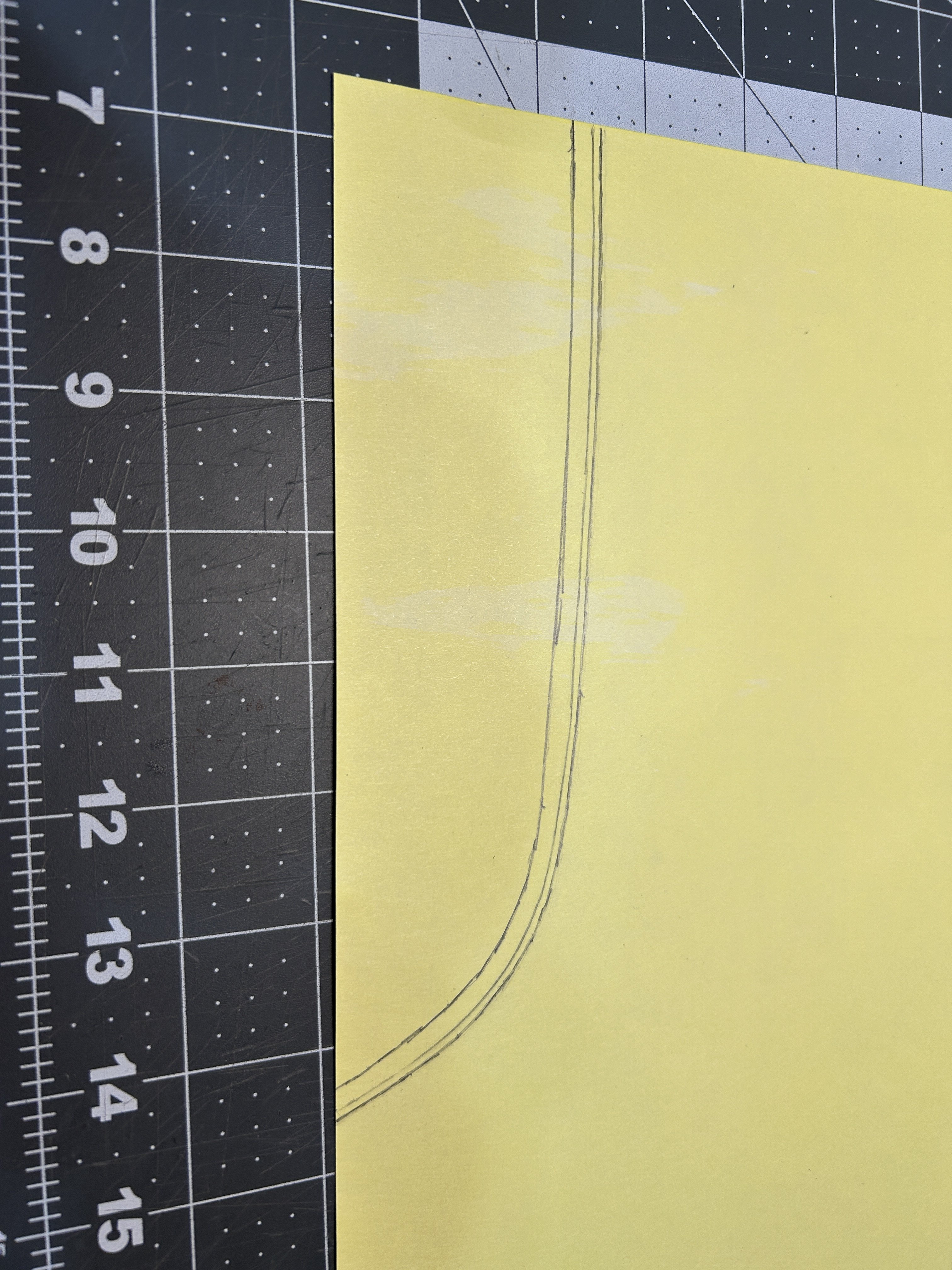

One area where I deviated from the plans was the method that I used to create the tape template.  The instructions used blue painters tape and a compass to mark the bottom edge of the plank.  Instead of traditional blue painters tape, I used Frog Tape brand Delicate Surface painters tape which is a translucent yellow color.  I start my process by making sure that the tick marks on the bulkheads are as dark as possible.  I then place the tape across the bulkheads.  The marks show through the tape.
I then use a carpenters pencil and lay the lead across the top edge of the plank below the one I am creating and make a pencil mark on the tape to make the mark for the bottom edge of the plank I am creating.
I then trace the tick marks that represent the top edge of the plank on the tape.  I put the tape onto a light colored section of my cutting mat and use a french curve, ruler and anything else I can find that connects the tick marks with the correct curve.

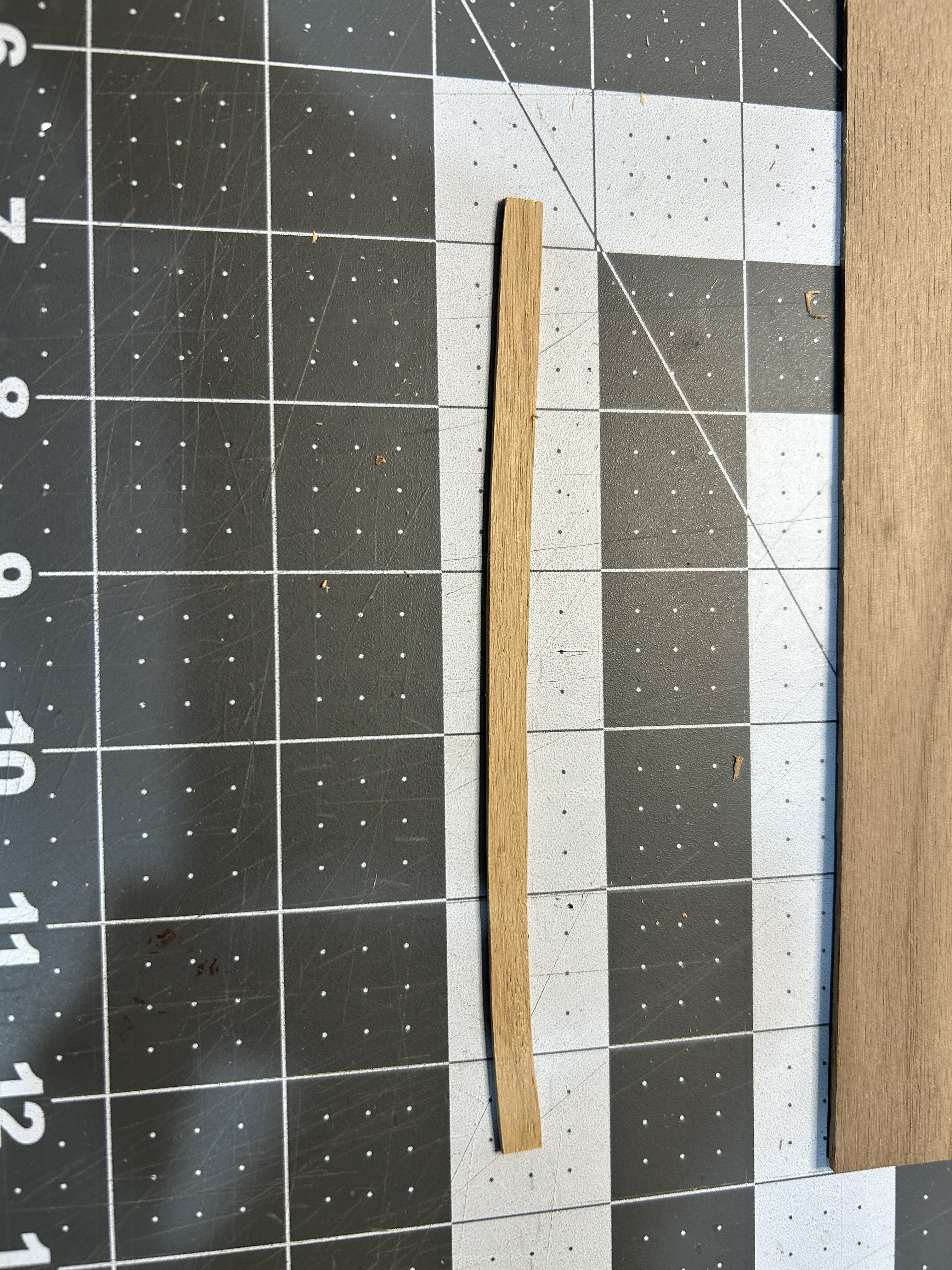

You may have noticed in some of my photos, the wale was installed using a darker colored wood.  I decided to buy some walnut and use that for the wale, cap rail and any of parts that were colored black in the prototype.  The wale will consist of 2 layers of 1/32 material.  After installing the first layer for the wale, I was not satisfied with the result.  I struggled to get a smooth edge.  I decided to remove the first layer and create the first layer with a continuous strip of basswood to ensure a nice smooth edge.  I used two 1/32 x 1/8 inch strips for the bottom layer.  I will complete the wale with the walnut on the second layer.

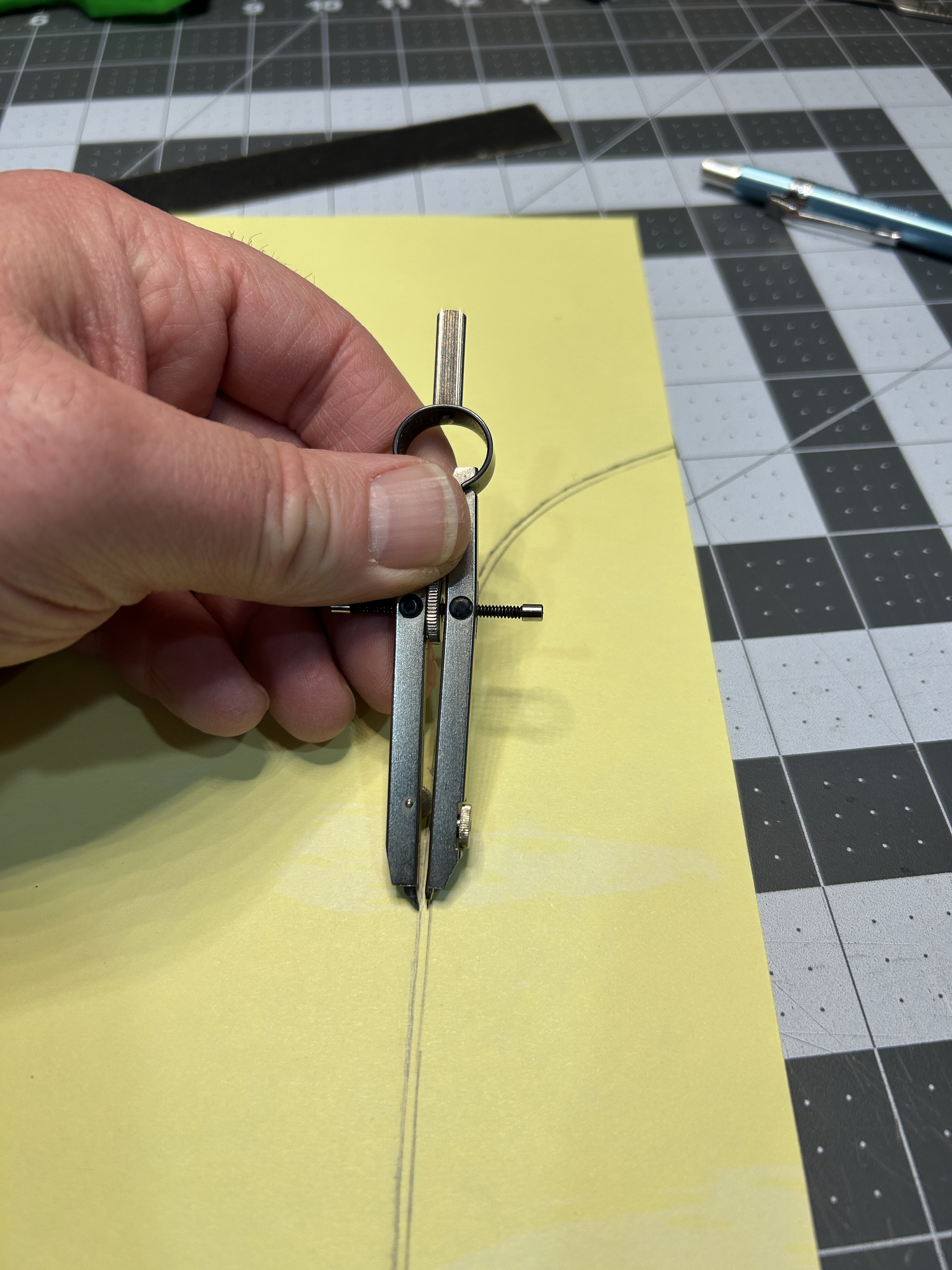

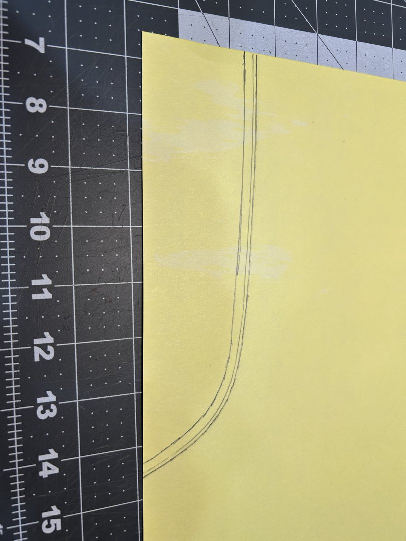

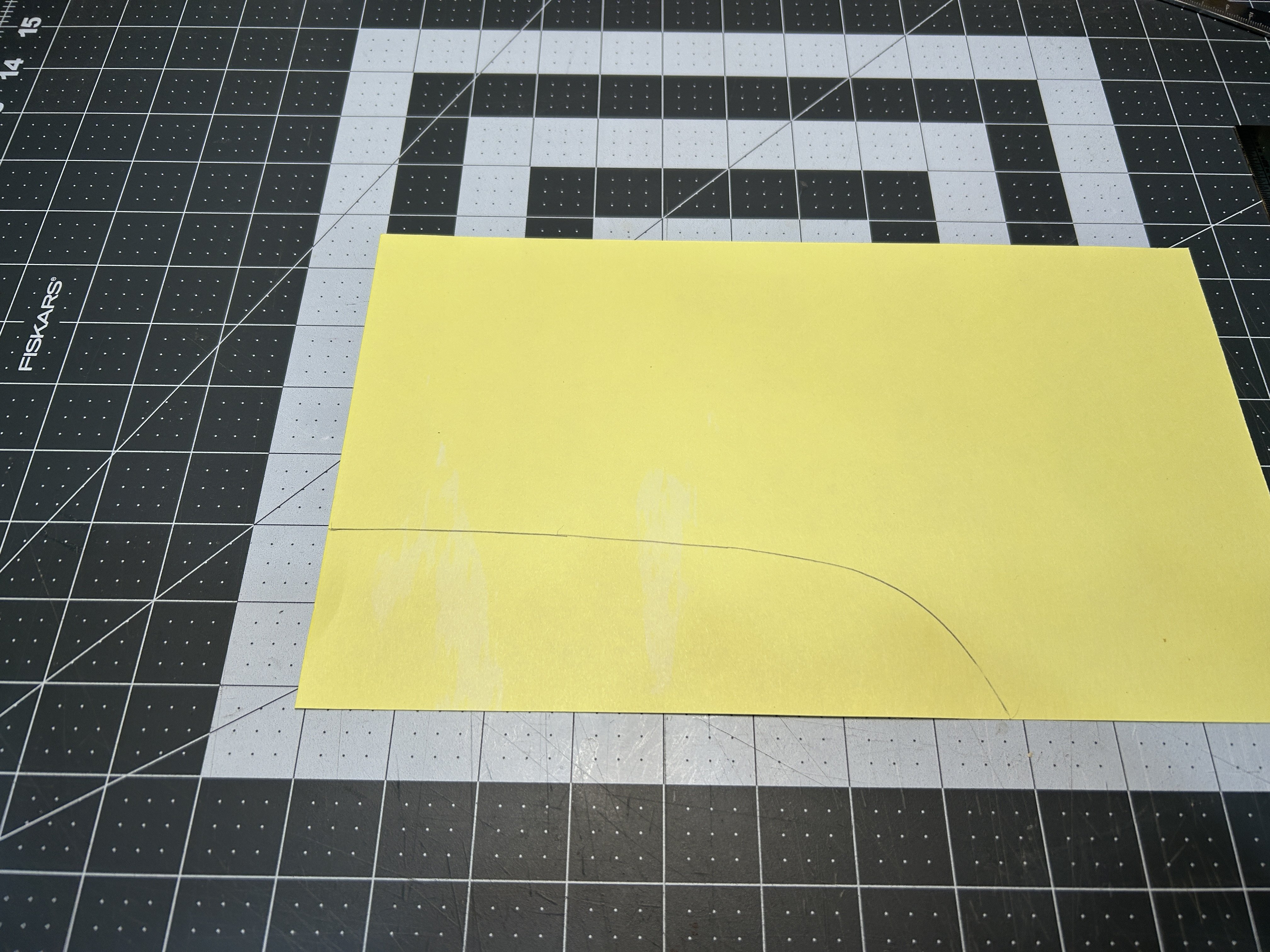

To create the template for the cap rail, I used a piece of cardstock and traced the outside line of the rail.  I then used a compass to create the the full width of the cap rail.

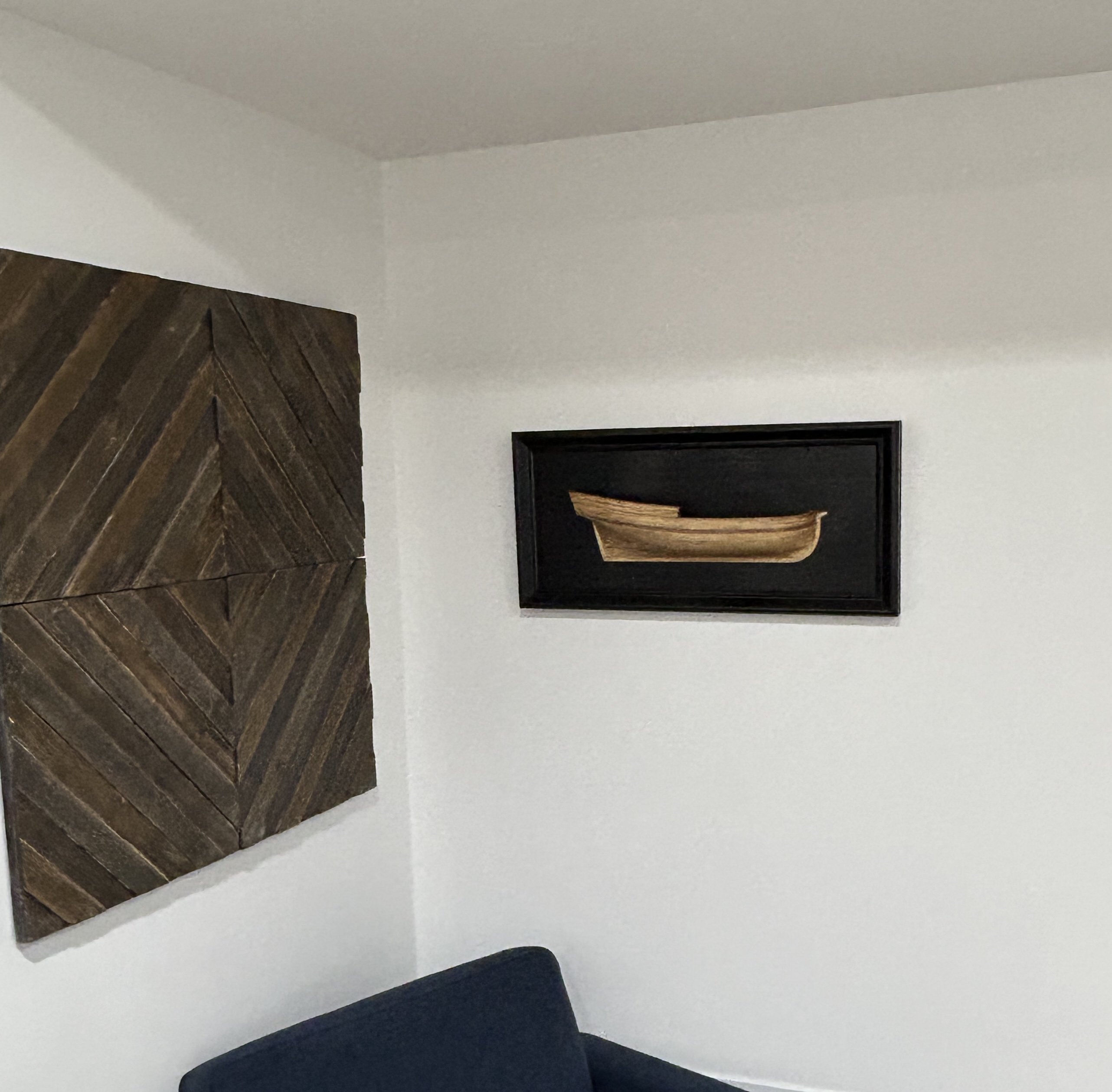

I finally have it hanging on the wall.  Thanks for all the nice comments.
Looks great hanging on the wall!  Nice job. Well done.
