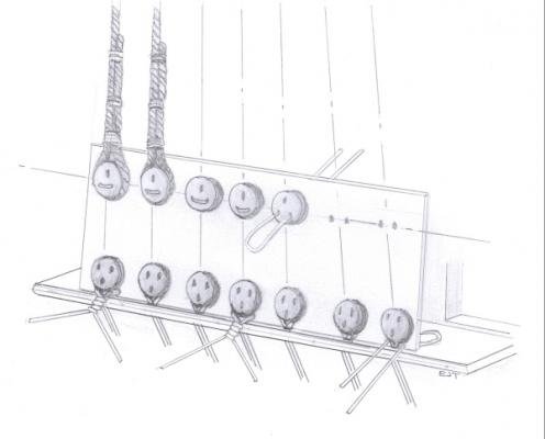

Rigging always gives me fits. One area I find myself re-doing the most frequently is getting the deadeyes even when attaching to the shrouds. Any tutorials to refer to re" this?
Many use a jig of some sort.  Often it is a stiff wire between the deadeyes.

While the jig solves one problem, it creates another - that of making the throat and end seizings 'in the air'.
I use a jig simply to mark the underside of the line where it wraps around the deadeye. After removing the shroud or shroud pair, I can hold things using third hands while applying the seizings. Then I pop a deadeye into the bight (the line has sufficient stretch to do this) and reinstall the shroud over the masthead.
For a second there Greg, I thought you looked at my jig and made a drawing of it..😁
I must have seen yours at some point and used the design.

Hi. I follow the  procedure where the upper deadyes are already attached on the edge of a shroud
but the seizing knots are slidable. So I have the ability to align all of them.

I do similar way as you but a bit different. My shroud deadeyes are removable off the jig. I seize the shroud line pair on the mast first and fix the seizing with drop of CA.  I wrap the deadeyes uninstalled on the jig with shroud ends. Then I adjust the throat seizing location, while trying the shroud tension by putting the deadeye in and out off the jig. When satisfied I set the seizing with drop of CA. Tedious process but this is what I found the best for me for having the deadeyes in line.
So not to be unsubstantiated here is a picture of newly installed shroud deadeyes. They are not yet made tight.
