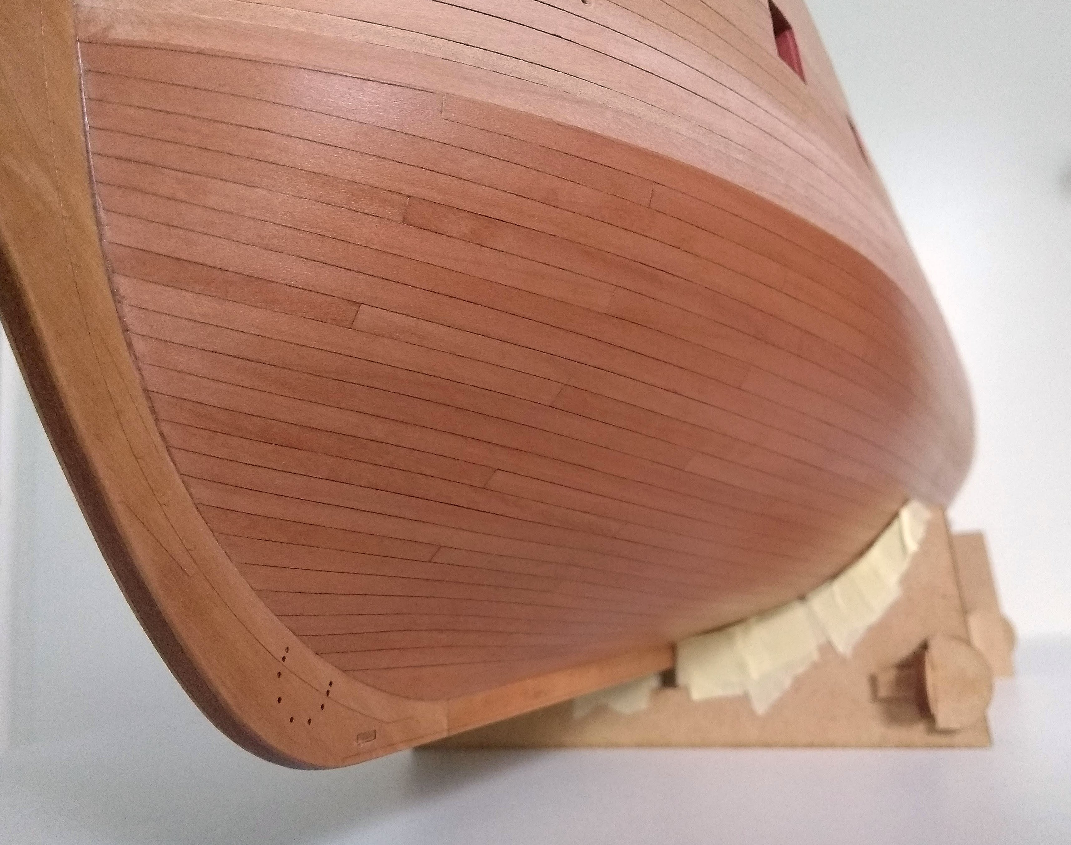

Here's a pic of my Occre Dos Amigos hull (not complete) which I did in cherry. I got the wood from the local (now closed) Woodcraft, and cut with my Jim saw. After sanding I applied a few coats of gun oil. The cherry was good to work with a turns a bit darker with age.

@bigcreekdad looks fantastic! I've found OcCre hard to get a good finish on with those veneer strips! Is gun oil like a tung oil or linseed?

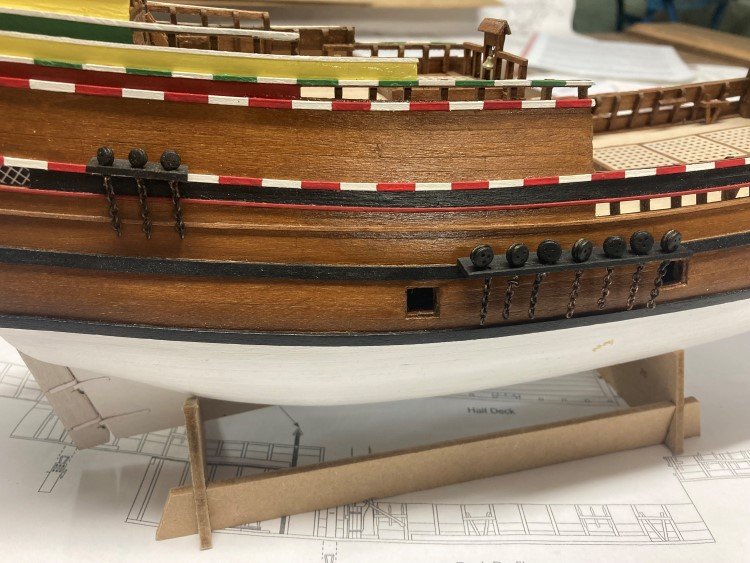

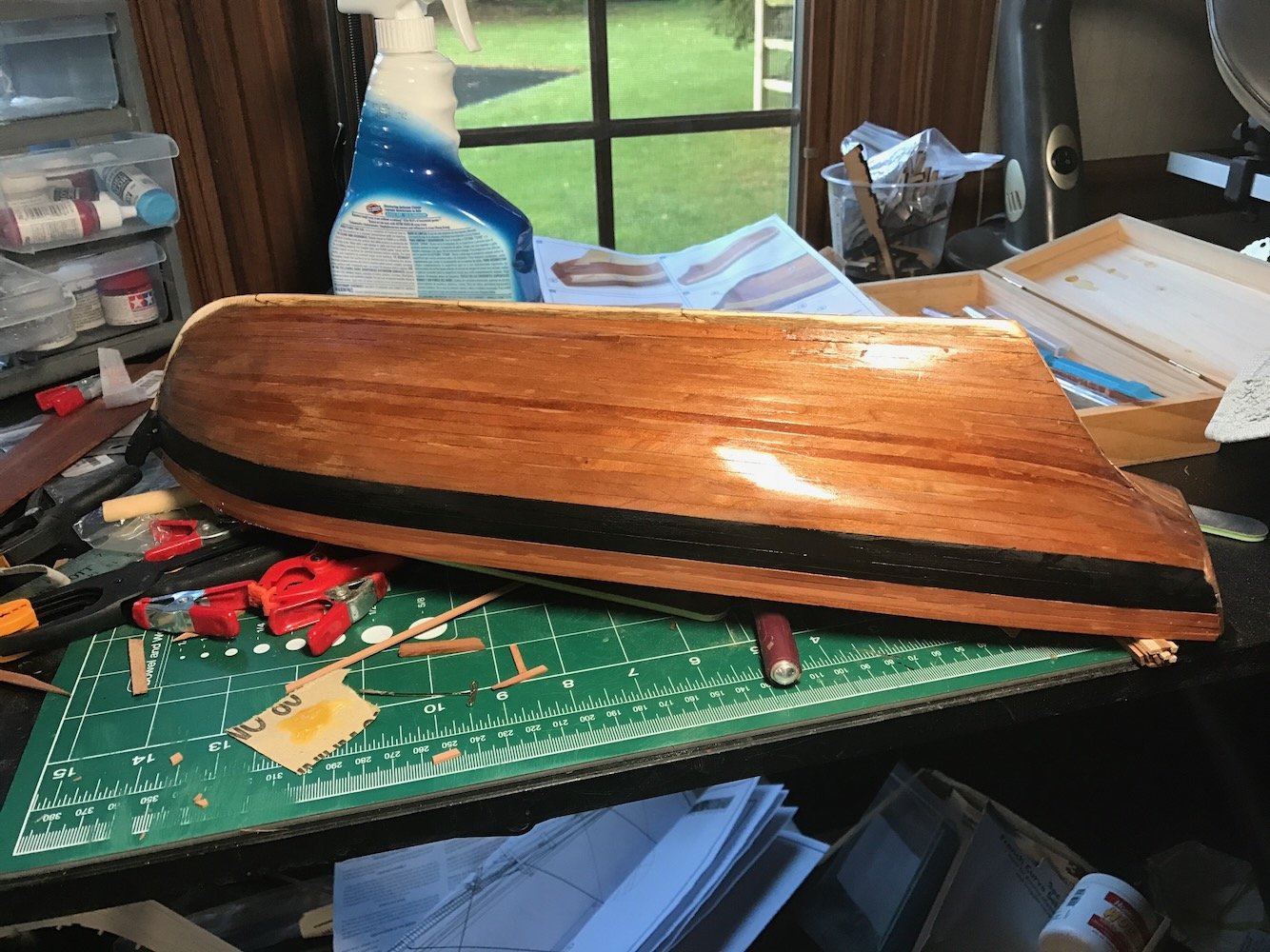

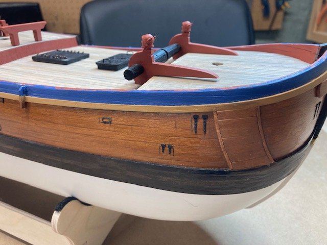

I have always found basswood to be all but impossible to stain successfully. It always wants to go blotchy. So here's what I do to colour it instead and it works quite well for me. I buy cheap Folk Art Paint from Michael's (flat finish) in a medium brown colour. I water it down quite a bit and apply it to the basswood. With a bit of trial and error with the thickness of the paint, it's possible to get an even colour that still allows the wood to show through.
Here are two examples:
In this one, I've used satin poly on top of the paint-
Here, I've used amber shellac over the paint-
Anyway, for what it's worth, that's one approach to dealing with basswood that I have found to work.
David
