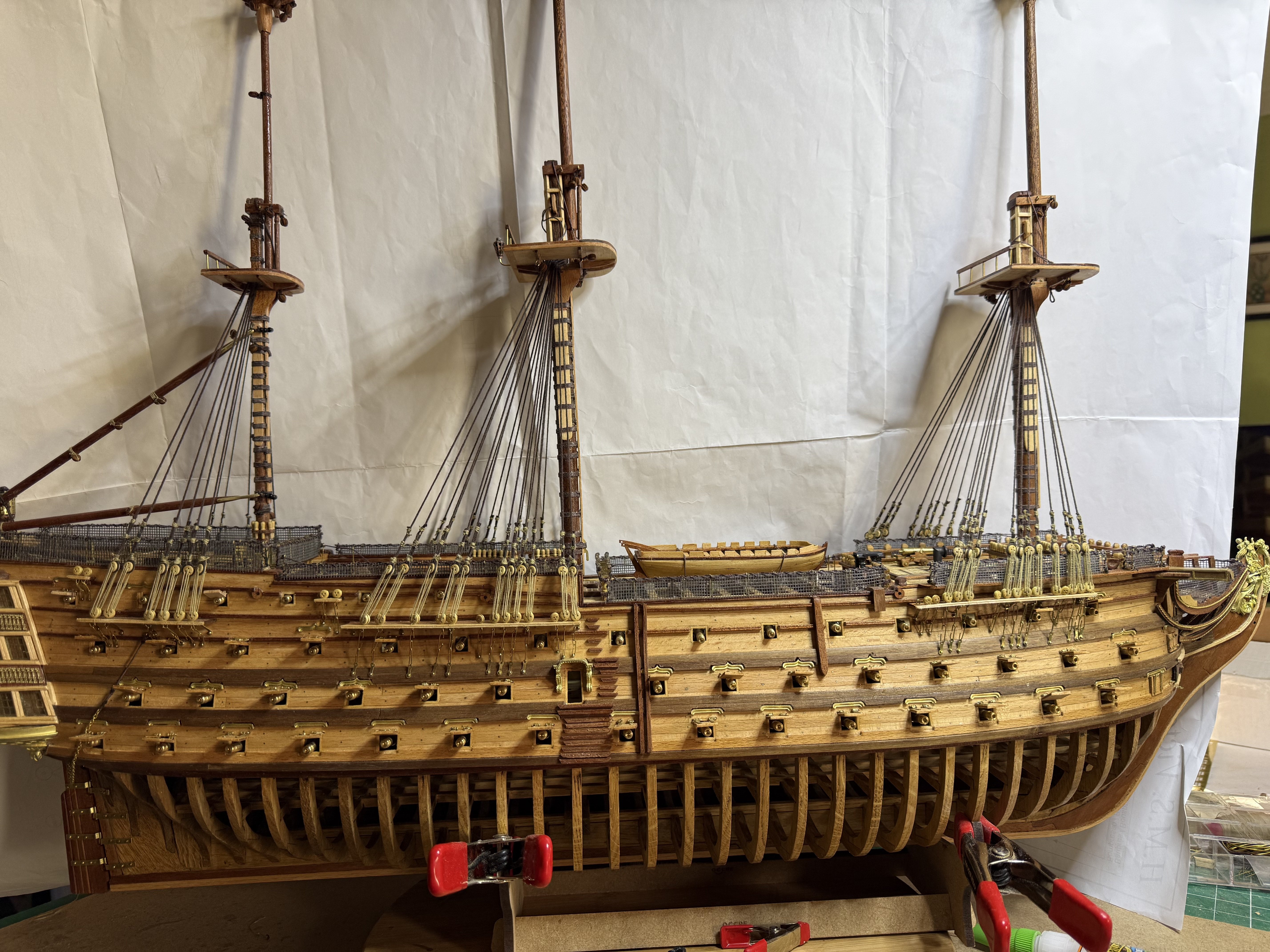

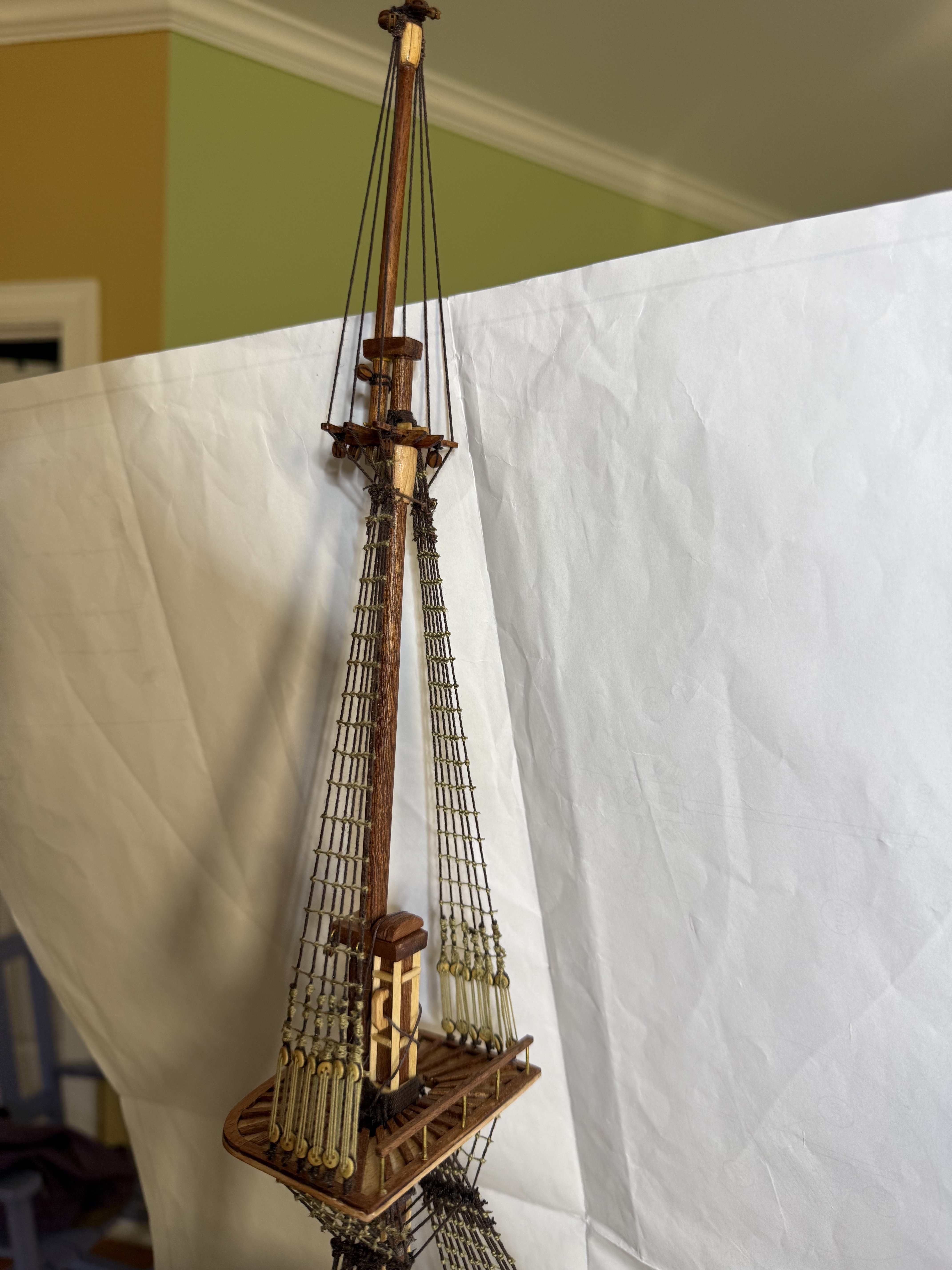

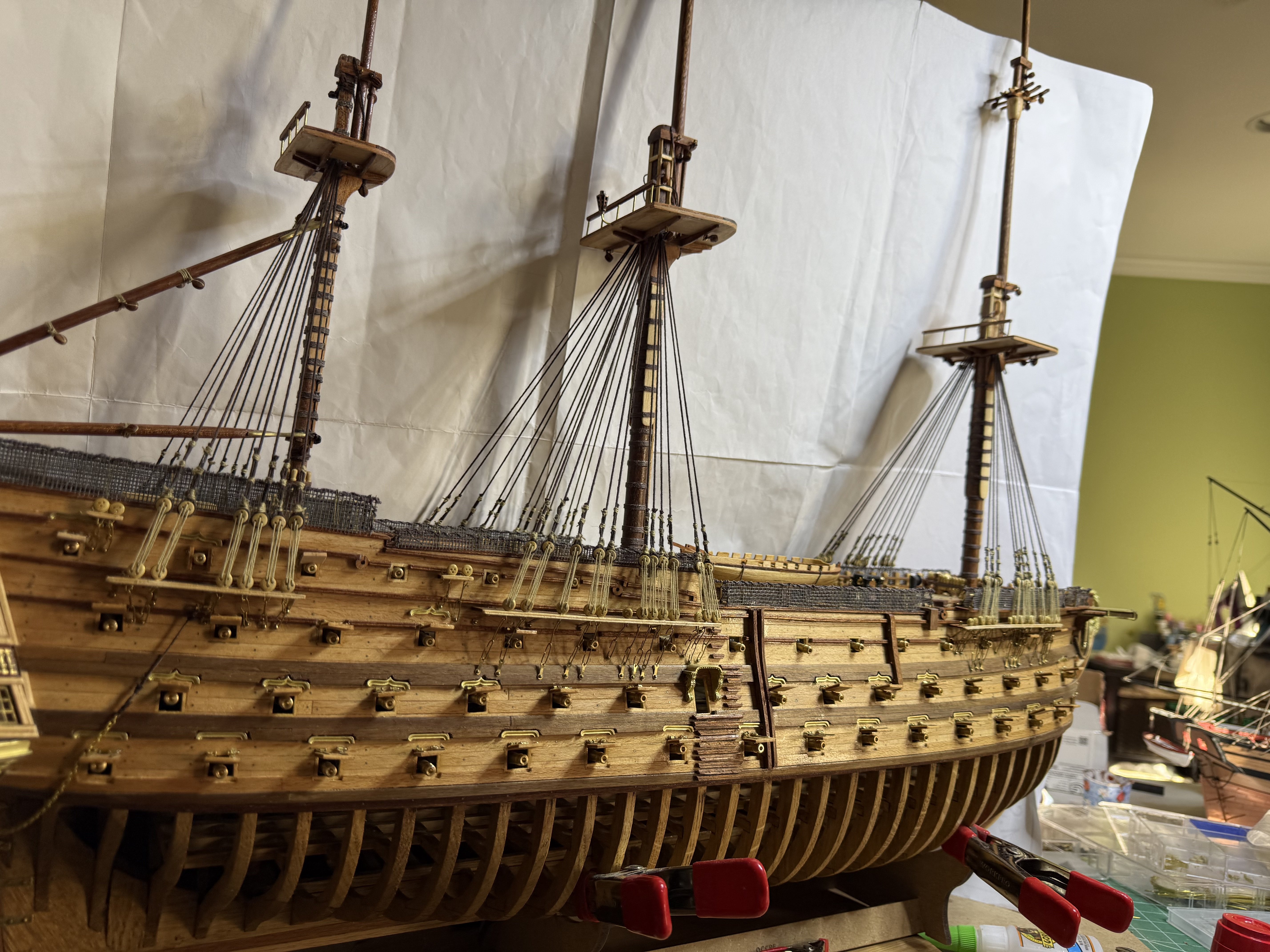

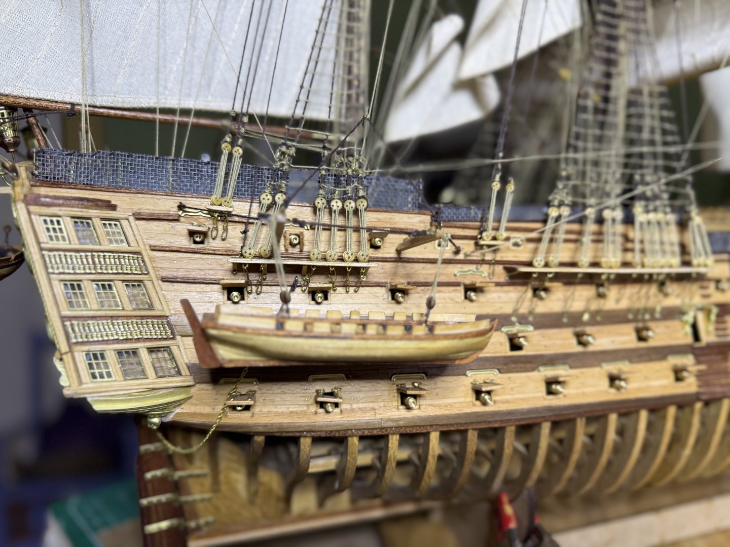

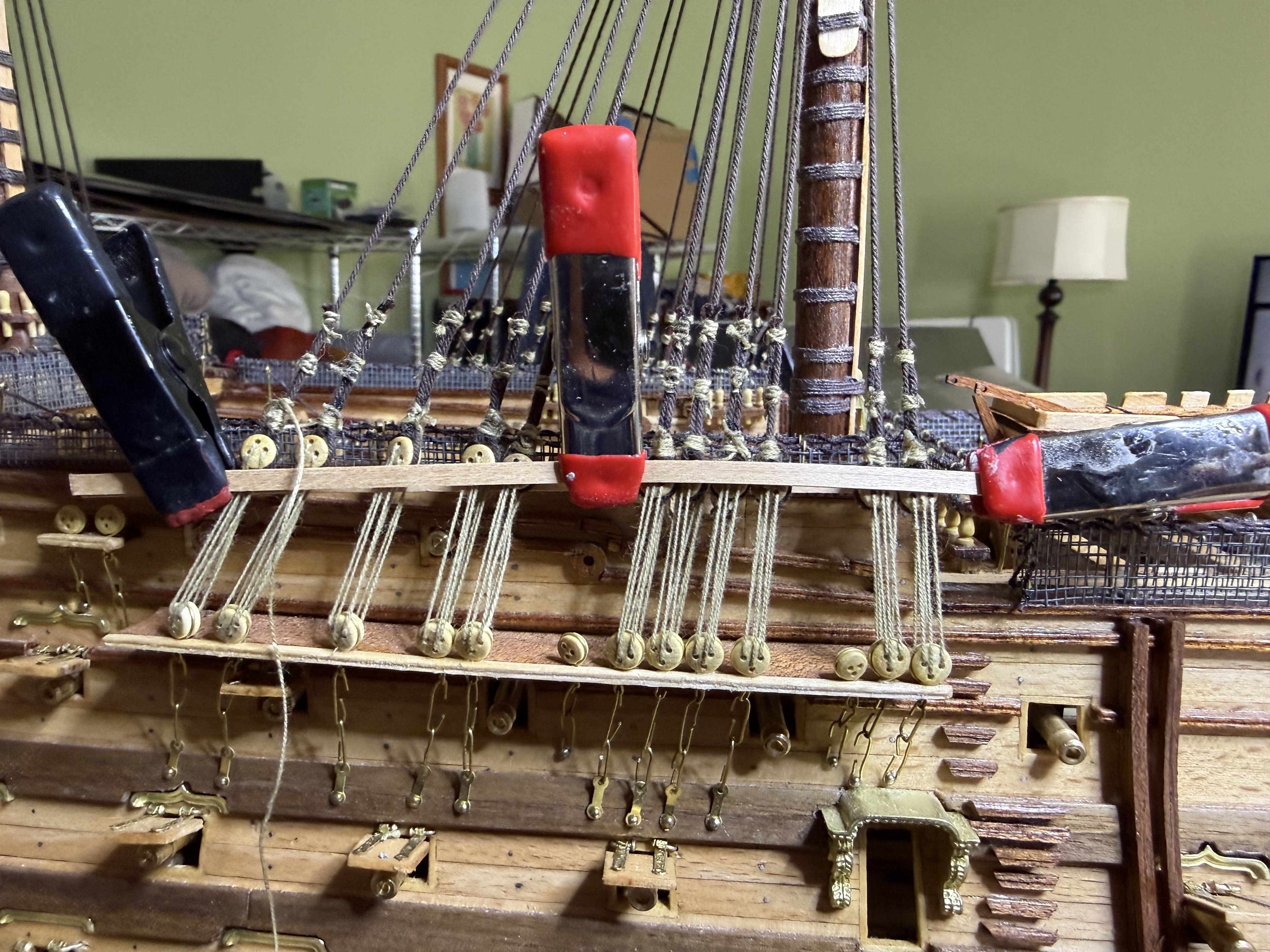

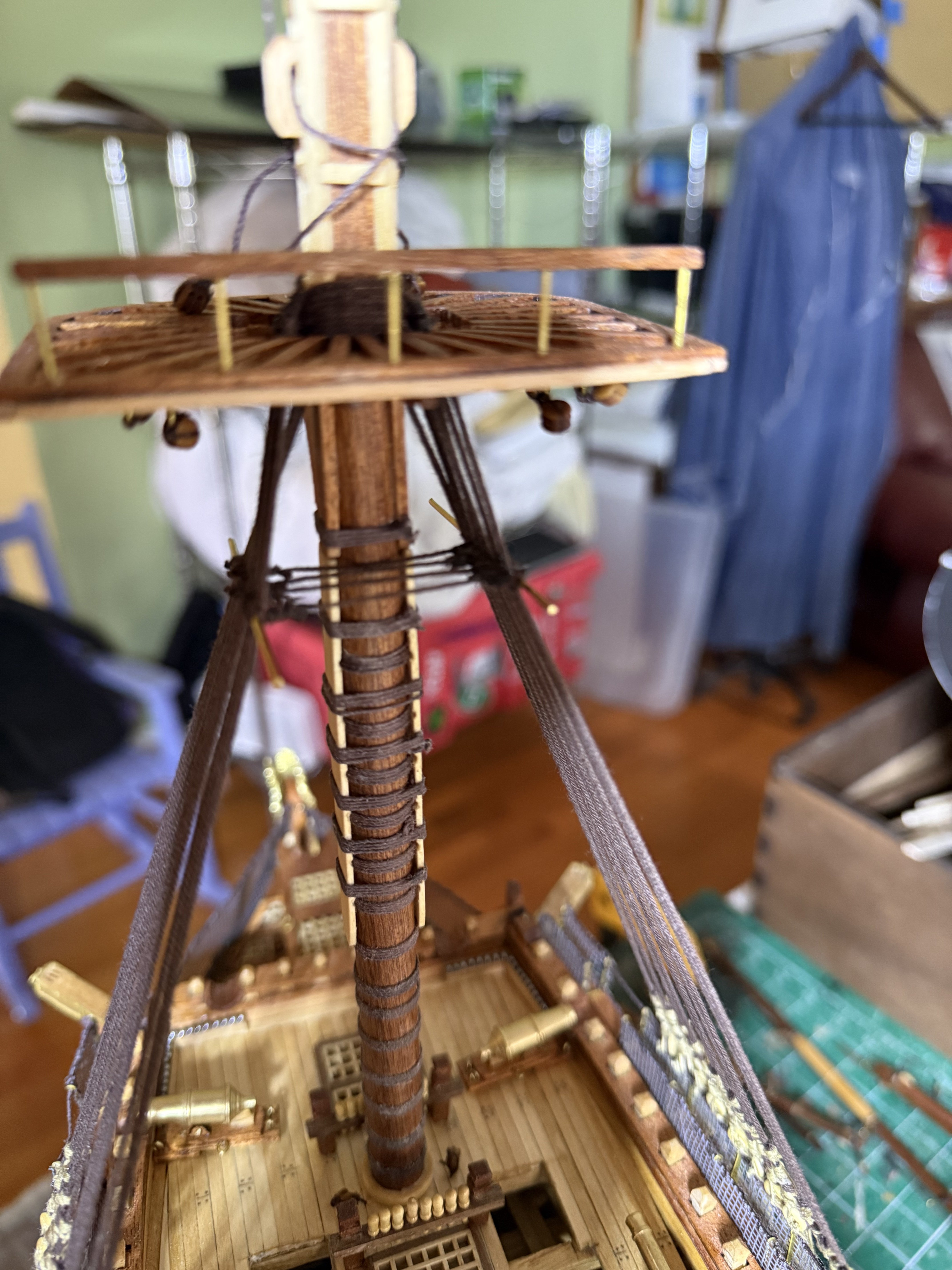

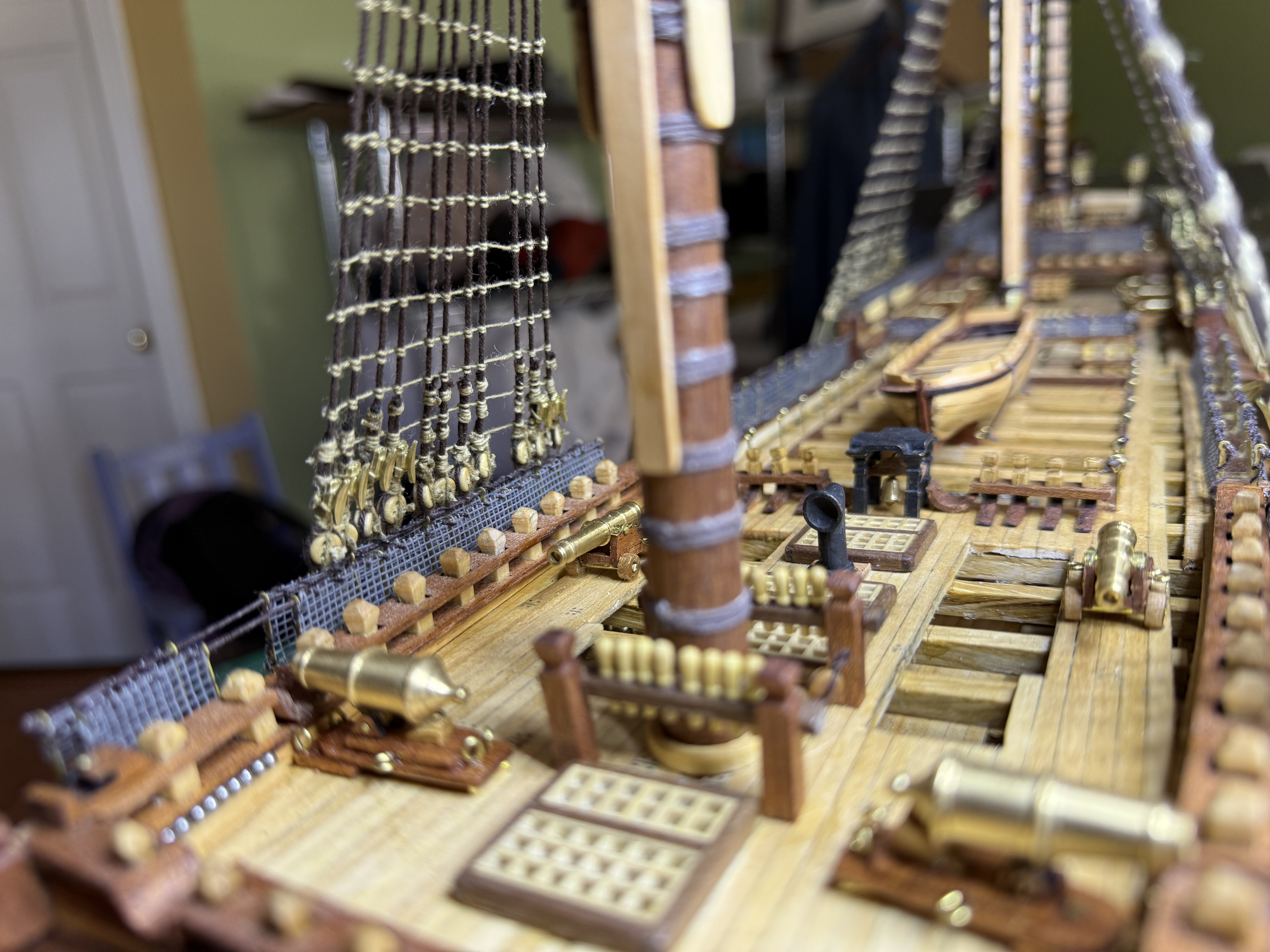

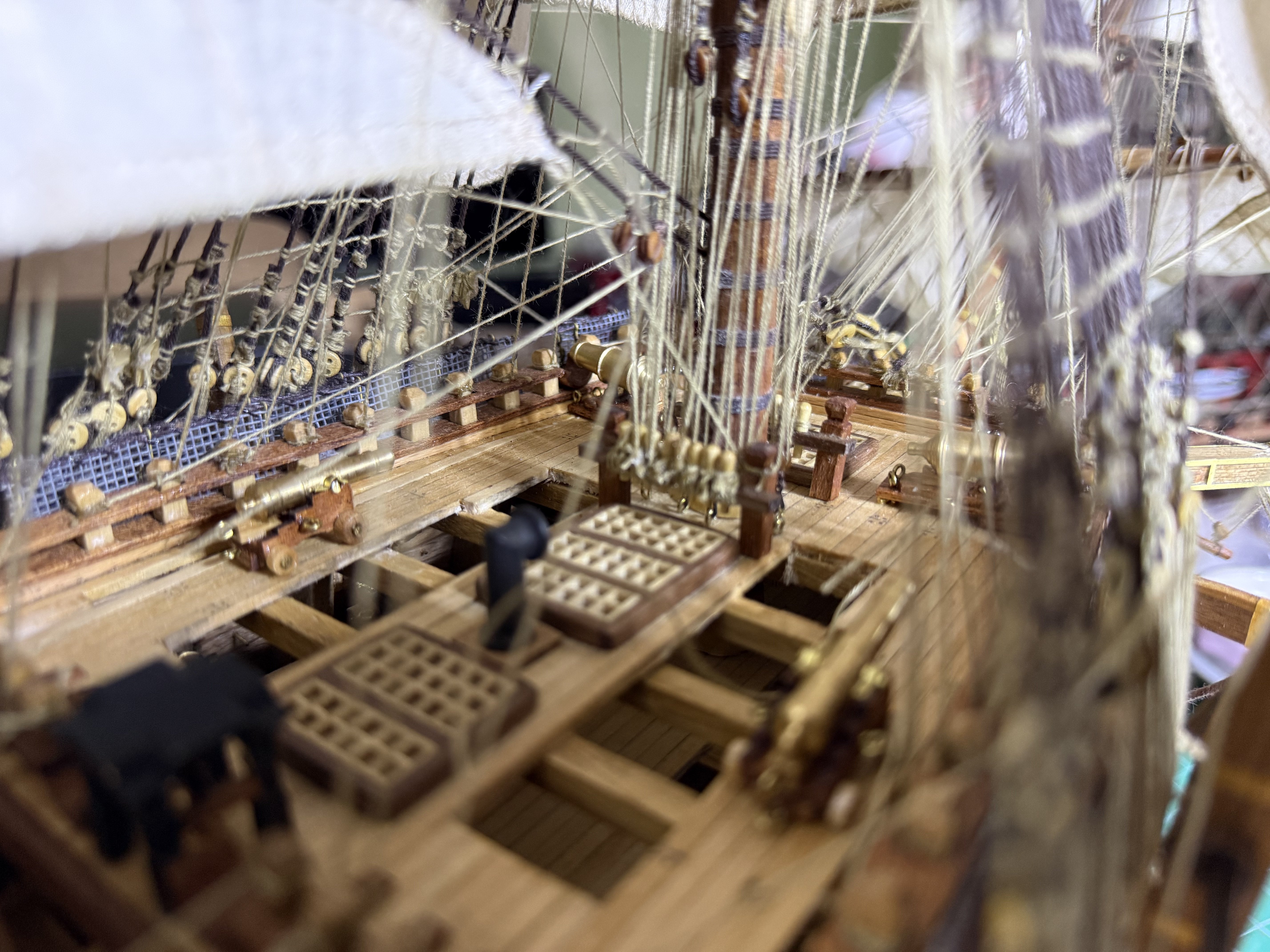

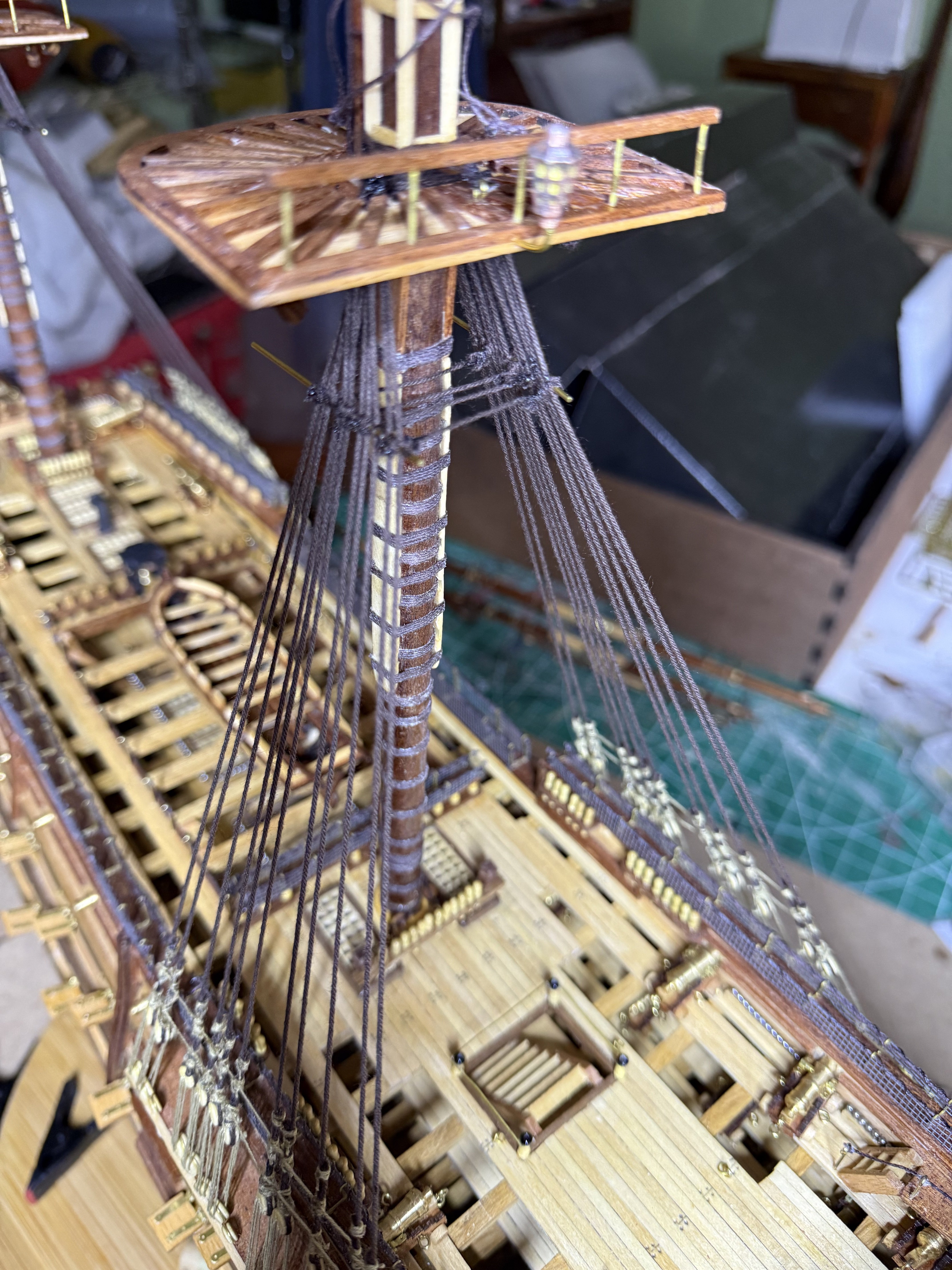

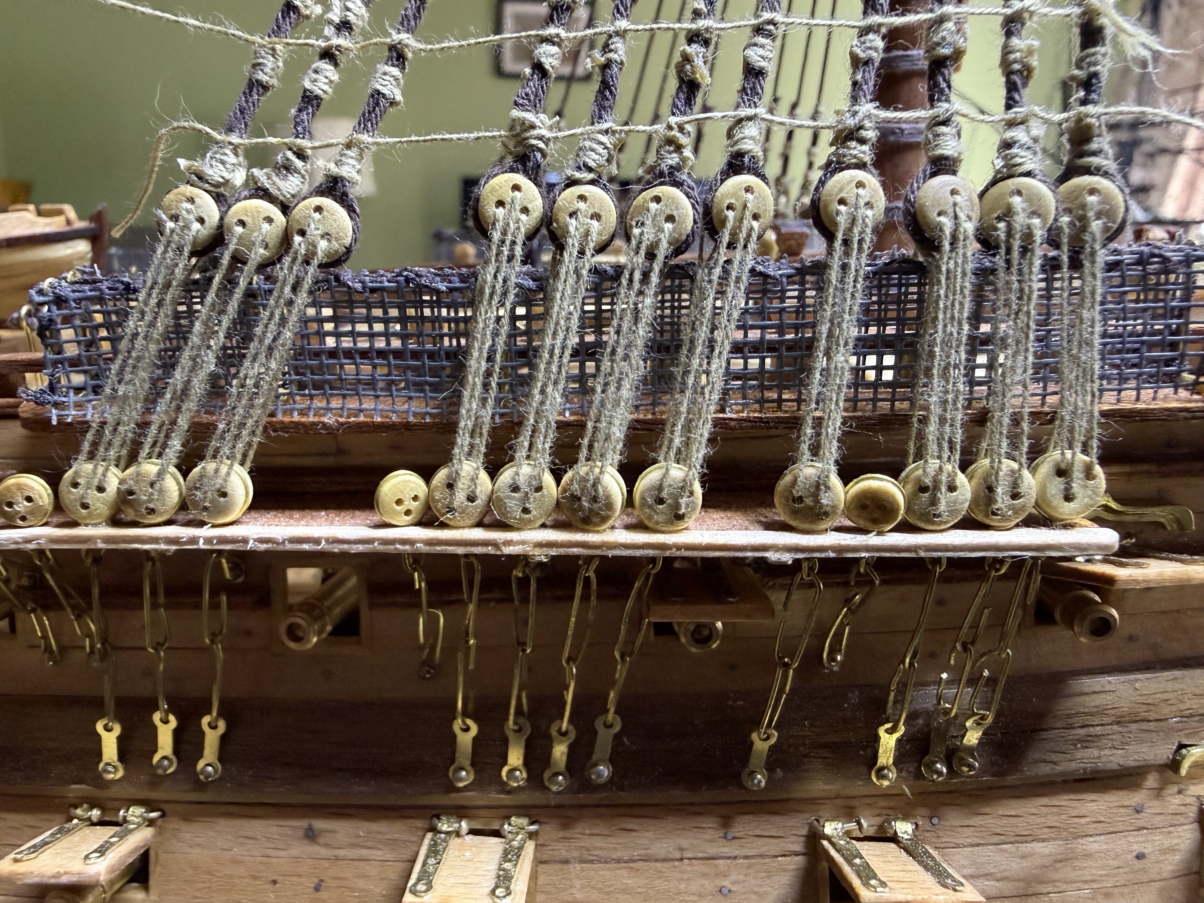

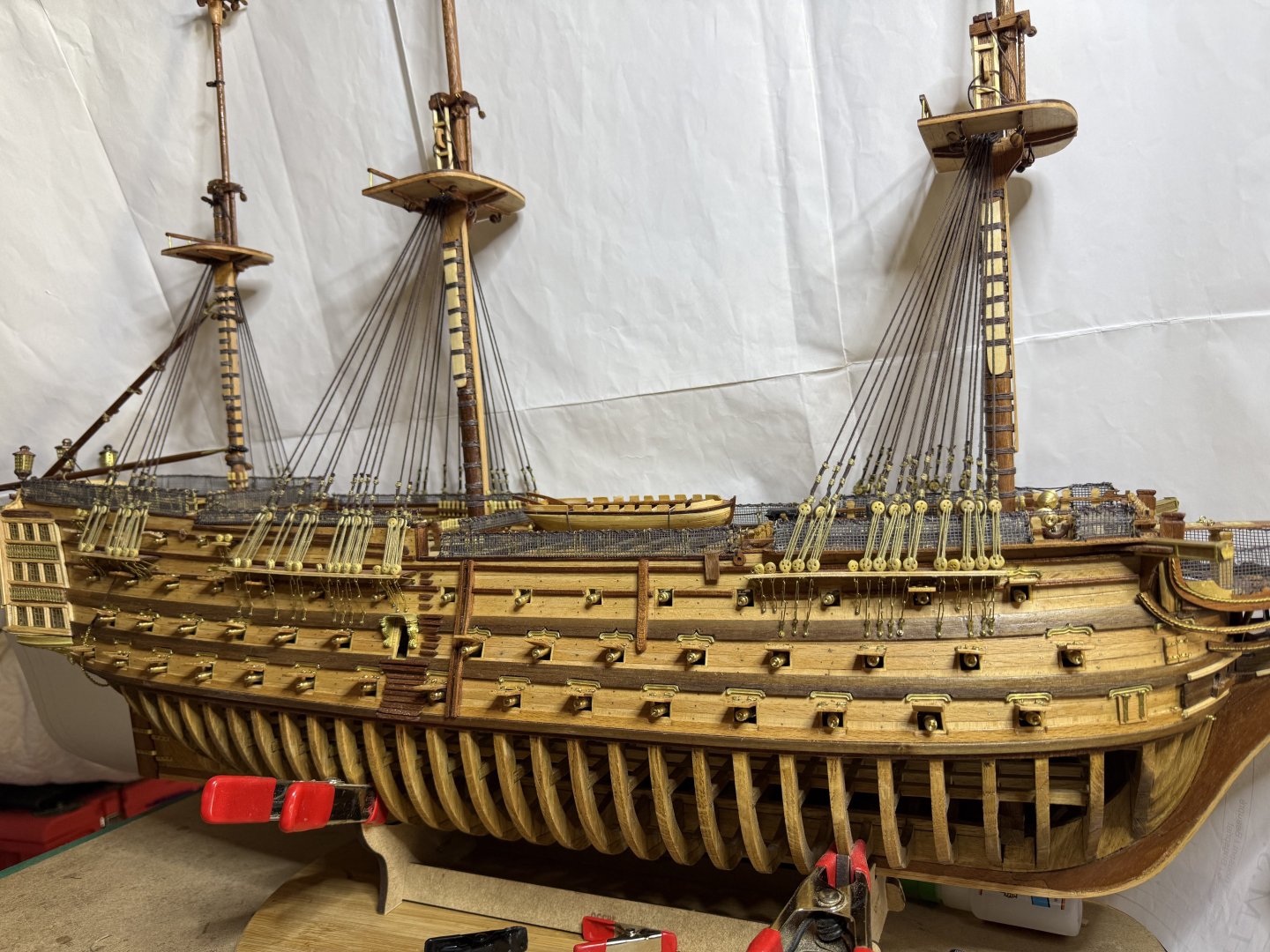

Lower shrouds done. Occre need to switch to a better way to attach the lower deadeyes like Vanguard several other manufacturers.  The instruction do not mention or show the clatharpins. Only shows the upper deadeyes attached to a ratline. I will add the appropriate clatharpins.
IMG_1187.thumb.jpg.e3b8ea1e6e6550353845ed02028b6a4f.jpgIMG_1186.thumb.jpg.3d400f27e544765c0da6a692a6ce5240.jpgIMG_1185.thumb.jpg.4939679c718e78c08a44aa6430779c36.jpg

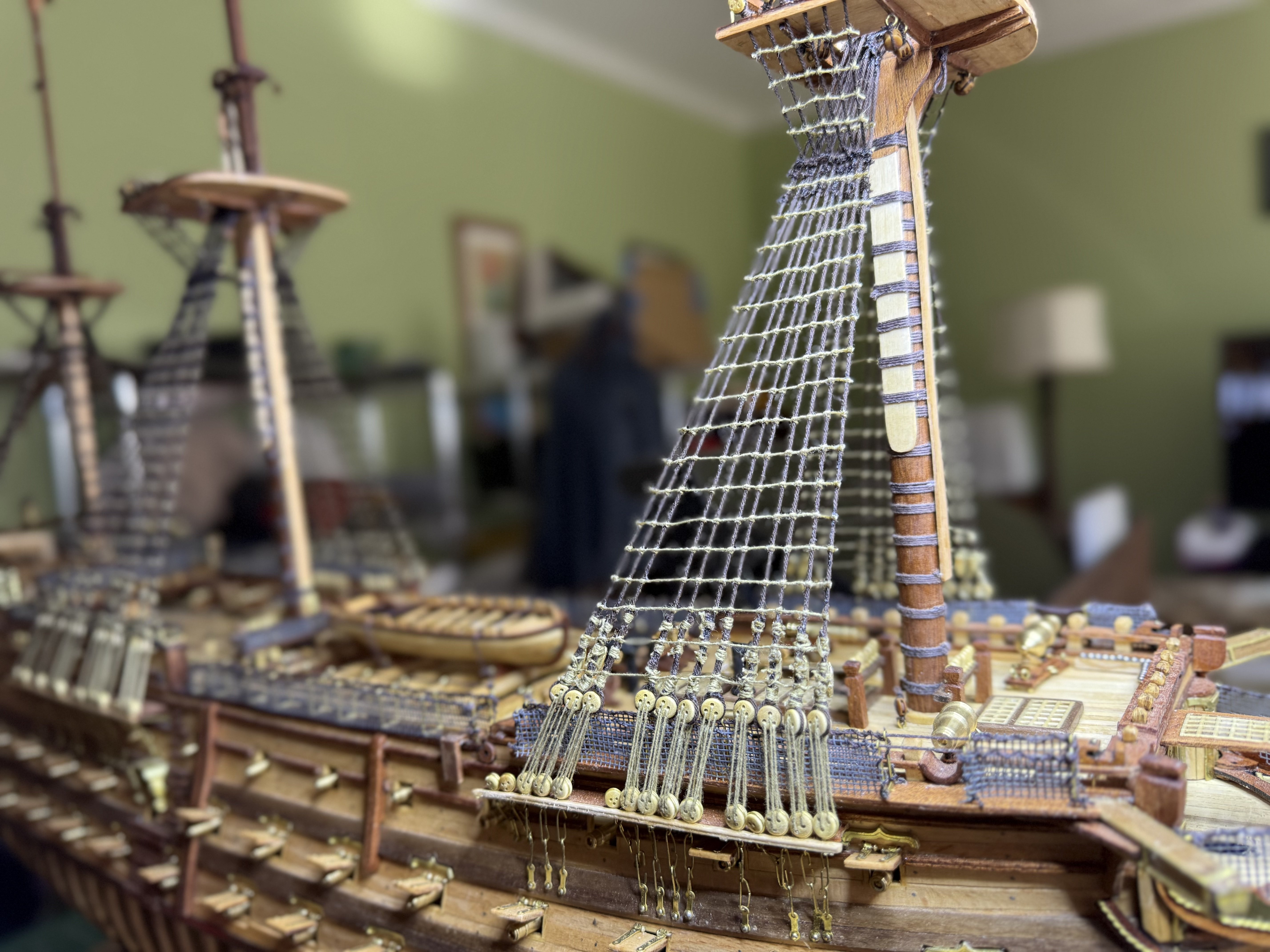

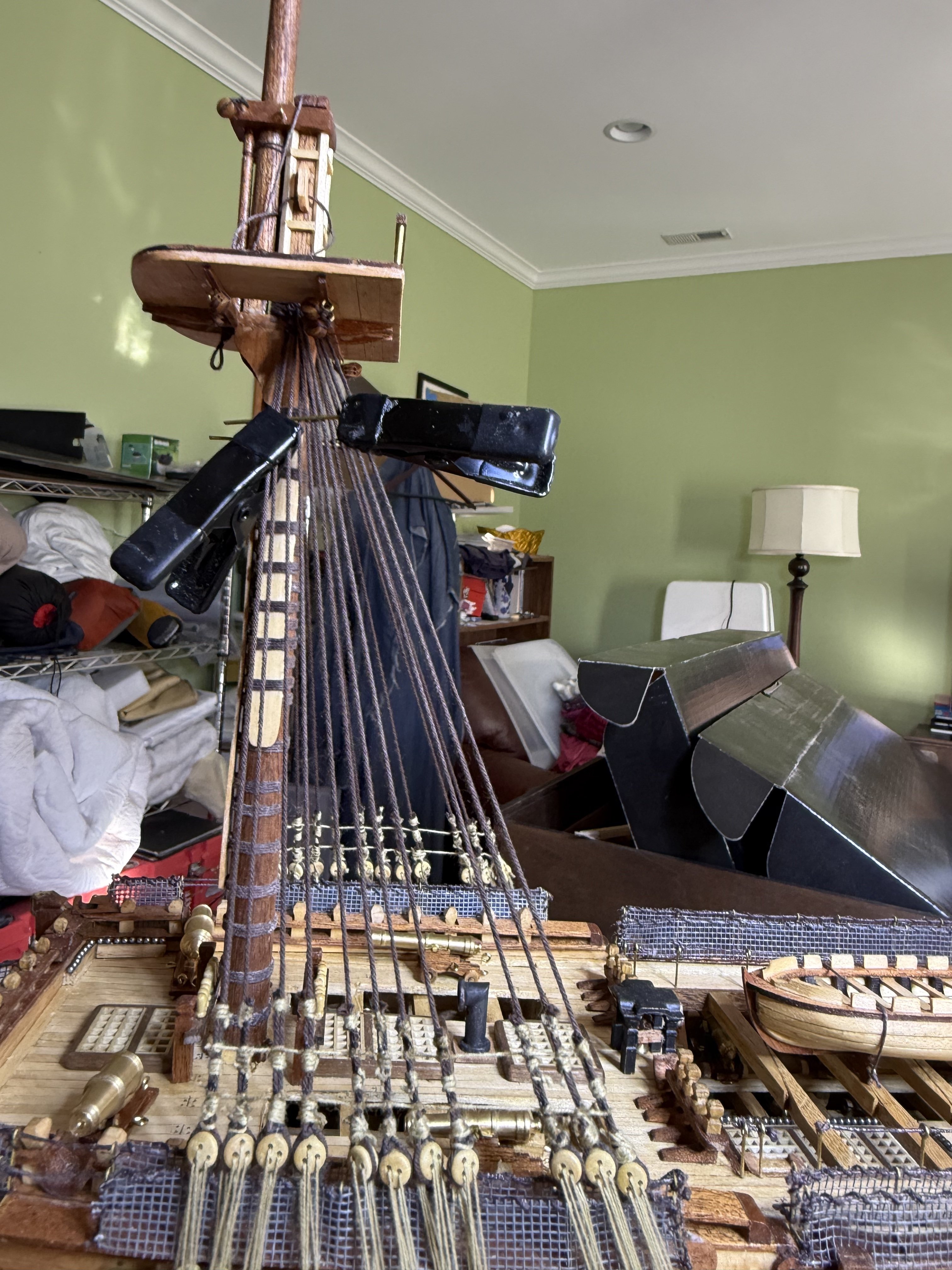

First job with the lower shrouds is to straighten the deadeyes as they tend to twist given how close they are.

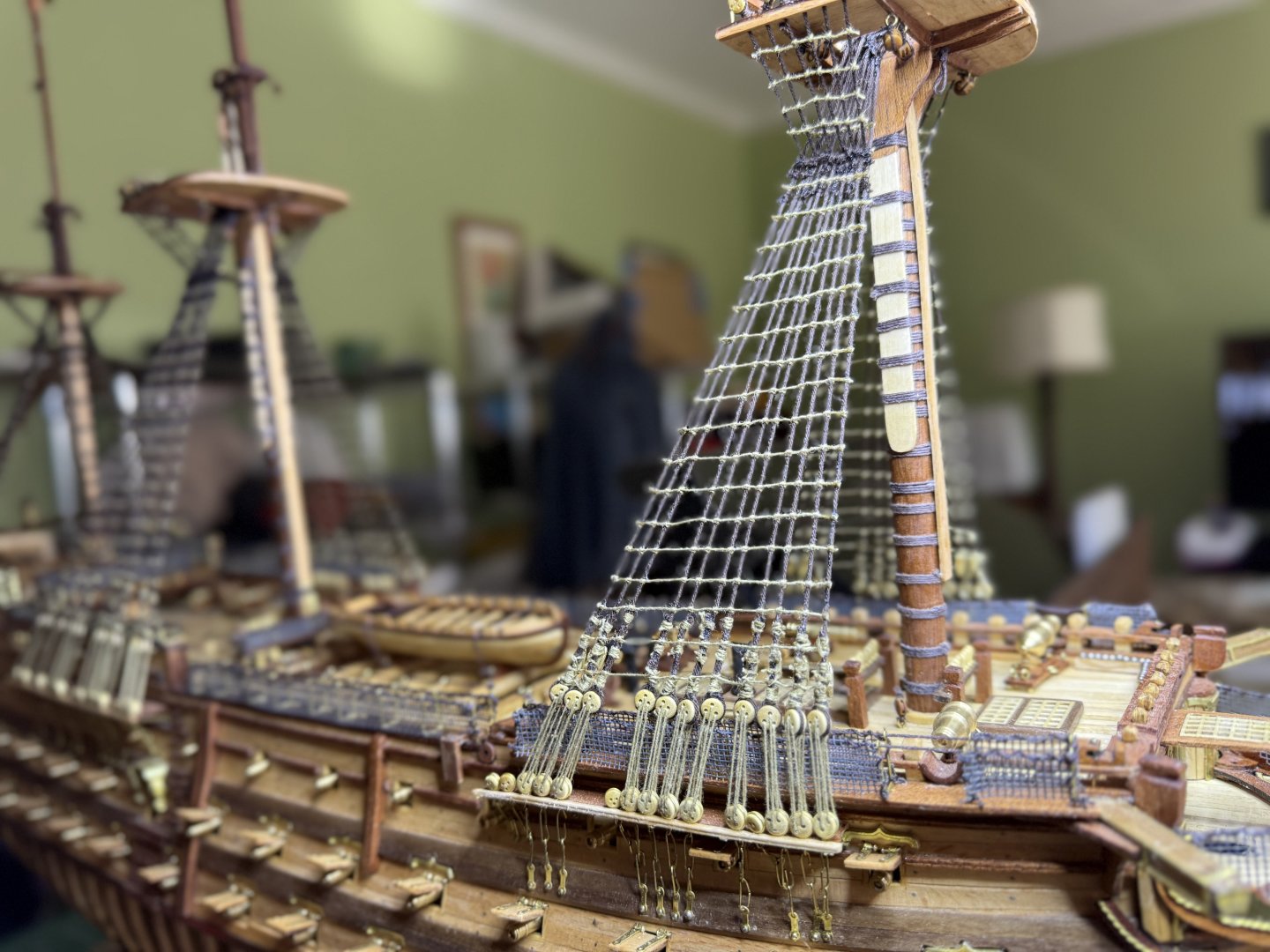

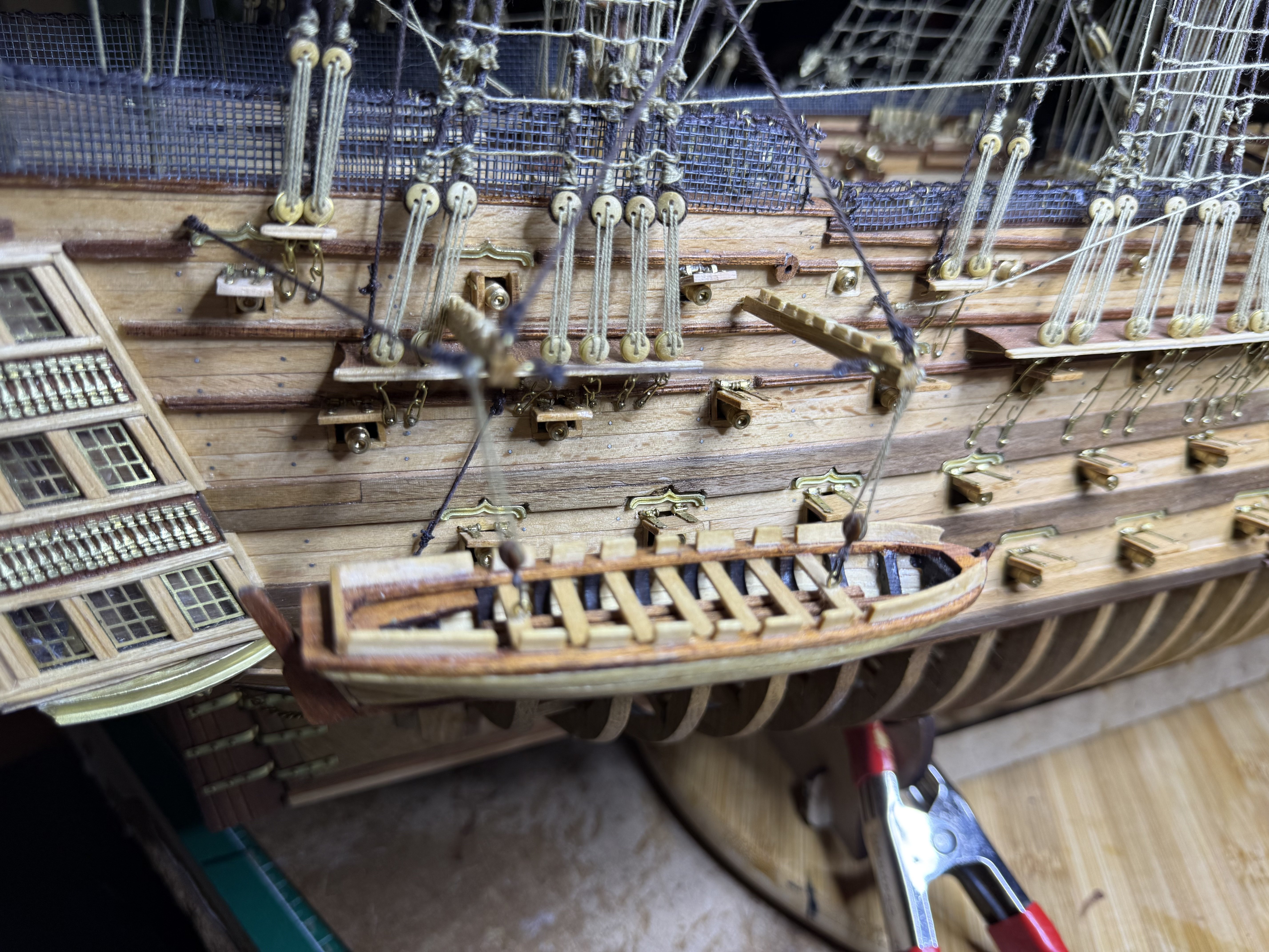

Next 2 rows of ratlines to lock into place

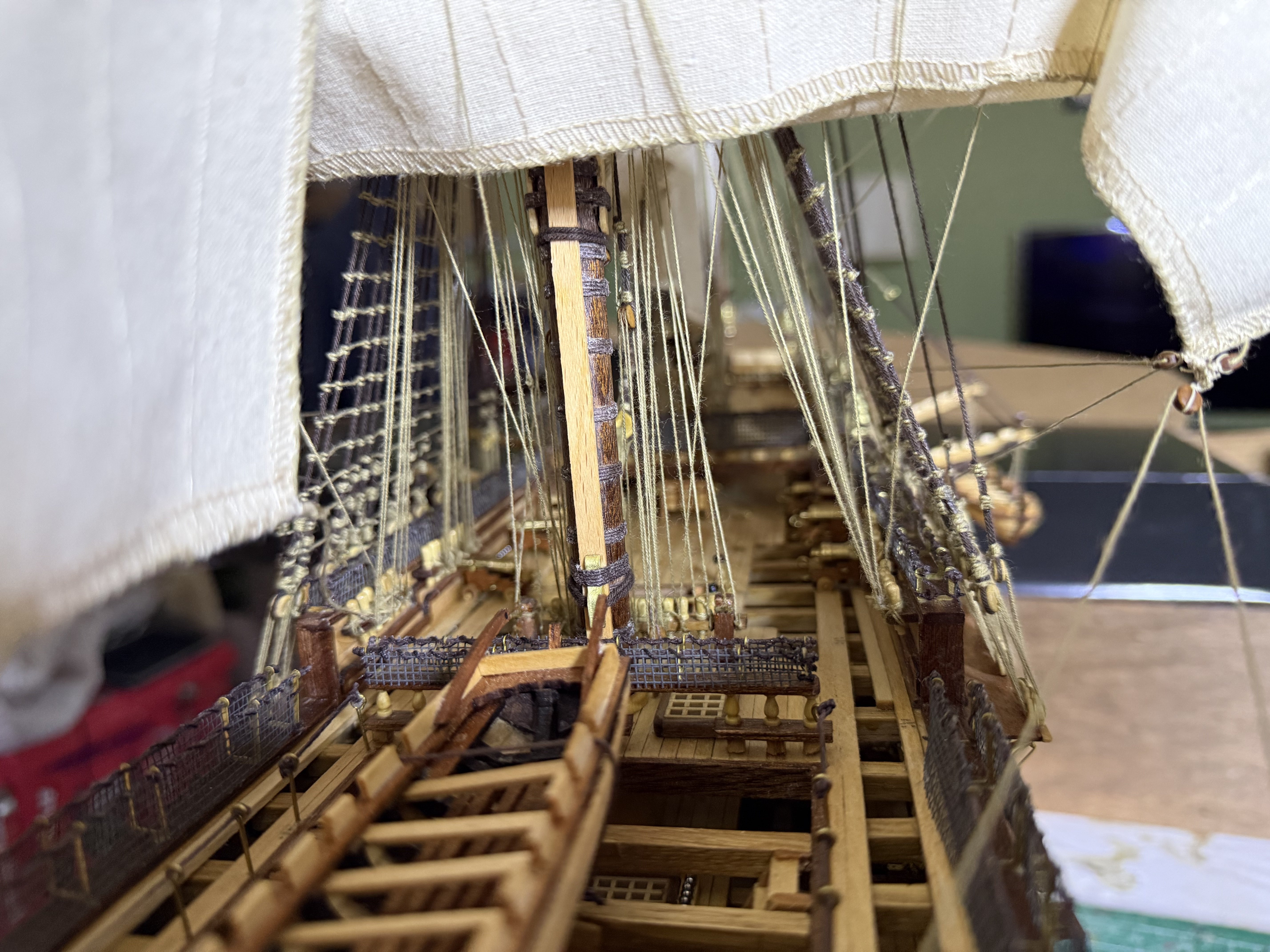

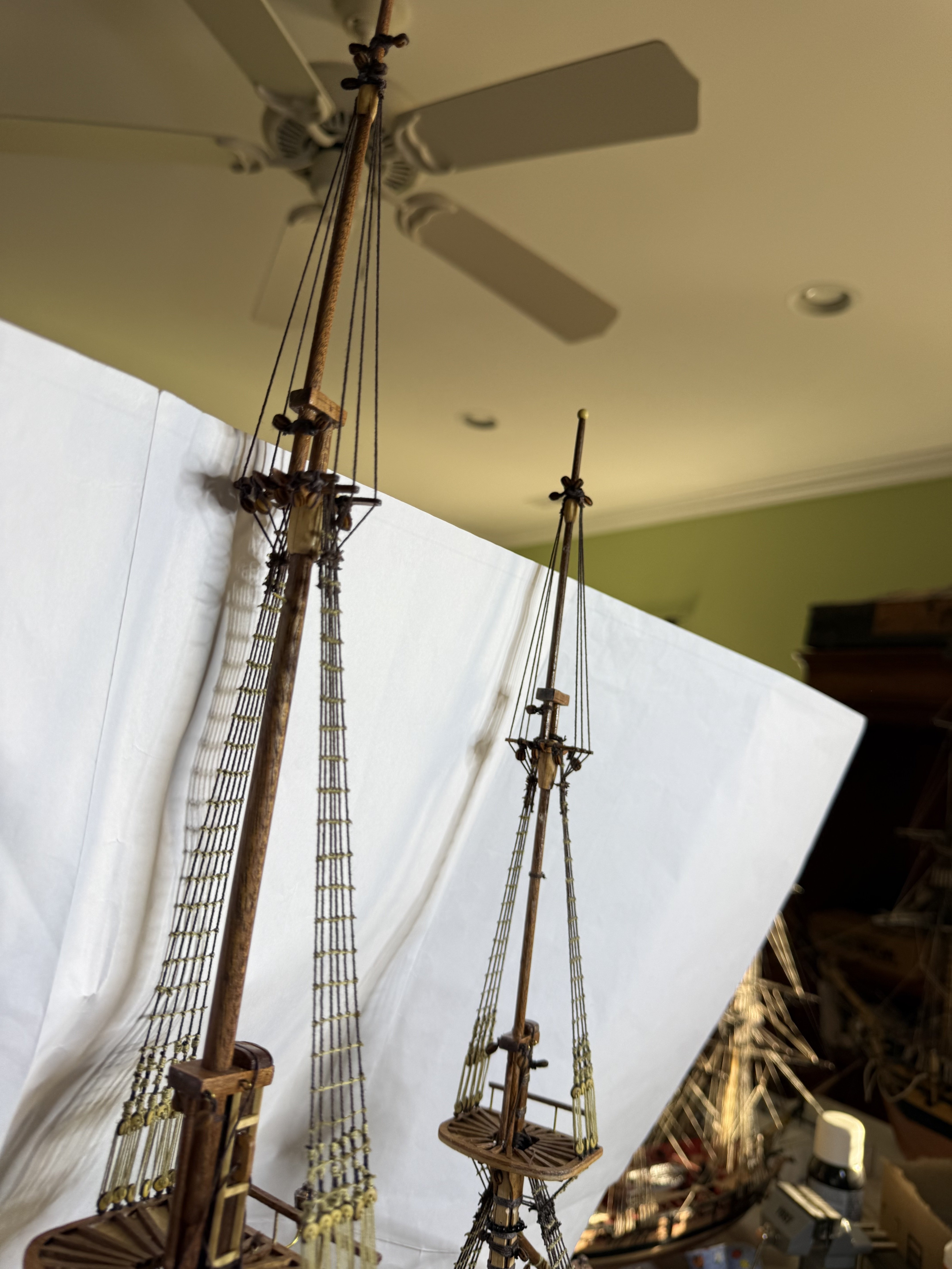

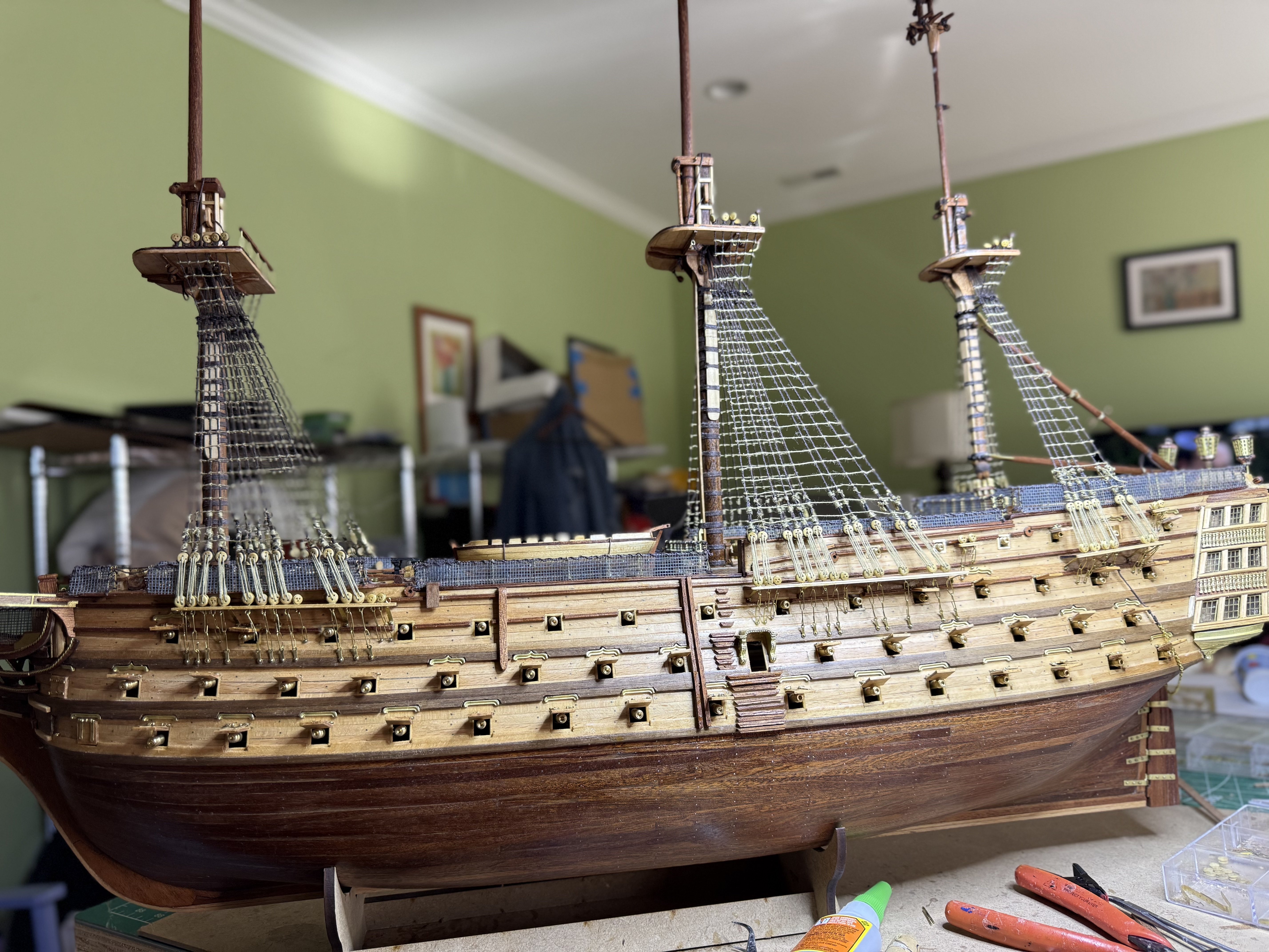

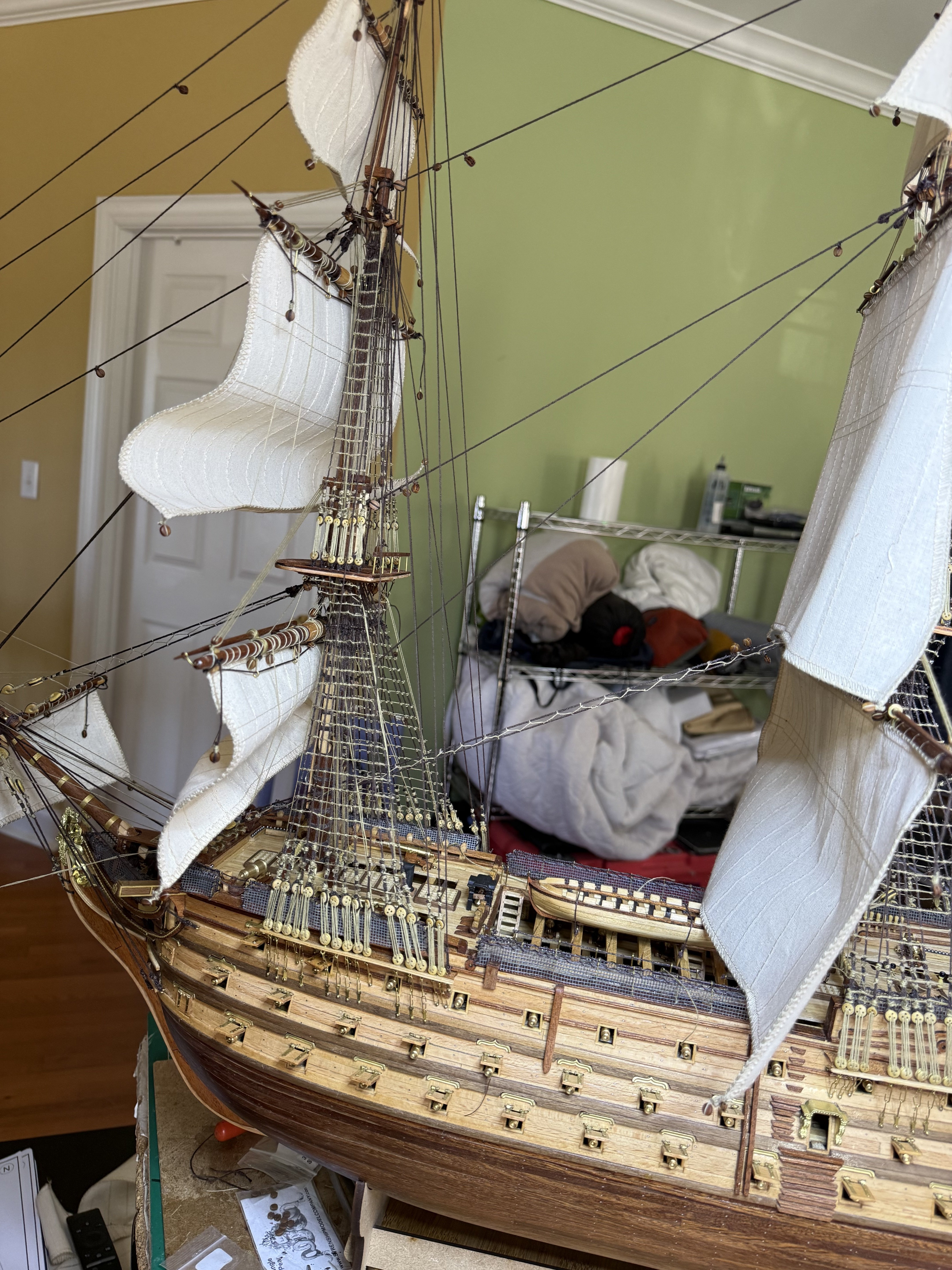

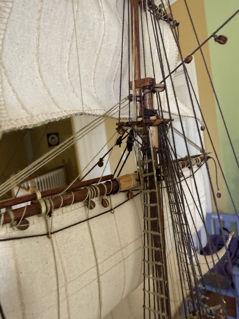

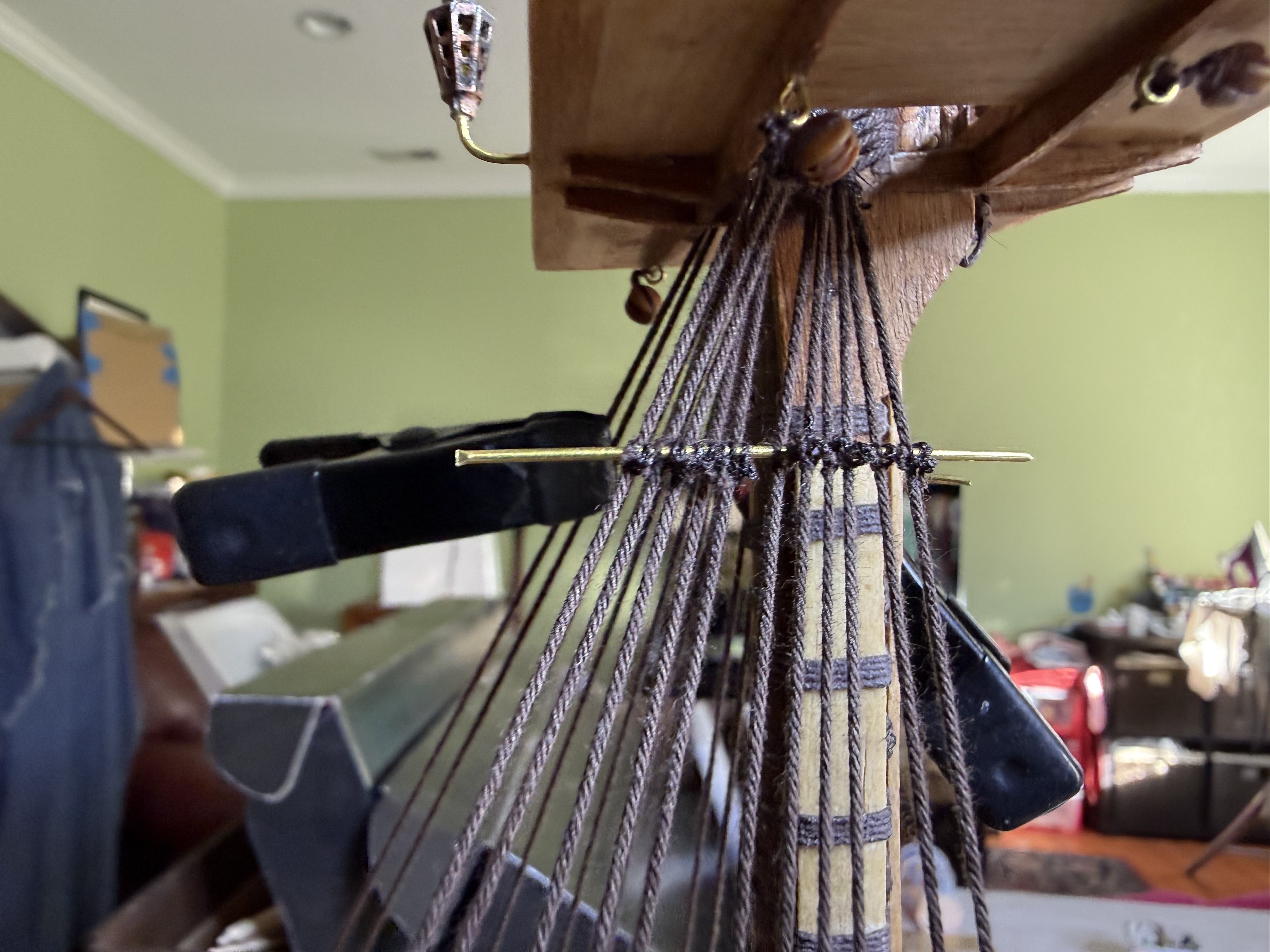

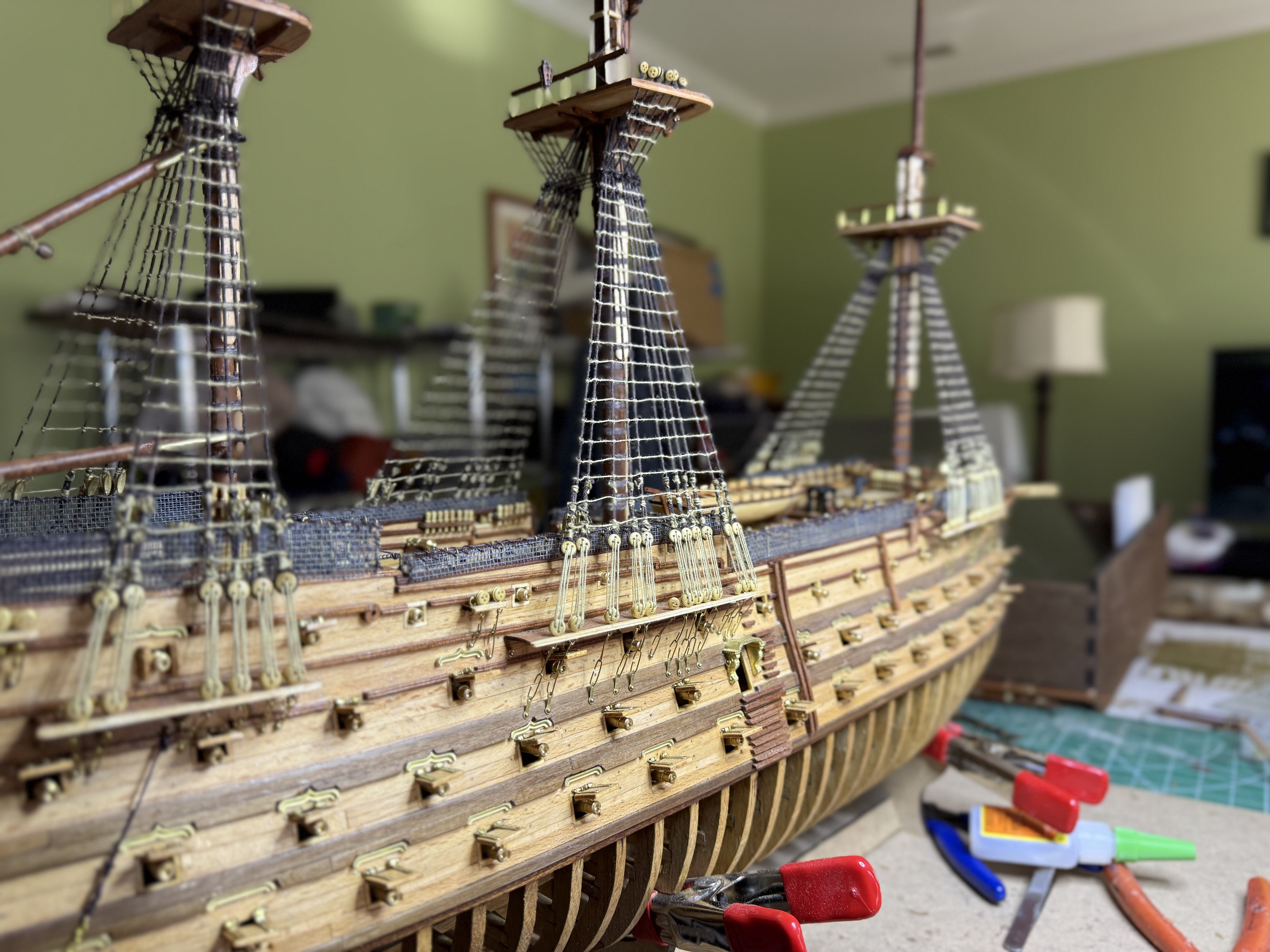

Now to straighten out the upper part of the shrouds by adding the clatharins which also align bring in the back part of the shrouds which tend to flare outward.

I could have saved you some knots by telling you that not all ratlines pass across all the lower shrouds, in fact only every fifth one......too late now.....a good reference to have for Victory is Longridge's Anatomy of Nelson's Ships in which stuff like this is detailed. It has very very detailed notes on line and block sizes for each piece of rigging.
Nicely done.
Eck, what thread did you use for the shrouds, please?  It won't be too much longer before I start doing those on my HMS Beagle and I wanted to know if the thread OcCre provided is the same as what you've used (in which case it looks plenty good enough!)

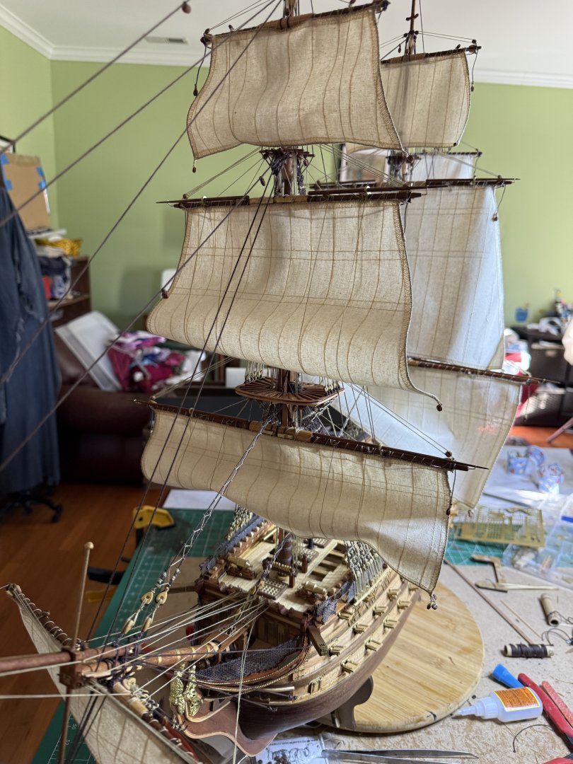

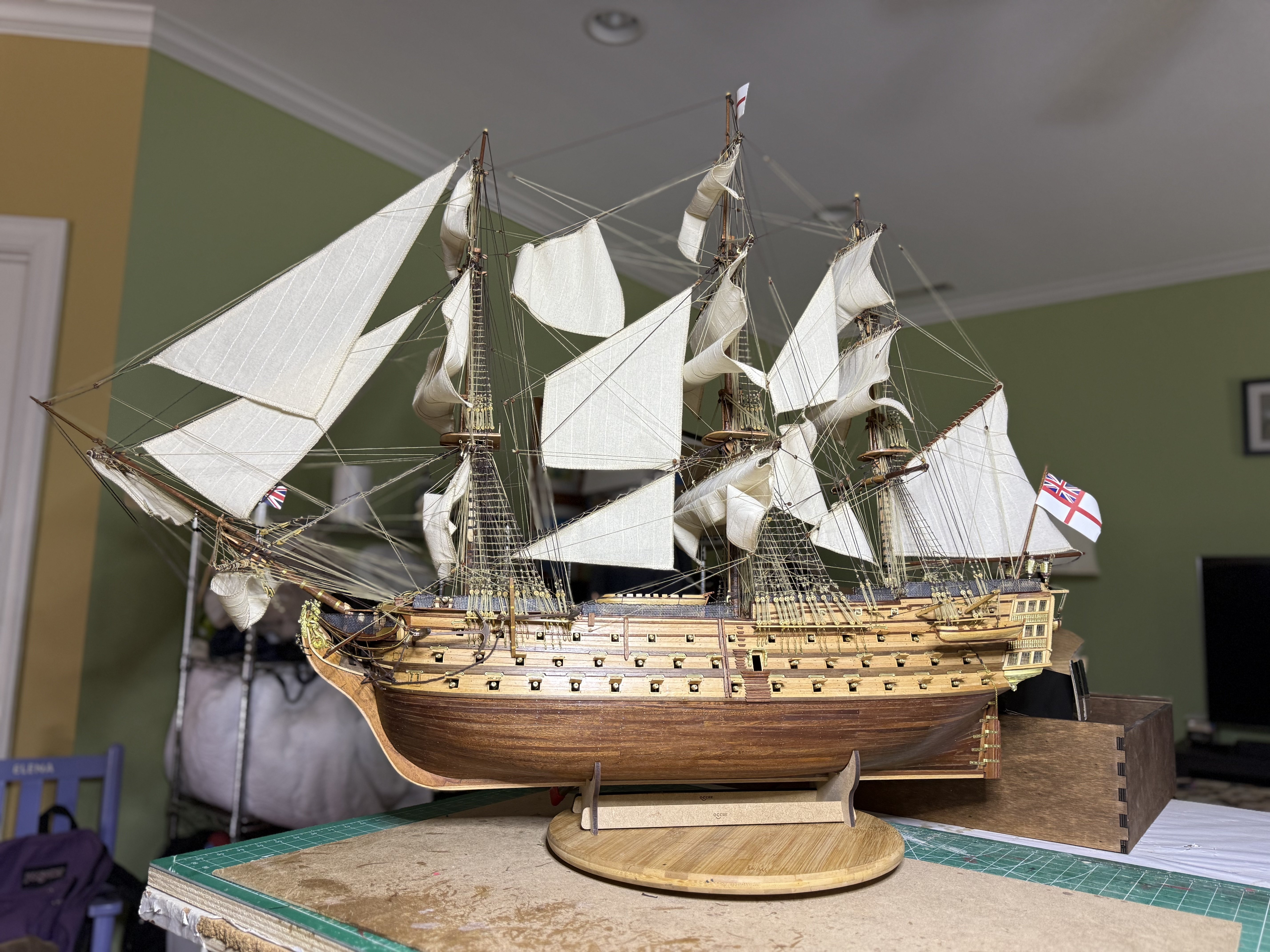

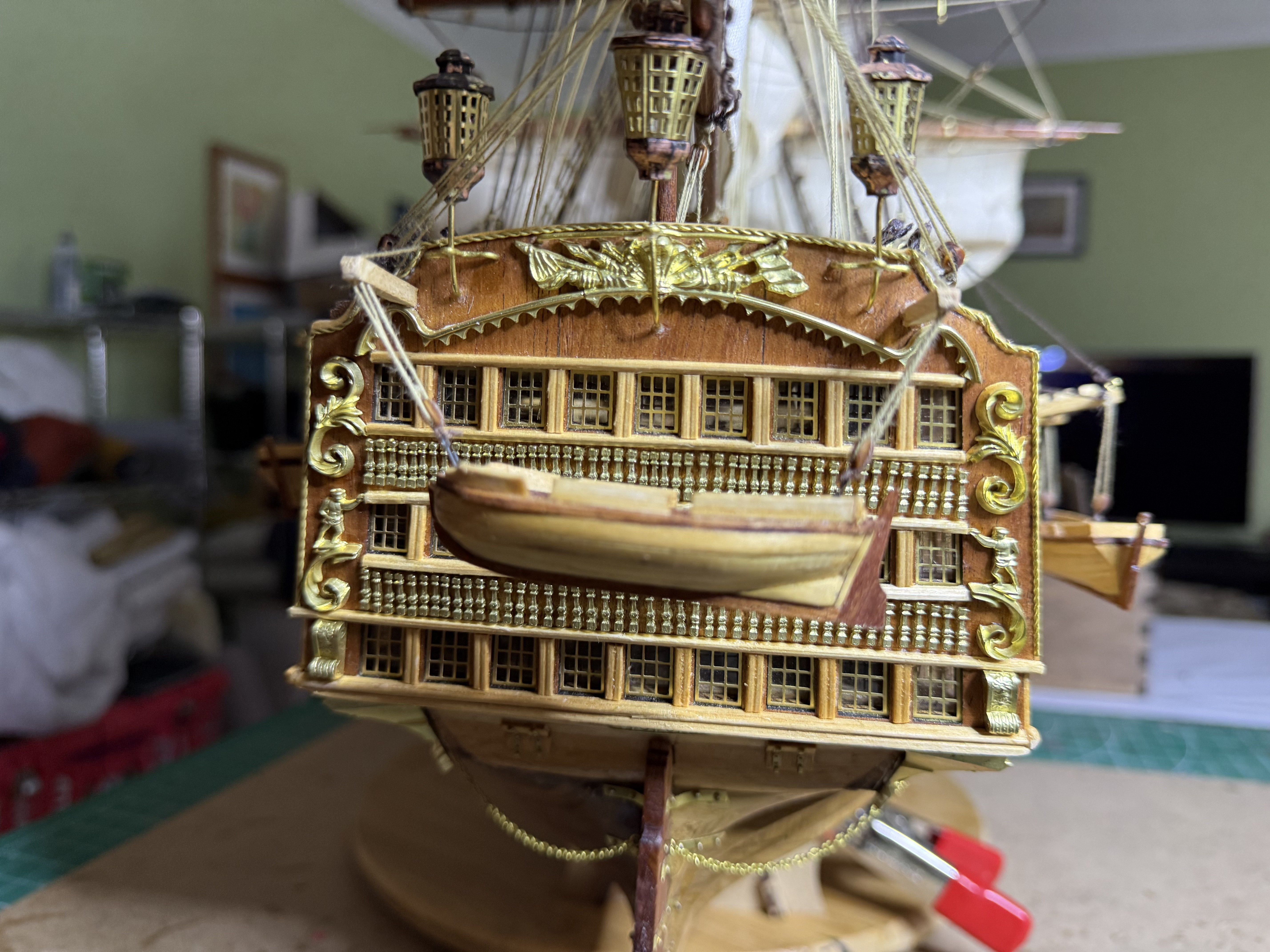

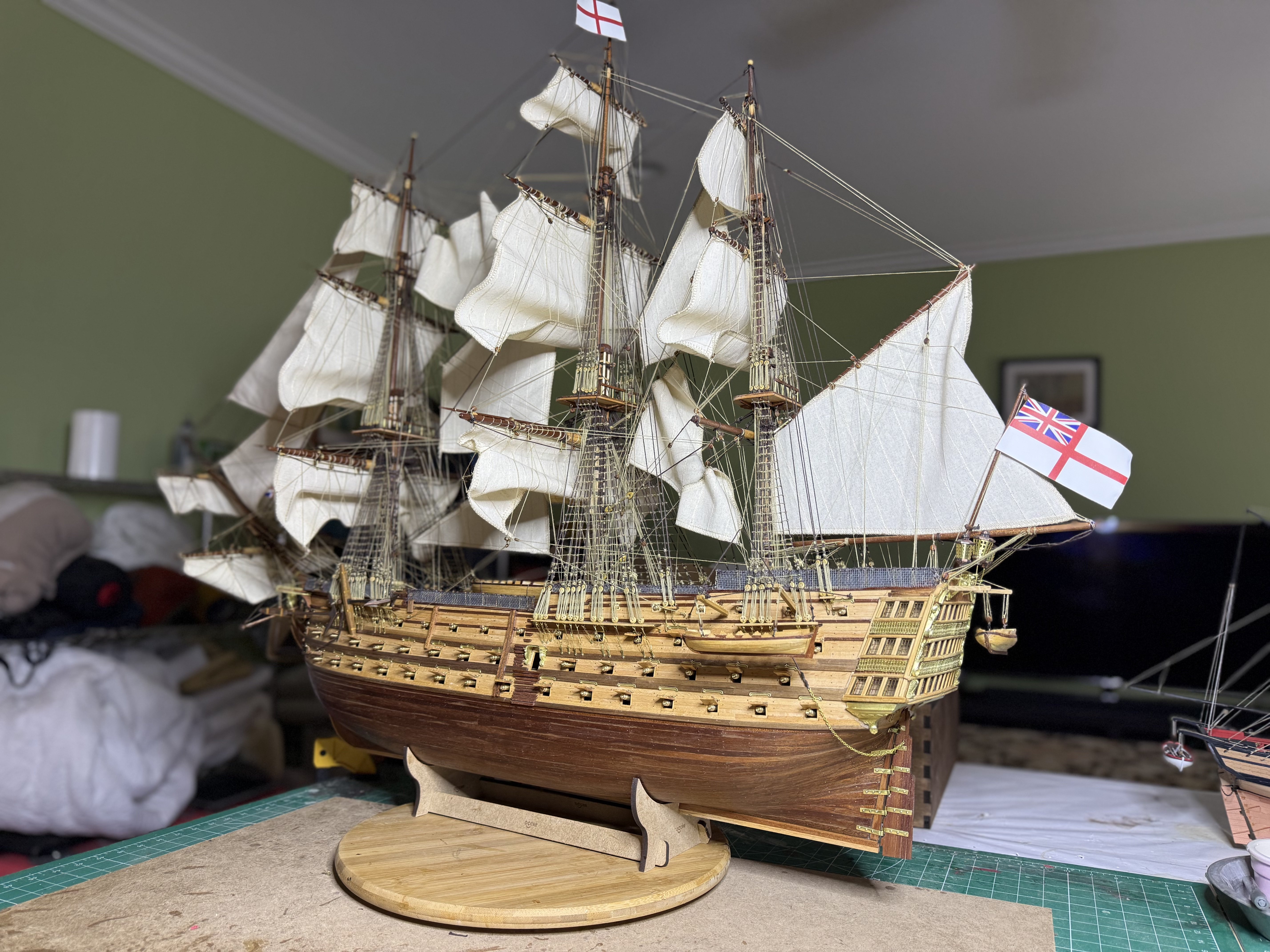

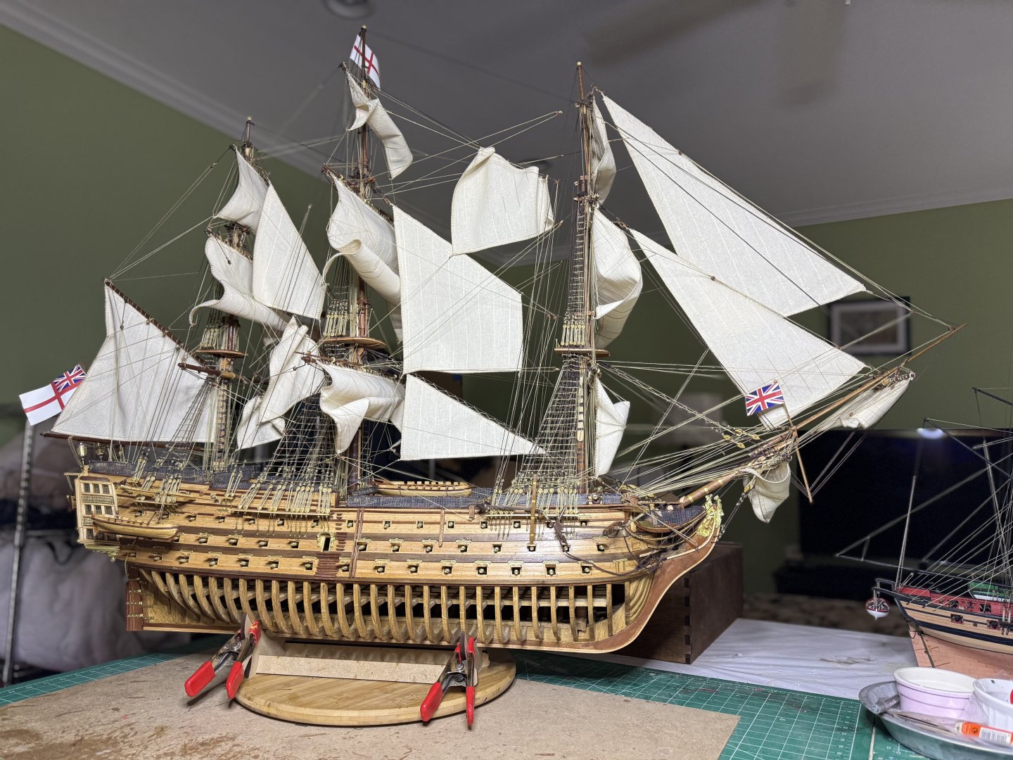

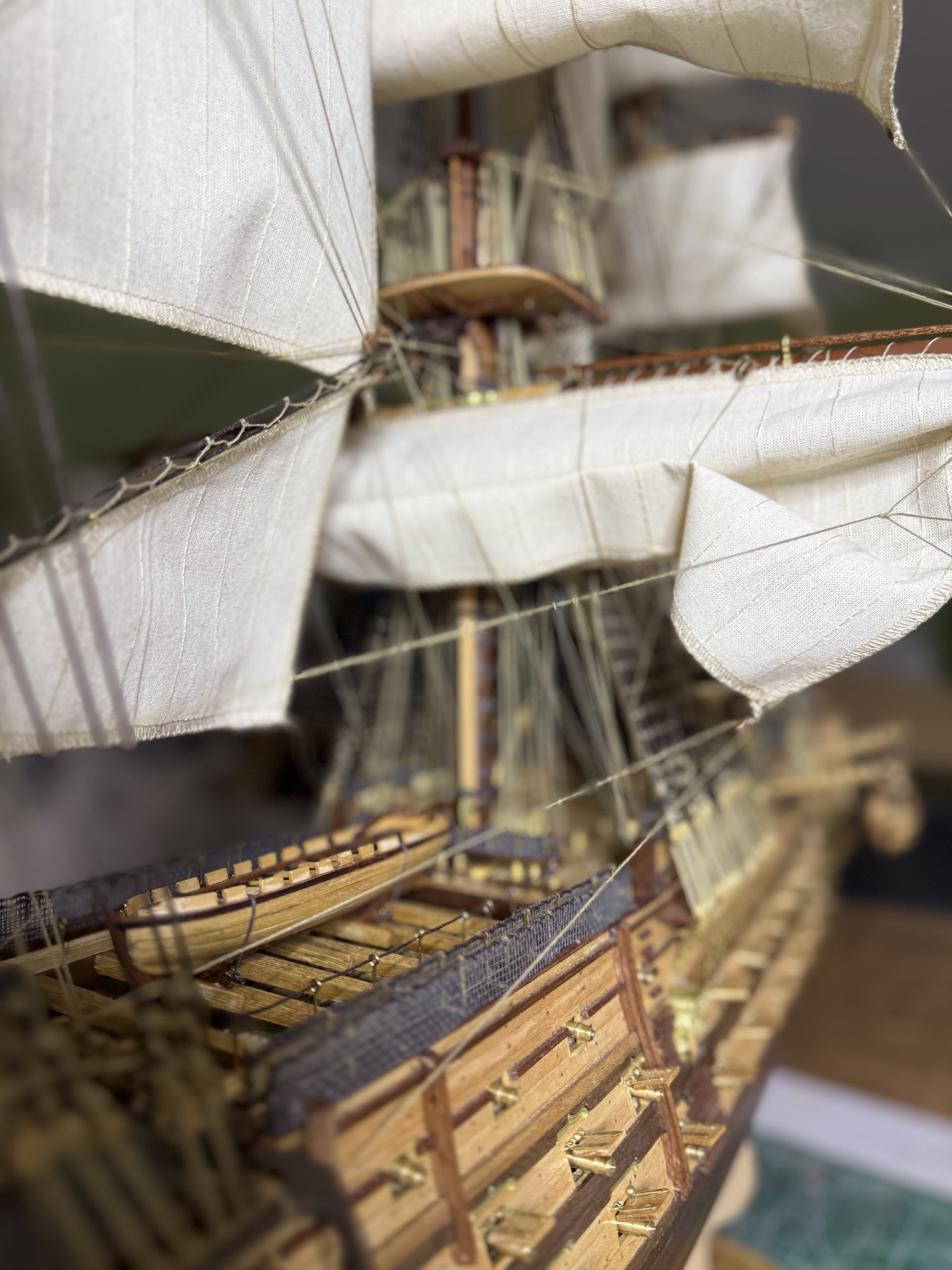

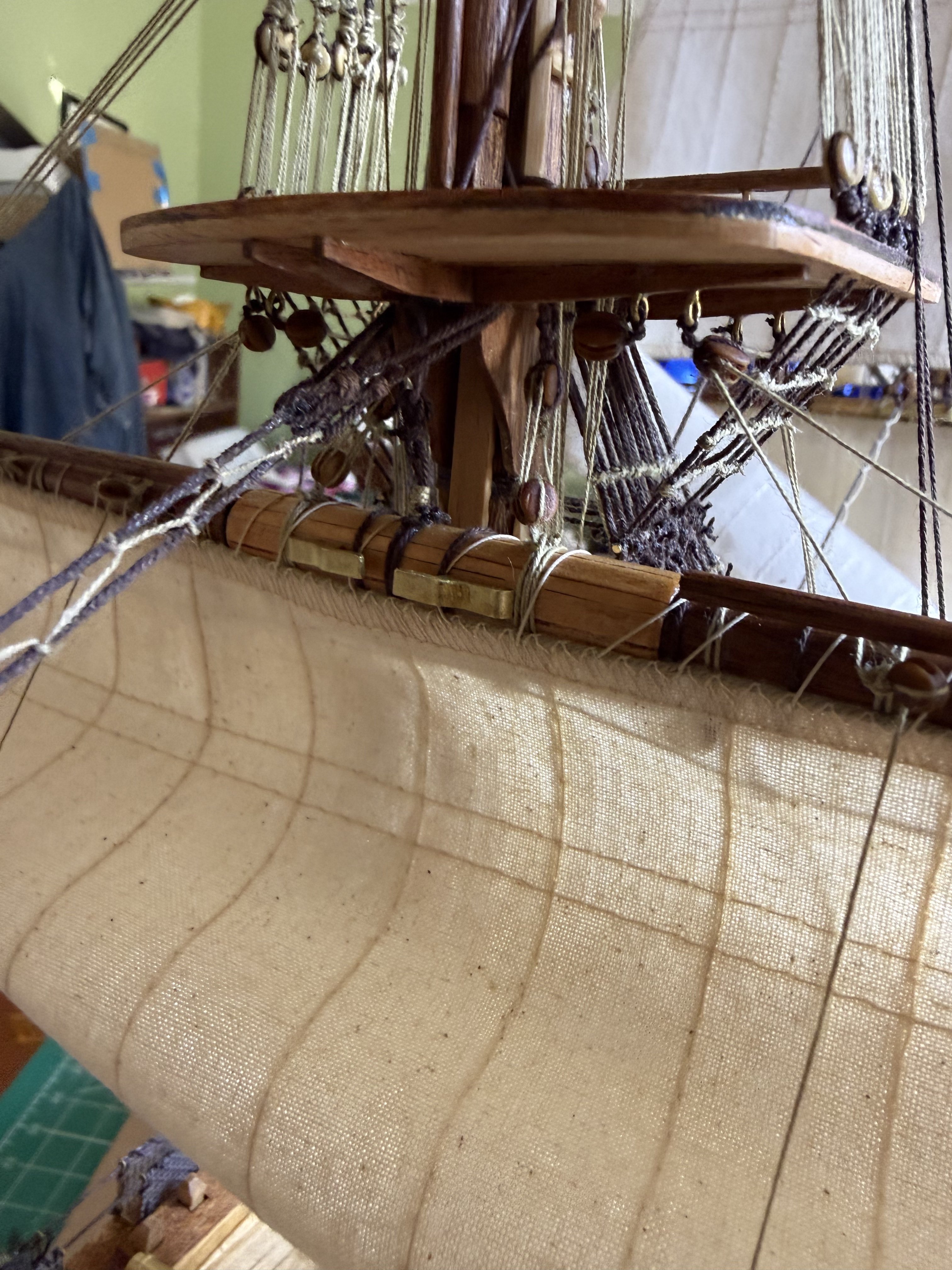

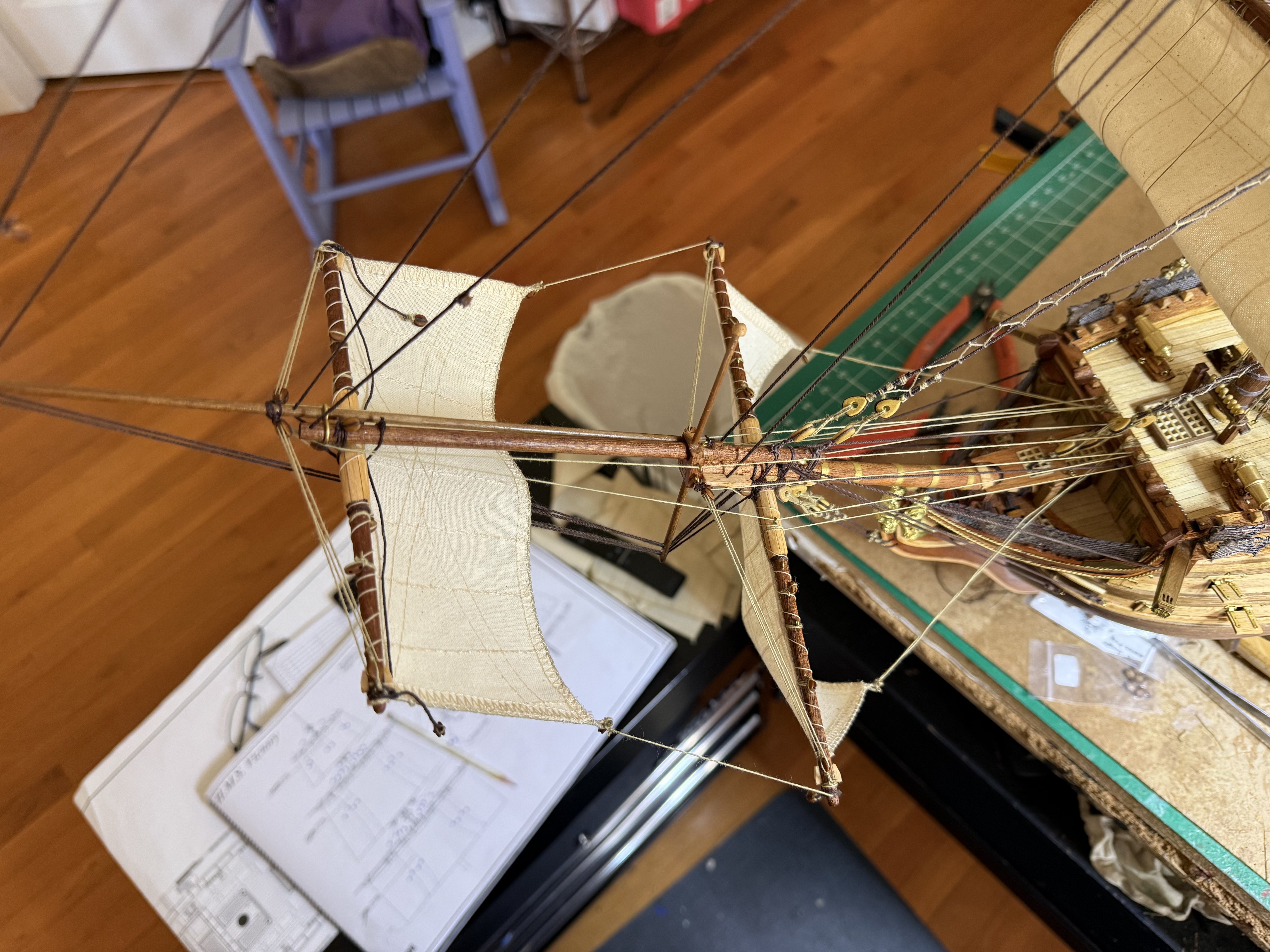

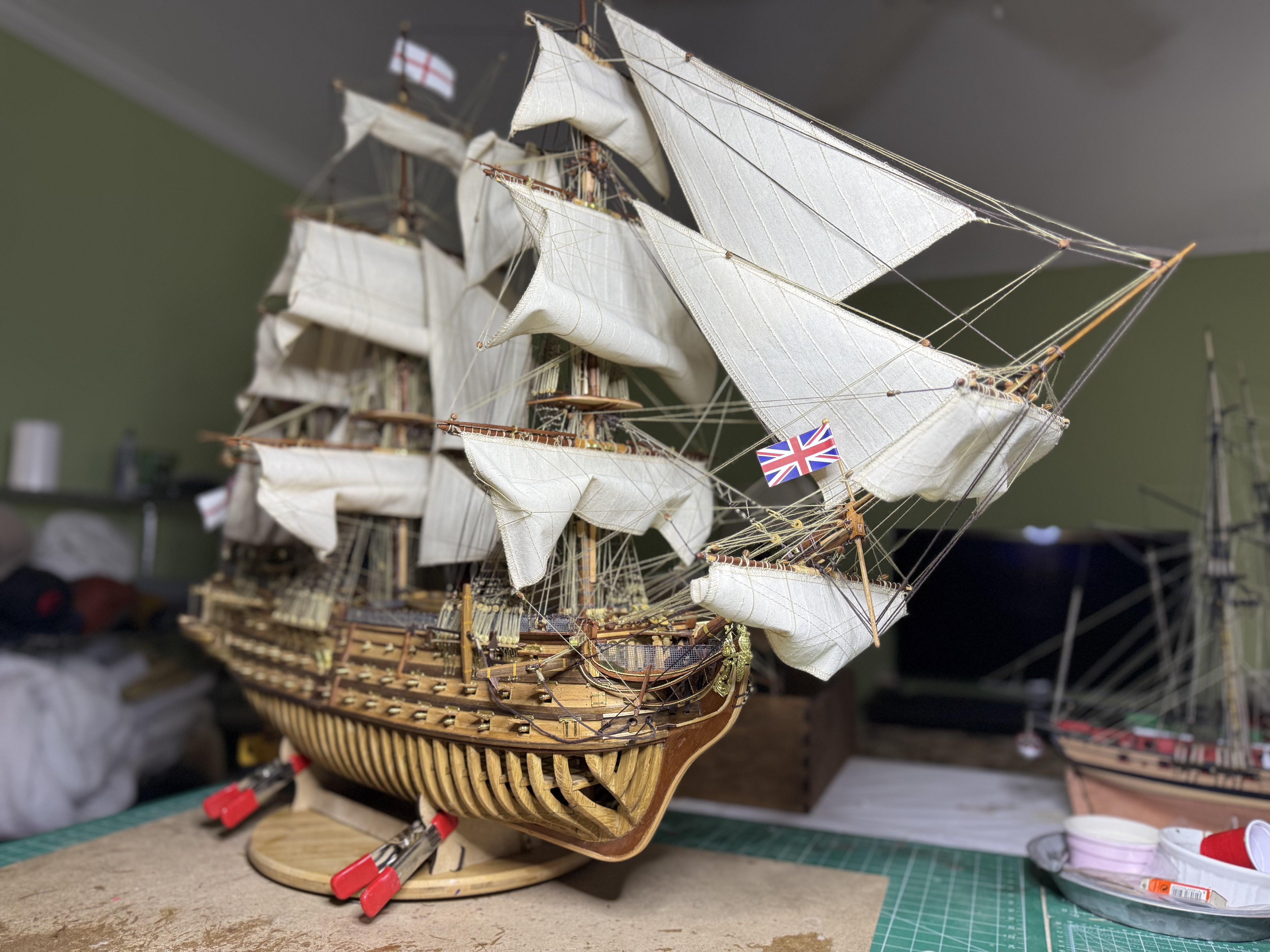

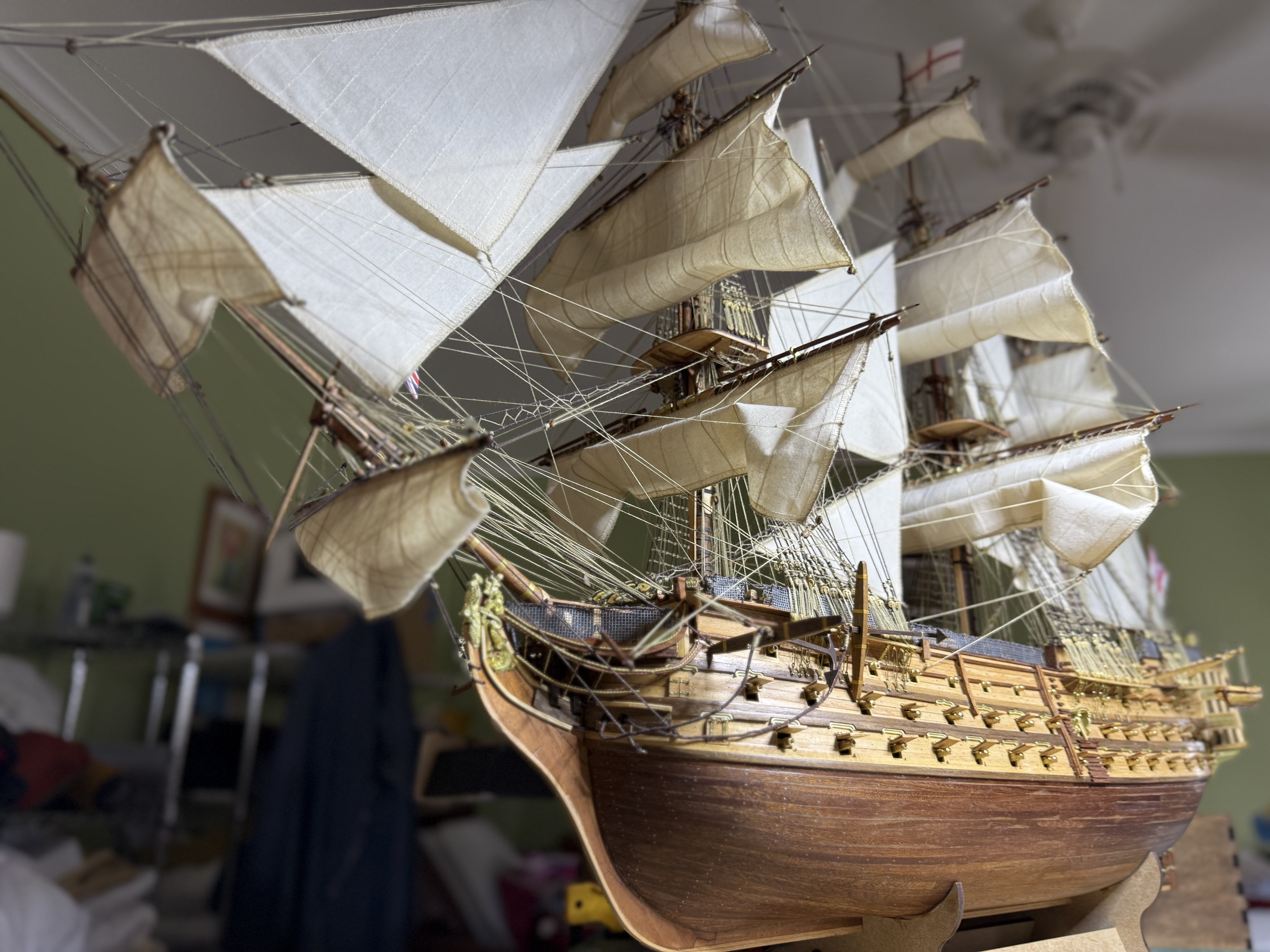

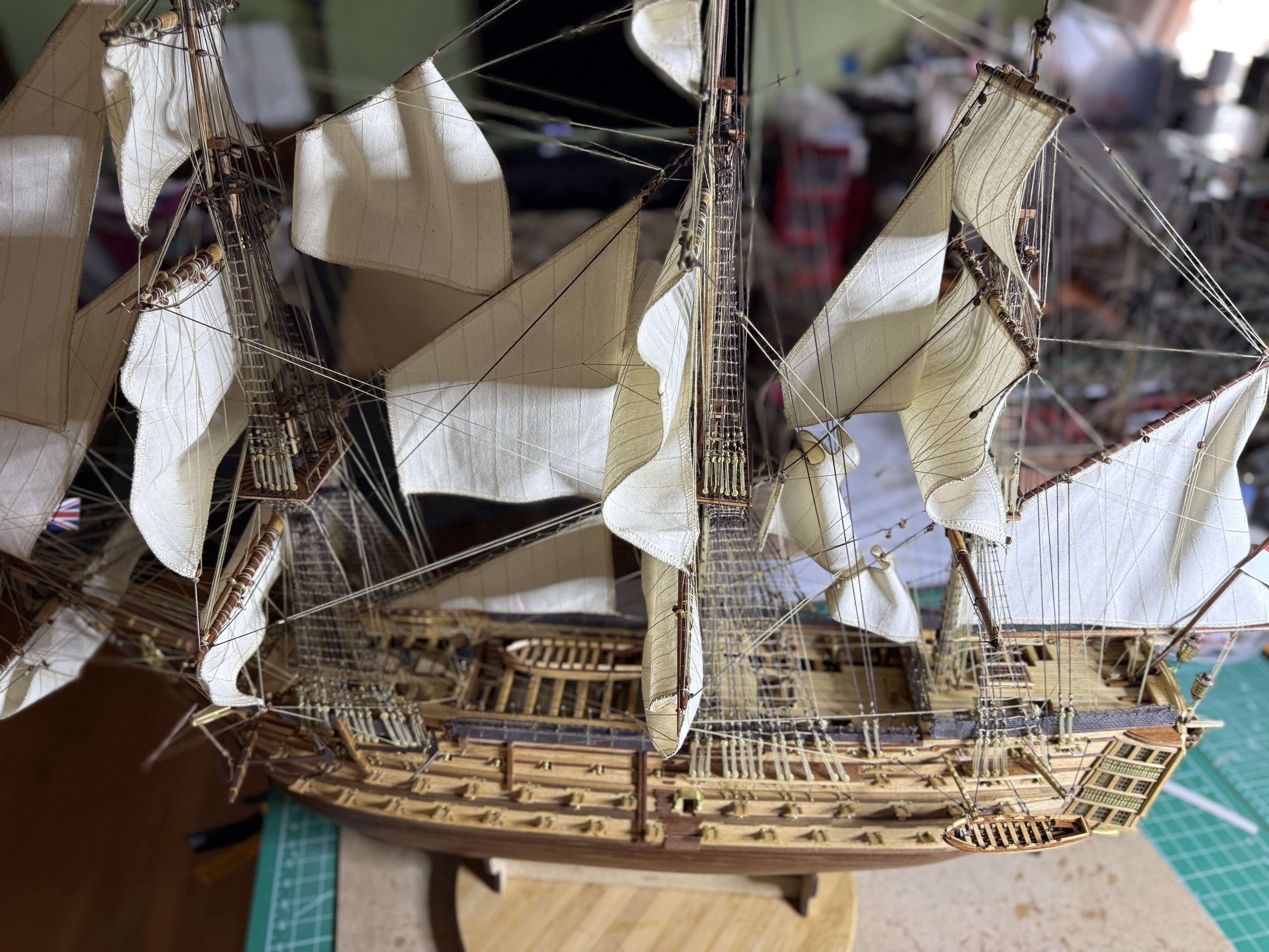

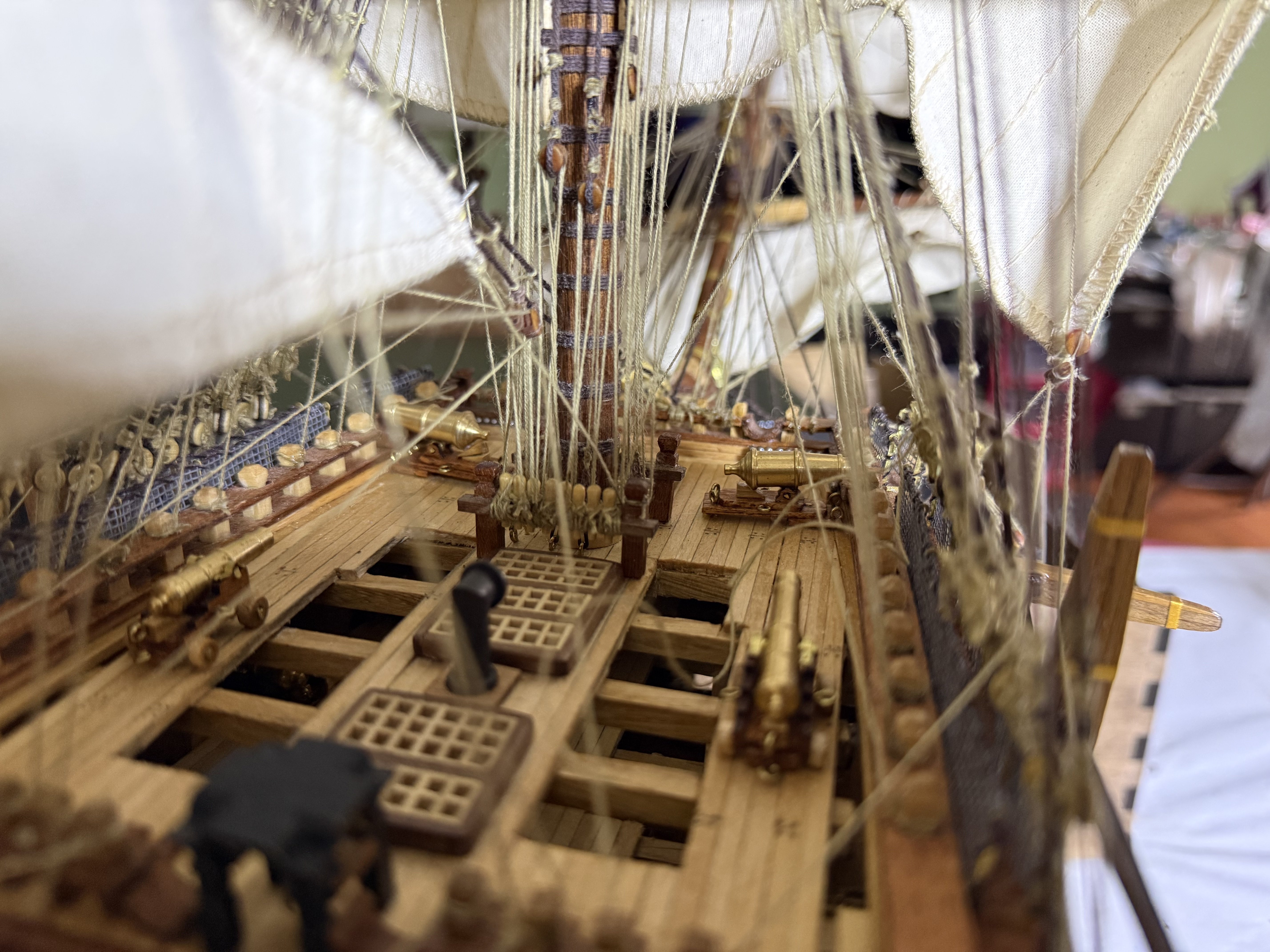

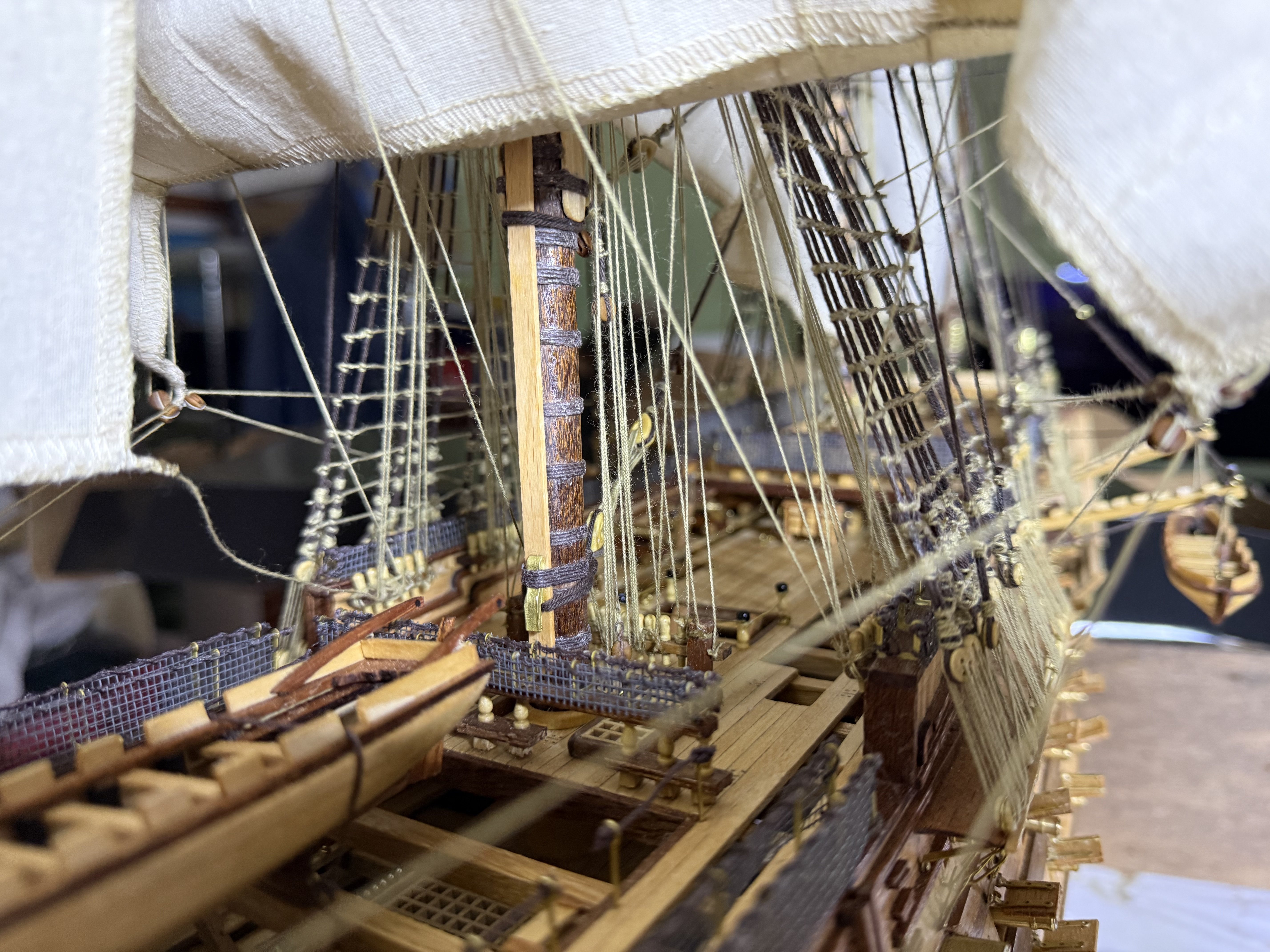

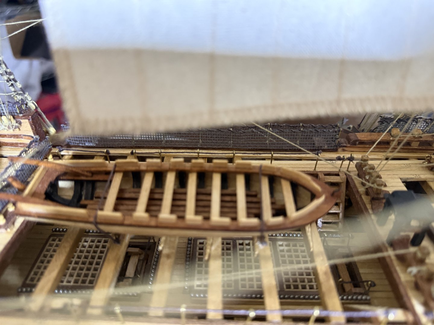

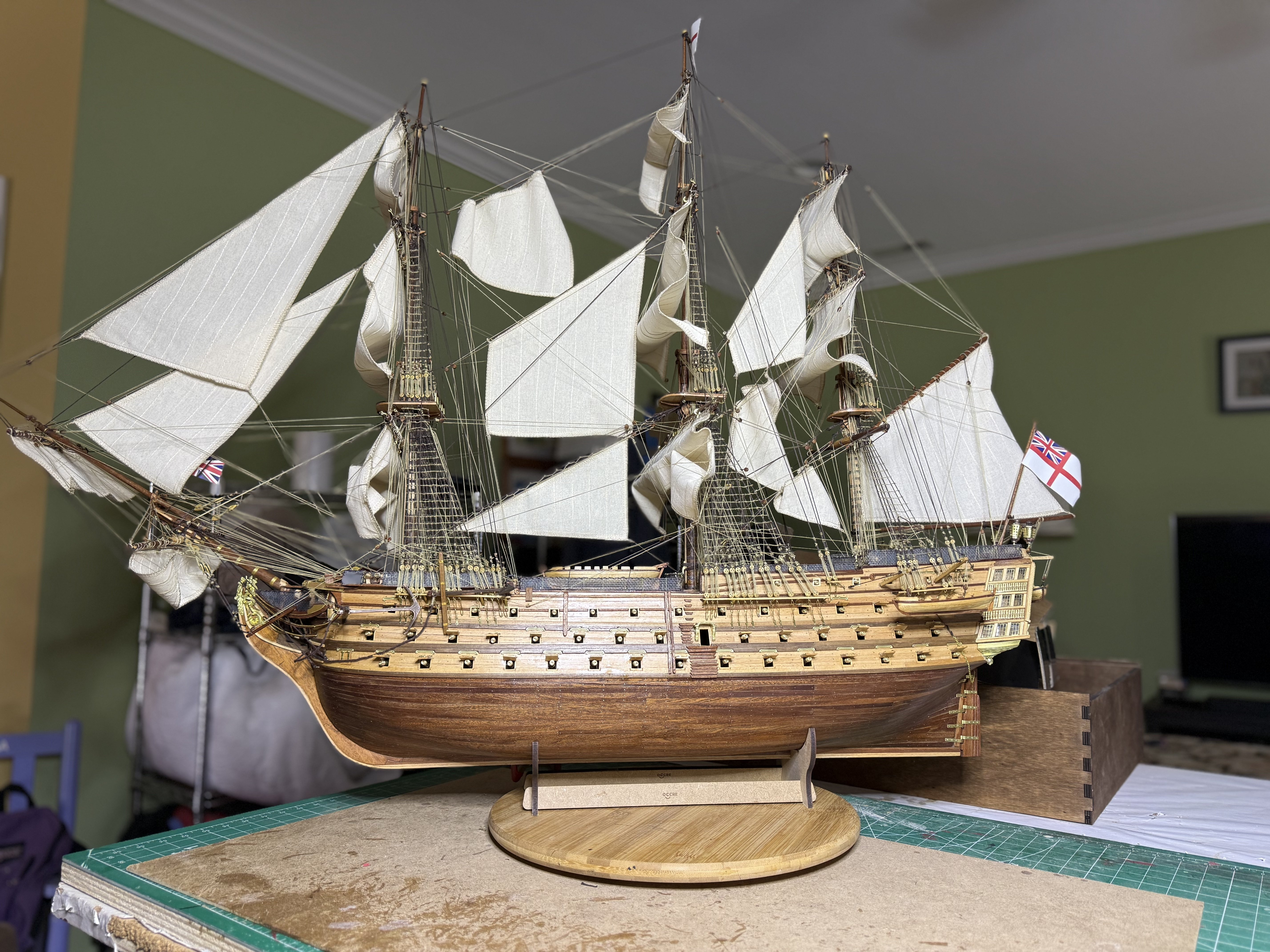

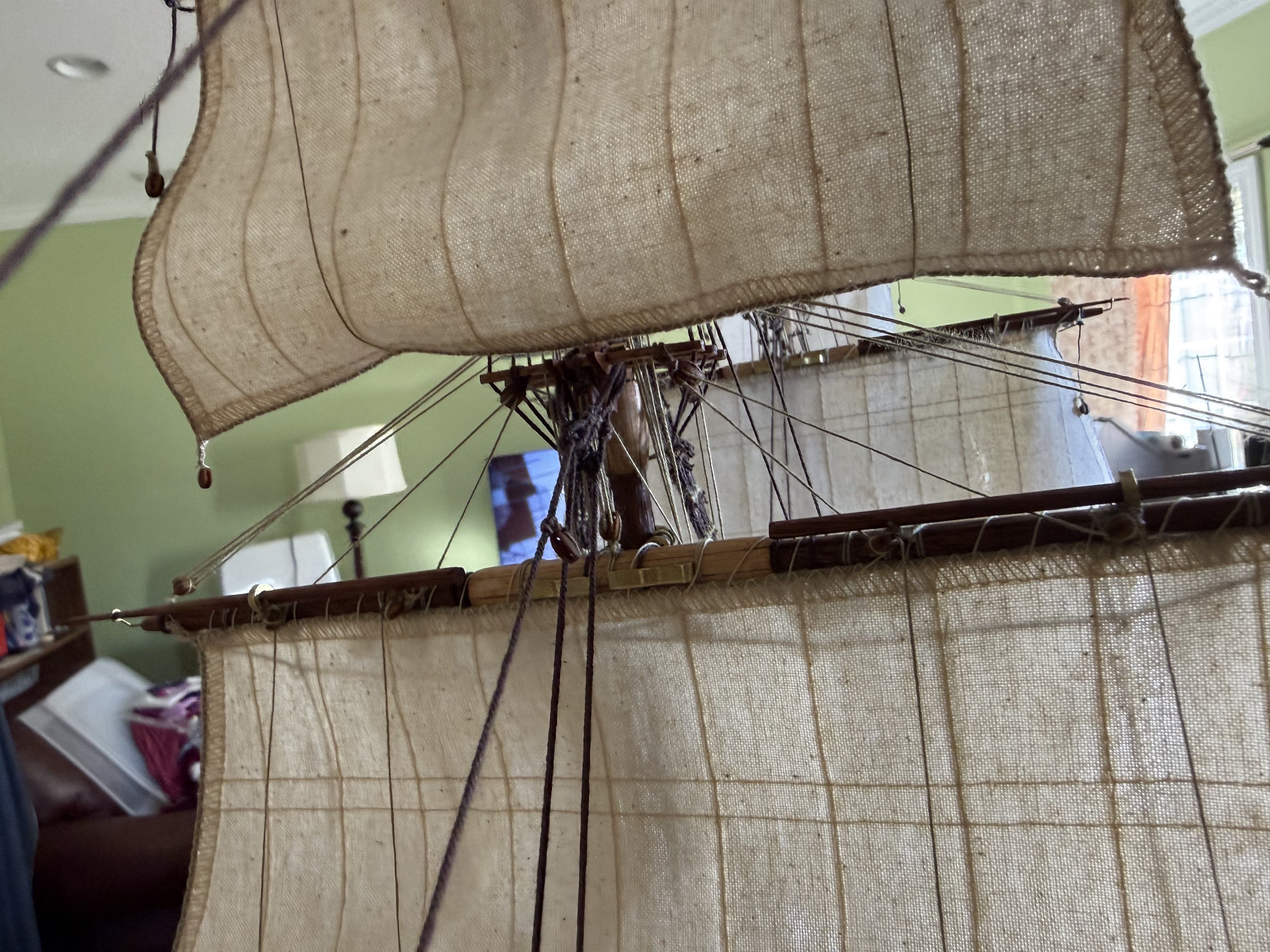

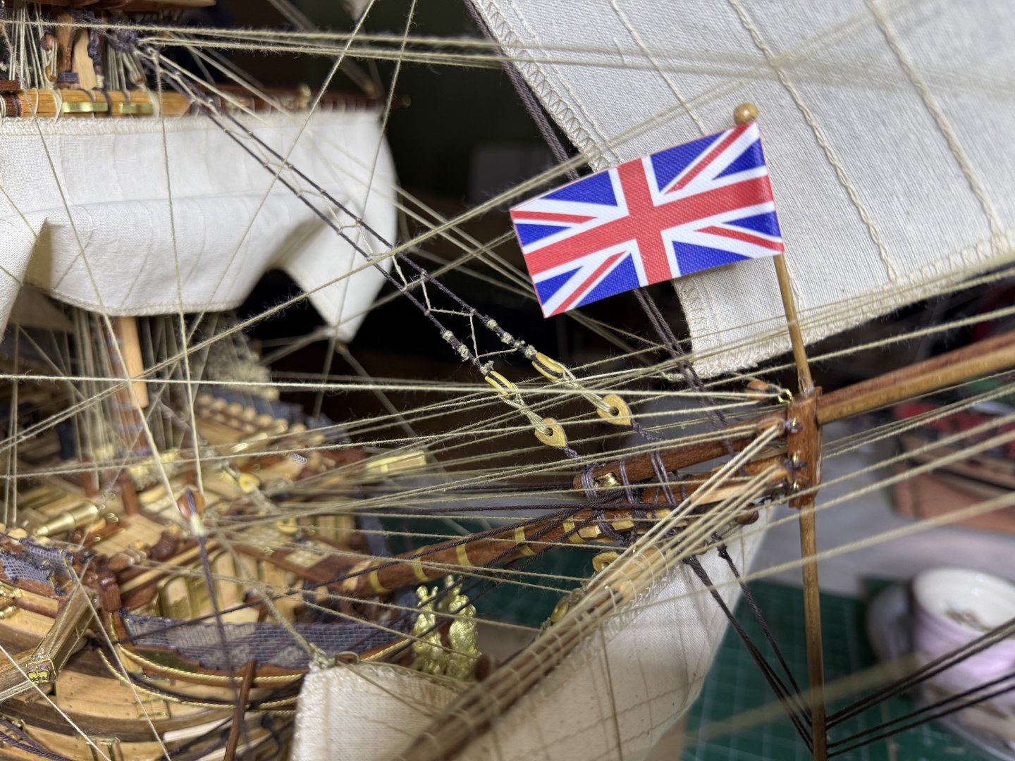

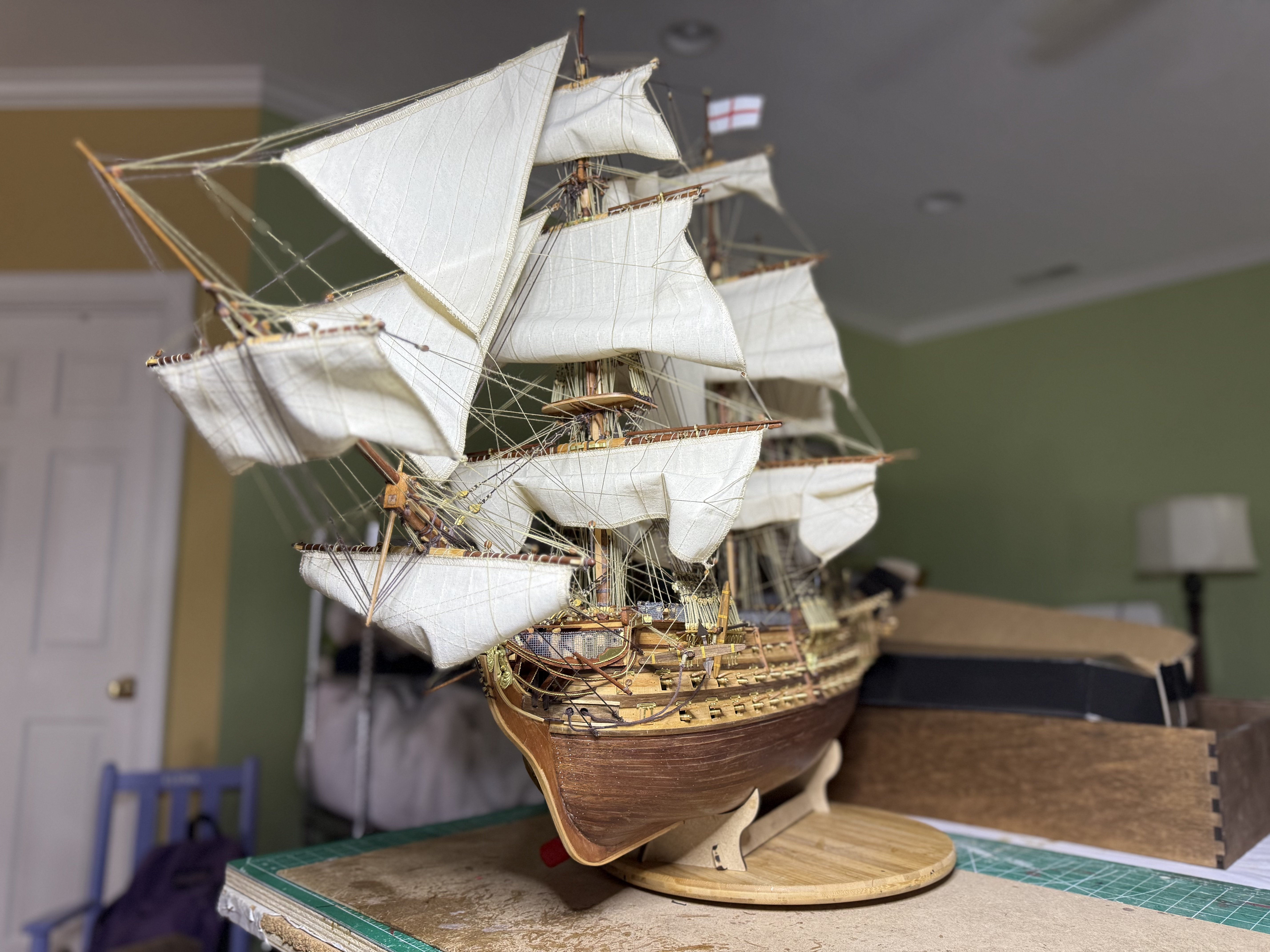

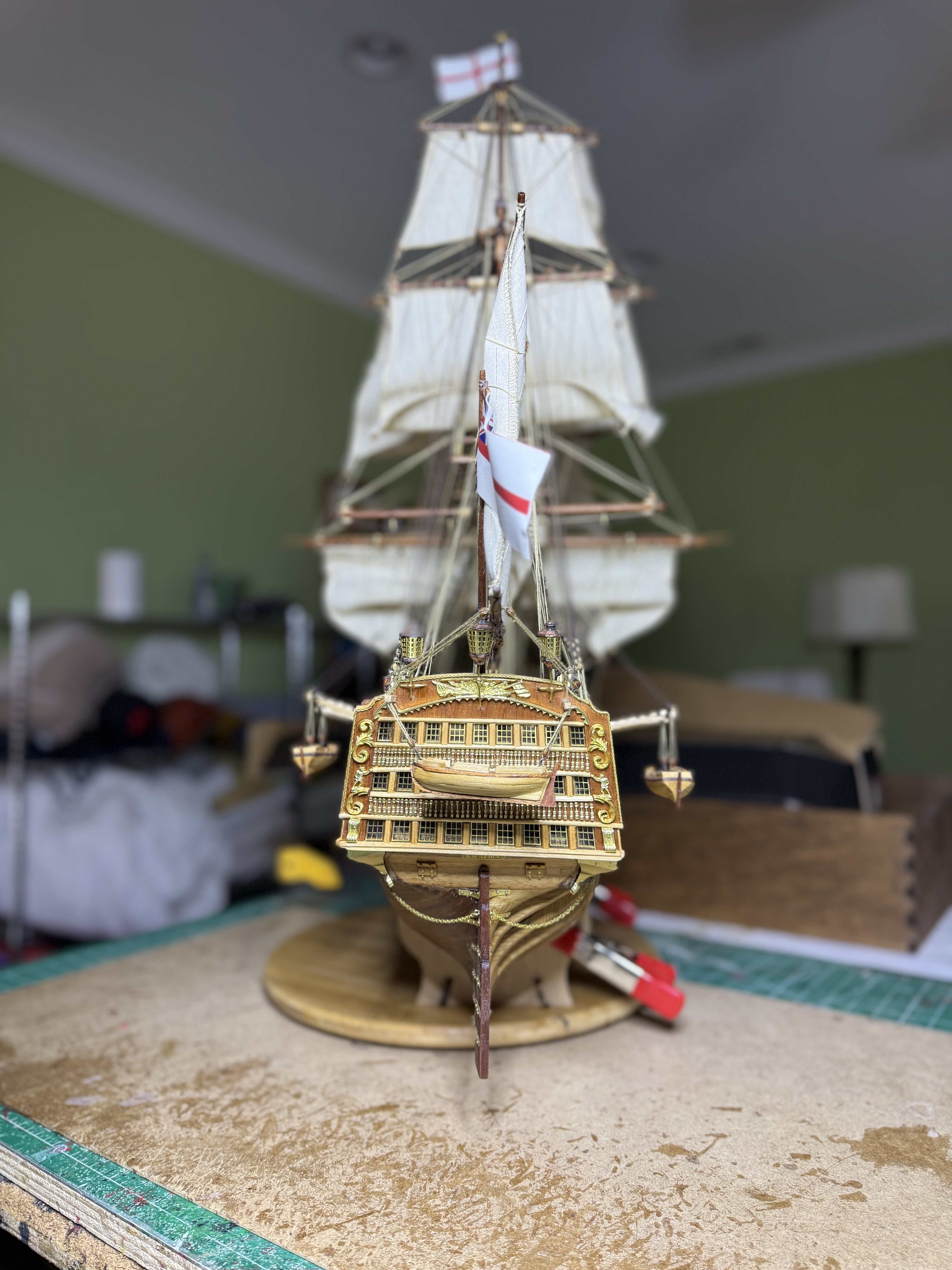

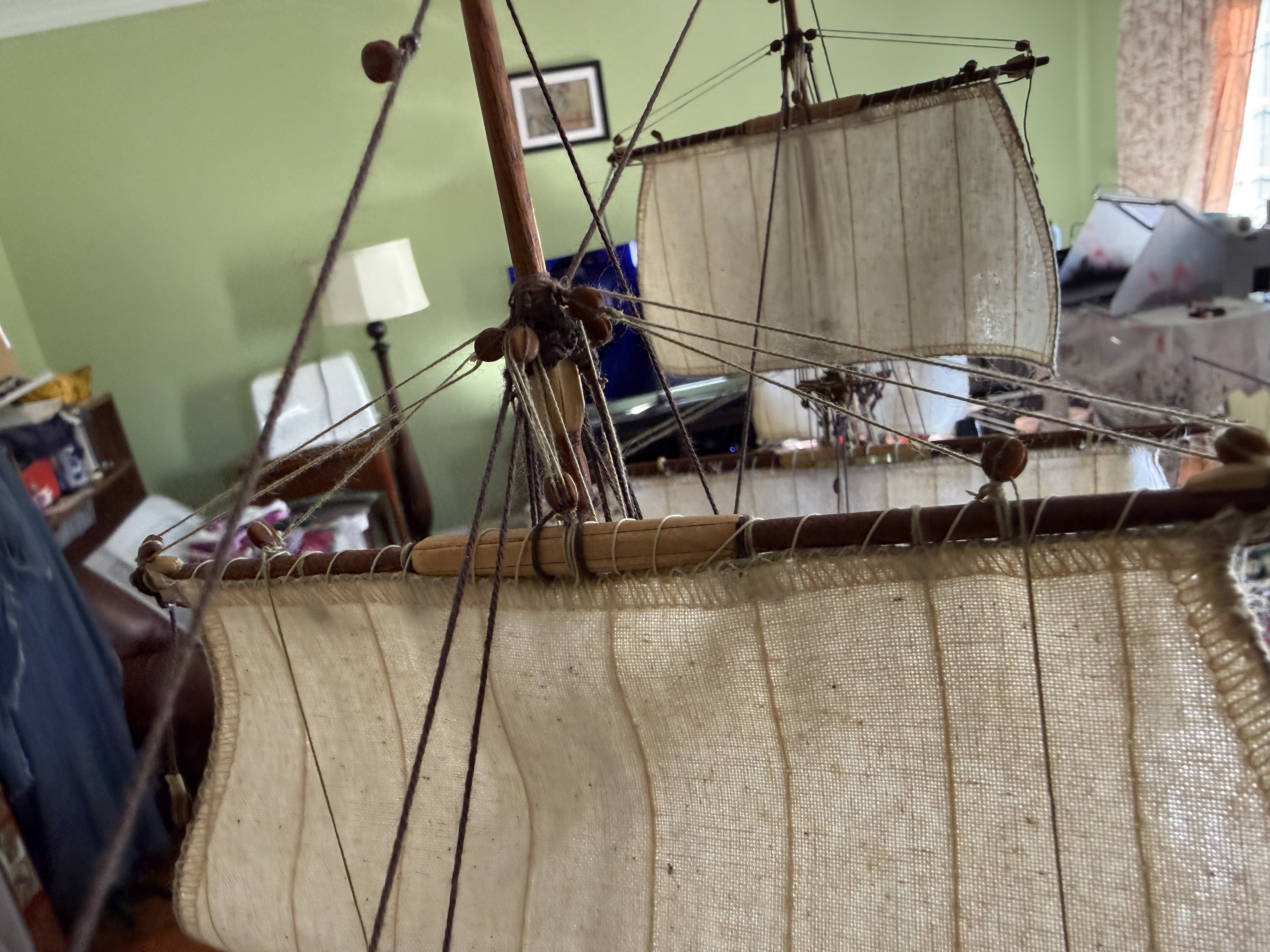

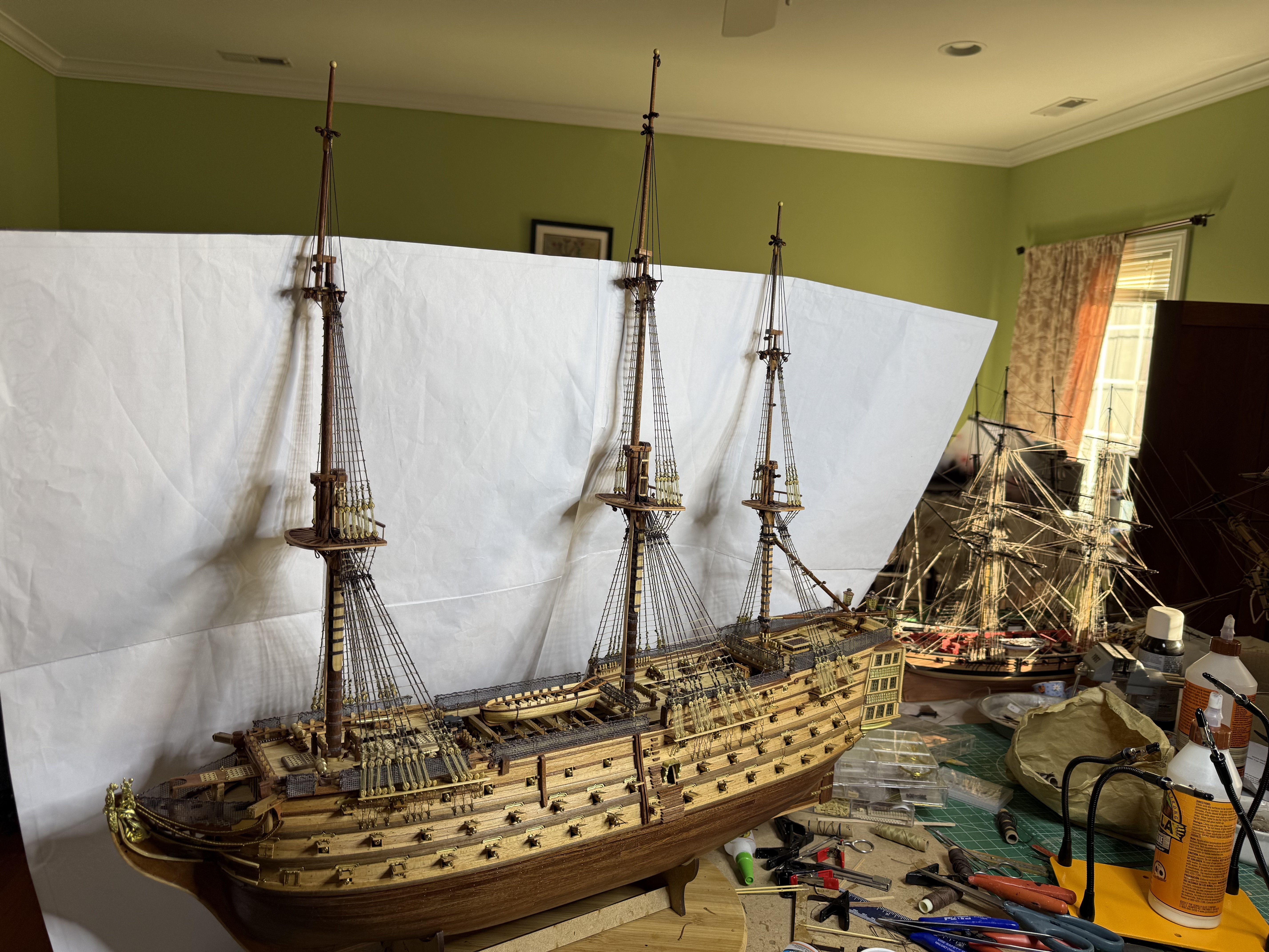

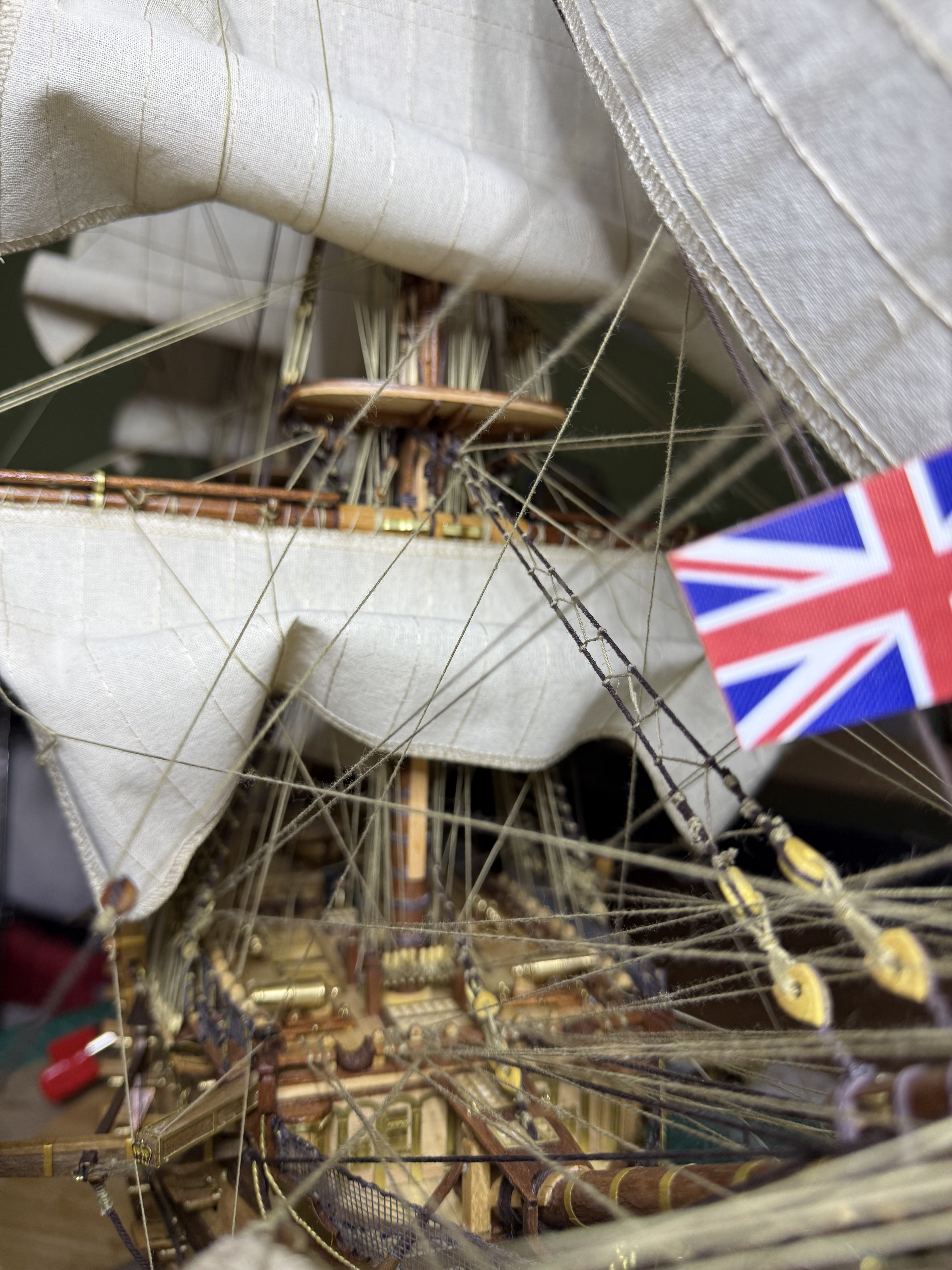

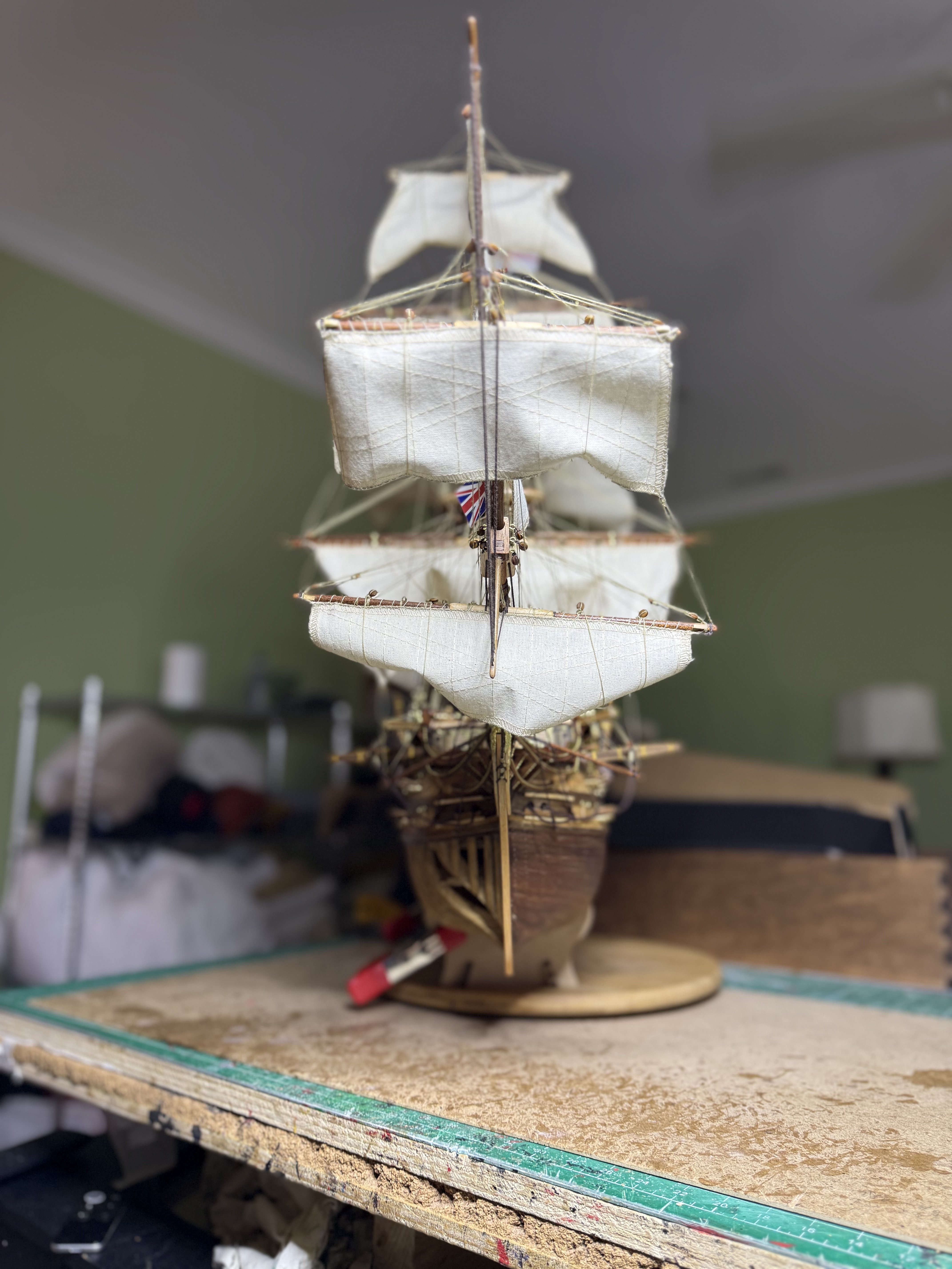

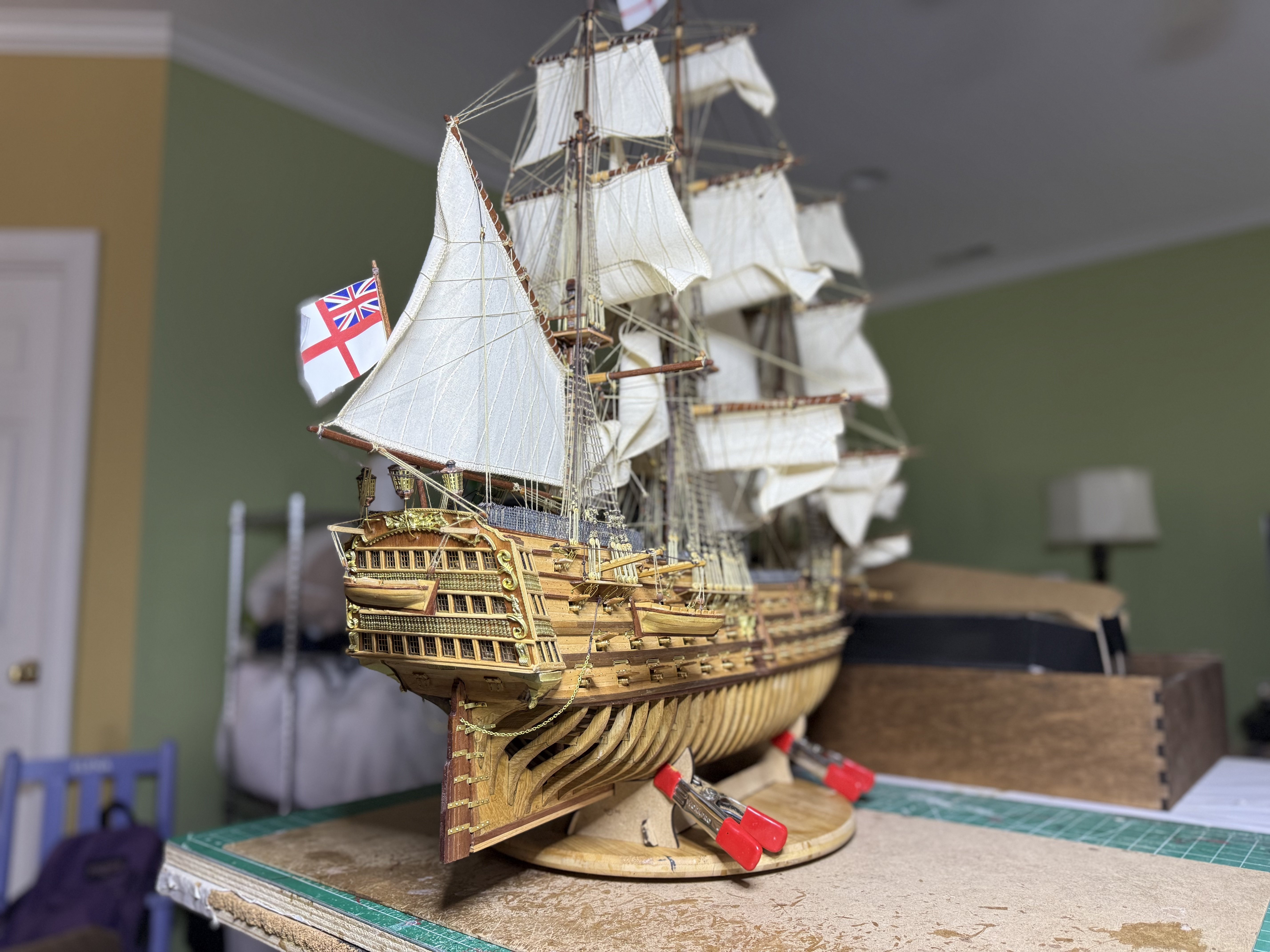

Weekend work involved attaching the mizzen yards with sails then adding the mizzen fore and back stays. Next will be the spanker rigging before finally adding the bowsprit to complete the other stays. I try to wait as long as possible before adding the spritsail yard as it sticks out so far.
