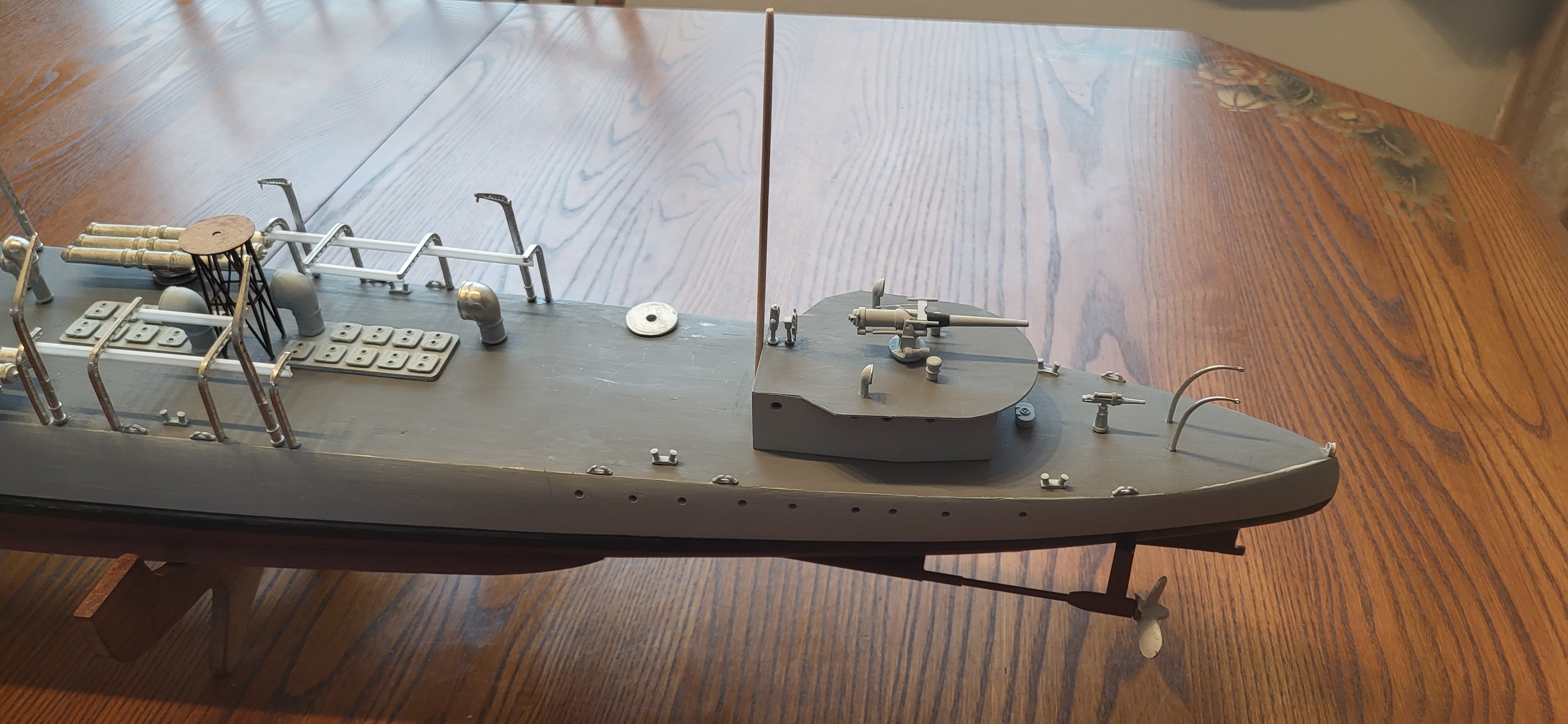

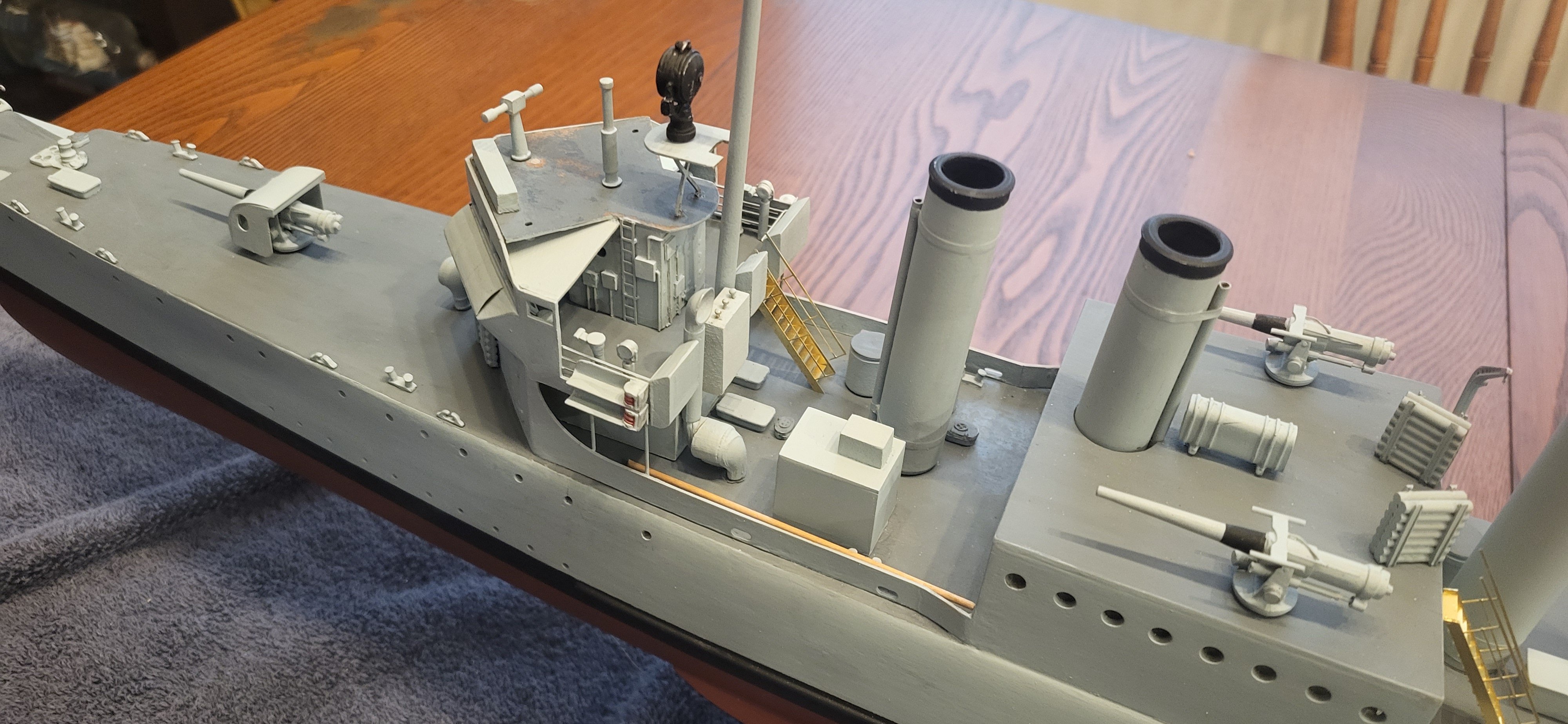

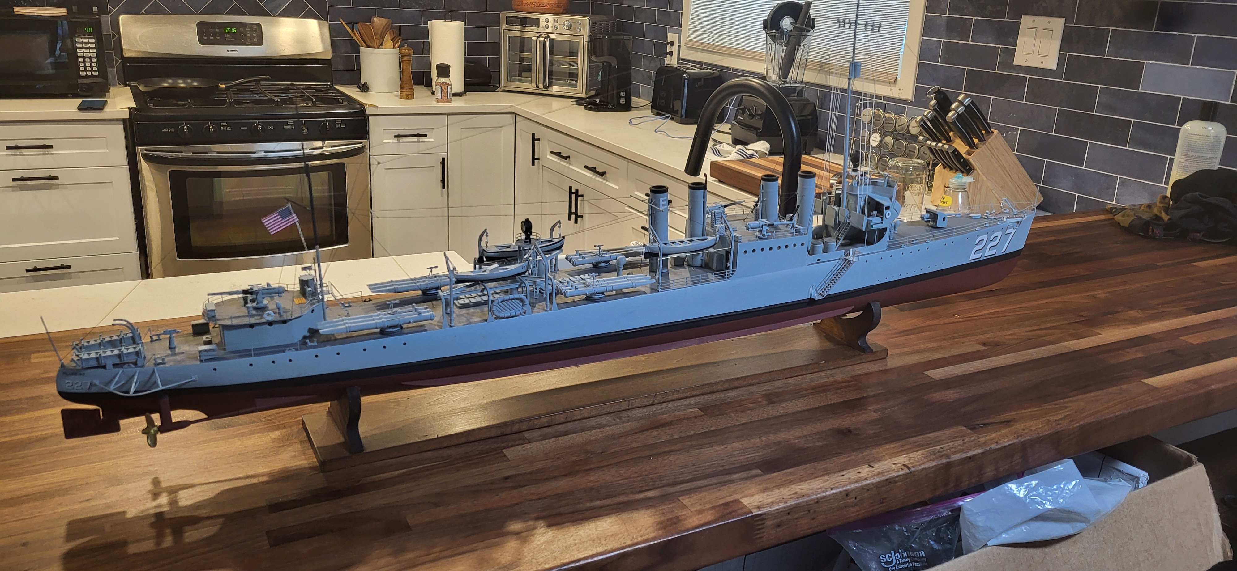

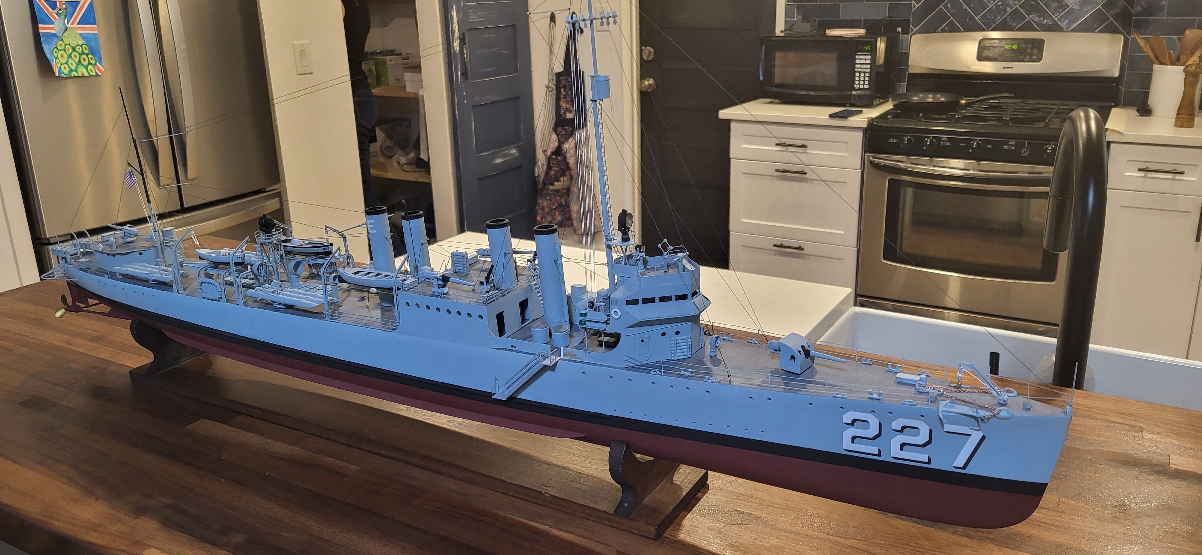

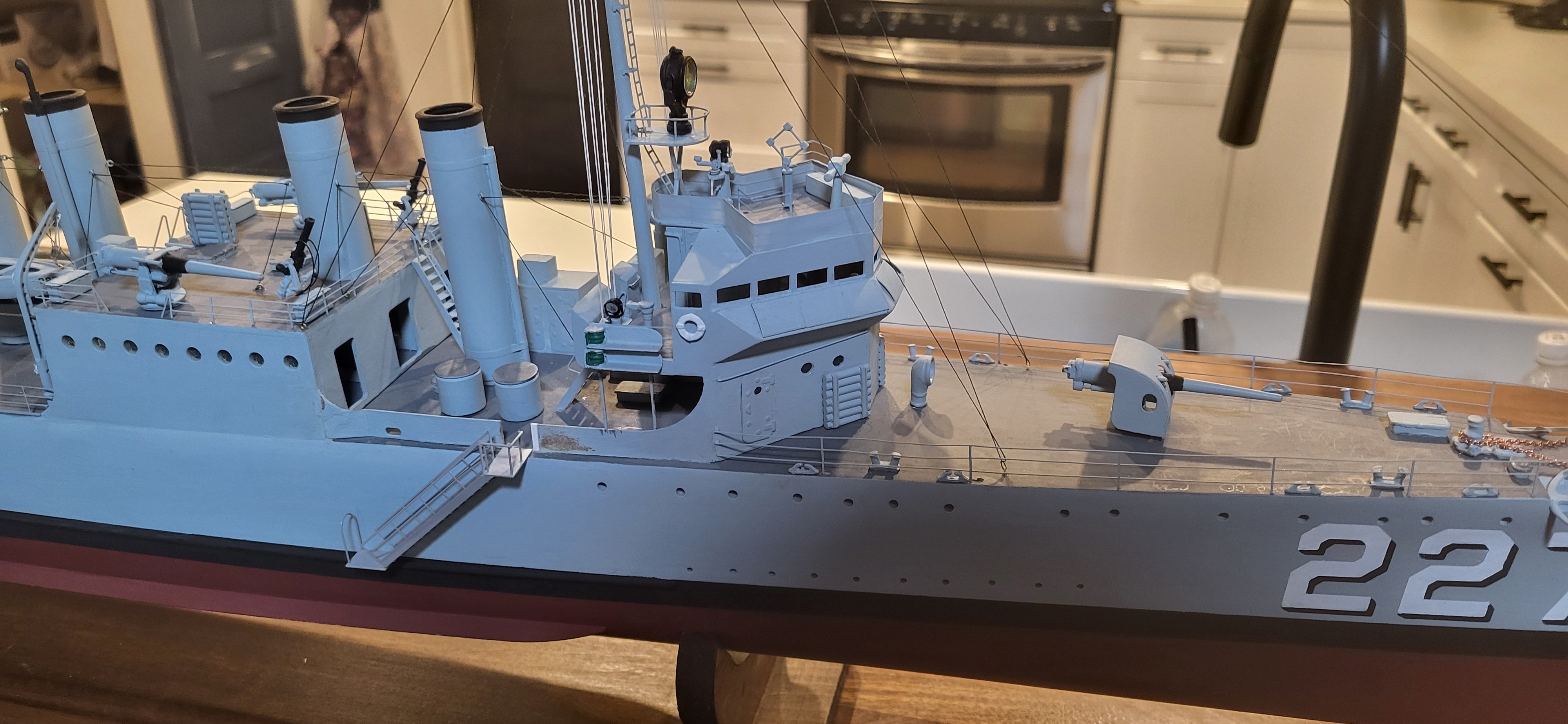

I've started work on the Bluejacket 310 destroyer. I am building her as USS Pillsbury DD-227. She was lost in the aftermath of Java during WWII with all hands. Taken by surprise, this aging destroyer nonetheless reacted valiantly, returning fire and launching torpedoes before being sunk by overwhelming IJN firepower.
Bluejacket makes a great model. It does need some modification to resemble a late 1930s Asiatic fleet DD. I am representing DD227 between 1937 and Oct 1941 as that represents her most complete configuration prior to her collision with USS Peary. Many thanks to "rcweir" for his assistance and to my fiancee, Sarah, for tolerating my latest obsession.
I am all ears for any critiques or suggestion for improvement. I am very much an amateur modeler.

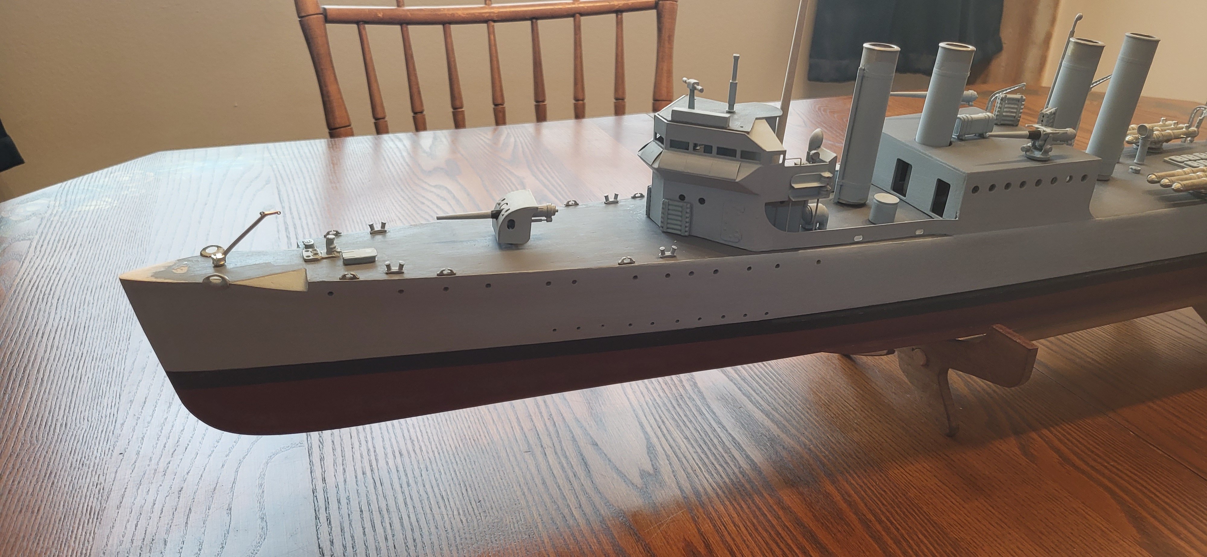

i think your black waterline is too high as should be below the reinforcing hull strake not above it according to the US Navy's Booklet of General Plans of that class i have saved on my computer.

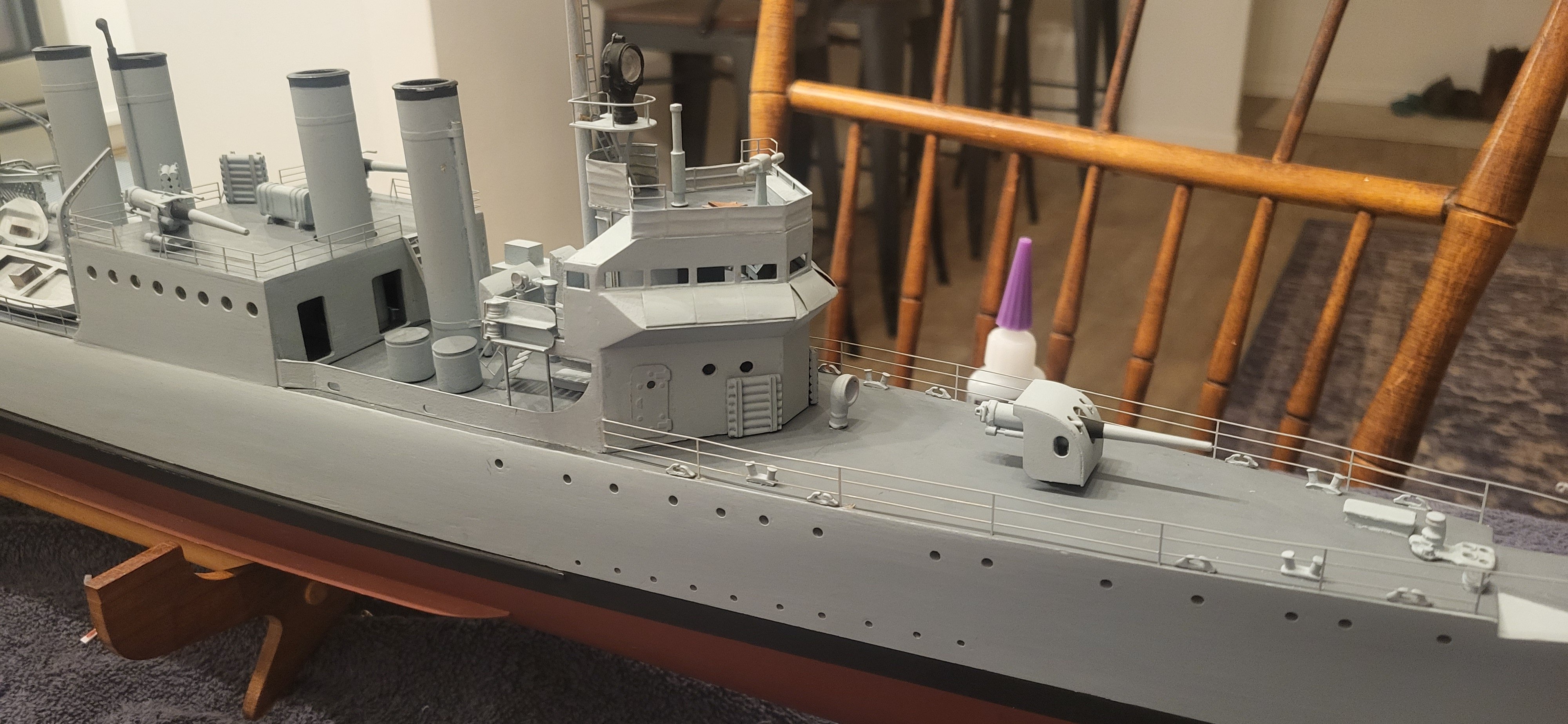

Exactly. It looks like the higher boot topping was just about universal by the 1920s.

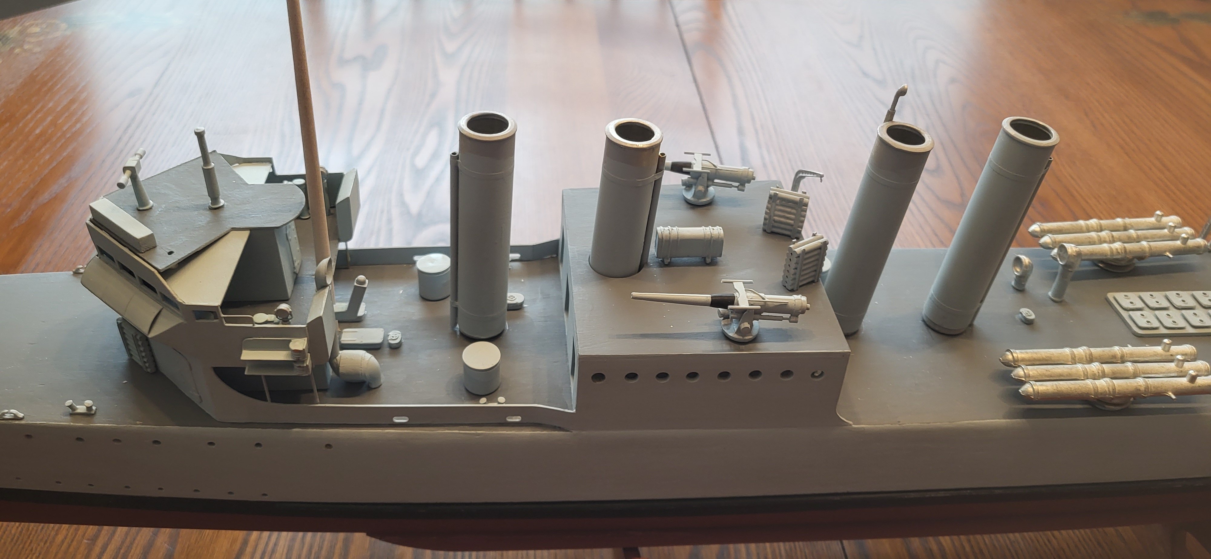

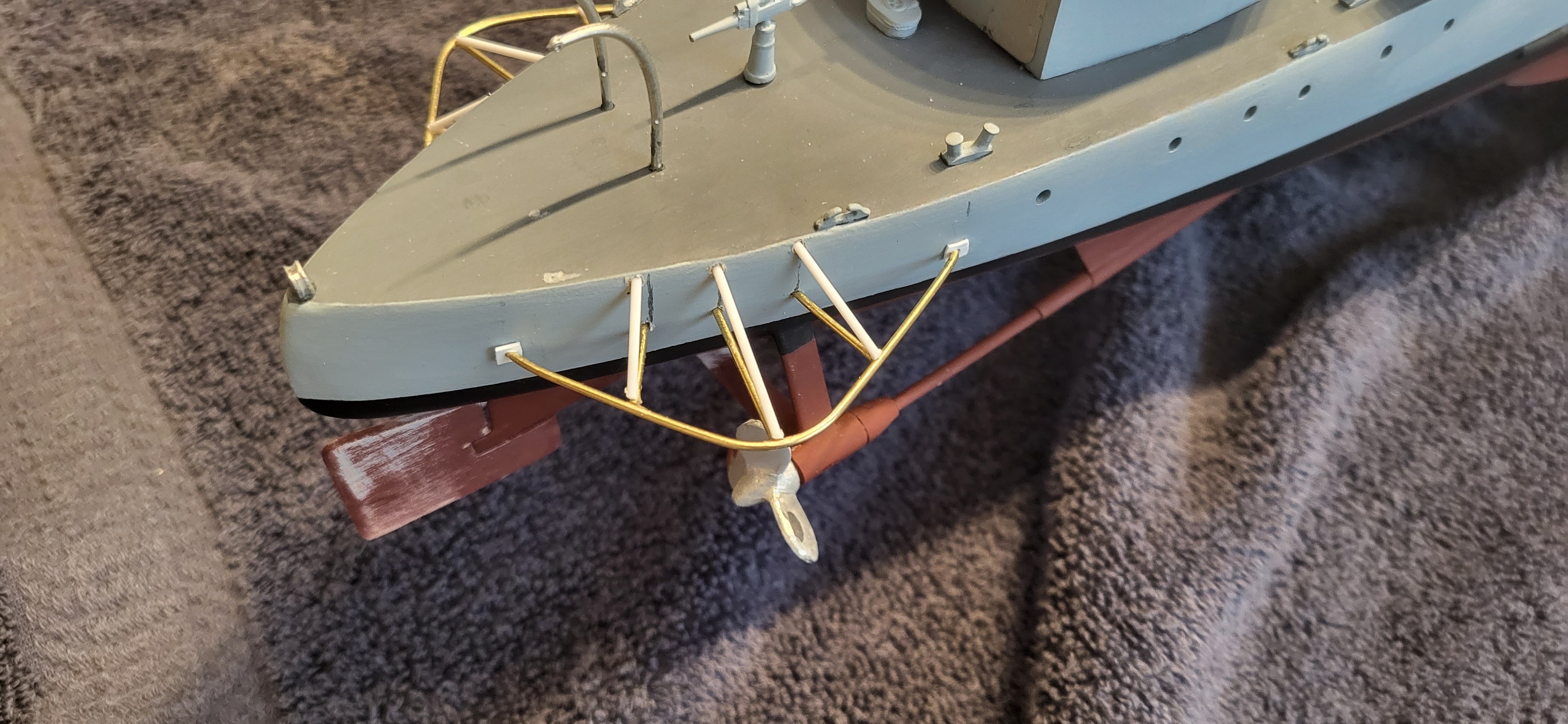

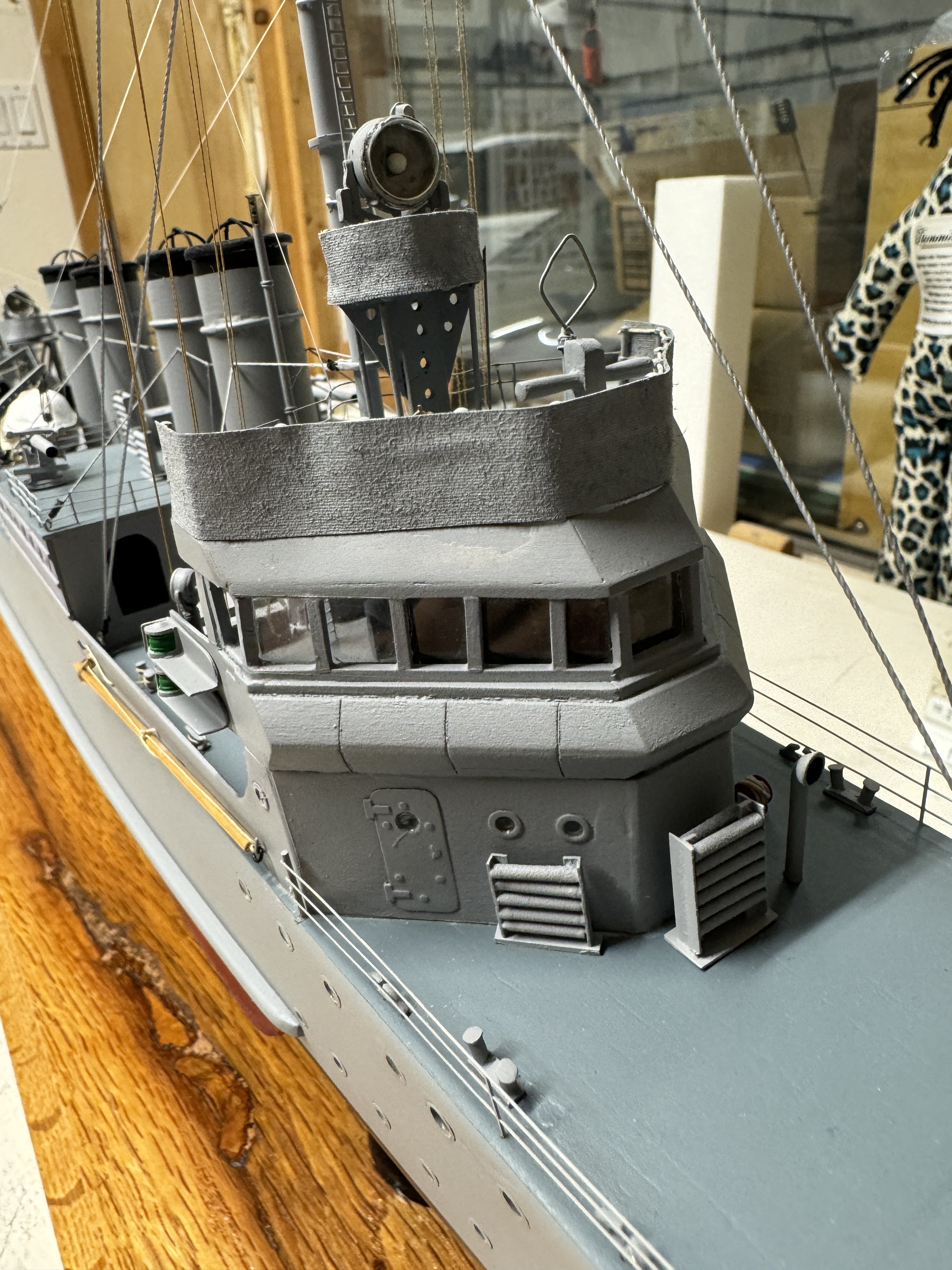

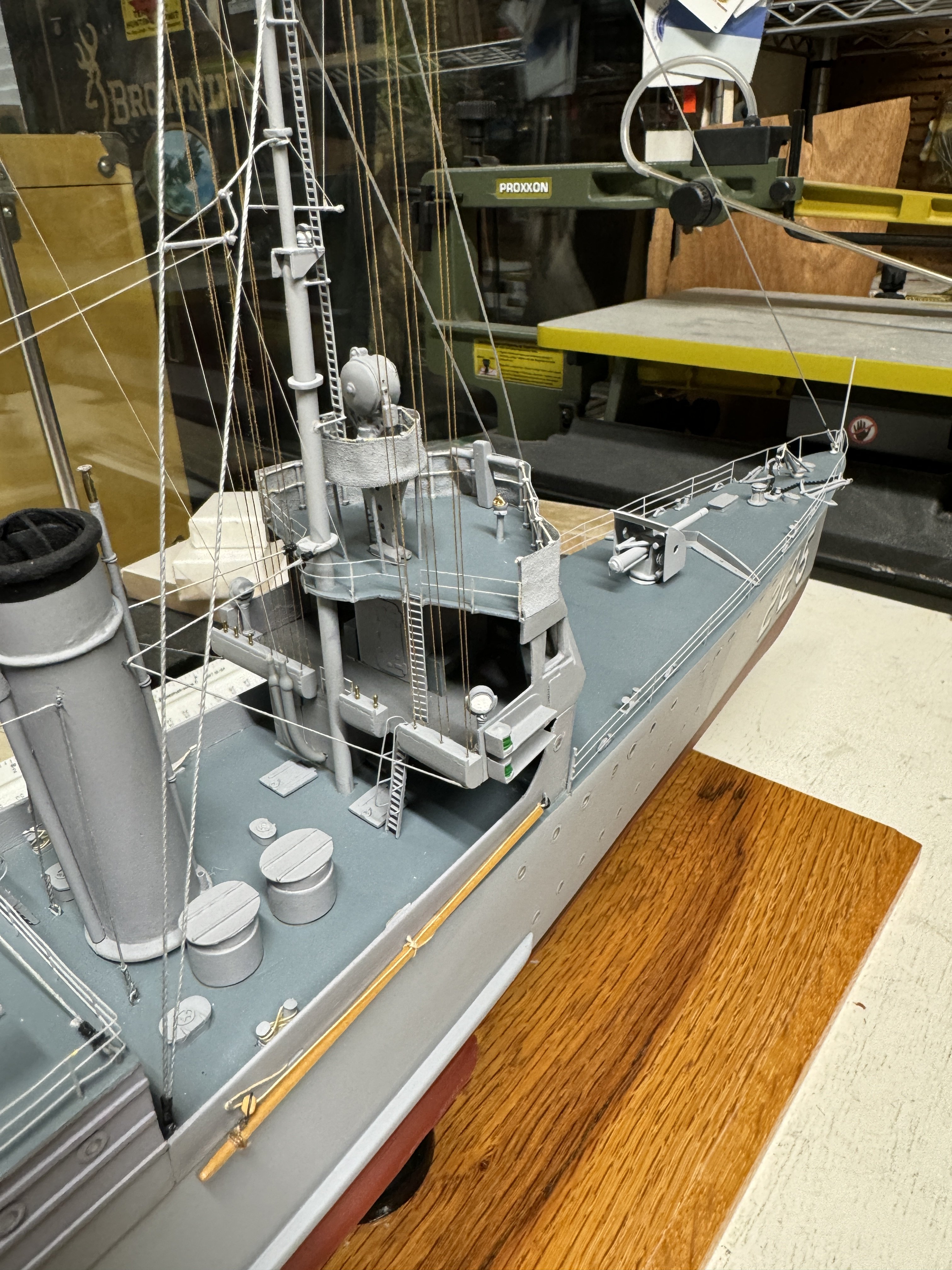

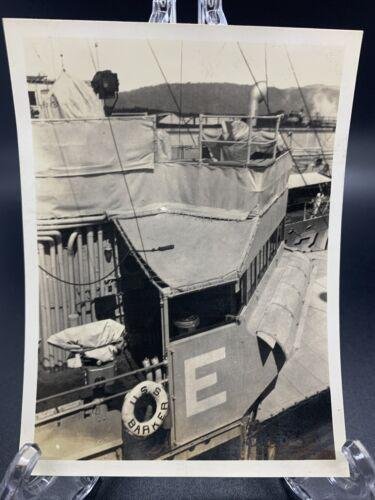

I've run into another minor issue. Prewar Clemsons had a rather unique railing setup on top of their bridge. I've attached two reference pics as opposed to trying to describe it. These railings were covered by canvas and painted grey to match the hull.
Any ideas on how to replicate this? The Bluejacket kit railings are two bar.1_4c1f7f4fb0ffa723973f7284f7dbc84e(1).jpg.db14c7079c929c226fd3ae0e8fd026e4.jpg1_4c1f7f4fb0ffa723973f7284f7dbc84e(1).jpg.db14c7079c929c226fd3ae0e8fd026e4.jpg0512107.jpg.68039bb3eaa6159acecabc9c5edbedab.jpg
what are the bluejacket railings made from, pe, 3d printed or what?  the canvas can be made from tissue paper then painted same color as vertical side of superstructure.
They are PE... unfortunately they aren't even close to the 1930s configuration
If I understand the railing issue correctly it looks like some areas are 2-bar and higher parts looks to be 4-bar. You might be able to "double- stack" some short pieces of 2-bar where needed. If their length is a problem you can always trim them to the needed length and then add a small piece of spare PE to make the vertical stanchion at the end. The key would be to get all the required bending done first before glueing pieces of PE to each other. The painted tissue idea from ddp works well and would also serve to cover up some of the joints.

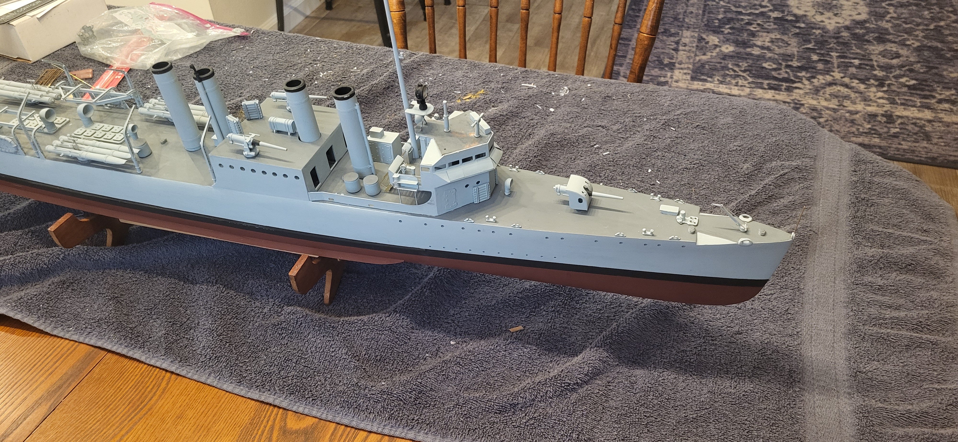

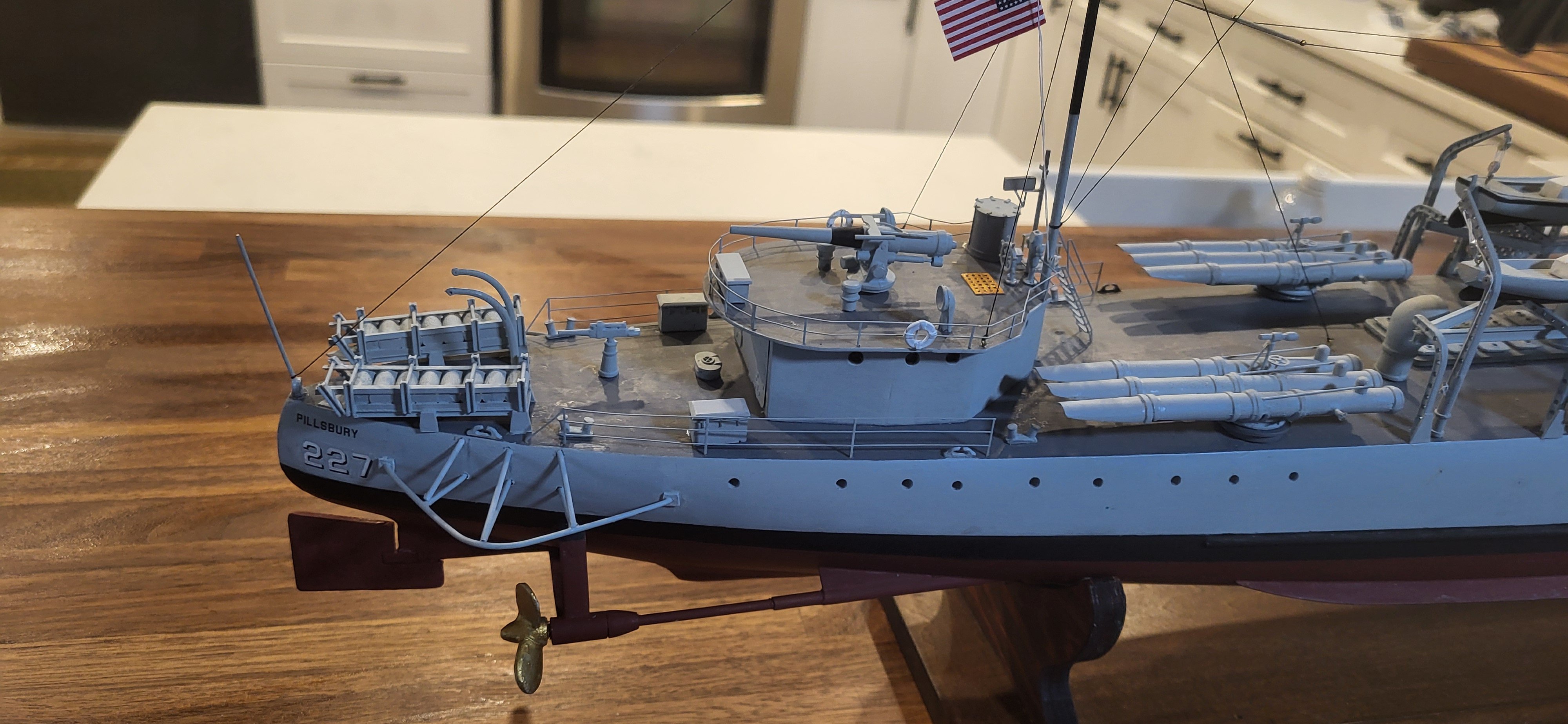

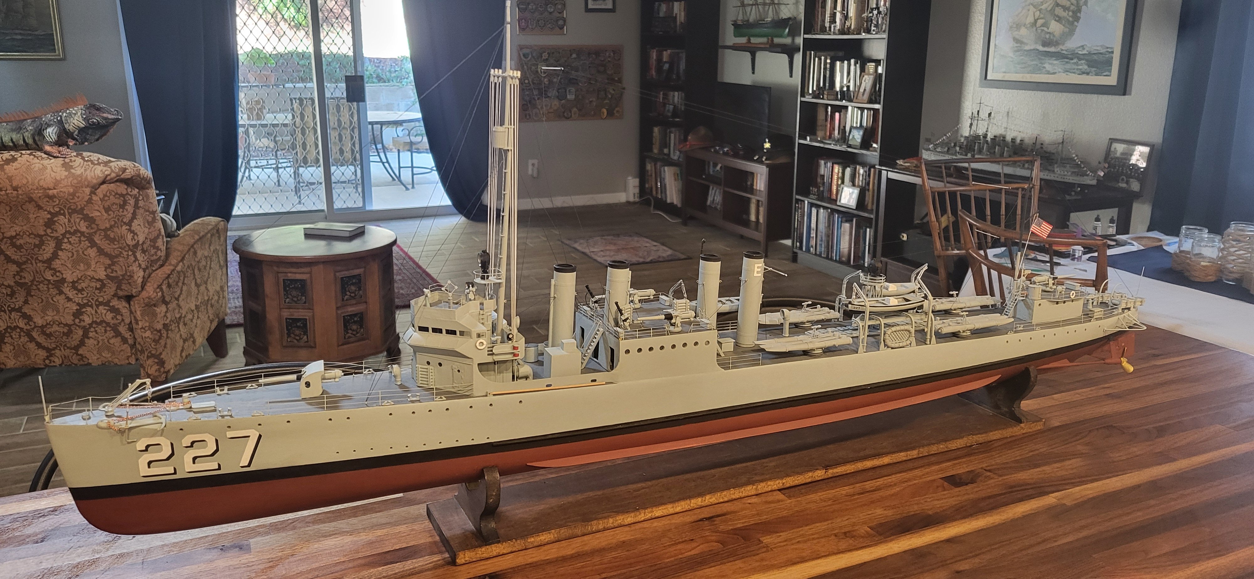

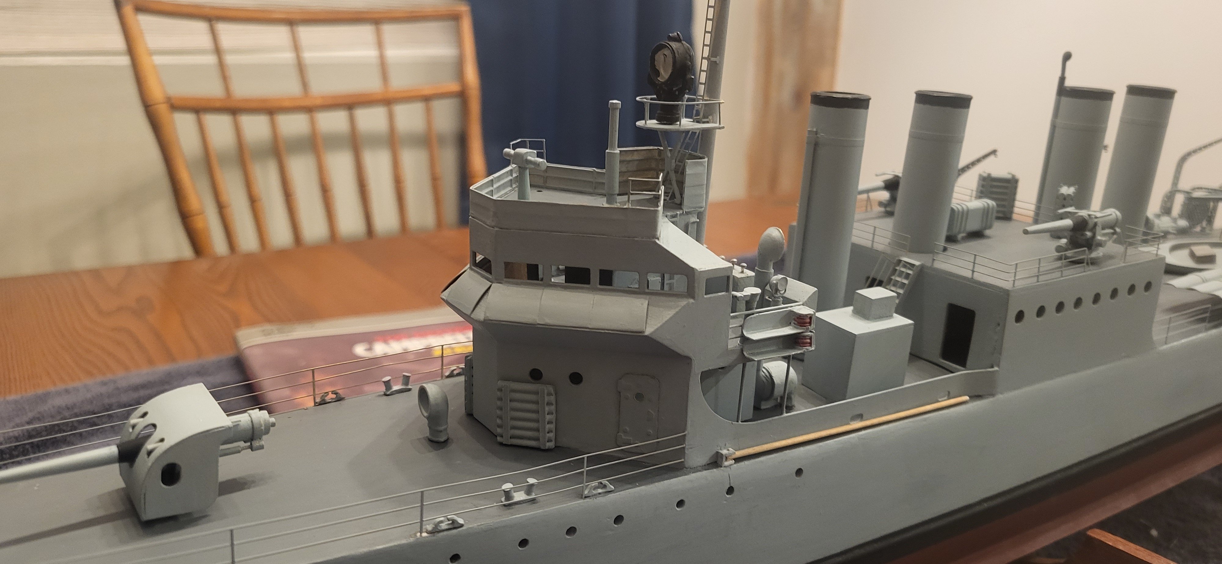

Thank you for the compliment. Just discovered that I had misspelled the word dodger. I think you came up with a  great solution for your model. Although it looks like you are about finished with the Pillsbury, my best research was done by reading A Family Saga Flush-Destroyers 1917-1955 by John L. Dickey.
Excellent book for anyone interested in these forgotten tuff little Tin Cans.
Looking great!  Your .50 cal mg's came out very nice.

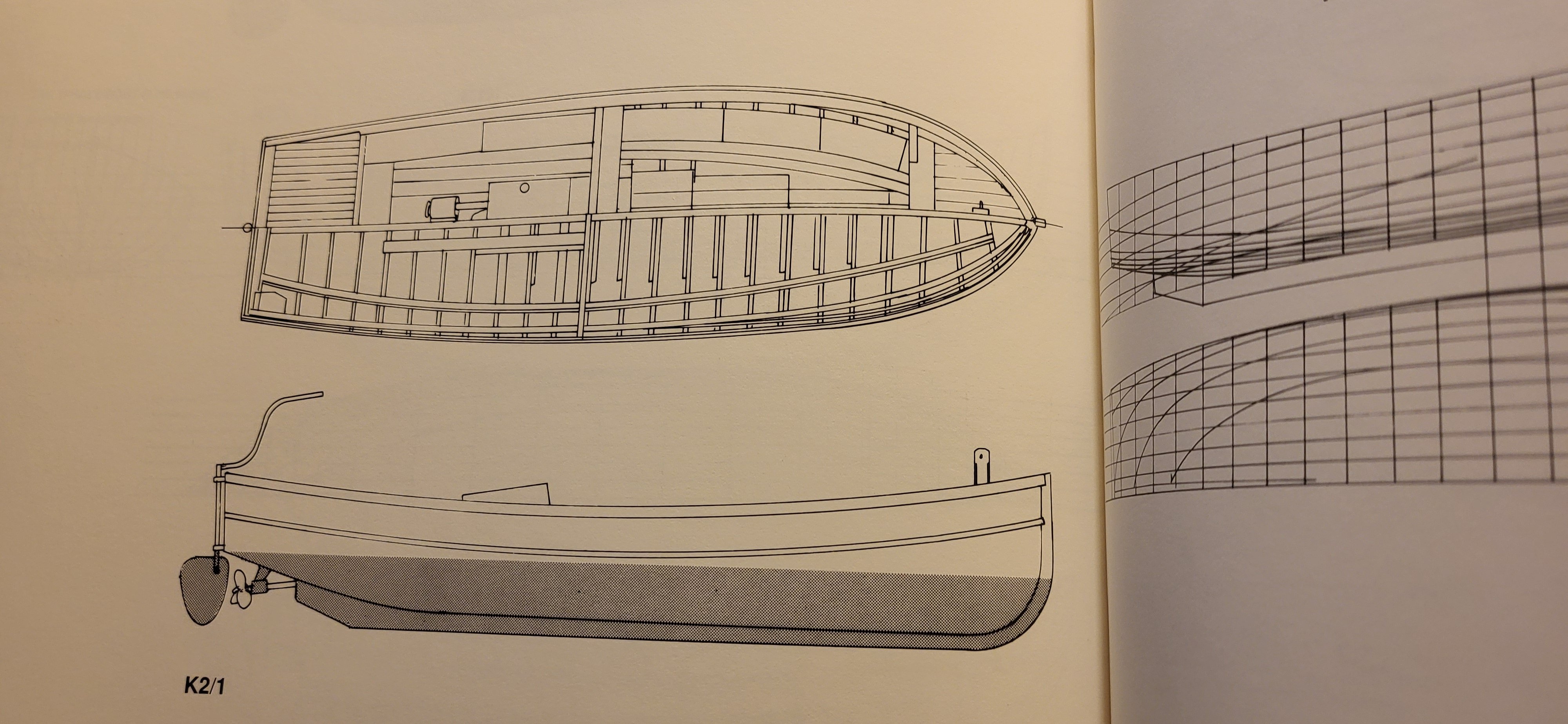

You might try Distefan 3-d printing, they have a lot of stuff in 1/96 scale, including a motor whaleboat. They might be willing to gin up a launch for you.
The following link will get you to the website, you then select 1/96 scale, their MWB is on the first page.
