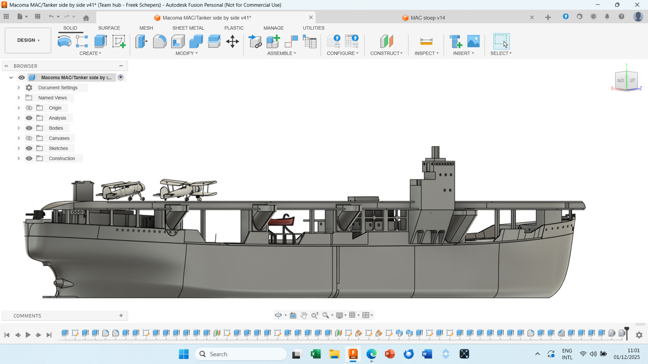

As the first level of the deckhouses in the bow, stern and midships follow the hull shape, I used for a deck the top of this level. Then I constructed the actual deck level and used that plane to cut out the hull including the first level of all three deckhouses.Picture2.png.149db55a9035ebb145b195209ece8312.pngPicture3.png.afe3affb21d01b015c9ba97729a2fa4c.png
Above a side view at this stage, superimposed on the scaled side view of the tanker. As the rib plans were traced from a poorish image, at this stage I spent some time changing the rib drawings until the hull appeared best. This is very powerful as you see the hull shape change instantly. Without actual Macoma plans this was the best I could do.Picture4.png.626c4f5a8b684e958e2634cf492c486f.png
And here is the same hull body superimposed on the carrier side view. It fits both quite well.

Then I split the ships in two halves lengthwise and combined the tanker and carrier into one design. Here is where I think the concept will work for this ship - the half width deck still looks typical for a carrier and the tanker deckhouses are well recognisable. Have to decide how to paint the “cut” surfaces that would not be seen in the individual models and the masts of the tanker will still affect the overall view.
also at this stage I cut the three sets of model parts (hull, tanker superstructure carrier superstructure and carrier deck) into 5-6 parts each to fit the side of the printer, making sure there are big enough glue surfaces between them. Several bolt closures are included also.

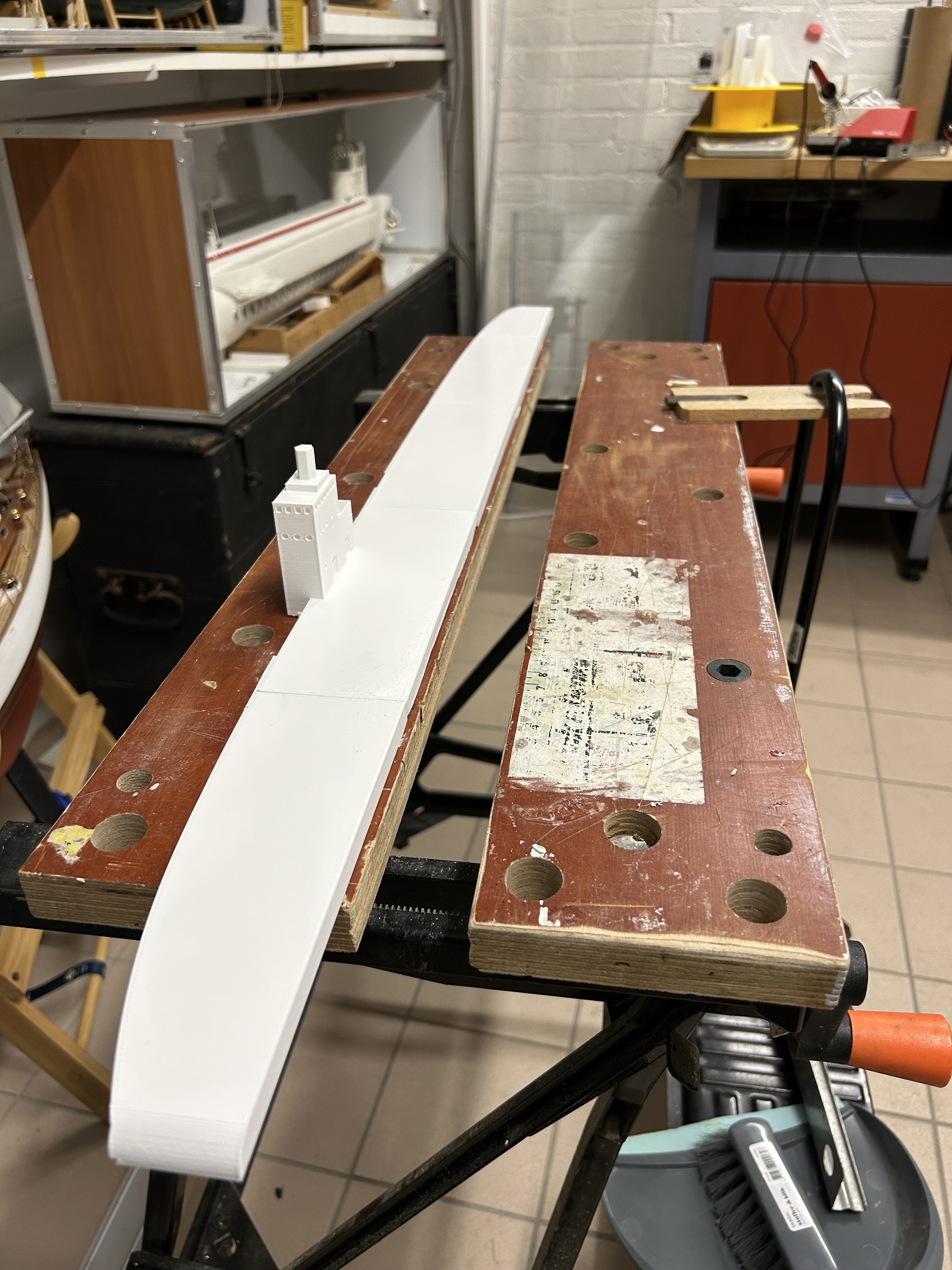

also printed the half flightdeck which has been sanded once. IMG_1528.thumb.jpeg.ec3bad66dff8d2abb1c0e7a00baf3f0c.jpeg

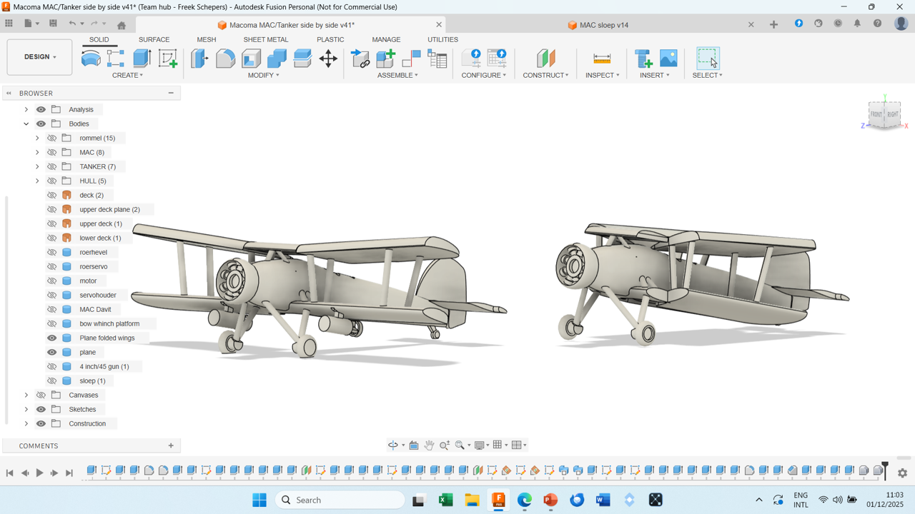

Macoma had two to three Fairy Swordfish planes on deck. There was no hangar.  Wikipedia has a nice set of side view, top view and front view drawings of the plane, which I used to construct the planes in Fusion. The actual prints will be 7,5cm in length, so I strengthened some elements like the spars between the wings to ensure enough strength. If they print well I can still try to narrow them. I constructed a full plane, then cut off the wings along the hinges, and reattached them in folded position.
when viewed on the half-width deck of the carrier it is clear just how difficult it must have been to take off and land on such a narrow deck.  Just clearing the island looks hard. Also designed son of the larger details such as lifeboats and the gun aft. Picture11.png.a06a8a16d856b1c7ef15f4dc592b974f.png

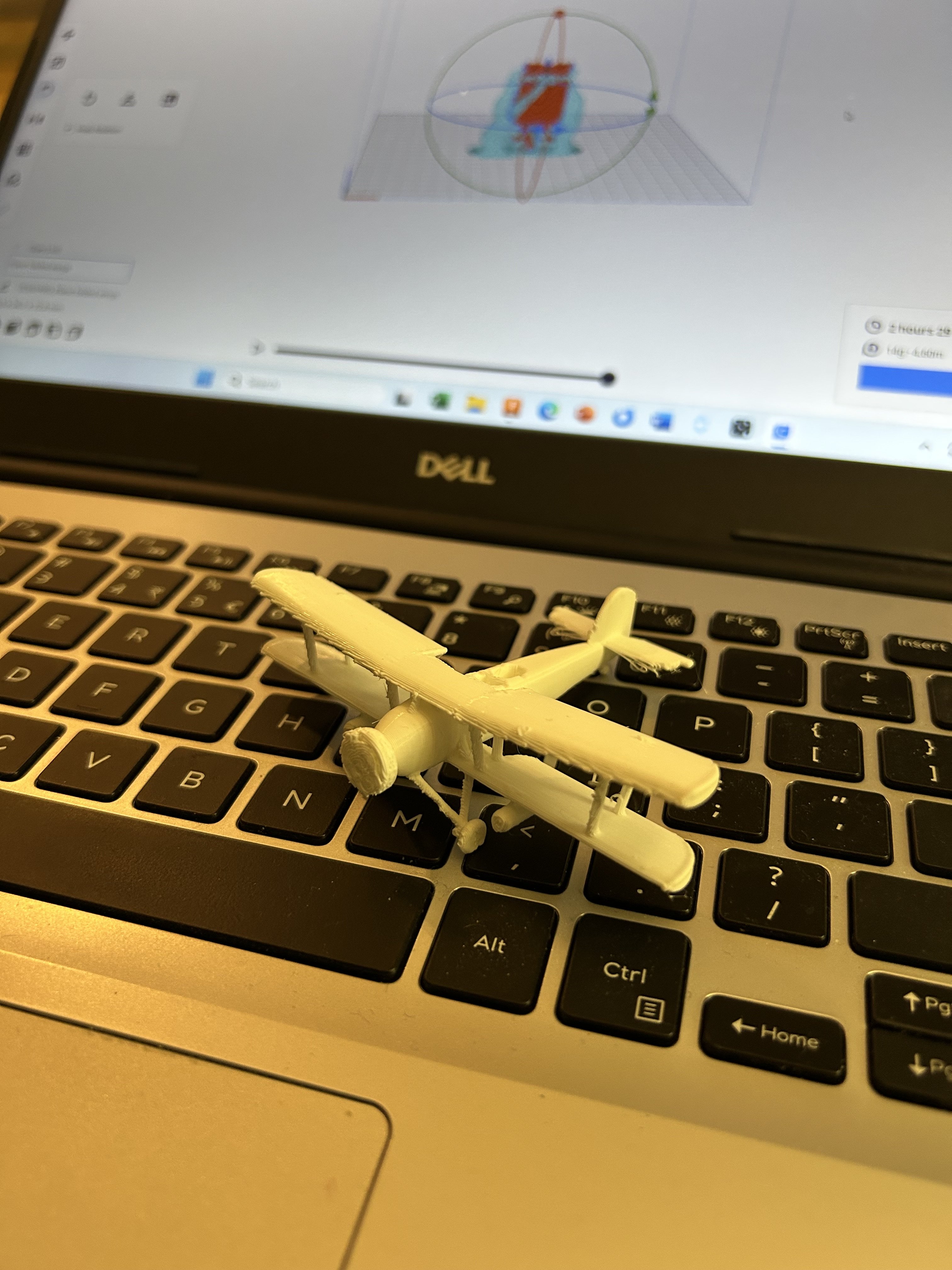

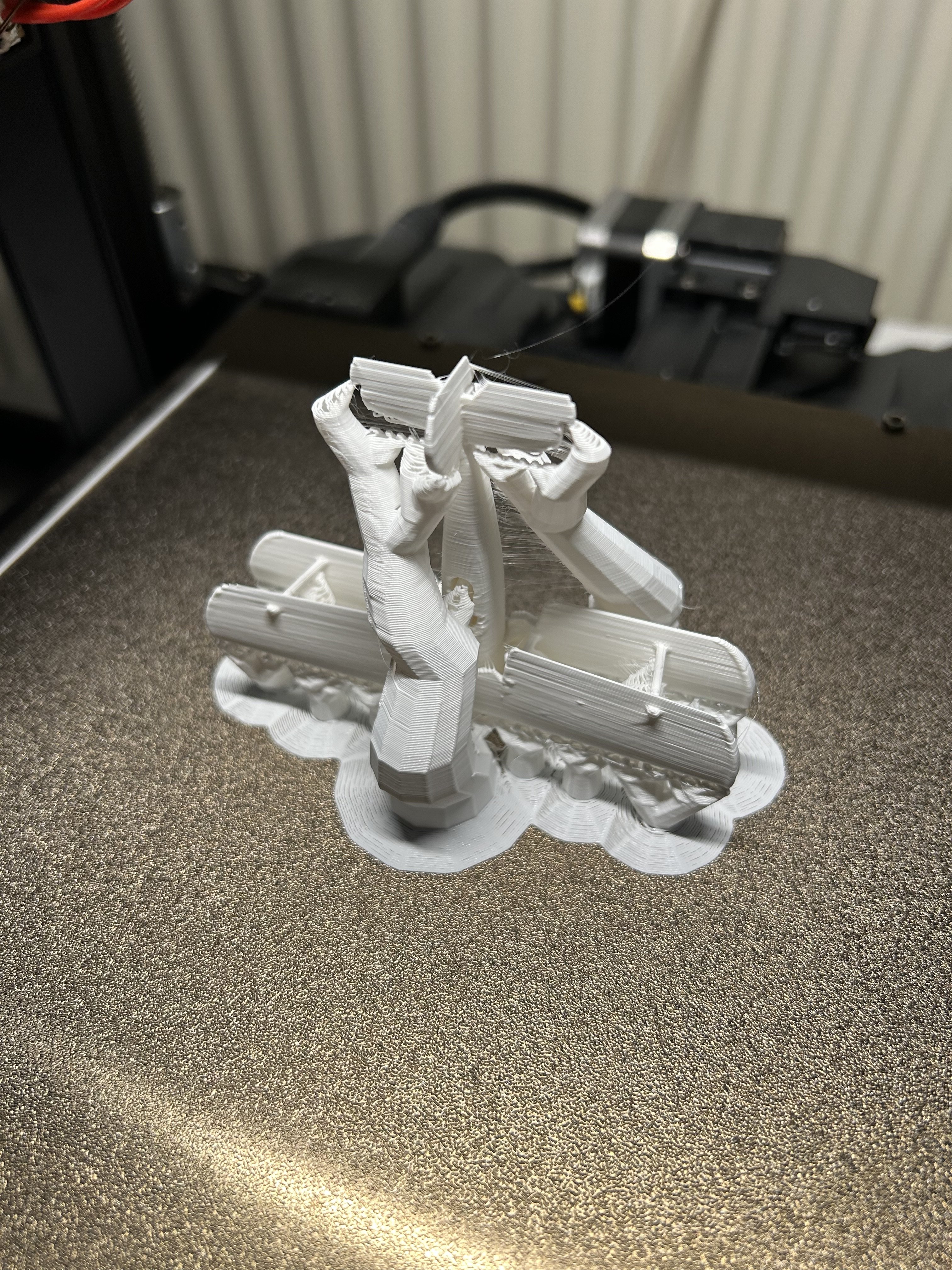

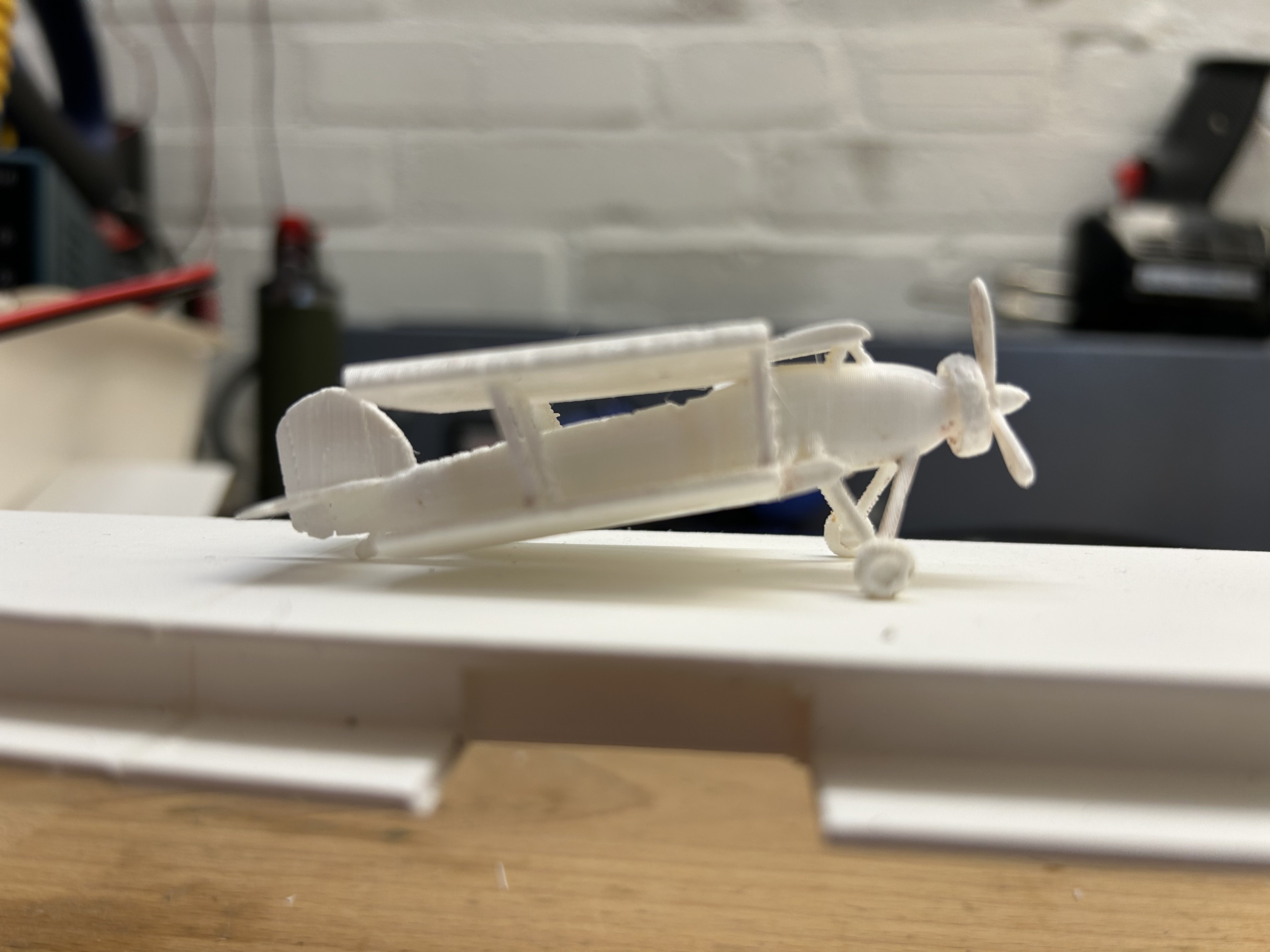

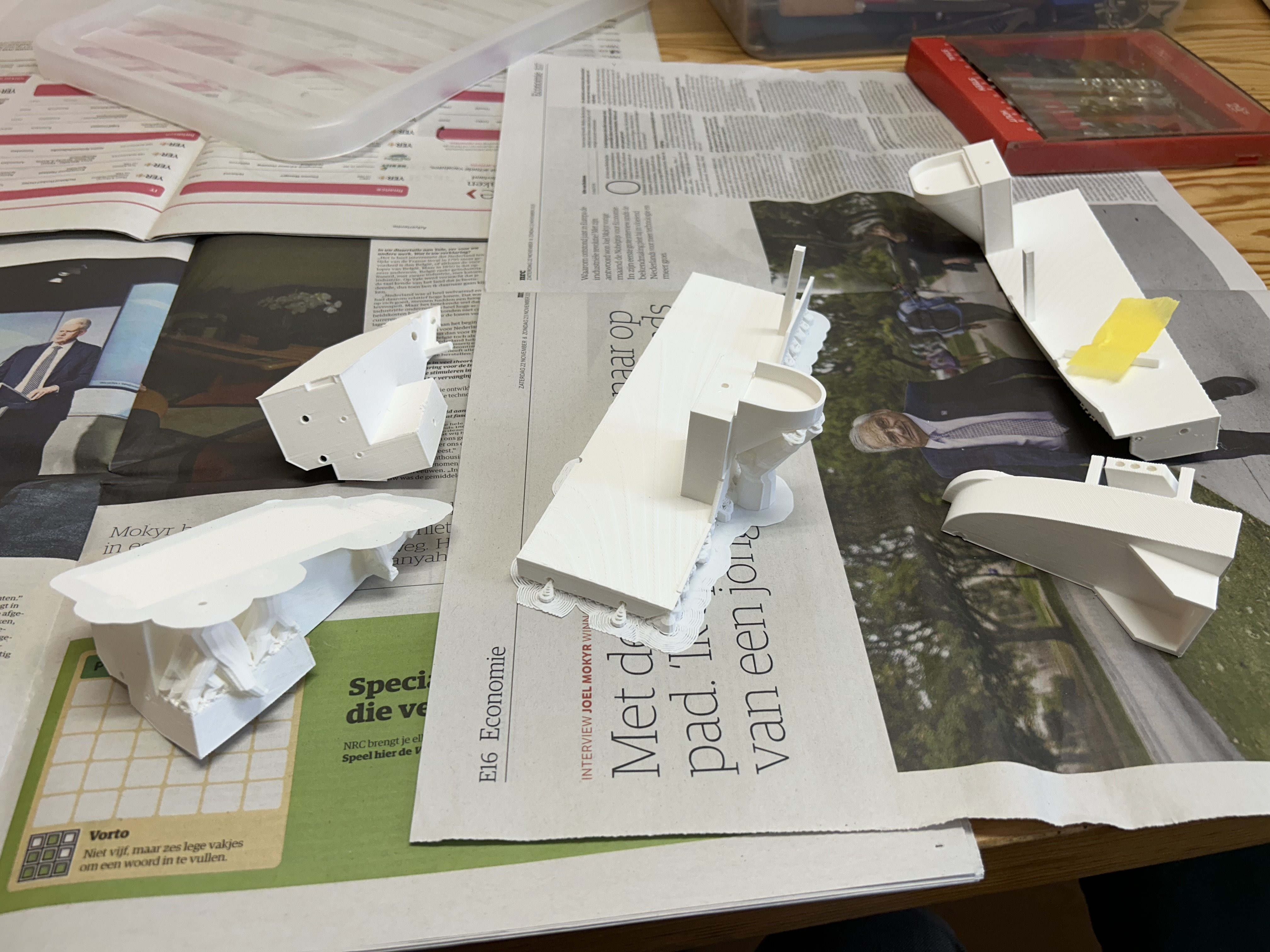

Here is how the first prints came out, the first during printing - note the horizontal stabilisers lost contact with the support. Then the full plane after removal of the support, and the second version with folded wings (and temp attached prop) after initial sanding.
IMG_1564.thumb.jpeg.c8fd10bd6cab785341bcf41673b10b2f.jpegIMG_1565.thumb.jpeg.5b203f9f22d9688e11ebf6af638d4d29.jpegIMG_1566.thumb.jpeg.fab13af6d14c7591887ff2473517c7e1.jpeg
You may well have seen a Swordfish under my name on TV....
BTW, I put up a tutorial on RCG in my USS Bodega Bay/HMS Puncher thread starting at post #30 on how to size and print aircraft for 1/144 scale RC Aircraft carriers.
USS Bodega Bay - or...HMS Puncher? - Page 2 - RC Groups
Have a peek - cutting the fuselage in half part-way then gluing it together will give decent results with less supports required in my experience.
Your printer looks like it's got a bit of loose-ness in one axis result in those pronounced lines across the wings and tail - check your belt tension maybe?

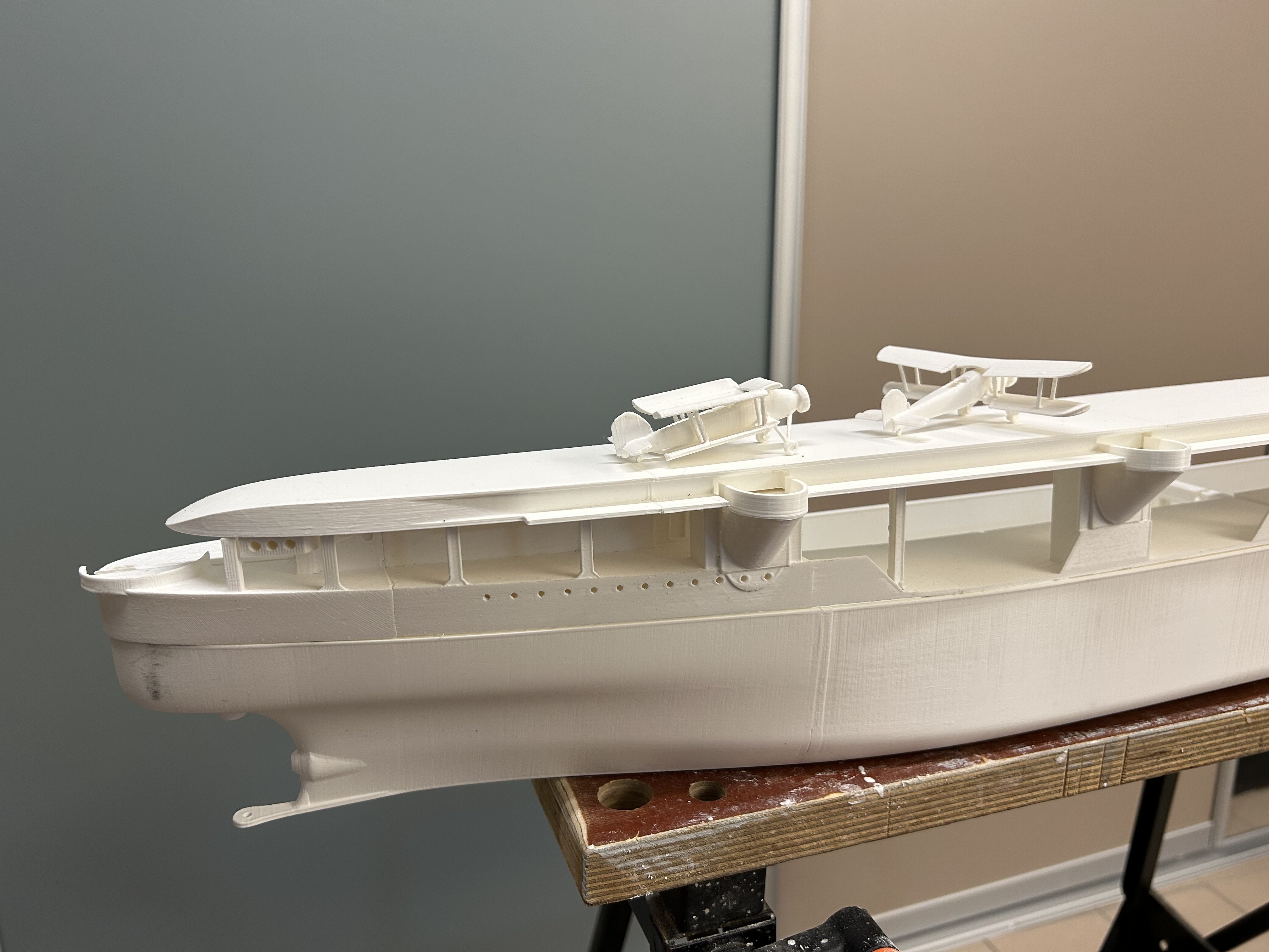

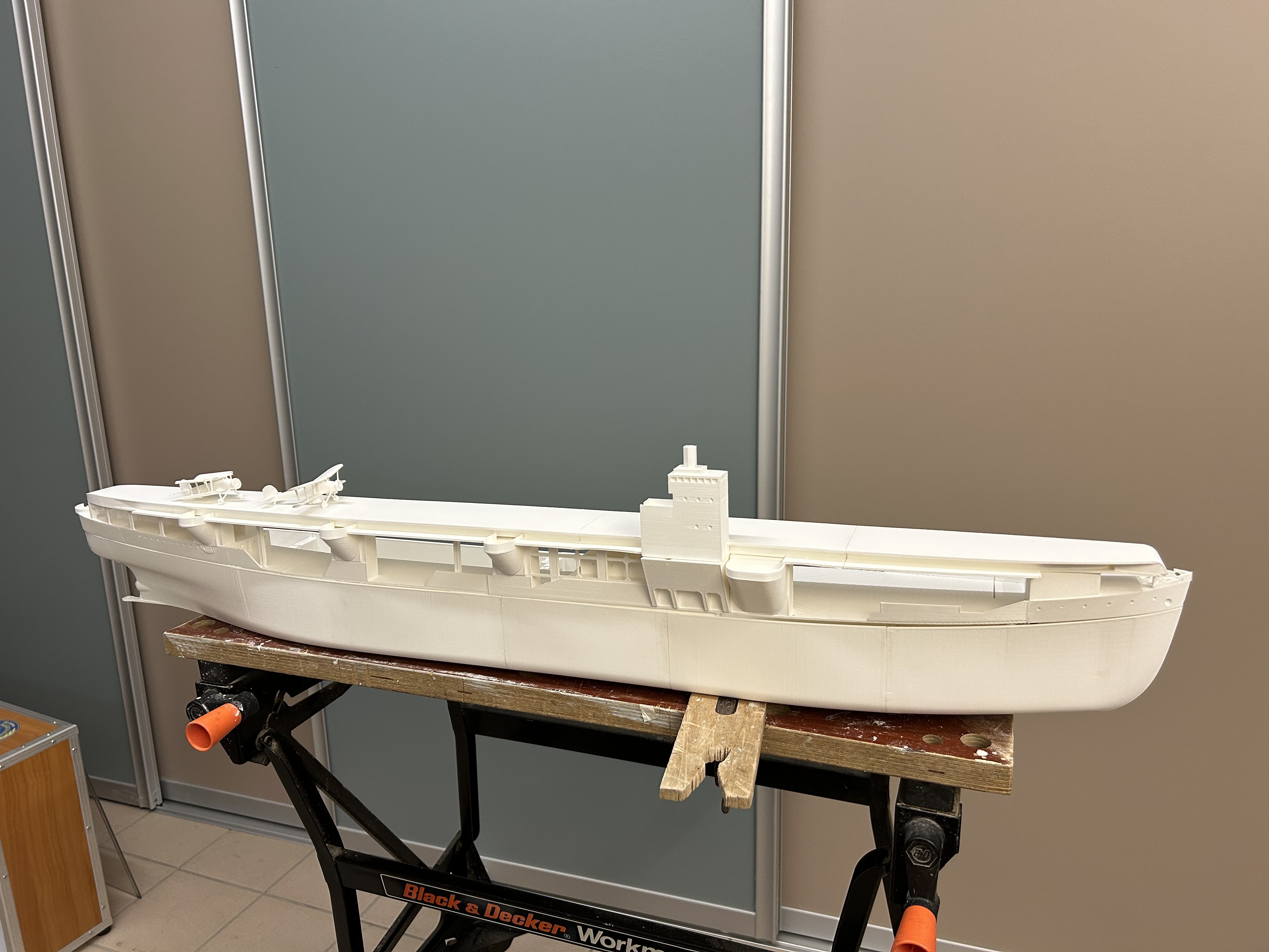

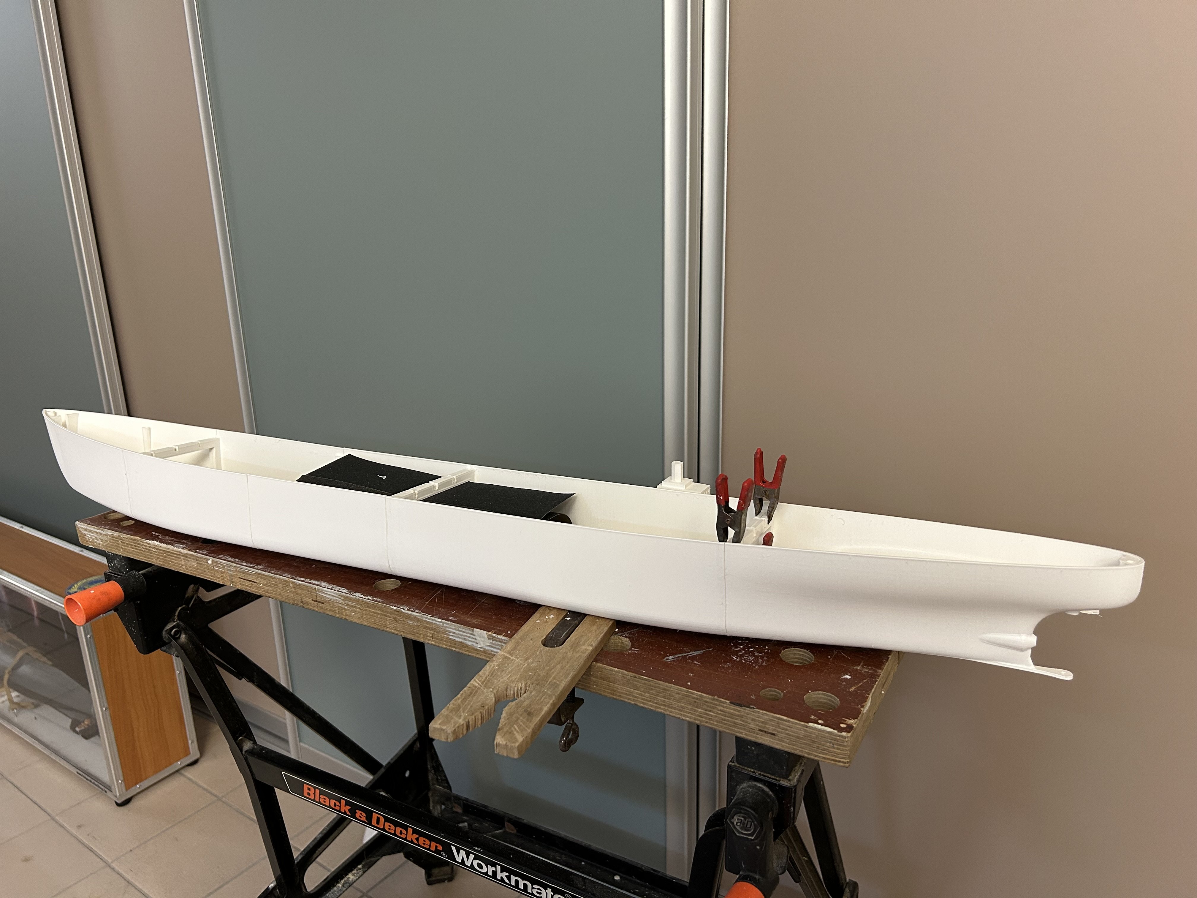

Lots of parts have been printed. It’s now possible to loosely assemble what the ship(s) will look like.
IMG_1567.thumb.jpeg.17967ba6e8dafb858cb6ca5e7cb293a8.jpegIMG_1568.thumb.jpeg.ae56f27ccb29dd3dcf0e3435117c1c7c.jpegIMG_1569.thumb.jpeg.5bd2280393fe81b5748646cbb009fda2.jpeg

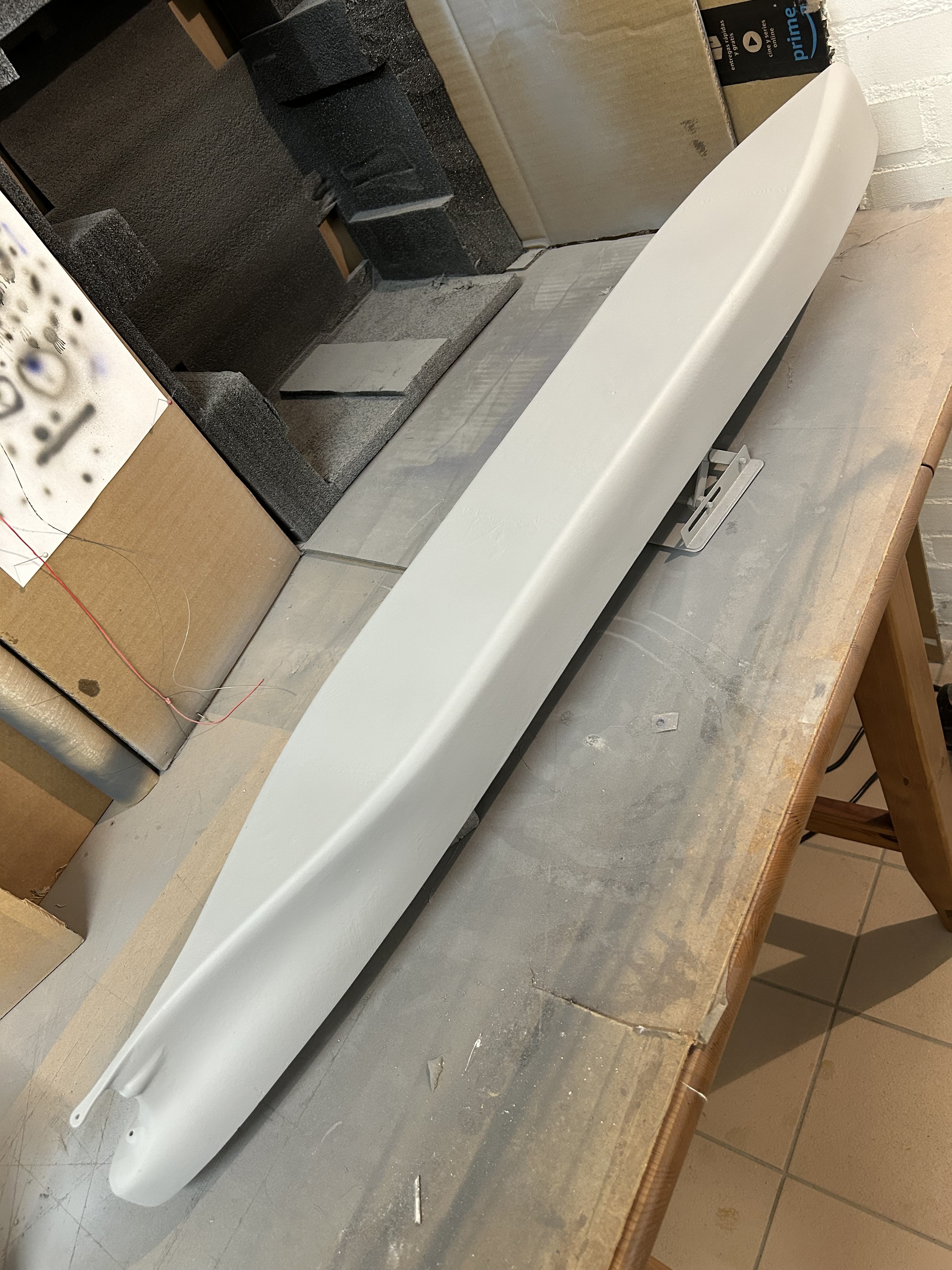

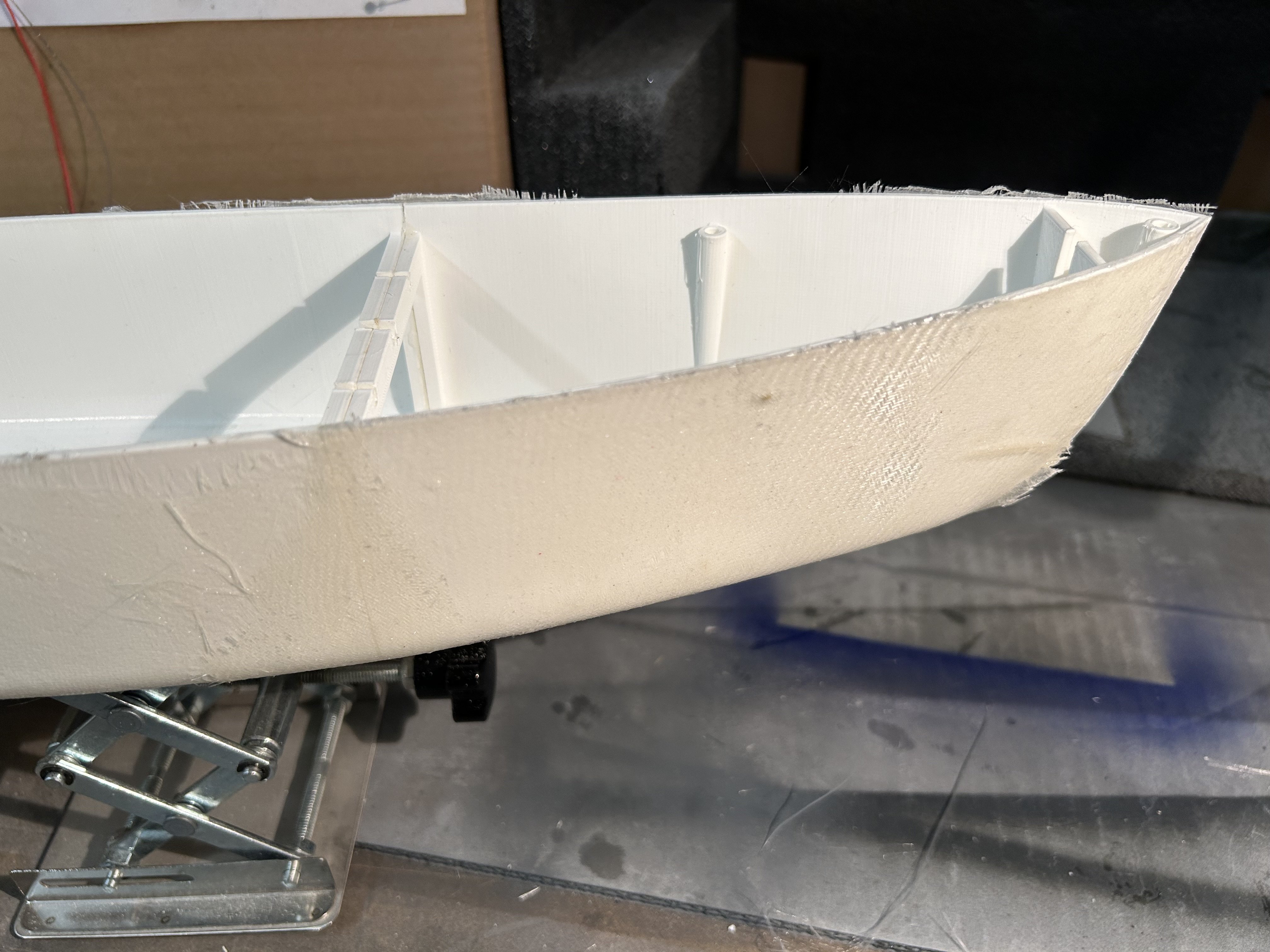

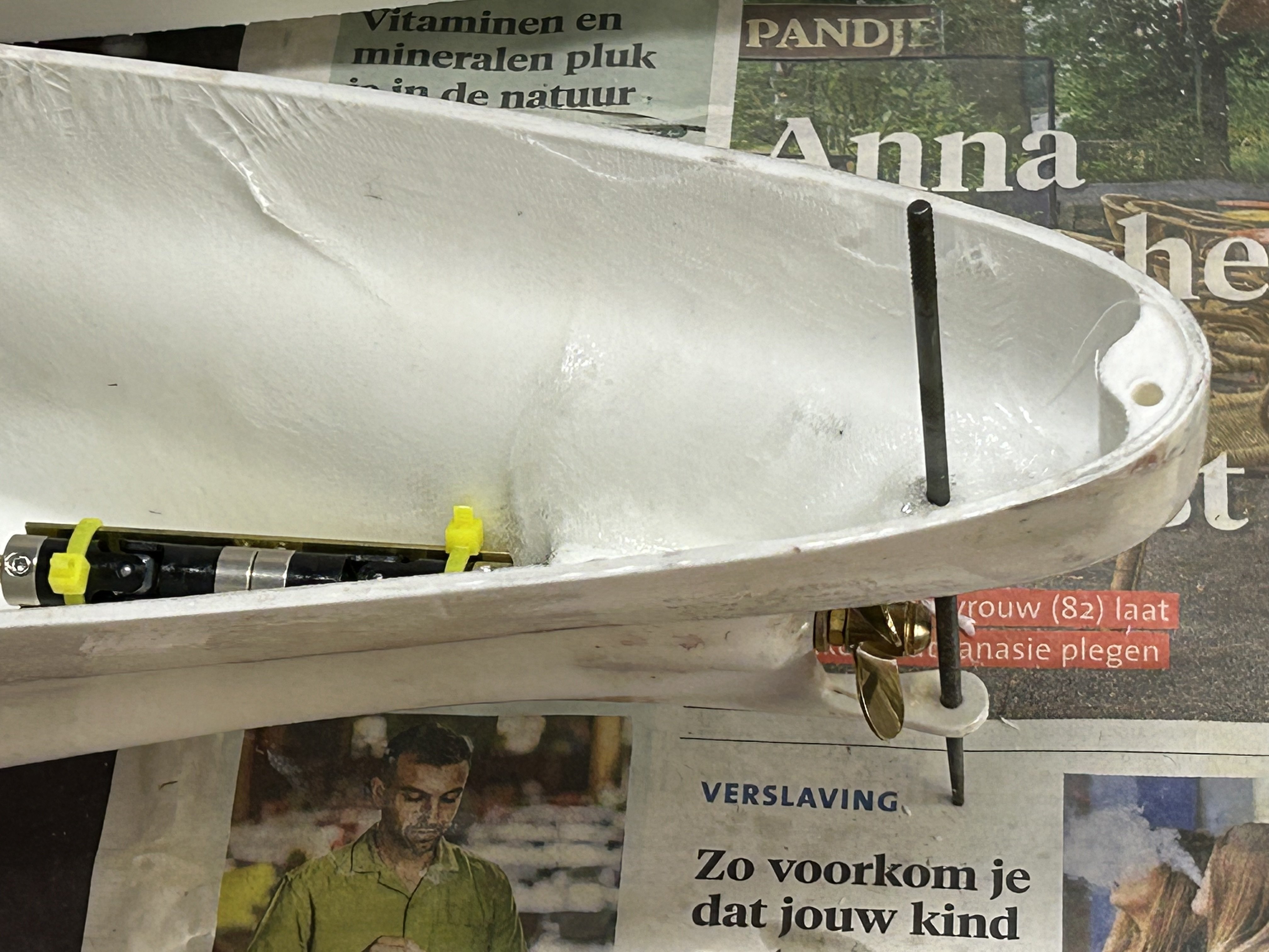

then started to treat the hull with a coat of epoxy; and after a few hours curing (still wet) covered with a layer of 80g/m2 of glastextile, then another coat of epoxy in wet.
Result is not very good; the glass textile has some folds and bubbles. But the hull is clearly stiffer and stronger. Next I’ll try to sand the first layer and probably apply another layer of glass textile and epoxy.
IMG_1576.thumb.jpeg.184408c9fd7531be6121153e770d9d1c.jpegIMG_1575.thumb.jpeg.6c7d847a0bf114700115a2819427a4cd.jpeg
It's a wonder what sandpaper and a bit of body filler can do. The overall impression of the hull is actually quite realistic. The pilots will require some skill landing on that half width deck.

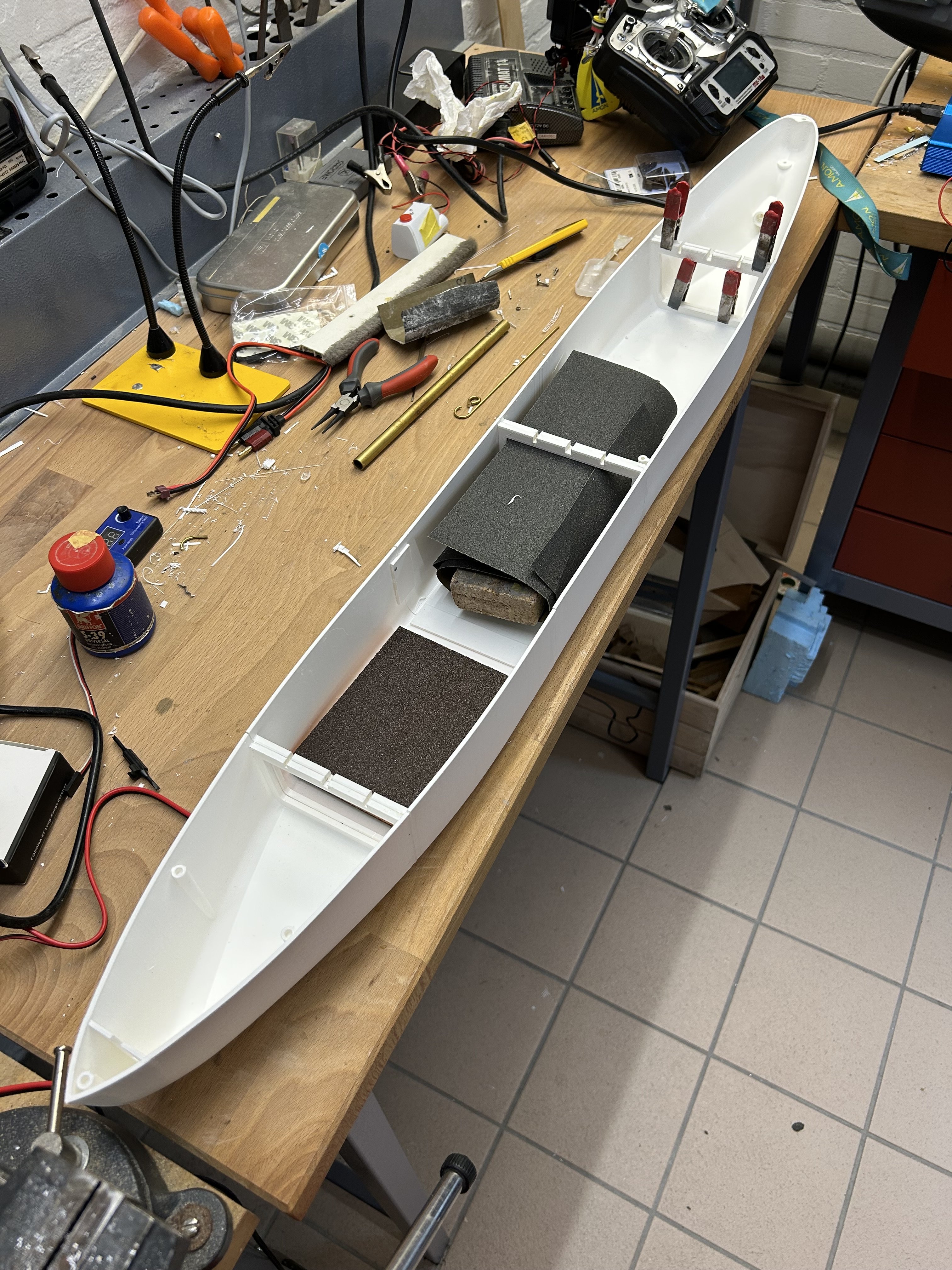

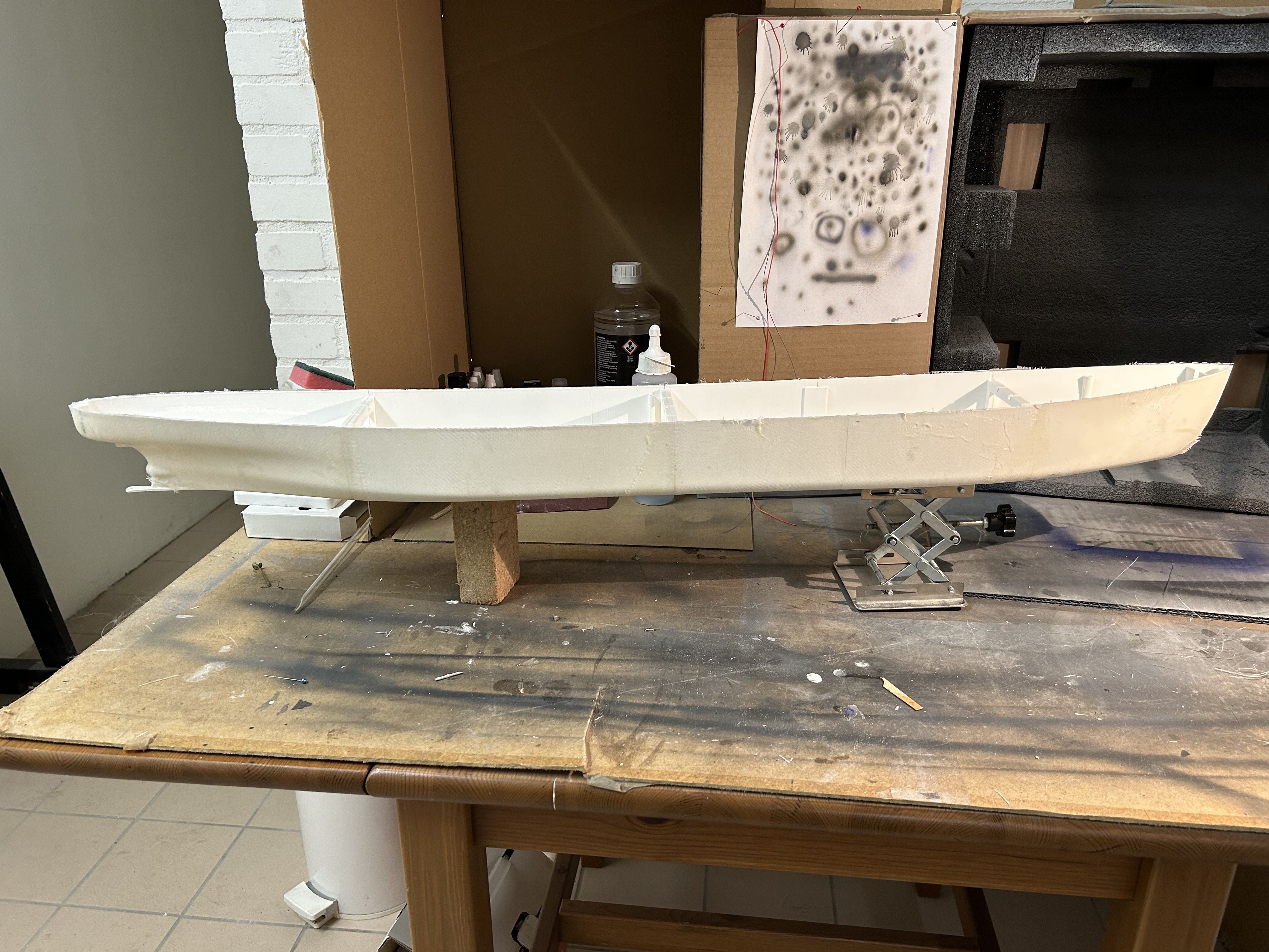

The hull now has epoxy/glass textile both on the outside and inside. After several rounds of sanding and epoxy putty I now used spray putty on the hull. Four layers so far - looks much better (splits between the hull sections are now invisible) but will be continuing sanding….IMG_1592.thumb.jpeg.3992ada4e09f960952ed71e276e51353.jpeg
the superstructures are too complex for spray putty (too many shadows) - so have been sanding them in preparation for 2 comp epoxy putty applied manually.

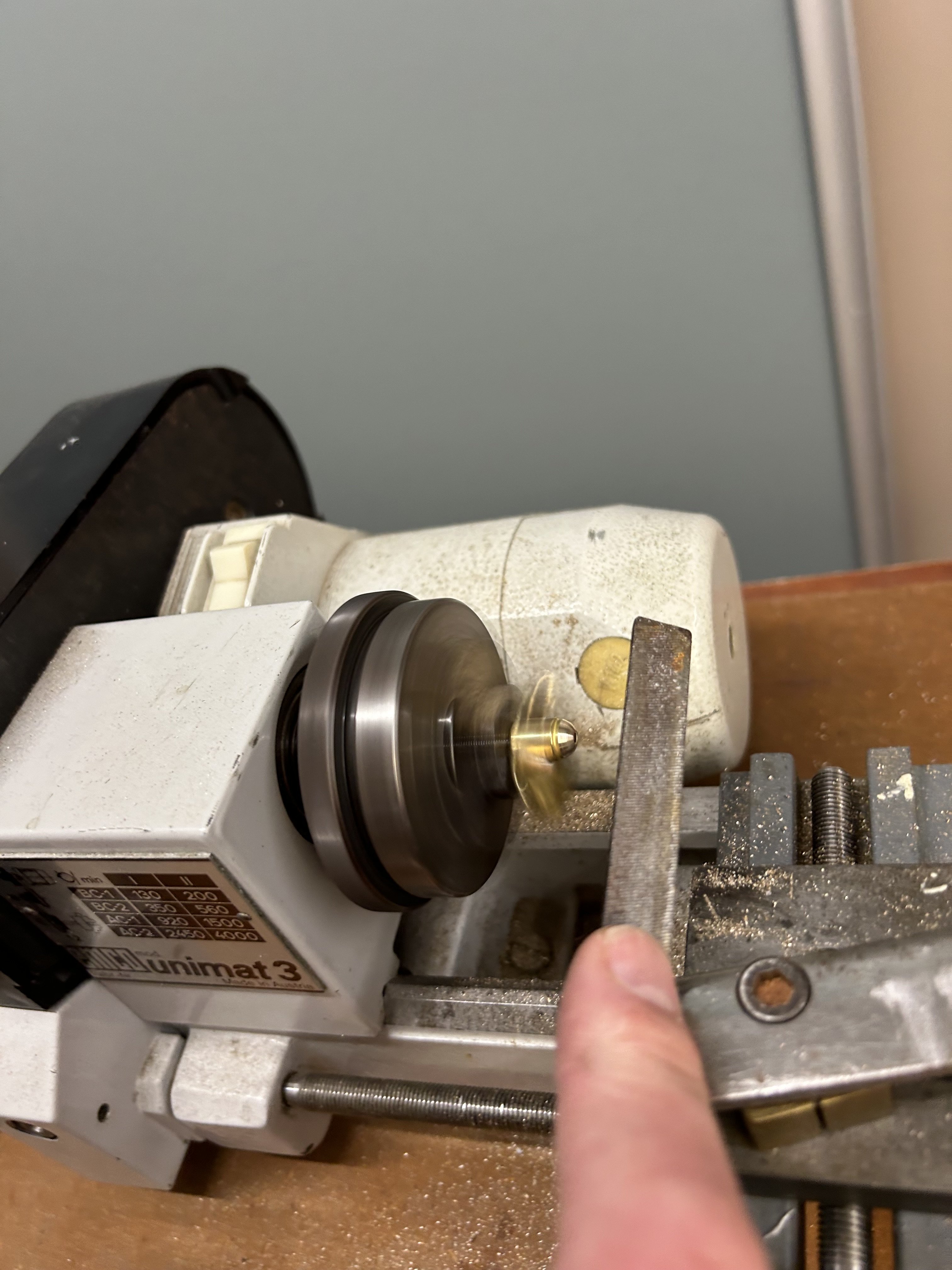

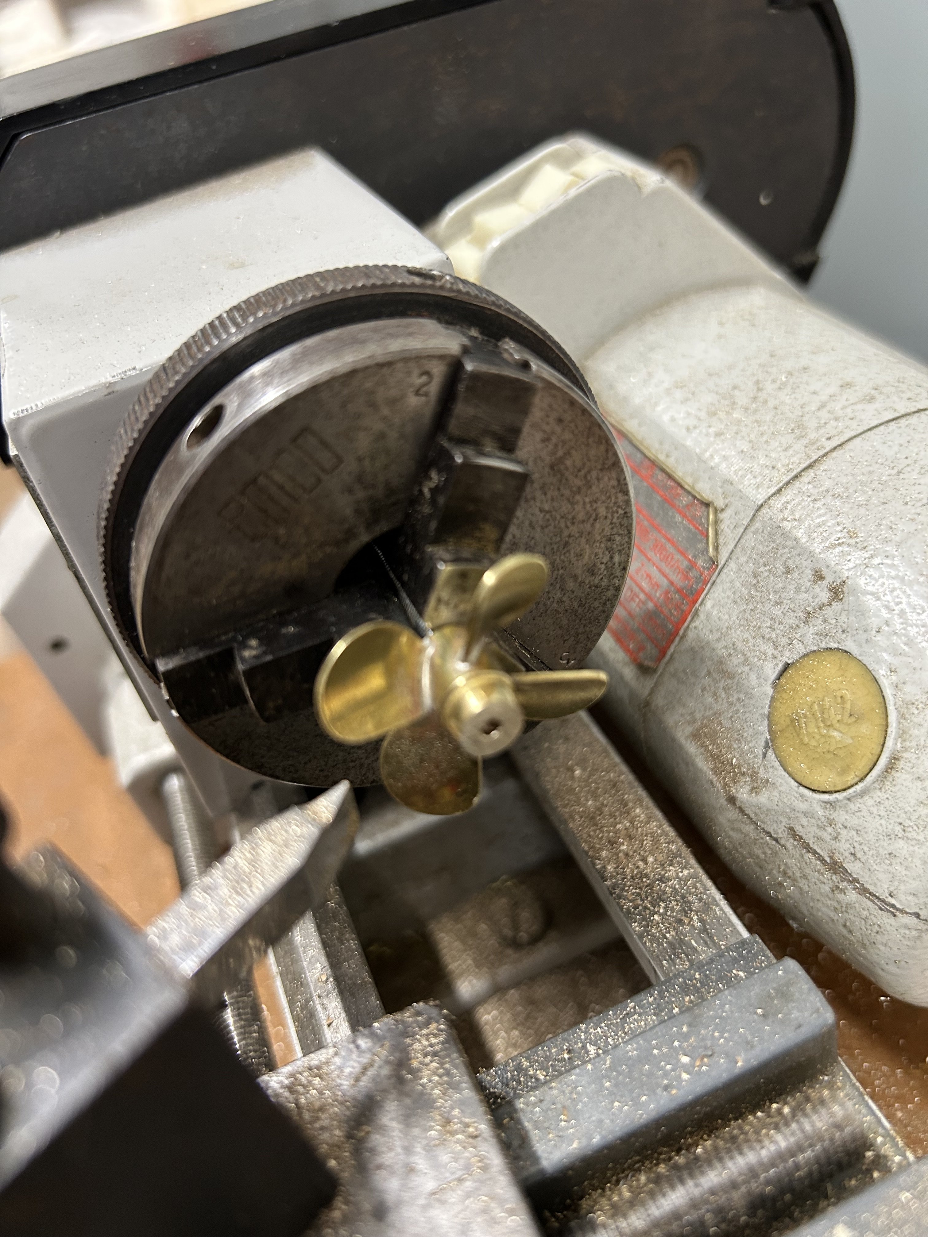

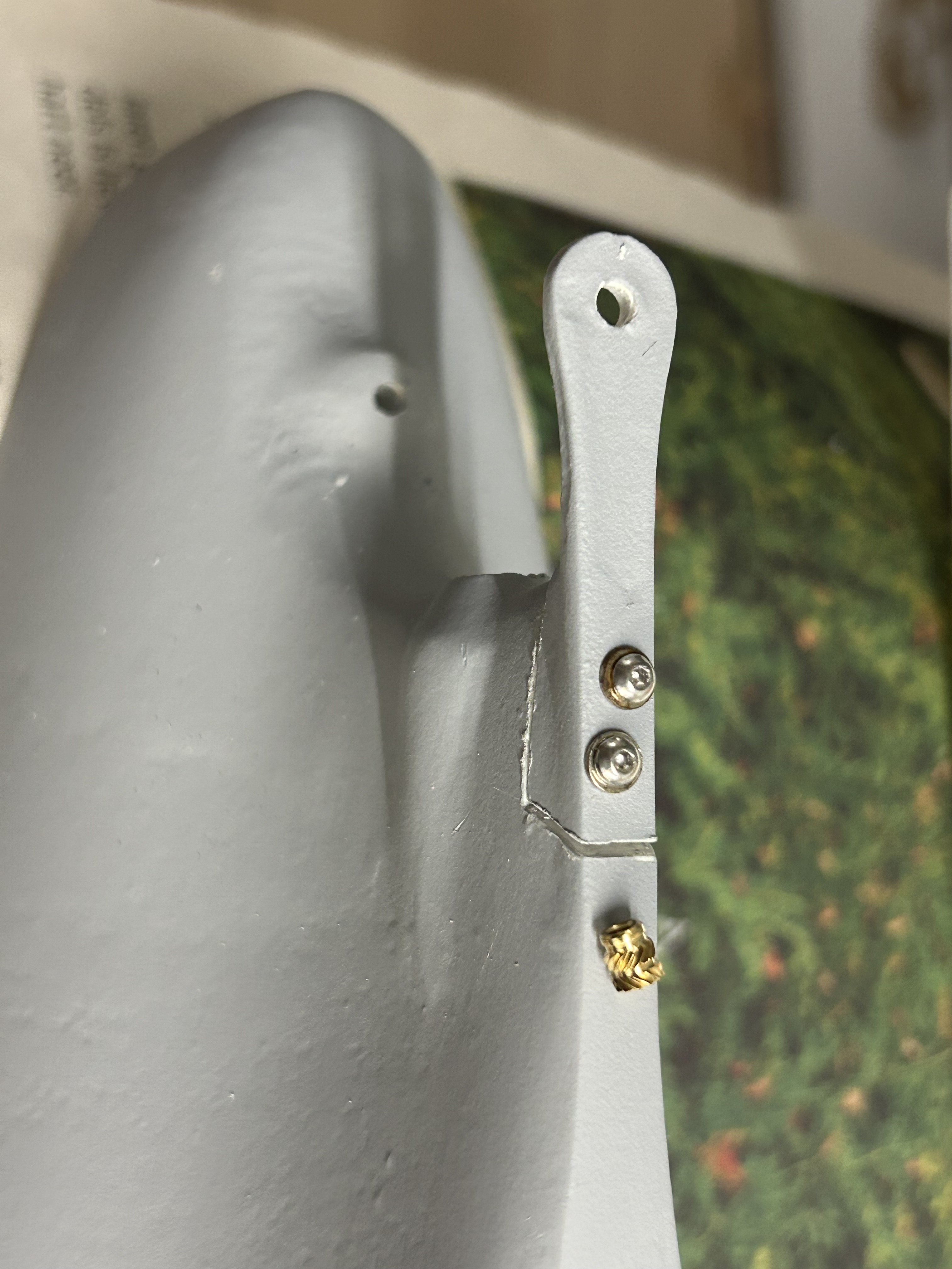

A 4-blade Raboesch brass prop came in, but the hub needs shortening or the rudder won’t fit. Ideal job for my small lathe, first filed off part of the hub, reformed it on the lathe and carefully filled the emerged hole with soft solder. The prop axle and motor mount are made but not glued in yet.IMG_1587.thumb.jpeg.de0209d8e1150d6d0597d335d3620633.jpegIMG_1588.thumb.jpeg.074ded3c6ec477438b308bfa47156612.jpegIMG_1590.thumb.jpeg.c05fb5e37765924967cdee73f85cbc4c.jpeg
to be able to mount a rudder (and maintain it and the drivetrain, I cut off the “foot” of the rudder from the hull (it must have a name…). I drilled 3.2mm holes in the PLA hull, and using a hot soldering iron pressed two 3,5mm M2 inserts into the bottom of the hull. This fixed the inserts beautifully (I did test this on a spare piece of PLA) and allowed me to screw the rudder “foot” back on with 2 M2 bolts. Seems very stable and firm.IMG_1593.thumb.jpeg.3e5bd6b9d2ba9d74ea3d88e11ab231cf.jpeg
next back to sanding…

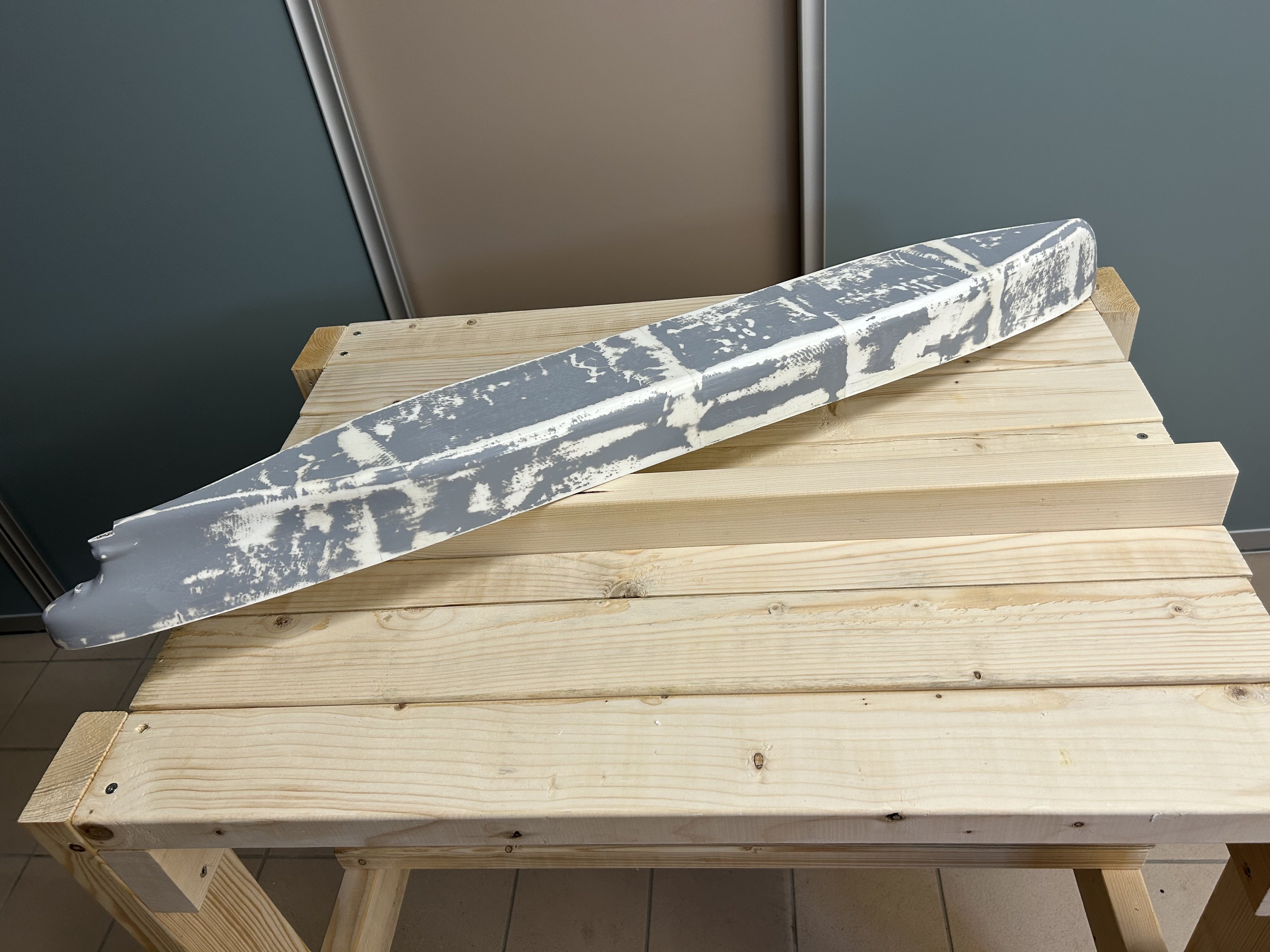

A little bit of progress - the hull has been primed after the spray putty, revealing some further need for sprayfiller. The deck sections have started to go through that process of sanding and filling and… too.

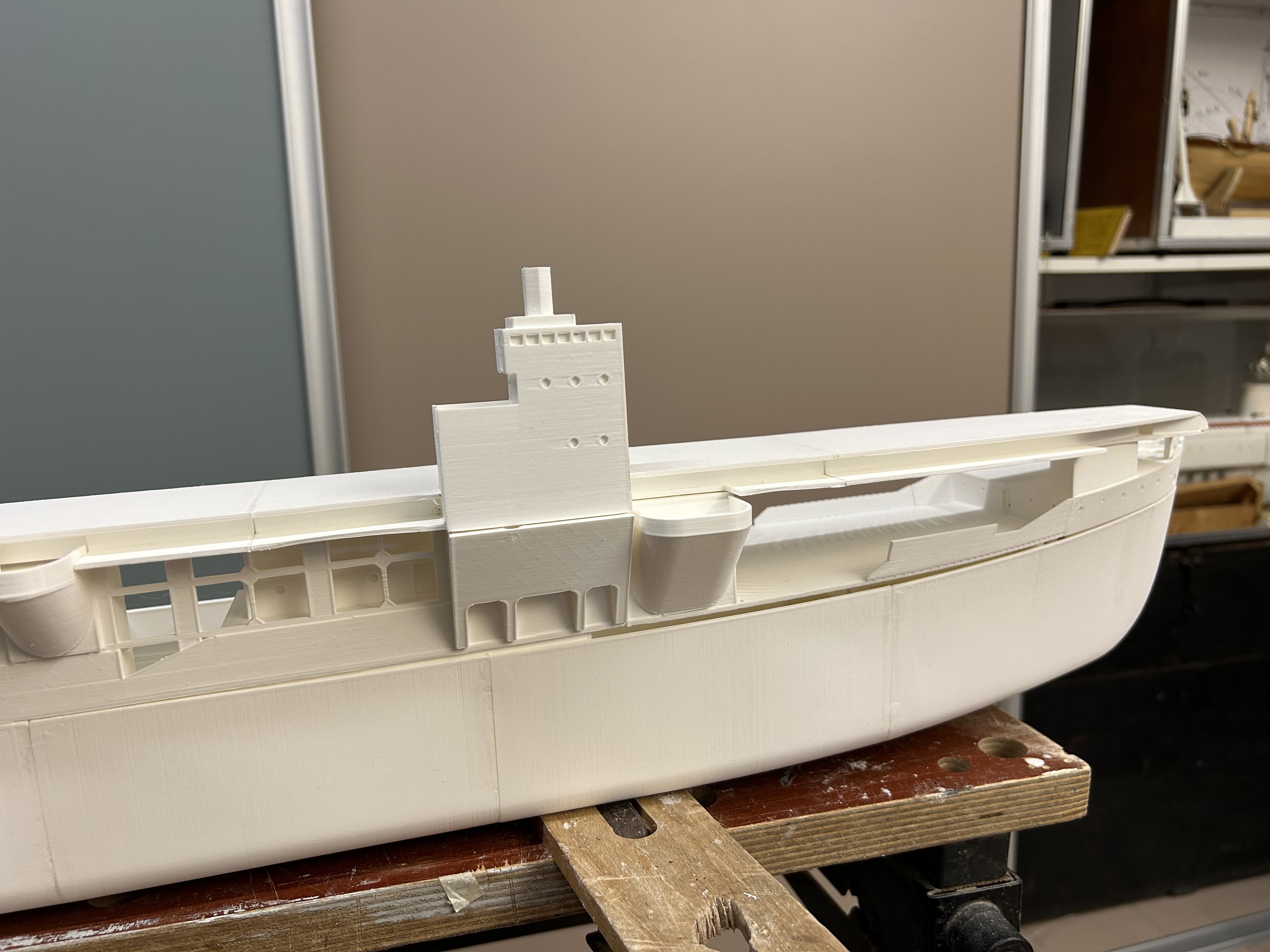

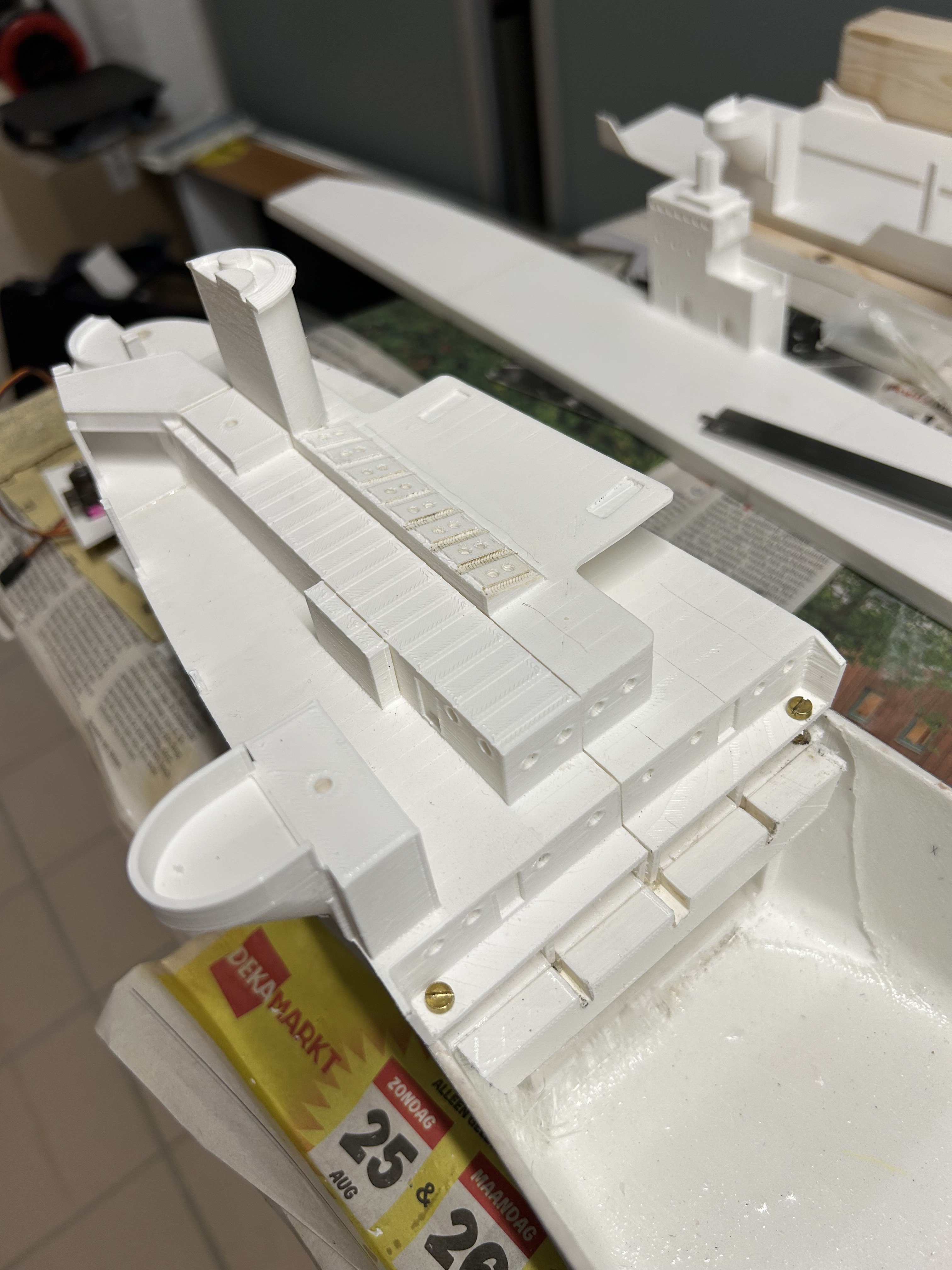

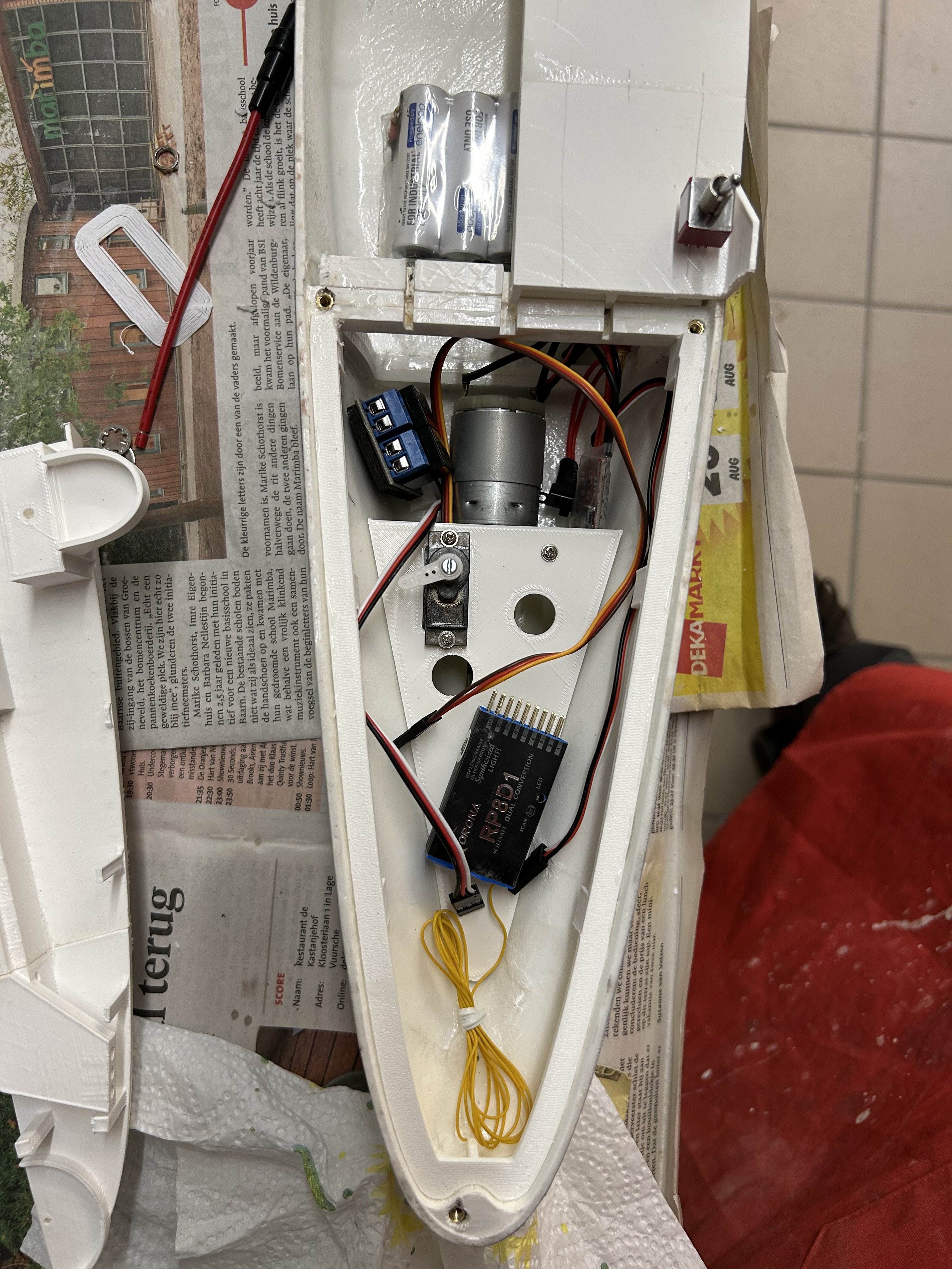

i prepared the back part of the deck and aft deckhouse to be removable. Found some m3 insert nuts and using a soldering iron pressed these into  drilled holes. I also printed and glued in place a 7mm wide ledge that will get a waterproof seal made of a plate if cell-rubber. That works for my submarines so should keep water out of the tanker too.
underneath the aft deckhouse I will need to position all technology that needs to be accessible. Only the ballast will come further forward and after trimming the forward parts of the deck can be glued in the hull. The technology is pretty simple, a servo for the rudder, the motor - shaft assembly, a relais unit that allows switching of the deck lights and a receiver. The motor does not draw a lot of power, so I plan to provide that power with an old set of eneloop NiMH batteries. That will give me 2000mAh at 12V.
The aft deckhouse fits well to hull, so I’m happy so far.

Can you share more details on the spray putty please?  I suspect this is something I need in my life!
Brad/NavyShooter
Spray putty is a 1-component filler in a 400ml aerosol can. It’s very good for filling smaller scratches and unevenness, quick drying and easy to sand wet and dry. For me, as PLA is so hard to sand, it does a good job of filling the layered patterns the 3D printer leaves behind.
I cannot imagine it’s something only known here, I think it comes from car repair but lots of people use it for model boats. Maybe the is a different English word for it?
example:https://www.colormatic.com/en/products/aerosols-and-putties/paint-preparation/filling/1k-spray-putty
