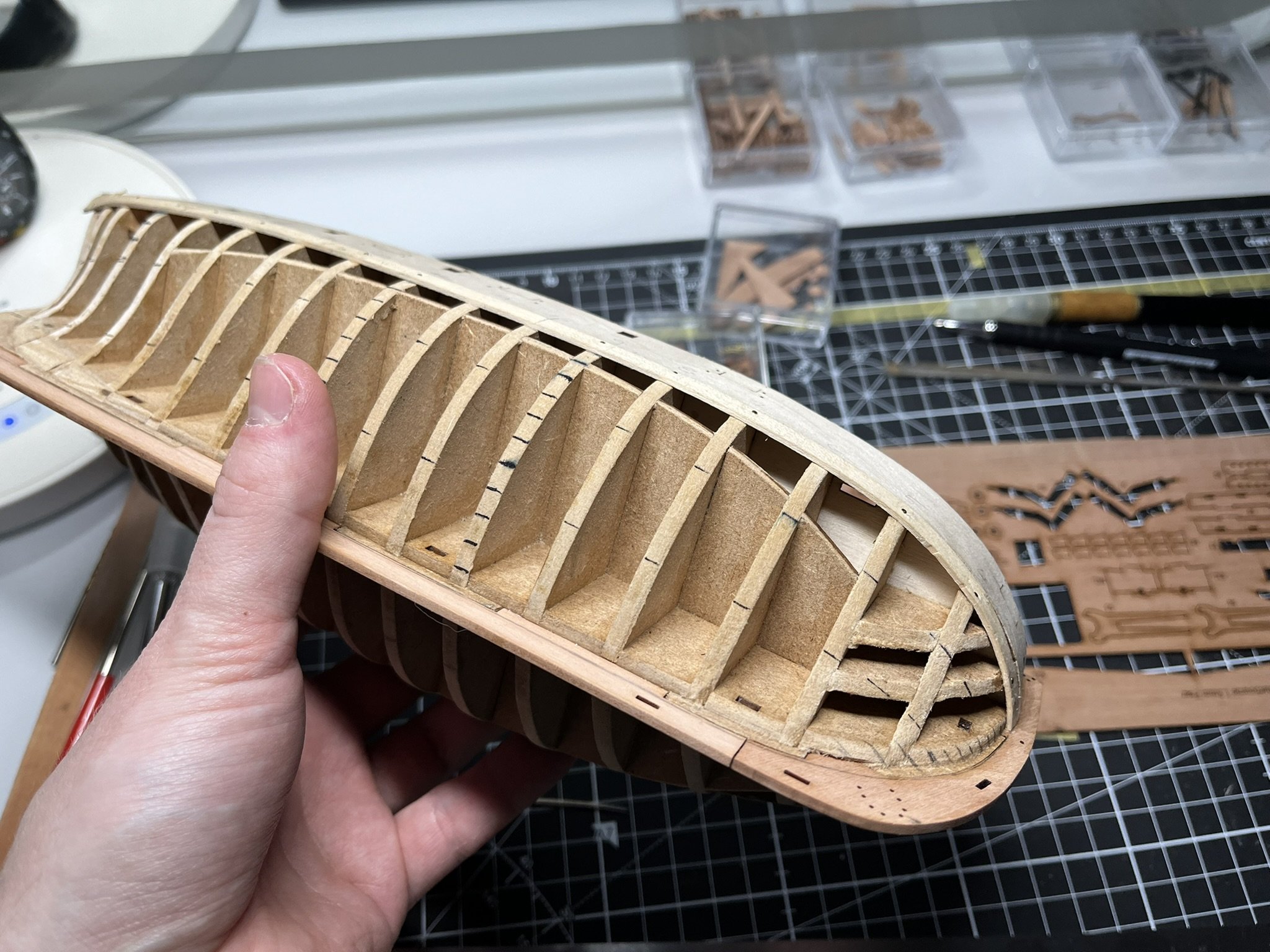

Opening the box, I was really impressed by the packaging and the overall quality. I inspected everything and found no issues. I went through the instructions, tried to understand the overall process, and made a shopping list for tools—since all I had was a knife and tweezers! I’ve now stocked up on the basics, with a few things still on the way (pin vice, table clamp, calipers, etc.).

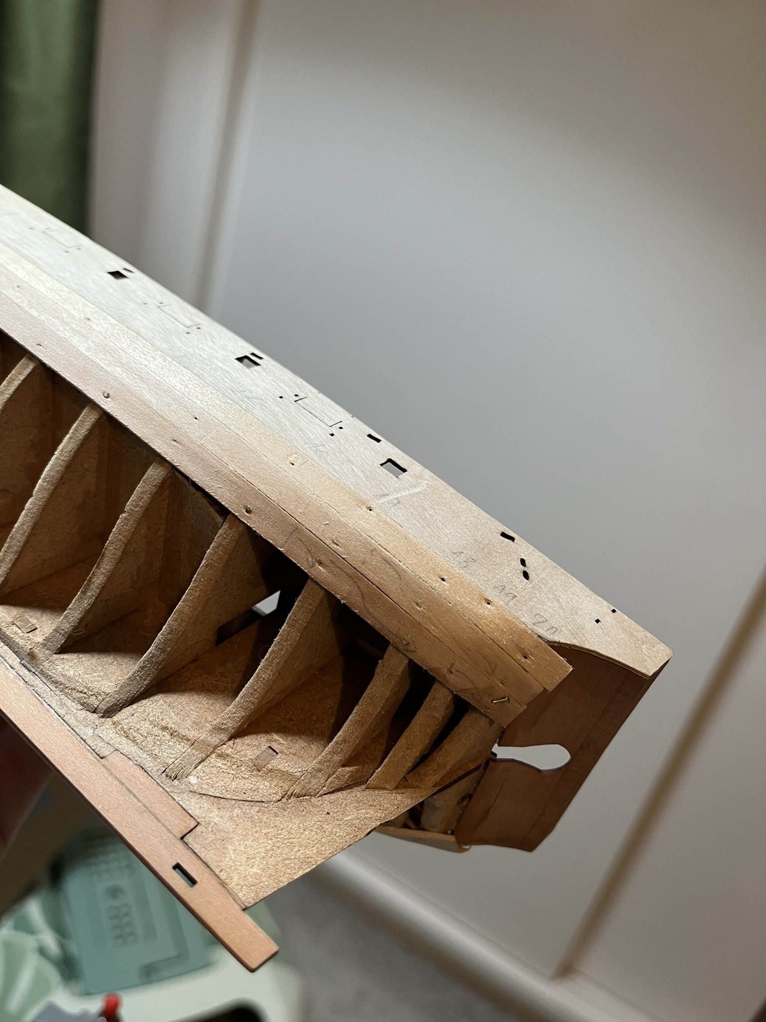

I cut and shaped the hull frame and pre-sanded the visible stern pieces before gluing them in place. Everything went smoothly. The deck also fit well, and I was able to do the major hull-frame sanding. I was a bit surprised to find some of the MDF parts slightly off, even though I followed the laser guidelines very closely. I noticed the same slight mismatch in the manual photos, so I just sanded things down to fit.
Next came the bulwarks and my first attempt at bending timber. I tested the bending iron on a scrap piece, and it worked well. Both bulwarks went on without trouble—though I was careful not to glue the section that gets snapped off later. During test-fitting of the next stages, I realised I had bent the bulwark curve a little too tightly at the prow because I mistakenly thought the outer bulwark slotted into the same prow slot. So my Sherbourne will end up with a slightly different bow shape. I added a small pearwood filler piece to fix the gap in the inner bulwark, and I’ll fill the outer layer gap later.
Another concern was the rudder: I thinned the keel deliberately so I wouldn’t have to sand the first planking layer down to almost nothing. And then—of course—my cats knocked the hull off the table, breaking off a bulwark and part of the stern. I’ll fix all that once I get to adding the outer stern structure!
Right now, I’m researching planking while sanding and preparing other parts. My main sticking point at the moment is how to mark the plank lines on the bulwark. I’ve seen Chuck’s videos, but I’m still unsure how to approach it. Do I simply measure the bulwark length and divide it by the number of planks, or is the spacing supposed to be nonlinear?

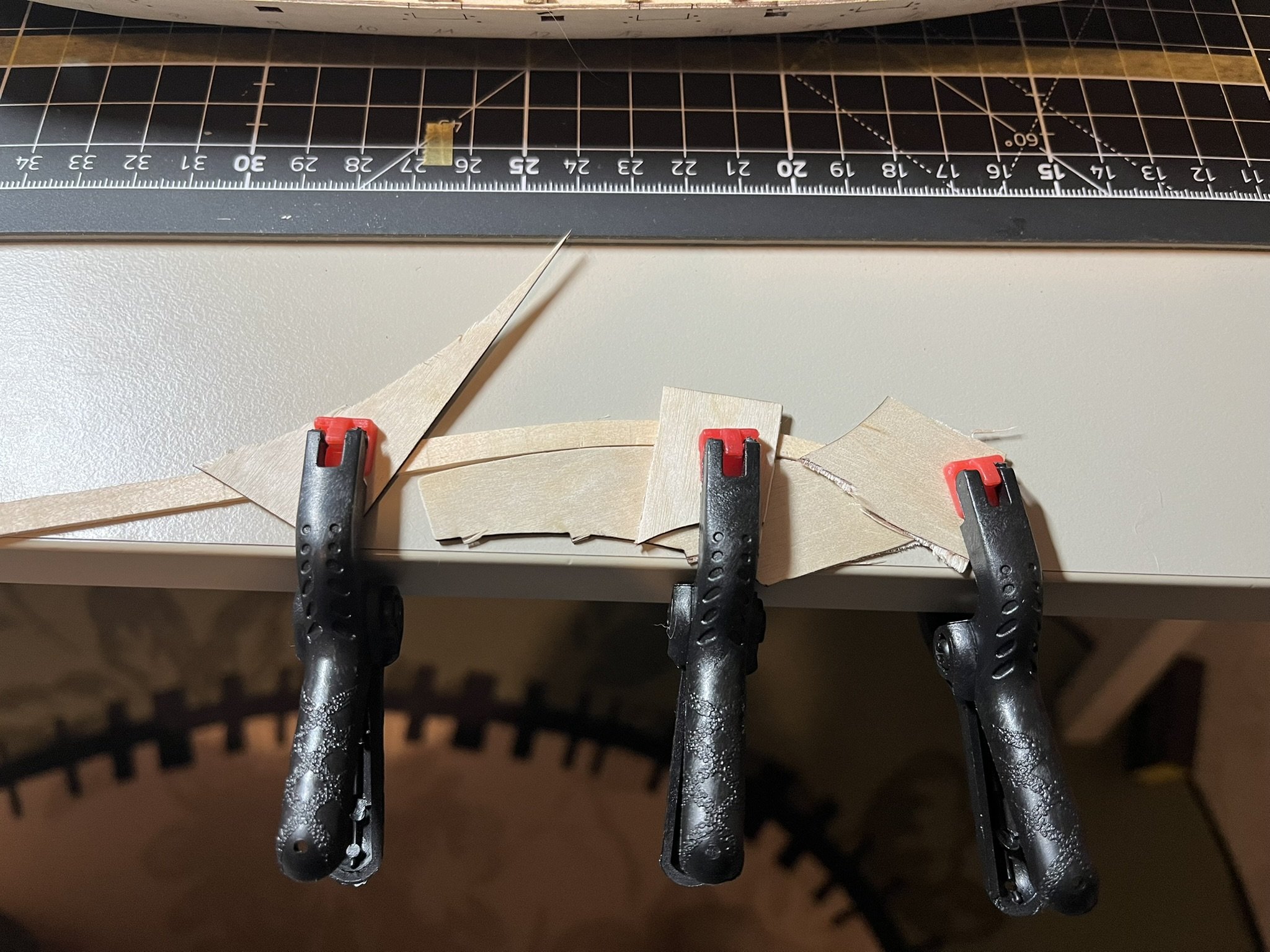

About the planking question, There are diffirent approaches to it. Some like to create equally divided sections where you use battens on the hull. Myself I measured the length of the bulkheads using a thin piece of paper which in my case was around 6cm long.  I then placed this on each bulkhead and wrote down the length of it.  After I looked for the bulkheads in the middle section where the length started to decline towards the fore and aft.  Cause this is where the tapering would start of the plank eventully meeting the end of it.  How far the tapering goes depends on the length of the final and first bulkead divided by the amount of planks you can fit.  And I try to follow the rule of not having a plank go below 2.5mm in width due to risk of it cracking once you put the pin through it. Now there are probably alot of better guides out there and threads or even advice from the veterans of this site as I myself has only planked two ships. So I consider myself still new to it but best of luck to your build!
A few thoughts wrt planking - from a non-expert:
On a double-planked hull like this, use the first planking as some practice for the second. It's not going to show, so it's easy to do it in a way that gets the job done. The Modelkit Stuff videos are great, though Jason kind of takes that approach likely because he doesn't need the practice and because he has videos to make; he said as much in a recent video on his current build. Treat every plank as a mini-project.
Just know that it's likely that the first go around - of both the first and second planking - could well look terrible. Mine certainly did on my Vanguard Sherbourne. I learned as I went, but it still looked terrible. My second model with strip planking (Vanguard Ranger) was a bit better. My third with strip planking (Vanguard Zulu) a bit better.
Even if the planking does not look great, on this model - really any model - you can paint the hull, which means that you can add a bunch of wood filler or bondo and sand and repeat. My Sherbourne hull ended up looking way better after all the filling and sanding and painting. On my current Zulu model, I am considering possibly leaving the top part unpainted. It's not even close to some of the plankings I've seen in other builds, not by a mile, but it's good enough for me to consider just adding some shellac or WOP to it.
On my current Zulu, I used the approach you see in the Vanguard instructions and James' build log. I laid each plank until it rubbed against the one that was there and tapered from that point, kind of doing most of it by feel and by eye. That's fine for a first planking, or for one where you are definitely going to paint the whole things, but since this model could have the upper part unpainted, I wanted to try something different.
So on my current Vanguard Zulu, I've been using Chuck's planking fan, which I think you can find in the Articles Database linked at the top "Lining Off Your Hull Planking, Tutorial and Fan". I put some tamiya tape at around 5 places across the hull, figuring out the maximum number of full-width planks that will fit at the widest point, marking the extent of the planking area on each piece of tape, and then used the planking fan to determine the equal spacing of widths. The planking fan essentially eliminates the need to divide some small number by 10 or 12 or how many planks you have and then hope that you can measure out those equal widths. Then I copied the marks from the tape onto the first layer of planks on the model. You don't ever want the width less than 1/2 a plank. On more complicated hulls, you can either end up having to drop a plank because the width would get too narrow (drop plank) or add in a plank because it flairs wider (stealer). I did not do measurements of the planks, but compared them to the marks I made on the hull and either cut or sanded, comparing the plank to the hull and repeating until it was the right width at the marked locations.
On my current Zulu, I kept a couple of planks in the middle full-width. I probably could have just had one (this model does not have a specific wale part, but I kind of used that as a concept). On my Zulu, the hull being kind of small and simple, I did not mark off bands of planking, where you'd work on each band separately. I guess in a sense I did in that I had to plank about the wale (middle) and below the wale to the garbourd, so kind of two bands of planking. After doing a bit, I retaped and brought out the planking fan again, and adding new marks.

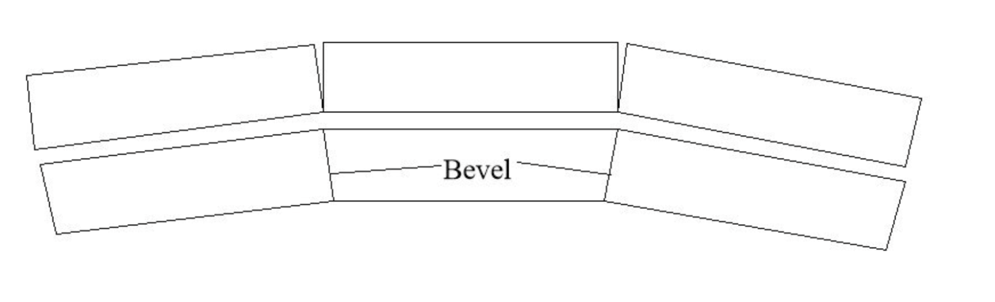

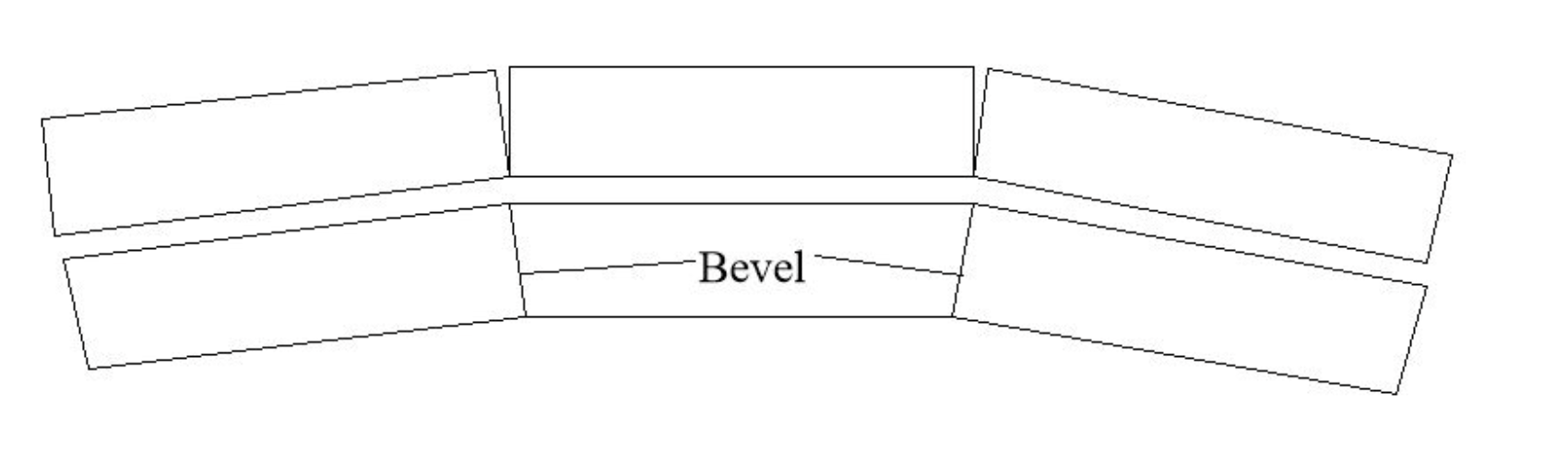

You also want to bevel the planks, though that's not something I do enough of. It eliminates the small gaps that can appear between planks. I've pasted a photo from another build log (https://modelshipworld.com/topic/25391-stealers/.

I’ll definitely be beveling the planks, and I already practiced a bit of that on the stern area. And yes, the reminder that the first layer is “practice” is very comforting. I still want to do it as well as I can, but I’m keeping in mind that the second layer and the final keel piece need proper slots, so no over-sanding.

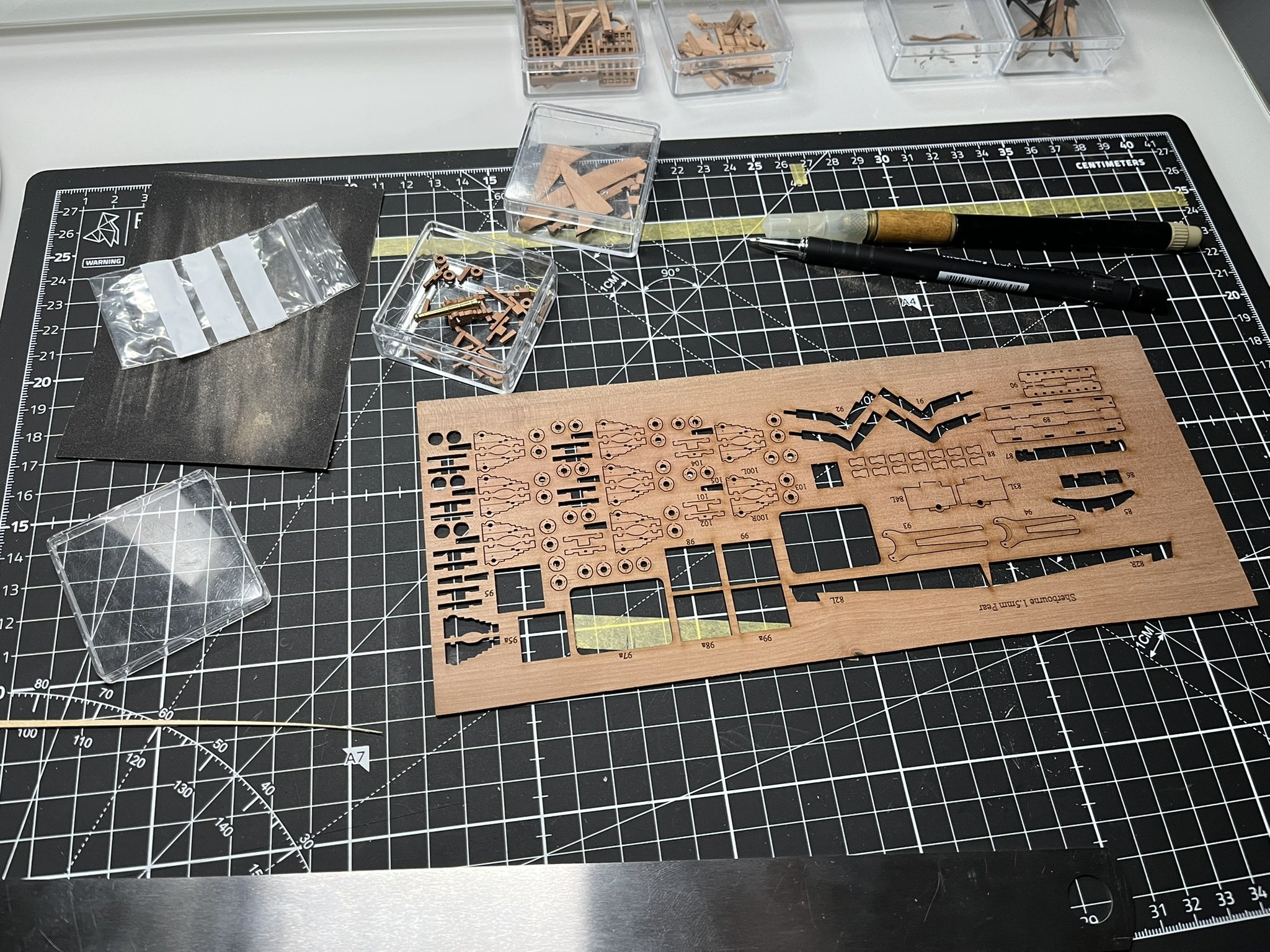

On a side note, I also talked with a colleague from work who has a jewellery workshop about brass blackening. He’s giving me some of his sulphur-based blackening powder and pickling solution, along with tips on what to do (and avoid). That should help a lot with the PE parts and the brass cannons I have coming. I also ordered 0.4 and 0.5 mm brass wire for the hooks and future rigging work.

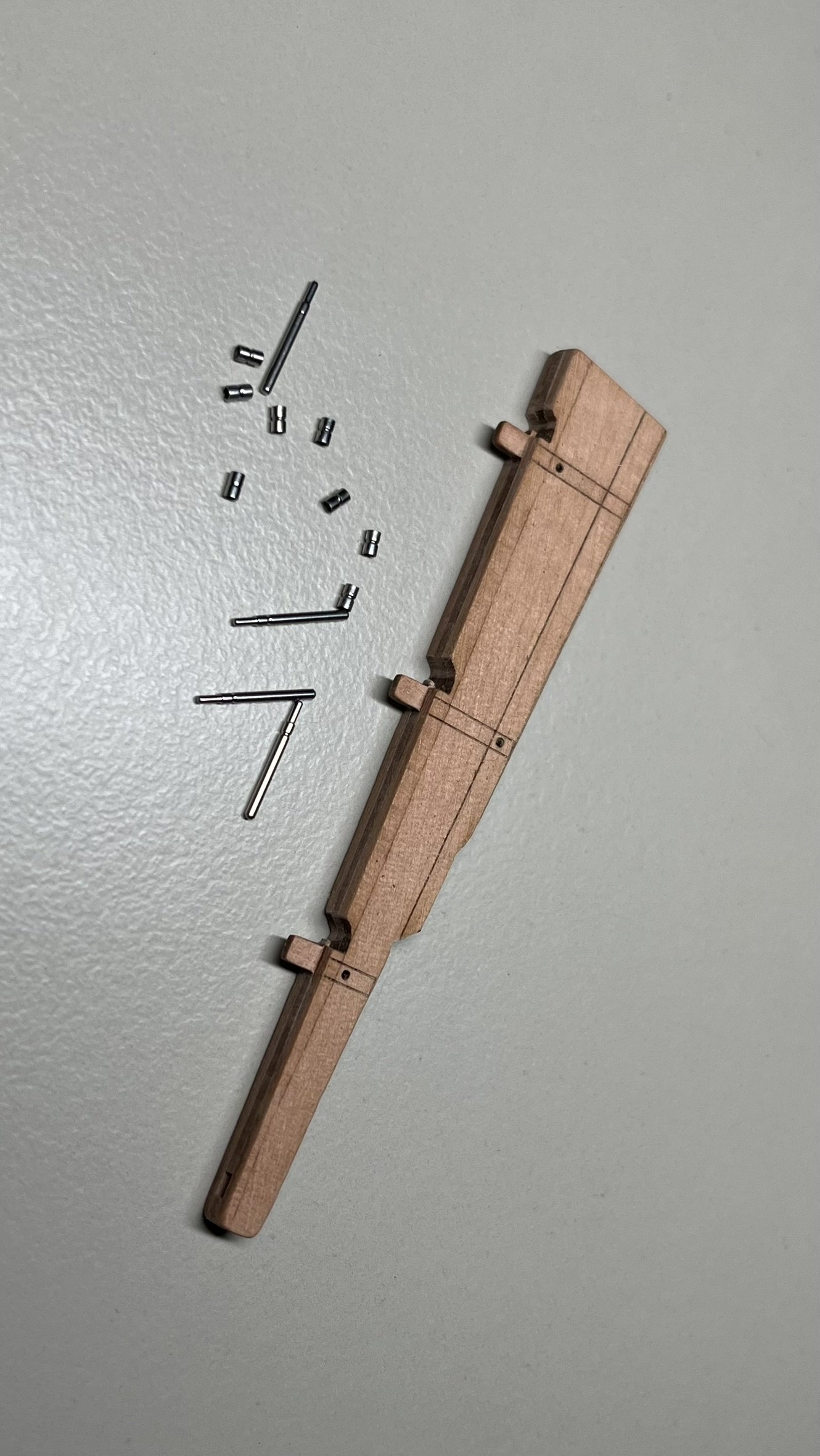

I’ve also started a small rudder improvement project. I have pins and tubes from work that are perfect for making pintles and gudgeons, but I’m still researching what the correct rudder cross-section should be — whether it’s more of a half-circle or a softer curve. If anyone has a good reference for that on a cutter like Sherbourne, I’d really appreciate it.
For now, I’ve continued sanding and preparing other components while waiting for the remaining tools. Photos of the progress so far are attached below.

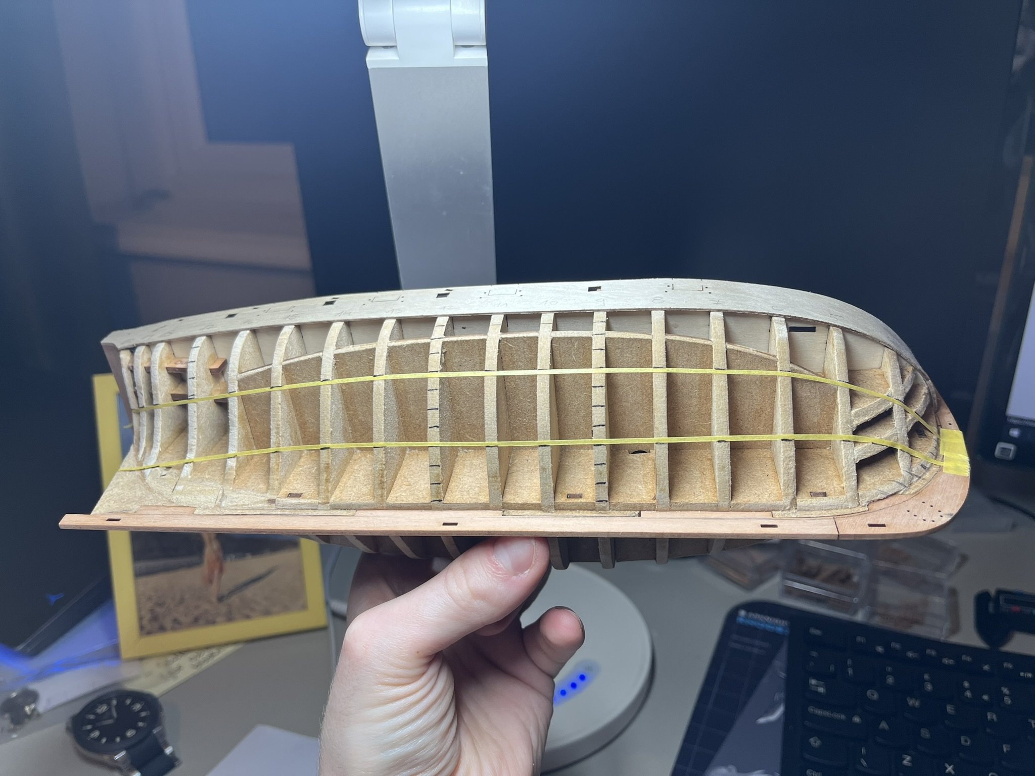

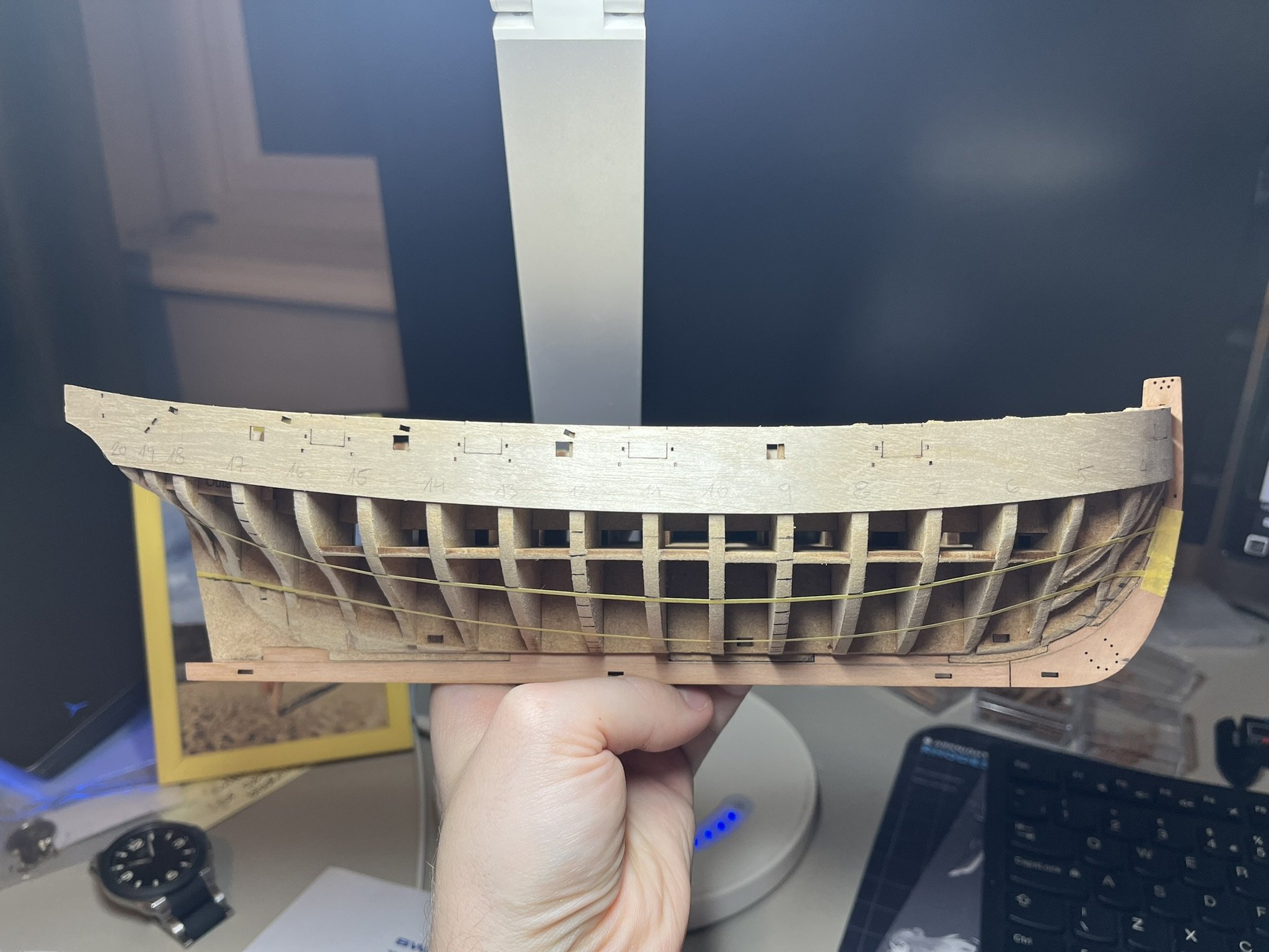

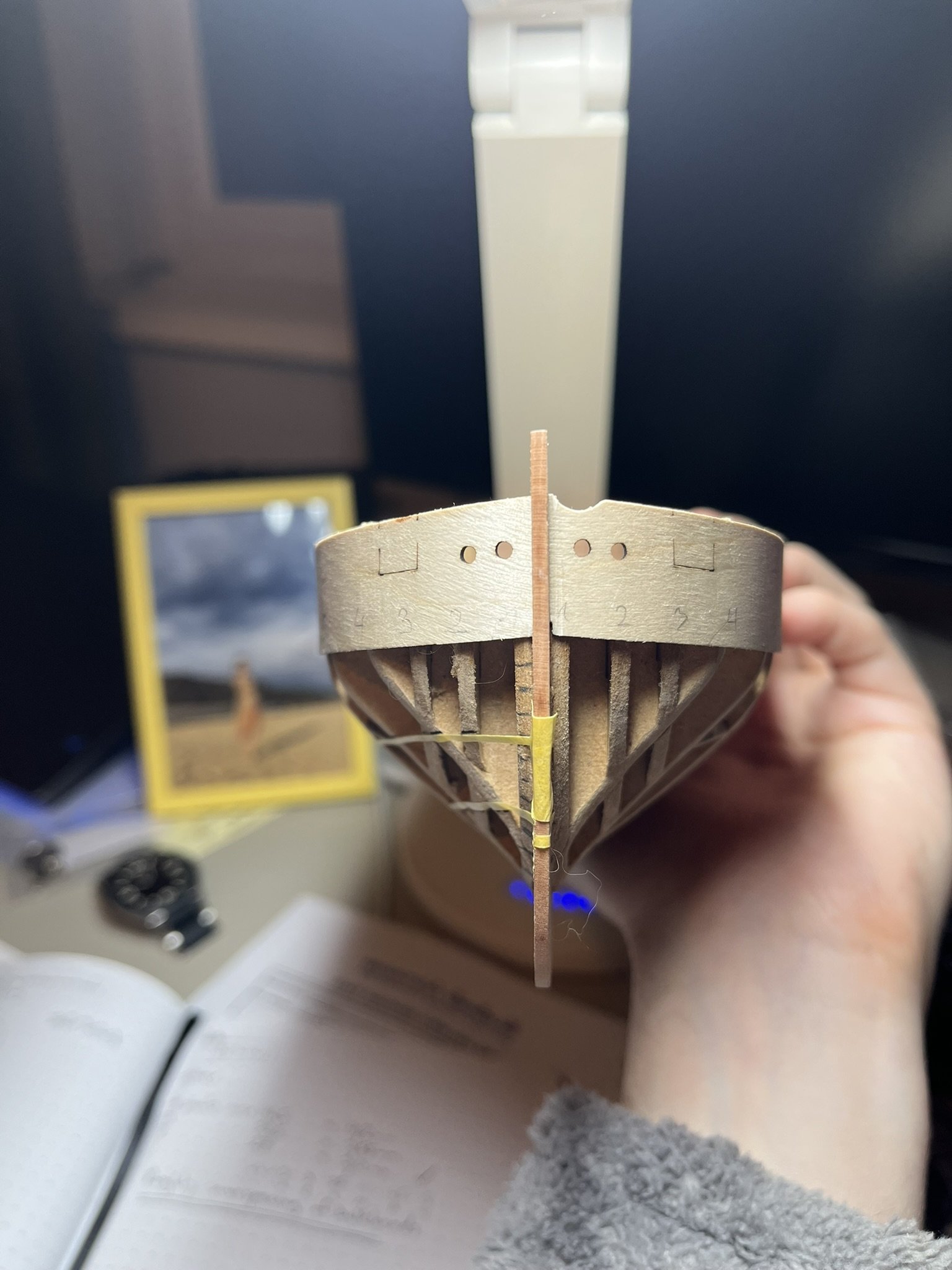

I also finally started measuring all the bulkheads (which I had mistakenly been calling the bulwark before). I wrote everything down in my notebook — I’ll attach a picture of my notes along with the small glossary I’m building as I learn the terms.
At first I was worried: the centre measurement was around 61 mm, and with 12 planks at 5 mm each, that didn’t look possible. Then I stacked 12 planks together and got 63 mm, so the real average is about 5.25 mm and everything lines up fine.
I also noticed the starboard bulkheads are a bit thicker — about 0.5 mm, with bulkhead 17 off by a full millimetre. I’ll sand the starboard side so both sides match more closely before I start planking.
My plan is to plank from the bottom edge of the bulwark downward, then taper the final plank at the keel. On that subject, I realised I need to adjust the area where the bulkheads meet the keel. I had sanded them earlier to match the MDF outer keel parts, but that leaves too much of a gap for the second planking layer. I’m going to add a triangular insert to correct the shape, and bevel keel parts 58 so the second layer sits properly. At the bow, my calculations suggest tapering the first 6–8 planks to about 3 mm should give a fair run, then gradually bringing them back to full width. I’ll test this using masking tape strips before committing.
Rudder update: I found a reference photo (Rudder pintle and gudgeon) that supports the cross-section shape I had in mind, so I sketched out my plan. I’ll include that below.

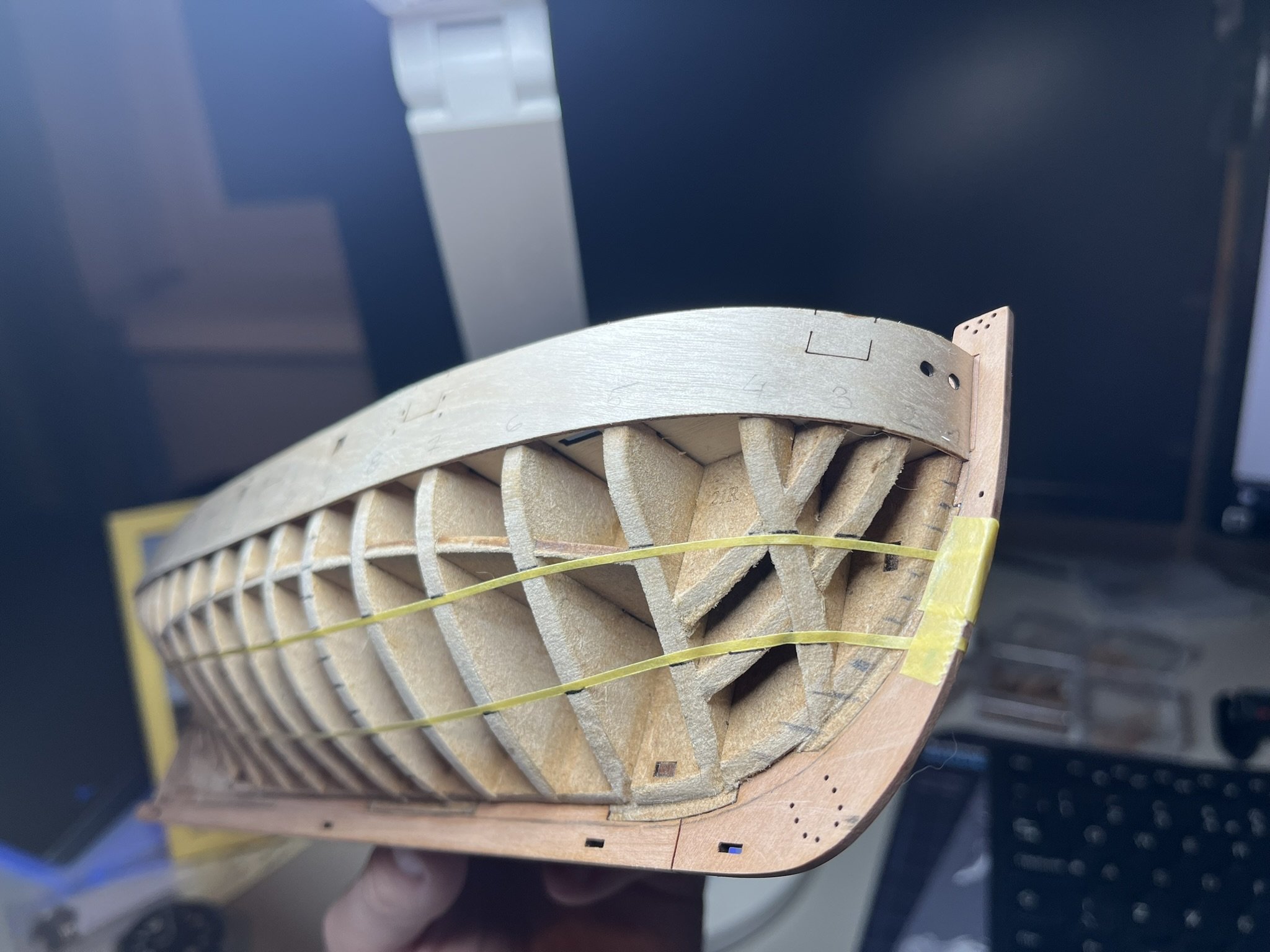

A bit of progress today.
I sanded the starboard side and it now matches the port side much more closely. After that I added some markings on the bulkheads and tried laying a strip of masking tape along the hull to get a feel for how the planks will run. I cross-checked the distances and the flow looks reasonable. Toward the bow the tapering appears to be fairly linear, at least based on my initial measurements.
IMG_9453.thumb.JPEG.d5d0c7b065fd0641928cc2471632c7d9.JPEGIMG_9454.thumb.JPEG.c4c3aa9fa8071846bf48baf1ef22ceeb.JPEGIMG_9455.thumb.JPEG.52ba5797bd354435ff64027c8605caef.JPEGIMG_9456.thumb.JPEG.65d1ad85290057d0c90bf5ab14d4968a.JPEG

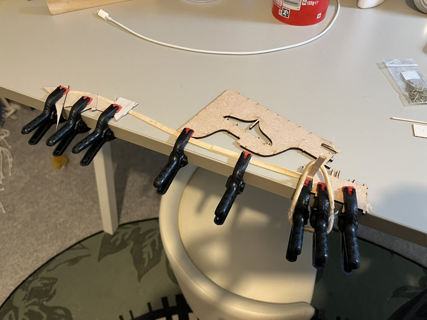

I went ahead and tapered the first plank and started testing Chuck’s bending method. Once it takes the first curve, I’ll give it another bend with my bending iron to match the hull shape more precisely, but I’ll see how it behaves. This part is a bit intimidating, so I’m taking it in small steps.
It’s late now, so I’m letting the plank dry naturally overnight. Tomorrow I’ll try the final adjustments and, if all goes well, get plank number one glued into position. If the technique works as expected, I’ll repeat the marking on the other side.
As for the keel-insert issue, I’m postponing that for a little later. I may do the correction once a few planks are on and the hull has more strength.

As for planking — well… I managed to bend the same plank the wrong way twice before finally getting the shape right. All of this bending drama is still about one plank out of the full 24 for the first layer! At one point I even splintered it in two places when it caught on my winter pyjamas and snapped from over-bending. But everything was repairable, and plank number one is now glued in place. I also beveled the top edge and accepted that the bulwark at the bow will need sanding to correct the shape difference I mentioned earlier.
With a bit more experience under my belt, I’ve now prepped the matching plank for the port side. Later I’d like to start preparing planks in pairs (one port, one starboard) so both sides stay as close to identical as possible — hopefully this will speed up my currently very slow progress.

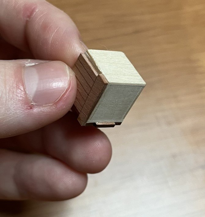

Hello everyone,
It’s been a little while since the last update. Life has been busy again, and unfortunately Dandan took a turn for the worse and had to go to the hospital.
He’s improving now, but still not fully out of the woods, so progress at the bench has been slower than planned.

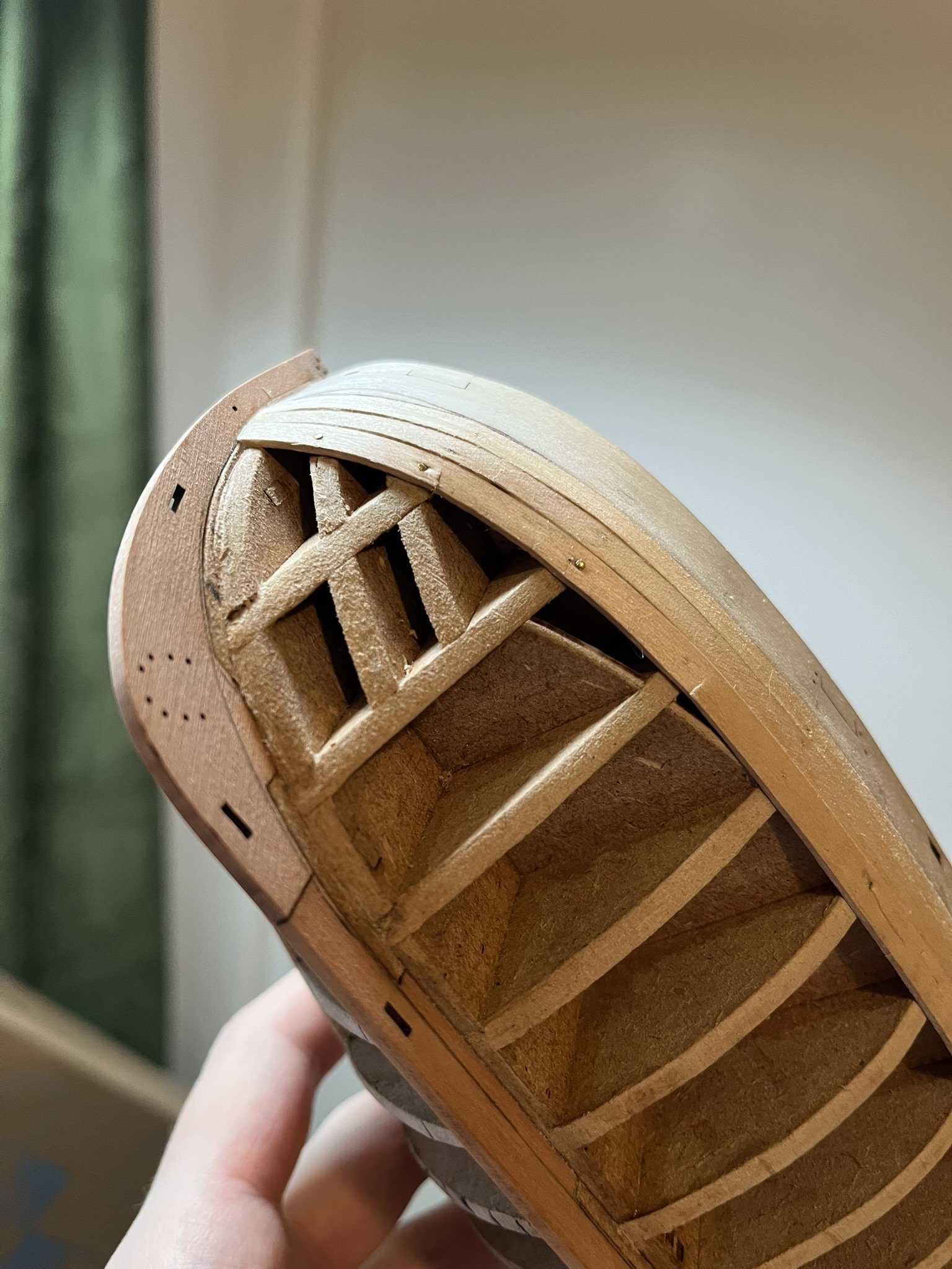

As for the Sherbourne, I’ve managed to complete two planking bands, three planks each. With that extra stiffness in the hull, I’ve started correcting the keel area shape. I added a few small blocks that I’ll sand to final shape once everything is fully dry.

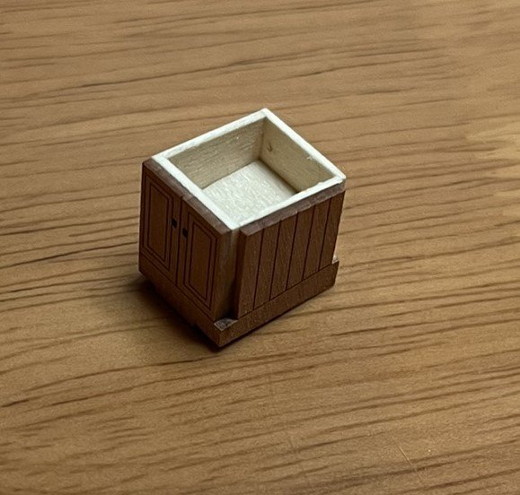

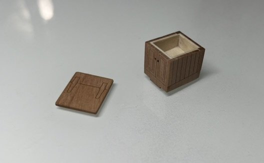

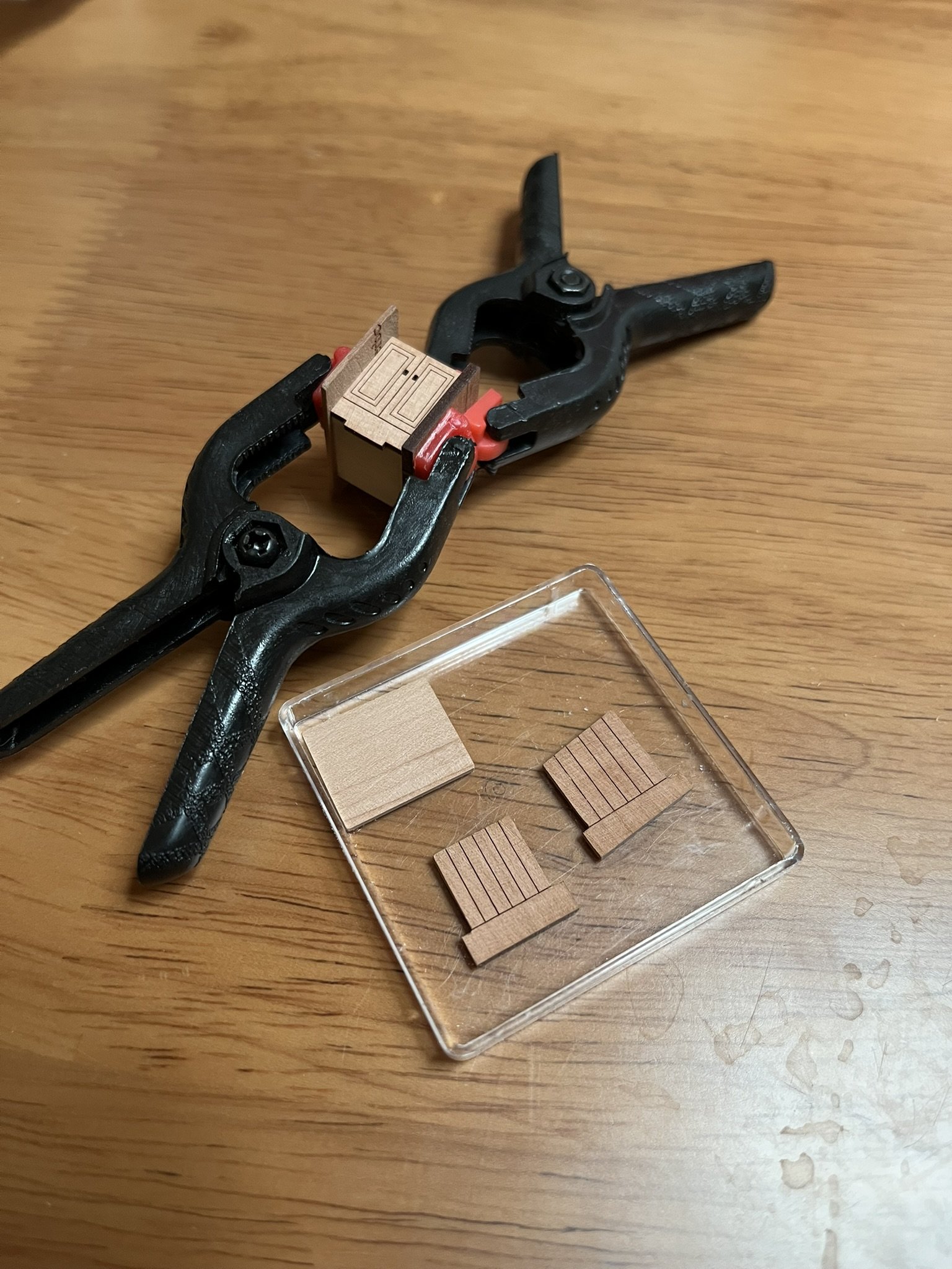

In the smaller pockets of free time, I shifted my attention to the companionway. I wasn’t happy with the original “key-style” construction, so I decided to redo it. I built a new inner structure from spare wood and reinforced it with two plywood sections. Then I cut out the keyed boards from the kit parts and glued them onto the new skeleton. After that, I made each individual plank and sanded everything to size.
Right now I’m debating whether to add a skirting around the companionway, similar to what’s used around the chimney and the mast. Otherwise, it’s essentially ready for a final finish — varnish, shellac, or something similar — which I’ll decide on later, before it eventually gets fitted to the deck.
