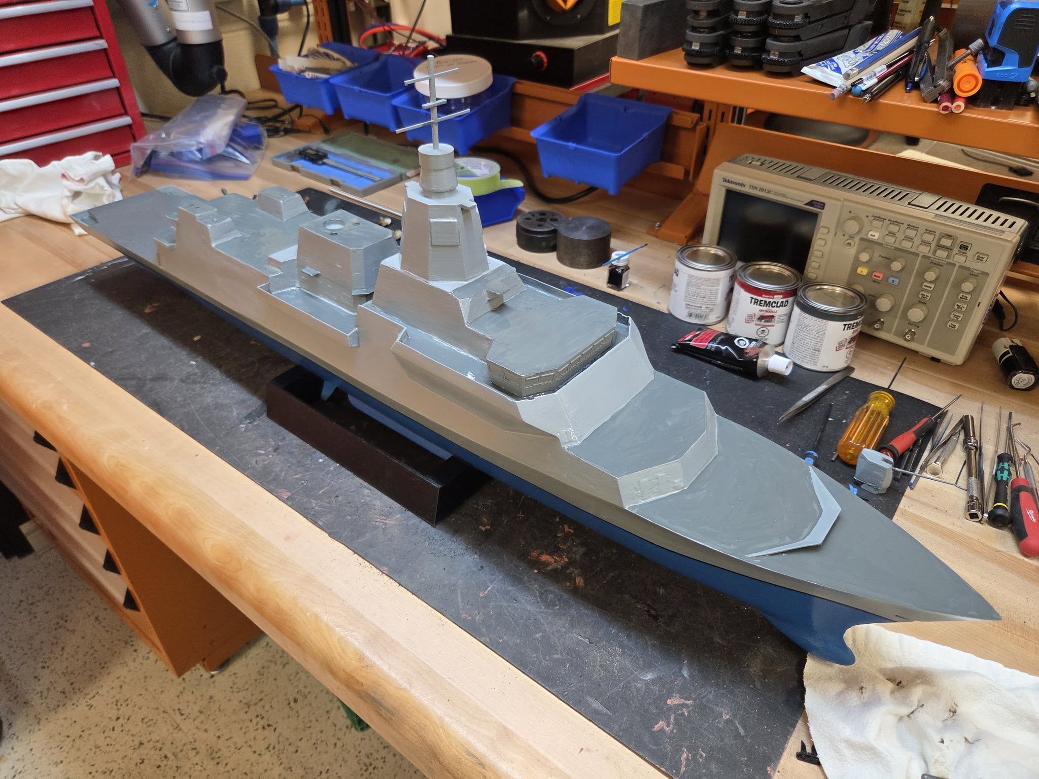

First coat of gray on the decks - starting to look the part for sure!
Merry Christmas one and all!

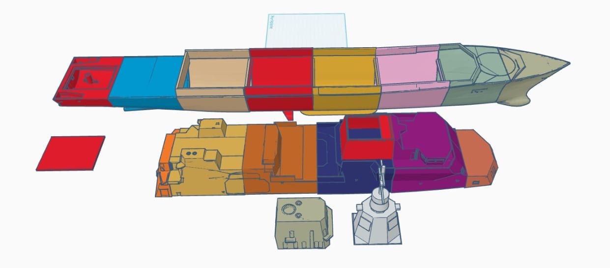

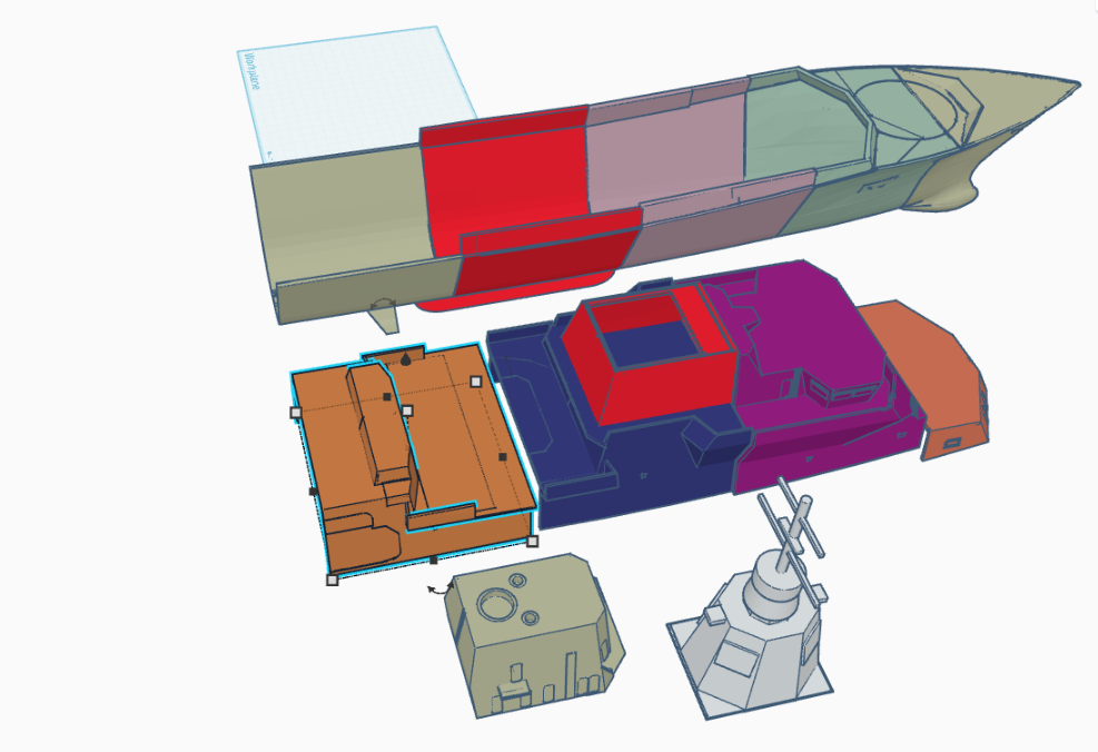

I've decided to try and make a version with a removable upper deck/superstructure and access through the flight deck to the rudders/steering system.
That will make it suitable for RC - I'll see how this turns out.  It'll still need a bunch of sanding and smoothing, but perhaps it'll run.

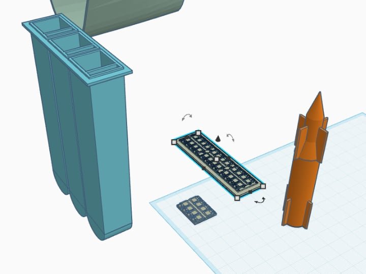

And...a few more hours of CAD work down the trace, and here's the 95% solution that I'm going to try printing I think.
And...if I'm going to have a Type 26 that's got a VLS system, I'd best have a functional VLS to go with it....
Sizing it to take 3 cells with a 14.5mm rocket body to accept a 1/2A Estes 13mm rocket.  We'll see if/how this works out.

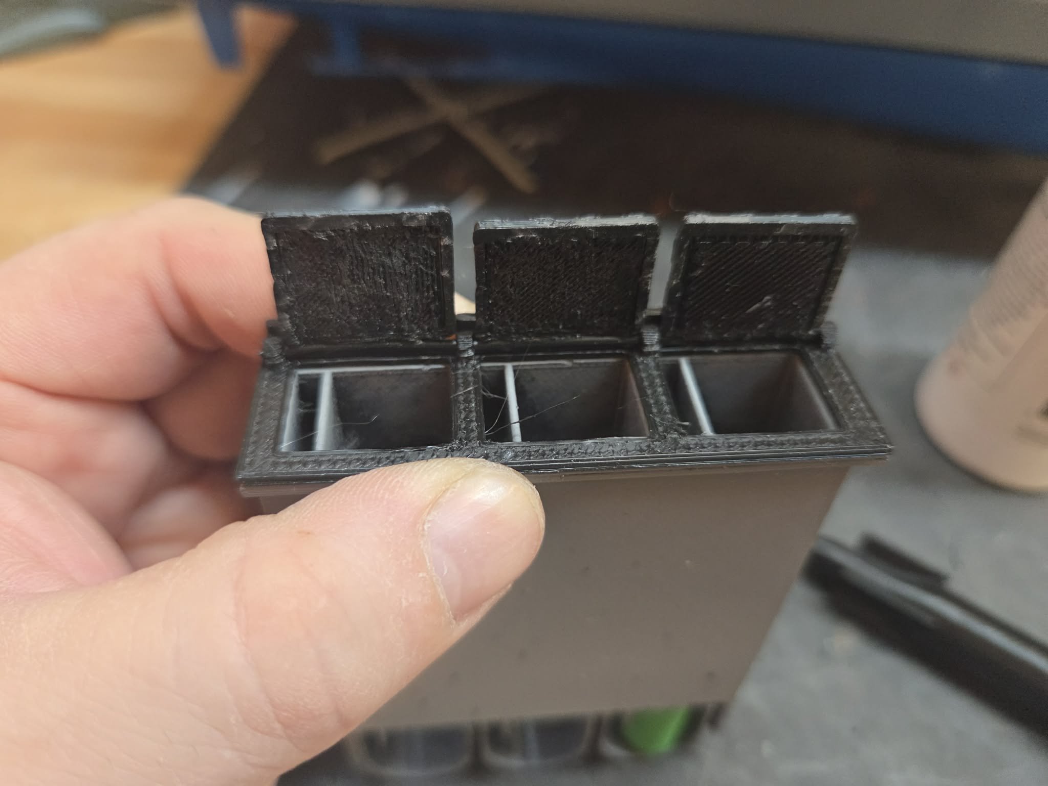

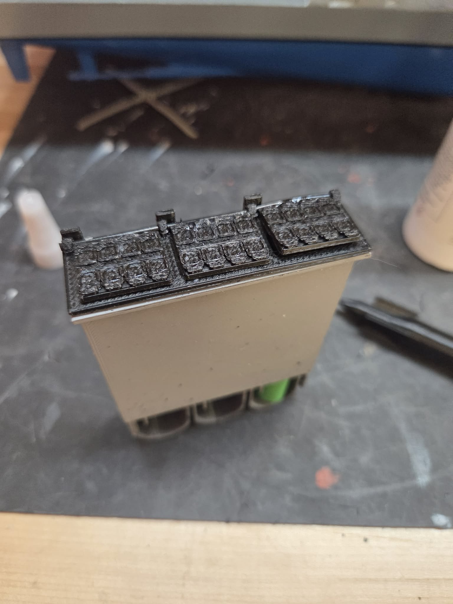

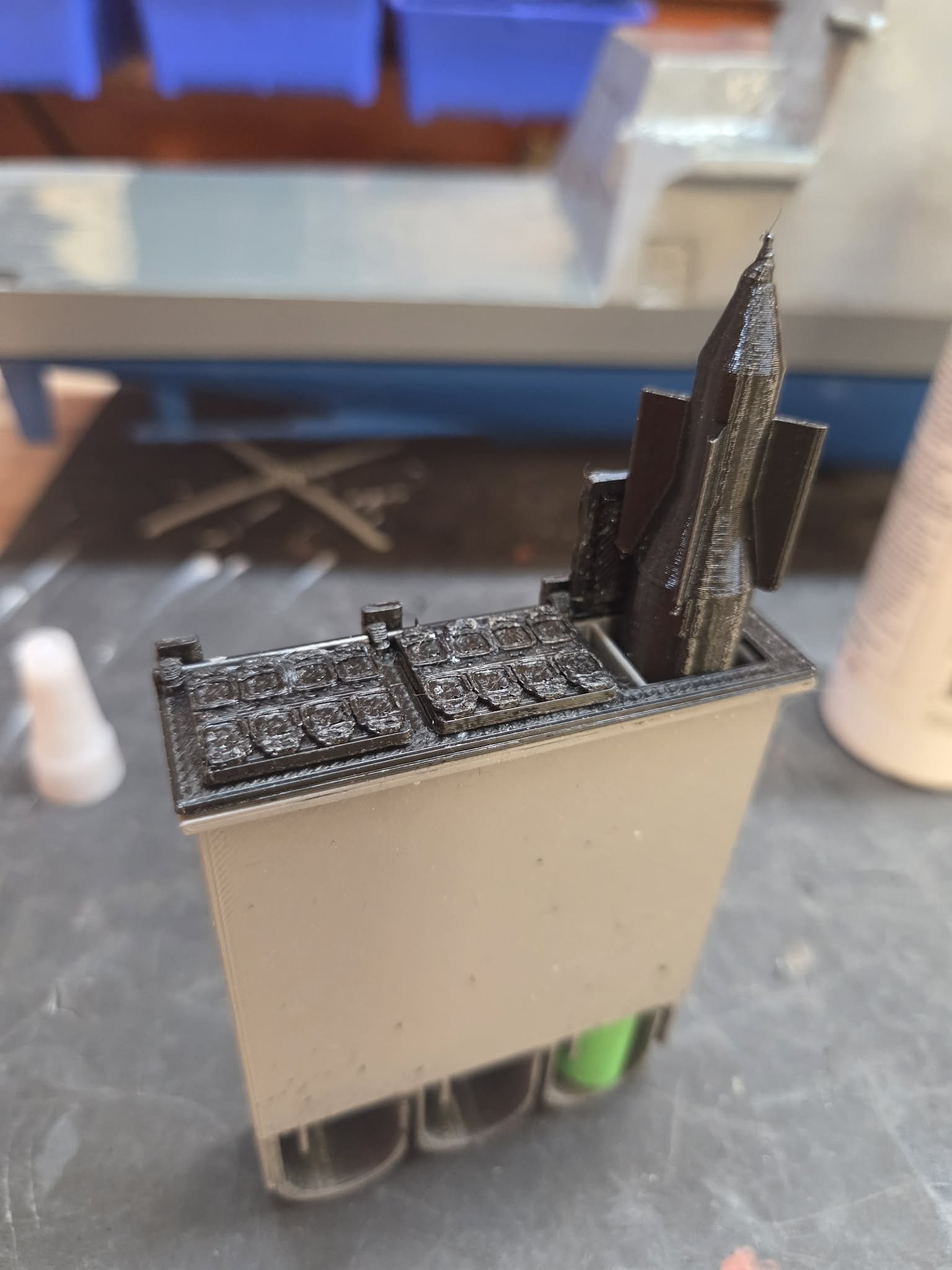

OK, the really really good thing about 3D printing is that it's very quick to shift from 1 version to the next in the prototyping stage.
V3 got glued up today with brass inserts in the bottom of the J-Tubes, and I tested the 'doors' (flaps really)
Here's some pictures.
Each 8 cell 'pack' of the MK41 is a single tube in this scale.
Version 4 is now heading to the printer once we get power back after the ice storm tonight - I needed a bit more space for the wiring channels and there were a couple of fit issues I had to solve.
I'm trying to keep it simple so I can use them as effectively disposable launch tubes, but if I can re-use, I will try.

So, the VLS plan is on hold for a couple of weeks until I get some new model rocket ignitors in hand that I ordered tonight.  The Estes 2 wire ones are too finnicky to be consistent.  I've found one that looks like it'll work better - I guess we'll see in about 2 weeks.

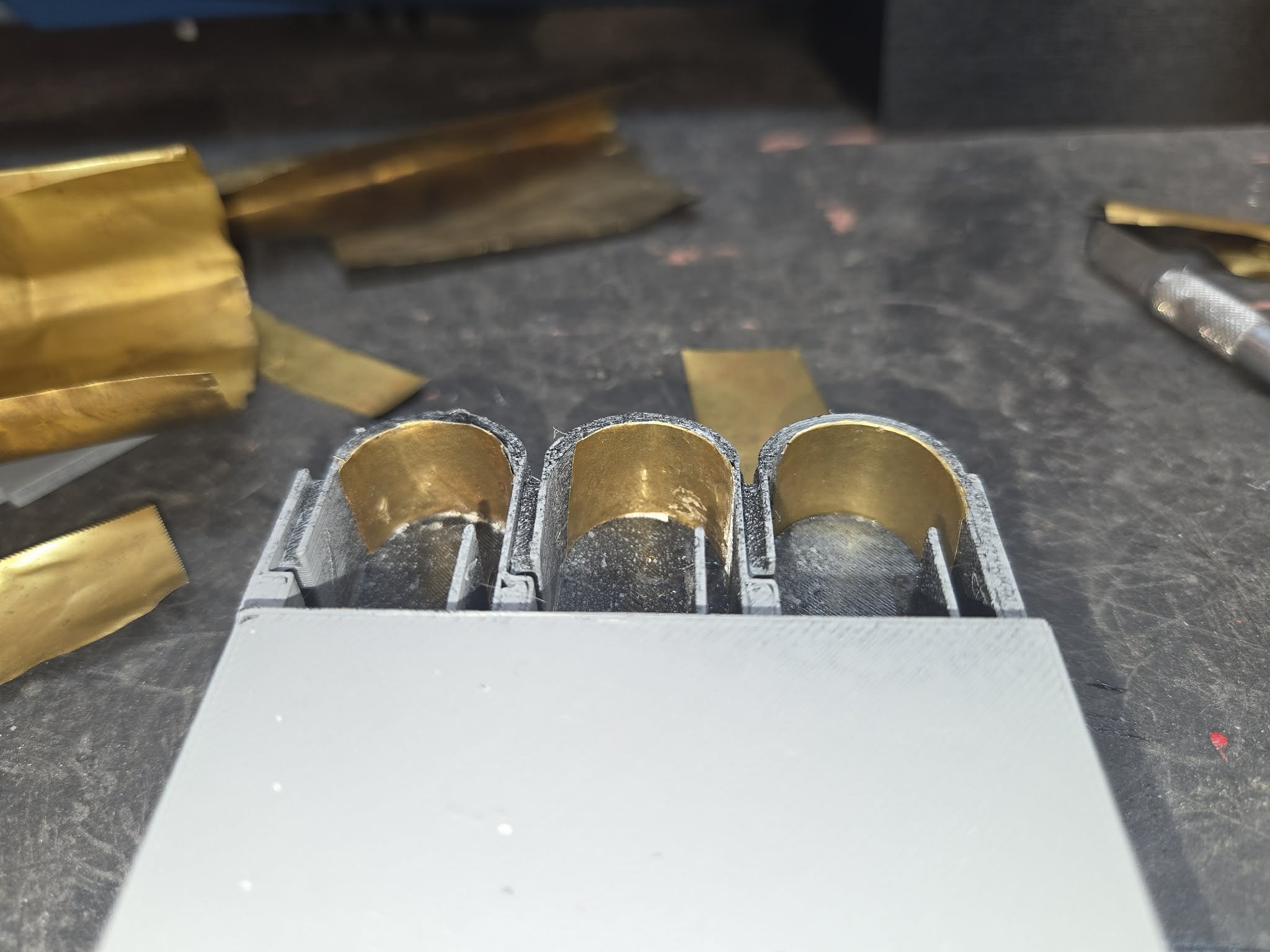

Visible in one of the images is the brass plate I glued in place in the bottom of the launch tube (J-tube) to see if it'll work for me as a heat deflector.
Intent is to have the module effectively disposable after firing so that I won't have to worry about burn through.
I'm going to be testing this a bunch before firing from the ship.
