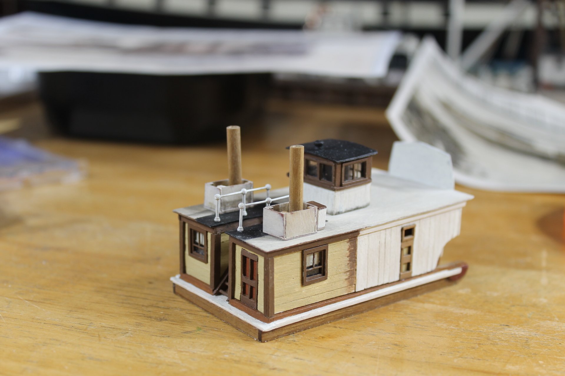

Tom, thank you suggestions and I did note the file name. At some point I need to mess around with India ink. In this case of the roofing, I'm trying to represent tar paper not wood but I do like the wall. The roof is painted with very thin black acrylic paint wash repeated till I was happy with the results. I intentionally left areas without the third and fourth washes. When the roof had dried I thumb rubbed the surface pretty good. I think that did more for me mentally than what it did for the roof. Thank you, Ken. As I said to Tom above, I do need to get myself to the hobby store and pick up some India ink. I think India ink would have highlighted the individual vertical boards much better than black pastel. I'm still an infant when it comes to weathering techniques.

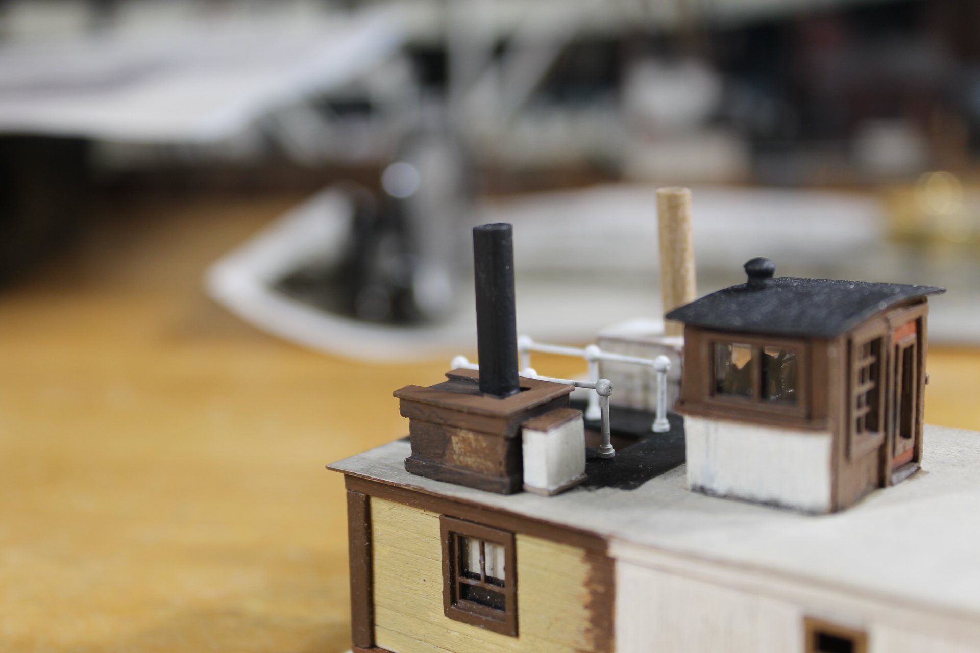

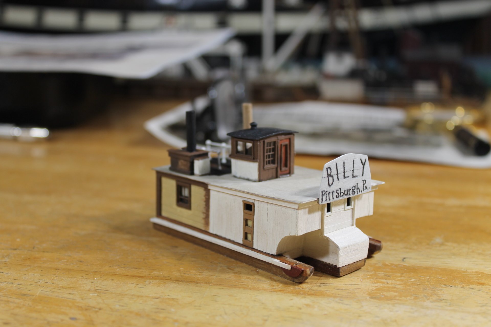

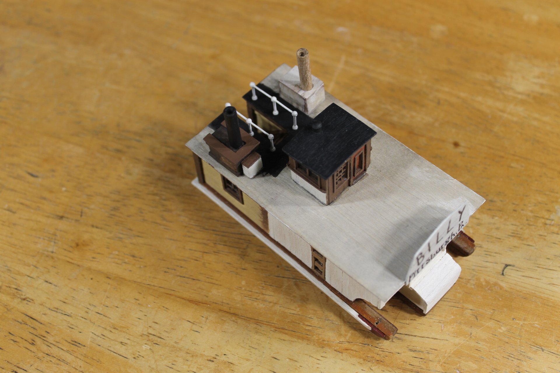

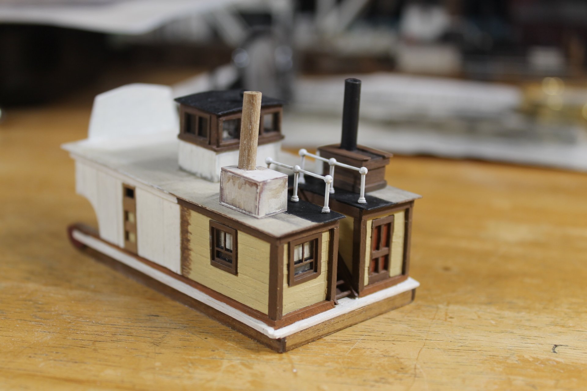

Thank you to everyone for the comments and likes. Well, finally something that resembles a build log. Research is a necessity but there comes a point when ya just gotta make something! I've completed the pilothouse. Who say's you can't start at the top and work your way down? The vertical siding is 1/32" x 1/32" basswood glued together using CA. I believe this was only a two man crew, the pilot would have been responsible for making forward and reverse changes requiring him to race up and down the stairs to the twin cylinder vertical steam engine which leads me to believe there wasn't a PH door. I also think the boiler had an automatic coal feeder, more about that later. The sternwheeler I'm trying to replicate is so rough that I didn't do any sanding and I didn't try to correct the basswood pieces if they didn't line up exactly. This is going to be pretty much the theme of this build though it's hard to not try and make things all nicely aligned and ship shape. There didn't appear to be any glazing in the PH windows, these are open window frames from Itchy Train. I don't know how one weathers the color black so I tried to show wear by not making the roofing a deep black and leaving light patches here and there. The PH is 0.8" W x 0.9" L x 0.8" H. The roof is 0.11" x 0.12". A penny is 0.7" D. Next up is the what I'm call the engine room which isn't exactly what that room is but.. I wanted to get the ER and PH done where I'd have a better idea on how long and wide I need to make the hull. Thank you to everyone for the support and following along and being part of the journey. Keith
