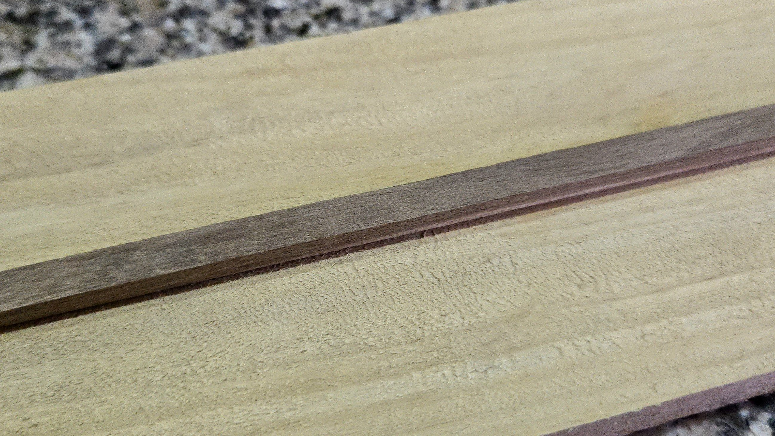

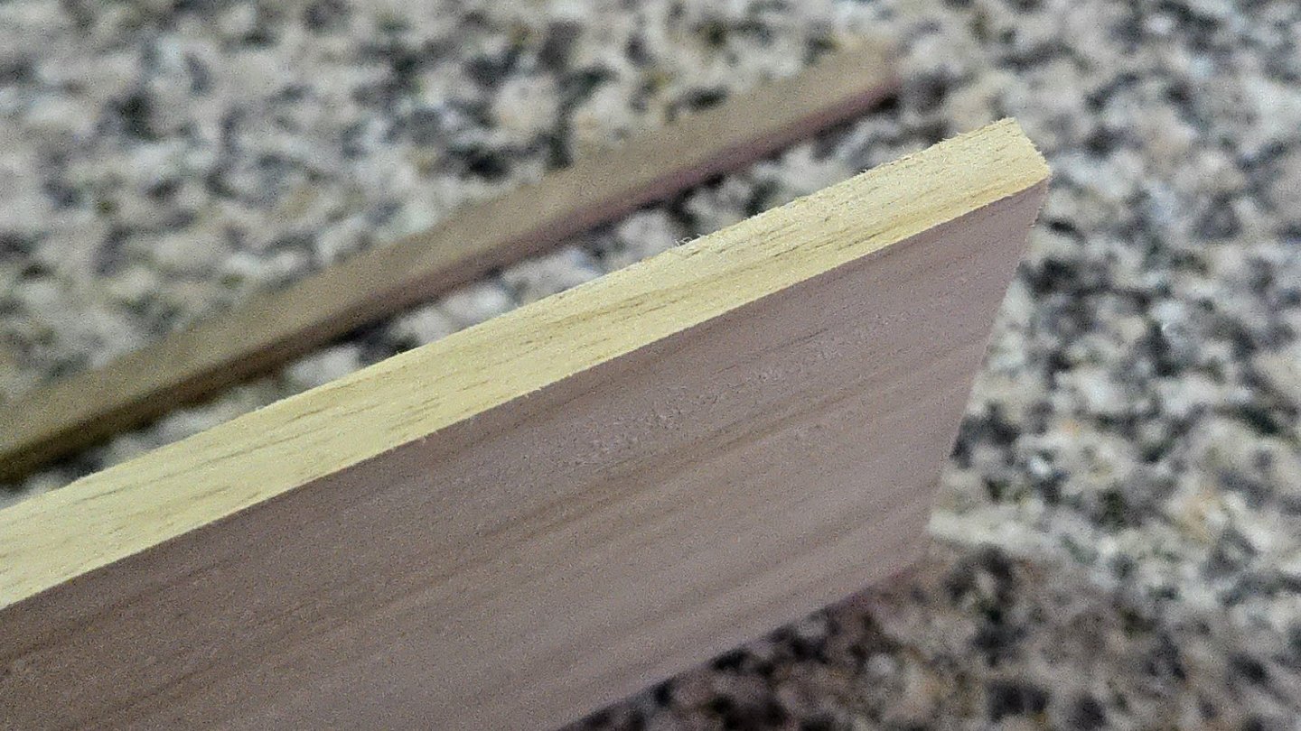

Between travel, work, and focusing on other builds for a while, it's been a long while since I made progress on the Bateau. The next step is planking. I decided to plank the wales first, then up to the sheer strake, in order to help strengthen the framework before I get to the more complex curves of the lower hull. My planking method is the same I have used since learning on the NRG Half-Hull kit. I've explained it elsewhere, but may as well go over it here. With the plank locations marked out, I put Tamiya yellow masking tape over the frames. It's thin enough that the markings on the frames can be traced. I should note that, according to the drawings, the wales should be made of two thick strakes running continuously from stem to stern. I don't want to try to bend thicker wood, so I'll make my wales in two layers. The inner layer will also be made of several planks per strake, as shorter planks are more manageable. None of this will be visible once the outer layer is on. After marking the plank shape, I move the tape to a sheet of planking material--in this case, 3/64-inch thick alder--and use a French curve to connect the markings in a smooth curve. I then cut out the plank, cutting slightly oversized. I sanded the edges a bit to get it closer to the final shape, but I held off on final shaping yet--given the tight curve, it's tricky to hold the plank in place to check fit. So, I then soaked the plank, heated it, and clamped it to dry in place. This is my first time planking with alder. As can be seen, the alder curved beautifully. I then sanded it to its final shape. Now that it's curved, it was much easier to check its fit. I then glued and clamped it into place. As the model is of an open boat, I made sure to clean up any excess glue with a damp brush and a knife--there's still a little to clean, below. And with that, about 11 months after I first made sawdust on this build, the first plank is on! One down, many, many more to go.

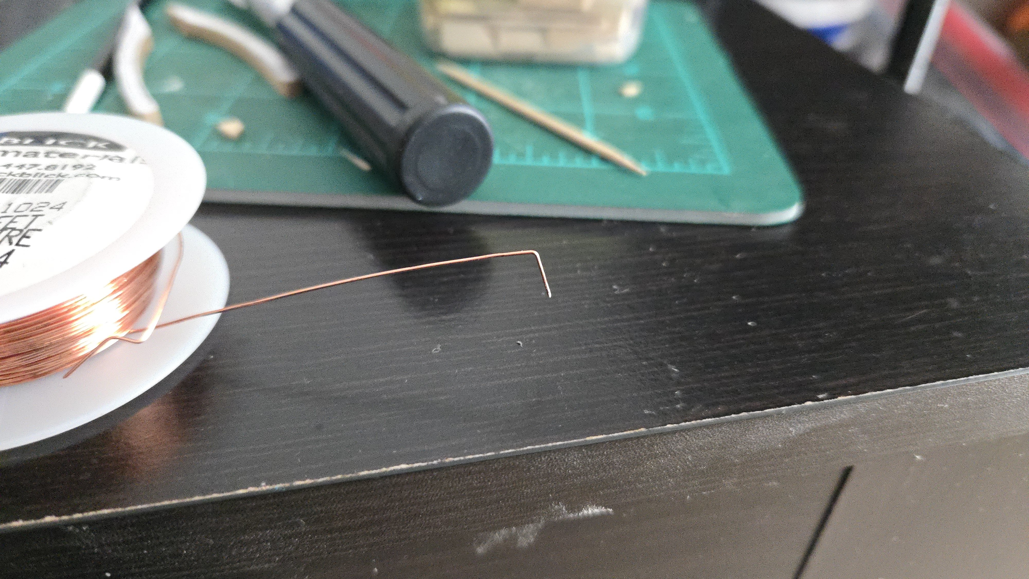

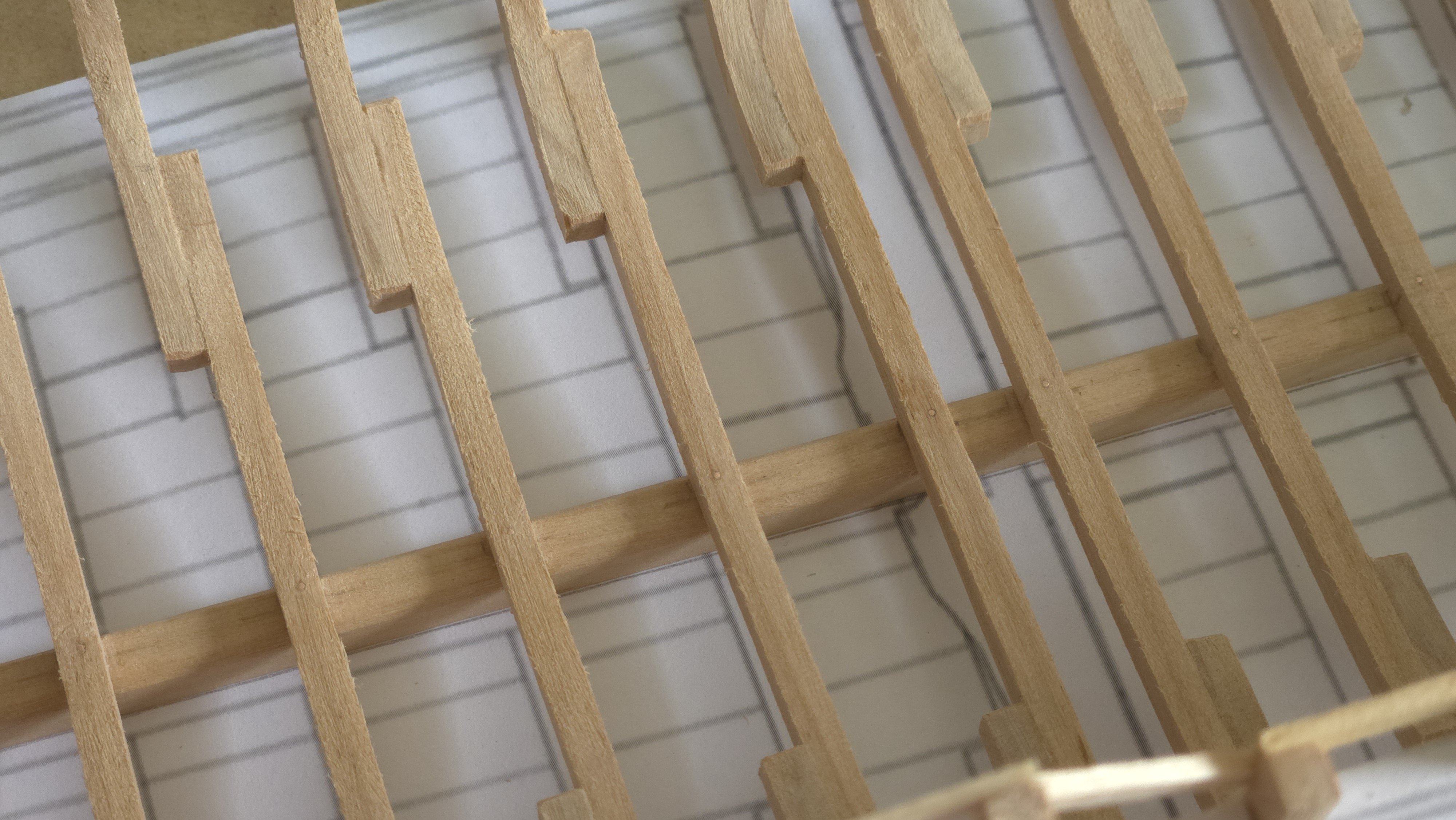

Thanks, all! On the exterior, I shellacked the hull and lightly sanded to remove the raised grain. I also decided that now is a good time to add the rudder, as I'll need to paint it when I paint the hull. I first added a small brass pin at the bottom, that will anchor one end of the brass rod I'm using for the rudder shaft. It was then straightforward to add the rod, mark where to cut it, cut it, place it, and superglue on the rudder. The completed assembly currently can turn. In the cockpit, I decided to paint the frames and inner faces of the hull planking the same white that I used for the cockpit's fore and aft bulkheads. This was originally done with alternating layers of dark and white acrylic washes. This attempt turned out a little darker and grimier-looking. Unfortunately, the washes loosened the glue on several frames, so I ended up supergluing them back into place. I also added extra frame pieces coming up from the bench-level bulkhead and aft of it--I don't know if these will be visible, but better that they're there in case it can be seen. Next, the benches. For this, I was inspired by this photo of a Friendship Sloop, which shows a framework extending back to the frames. Source After considering how best to handle these and their delicate framework, I glued them in place. I then added the foremost horizontal beams, using tweezers to manuever the pieces into position and securely glued to the underside of the bench and to the hull/frame. Once those dried, I was able to glue one more plank on the back end of each bench. I then added an intermediate horizontal support at the level of the middle bench leg. After that, I added some low backs to the benches and around the rudder head housing. I also added a cap piece going over the aft bulkhead--it may be disproportionately thick, but it looks better than the bare wood (and it really shouldn't be very visible). With that, I think the cockpit is basically finished. Below, I placed the bilge pump, although I think I may just leave it off entirely until near the end of the build. I'll need to think whether there would be anything else in the cockpit--some sort of hanger on the bulkhead to securely stow a gaff hook? In any case, the cockpit has been a lot of fun to build, and I'm glad I decided to modify it from the kit design.
