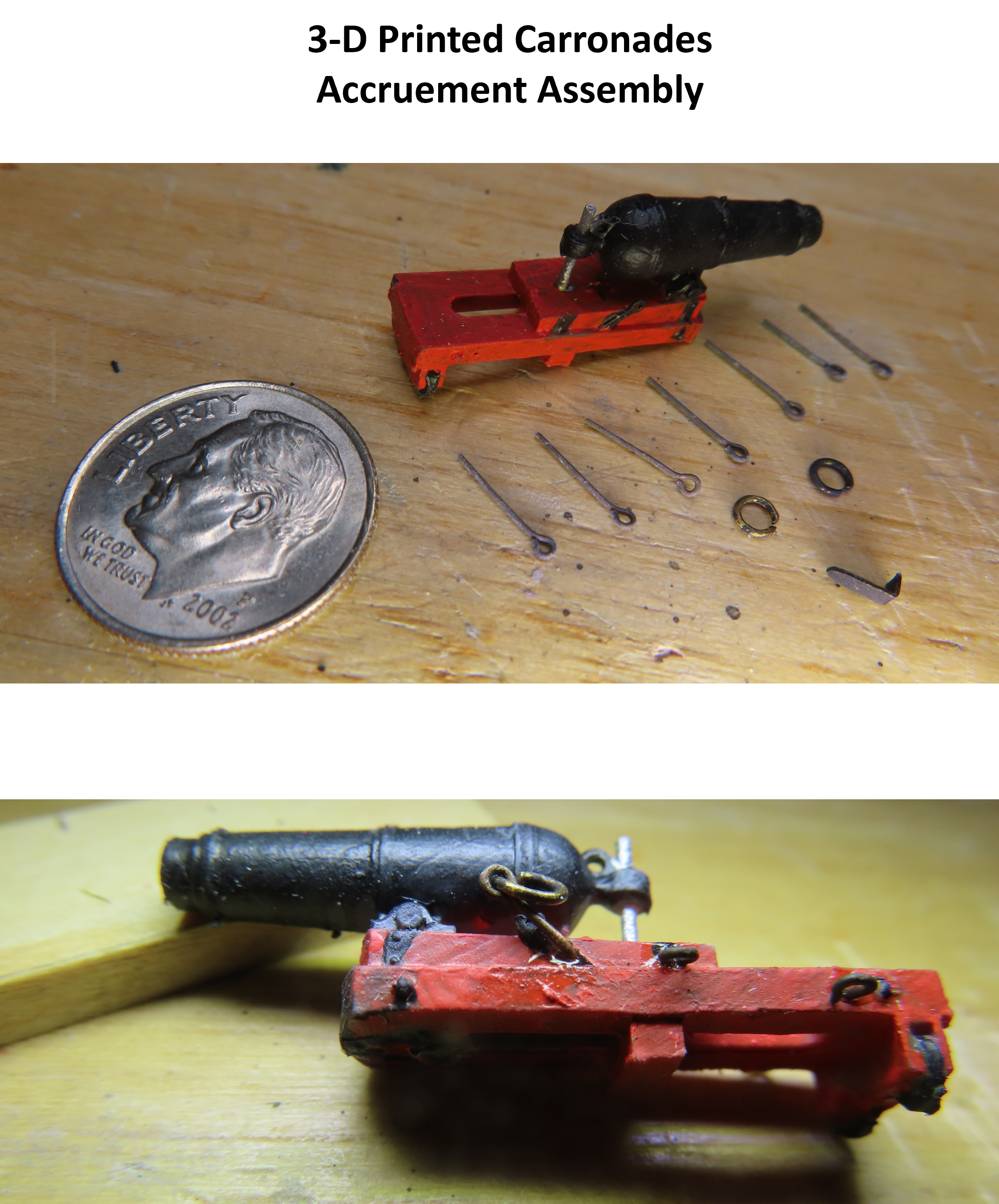

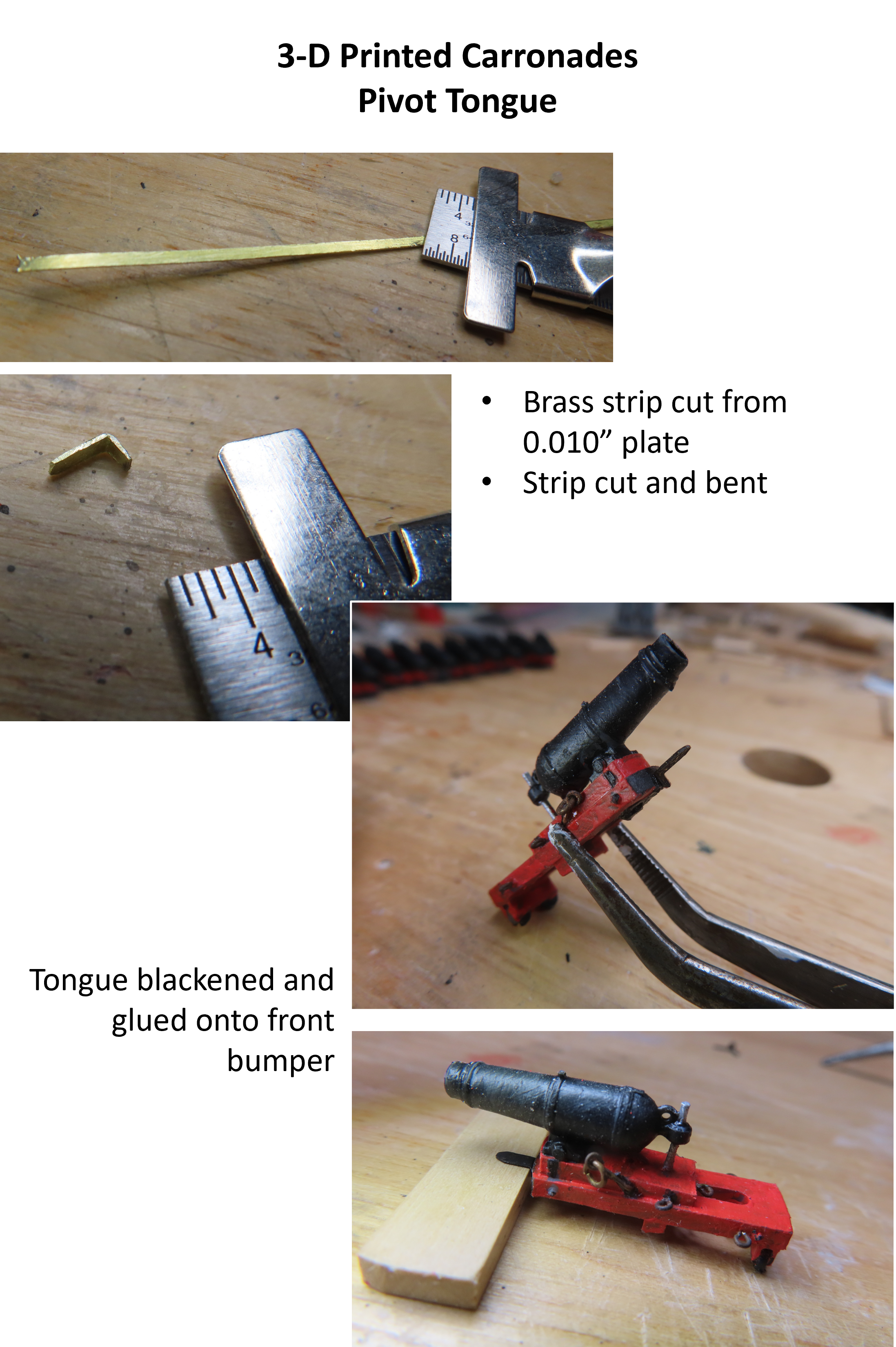

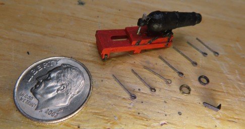

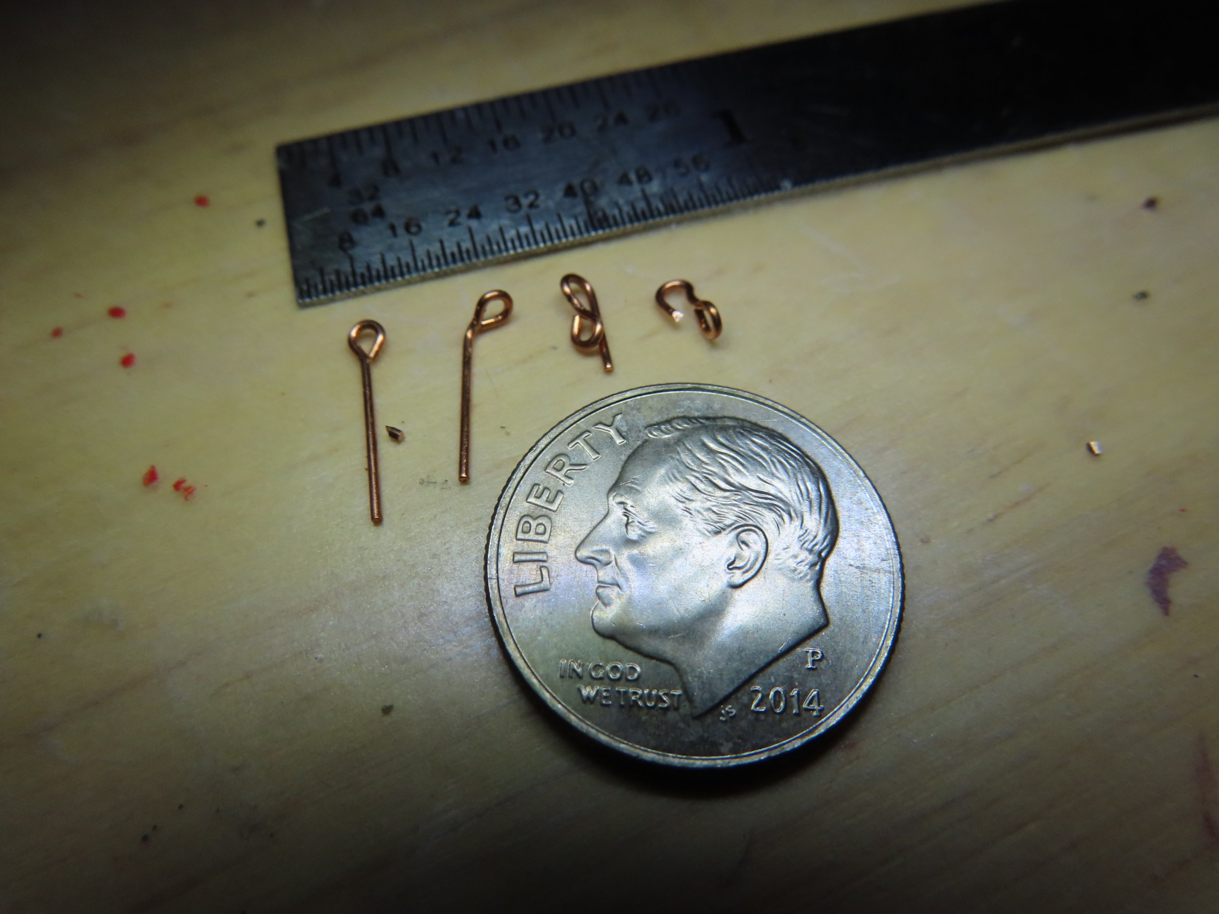

As it turned out, the 3-D misprinted/broken recoil rope eye bolts for are a moot point as I had to remove all of them anyways. They were very fragile, delicate, and broke when I tried to attach the required ring to them. The plastic is very stiff, inflexible, and will snap if any stress is applied to them.
Each of the 20 carronades required seven 1/32” eyebolts, one each for the two tackles per side, one for the recoil rope per side, and one on the rear of the gun slide. The recoil eyebolts have a ring passing through their eye through which the recoil ropes are threaded. These were replaced with trimmed eyebolts bent 90° with the attached ring.

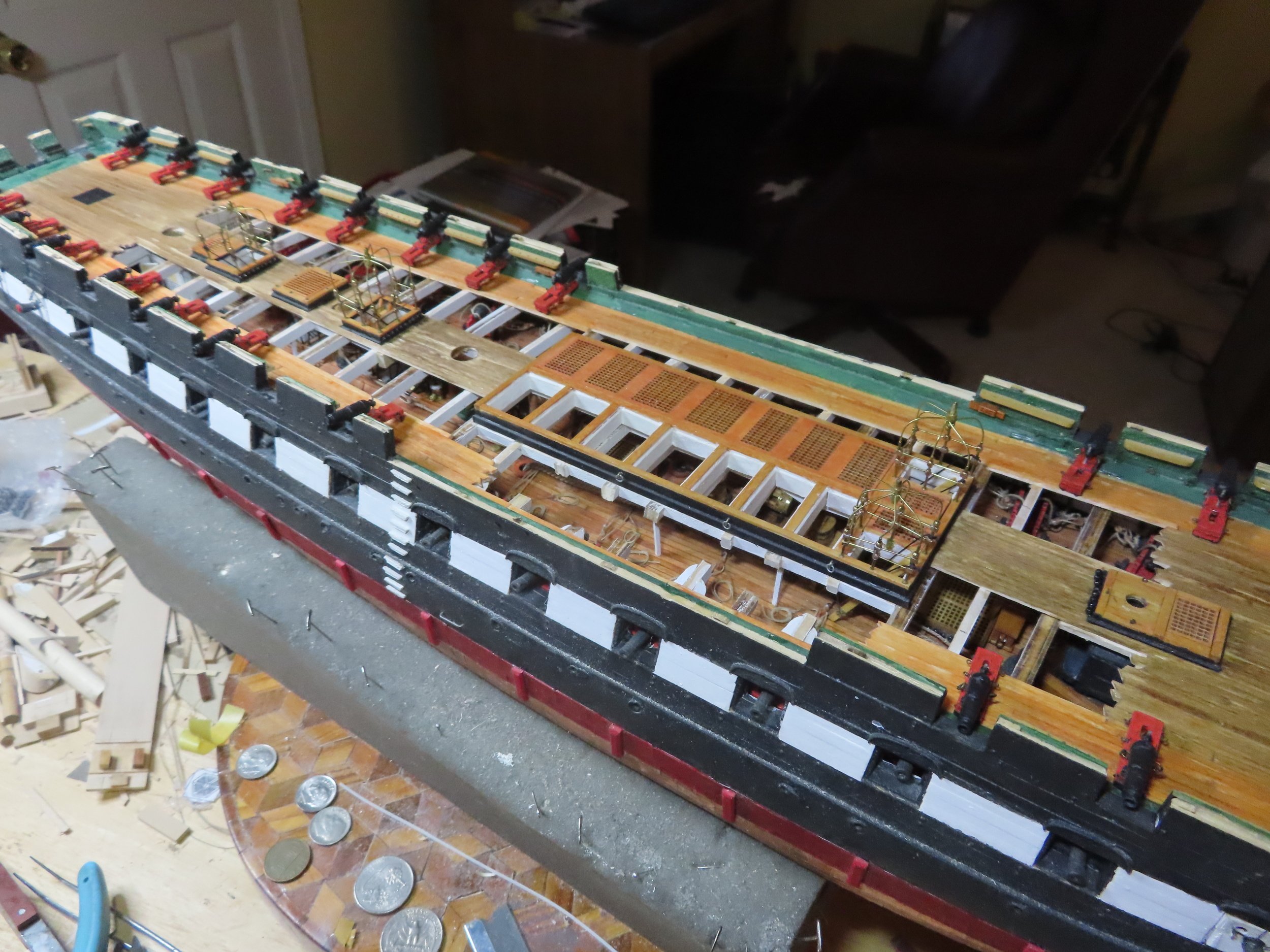

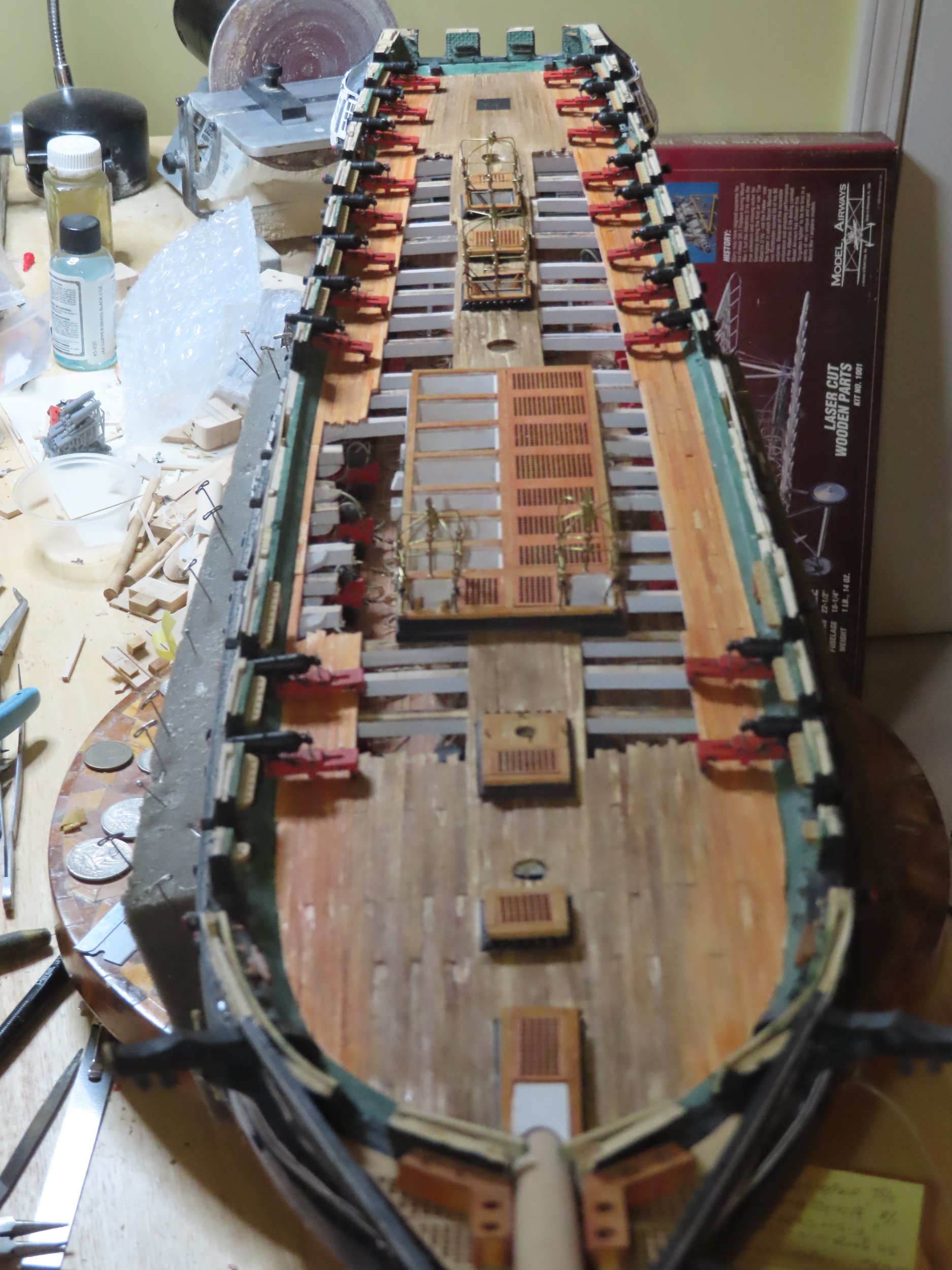

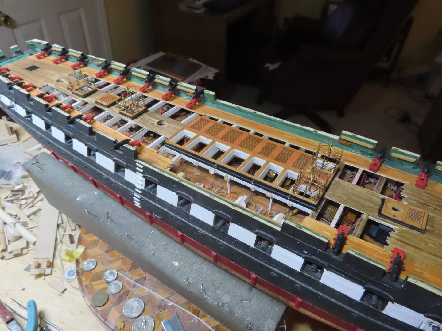

All 20 carronades were dry positioned on the spar deck ready to be rigged. First, I need to fabricate the two long guns to complete the spar deck’s armament.

Would you believe there are 100 hooks in this container? Once I got into the rhythm of bending the 1/32” eyebolts, I could do about 2, to 3 per minute, but it was tedious and working using the pliers, wire cutter, with a magnifier headset was tiresome. Now comes the really tiresome part, making 5 identical sets of tackle per each of the 20 carronades and 2 long guns. Oh joy.

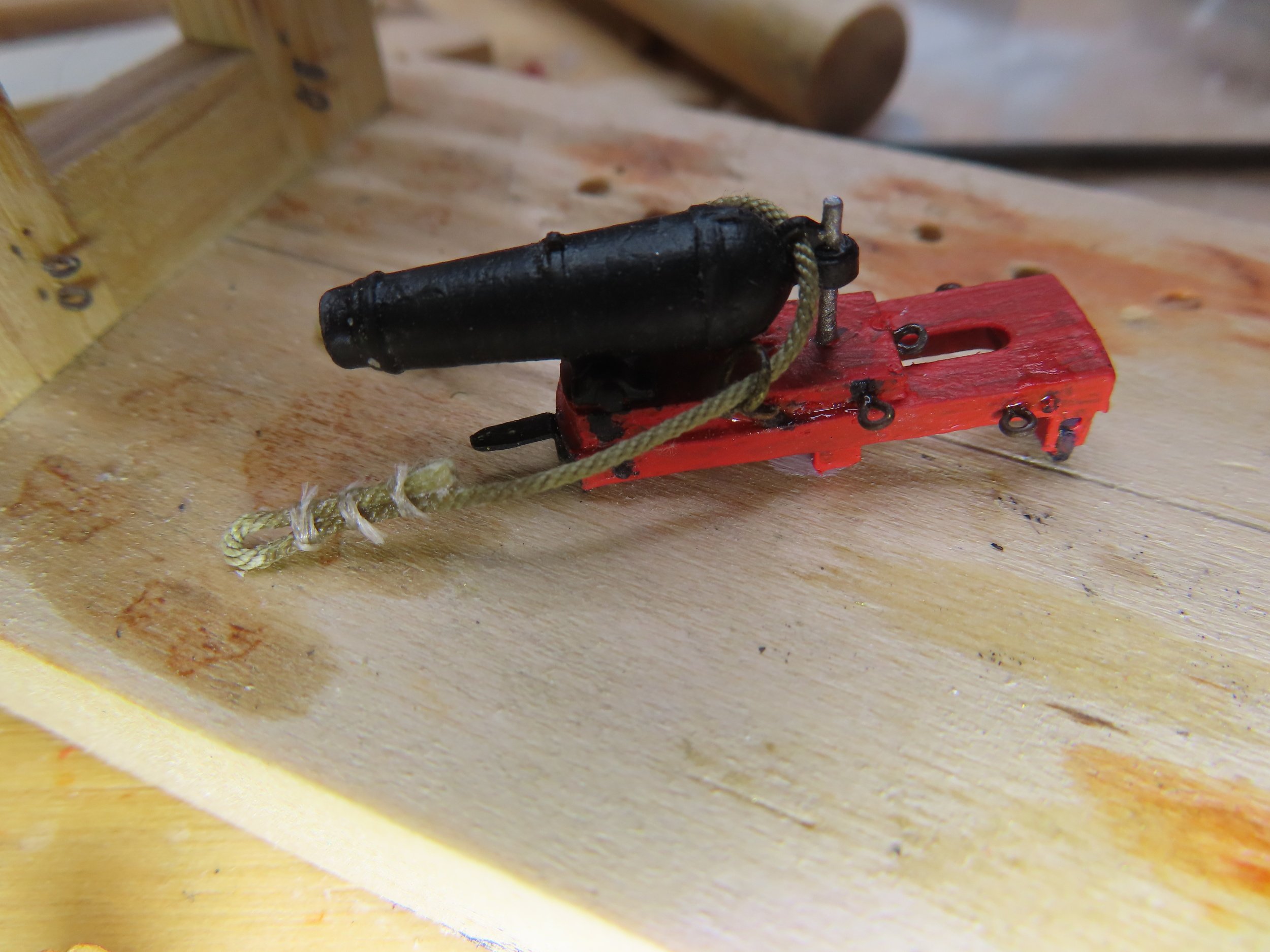

Using the mockup gun port I originally made for the gun deck; I fabricated the recoil rope and a set of typical tackles. The blocks, both single and double were 3/32”, the tackle rope was tan 0.008” (0.028 mm), and the recoil rope was Ultra tan 0.030” (.76 mm), all from Syren Ship Model Co. As previously mentioned in the prior post, the seizing line was the 3/0 nylon rigging line from the kit. Once I was happy with first completed set, I made just the recoil ropes for all 20 carronades first.
While seizing the loops, I noticed quite quickly that the loop would not pass through the recoil rings already attached to the guns. The rope loops were just not flexible enough at this scale. Therefore, after seizing the first loop, the recoil rope was threaded through the rings on the gun with the “un-looped” end first. Then the free end was seized creating the second loop.
As is my masochistic custom of following the more difficult path, I chose to attach the recoil rope to the bulwark like I did on the gun deck by inserting the rope loop between two eyebolts mounted one above the other when the bulwarks were installed many years ago. Then a short drop bolt is inserted into the top eyebolt, though the rope loop, and out the bottom eyebolt. The drop bolt was made from a 3/8” long 0.025” shaft diameter flathead nail which was cut to 1/8” length. I apologize for the out of focus image. A zero depth of field, in a confined space, with a shaky hand are not a good mix. I didn’t realize I had a poor-quality photo till I was composing this post. So, I demonstrated the process using my gun port mockup.
I then went on and added the remaining tackle. At this point, nothing is glued in place, and the lines are not neatly coiled up and positioned yet. The last three guns on each side of the stern will have a fifth tackle to pull back the gun slide where the spar deck is not cut away as seen in the last photo below. This last tackle is not installed on the actual ship as they are tourist tripping hazards in the modern world.
