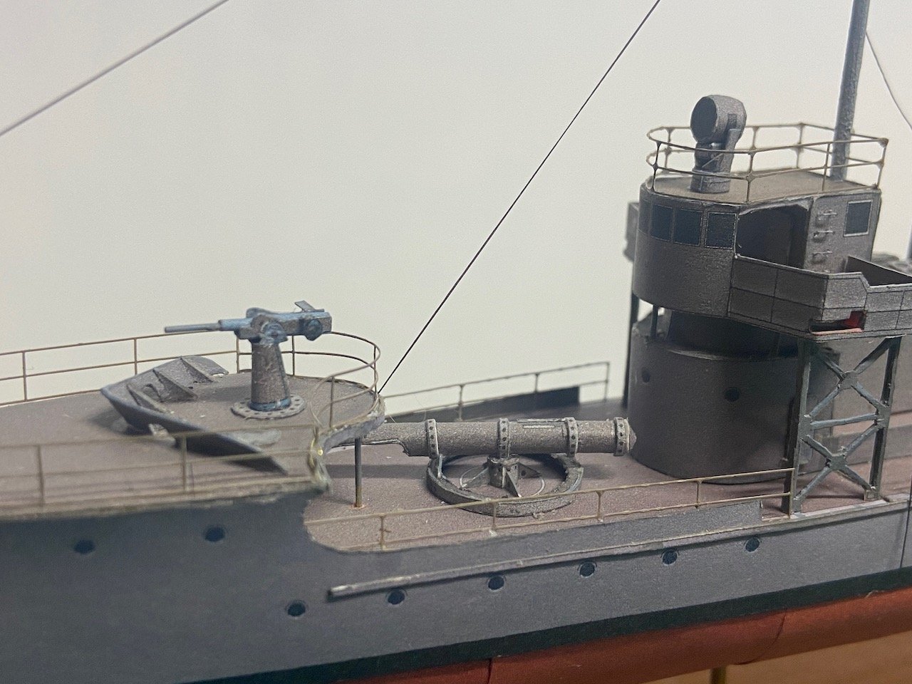

I did manage to finish the remaining pieces of photo-etch railings. These were the harder pieces I decided to save for last.
There were two pieces remaining. The first was to finish the curved rail at the stern. It took a little doing to create the correct curve, and to cut the railing to the correct size. The ends of this piece had to be cut, so that I ended up with three "free floating" rails that just slightly overlap the existing, mounted rails.
This worked pretty well, though it took me a while to glue the piece into place, as I couldn't fully achieve the right curvature, and had to get the glue to hold it in place and to hold the right curve.
I think this turned out pretty well, as it's difficult to see where the rails are "spliced" together.
The hardest piece to add was the one on the forecastle, just abaft the gun mount. This required a double-curve which took me quite a bit of work to get close to the proper shape. To help out, I cut an extra forecastle deck piece so I could work out the curvature off the model. Again, I got the rail curvature close, but not quite. It was close enough to allow me to cut the ends, again with the three free-floating rails sticking out.
Once the curve was close enough, I glued it down on the model, holding it into place with tiny scraps of wood, coaxing the piece into position with the right curve. The ends were glued to the vertical "stanchions" of the existing railing, being careful to get the rails to line up as closely as possible. After the glue dried, I carefully snipped off the excess. Again, it seemed to turn out pretty well. It's not perfect, but at this scale, except until zoomed photos, it's hard to see any issues.
Lastly, as you can see in the above photo, I finished assembling the searchlight, and mounted it on top of the bridge.

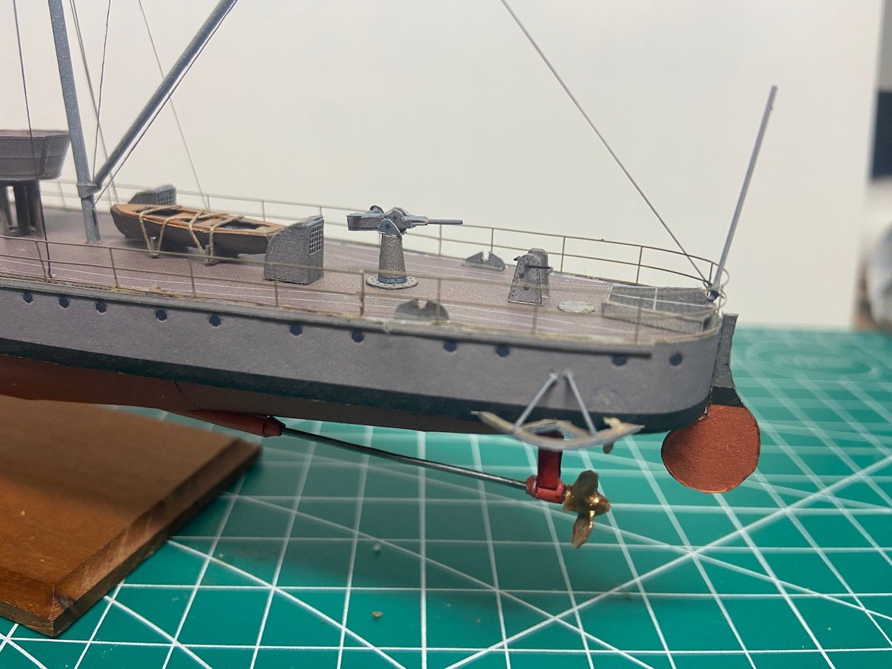

I'm happy to say that I finally put the finishing touches on my V108 model today. My first steel navy paper model is complete. It's not perfect, but I'm pretty happy with how well it turned out.
I ended up not detailing the radio aerials as much as I had originally planned. But, between the existing aerials and the photo-etched railings, I think I had enough of a challenge to satisfy me.
Today, I finally got around to adding the anchors and cutting out and building a new anchor crane and mounting it into place. I'm much happier with the new one that with my original one. Also, since my last post, I added the new ladder that leads up to the bridge. Again, it's not perfect, but it actually turned out much better than I thought it would.
