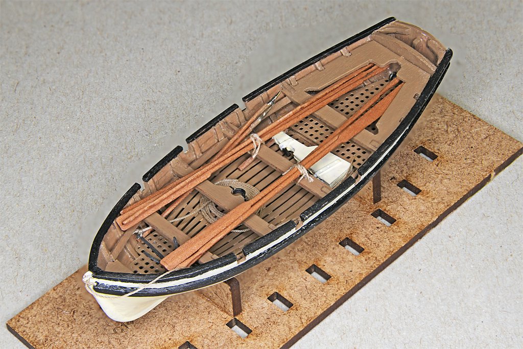

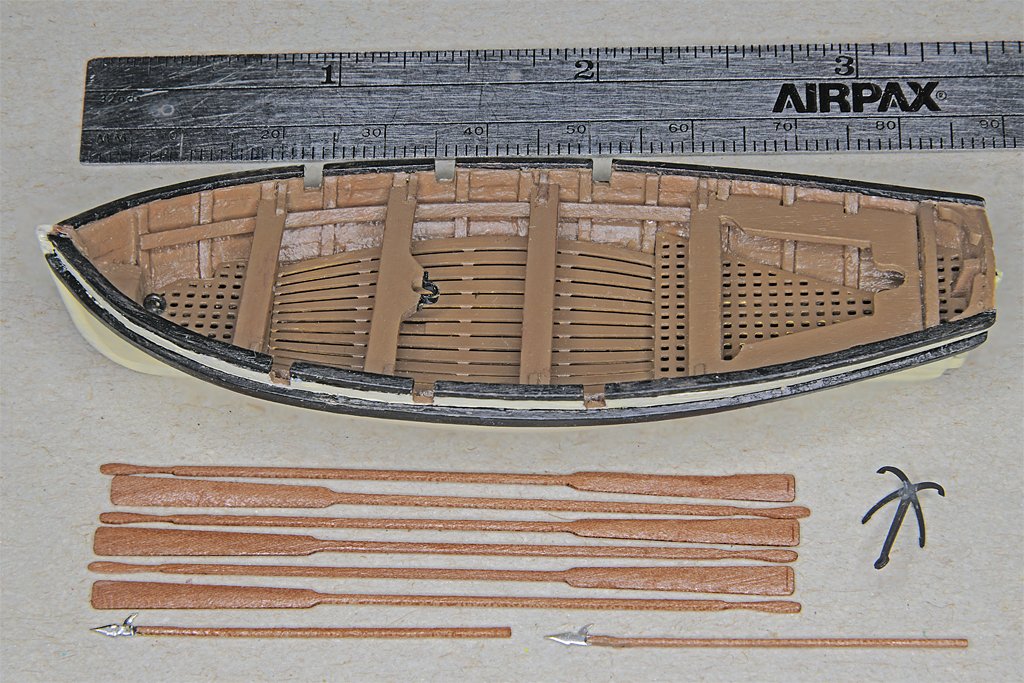

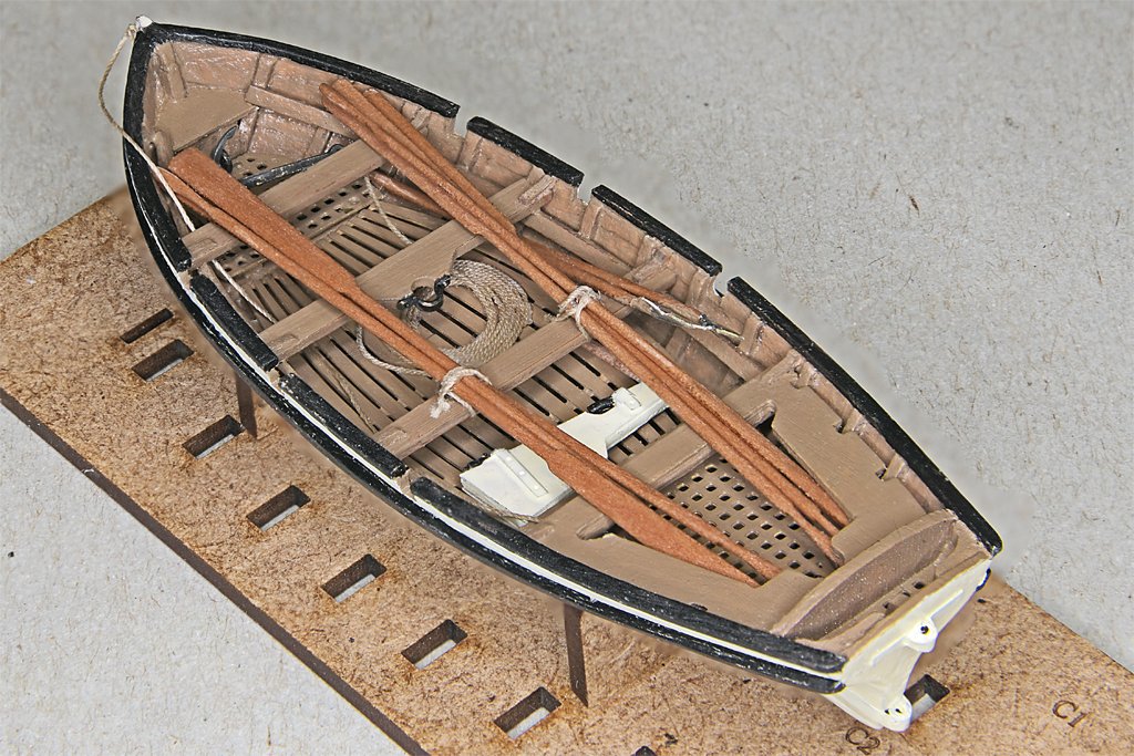

Since the Albatross is a kit build, and kits usually supply a boat or boats for the model, you might wonder why I am going to all the trouble to build the Vanguard cutter kit. Well, they say a picture is worth 1000 words, so here are 2000 words - with the expletives deleted!
Boats1.jpg.99715fb47b68d72405a8944b4456df84.jpgBoats2.jpg.7439aedc5a1b1d7e267fb8aa8002f9ca.jpg
At the top is the Vanguard 18 foot cutter kit model, and below is the 1980s Mantua Models Albatross kit boat. Not only is the Mantua boat absurdly small - 10 1/2 feet (3.2 meters) at 1:48 scale, but it certainly is the most worthless bit of trash I have seen in model kits! I have said before that it appears that for the Albatross kit Mantua just threw in whatever parts they had on the shelf from other kits. The kit boat's quality speaks for itself!

Oh my, and I though that the quality of the plywood was a bit rough in my kit - this one wins hands down!! That material looks very much like pressed paper or something......
I don't know what that thing was made of. I looks a lot like sawdust mixed with glue that was pressed into a mold.
Not everything in the kit was bad! I have no complaints about the quality of the wood - except the thickness of the deck planking strips varied quite a bit. That just meant a bit more sanding to get everything smoothed out. They did scrimp on the bulkheads - not enough midships - but I added a couple more to ensure that the hull planking came out OK. The hull planks were a good quality wood, but I am not sure what it was.
The cannons were very bad. I have never seen anything like that in real life. And the gun carriages were a joke! But the anchors were nice - after I filed away the mold flash.
The kit did supply some thread for rigging and "standard" low quality blocks, but I replaced it all with Syren products.
The masts and spars were ordinary dowels. But they were too short for the extreme American rigging. They would have been OK for a British schooner build for the late 1700s or early 1800s. I replaced them all.
The kit had a fairly nice flag, but it had 48 stars and 13 stripes as was used in the mid 20th century. That was just cheap! For my 1815 build I needed a 15 star flag with 15 stripes.
This was a cheap kit, and I knew it when I bought it at a local hobby shop. This wasn't my first kit build. I expected to have to correct a lot of things. Basically it was just a supply of wood for a ship model.

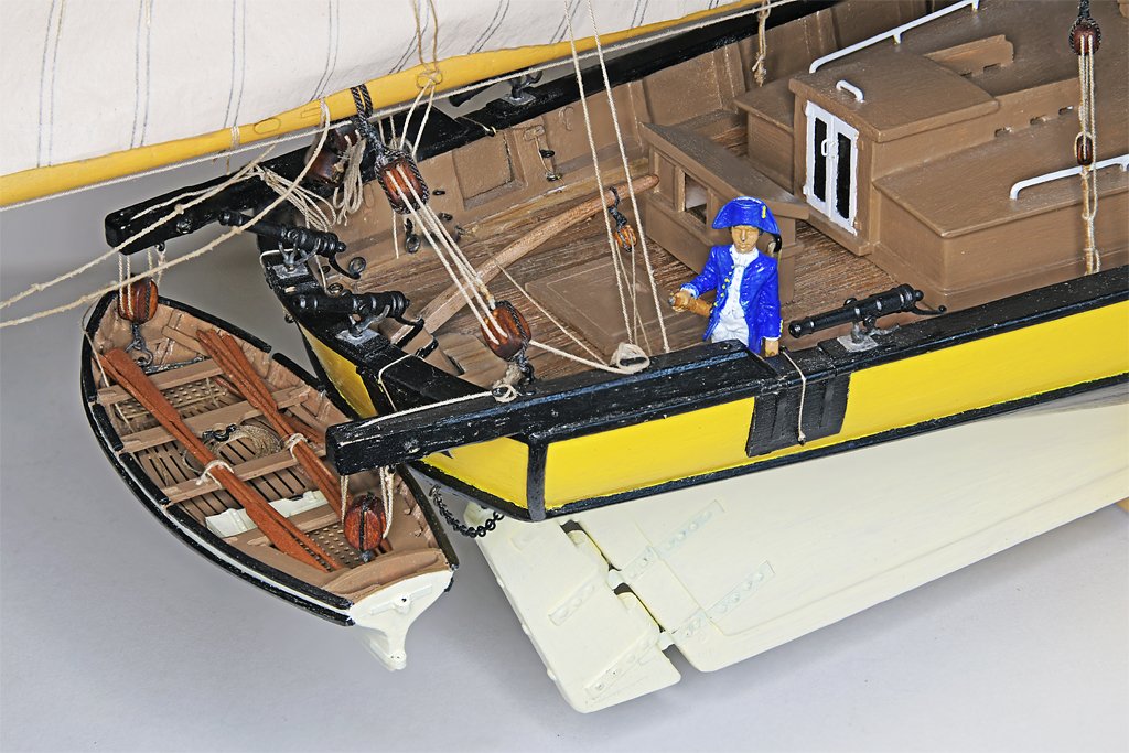

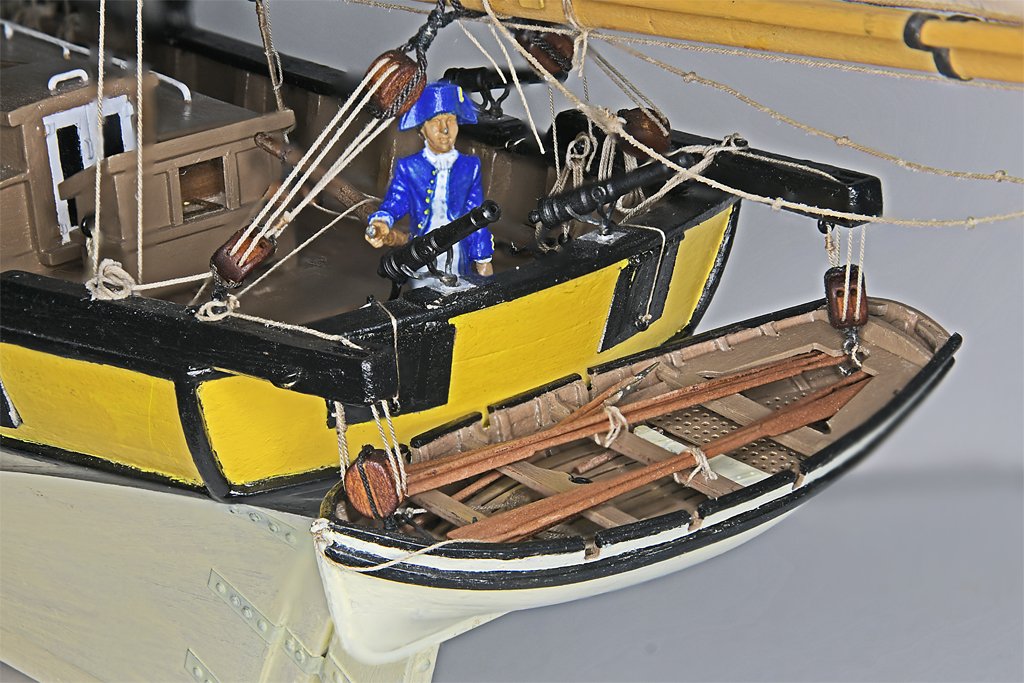

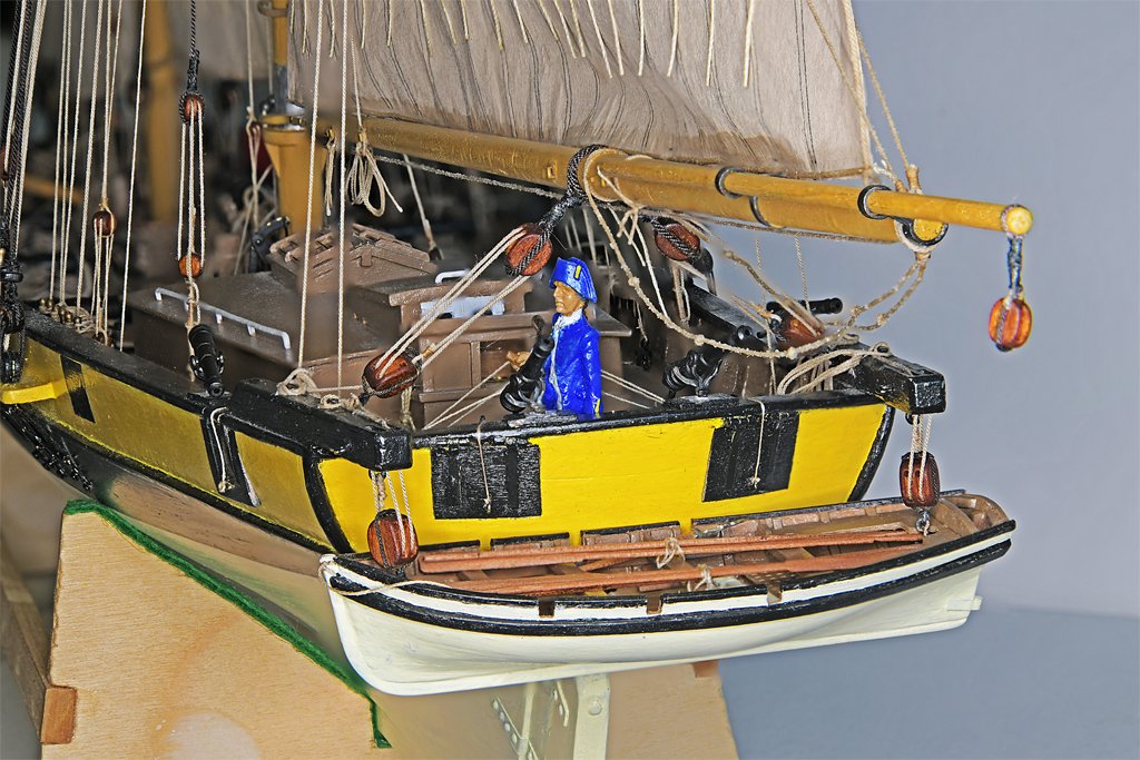

The boat is finished.
Boatandgear2.jpg.2601ca5fa288ff0b8c29af05eca9dbcb.jpgBoatandgear3.jpg.b3990ba5eccd481fa24abc025868fc11.jpg
I stowed the oars, rudder, anchor and boat hooks as if the boat was ready for lowering from the davits. The ship's port anchor is rigged as if it has just been fished from the water, and the sails are set as if the ship has just gotten underway. So the boat is rigged for "sea and anchor detail" (I don't know if it was called that in the early 1800s).
Boatindavits1.jpg.9b6110511a0a01c9998efd2b2b6be977.jpgBoatindavits6.jpg.b1fa359cb09148299193dcd37c2faef3.jpg
The Vanguard cutter is just the right length for hanging under the boat davits.
Unfortunately, the ratlines did not rig themselves while I was distracted building the boat, so I must now go back to that drudgery - unless I can find something else to work on.
Phil
Current build: USS Cape MSI-2
