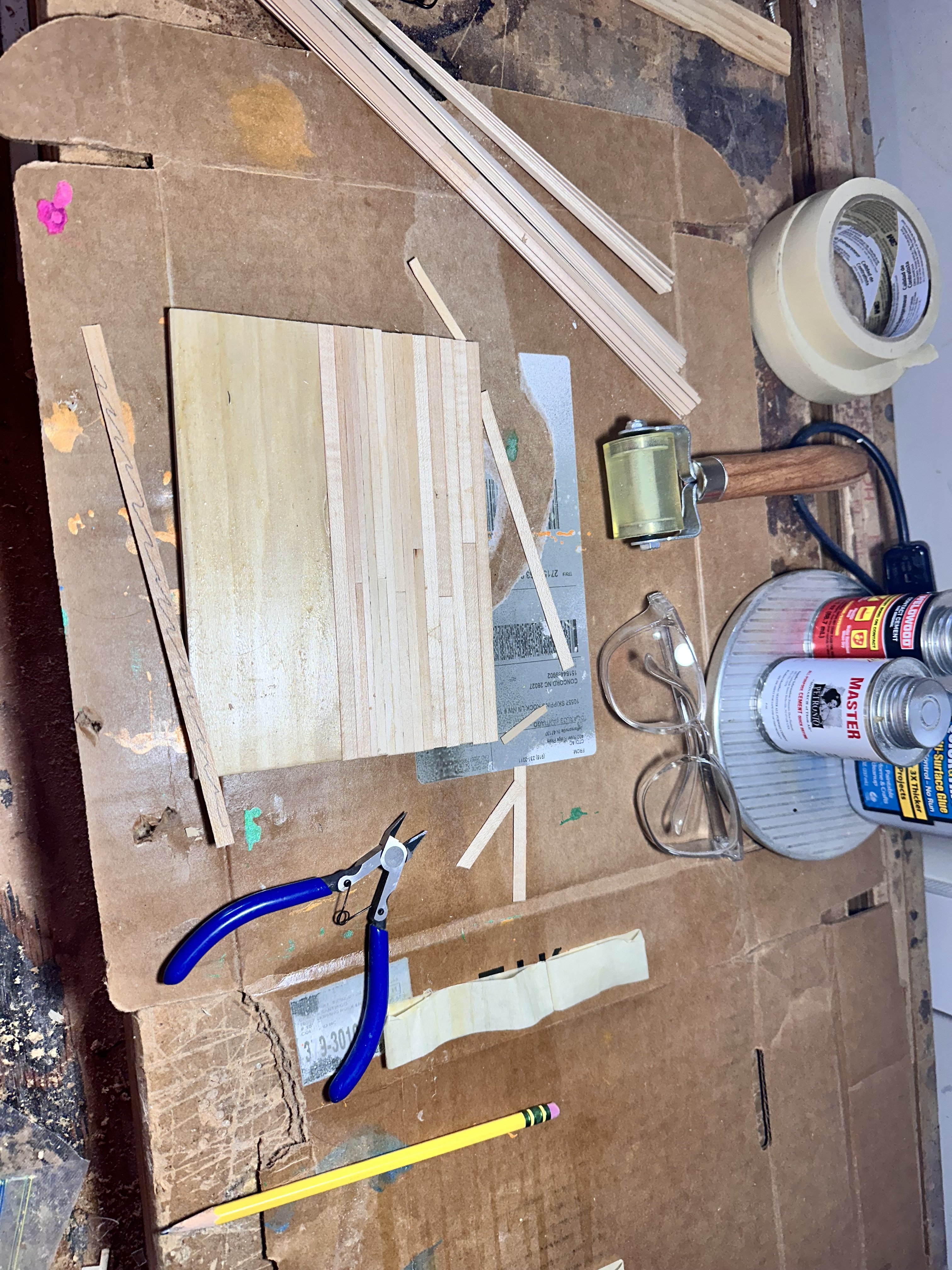

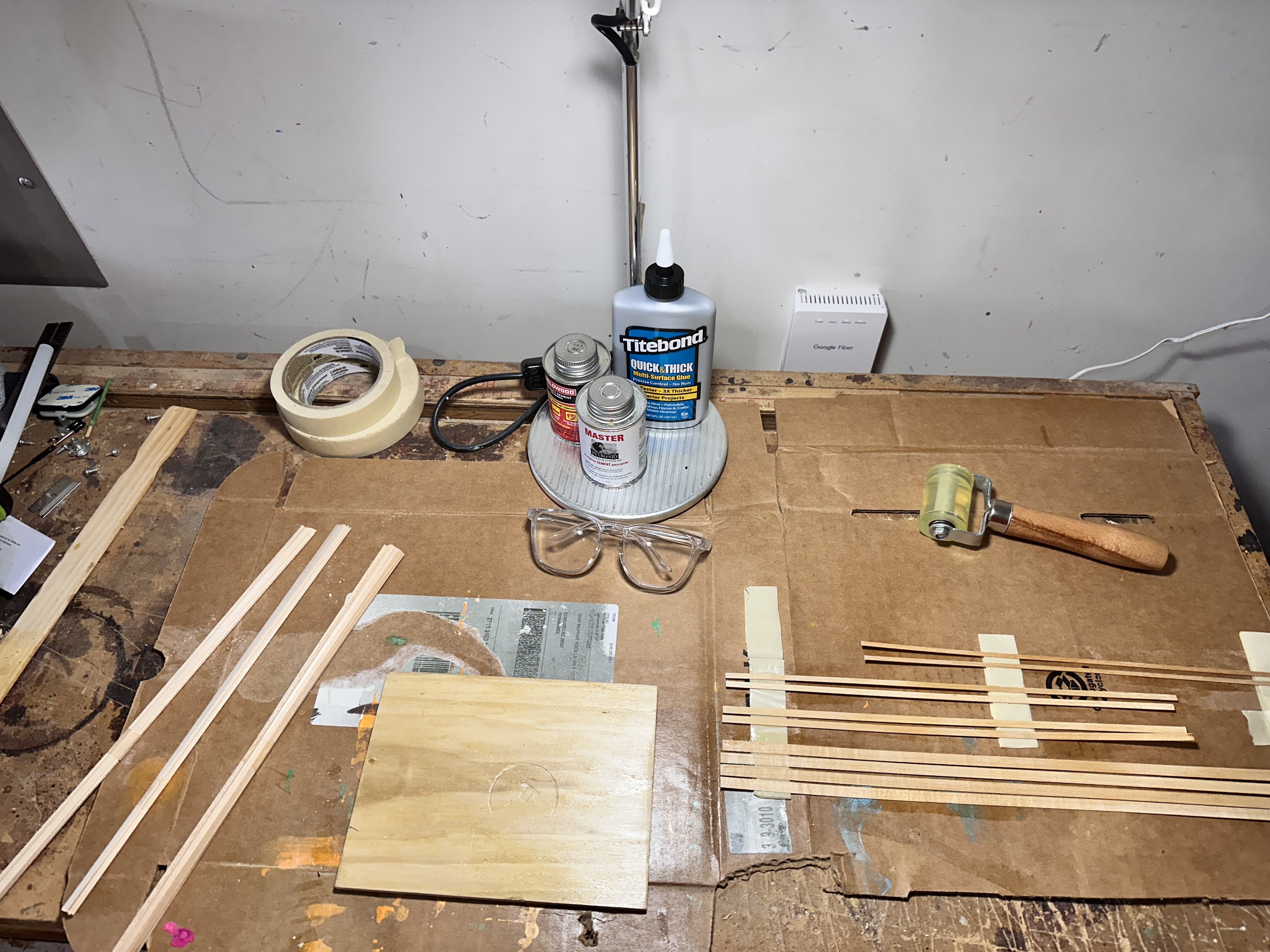

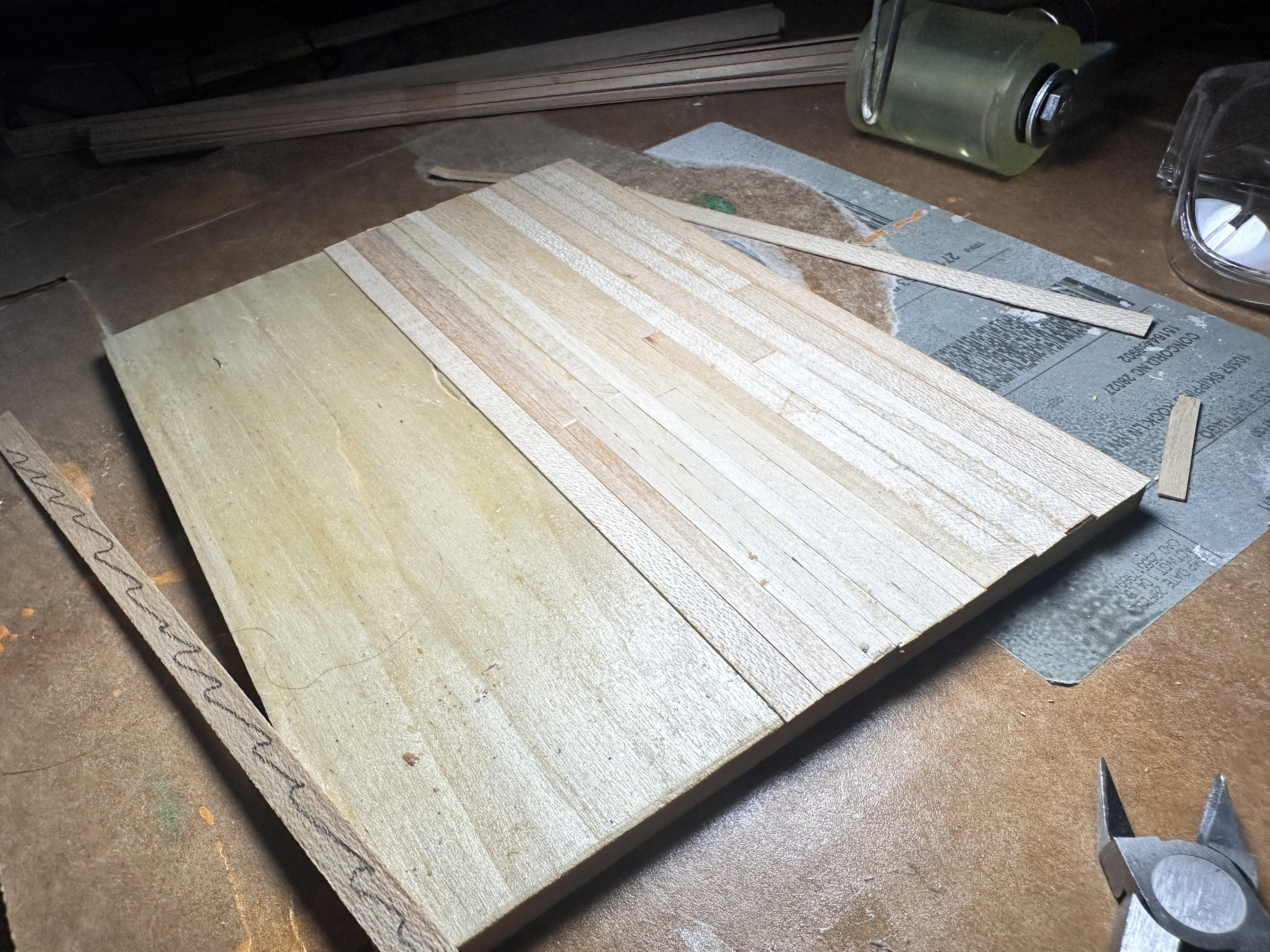

  Some contact cements may not pass "the test of time", depending on the right amount being used with the right procedures (e.g., temperature, humidity, film layer thickness on each surface, correct partial cure before assembly, assembly technique, the absence of air bubbles, clamping pressure, time under pressure, etc,) ...  While there are many examples of professionally produced laminated products lasting at least 50 years or more without delamination, there are also examples where cheaper products have failed - like in the 'builder grade' countertop in our kitchen that started failing 15 years after installation (we were the 3rd owners who bought the house 13 years after construction).  We lived with it until we could afford to have the kitchen remodeled 10 years later, and wisely chose fused quartz counter tops.

I see this comment from time to time.   Contact cement is used for laminate countertops, and I have lived in houses with 50 year old countertops that show no sign of the glue letting go.
it does have very specific applications and certainly isn’t useful for most modeling applications.   If you have 100% surface contact, especially when one layer is as thin as Occre’s second layer of planking or two flat surfaces like decking on a plywood base, I think it is an good product to use.
You do need to use it properly.   Apply it to both pieces and wait for it to dry to a point of being slightly tacky when you touch it.  When the two tacky pieces make contact you get a very strong bond.
On most contact cements it is written that the amount pressure applied is important, not its duration. This is why cobblers hammer down soles etc. and C-clamps are used. Both are not so good propositions on a delicate model ship's hull ...

I use a round wooden handle from a pin pusher.  I am not positive, but I think for laminate countertops tops a roller would be used, but no clamps that I am aware of.   I can’t speak to what cobblers do, no knowledge on that subject.

If working with thicker planking, I would use PVA and a little CA glue. But, there is very little hold necessary for veneer planking. It's not like a countertop or shoe that has to stand up to decades of abuse. Never seen contact cement bond fail. But, that's just me.
