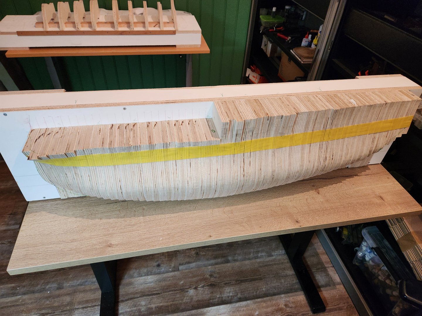

Hi,
its a very interesting, and i find it also a easy way of making my hull contours. It was a little bit of a struggle at first to discover how everything was done with the drawing part but after some small tests i think i am on the right track now😄
If there is some interest i can make a "how to" build log from the beginning. The drawing part is the most difficult part i think to understand. I am to far now and didn't make more pictures than these, but if i order some new drawings in the nearby future i can create a small part of a hull from start to finish.
Just let me now, then i collect how much interest there is.😉

today i started with making my building-boards.
20210220_204824.thumb.jpg.af763ef78a70ae82affcea9660ed2c90.jpg 20210220_204828.thumb.jpg.d85f83927bb7c884b0d23df8f3d22d4d.jpg
After the drawing part i made two corresponding long "ribs", Those are the backbone of the ship and hopefully they hold my ship straight and square🤞😁
Also i made a false keel to mount everything straight and i made it 2,5 mm thick (half keel minus rabbit).
20210221_164653.thumb.jpg.d8efffe37513b07c3f16a11d04aacfbe.jpg 20210221_164705.thumb.jpg.8e5983e0231b86049e18da36474c8e33.jpg
After that i start mounting every 5 or 6th rib, i glued them in place and those are my markers, i'll fit the rest between those. Those i will not glue at first, but later when all the sanding is done.....you'll see when i am on that point in the future.

Great so far. I'm thinking of using Dr Mikes method or similar on my next project too. I guess you lofted the frames yourself from the plans ? That's one part I hope to avoid. One thing though. I think you want the grain running vertically not horizontally. ?
