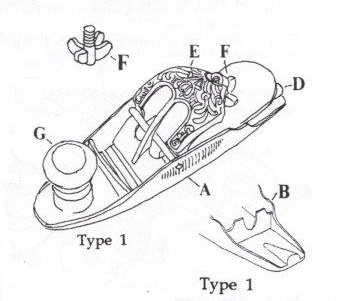

This site http://thevalleywoodworker.blogspot.com/2017/03/the-commun-stanley-no-120-block-planes.html suggests you may be right Bob:
Type 1 No 110 Late 1874 to mid 1875
The earliest model of the Stanley No 110 was designed by Justus Traut and is covered by US patent No 159,865 issued on Feb 16, 1875.
A - Boat shaped body wide sides thickened at the top edge and textured with raised vertical ribs, for better finger grip
B - Cross rib cutter support
Type 1 cross rib in the back.
C - Raised cylindrical receiver for front knob
D - Long raised lug at heel of plane (that would be the nib left over from the sprue casting)
E - Shoe buckle lever cap
That fragile shoe buckle was captive on the plane bed
by a metal rod running over each ends and under center arch.
Metal rod is screw in from the sidewall of the bed
F - Steel or brass lever cap locking screw has four spoke
G - Fruitwood front knob (Apple) has cylindrical tenon that fits into cast receiver on plane bed
