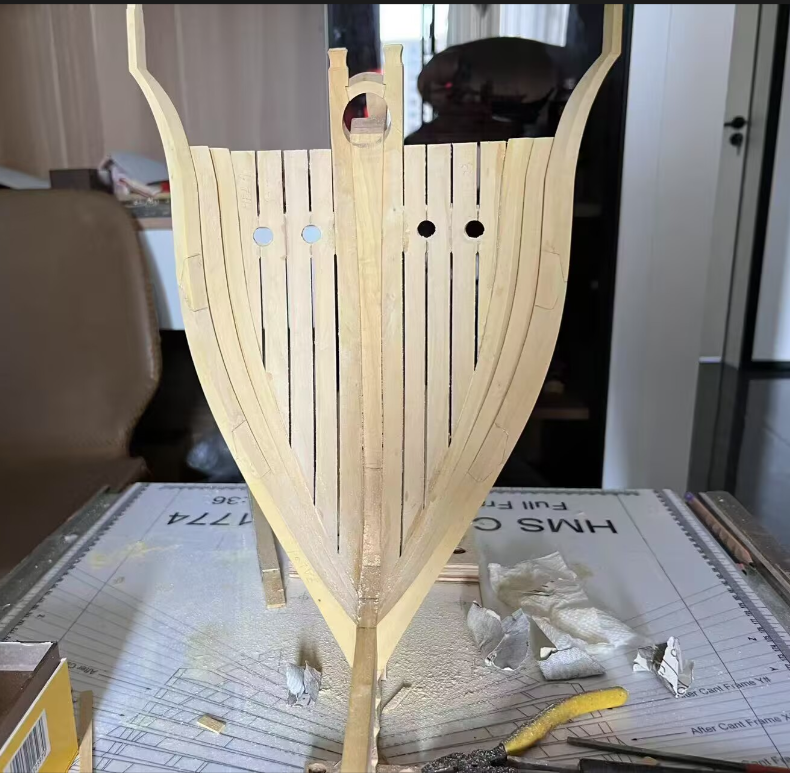

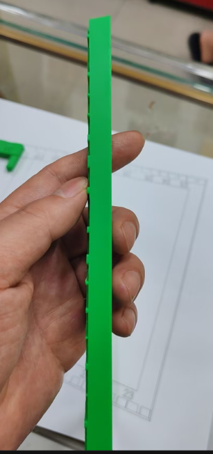

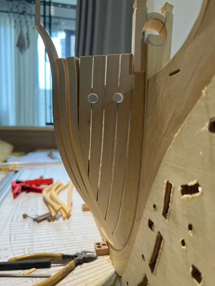

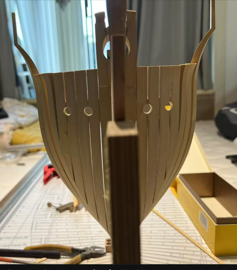

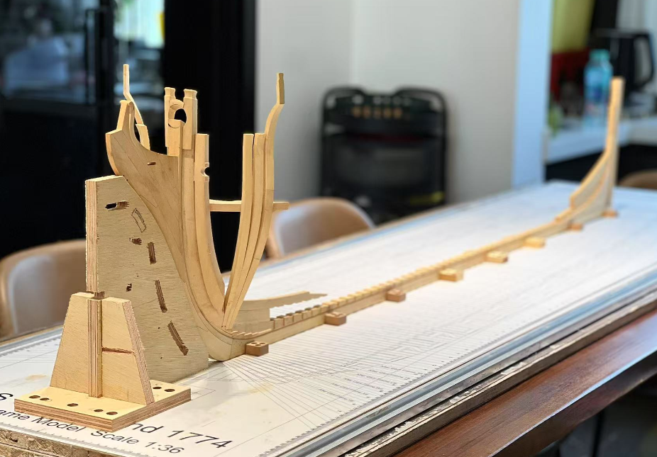

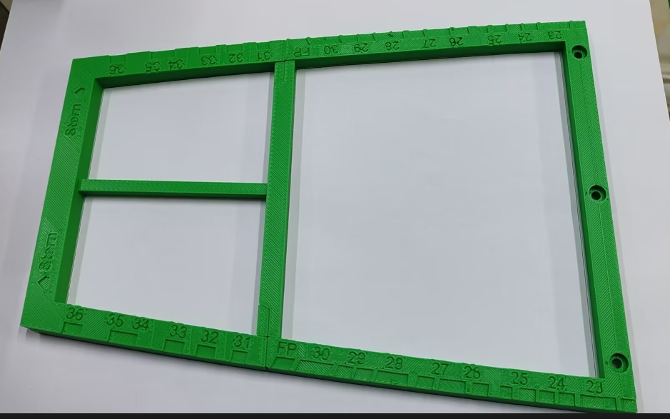

Maybe I'm processing 1:36 and 1:48 pear wood and boxwood parts at the same time, so it seems a bit messy,but I'll mark the scale of prototype. 1: 36 is a customized model, I can only verify the 1:48 version of pear wood and boxwood myself. Pear wood will be the basic version. I should release the parts of the basic version immediately. As mentioned earlier, the basic version is equivalent to the parts of laser cutting. The difference is that the laser has black carbon , but the CNC has no black carbon . Because the thickness of the laser cutting board will not be too thick, the kit scale for laser cutting is generally small, such as 1:72 or 64.
The first chapter parts (1:36)will be sent out soon, and then I will process 1:48 parts of pear  and boxwood, you will see the material and color of pear wood more intuitively.

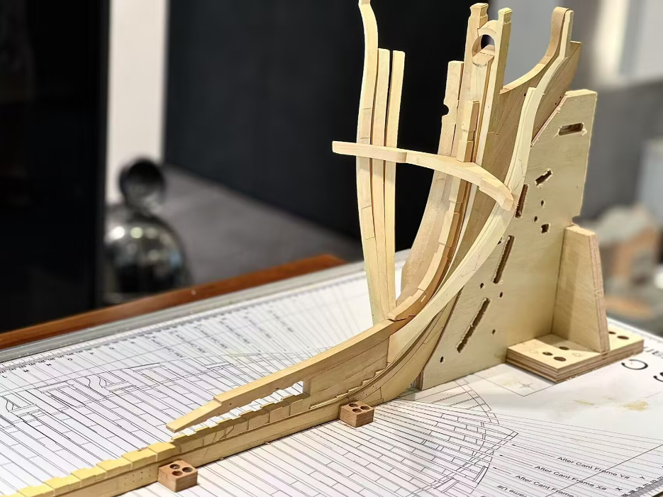

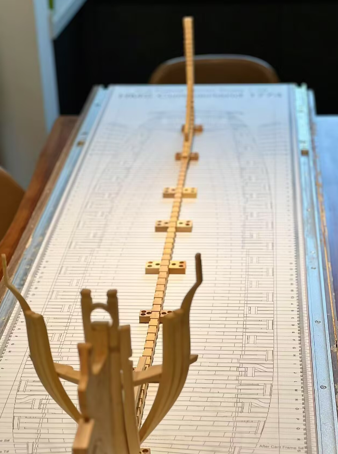

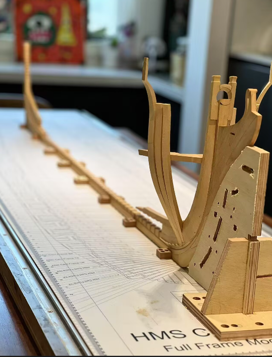

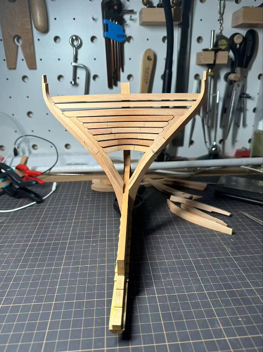

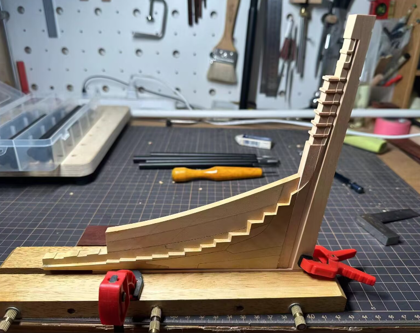

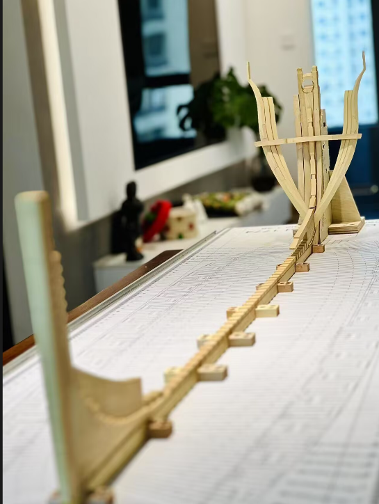

And then I went on to process the 1:48 parts, and I started to make this model in a real sense, I want to show you my idea, that is, how to simplify a complex POF model into several large parts by machine and hands, so that modelers with common skills and no professional tools can make this complex model.

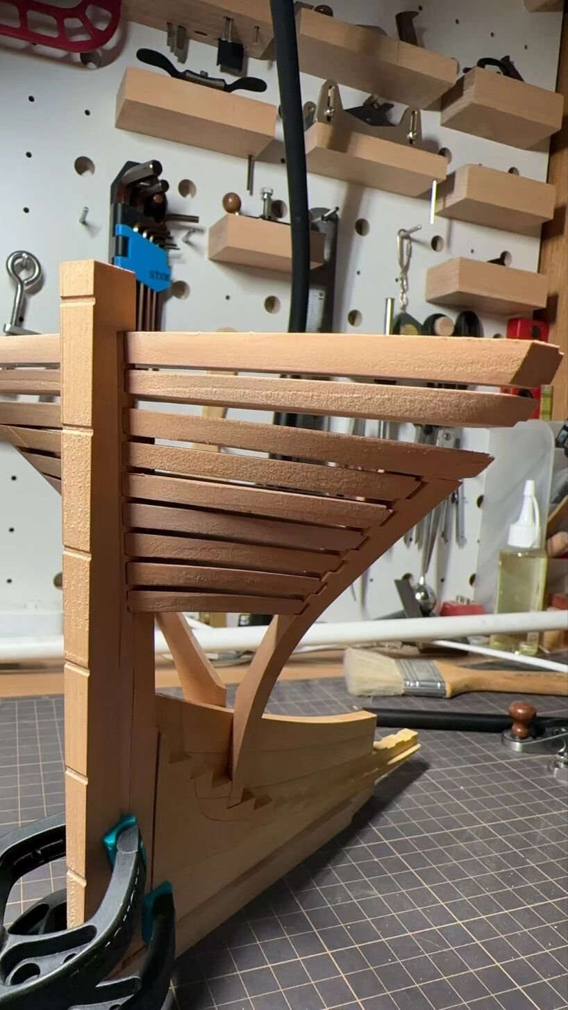

This is the first step. Let's take a look at the basic parts of pear wood and the pre assembled parts of jujube wood on the right.I will process a set of Asian boxwood samples at the same time.Maybe you are tired of looking at those model parts all the time. Indeed, I am too busy. I have to go to work during the day, and then design and process the ship model in my spare time. Maybe I only have a few hours of spare time every day. However, my classmate's processing factory can process these parts in batch ,I insist on testing these parts myself in the hope of finding more mistakes and modifying them.
On the left is Chinese pear wood, and on the right is jujube wood. Asian boxwood and jujube wood look similar, but undoubtedly boxwood is the best, more delicate than pear wood, and has good color. In the future, I will release about 3-10 full boxwood kits, if anyone likes them.
