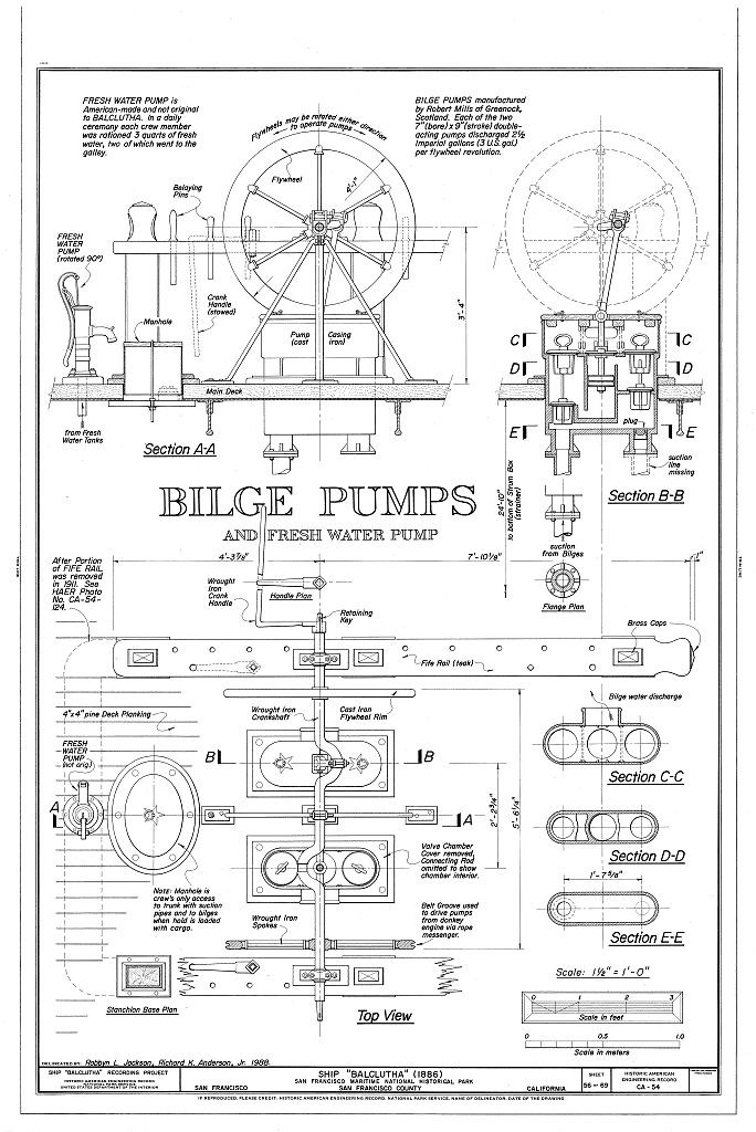

Great job Vlad...but before you glue that pump down, correct the flywheel's location ....  They are not on the inside of the rail, but the outside.
How do you suspect a human is suppose to hold the handle on the pump and rotate it with it on the inside of the fife rail?
People always seam to get this wrong.
Rob
Rob
Crew_of_the_ship_GLORY_OF_THE_SEAS_with_fish_catch_on_deck,_Alaska,_August_19,_1911_(COBB_207).jpg
Thank you Rob. oh ok, :) I relied on Michael Mjelde drawing in book. I will move it out sure. always better to compare photos with pics thanks V.
Vladimir, beautiful work on the Mainmast fire rail and bilge pump. The sole concern that I have is the gaps on your 2 pump flywheels. I've attached a link to the Baclutha website with specific focus on her Bilge pump. While Rob's correct that Glory's pump wheels mount outside the rail, Balclutha's mount inside. There are handles which attach to the wrought iron crankshaft, which similar to how an old Model T Ford's engine would be turned over is how the flywheel crankshaft would be turned over. 00056v.jpg?maxwidth=1200&maxheight=1200&bilge_pump_birds_eye_688px.jpg?maxwidth=00056v.jpg?maxwidth=1200&maxheight=1200&

Rob, Vladimir while looking for more images of Glory's bilge pump, I came across Michael Mjelde's deck plan illustration. It's also inaccurate as it shows the flywheels inside the main fire rail, while photos clearly show they were mounted outside. This is a somewhat poignant article and indicates her final resting place as well. Scroll through the images and you'll also see a magazine excerpt showing her beautiful figurehead described as being 90" tall.
39 minutes ago, ClipperFan said:
https://www.google.com/amp/s/batgurrl.net/2021/07/03/demise-of-a-clipper-ship-on-endolyne-beach/amp/
Thanks for comment and  fine images Rich, i see those cylinder are a bit different but im glad i depicted overall shape and function. I dont have tools working skills and capacity to go with tremendous details at his scale to make it aby different i Guess. I need to have run doing IT and i had fun thats good enough fór me. :)
