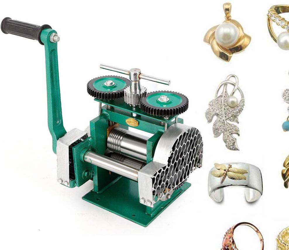

I am considering purchasing this bending machine to use for bending brass tubes and also for wooden plank bending. Does anyone have experience of this please, good or negative, appreciated. I do use the Amati Electric Plank bender also with fair success.
Non of the main Hobby Tool Suppliers in Australia appear to offer this so I shall need to buy direct which just takes longer.
Michael Pearce in tropical North Queensland

I have no experience owning or using this tool but my professional career involved fabrication of industrial piping systems and that included bending.
When a hollow tube is bent, it becomes oval in the Bend arc.  This ovality increases as the bend becomes more “difficult” Od/t/R.
OD= Outside Diameter of tube
t= Wall thickness of tube
R= bend diameter expressed as No of pipe diameters
Pipe bends made without ID mandrels or other special techniques are usually limited to 5XOD or larger radius, and American piping codes allow ovality up to 8% of OD.
So, If the flexible tube- the bending die, fits snugly over the tube to be bent ovality during bending will jam the bent tube in the bending die preventing extraction.  If on the other hand there is initially a gap between the tube and the bending die the die is not preventing the tube from going oval.  I don’t see how those tubes provide any advantage over bending the tube around a homemade die, a curved piece of wood or other round object.
Roger
Personally I see no use in these bending wood strips. Side bending, wet bending and steam bending would all be preferred by me.

This is called a slip roller or rolling mill.  The MicroMark item looks pretty cheaply made from aluminum.  For a few dollars more you can buy one on amazon that will be much stronger and produce better results.  Some of them have rollers that can be changed for use with different size tubes.  One thing to think about is that the rollers will flatten wood strips to some extent.
one example https://www.amazon.com/Rolling-Machine-Combination-Jewelry-Tabletting/dp/B07G7ZCCSZ/ref=pd_di_sccai_6/143-4564824-7564258?pd_rd_w=ORekI&pf_rd_p=c9443270-b914-4430-a90b-72e3e7e784e0&pf_rd_r=DVFFA5K61C6HG1PNPCA5&pd_rd_r=1679c72e-430e-4e18-8f4c-0b448bac5f51&pd_rd_wg=t3d30&pd_rd_i=B07G7ZCCSZ&psc=1

Check out 81356 on micro ark. It won’t bend tubing but I’ve used it to bend planks very successfully...Moab
