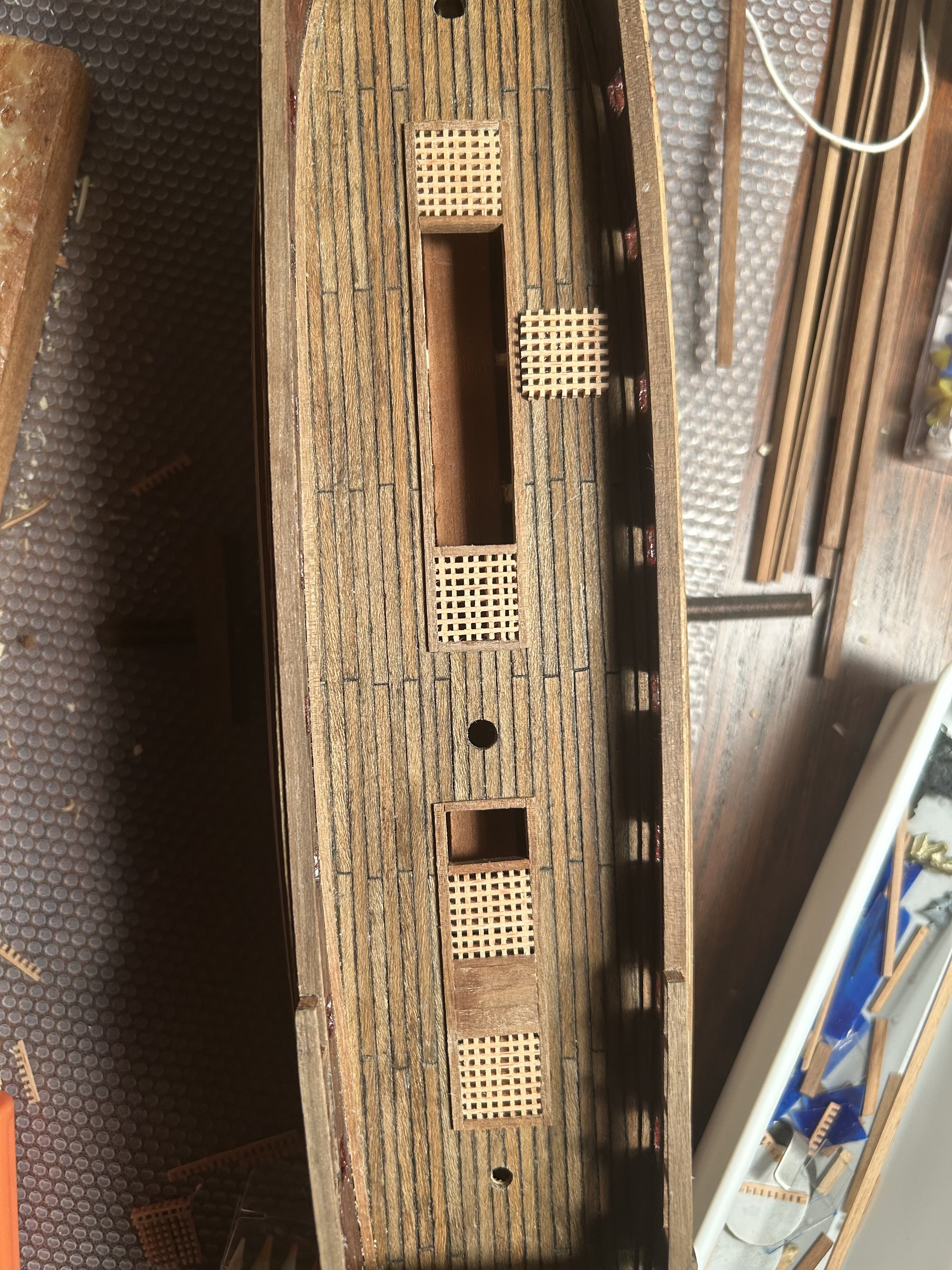

These last few steps have been so finnicky and small that they have hardly felt worth photographing. For the stair to the poop deck, I measured and cut a set of stairs, glued the ladder together seperately, then glued it in. I've left some stairs measured to its length over so that all the ladders can be the same consistent size.IMG_0550.thumb.jpeg.181e1fe3f2b9a0b02d2dba17b28bc428.jpeg

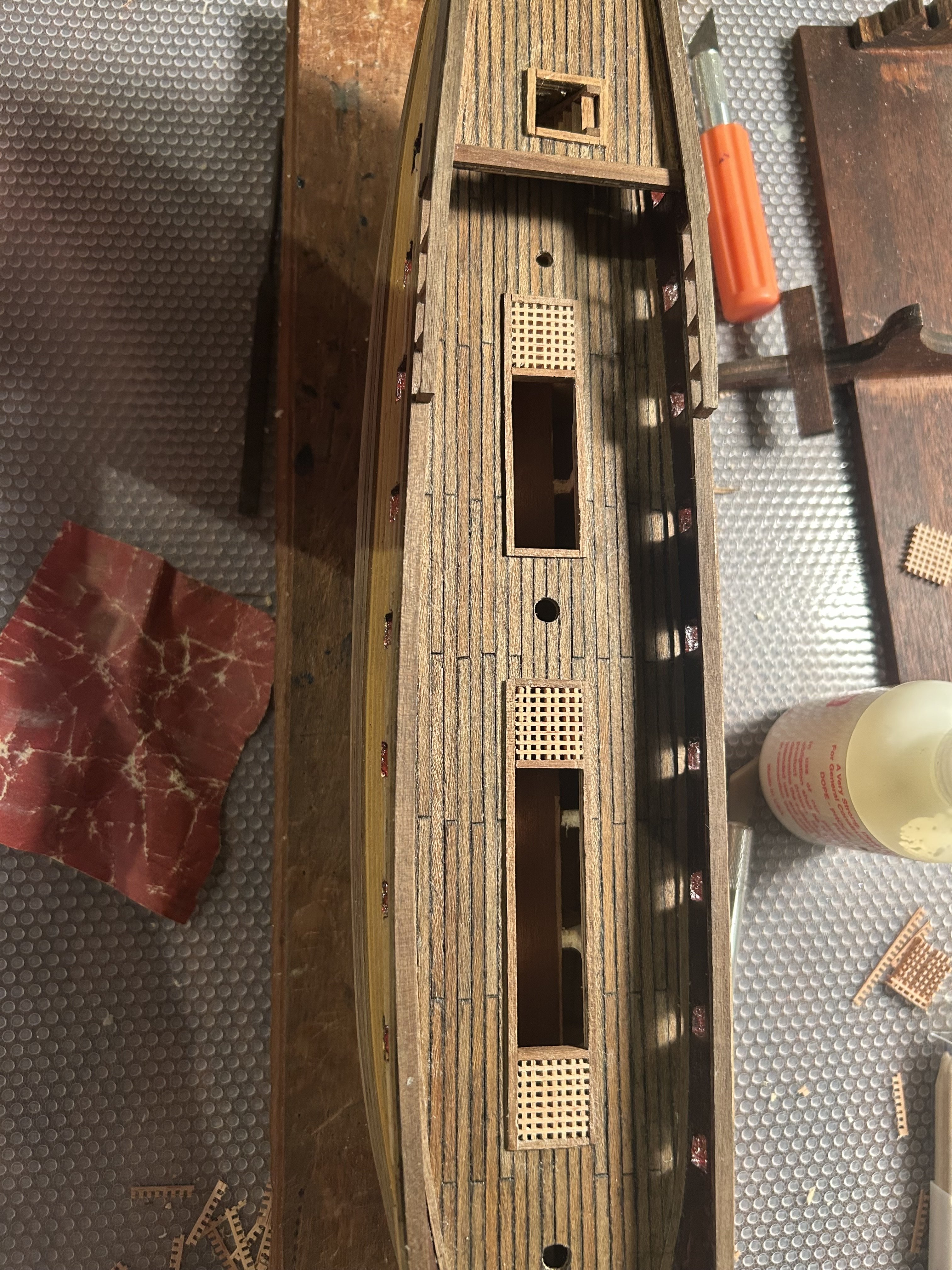

For the gratings, I glued and assembled them, then sanded them with 800 grain sandpaper until they were smooth. So far, I've attached three. I've been framing them with leftover 2x4mm wood. I have a lot of it.
Each time, I sand the gratings on the left and right sides with about 20 strokes, then check if they fit. By "fit," I mean "can be just barely jammed in without making me afraid they will break."
If not, I repeat the process.

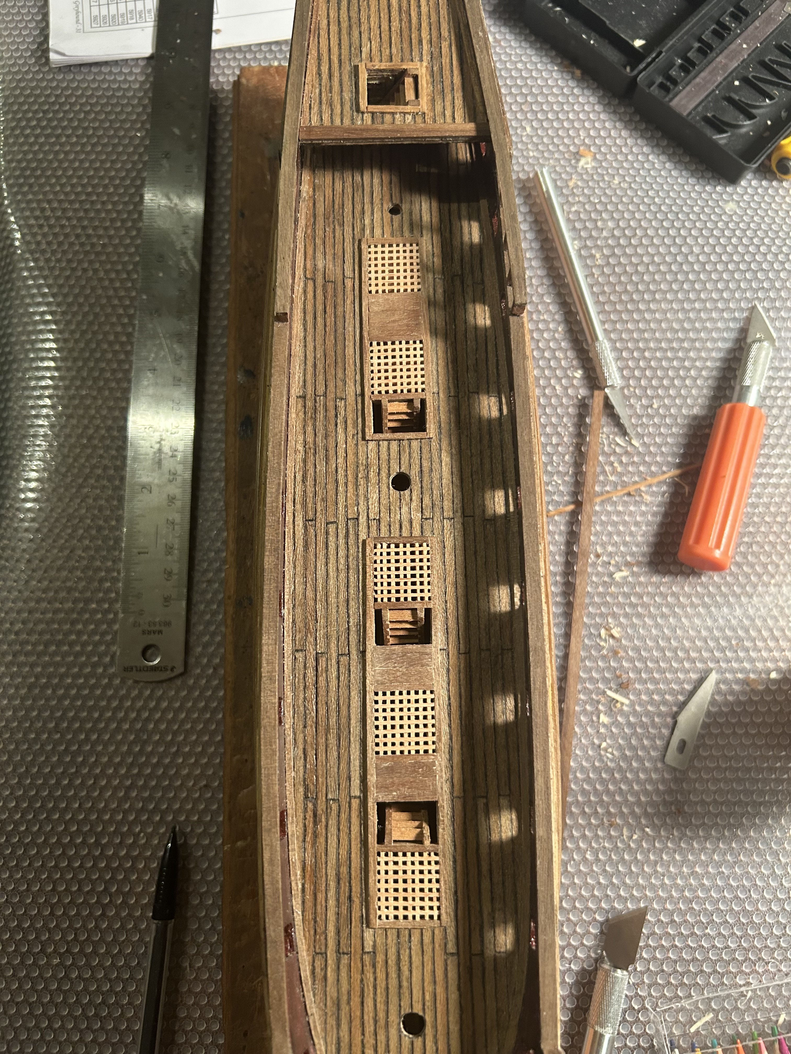

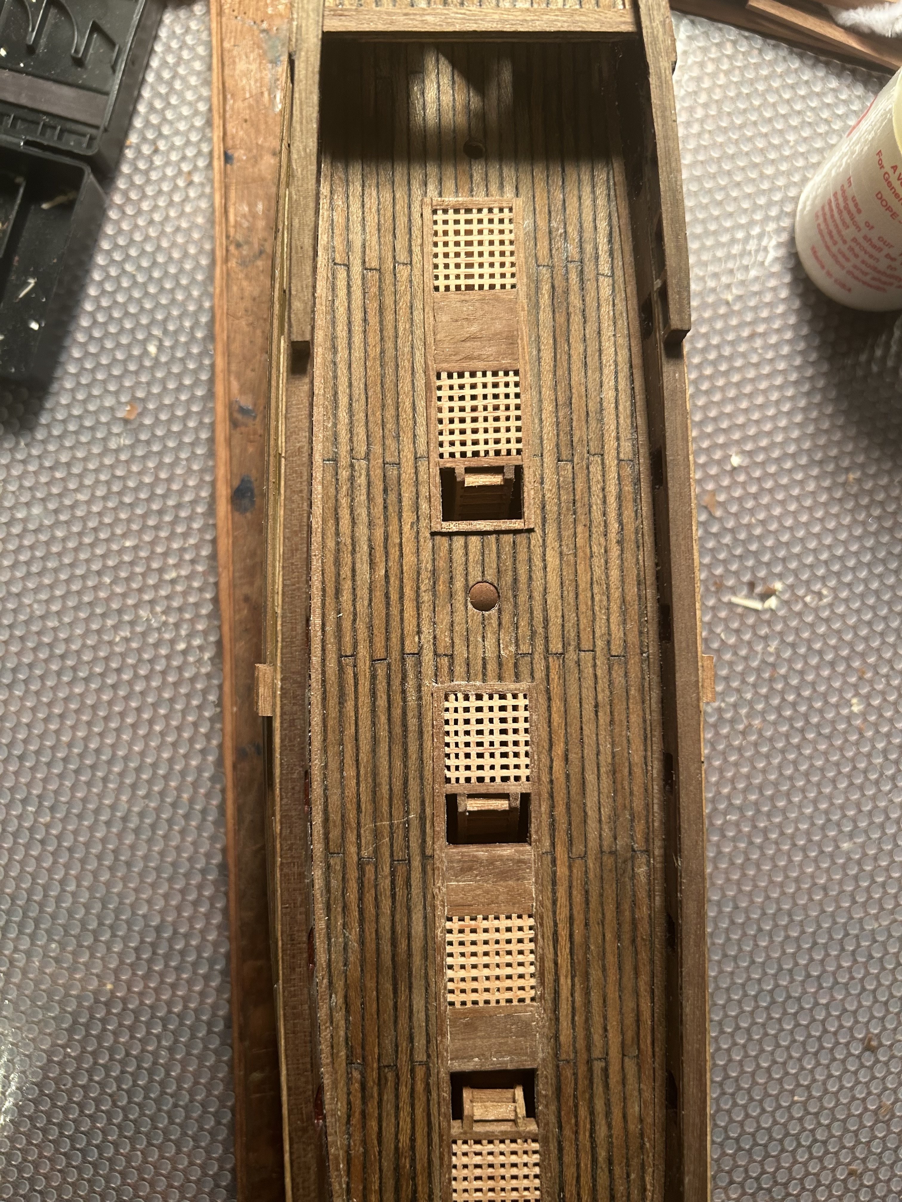

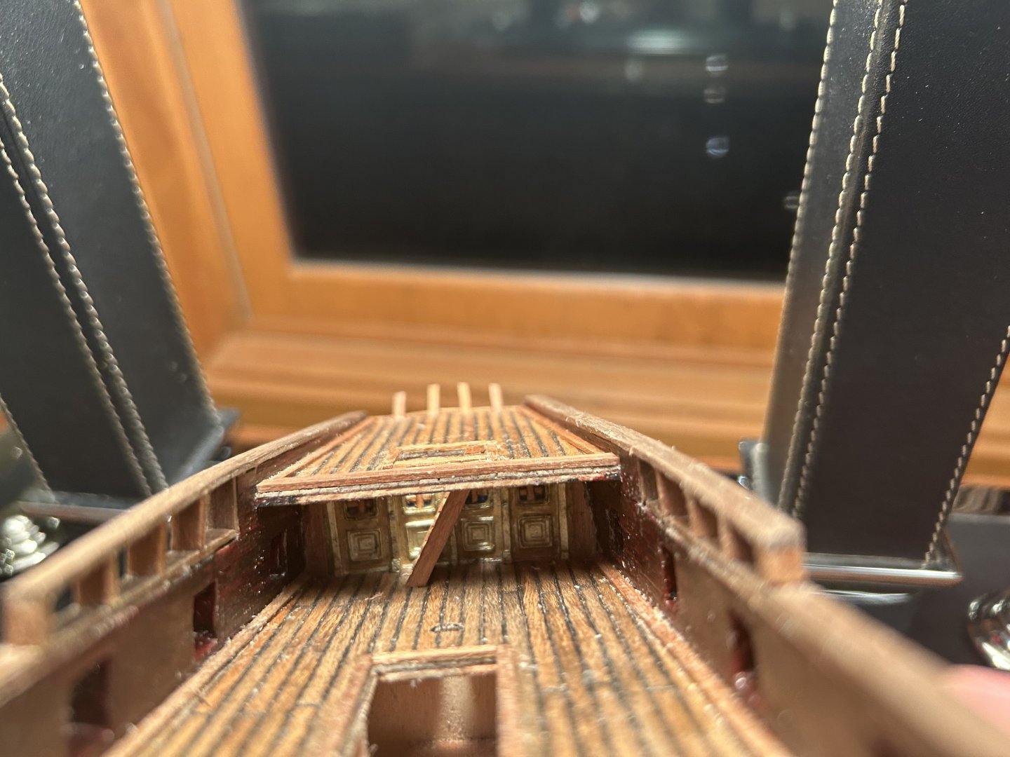

This step is fairly self-explanatory.
I put the ladders, final gratings, and planks around the gratings on.
It's probably pretty obvious that as much as possible, I put the ladders in first. Then I cut them to be relatively flush to the deck. This step was difficult, and I had to make a correction with glue at one point. But overall, it went well.
Finally, I put on the gratings.
When I was done, I sanded the gratings, planks, and ladders until they were level with each other.
Here's a picture.

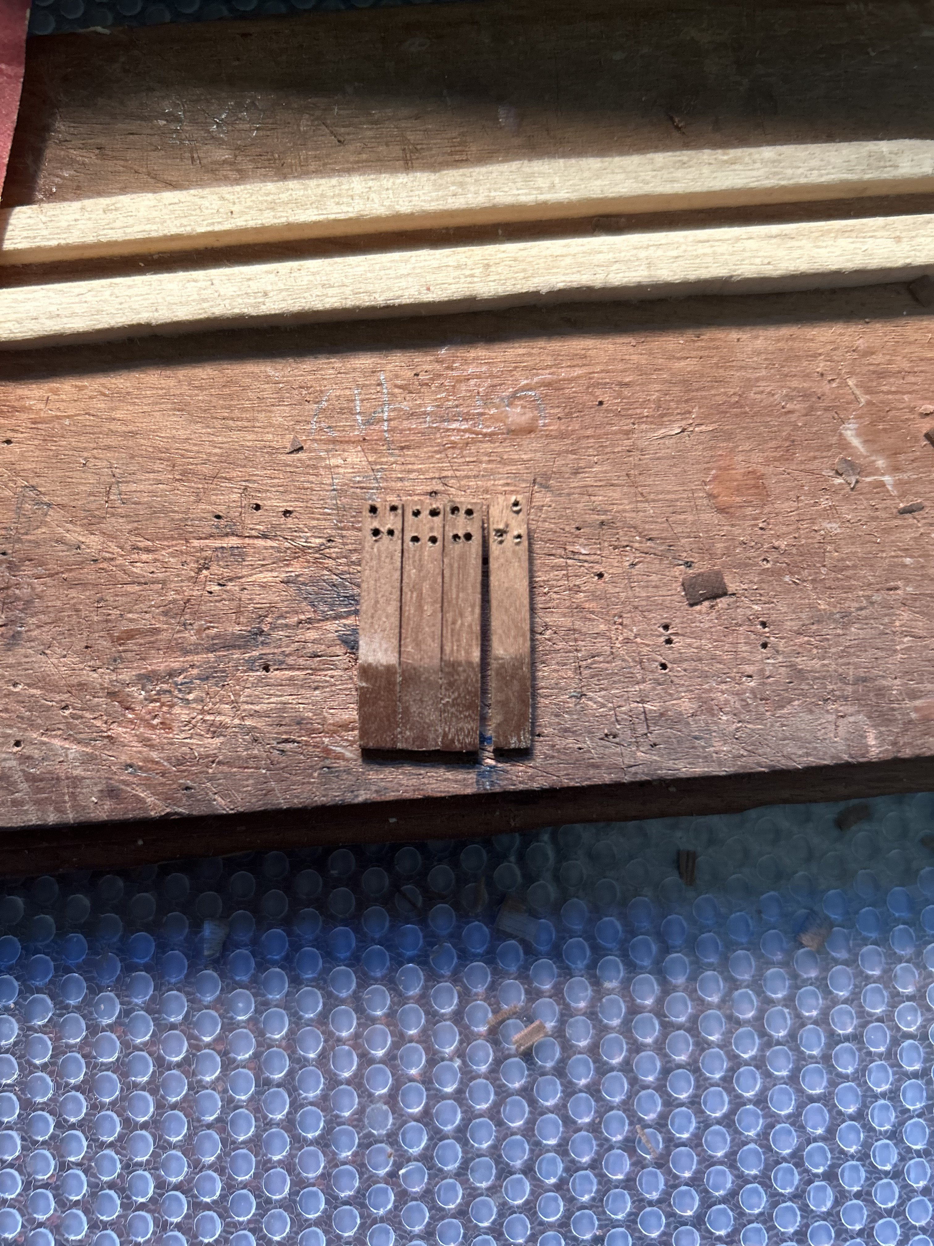

The clown show continues. I decided I might as well get the rudder done tonight so I can be certain that all the stern pieces I plan to use are safe to build with and not reserved for some other, more important role later.
It turns out the rudder directions are total nonsense. The 1-to-1 scale pieces are nowhere near 1-to-1. The kit calls for a 4x4mm piece when the three is the only one that fits. And to top it off, one of the hinges is broken.

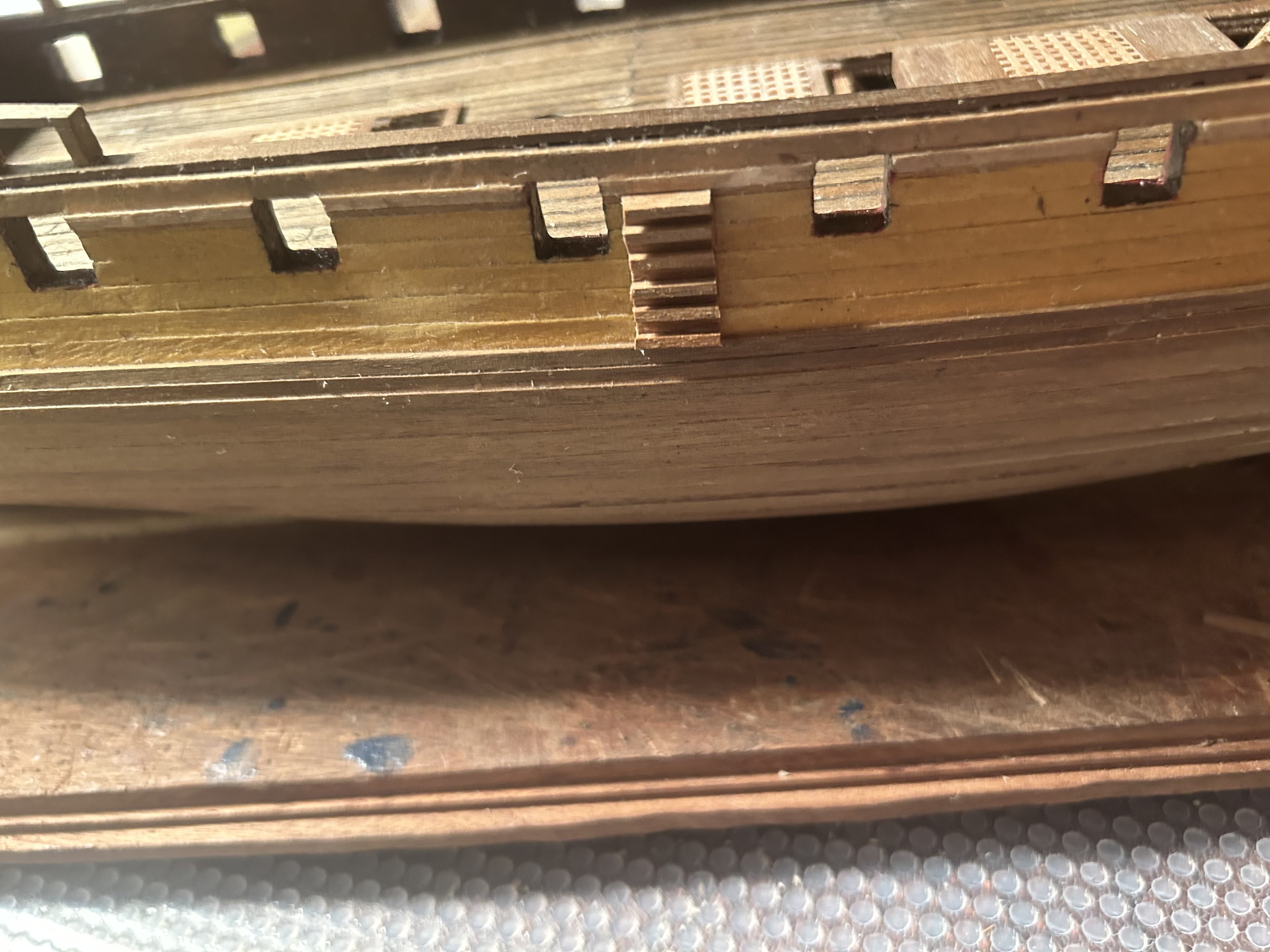

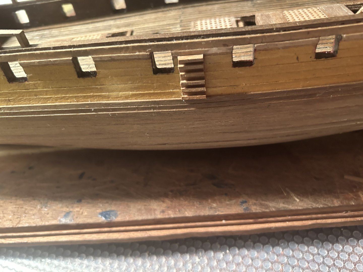

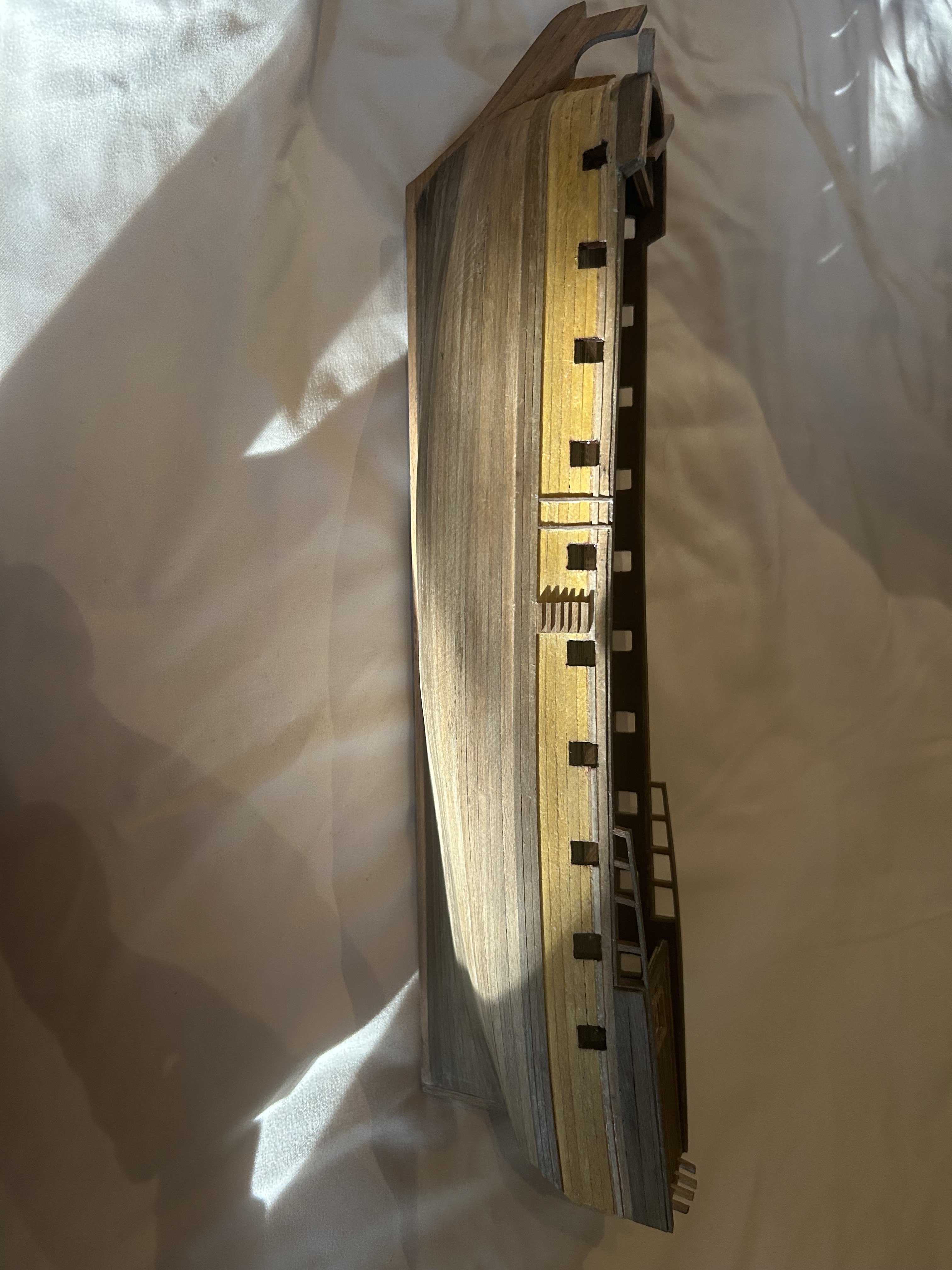

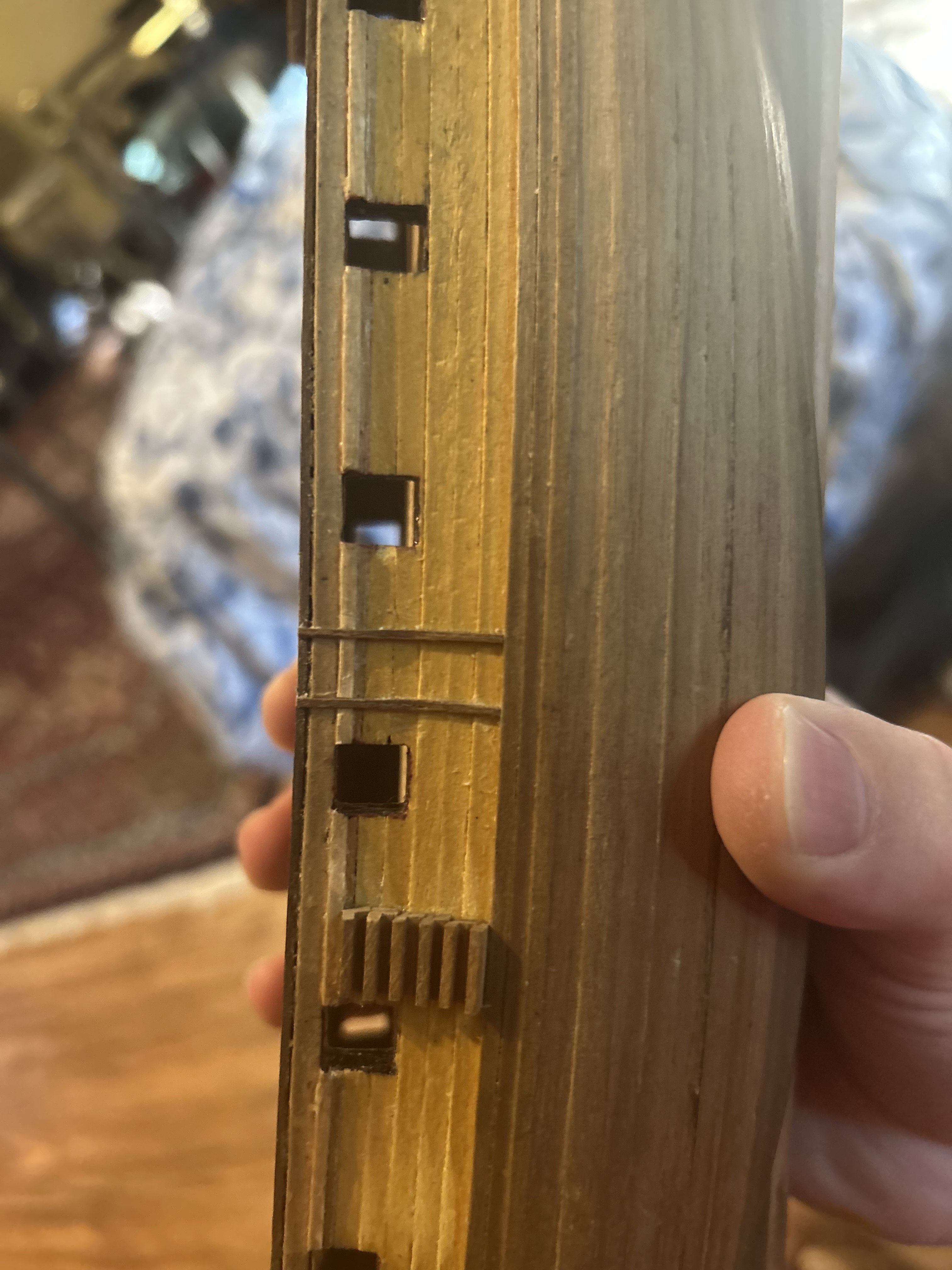

I've attached the side ladder. It's pretty much exactly what it looks like. L-shaped wood pieces glued to the side.,
After I smoothed the side with a little knifework and sandpaper, it went on fairly easily. I only had to bevel the L-shapes a couple times.IMG_0627.thumb.jpeg.6a772c5f1134788138f1f397e690ba19.jpeg

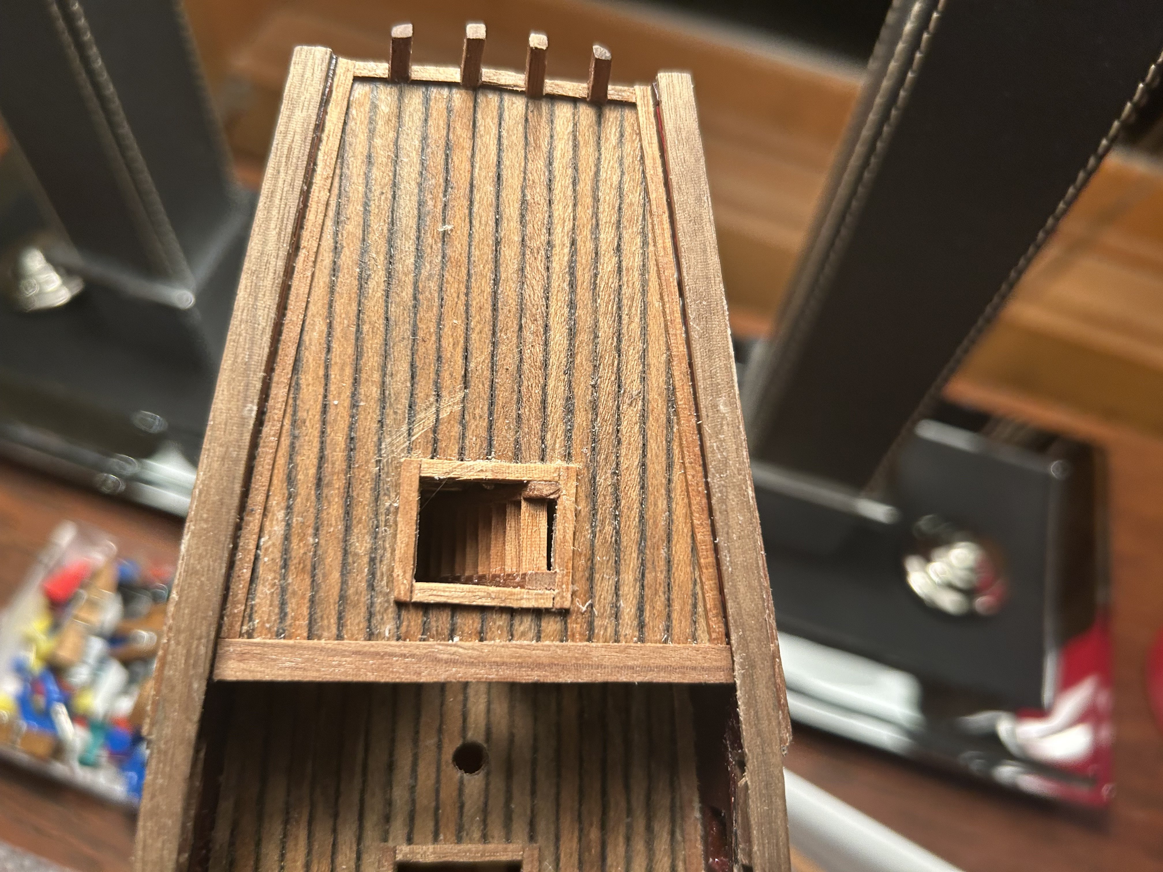

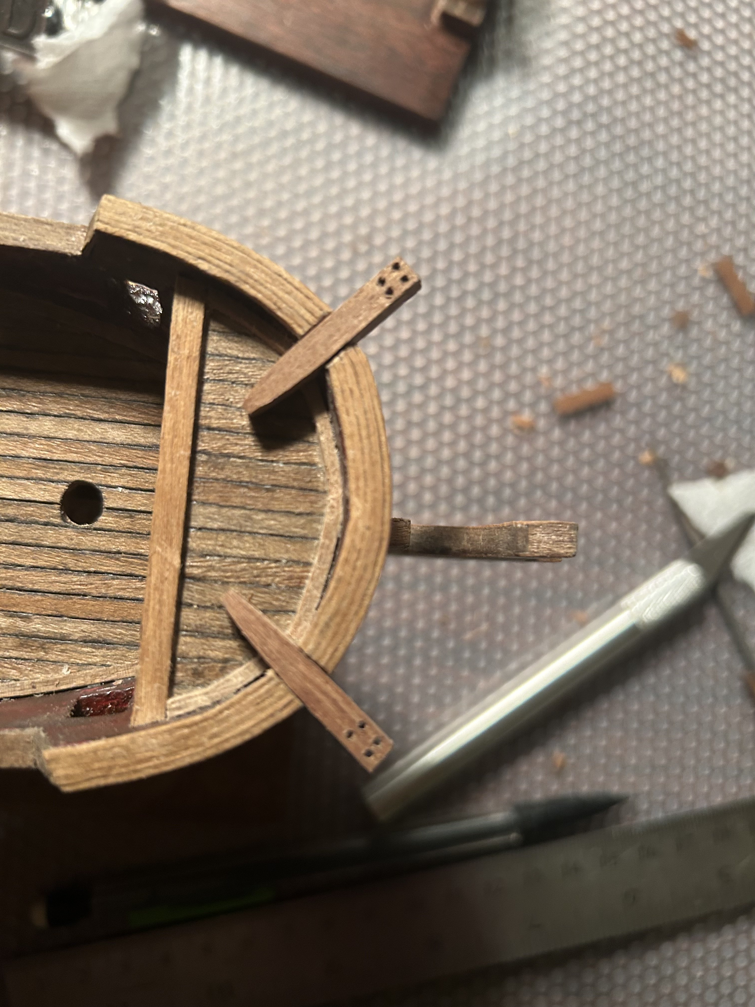

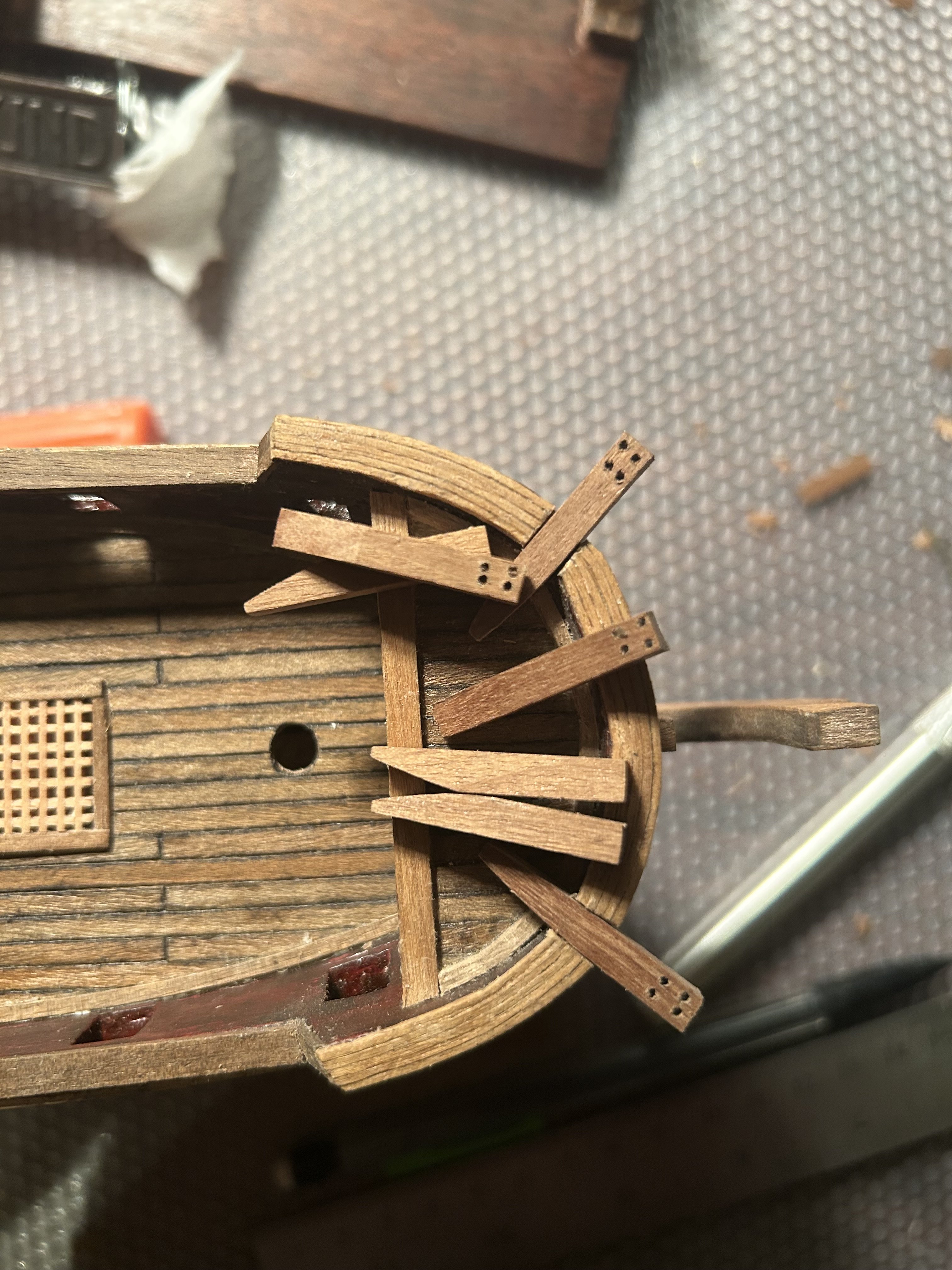

This morning, I finished the cathead beams.
No matter what the instructions say, the correct size for them should be 4mm by 4mm.

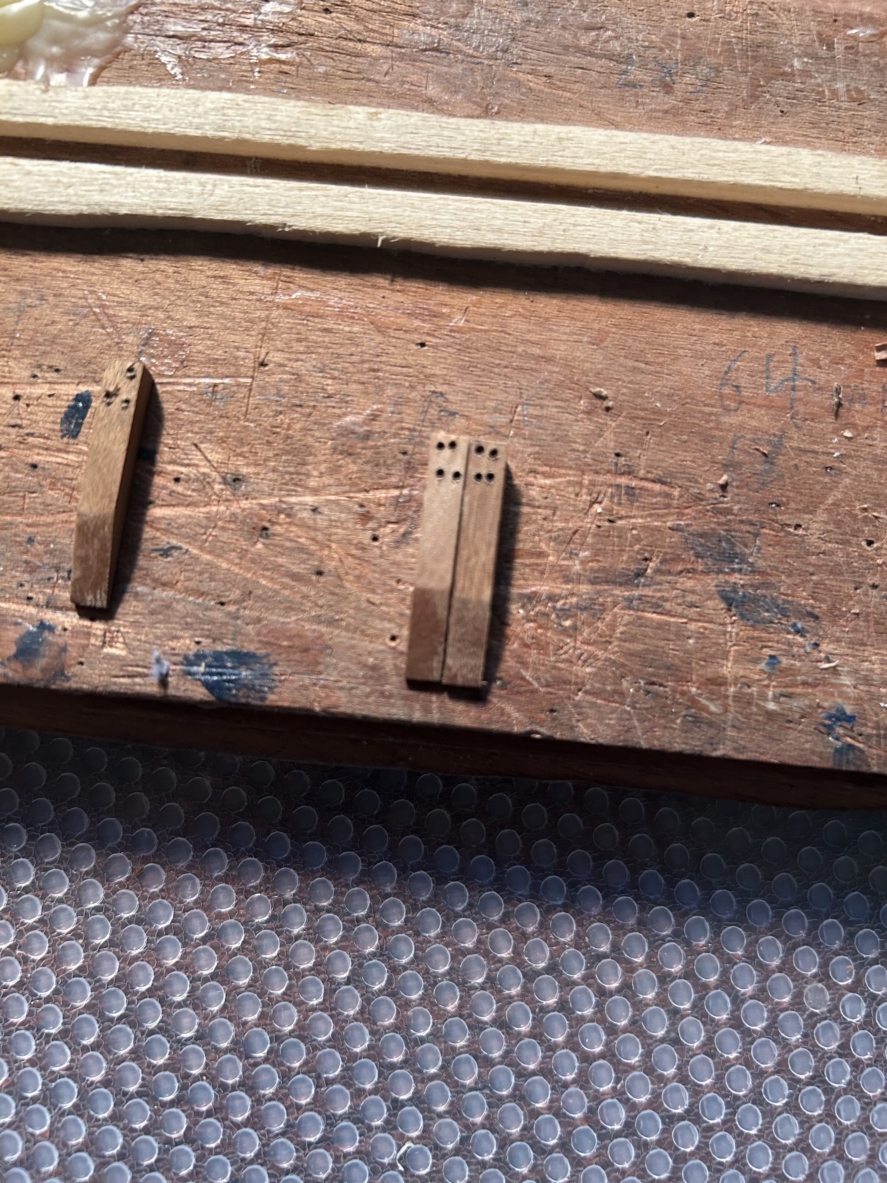

I looked ahead in the kit, so I knew I had to drill holes in them for some rope to pass through. This task would have been almost impossible if I had mounted them on the bow where they go first.
As it was, drilling the holes out took three pieces to do. They are quite good enough for my standards at this point, and I think if I tried four or five more times, I'd just have the holes slightly off in a different way. Drilling stuff is so finnicky.
Now all that remains is to cut out a slot for them and glue them on.
I discovered last night while installing the catheads that I had angled mine way too much, even if they did look roughly like the ones in the instructions.
Believing the instructions on this was simply a mistake.
After cutting out the slots in the bow for them, I had to make new catheads. Unlike the old ones, the new ones were vere slightly sanded to an angle.

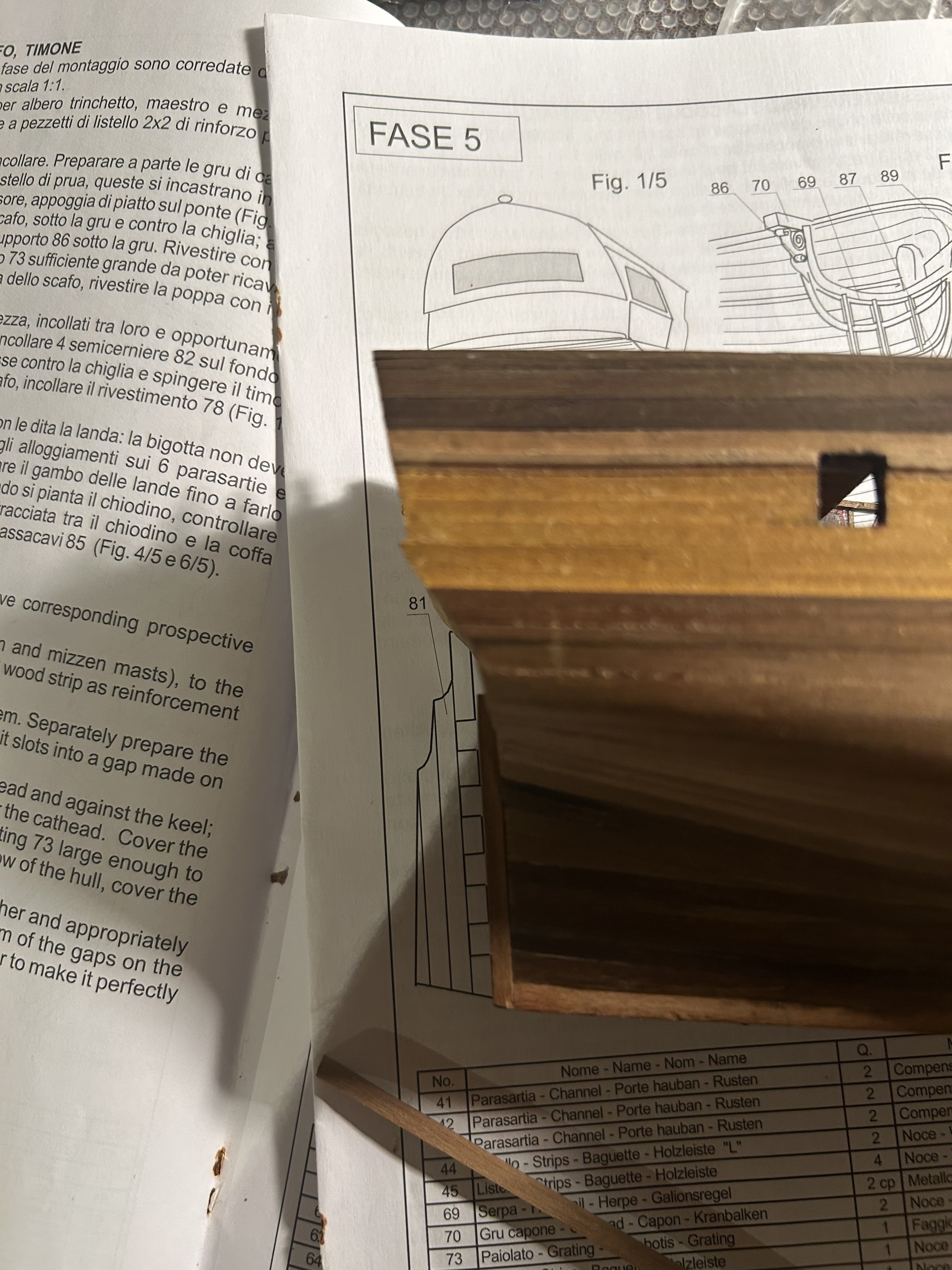

Cutting out the slots was relatively easy. After measuring and cutting with an X-Acto knife, I used a file to sand the final bit to shape. I was worried about the potential to cut the slots too wide, but I was careful, and it worked.
It's fortunate I had extra wood to make a full seven catheads. Here's the finished product.

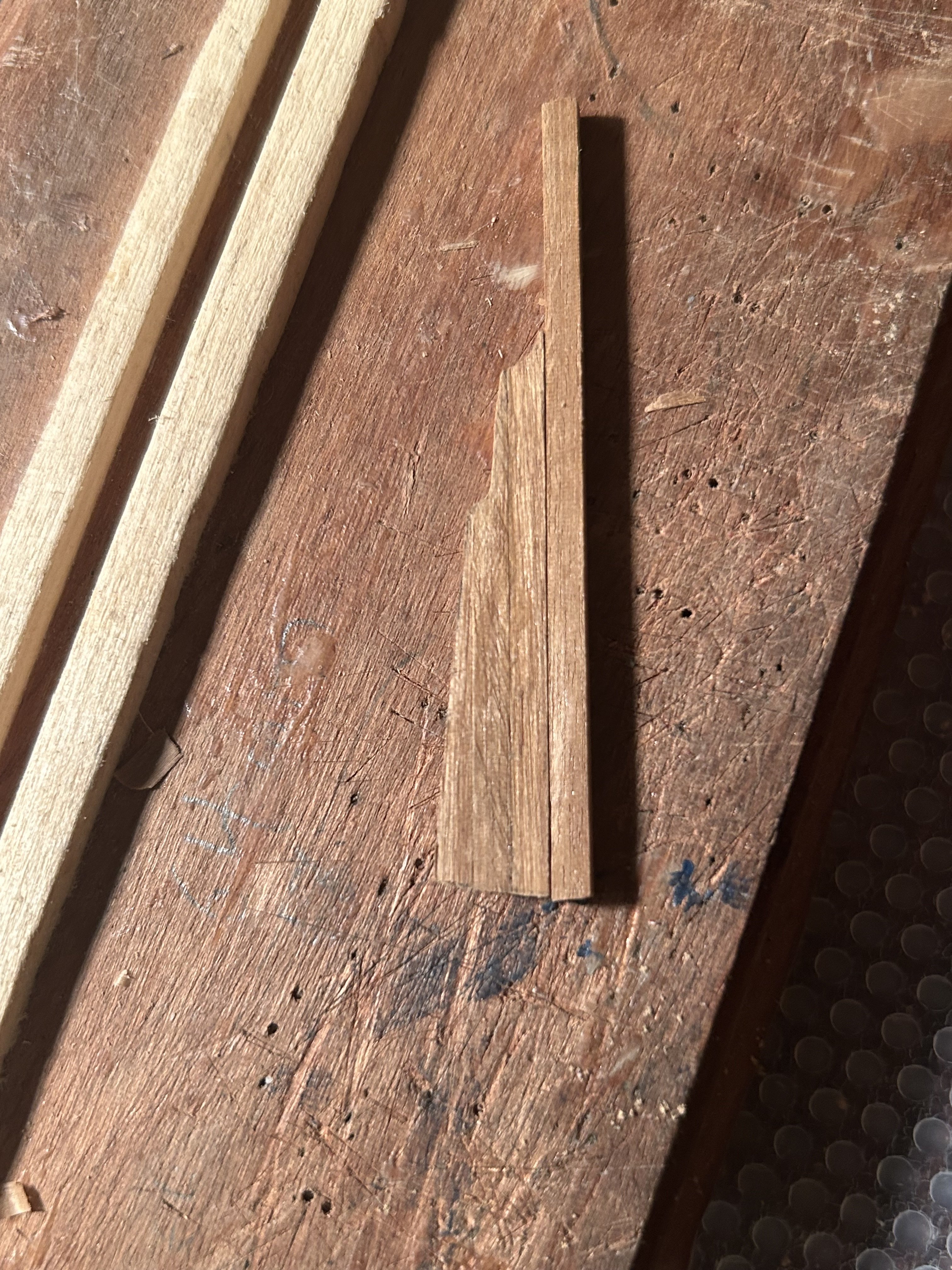

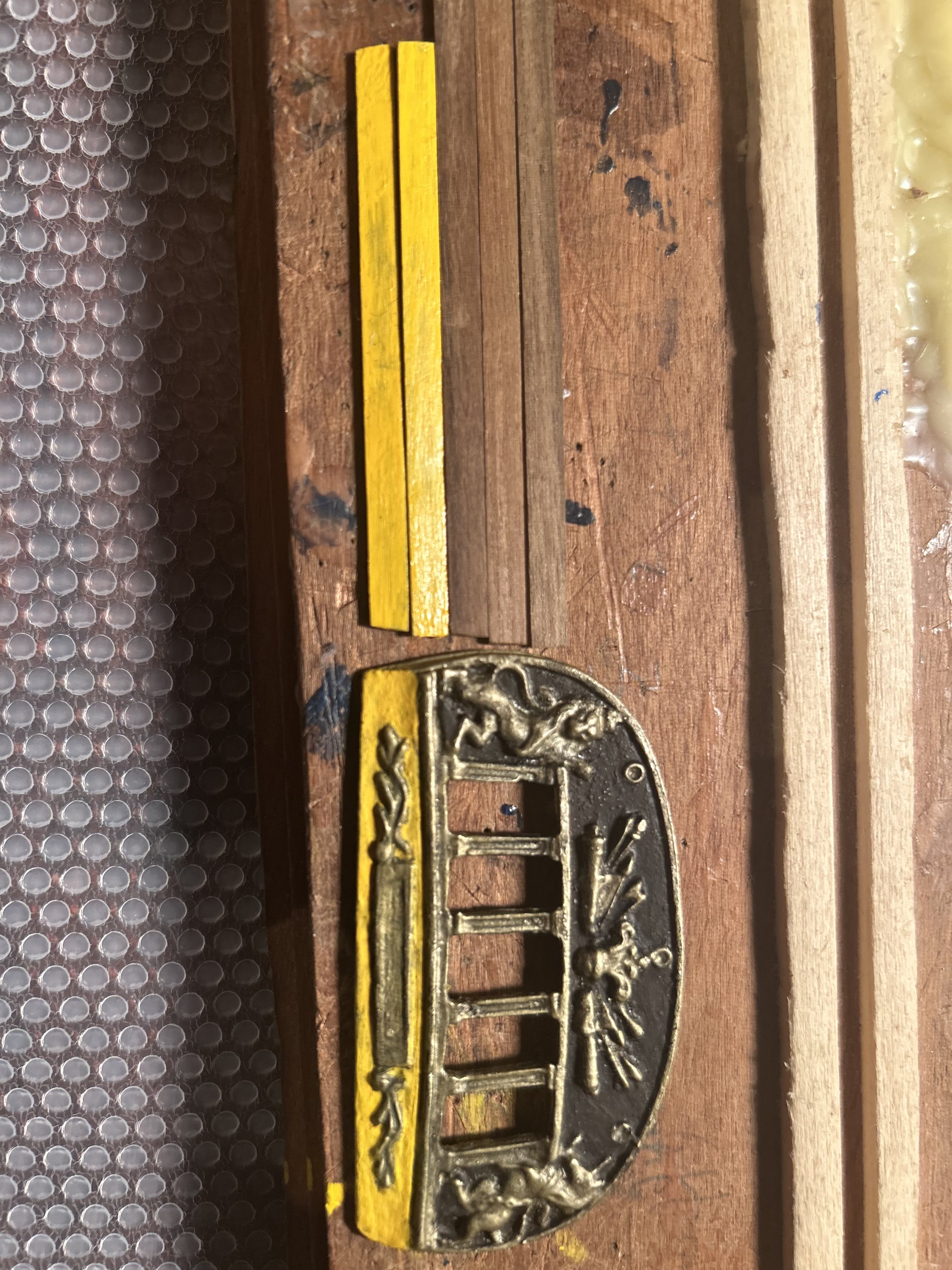

One of these humble 1mm by 4mm walnut planks began life as one of seven surplus 2mm by 4mm plank that Corel generously provided for reasons unknown, given that hardly any wood in the kit requires wood of these measurement.
At the same time, I need 1 mm by 4 mm walnut to build my own transom, given that the metal one Corel provided is slightly off in terms of shape.
Therefore, with the help of my patented X-Acto Knife and 400 grain sandpaper program, our patient lost half his body weight in under an hour! *

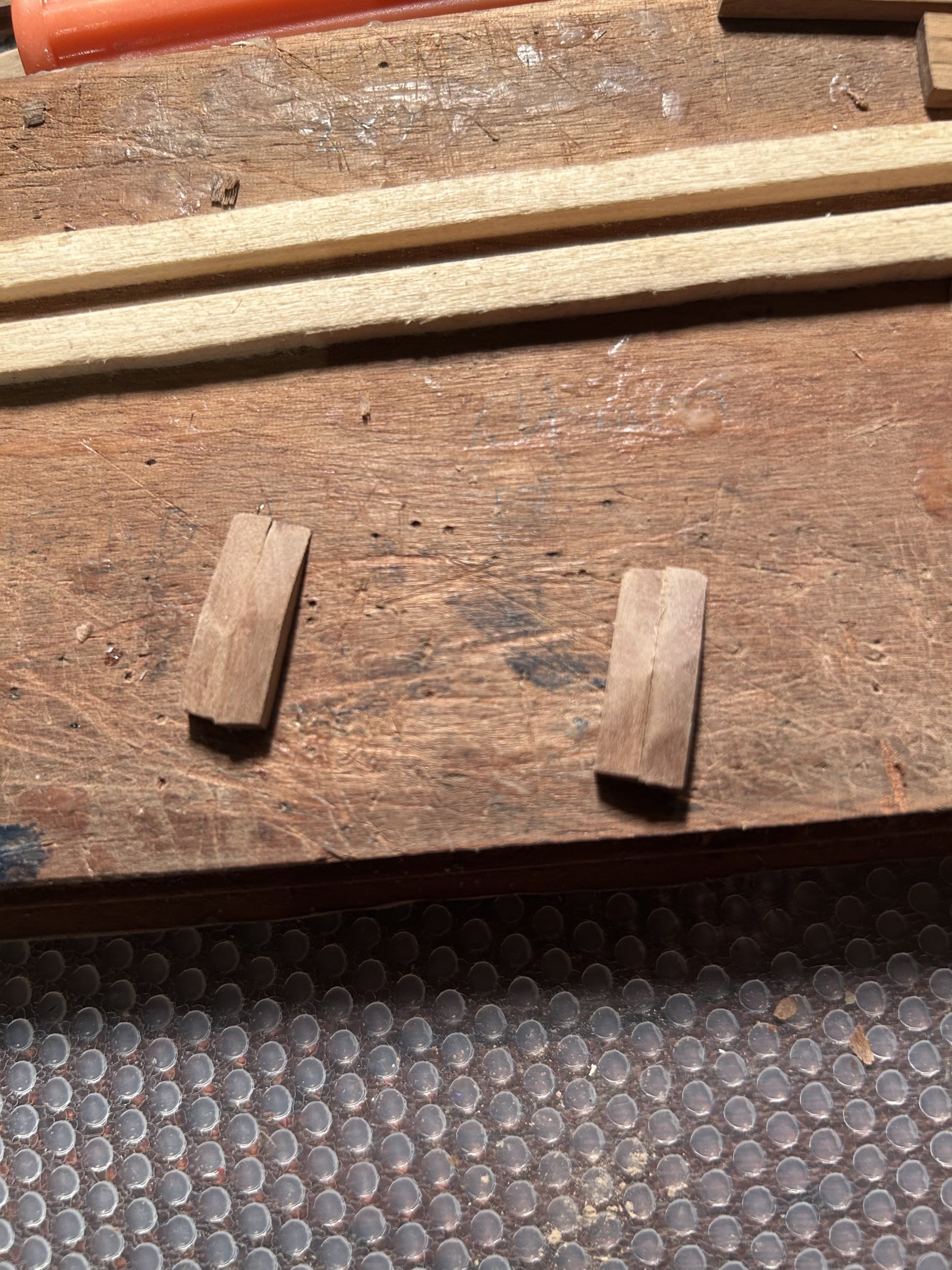

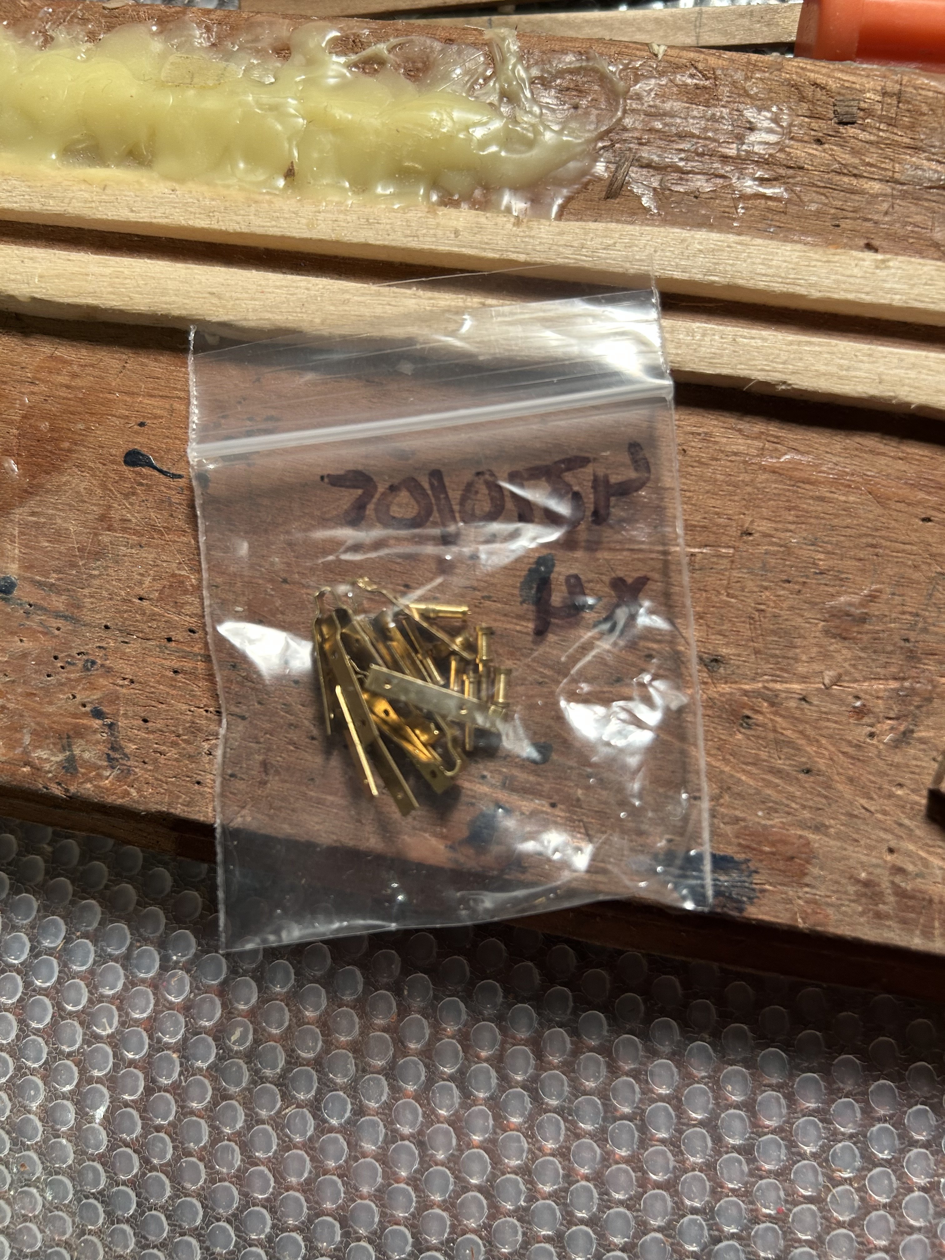

The good news for us here is that my package of 1x1mm, 2x2mm, and brass hinges have finally arrived!IMG_1013.thumb.jpeg.f449151e80145898ad06585178be1b70.jpeg

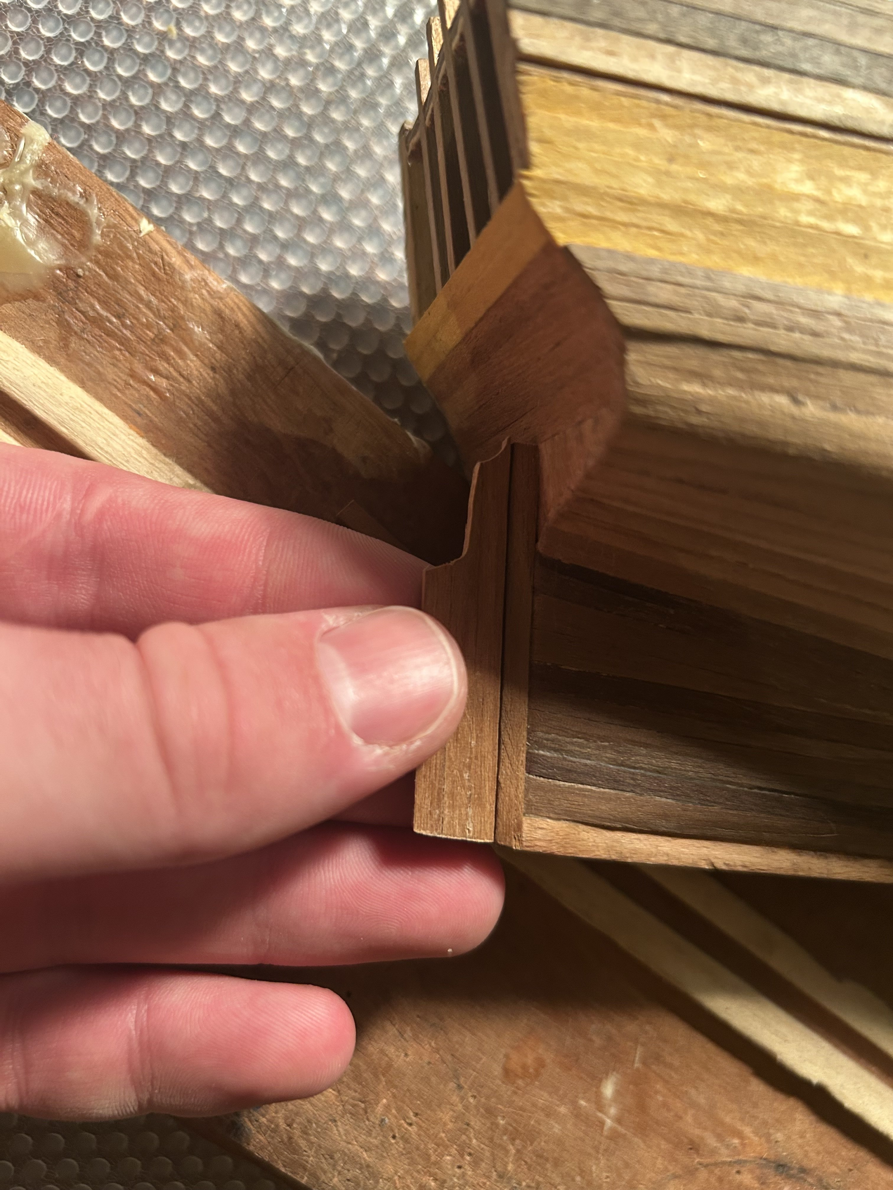

I attached the little side protector pieces over the last couple days.IMG_1076.thumb.jpeg.37246ff5fce6c89ca62b8a537ef8114f.jpeg
They were fairly straightforward. I measured some distances, cut out a place for them on the parts of the hull that stuck out, then boiled and bent them to fit the hull's curve.

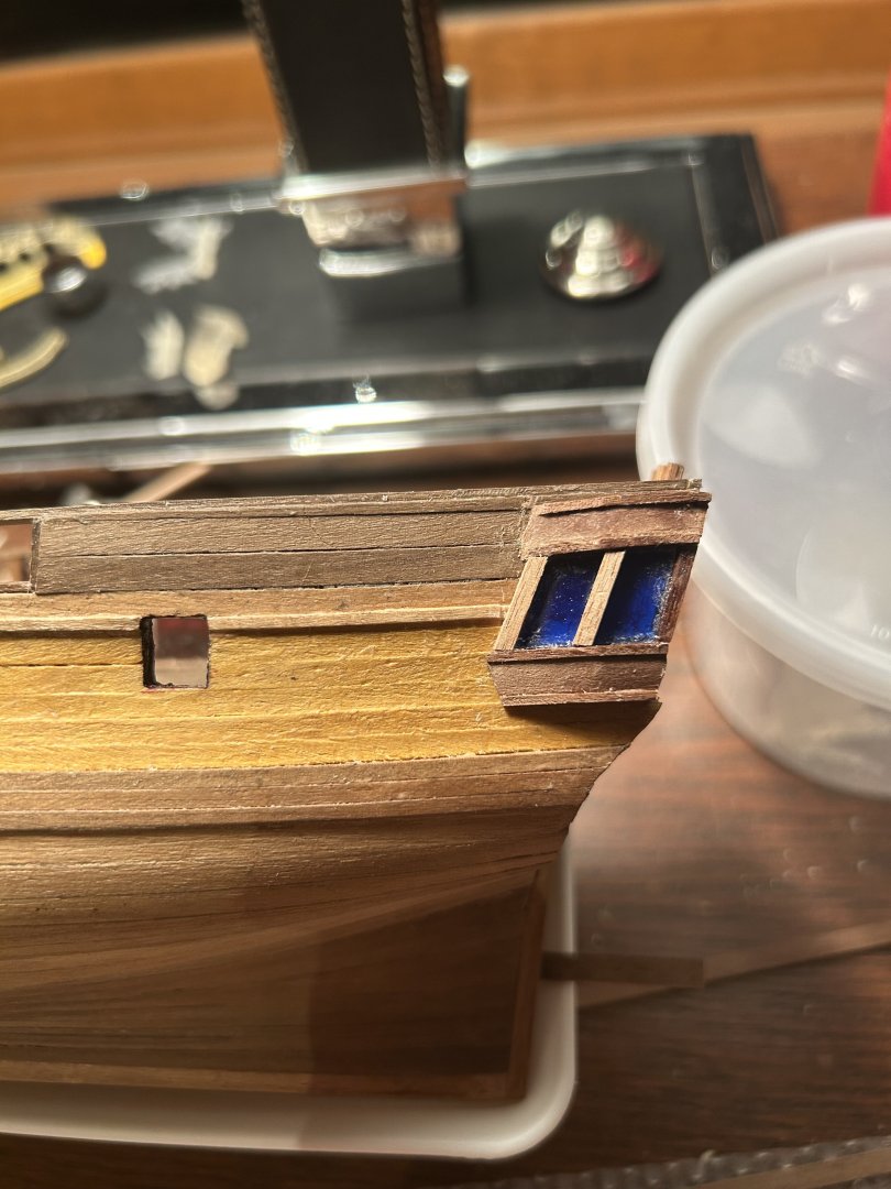

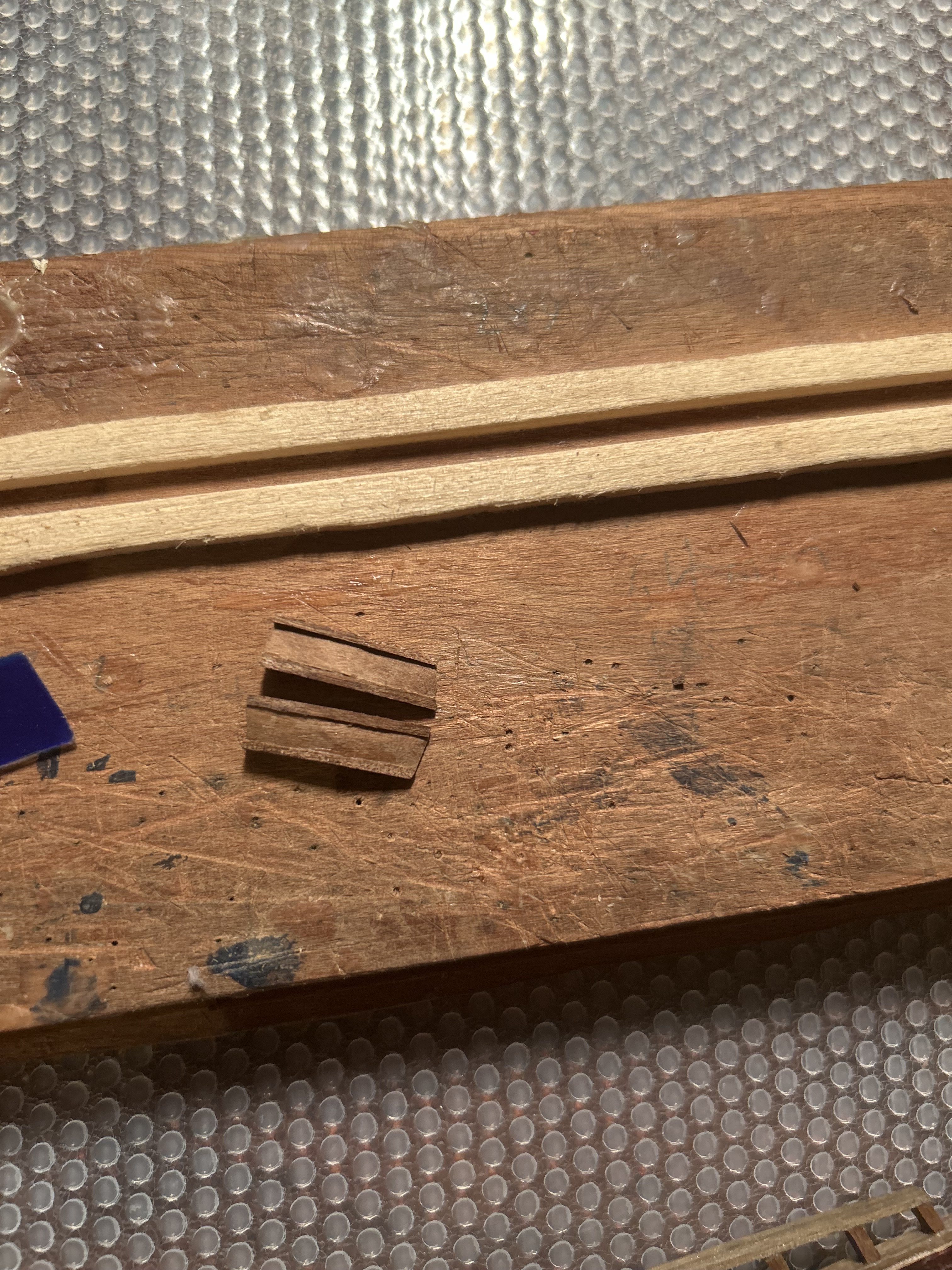

I've started building the side windows. The glass is cut already. And today I finished making the little side pieces.IMG_1137.thumb.jpeg.591e1d9381d4385a84e32ce217e69d37.jpeg
I basically chiseled a 4x4 to be 3mm at the bottom and 4mm at the top, then worked to shape the rest of the piece into something reasonable. I glued 1x4mm pieces on the top, and trimmed them to shape until they looked good.
77424413218__6A2371E9-6D4D-42C4-952B-B47CA27FF4CB.thumb.jpeg.3b51f08d204b6552a5f99995a7598a7c.jpeg
It was annoying, it was exasperating, but now one side is done!

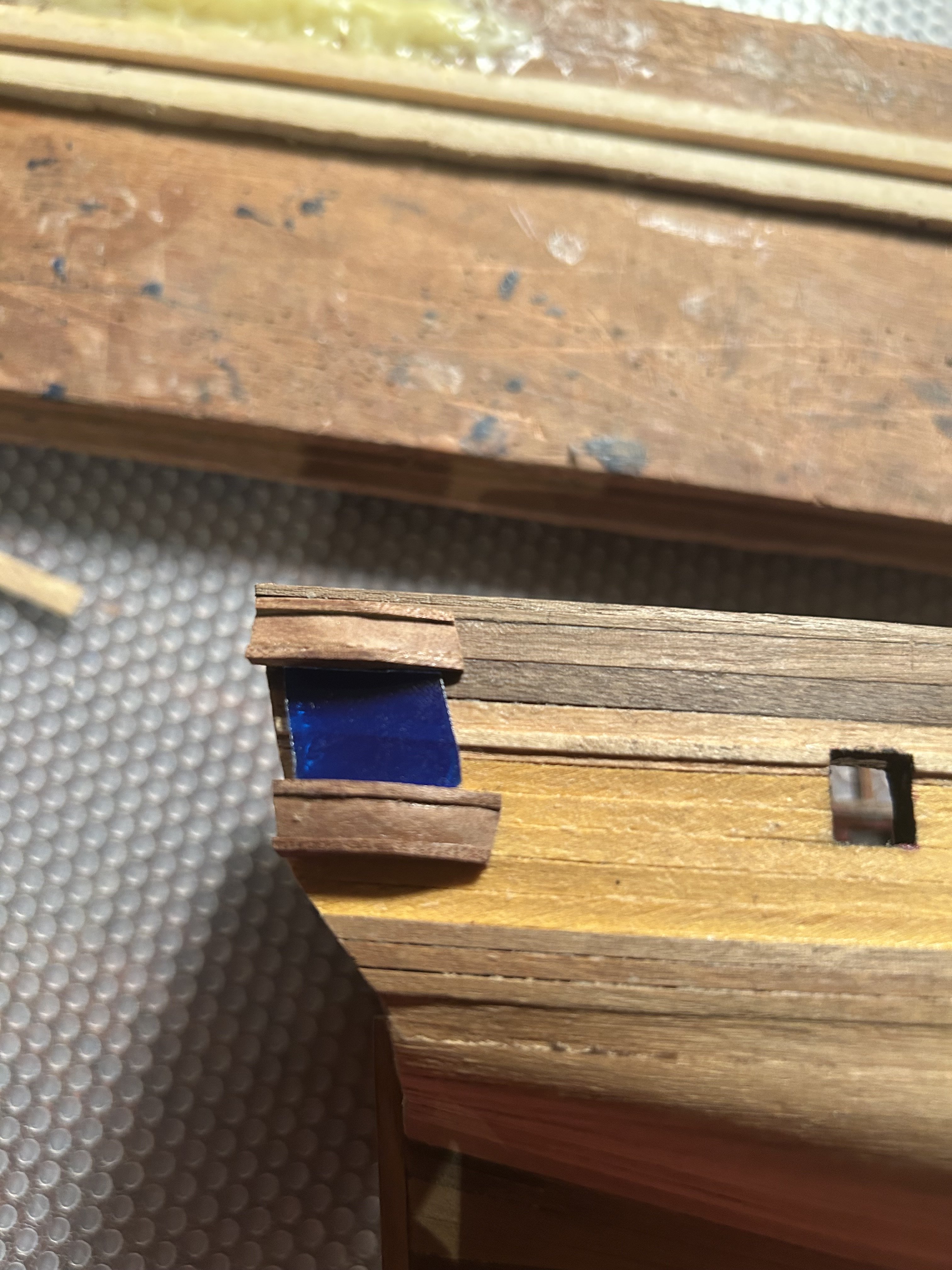

I used superglue to attach the fake glass, and it binds fast to the blue stained glass stuff. On the starboard side, it got messy and I had to cut out another piece of fake glass for it. Staining the glass takes a solid 24 hours. So I will have to wait until tomorrow for the next step.
Success! The starboard replacement window went on perfectly. It's all glued in place now, and I will start putting the little window bars on after this weekend. I'm not up to more tonight, and I have plans for this weekend.
77449941144__E2F93265-7392-4D1E-9830-577CB5E7B27B.thumb.jpeg.9f92810c77487c2ea805536b168b84fe.jpeg
Doing it this way looks so much cleaner and more real than the kit parts.

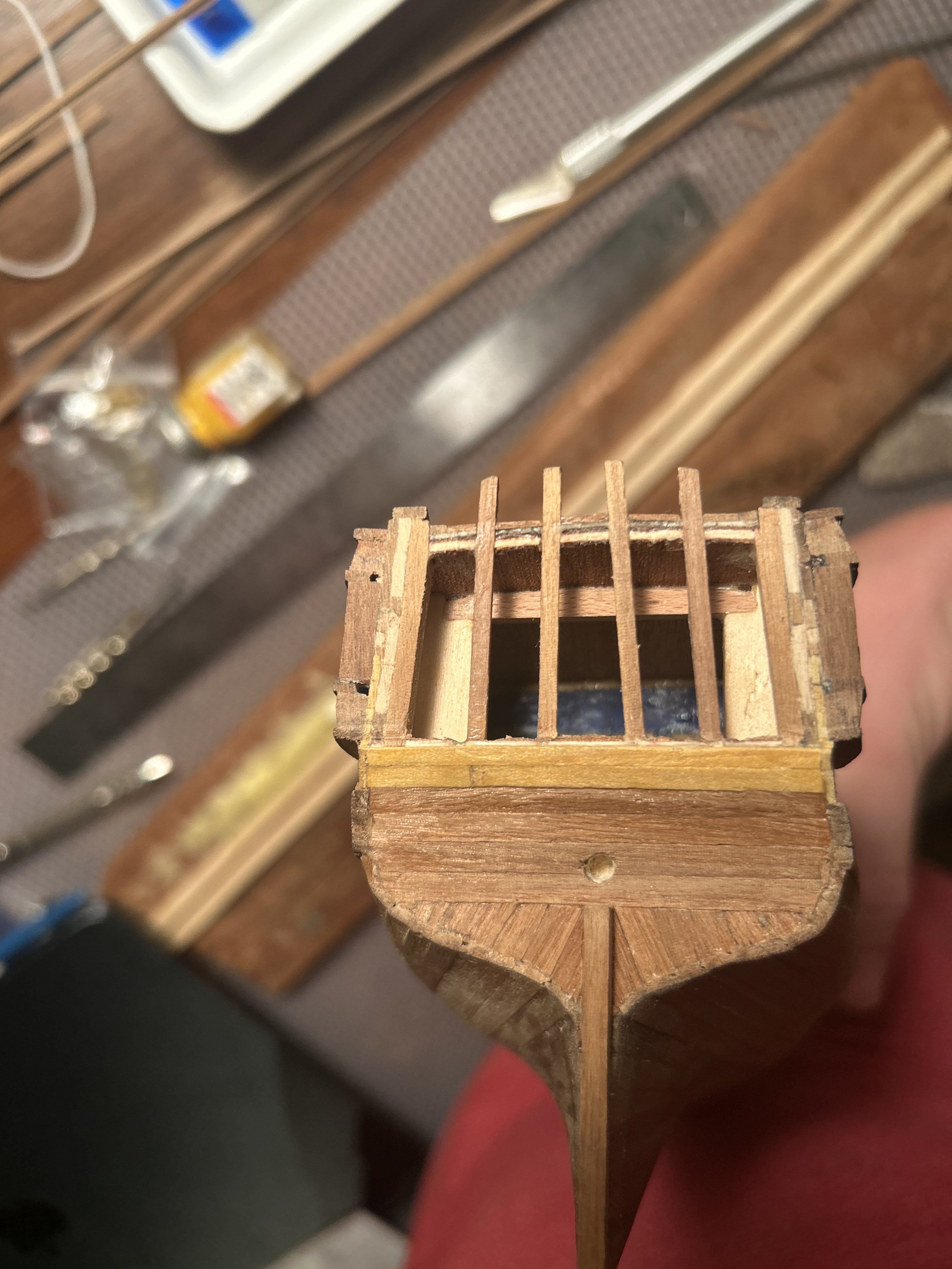

I'm hoping the transom will prove easier.
Things have been slow, because oil paints take a while to dry and yellow takes a lot of coats.
I'm working on painting the transom planks, and I'm fairly sure I need just one more layer to make them look solid.

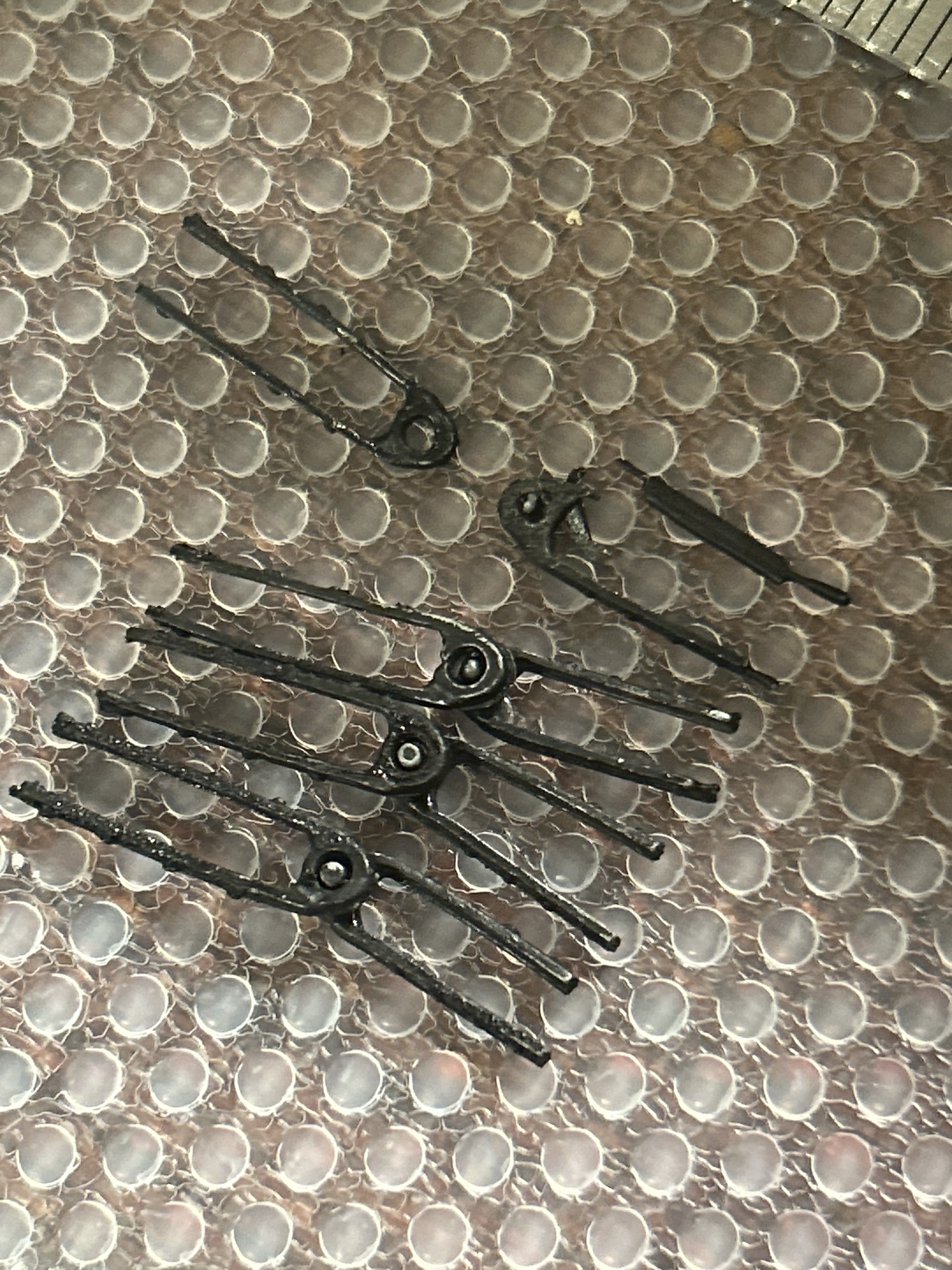

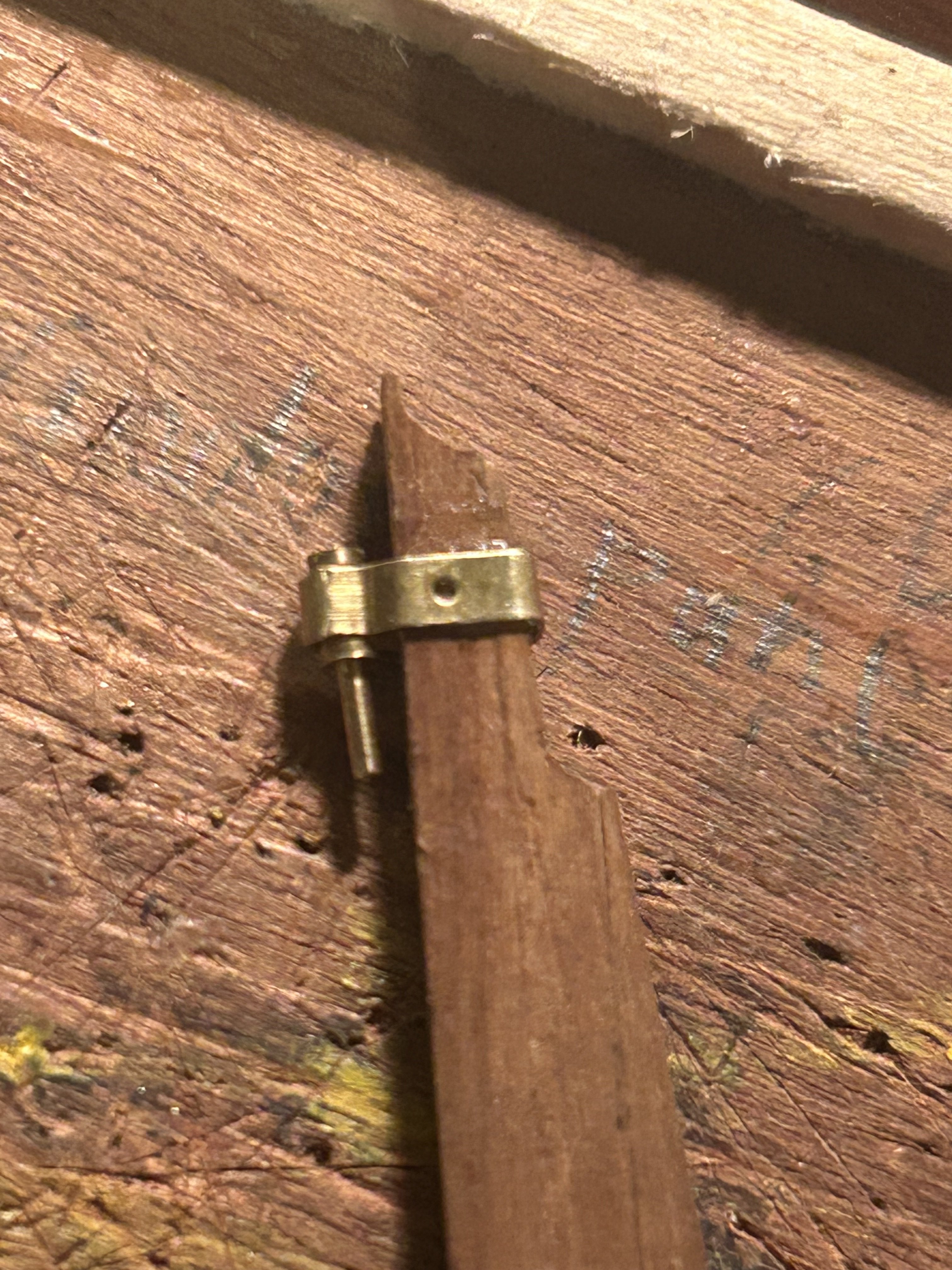

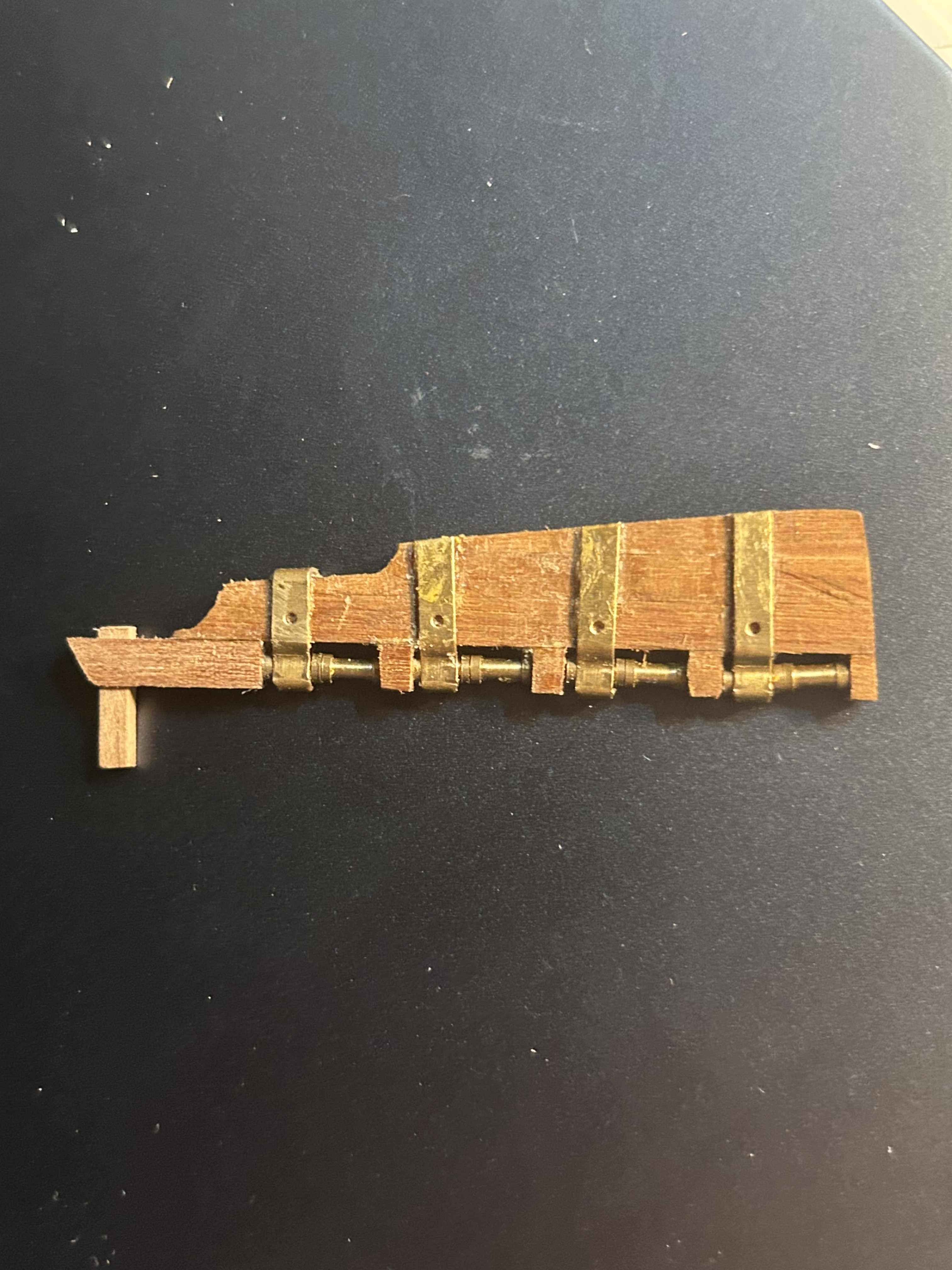

In the meantime, I've started work on the rudder. My clippers don't really do well at cutting through brass, but enough perseverance and gentleness can go a long way. I have one hinge on and have three to go until the rudder is finished. My measurements suggest that each piece of wood between the hinges can be no more than 2mm in height.
I have a feeling the rudder will take me a solid three or four days to finish if I'm lucky.

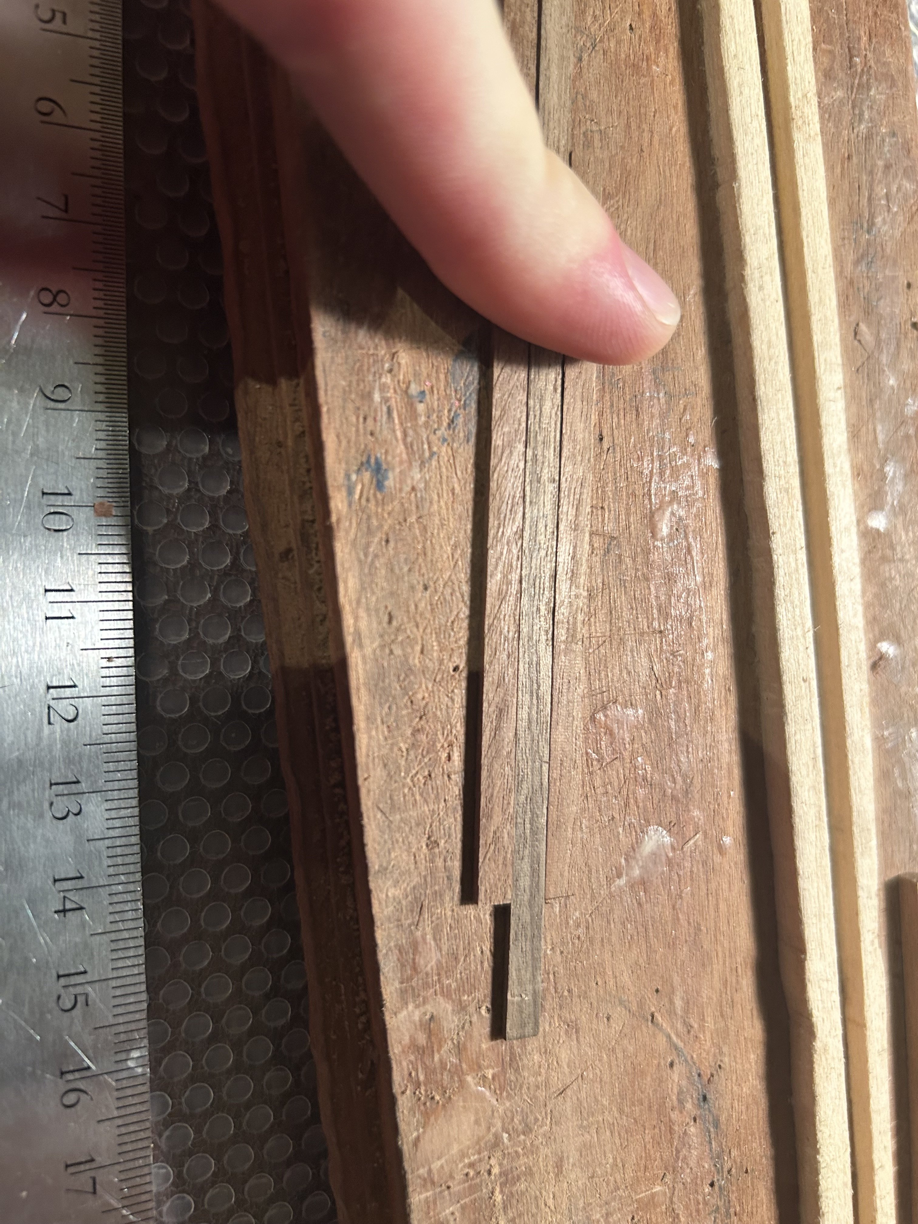

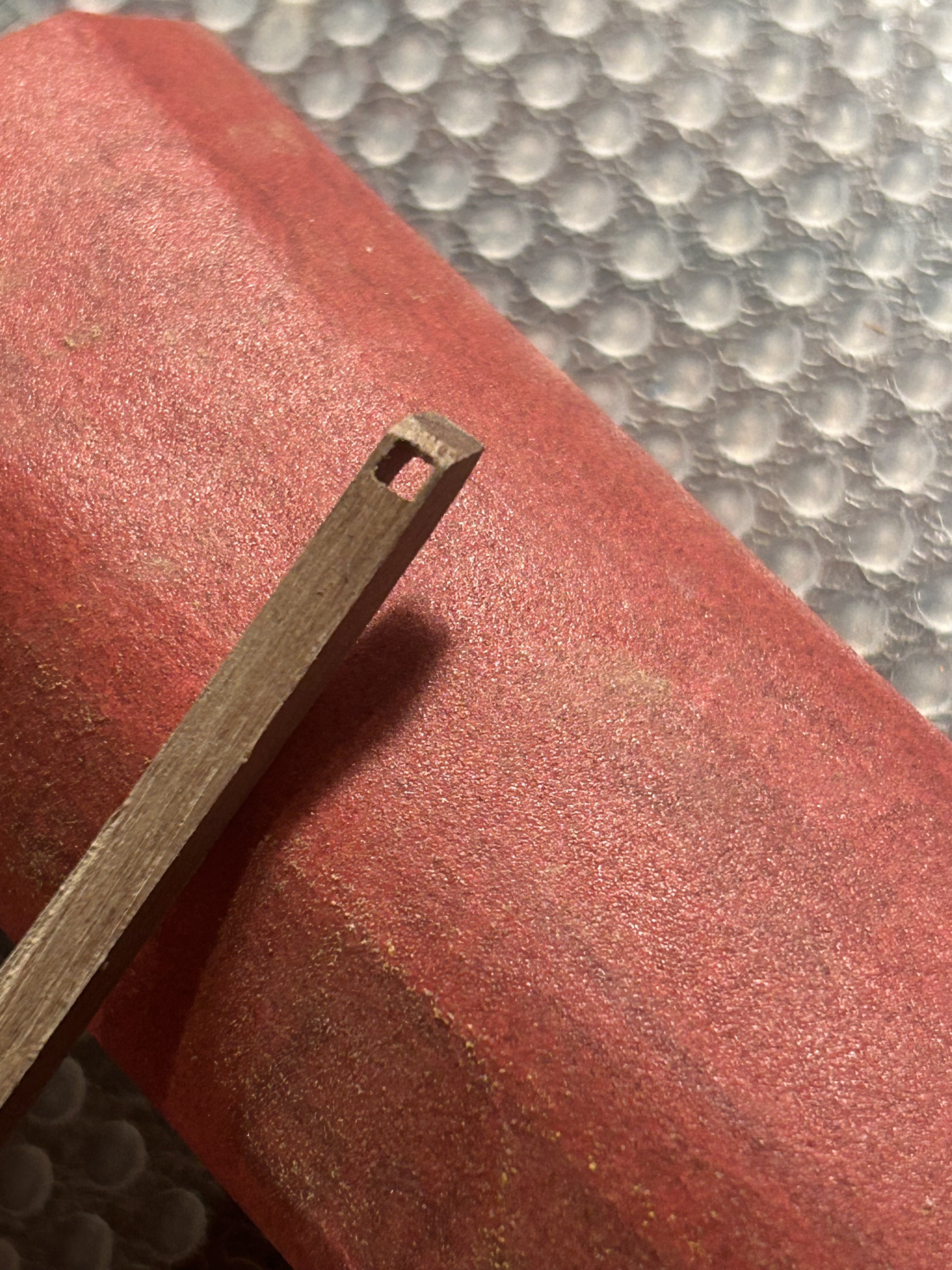

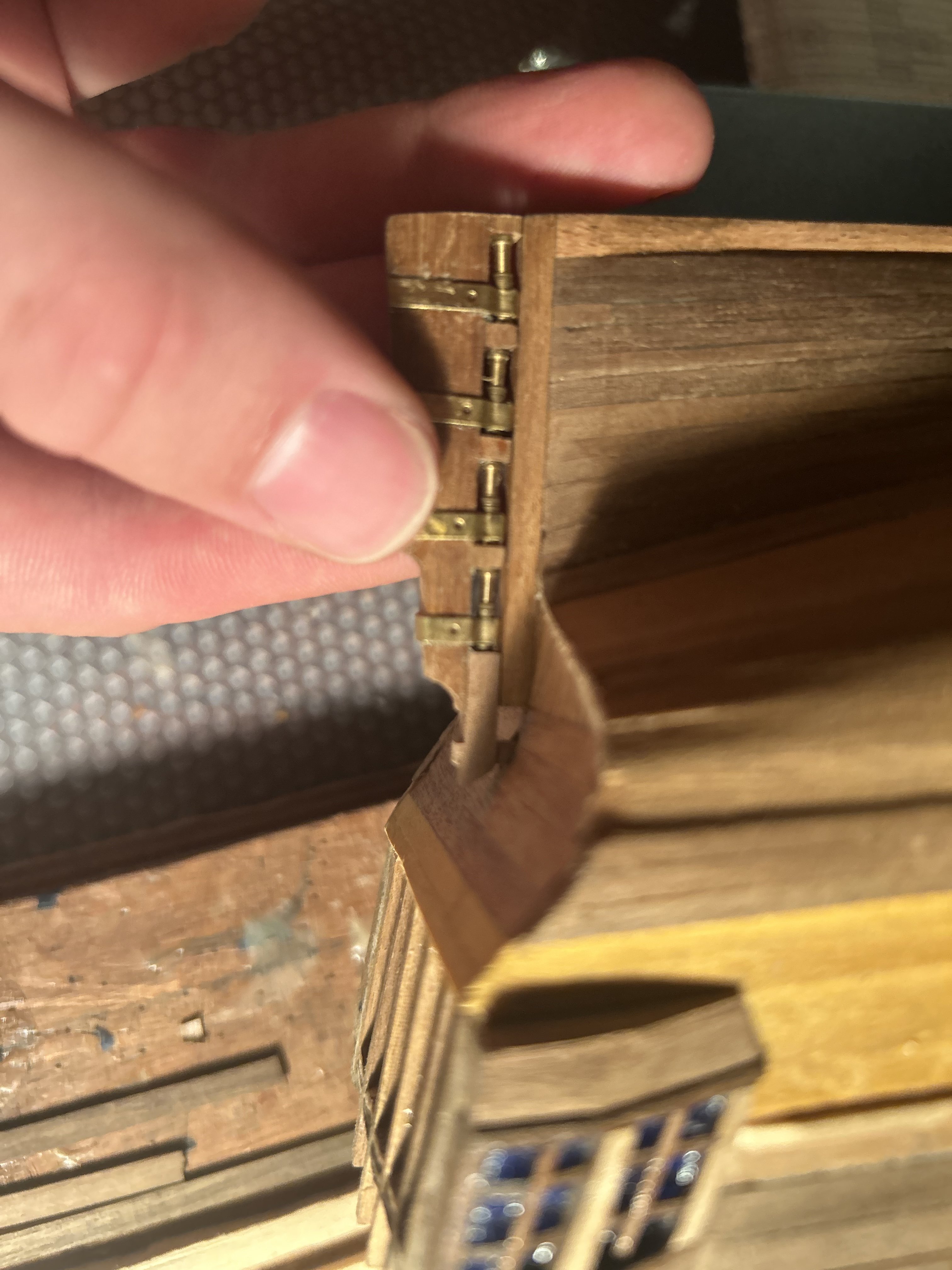

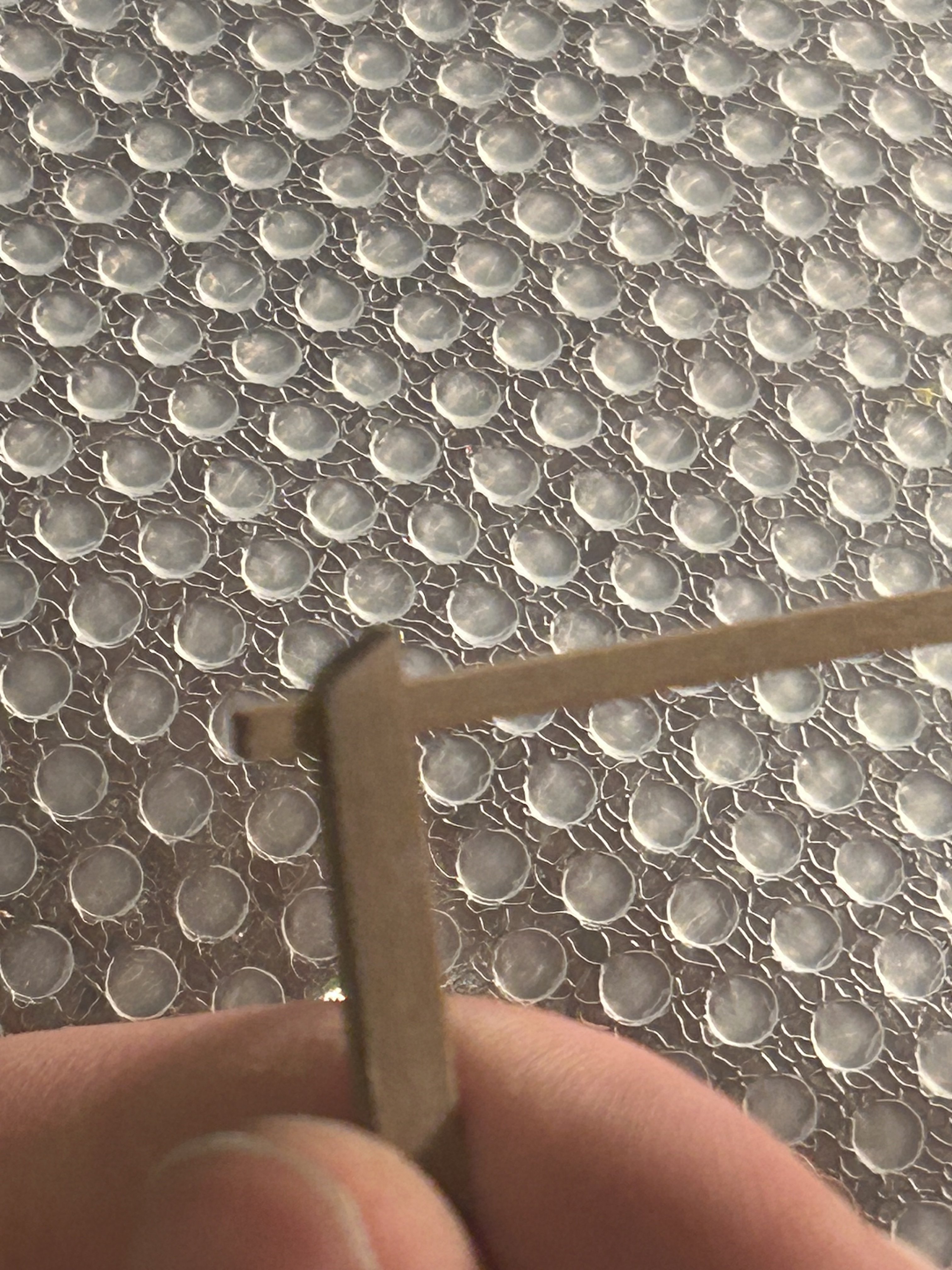

I have finished the rudder. It may be the best woodworking I have yet achieved on this ship.
To get the last piece of the rudder required something special.
I bored a hole in 4mm by 4mm, widened the hole to fit a 2mm by 2mm tiller, then shaved down the whole piece so it was 3mm by 3mm.
Then I cut it to shape and glued it to the top of the rudder, so it can fit in a new hole I carved into the hull.
It all fits perfectly!
