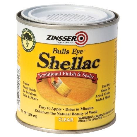

Dewaxed shellac is indeed a universal undercoating for any overcoating I've ever encountered. It's one of the least permeable moisture barrier coatings around and non-toxic. (Shellac is what they coat jelly beans with to make them shiny.) It's easily sanded, rubbed, and polished, as well. "White" (clear) shellac is invisible. One of the biggest advantages of shellac for those using water-based coatings is that it does not raise the wood grain like anything containing water is prone to doing. There's nothing not to like about the stuff... and it's relatively cheap. $20 a quart, $13 a half pint.
Bulls Eye® Shellac-Clear - opens a modal dialog
 Bob
Thanks for the clarification,note that your can is identified as "clear" which identifies it as wax free.
Seems that in my area stores only carry amber which is not wax free. Bummer.
Bridgman Bob

The amber colored shellac is called "orange" shellac. It's the same thing, just unbleached. (You can get orange dewaxed shellac, also. For ship modeling purposes, in fact, for most purposes, it doesn't matter if shellac is "waxed" or "dewaxed." Clear shellac has much less wax in it than darker colored shellac. The only issue with the natural wax in shellac is that it can sometimes cause problems with oil-based over-coatings such as gloss varathanes.) The "orange" shellac builds up to a very deep dark brown and is useful for classic furniture finishing. The "white" (clear) shellac is colorless. I buy Zinsser pre-mixed in the can. You can buy dry shellac flakes and mix them in your own denatured alcohol, but that's an extra step. If you want thicker shellac, just pour a little into an open container and let the alcohol evaporate until it's the consistency you want. Thick ("gooey") shellac is a good adhesive for some purposes.
Shellac replaces a lot of adhesives in ship modeling. It's particularly useful in "gluing" rigging knots. (Nothing's more frustrating that tying off a line and cutting the tail, only to have the line come loose from a belaying pin, or whatever.) A drop of shellac on the knot will set it forever, but if you need to untie it sometime later, just a drop of alcohol will melt the shellac and easy untying or repositioning. Let the shellac dry before cutting off the end. It's similarly useful for preventing thread ends from fraying and, by applying shellac to a length of line, it can be formed to a catenary while drying and will stay that way when fully dried. Shellac is perfect for fixing hanks of line and gun tackle coils so they appear to hang naturally and don't move. It's also good for "hardening" soft woods like basswood. Lay on a generous coat of thinned shellac and let it soak into the wood. When dry, you can sand the surface easily without raising "fuzz." I'd put shellac right up there with sliced bread as one of the world's great inventions.
