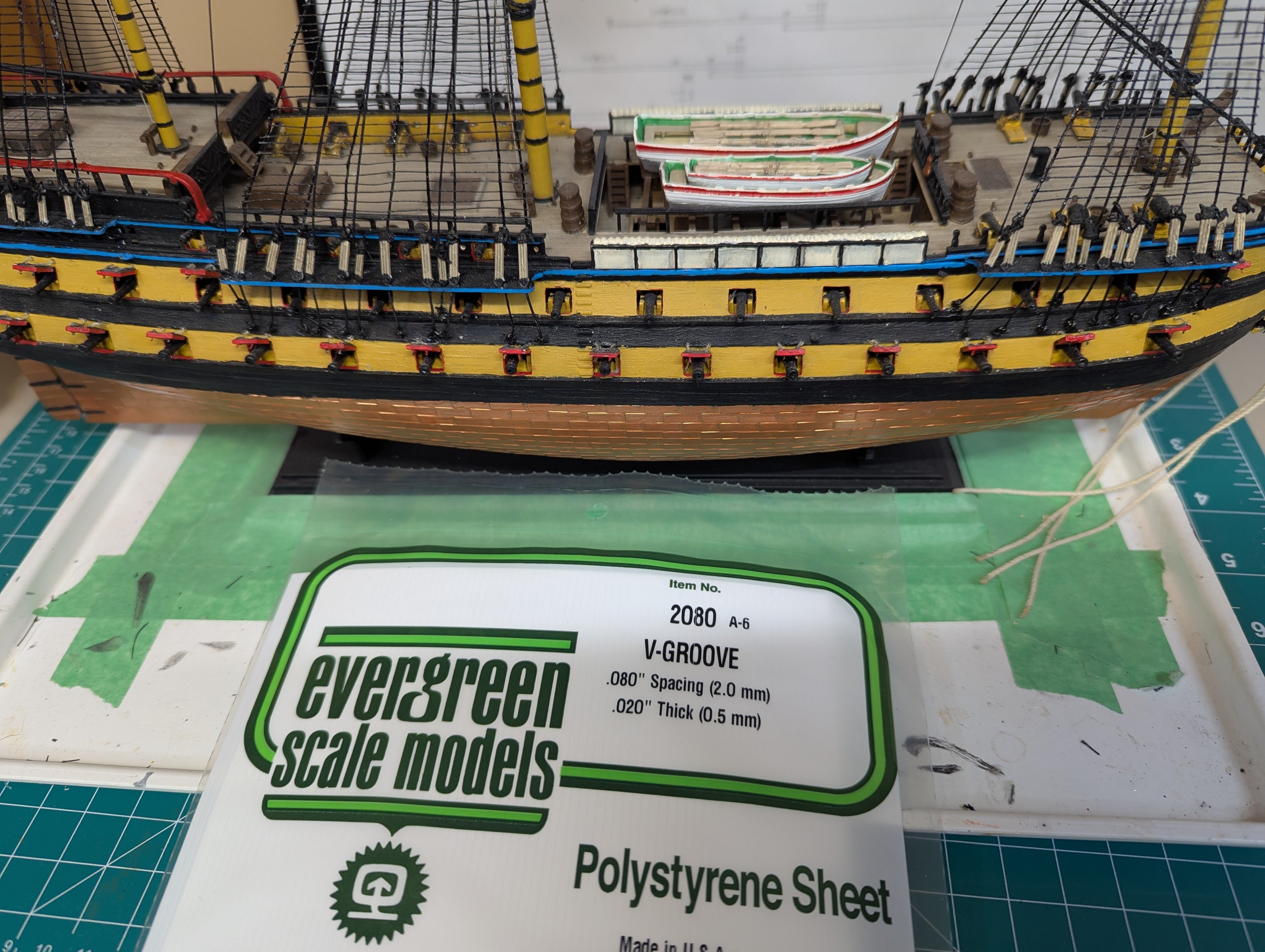

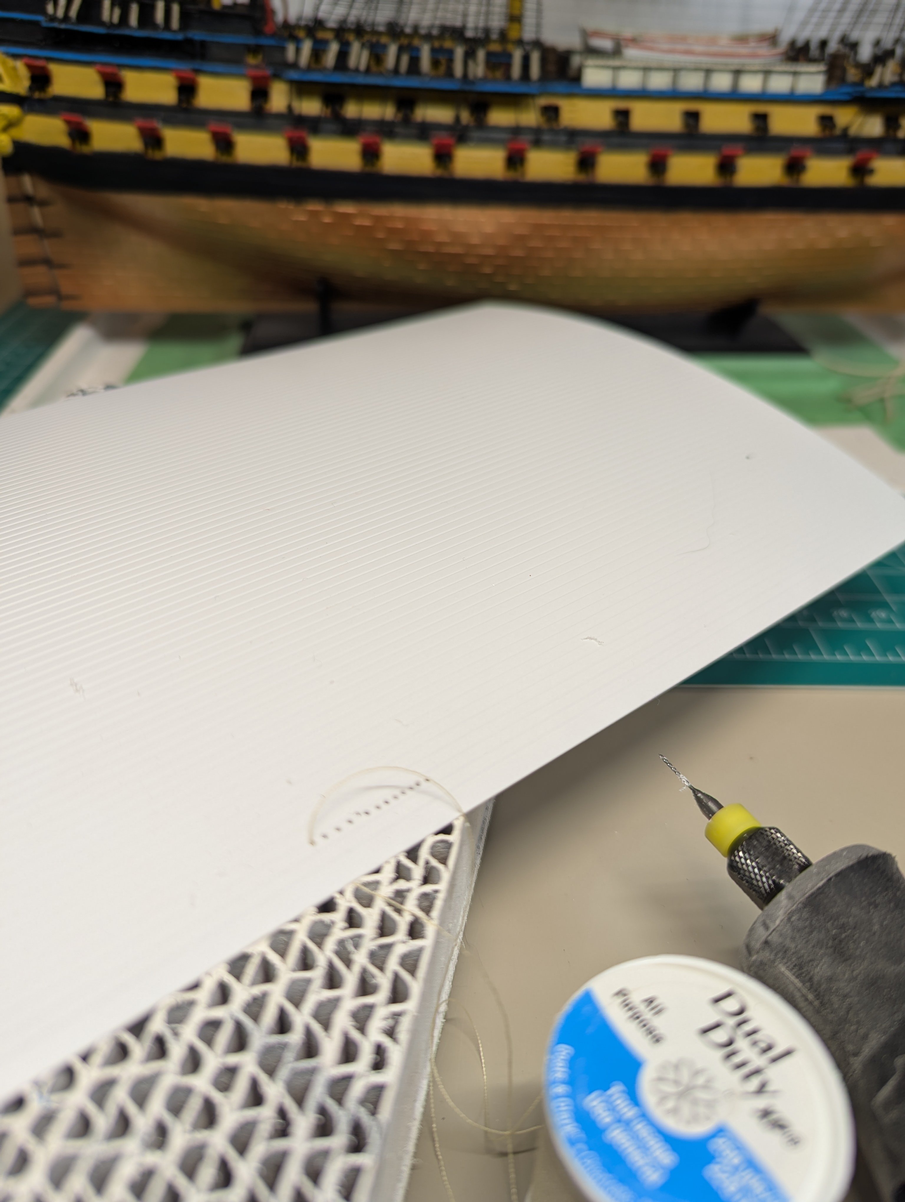

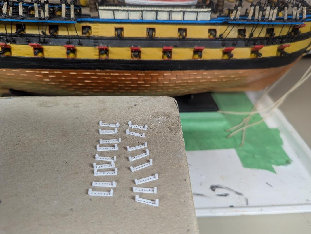

I bought a sheet of v-groove styrene today at my local hobby shop.  I was trying to figure out how I was going to hold the usual small styrene strips down to drill the holes so I could pull the running ringing through them.  But with the styrene sheet I can drill the holes before I cut it. And I have lots of material for trial and error.  My goal is to have the running rigging done in a few weeks.
Edited by Admiral Beez

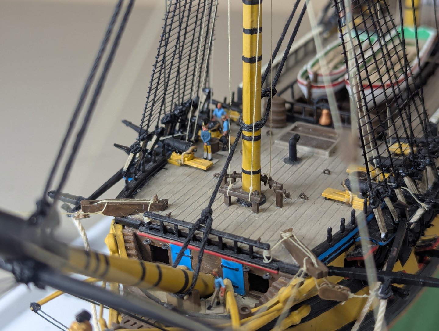

I'm pleased with how it turned out.   I bought a micro pin vise drill to ream out the holes, necessary as some of the CA glue blocked them.  We'll now start installing the running rigging, running it through the holes in the pin rails below - but not knotting it permanently until I am sure there are no crossed lines.  When we're done I'll mock up belaying pins.
PXL_20251110_214828501.thumb.jpg.75fc017303cad7bf86ecea11aececf44.jpgPXL_20251110_214904449.thumb.jpg.f6540e487f468b17a59dffdbdfbe96c0.jpgPXL_20251030_204145286.thumb.jpg.6b6e67a049d18cdce9297cdb4e1eba75.jpg
The book on rigging has been a godsend for this project.   I may not be to Royal Navy spec, but my rigging will be as close to the book as possible.   My custom pin rails seem to be working out nicely.   The kit only provides about ten sets of blocks, so I am using them sparingly across the build.
