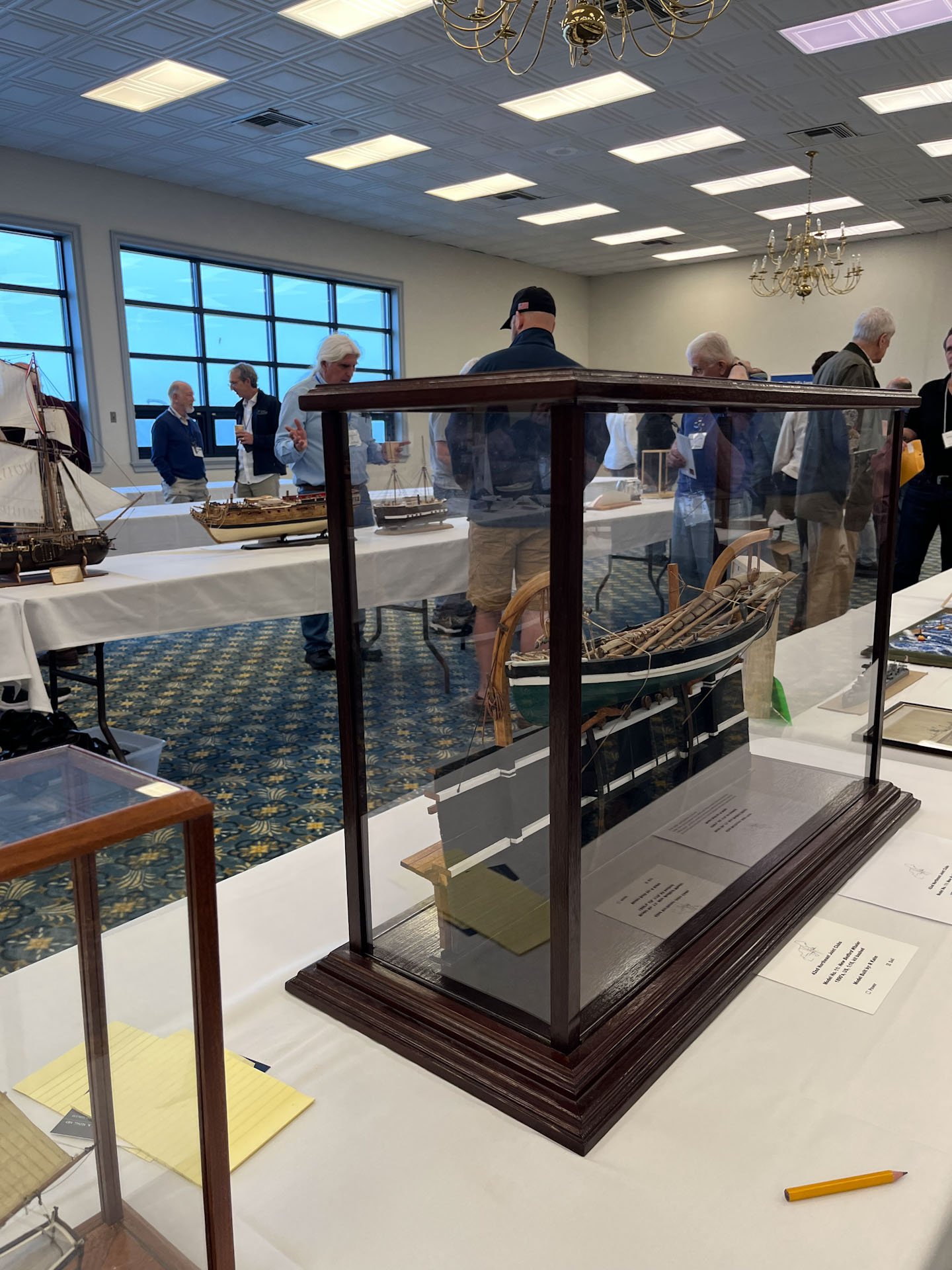

Heres a pic of this case which I really liked; and I notice I accidentally caught Dave and Greg talking in the background.  They gave the lecture after lunch about their current project, a 1:48 behemoth frigate? thats so big there are concerns it may not fit through Greg's doorways when he's done rigging her.  Along with some other attendees I worked on them both to restart the Admiralty Workshops and its sounding hopeful.  If either of them are reading this I still vote for a short cross- section of a ship.  They did Echo years ago which I have downloaded but maybe a different ship, same idea.
