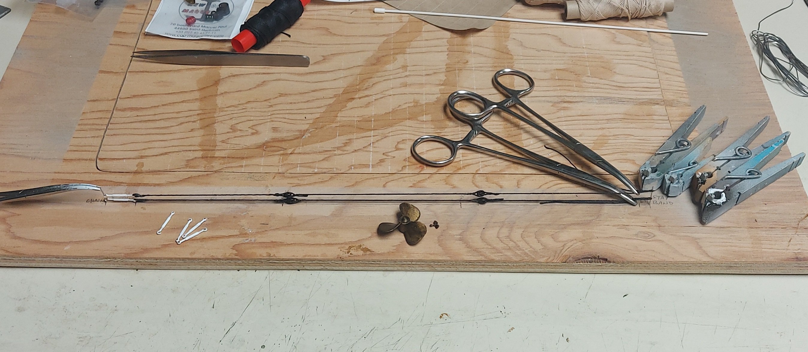

Running rigging at the forward end of St. Roch is now complete, and work continues to prefab the shrouds and stays...

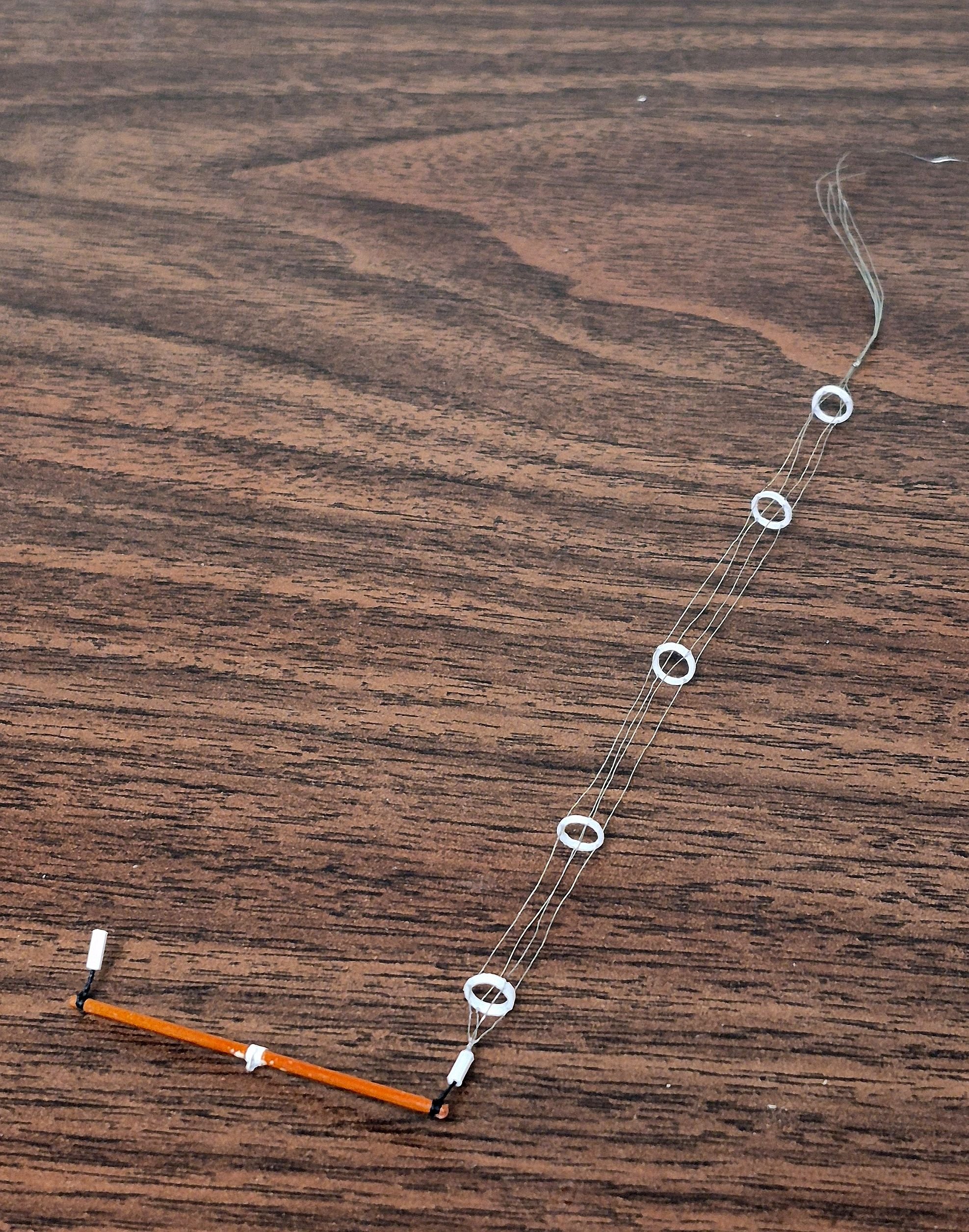

The previous picture shows the back stays being built together on a template that I made on my silkspan frame.
This picture shows the stays finished and the shrouds started.
This is a clearer shot of the template... the jib sheets (ready for paint) are also seen in this picture.
The template started out as one line for the back stays, with the insulator locations marked. Holes are drilled for pins to hold the turn buckle, insulators, and at the top eye location. The two stays already made are shown, ready to be installed.
Then I added the second line to make the shroud template, moving the insulator and eye locations, and indicating where the ratlines (which are wooden slats) will go.
Here is the shroud partially made...
Note the running light will also be fastened to the shroud. Once the shrouds are completed I will adjust the top end of the template for the longer stays and shrouds required for the main mast. Thus the template evolves while the lower end turnbuckles remain constant and properly spaced.

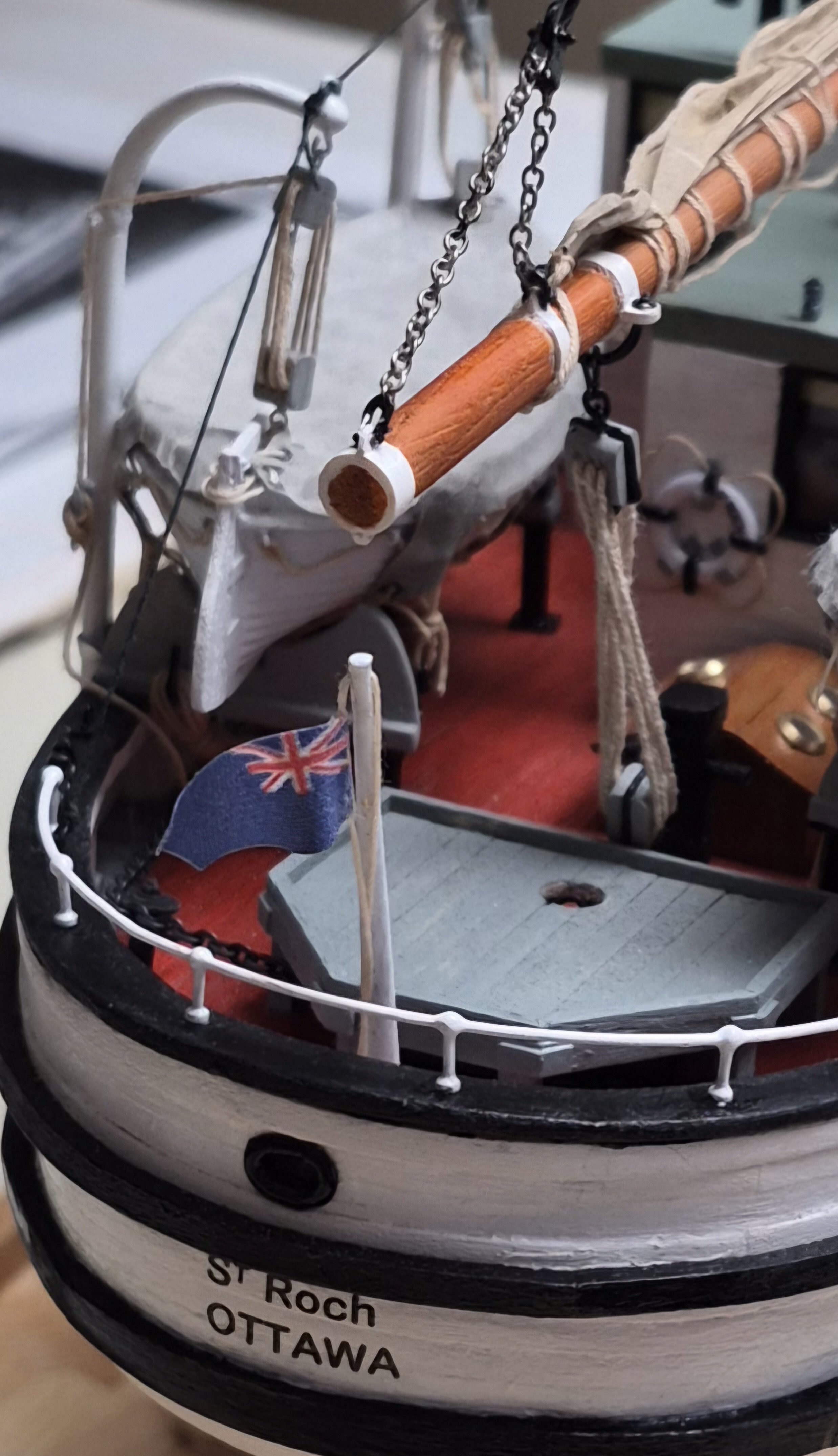

Moving on, the jib sheets got installed... consultation with my museum contact and sailor friend was required, since photos do not show them rigged to the clew while the sail is furled. Consensus is that they were still rigged on the ship and not stowed away, so they would be handy if the sails needed to be set. I accordingly belayed the ends to the pin rails just aft of the fo'c's'le break, and mounted the blocks to rings on the cap rail as shown on the rigging plan. They may have been mounted lower down, on the staghorns, but there is no consensus for this, so I went with the plan. The horns may have been used to belay the running end of the sheet when in use, again, not sure, but makes sense...
I ran the sheets out to a pair of rings near the bow. Whether or not these were installed for this purpose I do not know, but their presence was too convenient to ignore, so the jib sheets were hooked to them. This arrangement keeps the rigging from fouling the deck while being ready to bend onto the sail.
Here is the port side jib sheet...
The next picture shows the starboard jib sheet, and the foresail sheet as well.
This last picture is a clearer shot of the foresail sheet, which was made up on the model after the blocks were prepared and painted.
The boom is posed over to port to allow the cargo handling to be shown. I wasn't sure what to do with the extra line, since there was no obvious place for it, so I placed the coil between the cleat and the horse... I could move it if a better option presents itself, we'll see.

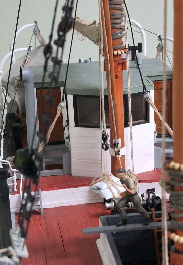

2 hours ago, druxey said:
Those furled sails look very convincing. But why is the deckhand rolling around on the deck?
Ha Ha... good question! Because he was posed on the plank athwart the hold, and I knocked him off!
Once I get the main mast and derrick on, he will be pushing a load of cargo to the side of the ship. I wasn't going to show this, but I wanted an open hatch, also he gives scale to the model.

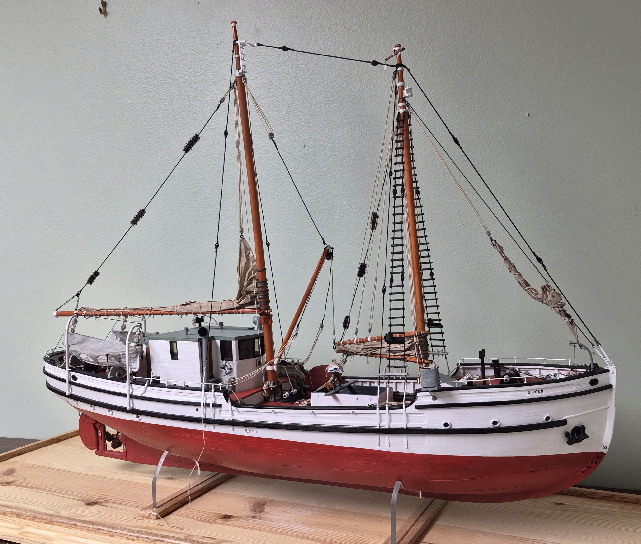

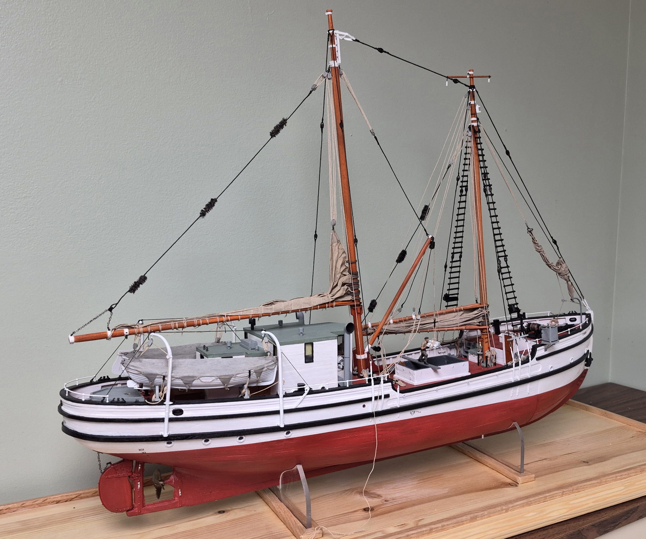

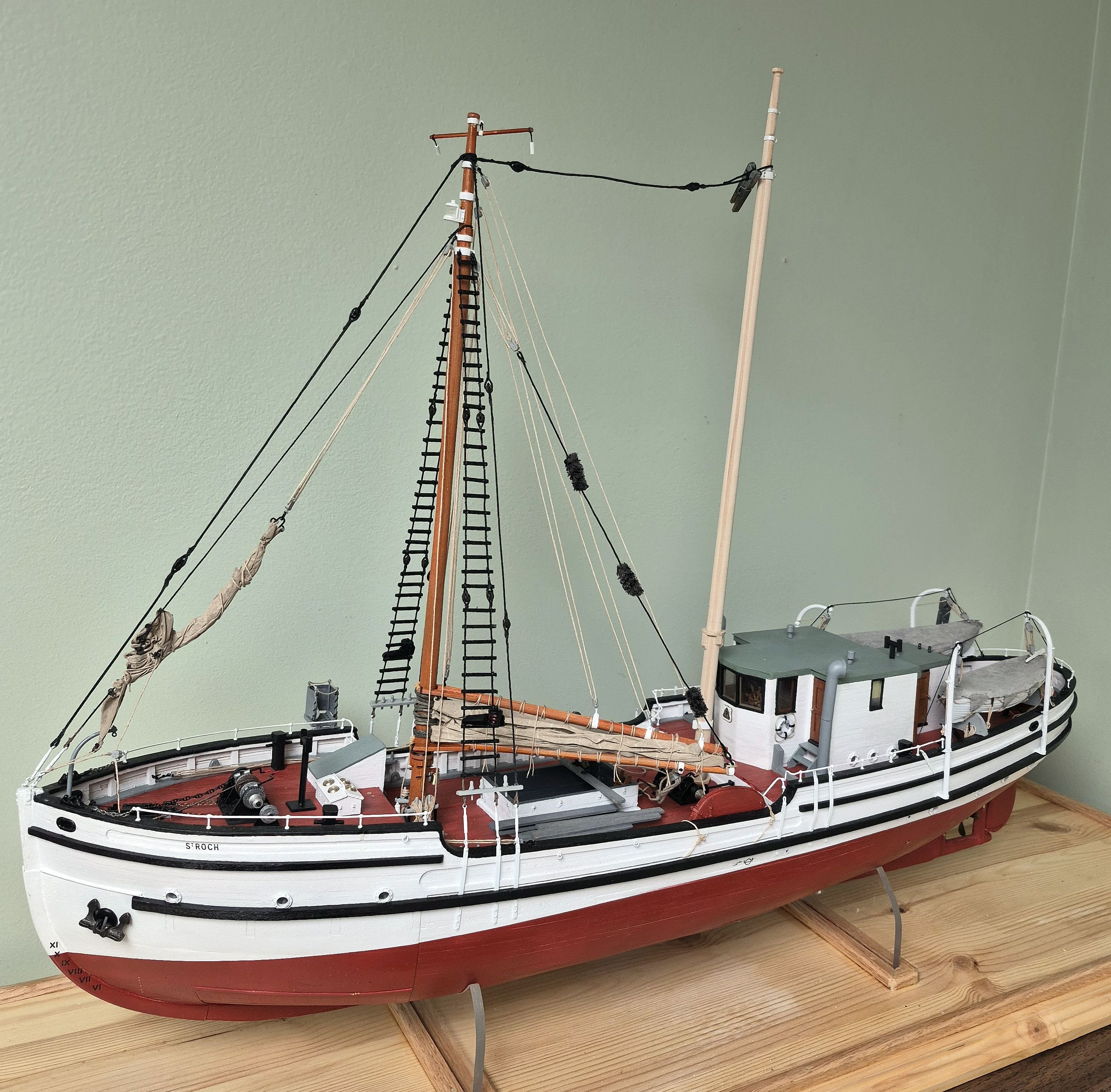

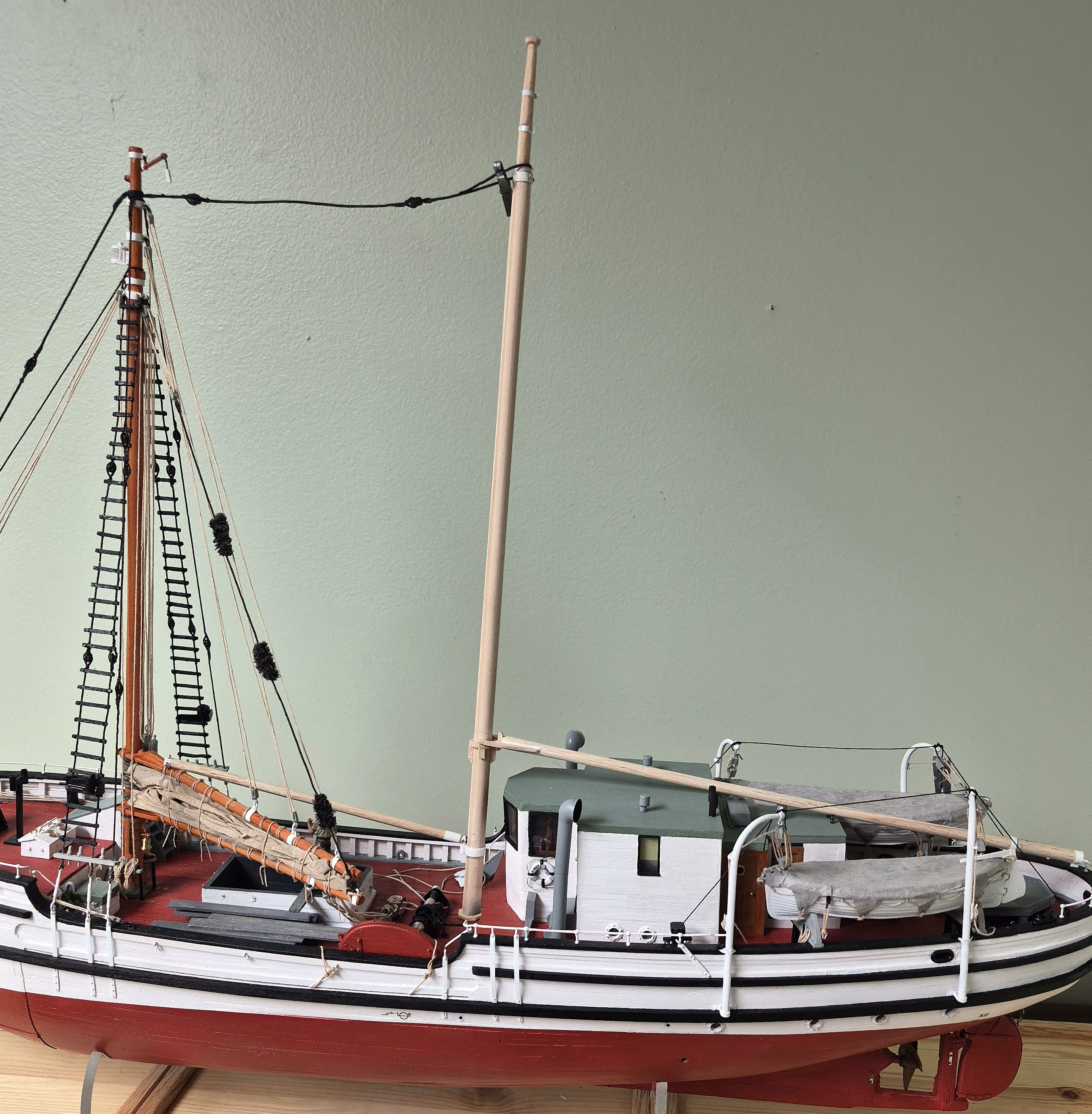

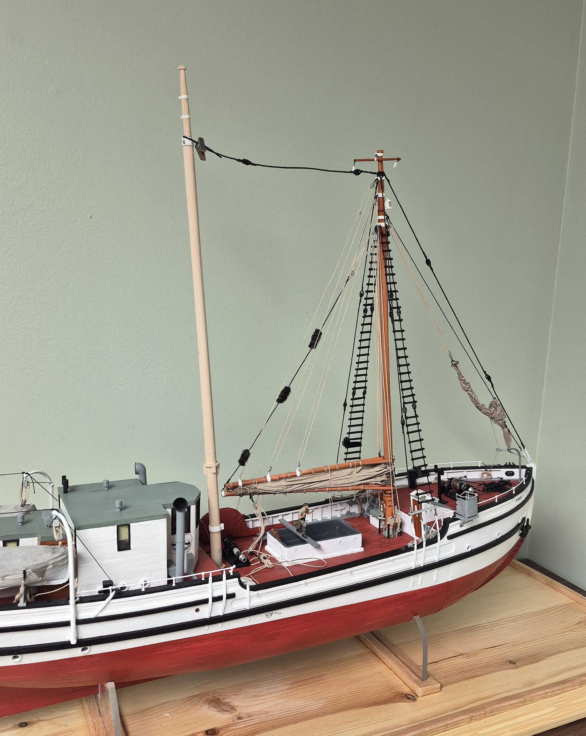

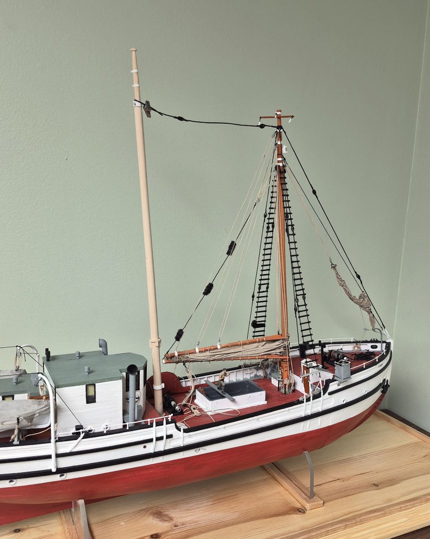

Well, it has been three weeks since my last update, and I was hoping to have had the foremast completed before now... but the empty calendar filled up with commitments that took a higher priority, and here we are!

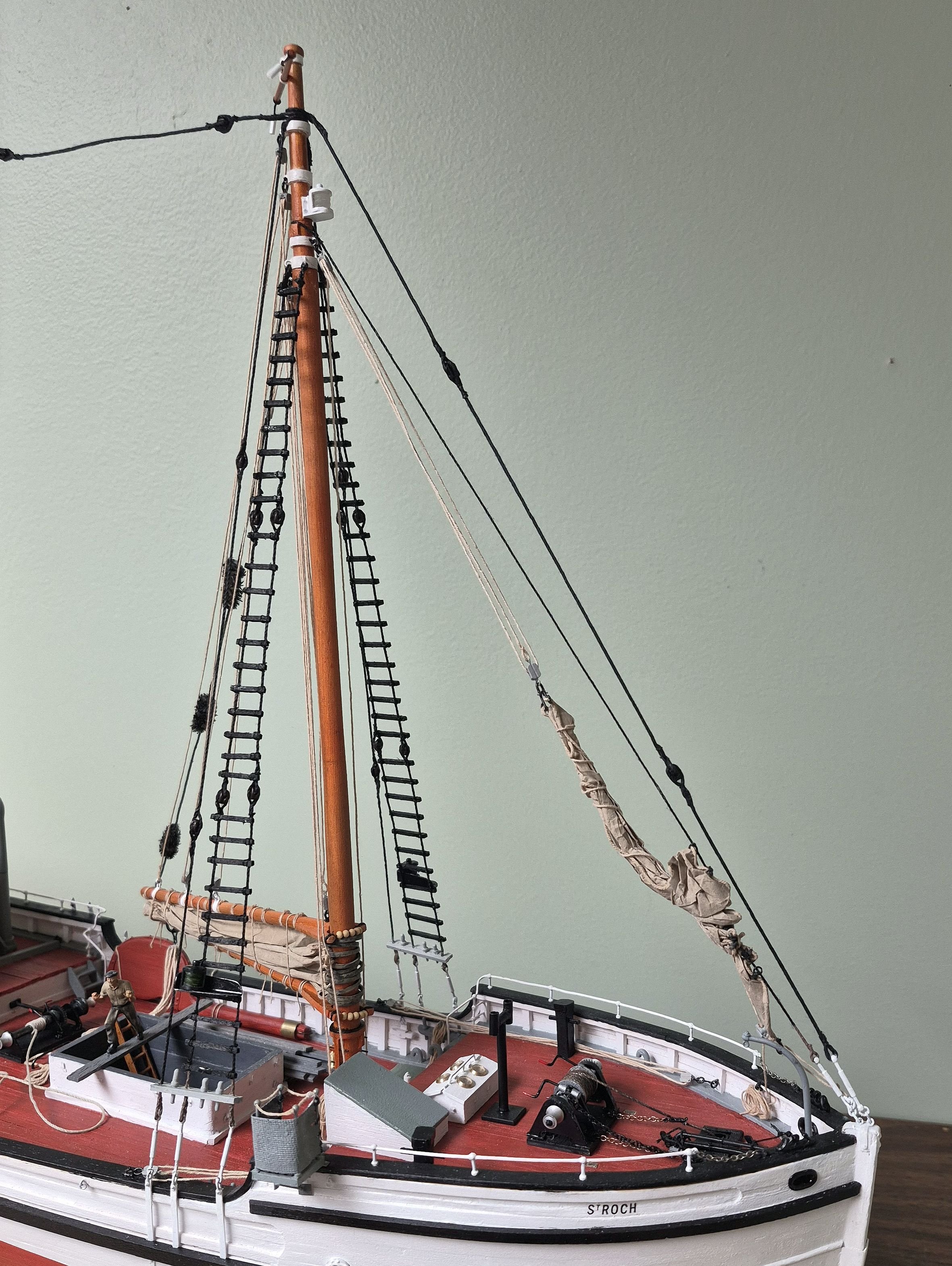

The running rigging on the foremast had already been completed. As you can see in the first picture below, I have been making stays and shrouds...
The ratlines are iron bars, I used balsa wood, because when it is tied to the shroud the thread takes a small bite into the balsa and holds the ratline where I want it.

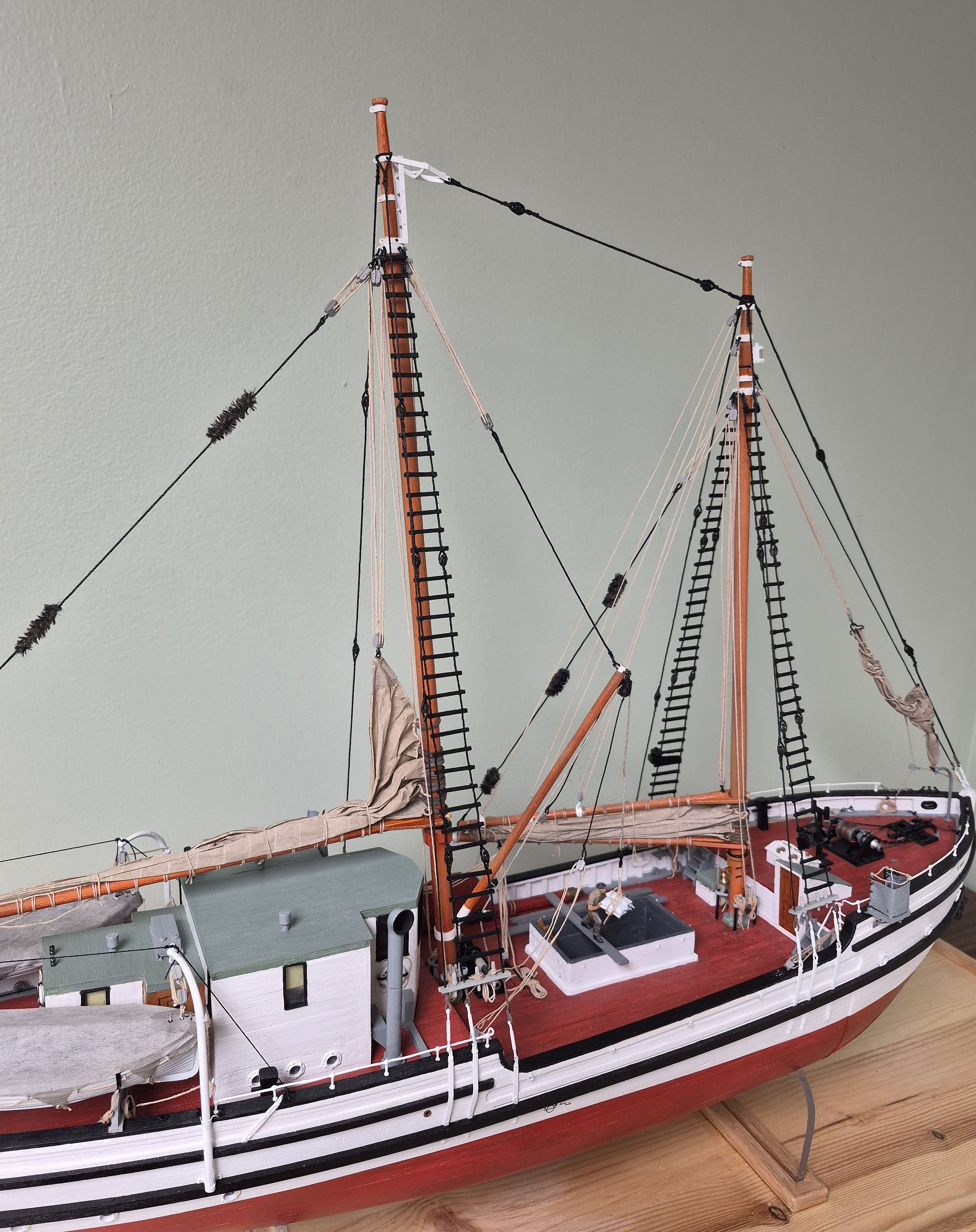

The next three pictures are different views from around the ship...
The main stay and main mast are posed... the stay had to go on now since the forestay is over top of it. It does not belay to the main mast, but to a spreader that will be under the crow's nest.
The sailor has gotten over his hangover and fall into the hold, and is back on his plank awaiting the cargo derrick.

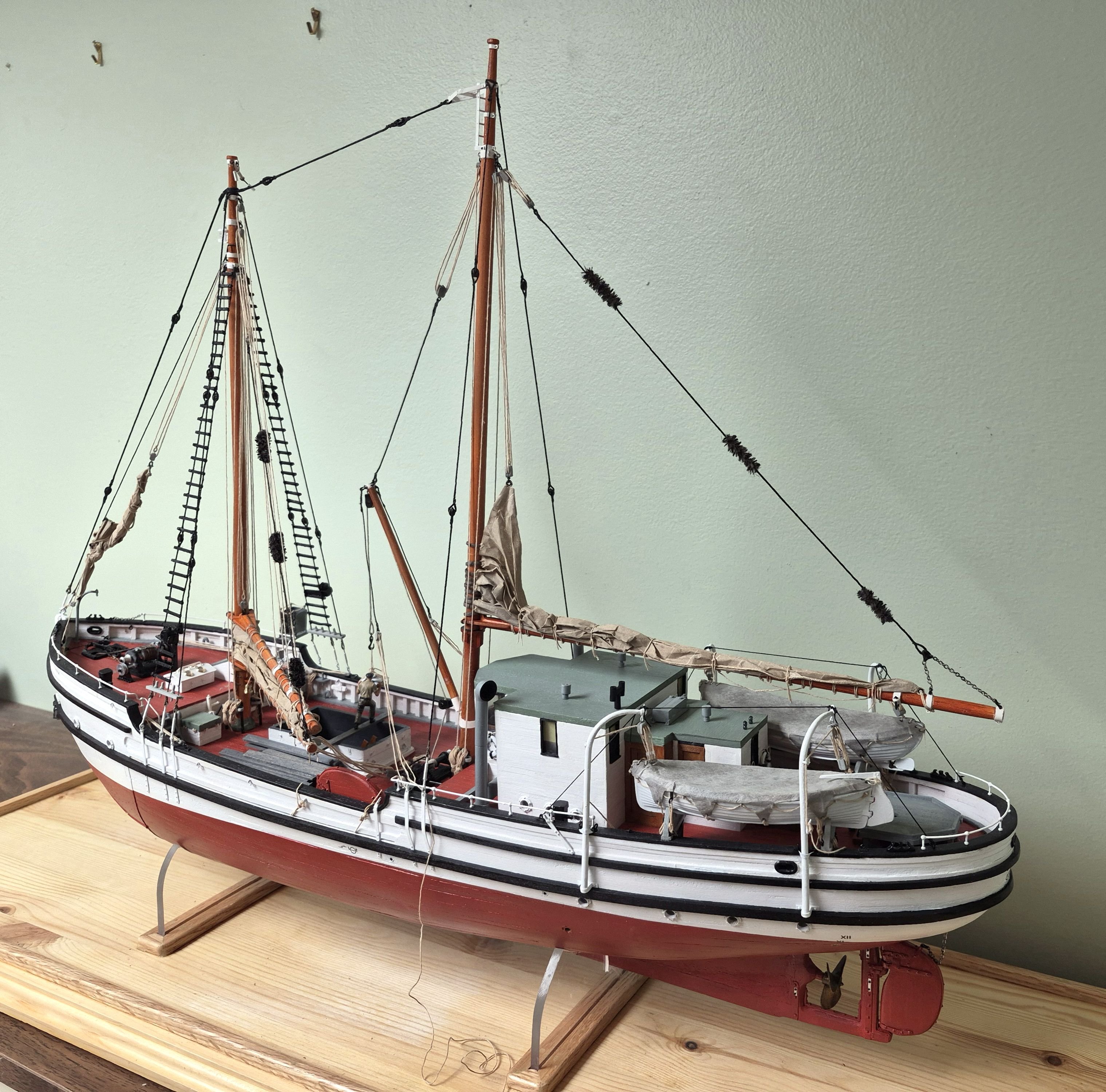

The running lights were modified the same way as the masthead light.

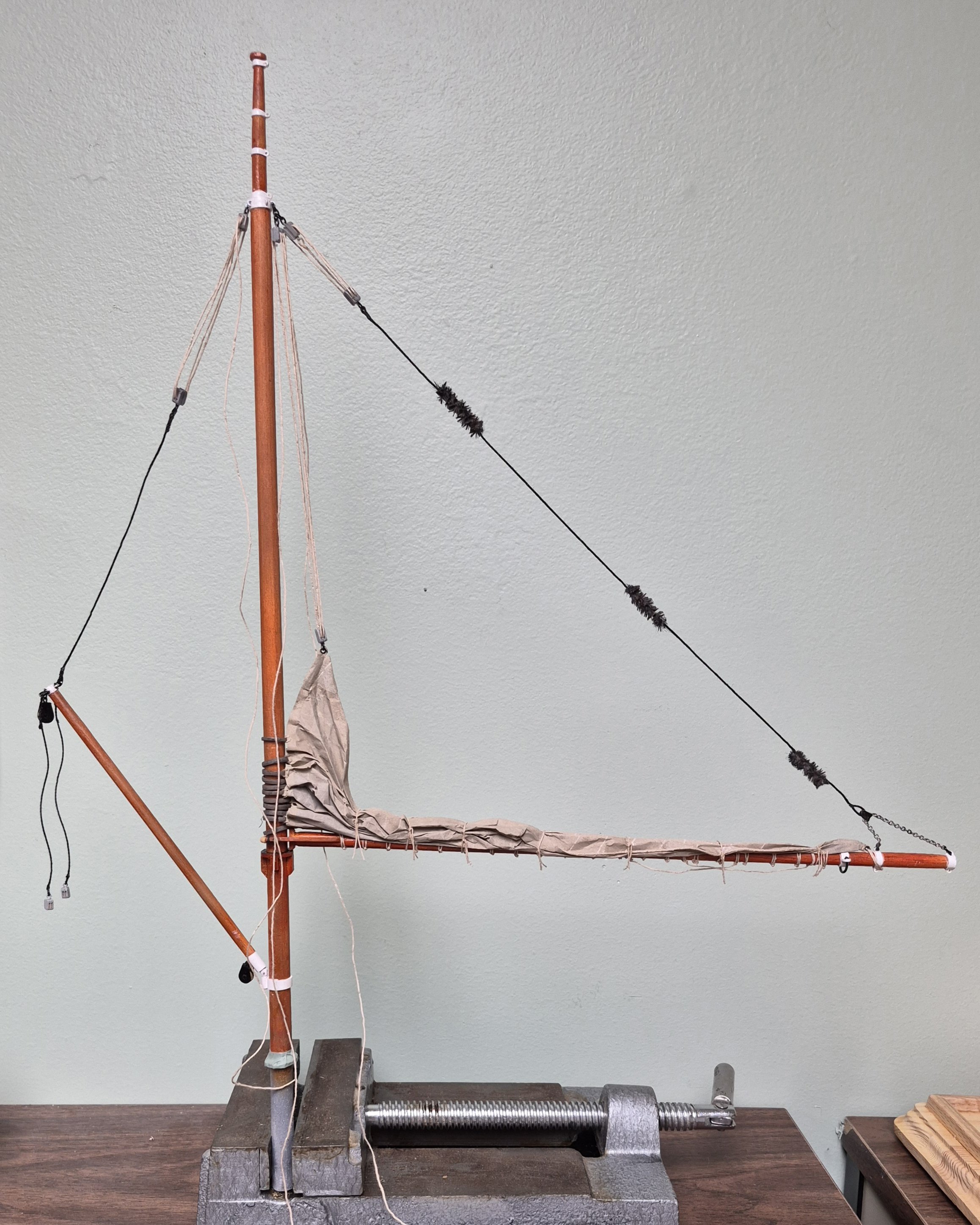

 I have been able to make some progress on the main mast and spars, which consist of the main sail boom and the cargo derrick. I also have made the main sail...
This last picture shows the derrick and boom posed on the main mast. I made the derrick's goose neck from styrene bits and bobs. Most of the bands are installed and then will be ready for the spray booth!
If I don't get back to the forum before Wednesday I hope Santa is good to all of you, and my wishes go out to everyone for a Merry Christmas!
