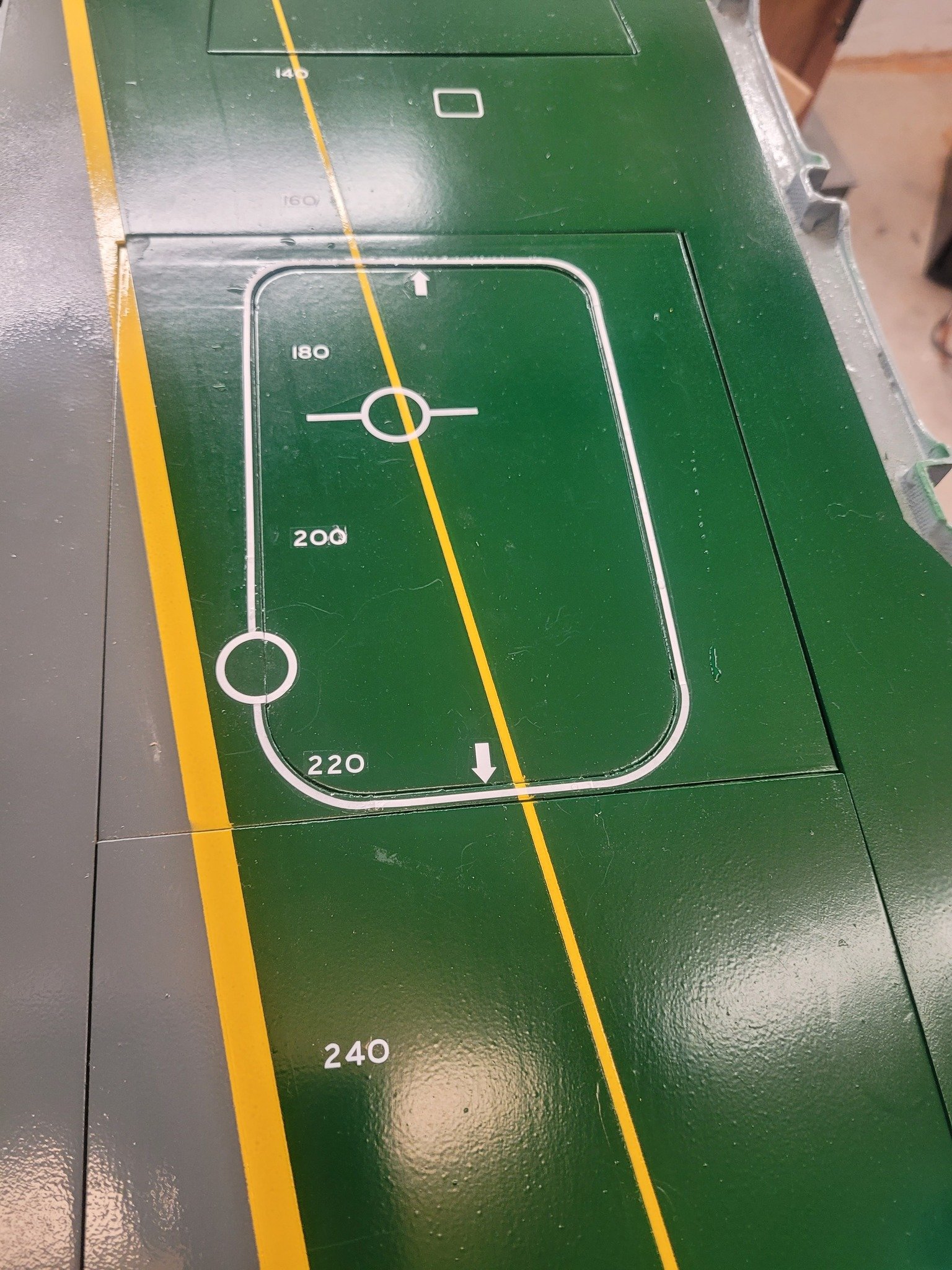

Decals applied - those which I'm going to use at least!

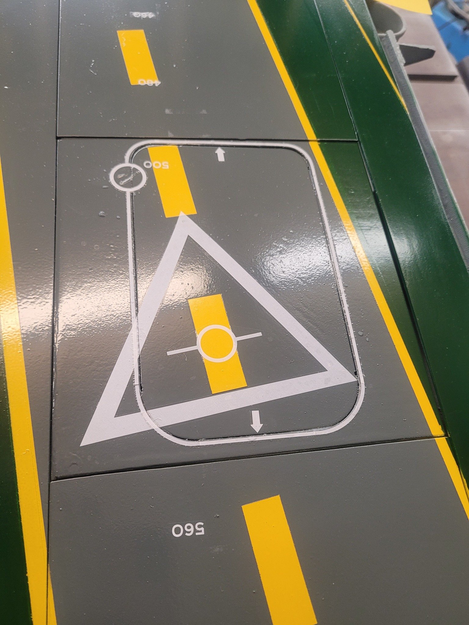

The elevator decals turned out damn near perfect on the forward elevator - the aft elevator is, for some reason, slightly off-center, but at this point it's an error I'm going to have to accept.  The triangle should be basically centered on the elevator - not offset to Port.  Alas.

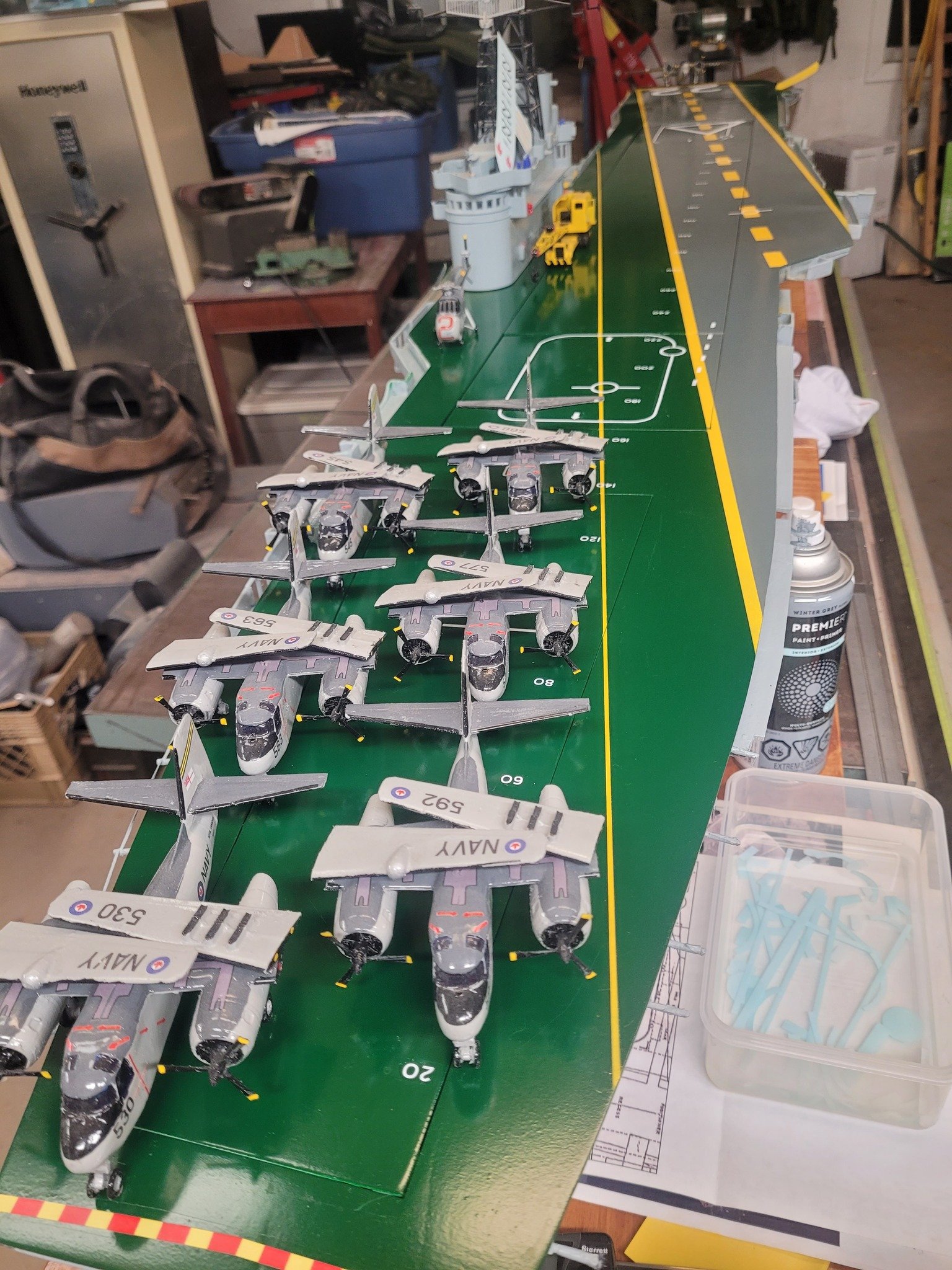

I decided to stack a few planes on the deck to appreciate how things look at this point.
One thing I decided/determined was that the 'center line' dashed stripe decals are too wide to use.  They're about 1/4" wide, and they should be about 1/8" wide.  So, I'm going to end up painting that line on instead of using the decals.  I spoke with the decal supplier, and we agree that this is probably an artefact of scaling the decals up from 1/400 to 1/144 - and now scaling them up to 1/96 for my model.
Before I do the masking, I want the decals to dry and set - and I want a layer of clear coat applied to seal them so that when I mask, I don't accidentally pull any of the decals off.  So - Patience is a virtue!
I have some painting left to do on the deck anyhow because I'm going to paint on the catapult line.

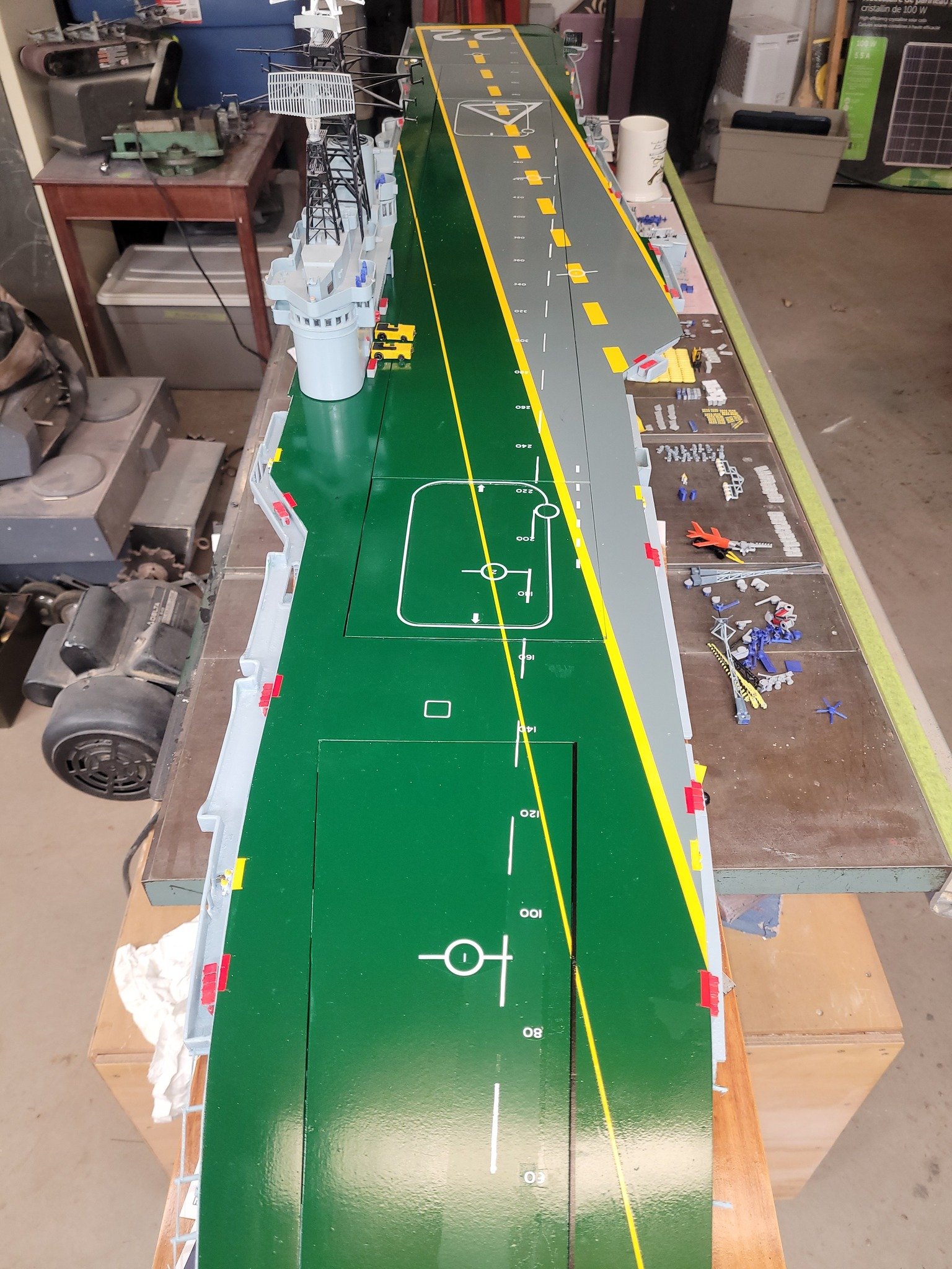

Put a layer of clear gloss on top to seal in the decals.  I now have to paint a couple more lines down the deck - the catapult, and the dashed center line (that's not quite on center for some reason?)

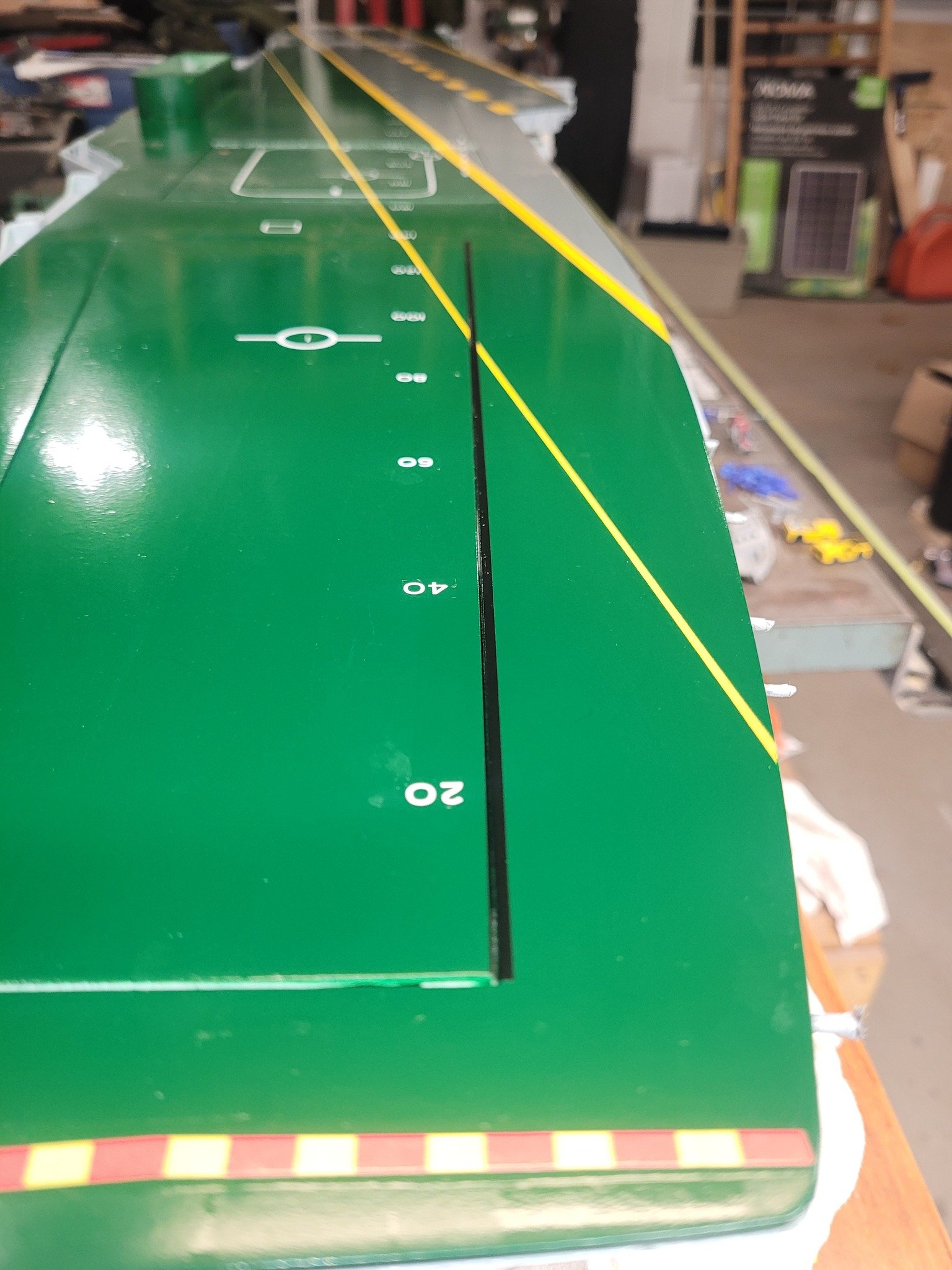

Catapult line masked....and painted.

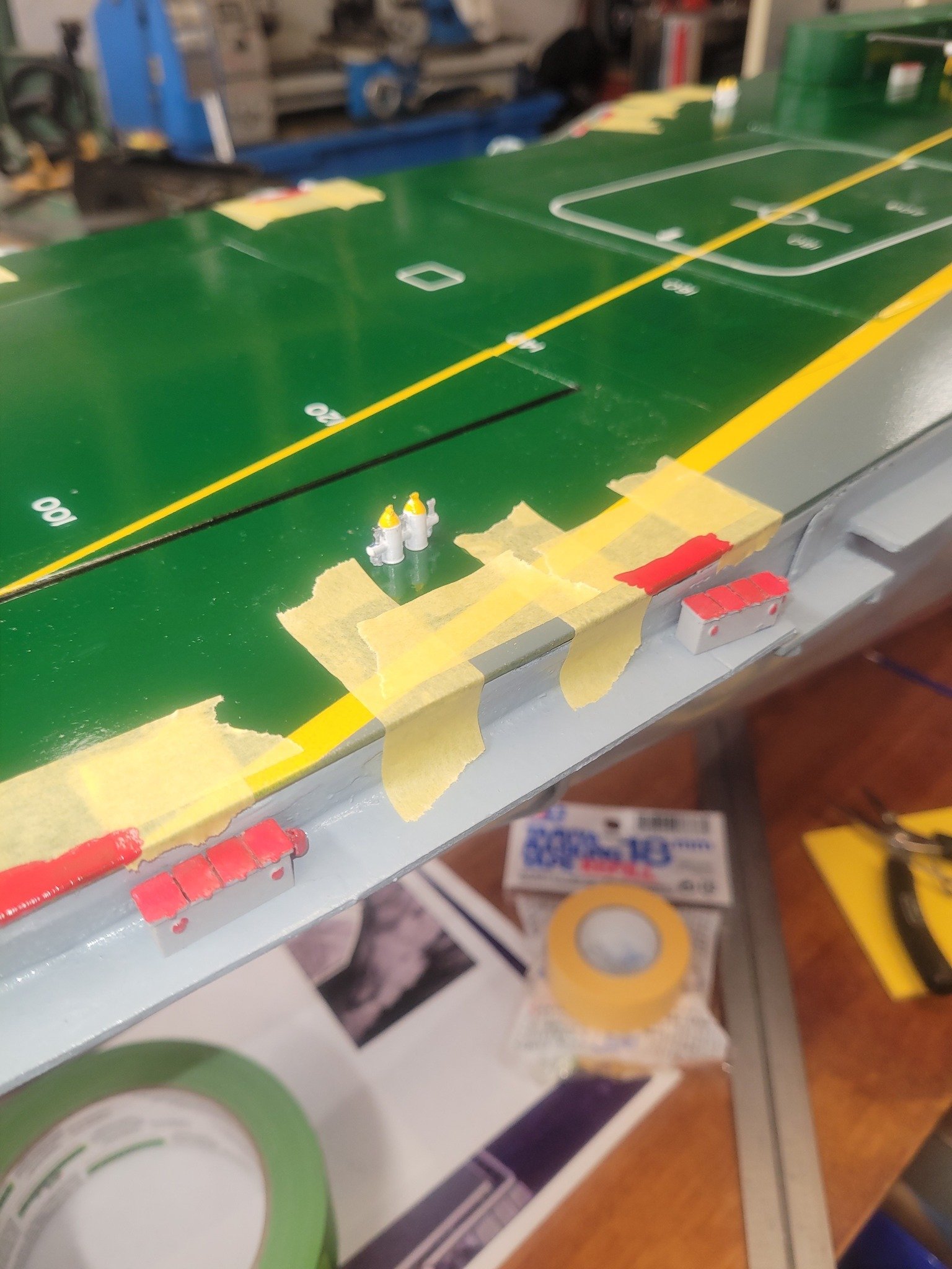

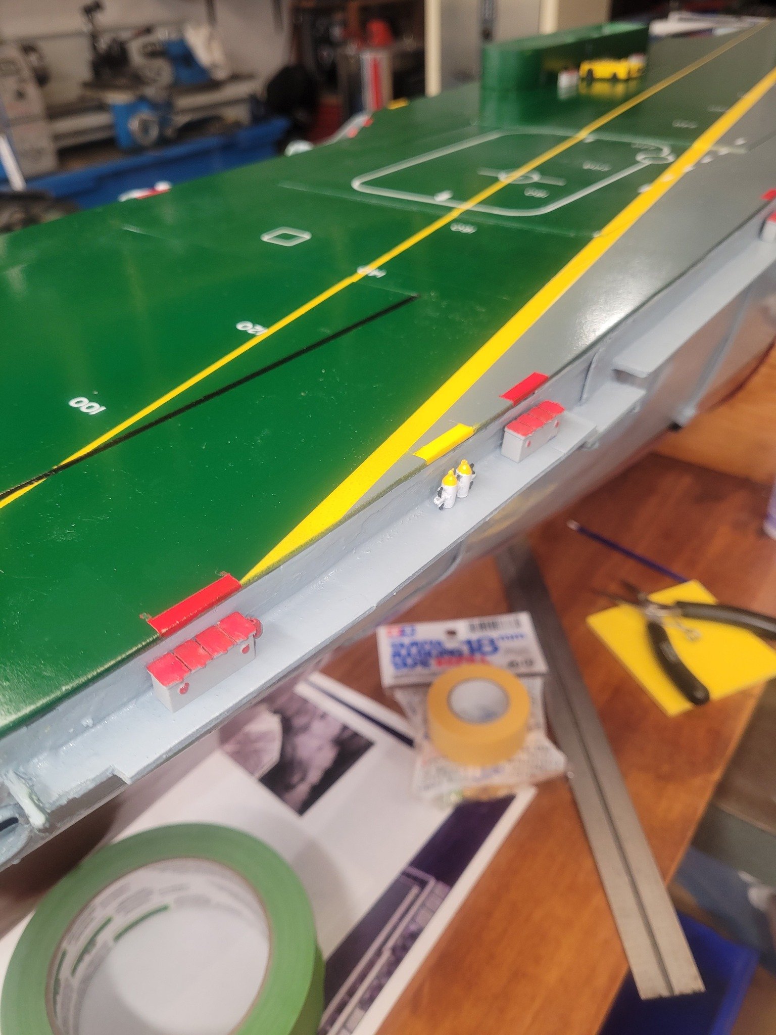

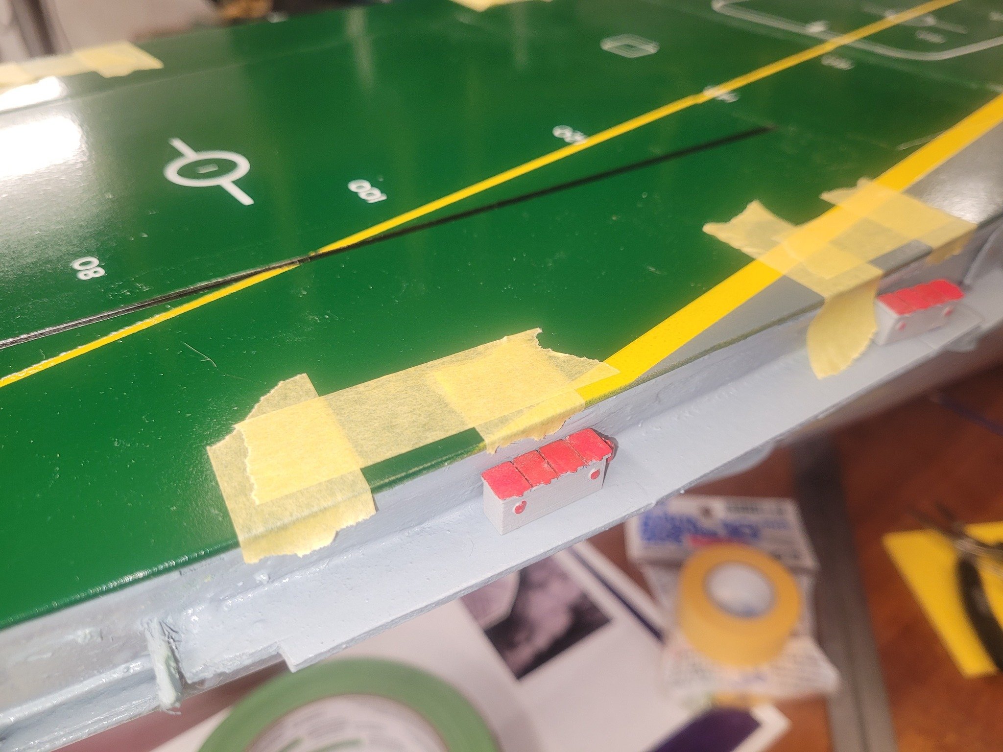

I got the LP Air station and Firefighting locker deck edge markings put on yesterday - there was a tiny amount of bleed under a few edges, but that's fixable.
I initially printed red and yellow decals for these station markers, but the first decal turned out to be basically translucent, so it didn't show up the way I thought it needed to.  Hence the painting....oh well.
I still have the blue power supply stations to do up.
I'm almost at the point of gluing down the lockers along the edges of the deck!

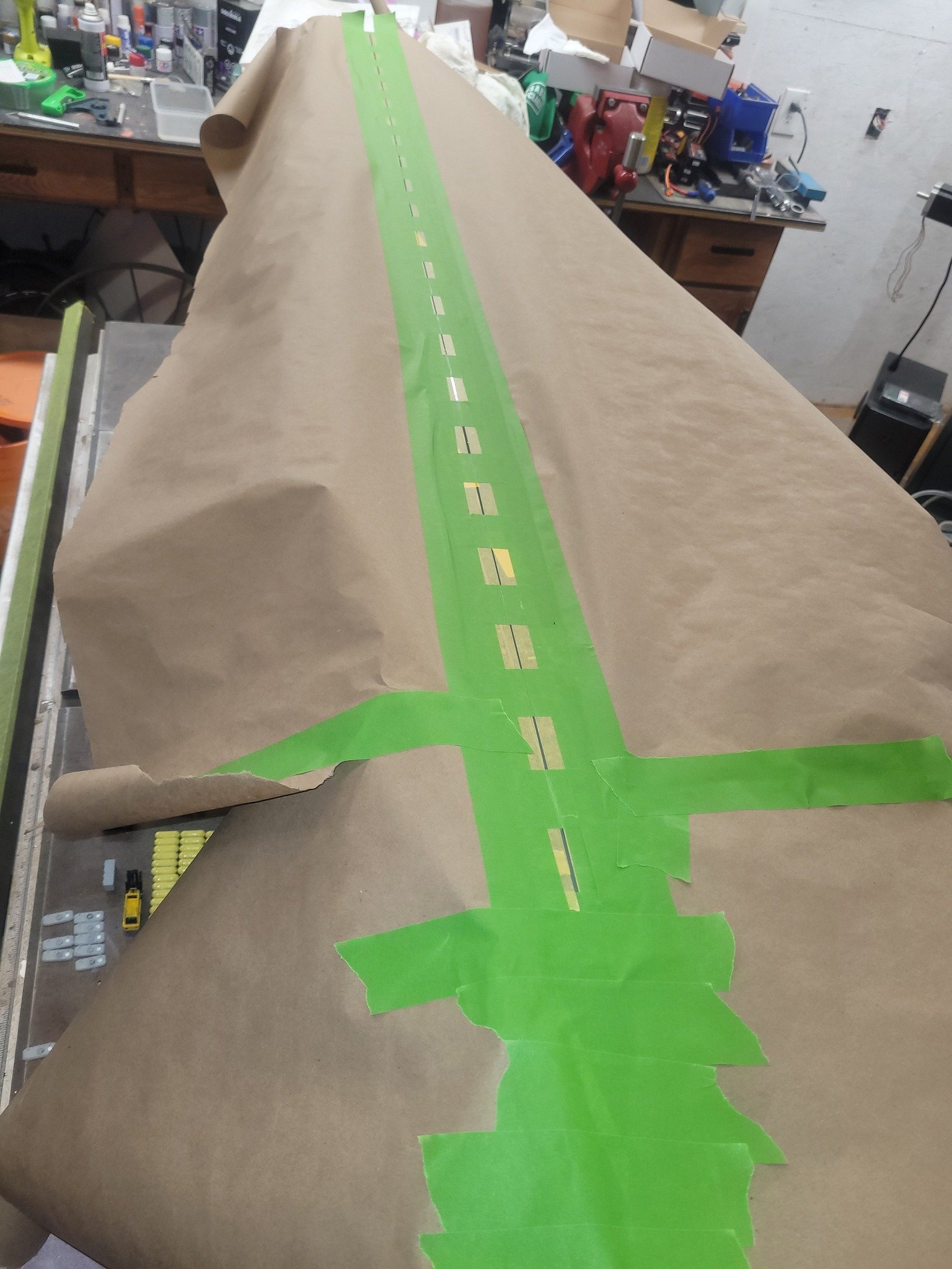

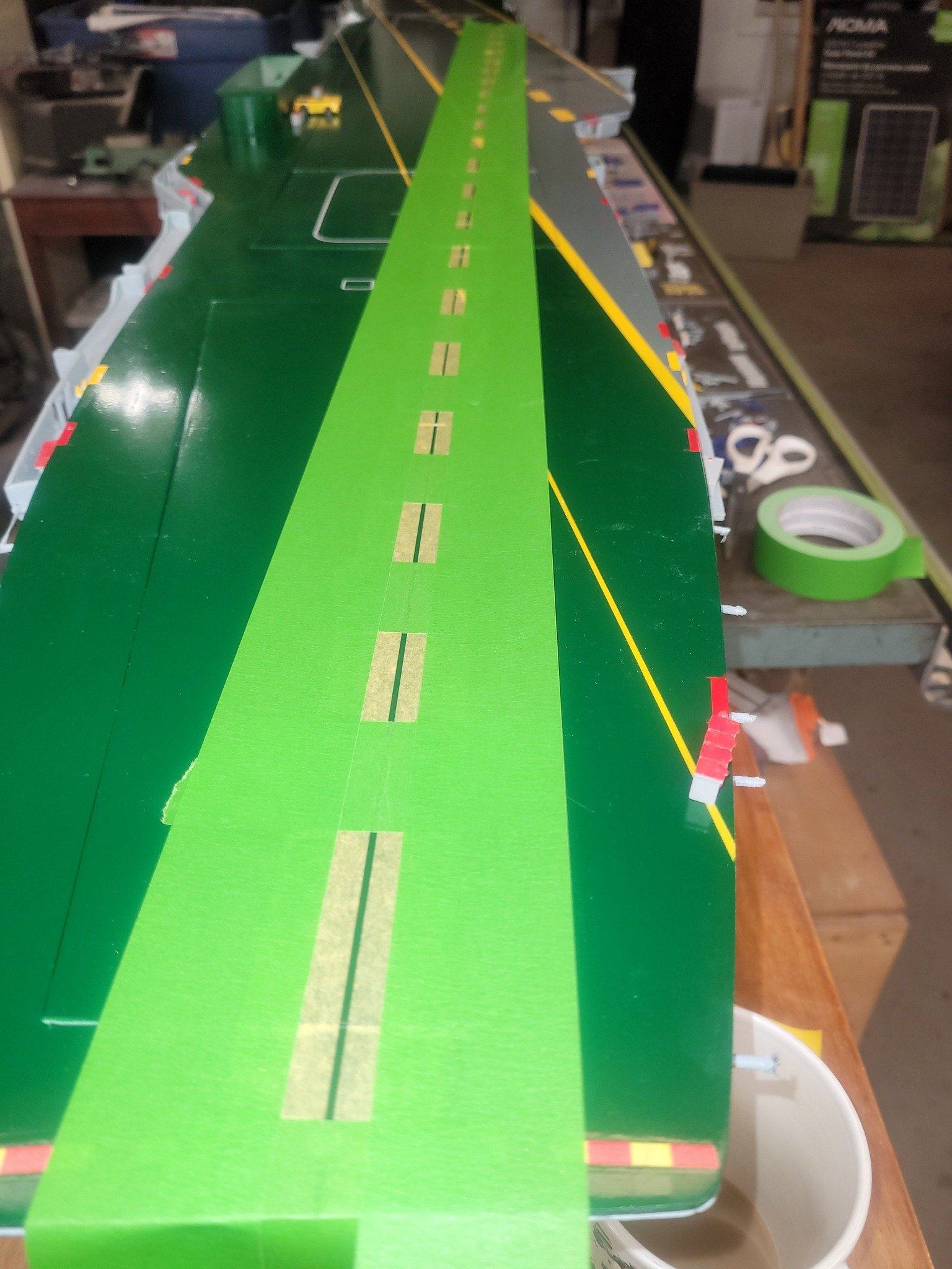

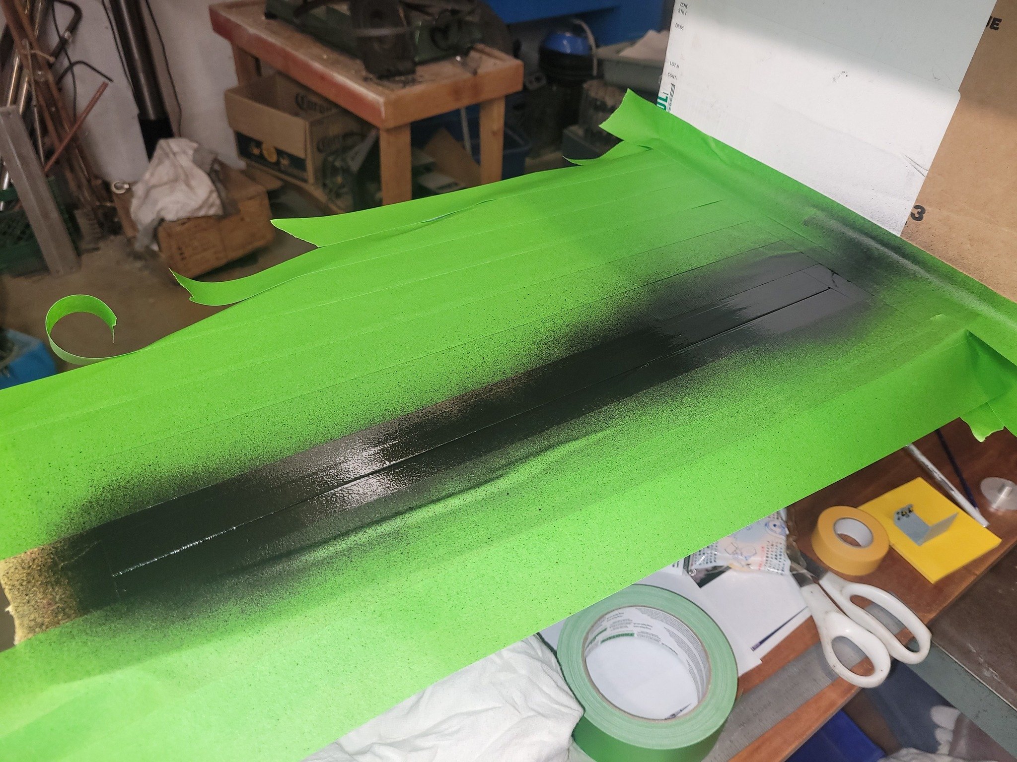

I also masked the launch line yesterday - a very light first coat that will be re-coated tonight to give it some depth.
A LOT of tape for a little bit of paint!

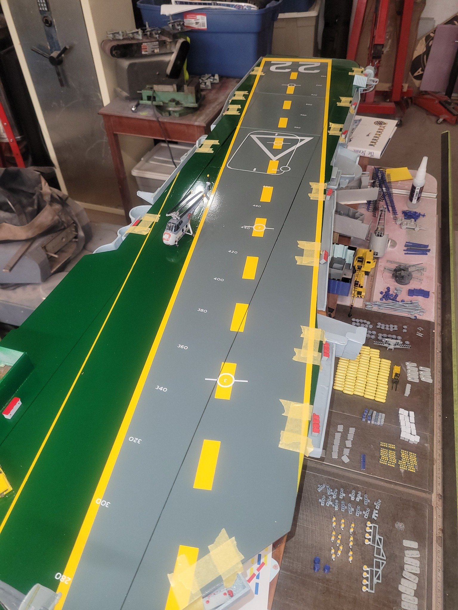

And....we have a line done...and some decal repairs conducted because that Tamiya tape sticks a bit too well...

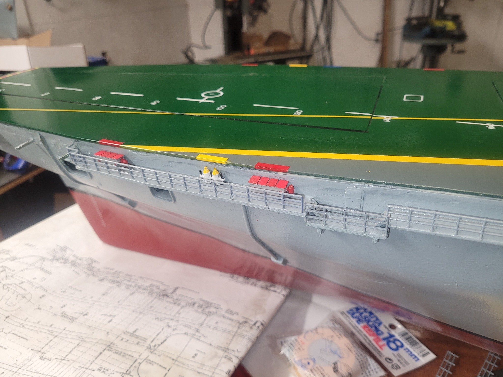

We now have some guard-rails up.  Lots more stuff to add, but a big step in adding details like this!
