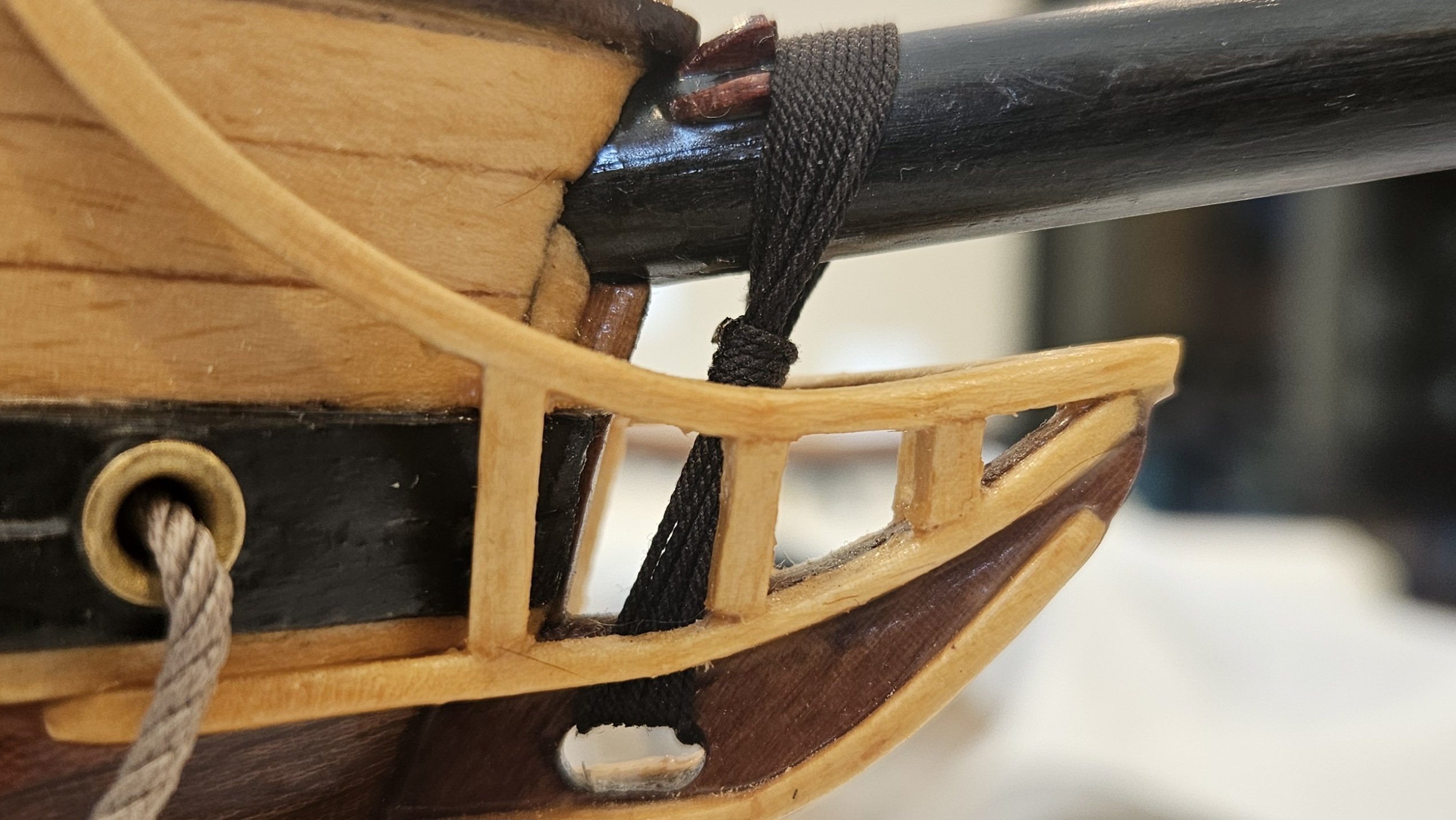

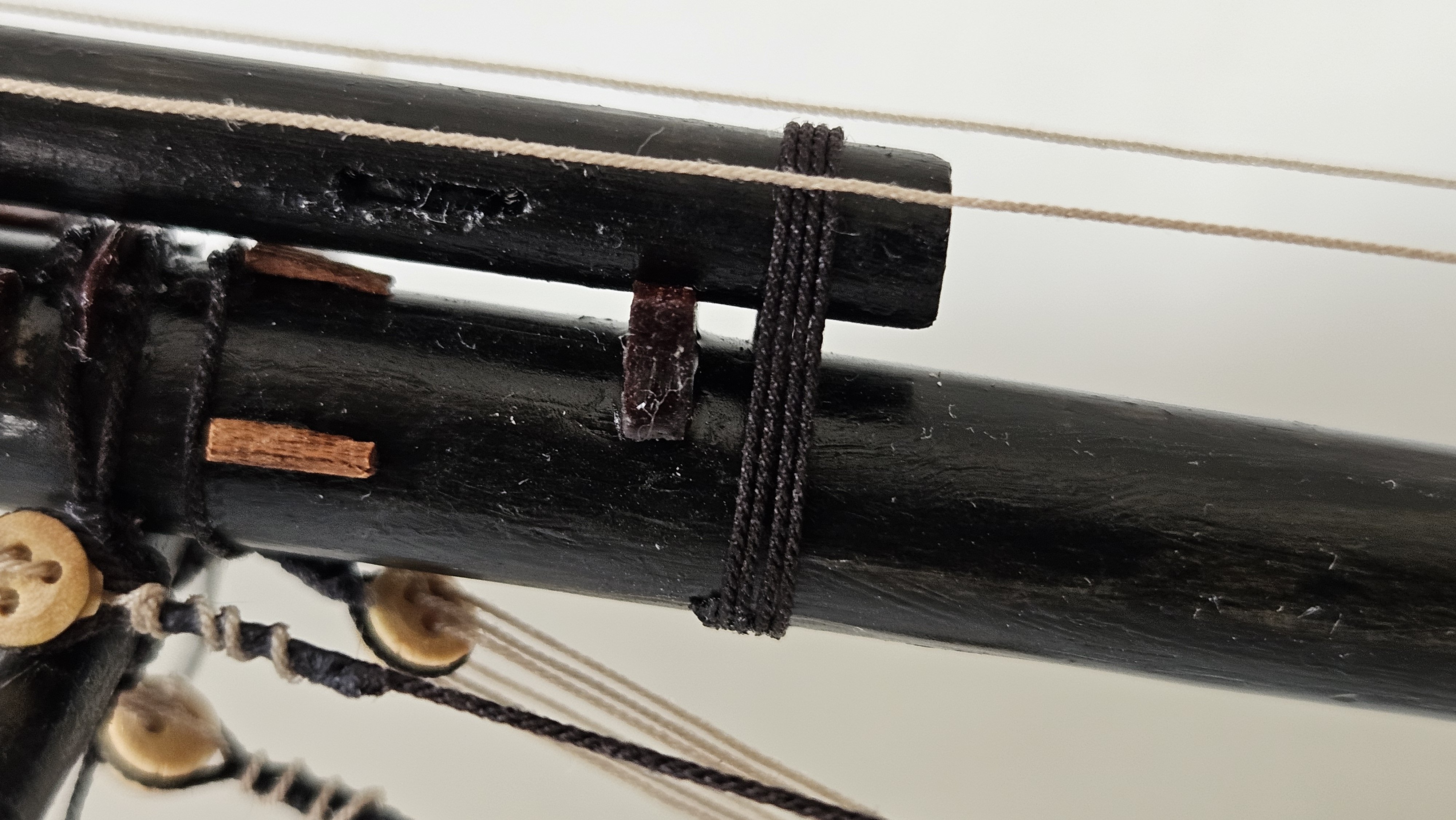

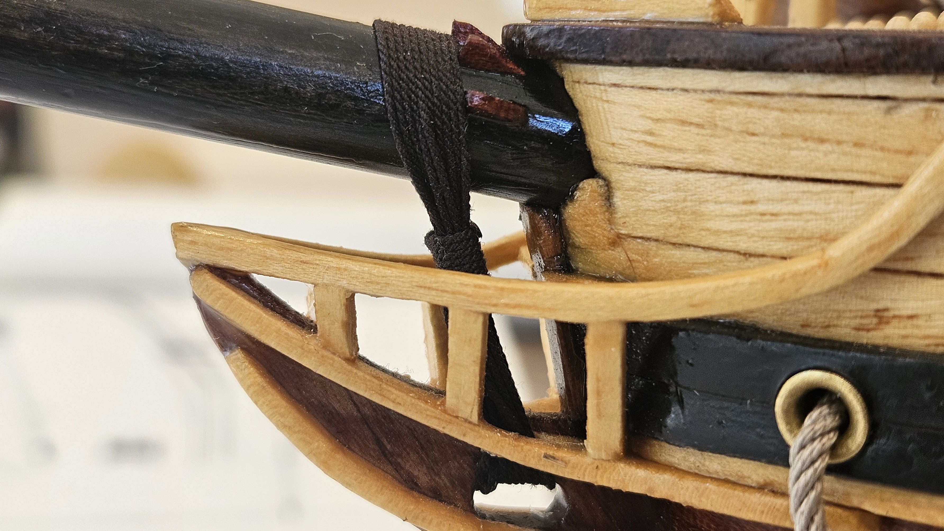

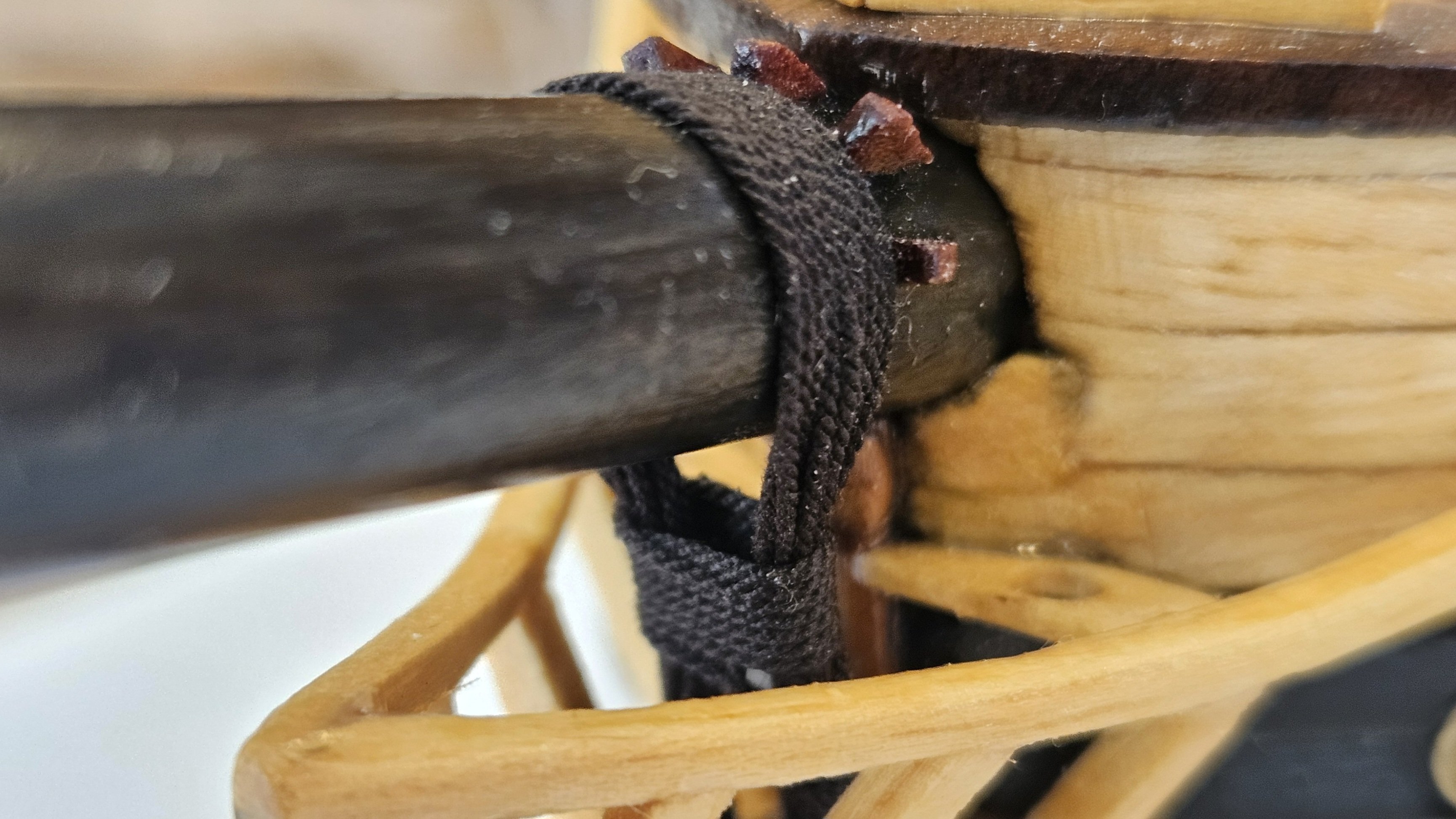

Bowsprit gammoning and frapping turns per Lever.  Let me know if I have issues friends - I think corrections will be more difficult the farther we proceed!
Port:
Starboard:
Frapping turns:
I think bobstays (bobstay and bobstay preventer???) are next on the list.
Thanks for looking in and any comments in advance!
(Lever, Sheet Anchor, Page 19)

Steve,
    The gammoning looks great.  I am glad you chose NOT to serve it.  I agree with Phil, detail is great, but there comes a time when 'close enough' is good enough.  If you worry about absolute authenticity, you will never finish. :default_wallbash:

6 hours ago, Dr PR said:
I think you may have a problem here. You seem to be worrying about it too much!
My thoughts exactly. Don't beat yourself up about it, Steve. For the record, I thing your gammoning looks just fine!

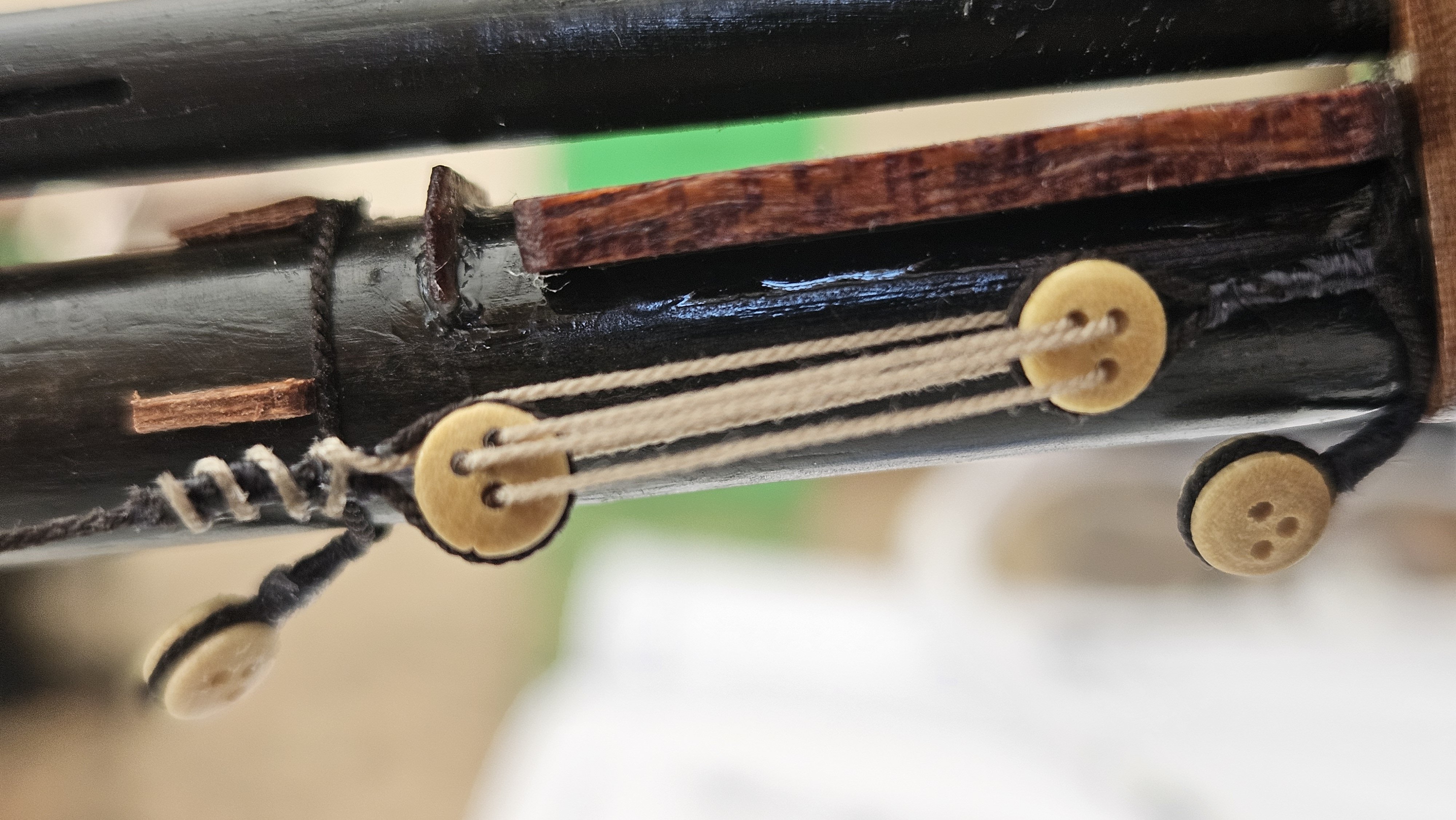

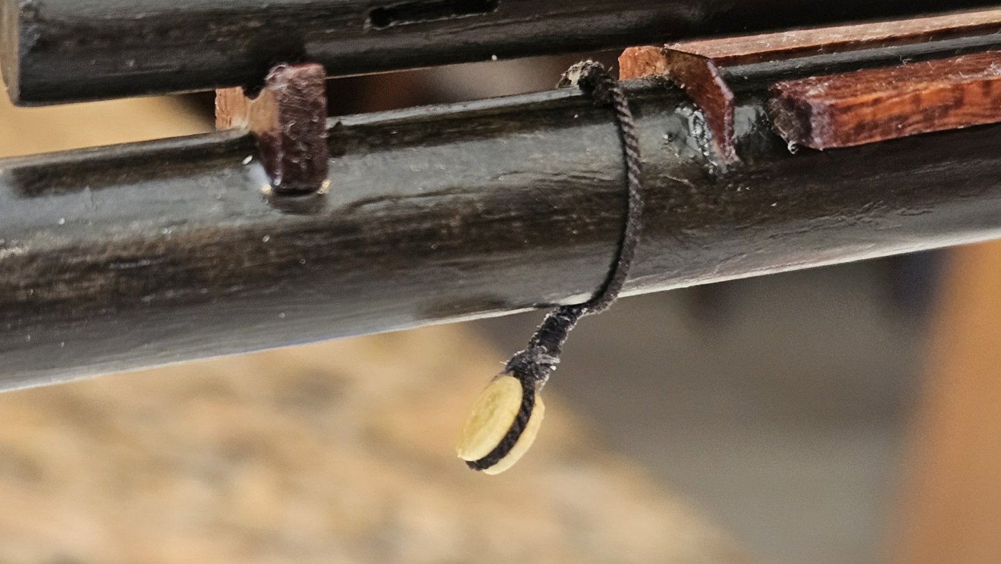

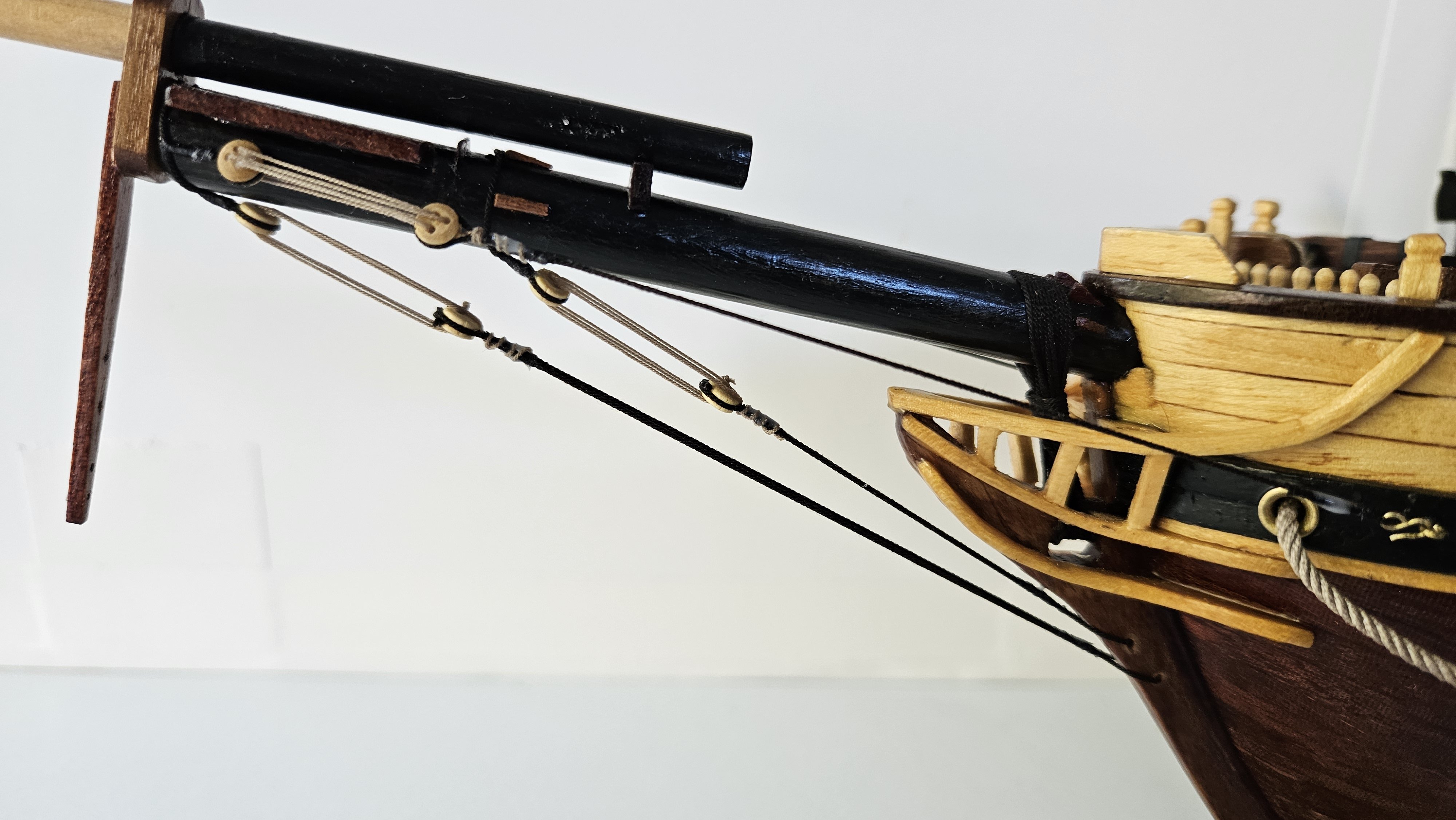

"Rigged" the first bobstay deadeye as well.  (May add a couple cleats for this one?)  Steady as she goes then.
(Lever, Sheet Anchor, page 21 fig 156 and Chapelle's rigging plans)

First deadeye rigged.  Like, ever.
(Petersson, Rigging Period Fore and Aft Craft, pages 76 and 77)
Edited by Coyote_6
Steve
San Diego Ship Modelers Guild
And you did a fine job of it sir... like you have been doing it all yer life matey 🤣🤣

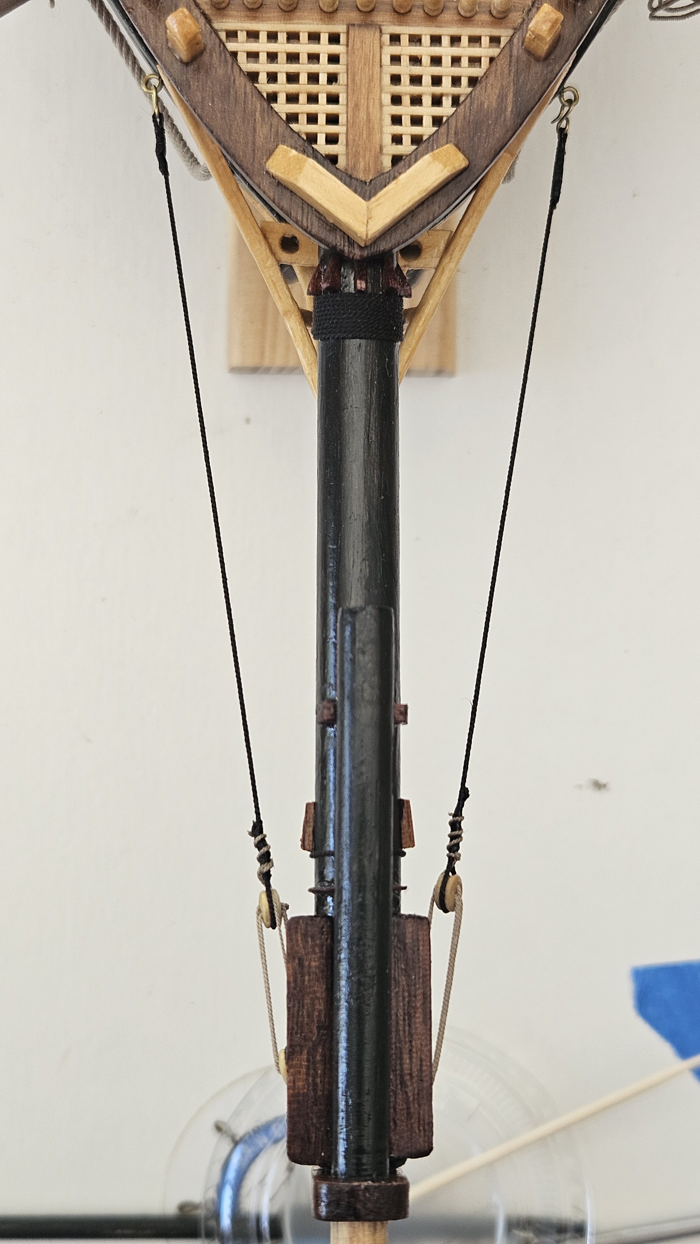

Bowsprit Shrouds.
(Syren Ultra Brown 0.025",
Syren Ultra Tan 0.012")
(Marquardt, The Global Schooner, p.169, figure, index 7 and Chapelle's rigging plans)
Edited by Coyote_6

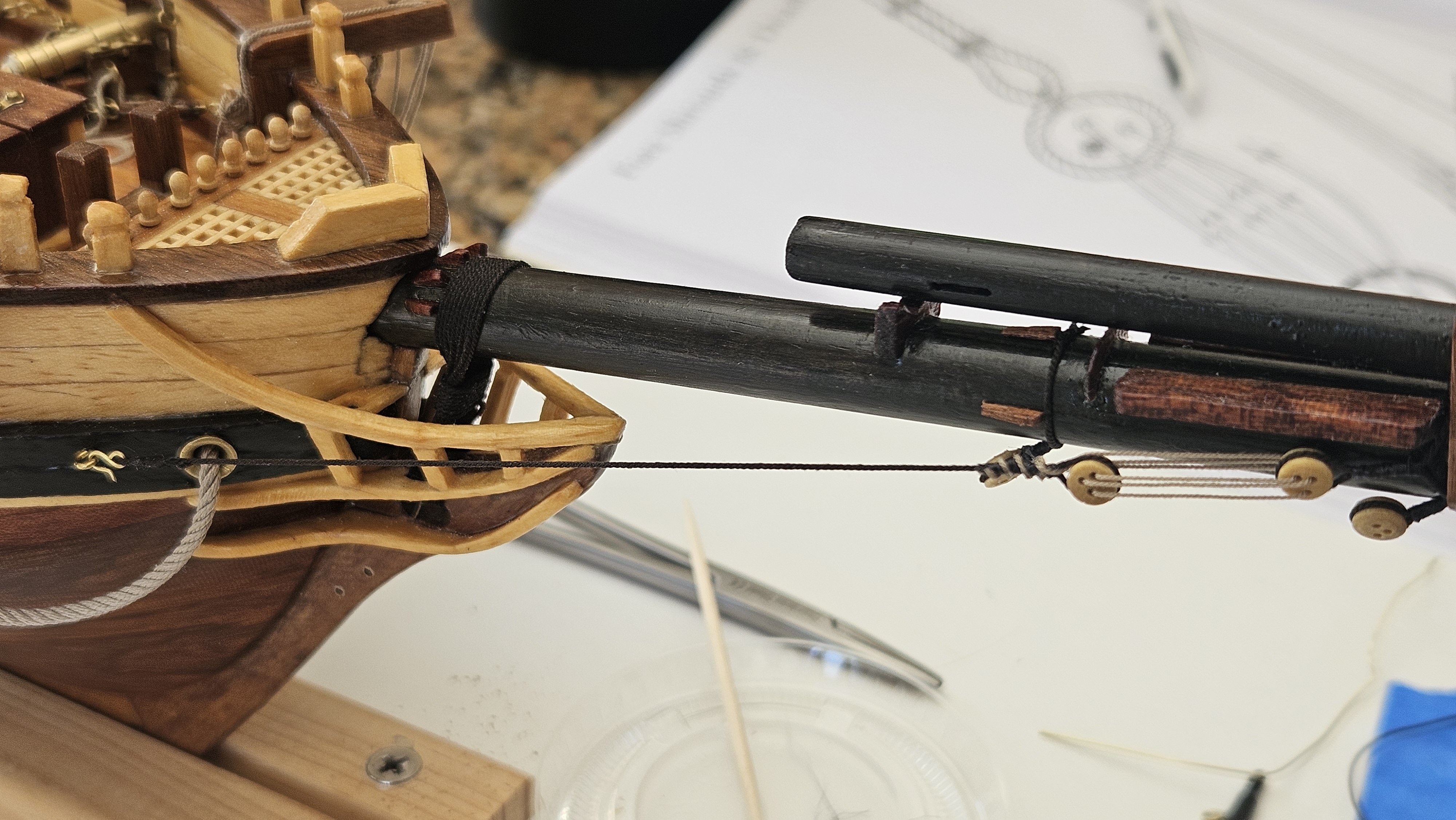

And finally closing the weekend with the bobstays.
(Syren Ultra Brown 0.025", Syren Ultra Tan 0.012")
I am thinking I might be needing some masts soon to continue rigging?
Anyway, thanks for checking in and for any and all comments/advice.
(Marquardt, Global Schooner, page 169, figure indexes 2 and 8, Petersson, Rigging Period Fore and Aft Craft, page 84, and Chapelle's rigging plans)
Edited by Coyote_6

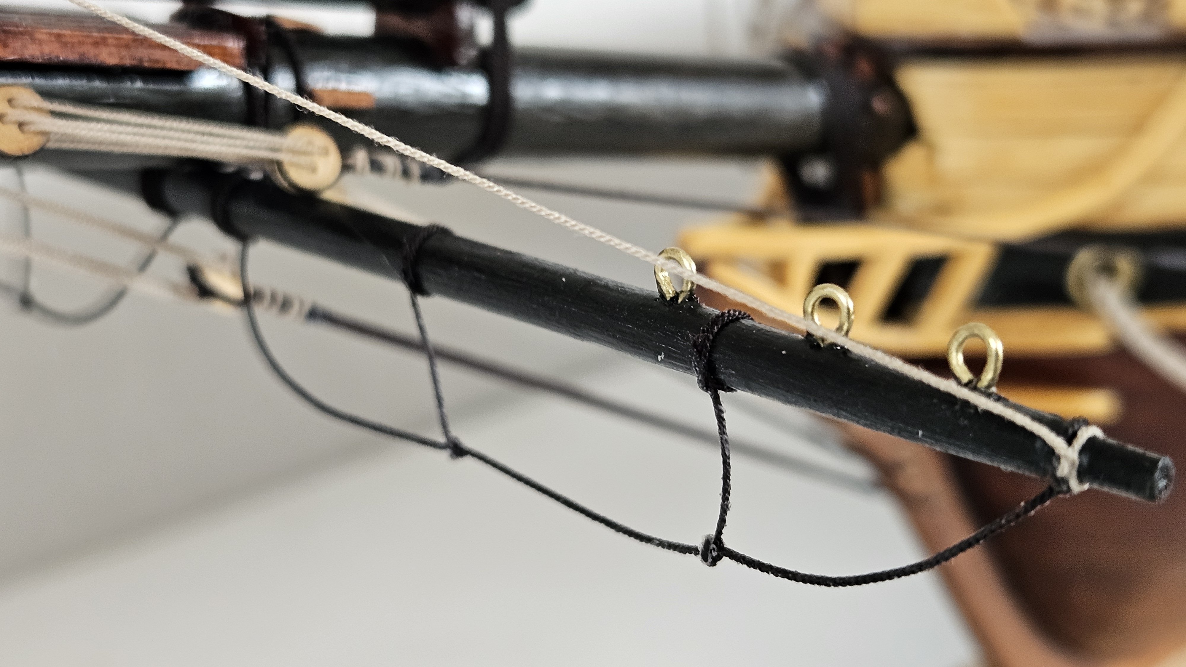

Hope everyone is doing well.  Progress for the weekend:
Heel lashing for the jibboom.  Lever (page 20, fig 152) says heel lashing/gammoning would be nailed to the bowsprit with a leather washer under the nailhead.  5 turns of Syren ULTRA 0.025" Ultra Brown clipped taught above the jibboom.  Bead of superglue along the turns at the bottom of the bowsprit.  When dry, removed clip and trimmed off loose ends on the bottom leaving 4 clean turns.

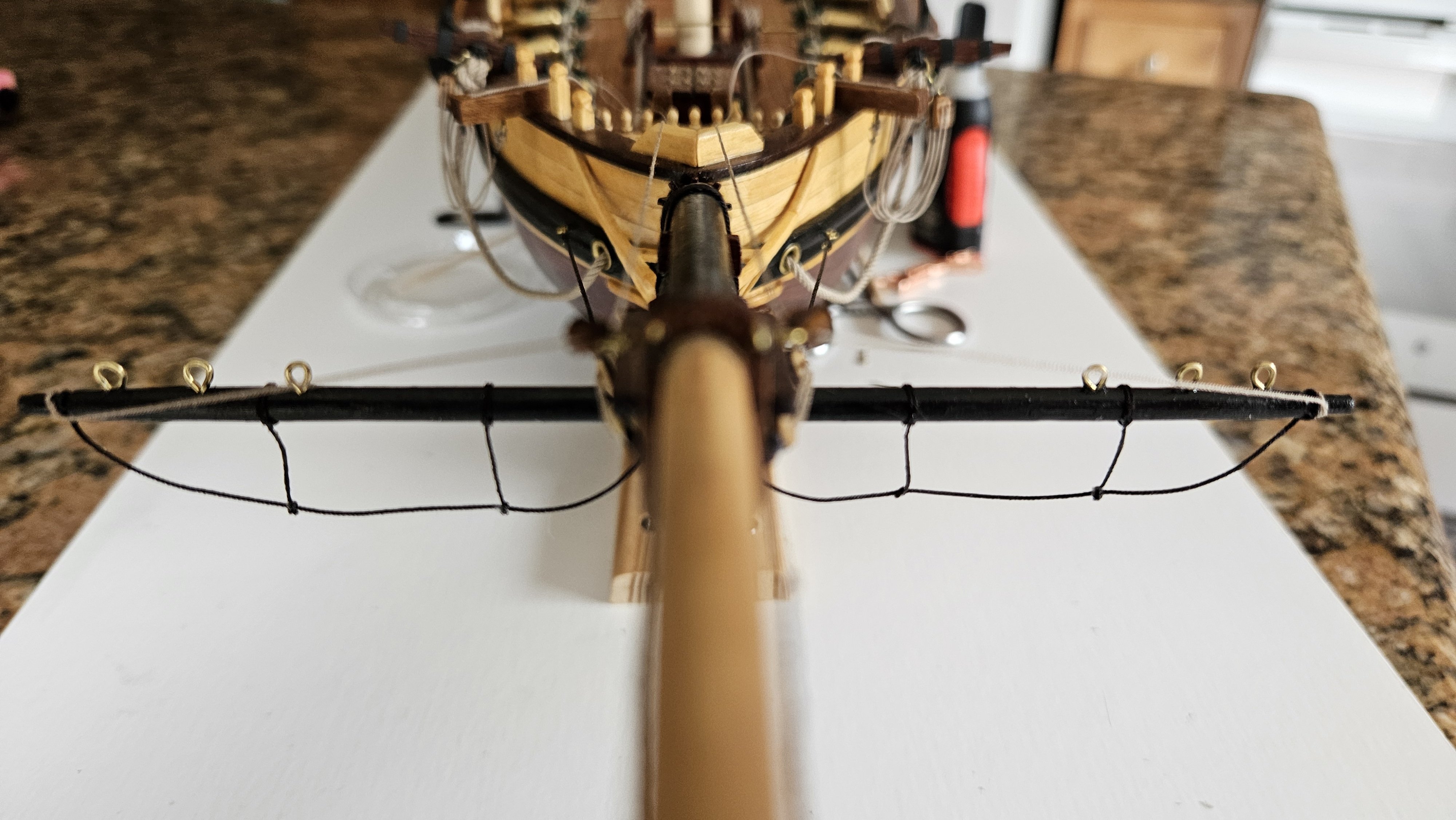

Spritsail yard horses and stirrups (Smithsonian Rigging Tables for PdN, 1964).
Smithsonian plans list horses and stirrups.  Clove hitches at the spar, overhand knots at the horse, dab of superglue to hold them.  (Ship Modeling Simplified, Mastini Figure 55, number 6)
Syren ULTRA 0.018" for horses.
Syren ULTRA 0.012" for stirrups.
Stiffened with 50/50 diluted Elmer's School Glue.

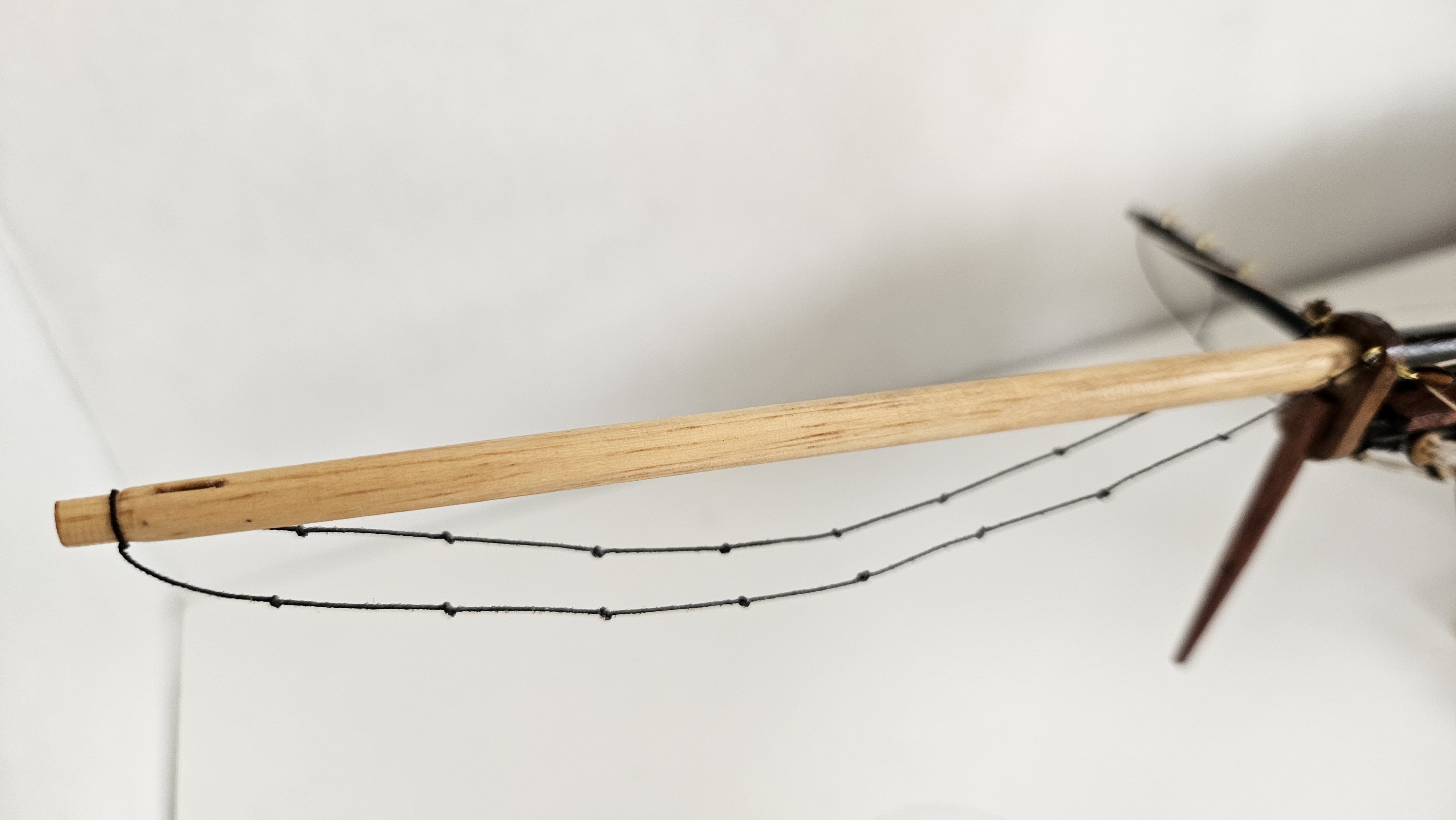

Footropes at the jibboom.
Chapelle plans.  Syren ULTRA 0.012" line.

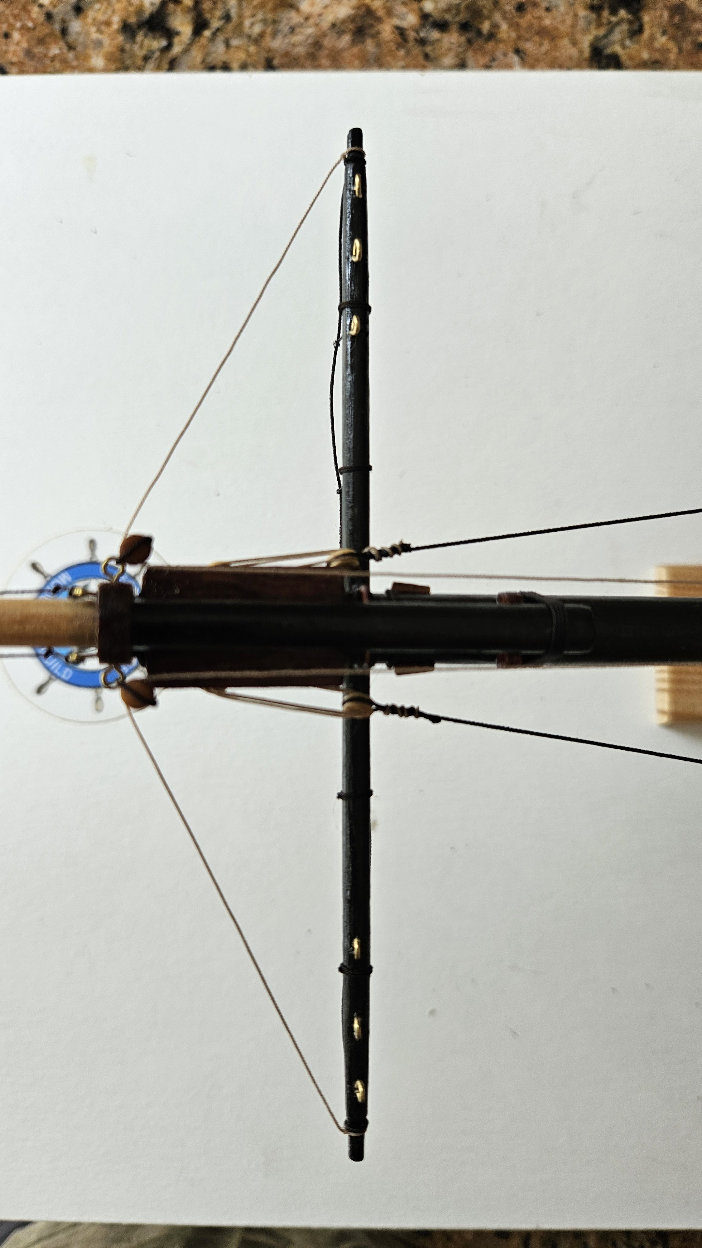

Spritsail yard lifts.
Chapelle plans and Smithsonian Rigging Tables for PdN.
Syren 5/32" blocks.

Nice and precise, Steve. I like the work on those footropes, the knots are all well tied and neatly spaced. She is coming along very nicely!
