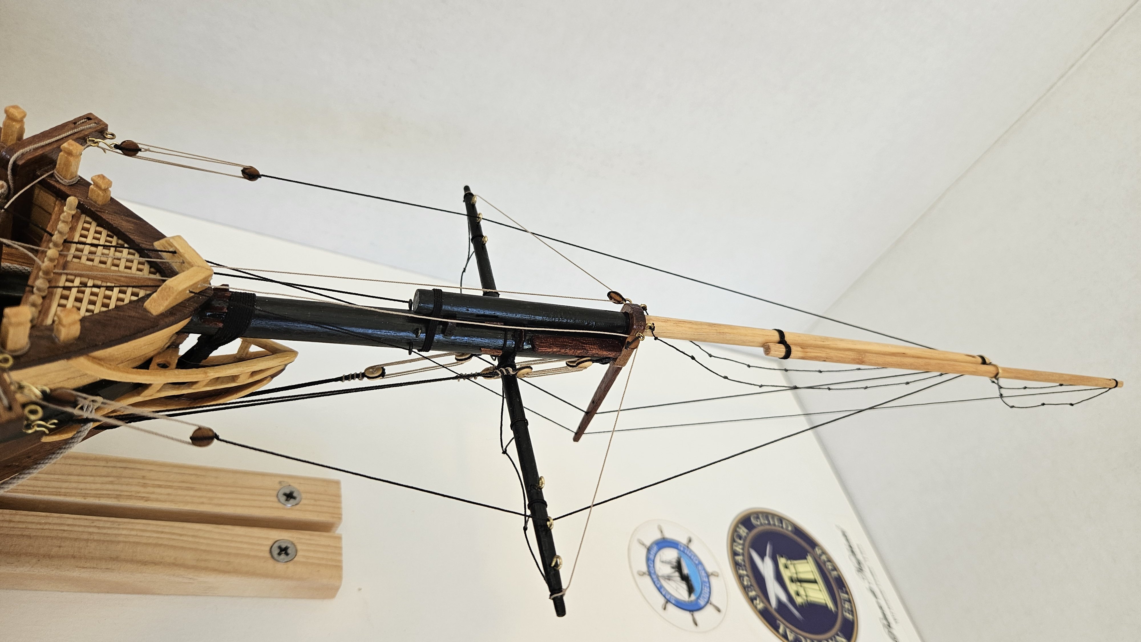

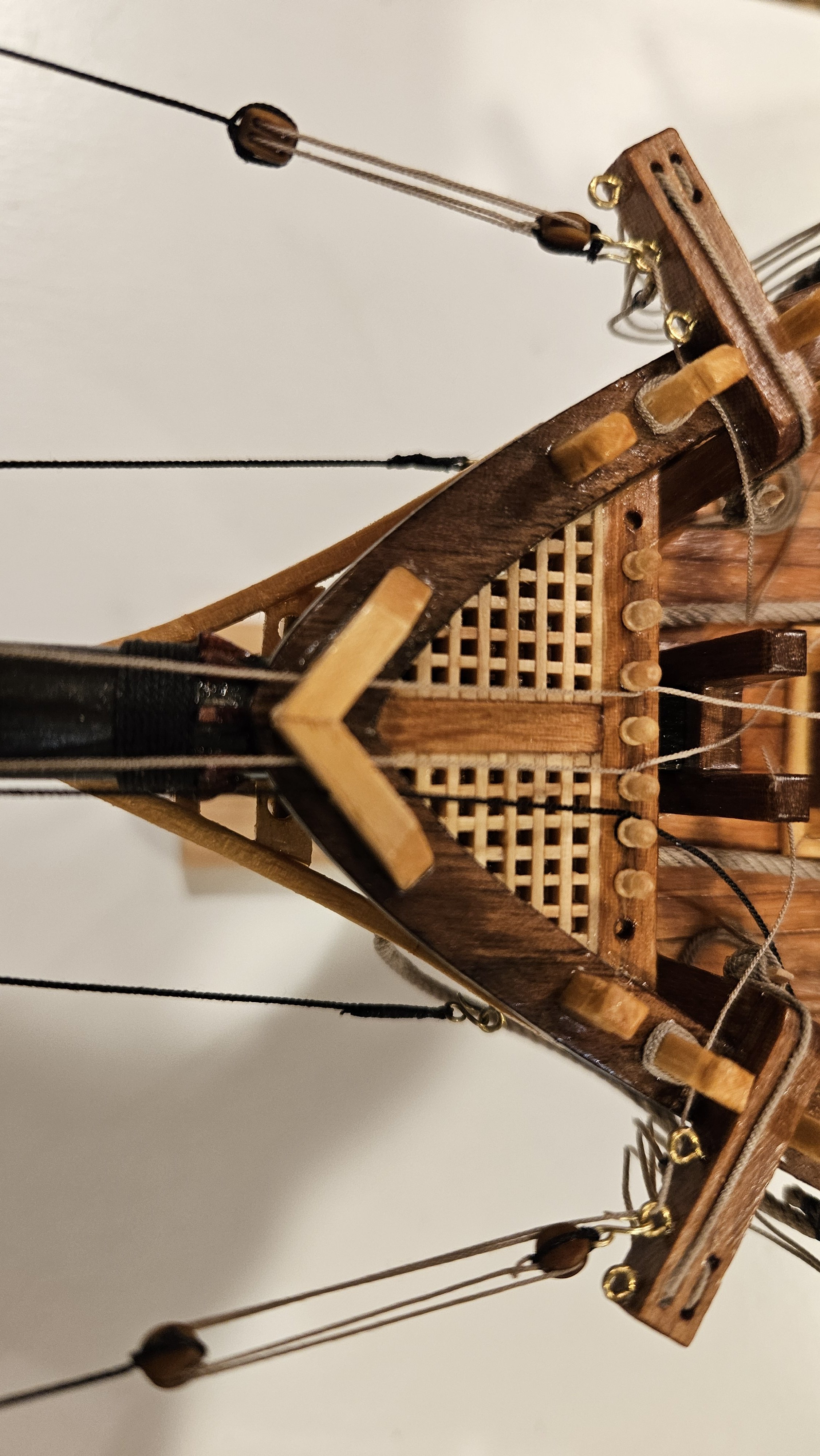

Jibboom guy pendants - 0.018" Syren ULTRA brown.   (Chapelle plans and Smithsonian PdN Masting and Rigging Tables.)20250724_215029.thumb.jpg.902ad39240648f0cd9d06e93e63c0bf7.jpg
The falls (lanyard).  Port and starboard, 0.012" Syren ULTRA tan.  Placed my port block on the pendant 1/8" too far forward, but alas.  Not gonna burn a foot and a half of line to redo that.  Blocks are Syren 3d printed 5/32", 2 doubles and 2 singles).
Brought the fall/lanyard inboard.  Tied off on the bollard, and I'll let 3 scale foot drop down to the deck against the bulkhead.  Enough for the sailors to work with if need be.

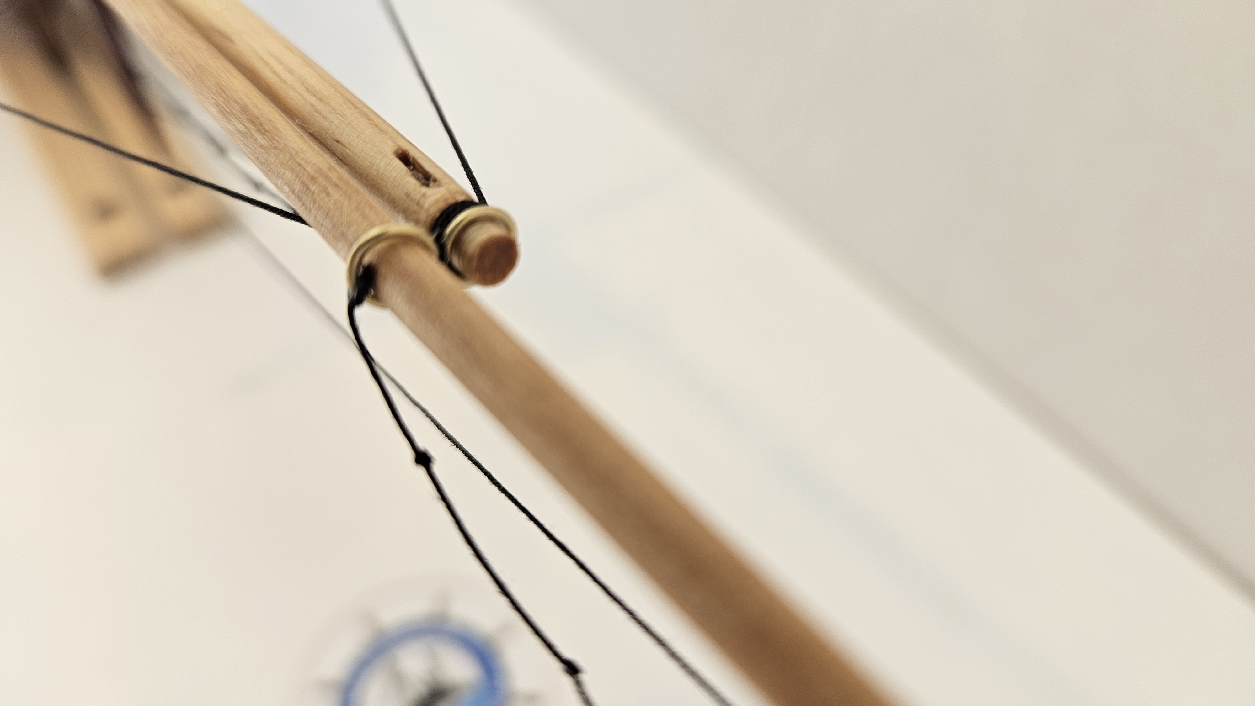

Jibboom Martingale line was next (Syren 0.018").
Then installed the Flying Jibboom with a homemade brass wire guide fore and a 0.012" line heel lashing aft.

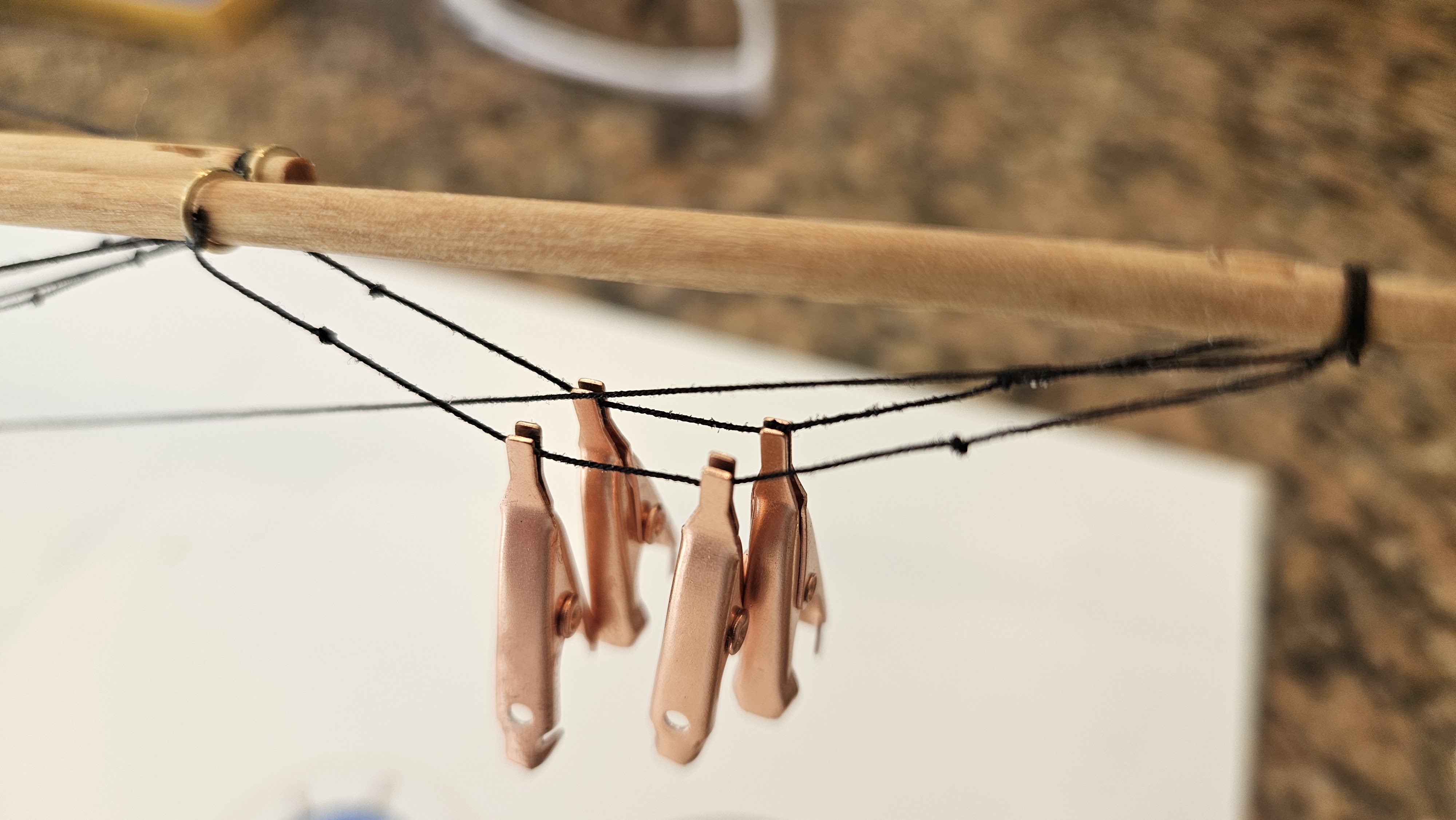

Next came the Flying Jibboom footropes from 0.012" line (slightly smaller diameter than the jibboom footropes).  Here I have rubbed them with dilute 50/50 Elmer's School glue and "training" them with the little copper clips.
Finally the Flying Jibboom martingale from 0.012" line (also slightly smaller diameter than the jibboom martingale).
Next up will be the flying jibboom guy pendants.  I realize I will have a challenge installing travellers on the jibboom and flying jibboom - I am hoping to fabricate in place.  (🤪)
Any advice or corrections are welcome and appreciated.

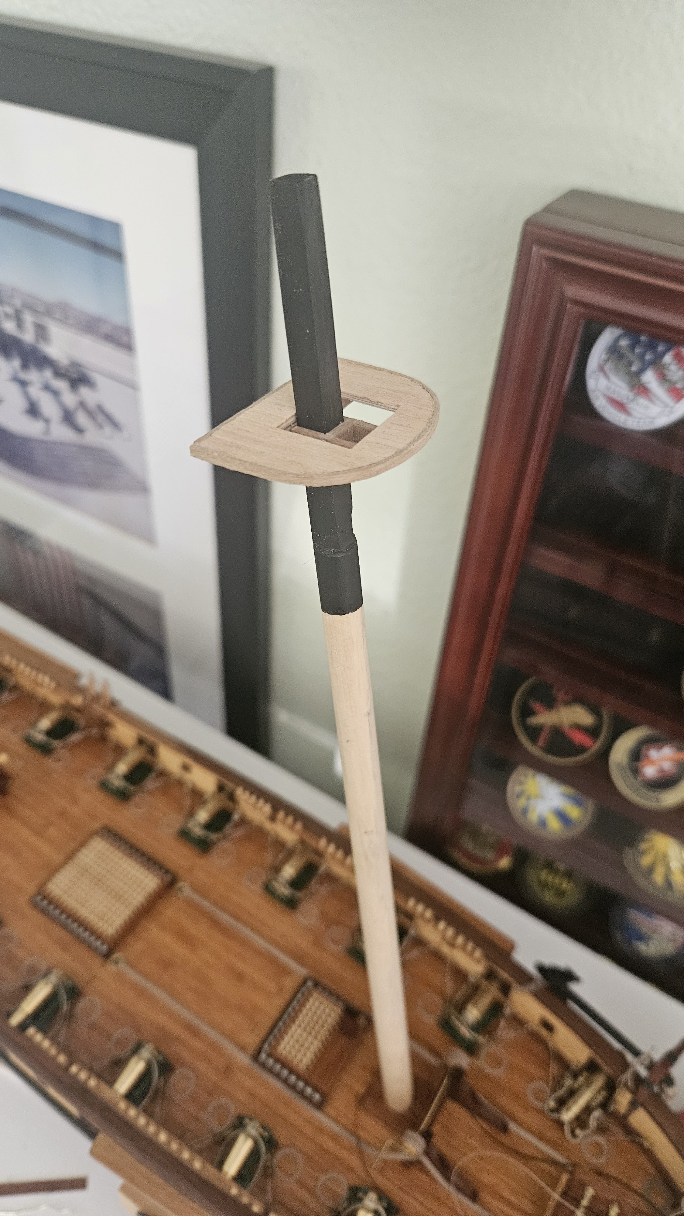

On to new things.  Shaped the fore mast.  "Turned" it with a cordless drill and some sandpaper.
It is expedient to put together kit supplied parts instead of making from scratch.
Stained from just below the hounds up.  Still need to set it up for the cap, so well have to get out the black stain again.  But at least you get the idea with the below mockup.

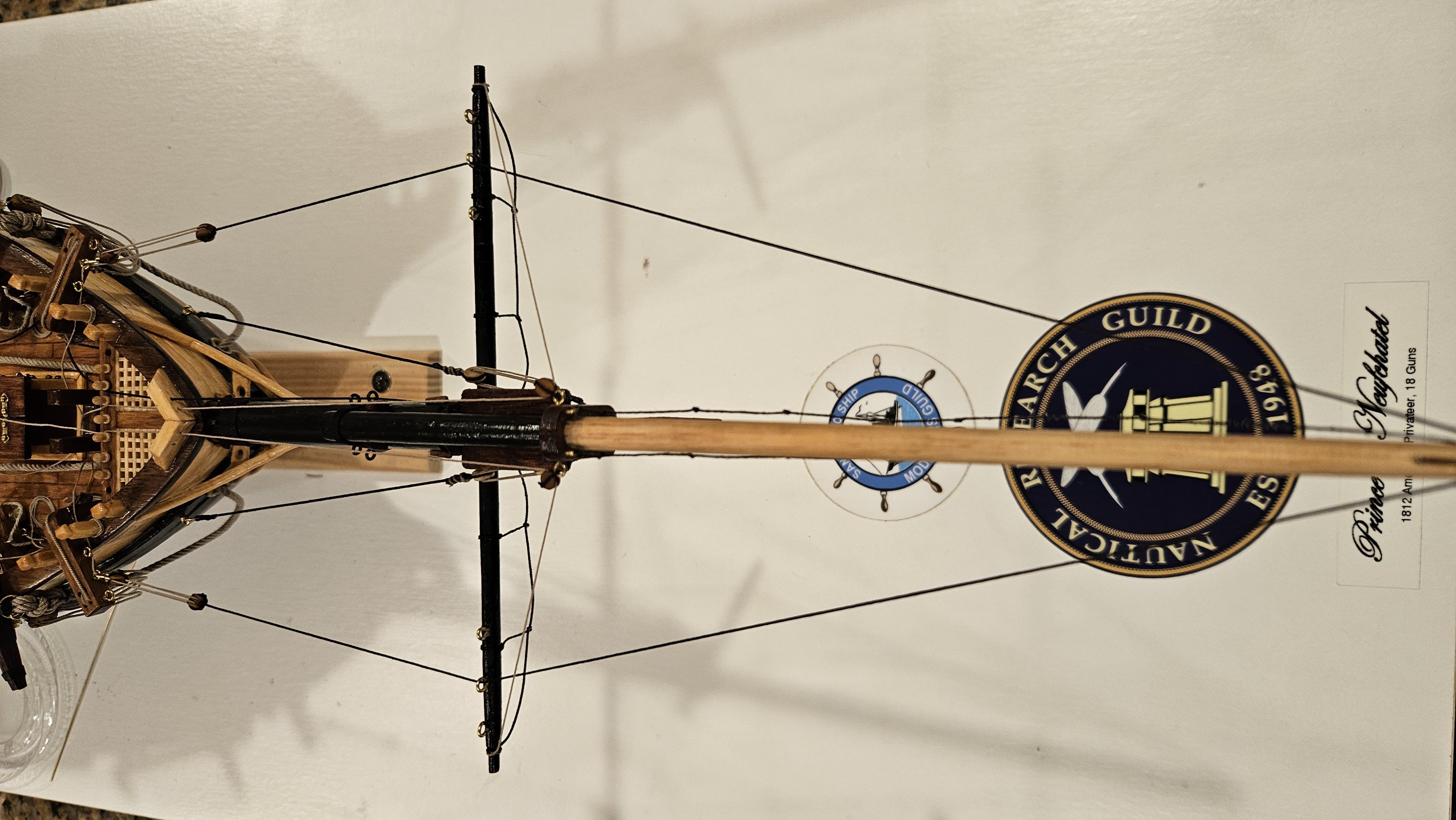

Some random progress over the last week or so.

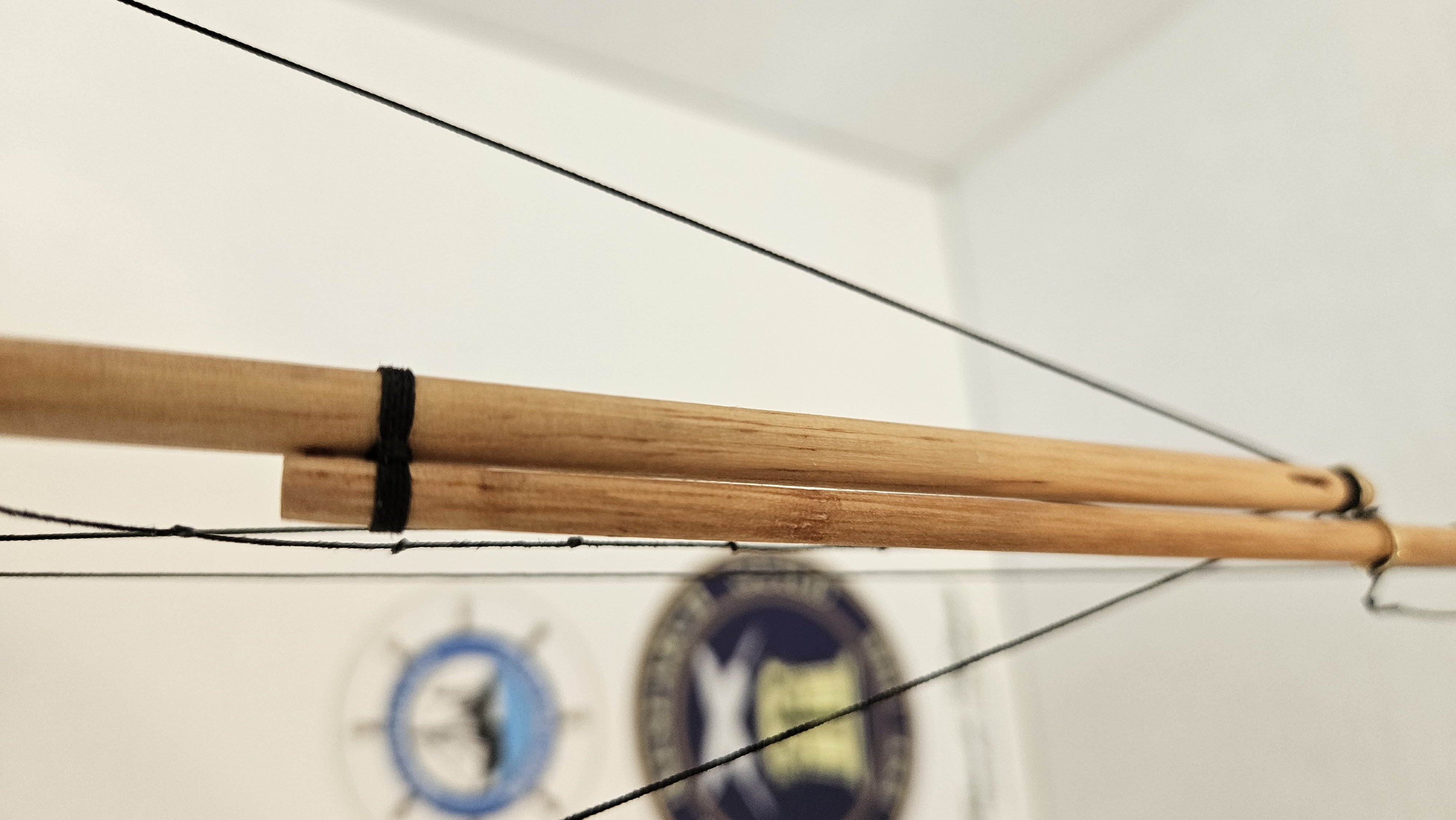

There has been much gnashing of teeth on bowsprit rigging (particularly as it relates to the travellers), and still there are questions.
Detail of the jib boom traveller:
And the flying jib boom and jib boom travellers together.
  @Dr PR provided invaluable insight on martingale spar(s), martingale lines, and traveller rigging.   As I type this I believe we will have it sorted - jib boom traveller inhaul, port and starboard, through the staysail yard rings to the catheads.   Flying jib boom traveller inhaul running the centerline via a block at the traveller.  So many lines - yikes!!
Some work on the foremast - top-o'-the top. (Should probably be all black but natural wood looks nice - can always stain or paint it later?)
Bottom-o'-the top.

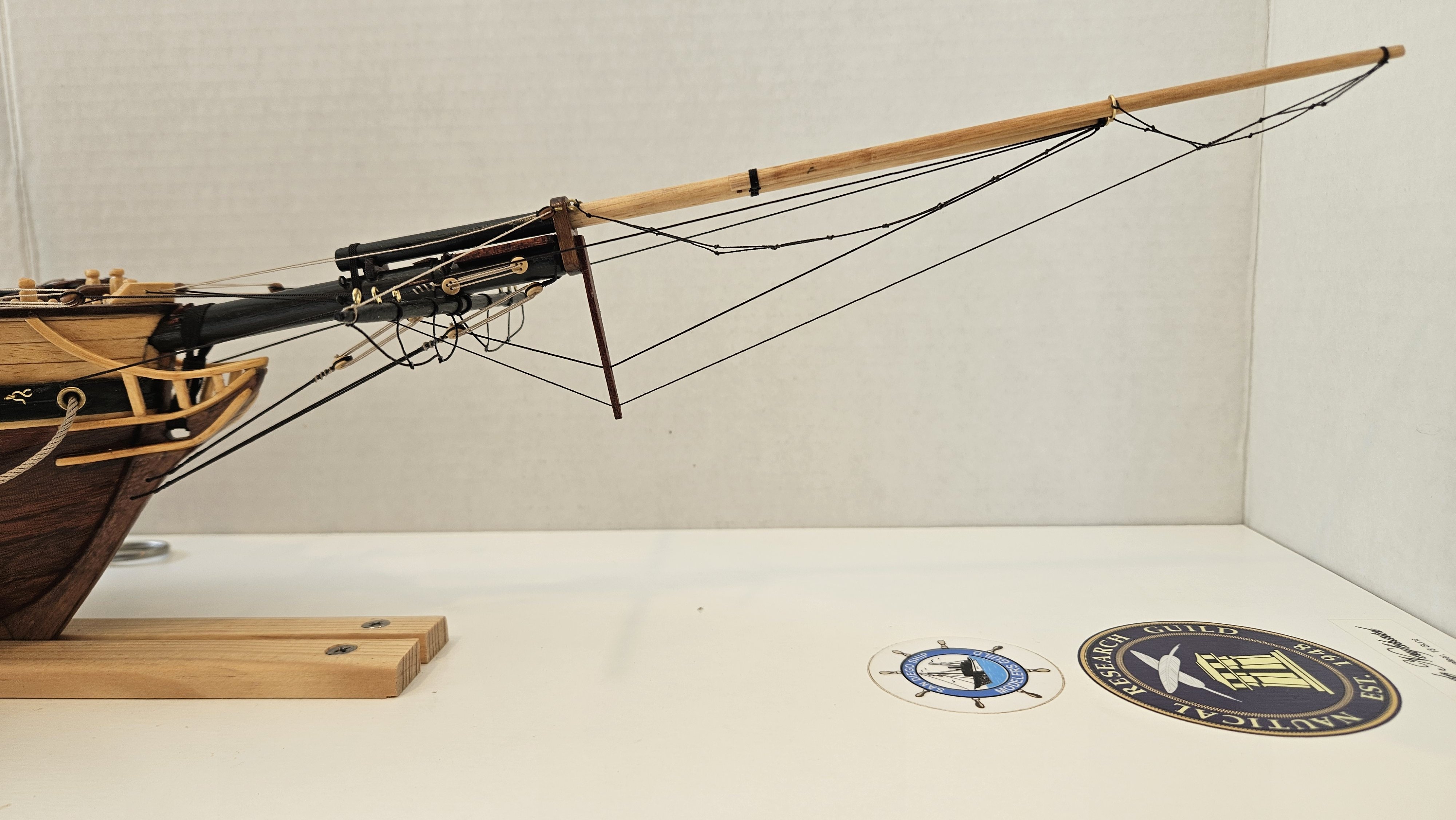

Good progress today.  Have all the lines through the eyes in the staysail yard:
Outboard:  0.012" line for the flying jibboom guys.  0.012" lanyards. (Chapelle plans.)
Inboard:  0.012" line for the jibboom traveller inhauls port and starboard.  0.012" lanyards (Lever, fig 215, "travelling guys").
Middle: 0.018" line for jibboom guys.  0.012" lanyards.  (Heavier line for heavier spar, Chapelle plans/Smithsonian Rigging Tables).
Below shows port traveller guy/inhaul rigging.  Identical guy starboard, overhand knot with superglue.  (Forward line in traveller shackle is temporary for placement/tension.)
I have two holes left in the dolphin striker and I hope the correct lines become apparent 🤣:
Beauty shot to close out the day.  Thanks for checking things out!

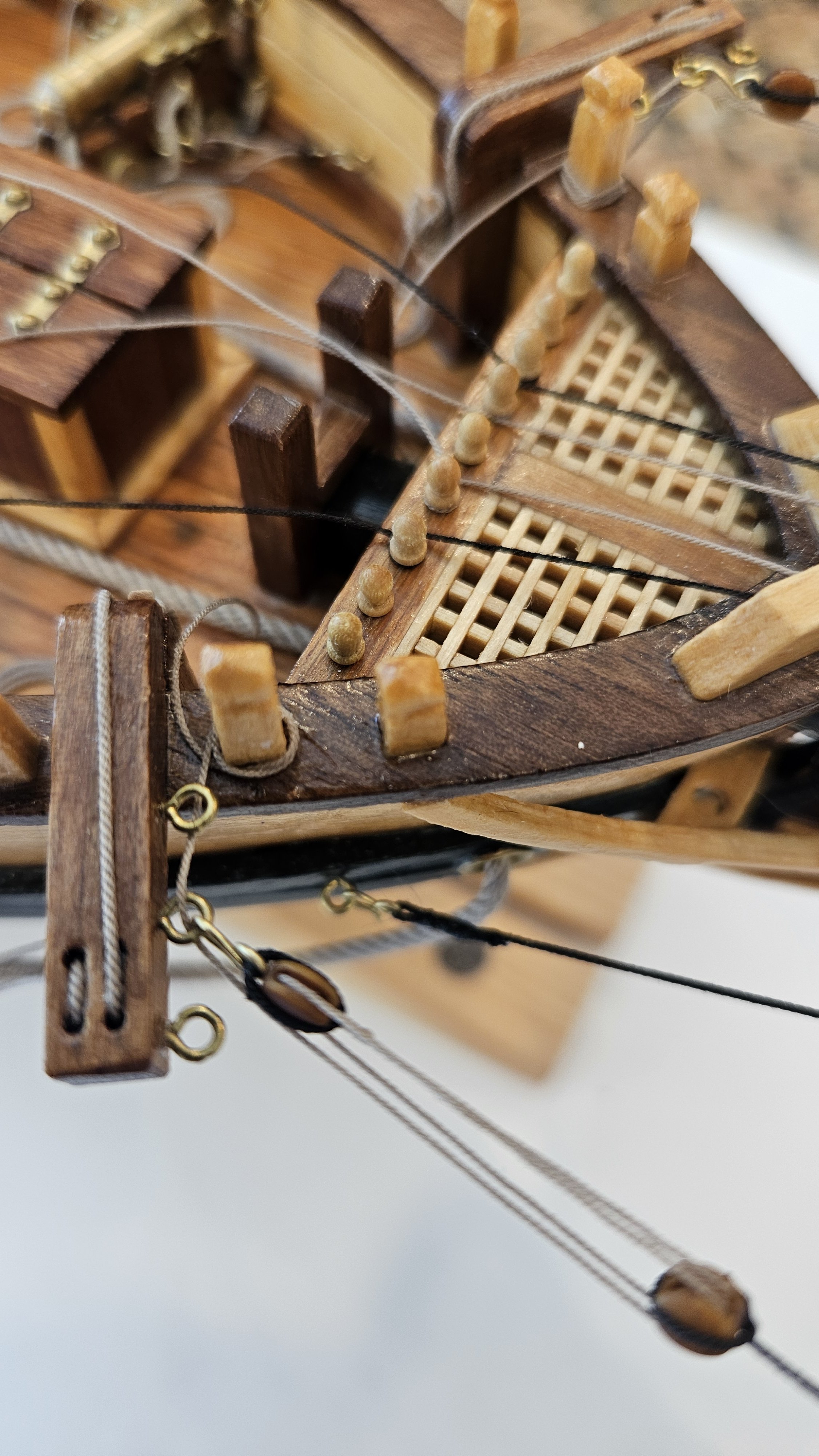

Belayed some lines at the bow, with plenty of excess line to the bitter end.
Right now, as it stands, everything is more or less "functional", except for a little diluted white glue to ward off @Dr PR's Murphy.
Before I started rigging I figured every pin would have a coil of line hanging from it, but now I wonder.  Lines like the martingale stays don't need a lot of excess once belayed taught - Maybe enough to bend to if need be?   Thoughts?  Or am I taking this too far (having realistically scaled lines belayed and coiled)?
Coiling actual excess might be a challenge with this line in tight spaces.

Some lines will not have large coils at the belaying point, especially if that they haul on is let all the way out. For example, if a foresail is reefed the halliard will be let out all the way with little left to coil.
On the other hand, if the sail is hauled all the way up there will be a lot of extra halliard line to coil at the belaying point.
As you say, the stays on the jib boom and flying jib boom do not have to be adjusted much, so there never will be a large coil of line at the belaying point.

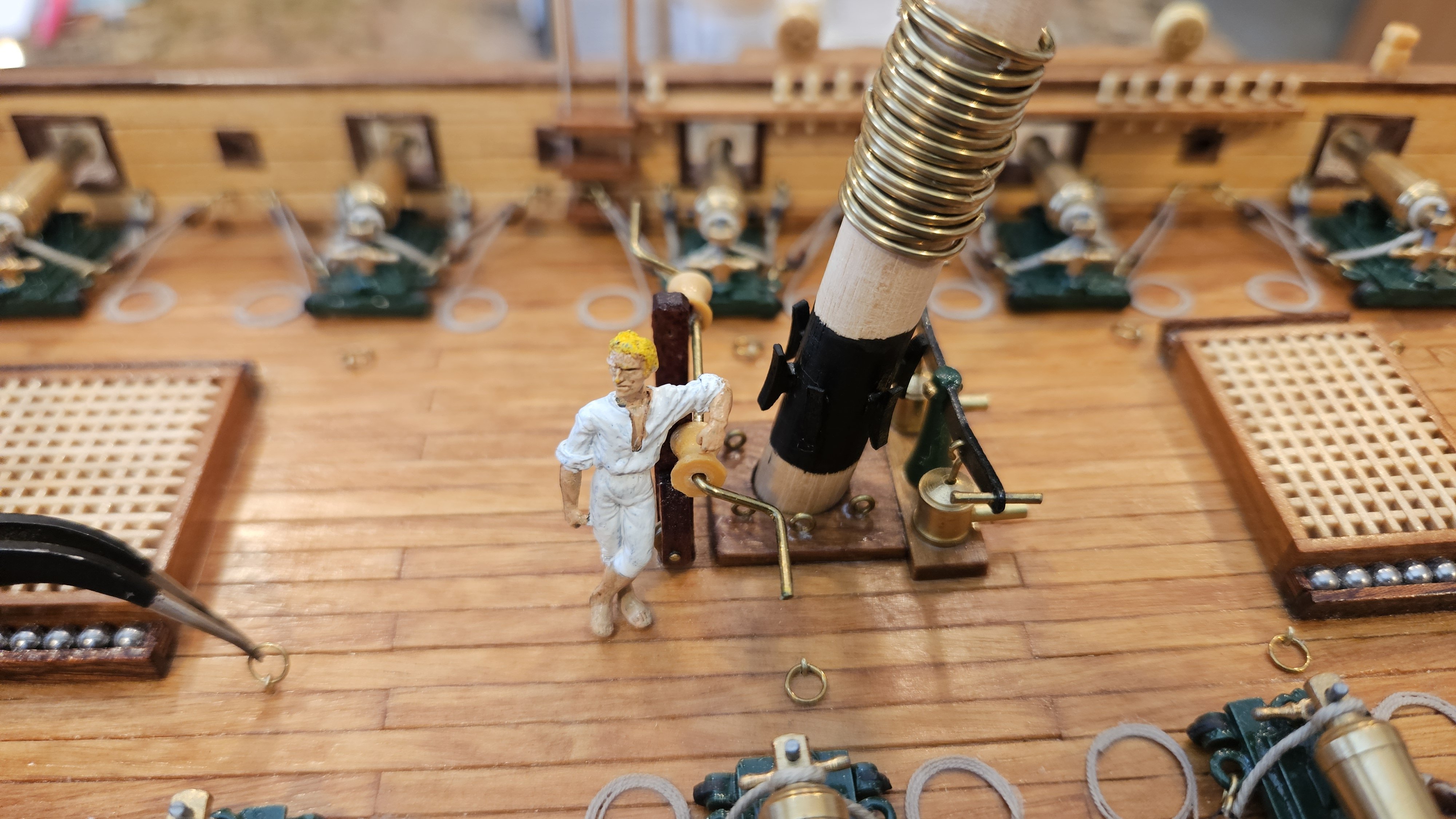

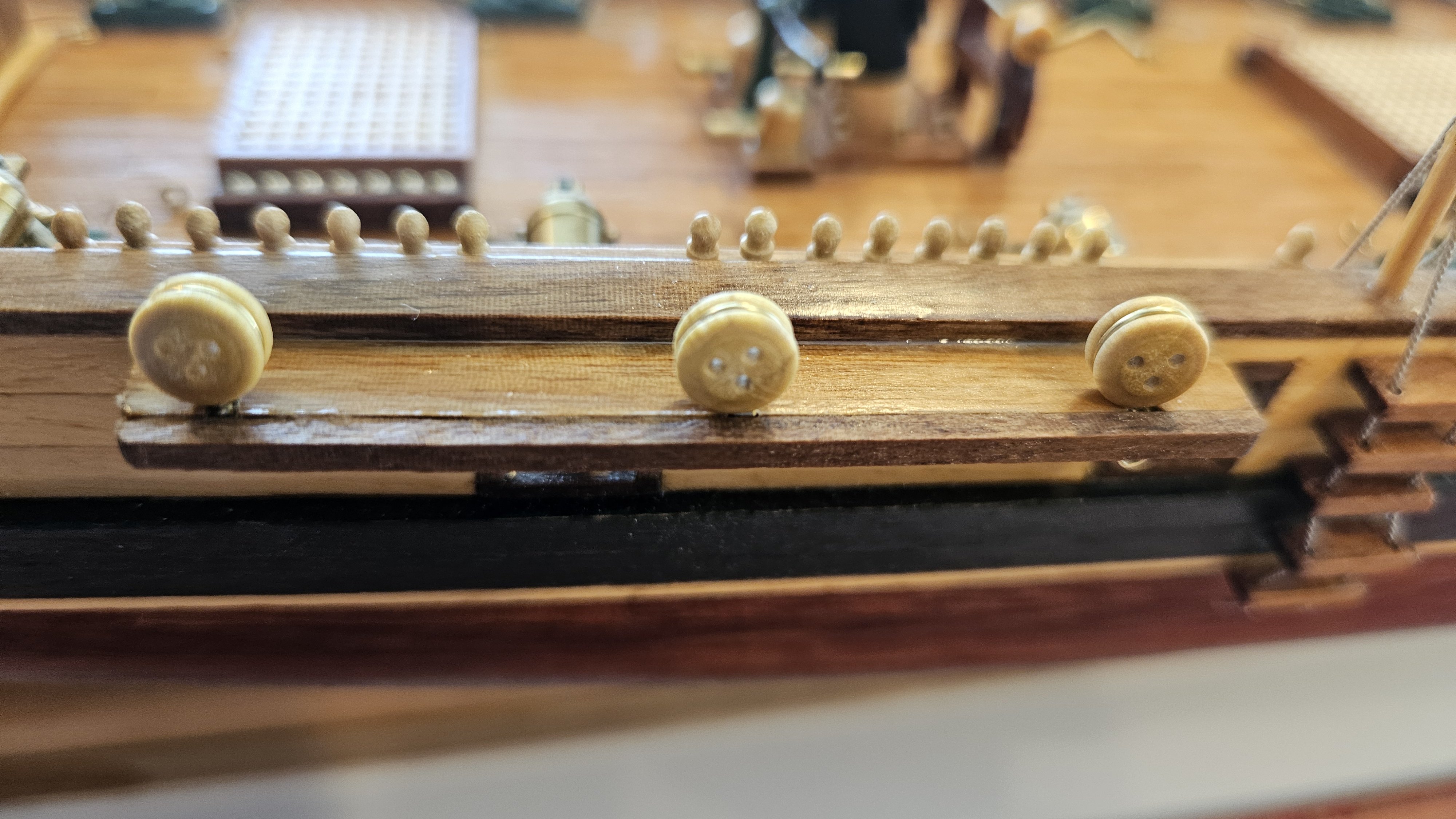

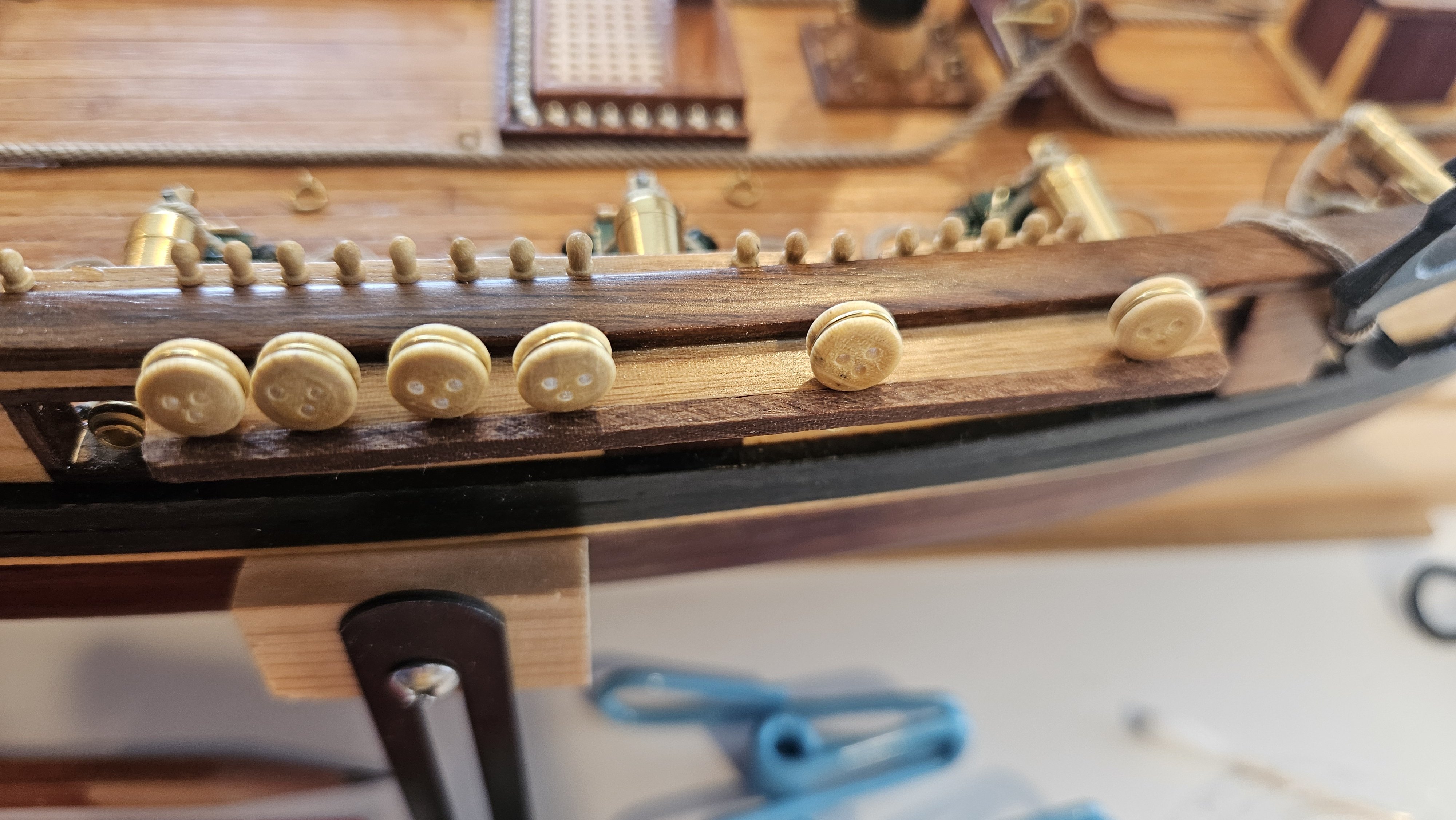

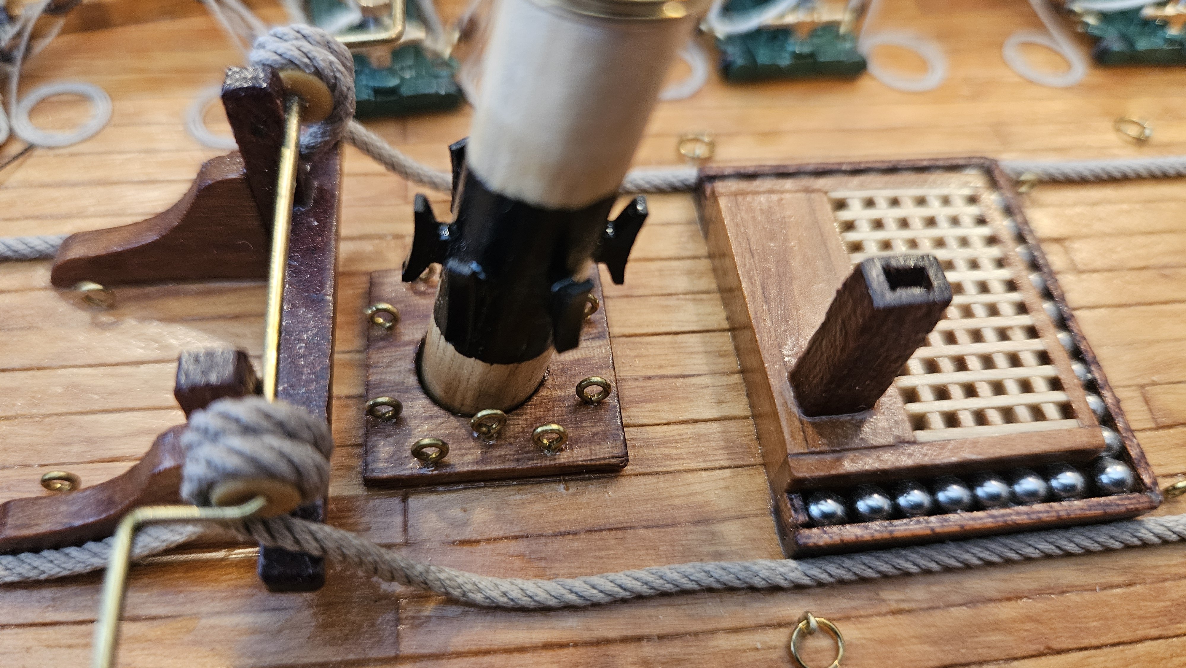

In the below photo, the 18 brass mast hoops (probably not a traditional material but so pretty 🤣) and some of the 14 functional deck tie down rings.  Also, the six lower main mast cleats and the black stain markings around the cleats.
All of the appropriate deck eyebolts required for rigging now installed and proof tested...
The fore chainwhales with deadeyes...
And the main chainwhales...
The chains themselves for the chainwhales are next, as well as the first shrouds!
