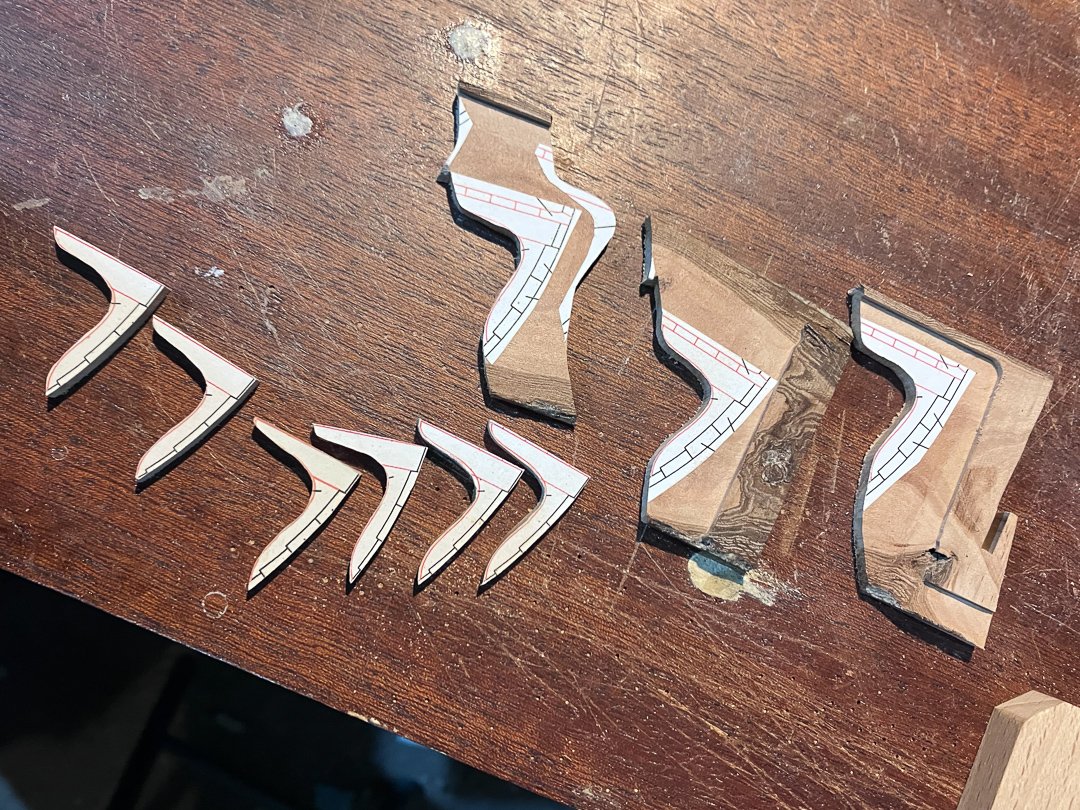

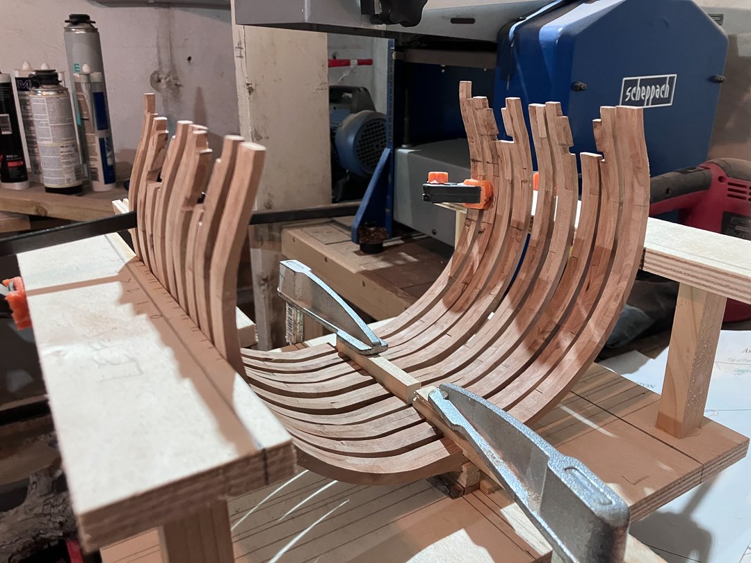

1st test frame I cut out of pine scrap wood just for testing purposes. Immediately said, this wood will not be nice. too soft and too grainy. So time to prepare my patiently waiting pear tree.

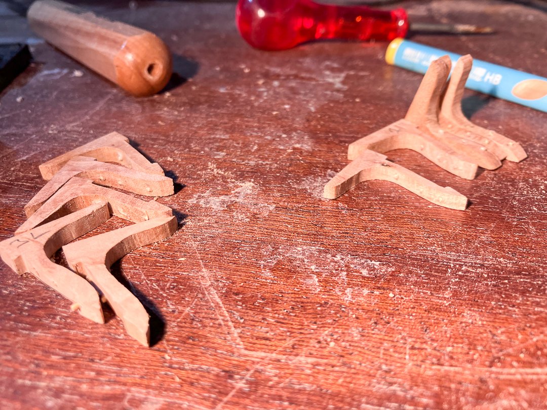

I cut into 7 mm planks and then with thicknesser went down to 5mm... Sorry I am metric oriented.

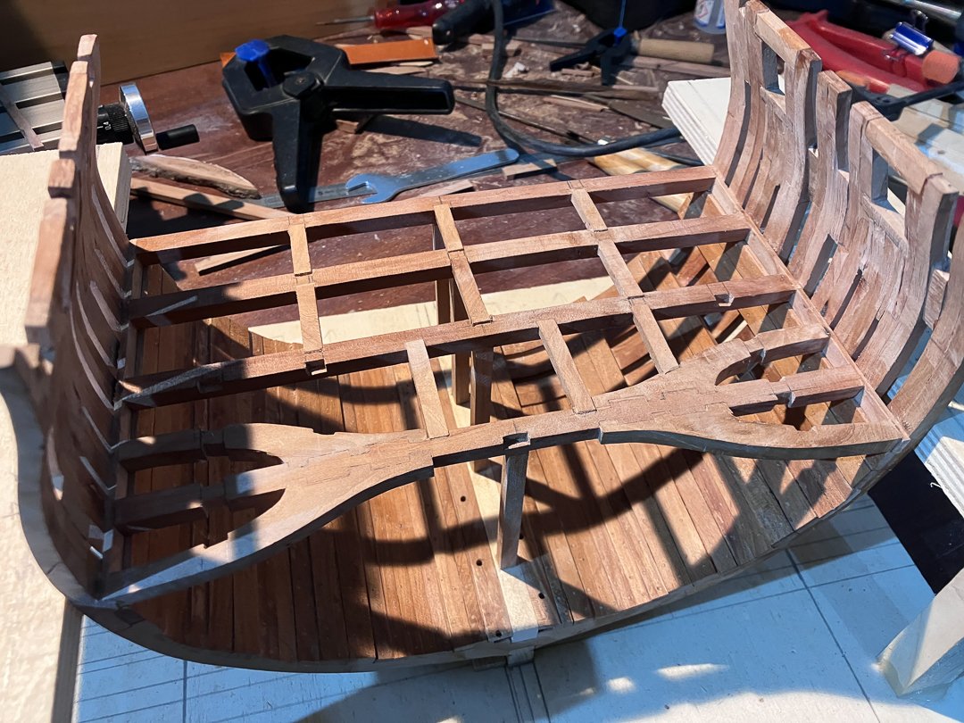

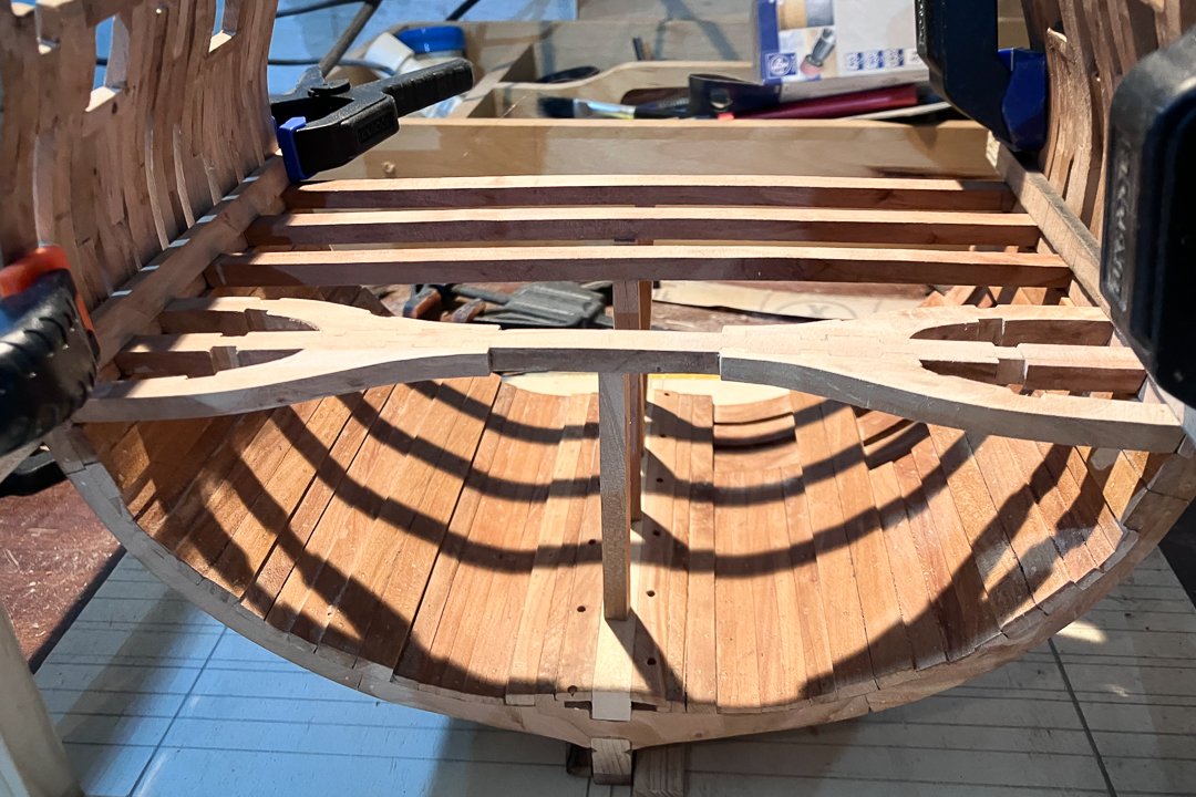

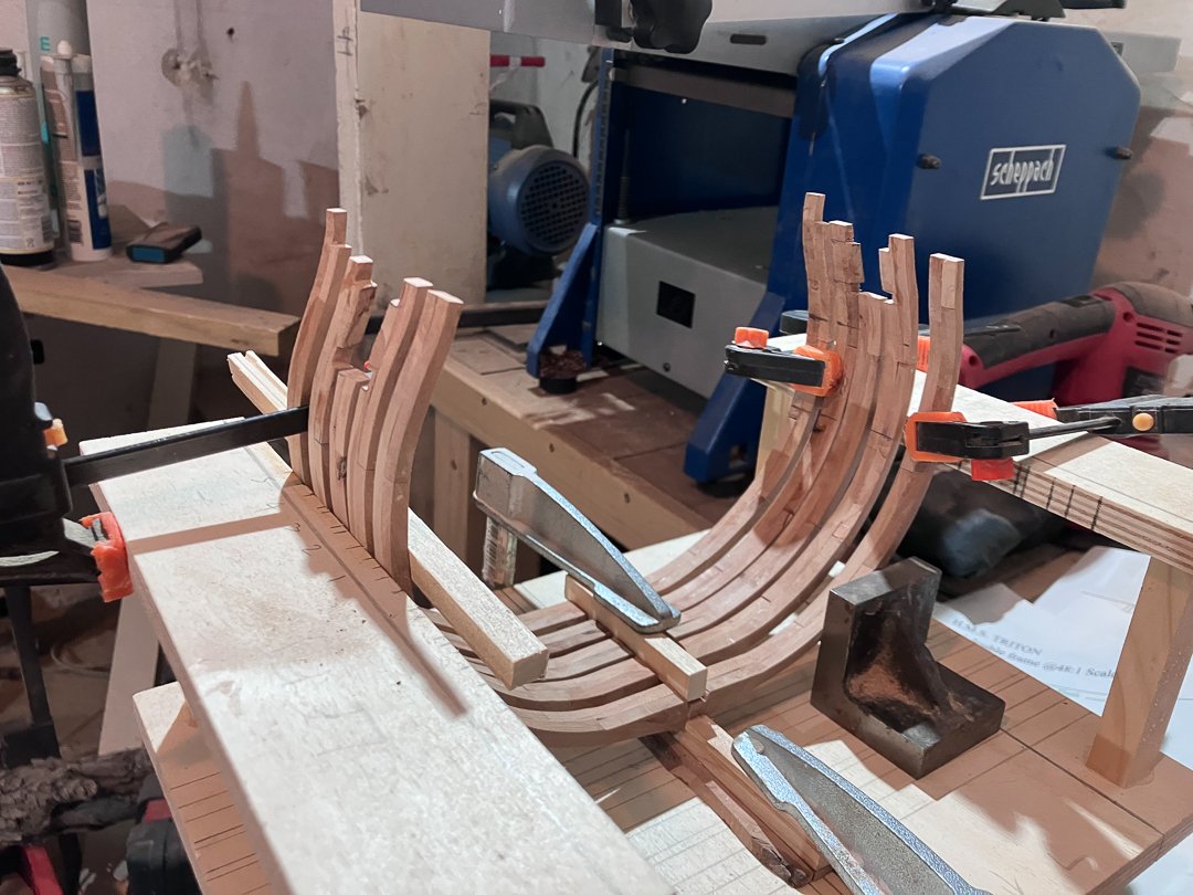

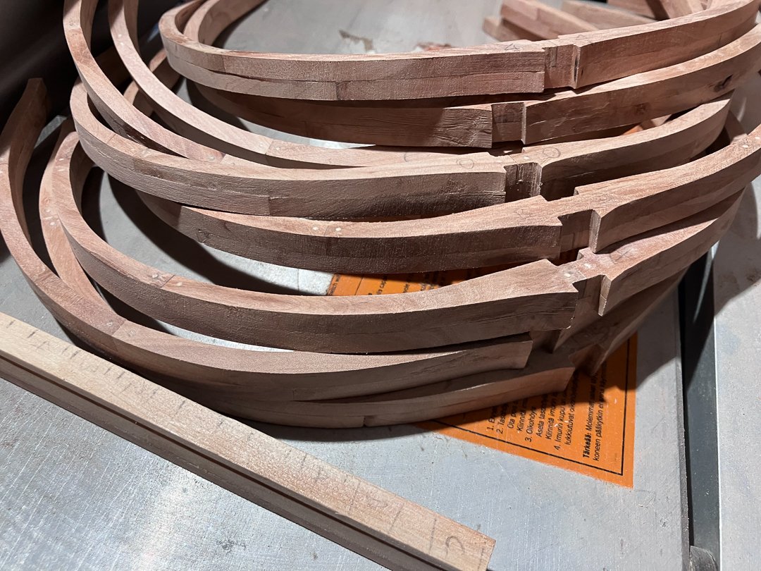

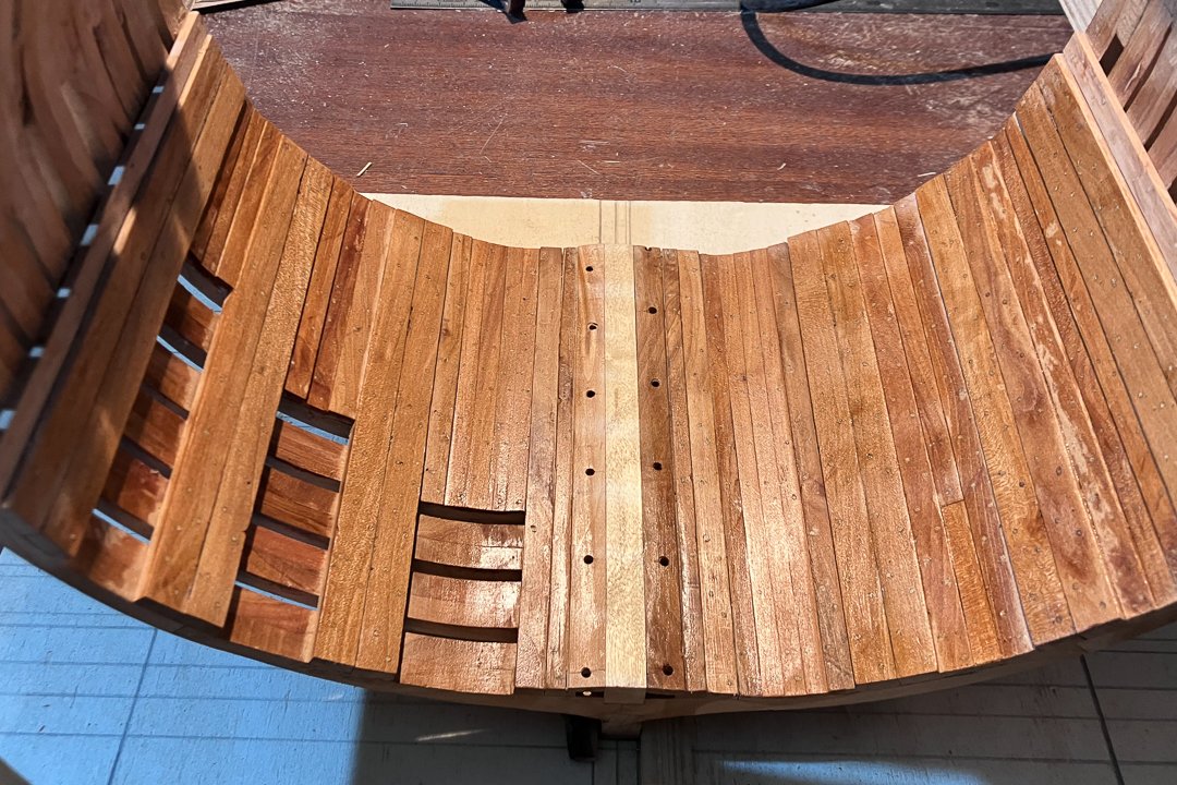

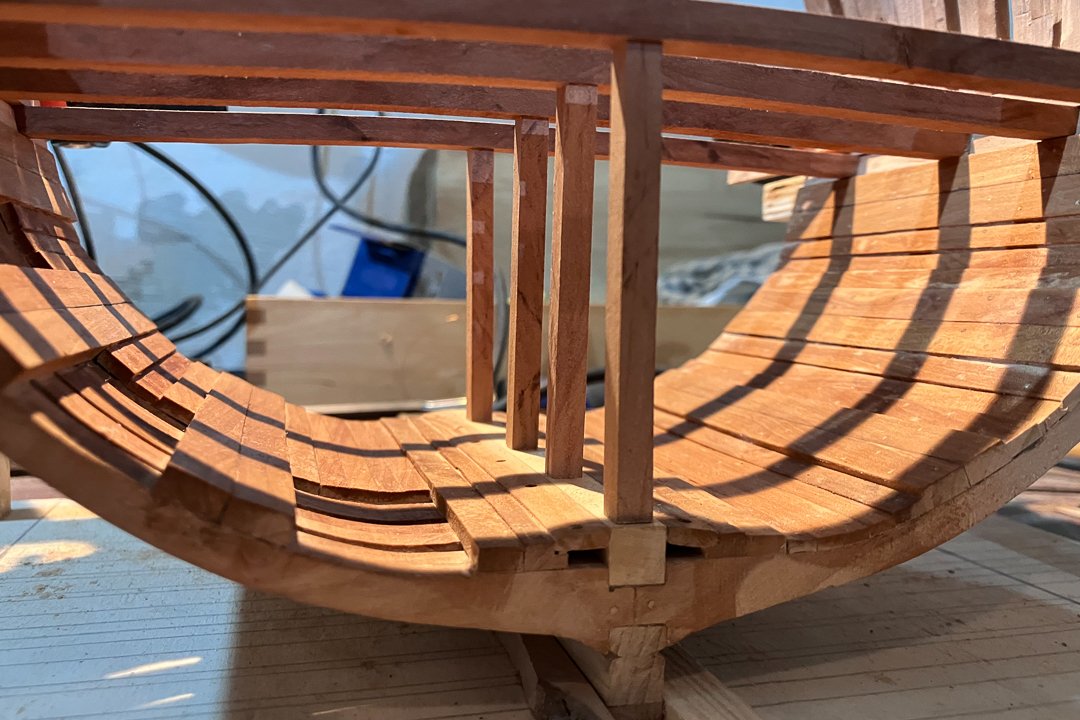

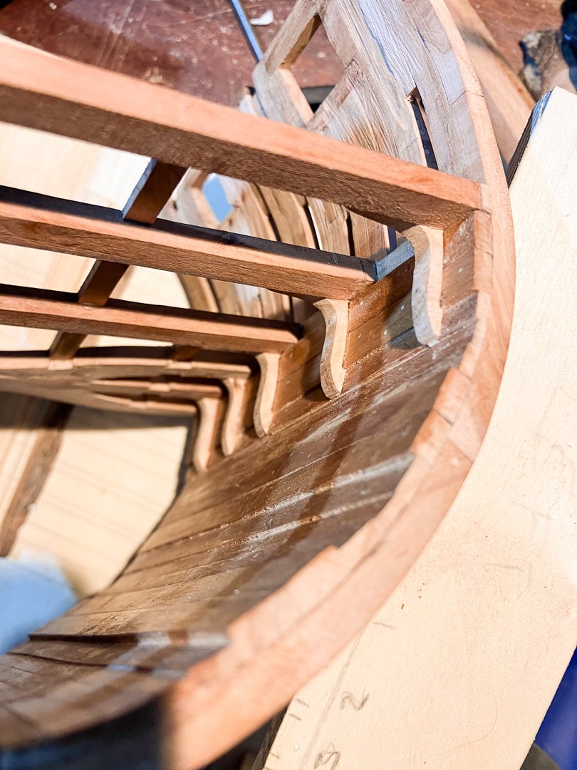

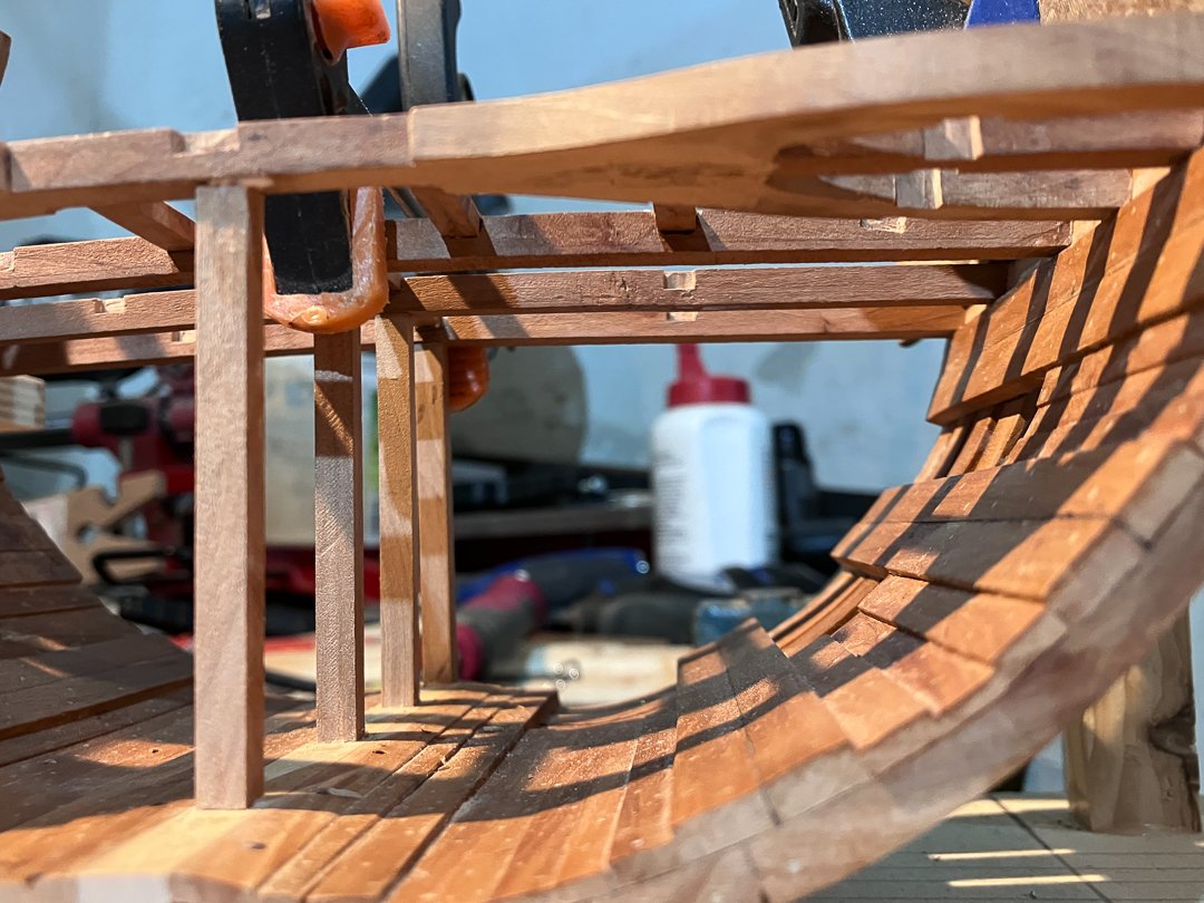

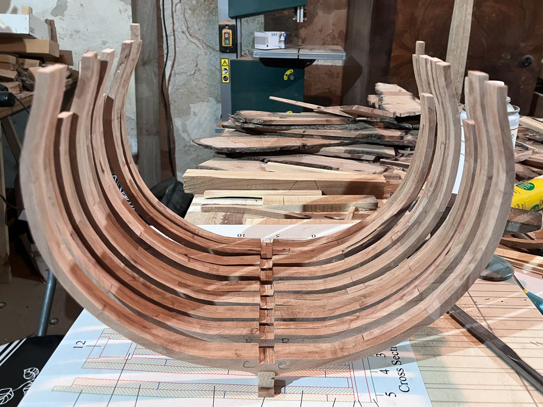

Aseembled 2 frames and started to think.... about leaving one side open with visible frames as I saw by few other threads.

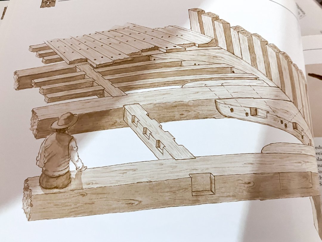

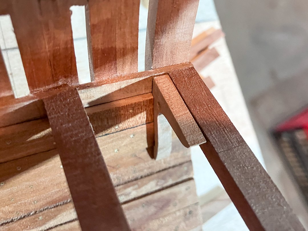

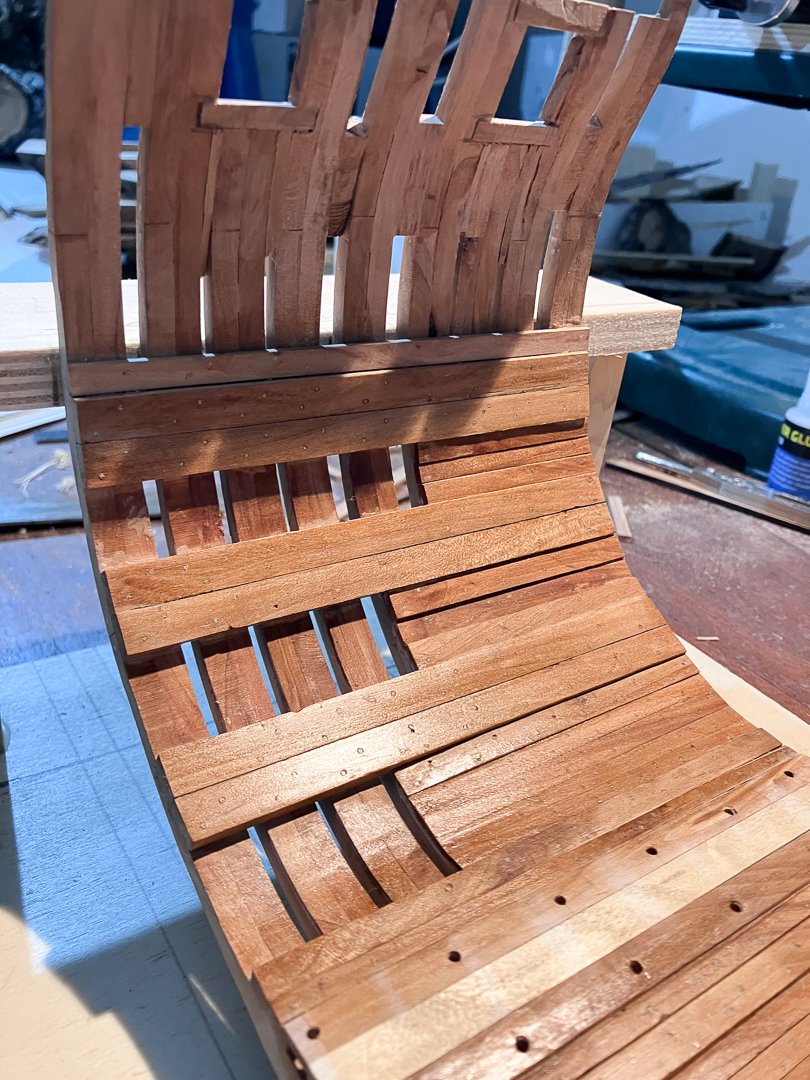

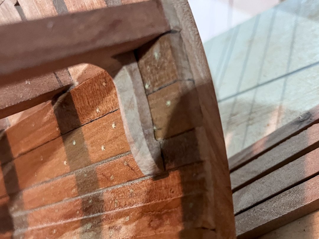

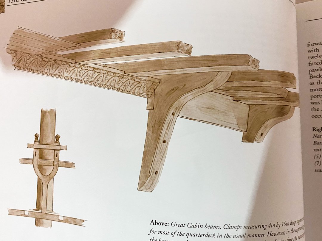

I am not subject matter expert but I was wonderring about futtocks assembly. Many placed treenails ond sides of frames. But what about chock piesces?
Then treenails actually would be placed from inside of the frame.
Cheers
Jerzy
Edited by Jerzy

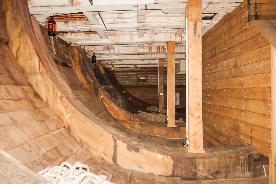

Yes for english ships like Triton treenails are on the outside.  Straight through but for a model its easier to fake it and put them in from outboard only if you are going to plank inboard and not see them anyway.
