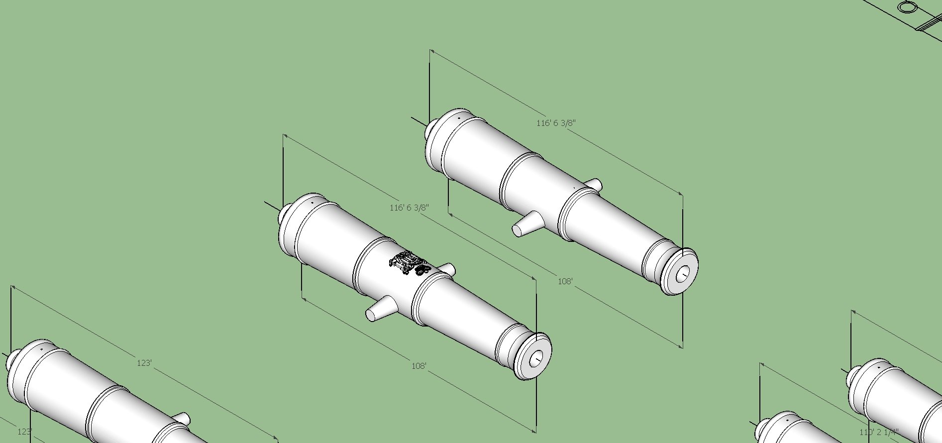

Here is the first of the Commonwealth cannon barrels. This is the 32 Pounder 108 barrel. I'm going to draw all the barrels I have 2D drawings for, initially, with no cyphers. The earlier cannons had the "Arms Of The Commonwealth" cypher on them, then when Charles II retook the throne, these were removed Filed off), leaving no cypher. Cannons cast during his reign had his cypher cast on.

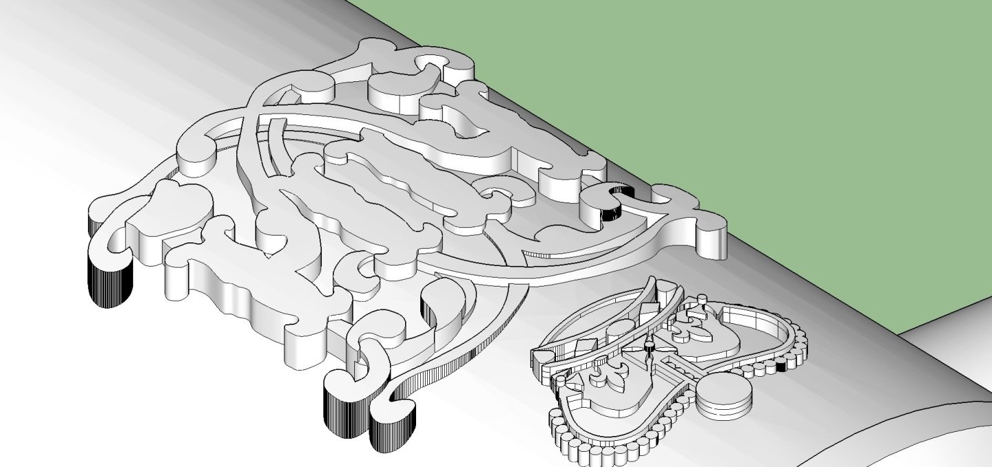

I will draw that "Commonwealth" and Charles "Tudor Rose" cypers after I've finished all the barrels.
Yes the trunnions are too long. I did this on purpose, after doing a couple of barrels for Chuck, last year. He leaves his long, so that modelers can then trim them to match the carriages they build, which might end up a little wider than a "Perfectly Scale" width. Easy to do for small scale models. When installed the ends can be trimmed to match the model carriage.
Ron Thibault

I've been working on the Commonwealth cannons also. I now have 7 of the twelve size barrels, I have drawings for completed. When I'm done there will be three versions of the cannons. The first will be with the original cypher when they were cast under the "Rebel" rule, the plain barrels used when Charles retook his throne, and had those cyphers ground off, and the version that were cast later with his crest. Then I have some sizes that a member asked for that were specific to drawings he found for HMS Tiger.
I'm going to concentrated more on the cannon, now that I finished this depot.

Back to ship stuff. I finished the master drawing for the King Charles II cypher. This is the last piece for the HMS Tiger cannons I'm doing for a forum member. After I finish those I will complete the Charles II era Commonwealth cannons, to (hopefully) be added to the other cannon files in the Resources Section of the NRG site. The Commonwealth barrels are drawn, I need to add this cypher to the barrels.
The depth of the Solid is so I can fit it in the 3D barrels. The 3 different levels of relief with be trimmed parallel to the barrel, and the part sticking inside removed.

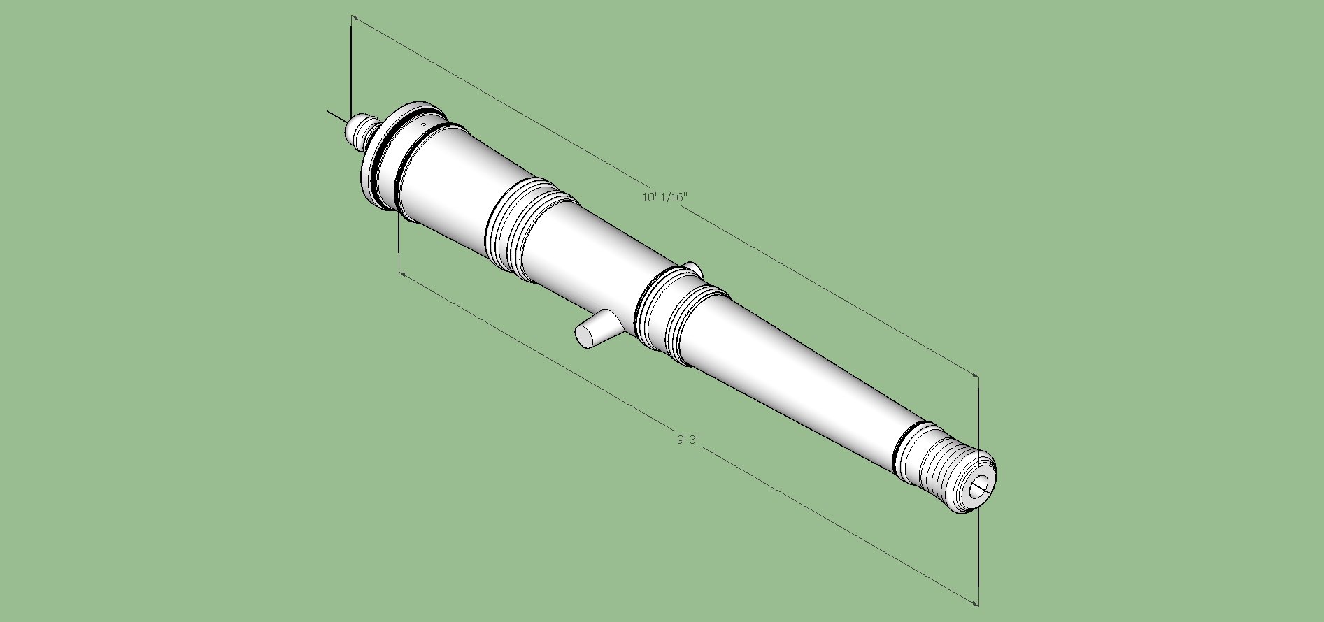

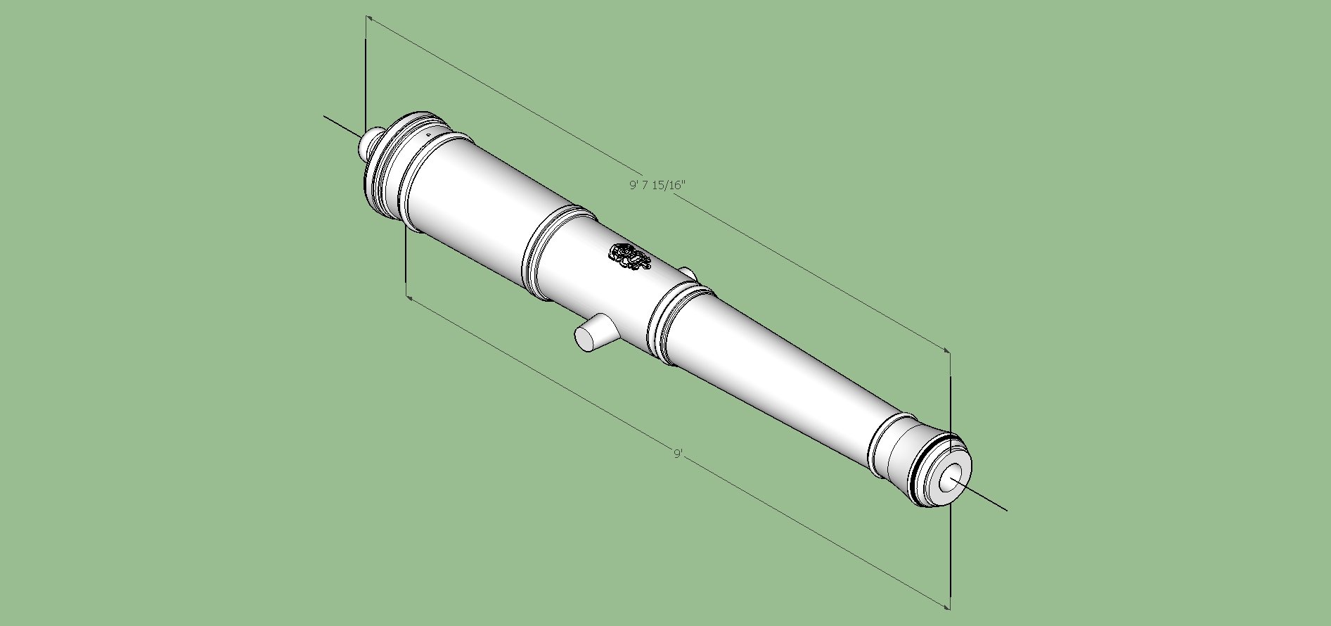

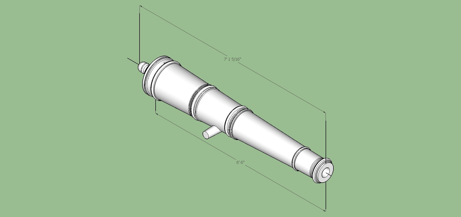

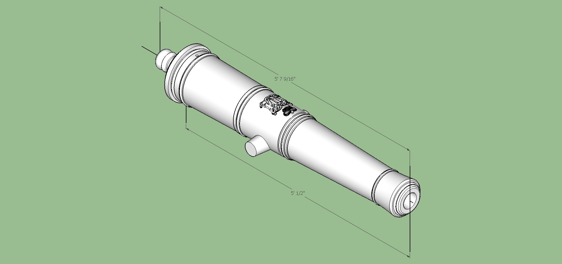

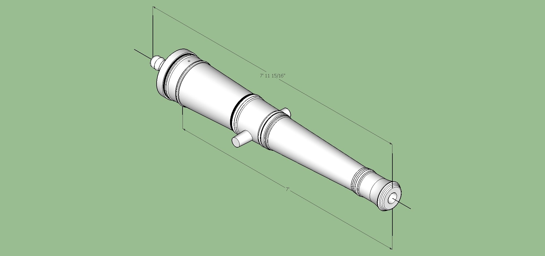

Finished the files for the cannons on HMS Tiger ca. 1650 to 1690. I'm not sure just when this set of cannons were carried. The cannons are from illustrations in the book "The Master Shipwright's Secrets".  Three of the cannons in the pictures had no cypher, so that is how I drew them.
These drawings were requested by a forum member.
6 Foot 6 Inch Saker 6 Pounder
6 Foot 6 Inch Saker 6 Pounder Full Size_2166_14mm.stl
7 foot Saker 6 Pounder
7 Foot Saker 6 Pounder_Full Size_2436_94mm.stl
9 Foot 3 Inch Saker 6 Pounder
9 Foot 3 Inch Saker 6 Pounder Full Size_3050_38mm.stl
9 Foot Demi-Culvern 12 Pounder This was shown with the Tudor Rose cypher.
9 Foot Demi_Culveren 12 Pounder Full Size_2945_34mm.stl
Rupertino Saker Cutt 6 Pounder. This cannon is based on a cut down cannon. They shortened cannons from a previous design whose muzzles had cracked, for the original Cutt cannons, liked the performance, and cast new cannons to this length with a muzzle flair. This cannon has the King Charles II cypher.
Rupertino_Saker_Cutt 6 Pounder Full Size_1716_09mm.stl

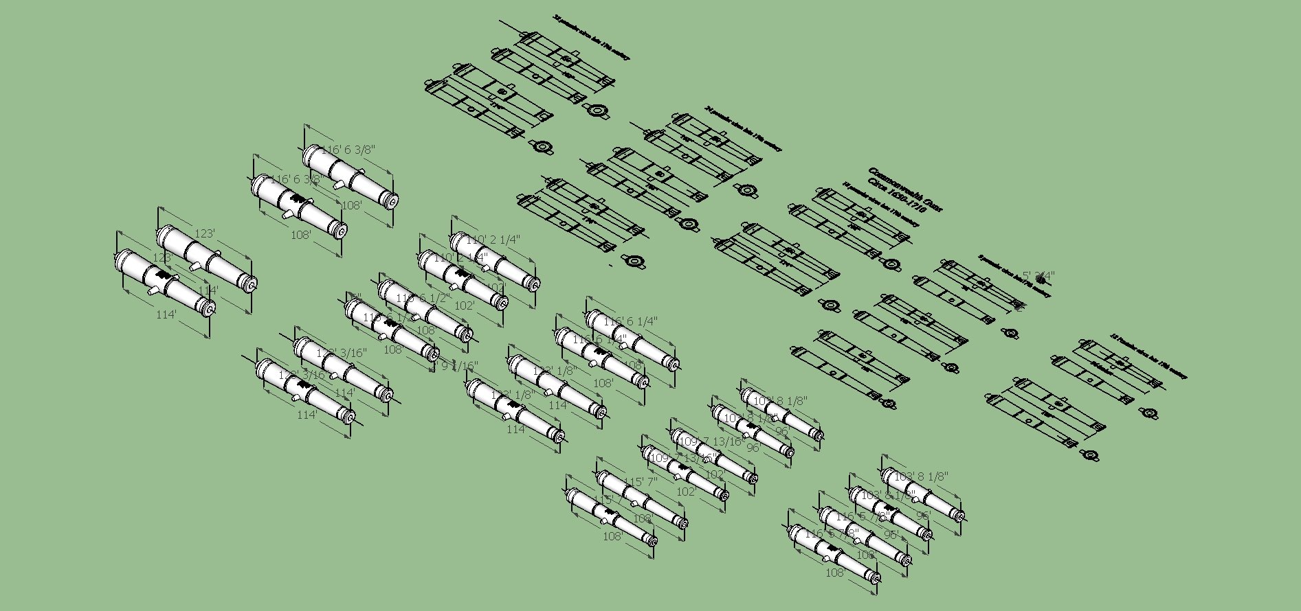

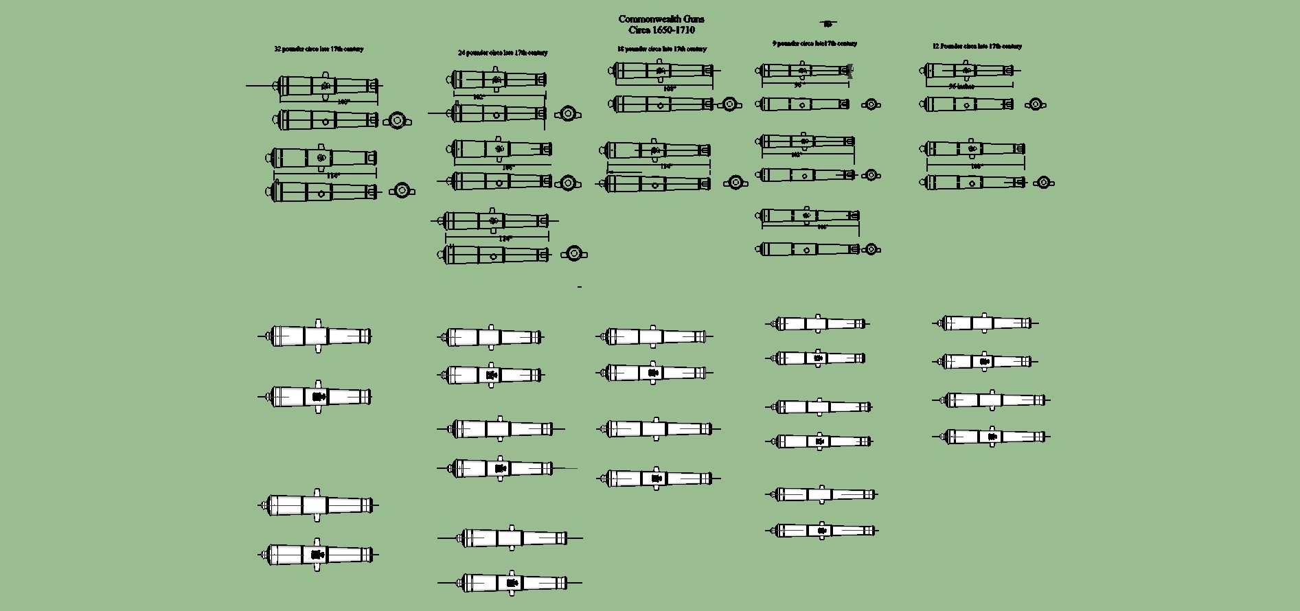

I finished the drawings for the Commonwealth Pattern cannons from 1650 to the end of Charles II's reign.
The original pattern was developed during the Commonwealth control 1640 to 49, and originally featured their cypher. When Charles came to power those cyphers were removed from the existing cannons, leaving cannons with plain barrels.
These drawings feature the plain barrels and those with Charles' cyphers.
I still need to go through and create the STL files, and the graphics for each cannon, as well as updating the spreadsheet to include them. So it will be a couple of weeks before I publish them.
I hope to add these to the NRG Resource page.
Overhead and perspective views with the original 2D drawing at the top. The 2D drawing mistakenly shows the Tutor Rose as the correct cypher.
A closeup of one of the larger caliber guns showing both types of barrels. Note: that the drawing shows them 12X size this is how I typically scale the drawings to be able to get the fine details, as SketchUp is designed for architecture and has a 1/32" minimum drawing unit (at least my 2017 version). For these drawings I had to go with 144X due to the small "pearls" in the crown.
When I create and verify the STL files, I rescale to 1:1 in the verification program.
Ron Thibault
