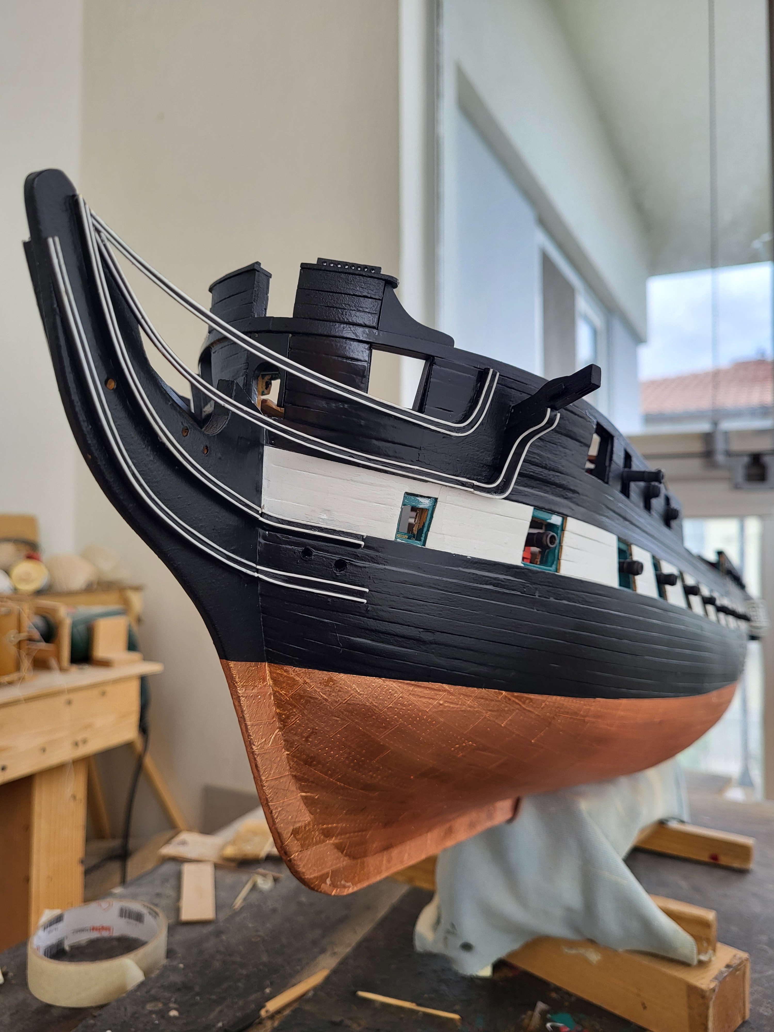

I've started working on the bow details, which are my greatest fear. I see that the most challenging detail for modelers in this model is the white stripes on the rails and other items. I've been pondering for some time about how to make these stripes in the best way. Finally, I decided to try making them out of brass wire. I flattened a brass wire with a diameter of 0.5 mm by hammering it, then shaped it as needed, painted it white, and varnished it. After it dried completely, I carefully glued it onto a test piece. The result looks satisfying. We'll see if I can achieve the same on the model itself."

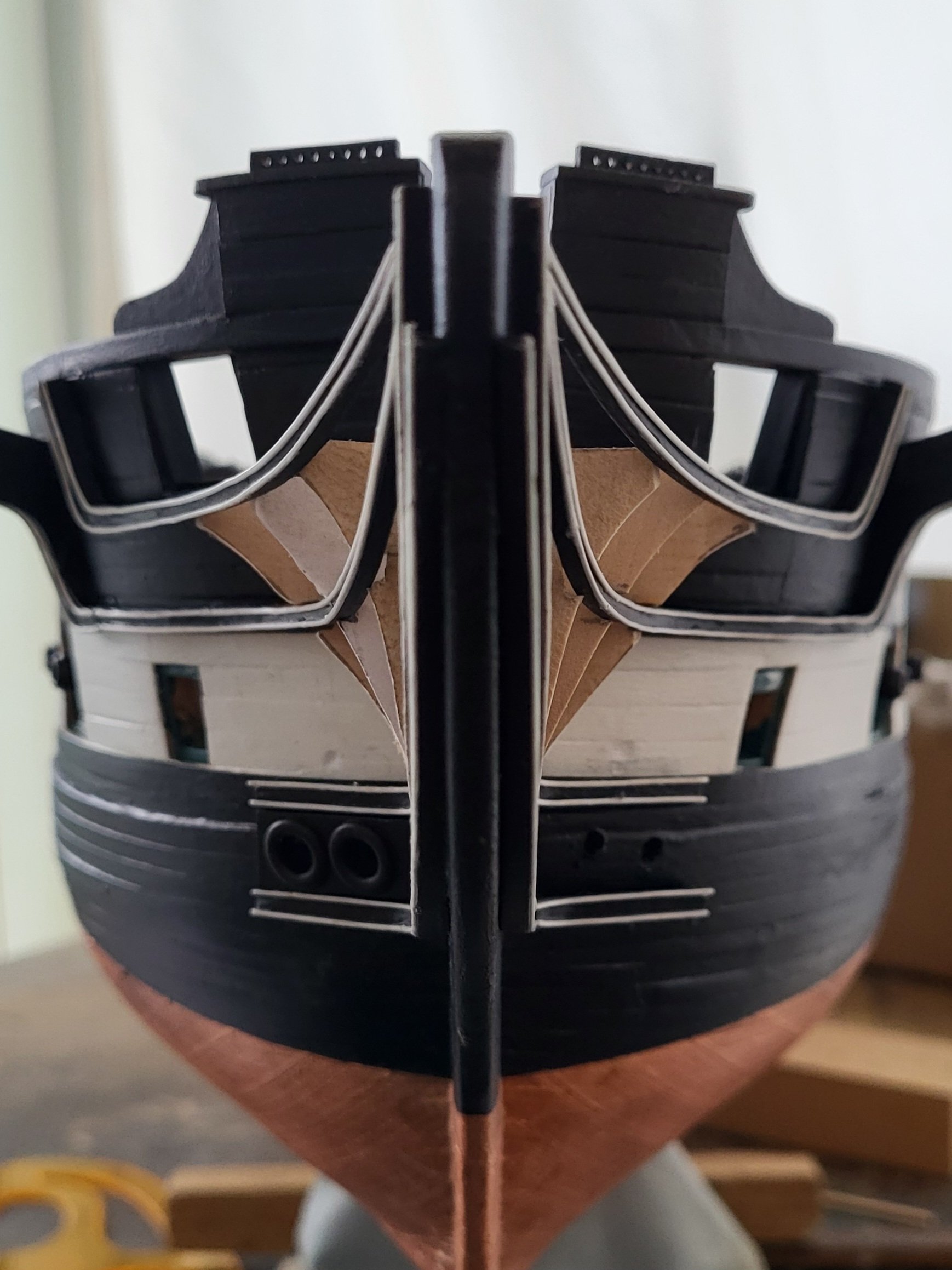

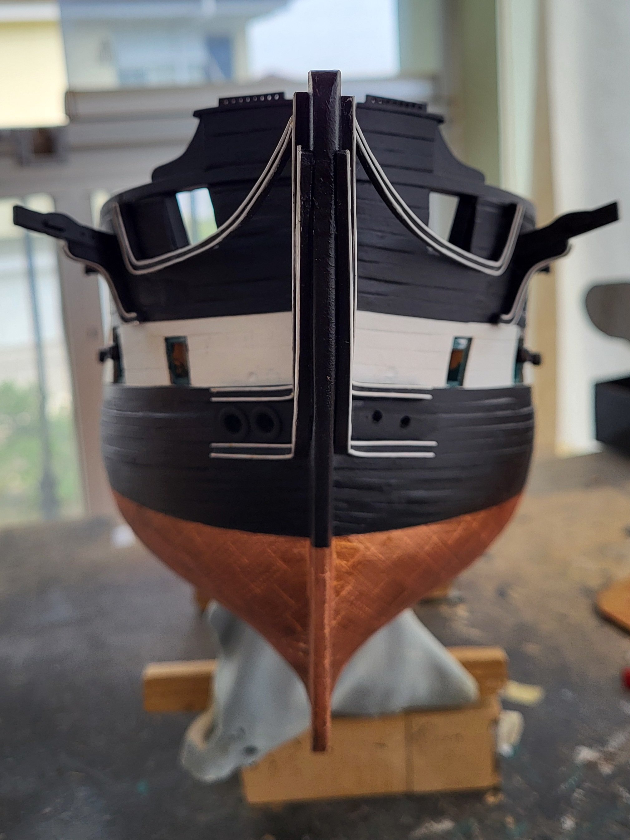

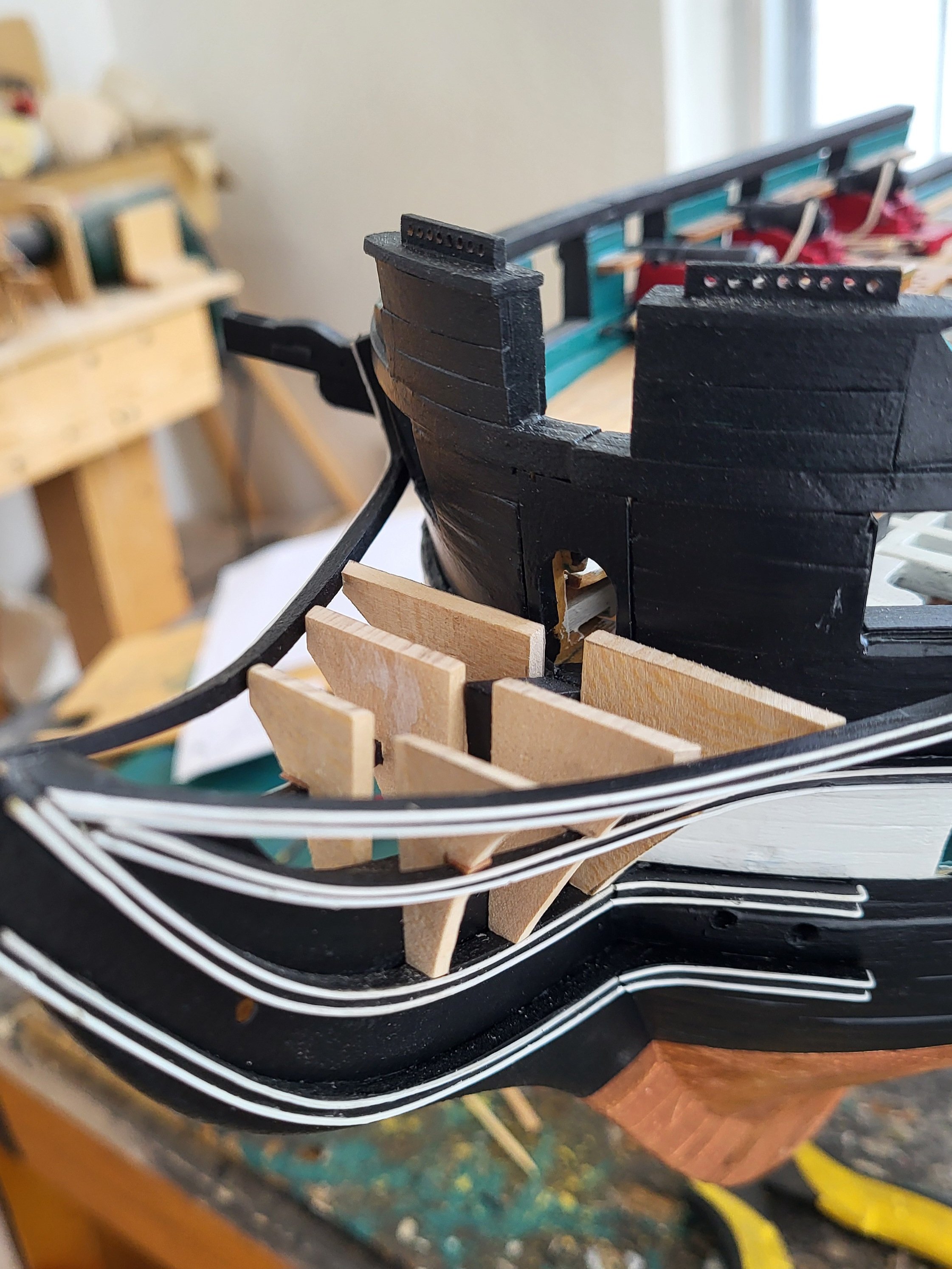

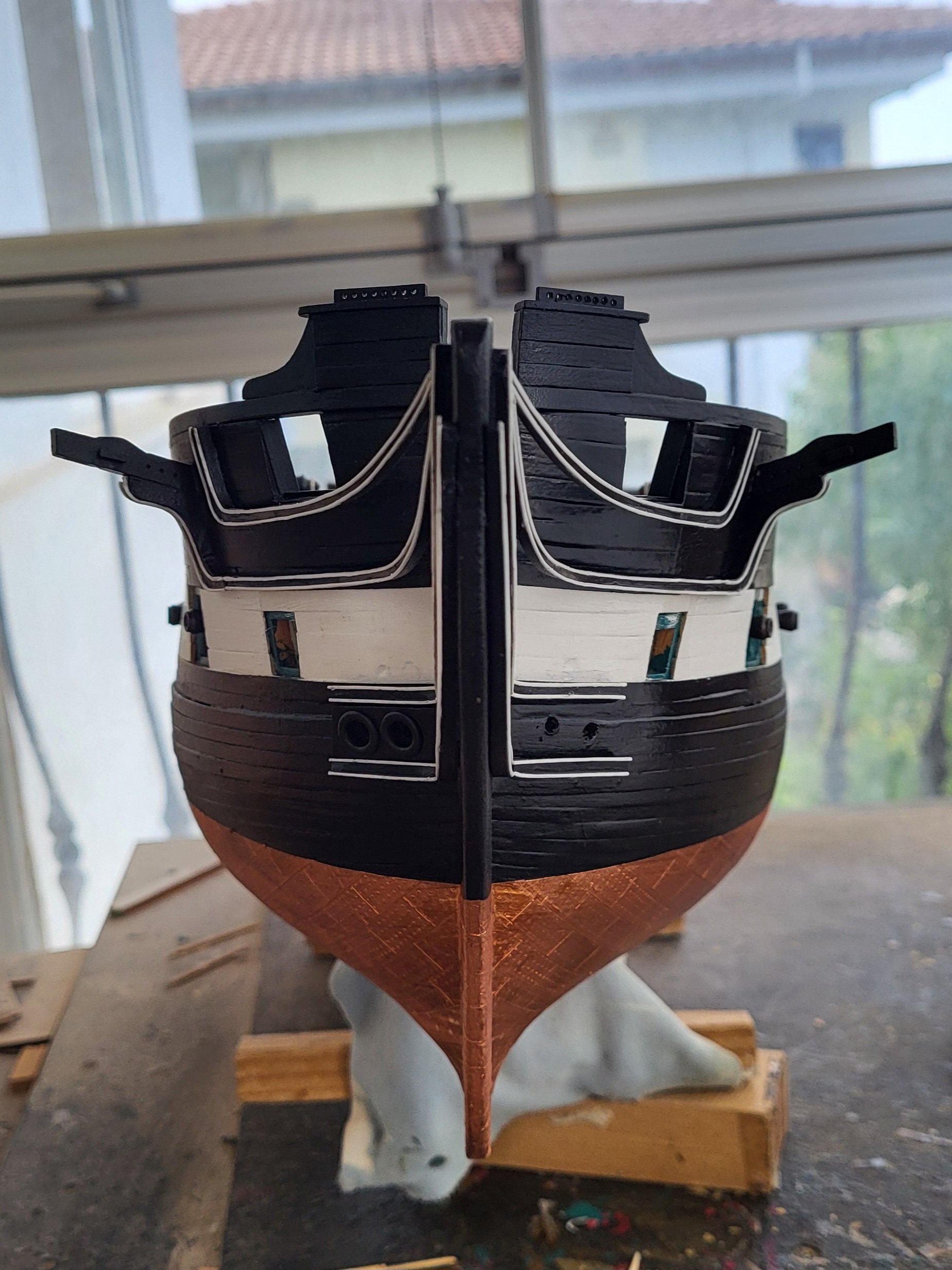

I was away from my shipyard for a while because I was out of town to visit my grandkid. I'm continuing the bow details where I left off. I'm assembling the starboard side cheek knees. As I mentioned in my previous post, I'm making the white strips by flattening the brass round wire.

I use a hammer and anvil to flatten the brass wire. At first, it wasn't perfect, but as I practiced, it got better

Amazing result on the pinstriping!

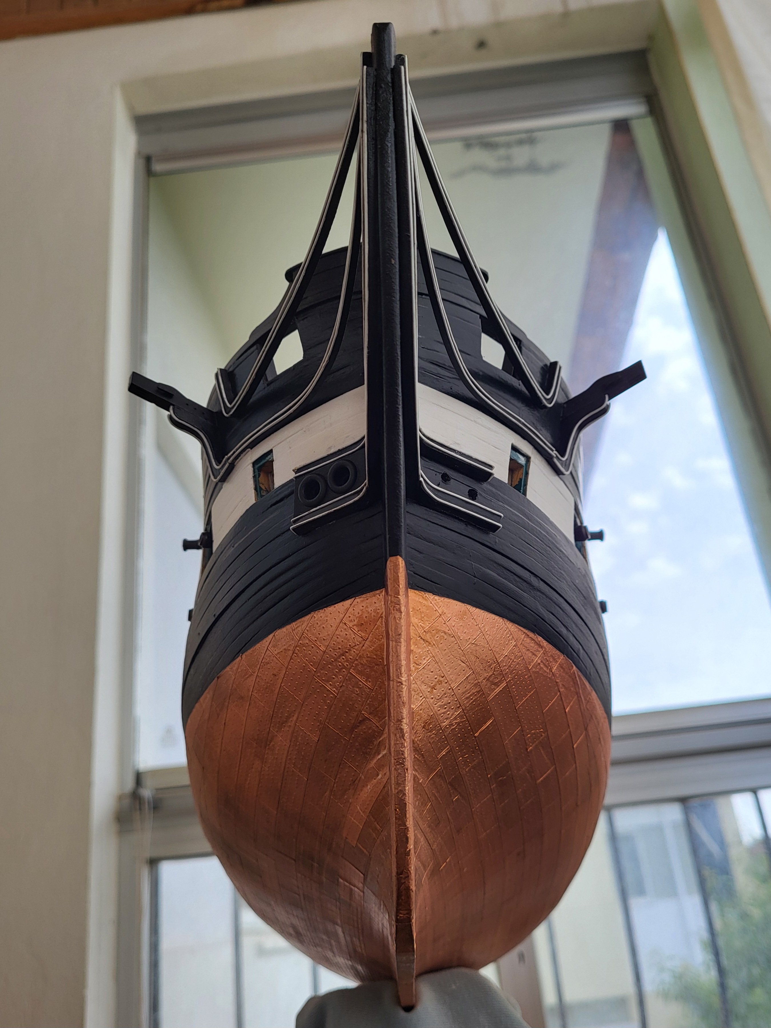

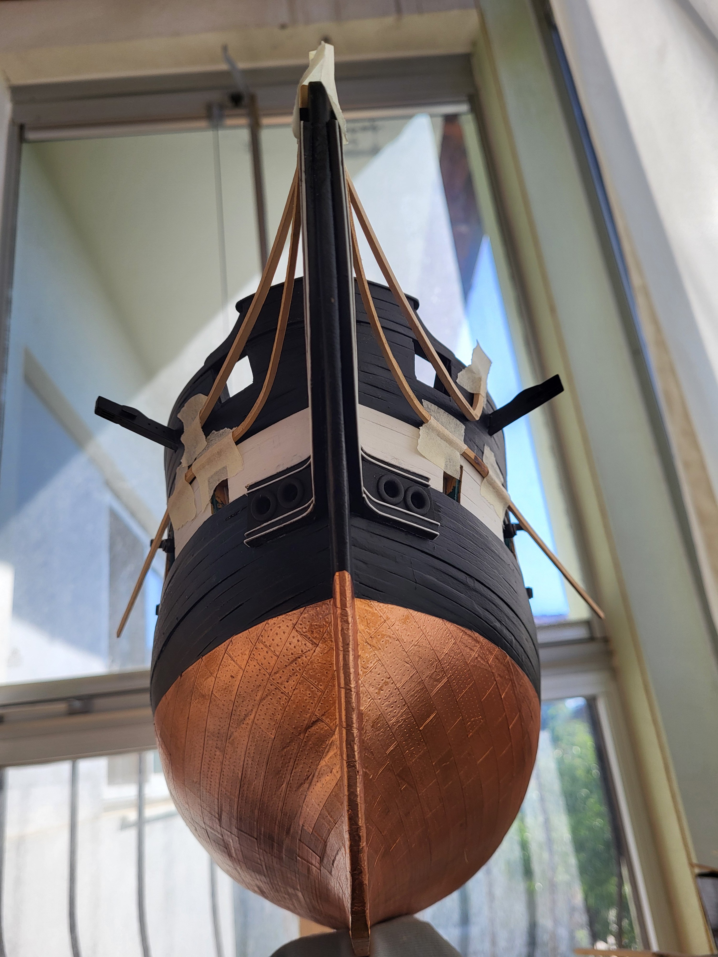

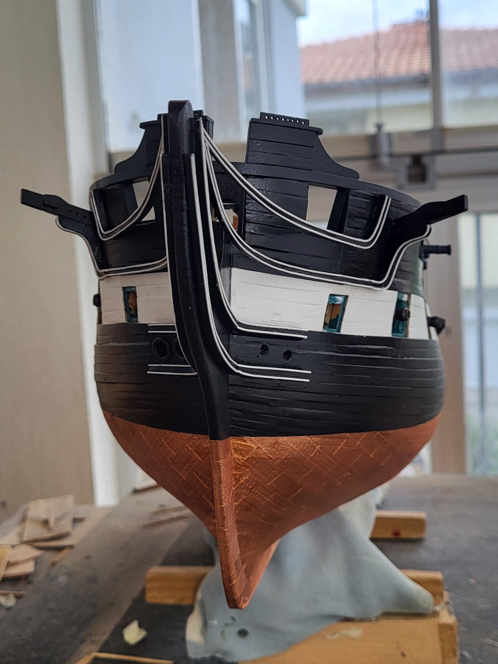

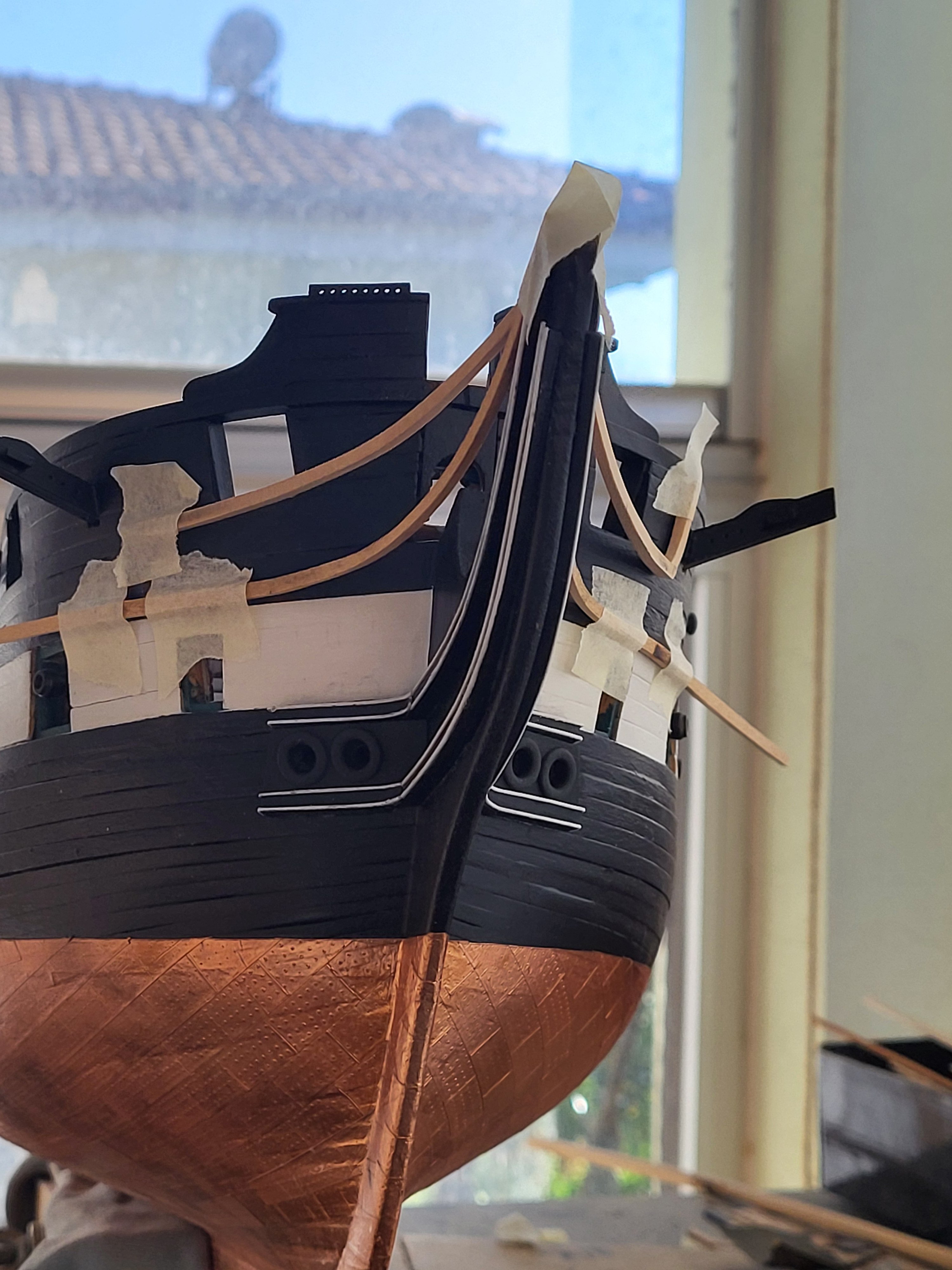

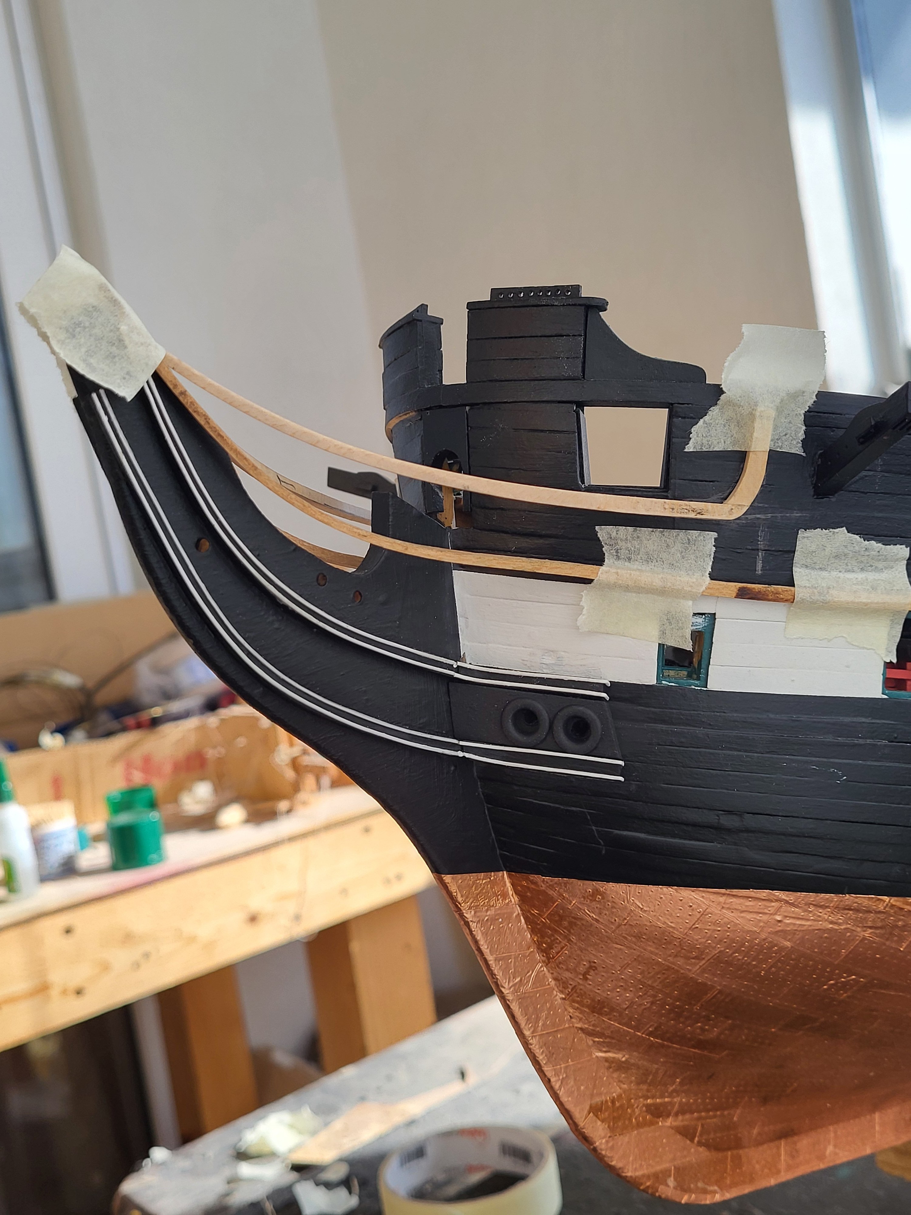

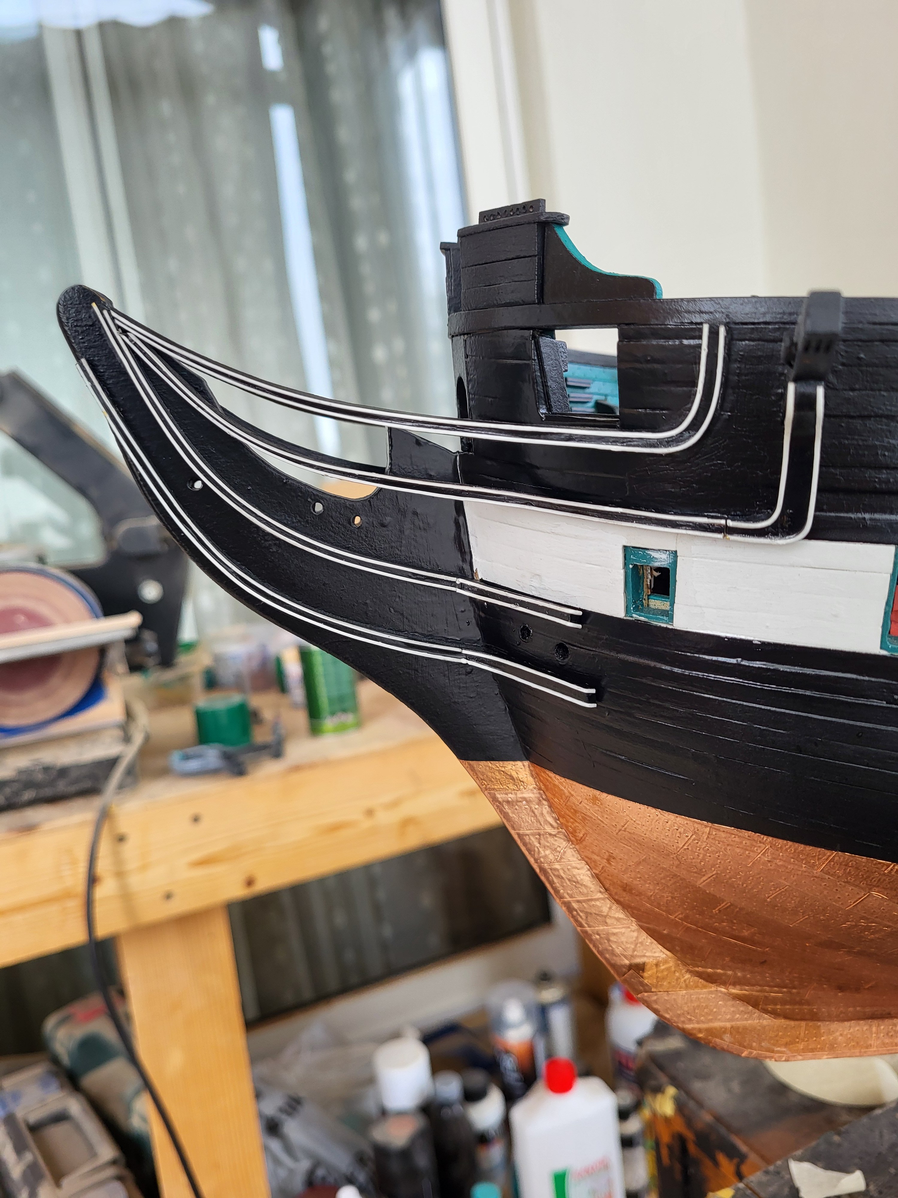

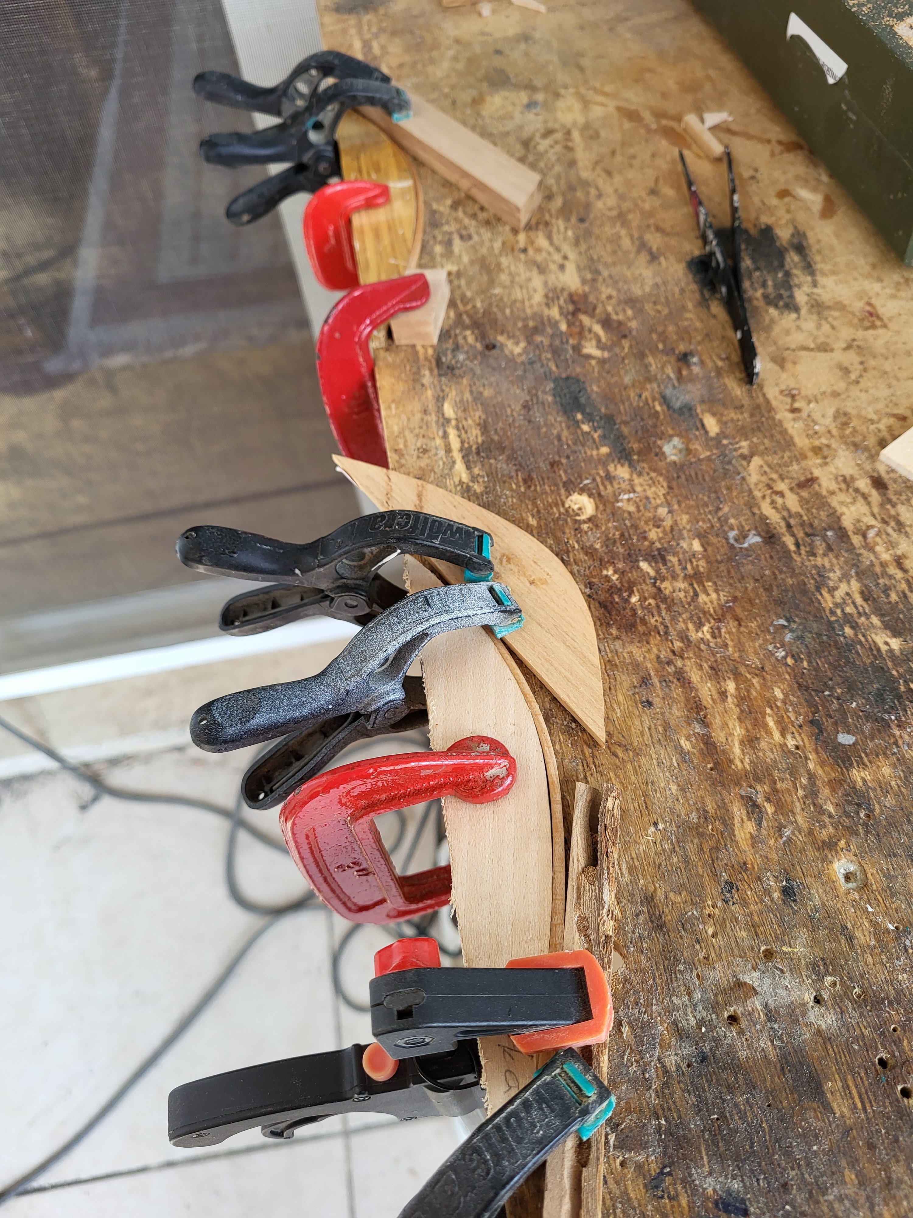

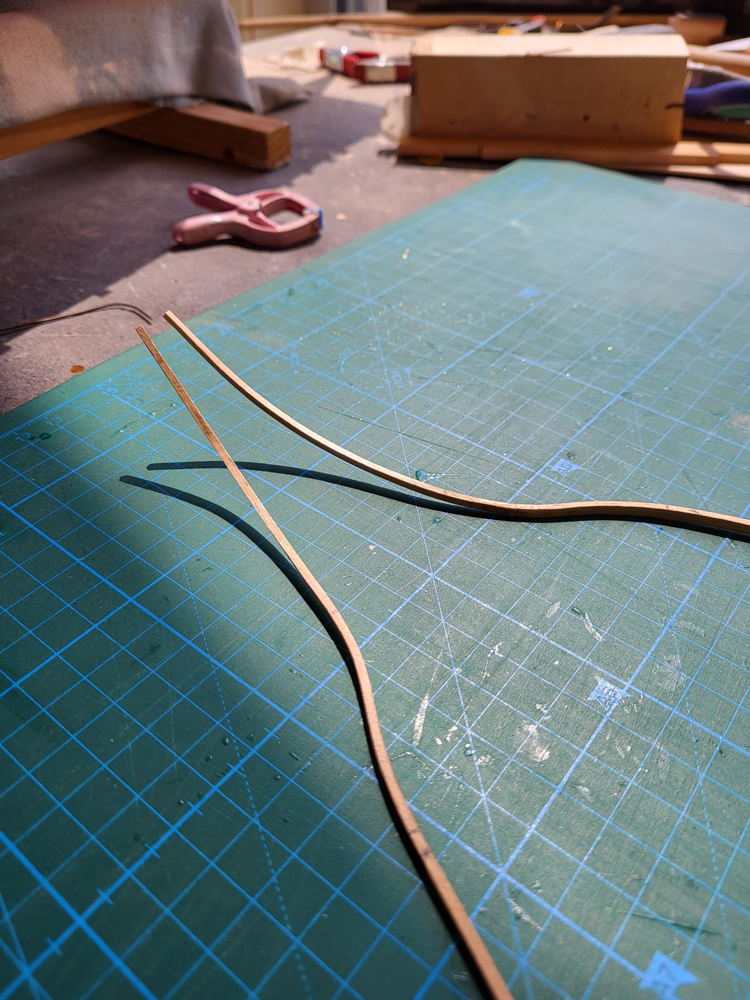

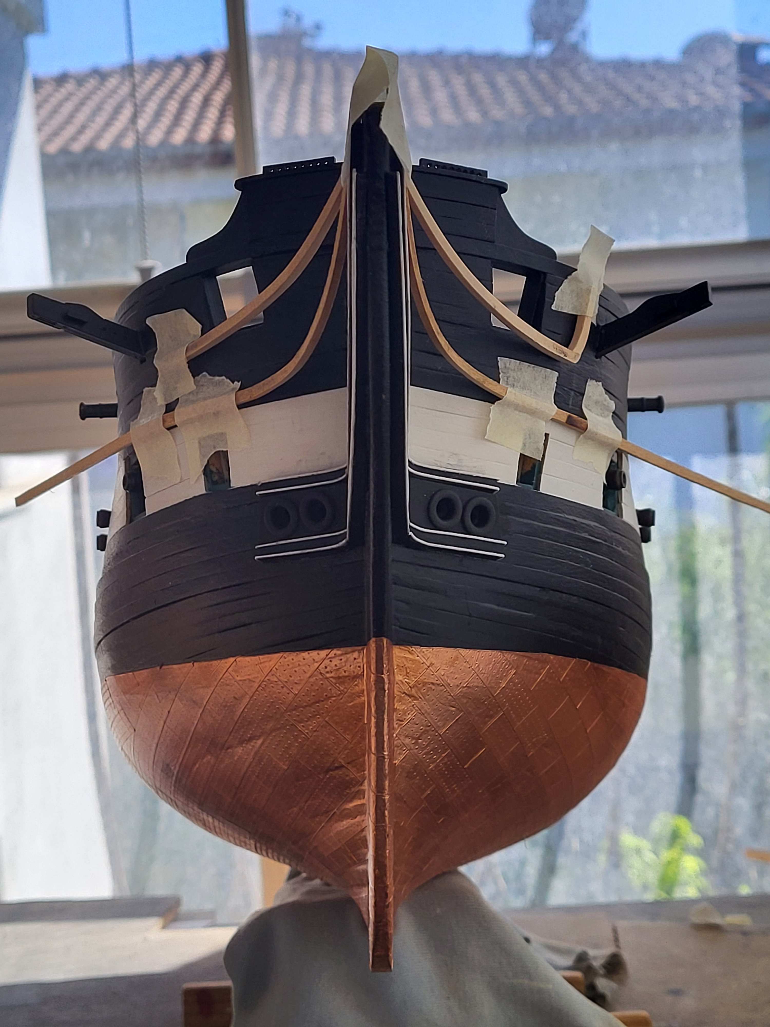

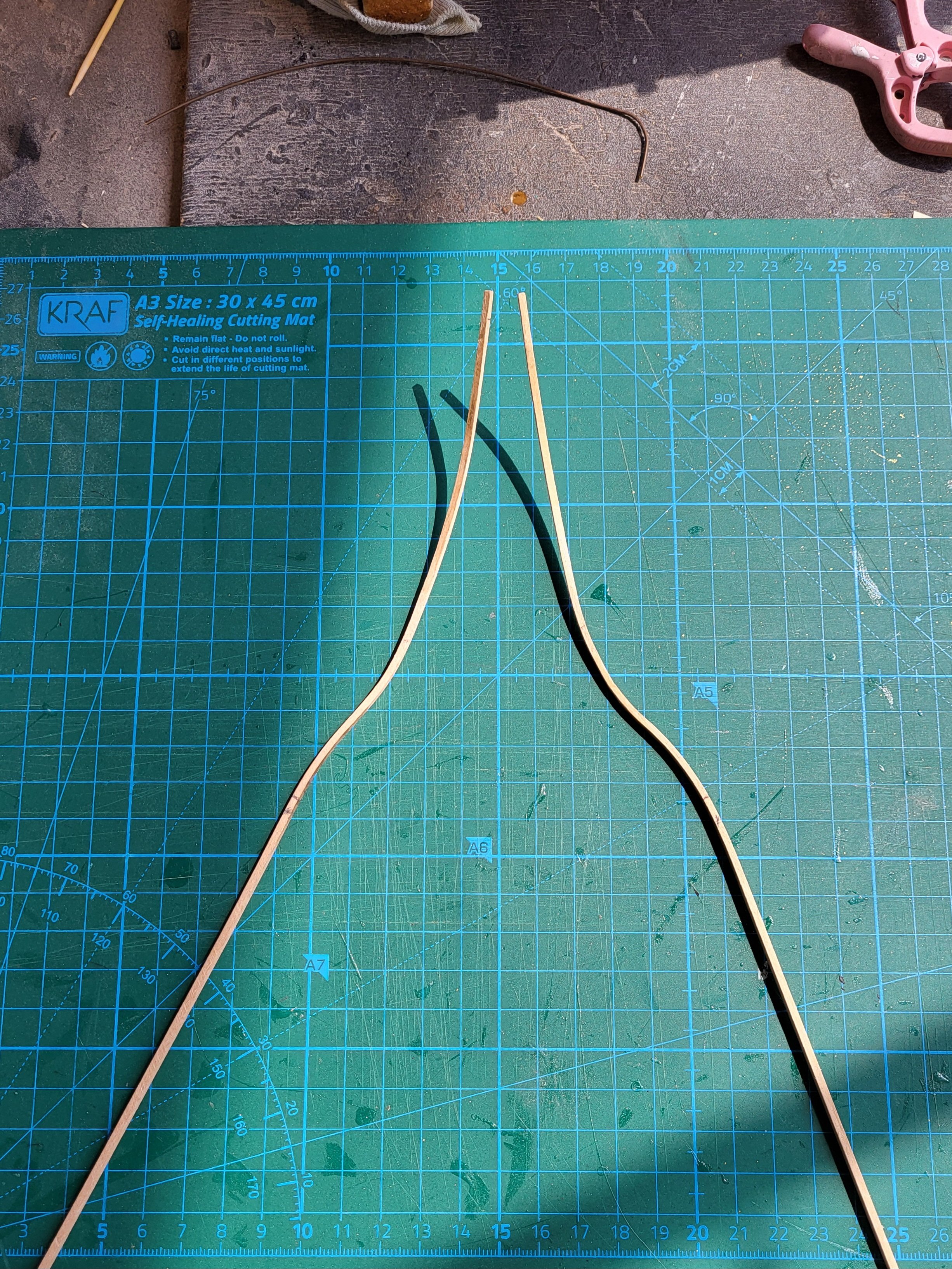

Finally I decided to do this; first give the rails the required shape and glue them in place, then make the supports. I shaped the 3rd rails by heating them with an iron, since they required bending in three different directions. Of course, this was not easy, but I achieved an acceptable result. The 2nd rails were easier, I soaked them in hot water and attached them to the molds I had prepared beforehand and waited for them to dry. I tested all the rails in place and did not see any visible defects in symmetry. Now I will paint these rails and attach them to their places by adding the white stripes.
Note: To name the rails correctly, I reviewed the MS plan again and renamed them. In this post, I have renamed the rails I made as 2nd rails and 3rd rails.

It would seem that you and I are taking different approaches. I'm coming at it from the support-first methodology. I'm keeping my options open though, and will watch closely from the sidelines to see how your plan shapes up.  So far, I haven't glued anything into place, while I experiment.
Good luck.

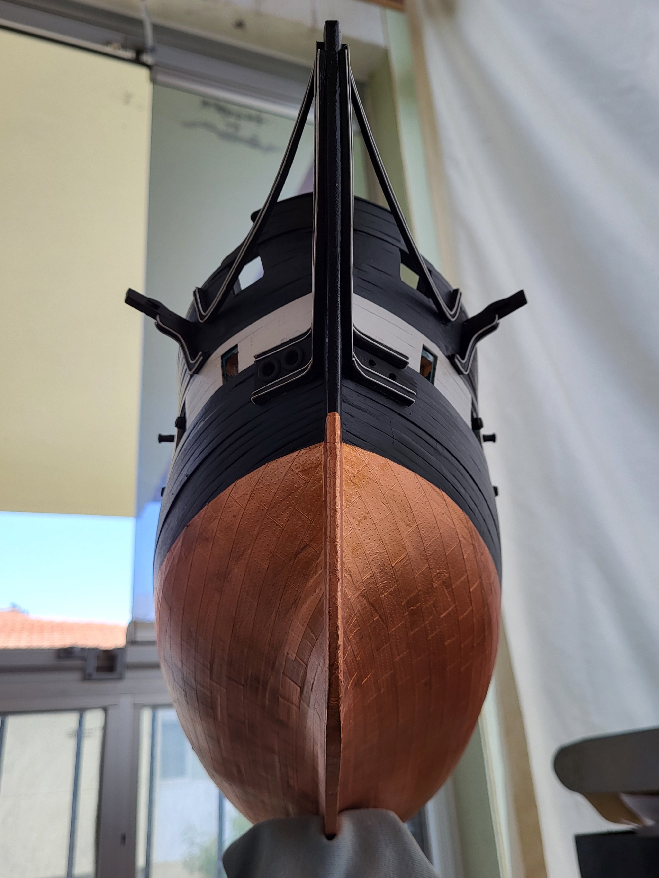

P.S.  Man! that copper plating looks good.
Good luck.

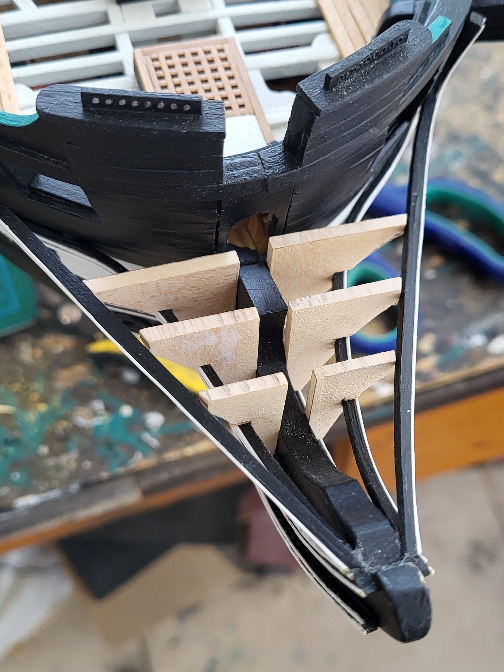

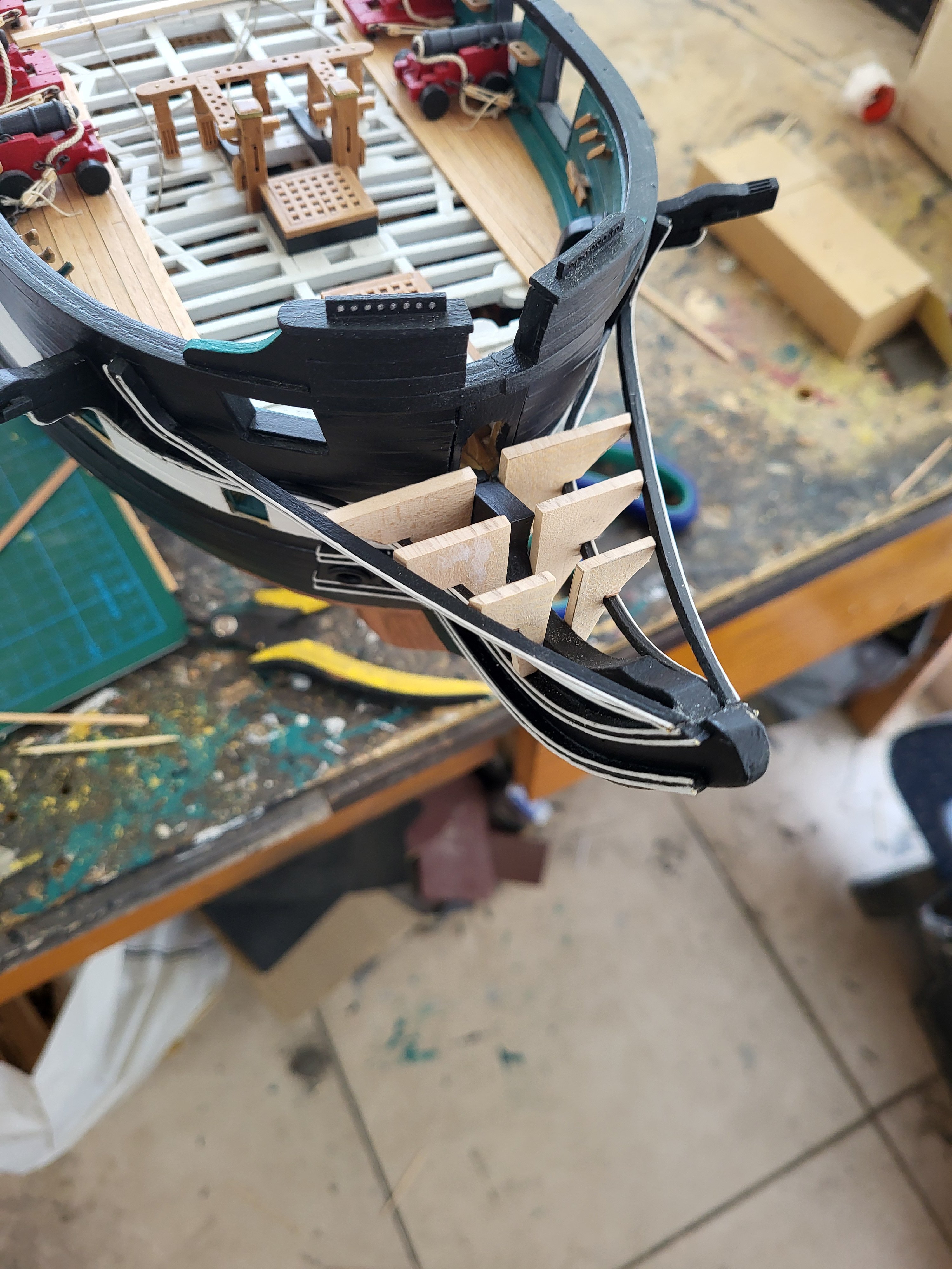

I decided to do this because I was convinced that I could produce the supports correctly by making precise measurements on the model. It seemed to me that bending the rails to fit the supports would be more difficult.

You may indeed be right.  One think I would check now though, is how does the grating for the head fit?   When I fitted the rails I had bent to shape, I found that the grating didn't fit at all.  So, I think I'll bend the rails to fit later.  With the plank bending iron I have, that should be easier than trying to get the grating etc. to fit the curves later.

Some modelers created a flat platform and placed the gratings on top, while others positioned them in a curved manner to match the bend of the second rail. As far as I understand, you chose the second option. I don't know which one is correct, and I haven't decided how to proceed yet.

On 5/5/2025 at 12:32 AM, mtbediz said:
...because I was convinced that I could produce the supports correctly by making precise measurements on the model. It seemed to me that bending the rails to fit the supports would be more difficult.

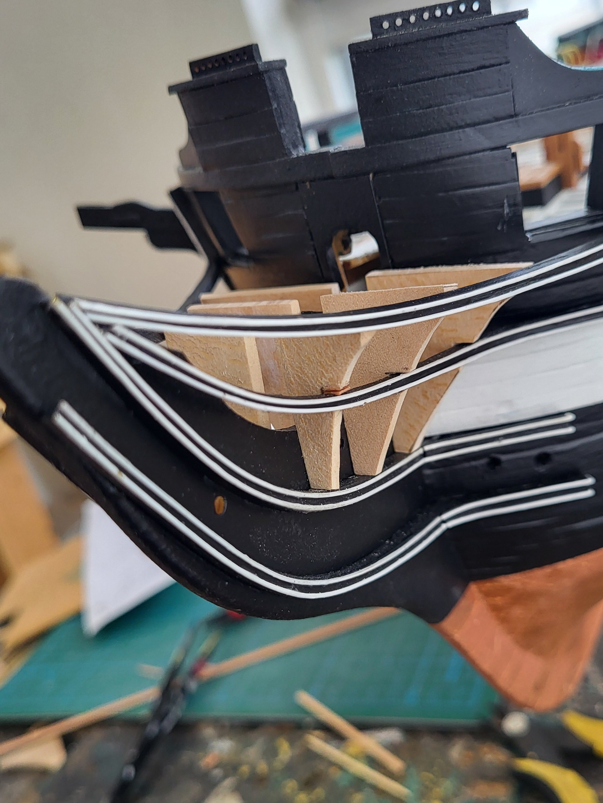

Looks like you made a wise decision, Mustafa!  Your supports are fitting between those rails like hands inside a glove.  Especially interesting how you made the notches in the supports for those lower rails.  Anxious to see how you finish this area up.  Great work, as usual, sir!
Gregg
Man!  You make it look so easy..
I just spent another 4 plus hours on mine, and the supports don't look anywhere as nice as yours.
Great work!
Edited by Der Alte Rentner
The supports are removable and attachable, so there is no problem. I mark the positions where the notches should be by measuring on the model and cut them with a milling machine.
Yeah, I assumed, after you measured where the notches should be and milled them, you slid the supports in a bit sideways so they clear the rails and then pivot them into position.  Excellent work.  Another winner I need to remember!
