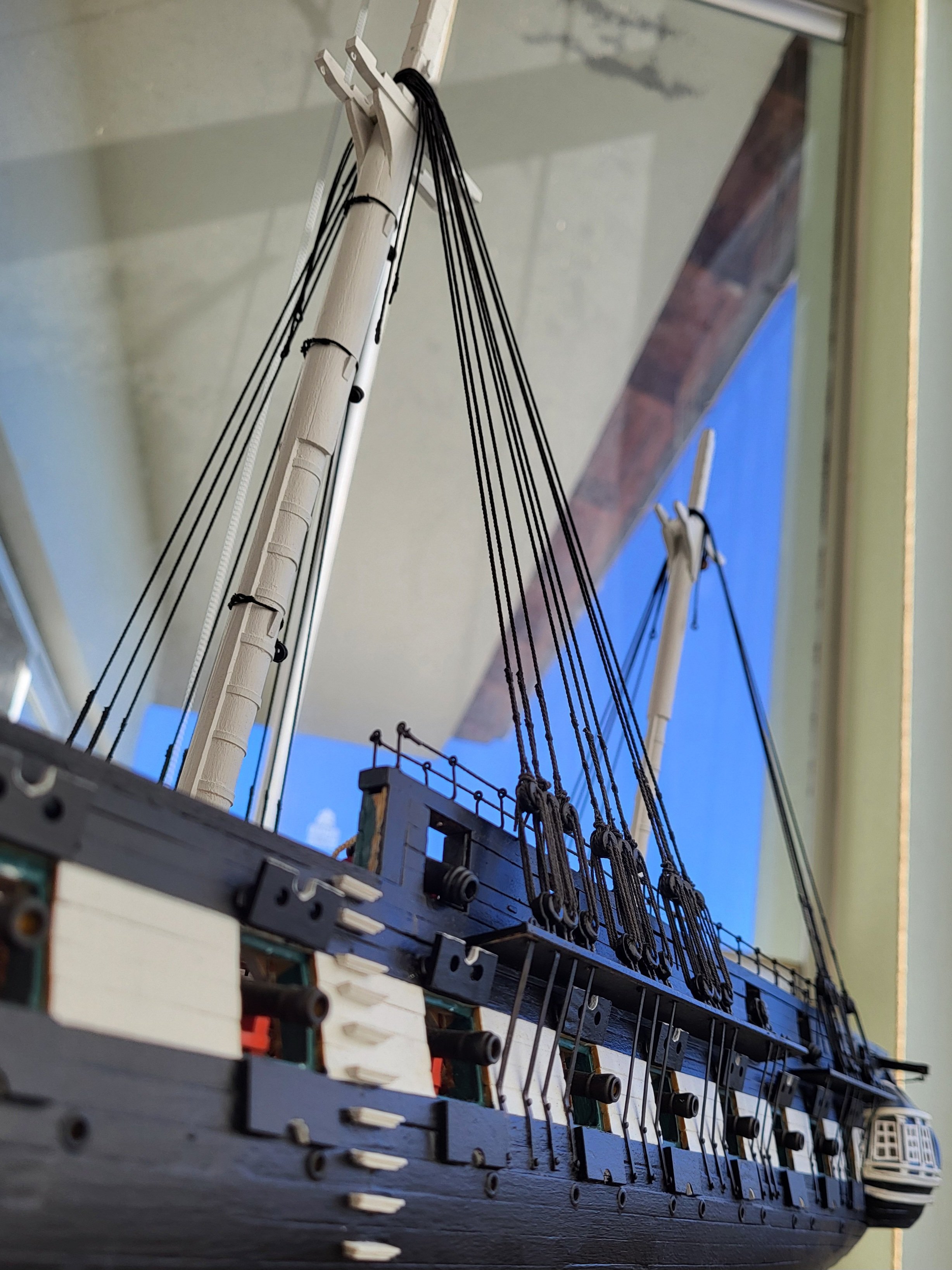

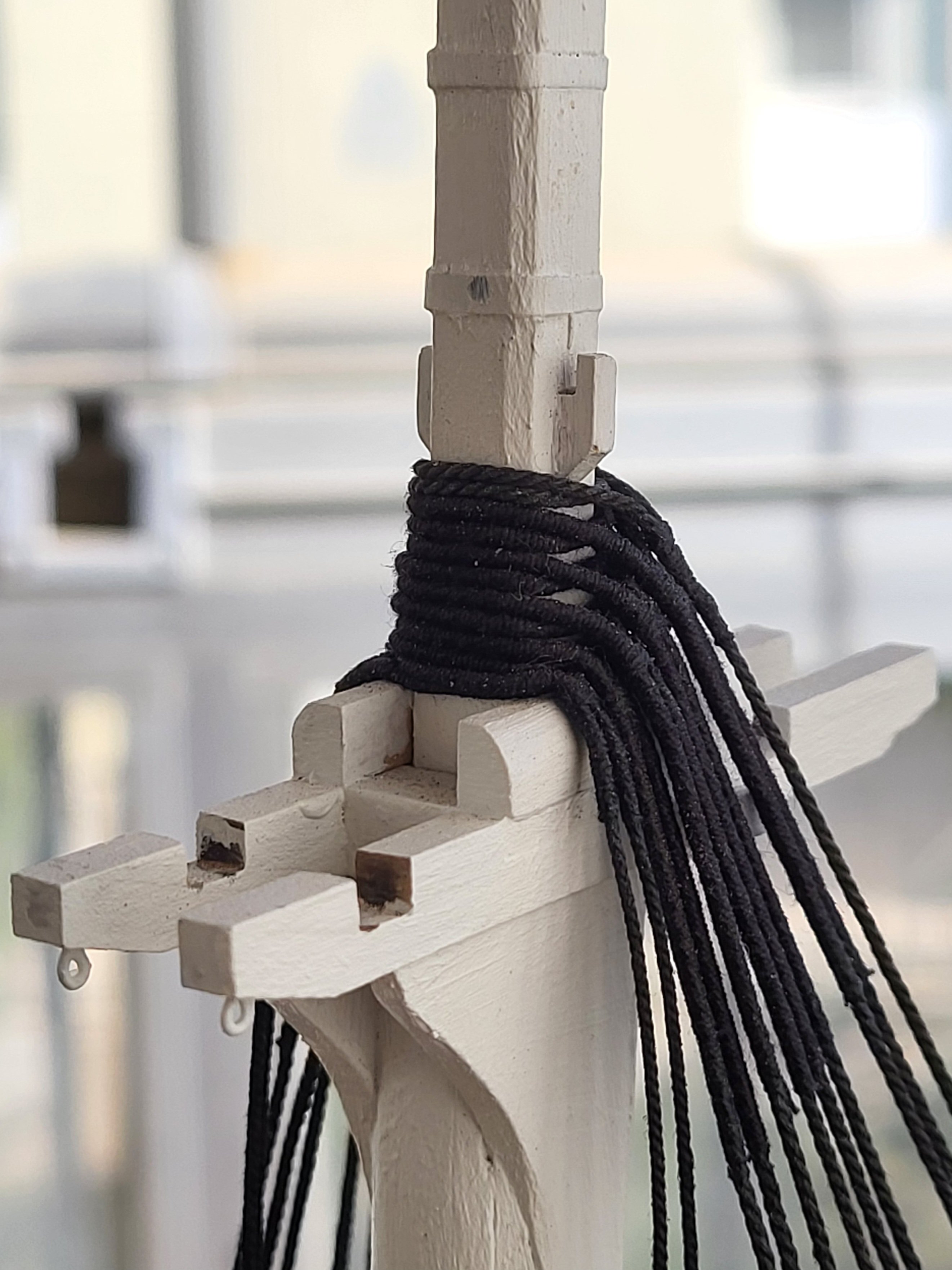

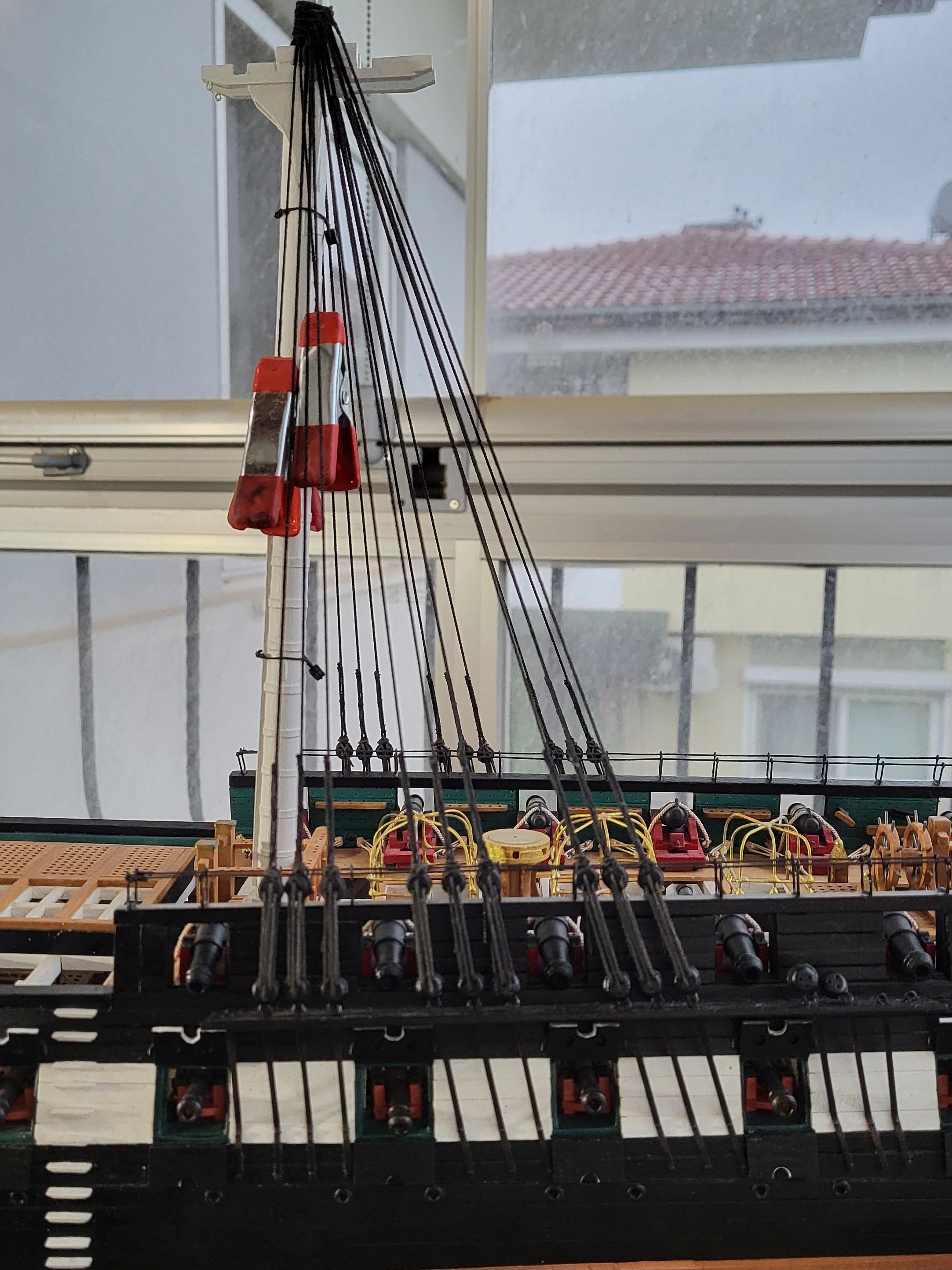

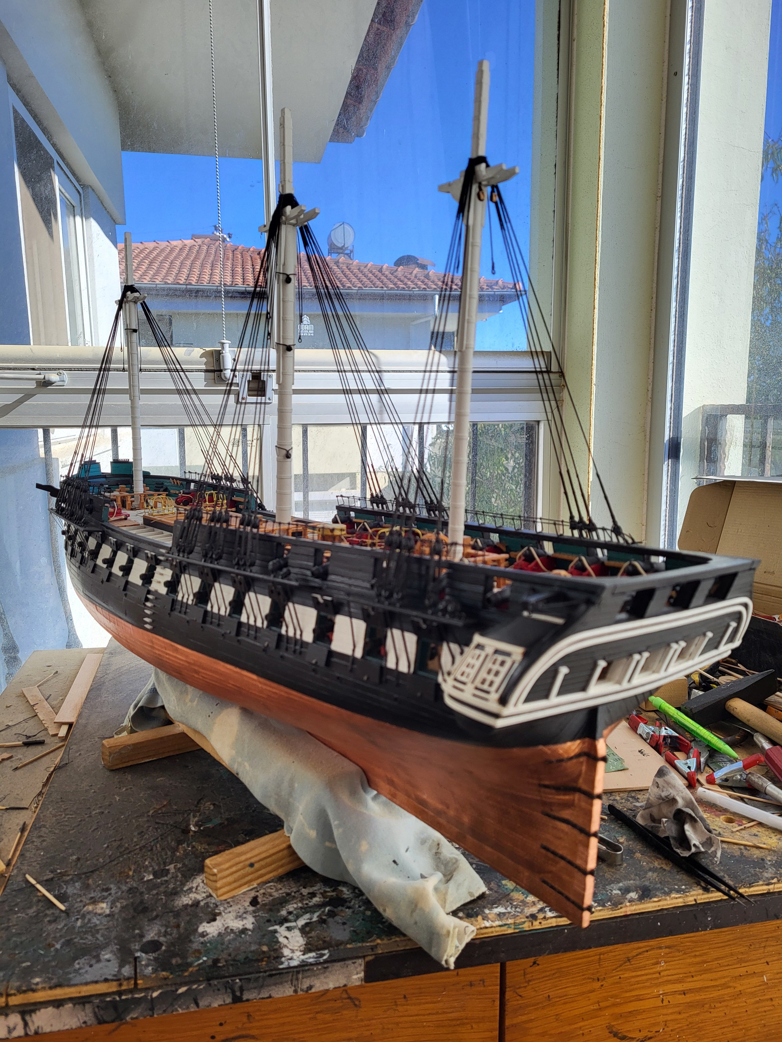

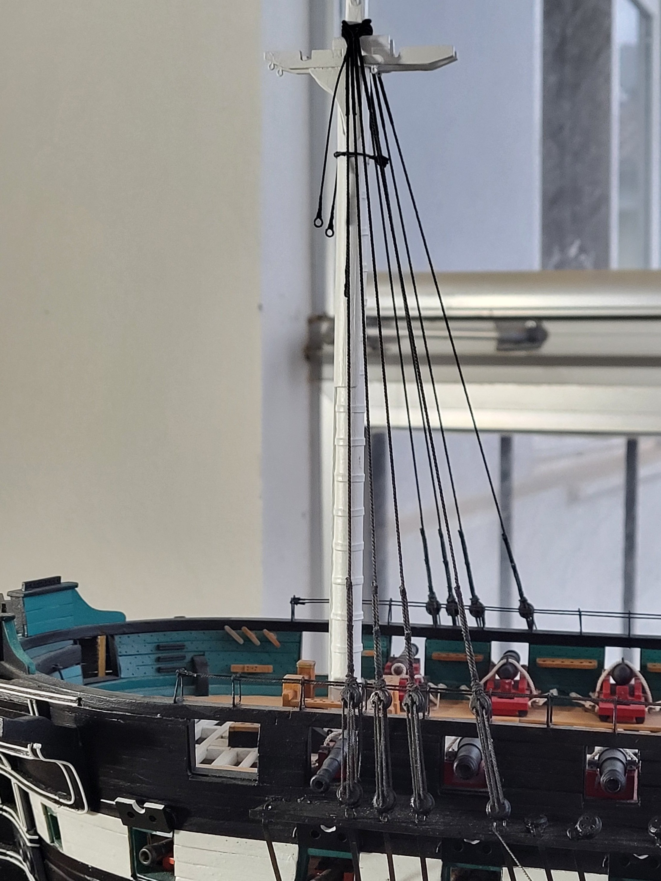

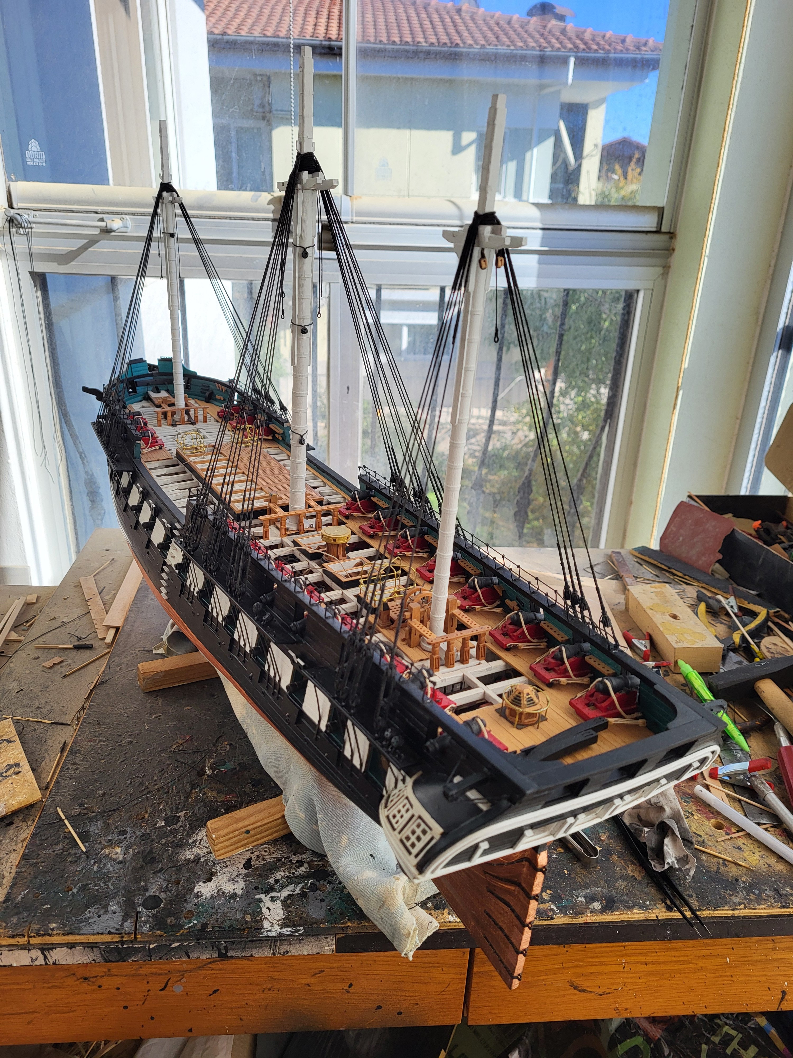

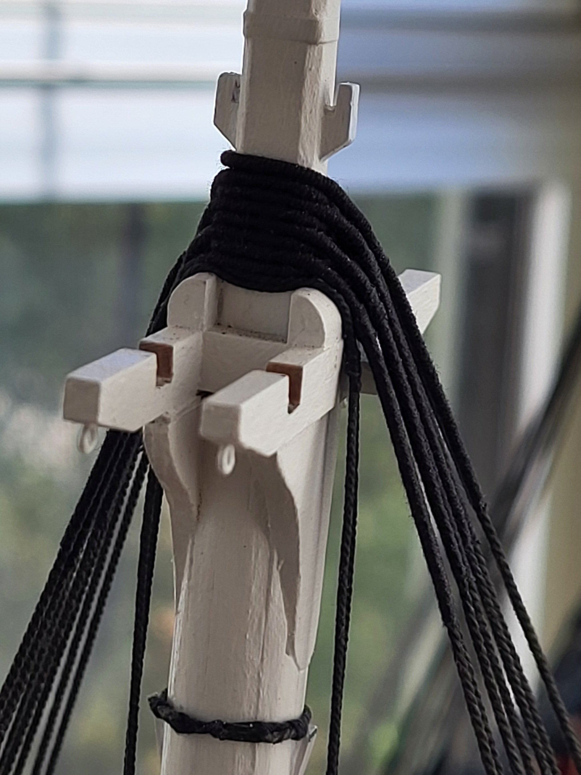

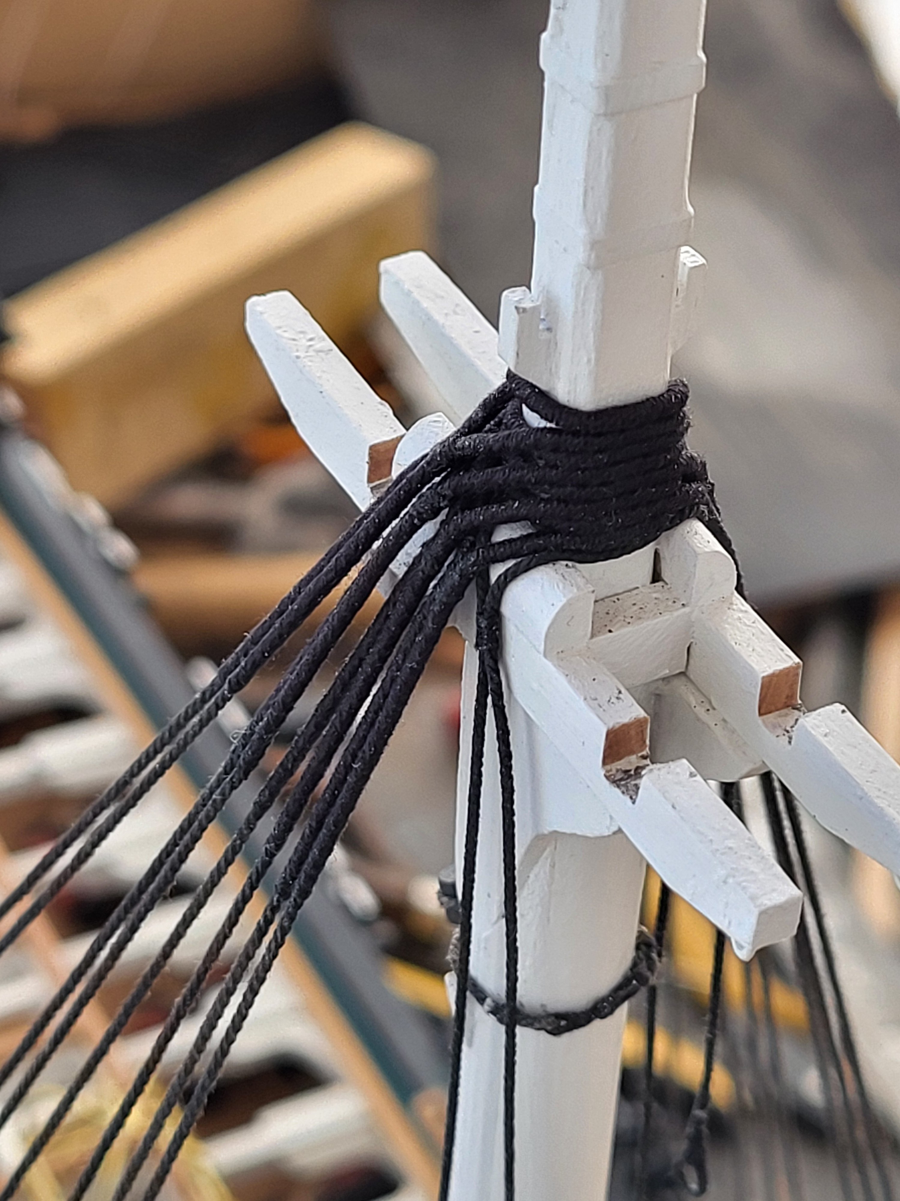

I started on the mainmast and started adding the shroud lines that I made. I started on the forward starboard side and worked side to side adding a pair at a time.
To ensure equal spacing between the upper and lower deadeyes, I use a jig. I secure the upper deadeyes onto a wooden board with a pair of nails set at the same height, and then I attach the shrouds to the deadeyes. After that, I remove the deadeyes from the jig and complete the remaining three knots outside. Once the knots are finished, I pass the shroud back over the mast and connect the upper and lower deadeyes using the lanyard.
Edited by mtbediz
Excellent work, Mustafa!  Nice use of the jig.  What is the distance between upper and lower deadeyes that you were achieving?
Gregg
Thanks, Greg. As you know, I’m working on modeling the Constitution as she appears after the 2015 restoration, so I'm not sticking to any specific plan. Online images of the Constitution show the upper deadeyes slightly above the main rail. That's what I'm trying to achieve.

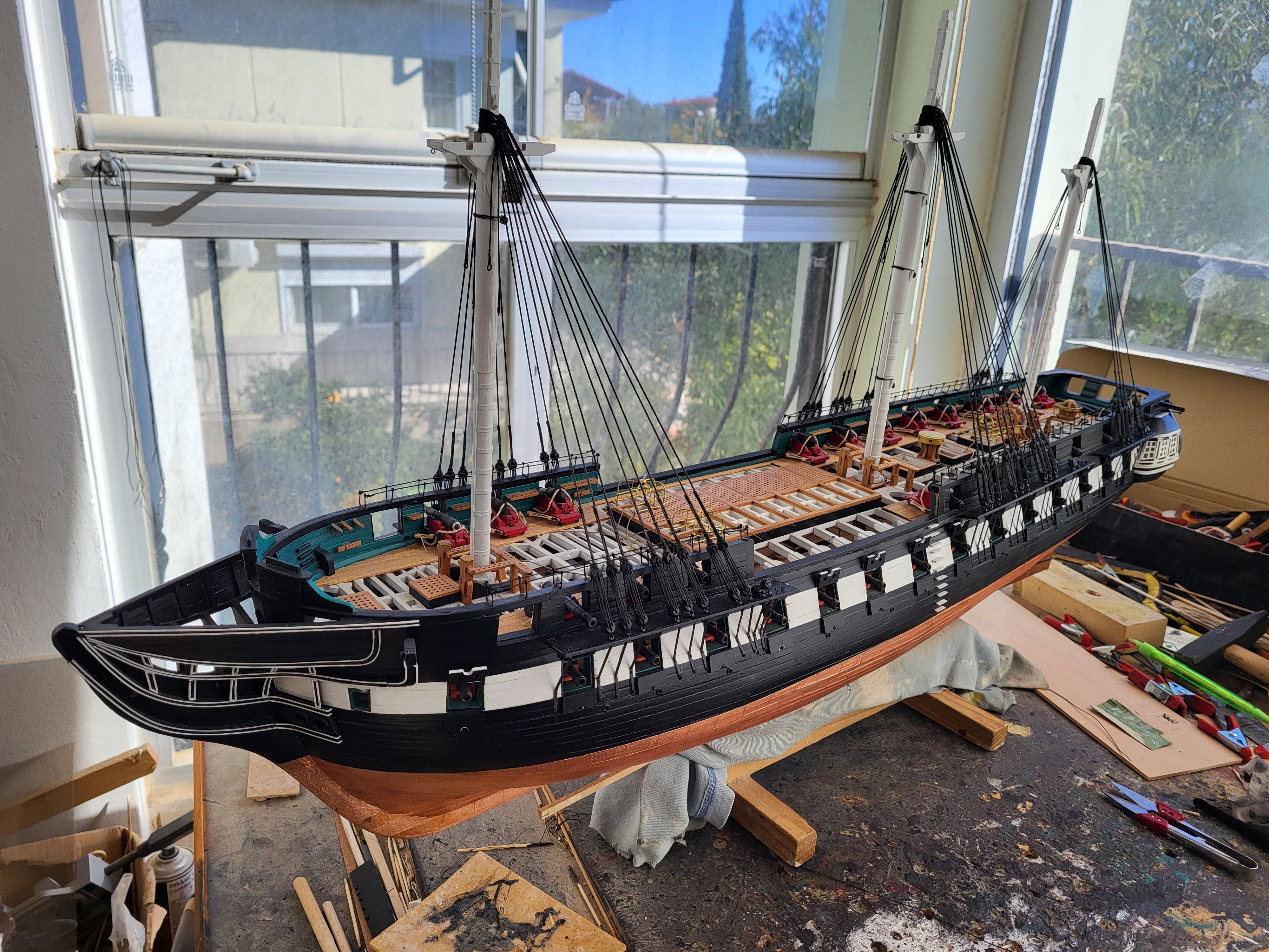

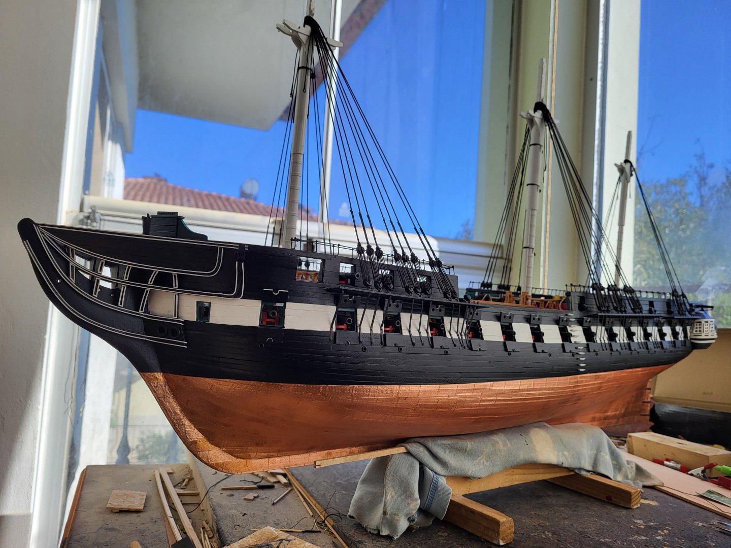

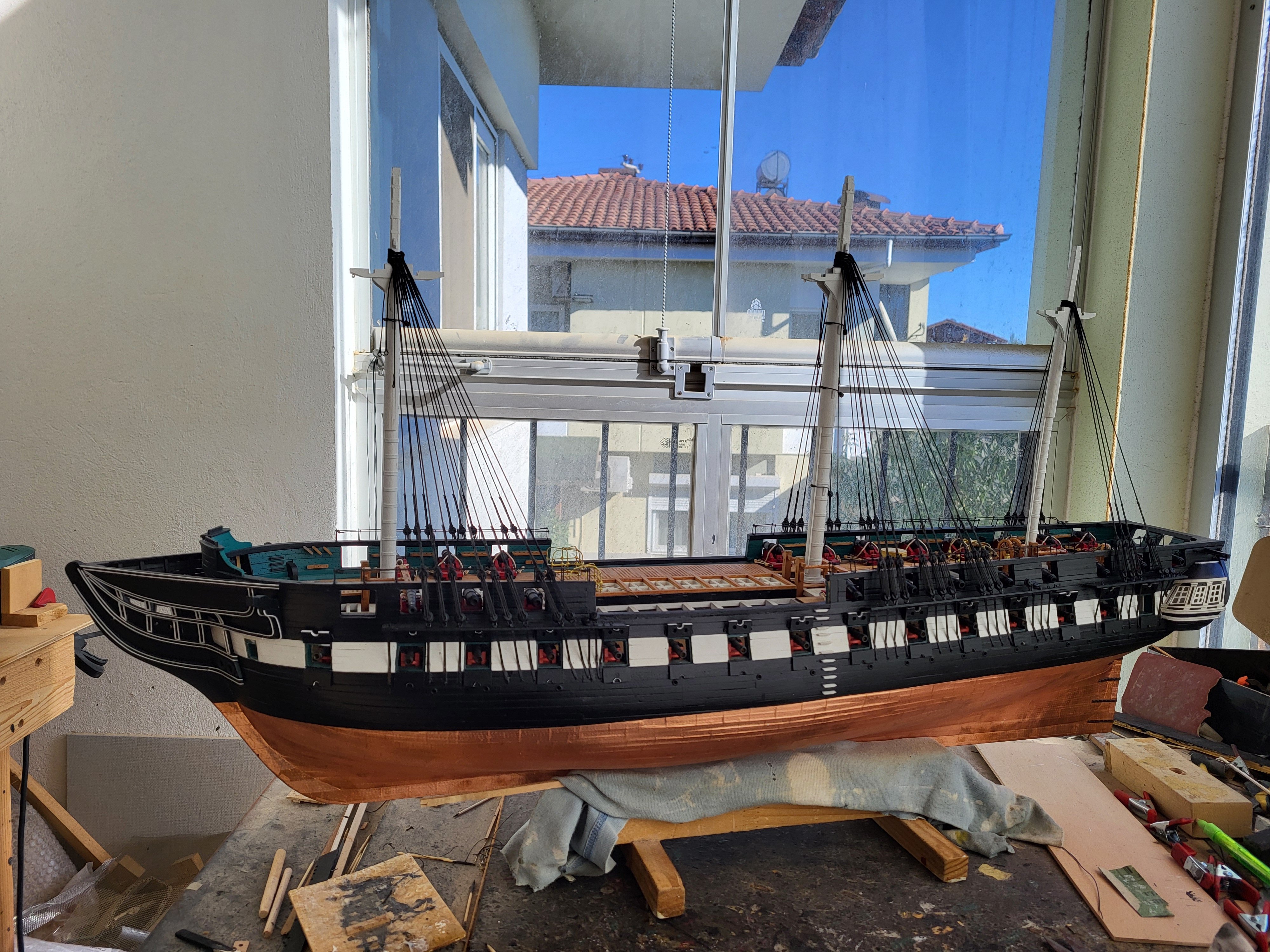

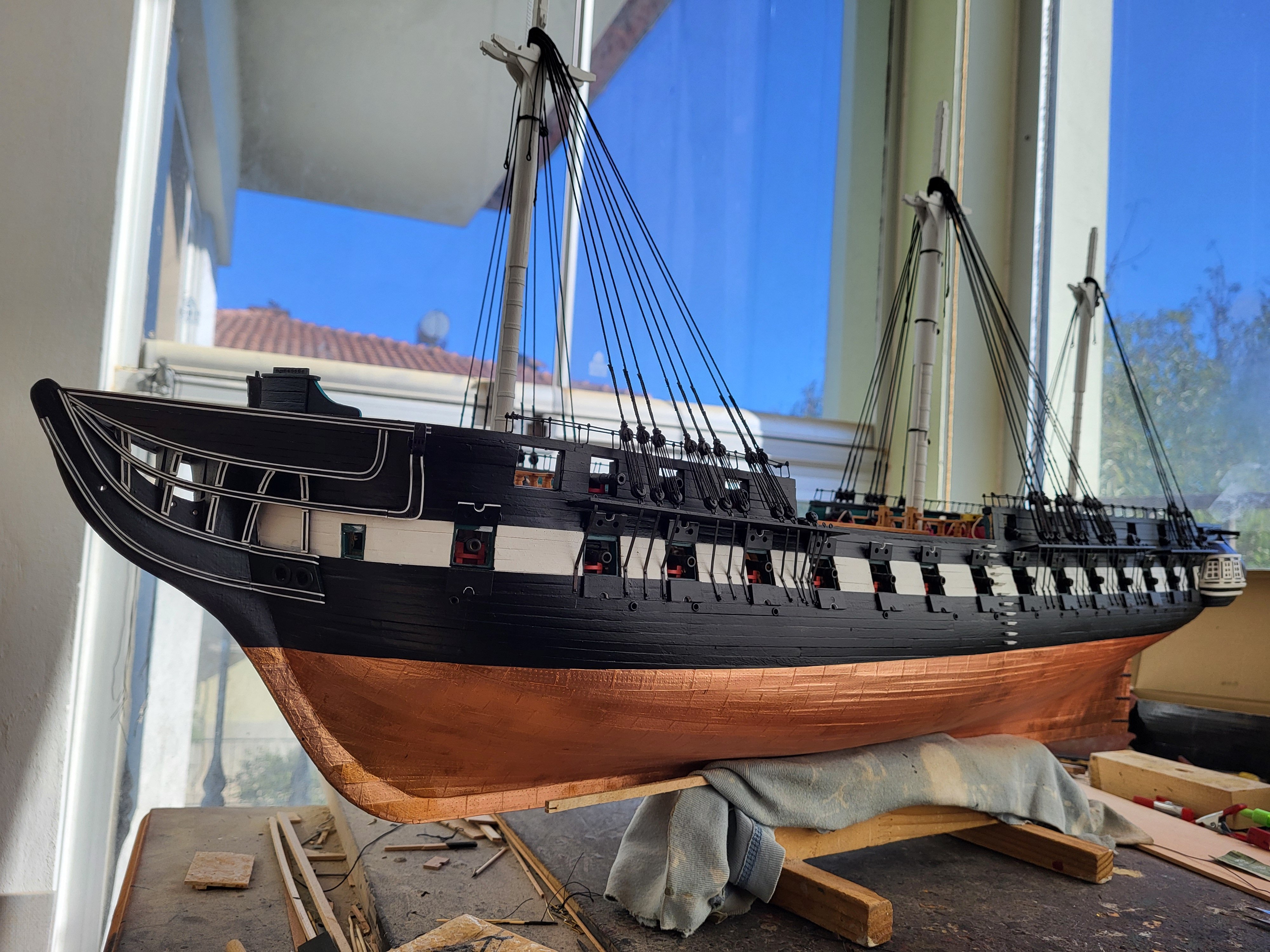

Is it just me, or is the ship starting to look like it belongs in Boston Harbor?
With the rigging coming together, the overall silhouette is finally emerging. Little by little, she’s beginning to feel less like a pile of parts and more like a proper ship one that wouldn’t look out of place moored in Boston Harbor. :)
Very impressive, as always!!
Jon
Your ship looks pretty much exactly like what I saw in Boston in September, Mustafa!  Rigging is looking sharp!  Can't wait to see more as your ship gets even taller!  👍🏆

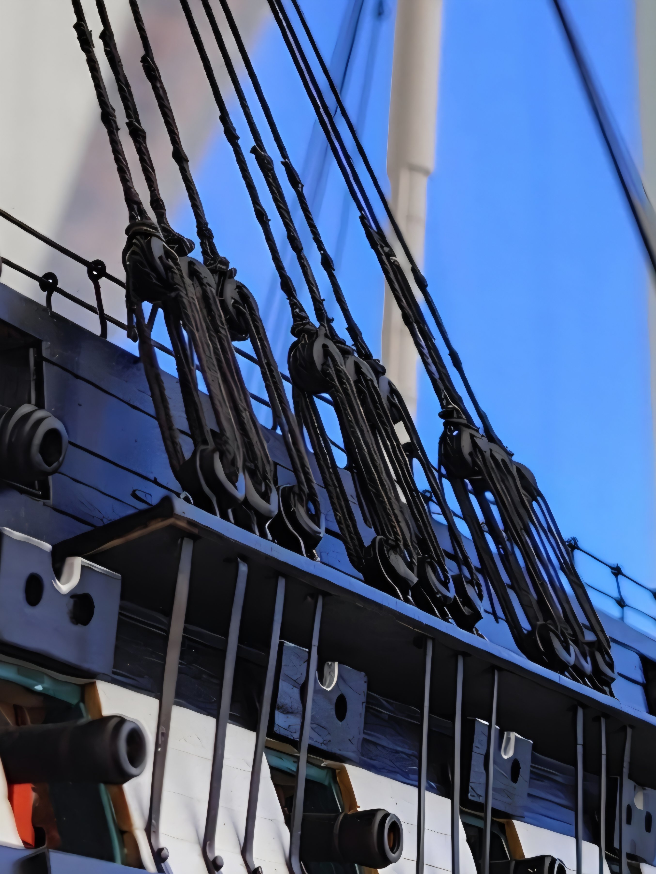

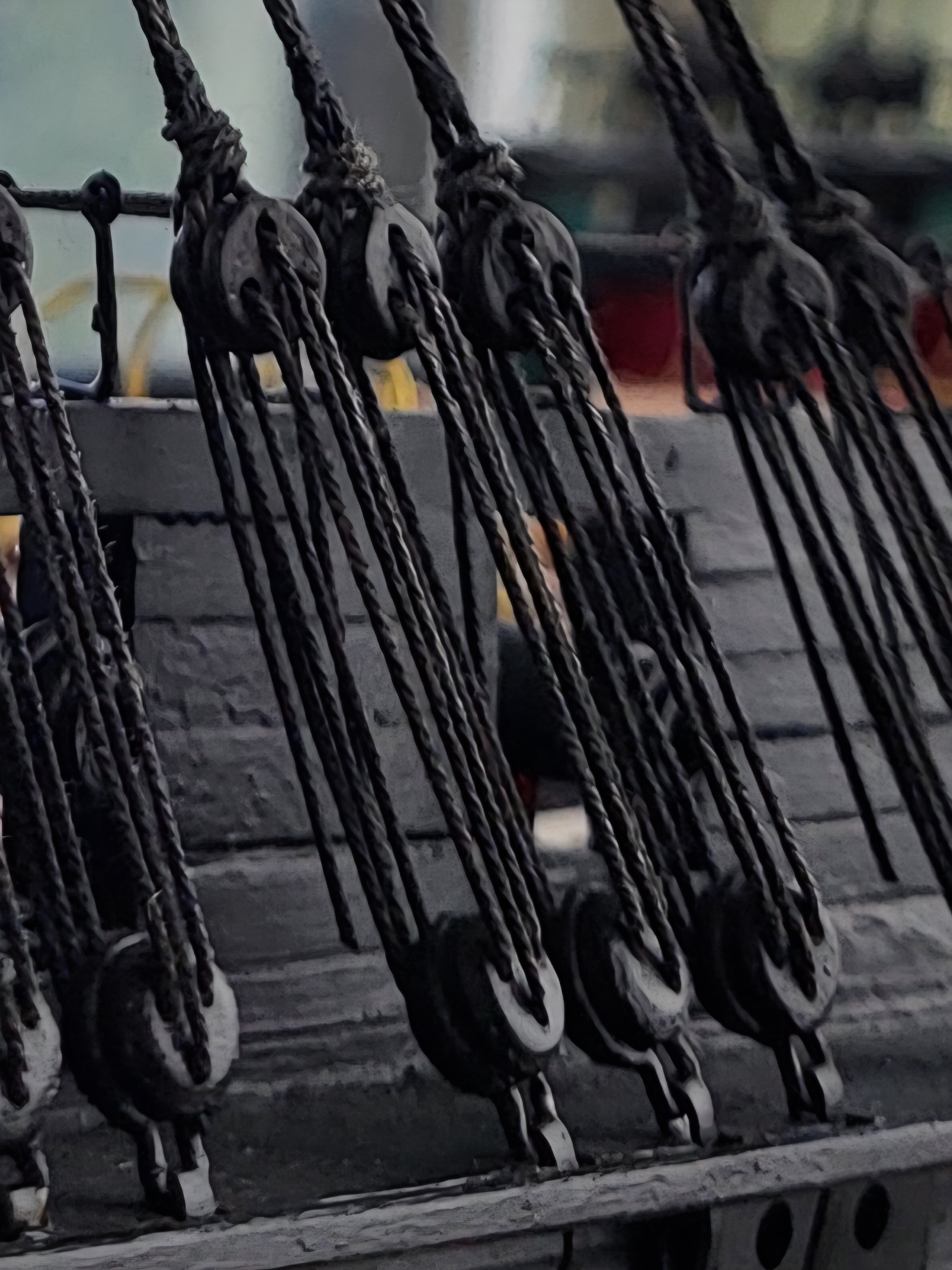

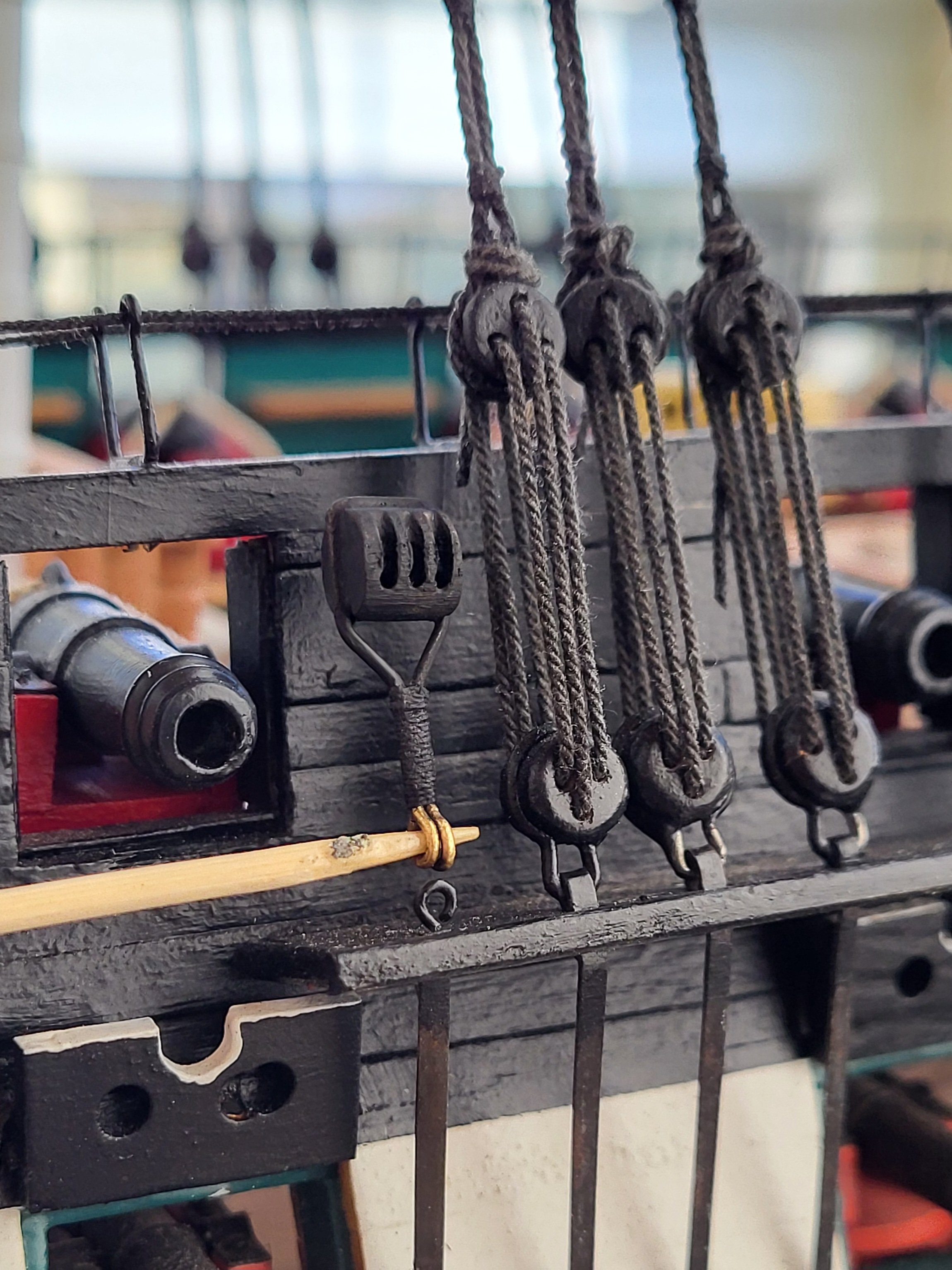

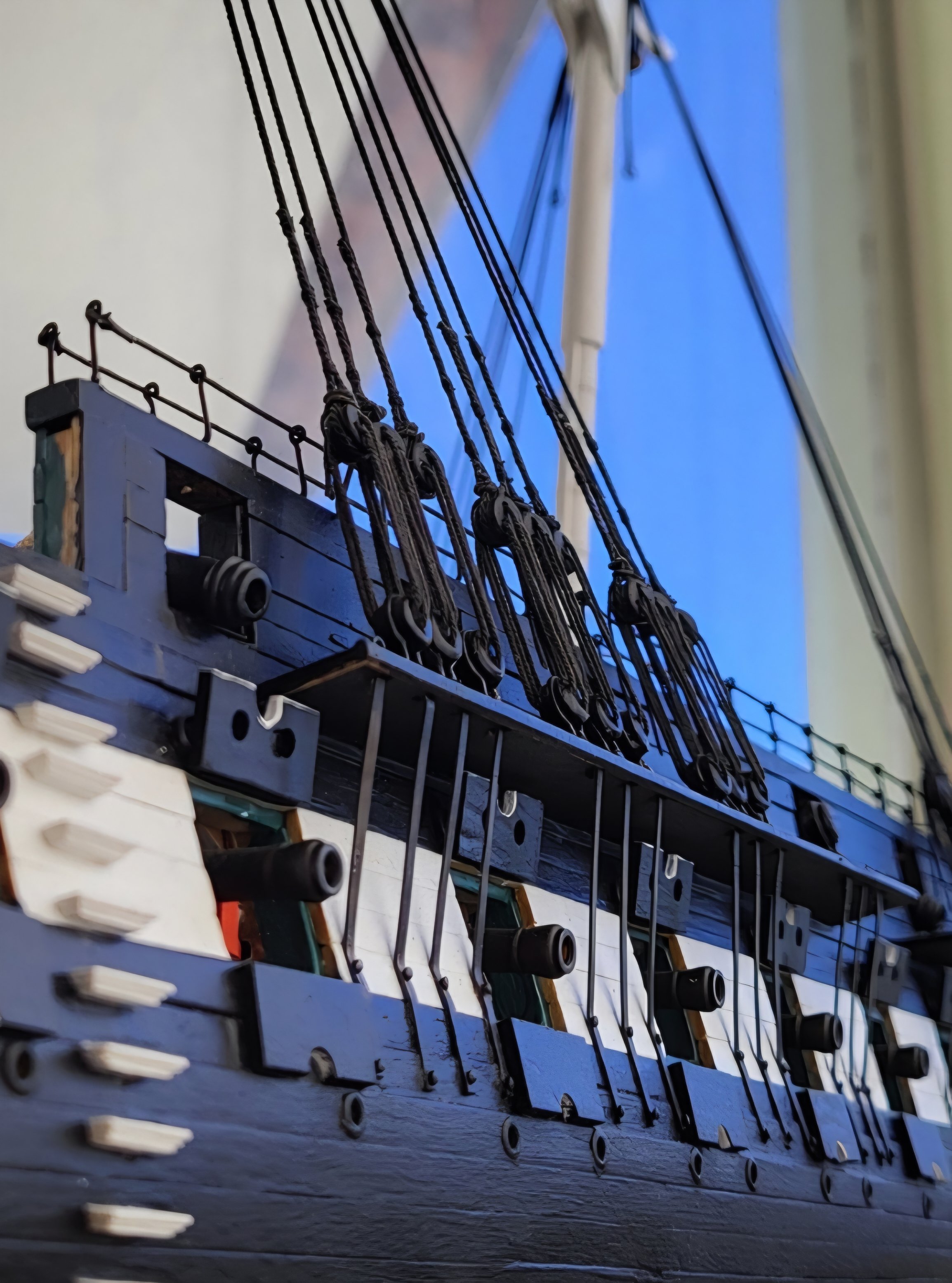

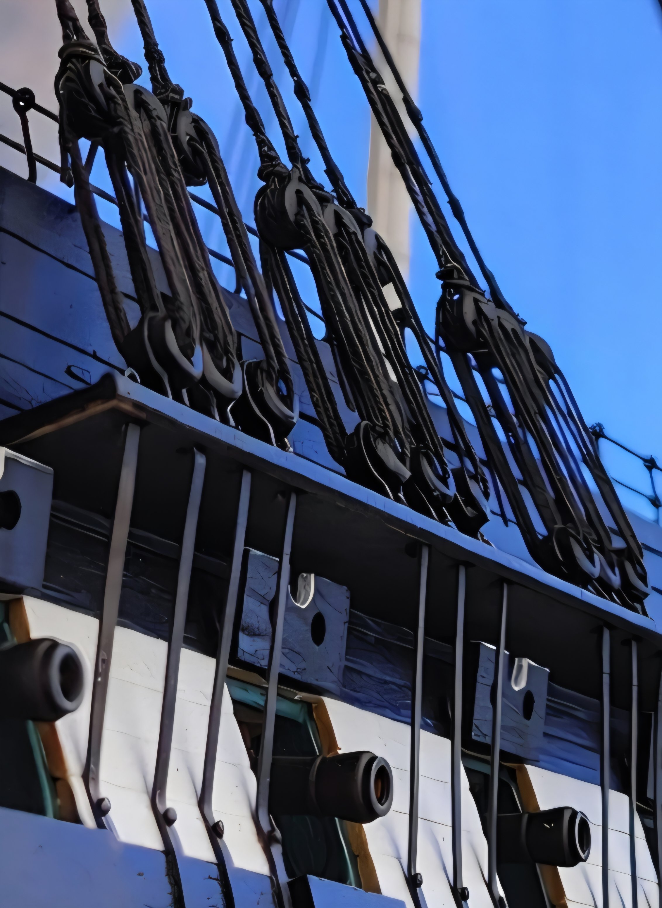

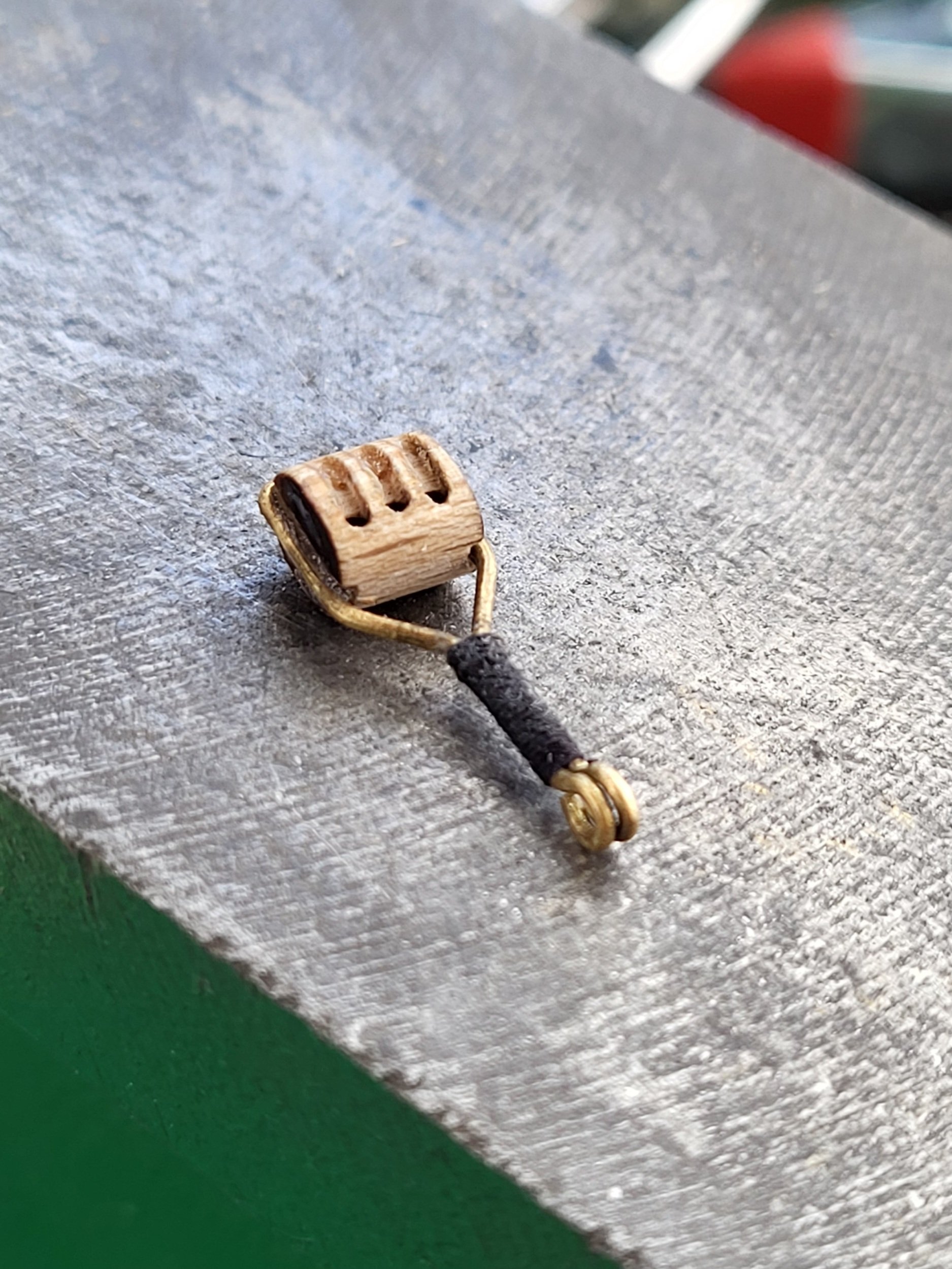

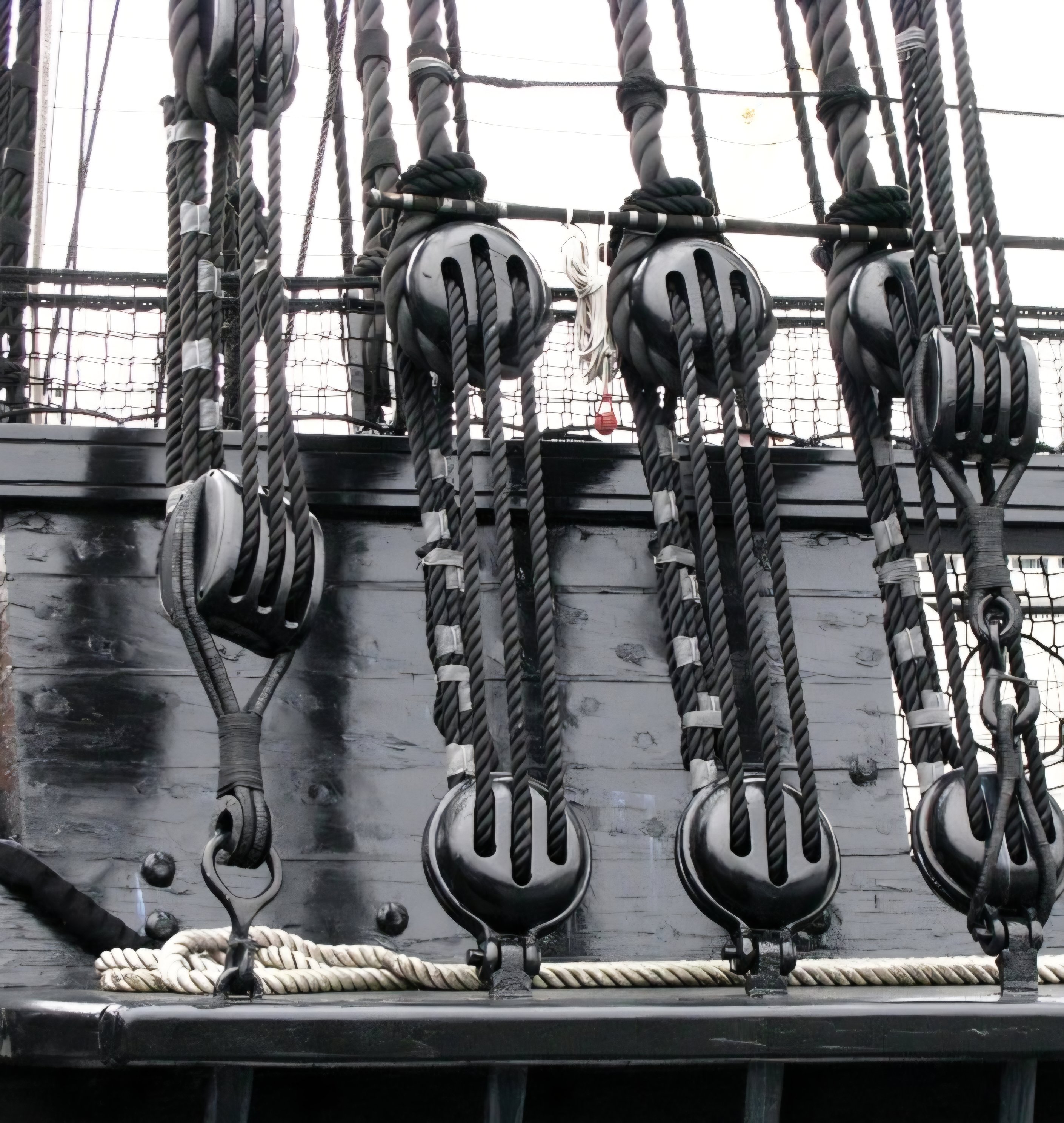

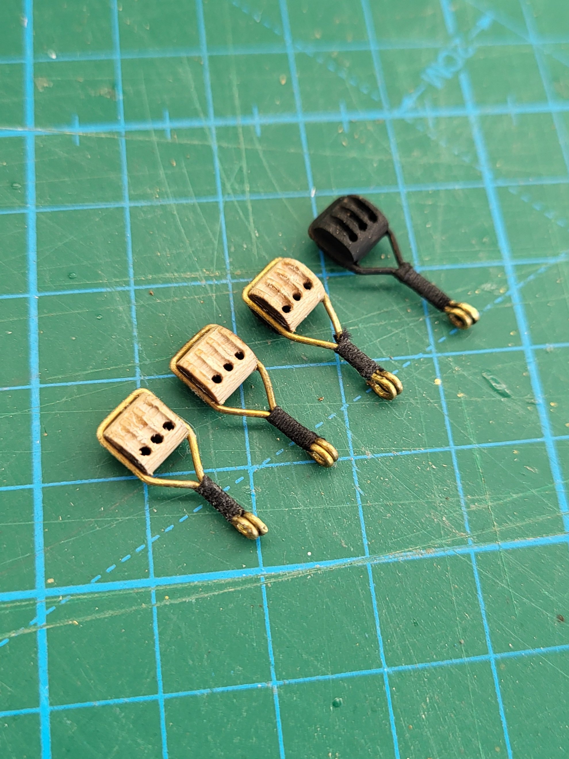

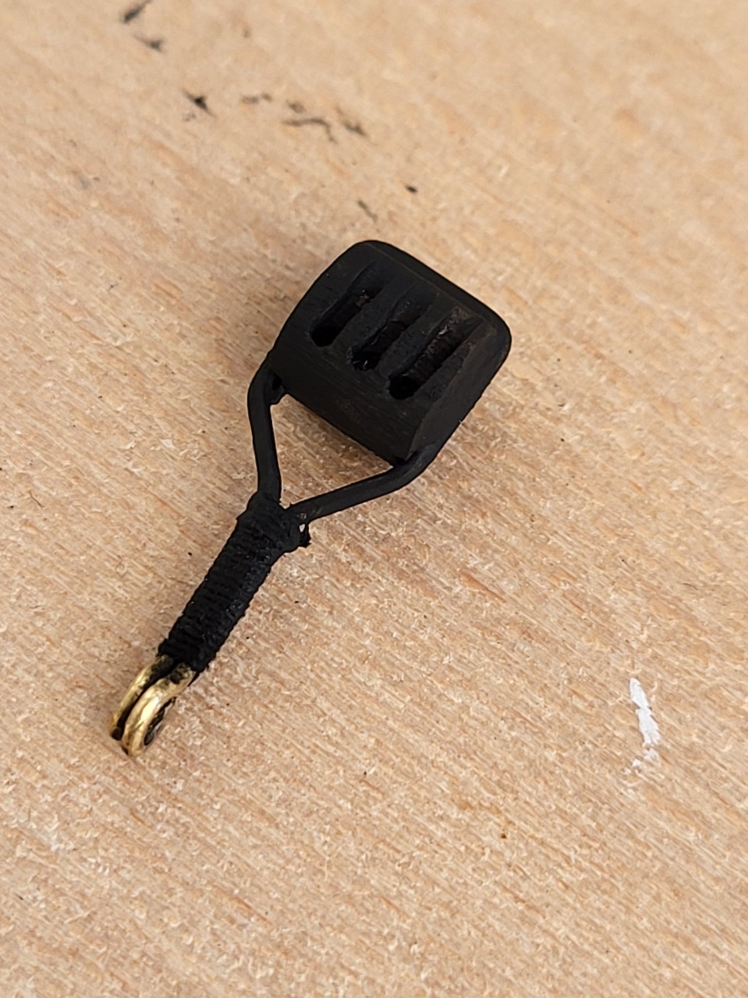

Beautifully done. I assume that since that channel eyebolt is not attached to anything other than the channel, can pull it off, open it up to accept the block double rings, and insert it back into the opening left in the channel? Or do you have a better alternative elegant plan to attached to that triple block to the channel eyebolt?
Jon
Jon
Jon, in the photos of the real ship, the triple block is connected to the eyebolt on the channel via a hook. I'll add a hook to the block as well.
Looking at the actual ship, you are right...of course! My eyesight is not what it use to be...and it was bad then too. I've been wearing glasses since I was seven and should have been wearing them sooner than that. That little detail my fabrication so much easier.
Jon

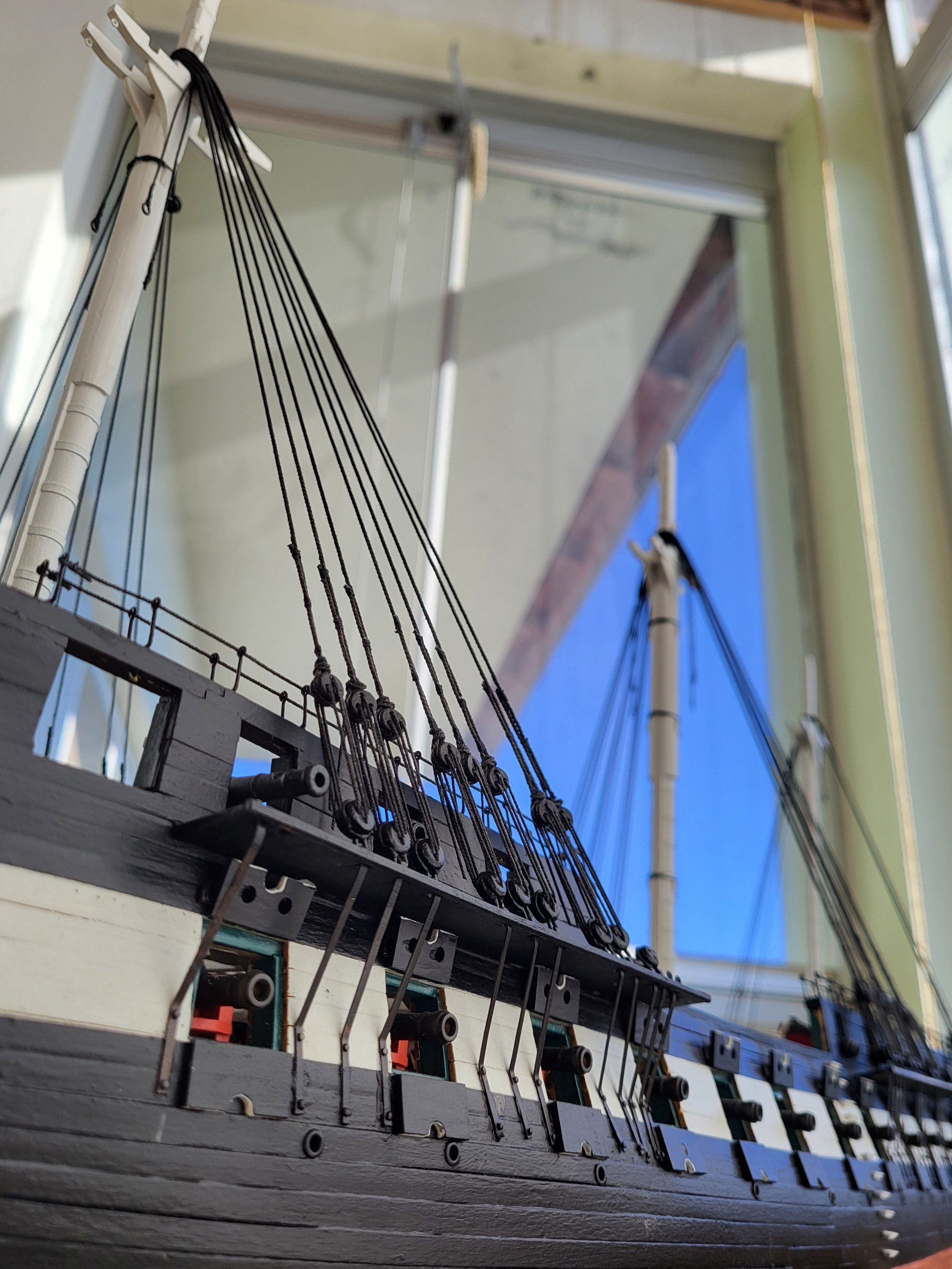

Looks great, Mustafa!  It all looks perfectly aligned.

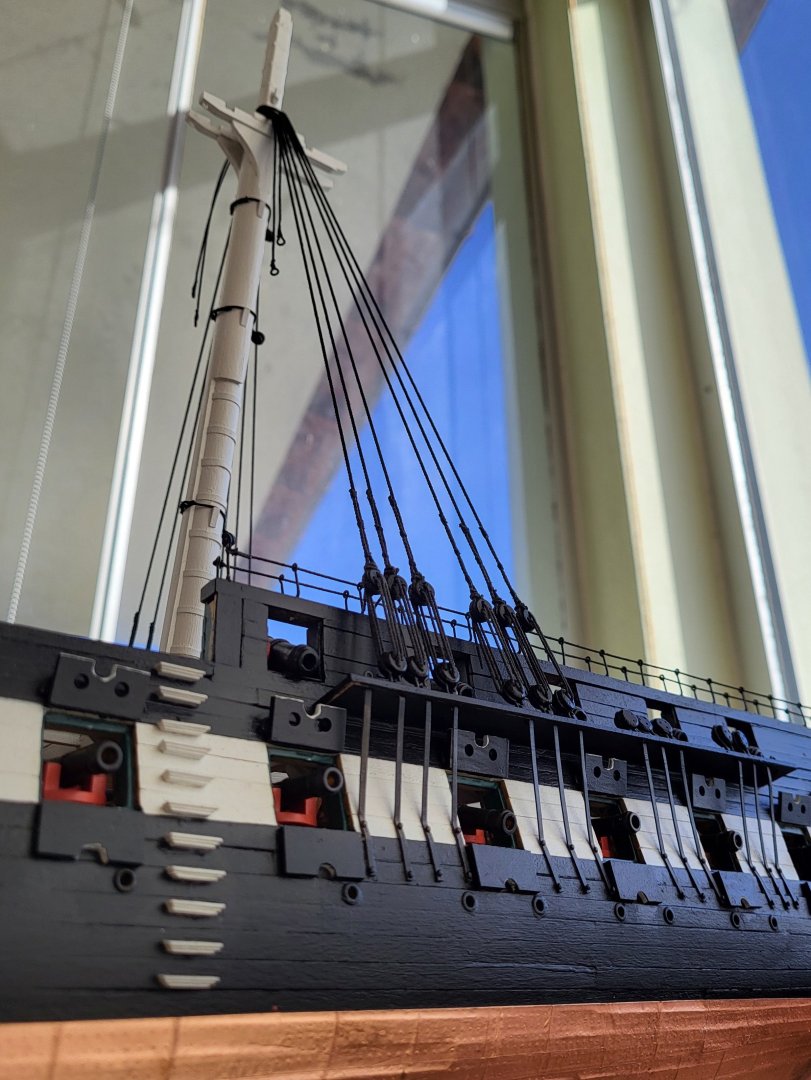

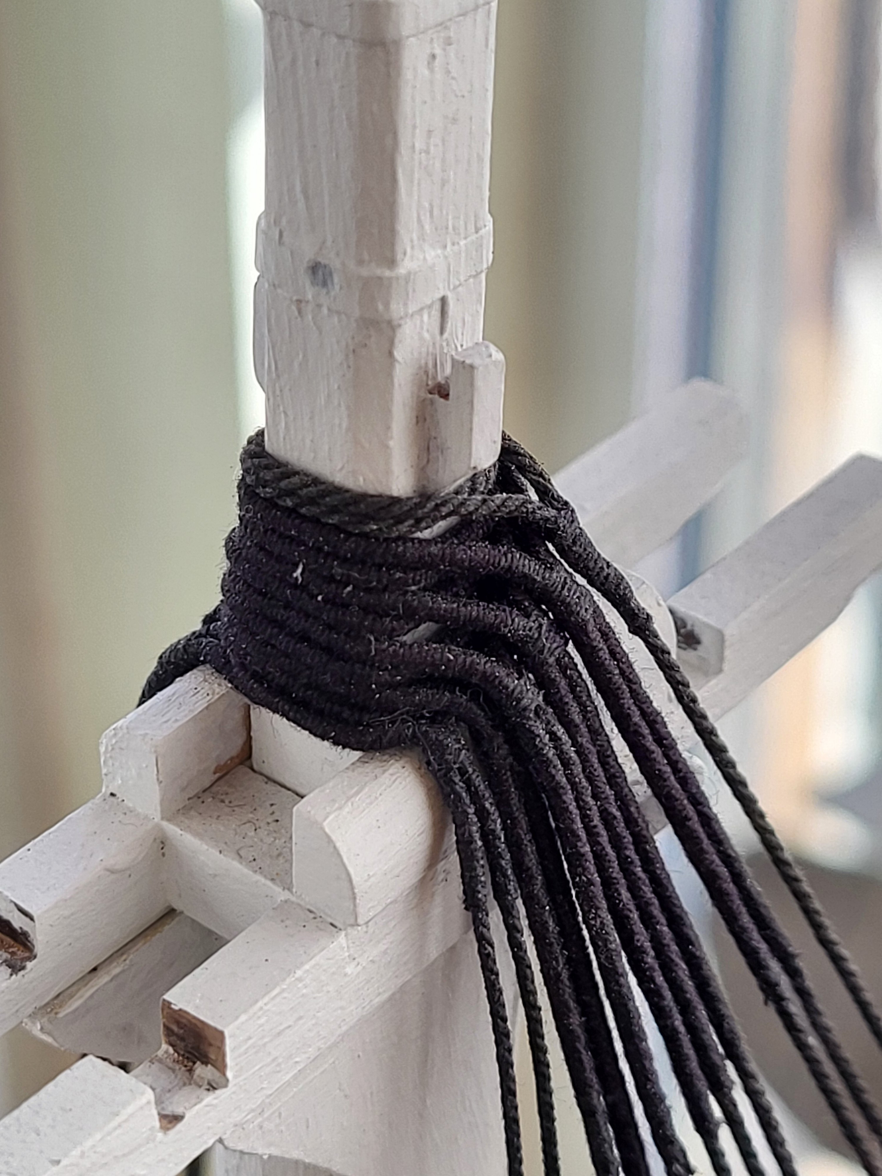

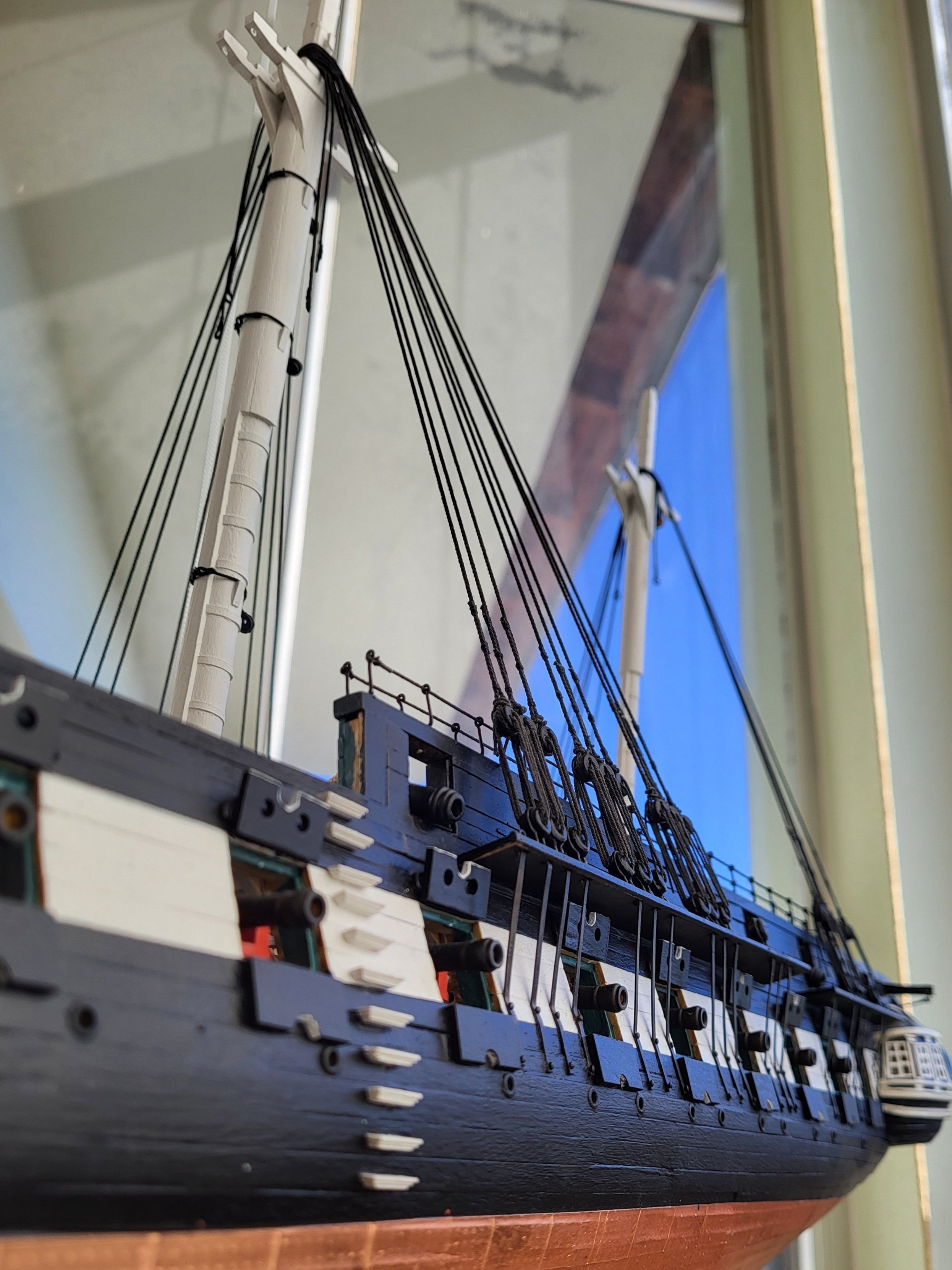

3 hours ago, mtbediz said:
I mounted the tackle equipped stay on the port side of the main mast. By the way, I call this rope a stay, but I'm not sure if that's the correct name.
Is this the rigging I have seen referred to as a "swifter"?
Gregg
At first glance, Jon, it looked to me (both on the real ship and on Mustafa's) as some sort of twisted loops, rather than a simple hook. Excellent work!
Gregg
Thanks Greg. I can’t find what this is in the MS plans, maybe it doesn’t exist, or maybe I just missed it. That’s why I felt I had to point it out. If someone knows, perhaps they can inform us as well.
According to Darcy Lever's The Young Sea Officers Sheet Anchor the tackle you are referring to is called the burton tackle (page 23), especially if it descends from the upper mast top. Sometimes it is just called a mast tackle, especially on the lower masthead. The line from the top is called the tackle pendant. These tackles were used for handling cargo, boats, cannons and other heavy objects.
For what it is worth, the heaviest and strongest winch used for handling cargo on US Navy ships is still called the burtoning winch.
A swifter is the after shroud if there is an odd number of shrouds. It is fitted over the masthead with an eye splice and the shrouds run down on both sides of the mast to deadeyes like the other shrouds.
Phil
Current build: USS Cape MSI-2
From what I understand, since this is on the lower masthead, we can say it's a mast tackle. Thanks for the information Phil.
