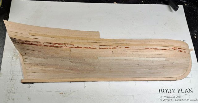

Been awhile since I last posted an update but I have been moving along. Planking is complete except for the second wale and the rails. Of course staining / panting will be the final step.
How well did it go? Not as professional as I would have liked but the kit did serve the purpose of teaching me the correct way to plank a hull and what spiling is all about. Only practice will improve the newly learned skill.
I will post when again the model is completely finished.

Plan is to stain the hull a warm oak. I had a few small gaps in the hull strakes that needed filling before staining. In order to make these as invisible as possible I did the following:
Using this filler that can be tinted with either oil or water base stains.
Placed some in a paper cup and, using a pipet, added my stain and mixed until I was happy with the color. A few hours to dry and then sand and stain.
