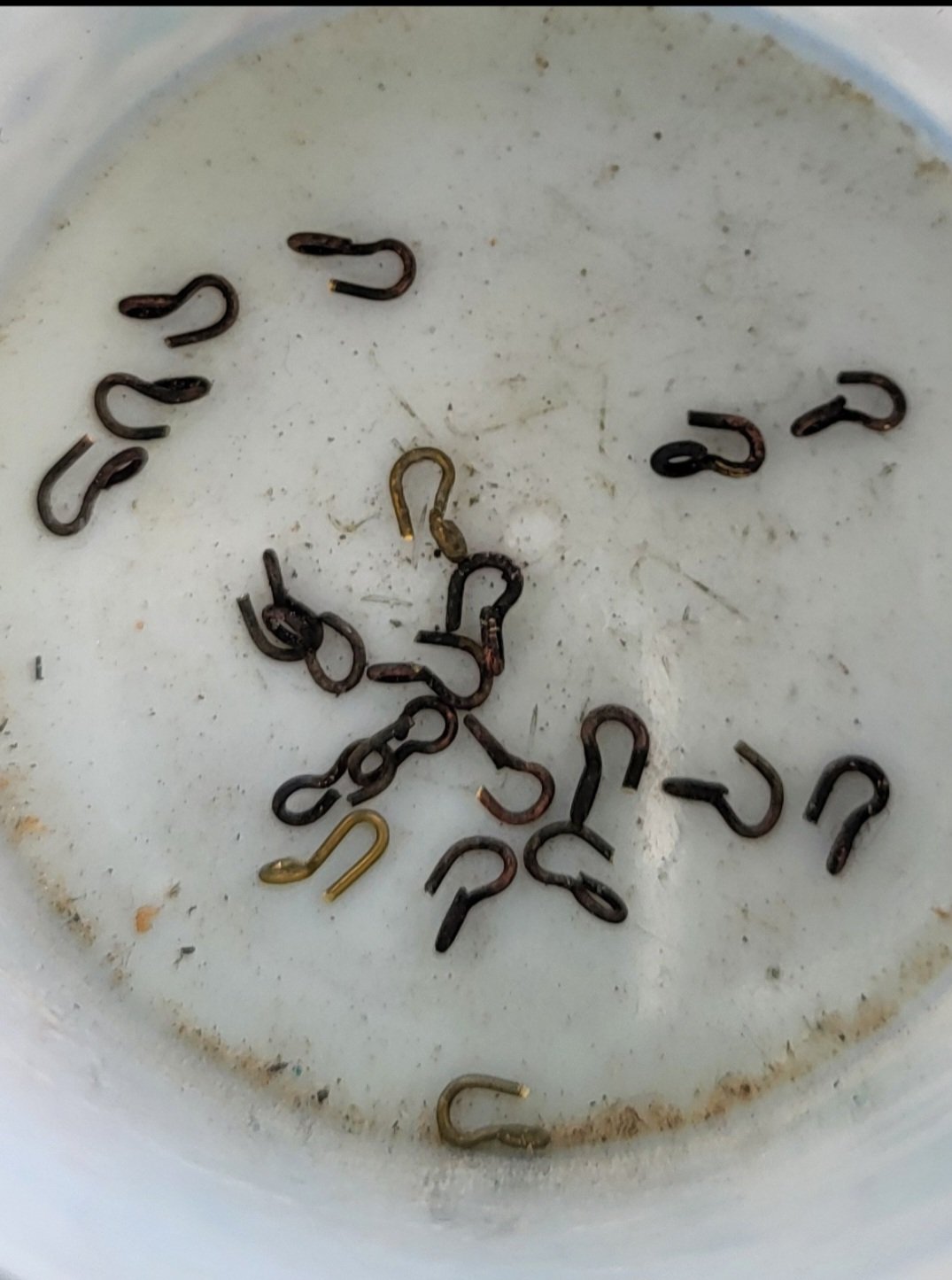

The only way I can get the knot to work was to adopt Hunt's technique of keeping the hook on the left of the block, for which I made a little rigging rig. (I won't bother showing pictures of the two other methods that were only semi-successful.)
I knew you would find a way to make this. Doing it without clamps is almost impossible.
That is an excellent observation, Mustafa, and it's something that I thought about myself.
Arguments for sticking with my method?
1. The Marquardt book.
1. And Syren Ship Model Company catalog itself.
3. At least one other builder is doing it the way that I am.
4. I don't know if I can bend the hooks at this point without breaking them. And I certainly don't want to remake the 20 that I've already done, which, by the way, are already a mixed bag of the two methods I've been employing.
I made another four this morning and ran a stopwatch. I'm averaging one in about 10 minutes now.  Wo hoo! On a roll.  How do you do this in 2 minutes, Mustafa?
Since I still have work to do on the hull, I can't install the coronades or cannons until I've, at the very least, installed the rudder and most likely the gun deck cannons and ports covers.  Therefore, I needed a place to store the tackle, which I intend to complete first.  I'm happy that the drills that came with the Craft911 pin vise have shafts that will fit in one of the Proxxon mill collets.
I'm not entirely pleased with this first pair, but as has been observed many times at this website, at a distance no one's going to notice the flaws. That would also include whether or not the hooks are perpendicular to the eyes.

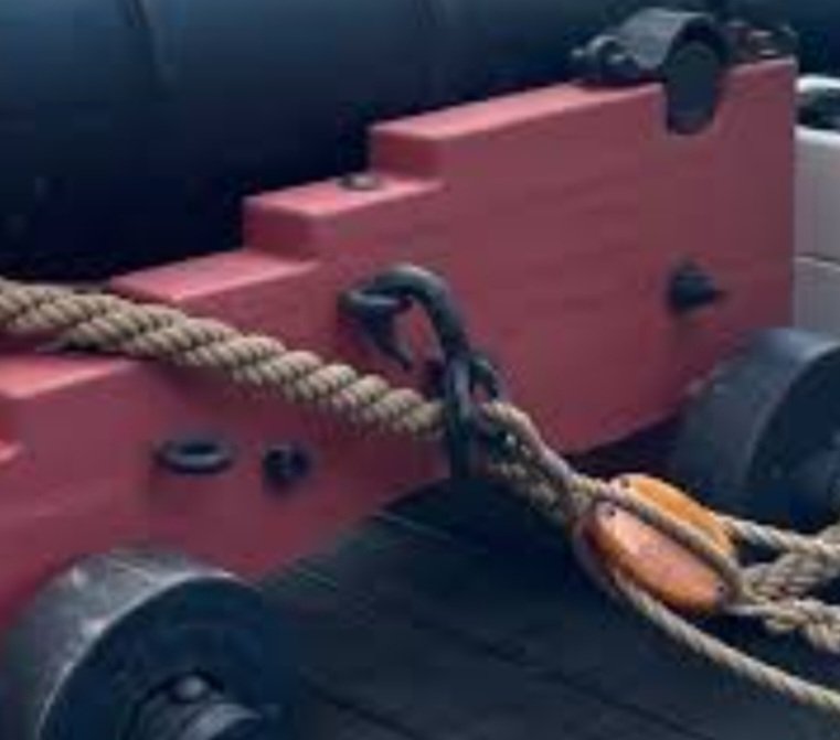

OK, Peter, on this issue I am going to side with Mustafa and Jon on the twist.  I just received another addition to my Constitution library, Olaf A. Eriksen's "Constitution - All Sails Up and Flying", which appears to be an awesome study of how the Constitution was rigged in 1815.  Here's a page from his "Strapping of Blocks" section.  Sorry for the poor attempt at taking a picture.
In these diagrams, the hook appears to be turned 90 degrees from the eyebolt.
Gregg
I think the photo I shared in my previous post, taken on the real ship, is being overlooked. In the photo, it is clearly seen that the hook is perpendicular to the eye. However, I apologize if I caused confusion on this matter. Of course, the model is Peter's and he is free to make it however he wants. Mine was just a suggestion.
Edited by mtbediz
28 minutes ago, mtbediz said:
I think the photo I shared in my previous post, taken on the real ship, is being overlooked. In the photo, it is clearly seen that the hook is perpendicular to the eyes.
Absolutely!  I understand that the orientation is as you say - the hook being perpendicular to the eye.  I take your suggestions to heart, and am grateful you think my build worthy of your time and input.  I was only making excuses(?) for my not "strapping" a hook to a block as suggested in the photo from All Sails Up and Flying posted by Gregg above.  Almost no builder here is doing that.  Most are tying the hook to the block in the manner you and I are doing.  Were I a stickler for that level of detail, (and you all know I'm not.  Is my hull black?  I don't think so! 😁), I would be reeving a strap over the eye of the hook and the groove of the thimble, then clapping seizing between the thimble and block.  Maybe on my second build?  In 2030?  For now, I'll take selected shortcuts so that I'll be able to START a second build by 2030..🤣

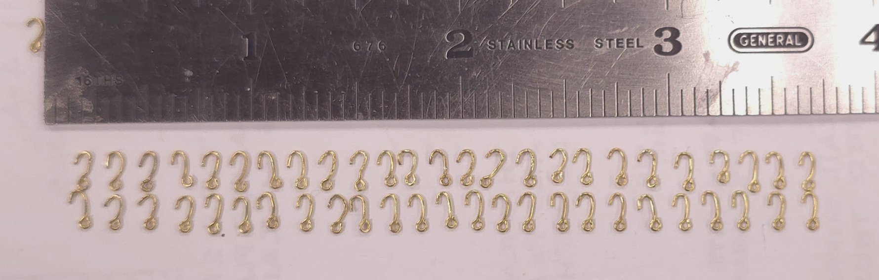

I spent a couple of hours at the shipyard today making more hooks than I'll need for the double blocks I plan to strap them to.

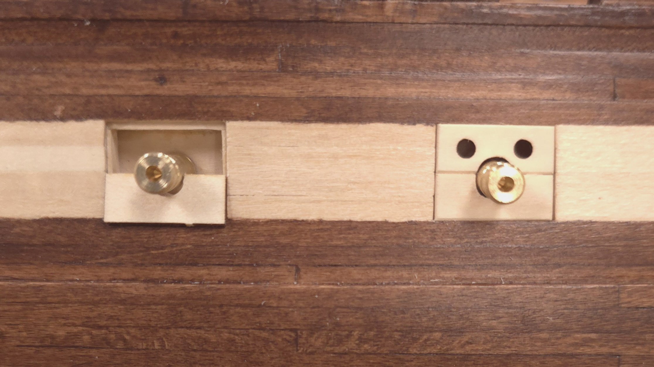

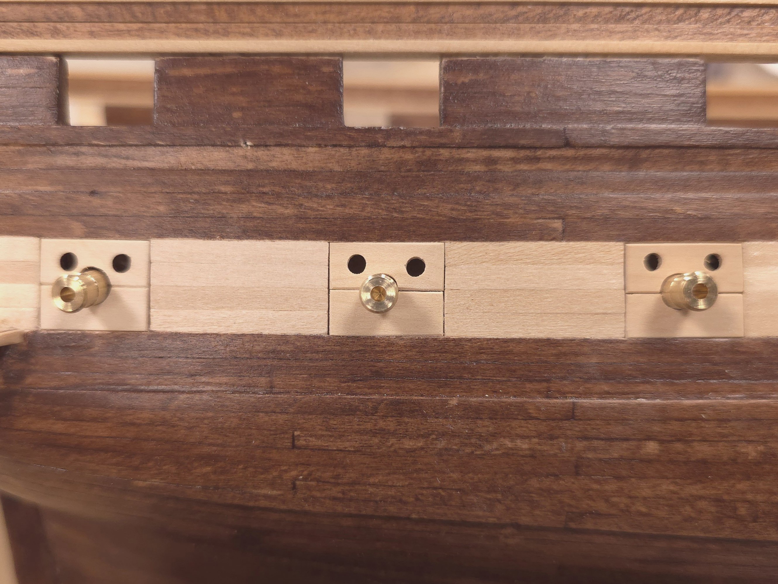

7 hours at the shipyard today.  7 false cannons and gunport lids added. Then 7 undersized false cannons discovered in that order from the Czechoslovakian company placed ast year.  Aaaargh!
I drilled 11/64 inch holes to accommodate the barrels. It wasn't until today, as I was gluing them into the hull, that I saw the first one that was 5/32 inch in diameter.  That wouldn't be so bad, but the rest of the barrel is narrower than the others as well. Making the opening in the gun lids a smidge too large.  Maybe the Casual Observer won't notice. I'll try one tomorrow.
The good news.  Getting there..
You're not really going to see much difference here, but the group of seven on the right are smaller diameter than the ones on the left.
Edited by Der Alte Rentner
check the Czech spelling (Czechoslovakian)
If you have to magnify the images this much to see the difference, the average person from a foot away, won't. The choice to fabricate new lids for to accommodate the smaller diameter guns is yours as captain. Yes, I believe it may help create the illusion that all of the guns are the same diameter, but is it worth the effort, that is is your decision. I guess that depends on how finicky you are. Overall, your model looks great!
Jon
Agreed!  Do whatever you feel you need to as the builder, Peter, but don't think anyone is going to comment on any cannon size disparity.
Can't remember if I have seen pictures of your base and pedestals previously, but I am really liking the looks!  Great job!
I just purchased a piece of canarywood that I am going to use (eventually!) for my Constitution base.
Gregg
Gregg and Jon,
I took my magnifying glasses off, put my regular glasses back on, and determined that I can live with the slightly smaller barrels. Thank you for your thoughtful feedback.
Gregg, I love canary wood and have a supply of about 8 board feet on hand.  If, for whatever reason, you strike out on the wood that you ordered, reach out to me and I can send you a piece.
To all,
It turns out that there's a minor advantage to the smaller barrels, I don't have to trim the center hole on the gunport lids as I had to for the larger barrels. If you're wondering why it's taking me so long per gunport, it's that,  despite the fact that I used a pair of gunport lids as spacers when I did the planking and therefore in theory should have resulted in perfect fits now, in practice every single pair of gun port lids requires trimming to fit properly.  Add to that, fitting the hinges and adding three coats of clear poly..   fiddly work? -  gotta love it! 🙄

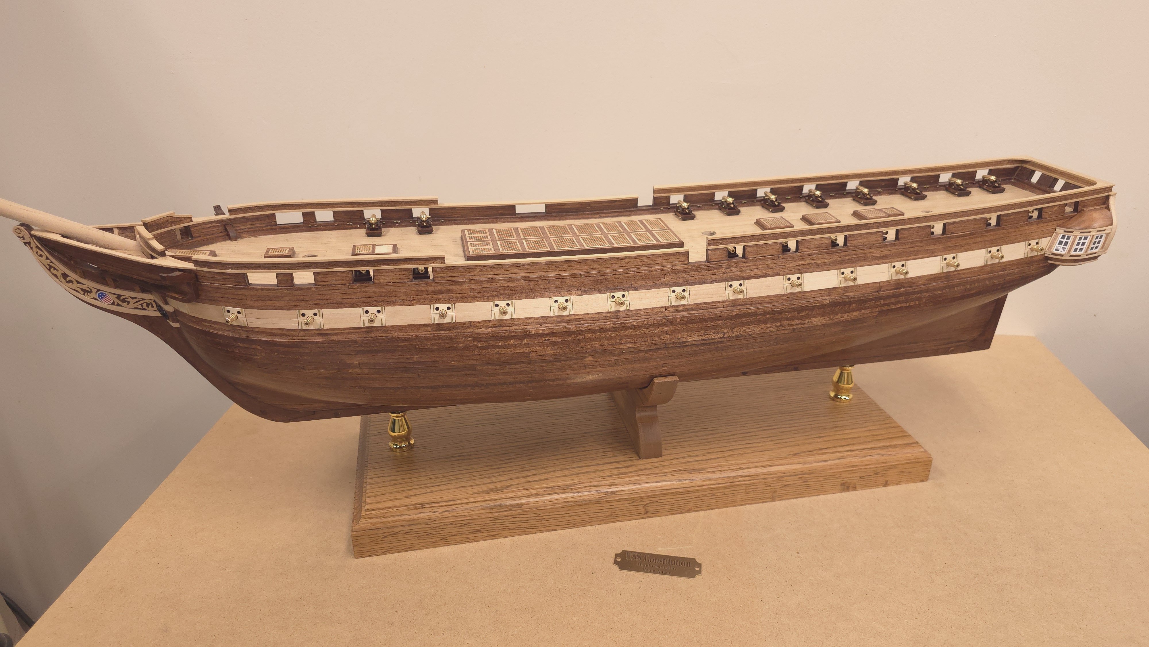

13 ports left to go.  Port side done, as well as three on the starboard side.  I just got a notification that the ropes of scale package arrived at home. So I'm out of here for today. Two more days at the shipyard to finish the starboard side, and I can return to rigging the tackles.
On 7/3/2025 at 10:45 PM, mtbediz said:
Your model looks great Peter. Just curious, did you ever consider leaving the gun port lids open?
No, I did not. If you go back earlier in my build log, you will see that I chose two different methodologies for creating the supports for the false cannons. Because of my filler block approach on the port side, leaving the lids open would not have led to a pleasant result.
Look at the opening to the left of the Canon below. Lids up? I don't think so.. One plus to doing it this way is that with the filler block, gluing on the lids was a piece of cake.
Not so on the starboard side where I've got the thinnest lip around the border of the opening.
Furthermore, I always thought that the open lids would be subject to too much damage while handling the hull for other work.  If Ever I attempt a second pass at the USS constitution, it will be at a much larger scale, and following the footsteps of everyone else with the black and white scheme. But let me get past this one first..

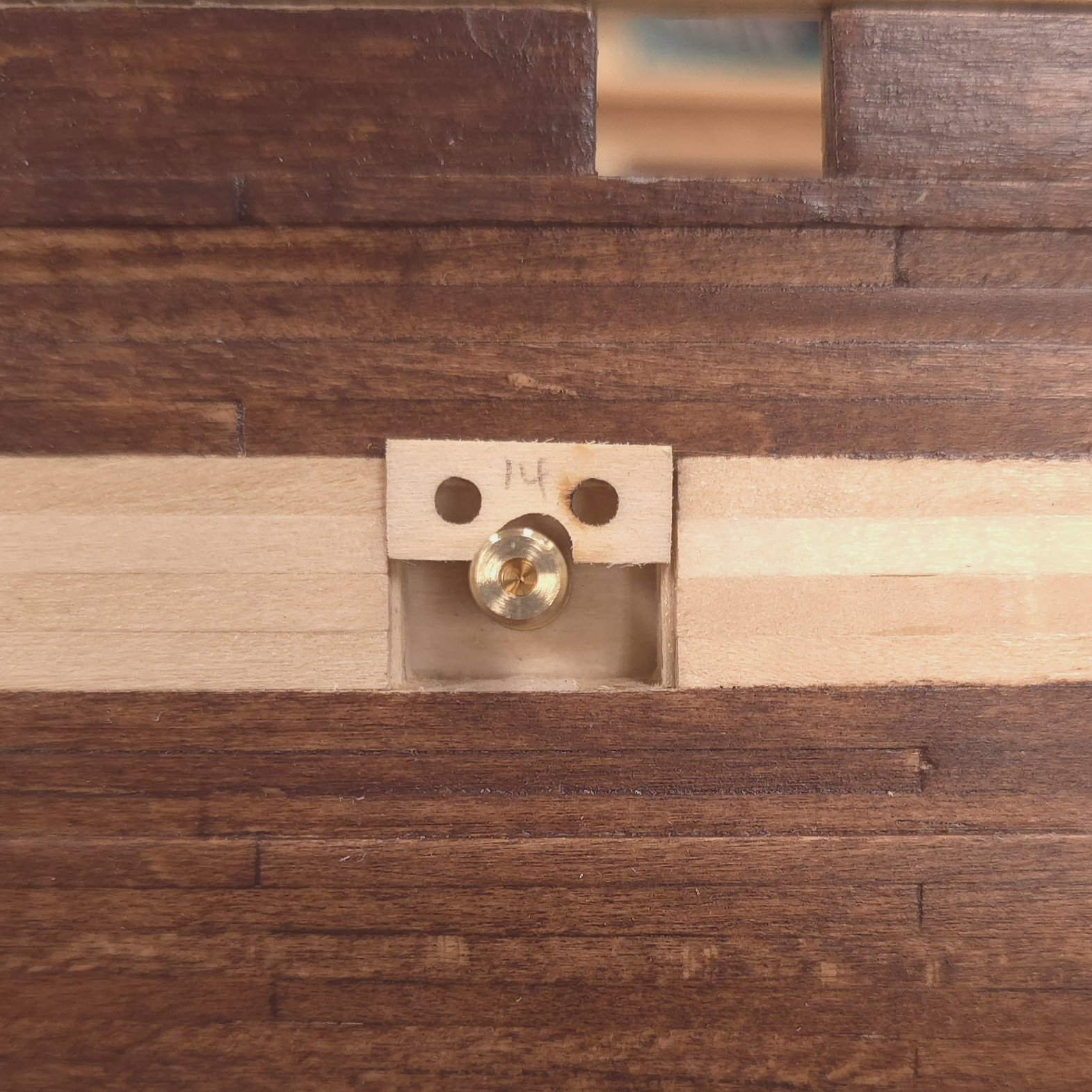

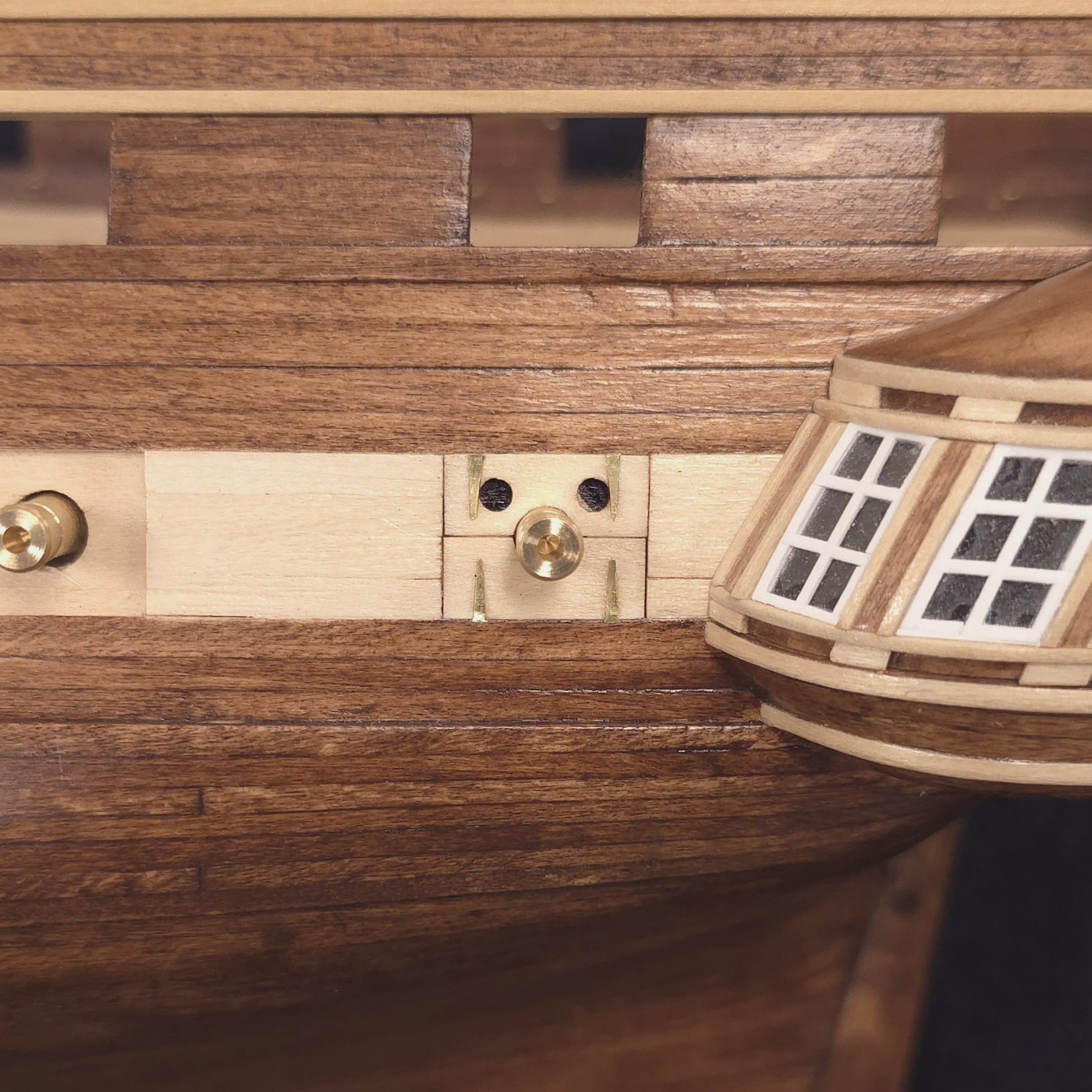

Oh snap! I'm on the last three gun ports on the starboard side. Out of the blue, the holes for the false cannons are off center, fore and aft, by 1/32". While that doesn't sound like a lot, it's a chasm the size of the Grand Canyon in this scheme of things.  Looks like I'm making three custom gunport lids..
My bad for not sticking with the scheme of doing one cannon at a time. I might have seen the offset before I glued the barrel in. At that point I could have made an adjustment to the hole on the back panel.
They're solidly glued in now, and I can't see trying to break them out.
Oh well...  🙄
I can't believe how many times I've had to remake these pieces out of Basswood - everyone a fail. No matter how careful I was with the drills, the 1/16" thick Basswood just kept splitting.
I finally switched to boxwood, and I lost two of those in the drilling pass as well.  But in the end, I got it done. I had hoped to get the hinges on today, but I'm calling it.
