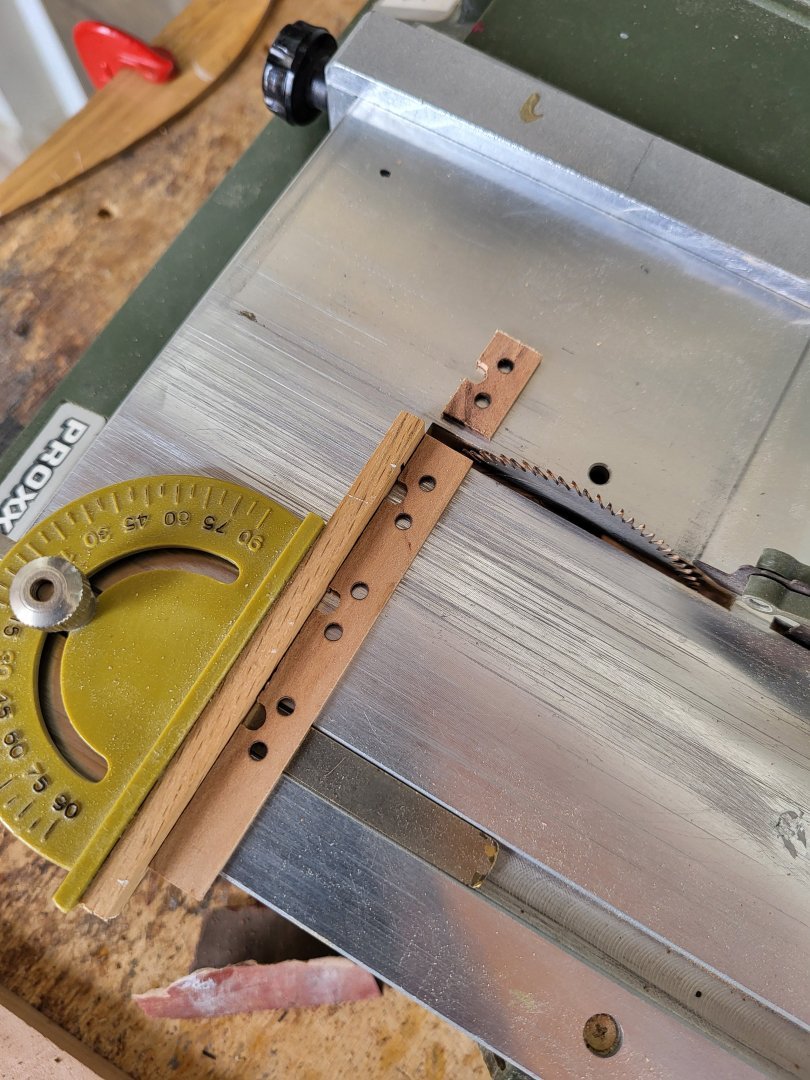

8 hours ago, GGibson said:
Not sure if I saw this explained previously, Peter, so sorry for asking again if I missed it.  When you cut and drilled these gunport lids, did you initially drill the holes from long strips and then cut the lids to size, or did you cut to size, then drill the necessary holes?
Drilling first and then cutting usually gives better results and reduces scrap. That's how I usually do it."
Edited by mtbediz
Sadly no. I cut the holes after I fabricated the rectangular pieces. Lesson learned. Thank you.

Let me also point this out, I cut the pieces a little larger and do fine tuning with sanding machine.

Sorry, I forgot to answer this in my last reply. Yes, indeed, I put waste wood behind the pieces being cut. Unfortunately the drill itself catches  on the Basswood and sucks it up.  Note: I had no problem with the one 1/16" drill. It's the 3/16" drill for center hole that proved problematic.  Rookie mistake?
This was not quite the same problem with the boxwood. In that case the grain of the boxwood split as I was drilling that Center hole. Part of the problem with the basswood is that I took the 3/32" material that the gunport lids came from to try to make the replacement pieces first.

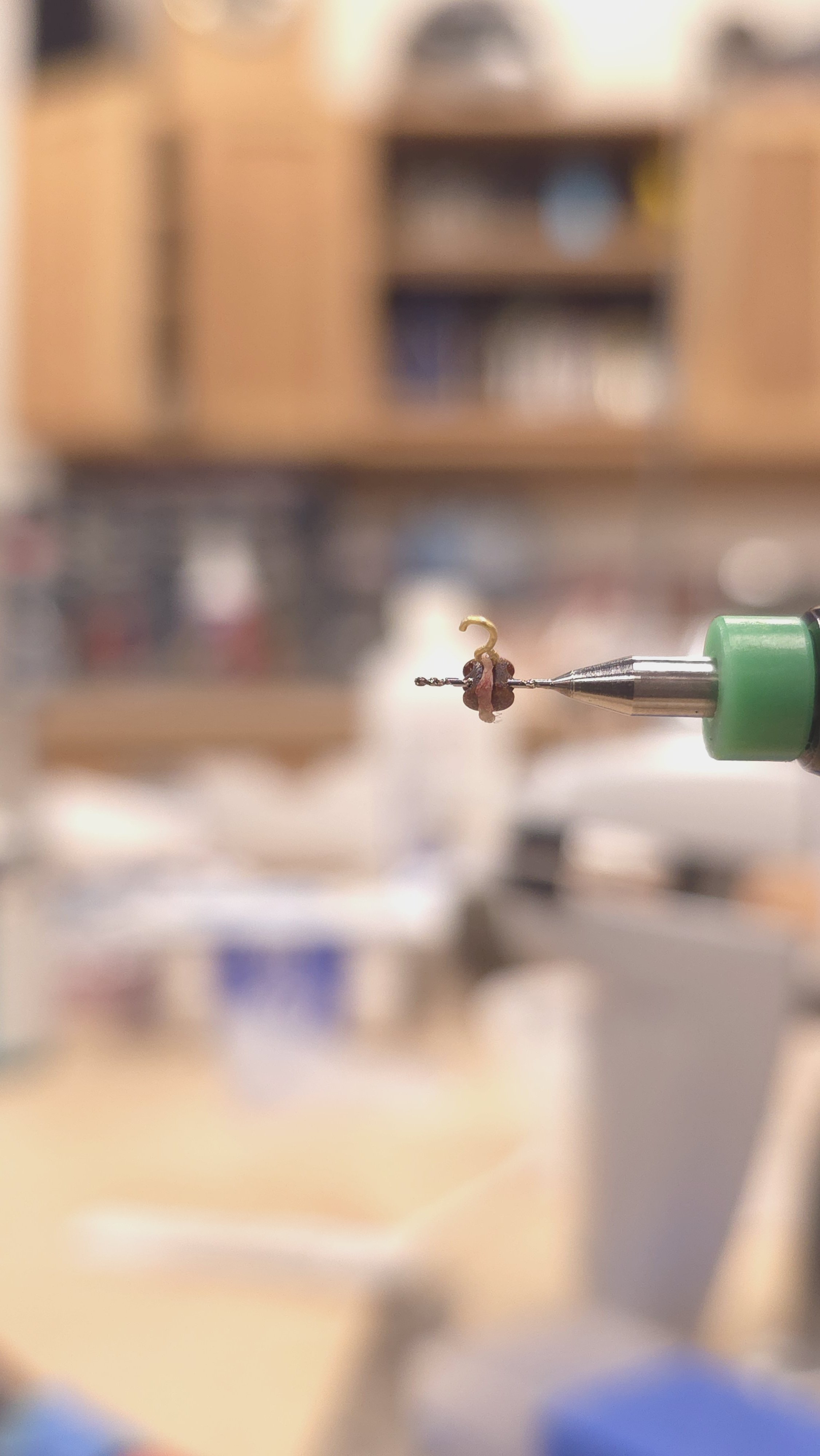

1 hour ago, mtbediz said:
...turning the drill in the opposite direction helped me drill without splitting the wood...
This is interesting, Mustafa.  And, I assume, using a hand-held pin vise?  I don't think my Proxxon has a reverse gear! 🤷‍♂️😅
Gregg
Greg, I have a reversible hand drill like in the photo. I use it when necessary.
Edited by mtbediz

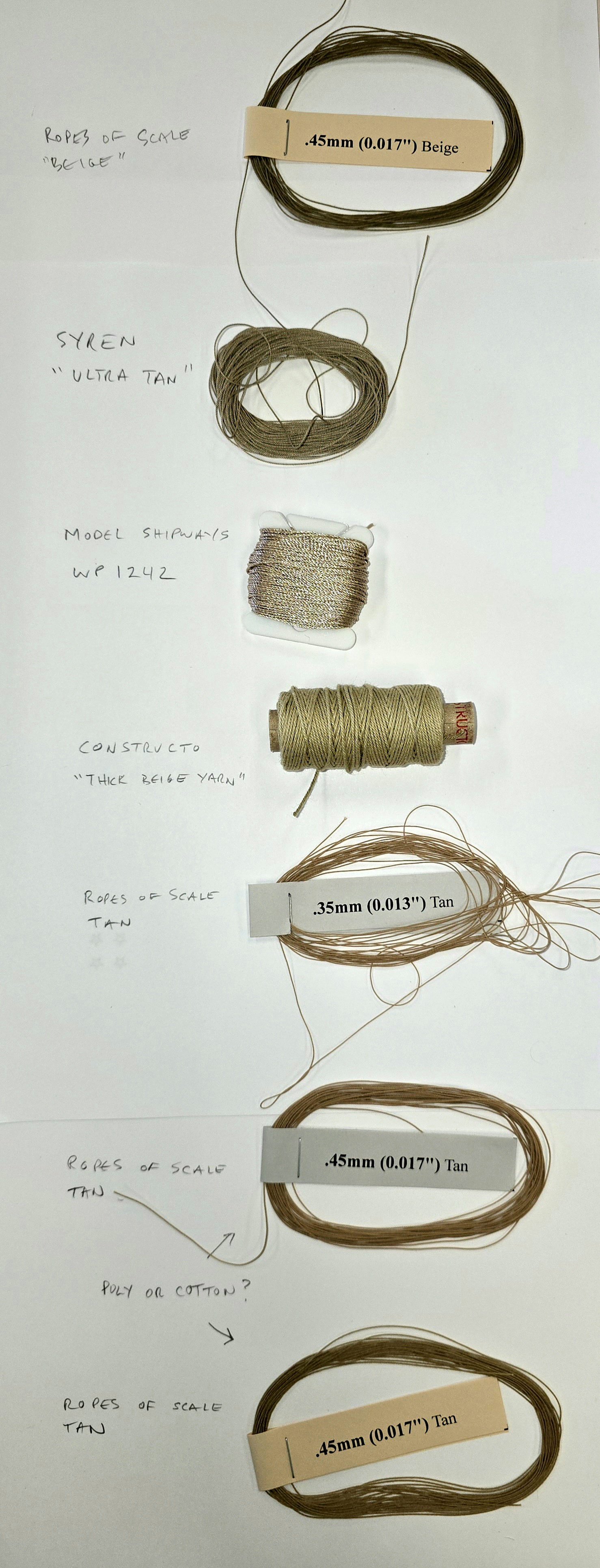

Another decision needs to be made. Which color to choose for the tackles?  This picture doesn't do the difference in colors justice. These are my options.
Note: Ropes of Scale did not identify which of the 45 mm tan lines was their cotton or their polyester version. Also, why is there a difference between the tan on the .35 mm and the two .45 mm ropes?
As far as color is concerned. My favorite is actually the model shipways WP 1242. Unfortunately this is too thick to get through the blocks, despite it being specified as the right diameter.  My second choice would be the Constructo provided yarn, which likewise won't go through the blocks.

And the winner is....
Ropes of Scale tan .45mm.
While I prefer the color of the polyester, it would not take c/a glue. I had to revert to cotton to be able to tie knots and lock them in with a drop of c/a.

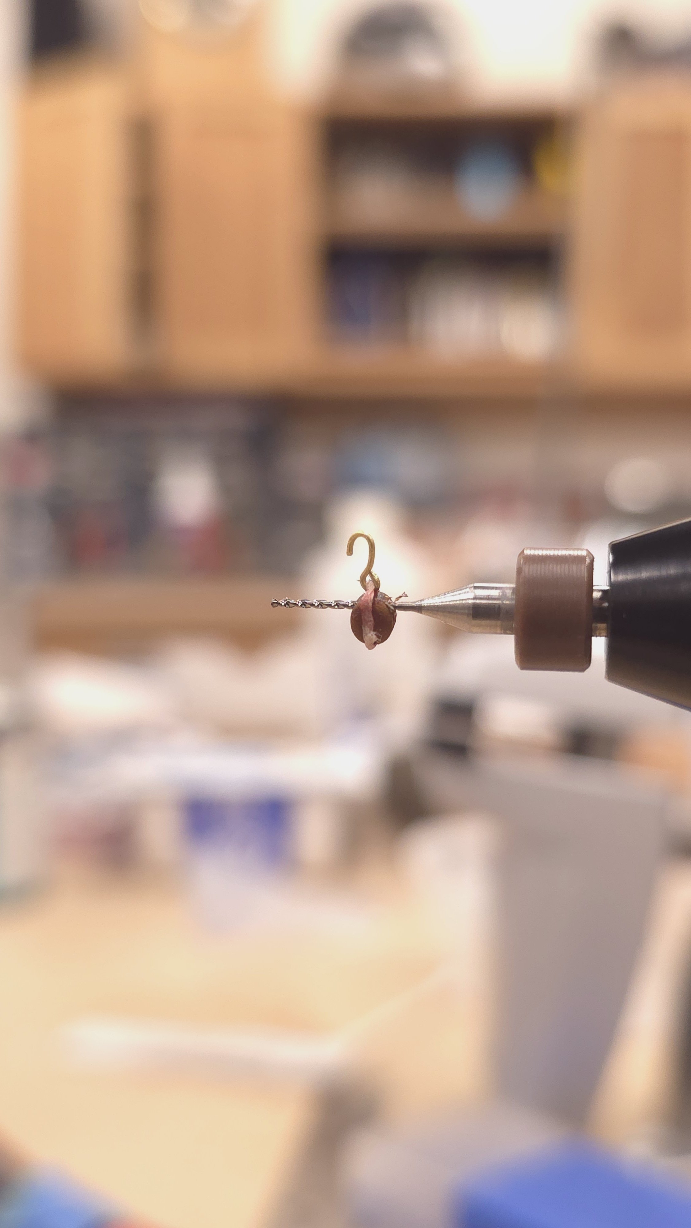

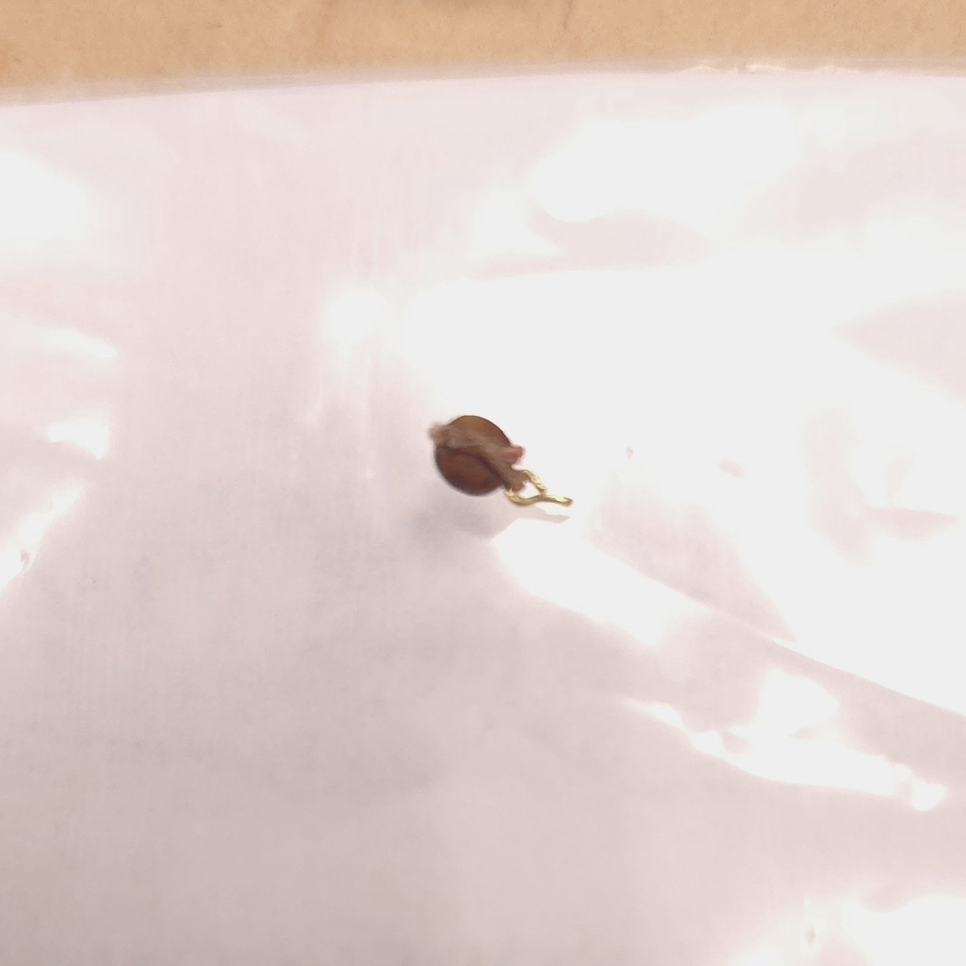

P.S. For those who suggested I twist the hooks, here's proof that these eyebolts are fragile, and cannot be overly worked.
I make the eyelet first, then bend the hook part perpendicular to the eyelet so I don't need to twist the hook. I know it's too late to tell you this, but keep that in mind; you'll want to try doing it like this on your next build.

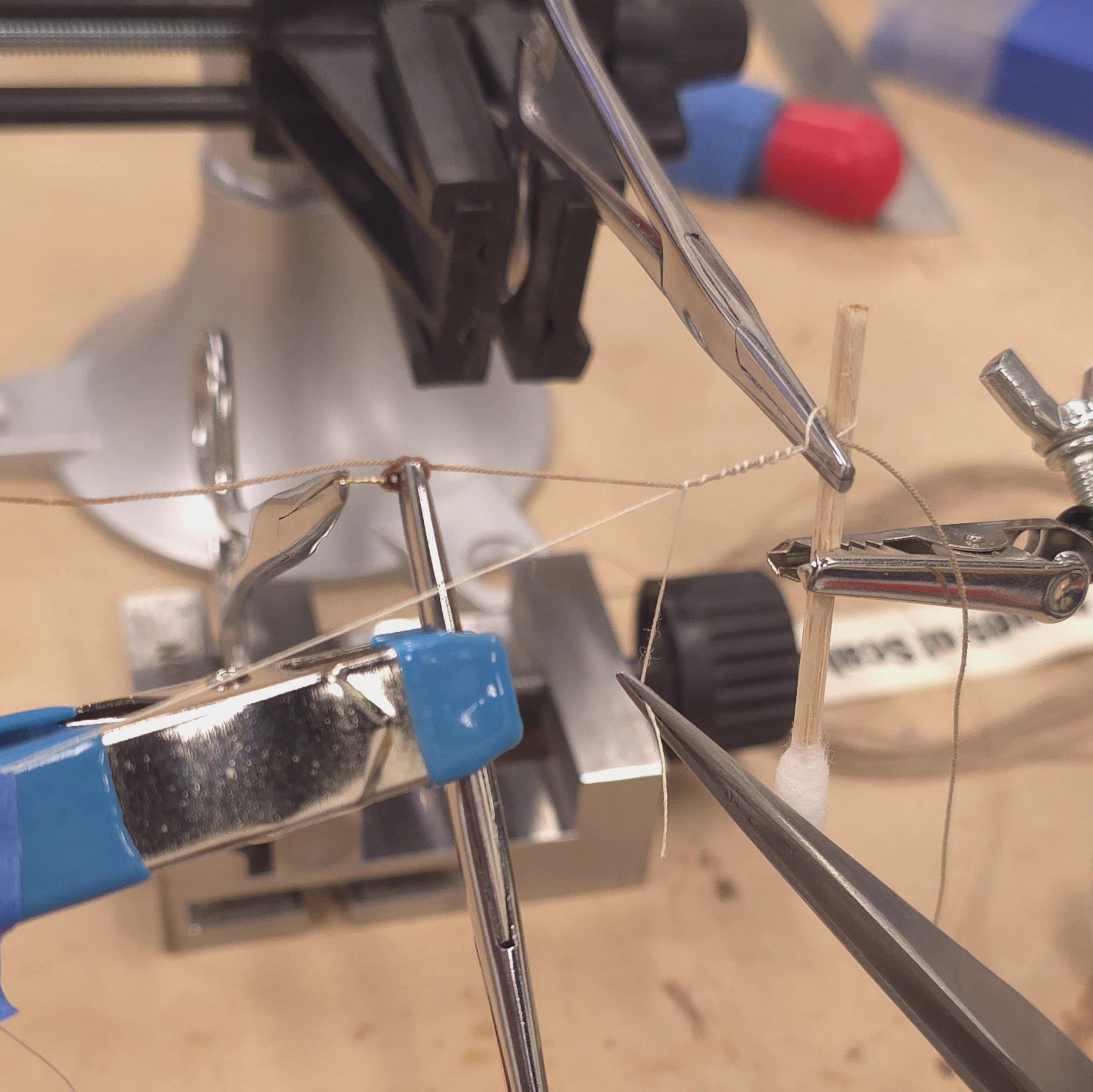

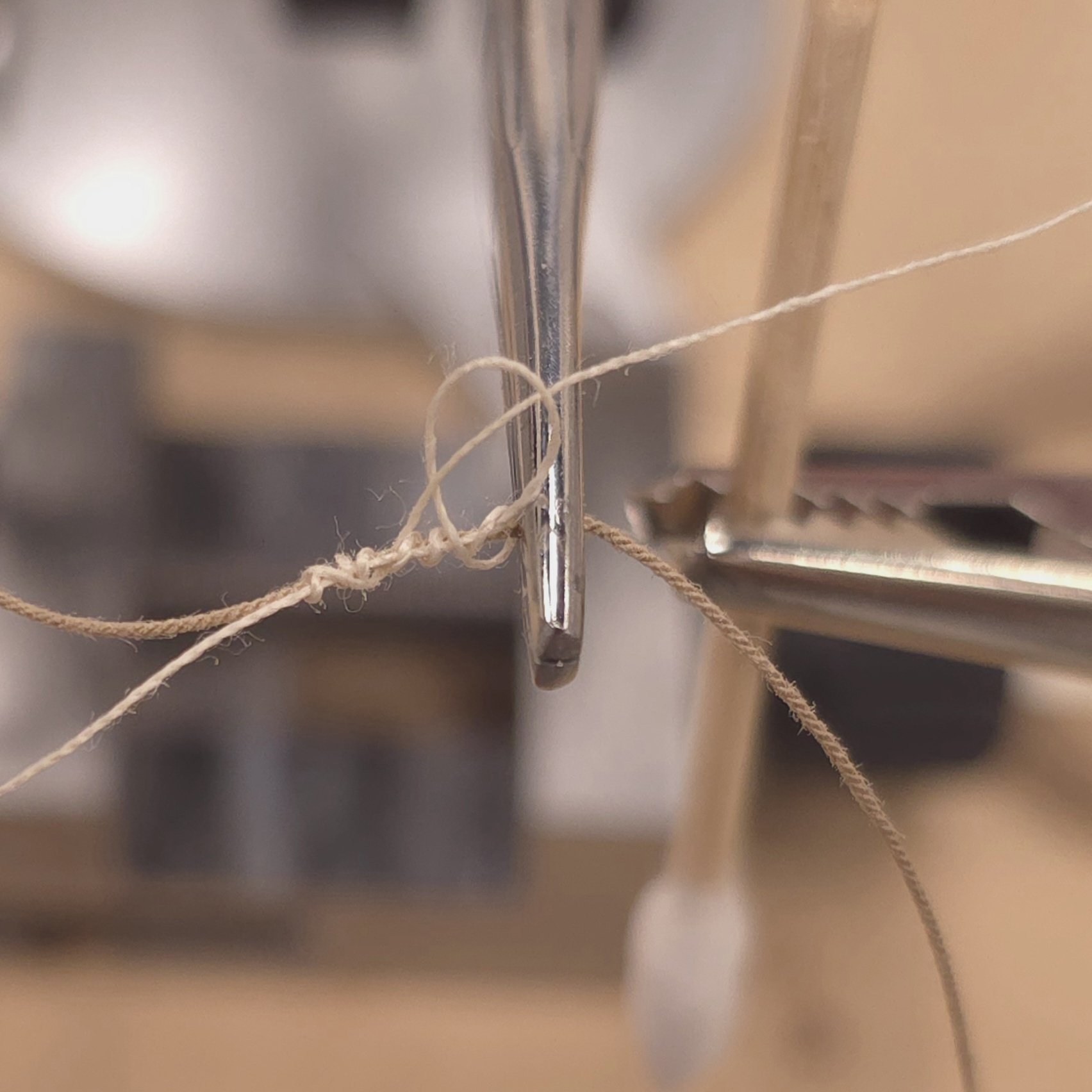

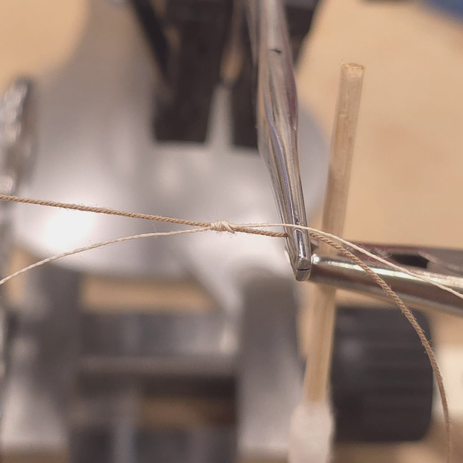

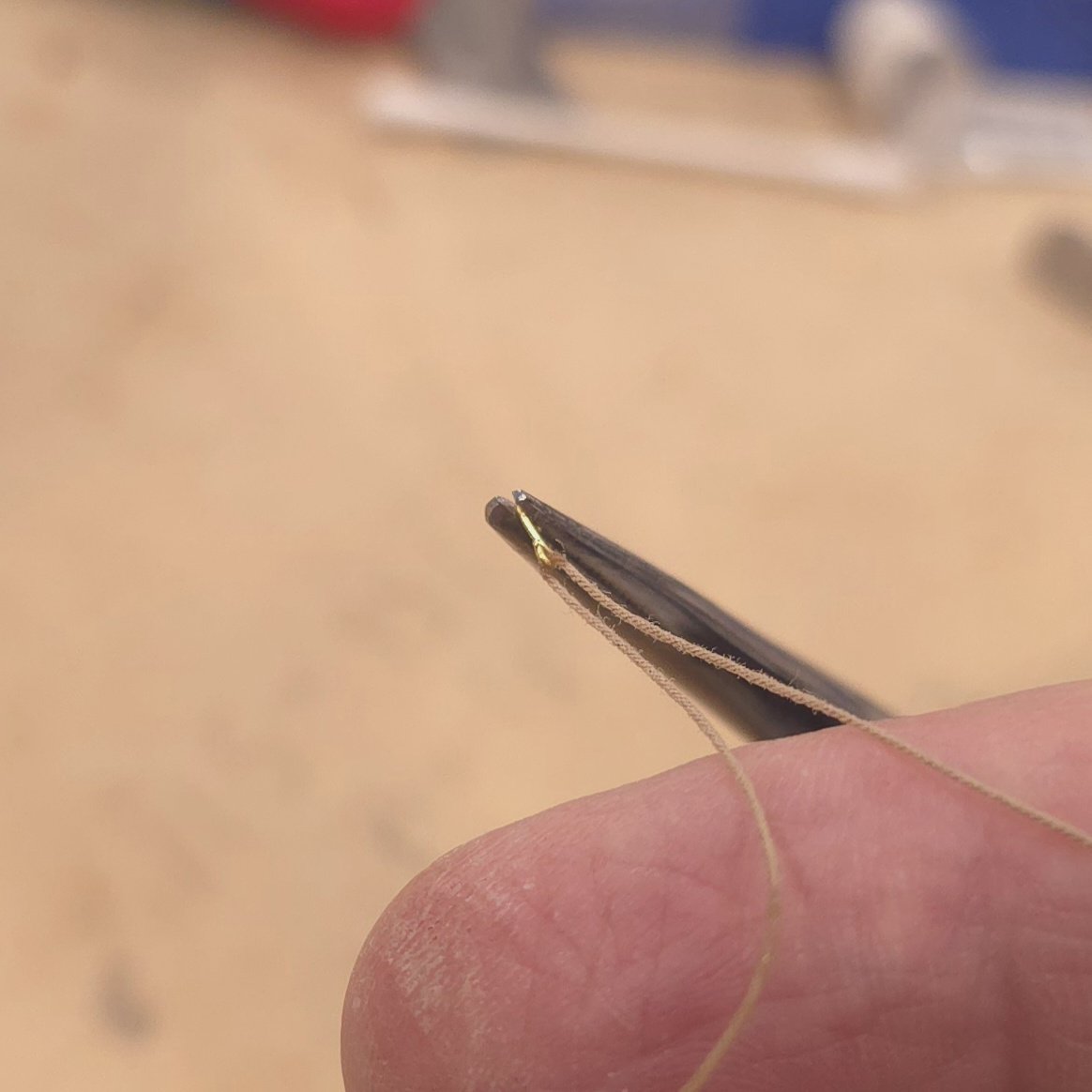

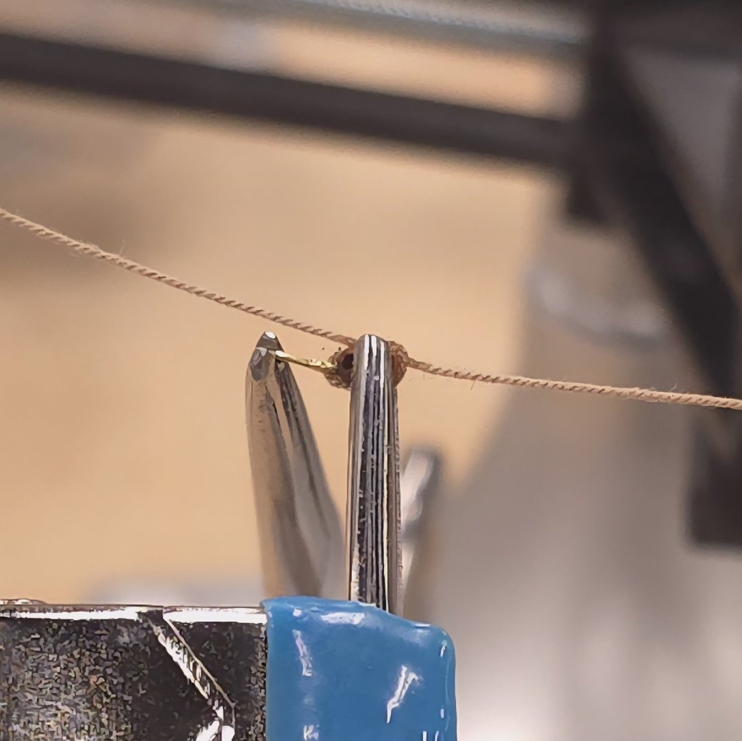

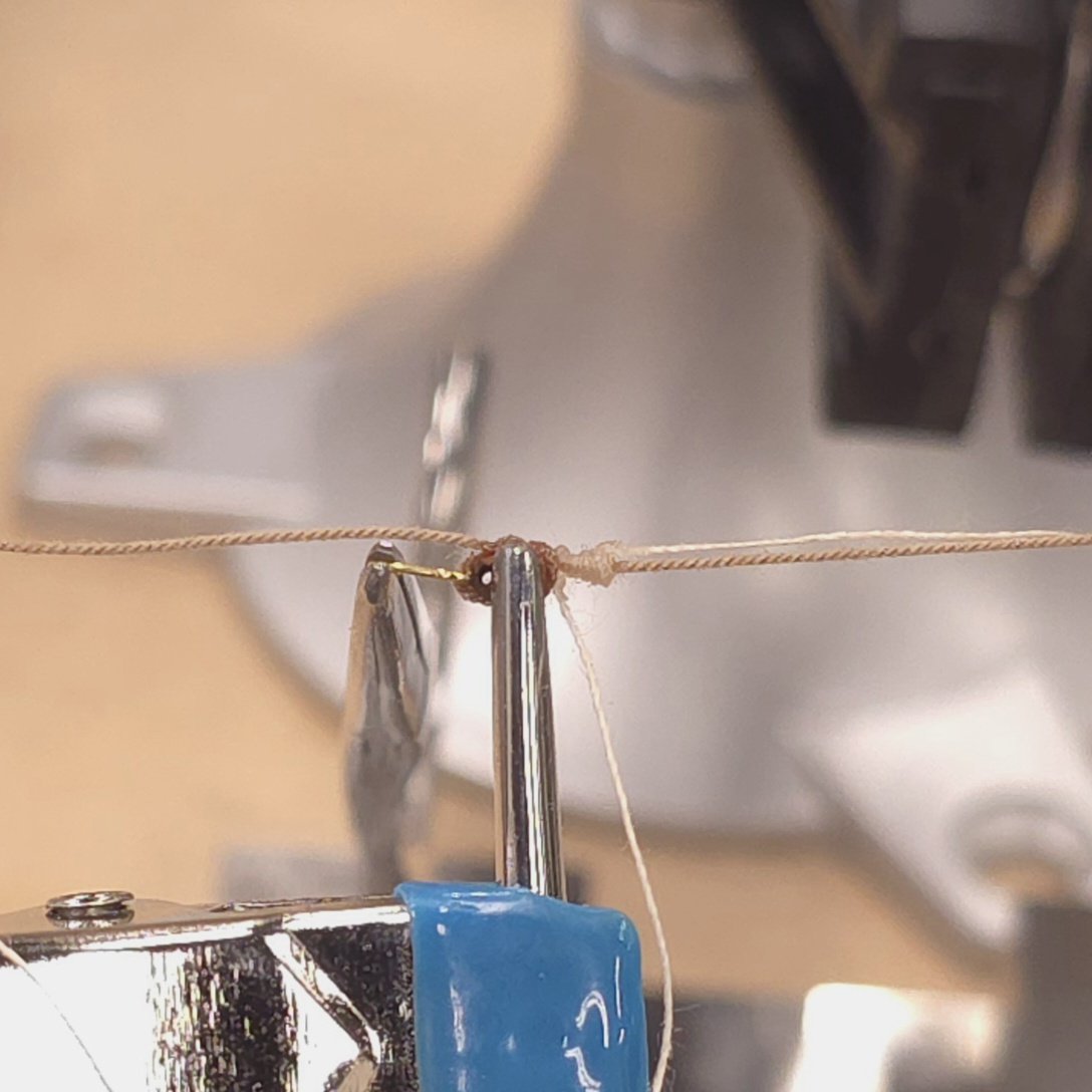

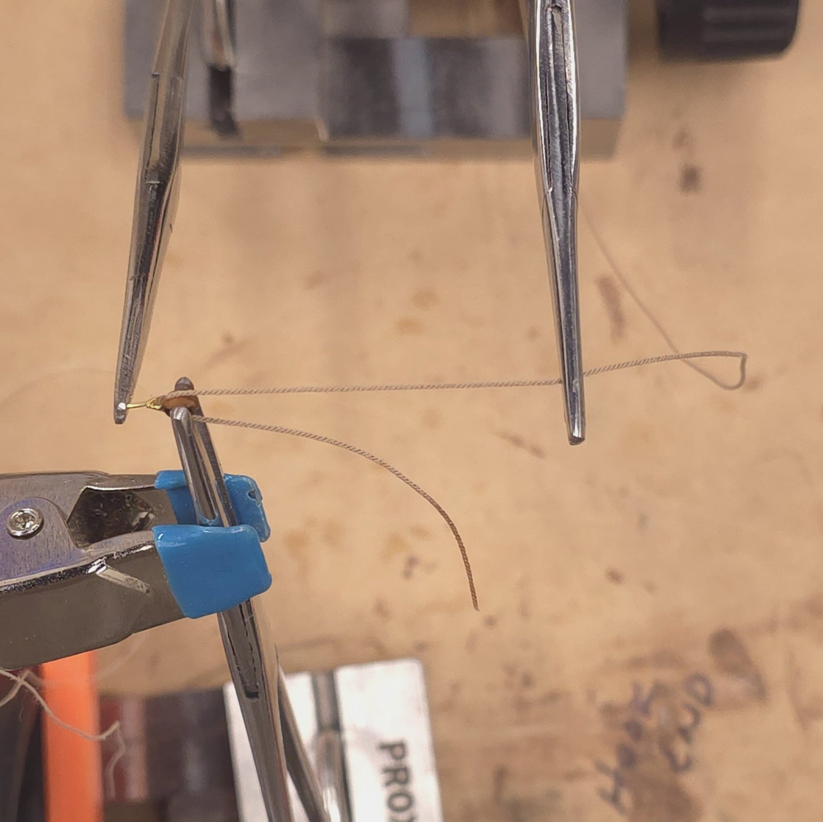

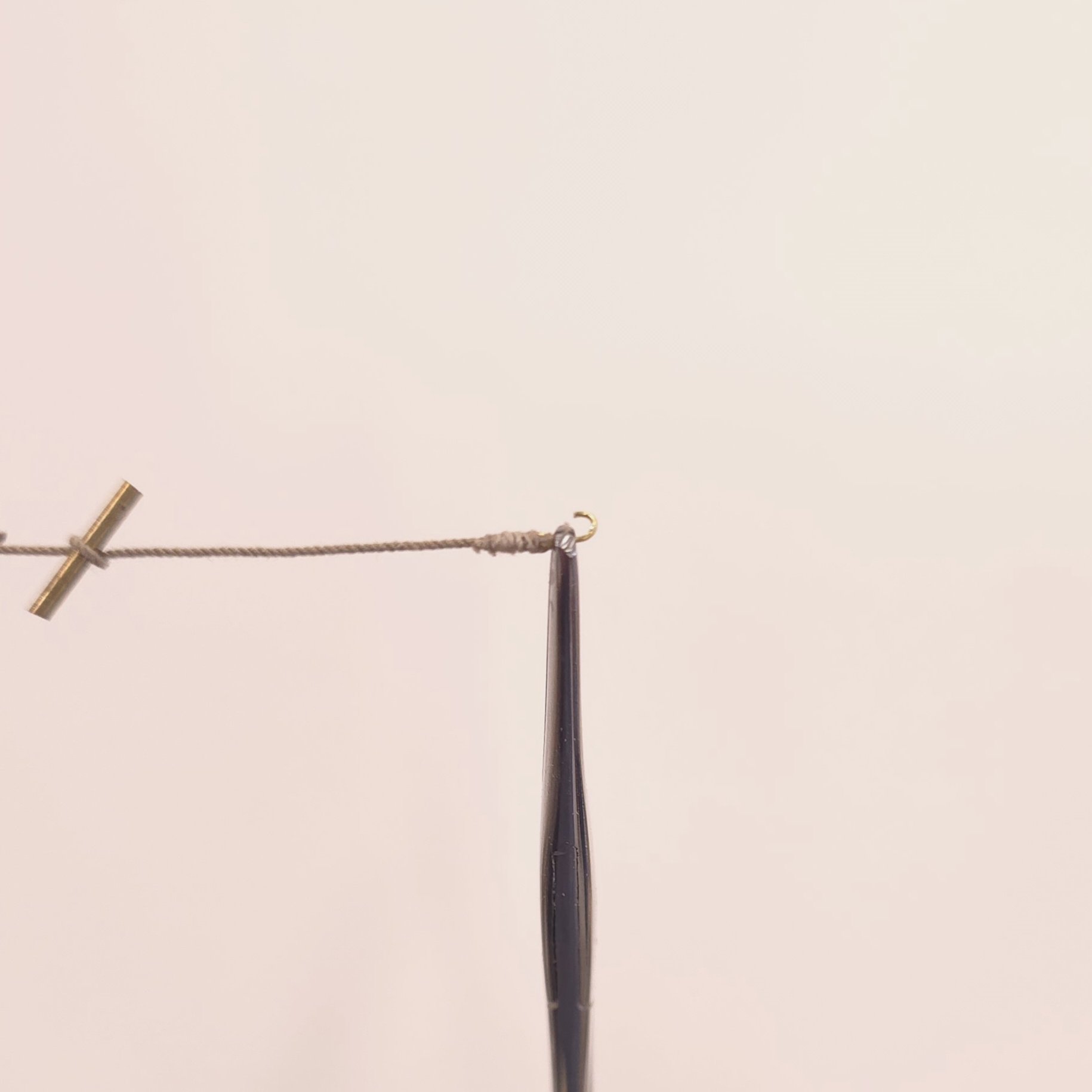

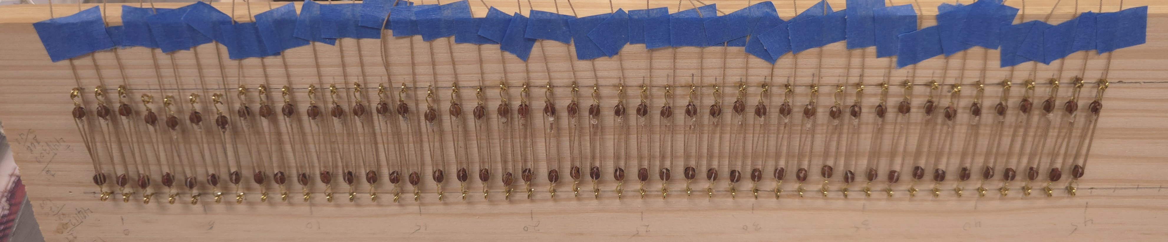

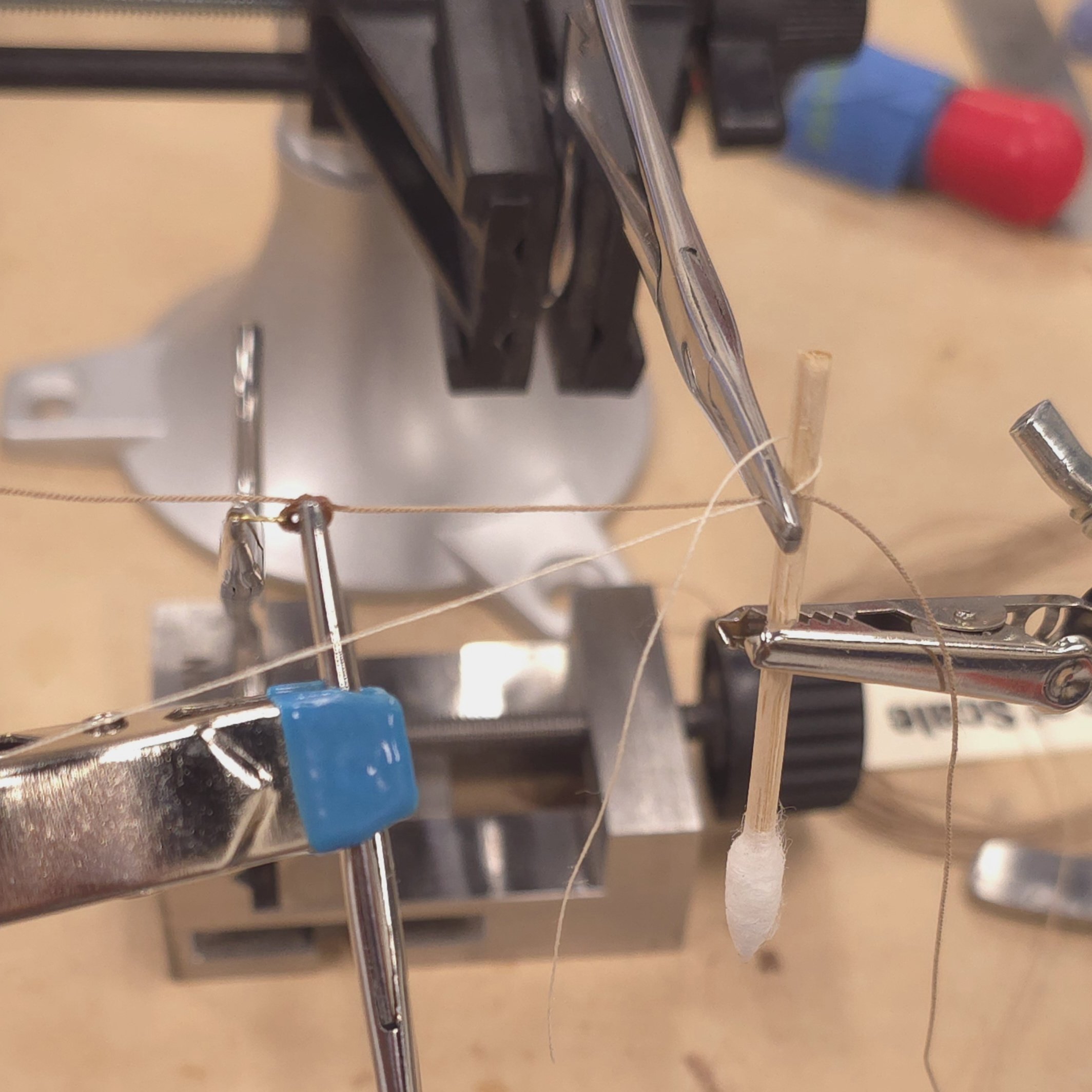

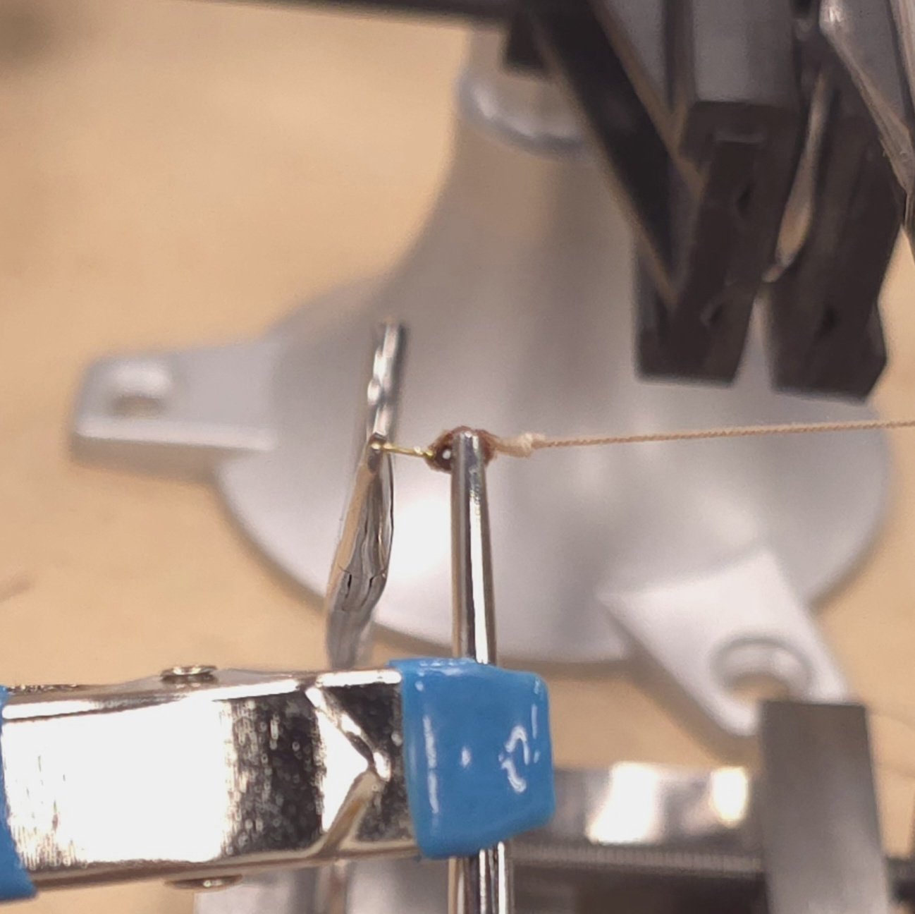

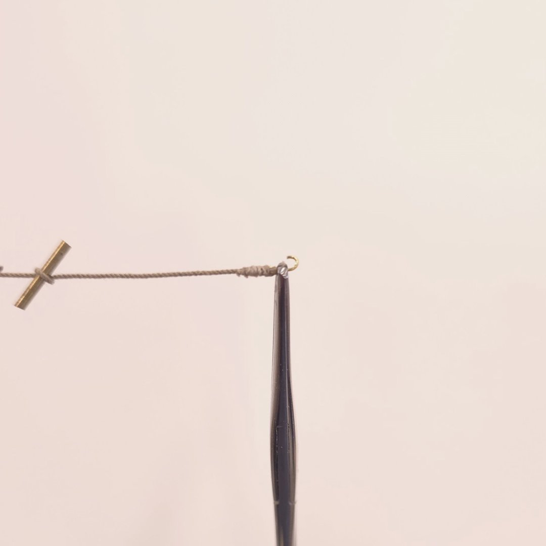

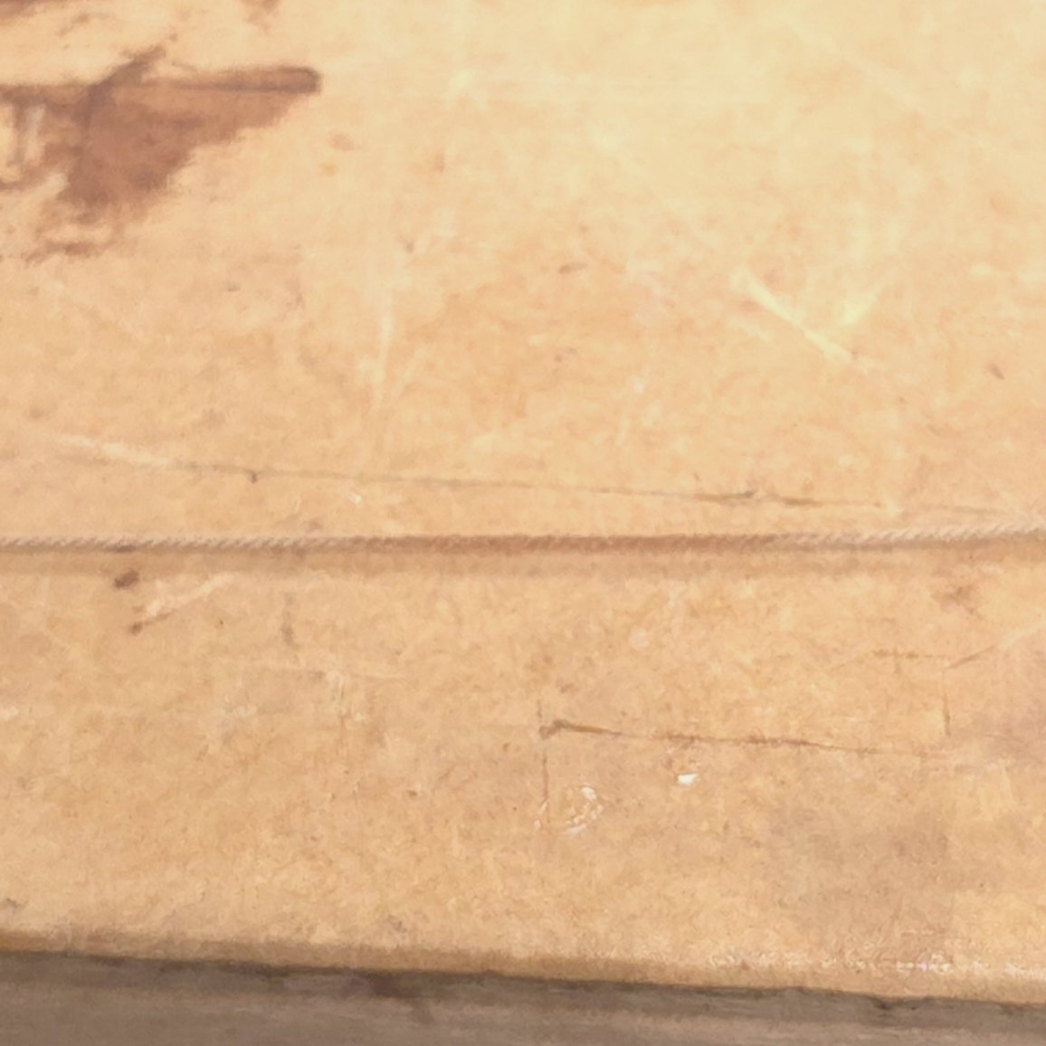

I'm submitting photos of the process I used to fabricate the tackles. This may not be of much benefit to seasoned veterans of model ship building, but I know I'm going to pull the information from this website into my personal build log on my desktop later. So, in part, this is my own documentation of the process.
I think the photos are self-explanatory, but I'll lead off with the comment that many hands make light work..

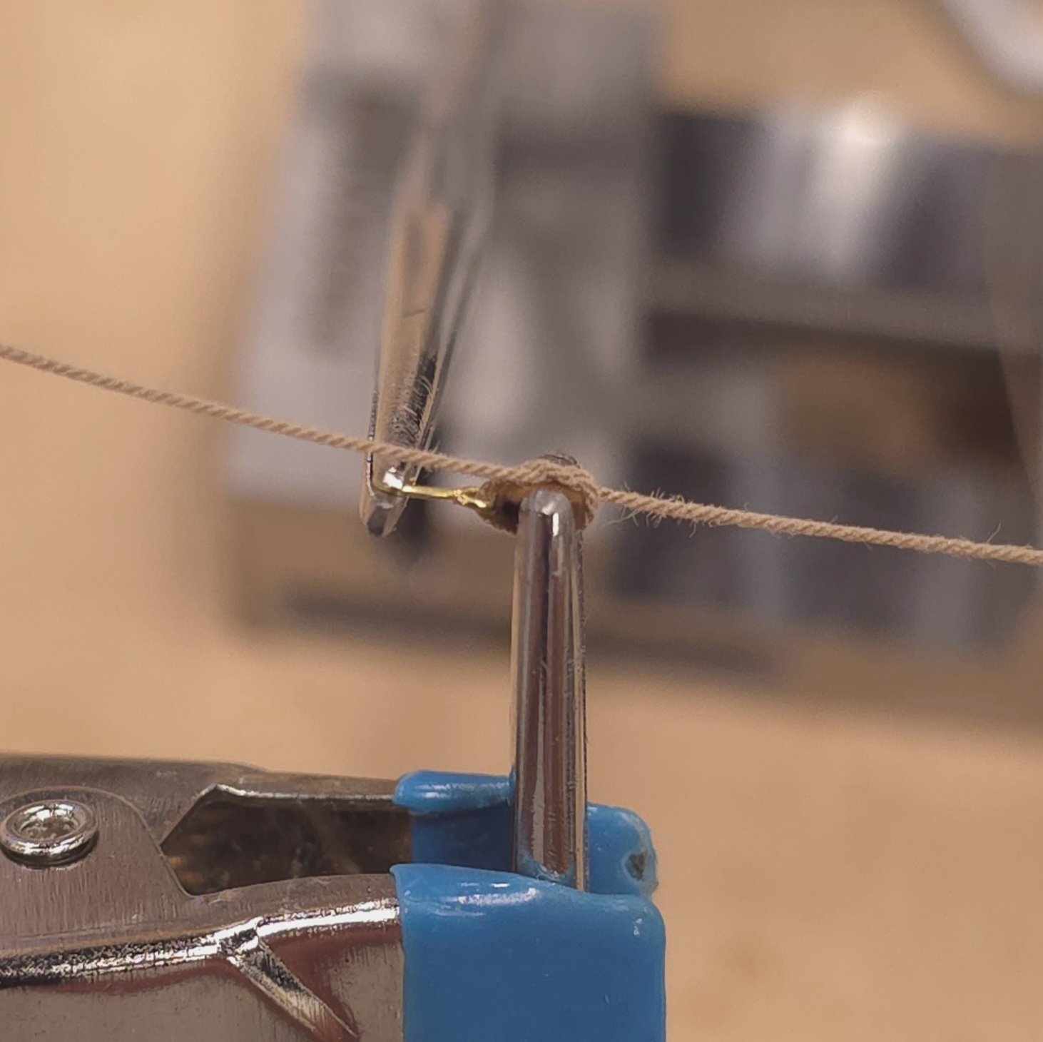

I used a drop of super glue and held the line against the eye of the hook until the line held fast.
Then positioned the eye precisely against the single block.
I tried other methods, but the simplest, most effective solution was to simply tie a knot. Note, this only works because I use the cotton rope. A knot in the polyester rope would not stay tight, nor would it take C/A glue readily.20250711_094721.thumb.jpg.498bfd69fbd3159d1b95165ff79557e0.jpg
Then I added a tiny drop of C/A to lock things in place..

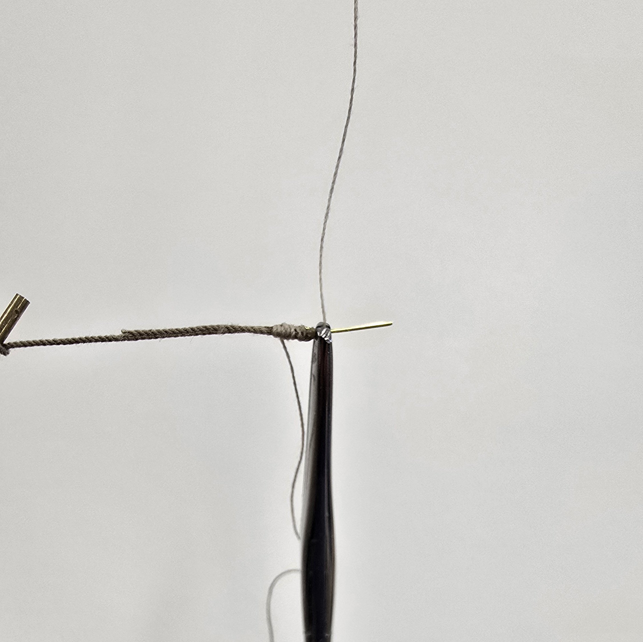

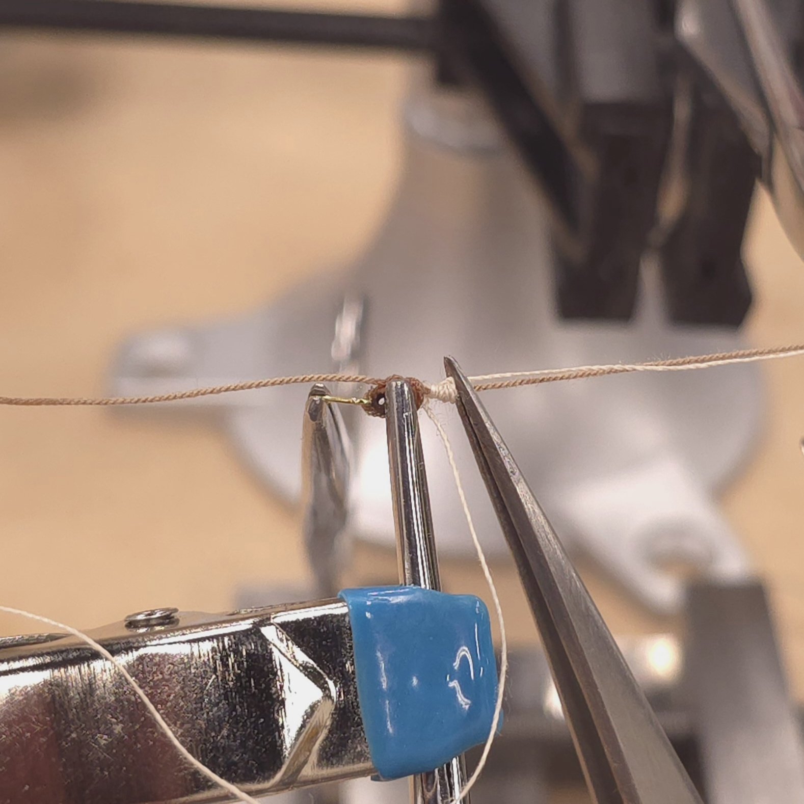

Then moved on to seizing..
Note, you don't see it here, but on the far left of the clamp with the blue rubberized end, I used a piece of masking tape to hold the other end of the seizing line.
Once again, a dab of C/A glue to lock things down at the end.

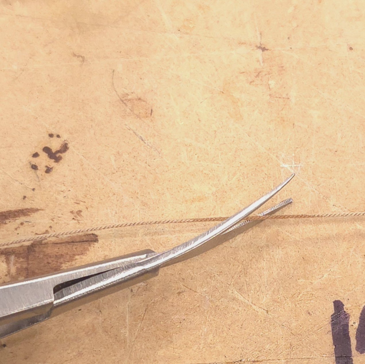

Cut away excess,
Measure,
Another dab of C/A glue before
Slicing the line at a sharp angle to facilitate rigging.

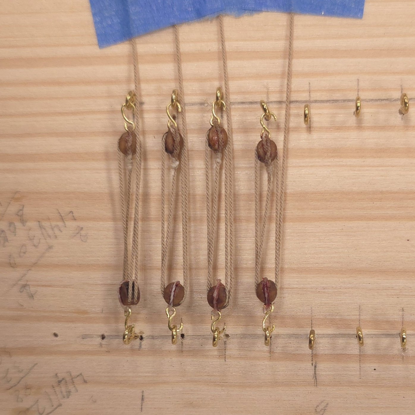

The holes in the Syren blocks were too small for the .45mm rope, so I had to take two passes to enlarge the holes without splitting the blocks. This needed to be done for both the single and double block.

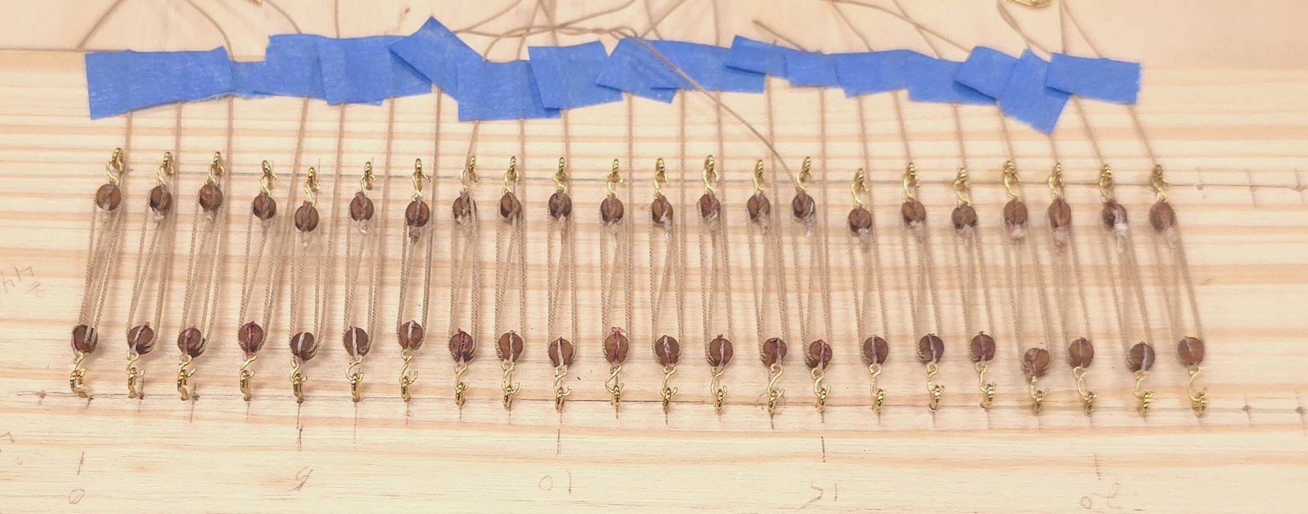

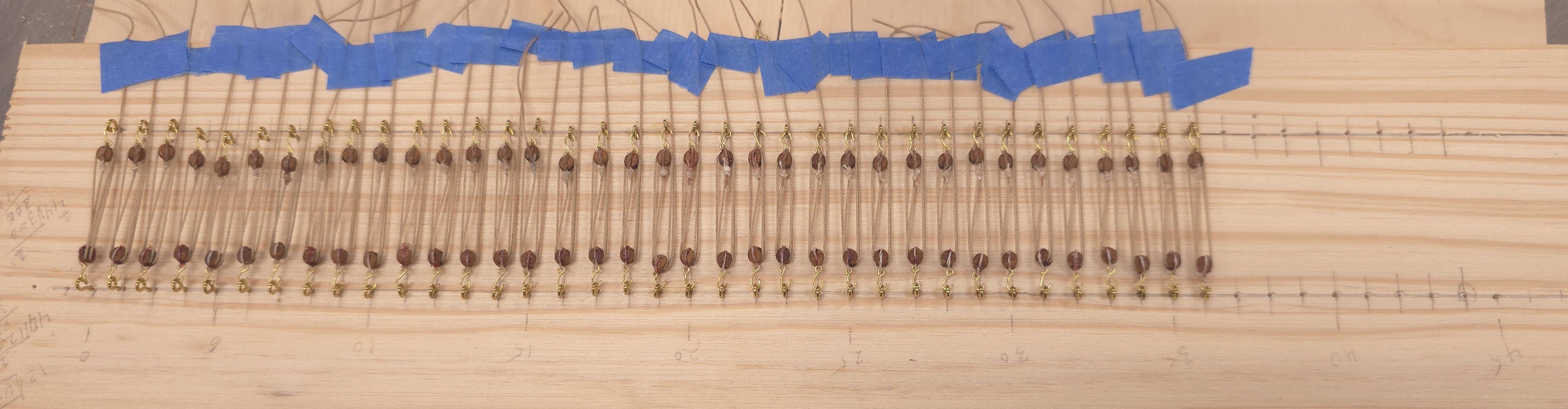

Rig the tackle.
36 tackles rigged, leaving 8 more to do on the weekend.

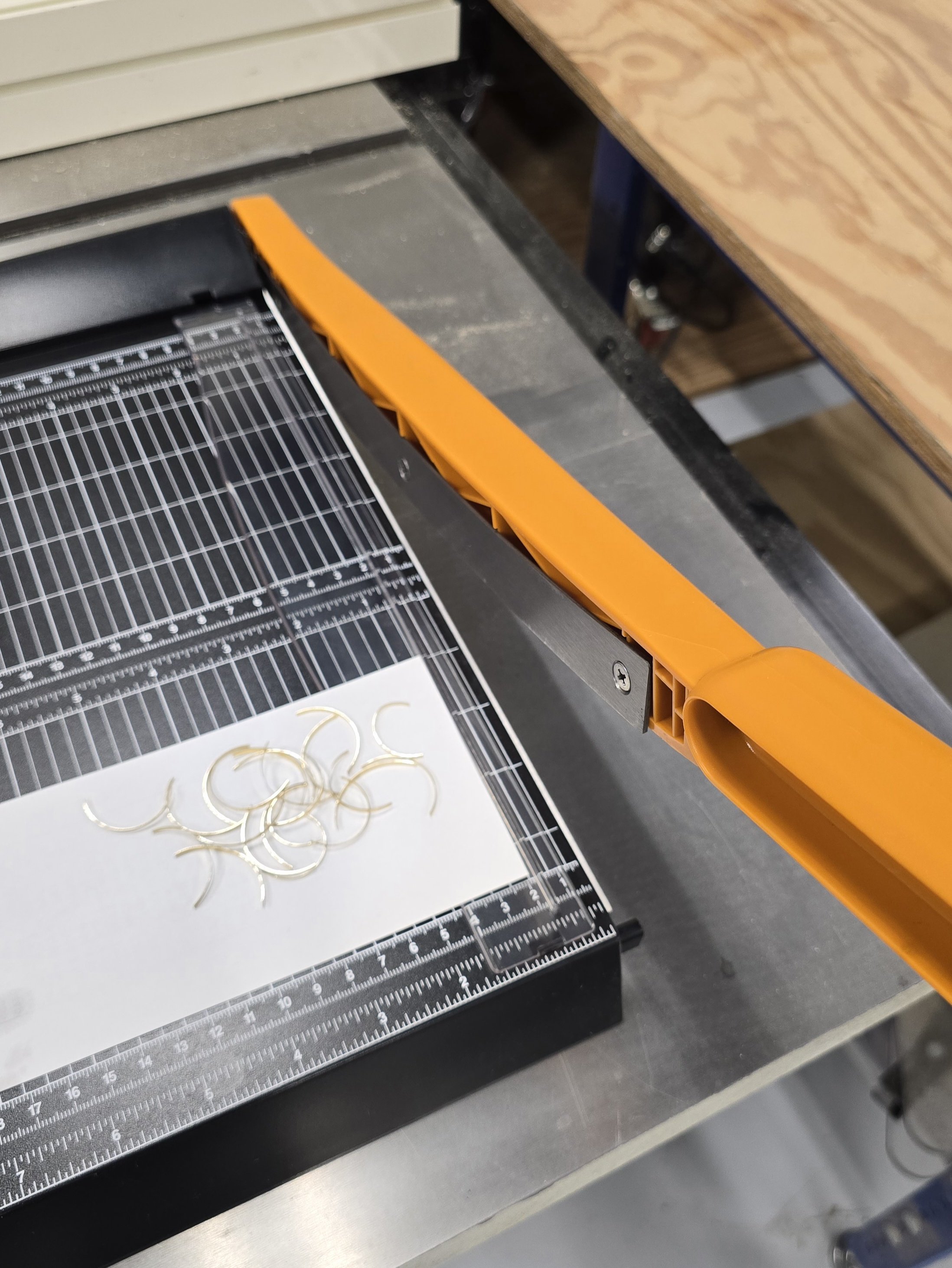

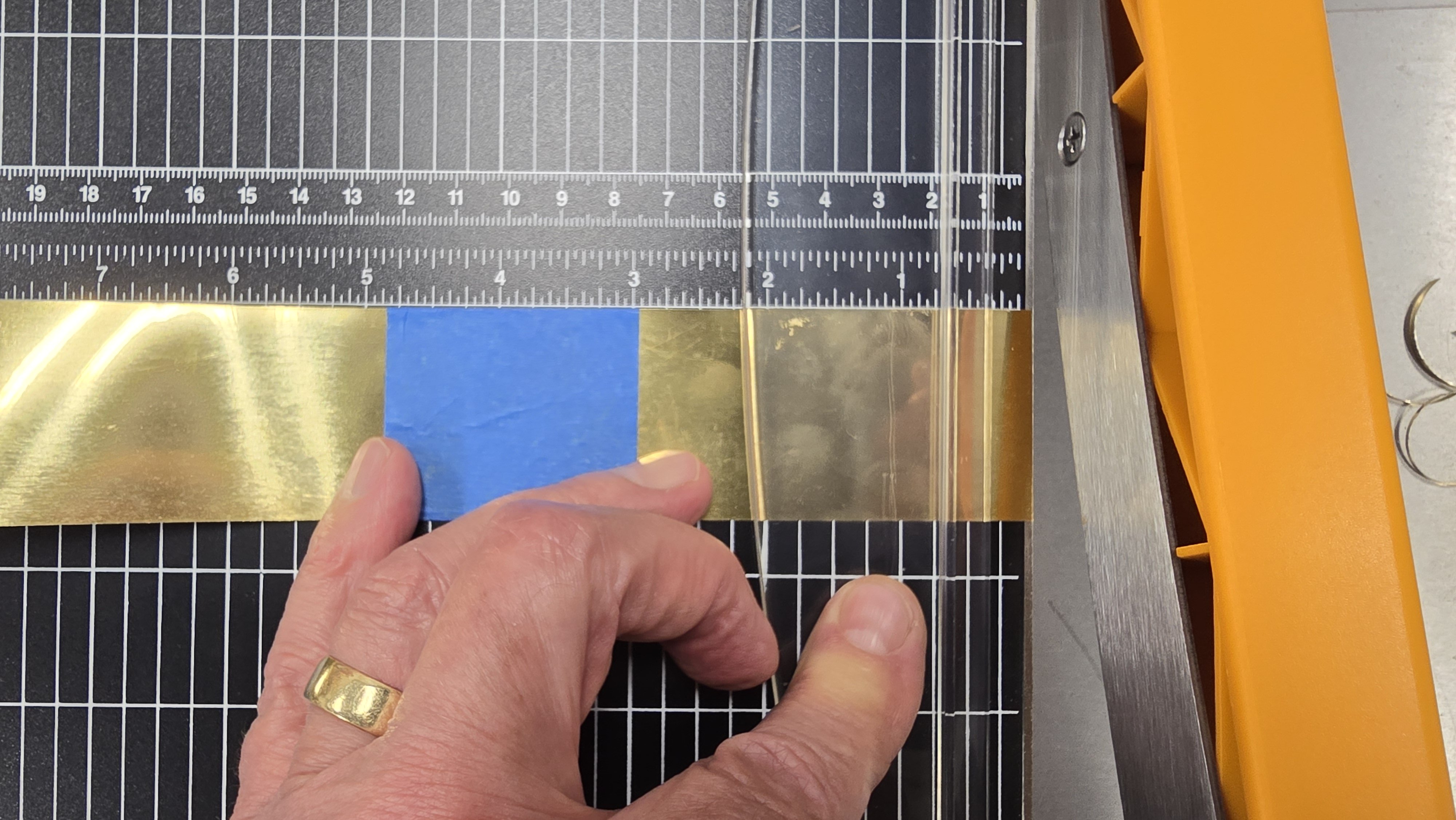

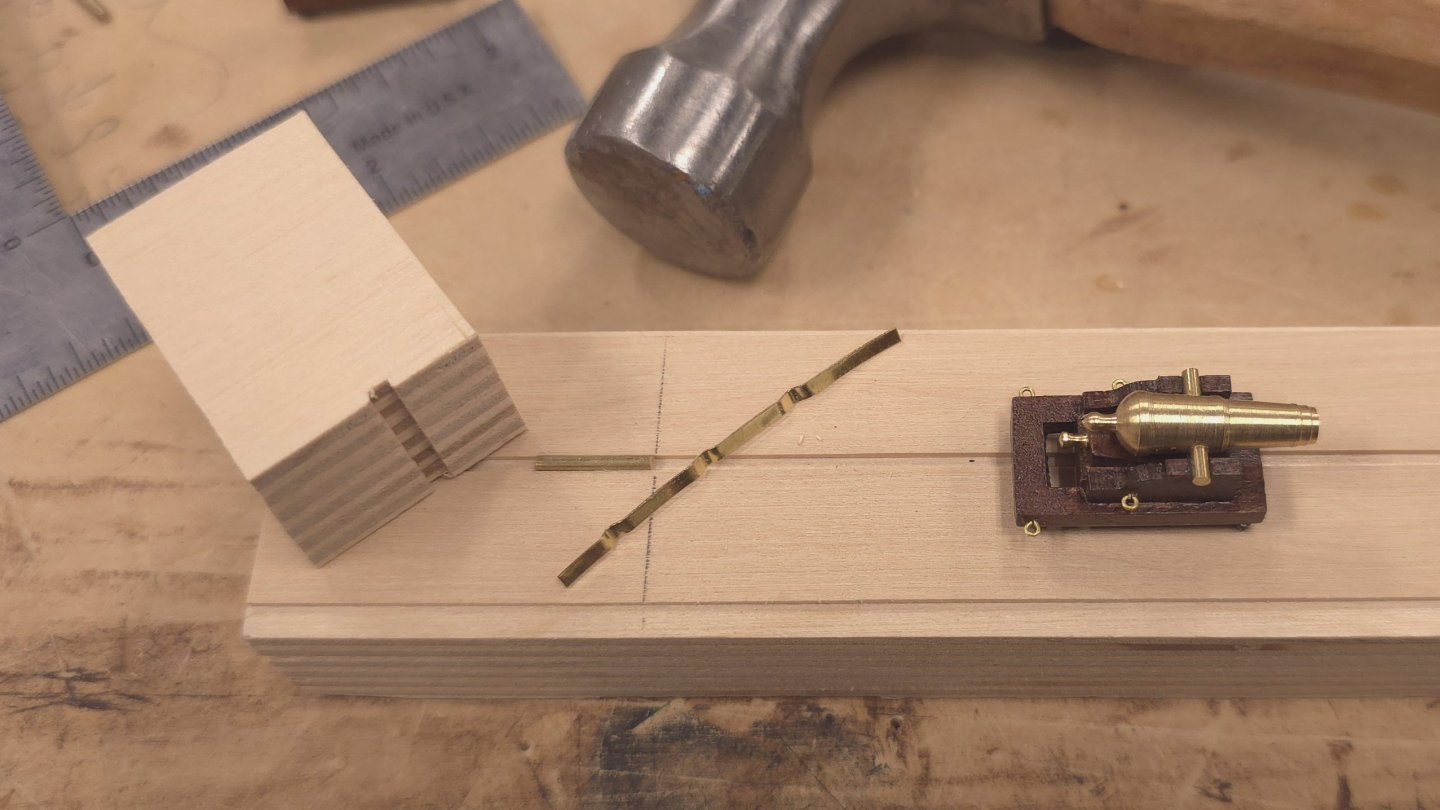

But before I get that far, I'm going to attempt to make the straps for the carronade trunions. The thought of painting on a brass colored stripe ala Bob Hunt (Chapter 11.8 The Carronades) did occur to me.  But you know me, I like the fiddly work. 😁
Borrowing a technique from Mustafa, I'm once again in manufacturing mode.

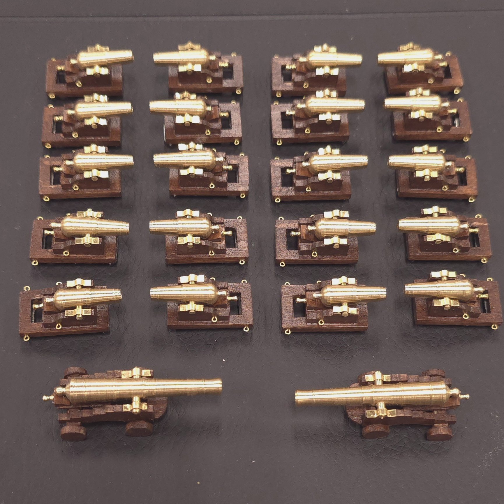

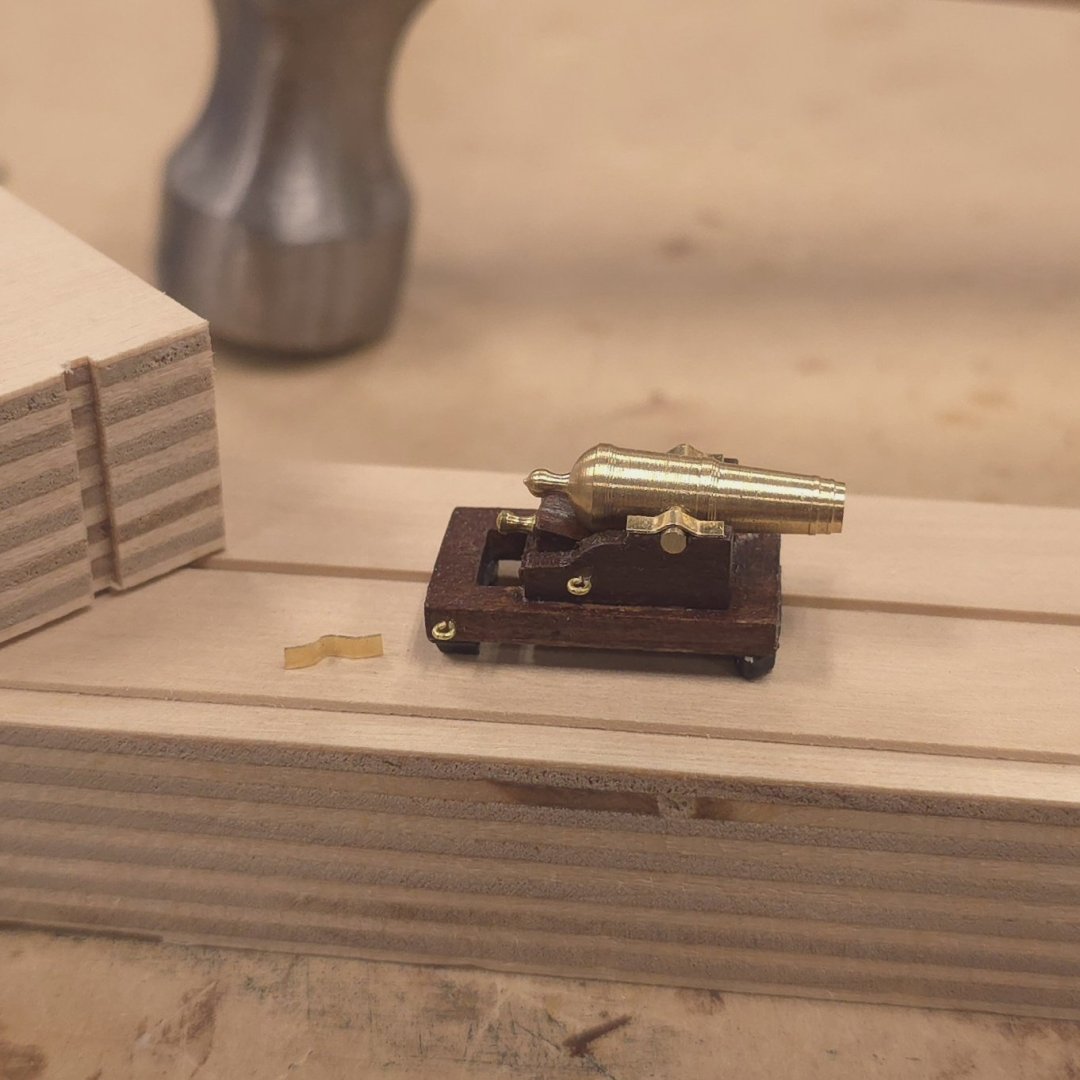

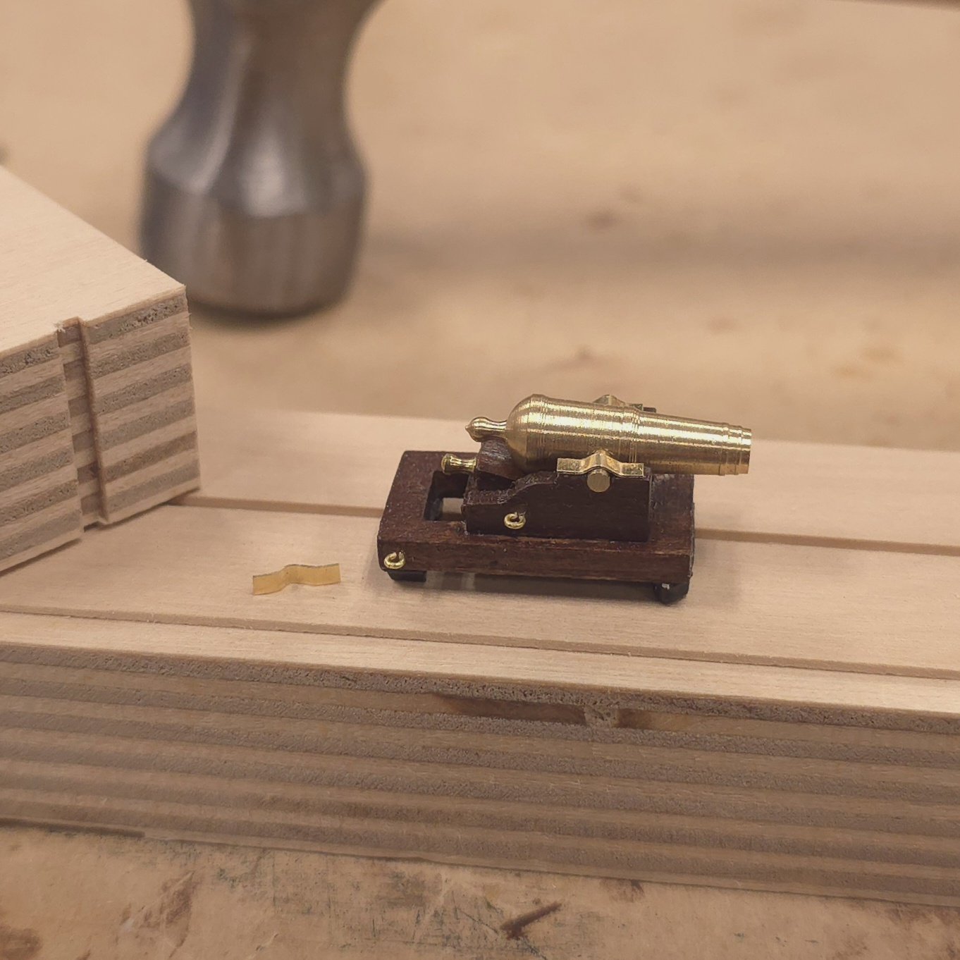

Another photo suitable for framing? Straps added to all Spar deck guns.

Those straps are relatively easy to make, but can be very tricky to install. They are so light, that the slightest, wrong breath or quiver of the hand can kick them out of alignment or knock them off altogether. And should they land on the floor, those little rascals run away and play hide & seek🤣. Well done!
Jon
Jon
No joke! Worse, maybe because I had a couple of coats of poly already on the carriages, the CA glue set super quickly. No room for error!
I actually rehearsed picking up the straps before applying the glue to the carriage. I did drop two, but because I had the glue on the carriage and not on the strap, I just picked up a replacement strap and got the job done.
For what it's worth, I tried really pointy tweezers first, they were a fail. An old fat blunt pair of tweezers held much better.

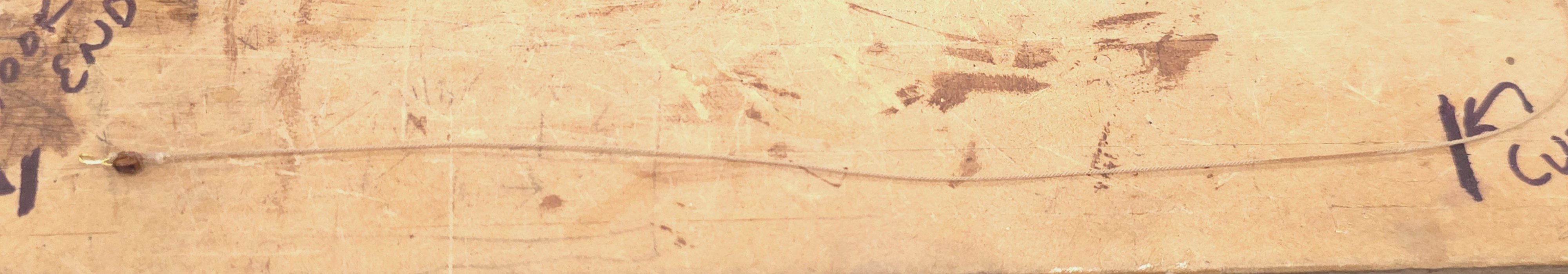

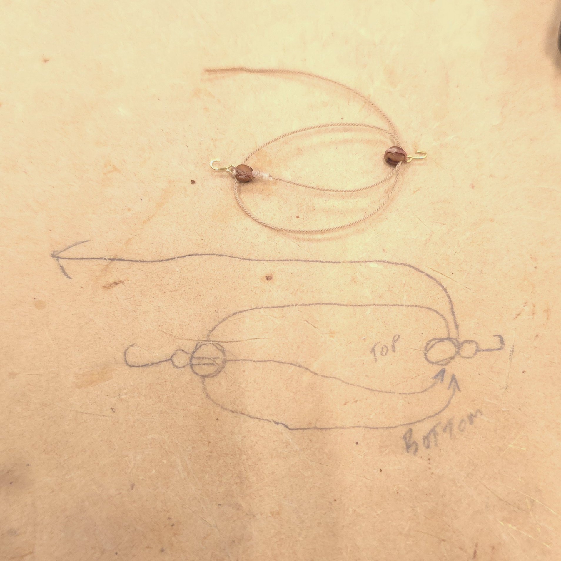

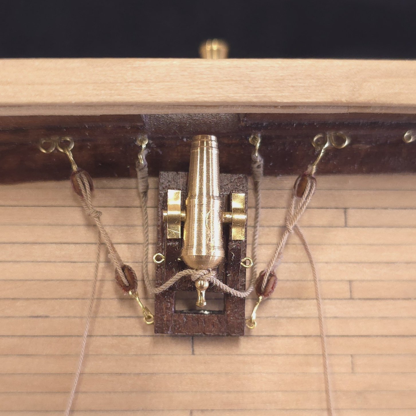

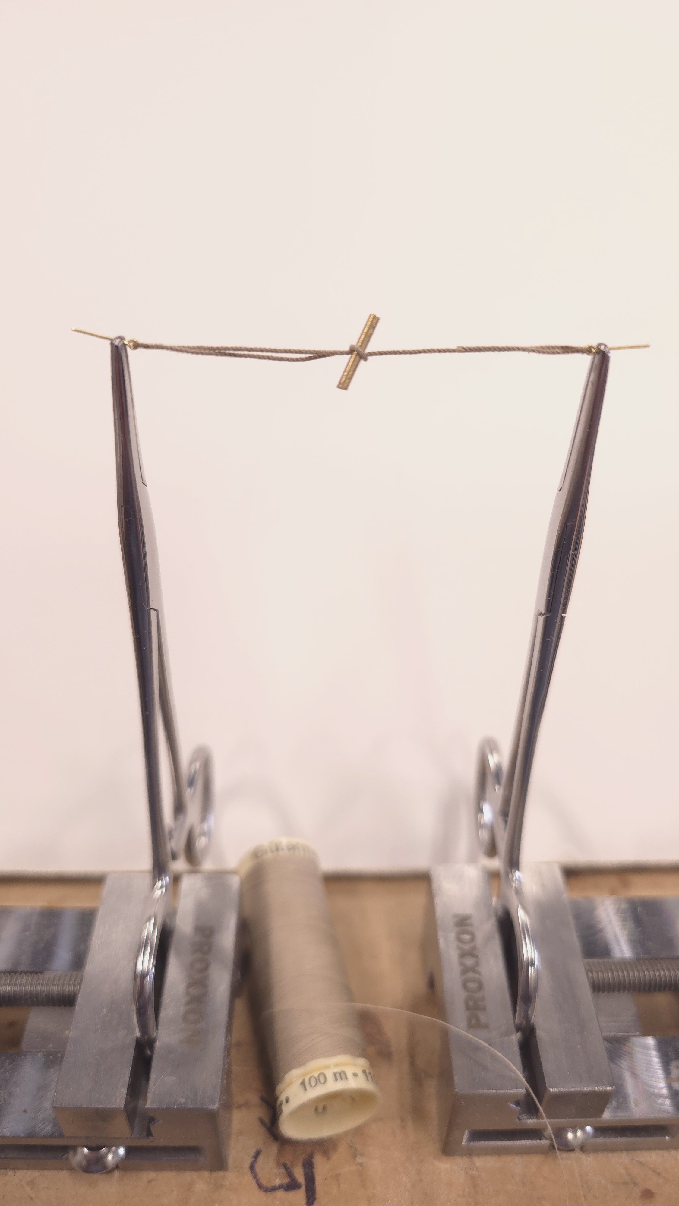

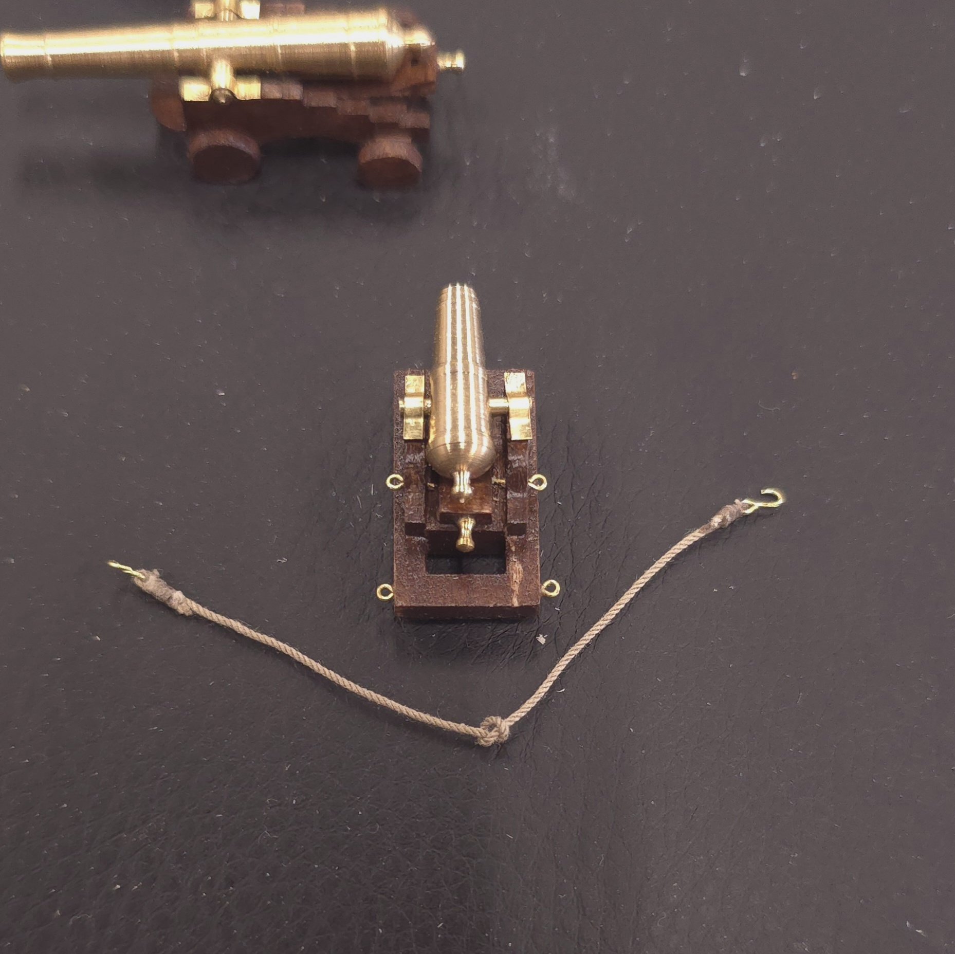

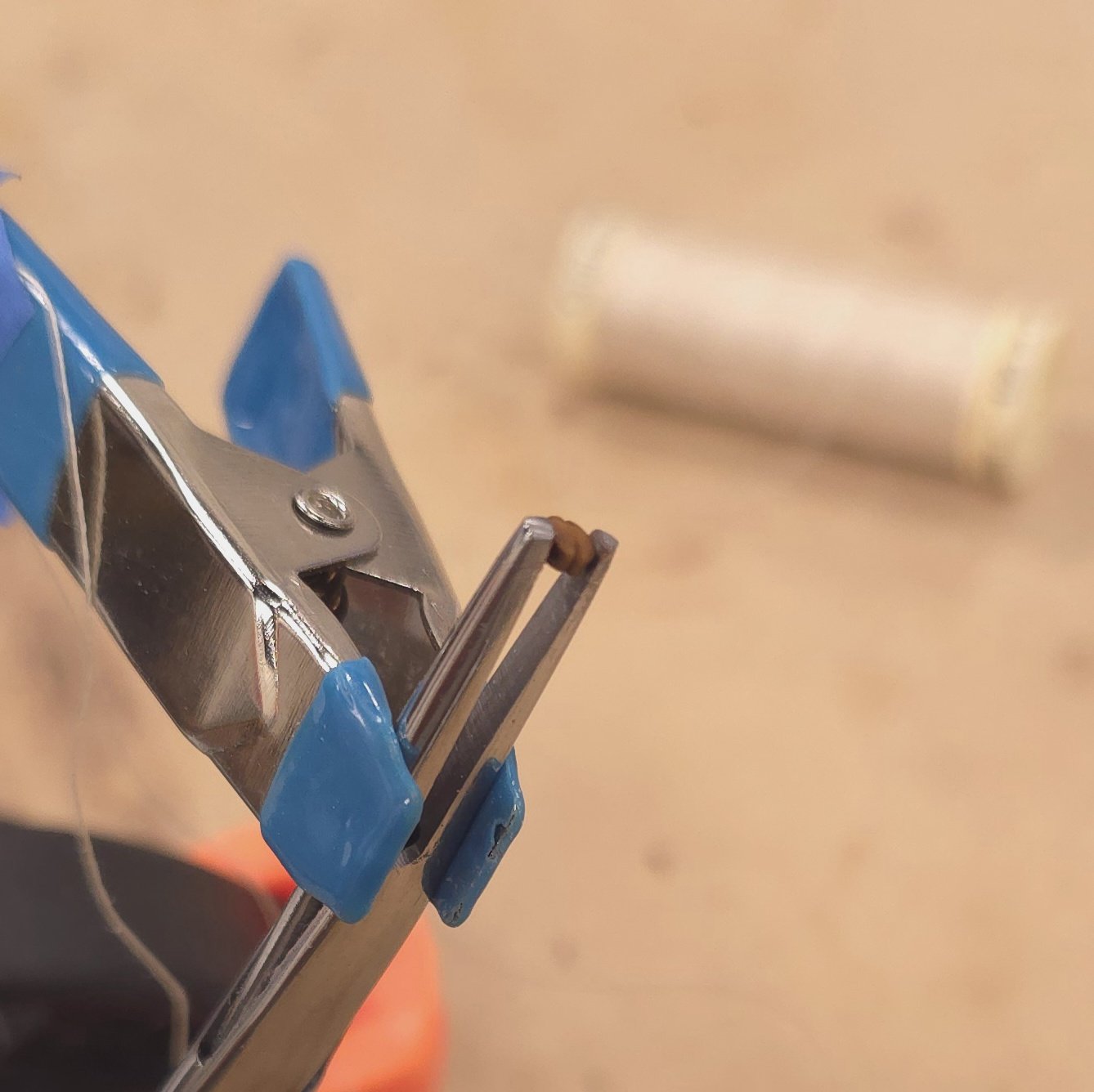

Once again, my apologies to those who have done this before.  I'm documenting the procedure for creating the breech lines for my own use later, when I copy from these posts to my personal build log. Still, there might be one or two newbies out there who might benefit from this exhibition.
To free up my hands for the seizing, I literally bolted two Proxxon vices to my workbench. The rest should be self-explanatory.
Note: the carronade is not glued in. This was just a test fit..
I started working on the pin rails as well, but have yet to decide which I will install first - the pin rails or the carronades. So, I will make the breech lines first and postpone the decision until the later.

For what it's worth, I chose .6 mm beige from Ropes of Scale for the breech line.
It's a tight squeeze through the eye bolts, so I treated the tips of the line with C/A glue, let it dry, then sliced at a 45° angle to facilitate a pointy end to pass through the eye in the eye bolt.
For the tackles I used .45 mm.
Edited by Der Alte Rentner
Another decision made - pin rails before tackles and breech lines. It seemed to me I would have a difficult time positioning the rails once the carronades were glued into place.  So, after I completed fabricating the breech lines, I fabricated and installed the pin rails.
I finished the tackles and breech lines lines, but I think I'll have to hold off on rigging the guns until I get the cleats installed and make sure I haven't overlooked any eye bolts that need to be placed somewhere on the bulwarks.
