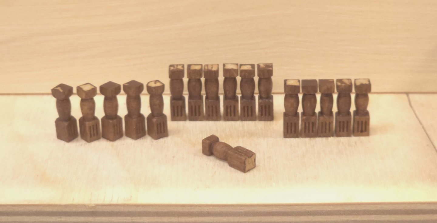

There is always the layer-cake alternative, the method I used for my catheads. Although, I too would prefer just to drill them.
Jon
Jon,
Too late for creating layer cakes from scratch, mine are already baked, and the only option I have is slice into the cakes that're already done.
BTW, I did check XKen's build.  He seems to have used a thin saw blade, cutting three parallel grooves up from the bottom of the stanchion.  I suppose, I could  use a scroll saw to do the same, but I'm not confident I could get clean parallel cuts - and I certainly don't want to make another batch of stanchions.  The band saw would be a better bet, if I had blades anywhere close to a workable thickness.  I don't.  Skip?  Or find a novel approach..  TBD
For what it's worth, not even XKen used these sheaves for his rigging, begging the question, why bother with holes at all..

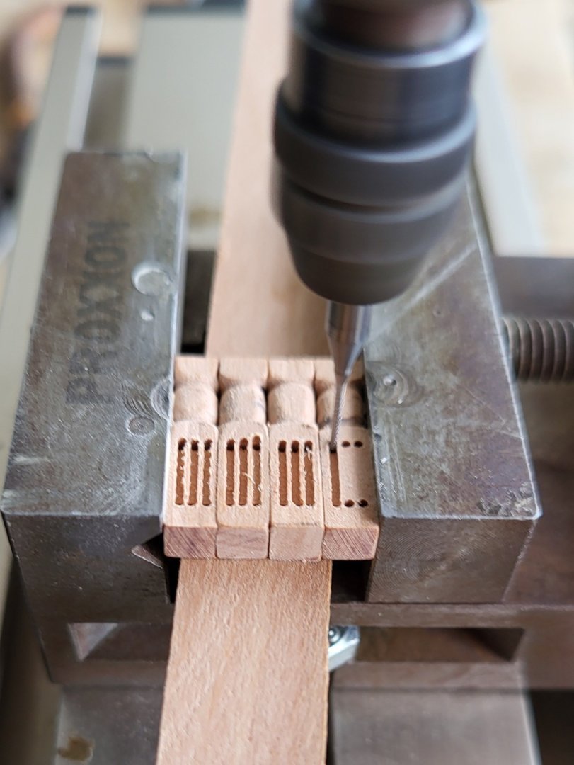

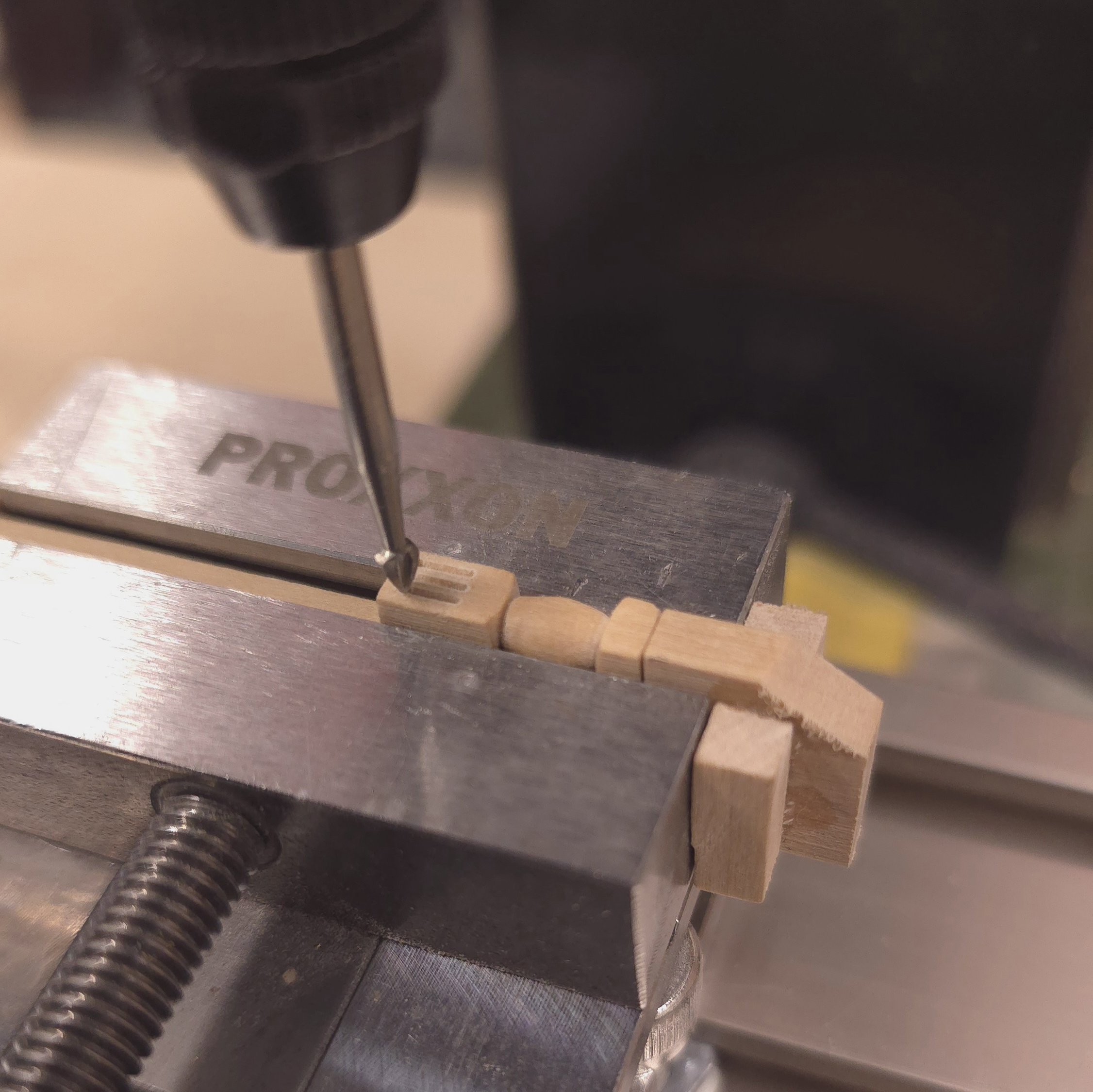

3 hours ago, mtbediz said:
I used my mill with 0,6mm cutter to make the sheaves.
You have all the best toys!
I'm not even going to try to find a 6 mm cutter. I've opted for another option, perhaps a little bit more involved than just painting the black stripes as Jon suggested, but resulting in a reasonable facsimile of a sheave.
Edited by Der Alte Rentner
Added photo of stained stanchions.
I'm not even going to try to find a 6 mm cutter. I'm working on another option, perhaps a little bit more involved than just painting the black stripes as Jon suggested, but maybe resulting in a reasonable facsimile.  Back soon..
I bought 0.5-0.6-0.7mm cutters from Ali Express. They're not expensive, so I recommend them. You might need them again.

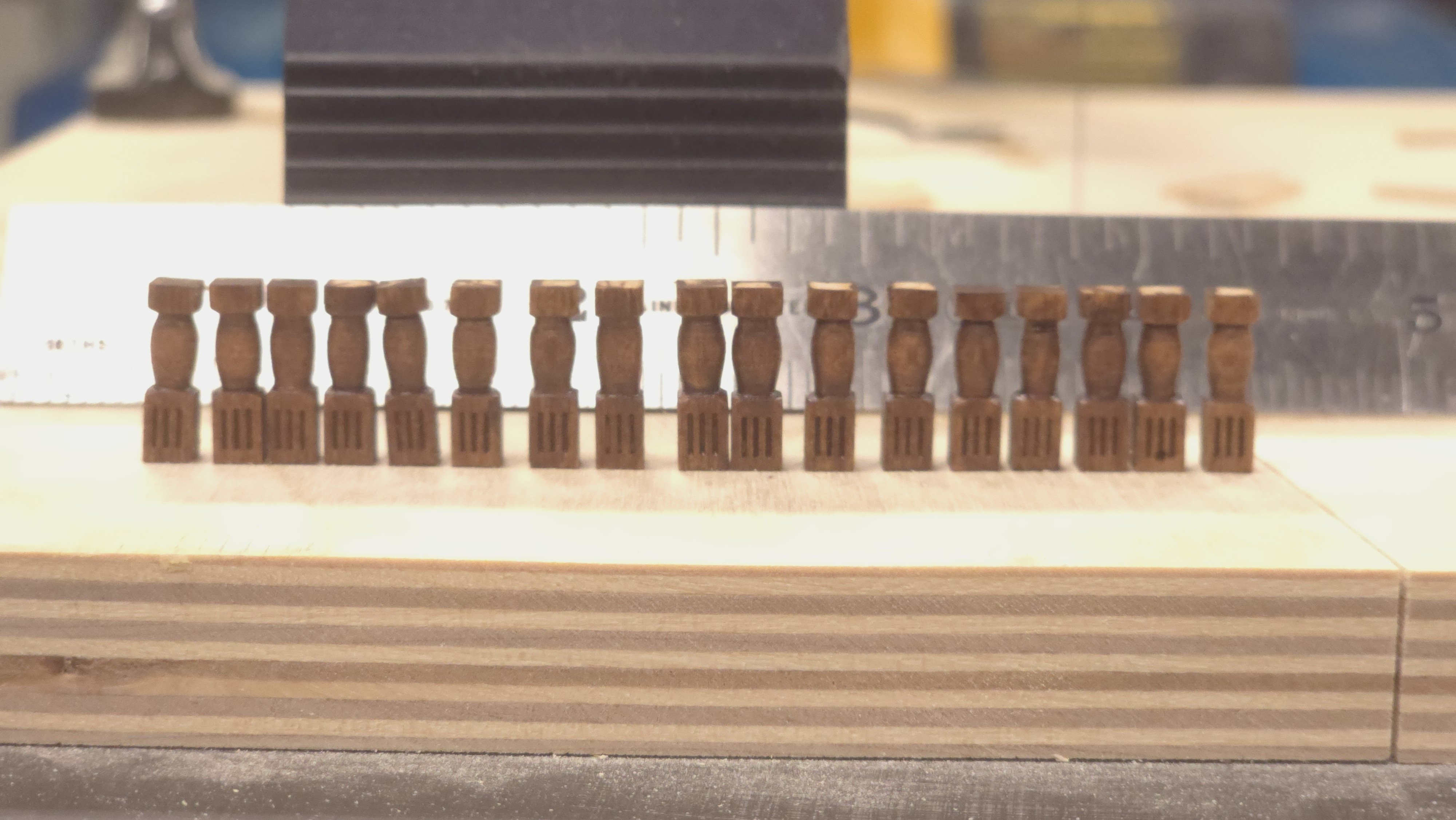

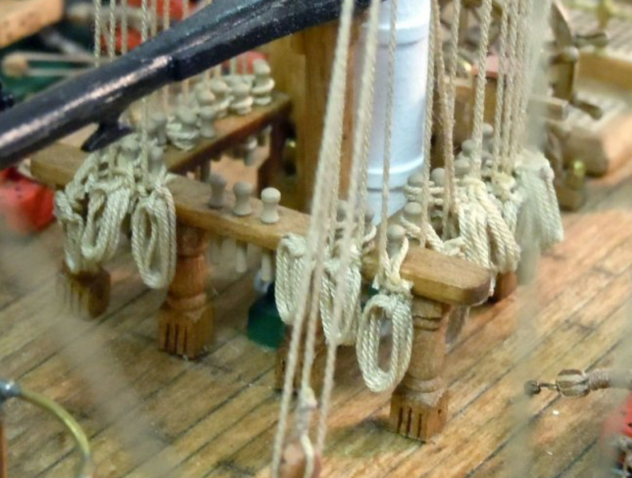

Since I ready faked the sheaves, not just on the stanchions, but also the ridding bitts,
I'm in no immediate rush for round cutters less than a millimeter in diameter. That doesn't mean I'm not going to shop for them, while I'm looking for something that'll cut a square hole 2 mm across for the wooden post that passes through the top of the ridding bites. (Hunt uses round brass stock, which I may resort to if I can't fit a square piece.)  Mustafa, if you are reading this, how did you manage to get square posts into your ridding bitts?
For larger woodworking projects, I have a tool that's a combination chisel/drill. Great for cutting mortises. I doubt I'm going to find anything small enough to work here..
Since I posted this response to Woodartist, I've taken a different direction. See proof of concept below:
I plan to put a 1/32" inch thick brass cap on top of the ridding bitt to finish it off.
re-ordered photos

I admit that I gave that more than passing thought. But that meant setting up the lathe again.  Since I already had the milling machine more or less ready to go, I opted for the approach outlined above. Since I knew I was going to be adding a brass cap, I wasn't worried about the look of the top after the woodworking.

I used the Proxxon mill and the dividing attachment on a quarter inch round piece of brass stock. If you look back to previous posts, you will see how I square off  round dowl - see binnacles...
With the dowel in the dividing attachment, first I cleaned off the end, then repositioned the mill above the dowel and took off roughly half millimeter slices at 0, 90, 180, and 270° of rotation until I got square stock roughly the dimensions of the top of the ridding bitt. Mine weren't entirely square, so I made them a smidge oversized. (Only you and I will know that..  🤫).  Then I shifted the cutting bit 1 mm in from the end, and started taking off half millimeter slices every 45°. Eventually I just hand rotated the dividing attachment to fashion a circular nib of about 1mm in diameter to serve as locating pin for the cap to facilitate centering it on top of the ridding bitt, on top of which I had drilled a 1/16".  Finally I used a hacksaw to slice the cap from the dowel. Rinse, repeat
While the cap was still attached to the rod, I polished it using 1000, 3600, 6,000 grit sanding discs. I have a machine (Work Sharp), which I use to sharpen chisels and such, that allows me to do this kind of polishing.20250918_105443.thumb.jpg.21de85db9a0cd6785c7f4560117a43fe.jpg

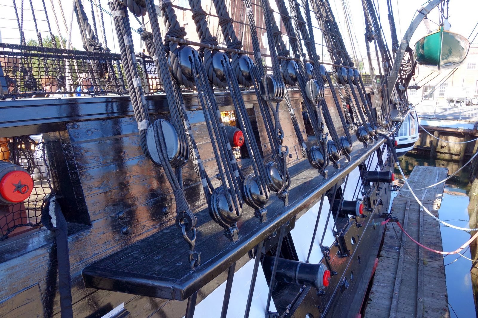

Today is being spent doing research on chainplates and channels.

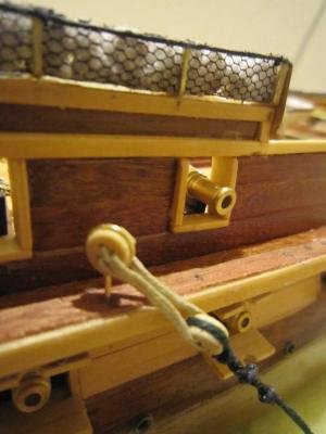

In my reading (mostly HipExec's Constructo build), I've learned that I may already be in hot water in that I didn't pin the pin rails to the bulwarks.  Probably too late to do anything about that now, sigh..  I hope the C/A glue holds up during rigging.  And this leads me to conclude that I am going to have to figure out how to get pins into the already constructed fife rail stanchions.  But I digress..

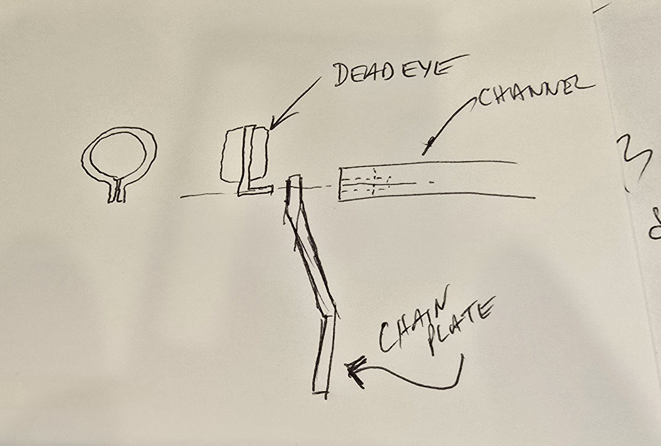

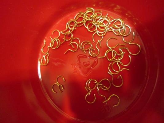

Chainplates and Channels:  Because I don't want to do any soldering (Hunt method), can't figure out what XKen did to connect his deadeyes to the chainplates, would like to be able to use the kit provided chain plates, and am lazy by nature, I'm looking to find an easier but effective method of tackling this problem.  I may have hit upon a simple technique of securing both deadeye and chainplate to the channel.   Here's what I'm thinking,

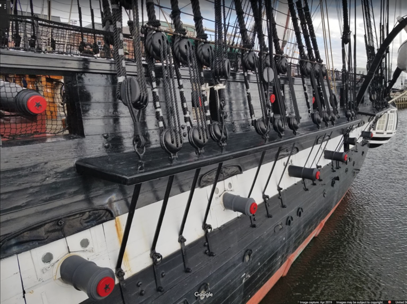

Bend brass rod around the deadeye similarly to how HipExec did this:
but bend the straight portion of it 90 degrees to make a hook.  The hook would then pass through a hole in the chain plate and be sunk into a hole drilled into the channel.  If the channel is pinned into the hull, this looks to be a very solid way to anchor the deadeyes.
(pardon the sketchy sketch - pun intended😁.)   Ignore the split in the ring on the left.  If I did that, I'd probably have to make my own chain plates, which would be wider than the kit provided hardware, to accommodate a slot instead of a small hole.
Thoughts?

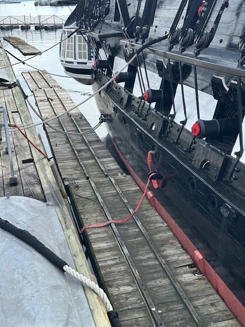

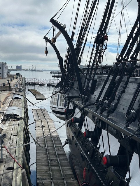

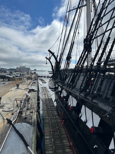

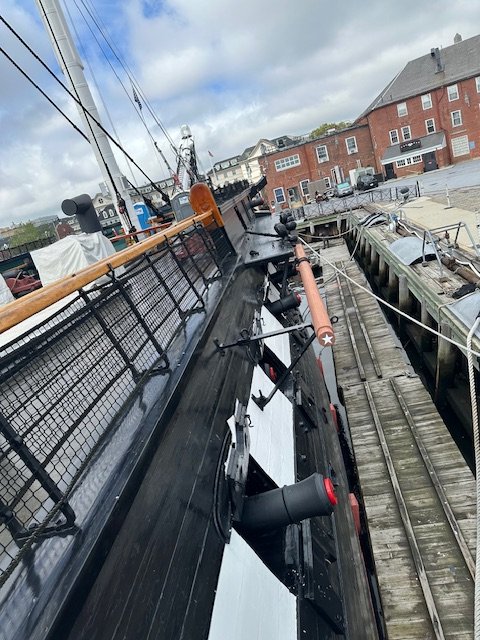

I sent these images to Mustafa as well. It shows what the actual connections look like to help guide you. In my opinion, your idea should work better if you use the stronger boxwood for the channels instead of basswood.
Jon
image.jpeg.00d12e9c21c1755ddf5689e8bda7cfeb.jpegimage.thumb.jpeg.38545c7e3462e087fd6154baad7d5d2f.jpegimage.png.46f614a034d399f09516a7b7cccbcd12.png

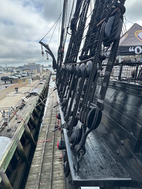

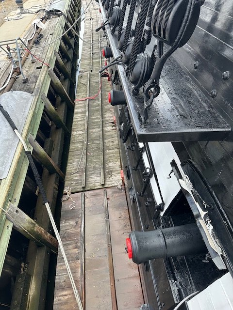

Hey Peter!  I returned from my Boston trip last Saturday and visited the Constitution on Thursday.  It was a cloudy and misty damp morning that day, and had rained harder earlier, so a lot of the spar deck was covered when I visited (groannnnnnn).  But here are some of the exterior, including the deadeyes and channels.  Probably not too much different than Jon's pictures but hope they help some.
Gregg
