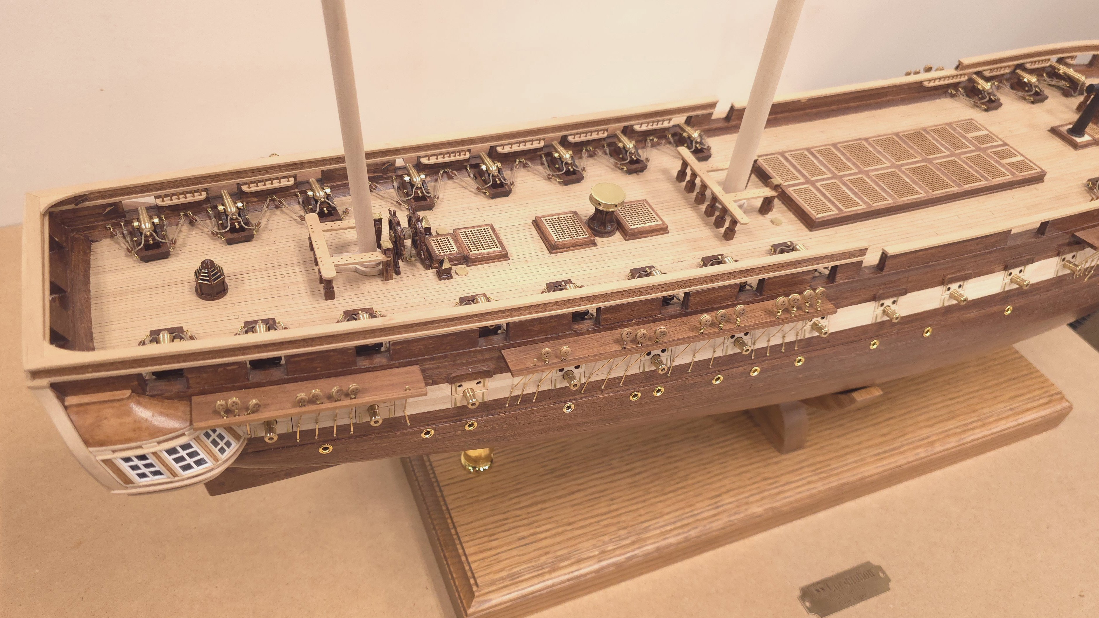

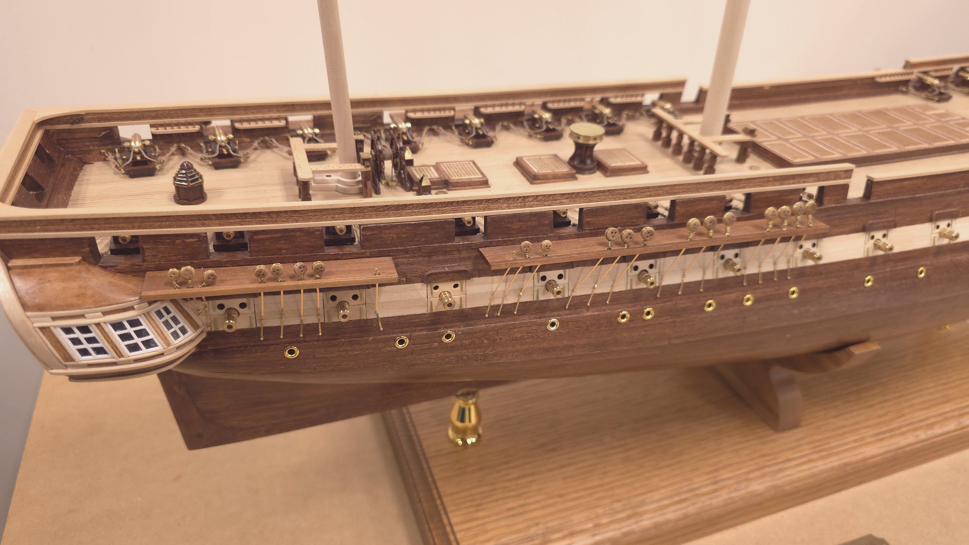

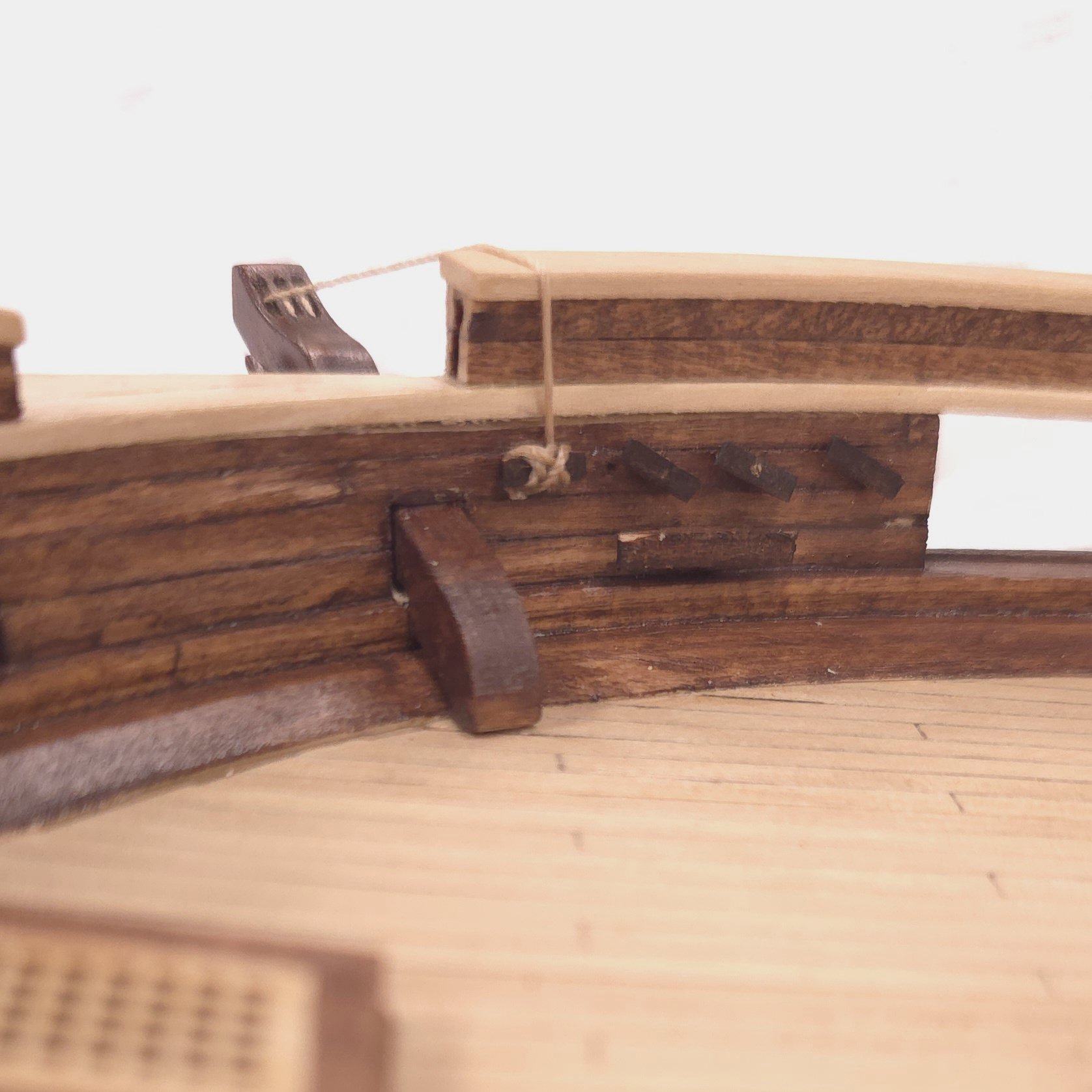

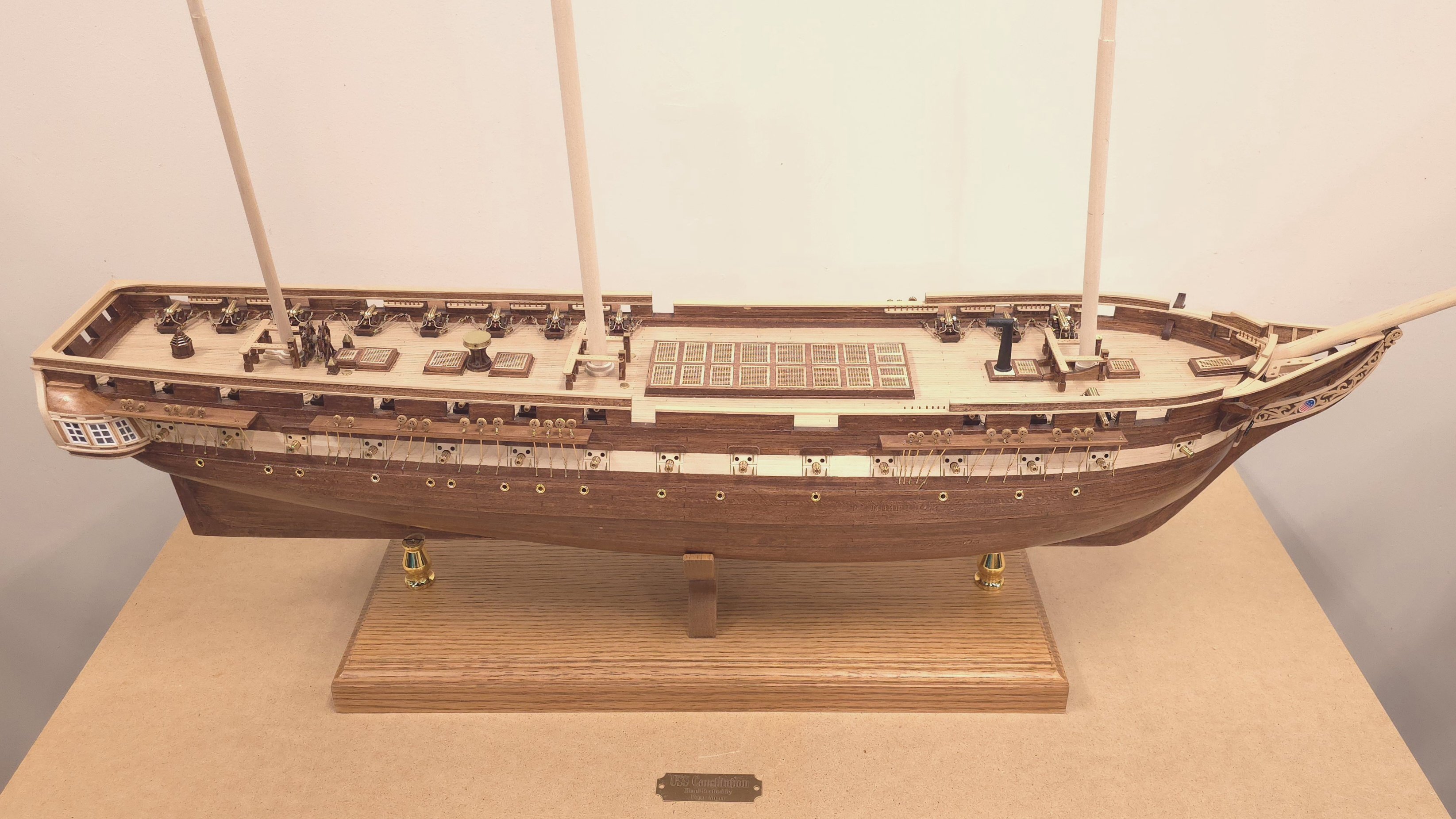

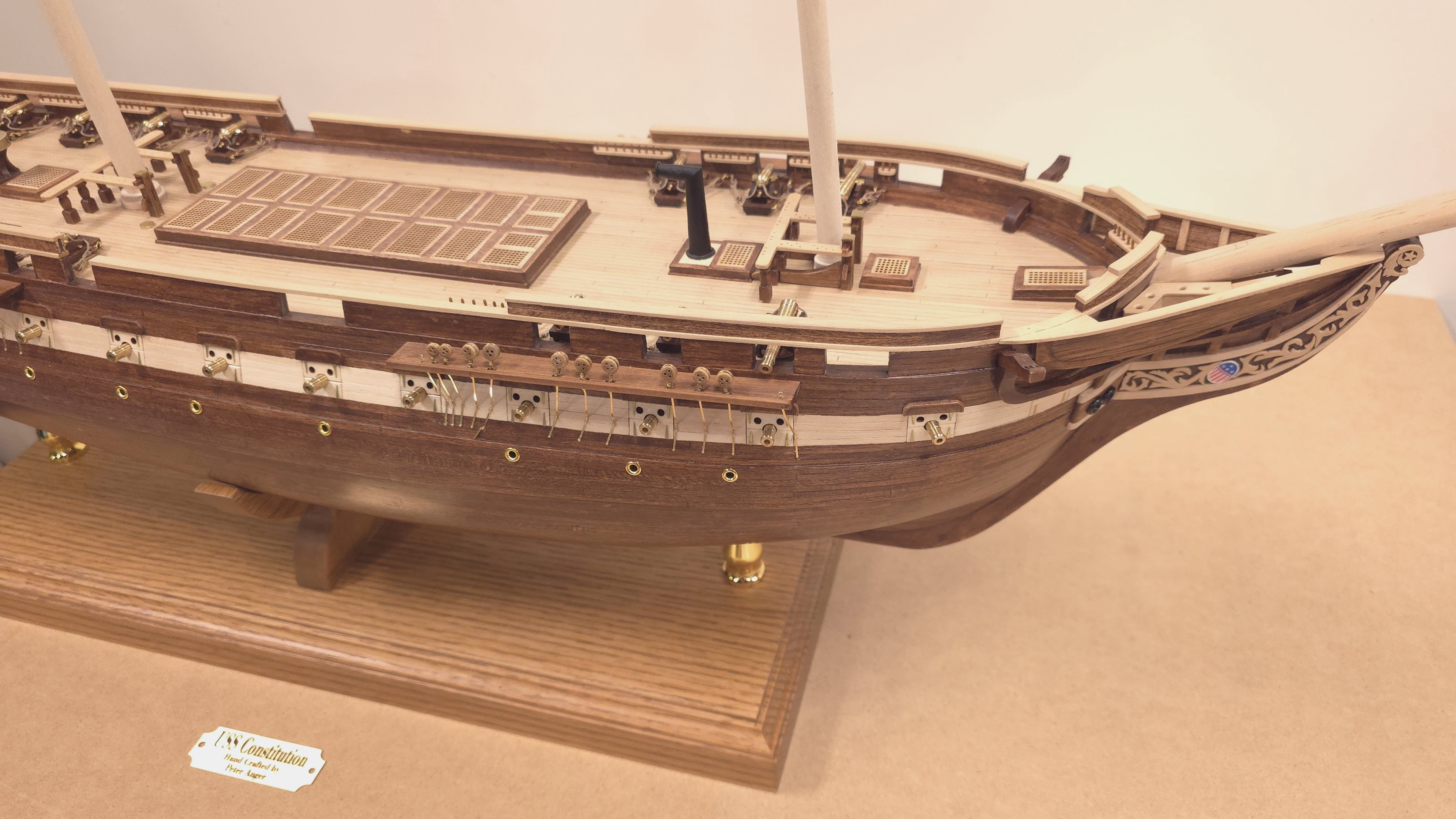

I finally finished the starboard side channels and chain plates. Well, almost.. I had to do a little trimming on the channels, which required a little touch up with stain, which in turn requires 24 hours to cure. So, putting a couple of coats of matte poly on them will have to wait a day or so.
While I contemplate next steps, (the remaining three items in chapter 12 of the practicum - steps, anchors and rudder), I'll update the build log with a few new photos.
By the way, the belaying pin replacement count was an even dozen.  I repeat my earlier advice, don't glue in the belaying pins until you're ready to use them. There's almost no way to work on chain plates and channels without taking them out.
Edited by Der Alte Rentner
2 hours ago, Der Alte Rentner said:
I finally finished the starboard side channels and chain plates. Well, almost.. I had to do a little trimming on the channels...
...don't glue in the belaying pins until you're ready to use them. There's almost no way to work on chain plates and channels without taking them out.
Nice work, Peter.  Your ship looks great!  Quick question, though, to show my ignorance.  How are the belay pins getting in the way of the chain plates and channels?  I'm not visualizing the concern.  Wouldn't the work for each be on either sides of the rail?  I can see, though, having the belay pins in before working on the shrouds so they are easier to secure in their place without the rope lines in the way.  Just a curious question...
Gregg
Picture yourself holding the channels in place while gluing them in, or fitting and gluing on the caps.  The problem is that your fingers tend to curl around the rails while you're working in the vicinity.  As careful as you think you're going to be, when one or more of the pins snap, you realize that, Doh! I forgot again.

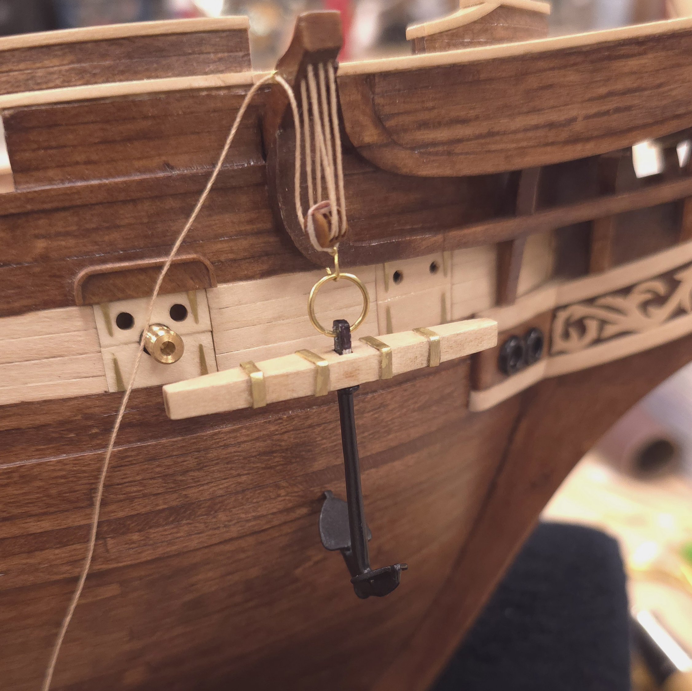

I returned to the shipyard yesterday, not much progress given multiple coats of primer, paint and poly.  Although I did fabricate the rudder out of boxwood instead of using the basswood piece supplied with the kit.

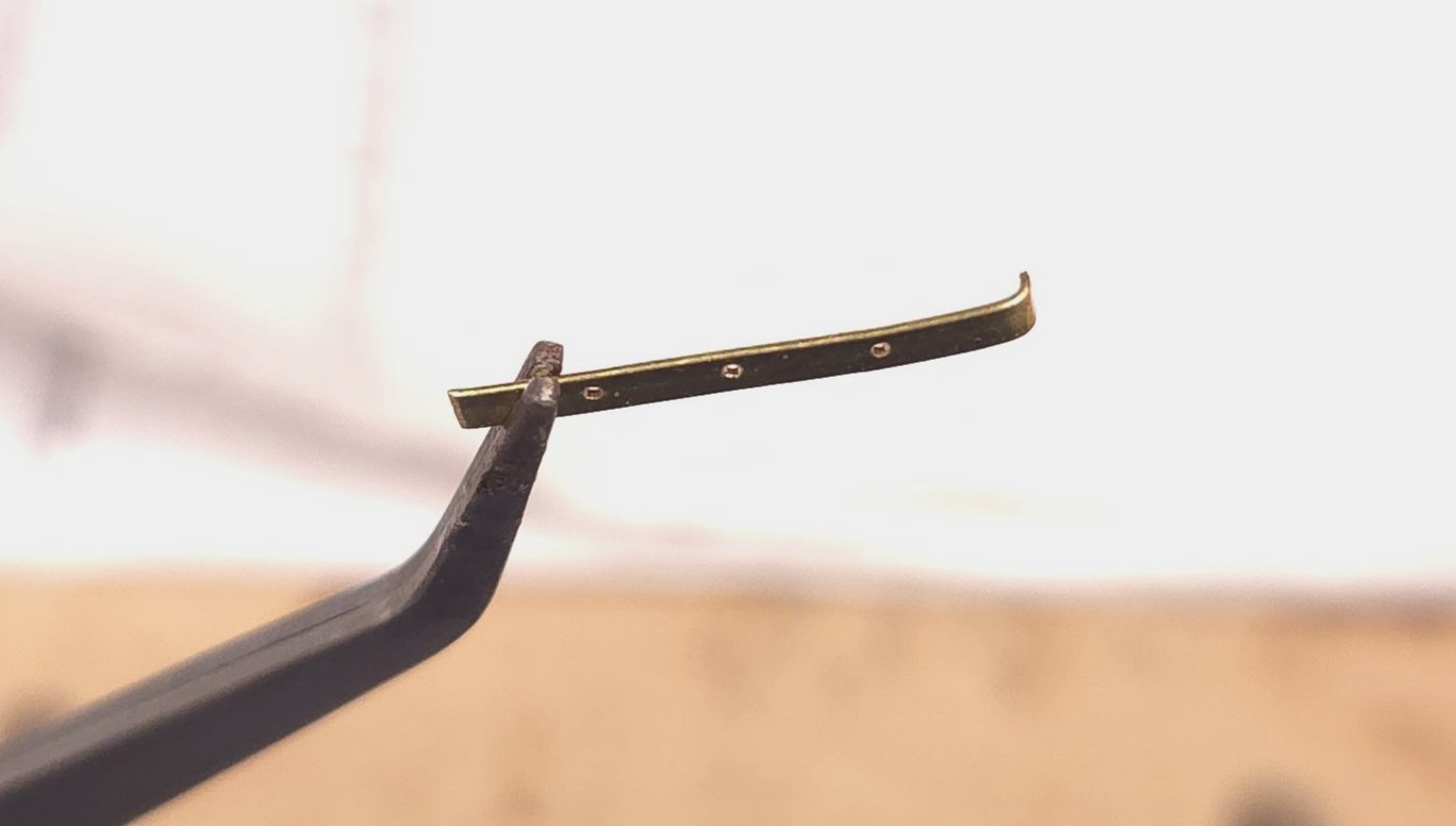

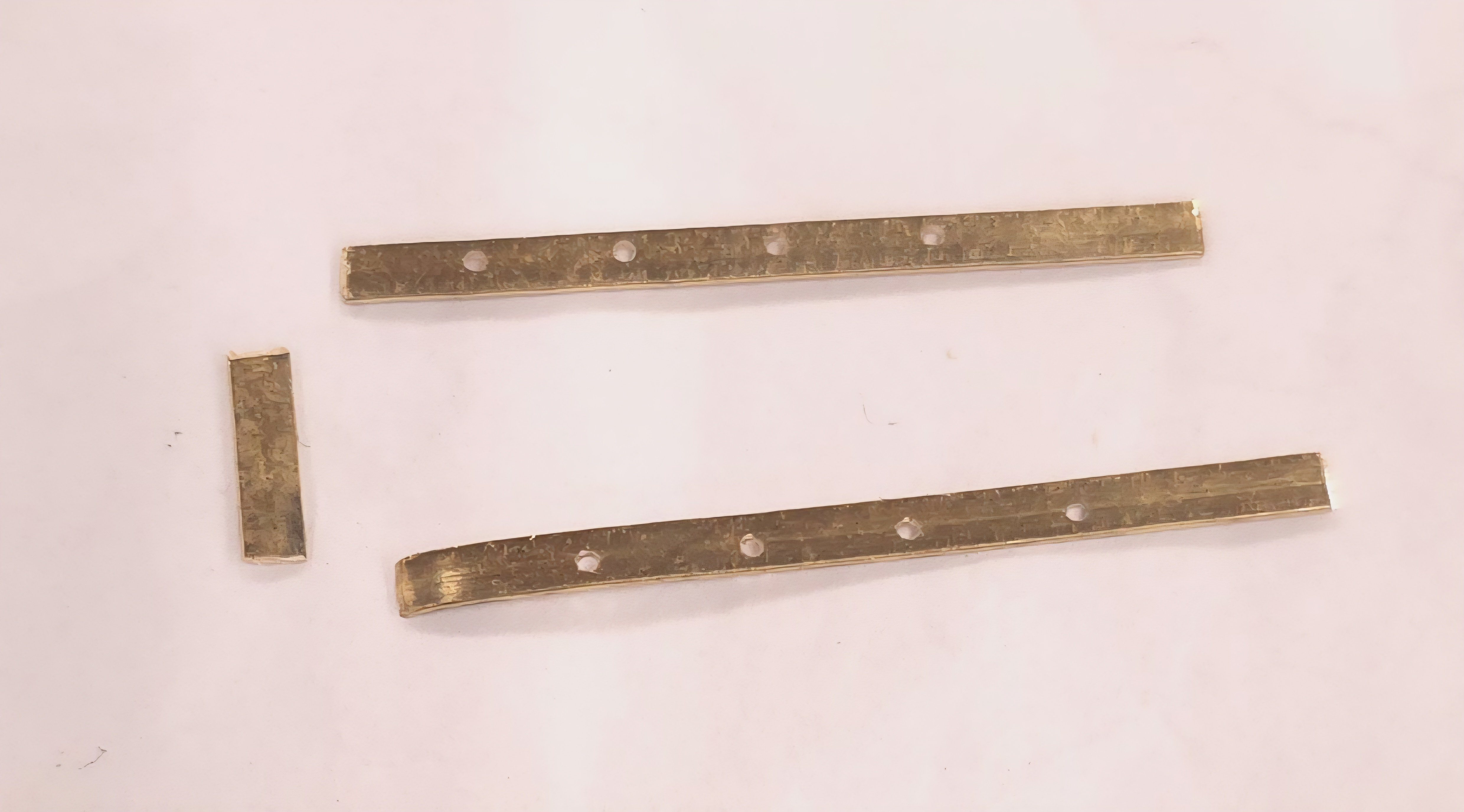

I have found that the brass strip material that I'm using does not adhere well to wood. I've tried both 5 minute epoxy, and C/A glue. (I can't begin to tell you how many times I've had to reapply adhesive to those brass bands around the anchor stock.)
As such, I'm afraid of attempting to glue the gudgeons to the hull. Today I am using the kit's rudder in experimenting with gluing on brass strip. If that turns out to be dicey, I may opt to drill holes and attempt nailing gudgeons and pintles to hull and rudder. Here's another instance where, having chosen the standard black/white paint scheme instead, I could have hidden any glue runs.

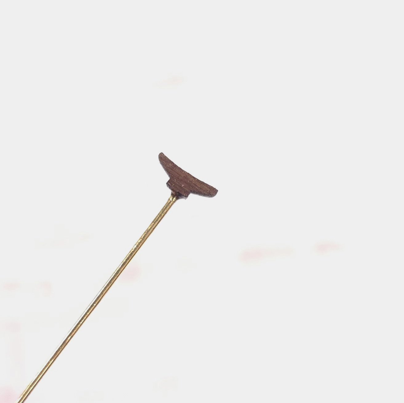

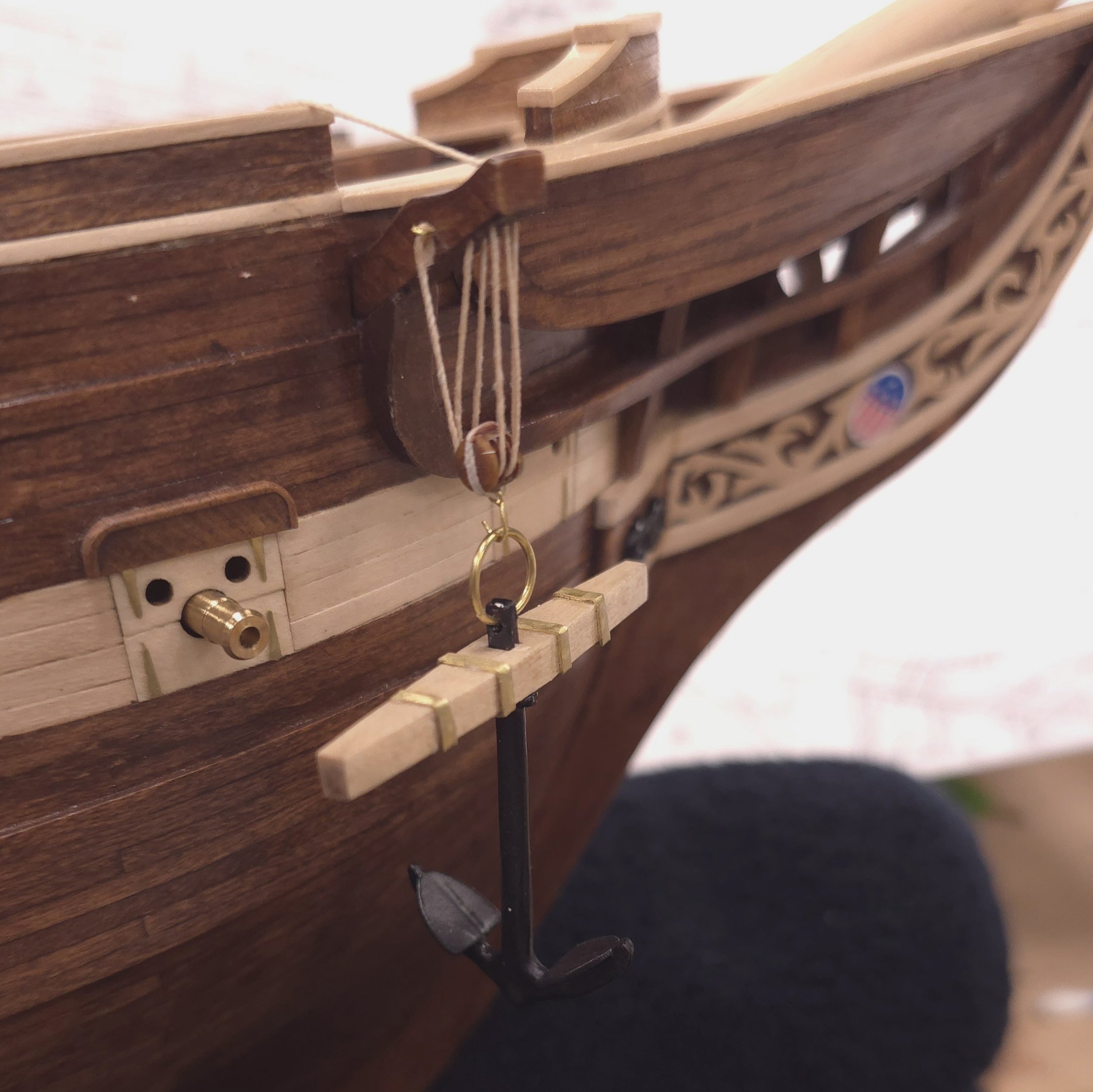

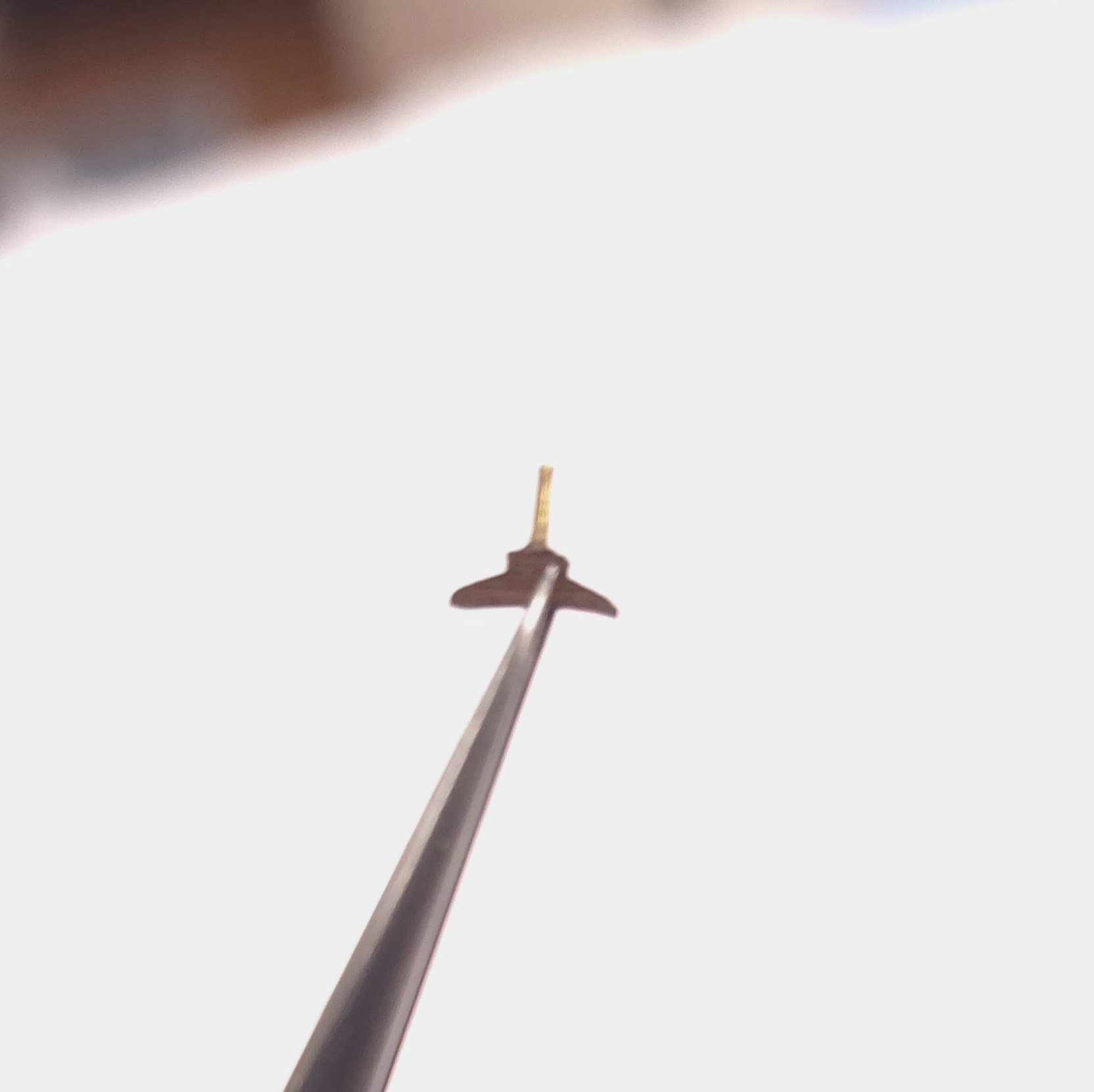

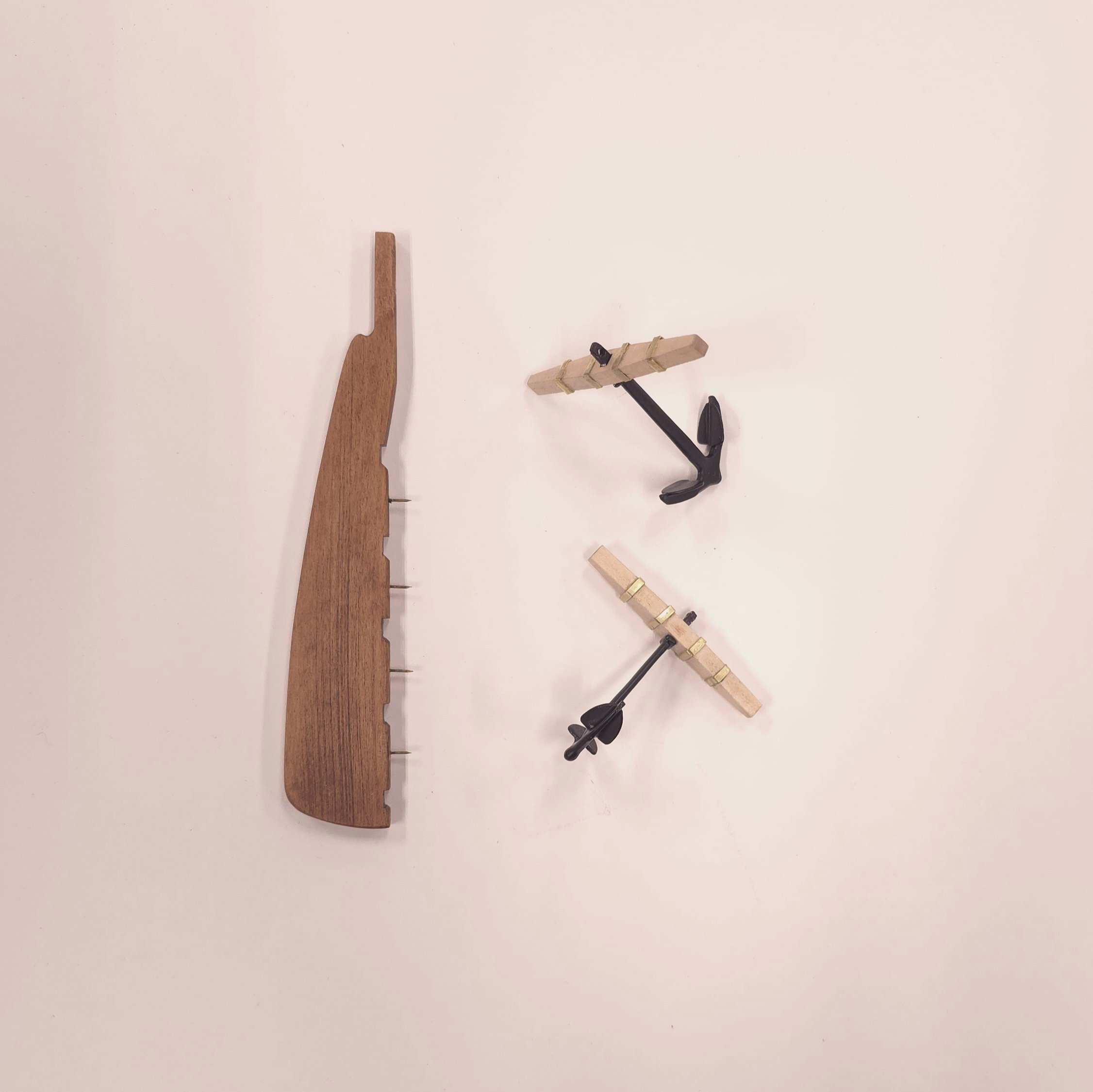

In retrospect, I'm regretting not having stained the anchor stock. That may yet come to pass..   (on second thought, no, it won't.  That would require my sanding off the coats of poly to apply stain.  I can't loose more ground to Mustafa, so am standing pat.)

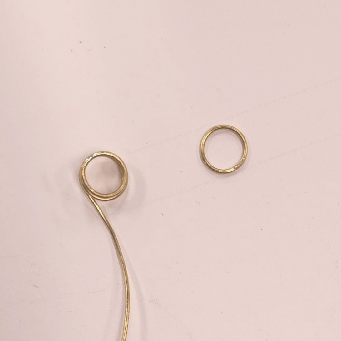

Also wrapped some .8 mm (1/32") wire around a 6.31 mm (1/4") rod, expanded the coil to 7.67 mm (5/16") per plans for the anchor rings.

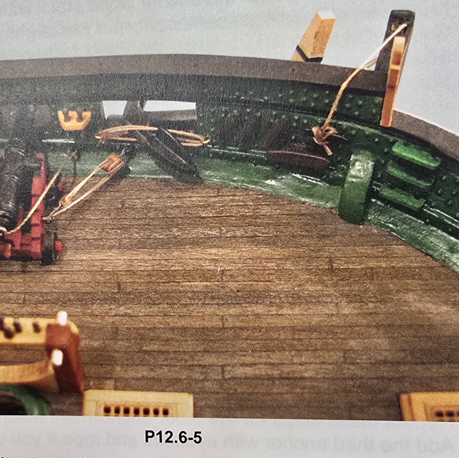

A question for those at this stage or beyond..  The kit’s plans suggest that the bow anchors are stowed without chains.  I’ve looked at several builds for guidance.  It seems that XKen has his anchors hanging, Kmart hasn’t gotten that far, neither has Mustafa.  I don’t like the copper chain that came with the Model Shipways kit (geez, is there anything in that kit I like?).  The kit comes with three anchors as well.  Yet several builds exclude this one.  Jon, I’ve seen all your photos on this, so please don’t resend them here.  I’m just looking for a consensus view.  How are you planning to display your anchors?

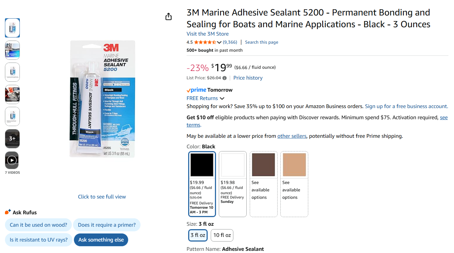

Peter, in a shipbuilding zoom meeting I participated in yesterday, a gentleman suggested using 3M Marine Adhesive Sealant 5200 for adhering copper plates to the hull of a model ship.  It sounds like that would work well with brass to wood, perhaps, as well.  Several others chimed in and said they've used it successfully, too.  Perhaps worth a go?
Gregg
My mental concept is to displayed one anchor hanging from a cathead with the double linked chain I bought on the web some years past, one anchor also hanging on the other cathead but with the cable, and the third stored on deck alone. I don't know how accurate that is, but does show off the various possibilities.
Jon
I checked this out at Amazon (see print screen below).  This does not appear to be available in a clear.  Black, White, Brown and Tan are the only options.
I may resort to giving this a try, if my experiment with drilling holes in the gudgeons and pintles and attaching these with nails fails.  There is also the option to skip the installation of these entirely.  😁
Thanks for the suggestion,  Gregg
Jon
I think I'm going to skip the chain, and the third anchor.  I just don't care for the look of the dangling anchor.  Initially, I had hoped the Constructo kit had brass (vs Model Shipway's copper) chain, but their plans show rope - not chain, but now, I think I've convinced myself to pass on the chain all together.
Thanks for your input Jon.

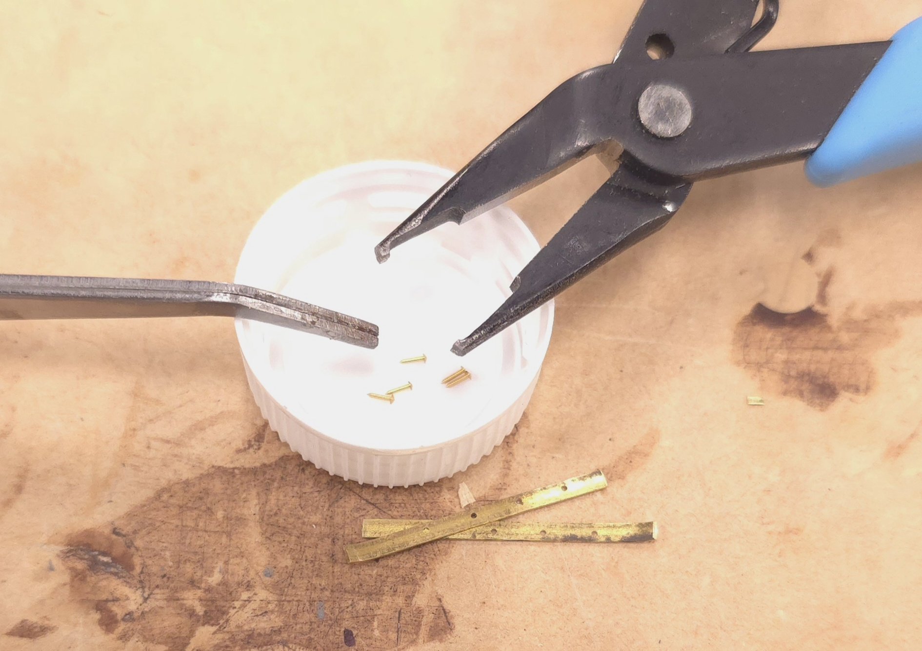

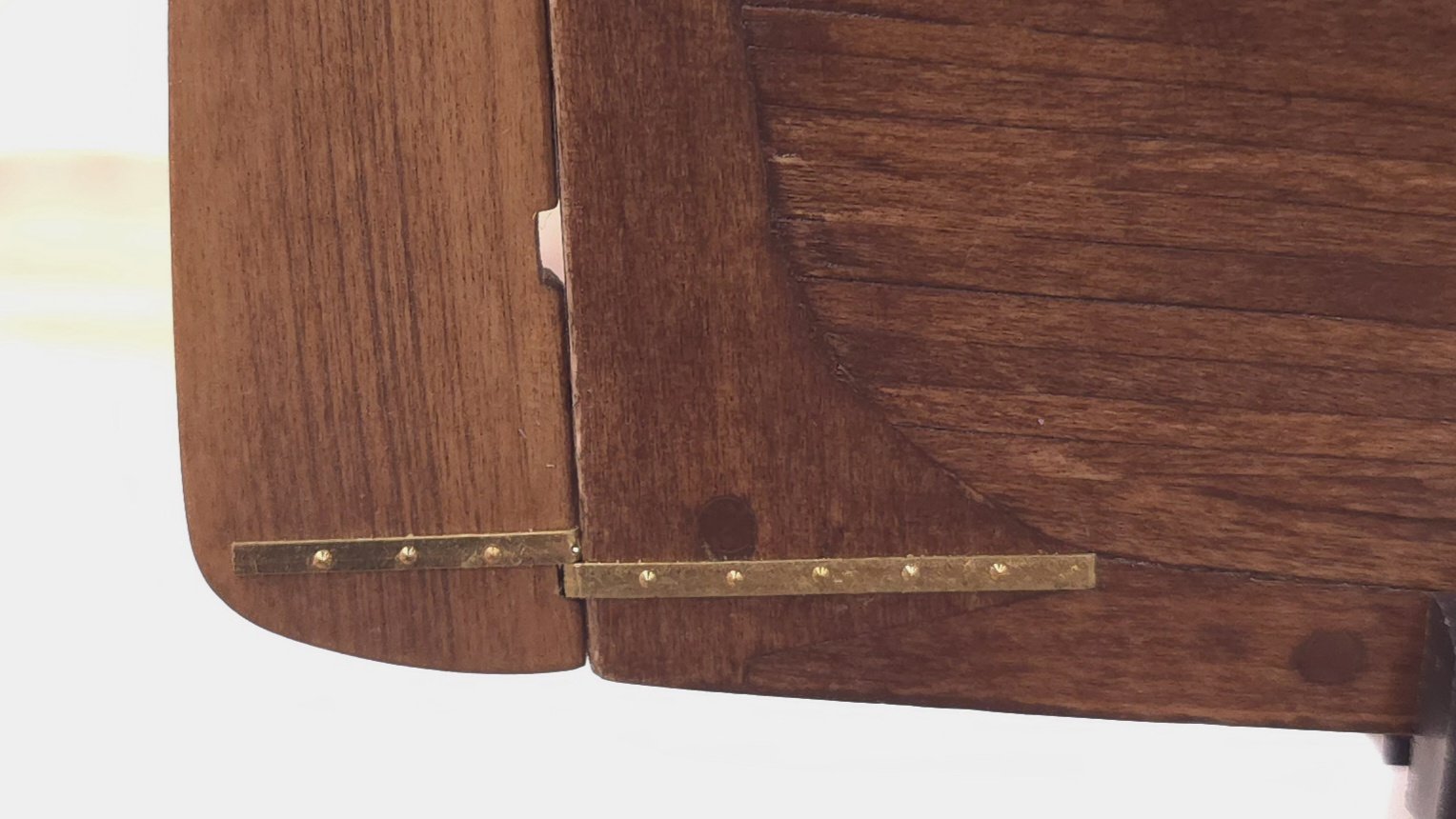

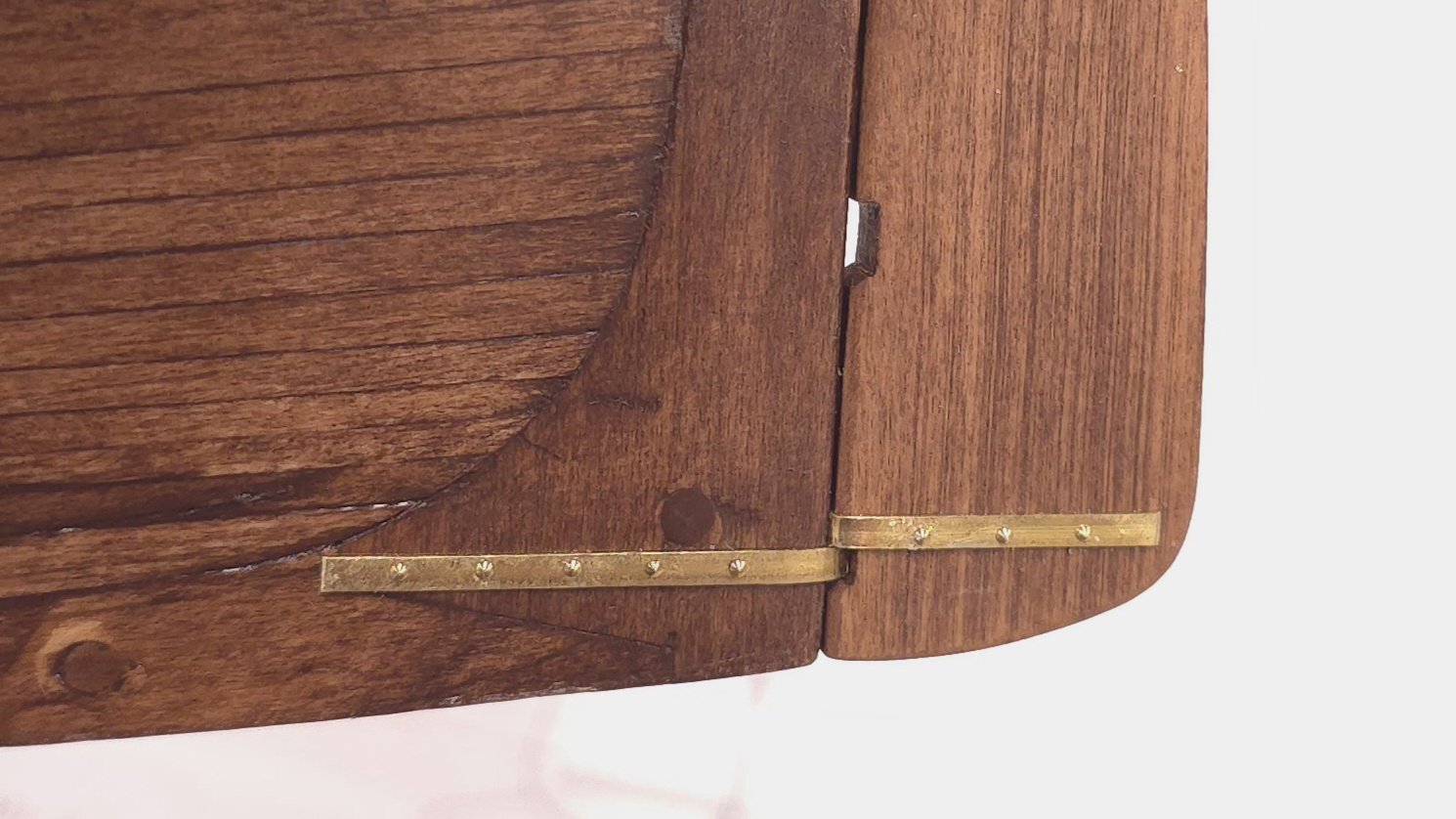

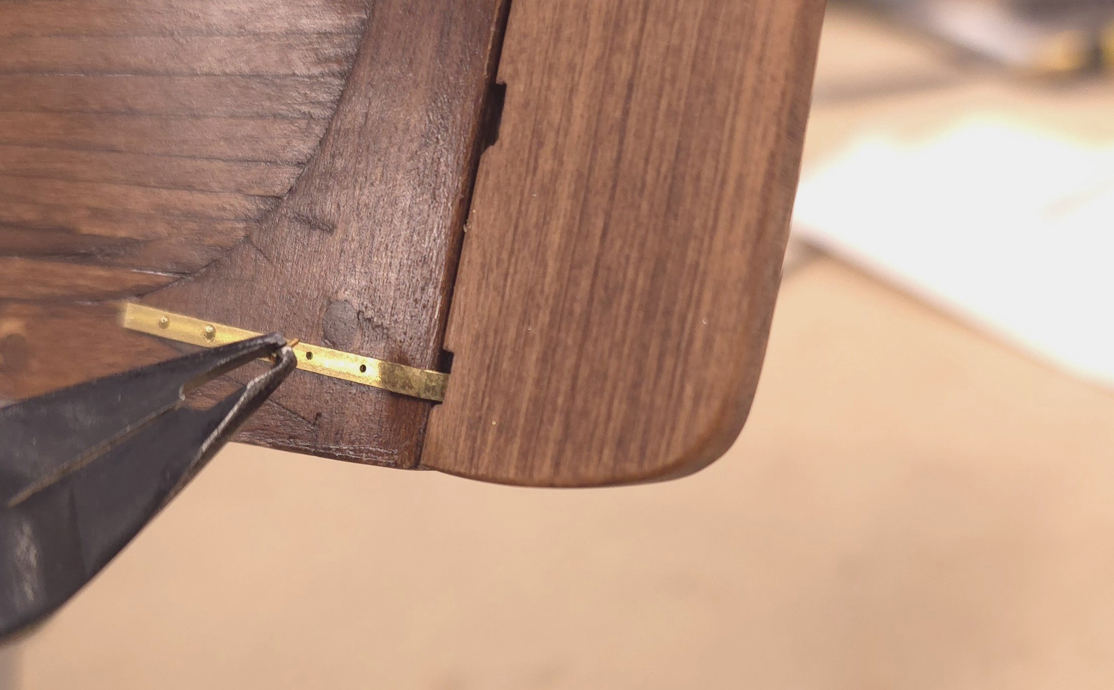

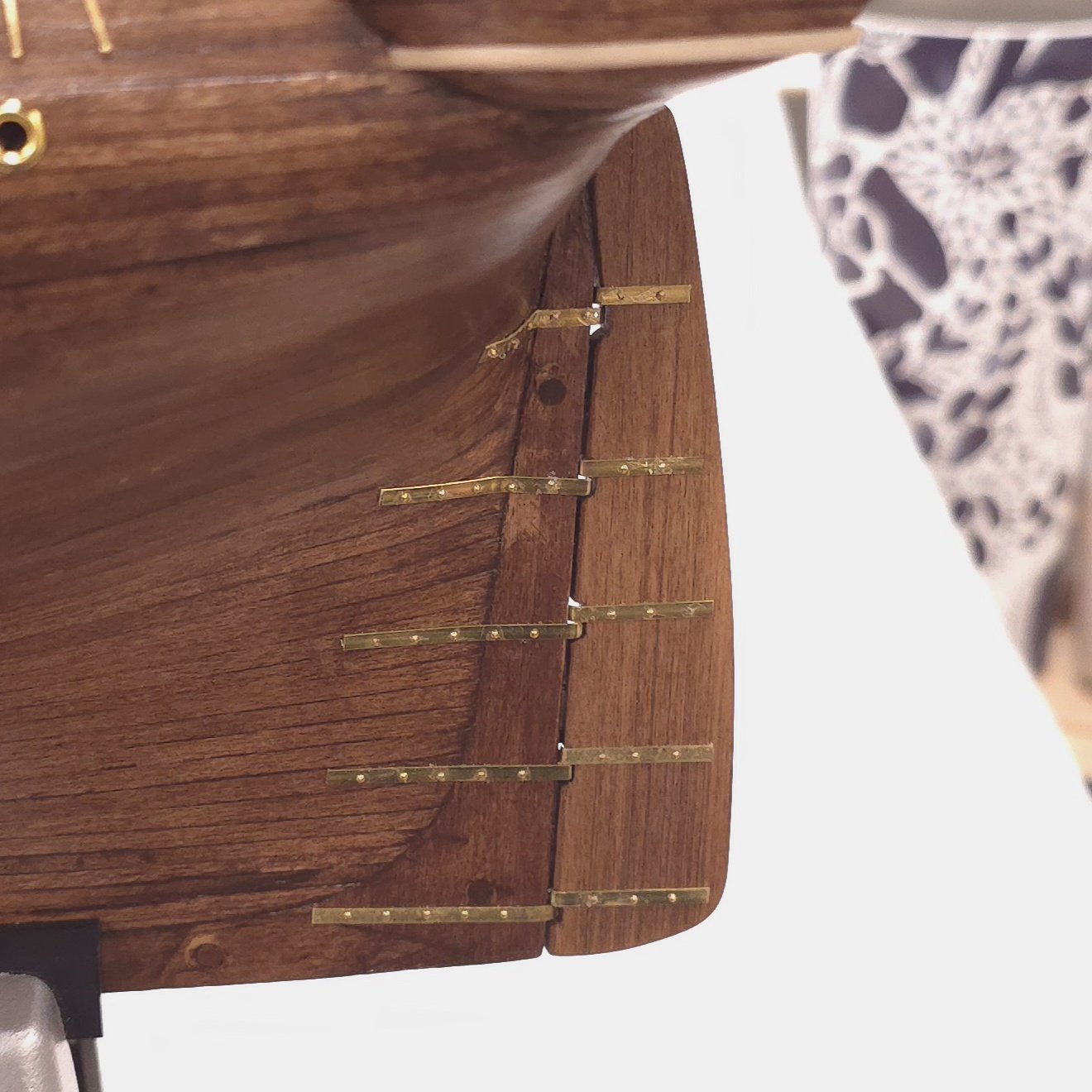

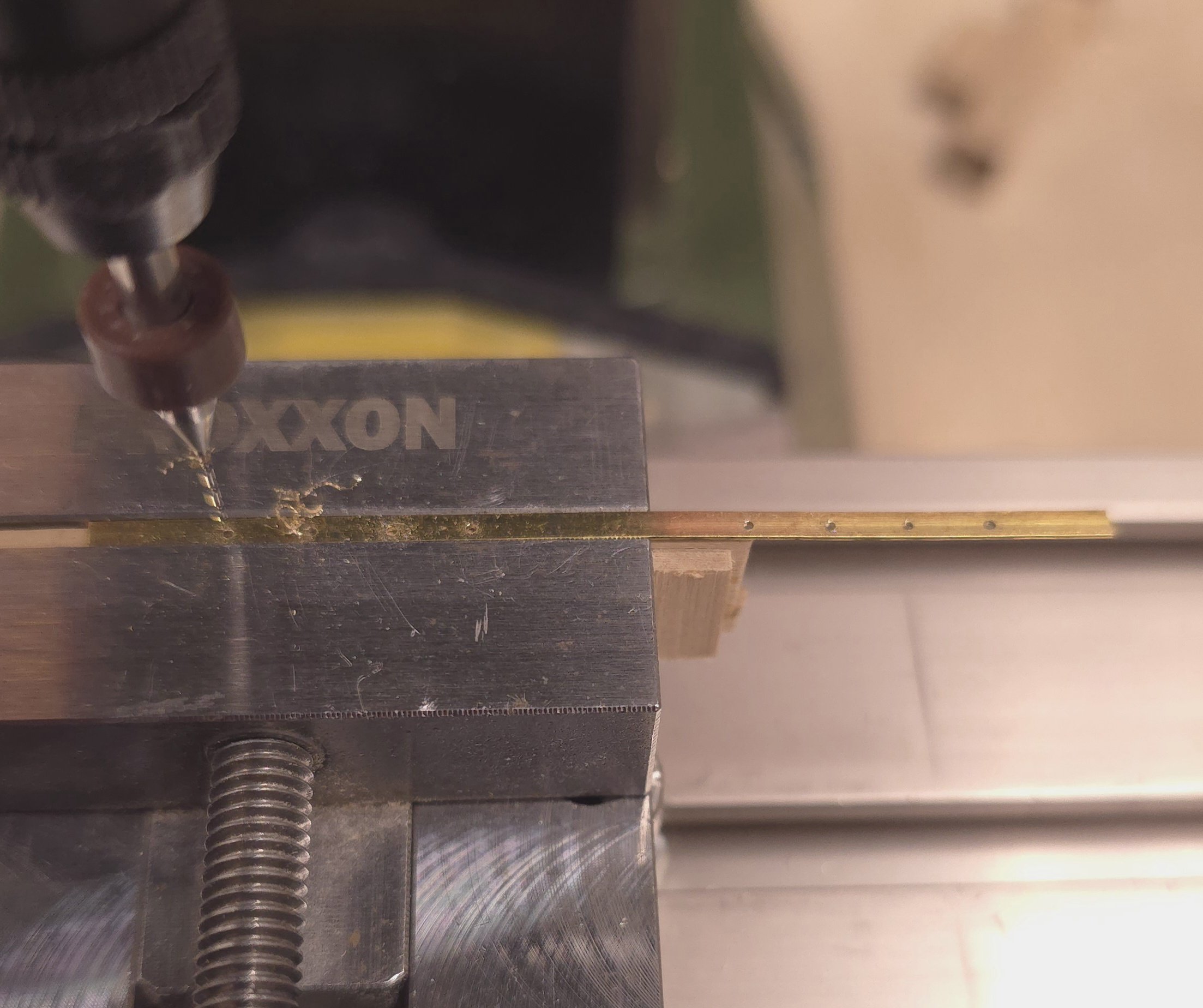

Okay, no glue. Well, except for a tiny droplet at the pointy end of the nails I use to secure the gudgeons and pintels to the hull and rudder.
I tried bending some brass at 90°, so I could make a U-shaped piece, but this brass was so brittle that it broke. In the end I decided it didn't matter. Because any pins wouldn't be seen anyway. So I'm taking a bit of a shortcut.
Anyway here's the process.
Added one more picture.

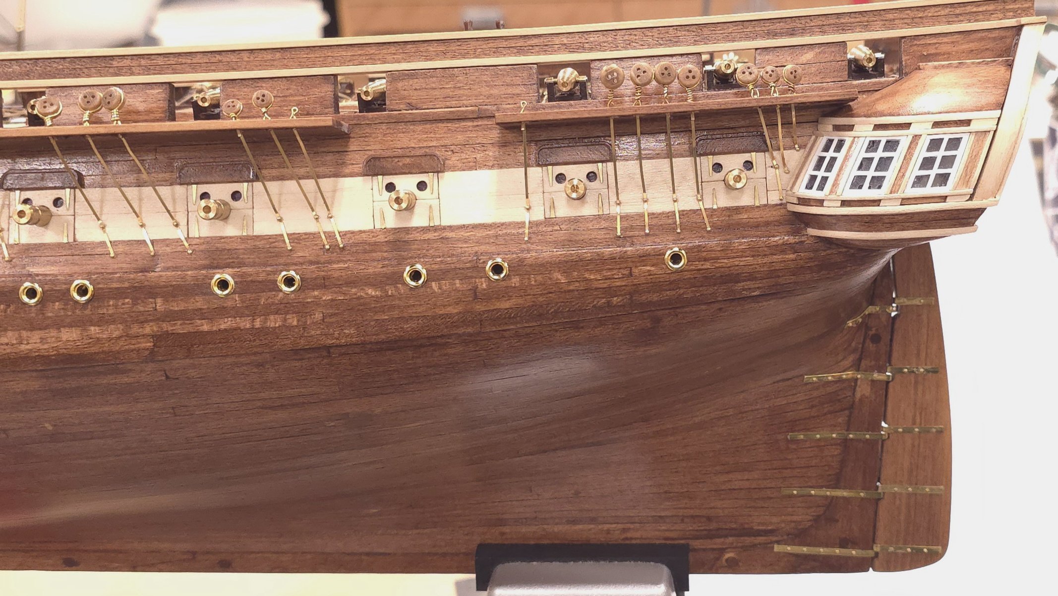

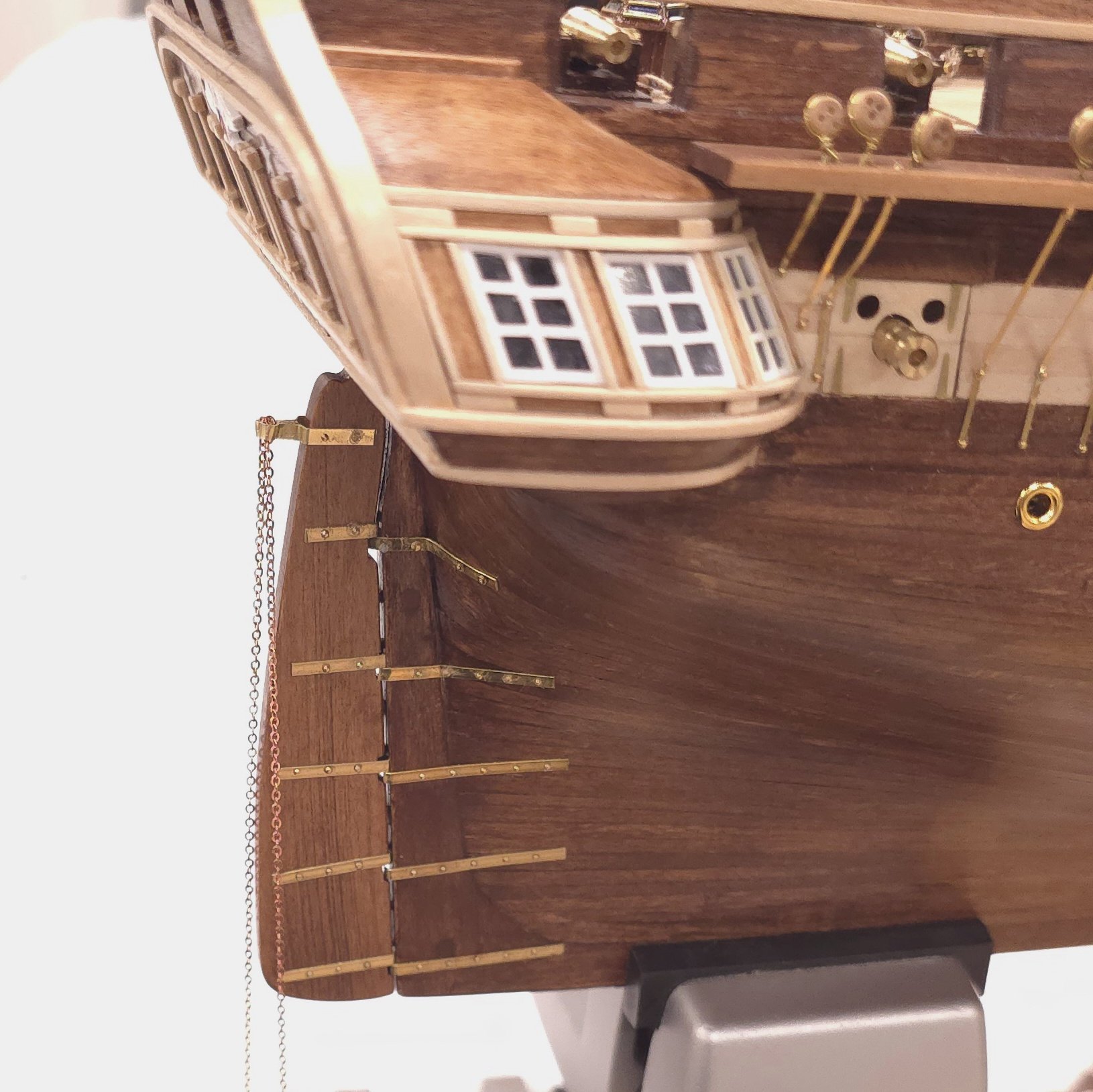

Very nice looking. From what I can see, the rudder will not move on your model, but then again it doesn't have to. It's a static model. I made mine moveable strictly as a challenge of my skills. Once my model is in its display case, my rudder won't move either. You save a lot of work and got beautiful results. Well done!
Jon
Right you are Jon. I never had any intention of having the rudder move. And you're right, once it's in the display case it's not moving, even if it could.
So, when you say you're planning on having yours move, do you mean that you're going to rig things so that you can turn the wheel and the rudder will move?
Port side done..

I think you misread my post. I have no intentions of rigging the rudder to be activated by the ship's wheel. Once the rudder is in position in the display case, that's it, I'm done.😁
Not so much a case misreading, as a misunderstanding -
"I made mine moveable strictly as a challenge of my skills. Once my model is in its display case, my rudder won't move either. "
I was just curious how much  you had challenged your skills.

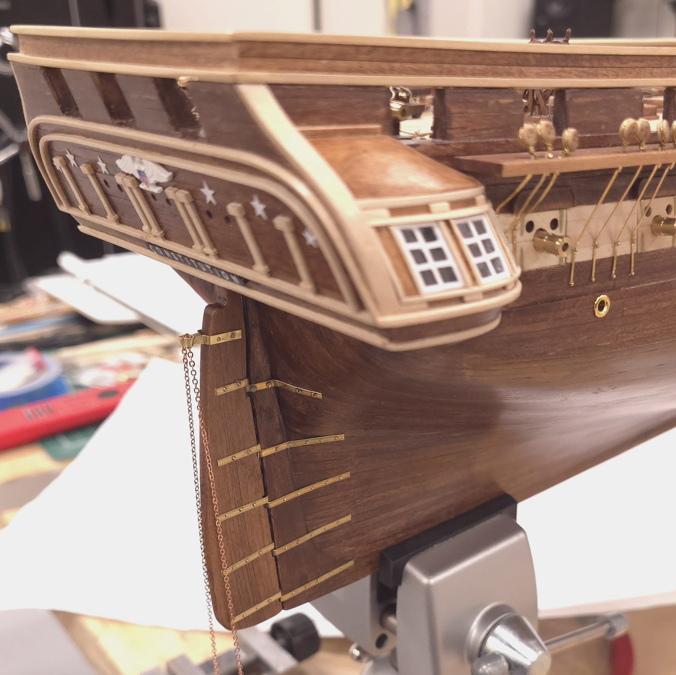

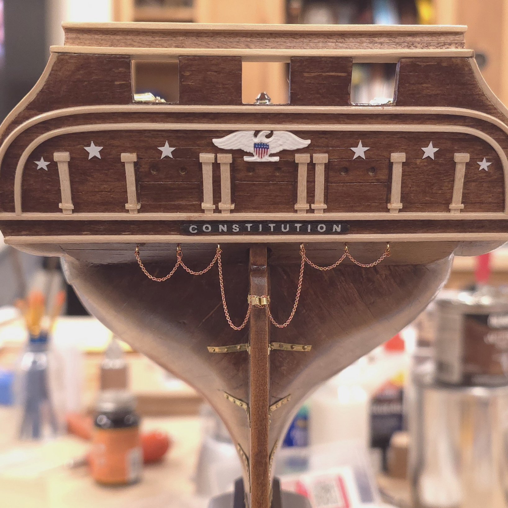

Slow going on finishing up the rudder.  When I started working on the starboard side, I realized that the rudder was narrower than the stern post on that side. So, I had to chisel away enough material to render the rudder flush with the stern post. That meant applying a new coat of stain, which took a day to cure. Then more poly needed to be applied.
I also lost one of the gungeons. I spent a half hour sweeping everything within 10 ft of my chair in the workshop, and cleaned everything off the work table, but couldn't find it. I'm sure it will turn up - someday..  😁
Then I fashioned the chain iron out of another strip of brass. I'm debating on whether or not to invest in a Dremel to make the part the chain fits through narrower. But perhaps not. As Gregg  said, no one is going to be peeking through the glass on the display case with a magnifying glass..
On page 63 in chapter 12 of the practicum, Hunt says that the kit comes with three different sizes of chain. "You will use the smallest size", he says.  The parts list that came with the Constitution does indeed indicate that the kit comes with three different size chains, but I can only find two. Interestingly, the chain pictured on page 64 of the practicum looks to be the middle sized one, which is the smaller of the two I have.  Since I have eye bolts of different sizes, I could use this and be done with the rudder.
To those of you who have done this, did you in fact have the 42 link per inch chain, part number WP0516 in the kit? And, did you paint it black, as Hunt instructs, but doesn't demonstrate?
Once again, in the photos I see that some cleanup will be required.
I did you one better. After I made my rudder, I set it aside in a box to be used later when I was ready to add its hinges. Then I used it to help formulate and fabricate the hinge axial, pintles, and gudgeons. When I was ready to install them on the rudder, I couldn't find the rudder. Now a rudder is not an easy thing to lose. Yet after weeks of looking I gave up because I didn't want to waste more time looking and so I fabricated a new one and installed it as you see it today. Then about a week later, the original one reappeared innocently sitting on my workbench just behind the model. I know I checked the workbench thoroughly and it was gone. Now it's back. A total mystery in the saga of ship model builders.

Looks good to me. Nicely done.
Jon

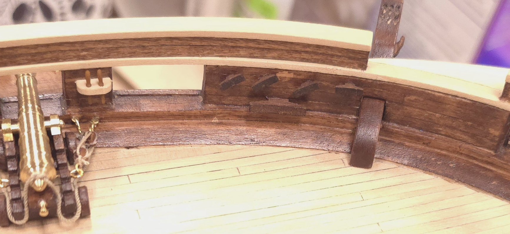

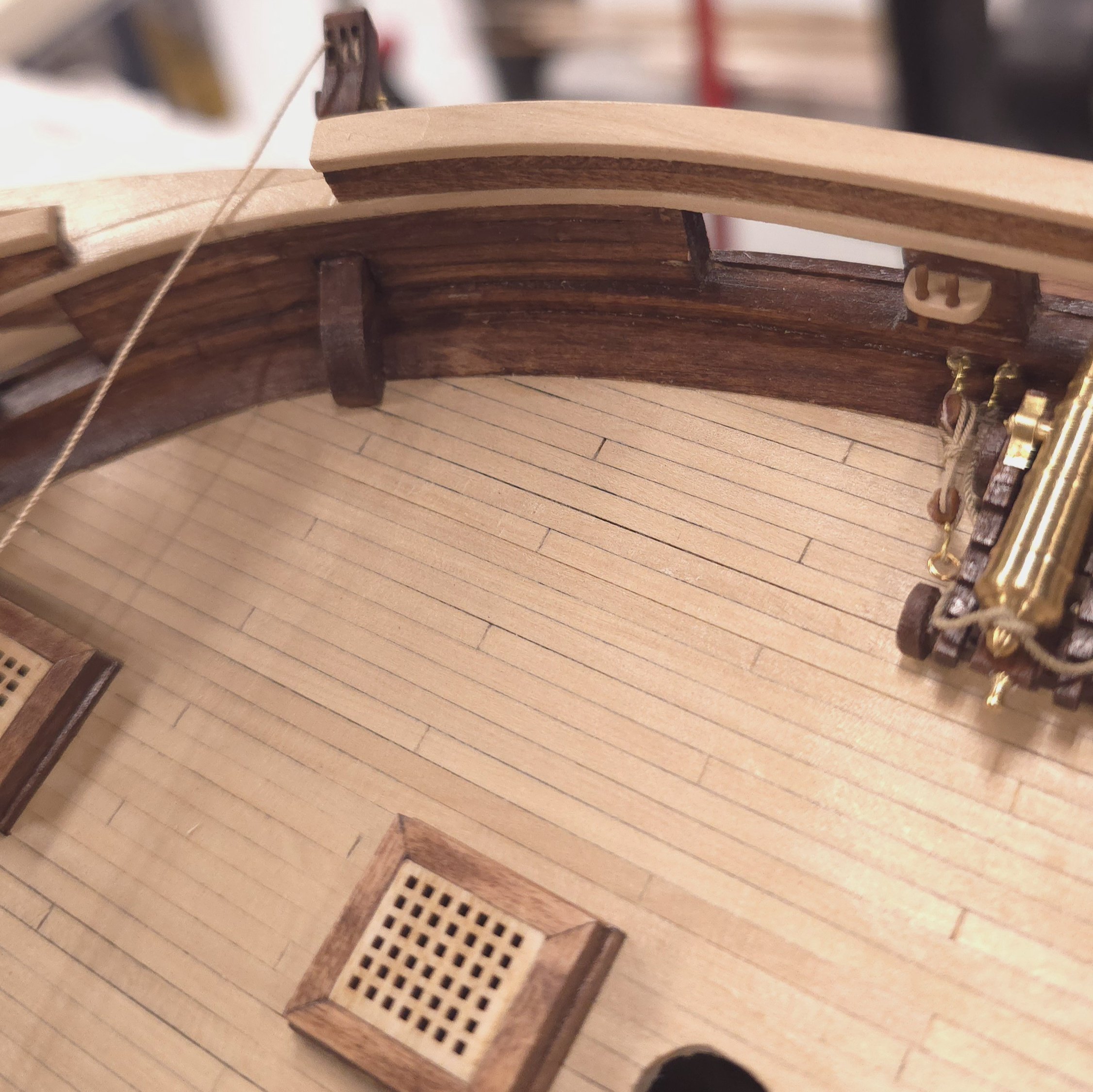

The old gray cells, they ain't what they used to be. It wasn't until I was looking for the cleat to tie the anchor rope to, that I realized I didn't have any.  Somehow, I only installed cleats at the stern half of the model. So, yet another delay in finishing up the hull.
I did sort of enjoy stropping hooks to two triple blocks, nothing like a stroll down memory lane..
But, I'm calling it quits for now, going home to bake Christmas cookies. (In part, because I also learned that I forgot to stain the bulk of the cleats. I remedied that just now. Since it will take a  while for those to dry as well, I'm off to do help the Admiralty with holiday preparations.)
