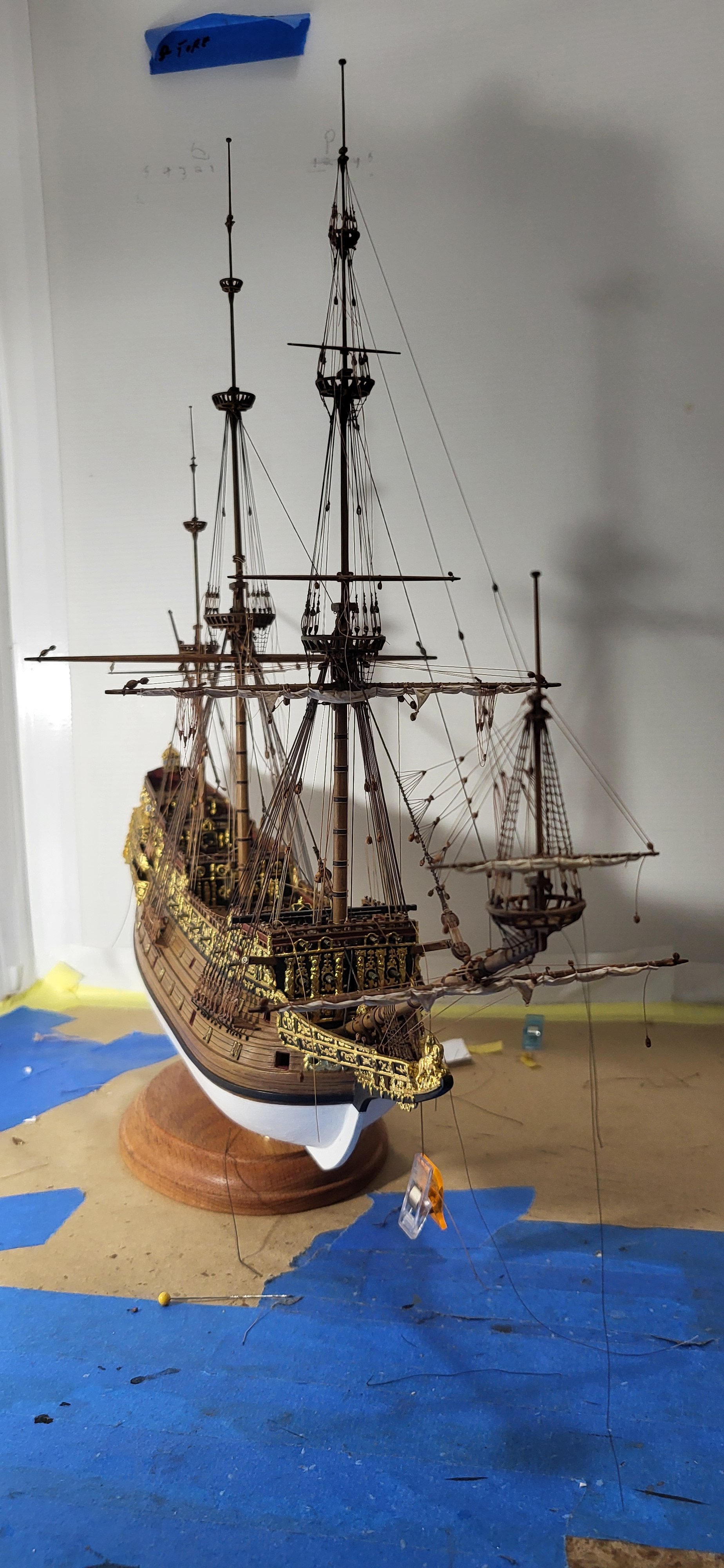

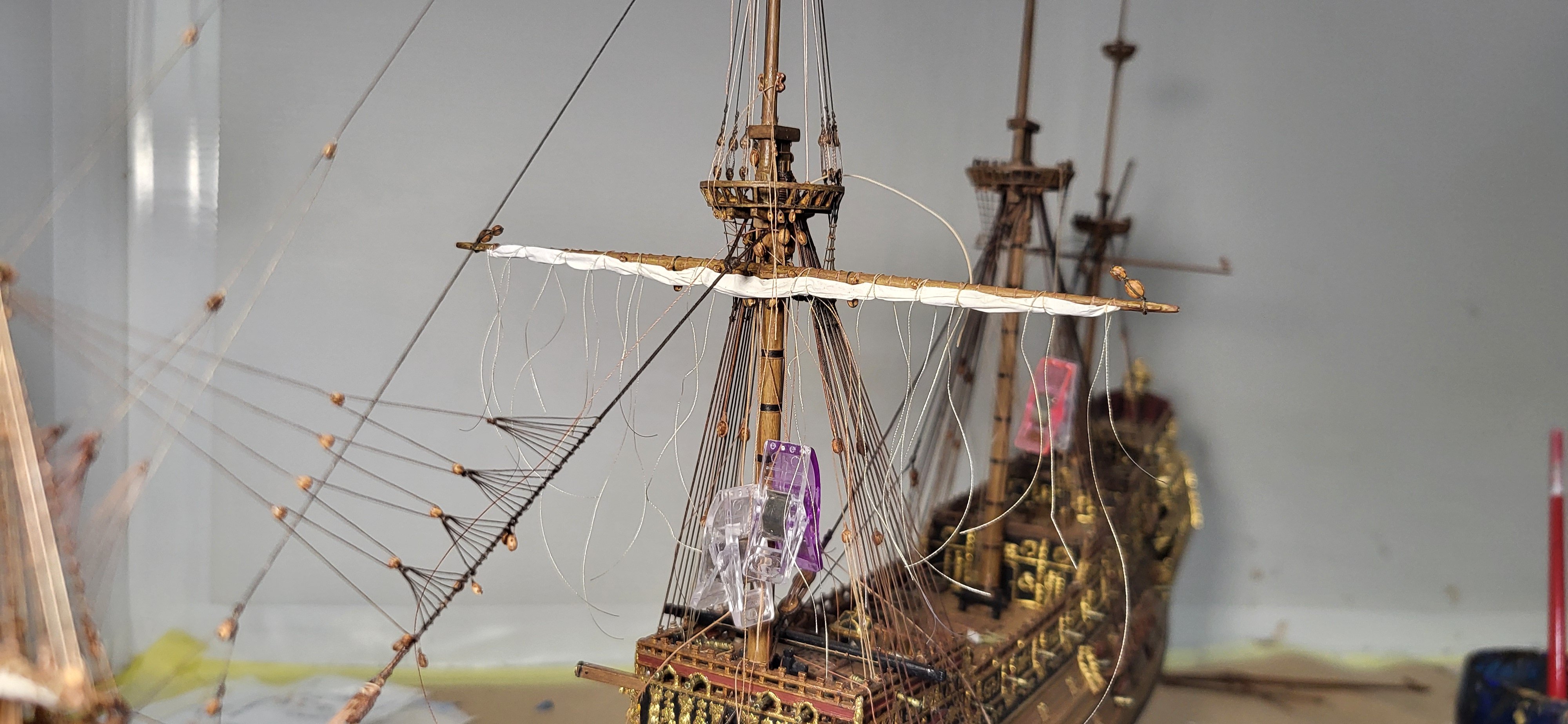

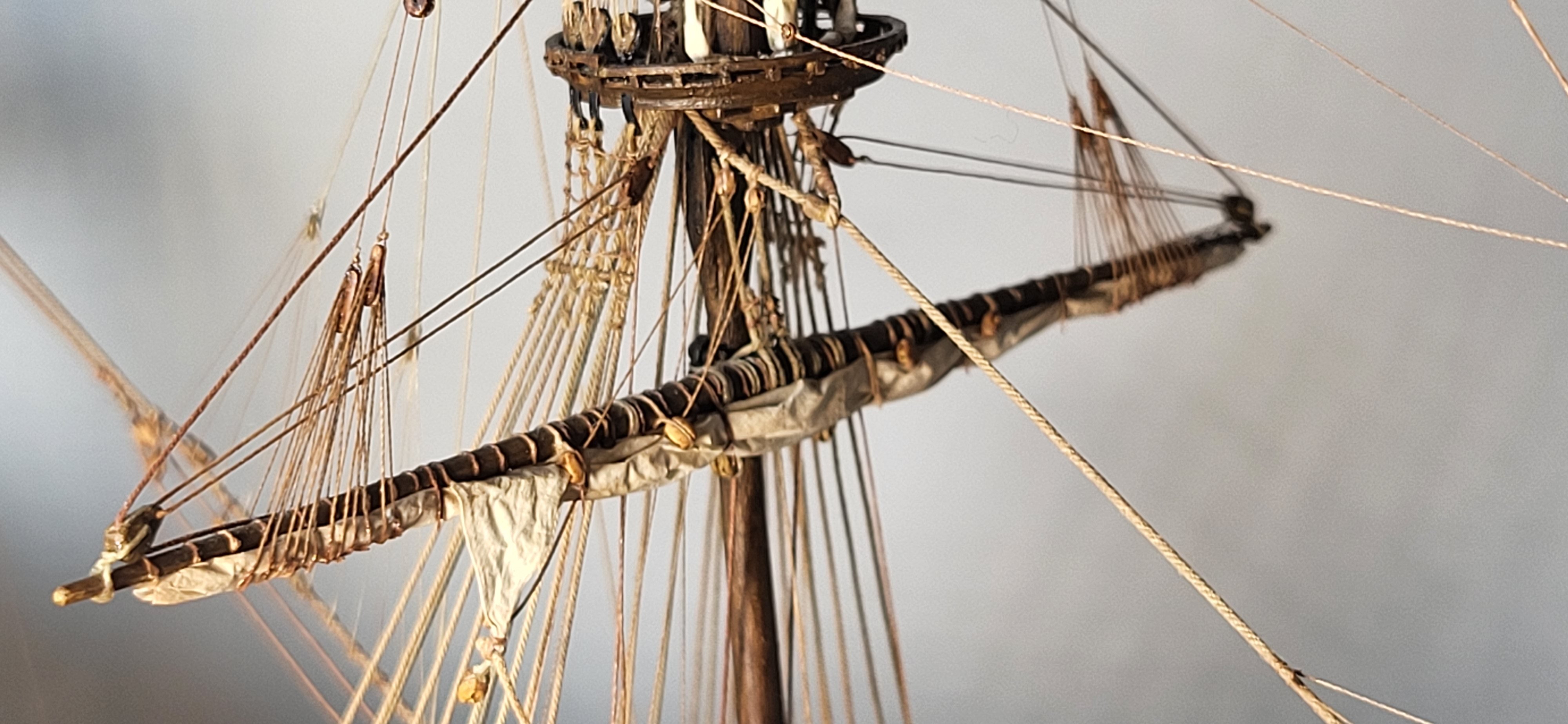

Work of the fore course continues with the rigging of the buntline blocks and the furling of the sail, I still to manipulate it some and tone down the white before finishing up the gaskets but looking good so far. My plan for the martnets is to let them hang down below the yard instead of drawing them up tight above the yard like I did on the Vasa, this will be quite the challenge.
Michael D.

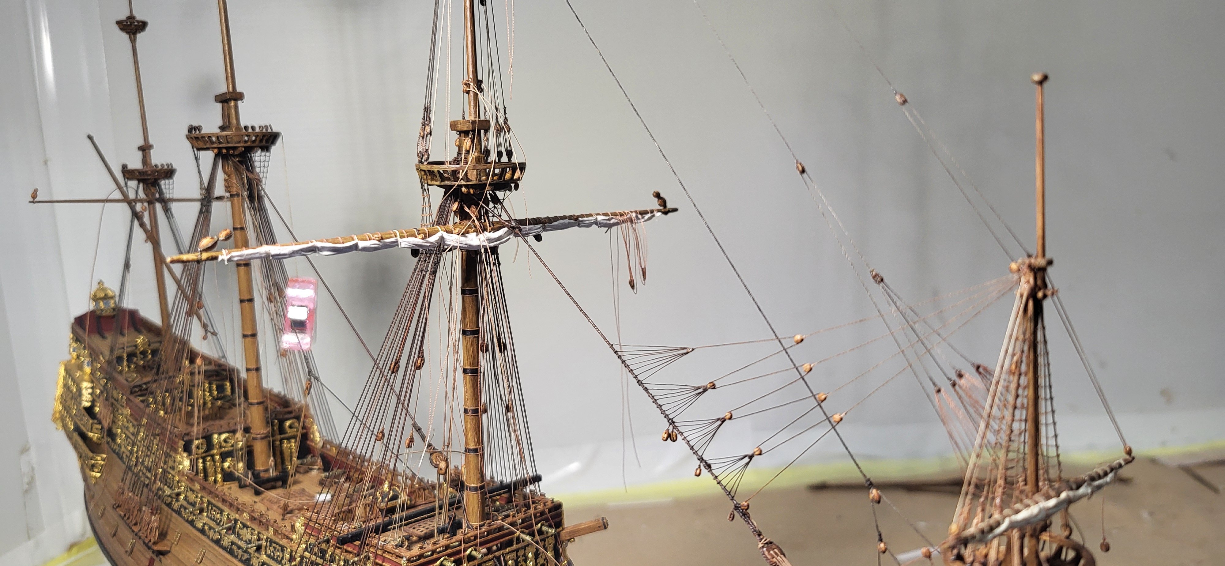

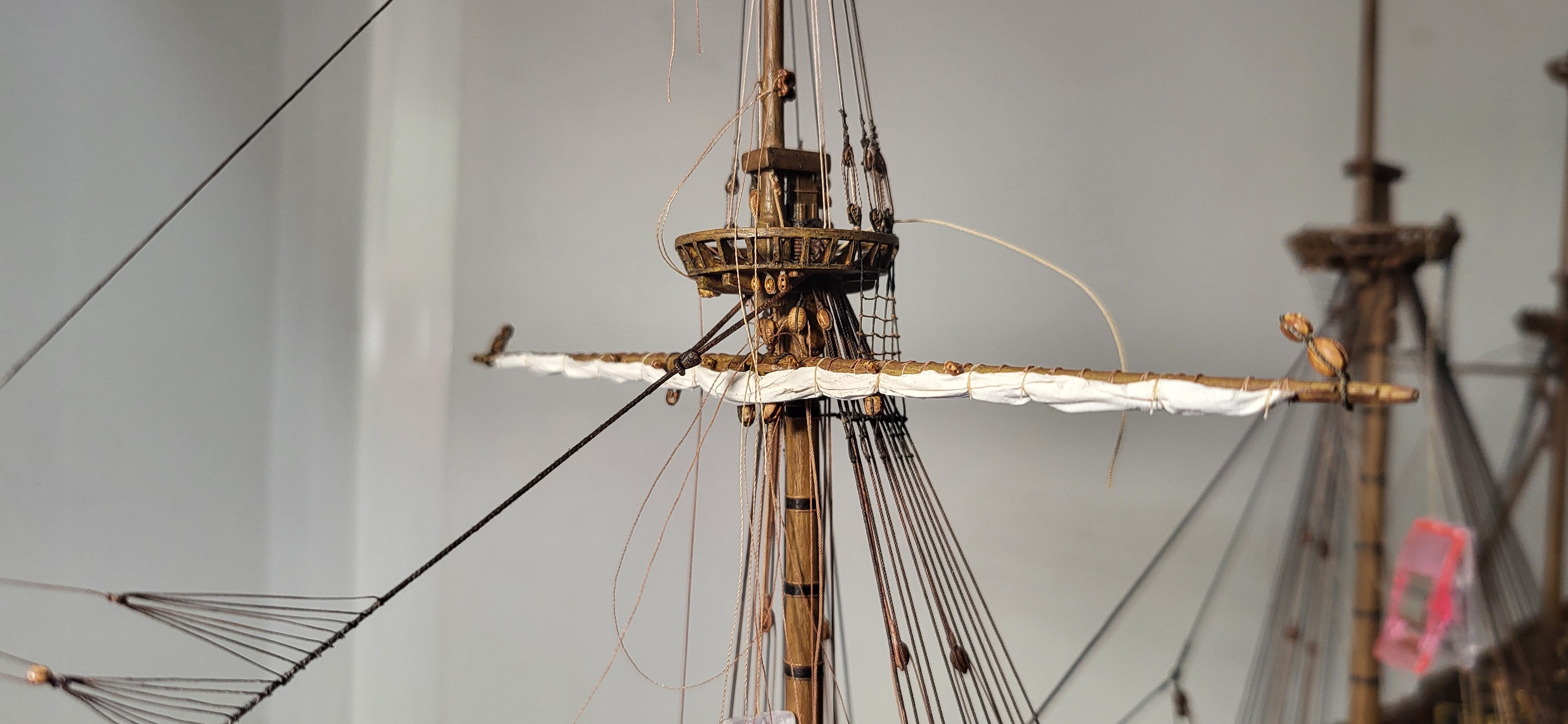

The furled sail is for the most part completed along with mocking up the rigging of the single jeer, next I'll be working on the sprit sail yard while I figure out the martnet situation. Thanks for looking.
Michael D.
You have a very nice representation of the sails!
There's more than one way to furl a squaresail and I'm not sure how it was done on English warships in the mid-17th Century -- though the (unreliable) Payne engraving shows the royals drawn together into a vertical, tube-like bundle ahead of the mast, which is a known technique of later decades. That source also shows the furled main course much as you have the fore course on your model, with sheets and tacks (hence the hidden clews) near the quarters of the yard. Maybe that wa show it was done but, through the 18th and well into the 19th, the clew garnets and clewlines pulled the clews up to the slings of the yard. When the sail was furled, the two clews (with their multiple blocks and general bulk) were hung outside and forward of the furled bunt of the sail. I don't know whether you should (or could) represent that but worth thinking about before you add the other sails?
I can't suggest how you handle the martnets. Their elegant draping shown in the Peter Pett portrait does look lovely but would be hard to reproduce in a model and does not look very practical at sea.
Trevor
Thanks Trevor,
I will attach the clue of the sail later on and still undecided on the martnets, I might just rig them as I did on my Vasa with 2 per side instead of 4 and I think will look fine as in this picture.
Michael D.
Nicely shown! But you have interpreted the martnets as brails, gathering the sail from both sides. I have supposed (perhaps wrongly) that they were like buntlines, pulling the edge of the sail to the yard across the forward face of the bunt. It would make a big difference when furling, as there would be no easy way to fist the canvas into a "skin" when it was gathered up tightly by a brail.
But maybe the idea of forming a weather-tight "skin", with the rest of the sail inside, was a later development.
Trevor

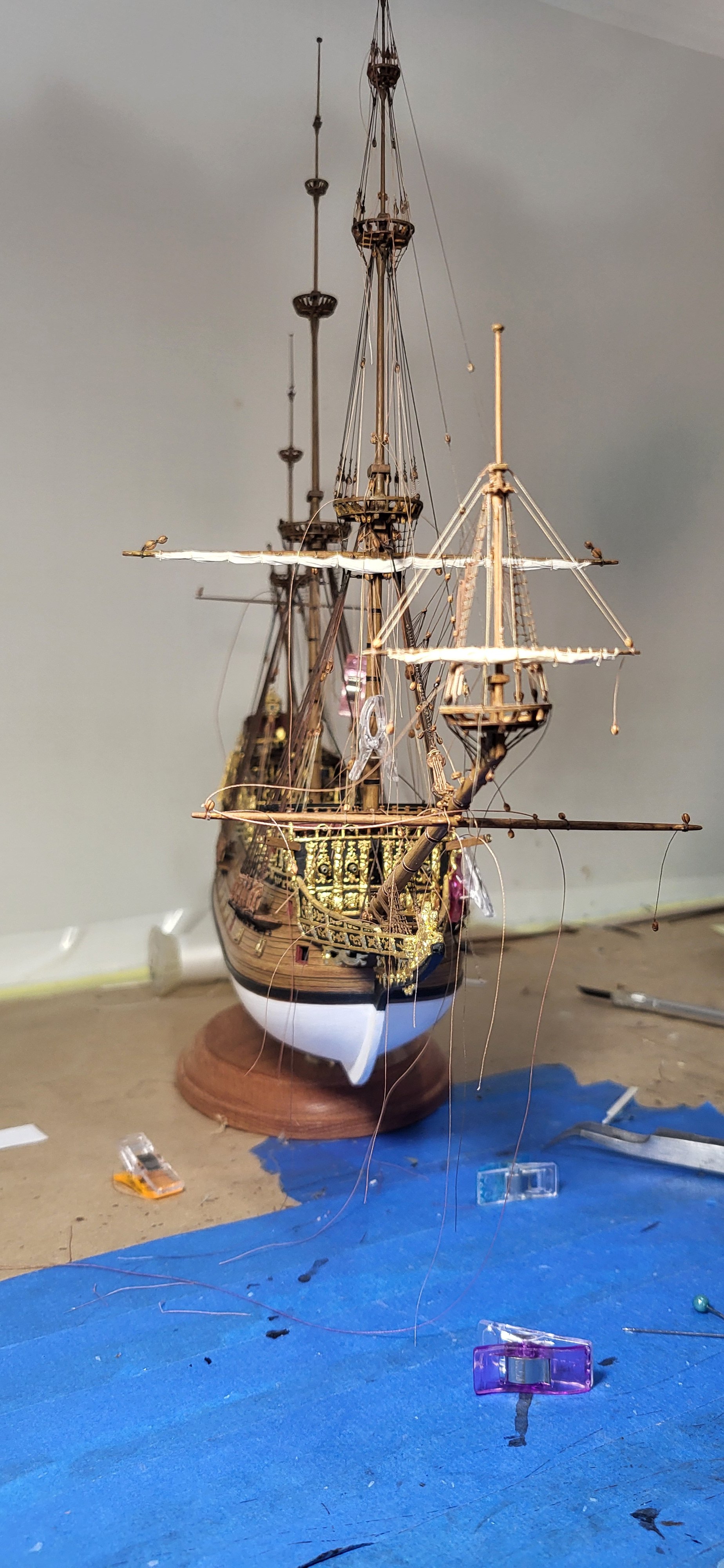

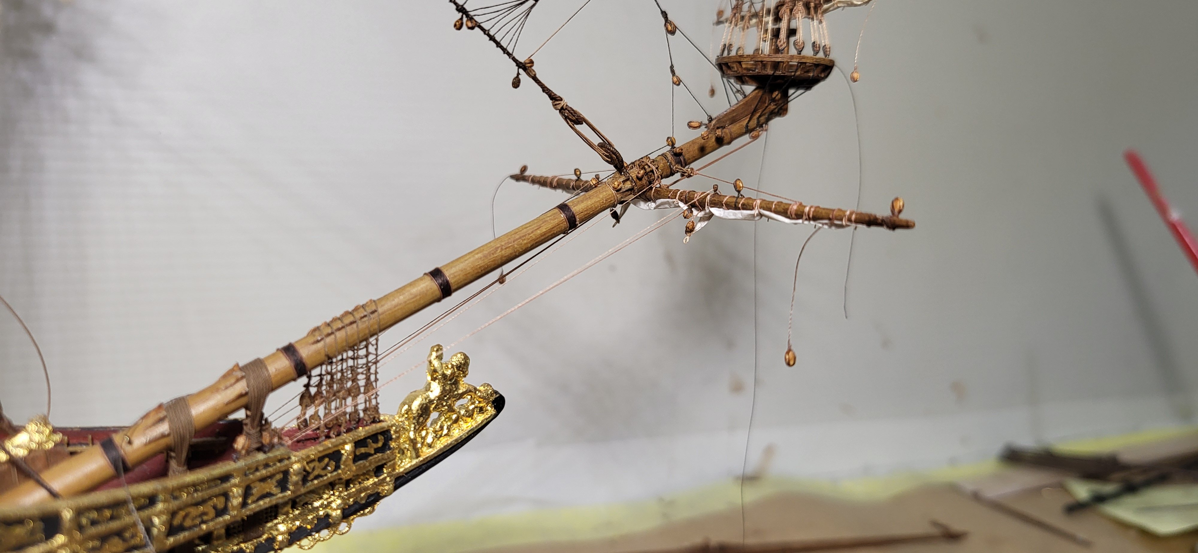

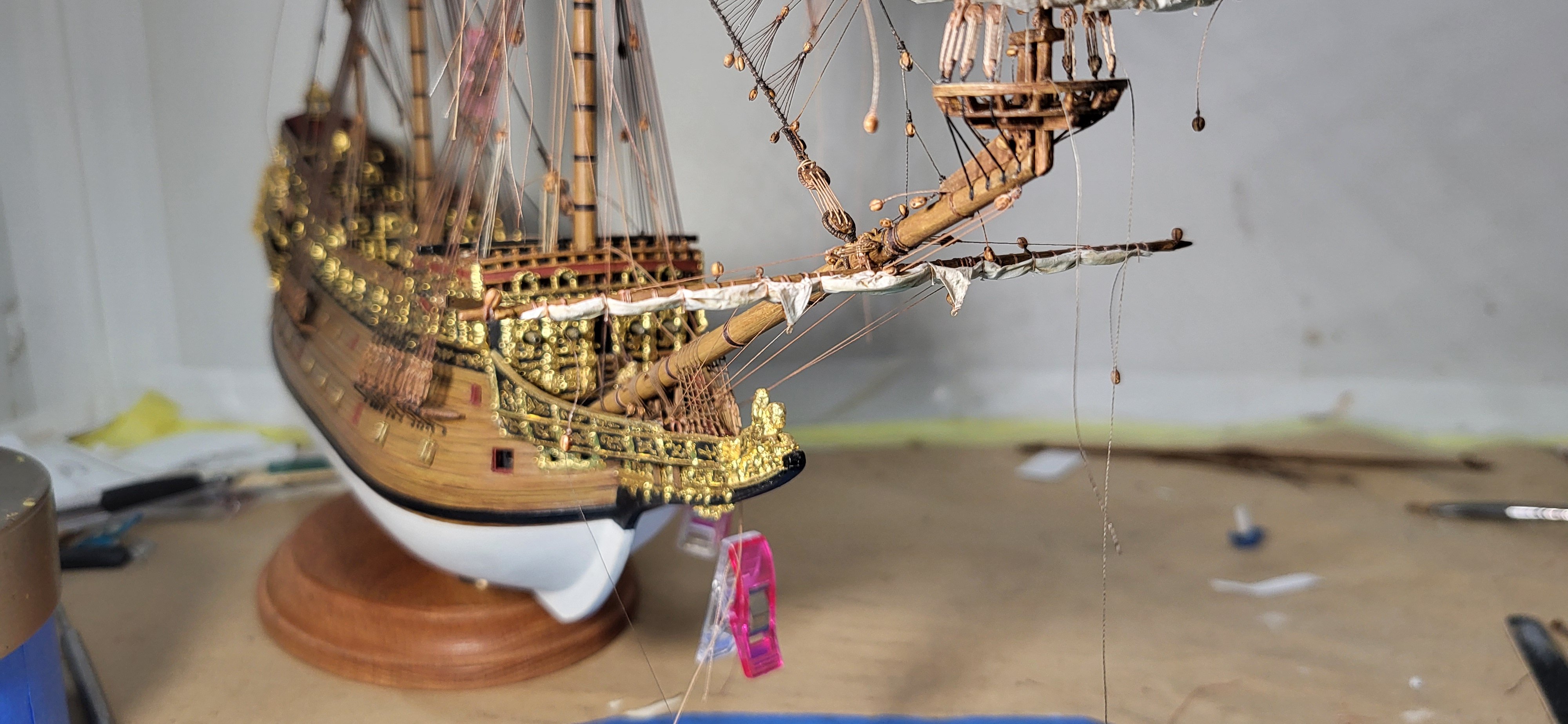

The spritsail is bent to the yard and furled and the yard attached to the bowsprit, still much fine tuning and rigging left to do but at least it's one less loose piece floating around.
Michael D.

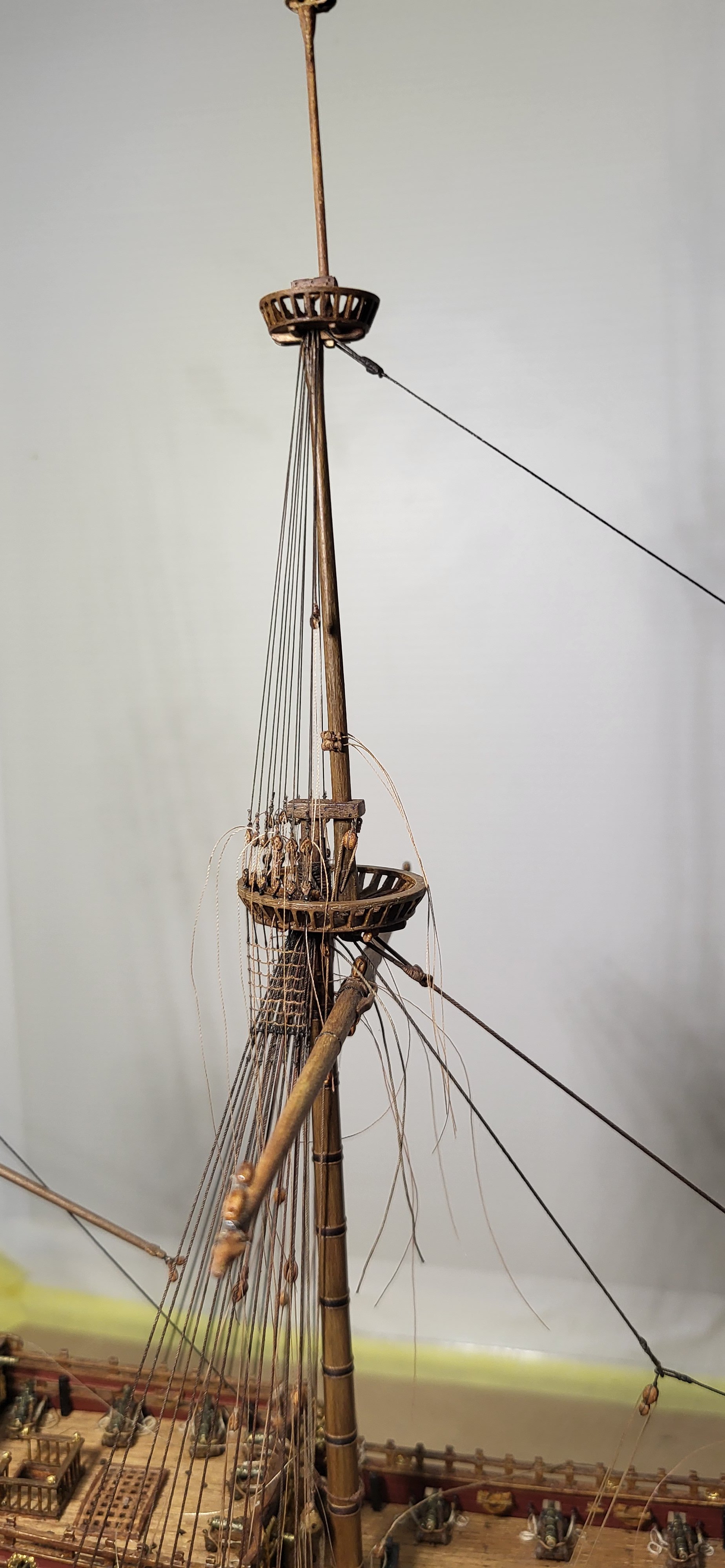

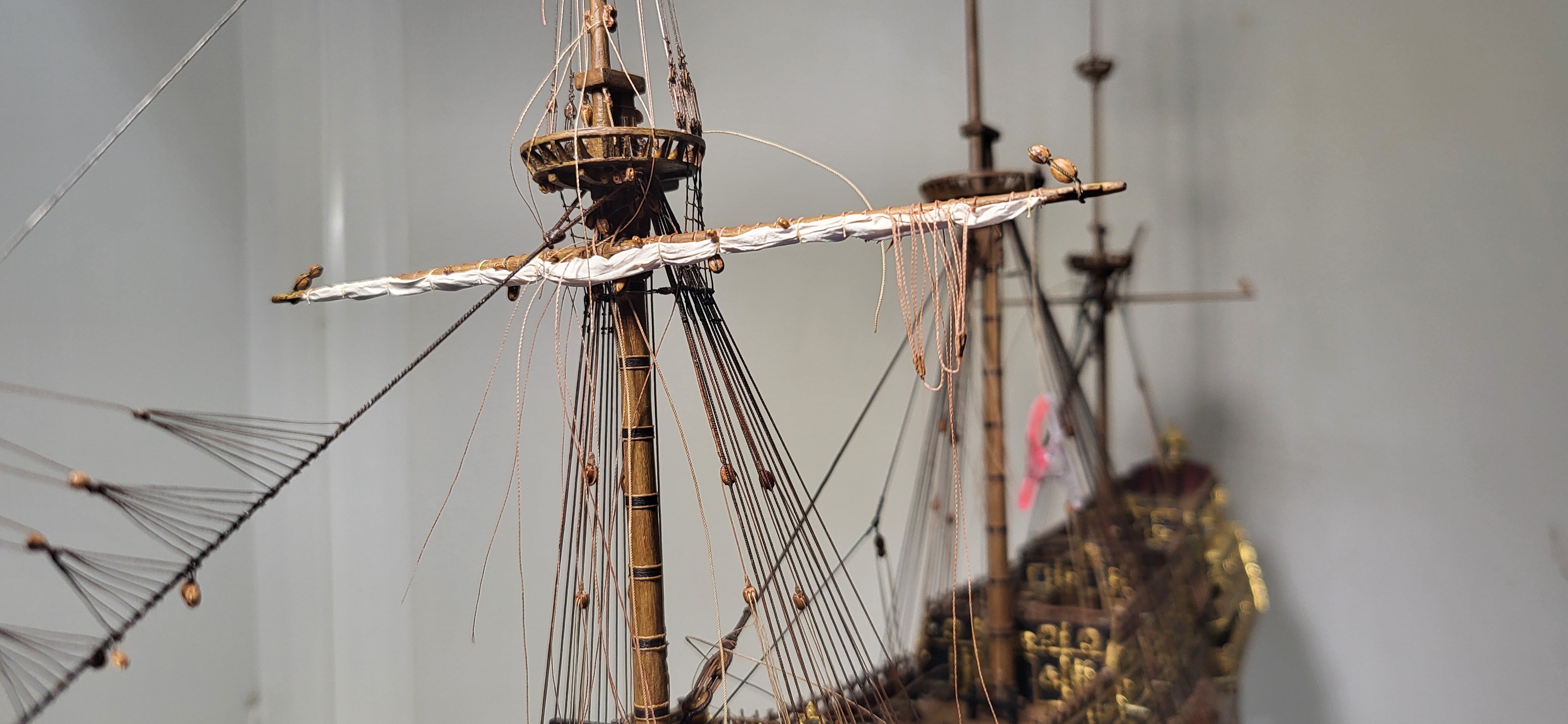

Small update, I've rigged the halliard which is lead to the range and working on the standing lifts void of any knots, sometimes these have knots according to Lee's, anyways thanks for looking.
Michael D.

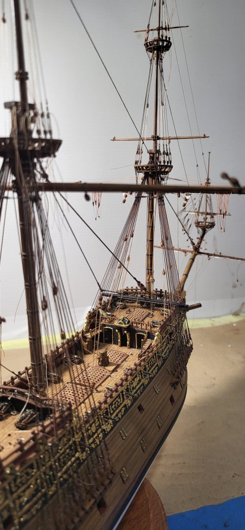

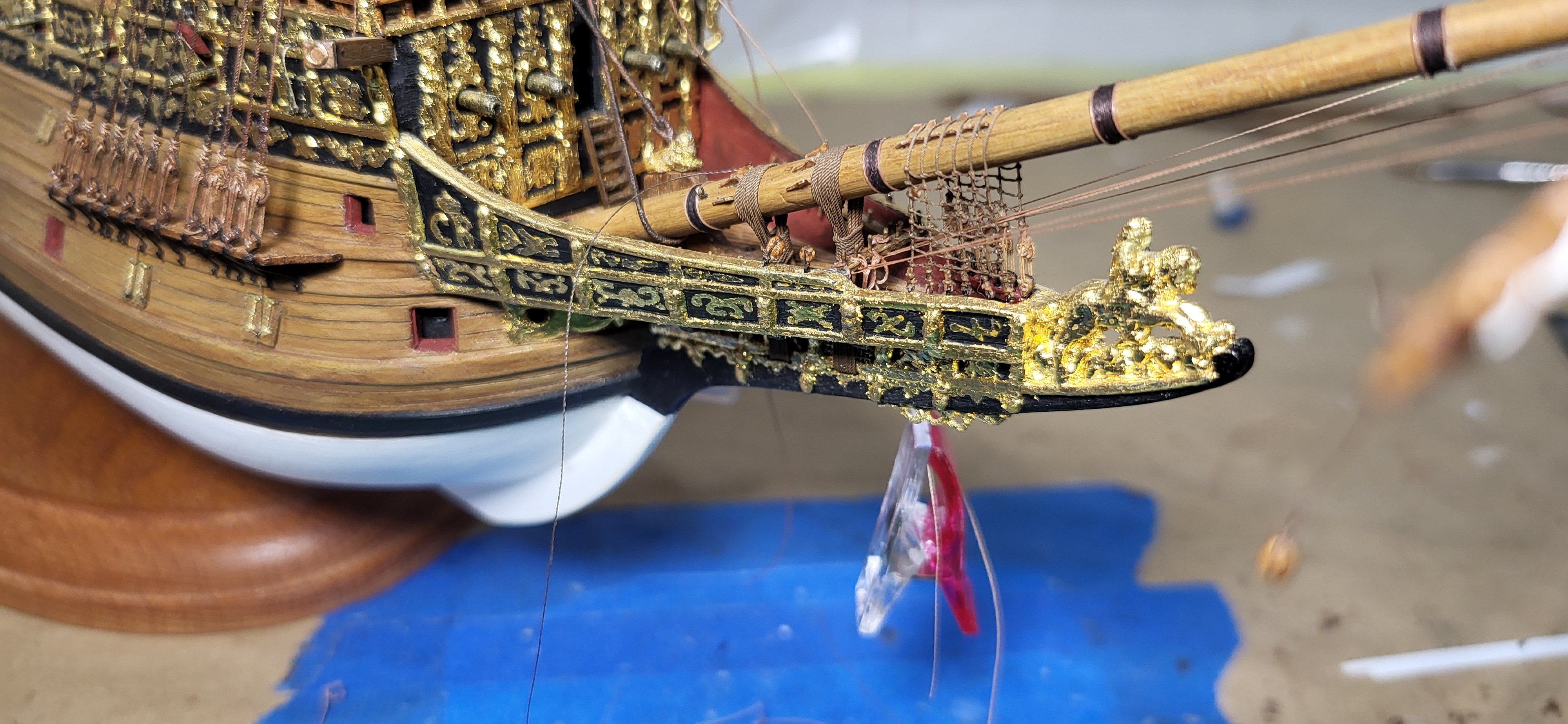

A bit more progress on the spritsail rigging, I've attached the clews, rigged the clew lines and the 3 buntlines, all of these are led to the range and belayed. As much as I want to continue in this area, I need to shift my focus on attaching the fore course yard as the remaining rigging will be in the way.
Michael D.
The port side martnets are completed and challenging to say the least, the crow feet on the fore side was straight forward feeding them over the sail and trimming them on the back side once the glue set, for the aft side I just cut to length and tucked them up to the underside of the yard, I wasn't too concerned about all the crow feet being taught as I suspect there be some loose ones during the gathering of the sail.
The bridle in reality is one piece, but I faked it by passing to two ends thru a bulleye in opposite direction, glued then snipped the ends, I did the same thing with the legs running thru the sister block, once the yard is set the fall will start at the stay collar, thru the sister block, thru a block on the collar and down to the deck.
Thanks for looking.
Michael D.

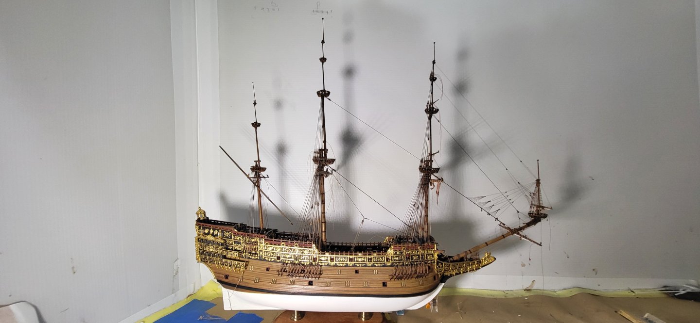

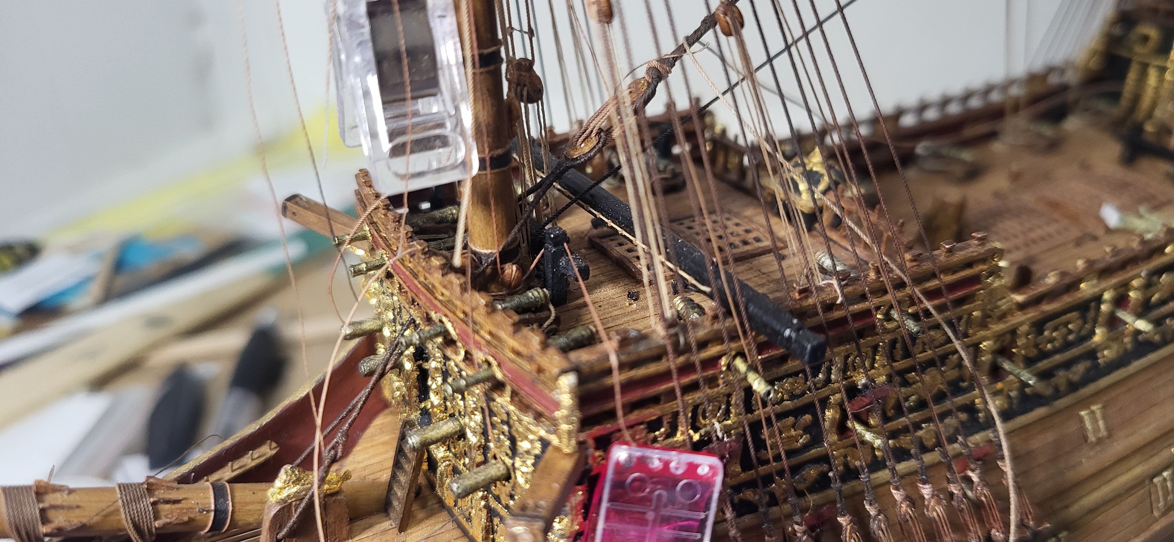

I've rigged the single jeer using .30mm line that's led to base of the mast, thru a single block and will be belayed to the bitts. The lifts are rigged using .25mm line, the standing part at the stay collar, thru the blocks and down to the deck belayed at the caval.
The fall for the martnets is 100wt thread with the standing part at the stay collar, thru the sister block, maybe should've been a shoe block but oh well, thru a 1.5mm block on the collar and down to the forecastle rail, once I complete the port side, I need to focus on the main topmast shrouds and stay as this is led to the tackle at the base of the fore mast. Thanks for looking.
Michael D.
