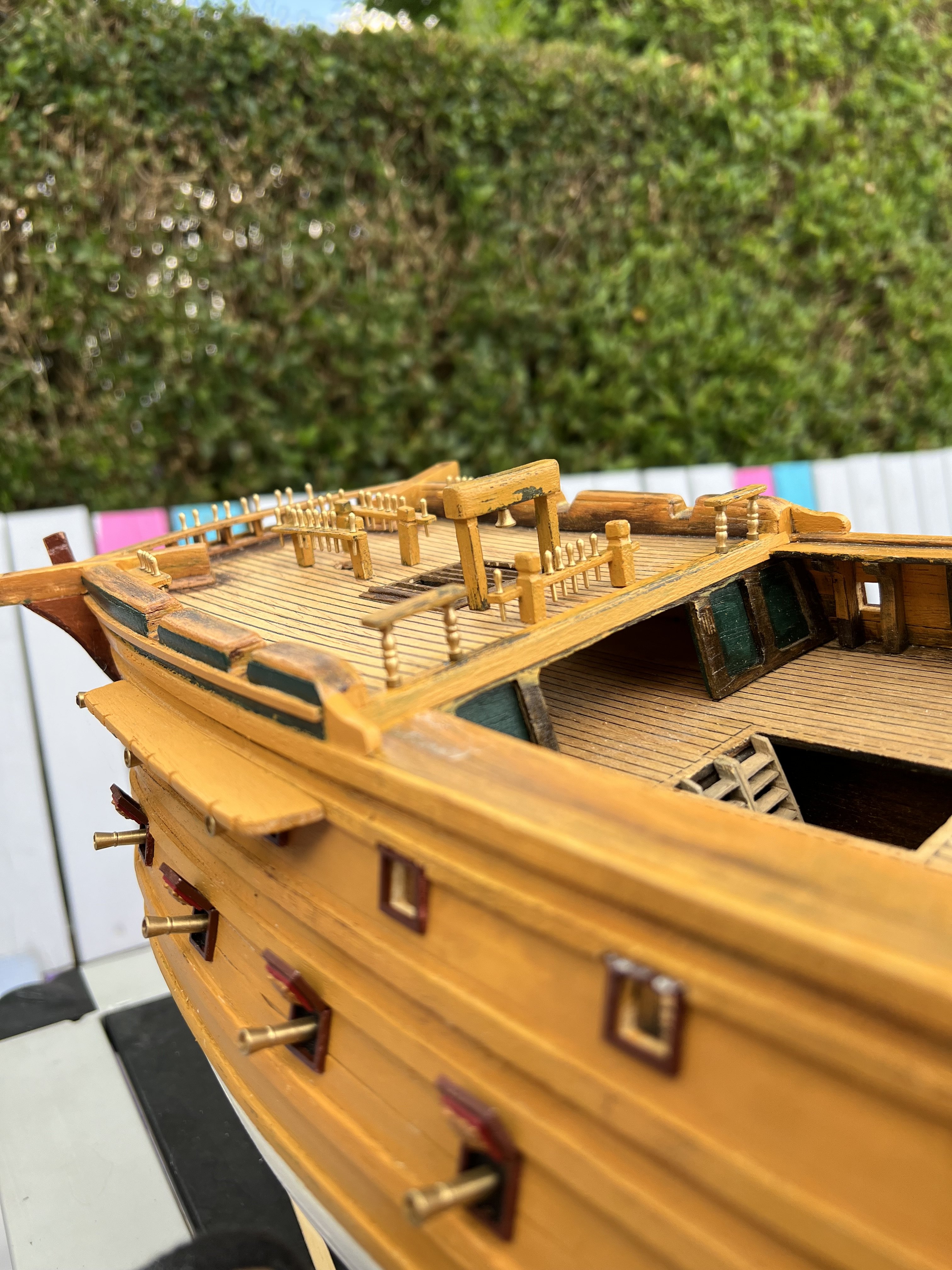

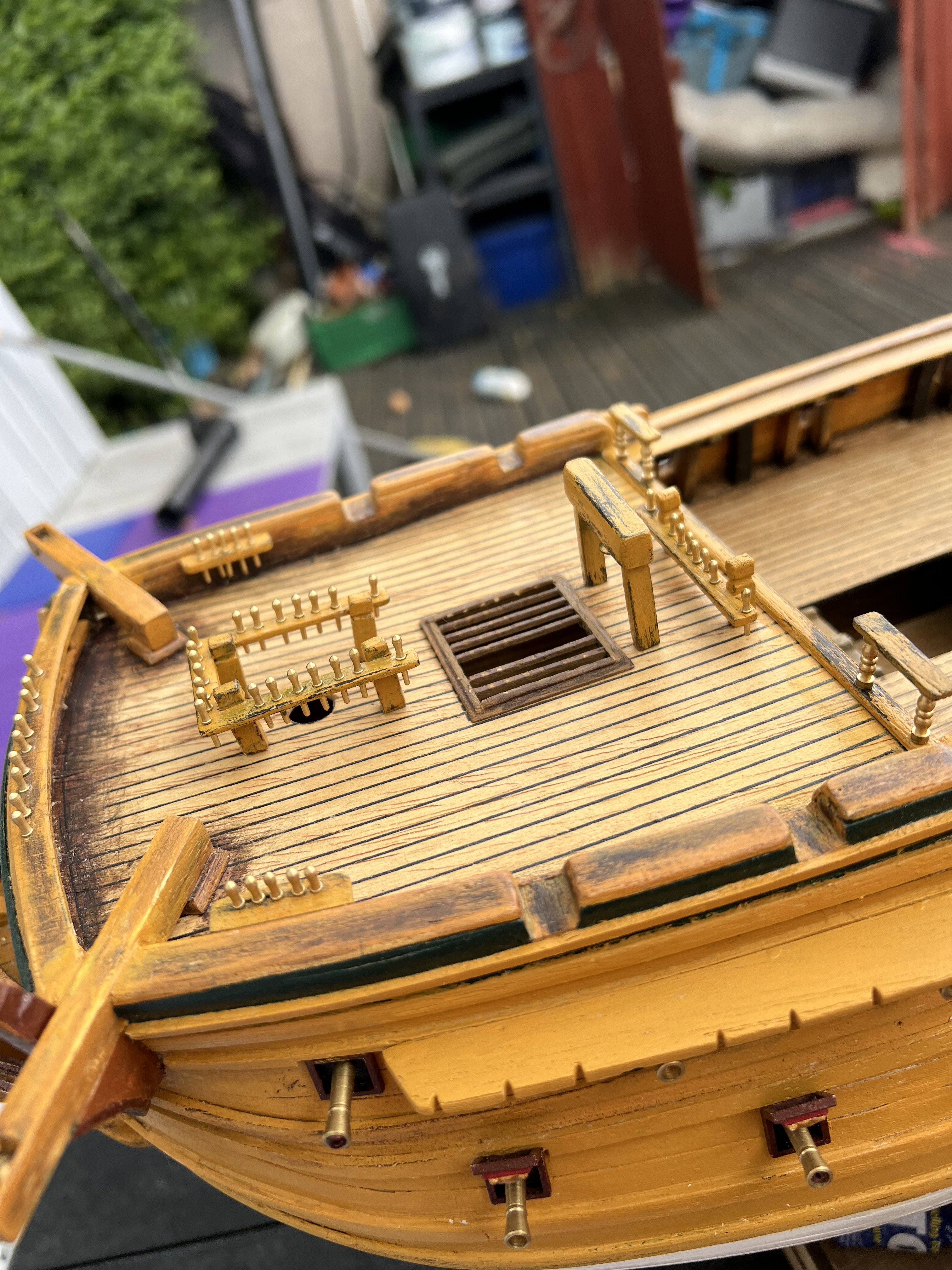

Continuing the work on the bow of the ship. So theres some gun ports that I need to make for the forecastle? (working on my boat terminologies). I did this for the length of this front deck, however, as you can see on the later photos this was a mistake. I needed to leave a gap for the large wooden support which later holds the anchor. I measured and cut the hole. I seemed to get away with the mistake. There was a couple of holes under the anchor support thing, but I filled it up will filler and painted. This blended everything in really well. I then varnished over the top.
If you’re able to give my Instagram account some love, they’ll be pretty amazing!
https://www.instagram.com/byron_dockyard/
Thank you for checking this out.
Daniel
UPDATE 12
I’ve been working on the front of the ship these past few weeks – as well as fighting off a sickness bug and decorating the bedrooms before the weather changes.
-          So, trying to learn some ship parts. Cathead and Hawseholes. Let’s see if I use them correctly!
-          I’ve been working on the Bow of the ship. I’ve filled in some gaps in the wood with putty and painted over. The colour seems rather ‘yellow’ on the photos, although in real life the colour is a little paler, I think the light I used did this?
-          I couldn’t find the name for the brown thing with gold trim. It was supposed to be gold. I altered it slightly.
-          Just above, the green barrier with gold trim (does it have a name?). This was made using planks for the side of the ship. Some photos of models have them, some don’t? It tidied up the bow having it, so I thought it was worth the time making them. I attached the trim on the top and bent it into place using the ol’ plank bender.
-          New word! Cathead! Which are the two beams leaving the Forecastle which will hold the anchor. I filled in the gap between the brown thing with gold trim. Then painted it a lighter brown. I put a pin in the end of the Cathead.
-          A little bit of the paint needs touching up. It’s my intention to come to that and then varnish.

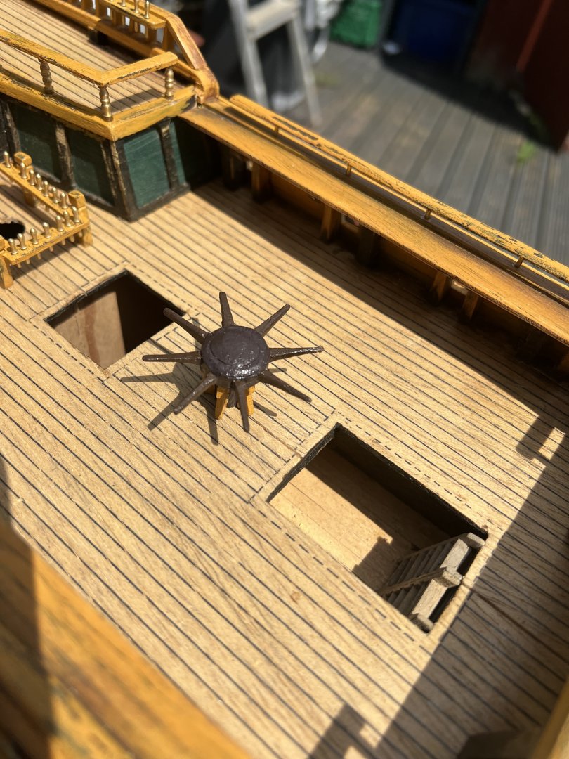

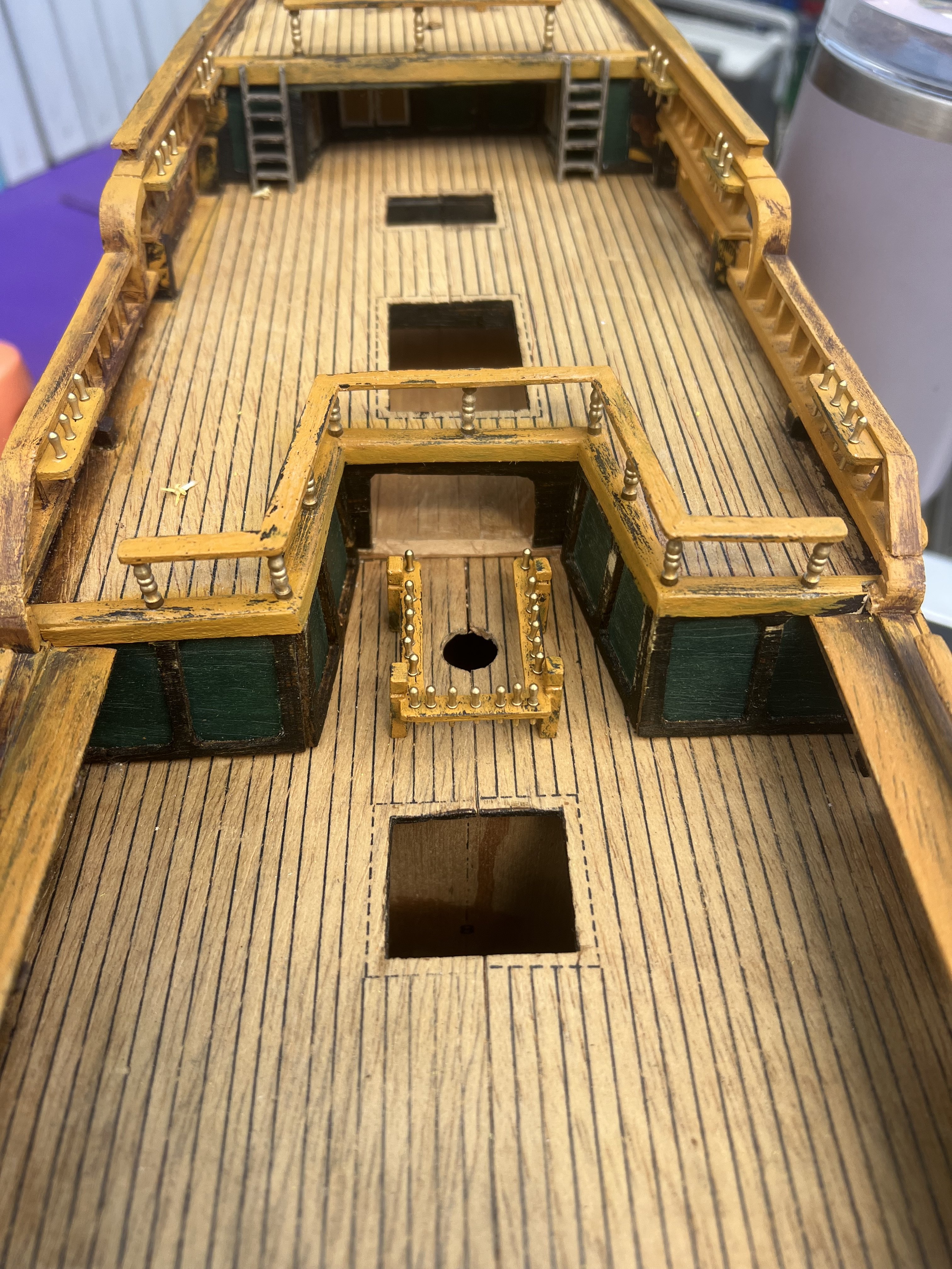

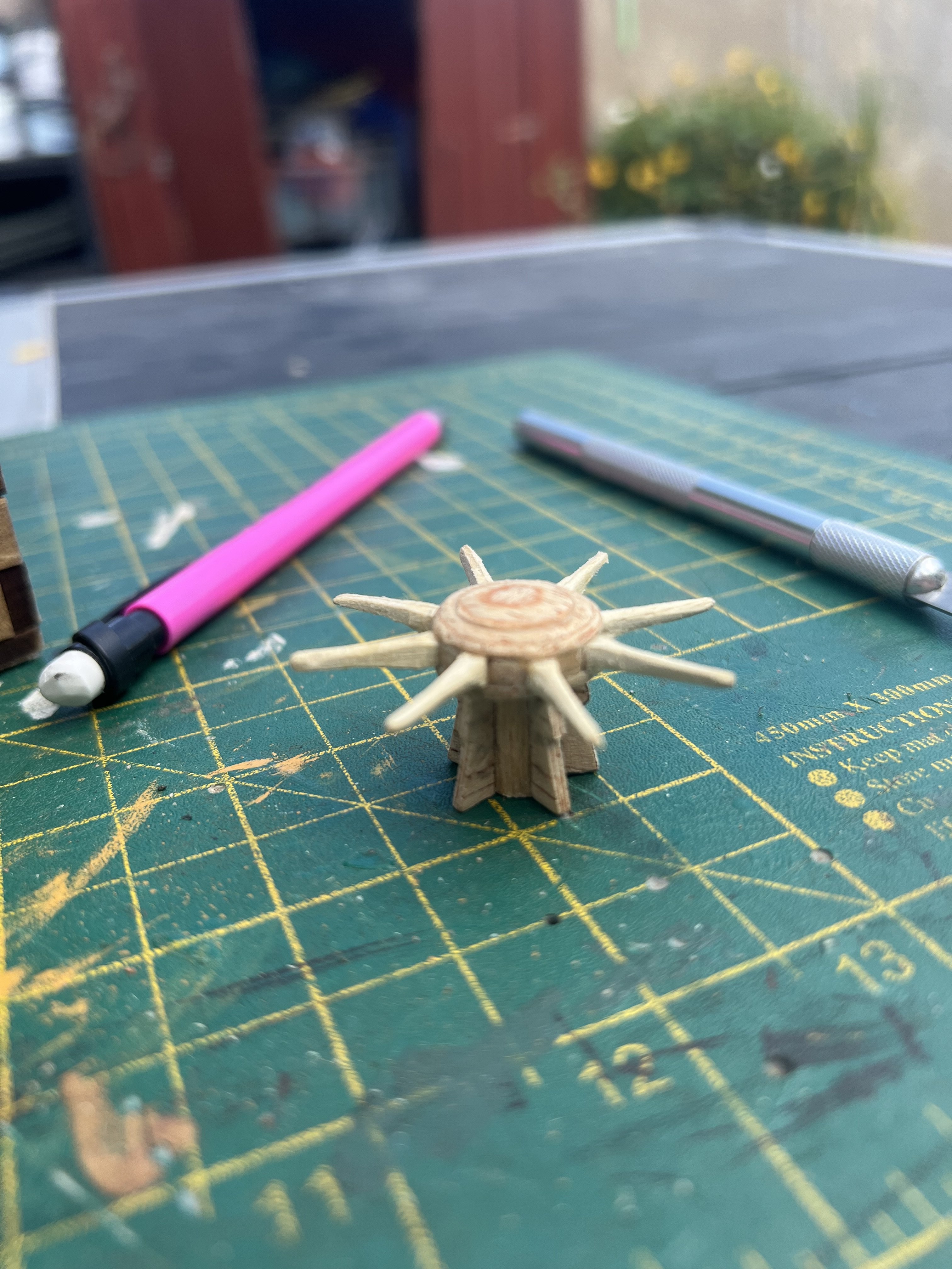

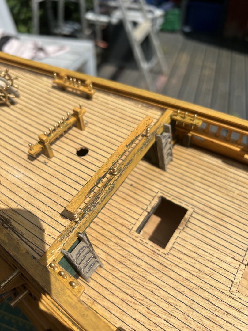

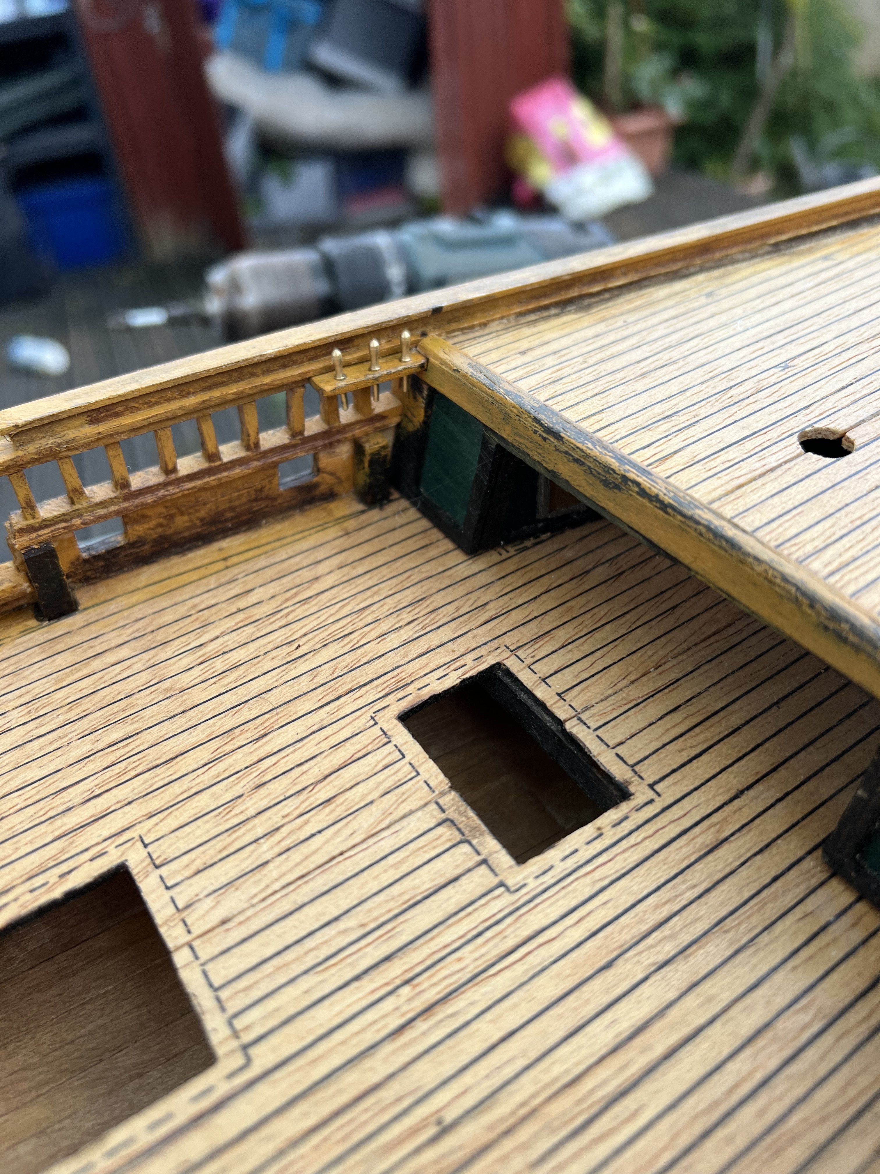

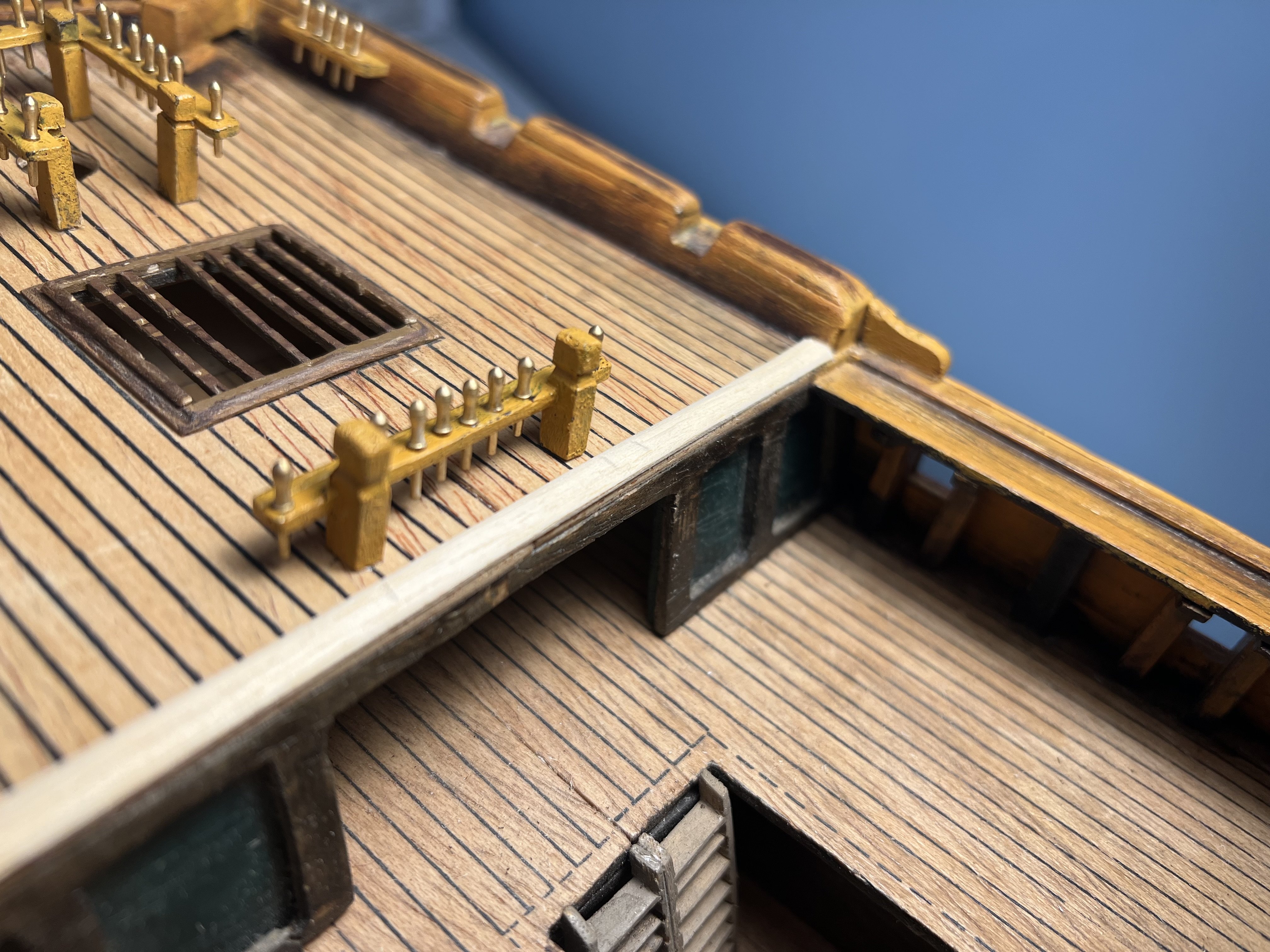

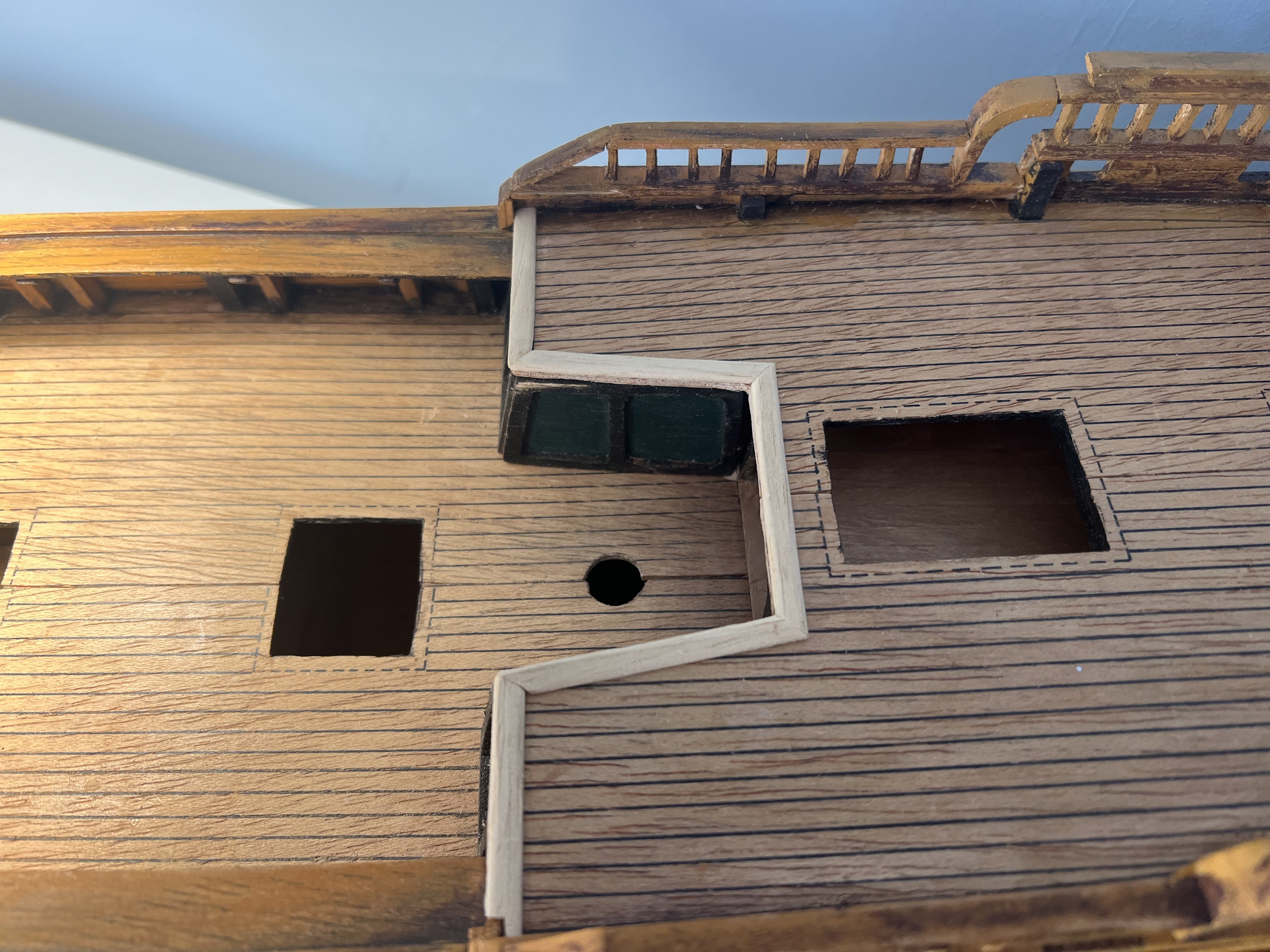

UPDATE 13

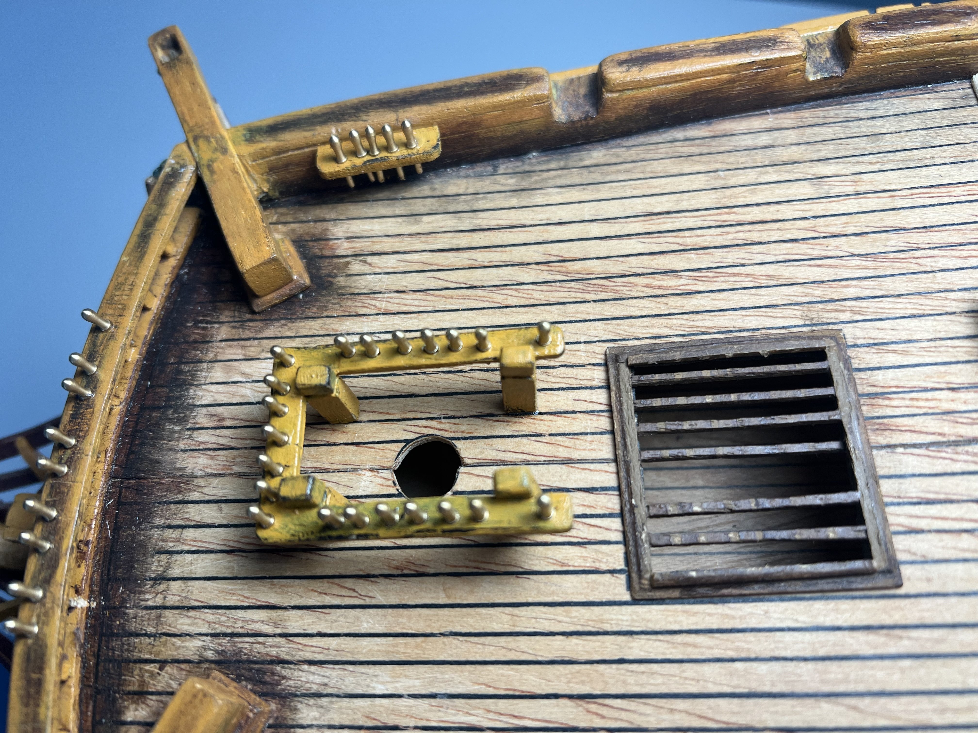

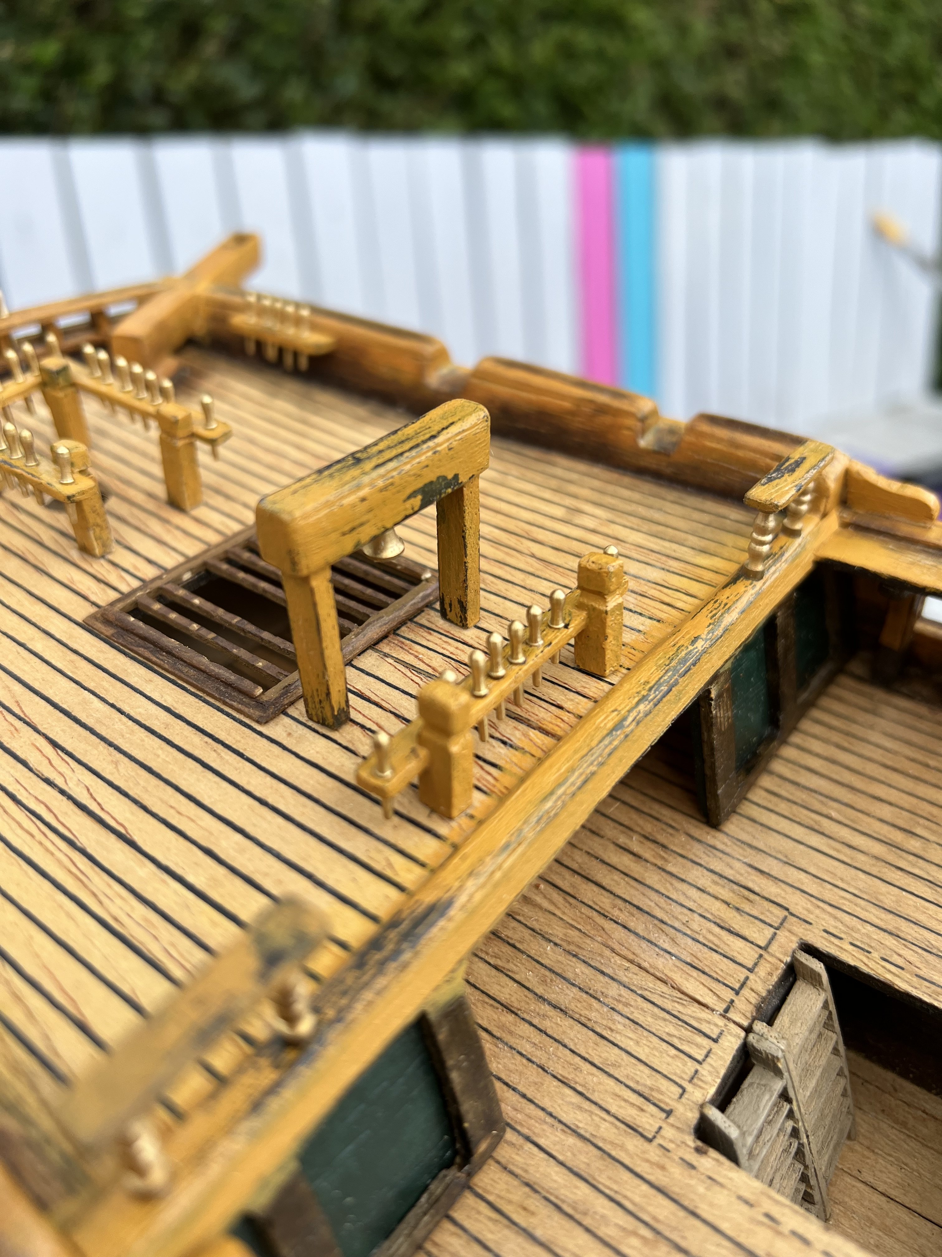

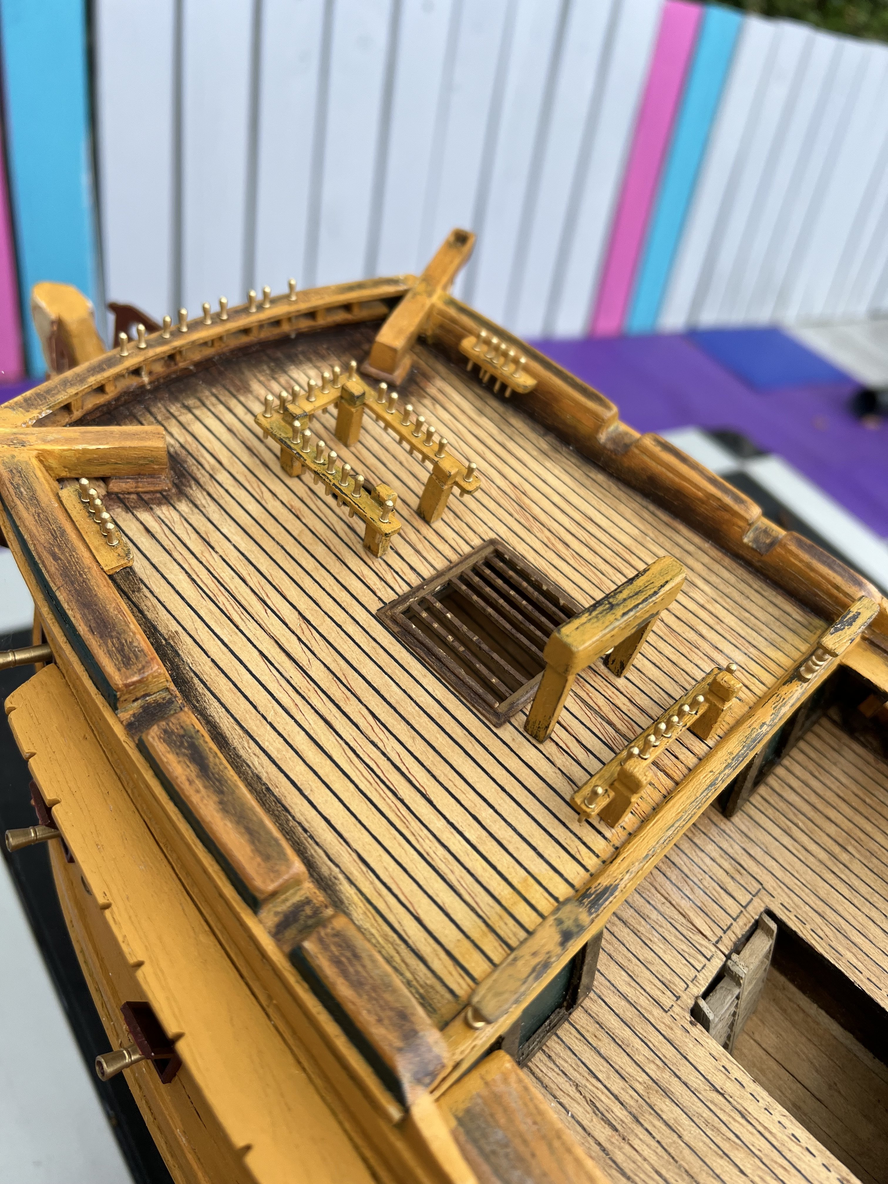

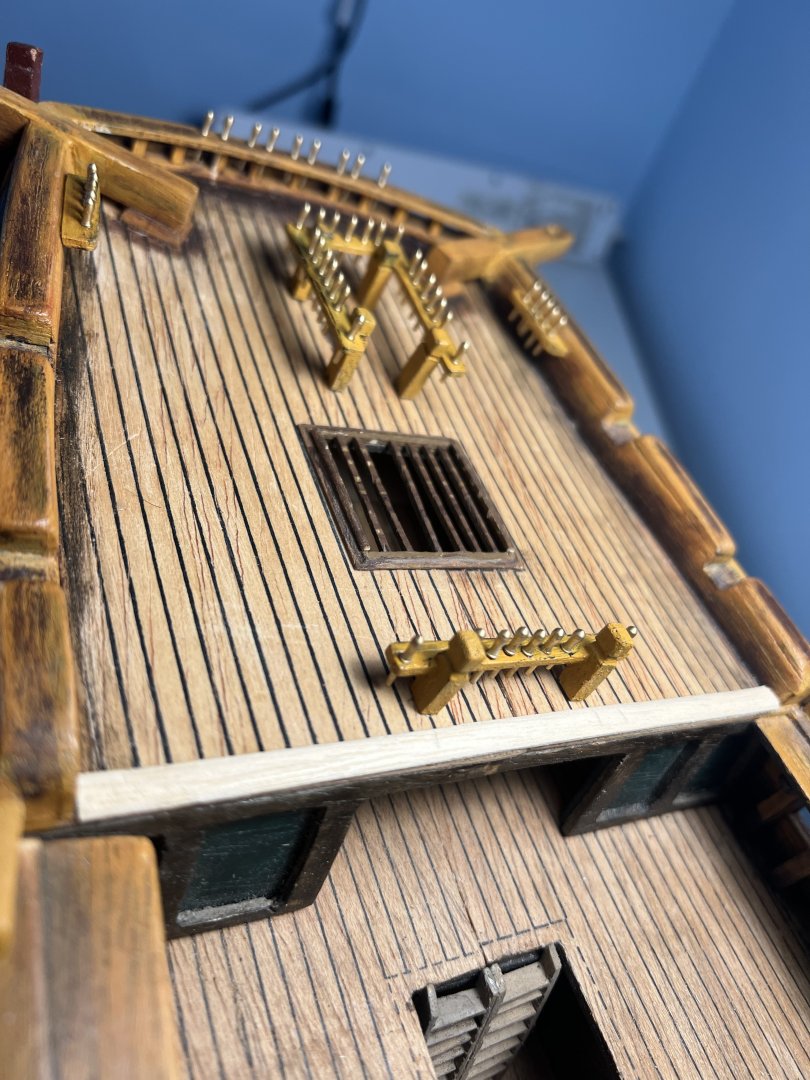

Time for another update.
A bit of a fiddly bit. I think the pictures make it quite self-explanatory, so I’ll point out some of the mistakes that I made along the way and how I’ve attempted to cover them up.
Towards the stern of the ship, I made a hole where a cannon would go. Turns out I didn’t need to do that! I’ve not filled it in yet; I’ll put some wood in and then filler around the edge to try and hide it.
I’ve had to use some filler to hide some of the gaps where the planks were stuck to the deck. I did glue them down, so I’m a tad frustrated to see the gaps.

BILLING BOAT. NORSKE LOVE UPDATE 16
I’ve added the canons! And mostly gun hole covers. I’ve also smartened up some of the yellow paint work as well. The painting took a while as there are a lot of there was a lot to paint.
Not much to explain this time. I’m moving onto the deck work next, so should start to see some progress on there.
Paint used:
Citadel Colour: Layer Doombull Brown. Base Mephiston Red Base Retributor Armor and Base Overland Sunset.
Edited by DanielNG10
BILLING BOAT. NORSKE LOVE. UPDATE 18
I’ve painted the rudder to match the ship and the water lines match. I used super glue and then slotted in a pin to attach the rudder to the ship. You can buy these ready made, which I think I might do next time. Getting this bit sorted took a long time.
Once this was attached I started attaching some of the things on the deck as you can see in the photos. I have added a plank of wood which I painted at the edge of each of the deck levels. This was just to tidy it up as you could see the top of the walls where the floor sat. I just didn’t think it looked nice. Added the brass pins. These were secured with a dab of superglue.
Daniel
NB: The photos didn't upload in the correct order for this post!

BILLING BOAT. NORSKE LOVE. UPDATE 19
I created the capstan and then painted. This was quite enjoyable to build. There were no real dramas while creating this. I’ve added the bulwark railings, and other railings around the deck. I used a strip of wood on the floor which was painted. Then attached the railings. To make the railings, I photocopied the 1:1 plans. I then used this to ensure that measurements were correct. I photocopied to ensure that original plans don’t get tatty. Completed the steering stand and the wheel. I’ve wrapped some string around the stand. It’s held in place with a tiny dap of super glue.
Should you be interested, I’m on…
https://www.youtube.com/@Byrondockyard
Appreciate and support.
Daniel
