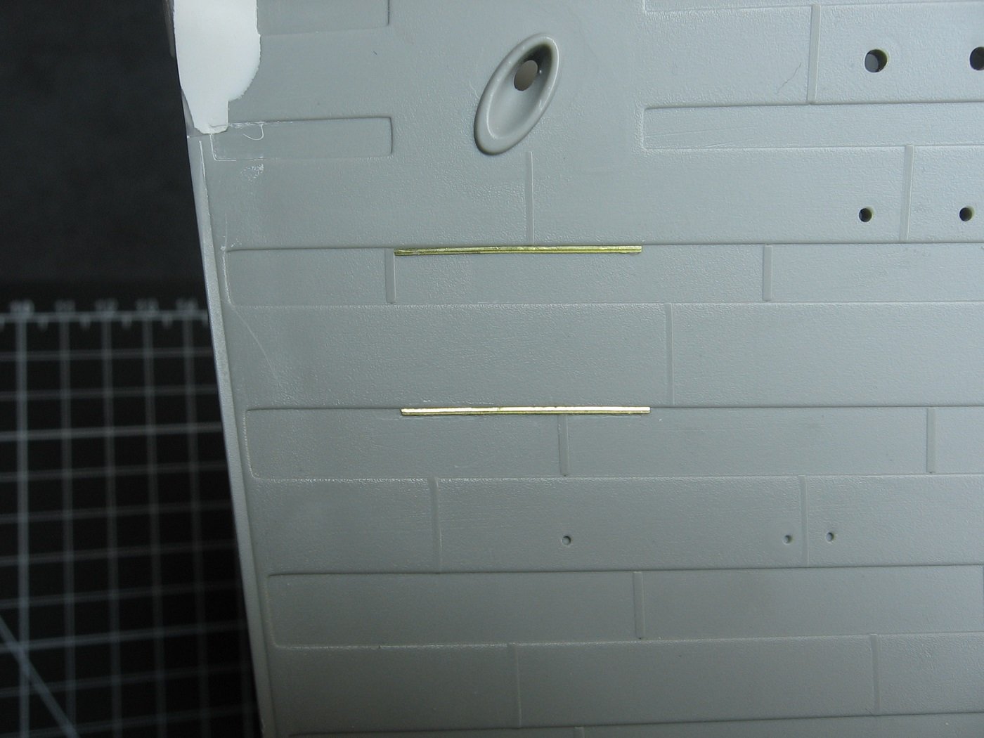

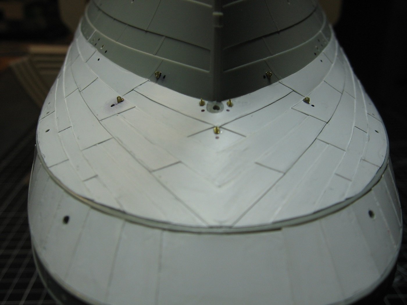

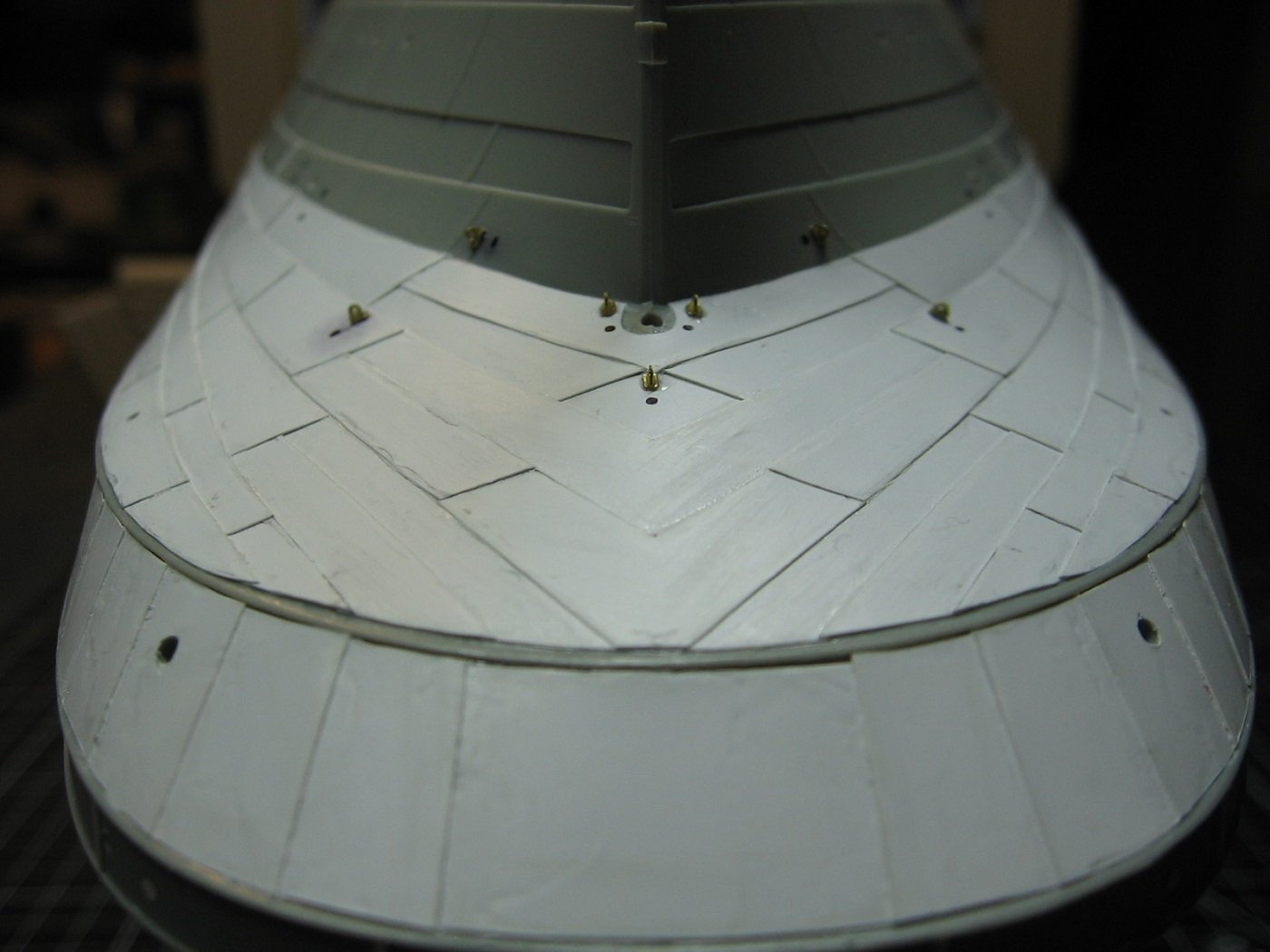

So, last May, Mr. Boyd amended his Hull Corrections document to include some double strakes that are missing on the kit hull. Honestly, my first reaction to this was "Ugh. More corrections. I'm NOT doing them.". But alas, it's winter and I've done them. (Well...not ALL of them. To be explained later).
I purchased some 0.25mm x 4.0mm styrene strip for this task.
The thickness is very close to bang on (perhaps a wee bit thick), but the width is not.
I used a set of calipers to scribe two strips to 3.75mm wide and then trimmed them with a #18 blade. Having said that, I found I still had to trim the width of each strake a tad more just prior to cementing in place. With using strips, I was guaranteed to have one edge perfectly straight.
Port Fwd....
I struggled with the Port Fwd section somewhat and had to fill quite a few gaps. I used Milliput Superfine epoxy putty.
Port Aft.....
Port Aft went quite a bit better....
Starboard Forward....
Starboard side went very well. Just one small gap to fill in the forward section.....
Starboard Aft....
More on the yellow and blue circled sections in a bit.
Starboard Aft went well also....
Regarding the strake circled in yellow, (both sides, Port and Starboard), two images above.....this is already flush (on the kit mold) and adding a strake here would just create another inaccuracy, in that it would then NOT be flush as reference photographs indicate there are strakes above and below this strake. To make this "flush" would require adding strakes above and below it as well. Therefore, I did not add a strake here.
What is missing, however, is a lower panel line here, as indicated....
Panel line added, Port Aft.....
Starboard side aft. I used the edge of an erasing shield as a guide for the scriber, (both Port and Starboard).....
And the result....
And finally, regarding the strake circled in blue.....
Again....this part of the kit mold is already flush. To add a strake here introduces yet another inaccuracy. For the same reason. Referencing historical photographs shows that there were strakes above and below this strake. To make it accurate would require strakes above and below to be added as well.
But that begs the question, where does it end? I have come to the conclusion that the kit hull has LOTS of inaccuracies. How much? 20%? 30%? I have no idea and I'm not about to try and find out.
My model is not going to be a museum piece. Myself and my wife are essentially going to be the only ones who see the completed project. And anyone else who does see it will not know in the slightest.
Having said that, I still have lots to do to the hull to correct other inaccuracies. I have already committed in my own mind to do so. But chasing the inaccuracies of the double strakes ends here, for me.
Thanks for looking. Suggestions are welcome.

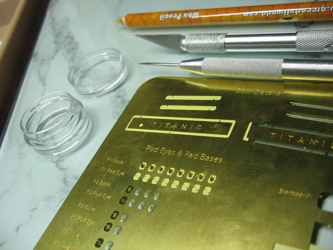

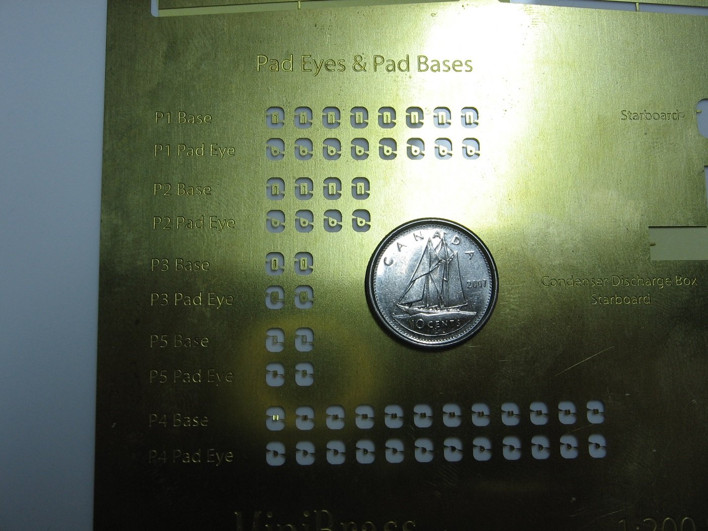

First ever experience with PE went well. Very pleased with the results.
Started with the Condenser Discharge Ports. I did the Starboard side first....
And the Port side. For this side I decided to give the provided template a try. I think it helped a bit, but not essential.
Looking forward to working with the rest of the PE and getting on the hull.

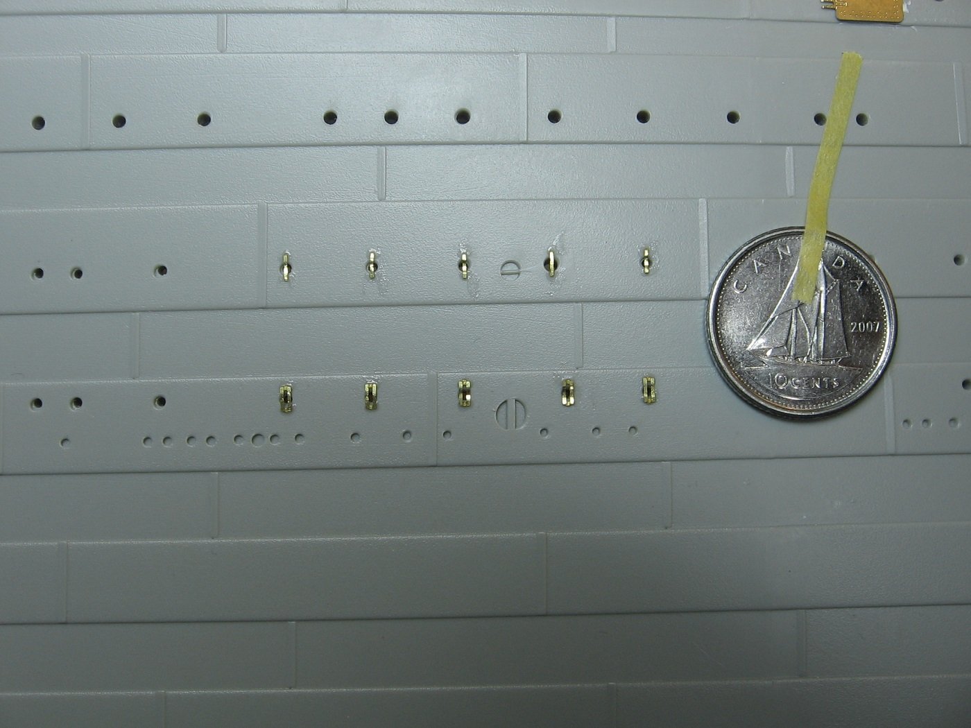

Continuing with the Mini Brass Hull Details PE sheet....
I applied the zinc anodes and reinforcement plates in the vicinity of the stern frame. Zinc anodes are the smaller squares, the reinforcement plates are the larger.
Not too happy with how the zinc anodes turned out. I did the Port side first.....
SternPEDetailPort.JPG.5757104f321e5d36f9169ac61680ace4.JPGI have a $15 CDN manufactured pick up tool, but it proved to be useless, so I crafted a homemade pick up tool made from a round toothpick and blue tack (as seen in the next image). I suppose the ball of blue tack is too large for these applications as, upon placing the zinc anode, I could not actually see the photo etch piece. I figured I'd just get it on there (CA glue already applied) and then shift it into position accordingly. However, the CA glue set up immediately and it is what it is. The zinc anode should be butted right up to the plating below it.
The Starboard side.....
PickUpTool.JPG.8ffd202e4d676dd08706413c62aae74f.JPGThe placement of the pieces here are what I intended to achieve, however, the zinc anode and the adjacent plating below clearly do not align exactly, indicating that I did not quite get the angle of the upper end on that stern frame plating correct.
Bottom line is, the placement of the zinc anodes, one side to the other, don't match and the Port side zinc anode placement is inaccurate (too high; should be right up against the plating).
I considered trimming the styrene on the Starboard side, to match the Port side, but that plating matches now as it is, so that would just change one problem into another. I also considered trying to pop off the Port zinc and reposition it, but I had visions of the piece flying off into the carpet monster's gaping mouth if I tried that.
In the end, it is what it is. This model will not be displayed in the middle of a room with both sides in view. One side will be up against a wall. Not sure which side that will be yet. Depends on which side has more mistakes. Chalking this up as a learning experience. One of my next tasks will be to make another pick up tool with a much smaller ball of blue tack.
Further, technically the reinforcement plates should be flush with the plating around it. Having said that, I'm okay with how I placed those.

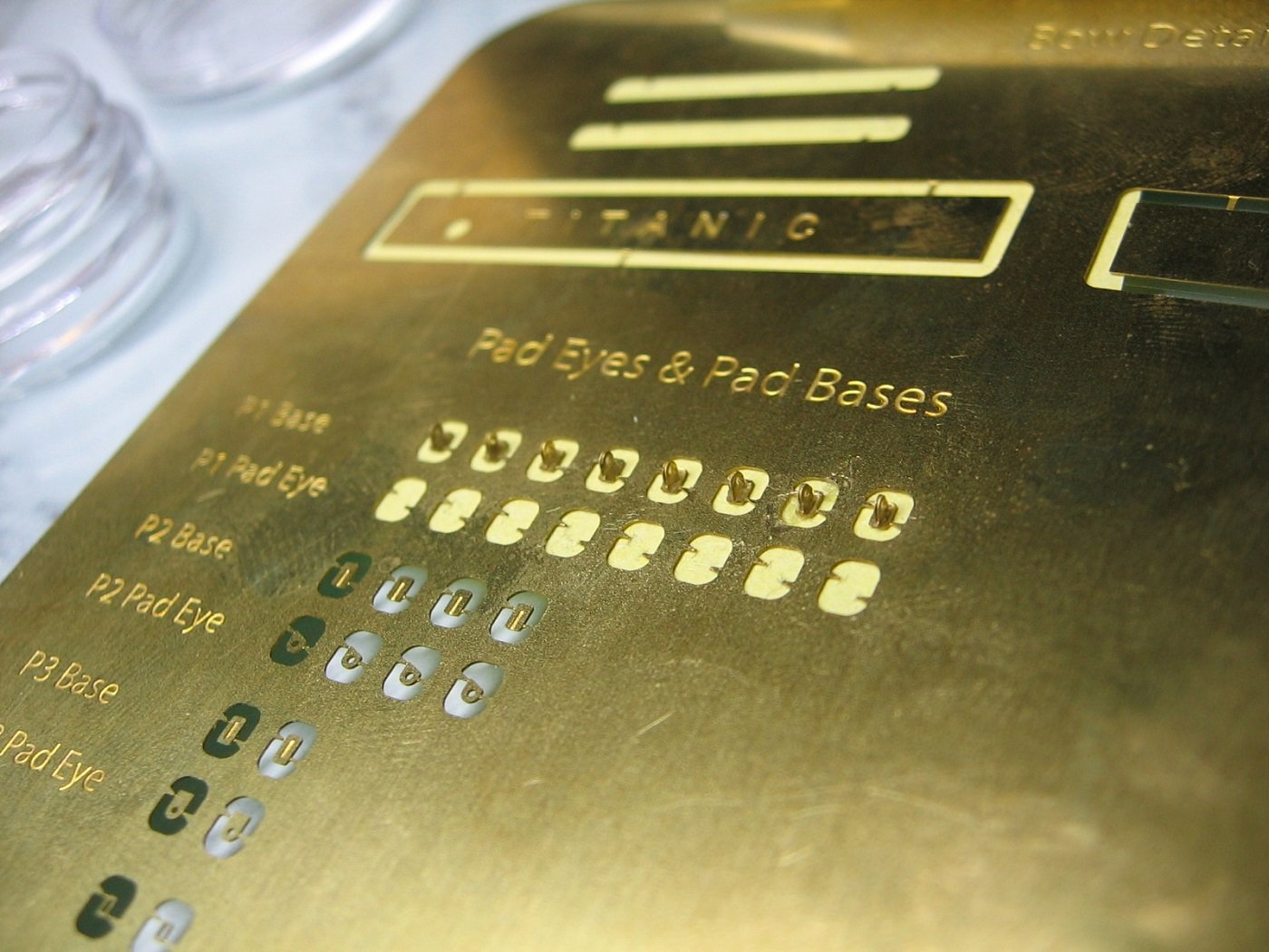

The only reason I purchased this sheet is because there are two molded Coaling Doors missing from the Trumpeter hull.  But seeing as I now have the sheet, I figure I might as well do all 44. There are 22 Coaling Doors on each side.
I'm not even sure where the Cleats go. Haven't researched that yet. (Instructions are lacking).
The black circle represents a Coaling Door as molded by Trumpeter.
The red circle represents a molded door already chiseled off by me. Happy to see the indentation remains. Will aid in positioning.
The blue circle represents one of the two missing coaling doors. A porthole was here in its place, which I had previously drilled out. Hence, the putty fill.

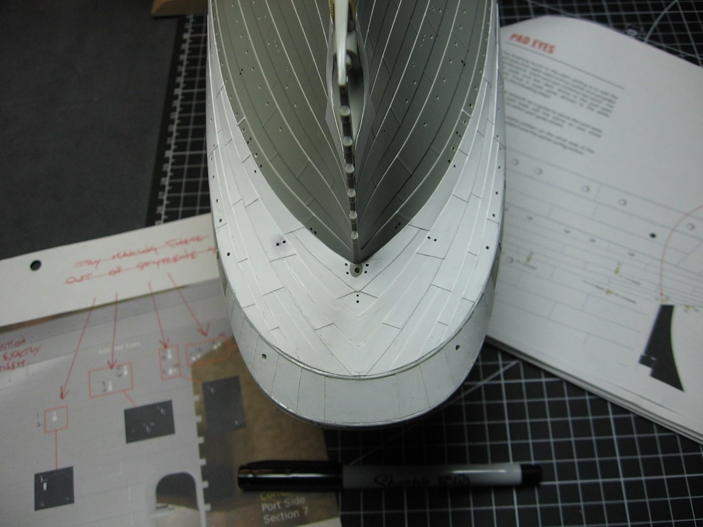

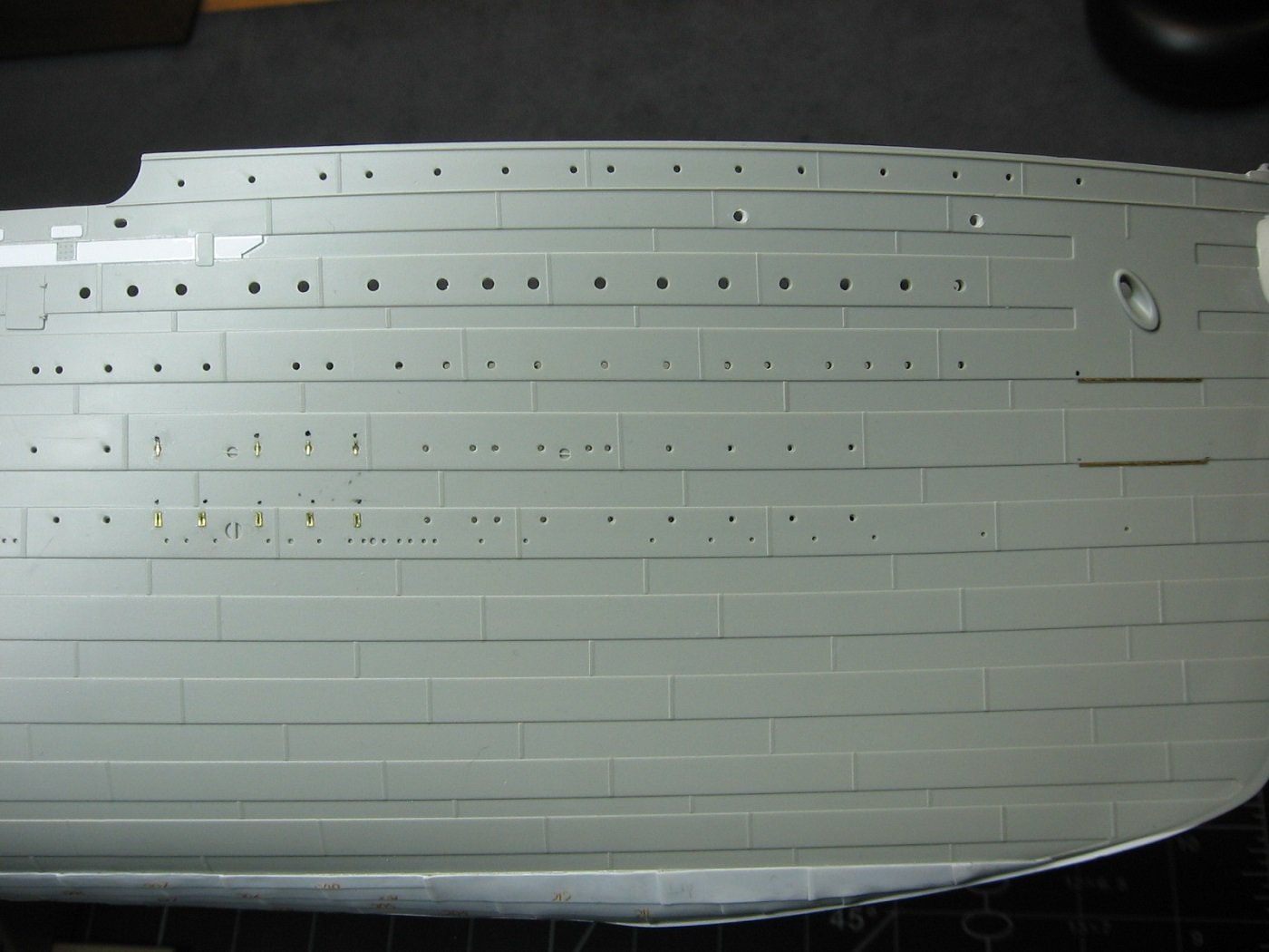

Proceeding onward, I was puzzled over where the Cleats, on the same PE sheet as the Coaling Doors, go. I had no clue. So, upon researching this it finally became apparent that the instructions for the MiniBrass Coaling Doors and Cleats PE sheet is buried in the MiniBrass Stern Plating Instructions pdf document. Sheesh!
Not only that, but the instructions for the MiniBrass 1:200 Titanic Hull Details PE sheet are buried in the same document. Sheesh x2! Absolutely no mention of this in the title of the document. Just “Stern Plating Instructions”. Ridiculous. Rant over.
So, it turns out the Cleats are actually associated with the Coaling Doors. A pair of them are to be attached above each door. I’ll be leaving that for another day.
I was also curious why the MiniBrass Hull Details sheet has only five so called “Gangway Doors”, when there are 16 total molded doors on the hull (8 each side). This research led to discombobulated thoughts on what the heck is accurate and what isn’t, strategy, and a potential change of plans on which direction to go with some aspects of the hull build.
I learned that the five doors provided are optional doors for E deck, and are to be used to compliment the MiniBrass 200 HULL PLATING PE sheets.
I also learned that the KA Detail Kit has PE hull doors for the model. I missed that the first time I looked through the kit. So, at this point, I decided to go with the KA doors.
I began with Port Forward. The KA instructions indicate a door goes here (red circle).
It is also “implied” (my term) from the Starboard profile hull plating diagram in a particular reference book, that there should be a door here (again, red circle) so I attached a KA door here.
As well, it appeared to me that some other modifications were required. The raised feature within the blue circle is not in said diagram and needed removal. Further, the lower portion of the raised feature within the black circle needed to be trimmed.
Here’s an image of the work done.
But wait! The KA instructions are wrong, and the hull plating profile perused is that of the Starboard side, not the Port side!
I forget the sequences of events moving forward from here, but upon researching the doors more I discovered the following:
-      There are instructions for MiniBrass’ Hull Plating PE sheets (who knew?). I was previously aware that MiniBrass has these sheets
        available, however I had assumed that using them requires major plastic cutting surgery. After reading through the instructions
        (that I just discovered), it looks to me that the application of these is not as hard as I originally thought.
-      Also discovered in said instructions, apparently, there is no such door on the Port side, such as what I just applied.
-      Unfortunately, there is no Port profile hull plating diagram in the (to remain nameless) reference book to point this out.
-      However, perusing a photograph in another reference book confirms this. No door here (red circle). Looks like I got the other
       modifications wrong as well (blue and black circles).

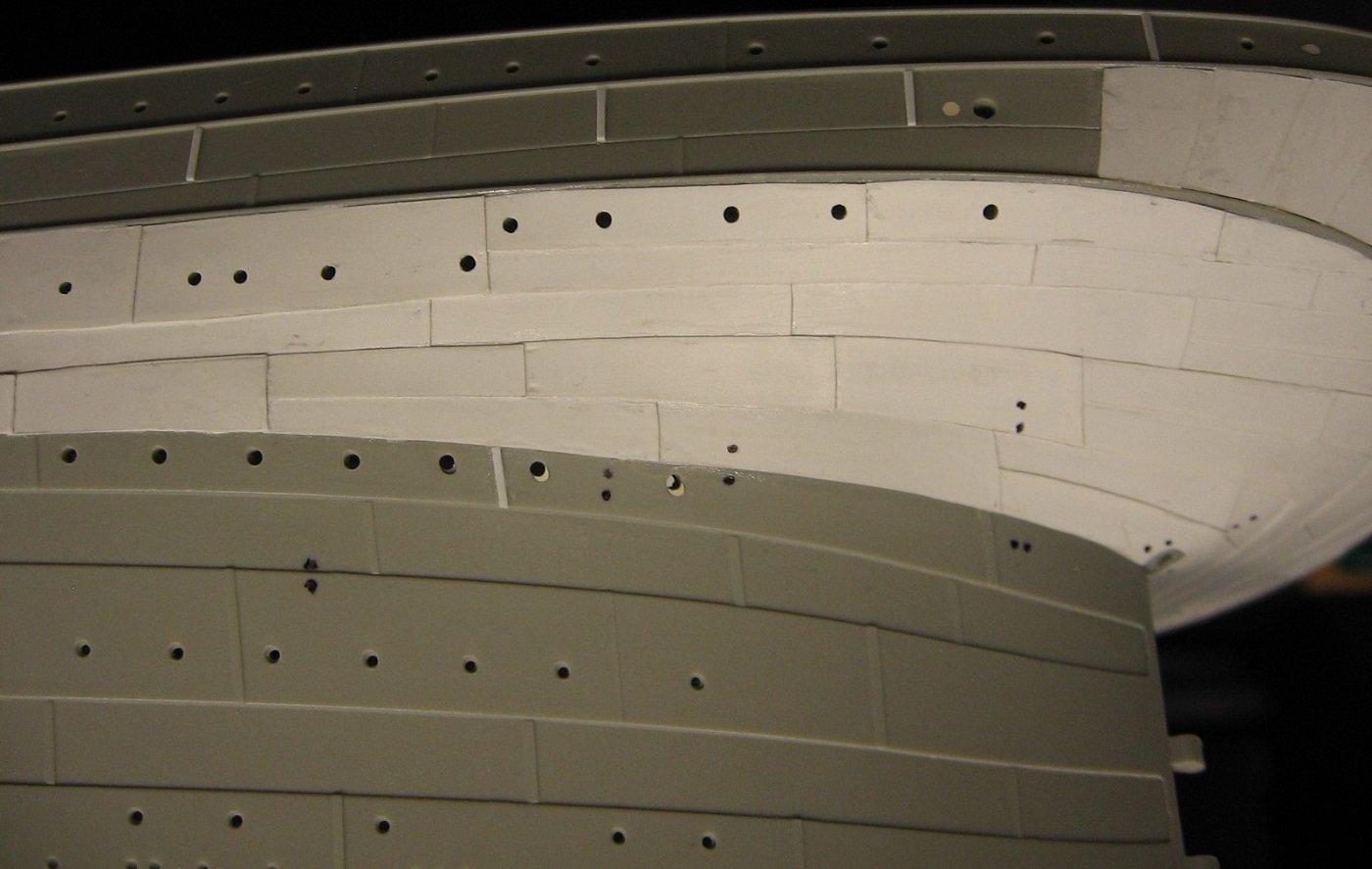

Also, while working on this door application I couldn’t help but notice (for the umpteenth time) the rivet damage I’ve incurred to the hull prior to having the cradle I have it in now. Prior to the cradle, I just had the hull on two boards with hand towels as protection. It didn’t always work out. Not to mention some of the rivets were inadvertently chiseled away by carelessness while chiseling something adjacent. Sometime a go, I purchased an HO scale 3D rivet decals sheet to help rectify this, but they just aren’t the same.
Taking into consideration….
-      the rivet damage….
-      that the Trumpeter hull rivet detail is actually quite lacking overall and that the MiniBrass PE kit captures the actual rivet detail….
-      that the MiniBrass kit looks to be not that difficult to apply…..
-      and the MiniBrass kit should take out further guesswork of what goes where….

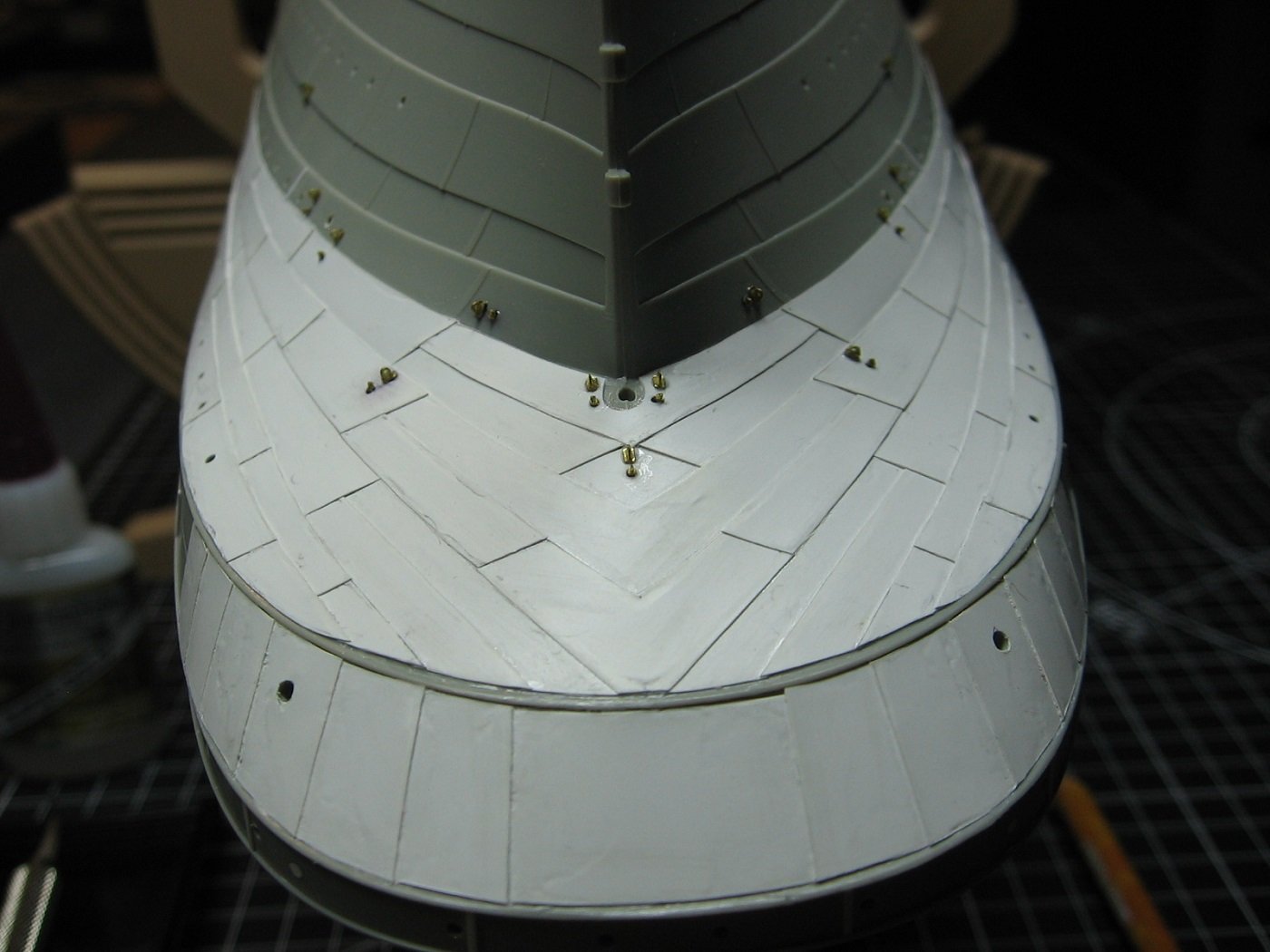

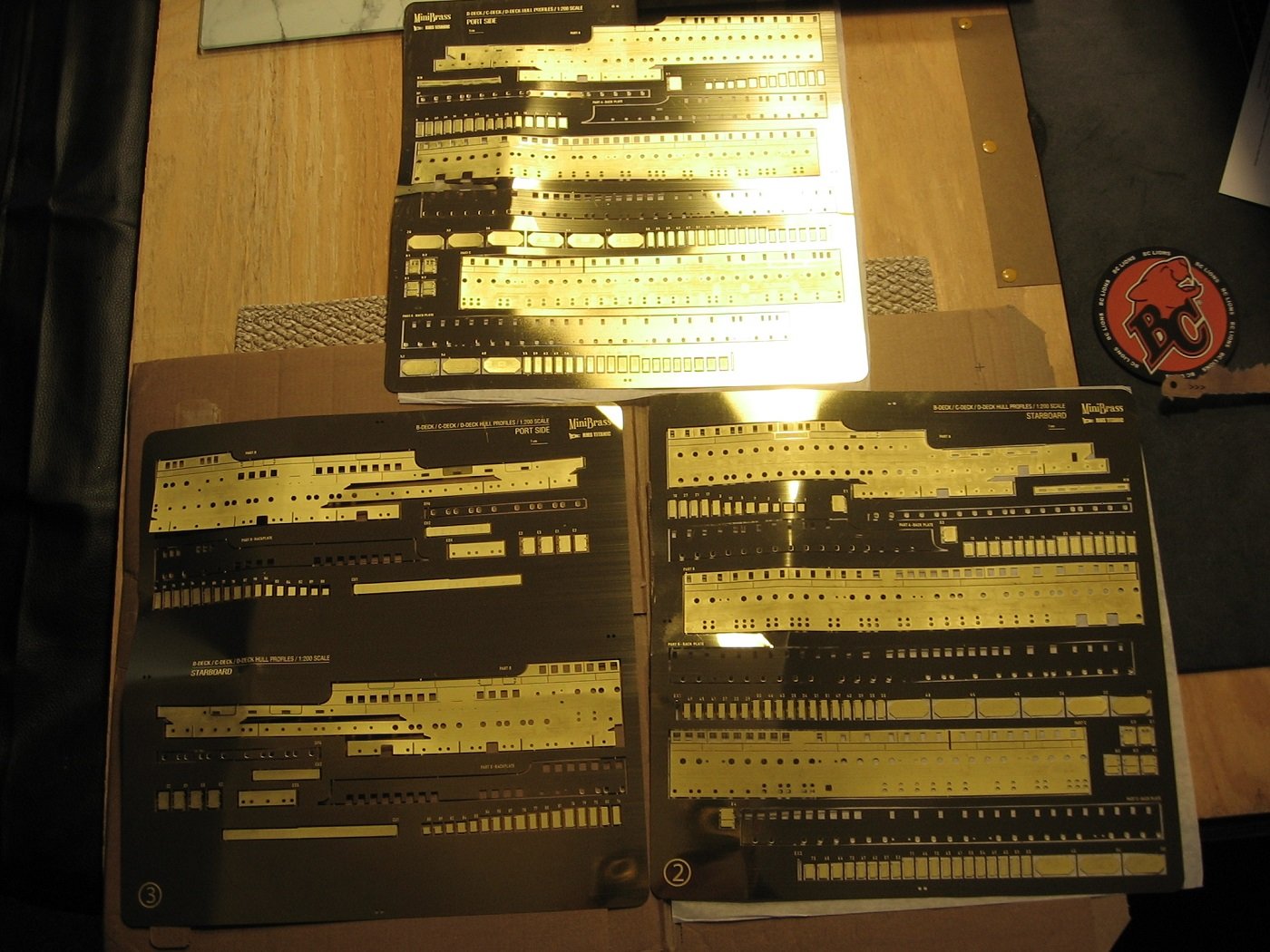

I’ve decided to order the MiniBrass 200 Hull Plating Kit.
Oh, and the scribed panel lines to indicate the missing Double Strakes…. those will be replaced correctly by this PE.
In the meantime, I’ve applied the Trumpeter provided PE parts 48, 49, 50, and 51. Condenser Intake screens.
Next work will be on the Prow Hawser Port. This piece was purchased from Shapeways.
This will require some plastic surgery and putty/sculpting application. Intending major patience on this. Even if the first cut takes me an hour, it takes me an hour. Hoping it goes well.
Hopefully what I’ve described makes sense. Believe me, to achieve an accurate representation of the Titanic with this kit is a major challenge and I’m often lost myself. I can only image the experience of what others just reading about it is.

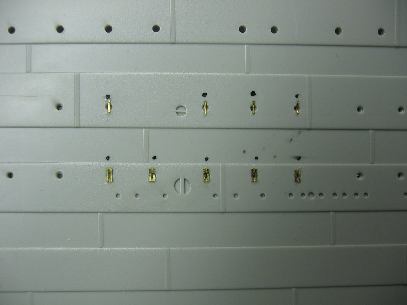

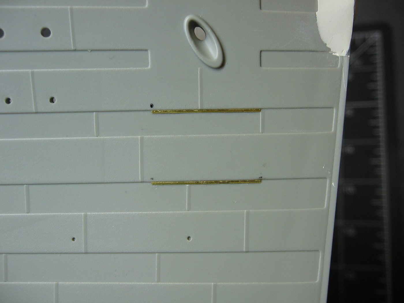

Got the MiniBrass anchor guard bars PE installed on the Port side.
As well as the single and double porthole guard bars on the Port side. Dime added in photo for scale reference. This is tiny PE.
Thanks for looking.

Despite golf season still being in full swing, I've found some bench time lately.
Before continuing with the PE for the hull sides, I've decided to do the Pad Eyes at and near the stern next.
This is tiny PE. Did the larger P1 Pad Eyes first. As evident in the pictures, this PE has two parts. The eye itself, and the base.
I figured it would be easiest to attach the eyes to the bases with the latter still attached to the fret.
I filed the fret nubs off the eye parts with an 800 grit sanding stick while holding the part with square jawed flat pliers. Tricky.
Then using the Mini Brass instructions, as well as Graham Boyd's document, I placed the positions of each Pad Eye, by eyeball, on the Port side with an Ultra Fine Sharpie.
For the Starboard side placements, I measured the Port side placements from various references points and placed accordingly to make both sides symmetrical.
And a couple of pics showing the P1 Pad Eyes in place. Unfortunately, I somehow managed to get CA glue within the eye hole of most of them. At least, it looks that way. Despite using Vision Aid magnifiers, I found it quite hard to actually tell. I tried cleaning them out while they were still on the fret, but after breaking two of them off, I gave up. I suppose, in hindsight I could have burnt the CA off with a lighter, but that heat would most likely have caused each eye to become removed from each base. Thus, having to start all over. Anyway, not sure how that might have happened. As they are so small, I'm happy with how they turned out. I think the ultimate tell will be when I get paint on them.
As for fret nubs on the base parts, I cut as close as possible to the base edge. Consequently, I manage to avoid any nubs on the bases. If there are any there, I couldn't see them.
And finally, as far as I could tell from instructions and reference photos, the two aftermost Pad Eyes were on the centerline (which makes sense to me). As a consequence of that, there is one extra P1 and one extra P4 provided.
Hoping the smaller ones will go as well as these ones did.

MiniBrass Pad Eyes P2, P3, P5, and finally P4 attached. Pad Eyes complete.
Not perfect by any means. A few are slightly crooked and there is excess CA glue here and there.
Probably goes without saying that the P4 Pad Eyes (the smallest) were the hardest.
The white object in the tray on the left in the first pic is a cat whisker. I used that for applying a tiny drop of CA glue to each P4 base before attaching the P4 eye to the base. I forget where I heard about using that as a tool for small amounts of CA as it was quite awhile ago. Perhaps a member of Model Shipwrights of Niagra, but I'm not sure. This is the first time I've employed a cat whisker for that purpose and it worked out quite well. I used a glue looper for all the other gluing.
Having said that, one lesson learned with this aspect of my build is I think I underestimate the power of CA glue, and tend to use too much. Looking forward to working with it more. I need to find something to practice on with it.
As for fret nubs, I did not bother sanding/filing any nubs off the remaining PE beyond P1. I figured it's so tiny and hardly noticeable that it wasn't worth the bother and risk of losing some of the parts. I considered cleaning them up (fret nubs and excess glue) once attached to the hull, but upon closer inspection with my Vision Aid magnifiers, I'm going to leave well enough alone.
Another lesson learned is my eyes aren't what they used to be. Despite using the magnifiers, this PE (especially the P4 eyes) was somewhat difficult to see and work with, but I managed. Hoping I will never have to work with such small PE ever again.
I suppose now, the hardest trick of all will be making sure they stay intact. (Read: not get careless and bump them off).
One final thought on the Pad Eyes regarding mention of mine upthread of the hole of the eyes getting CA glue in them. How did that happen? Well, in working with the subsequent eyes, it became apparent. It is quite difficult to attach an eye to a base while maintaining a vertical aspect of the eye. Often they wanted to just flop on their side once they came into contact with the drop of glue. Hence, once on their side and in the glue, that glue gets into the hole. Just a heads up for anyone else who might be using this aftermarket kit on their model.
Thanks for looking and cheers,

On 2/8/2025 at 12:36 AM, king derelict said:
For picking up PE I use a cocktail stick and rub the end on a piece of beeswax. For small pieces I use a dressmakers pin again rubbed on beeswax. I assume candle wax might work too. It’s easier to see where you are placing the part.
Great progress.
Alan
Good tip I will try that. I use a pick up pencil and find the tip a bit to big for really small PE parts.
Paul

Small update.
Got the starboard side anchor guard bars and porthole guard bars glued on a couple weeks ago.
In so doing, I discovered a mistake in the instructions. The location of the non-existent porthole indicated (starboard side only) is not where the instructions say, but rather ~20mm further aft. But it's a moot point anyway, as Trumpeter did not even mold this porthole into the hull, and therefore, it's obvious.

Next step will be starting work on the MiniBrass Hull Profiles PE set. This set is quite extensive and will transform the hull significantly.
The set arrived (last May) damaged. All three sheets bent. I assume this occurred during shipping. I emailed the proprietor advising him of this. I mentioned I thought I could make the damaged product work, but suggested he might want to re-address choice of packaging for future orders. He replied that this is the first time he had a report of damage and assured me that he'd replace any parts that won't work. Fingers crossed.
Intro to the instructions...
General information page....
First three pages, describing the first steps...
Expecting to get started this afternoon. Should be fun.
