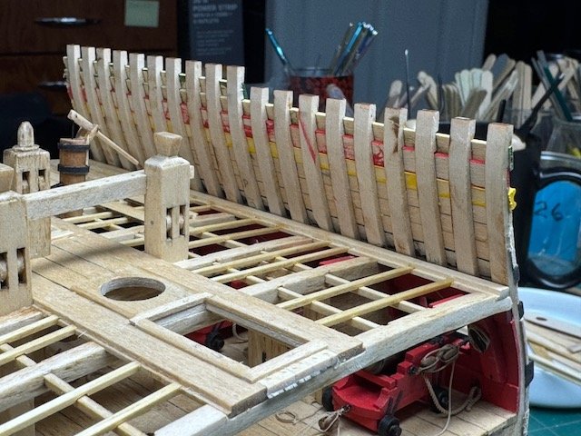

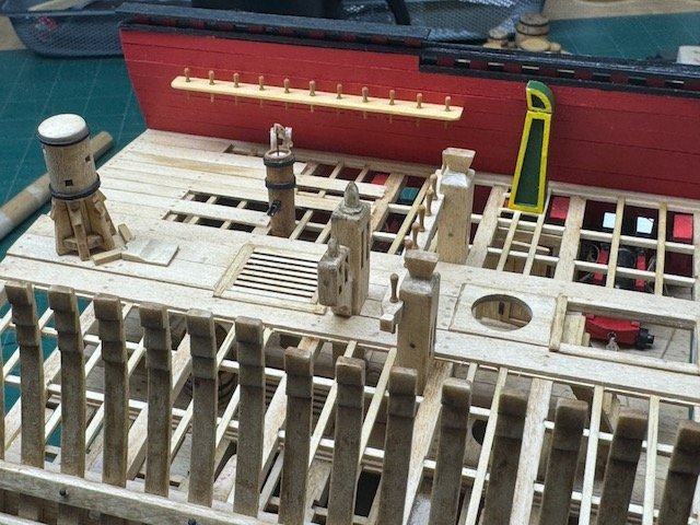

I've had a productive weekend so far, working on various details of the upper deck.   First, though it's not installed yet, is the staircase (or slanted ladder, if you will) from the lower to upper deck.  It wasn't hard to assemble, but I shaved the treads down to .5 mm (about 1/64"), so assembly was somewhat delicate.  Once glued up it has proven to be surprisingly sturdy.

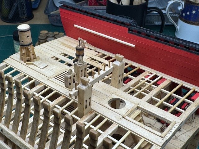

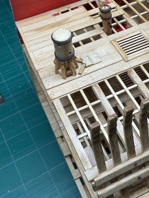

Next is the capstan.    I still need to make the upper half of the barrel,  but the spindle, lower half of the barrel and its platform are all done.  Dutch (and Swedish) capstans of the 17th century seem to use two basic designs for the portion above deck.   The first kind is a simple cylinder.  The capstan illustrations from the Vasa in Fred Hocker's "Vasa", a nice drawing in Herman Ketting's "Prins Willem", and the Batavia plans all show this sort.   The Batavia's dimensions are roughly 4' high and 2' in diameter, with the diameter constant top to bottom.   The other kind has two cylinders of differing diameters, with the larger on top and smaller underneath.   Holes for the bars are in the upper portion and the line being worked is wrapped around the lower.    The two-diameter style is what the kit calls for, and I've also seen that kind on plans that are part of Ab Hoving's "17th Century Dutch Merchant Ships".   In both kinds of capstans the bar holes spiral down the barrel, so that successive bars aren't the same height above the deck.
I am making my capstan in the second style, as the kit calls for.   The lower portion of mine is visible on the near end of the deck in the next photos (I haven't made the upper half yet).

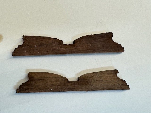

But now I will come to the point.  The kit's capstan design has battens on the upper barrel which spiral down on the same curve as the bar holes.   The few references that I have don't show that kind of decorative(?) detail and I'm dubious that I can add it in way that looks good.   So, at the moment,  I am inclined to skip the spiralling battens.    I think I will make a sample and see how it comes out, knowing that my references give me the leeway of taking an easier path.   Here are small photos of the three variants I'm talking about.  Left to right they are from Ketting, p. 51;   Hoving/Emke, Sheet 4 of Pinas Witsen plans; and the kit instructions.
IMG_7075.jpeg.84b05613e498cb6670a1aaf867adf73c.jpegIMG_7076.jpeg.c736d33d56eb1a4392c7f1d913233f3b.jpegIMG_7078.jpeg.49e3d1105f29d8908519d2c250b2521c.jpeg

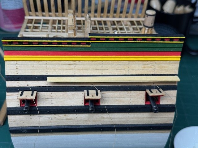

In my previous post, #60 from 14 April, I mentioned the possibility of not planking the starboard side of the upper deck as called for in the instructions.   Yesterday that expanse of unplanked surface was looking pretty bare, so I came up with the idea of planking just the after 1/3 of the deck.    The next three photos show the model looking from aft with planks laid on the after 1/3 of (a) the starboard side, (b) both sides, and (c) the port side.    (Remember, the instructions say fully plank starboard.)   My vote is for (c) - that layout satisfies my desire for consistency by keeping the port side more finished, yet doesn't significantly obscure one's view of the lower deck when seen from the forward end of the model.
IMG_7062.jpeg.ac0e66f7bfd2a580b34f6795b92723fa.jpegIMG_7066.jpeg.3ebd26cf16e35bb5c24c852b313e1f63.jpegIMG_7070.jpeg.4e8db5440aecb22f0d655e7dbe60d654.jpeg

Finally,  I'll add one photo taken from the bow that shows what the model will look like with the port side of the upper deck planked on the after portion.

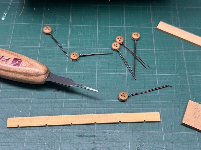

This post is more about chisels than the model.    The capstan requires 1.5mm square through mortises for the bars and  I took that requirement as an opportunity to improve my tool set with some high quality itty-bitty chisels.    In my chisel search I didn't find any practical reviews and few useful images, which is why I'm posting this.
For the last several years I've used a set from Micromark (https://micromark.com/products/premier-elite-10-piece-micro-chisel-set?srsltid=AfmBOoo25HTv42qIr3vrm2I6f-pPAJdfx_ZCUUQOsFwwSeSSKkIMR4j5).   It's easy to complain about these chisels, but they served me pretty well to the extent they could.   The handles are good and they fit in my hand well, and there's a great variety of sizes at the very small end of the spectrum.  And I think they are priced reasonably for what they provide.  In fact, I don't know of any other source for chisels narrower than ~1.5mm.   But, ultimately, they don't fit the bill for a genuine micro equivalent of a real bench chisel.   A bench chisel has to take an edge, of course, but there's more: its back must be flat and its sides must be parallel.  Nobody's chisel, regardless of size, comes from the factory perfectly tuned, but the potential has to be there and it isn't with my old set.
From some searching on MSW and a little googling,  my candidates for replacement were Kirschen's Two Cherries 1.5 mm chisel (https://twocherriesusa.com/product/micro-carving-tool-straight-chisel-octagonal-hornbeam-handle/) and the Flexcut 1.5 straight chisel (https://www.flexcut.com/home/product/mt11-116-1-5mm-micro-chisel?srsltid=AfmBOopeJrL74HjjF7cISoSlRGmPjaG7DdC1aEgpLCbbR6liTG1RayQW).    I didn't see anyone other than Micromark offering smaller sizes, but as it happened 1.5mm was the right size for my current need, so I ordered the Kirschen 1.5 mm ($60.00, free shipping) and the Flexcut 1.5 mm 6 chisel set ($104 from Amazon https://www.amazon.com/dp/B016DBO1TK?ref=ppx_yo2ov_dt_b_fed_asin_title&th=1).   Which may seem extravagant, but I figured the Flexcut set would prove useful and that one or the other of the two 1.5 mm straight chisels would be a good candidate to grind down to 1.0 mm, which is another size I think I have to have.
Both arrived quickly.   Pictures below.   These were taken after I'd done some tweaking on them, which is why you can see some honing marks.
IMG_7319.jpeg.957c5eb22c7598338904d13a0c9da697.jpegIMG_7316.jpeg.2de660e731971b0910d6d8ea9def3b75.jpeg
The Kirschen's bevel is 25 degrees and the blade is 1.7 mm wide.   The blade length is 5.3 cm and the width is constant.   The handle is 1.5 cm diameter x 11 cm.  It feels good and, since it's octagonal, it won't roll around on the bench.  The blade bottom is flat (and can be made flatter when it's tuned up).   One thing I don't like is that the blade tapers vertically from 1.5 mm at the top of the bevel to 2.8 mm at the back end.   That means it can only fit about 3/4 cm into a square mortise.   Most of the time, though, the extra strength that the taper provides will not interfere with my use.    All in all, I think I'll get plenty of use from this chisel and I am sure that long blade will often be an important feature.
The Flexcut's bevel is 27 degrees, and its blade was the same 1.7 mm as the Kirschen.  Blade length is a short 1.7 cm and it tapers in the horizontal plane from 1.7 to about 2 mm.  I definitely object to that horizontal taper.   (What are they thinking to do that?) The vertical thickness is a steady 1.1 mm from the top of the bevel back to the handle.
The handle looks like a sausage and I did not expect to like it.    But I found this chisel surprisingly pleasant to hold and work with.   Working in close, with the chisel in one hand guided by fingers near the end of the blade, everything about it is comfortable and secure.   The ovoid cross section of that sausage means that it's easy to keep track of the blade's angle.     I've already ground the blade down to about 1.3mm wide and my intention is to take it to 1.0 mm and make the sides parallel.    I will get a second Flexcut, grind it to an actual 1.5 mm width and also make its sides parallel.

I'm making progress.   After finishing the capstan (which isn't permanently installed yet) I did the partial planking of the upper deck, and then moved on to finishing the hatch combings and gratings.
The kit comes with excellent laser-cut parts for making gratings in the Dutch 17th cent. style, and that's what I used.   First was the lower deck - I'd originally thought to leave the hatch down into the hold uncovered, but thought better of that when I started this phase.   I had left a rabbet on its combing, so fitting in the grating was pretty straightforward.   Access was tight, but I could reach it from above or the after end of the model.  You can see it in the picture below, looking straight down.
Then I made the combings for the upper deck hatches as well as a grating for the open above the corresponding lower deck hatch.  I have to say that the details of my combings are all different - I don't quite know exactly what they ought to look like so I ad lib each one based on the levels of decking around them and what the opening's like in terms of beams and such.   But they all share the same 1mm deep by 2mm wide border at the top.  So viewers are probably not going to notice my inconsistencies too easily.
There is a hatch at the very front of the model where the slanted ladder will be installed.  I've seen some build logs where the opening was covered with a grating,  but I'm leaving mine completely open.  That makes sense to me because the ladder gives it the appearance of an access to the lower deck that was frequently used.  I didn't give the opening a rabbet to hold a cover of any sort:  I probably ought to have done,  but I couldn't decide how to make it look reasonable with respect to the ladder and the frame members around it.
Yesterday I did the treenails on the upper deck; next is give it a stain so I can finish up the capstan installation.

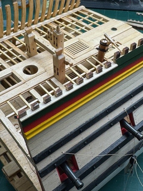

I'm getting close to the end now (since I'm only installing a stub mainmast), and this report is odds and ends of finishing details.   First, I needed to finish the exterior of the port side.  The planking above the upper deck is all clinker; the lowest of which has a double bead profile which I made with a scraper.   I used AYC for that strip rather than the kit's basswood - the AYC is easier to scrape and it's painted so the wood color difference is immaterial.    I'm using Kolderstok paint and the prescribed color scheme; it's nice stuff to work with and the colors are great.
IMG_7675.jpeg.0056ce3c1c5d6ec0ec9bc583c9aa32f3.jpegIMG_7677.jpeg.4cf67ef6d26ce246cb82edfa6f0fe458.jpeg

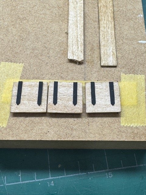

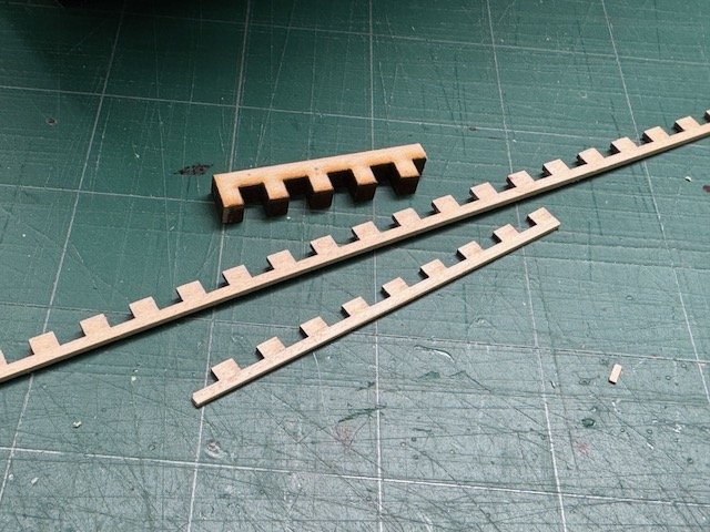

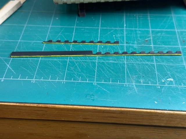

The uppermost plank's width of the side is not planked, so I had to make caprails with a lot of teeth.  I thought it would be very hard to do a neat job with it until I realized that the kit comes with 4mm comb strips used to help with alignment when erecting the frames.   So I just planed one of those strips down to 1mm, and had absolutely perfect spacing on the teeth.
IMG_7681.jpeg.0e8ed3dc8bb2a2fa887e1543a030b8d3.jpegIMG_7680.jpeg.9c2a5c93287fe9eb79b5a956dfd69a93.jpegIMG_7685.jpeg.de29a5b4ad97264586a67fe2d9a34457.jpeg
The upper caprail was just a straight strip, of course.  After that, I added the treenails in the planking, stained the result (no pictures of that), and the exterior hull was complete.

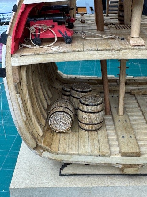

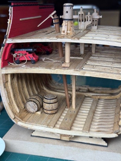

Trying to wrap up the last few tasks now.  First is a photo of the capstan, all finished and installed.   I won't install the bars, though, until it's ready to go in the case.
I've installed some barrels in the hold, plus one you can barely see on the gun deck.  They are glued down but not  secured for sea!    And I made and installed the galley chimney.   I livened it up a bit with colors since this is, after all, a merchant ship.   I was not sure how it ought to be fastened to the deck, so I settled on some stringers that mortise into ledges and deck beam.   Quite probably the kit's ideas about this are more correct - it has the chimney sitting on a couple of deck planks.  But, for esthetic reasons, I didn't want to put plank segments in that location, and what I did was the only alternative I could come up with.  In the second photo you can also see the one pinrail has been installed.

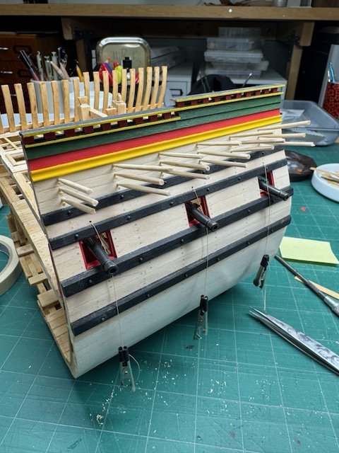

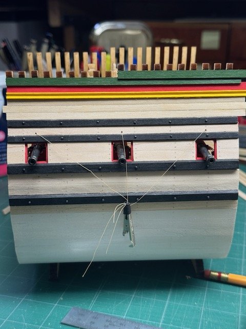

After that came the gun ports.   There is a little bit of smoke and mirrors with them since there are no hinge segments attached to the hull.   The tops of the gun ports are hard against the bottom of the 3rd wale, and I really don't know how that change in level between regular side planks and wale would be addressed in the hinges on a real ship.   So (like at least one other build log for this kit), I just skipped over that detail.
IMG_8281.jpeg.ce55ee0ba47a187f3975b9aed17b04f9.jpegIMG_8288.jpeg.319ef253da8420a5b9c528d816bb8f67.jpeg

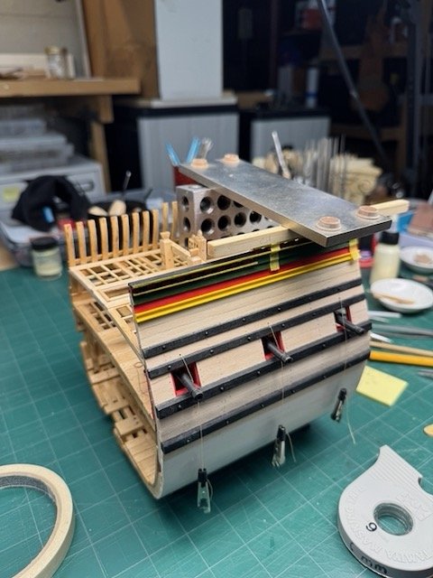

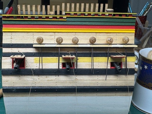

After the ports came the port main channel.   There are six deadeyes,  and I used the recently acquired chisel (with its blade narrowed down to 1mm) to cut the notches for them.   The wood for the channel, incidentally, is AYC which I used because it's better to take sharp, small cuts.  The channel hasn't been permanently installed yet, but the photos show it in position for fit checks.
IMG_8292.jpeg.8292ad2169703eae6e4cf188ec8ca409.jpegIMG_8305.jpeg.a6324d513959b50f53e135ef8f215775.jpeg
I've decided that I'll definitely make my own acrylic cover, rather than having one made for me.   I have the experience to make something that's acceptable,  but I intend to try to "up my game" on that score and see how close I can come to a box that looks really good.   Ultimately I know that viewers will not see the box anyway - they focus on the model, but I have the tools, and the web offers enough good DIY information that I think it's feasible to make something that I'll be happier with.

A long time has elapsed since my last post.    One reason for the delay is that I had a long, an ultimately only marginally successful, battle making the chains.   The long and the short of it is that I couldn't come up with a way to make them that I thought looked good.   I tried a number of ways, but never did really figure it out.    This is important to me not only for this model, but the next one up (Kolderstok statenjacht) has a very similar set up to this one (same period and same scale).  But, at least now I'm forewarned and I've had some practice.    I think a method such as Chuck showed recently on his Speedwell log might work for me.   Anyhow, enough whining (for now!)   The first picture shows my original attempt.   My objections to this, not all clearly visible in the photo, are (a) the fact that the two long bars under the channel aren't anywhere near parallel or uniform, (b) there's a wire twist under the bolt in the wale which really thickens things there, and (c) the wire twist under the deadeye that's submerged in the channel is too fat for me to install a batten over it.
At this point I stopped work for 6 weeks, did other things, thought about the chains, and ran some experiments.   In the photo above, each chain assembly uses a single piece of wire (about 23 gauge).    What I replaced that with uses three pieces of wire.  The section below the channel is a single link, as shown in the next photo.   That solved the problem of having the two bars parallel.
Around the deadeye I wrapped two wires:  a length of 26 gauge (which is never really seen) and a length of 23 gauge on top of it.  The fat outer wire is the strap around the deadeye that one sees.   It's twisted once and clipped, and acts as a stem to keep the deadeye upright.   I hate that twist,  and for the next model I intend to find a way to eliminate it.   The small wire is also discretely twisted and one arm clipped.  The one remaining arm of 26 gauge connects the link below to the upper assembly.
Everything is black, so the mess of wires and twists isn't very visible at all.   And, what matters most to me, those long bars are parallel and look reasonably uniform from one chain to the next.

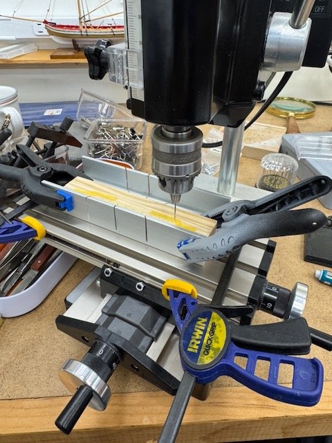

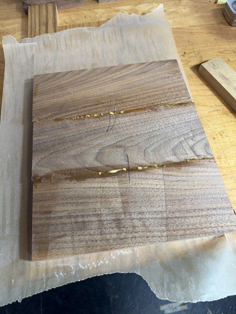

This method requires a full size tablesaw and a router table,  both of which I have.   Here are just a few photos of what I used and my setup.
IMG_9015.jpeg.a70dc7060a13b3366316b7232697727f.jpegIMG_9068.jpeg.431682ee9f4f0dc3a5f781ab315b1929.jpegIMG_9035.jpeg.c9c0ed4f3a18de6b35d61ca2b59eb5a2.jpegIMG_9037.jpeg.c95de4695d706c9aa42b9c48554fb0ab.jpeg
The last two photos illustrate a big lesson for me:  I'm using the table saw fence to guide the sheet of acrylic - the fence around the router is merely serving as a dust collector.   Doing it this way (which requires that opposite sides of the piece are parallel) avoids bumps as the work piece is slid past the cutter.
