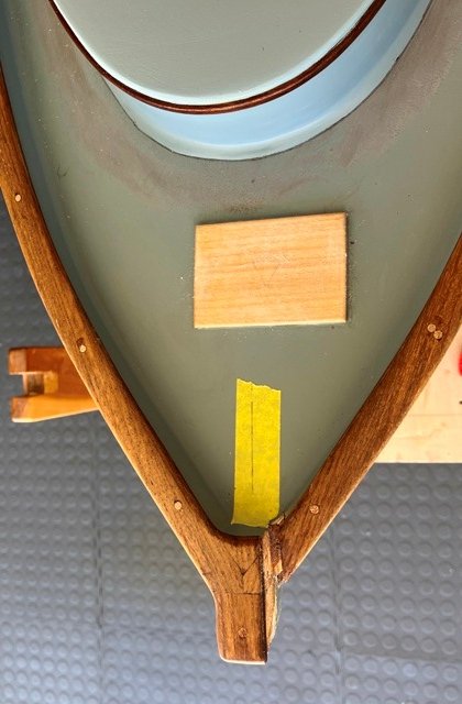

April 2, 2025 update:
Prior to permanently closing over the raised portion of the house above the forepeak,  I made provision for the speaker which is used to fool you into thinking this wee craft has a Gardner diesel in it.  A hole was drilled from below for the body of the speaker and a guard bent up to protect the projecting lower portion of the speaker whenever the PH module is removed from the deck.
April2025Image1.JPG.0c2e6def617ff927dc6e9550b5ba5e82.JPGApril2025Image2.JPG.46e5b6f497634cc283f0569248f10538.JPG
The cabin top was then planked over with basswood, faired and sealed with 'glass/epoxy.  The next task on my list was to begin the construction of the window framing for the pilot house. Upper and lower plates (head and sill?) were laid out and shaped to lay above the curved vertical face of the pilot house.

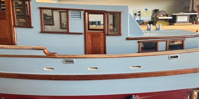

The upright window jambs were fashion from some teak and made with tenons top and bottom.  Corresponding mortices were cut into the plates.
April2025Image5.JPG.7bdb730c415f02bb49c4568307997c67.JPGApril2025Image6.JPG.05132fd07b1807a9b71e18c5b299d561.JPGApril2025Image7.JPG.e0dc1a0b384857b00bc3a26237d9e96c.JPGThis somewhat wobbly construct was then braced up and glued together.
When set atop it's future location, I realized an oversight on my part: the window framework tilted aft a bit rather than presenting  a vertical face to the elements.  For most of it, the tilt was not a problem but the after jambs had to ultimately be cut free of their tenons and re-aligned to vertical to deal with the doors. A yellow cedar header was laminated up and glued to the head plate, beveled to follow the curve of the overhead plywood from the main cabin.
April2025Image8.JPG.d1c3178e84f7b699127ea53ba227a832.JPGApril2025Image9.JPG.f11d7b20f5df54099a3223a98080c80c.JPG
April2025Image10.JPG.0a5751adb81834ae668351ec2fcc24c2.JPGApril2025Image11.JPG.9a4798160af5125e238c0c491fe63f55.JPG
The door framing was gotten out of some of that lovely Cuban mahogany and they were glued into place, reinforcing the re-positioned after window jambs port and starboard. As mentioned earlier, the whole pilothouse module is removable by lifting it out vertically.

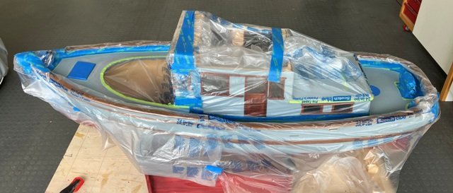

A cove between the house and the level of the deck is curing. Hopefully, unlike the first attempt, this cove will only glue to the house and not the deck.
April2025Image22.JPG.f7fc7166a539508bc75a83f7c5b5a2fb.JPG So step up and take a look.

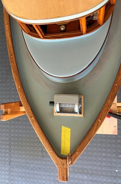

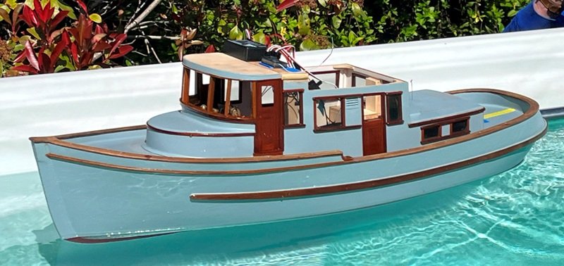

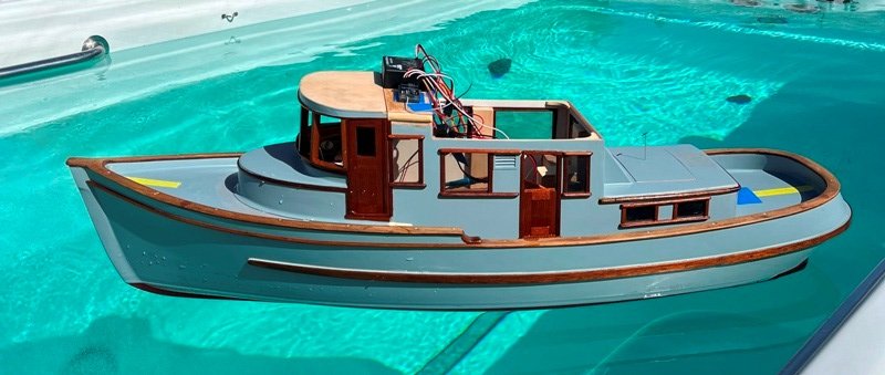

The pilot house lower shape was fiddled with to make a tighter fit to the deck and the electronics were (again) cobbled together to be raised above a probable splash zone. We then traipsed over to some friends' small saline pool for a preliminary "splash test".
The good news was:
 - She floats!
 - She did not turn turtle!!
 - There was no noticeable heel.
 - At this stage of the build, the trim was only slightly down by the bow.
 - The mechanical bits worked as hoped, both in forward and reverse.
 - She did not take on any water.
The "not-so-good"news resulted a couple of days later.
TWILIGHT was back in my shop with the cabin sole hatch above the motor room removed while I tested some re-worked wiring runs.  The 12 VDC feed into the ESC (electronic speed control) shorted within the potted portion of the unit and a (thankfully brief) fire resulted.  While the ESC was truly "toasted", the fire was quickly extinguished when I shut off the power and none of the model's structure suffered damage. However, a goodly amount of acidic smoke permeated the interior with an acrid stench.  The next couple of weeks were consumed disassembling, cleaning and reassembling everything removable as well as wiping down as many surfaces as I could get at within the model's interior. I did  install a new ESC.
While the fire was a setback, I am very grateful that it did not occur sometime when TWILIGHT might have been underway, out of reach - on some lake or pond!

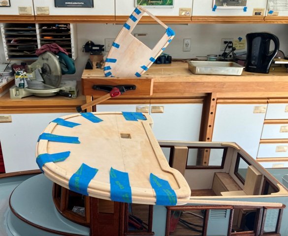

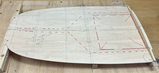

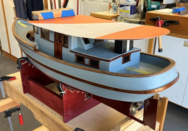

 Once building could recommence, card template were made for the outline shapes of the pilothouse and main cabin roofs.
Julypost1c-Copy.JPG.e816a9c0b8128ba1848333a4edc5d94f.JPGJulypost2.JPG.15503e66cf4adf4efc88fdecd457424c.JPG

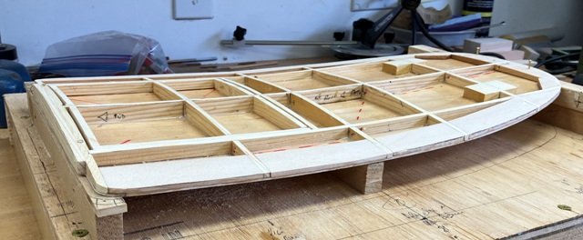

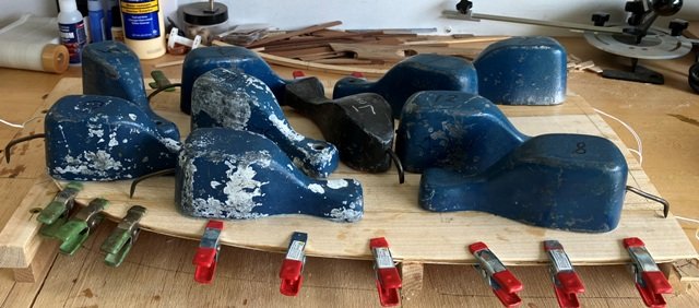

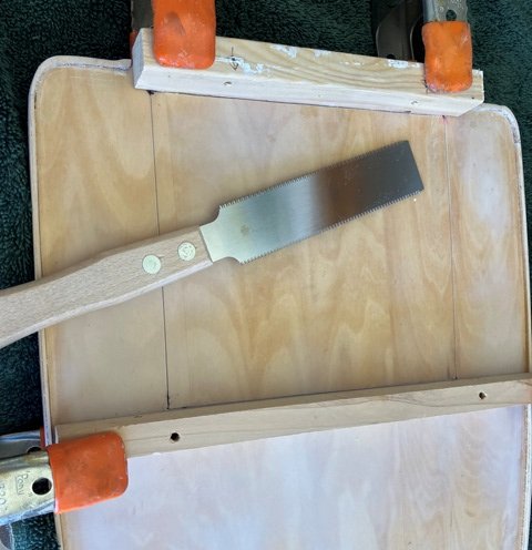

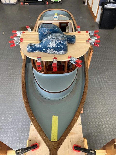

The main cabin roof was built as a hollow, stressed skin structure (much like an aircraft wing) with 1/16" thick birch plywood for top and bottom skins and AYC for beams and framing.  The roof for the pilothouse was built with similar construction, though without any compound curvature.
Julypost3-Copy.JPG.2c97e307f14338e9997bc627c48b02db.JPGJulypost4-Copy.JPG.2dfa687d57c4537dd81638915cb90dc1.JPG
Blocking for hardware supports and the carlins for the access hatch were fitted prior to gluing down the top skin.
Julypost6-Copy.JPG.9de7d5d90fdea271f5d71b0afc90ffcc.JPGJulypost7-Copy.JPG.18038d1d20e89762359674b78d8b59ed.JPG

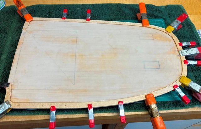

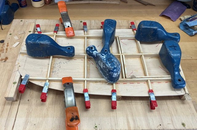

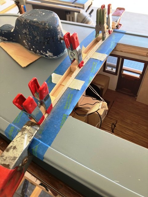

The upper skin had to take on a subtle compound curve and this required various clamps and weight to ensure a tight glue fit along and around the supporting structure.  Once cured, both roofs were were set aside to permit work to progress at deck level.
Julypost8-Copy.JPG.00038fc3545dbb8eccd1d0d8d31366cb.JPGJulypost9-Copy.JPG.134e6cd13959a44087c7a9c0447c515d.JPG

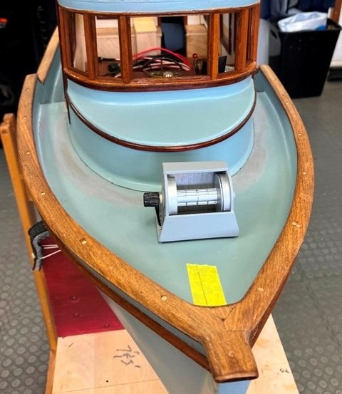

Aboard the planned full-size TWILIGHT, we had envisioned using a sturdy, commercial-grade fish-boat style hydraulic-powered, horizontal axis anchor windlass, so for the model, the location on the foredeck was given a raised basswood pad.  The windlass was built up from 1/16" plywood, a re-purposed thread spool and with a spare fluted knob serving to represent the hydraulic motor.  The bulwark just to port of the stem was carved out to receive a soldered brass anchor roller assembly.
Julypost11.JPG.fbf427ae55d627484f769d90c54322e8.JPGJulypost12.JPG.535cc1722be2da3345feeab317689b5c.JPGJulypost13.JPG.4542fd507acb9fd71fe0210a287d41d1.JPG

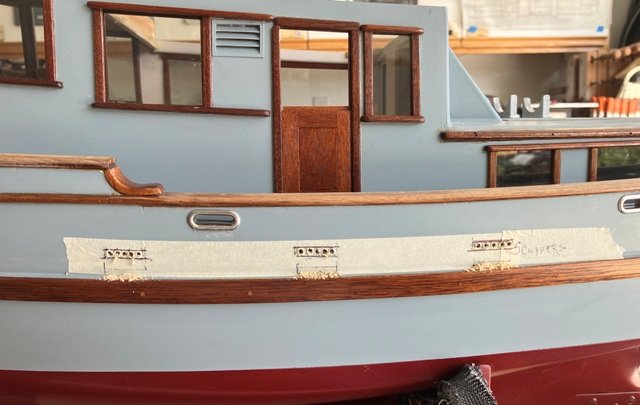

The bulwarks alongside of the main cabin were drilled out and the holes filed to shape in the proper locations for the hawses and scuppers.
Julypost14.JPG.af136065aeec19e10d13435fccd97a96.JPGJulypost15.JPG.d67ffc1734988fe5bd9514a6161e6c50.JPGJulypost16.JPG.cbdf619a8ff2d77022533d638d665721.JPG

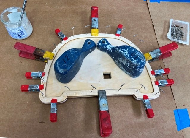

Back to working on the roof panels.
Julypost17.JPG.dc88925e29d35852ae804794350f5744.JPGJulypost19.JPG.f12a3441c9813a6418de4c947678f0d5.JPG

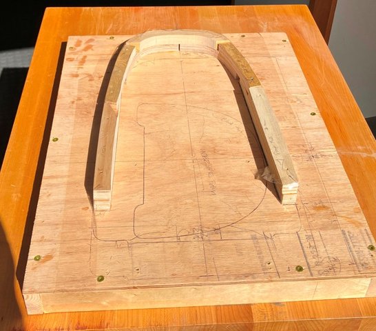

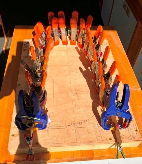

A laminating form was fashioned from scrap blocks to provide clamping positions when steaming and laminating the 1/16" thick basswood layers which formed the main cabin top fascia trim.
Julypost20.JPG.01a3c6294ce385d02578f2be000c2fad.JPGJulypost21.JPG.bc61a72be503bcbe2ad9f07978ba7bab.JPG

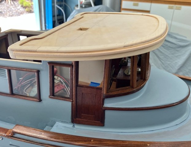

The cured, slightly over-height fascia was glued and nailed to the outside vertical edge of the cabin top roof. After the glue hardened, the upper and lower edges were then planed to the desired profiles in elevation.  Margin pieces (covering boards) were then glued to the cabin top surface, overhanging the flush roof-to-fascia seam. The outer edges of these covering boards were fair flush with the outer face of the fascia and the upper corners rounded off.  The pilothouse roof was built up in a similar manner.
Julypost22.JPG.d996d99eed5205c4bd72aa6533a05459.JPGJulypost23.JPG.9c5781dea0ffb906f81bc0363a1211d0.JPG

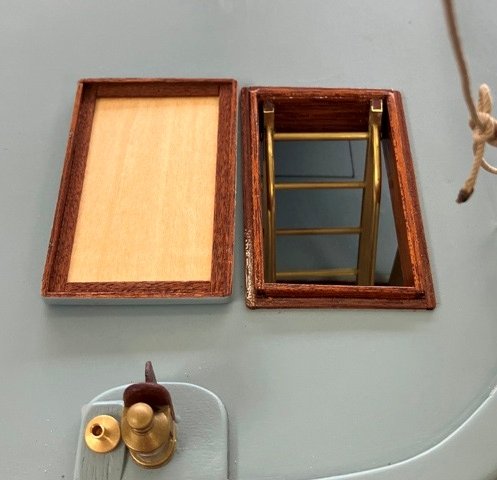

An access hatch down through the main cabin was necessary and was cut out by first drilling #55 vertical holes at each corner, then scoring the upper and lower skins with a sharp scalpel. I used the fine teeth at the tip of a small pull saw, riding in the scored lines and braced by clamped-on guides to cut through the skins into the spaces between the interior pairs of carlins and beams.  The piece of roof removed was then slightly smoothed up and given upper flanges to serve as the hatch body.
Julypost24.JPG.f7f949493cf37e074d9dc9511e6b1b90.JPGJulypost25.JPG.695accaba6a2d30d9adb5321c1b0a2b7.JPGJulypost26.JPG.f587d432eaef210a59f4a64e2df8c9d0.JPG

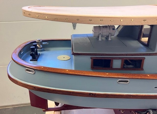

The heads of the Anchorfast copper boat nails, which were used to pin the fascias to edges of the roofs, had been set flush and they were now covered by the installation of glued half-round bead trims. These trims will ultimately be painted a contrasting color.
A forward-projecting "brim" was carefully shaped to attach to the lower edge of the pilothouse fascia, supported by small knees. A 1/32" x 1/32" mahogany strip was smoothed to a half-round shape and glued to upper side of the brim at its lower edge to serve as reinforcement.
Julypost28.JPG.dcc90115fe3305a30b979c86c10b53cf.JPGJulypost29.JPG.f777d8bd98e7271916105f10ef4377c5.JPGJulypost30.JPG.b6c43a1645527acd0ef83dee5423963a.JPG

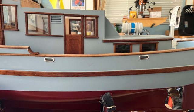

The port and starboard running light mounts were glued up from basswood (and the outboard faces painted black). The light fixtures are outfitted with the appropriate colored LED's and the assemblies were then affixed onto the permanently mounted after portion of the pilothouse, with wires fed down and inboard in small holes into the upper corners of the house.
Julypost39-Copy.JPG.ab07084c2d8d619d7c2b97543d5a681a.JPGJulypost40-Copy.JPG.72d6c81e5be325947bc3e8613f91277c.JPG
While the forward removable portion of the pilothouse was lifted away, a mahogany and AYC vertical "trunk" was fashioned (in the location where the originally planned dry exhaust stack for the Gardiner diesel would have risen through the main cabin.  The trunk permits necessary wires for the various R/C switches to be led to the pilothouse roof for convenient shoreside access.
Julypost41.JPG.7811f1aeaad676ca1d530b5297e34b14.JPGJulypost42.JPG.ab3330286e0d9510197f29d91a96cfd6.JPG

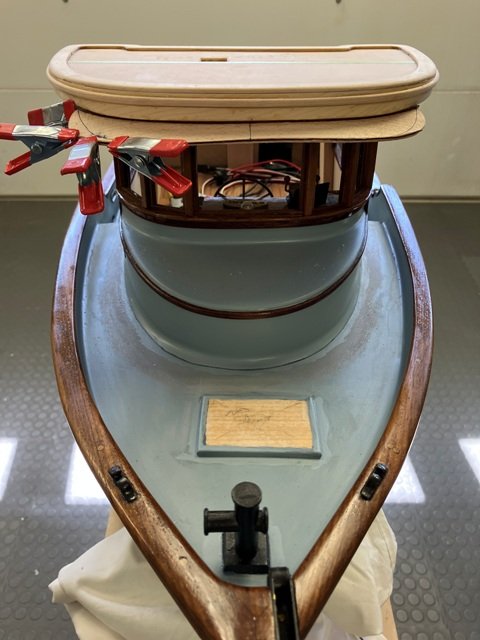

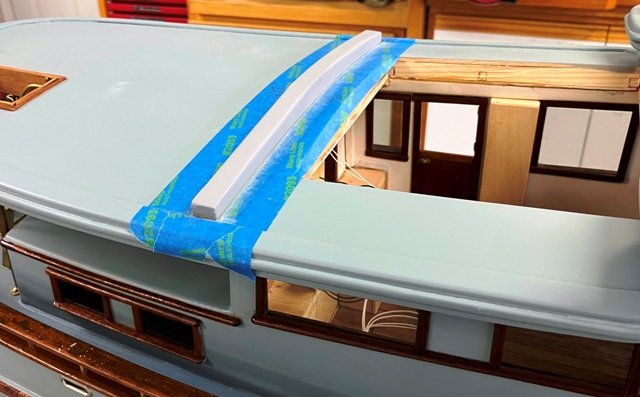

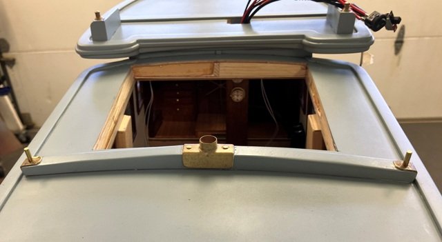

Before securing the main cabin roof to the house, the necessary preliminary (hopefully unobtrusive) wiring runs for the stern light and some interior lights needed to be developed.  Additionally, a change in location of the ladder access to the cabin and pilothouse roofs was made from that drawn on the original drawings. The ladder was moved from a position partially obstructing the helm's view to a location at the aft end of the boat.  A rectangular access hole was cut through the main house roof with my usual method and then faced with mahogany trim.  Also visible are: the stern light and flag pole socket, the black-capped top of the (hydraulic) warping capstan and a stout double "H" bitt for the occasional towing opportunities/requirements which might well arise.
Julypost44-Copy-Copy.JPG.51dfb8653851ea75f91c521ae68feb8c.JPGJulypost45-Copy-Copy.JPG.4c89fd6791846d159d178b5ae127b41a.JPGJulypost46-Copy.JPG.68484795fd7b94bfb59f0515e7ed97d1.JPG
The access ladder has been fabricated ( for the fun of it) from hollow rectangular brass  stock, 3/32" dia. tube rungs and closely fitting brass brads. It does still need a pair of handrails for safety before installation.

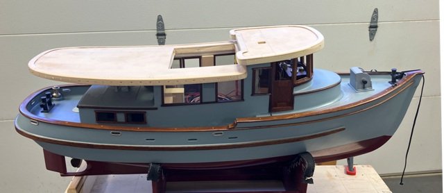

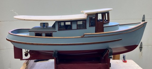

A fair amount of work remains to be done above the roofs as well as with the finalizing of the topside R/C mountings. I am also hoping to to build the main cabin joinery as removable modules later this year.
Julypost47.JPG.fec802a6b5e894683636dc9633b00a7d.JPGJulypost48.JPG.8d60171acd109653f14b1c309abaf791.JPGJulypost49.JPG.77b05dbf54fb8c581798d5c4d4b74239.JPGJulypost50.JPG.872f3ecf0bbca73315dc7144b1a223cf.JPG
Until again, my heartfelt thanks to all of you for following along with the progress of this build. Your comments and suggestions are appreciated and always welcome.

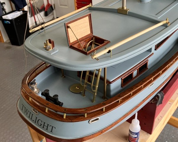

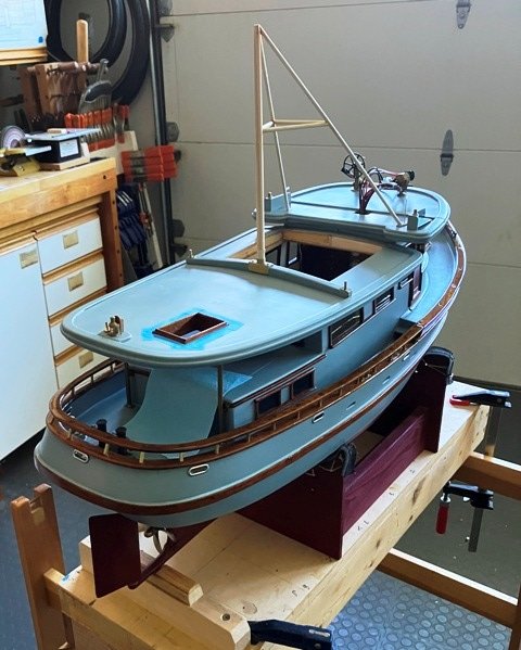

August 18, 2025 update:

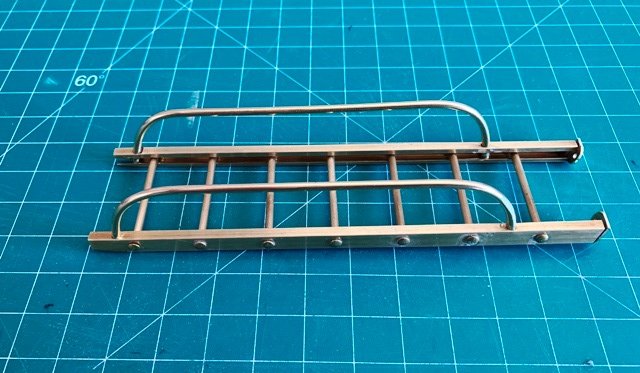

The handrails for the ladder up to the roof deck were bent and fitted to the ladder which was then positioned on the aft deck.
Augustpost1.JPG.563fe4b6dba8f5e12511b6ba151edba4.JPGAugustpost2.JPG.415275bc18037ad65269fc1b7f11c1fb.JPG

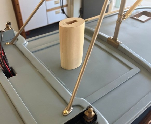

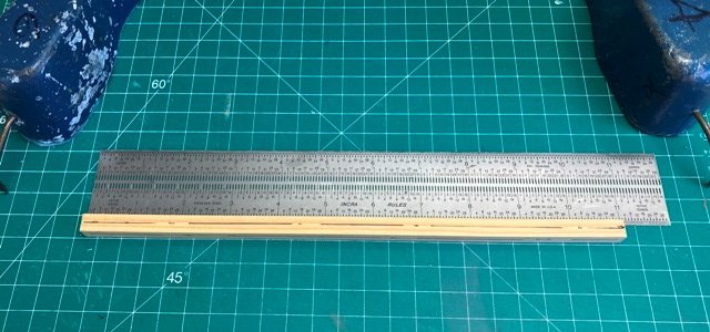

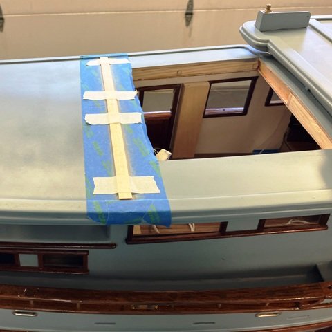

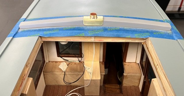

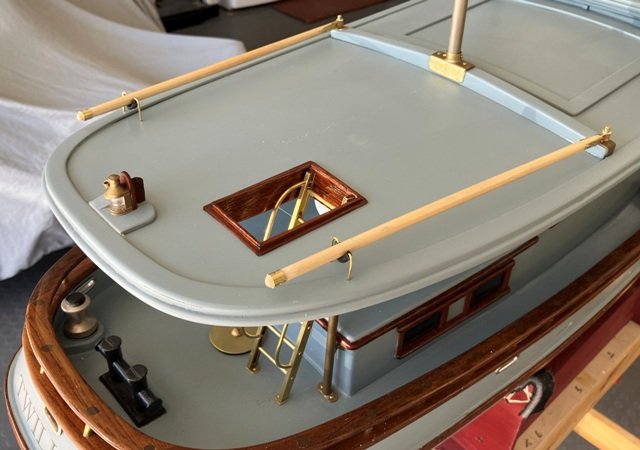

The mast installation began with the layout for the mast support beam. This structure was built up as a hollow box beam spanning the width of the main cabin top.
Augustpost3.JPG.7c68af53ab2eb7bb764255ff586ad7a7.JPGAugustpost4-Copy.JPG.480b9b697d8ca351c6f0db41d7d165ea.JPGAugustpost5.JPG.0f2a09c720971f6ce0138f80b02459af.JPG
A soldered brass mast step was fabricated to hold the base of the mast and after being filed smooth, was painted and installed on the support beam. Fittings were also fabricated to fit the ends of the support beam to provide pivots for a pair of boat booms, port and starboard.
Augustpost6.JPG.3ff05e9d913605756b4572e069b526ff.JPGAugustpost7.JPG.a788f4417fae17911f55dc65bd2fe6c6.JPGAugustpost8.JPG.e41adf29b27b82fa3ab3150ee6582163.JPG

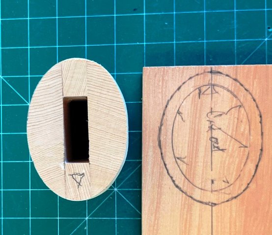

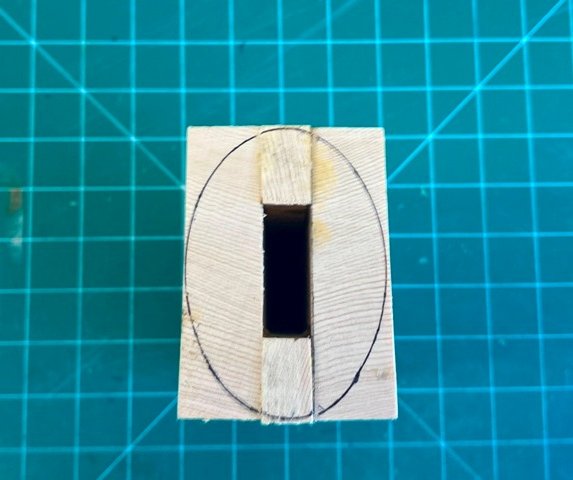

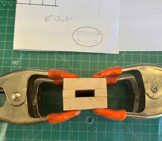

The mast was tapered and then rounded from spruce square stock. The round forebraces to the top of the mast were fashioned from birch dowel stock as well as was the necessary bracing for the radar mount.
Augustpost9-Copy.JPG.04ee1c3ddcc3adeb87a094659c001b9c.JPGAugustpost10-Copy.JPG.12ee1b5676515f4e4bf191f9d9451629.JPG

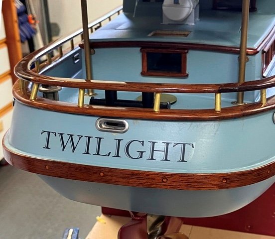

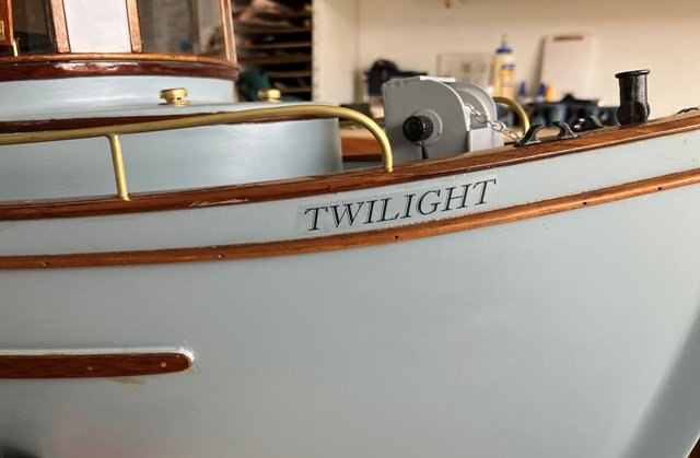

A kind friend printed up a set of water-slide decals for TWILIGHT's name placements. Fortunately, he made spares because I had to go "back to school" on how to properly install and seal the slippery critters.  After they were thoroughly dry, they were (later) sprayed with flat, clear acrylic to better blend them in to the existing paint job.
Augustpost11-Copy.JPG.6ea8d860ebb0fc741953500416b43f04.JPGAugustpost12.JPG.bf4930e04975a0df9e5adb852e34edb9.JPG

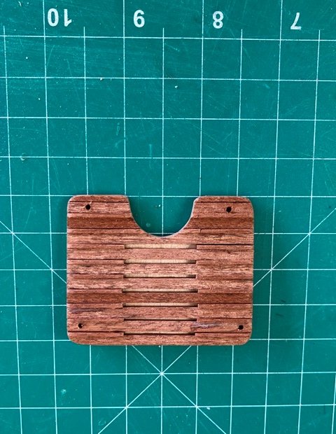

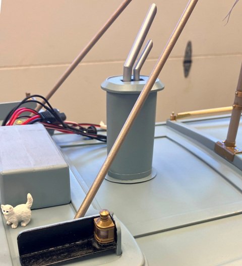

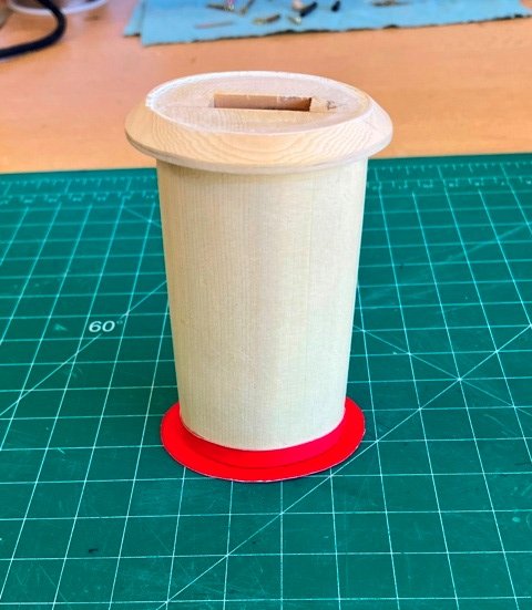

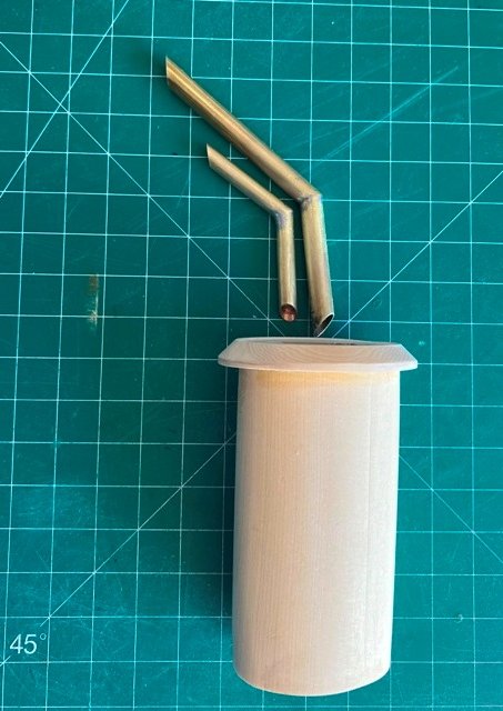

The upper "Maneuvering Station" pedestal and a searchlight were installed atop the pilothouse.

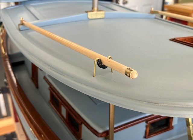

A pair of pivoting boat booms were made from spruce square stock, tapered and rounded. Goosenecks were soldered for the forward(inboard) ends and brass sleeves were positioned on the aft ends of the booms for later rigging connections. The boom crutches were bent from 1/16" rod and padded with split pieces of black wire insulation.
Augustpost14.JPG.b5943a5ba5736912674dbcfba7951c65.JPGAugustpost15.JPG.3ee747649e2ed05a0e57d8adb32d7080.JPGAugustpost16.JPG.8e781cdbeced7c8e0930f985671e97e9.JPG

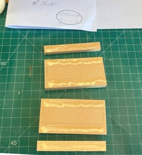

The basis for the elliptical-shaped funnel supporting the exhaust stacks was laminated from small pieces of AYC, then band-sawed to a close tolerance. Once sanded to the final section shape, a piece of AYC was cut to tightly fit around the top of the funnel and this was beveled to give the desired upper flange shape.
Augustpost17-Copy.JPG.6d9d7cc60000291da35a7c697f3596c6.JPGAugustpost18-Copy.JPG.e8ad5848a05b694bbc66895bafa63829.JPGAugustpost19-Copy.JPG.8d64677878619f2ec0f19df045c78c17.JPGAugustpost20-Copy.JPG.773898f430b236a78bd9d03881f248ec.JPG
The shaped funnel was placed on top of the removable main cabin top hatch to check clearances whenever the hatch was to be lifted clear in order to avoid future conflict with the mast's fore-braces.  Card was used to create the two portions of the deck flange for the funnel. Suitable sized pieces of brass tubing were beveled and then soldered together to represent the tubes of the dry exhausts exiting up through the funnel.  These tubes were glued into the funnel after also checking that they would not hinder the hatch removal (and in the real world, not send the diesel exhaust directly up into the bottom of the radar).
Augustpost21.JPG.c37b6e668d8a91c13ac608d80ee7b70f.JPGAugustpost24.JPG.0e198d141d574c0fb284ab7d78dd7f68.JPGAugustpost25.JPG.bcfa49349d20d21fba16fa83cdb6b17a.JPGAugustpost23.JPG.1a068d621c58a6fb4251f1457c0d37b7.JPGAugustpost26.JPG.7b7d6de4ea7dea03ed5853a69d96668f.JPG
A non-skid "grating" was glued together and the bottom beveled to level out the slope of the pilothouse roof in order to provide secure footing whenever the "maneuvering station" was to be utilized. A brass safety railing was soldered together and bent to the necessary shape for security on top of the pilothouse.  (I see that I will have to go back to slightly torque the alignment of the steering pedestal.)
Augustpost27.JPG.3945e2b5e0d0eb3c76df67d286831dca.JPGAugustpost28.JPG.a937c1ebf0df52cb7e61c154879a6433.JPG
A "hinged" hatch cover above the access ladder to the roof decks was the next item on my list. This was glued up from 1/16" birch ply and trimmed with mahogany to match the hatch coaming. I decided that it would be mounted in the braced open position.
Augustpost29.JPG.5ddf9019cc4ea70fc5e9618e0c4e2b2f.JPGAugustpost30.JPG.febe0e1ca1899e3d174ee4286a2c1370.JPG

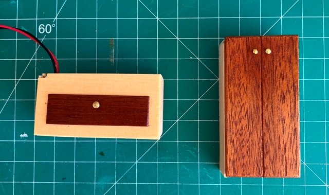

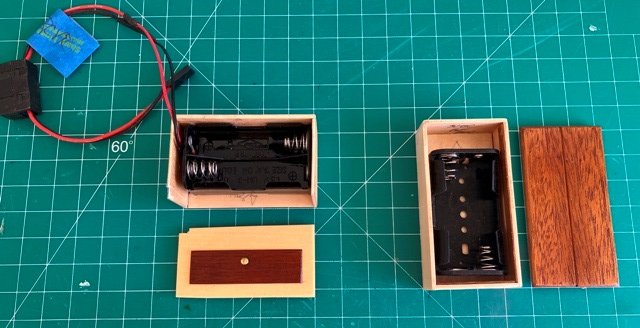

Joinery "cabinets" have been constructed to contain the 3 VDC and 6 VDC battery holders out of sight in the pilothouse and the main cabin.
Augustpost31.JPG.b76e4f3d5b3575faabd06d4282a0c454.JPGAugustpost32.JPG.e9f99b9e0c32a80c4f999b28e51780d1.JPG
And that will bring us current. As with nearly all boats, there remains a list of projects/tasks yet to be completed.
