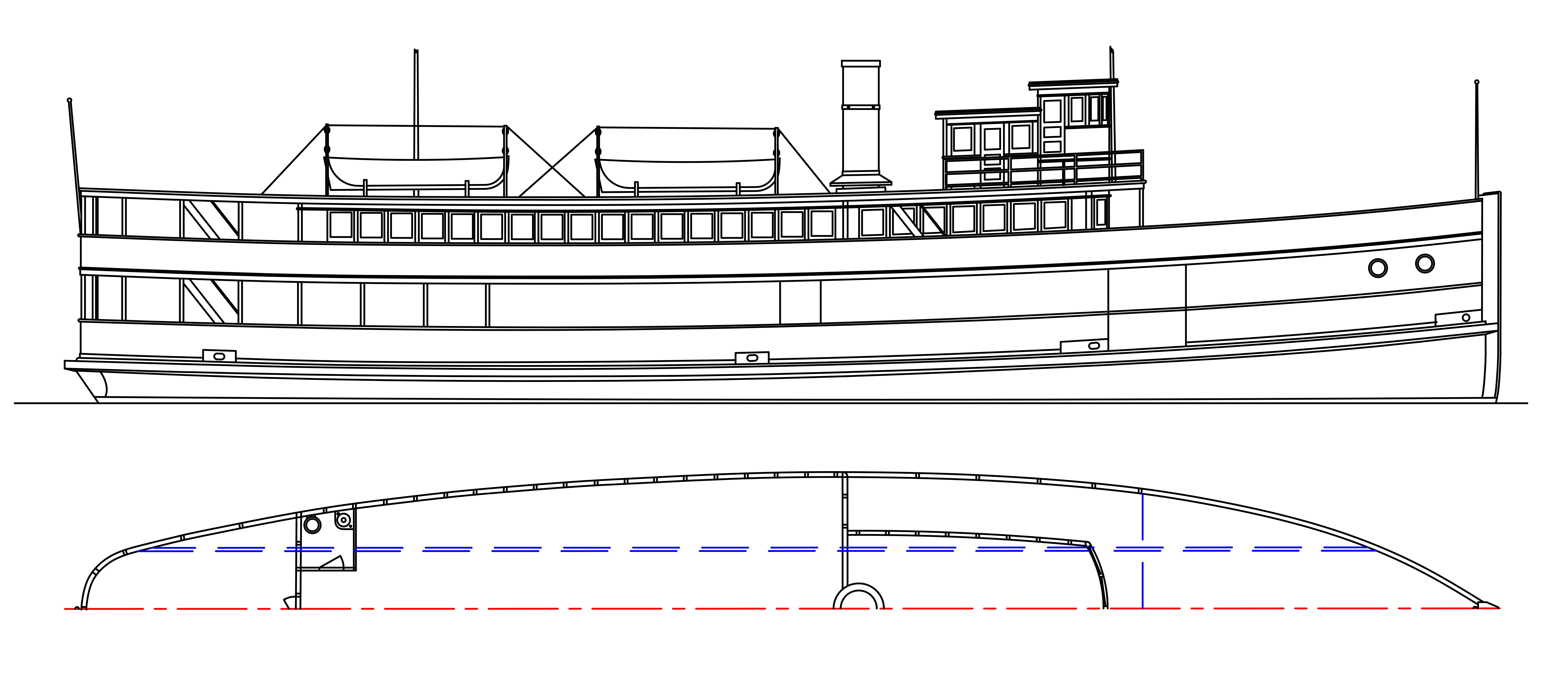

Right now, I'm waiting for all the existing drawings to be professionally scanned.  Note that the following drawings were laid out on the floor and photographed with a cell phone, and as such will not be used for anything besides initial planning.
This first drawing comes from a set drawn by the builder's son in October 1921.  As a primary source, it is obviously valuable, but there are differences between these plans and what was actually constructed.  For example, there was only one pair of boats on the boat deck (as can be clearly seen in the maiden voyage photograph).  One of the other drawings contains features that, while present aft, did not run the length of the ship.  However, I will use these drawings to get dimensions for windows, the wheel house, etc.  There are also no known photographs of the starboard side prior to 1934, so this is the only data I have for window configuration on this side.

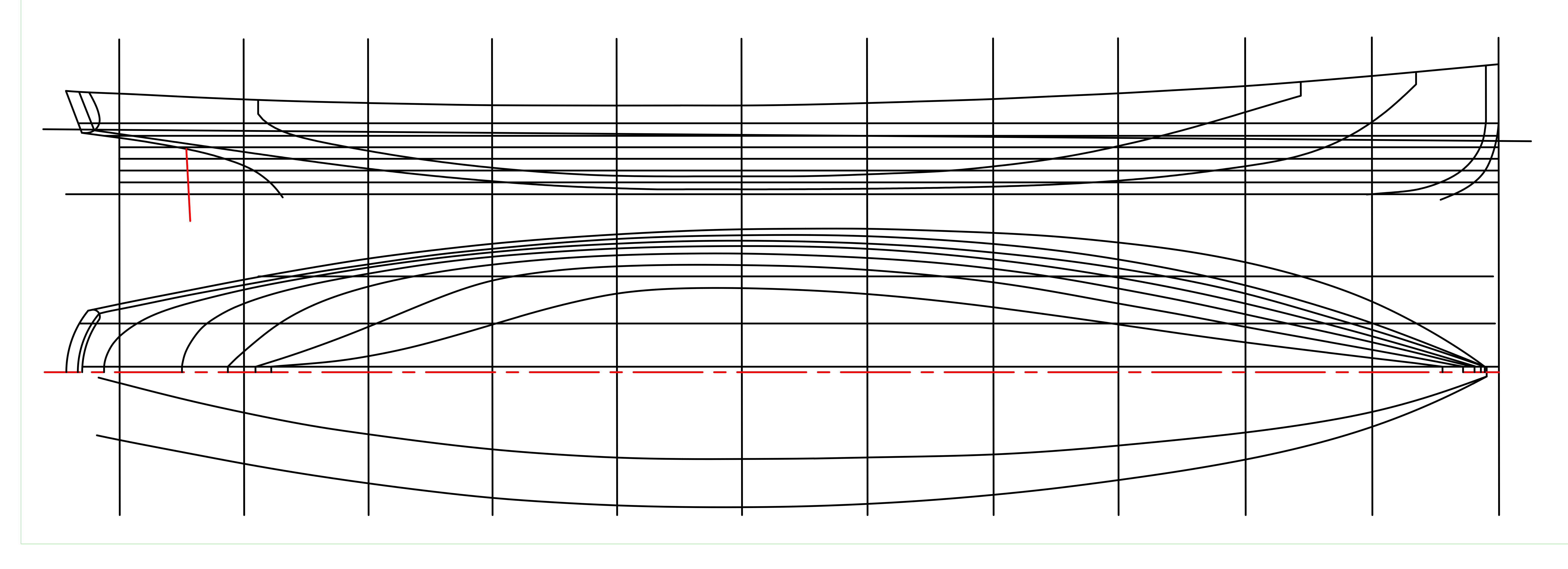

Lines, as drawn 1934 by a professional marine architect.  I will be referencing these as well as measurements taken off the ship when I draft my own drawings.

I can see that the discrepancies between the drawings and the photo is going to create some interest. I notice that the  stern end of the shelter on the lower deck is curved in the second drawing and square on the 1st drawing, it is square on the 1922 photo and curved on the ship today. Lots of opportunity for research. Her lines are quite nice - will the planking be visible or masked by filler?
