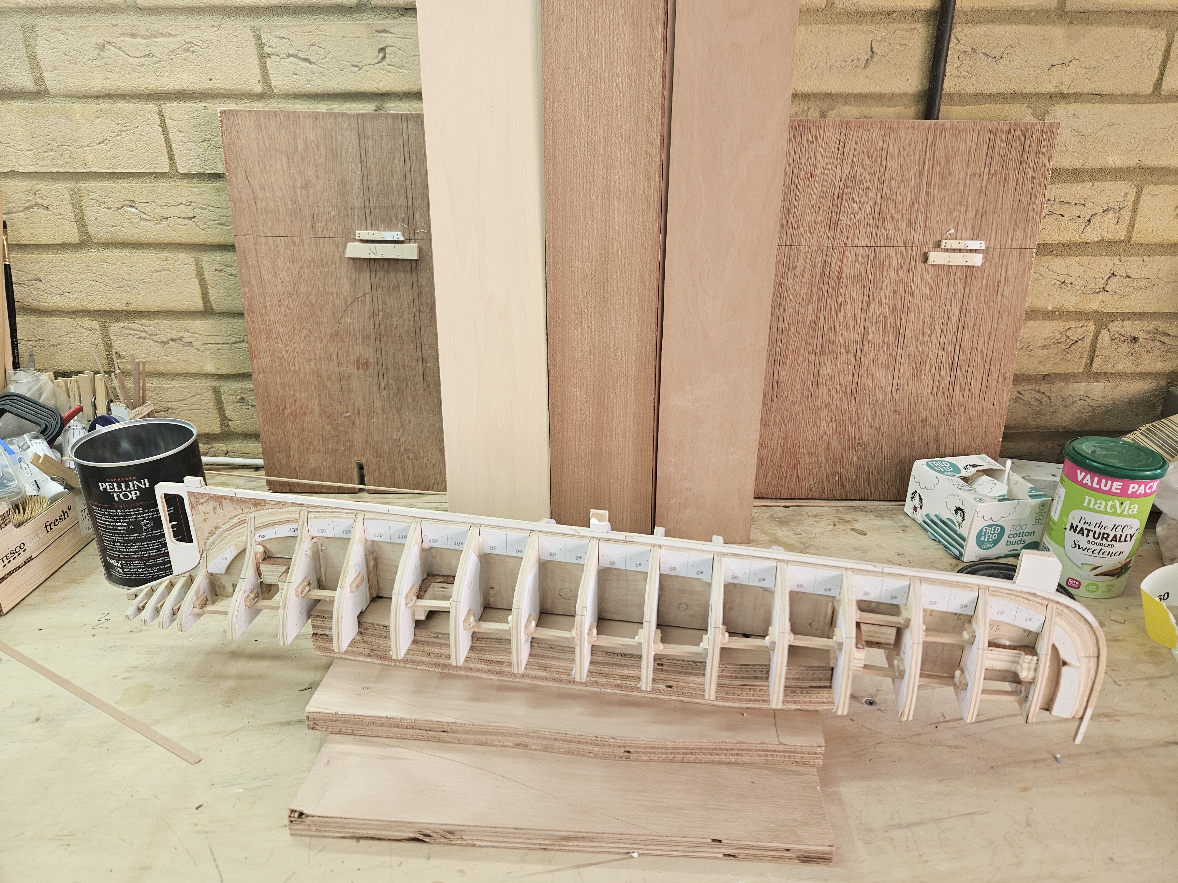

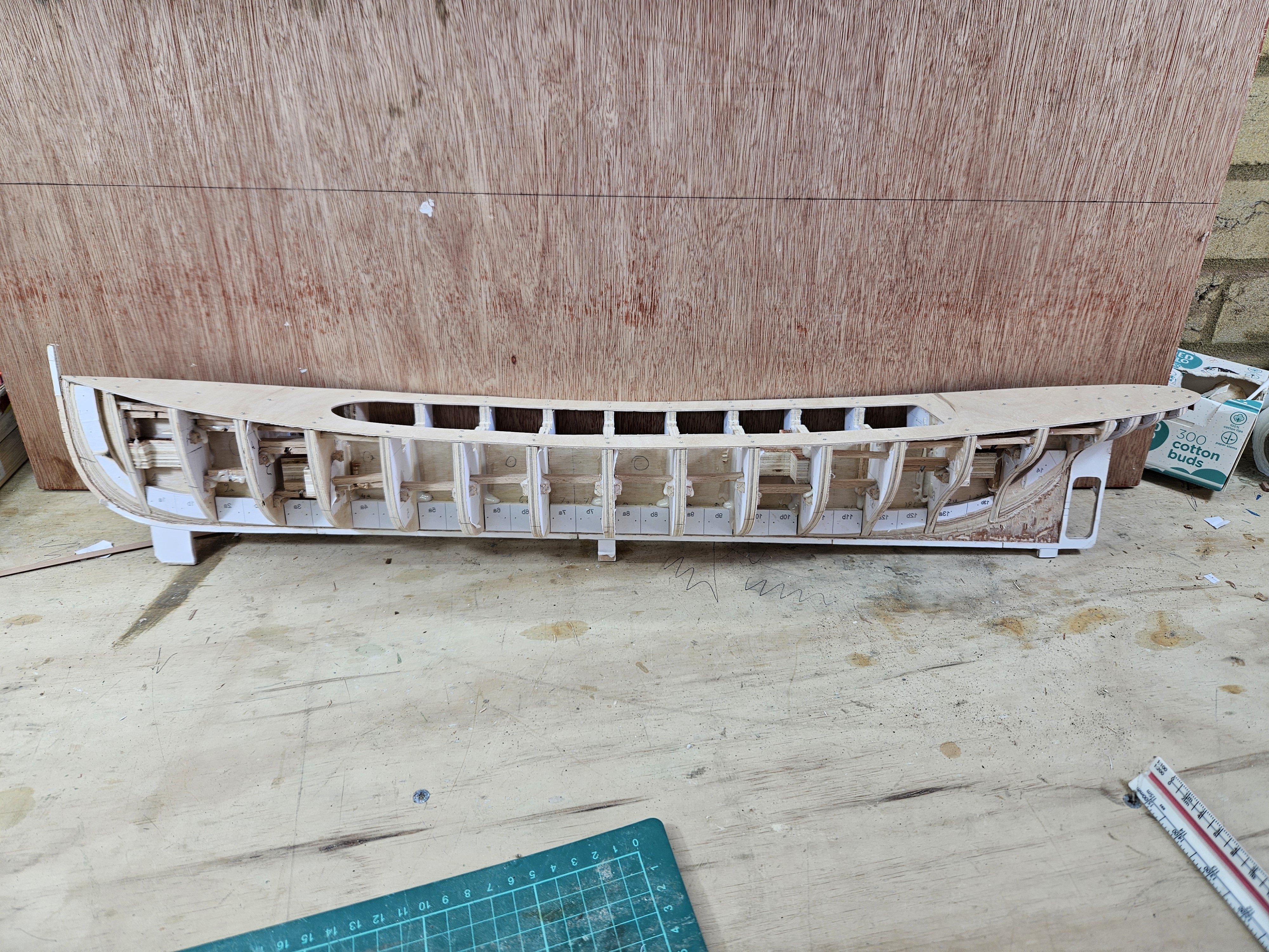

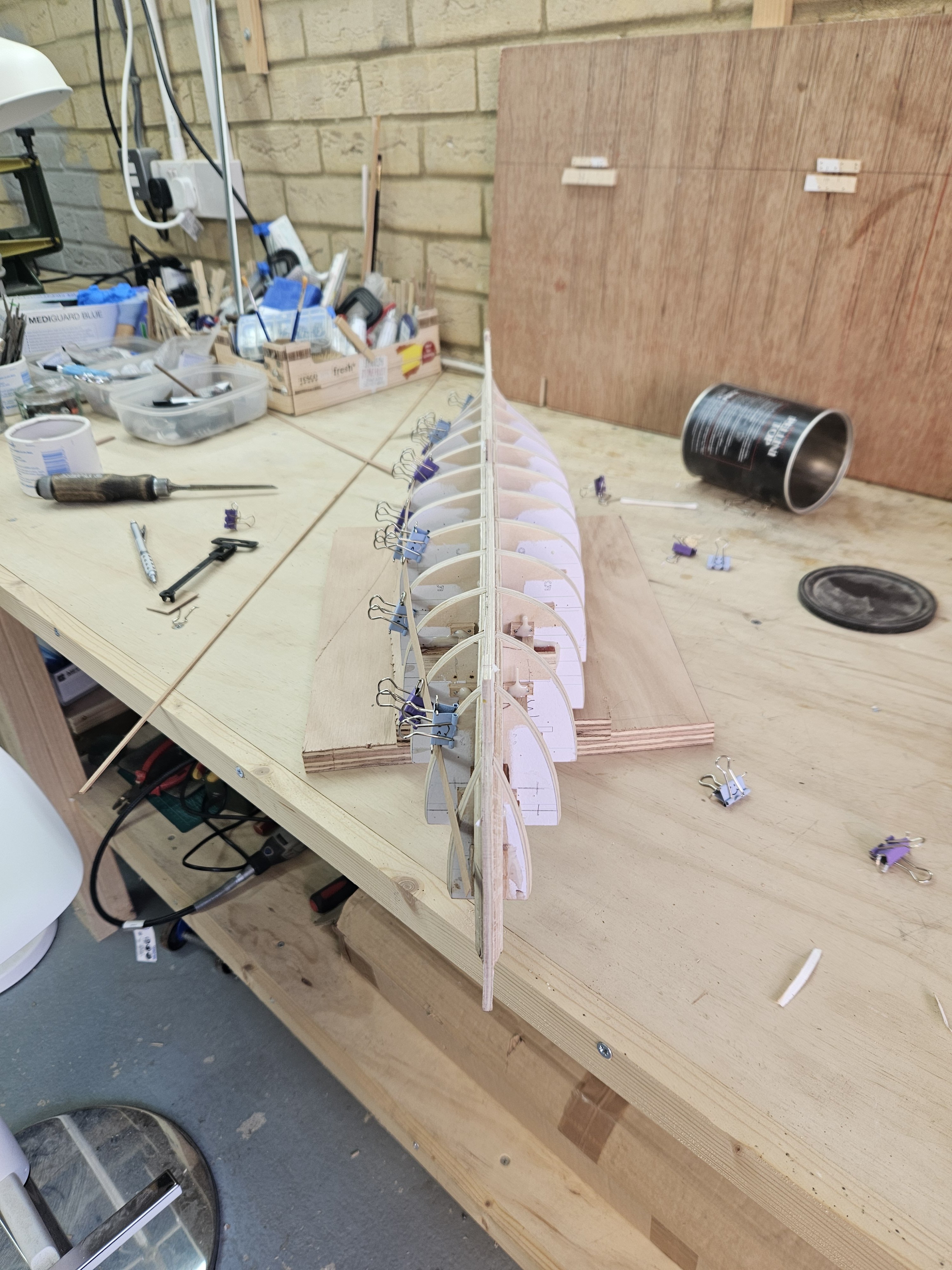

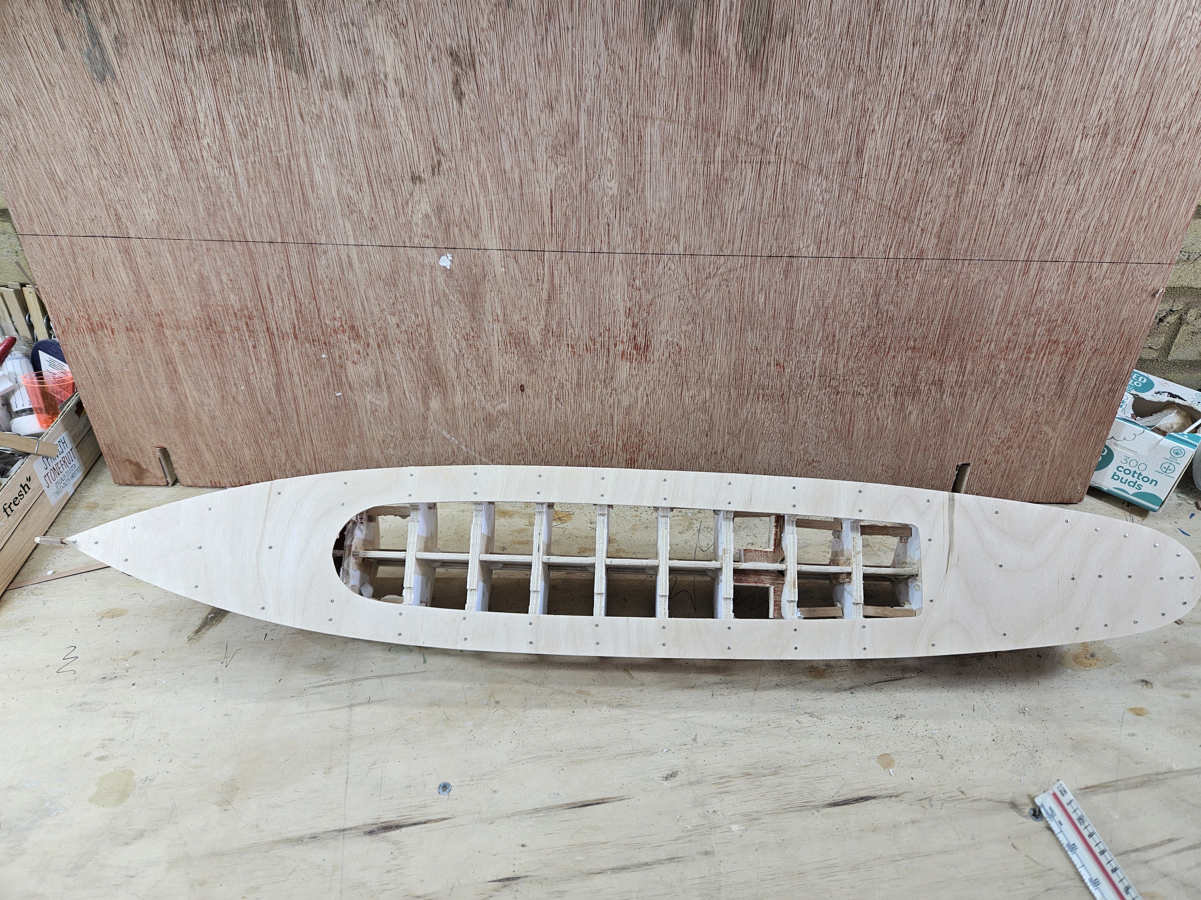

Now, this is my first POB model so I am figuring things out as I go. I made a simple jig to hold the keel straight and secure and some plywood right angle pieces. I did a lot of work trying to figure out a way to make sure the frames are square to the keel and installing pieces of wood to provide reinforcements and to connect all frames together.
The keel was decidedly bent, it is the first time my epoxy laminates fail to produce a dead straight sheet. Brute force and a heat gun improved the situation a lot.

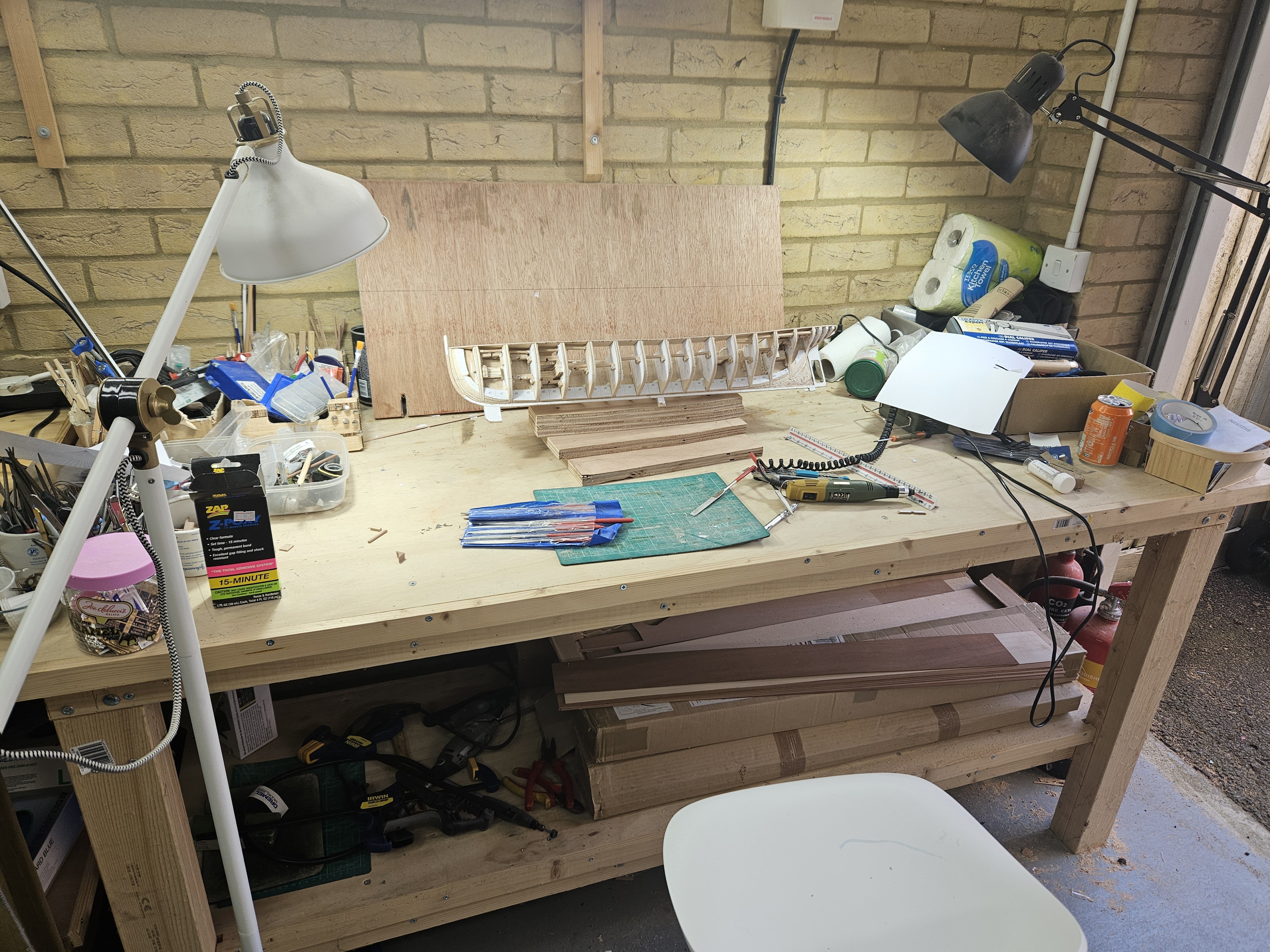

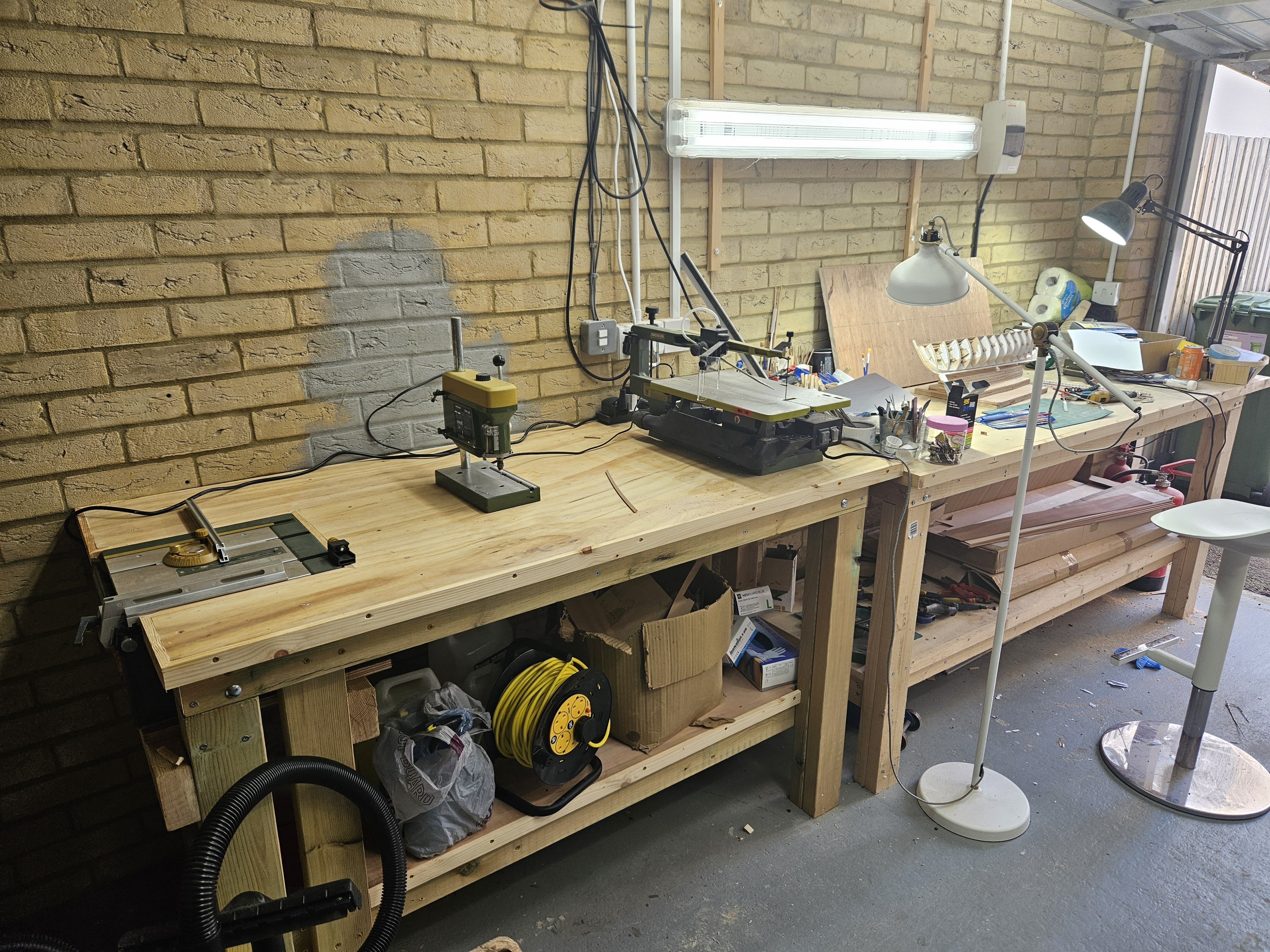

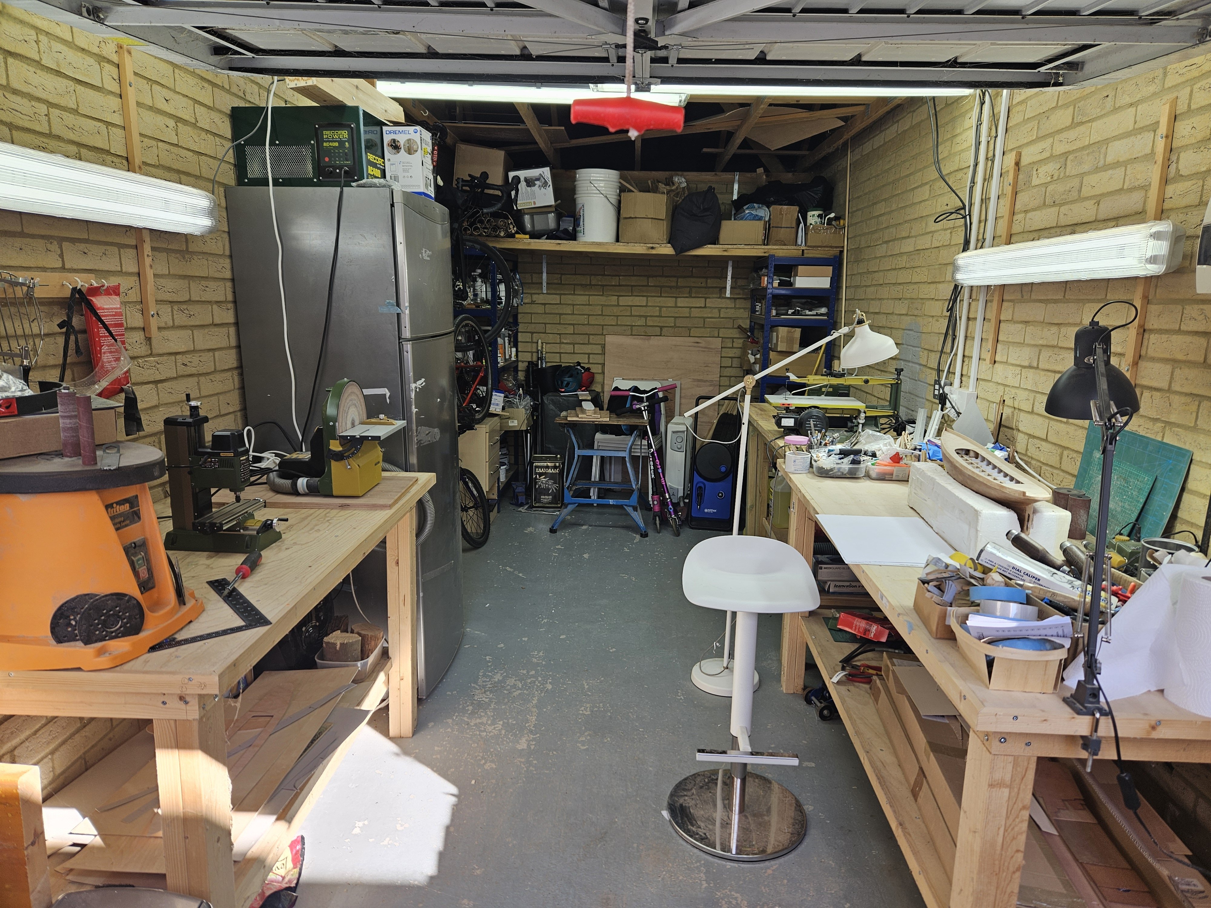

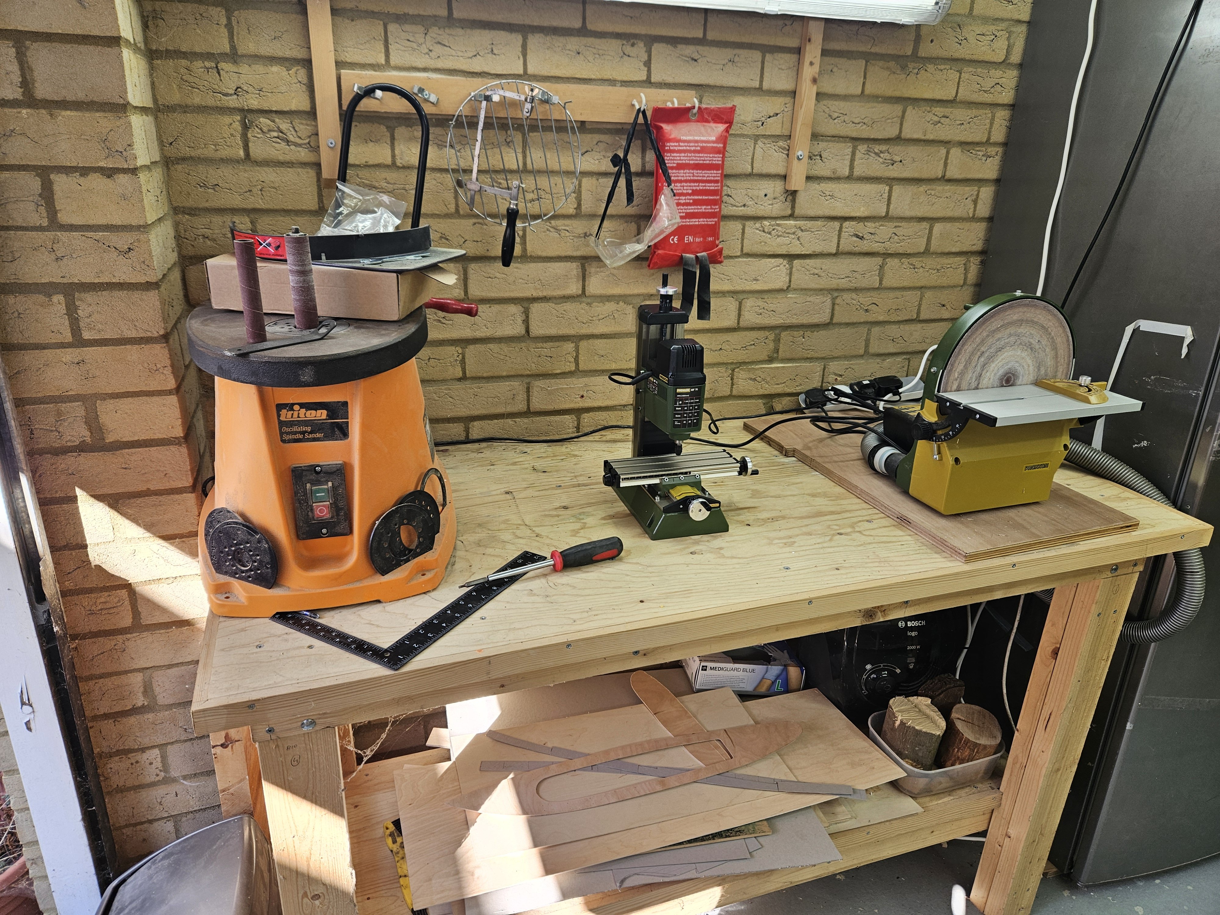

Now at this time, I had to stop and deal with my benches, tools and garage. I was running out of space, too many tools squashed close together in a very full garage. Also, the Axminster disc sander I was so excited about proved garbage, not pleased with their customer support either.

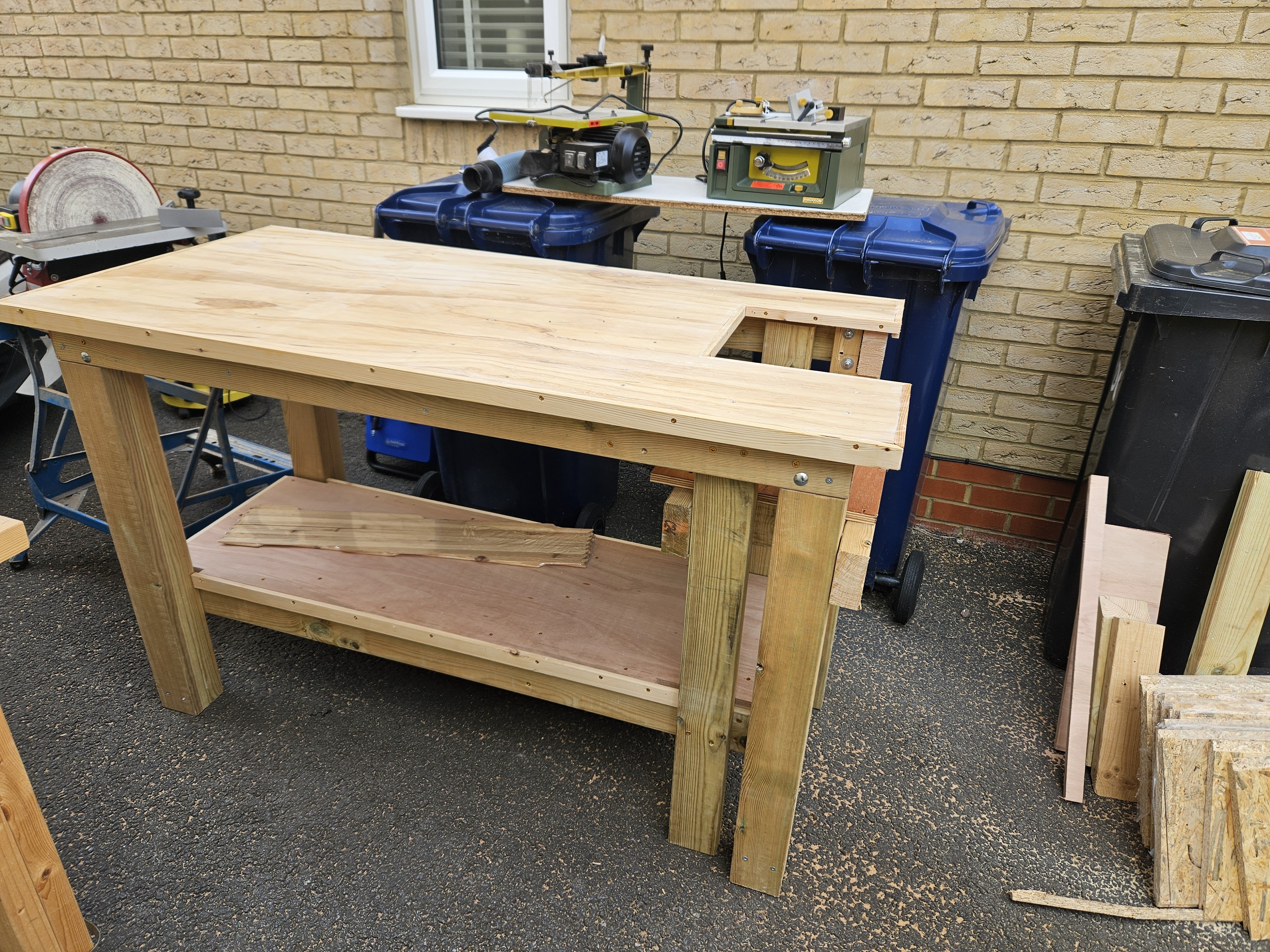

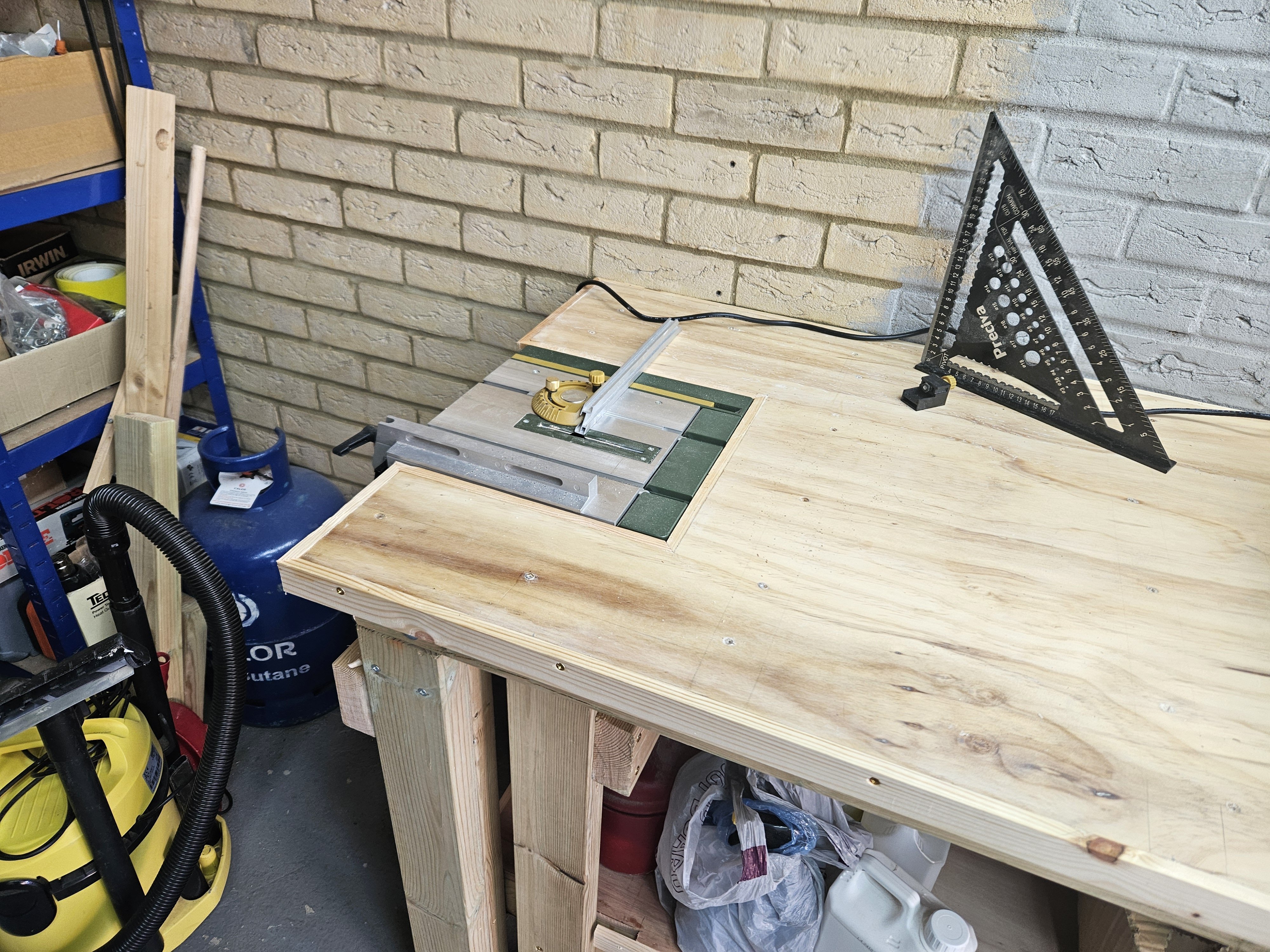

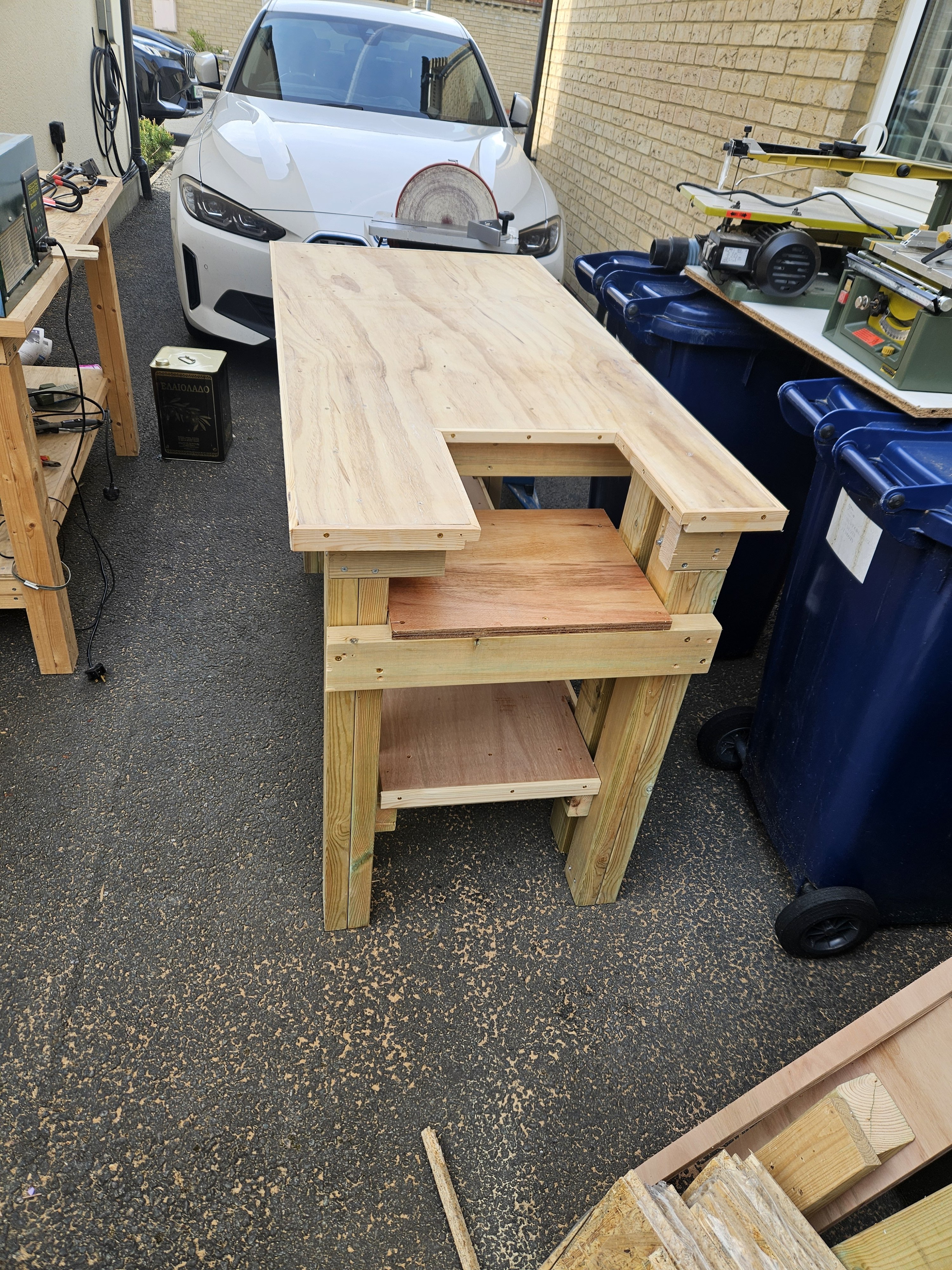

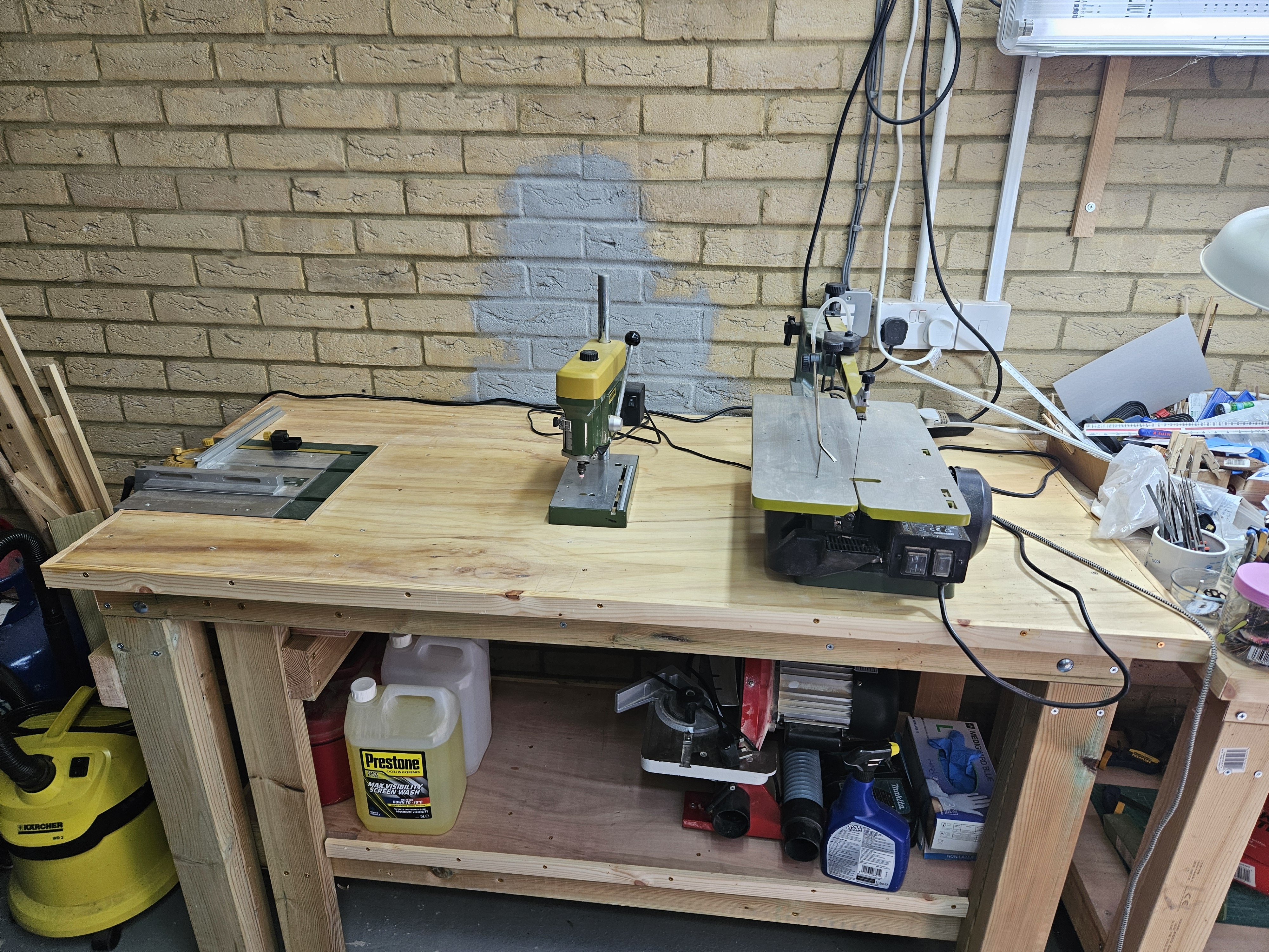

So, I made a new bench with the table saw built in. This took a lot of work (I do not have a mitre saw) and a lot of headscratcing too figure out how it would work but I am very pleased with the outcome. It is a very heavy solid bench.

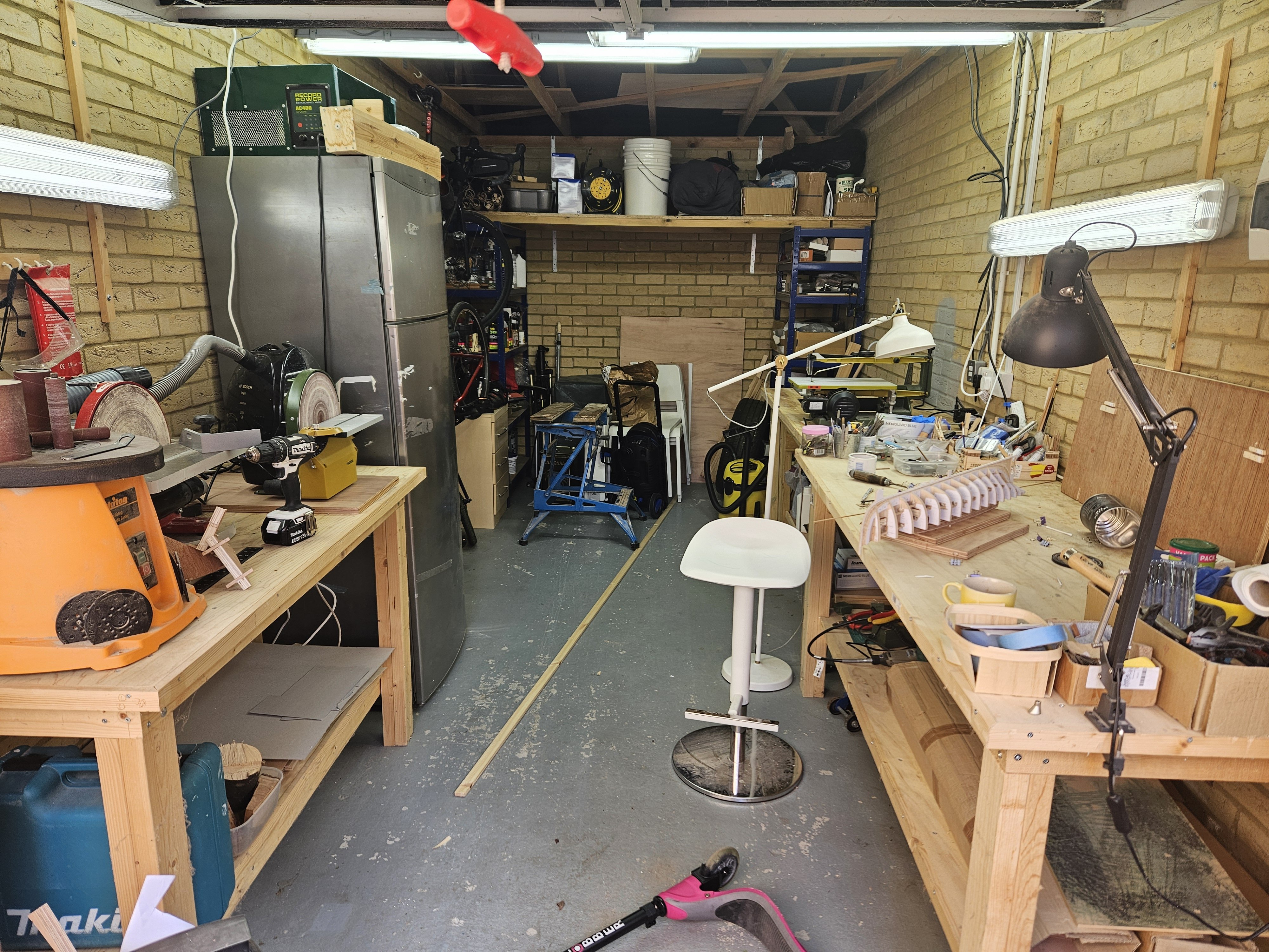

Then I took everything out of the garage, threw away lots of things, moved some light fittings,  made a kind of loft and put everything back in. Huge amount of work but I am pleased with the outcome.

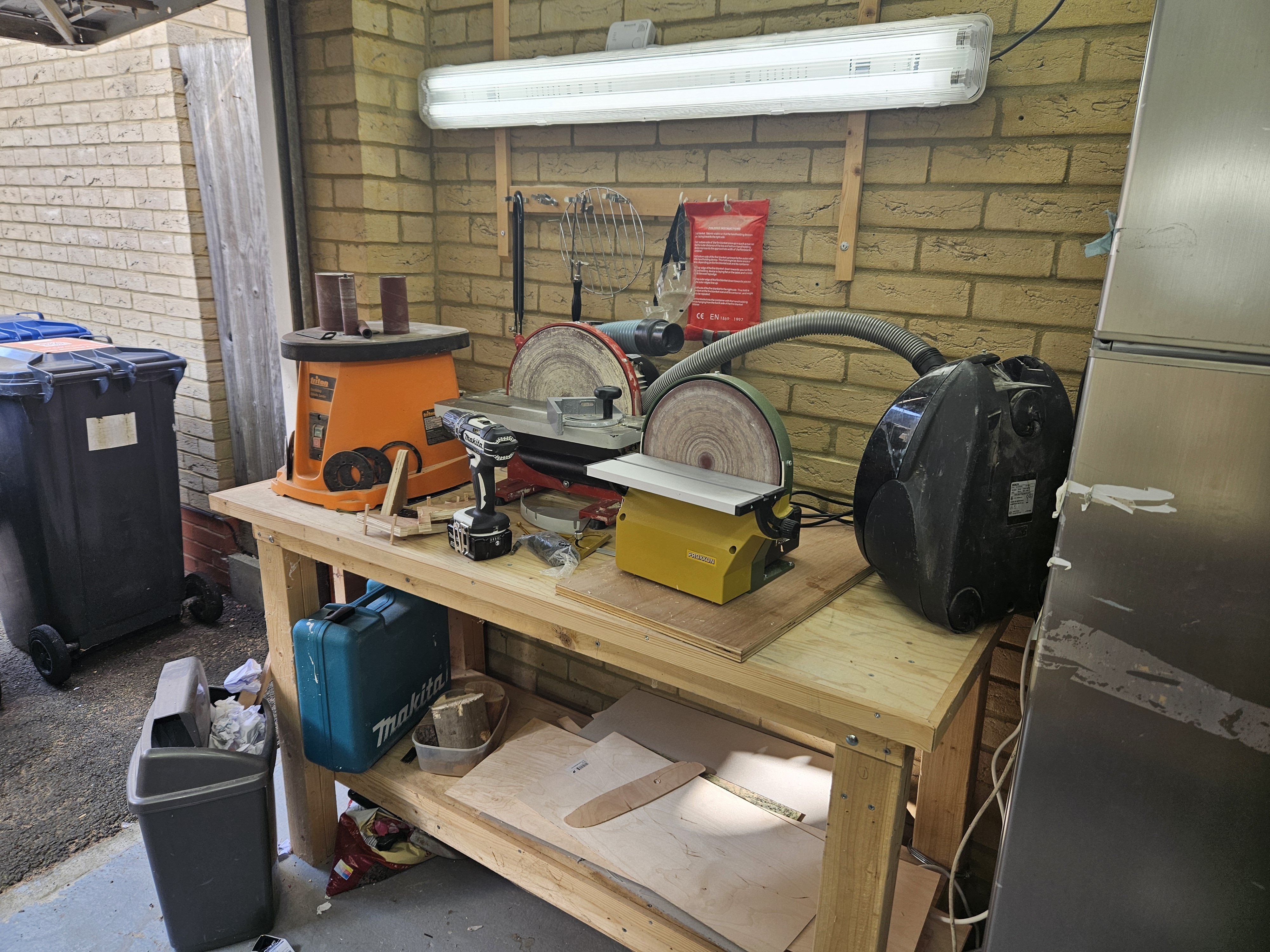

Drilling and cutting bench and main work bench
Sanding station. Yes, I had to buy the Proxon disc sander which is very nice I must say. The Axminster one is only good to rough sand the timber to make the bench.

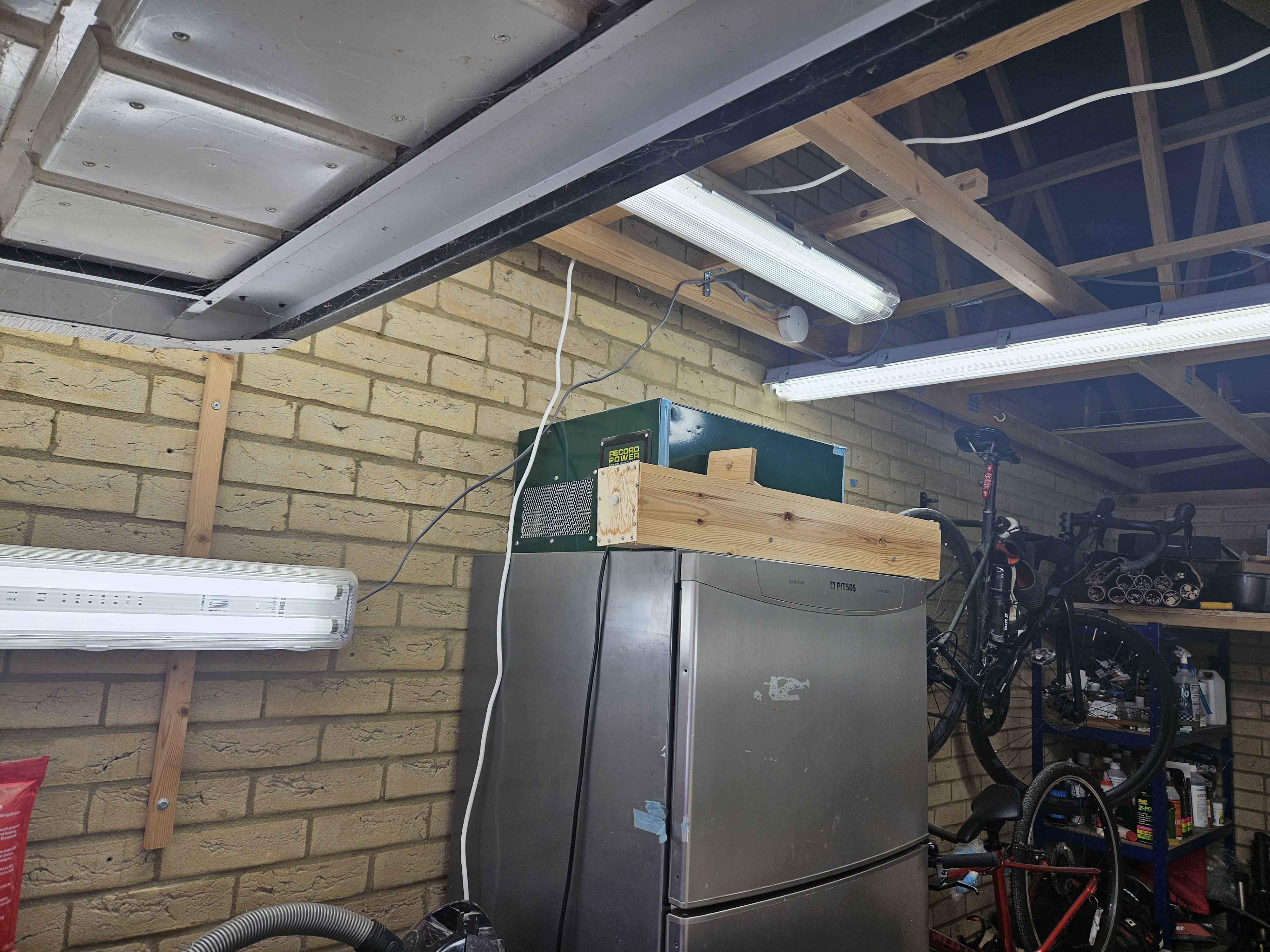

This fridge-freezer is taking up space but is also a nice place to put the air filtration system. Can be used for beer as well.

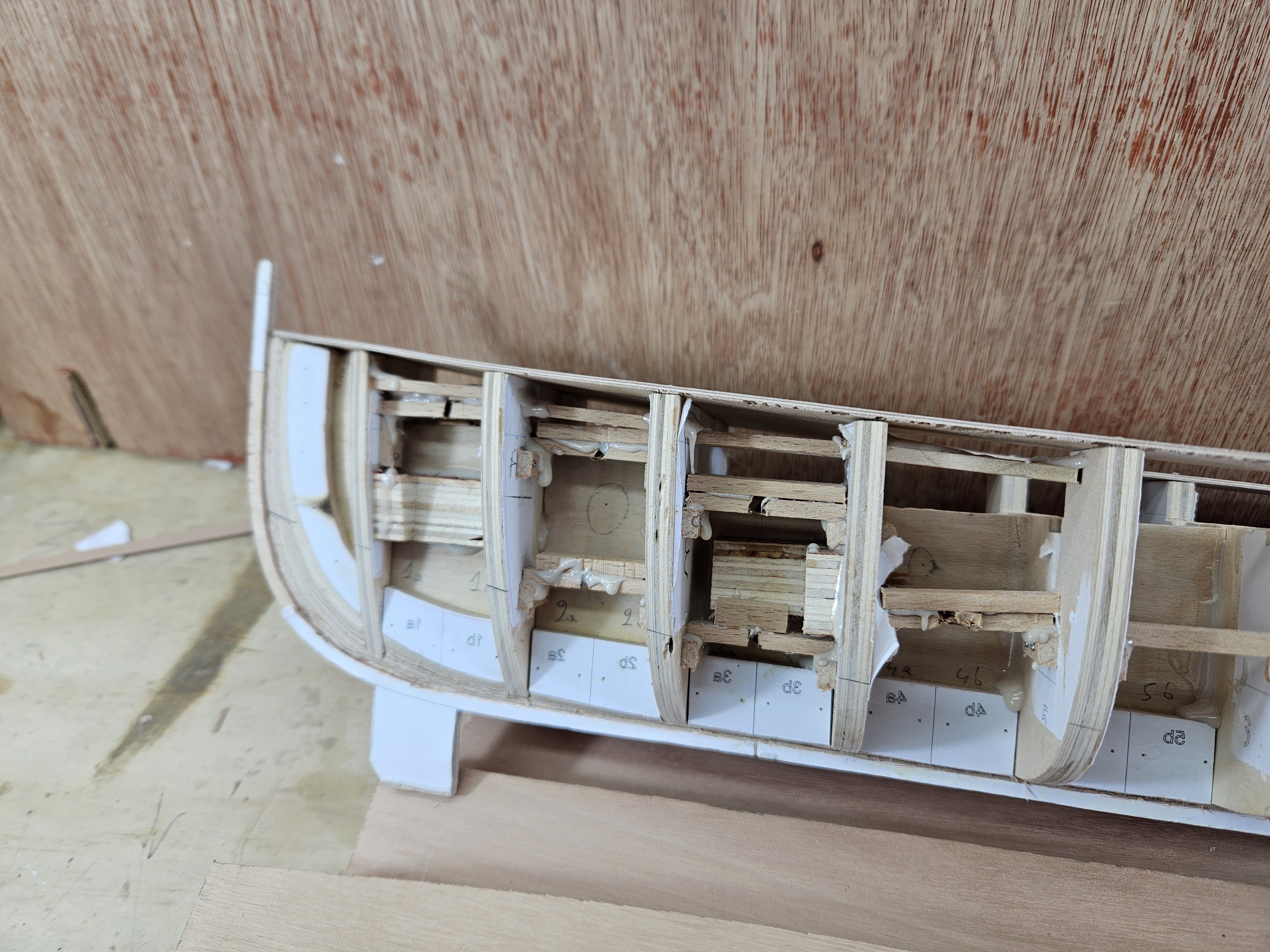

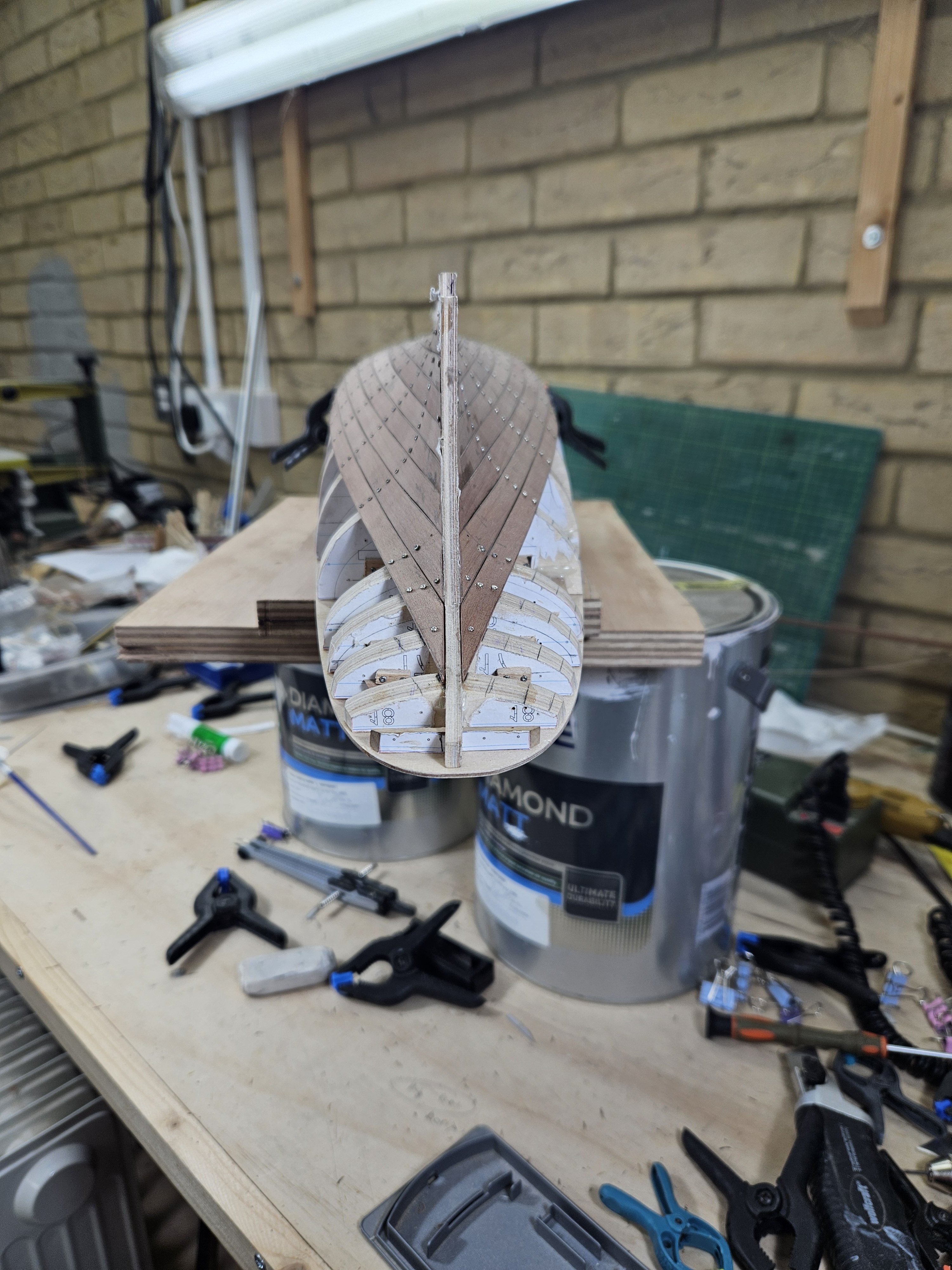

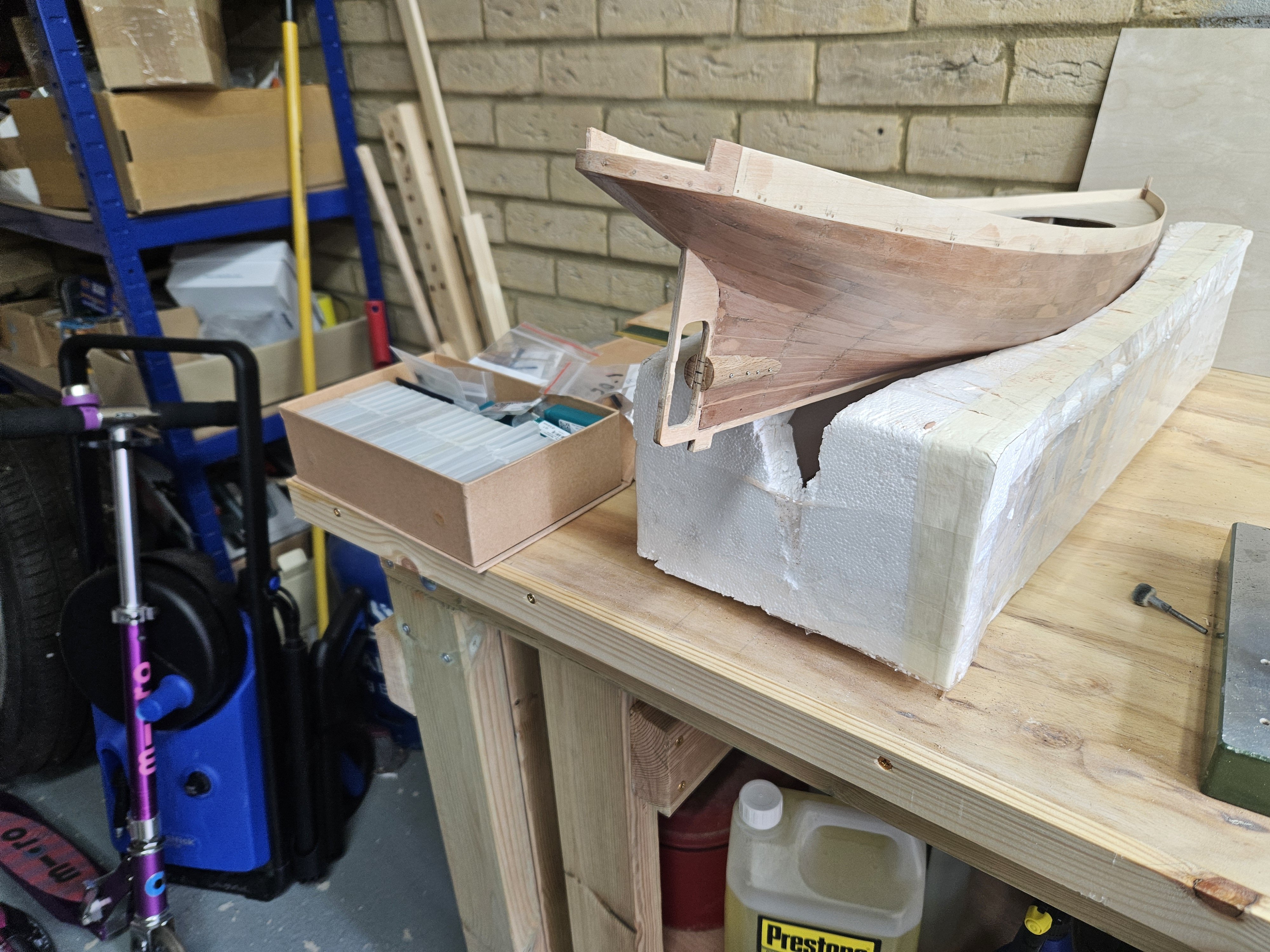

Ok, so back to the boat.

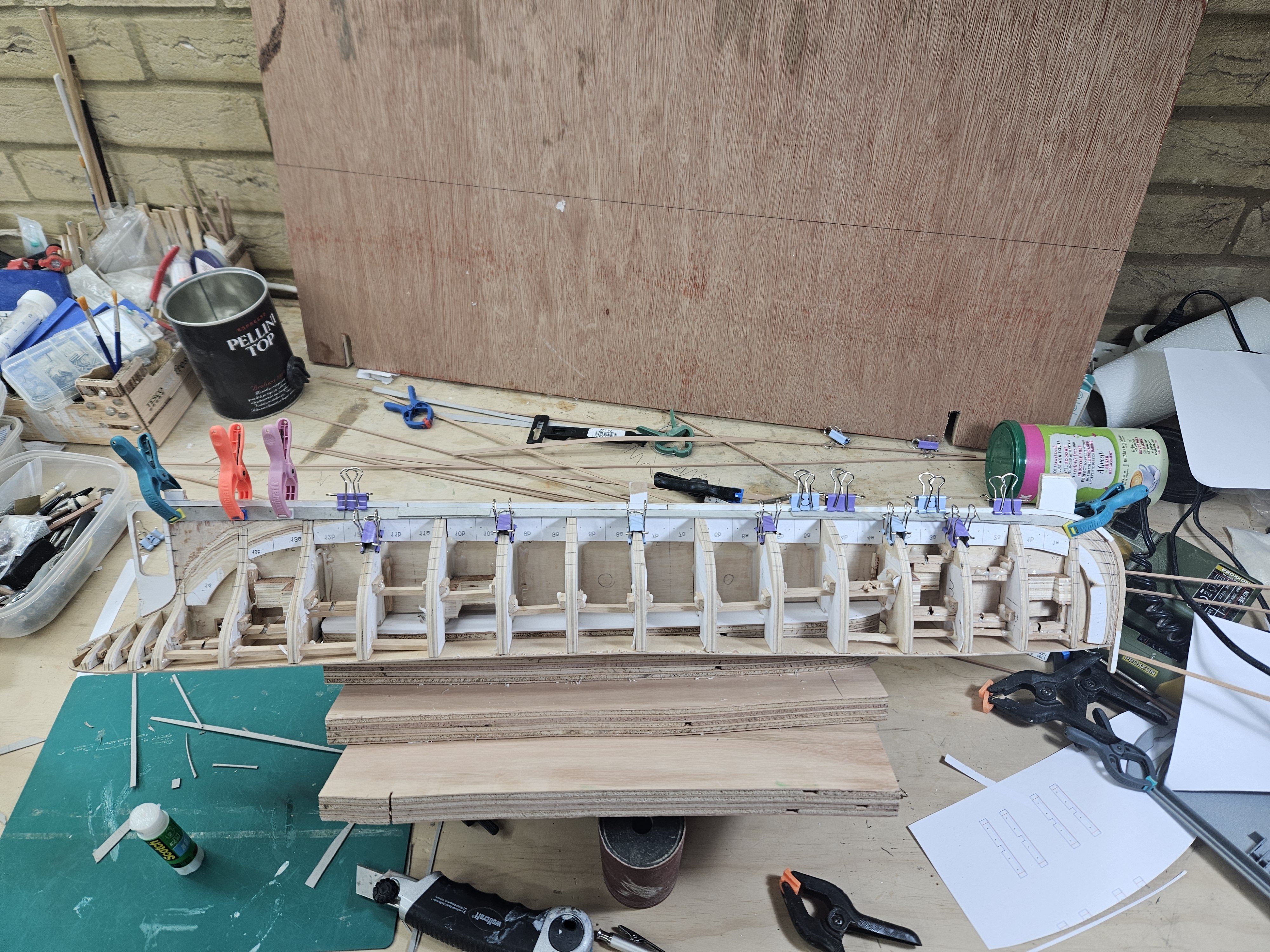

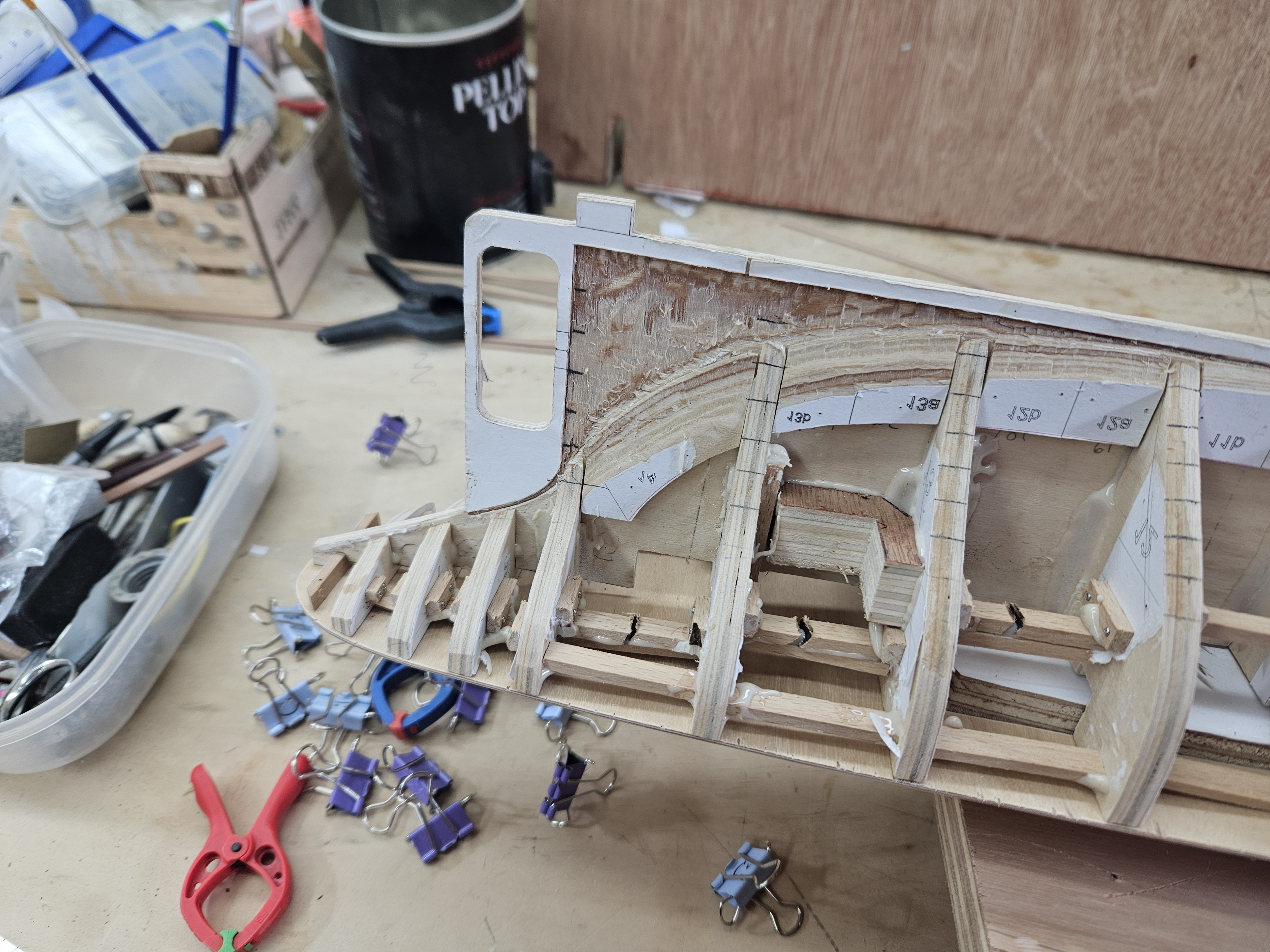

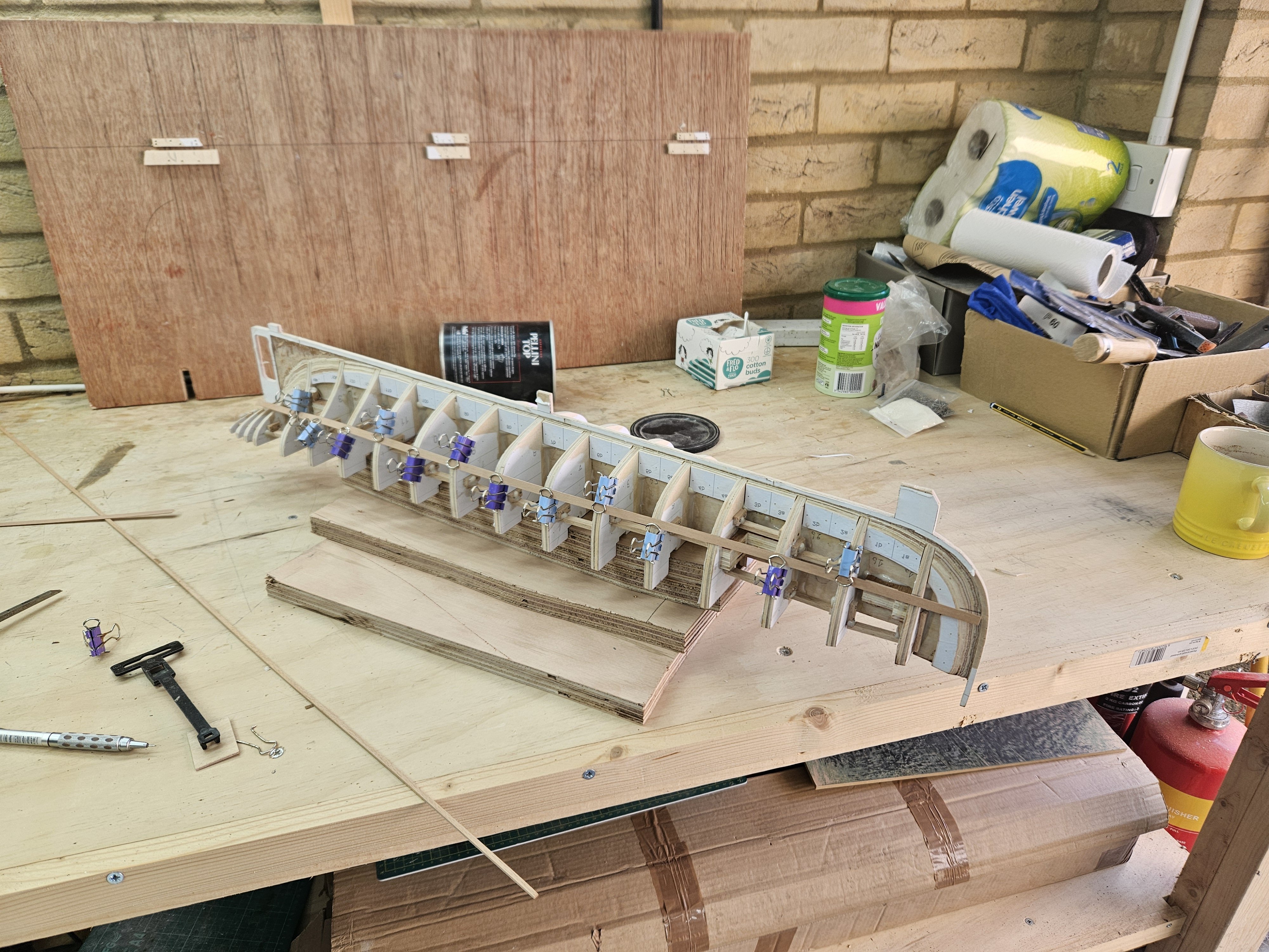

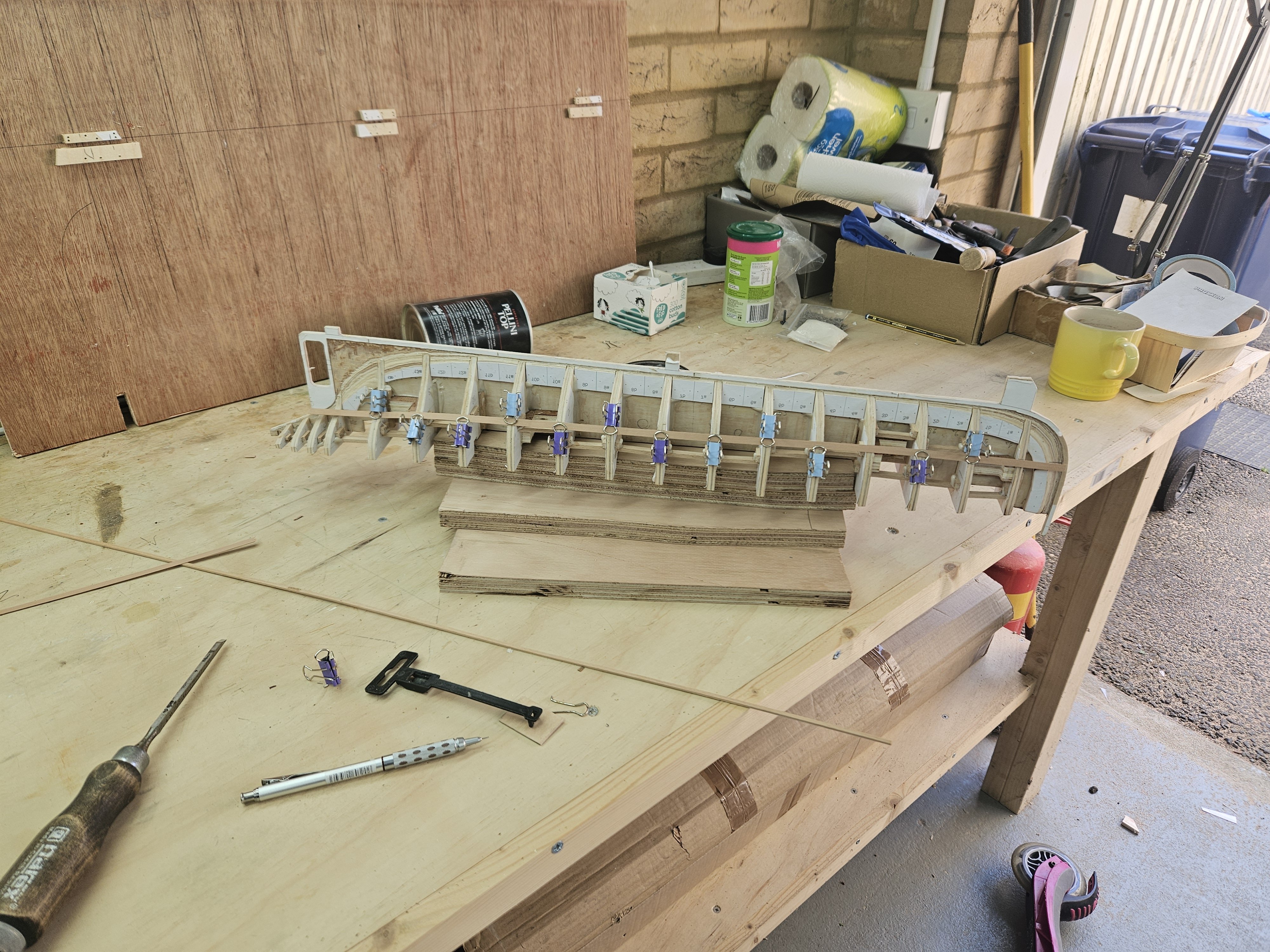

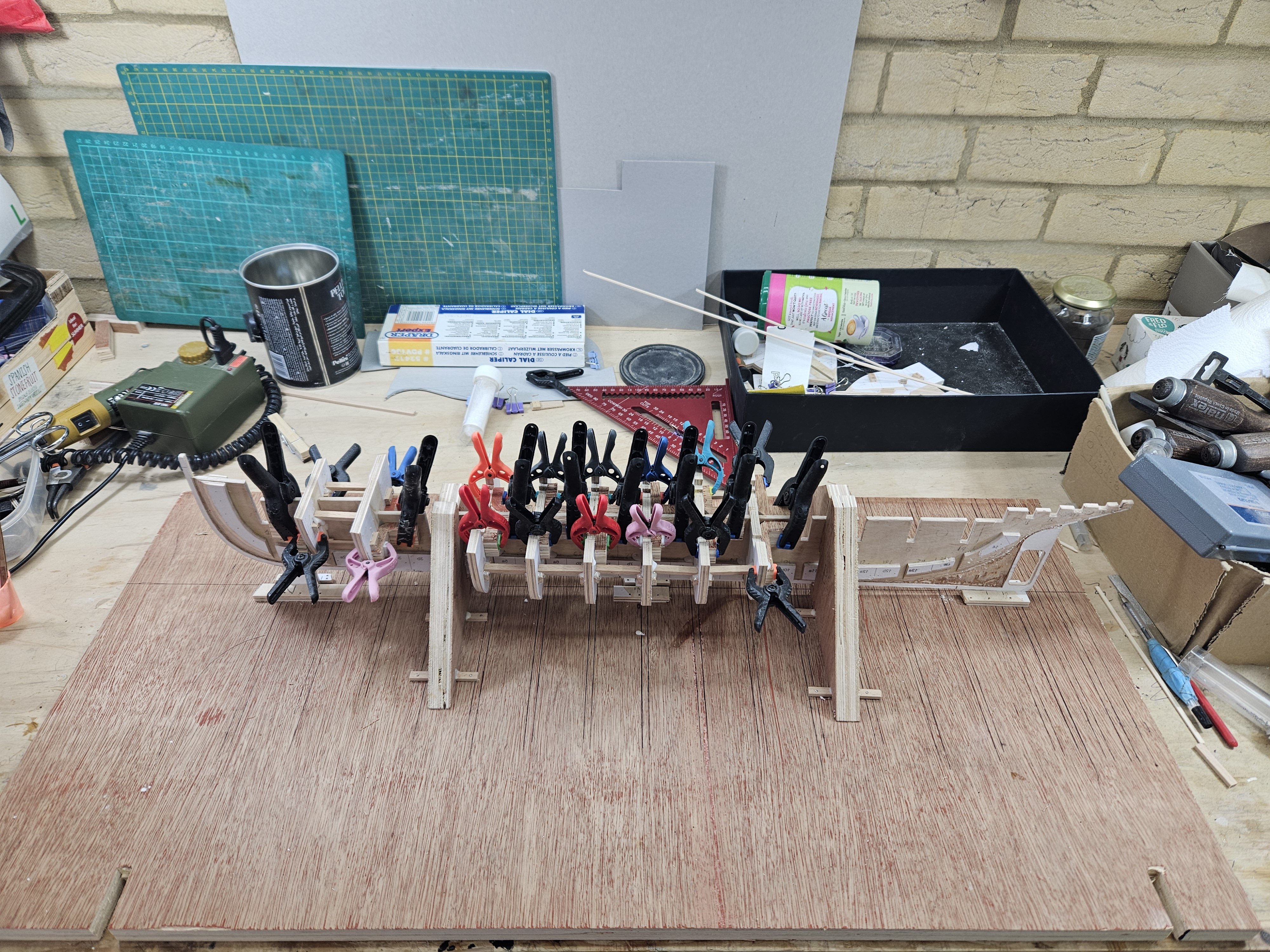

All frames were carefully installed and secured with thickened epoxy and bits of wood - very solid. The photo shows the hull and a crude base I made to support the hull during planking.
This is when I discovered the keel was very bent. The way I designed the boat, the plywood deck had to go in first. This was the first true test of alignment that failed miserably. The deck, printed in an A3 sheet is true and straight and both ends of the hull were pretty off center line - a lot.
So, I cut many of the connecting wood pieces, put longer ones in, lots of thickened epoxy and now I have a straight keel - at last! The deck has been installed with screws - this will be replaced with wooden nails but I will also epoxy it in place.
In the next photos note the cut pieces and the longer ones glued on top.
It does not look pretty but it is solid

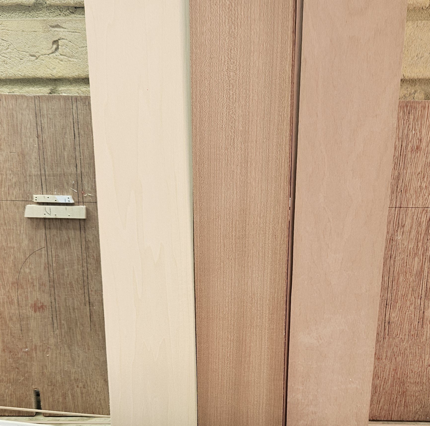

Now, I intended to use plywood for the planking but this is not going to work, plywood is very unpleasant to work with and does not cut cleanly (it can but needs specialised blades)
I do not really want to but new timber, so I looked at what 1.5 mm sheets I have. Left to right is maple. mahogany and pear.
Now they are all great but the mahogany is simply too beautiful to use for a hull that will be painted. I think I ll use the maple to start with and if I run out of wood, use the pear.

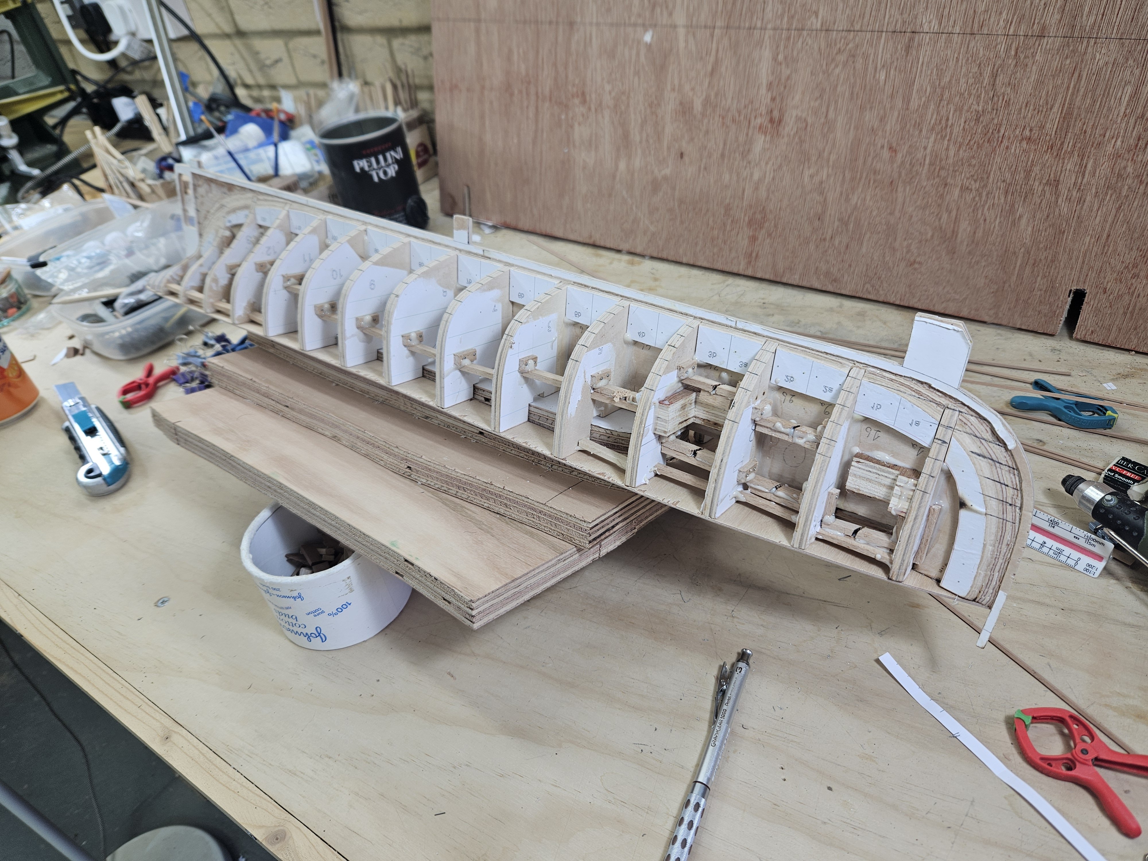

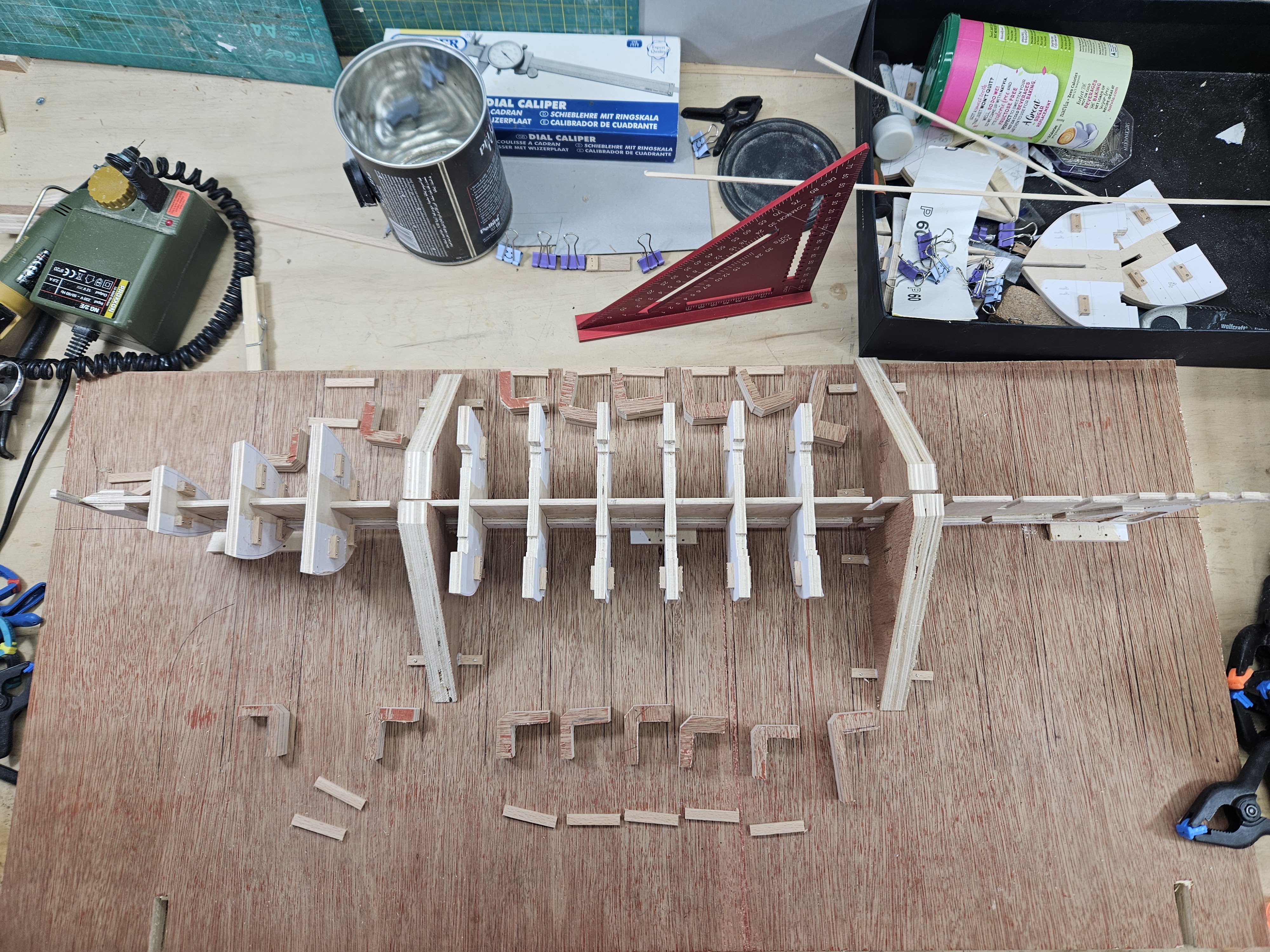

So now it is time to line up the hull for planking! There are some areas that need some consideration, the sheer plank, the top of the stern etc but more on this later.
For now, It looked easier to just divide the hull in two sections.
I first installed a very wide strip so it would sit dead straight at roughly the turn of the bilge and arranged it so that it would start at the middle of the bow and end aft at the point where the stern rabbet starts turning to horizontal
So at this level, a plank would be dead straight. All planks bellow will curve one way, all planks above will curve the other way.
I will plank the stern separately from the rest of the hull.

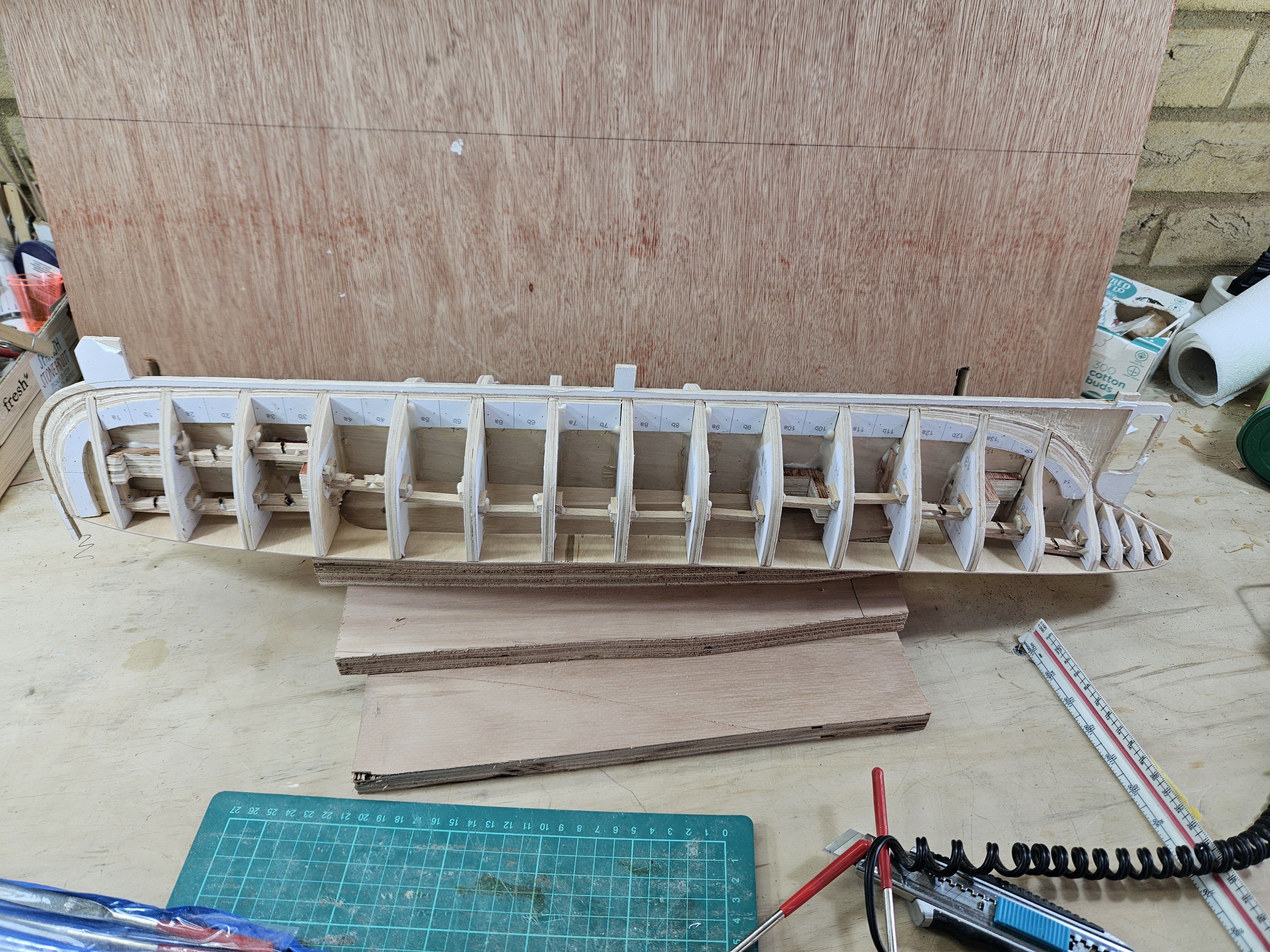

Of course I had to reposition this line, then divided all frames (except for the 3 aft and 3 fore ones)  bellow this level in 6 sections, put some battens (pear 2x3 mm) and drew the plank runs. Then of course  I had to erase all marks, restart and produce slightly better lines. And then do it again.
End result with all frames marked:
Ideally I think a stealer would be needed aft but I am not going to be too pedantic. So lets make one of the garboards.

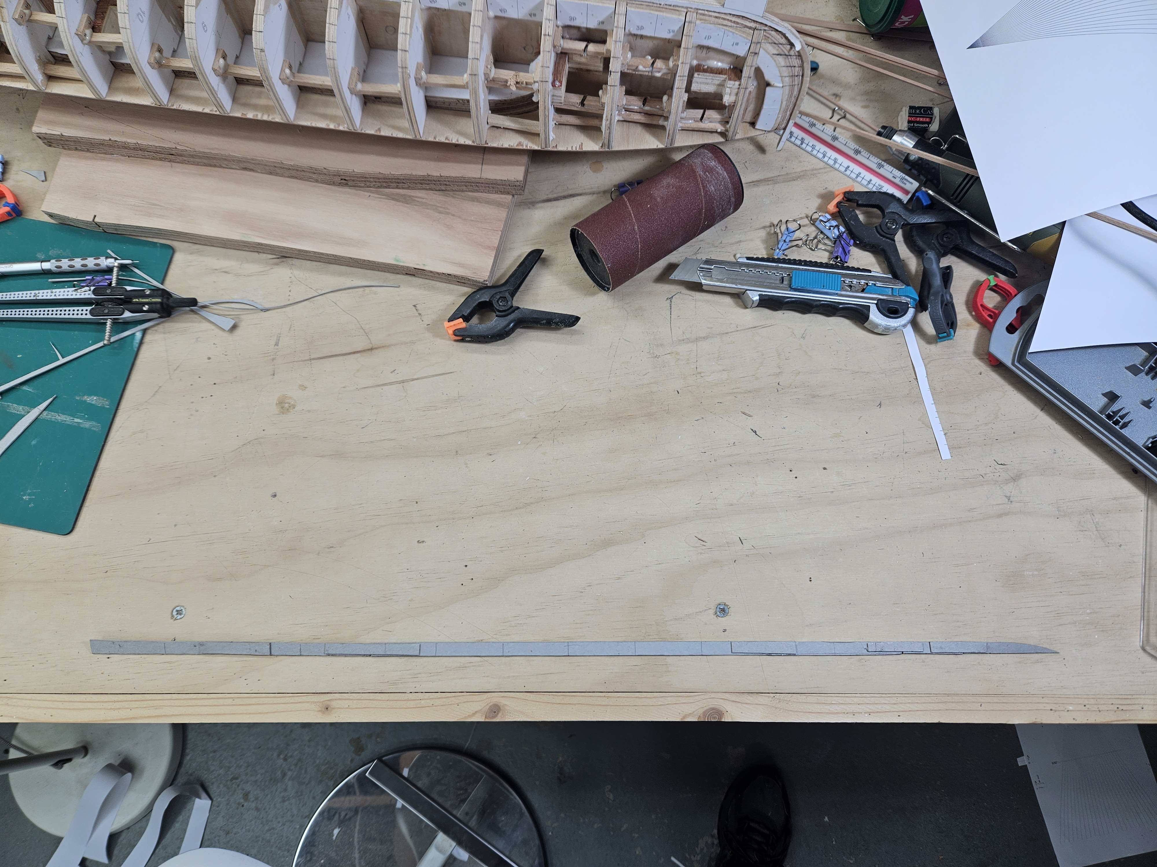

1 mm card used to make the patterns in sections - fitted and glued together.
A very long garboard, and strangely very straight - I expected more curve
I hope this is an accurate pattern. Now, ordinarily I would make this a single long plank but to minimise wood wastage, I am tempted to make it into three sections scarfed together. I also need to think what I will use to cut the planks - scroll saw and sanders or a sharp knife. we will see.

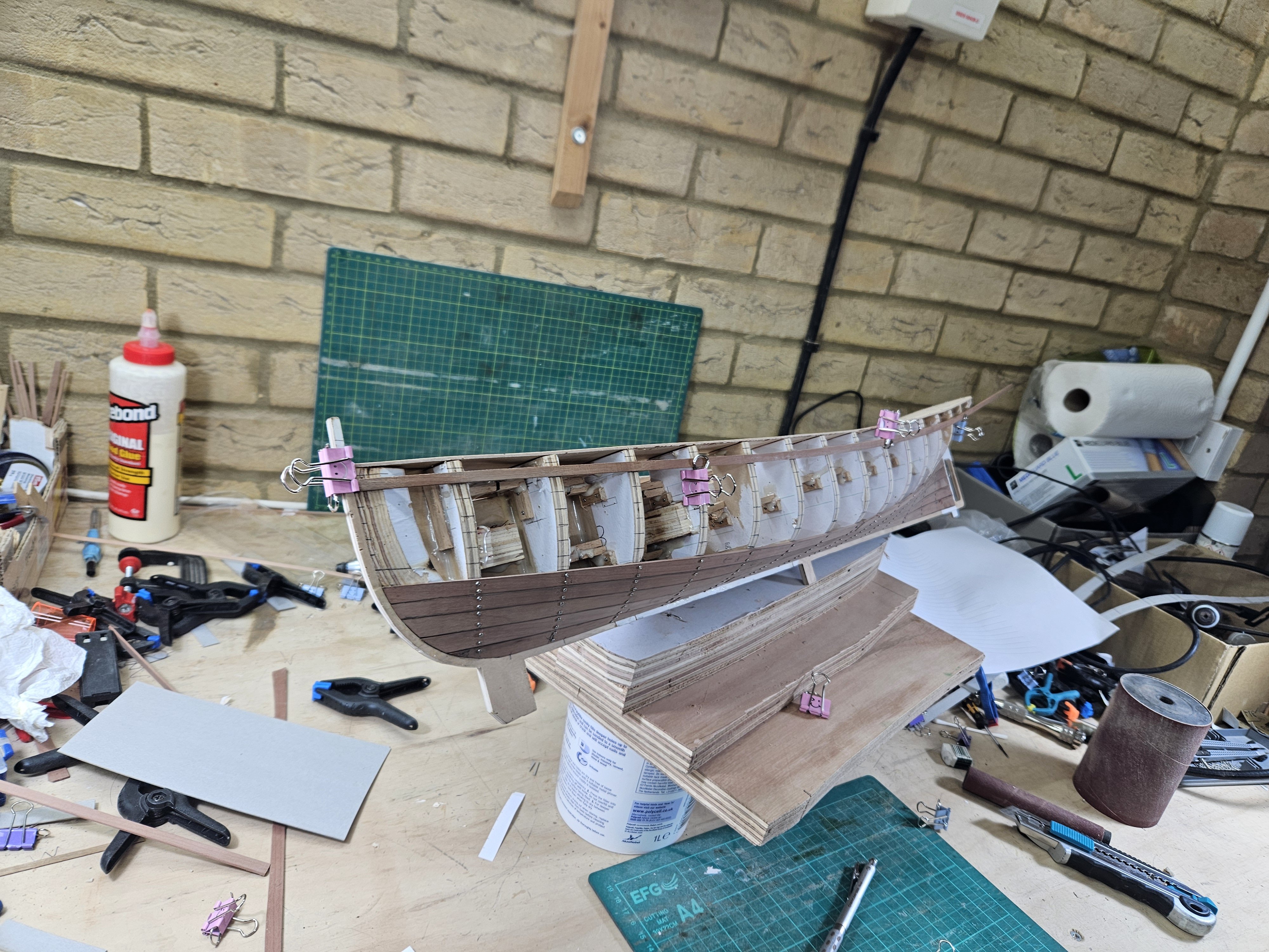

Now, lets talk Planking!
I cut both garboards and steamed them in place. I ve never steamed pear wood but it responded superbly. I used my steam box to heat the planks - worked really well.
I then scarfed the ends and secured in place with screws, The ends however had to be glued as the hull is not thick enough. Due to uneven surfaces I used epoxy - very messy solution but I do not think there is another. I think they came out alright!
I really like planking. For this boat, I did not really spend much time planning, I just eyeballed it a bit. I have only marked half of the hull but I feel pretty
confident. So let me share my method of spilling planks.
First I use 1mm (or 1.5 I am not sure) cardboard to make a pattern. I am only interested in the side of the plank that meets the plank already installed.
The foreword part of the plank has a lot of twist along its axis.
To get the correct shape of the edge, cut a strip of cardboard roughly the correct shape and run dividers along the edge of the plank already installed.
Then cut along the line with a knife
Fitting the pattern, it is a bit off - mark the high spots
Lightly sand the high spots, fit again, sand again etc. Now it fits fine
Connect with the previous plank using cardboard and glue and move on to next segment.
For the aft segment, the process is repeated - it just happened my rough cut pattern was spot on here!
The plank is now completed - the upper edge that is
Usually, I would just cut the plank as a single very long one but I would like to reduce wastage of wood.
So now lets cut the individual segments. First we transfer the shape of the upper edge to wood, making sure we mark the positions of the frames.
Then we measure the distances from edge of previous plank to line on frame and transfer over to wood
Using a baten, we connect the marks making sure the line is fair
Our plank segment is ready
Next cut the plank, test fit, mark and sand any high spots, fit again etc. Later on we will need to also take into account bevels and also curvature of frames - either sand concave the inner surface of planks or sand flat the frames.
Same process for middle and aft segments
All segments are ready, just the scarfs are needed.
The plank on the other side needs to be again cut individually as it is a close but not exact fit.
On a different boat I would have spent more time arranging the run of the planks but for Hercules, I think this will work well - the plank shape so far does not seem horrible.
I hope this was interesting!

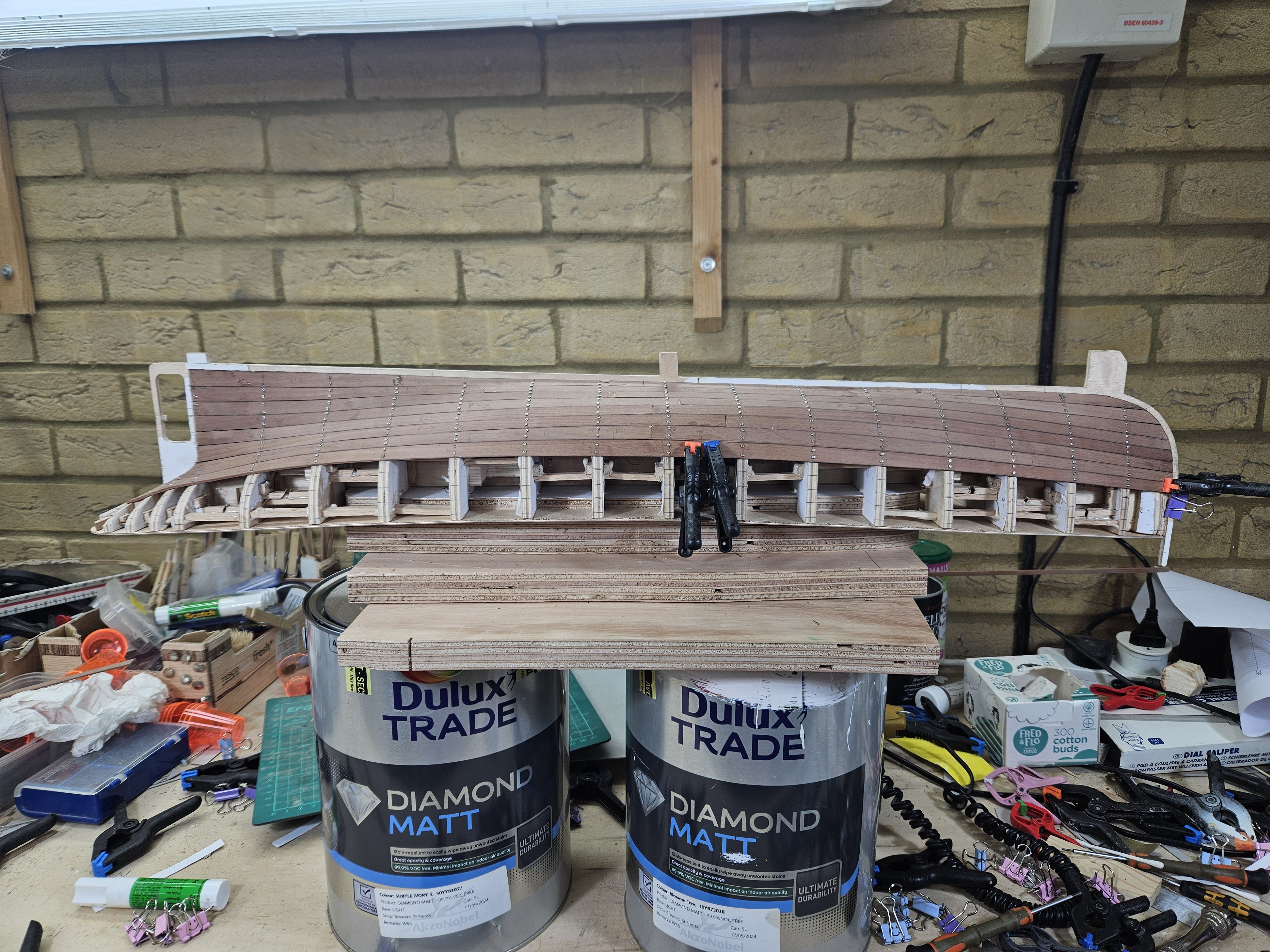

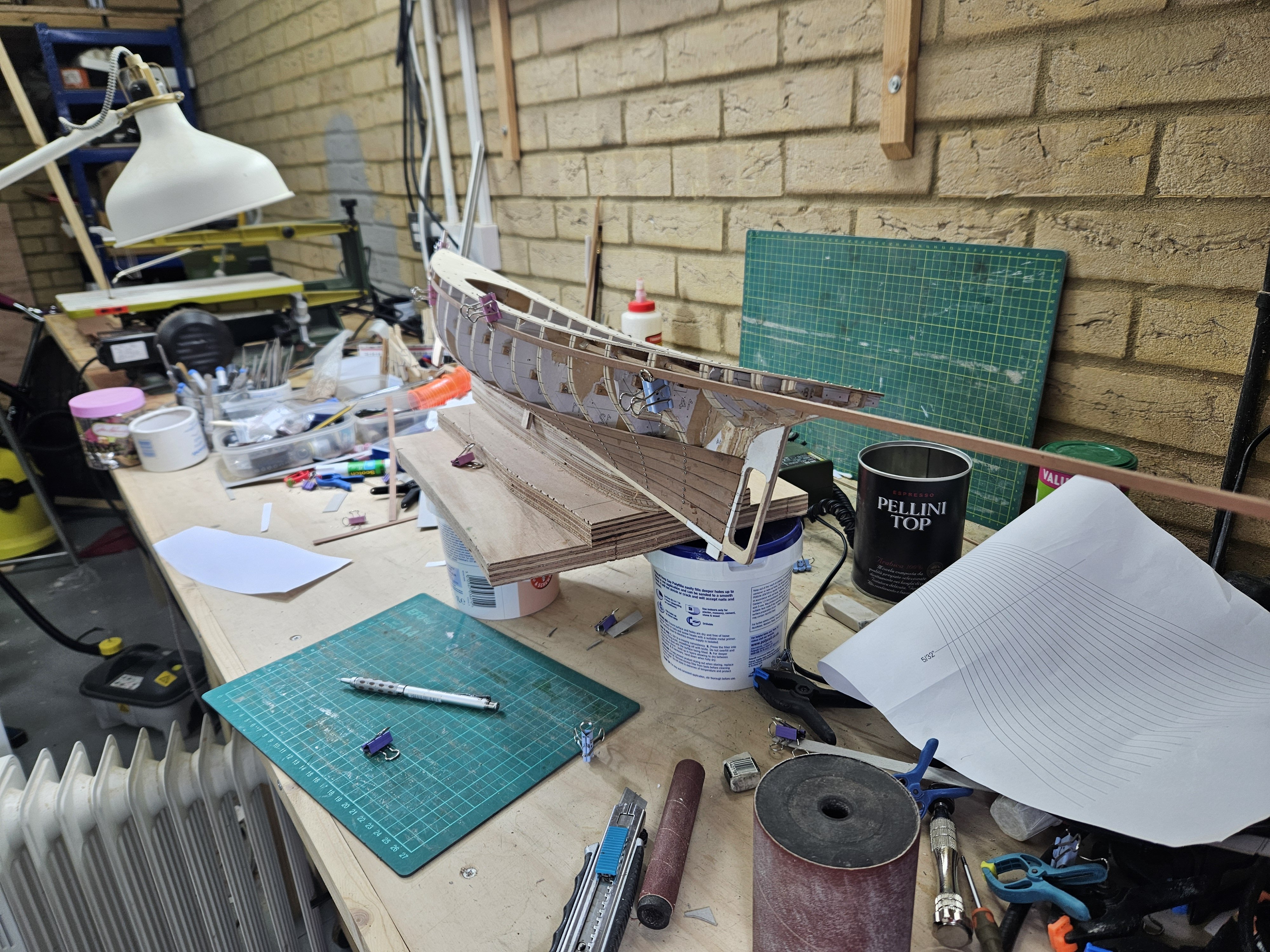

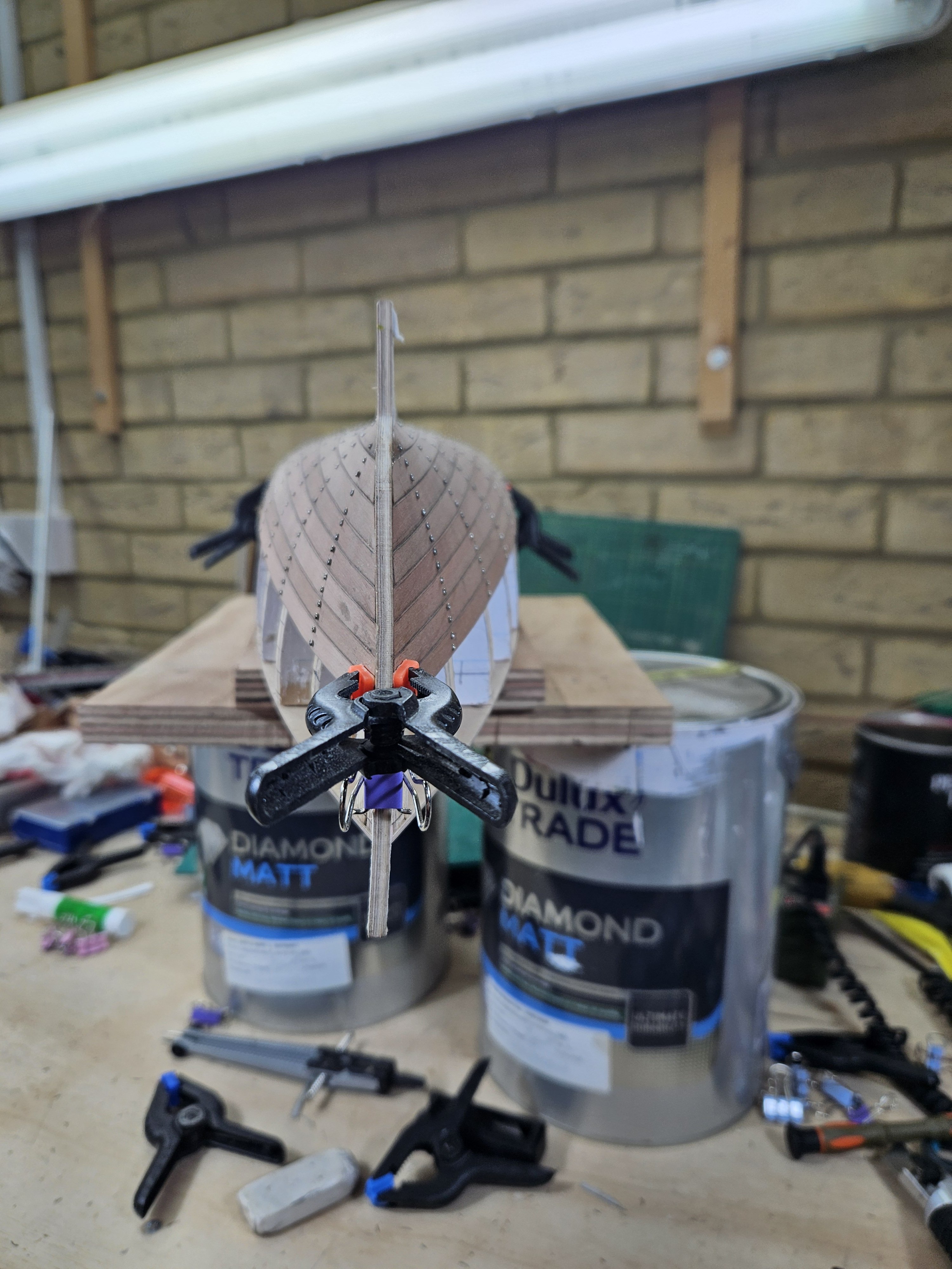

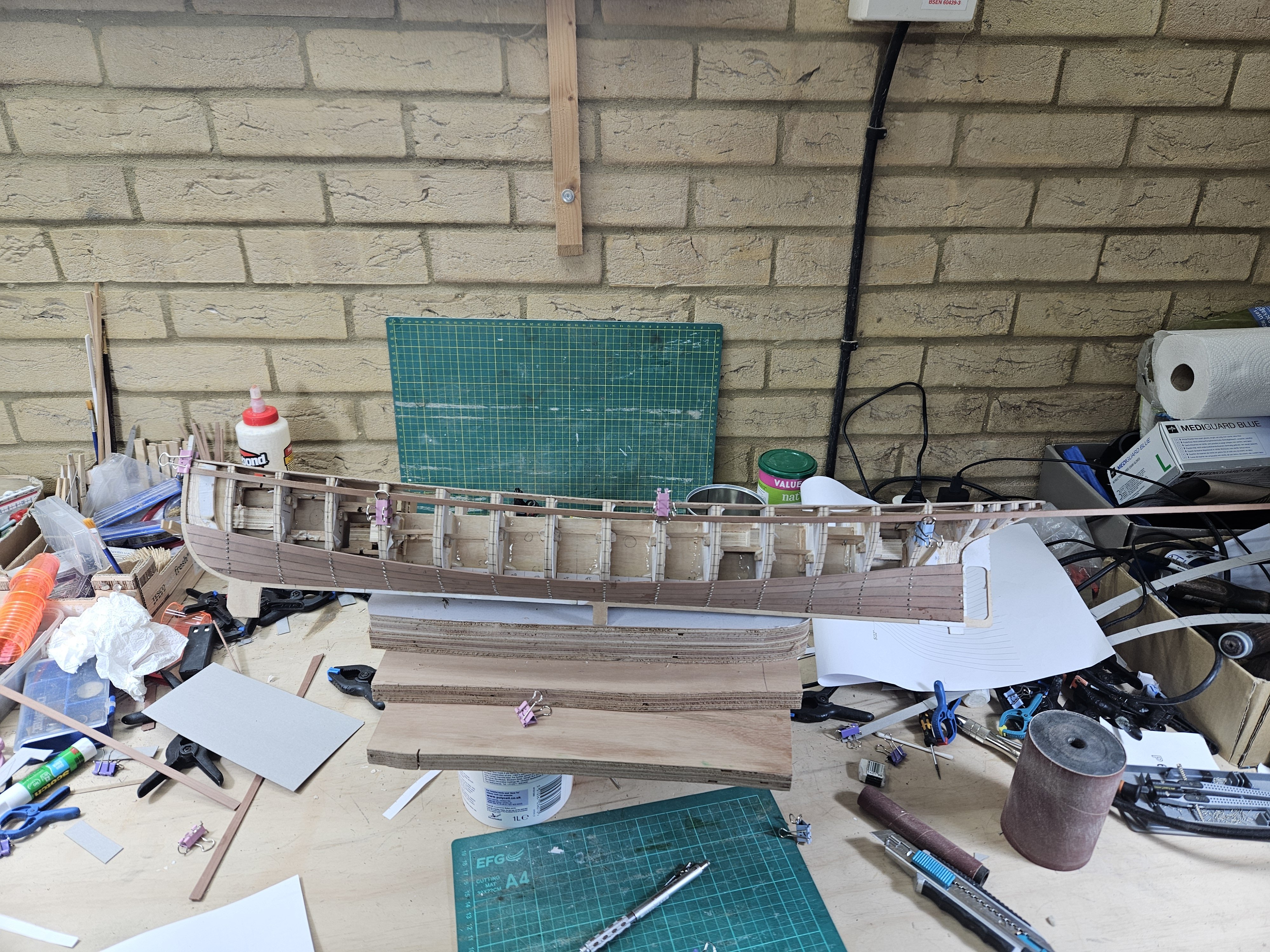

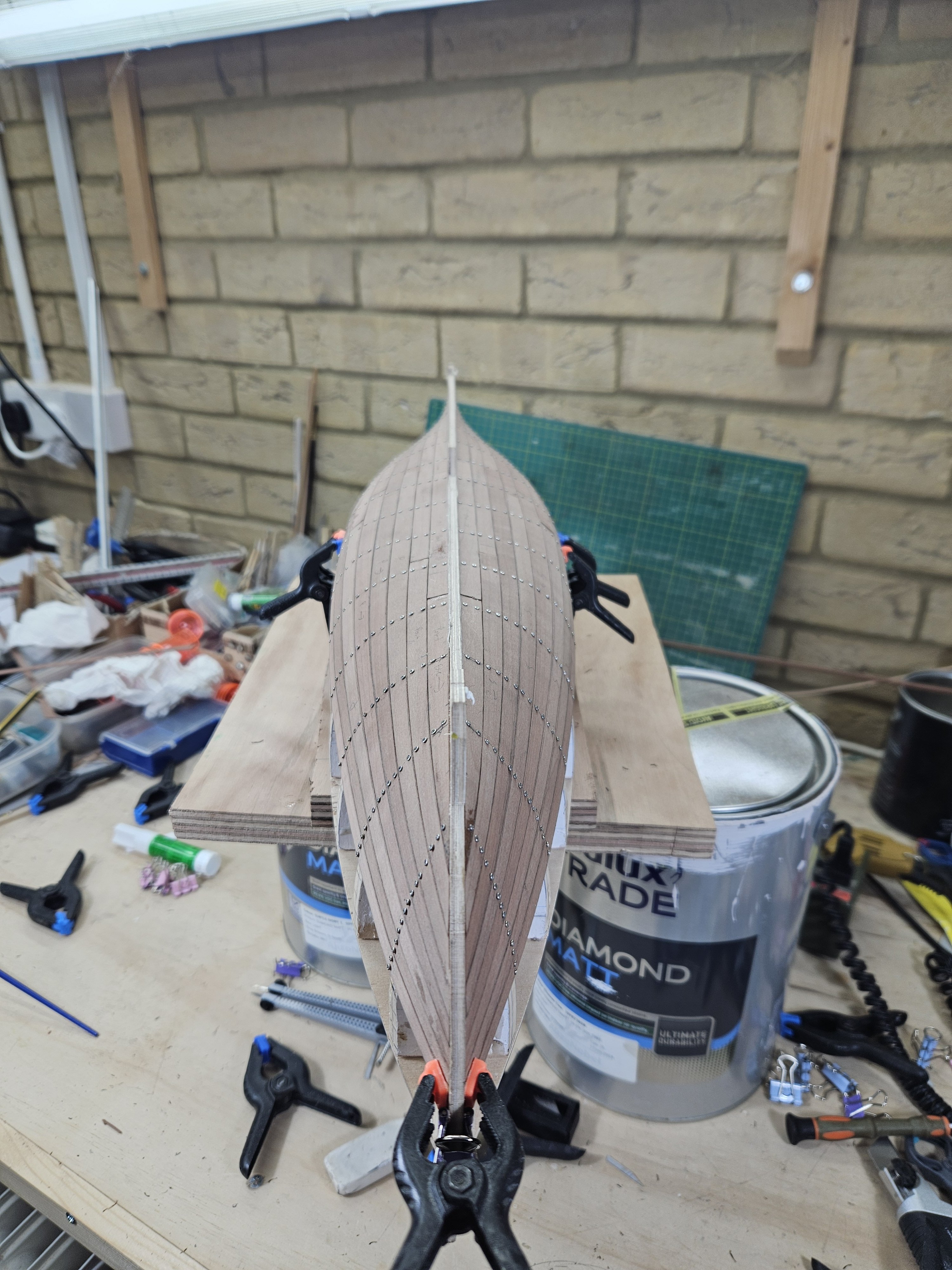

Time for a wee update!

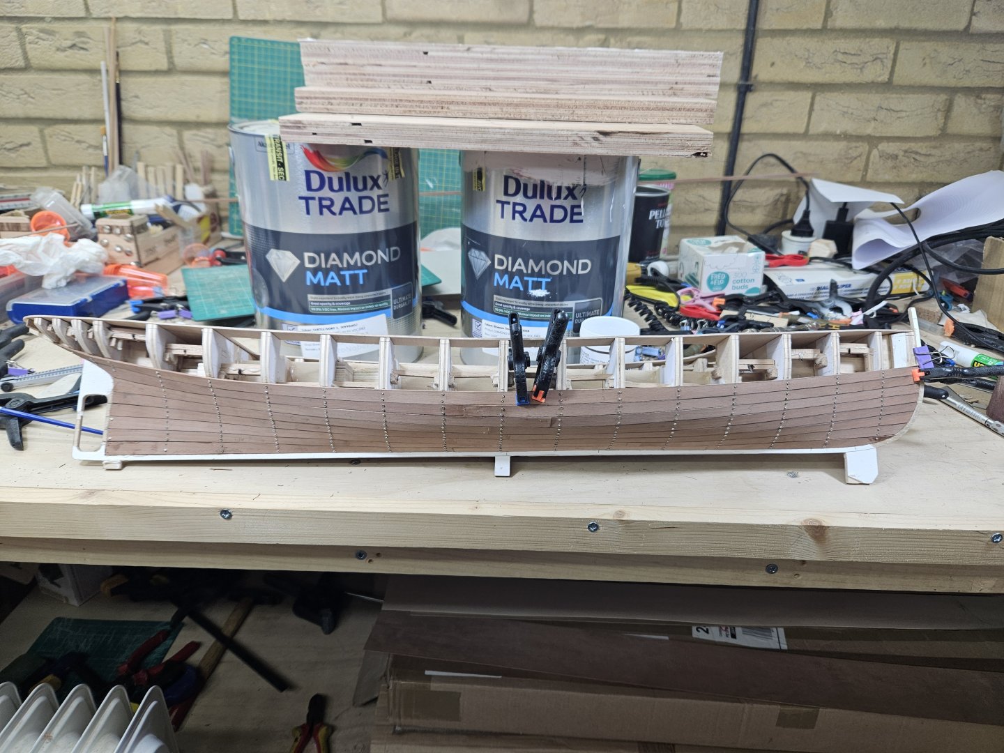

I did lots of work but have little to show, planking is a slow, labour intensive process. I need to cut the plank patterns for each side separately as the port and starboard planks are very close but not identical. I try to fit the edges reasonably close but I am not too fussed, with a bit of sanding and filler it will be fine. Also, I really should have hollowed the planks where they meet the frames at the turn of the bilge but it will be fine. The plank scarfing is a bit wonky but this will also be ok with some sanding.
I realised that to progress further I had to mark all the remaining planks. One of the aft frames looked (and still looks) a bit wrong so I cut some of it off and overall I am not sure how the stern will end up, so some head scratching  there is needed. Also, the sheer plank will continue as gunwales so this also needs some more thought.
I am not sure I have enough pear to finish the planking, I ve managed so far not to waste any wood but today I made two wrong planks - this is a lot of waste!
5 planks are in and the run of all the remaining planks marked. Of course the width of the planks is all way off scale but Hercules had a metal hull and I just want to plank the hull - there is no reason though not to do it nicely!
I think the planks so far run reasonably fair. The sheer also looks ok.

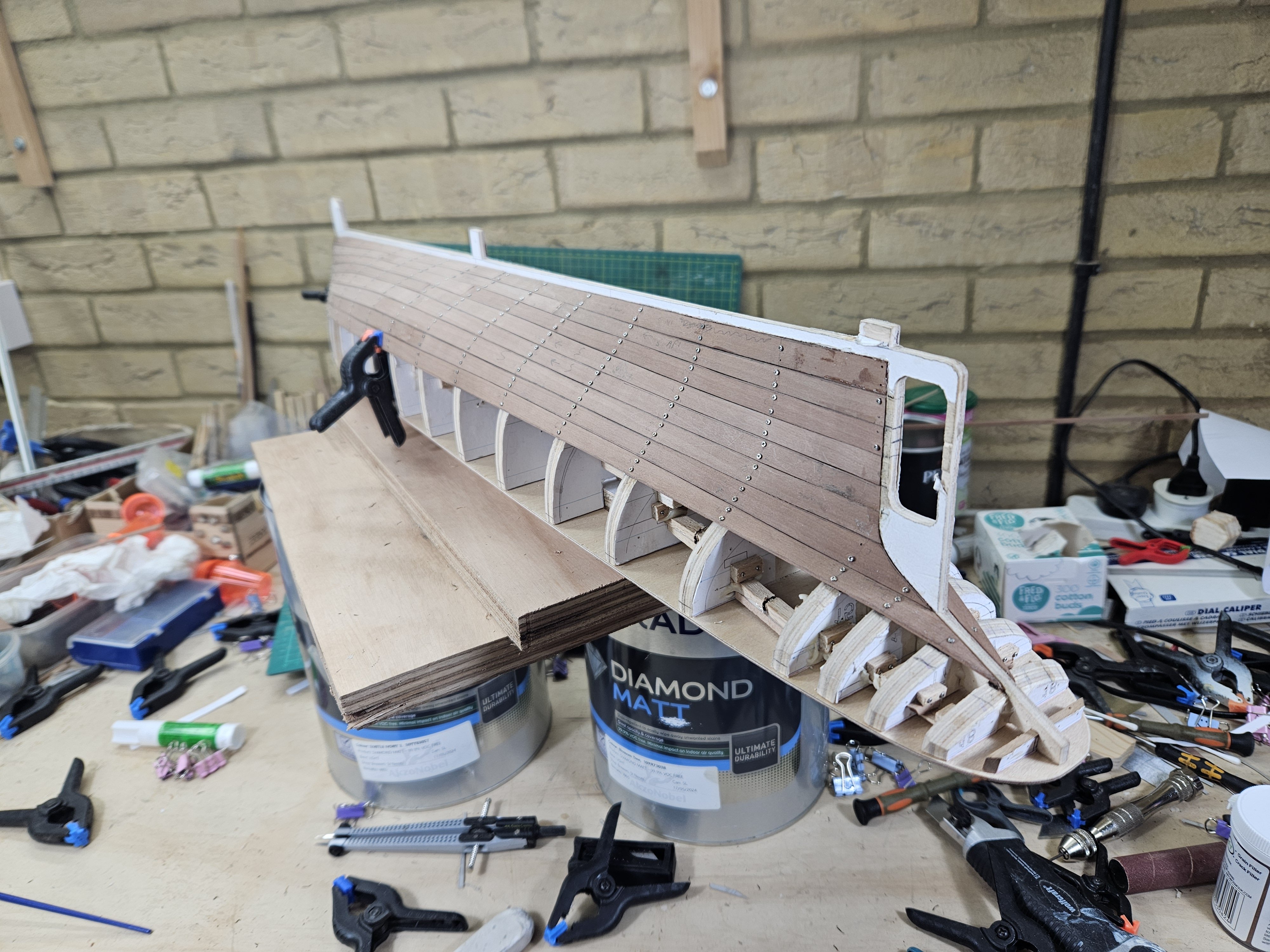

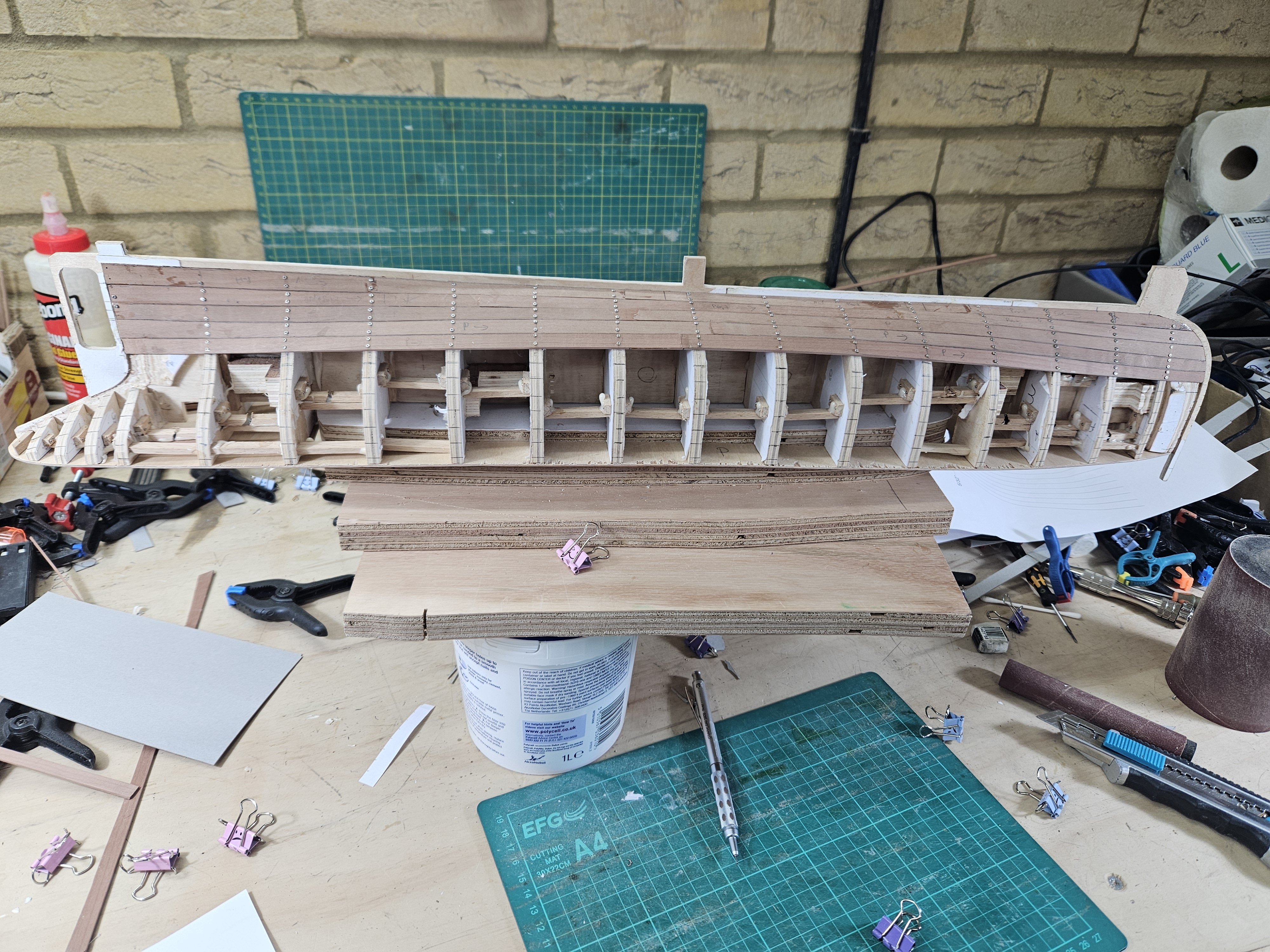

Dear all
Thank you all for your comments and likes!
I ve been working on the boat, walking a thin line between the Admiral's wrath and getting a few things actually done, so time for another update.
Rob Ross used to say that there are no mistakes, only happy accidents. There sure have been many happy accidents so far with this boat! Usually my CAD drafts are pretty accurate but as I move on, I am scratching my head as 1+1 does not always make 2, I cannot figure out what I was actually drafting. But so far I managed to more or less fix things.

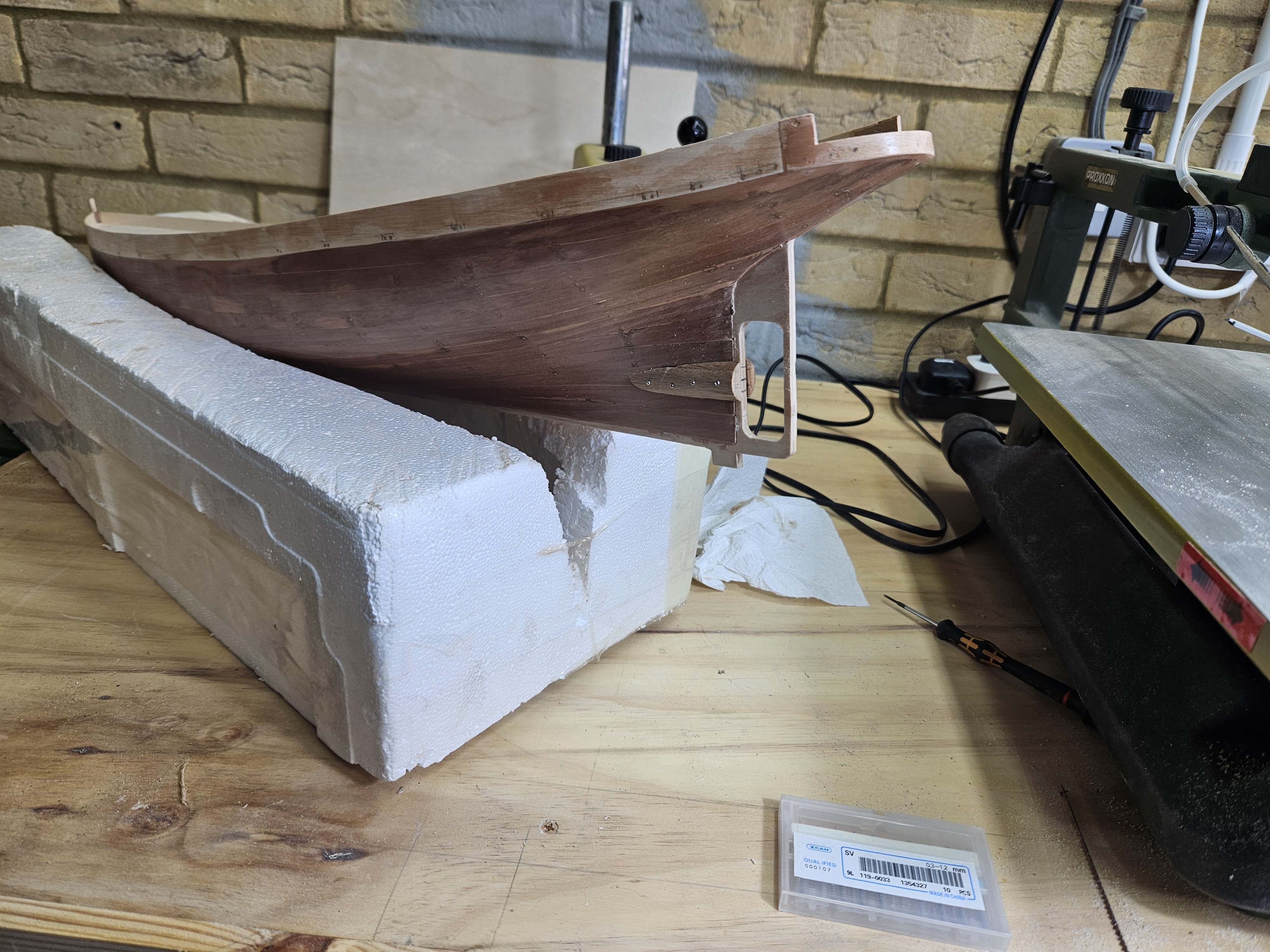

So planking is finished! You will see that the sheer strake, or rather half of it, is missing. The reason is that Hercules has a tall bulwark and it would be difficult to securely fix it in place so I thought it made sense to merge the sheer strake with the bulwark. Now Hercules is 150 feet long and made of steel so the planks are completely unrealistic but they do make a nice hull!
The card templates (there were even more than these) show how much work actually planking involves with spilling and everything - still I had only 2 half planks that I had to re do as they came out very wrong.
One of the many happy accidents is in the following photos. I did not really want to buy new wood so I had just enough pear for the planking. I managed to snap the very last length I had left, with just a half plank left to do! I managed to fix this by making it in two parts, narrow escape!
Then lots of Osmo filler and lots of sanding. Of course I did not read the instructions that state to thin the filler with 15% water and I struggled wasting a lot of the expensive filler. Prior to that, all the hundreds of screws were replaced by tree nails.
Much more filling and sanding will be needed but a big chunk of the hull preparation has been done.

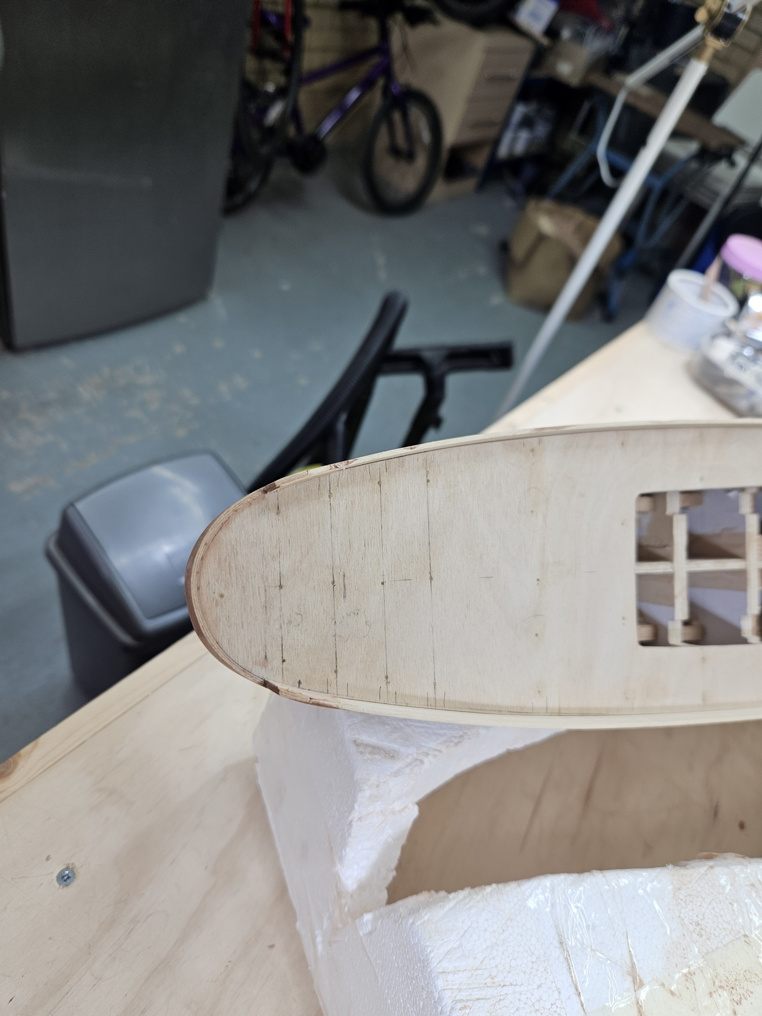

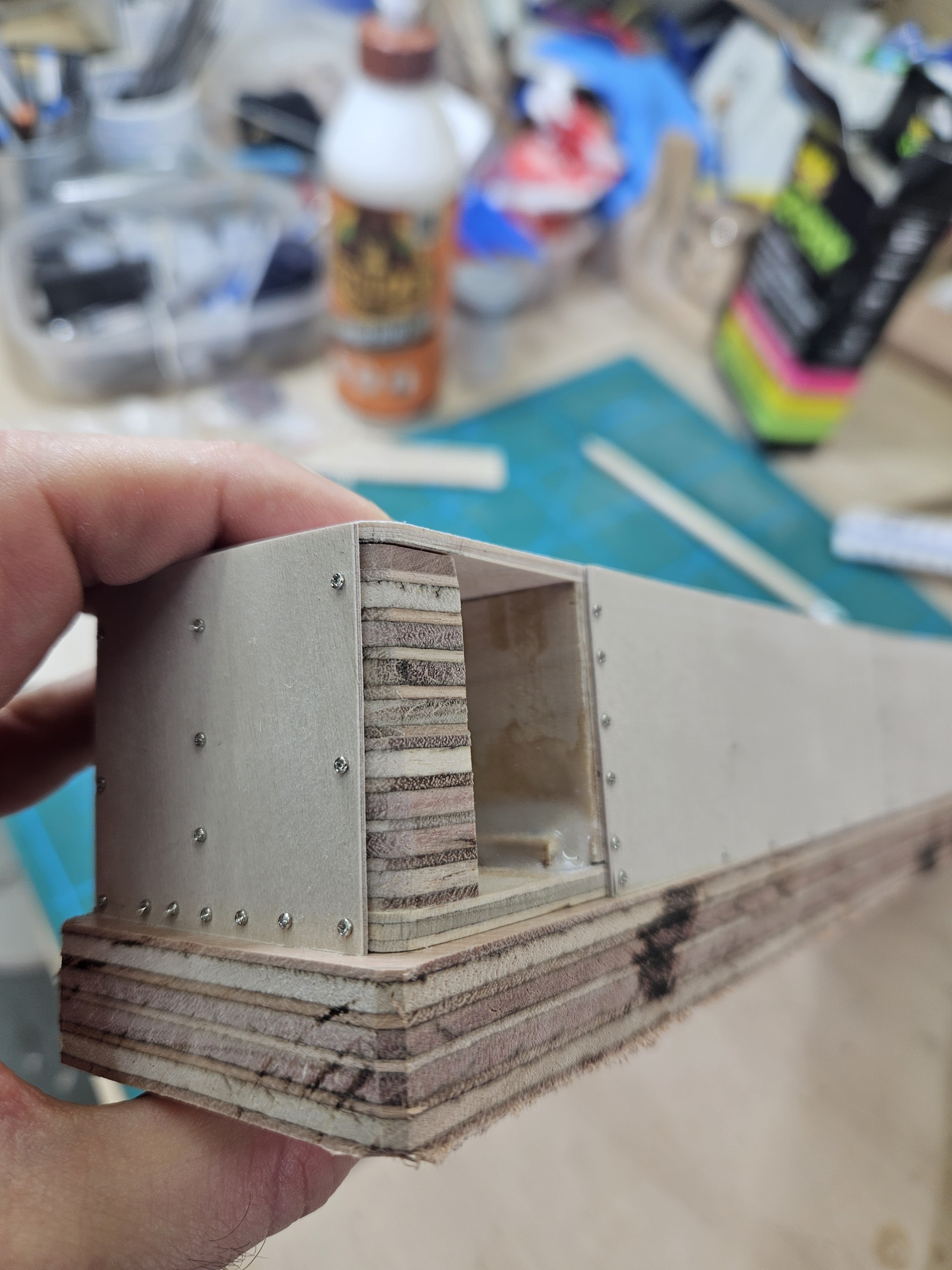

Then I made the bulwarks but only after I managed to snap the little stem extension not once but twice. I had a sheet of maple and three sheets of mahogany left so I used maple - what a nice wood it is! It will all be primed and painted black.
But something felt wrong. I went back to my CAD drafts and the plans and indeed, the bulwark/planks were a couple of centimeters short. The happy accidents are piling up!
Now, Hercules has this little feature at the stern where there is a small flat vertical segment, this has to be made by laminating thin strips which gives the opportunity to correct the mistake above.
So I used some thin beech strips I had. I dislike beech due to its huge movement in service but it is so nice to bend, just with water it can be tied in a knot.
I just used PVA to laminate the strips, if I had used epoxy it would have been very messy.
Then rough cut to shape and screwed in place.
I know it looks rough, I had trouble with the stern drafting in CAD and did not really spend time on it, I hope I ll fix it with a bit of filler, bit of sanding, paint on top.

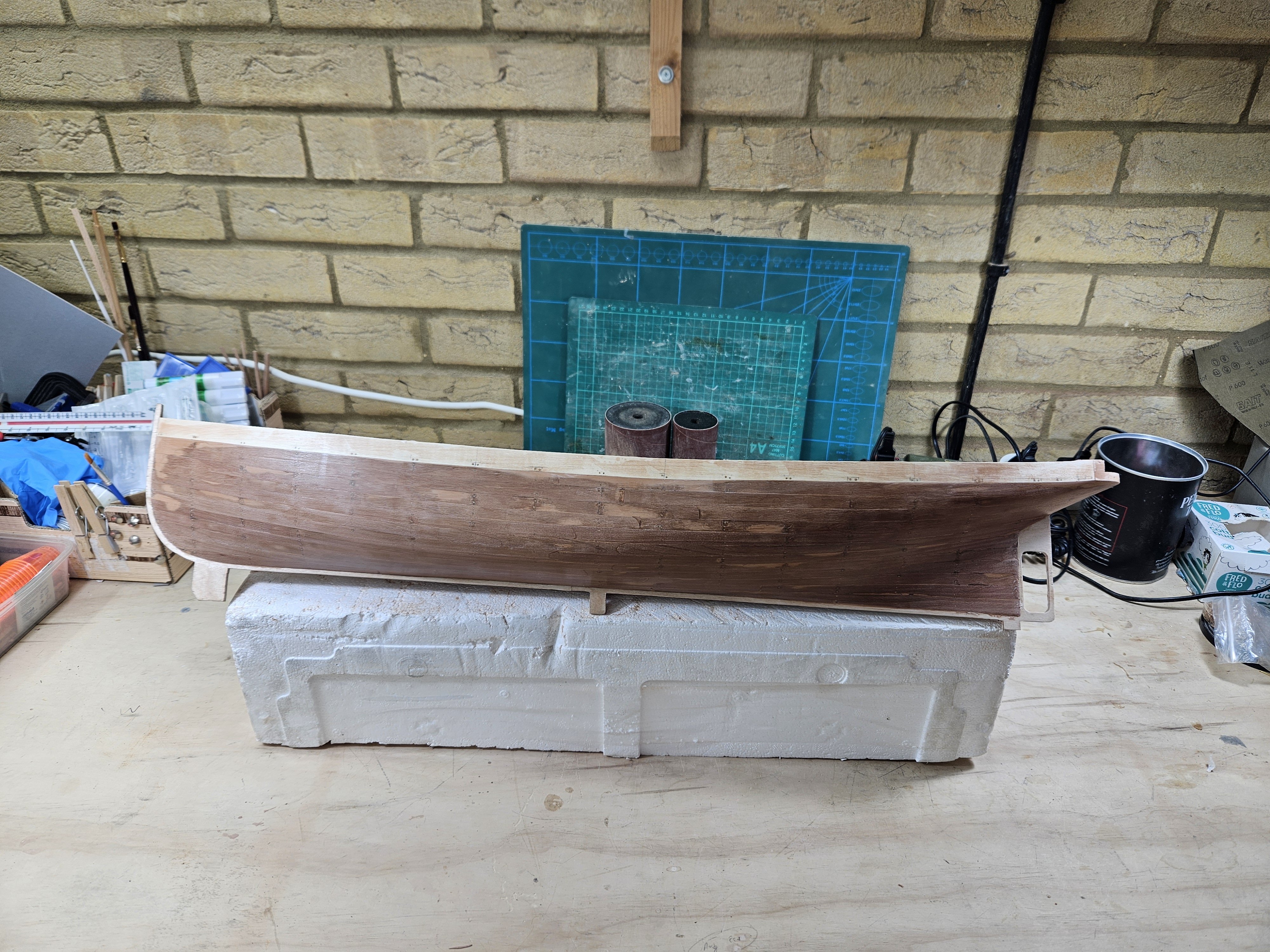

Ok, some more photos:

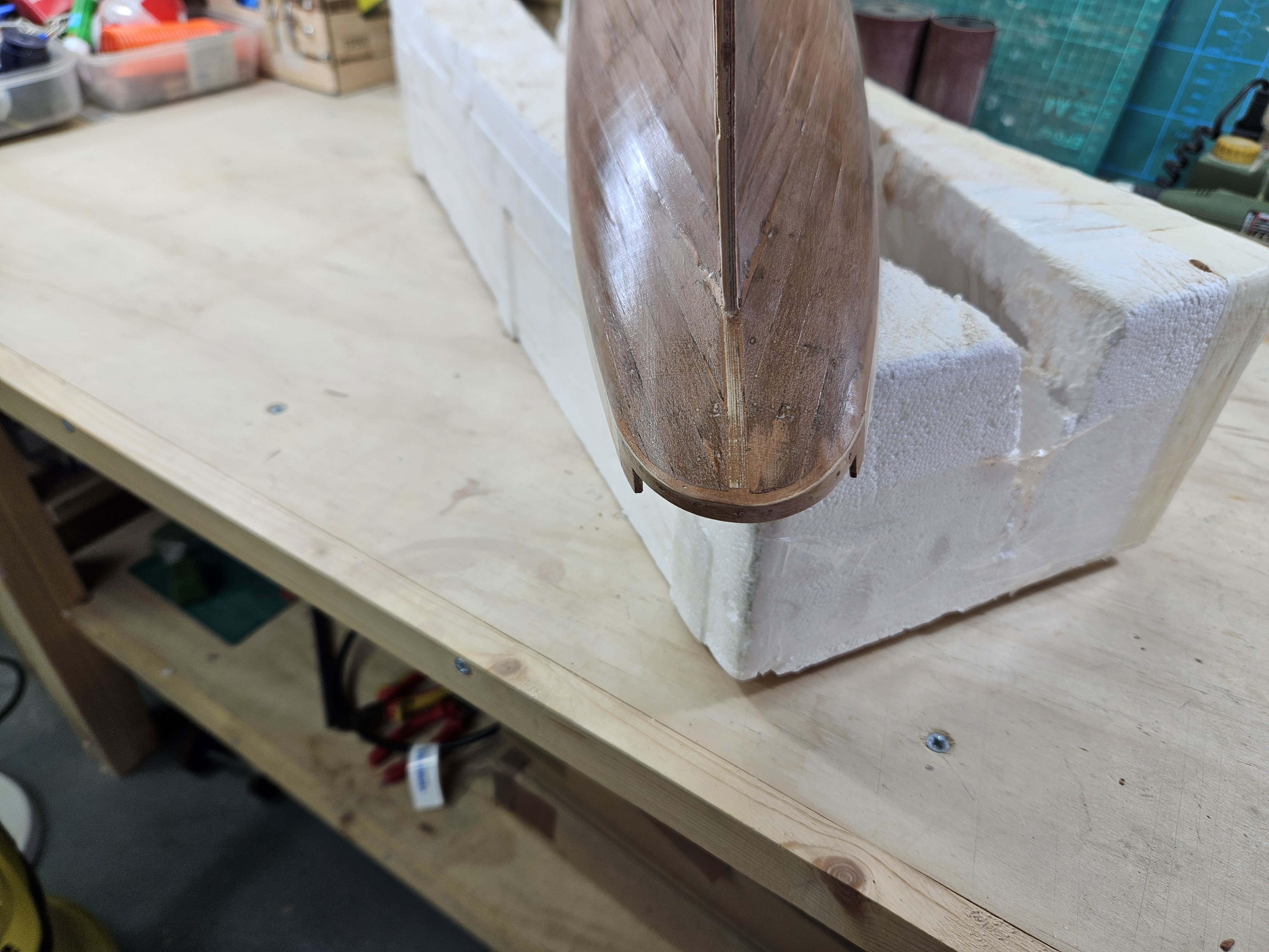

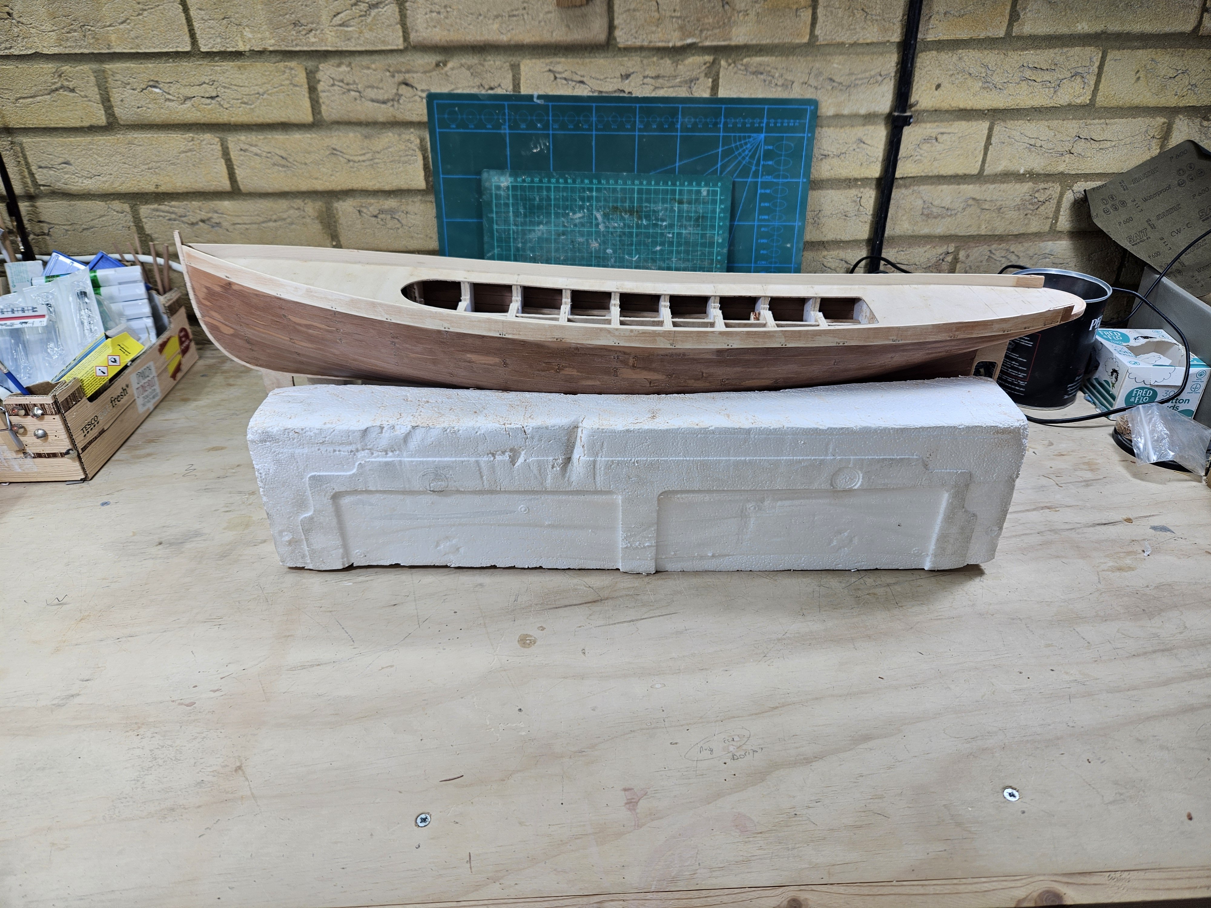

The hull is now filled, sanded to 320 grit, sealed and sanded lightly to 400 grit - then sealed again and re-sanded to 400 grit. I actually intended to use a blade to scrape the hull but I forgot to do it, it would have been faster. Still, the hull is now very smooth. I ve left the little feet to the hull as they ll help to mark the water line.
Happily, the stern also came out alright
There are several opening to be cut out to the bulwarks as well as some more  work to be done before painting

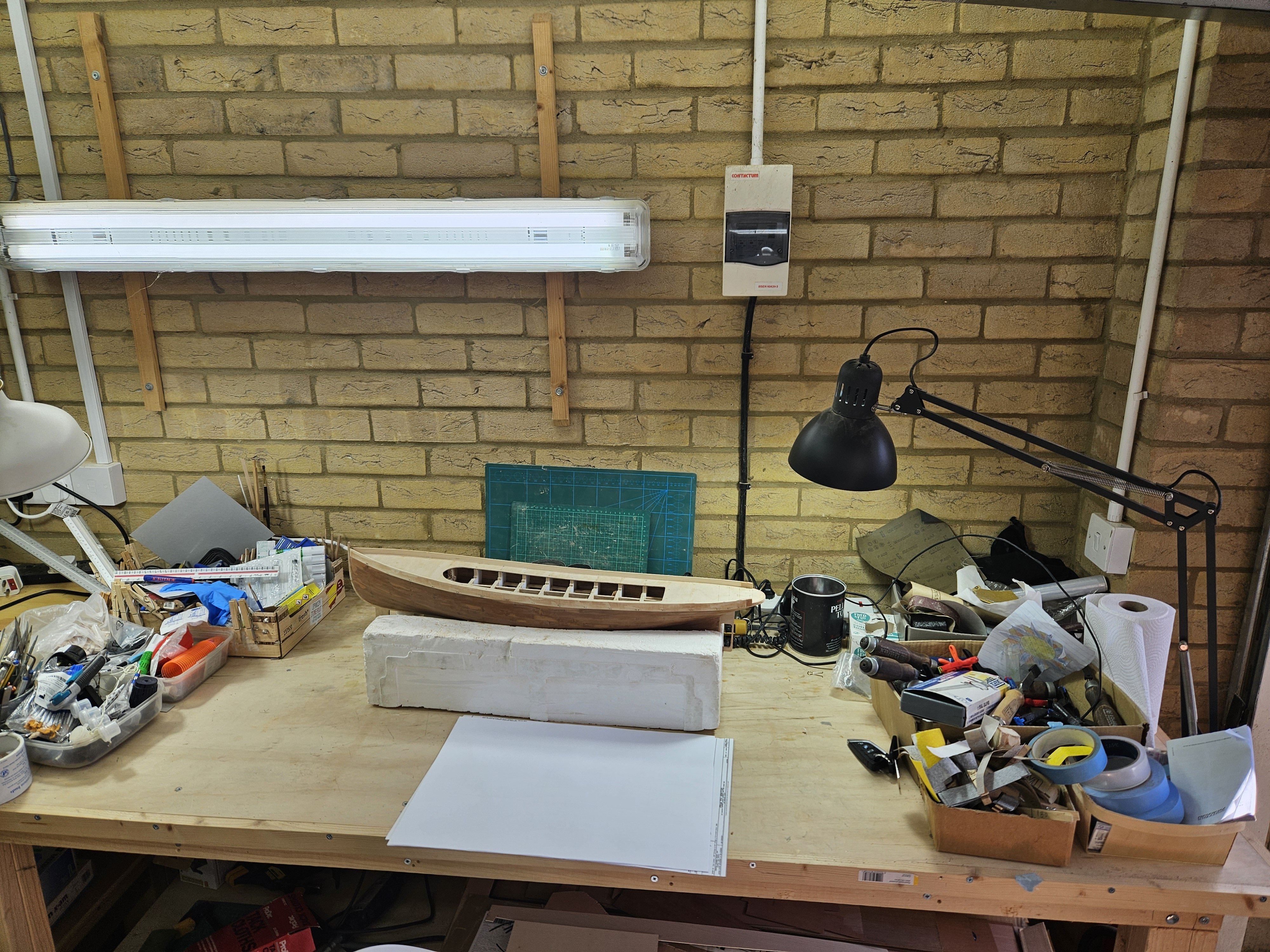

In the mean time I cleaned and tidied up the shipyard, thought I d share some photos
Sanding station with the new toy, Proxxon MF 70 - not sure what I can do with it but I had some credit with Axminster so chose this.
Cutting/drilling station
Work bench
Take care all

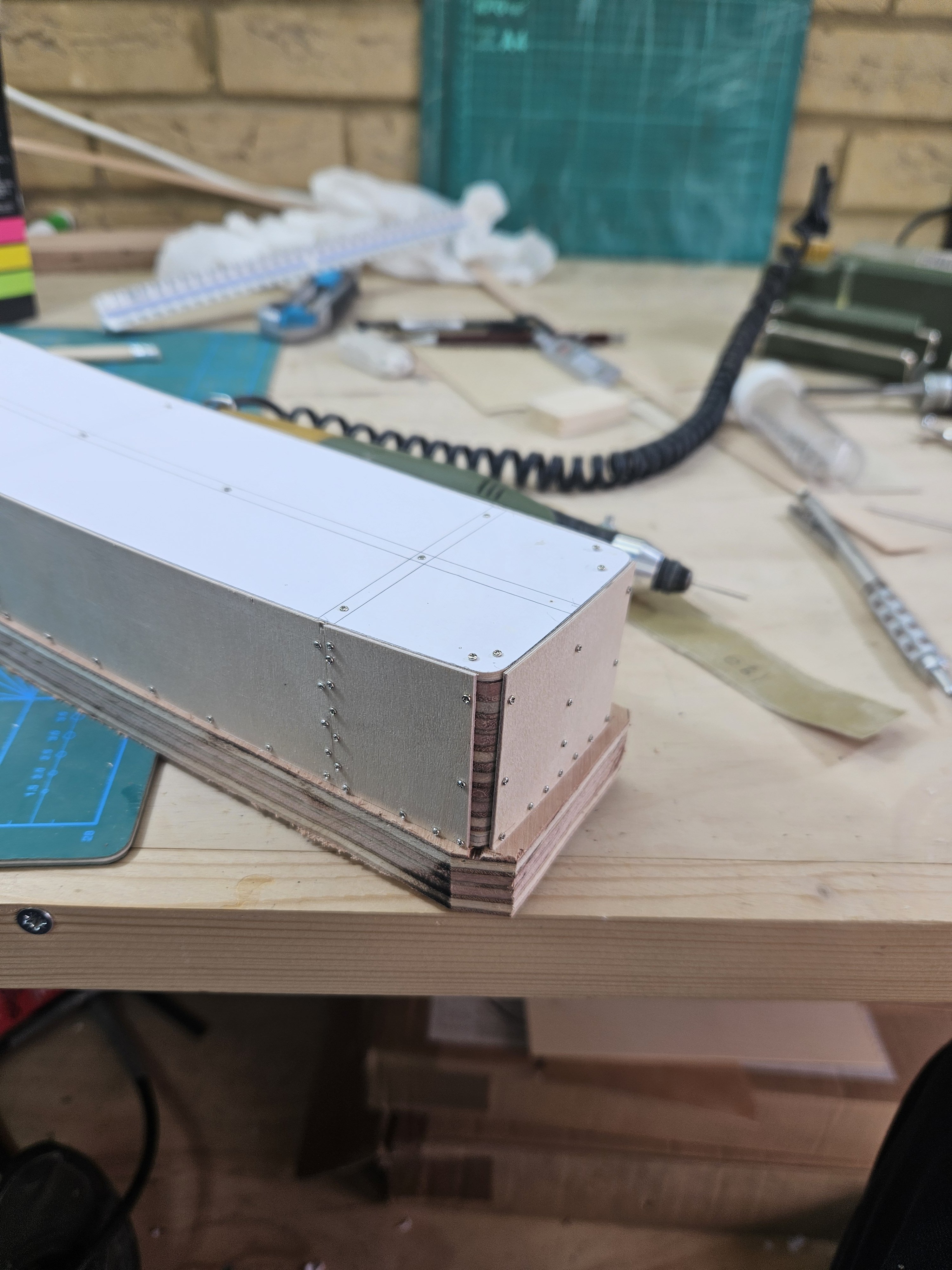

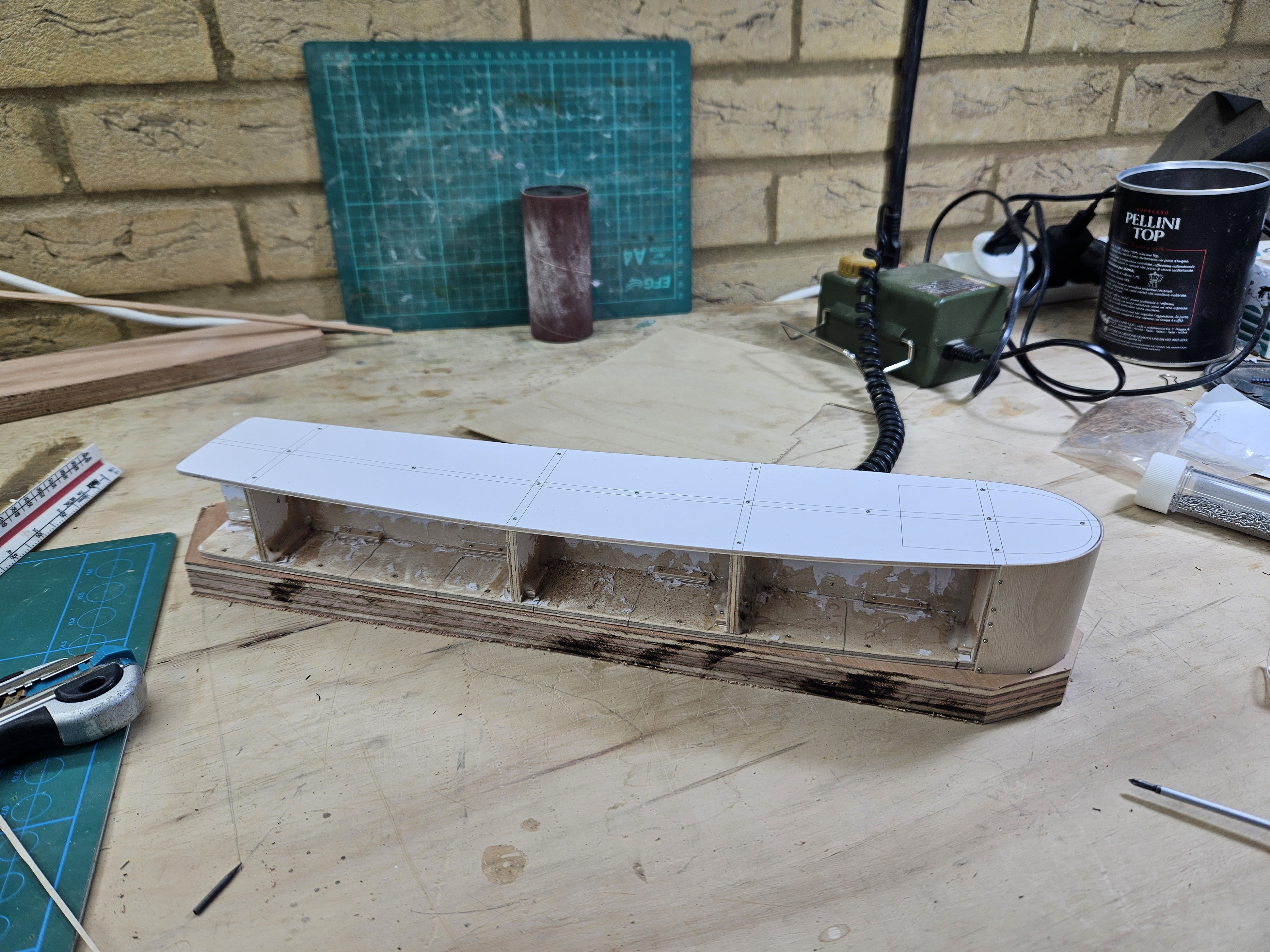

A wee more update as I did a bit more work on the boat - I must admit I am having too much fun!
I previously admitted that I shamelessly read the building instructions from Occre of their Hercules kit to get some ideas. There are a few things that I felt could be done better, in this post I ll show my solutions to the problems.

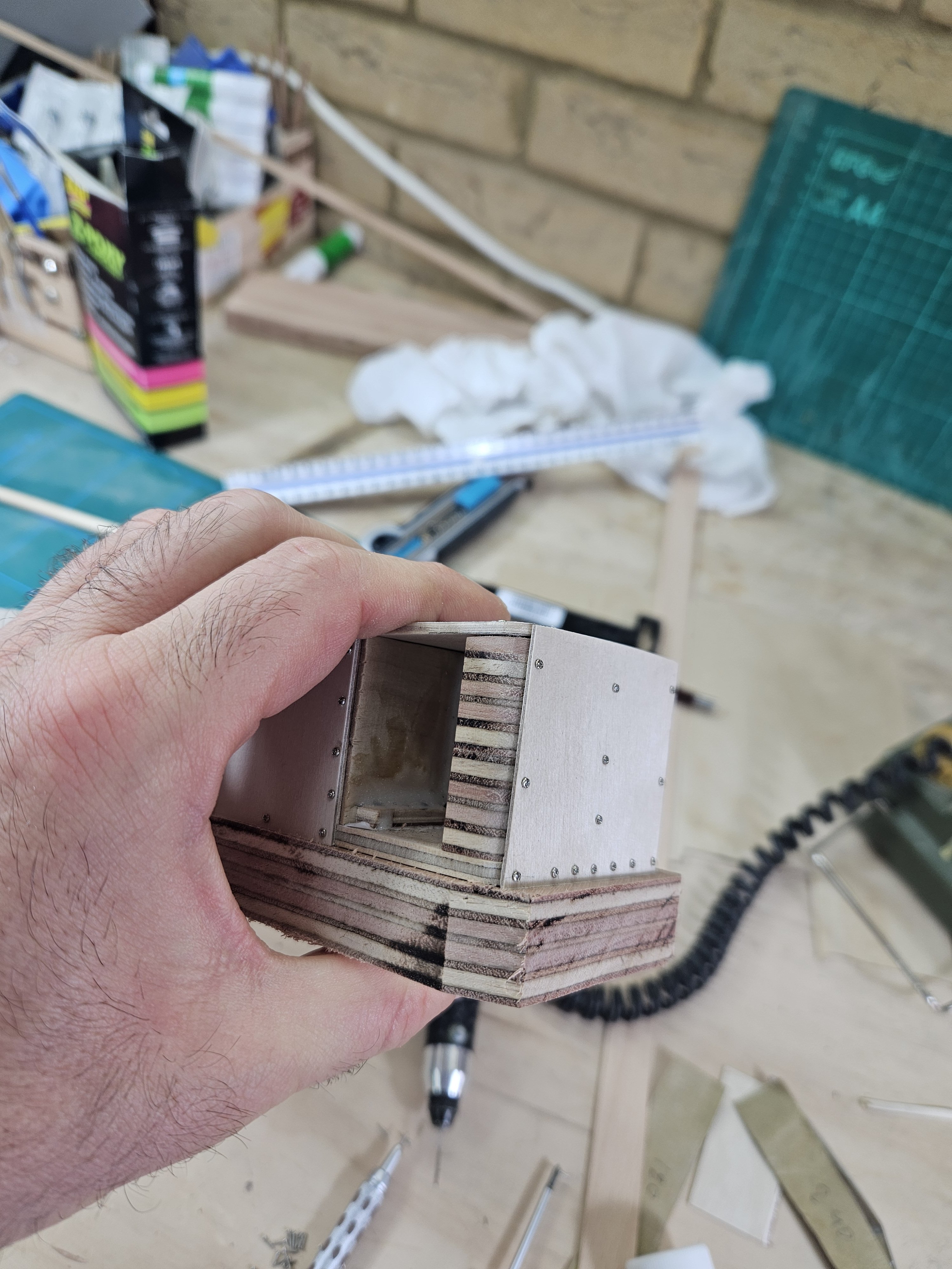

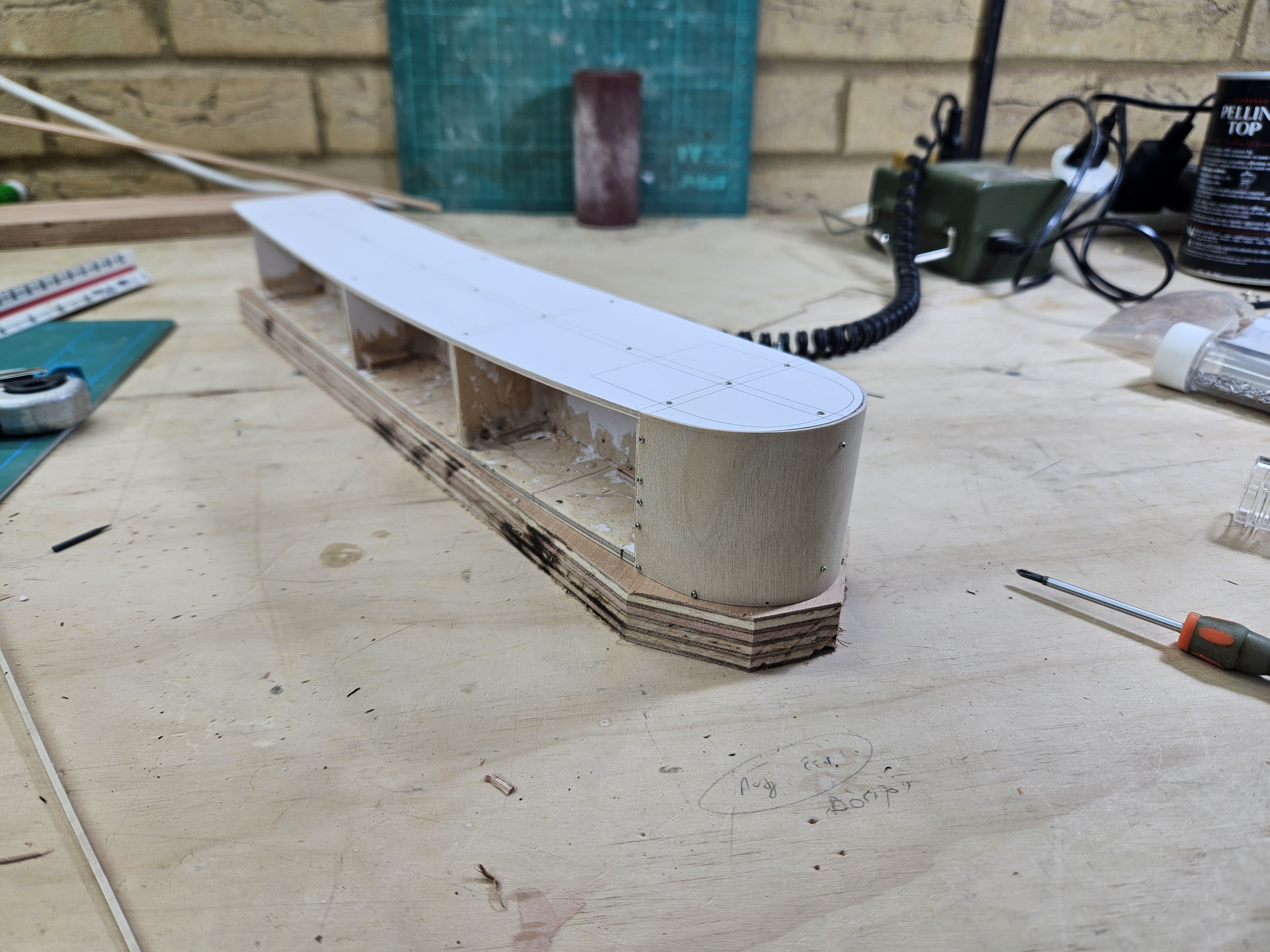

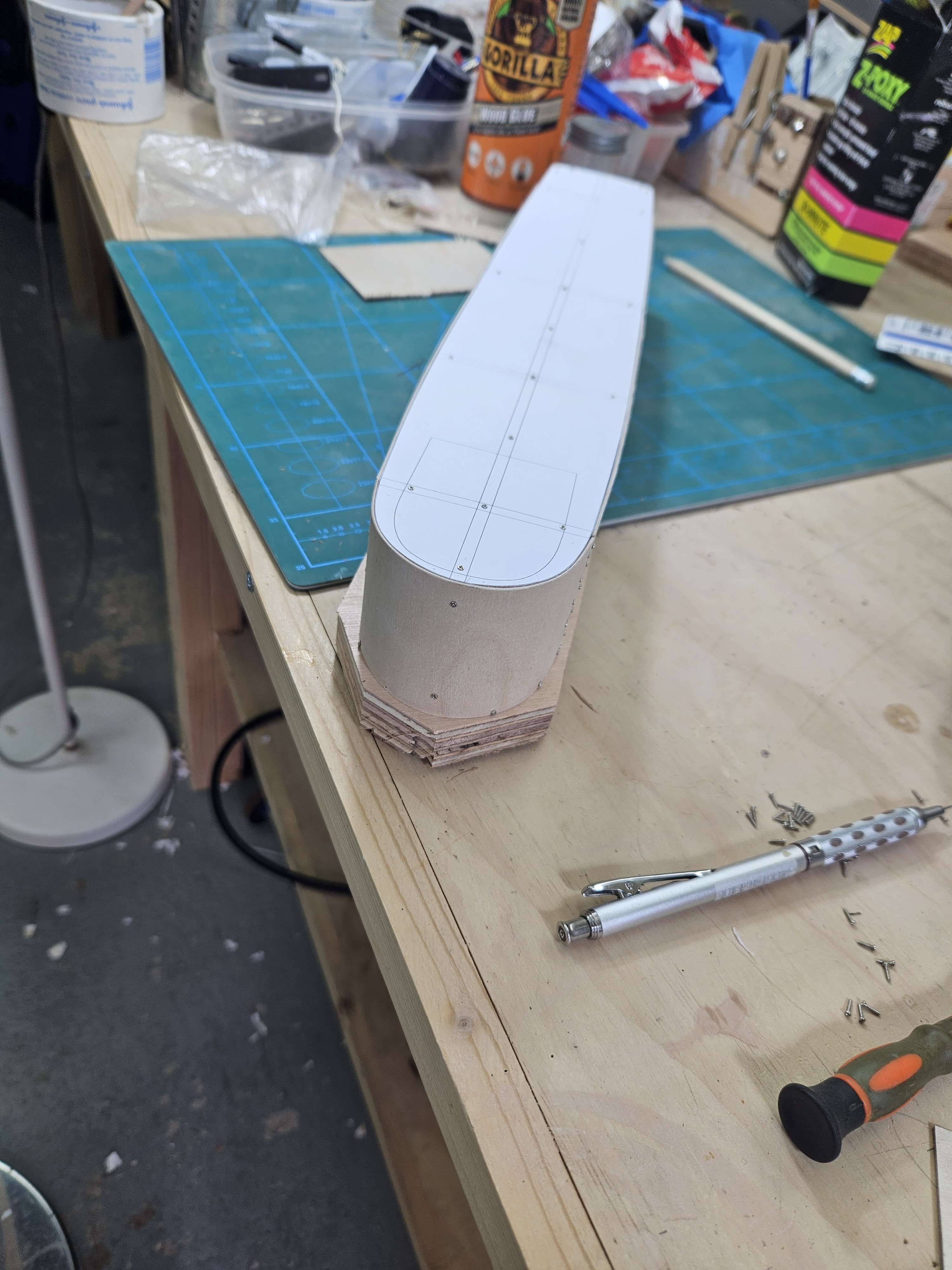

So I left the hull on the side for now and started work on the superstructure. Again, my CAD drafts were not entirely correct but at least the templates for the superstructure inner bulkheads were spot on. However, the plywood started warping so I screwed the bottom to a very thick piece of plywood and used screws and epoxy to make it rock solid.
Now, Occre uses lots of thin vertical pieces to cover the forward part of the superstructure, blended together afterwards with filler and sanding but I just bend a piece of 1 mm plywood.
Another area were Occre used multiple thin strips is the two aft corners but I just made two pillars with stacked pieces of plywood - the small gap will be very easily filled with filler.

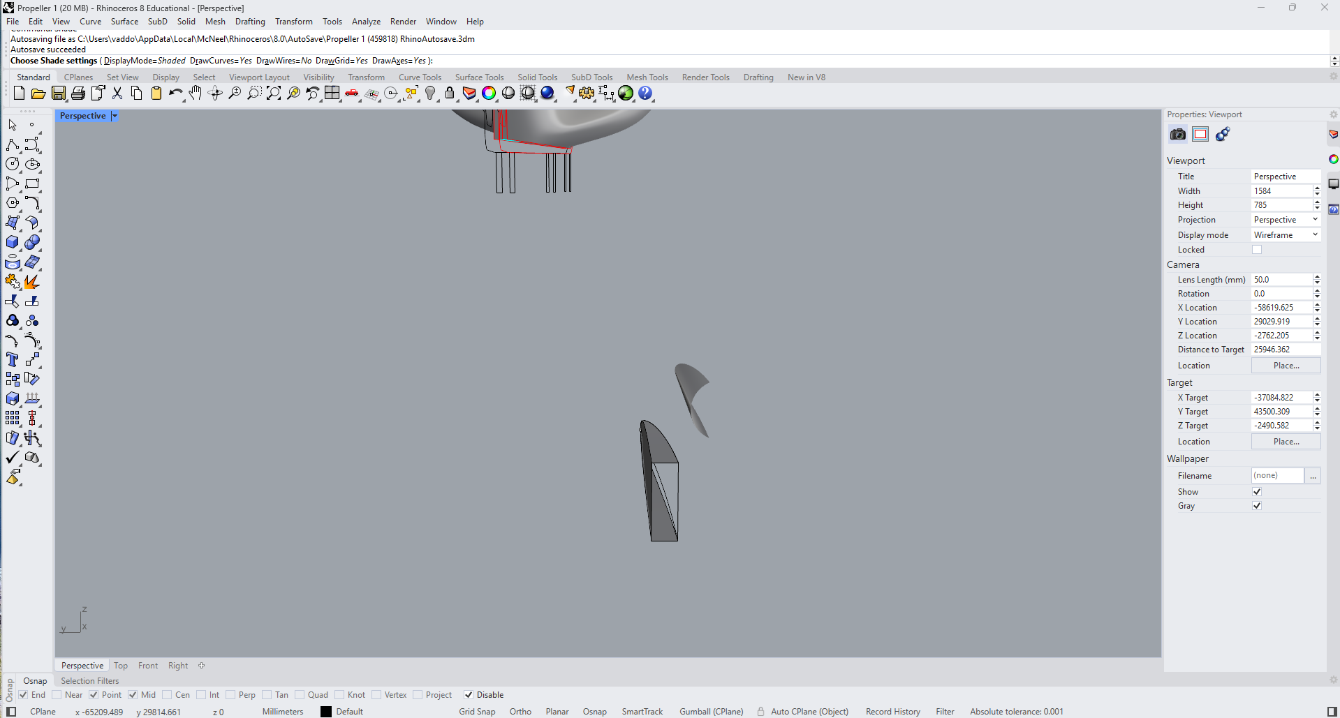

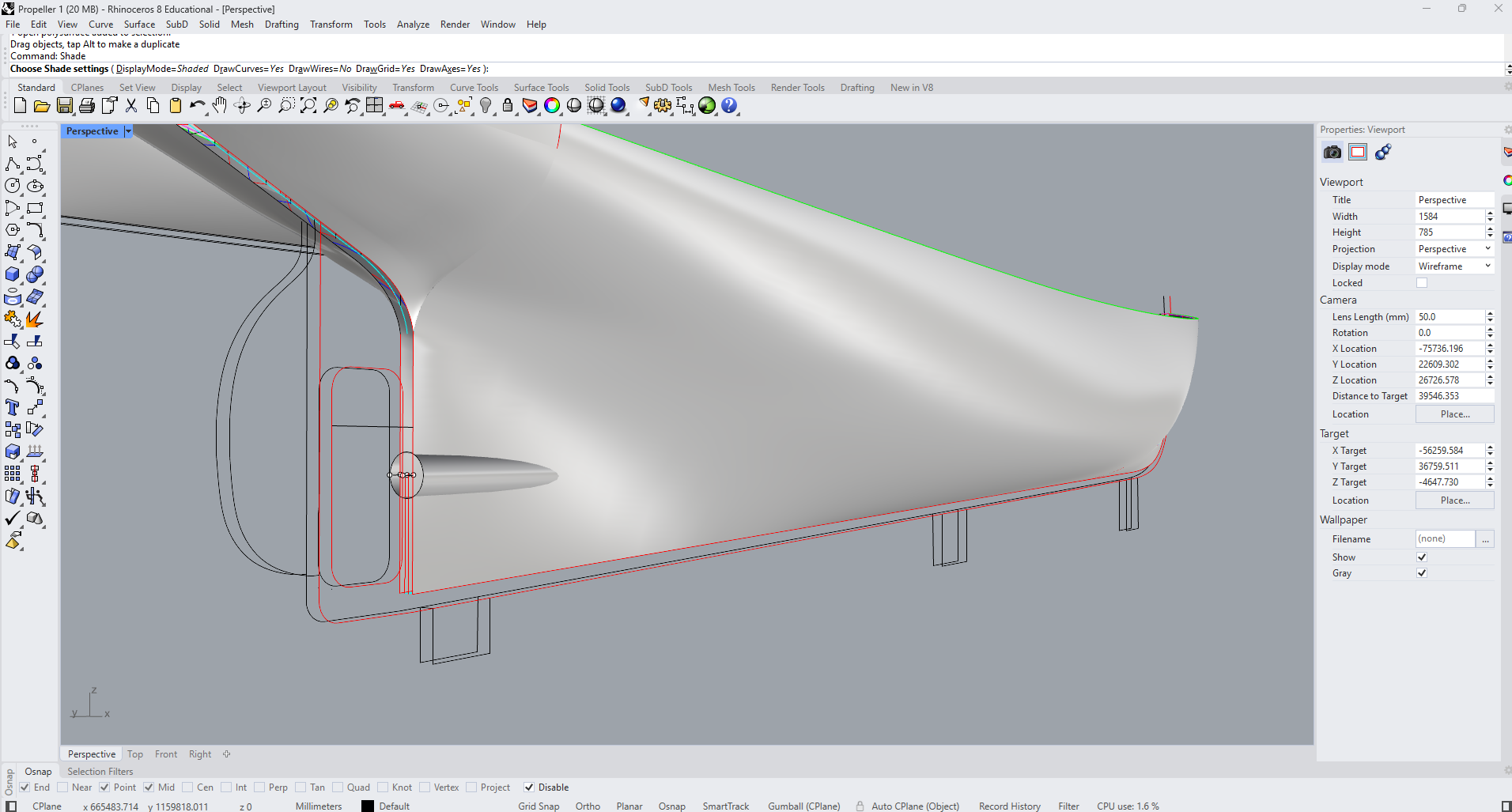

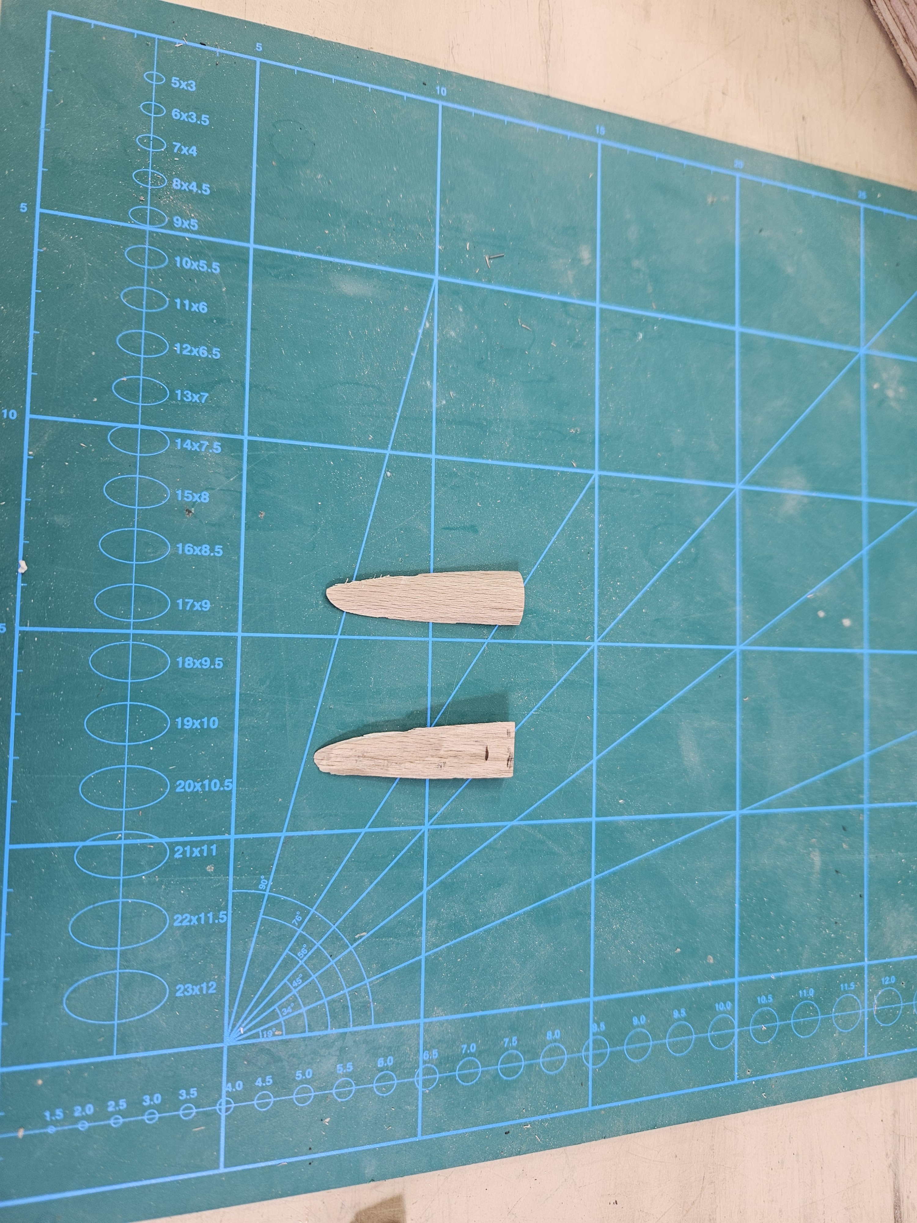

Hercules has a very distinct propeller shaft tube thingy, this is a feature that a model must have.
463793558_8454722294576597_7071510370891170678_n.jpg.37e7566228d7beae919d83ef49cc588c.jpg
The solution from Occre is not very elegant, just bending a piece of wood over a tube. My solution was different.
It was actually easy to draft this in CAD and looking at the drawing, it seemed doable to sand a half dowel to sit on the hull.
Indeed, it worked well and was surprisingly easy and quick. The screws will of course be replaced with wood nails, maybe even use a bot of epoxy, then filler and sanding - I think it will look fine.
Best wishes
Vaddoc
This looks like an awful amount of sawdust and sanding dust - I think I would have built up the core of the superstructure from layers of MDF and covered this in styrene sheet (or perhaps Bakelite paper in my case). This gives you a paint-ready surface.
Yes, this would have been a better alternative but I always end up overbuilding things. But I may have gone too far with this! What is not visible is the epoxy I added inside afterwards to glue the plywood walls with the frame...
I had problems with planks swelling and shrinking on my first two plank on bulkhead models, causing cracks to open up. Since then I have coated the inside of the hull planking with thin epoxy. It flows into the cracks between planks, and between the planks and bulkheads, sealing the hull. After the epoxy cures the hulls are really solid. After 35-40 years the first hull I built this way still has no cracks between planks.
I plank the hull and seal it before installing the deck.
Phil
