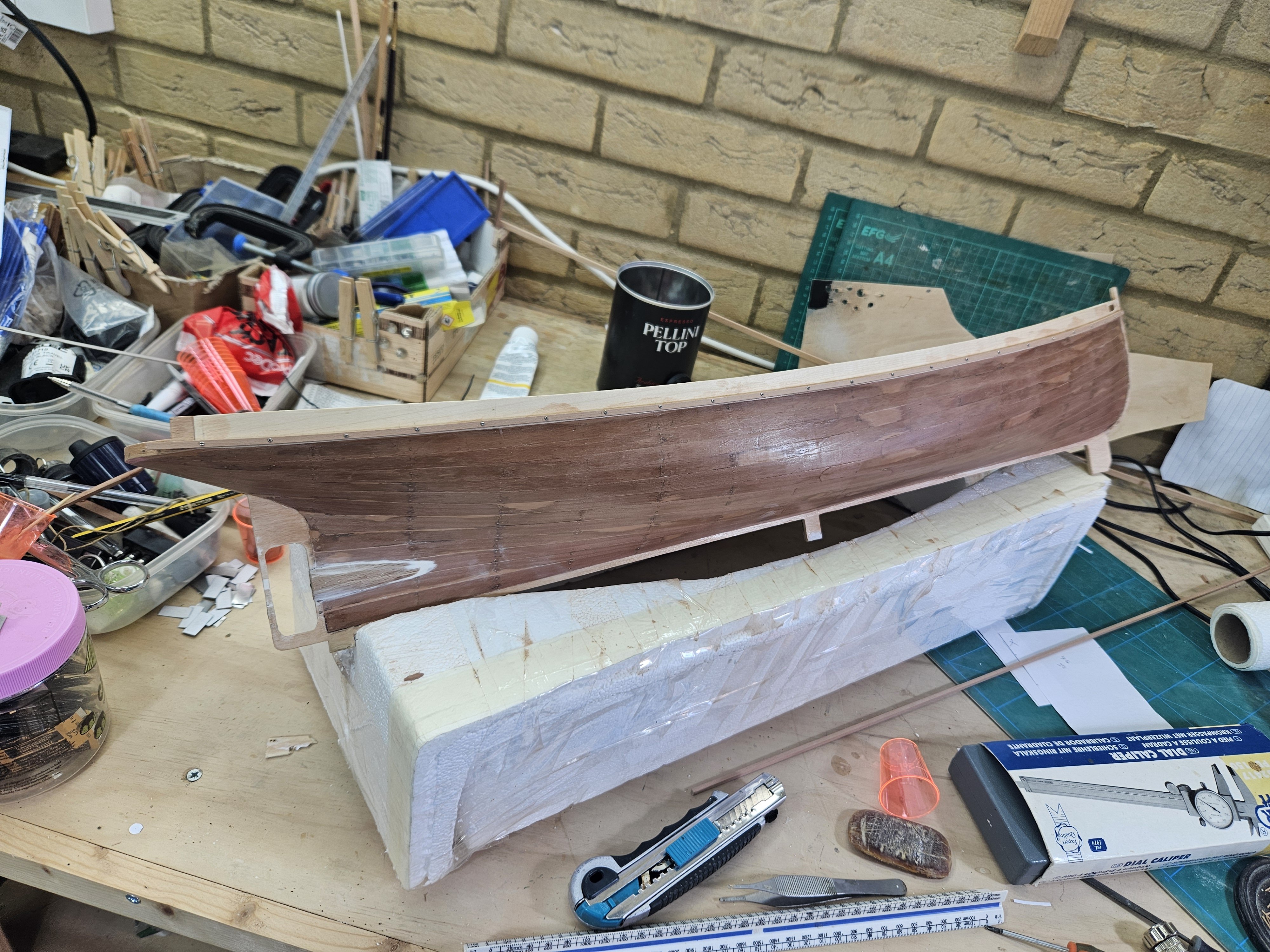

@Dr PR Phil, I remembered you sharing this and it was on my to do list, unfortunately I had to use so many pieces of wood to straighten the hull that there was no space for a brush, most of the inner surface of the hull was inaccessible. I ll be using epoxy for sure in the future though.
So, very little progress to share but here it is:

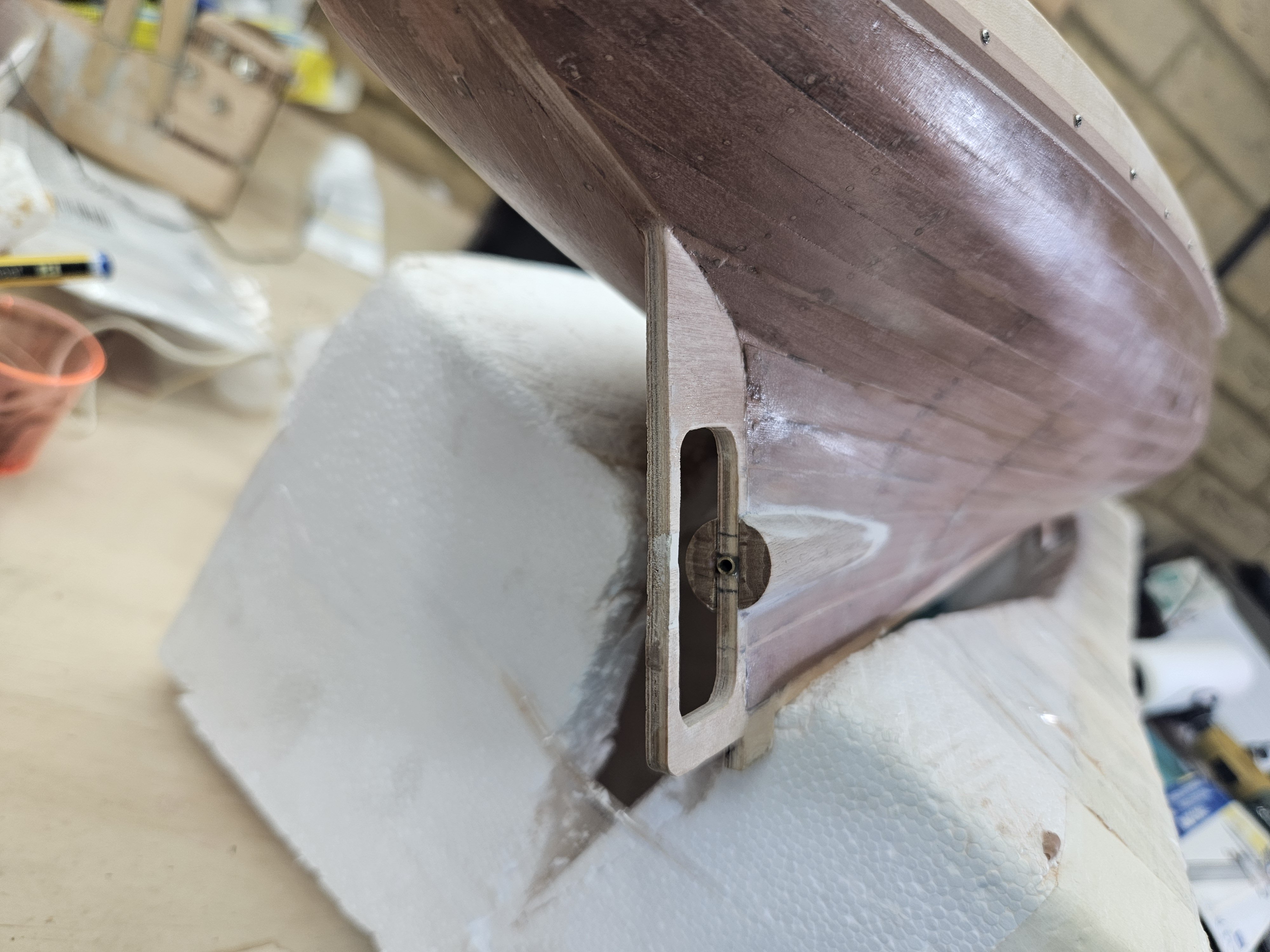

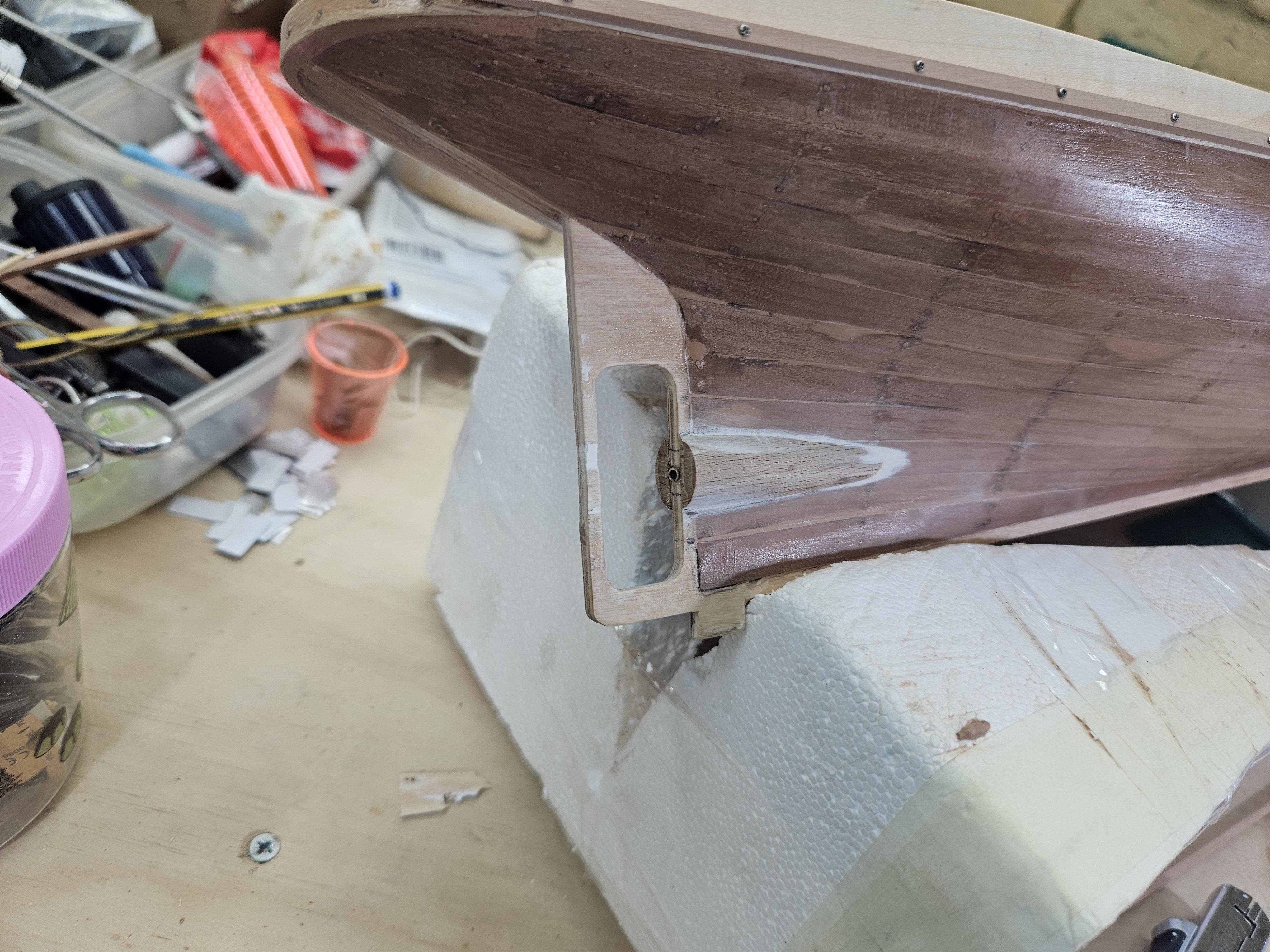

I finished with the propeller shaft housing, it is secured, sanded and faired. I think this was a much more elegant solution than Occre's but also much more difficult.

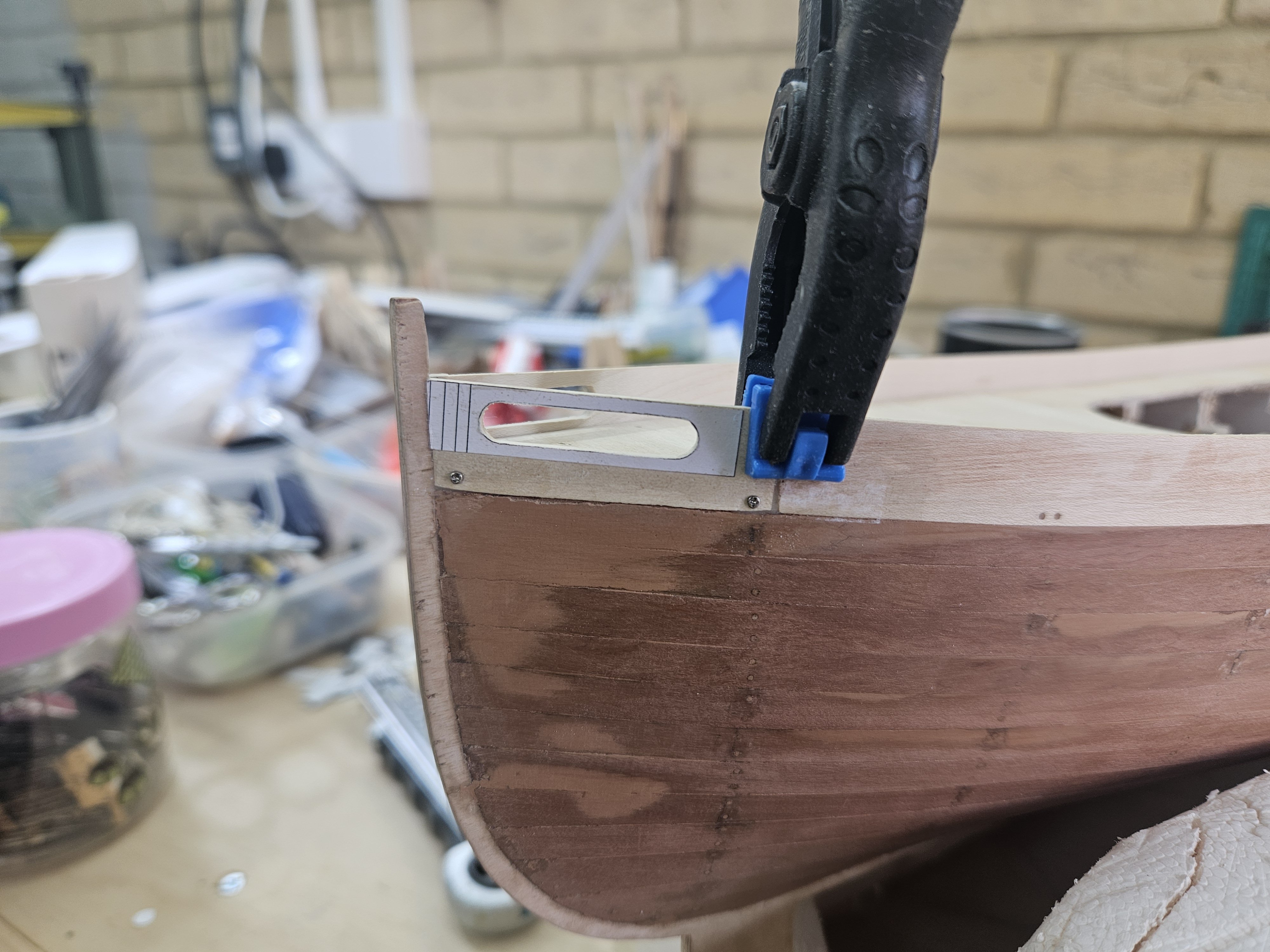

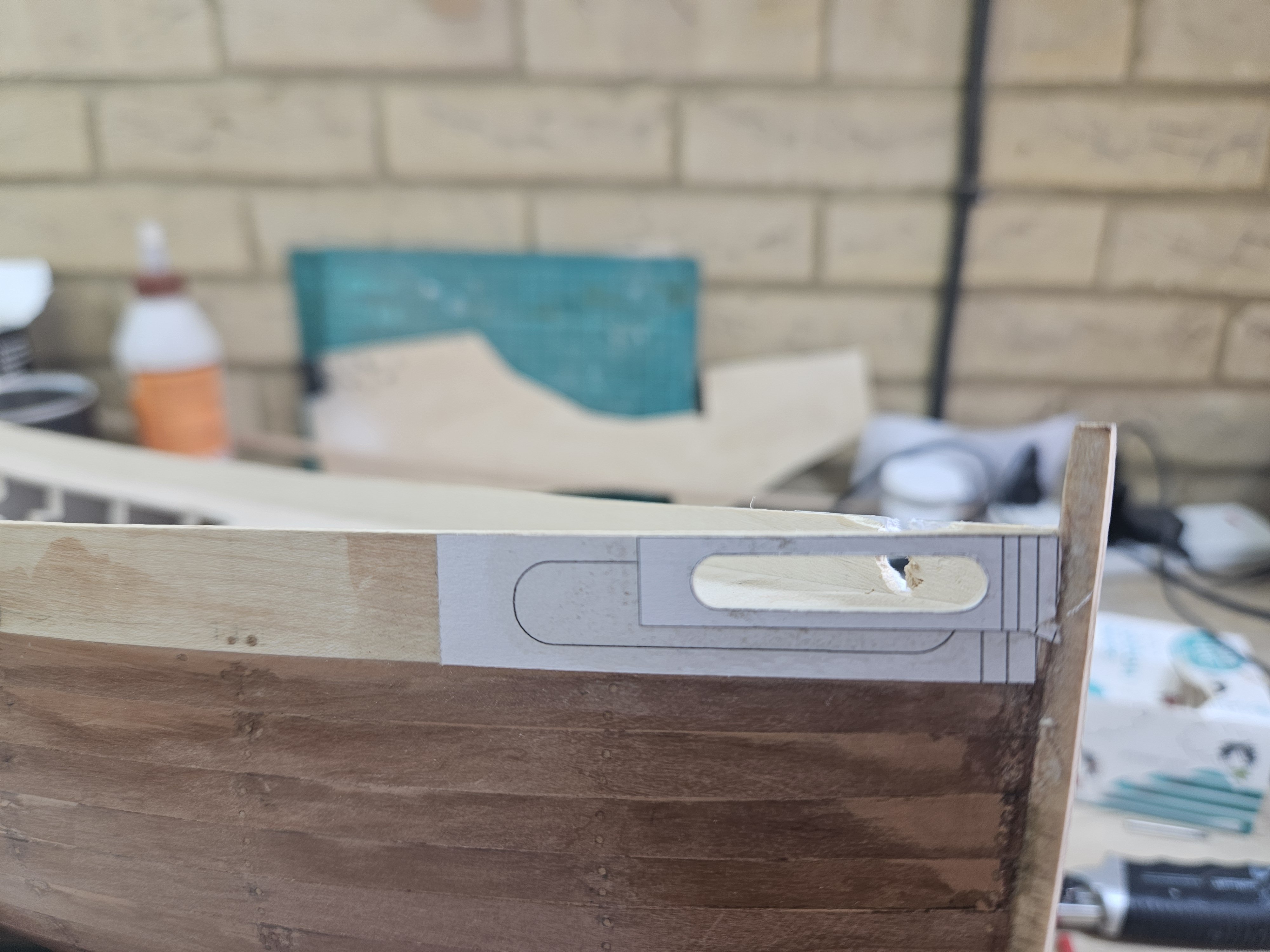

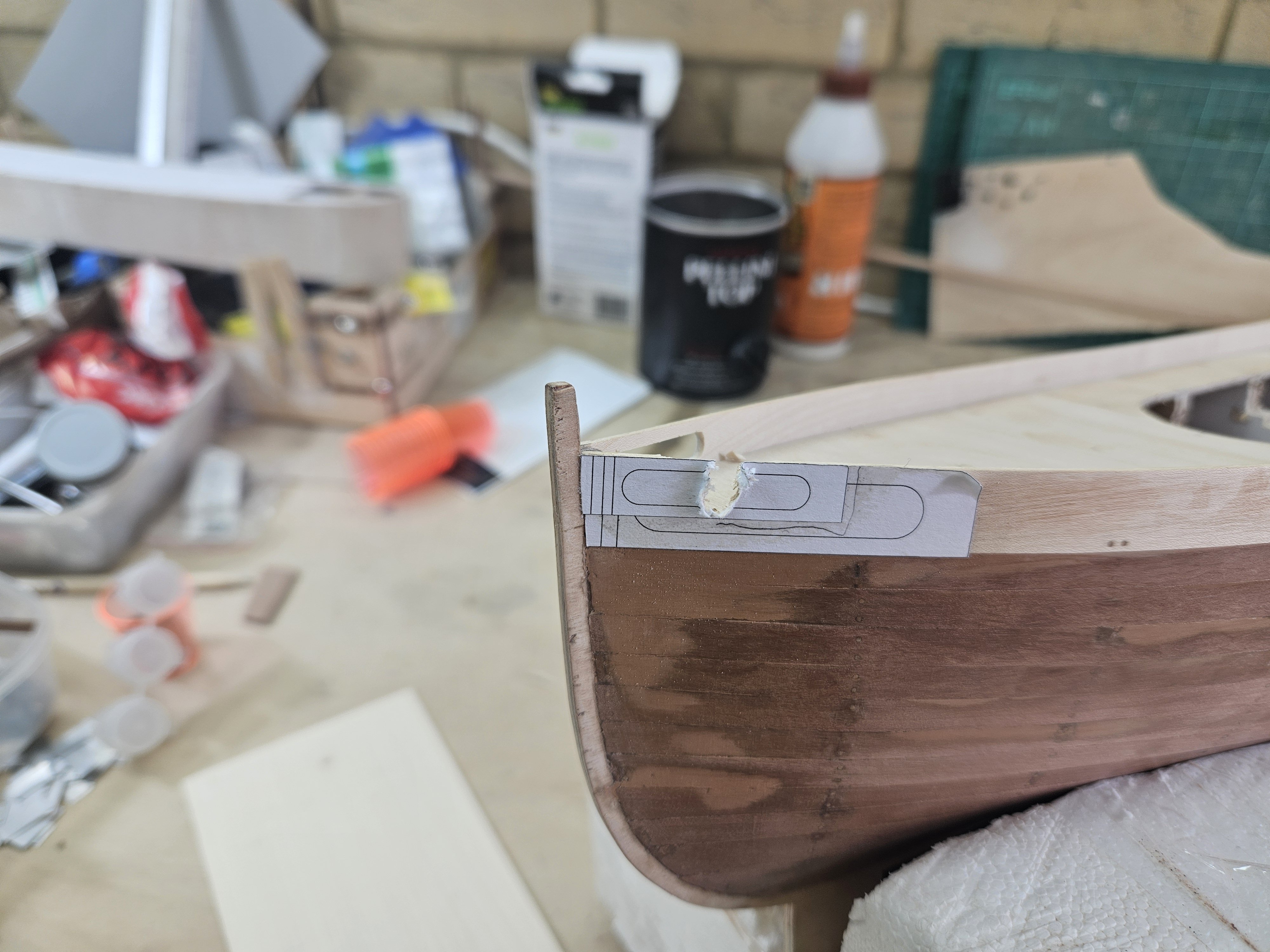

Next I started cutting the openings on the bulwark. One side went fine:

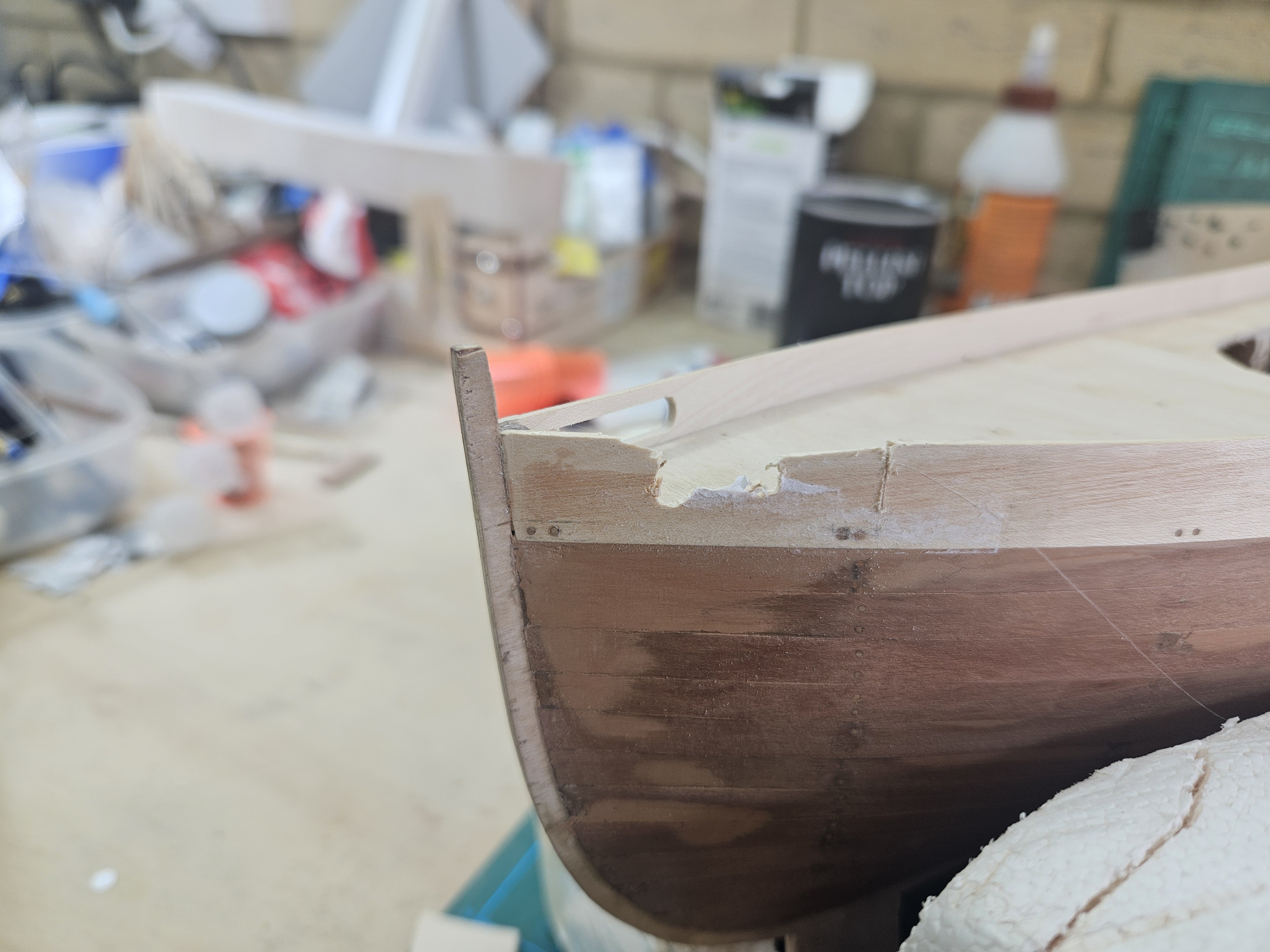

The other not, the drill slipped!

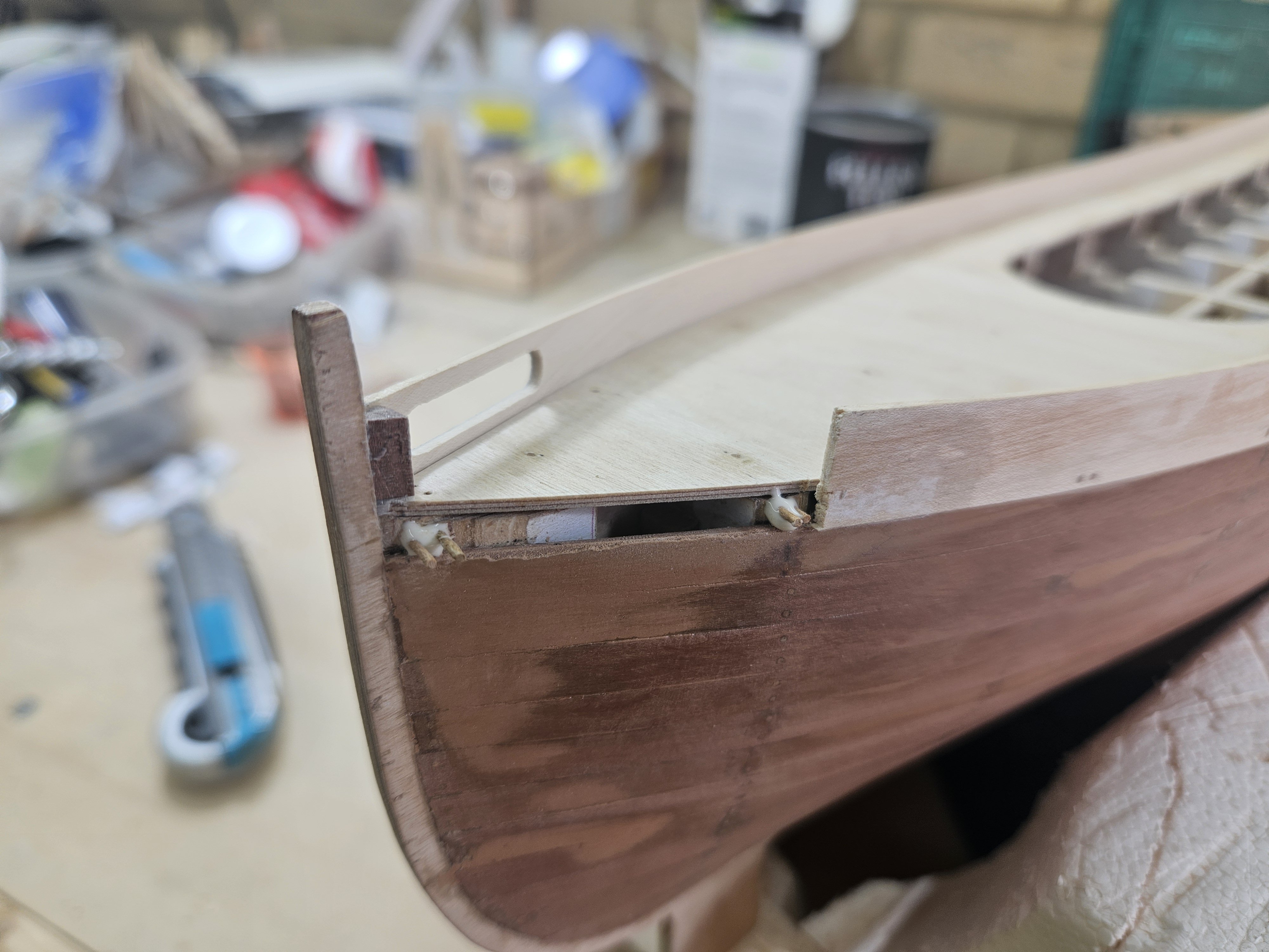

Trying to see how to correct it, I broke it even more!

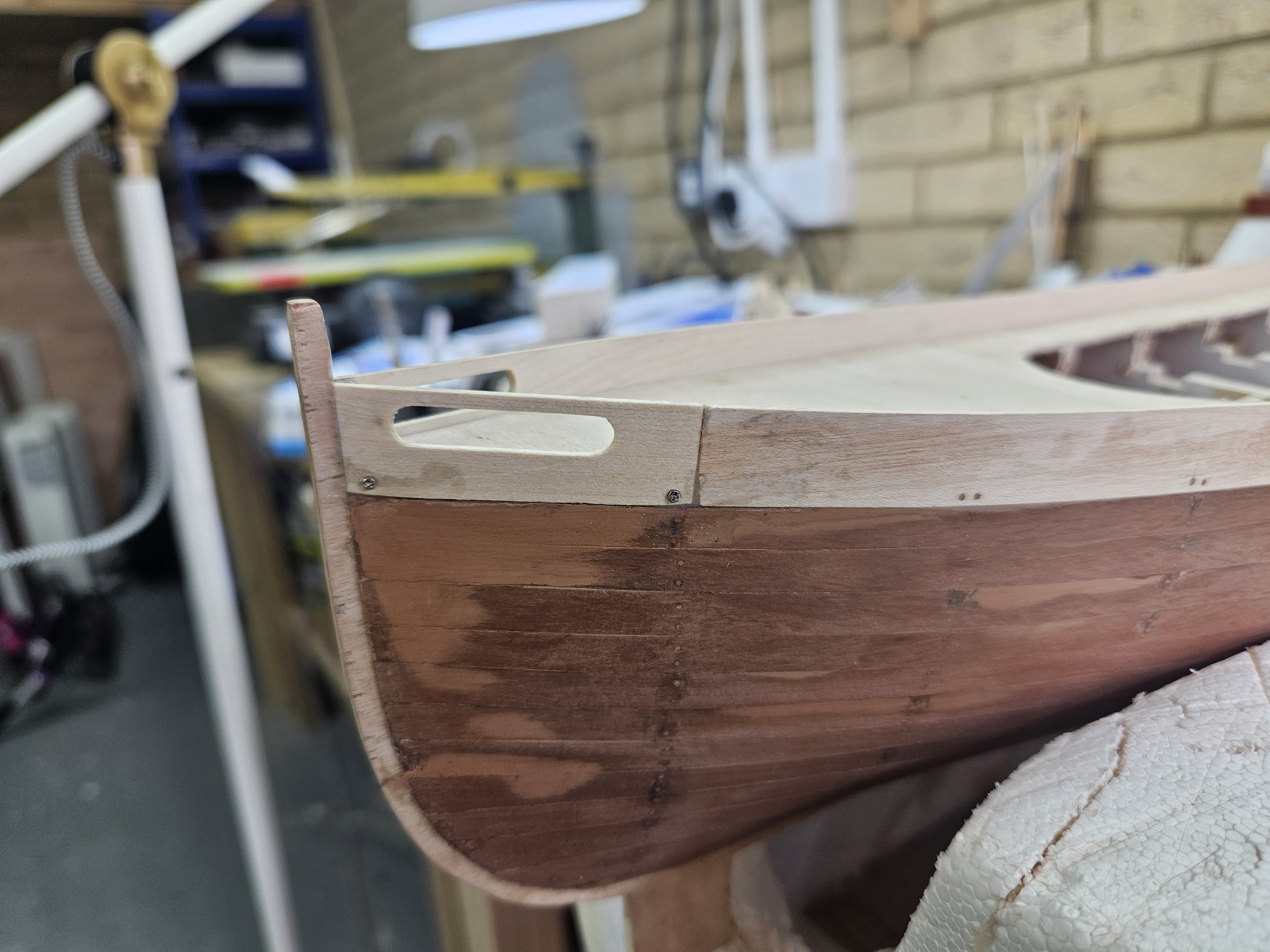

Ok, no need to panic. It was relatively straight forward to fix it:
It has since been sanded and the screws replaced with tree nails. When painted and more stuff added on, it will be invisible.
I then attached the rubrail on one side

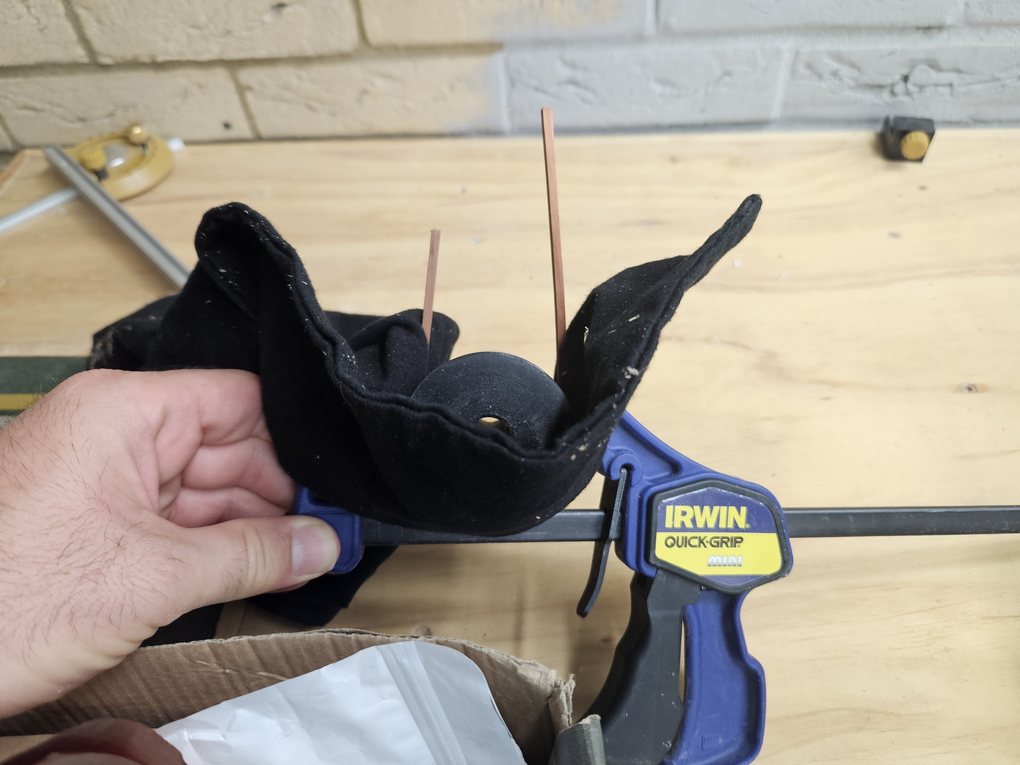

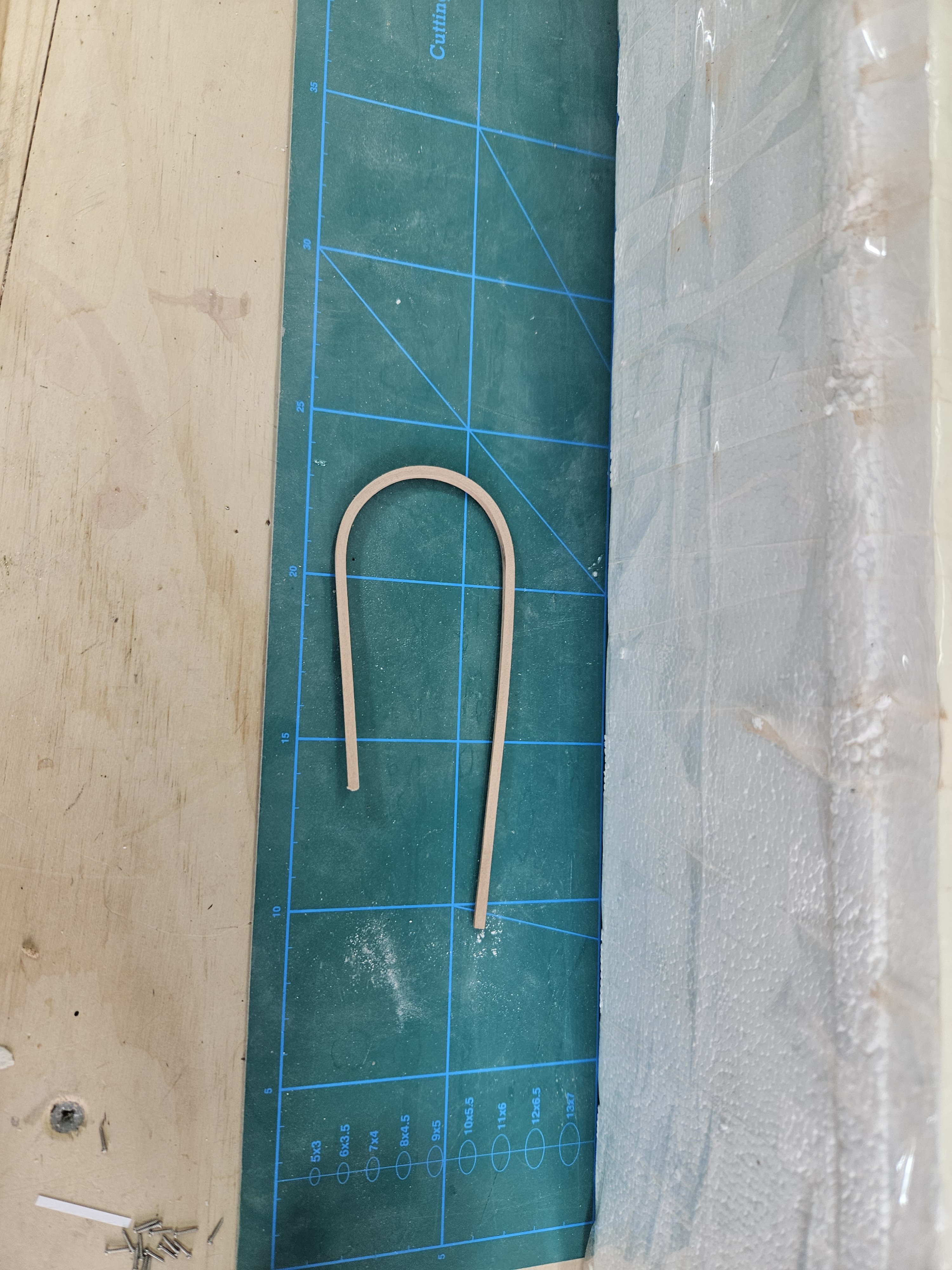

Now the rub rail continues around the stern in a pretty tight curve for a 3 x 3 mm pear strip to accept. I emersed the strip in a pot of boiling water slowly pushing against the pot wall, the strip took the bend in no time.

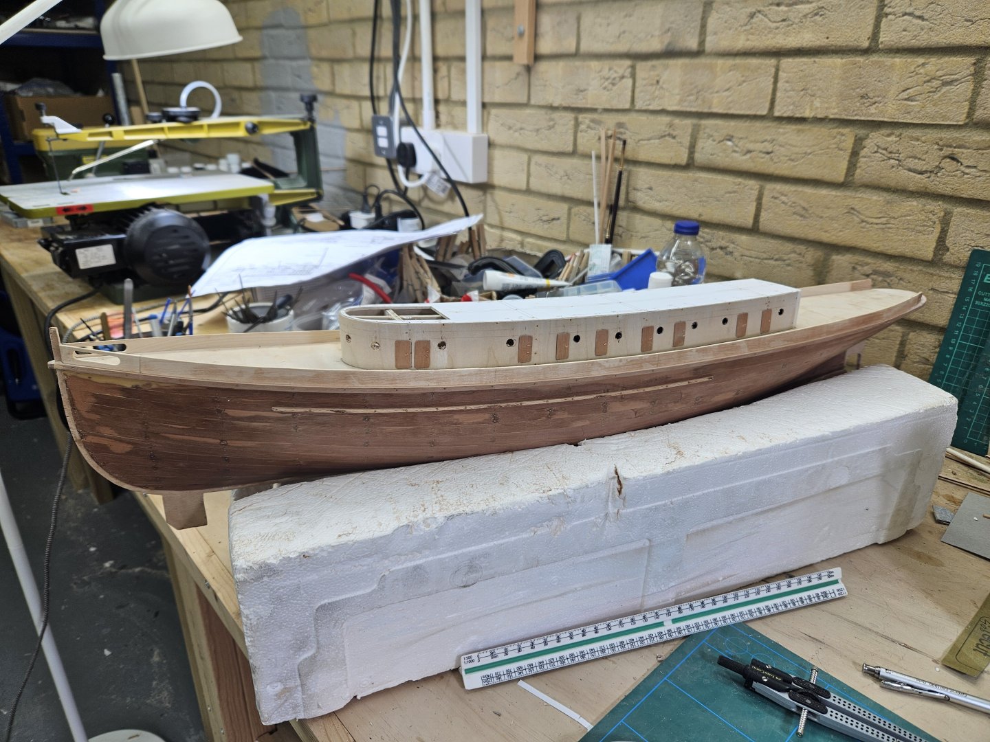

Ok, so I did a bit of work on Hercules.

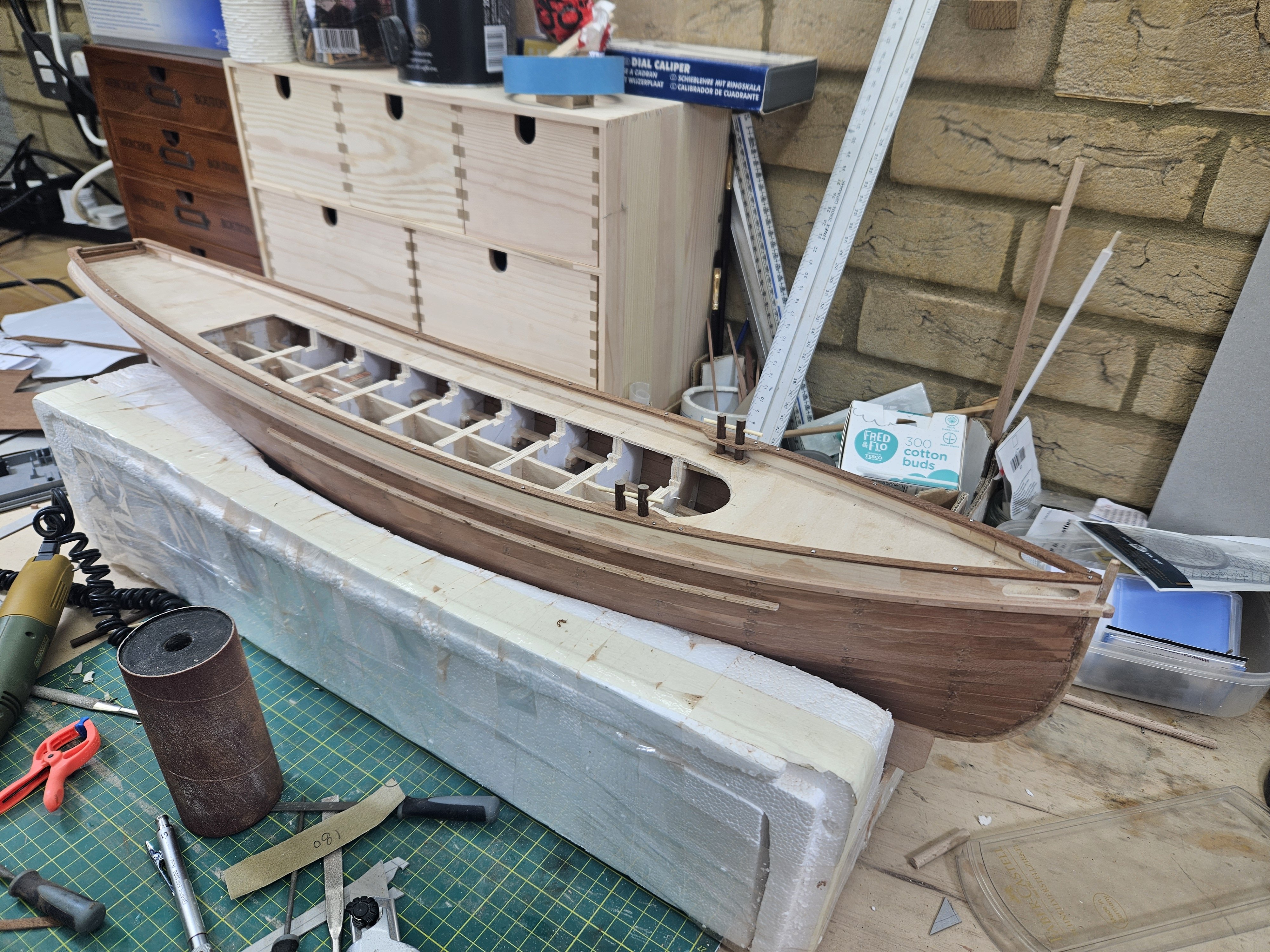

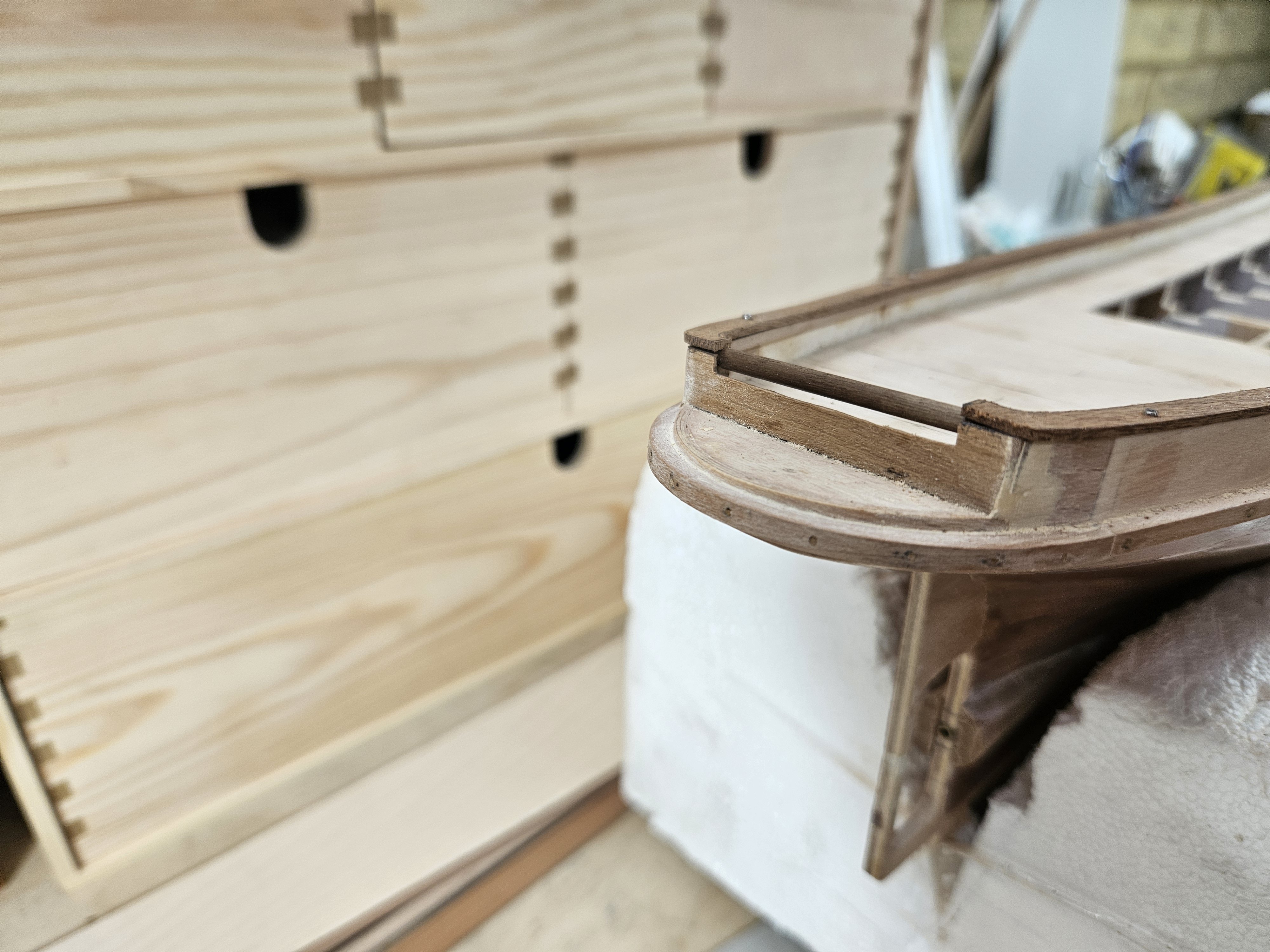

I managed to finish the timber guard at the stern which was a bit tricky, I am not used to work at such small scales. I then installed the lower timber guard
20250826_103447.thumb.jpg.c2fe61497cd4a13dccfe472893f178ef.jpg20251219_210644.thumb.jpg.2a7f258990108f362ebdc4072036ffbe.jpg

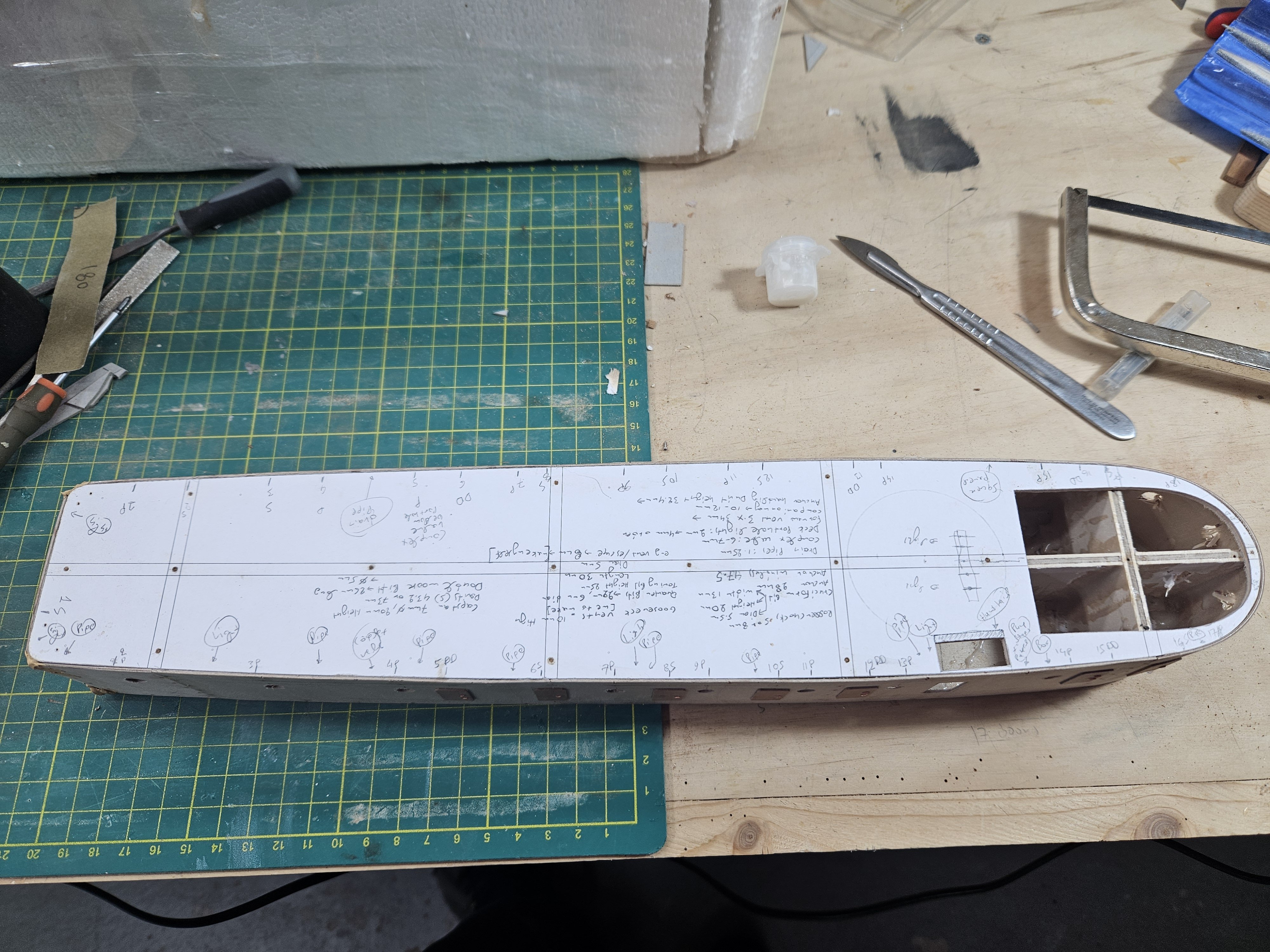

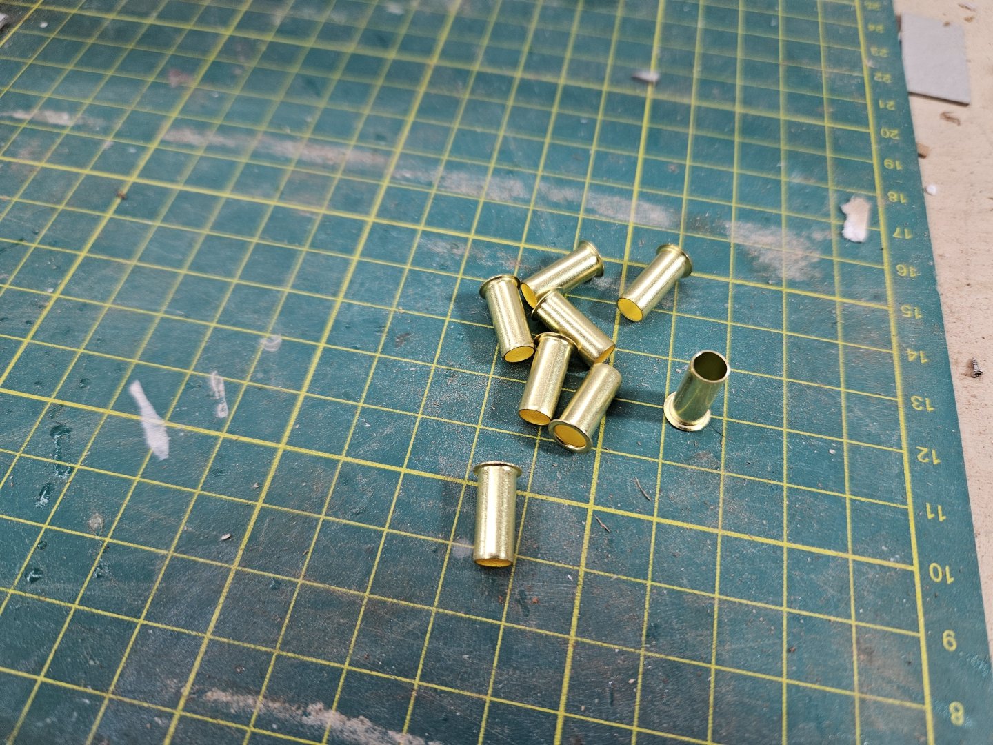

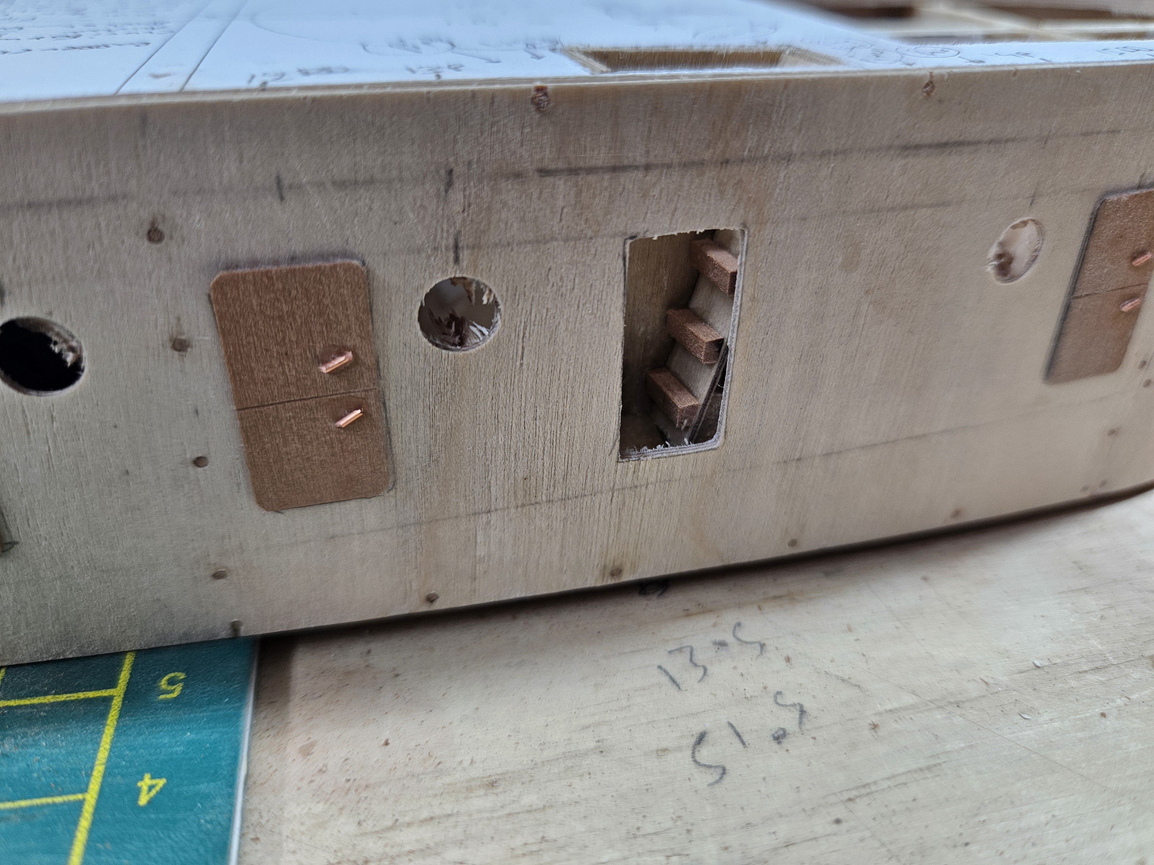

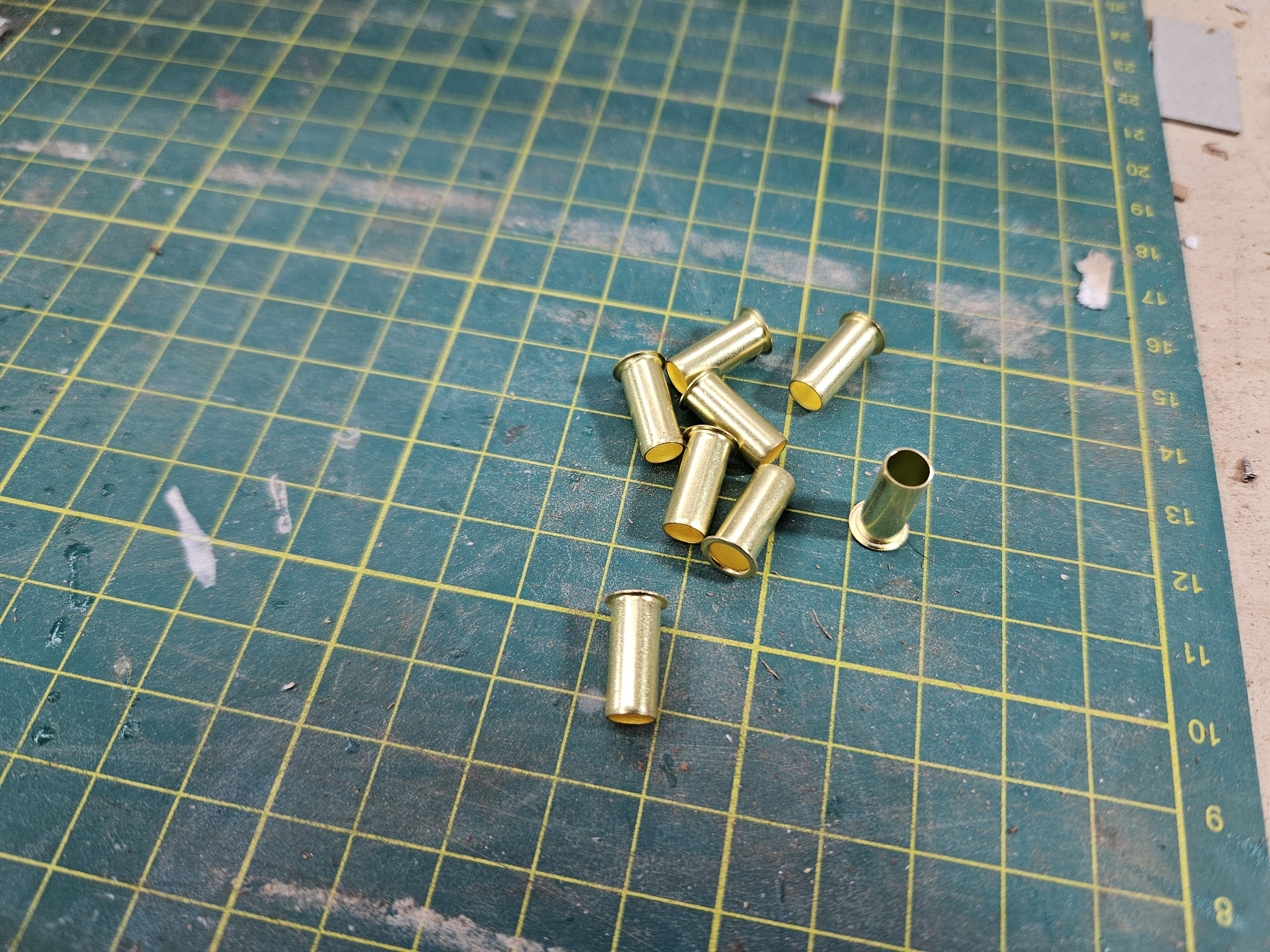

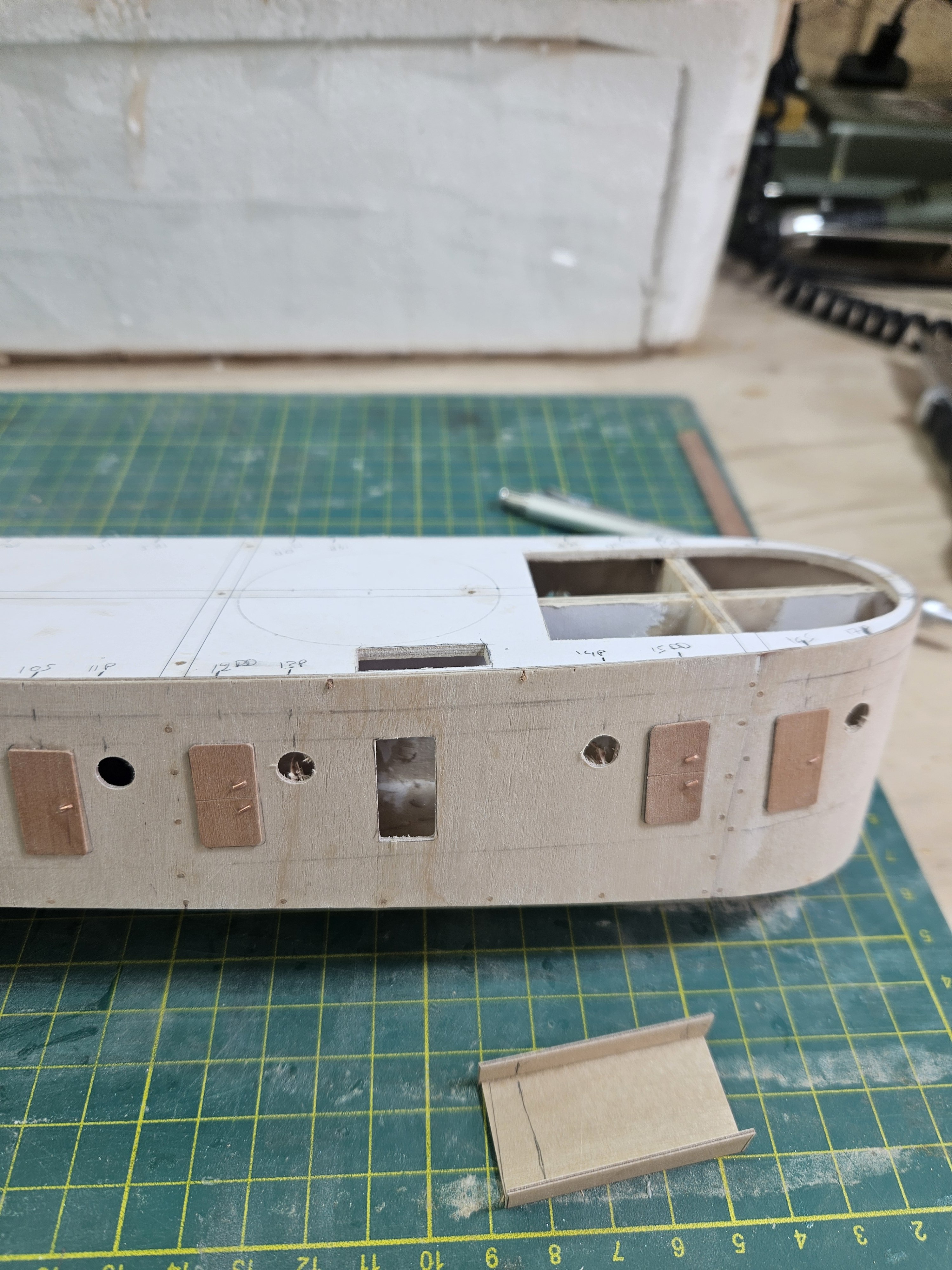

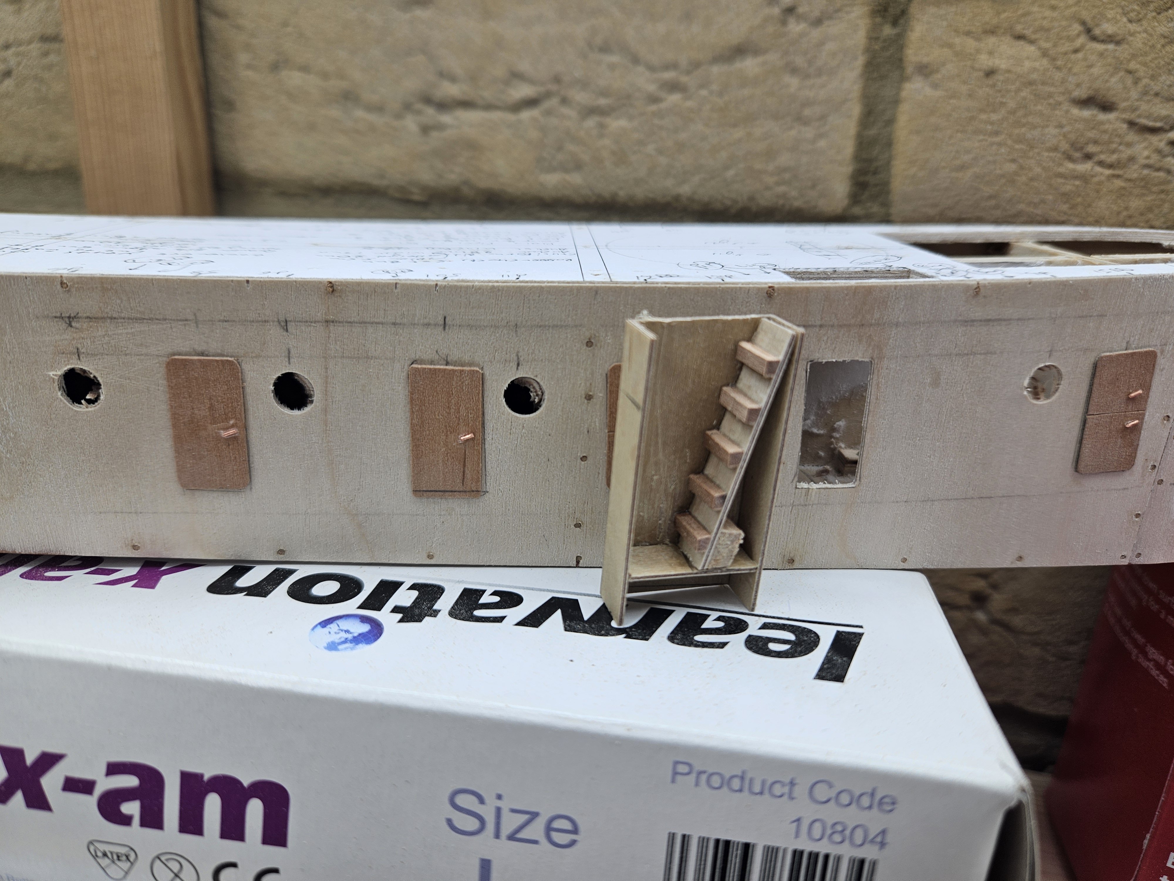

Then I started work on the first level of the superstructure, lots of things going on there. I made the doors and drilled (very carefully!) the holes for the portholes- it was at that time I realised there is a staircase. After a bit of  trial and error I managed to come up with something that painted black will look ok ish I think.

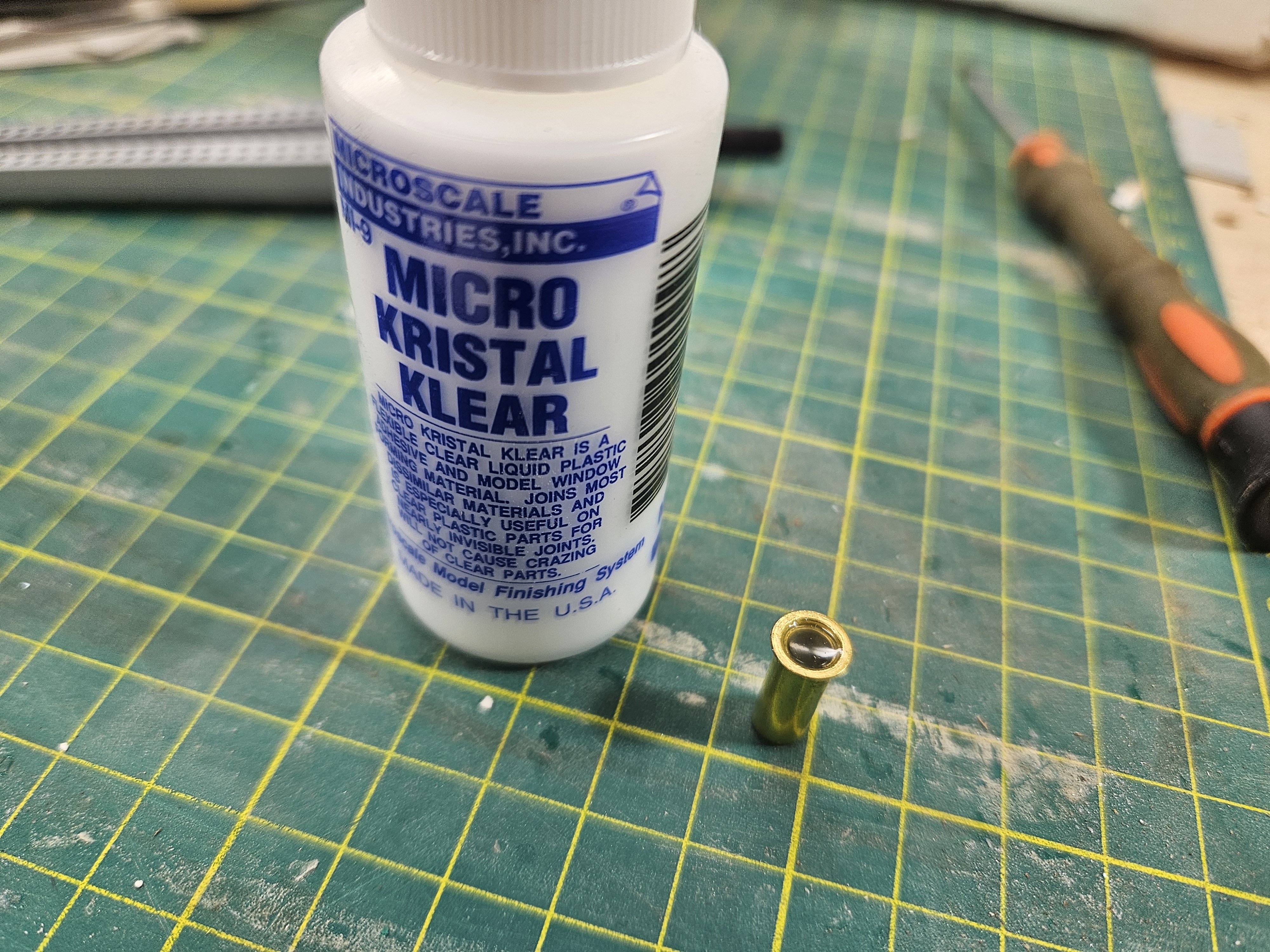

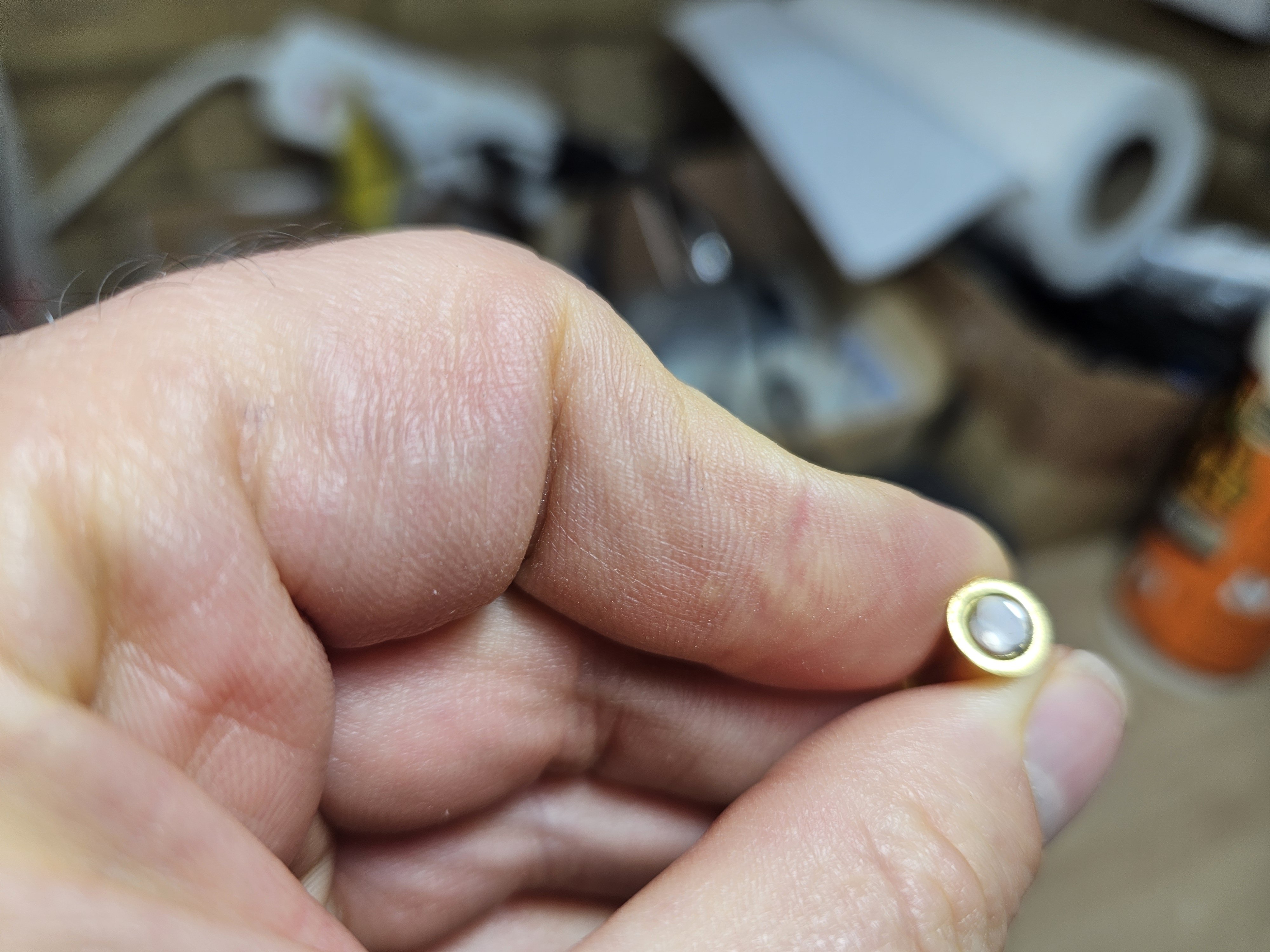

For the portholes I just bought cheap brass plumbing thingies that come in all dimensions. I experimented with Micro Kristal Clear for the glazing - excellent results.

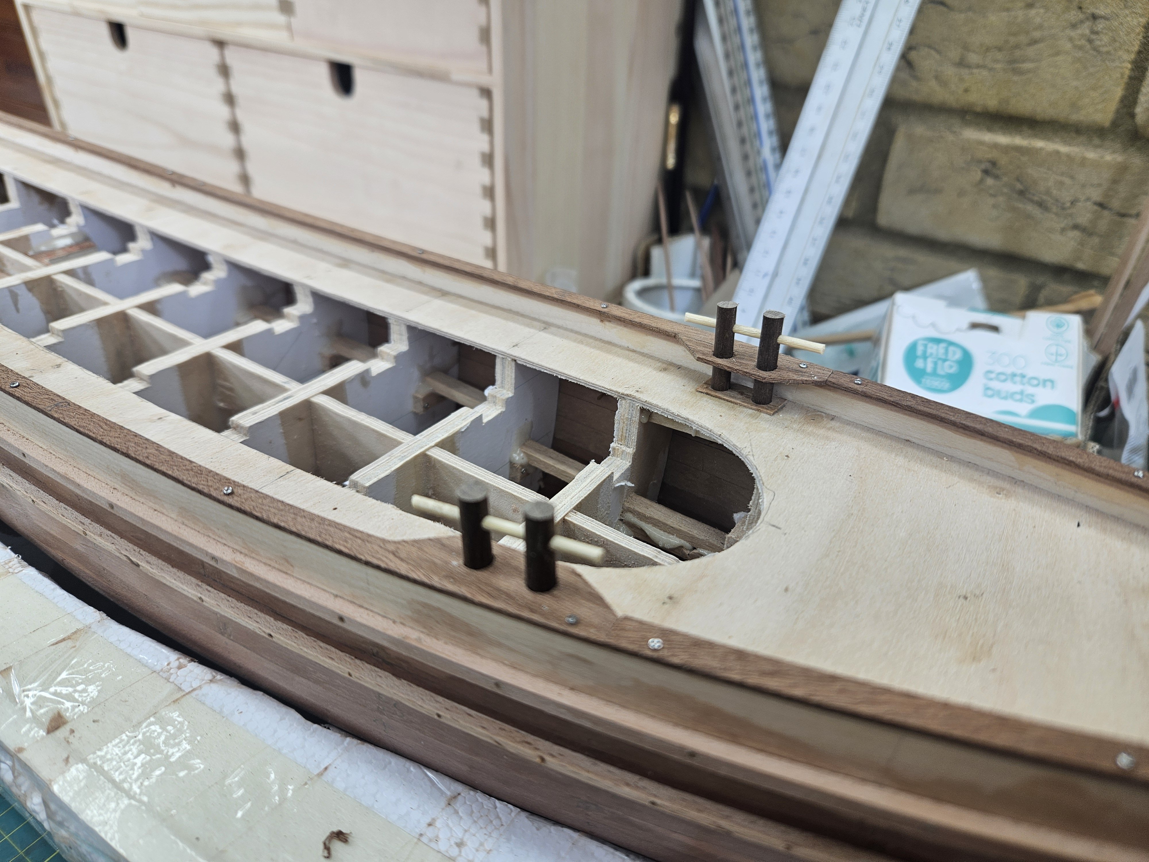

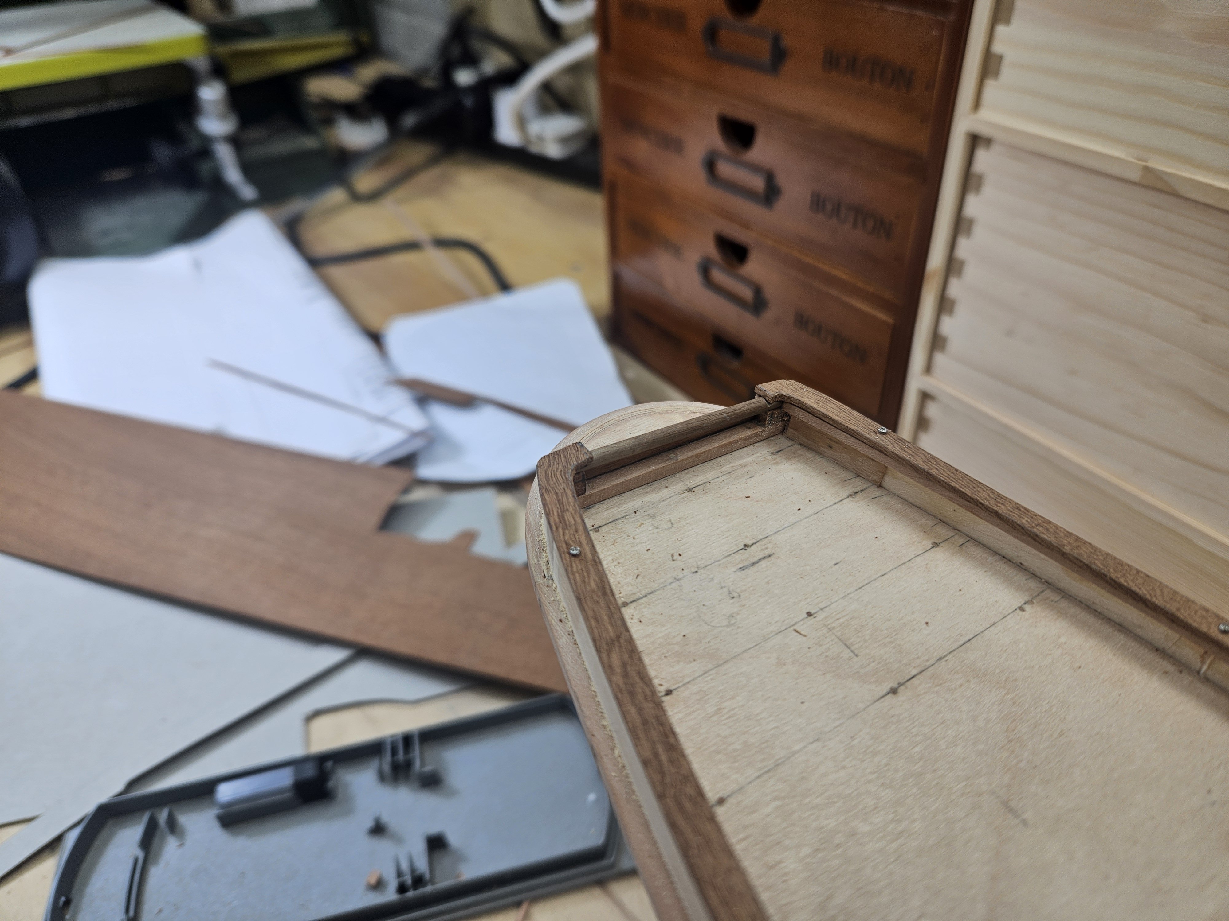

I then made the cap rails, I used mahogany which is the wrong wood for the job but did not have anything else in 1.5 mm thickness and I am not ready to put in the massive wood order for Tally Ho. Everything will be painted black though so should be OK. I also made the stern structures and roller - All need to be painted and screws replaced with wood nails.
I then made the quarter bitts - still need a bit more work though
Really now it is time to paint the hull and make and paint the rudder so I know where exactly the steering mechanism at the stern needs to be placed. It is too cold though in the garage to spray primers and I do not really have permission from the Admiral for indoor modelling activities - or actually the time.
Still Hercules seems to be on the right track steaming along side Tally Ho.

As you say, paint spraying is best kept out of the kitchen. Great progress and like others i have logged the porthole glass tip.
Keith
Current Build:-
Previous Builds:-
Other Topics
Nautical Adventures
Great tip - Amazon
Keith

Mikro Kristal Clear is an acrylic gel, I believe. It has been formulated originally for railway modellers and has been used by them to e.g. glaze locomotive windows for decades ... it's always useful to look out in other domains of modelling for useful materials and tools.
Another option for glazing is the special UV-curing cement that is used for acrylic glass. It's kind of liquid acrylic glass and can also be polished like it.
