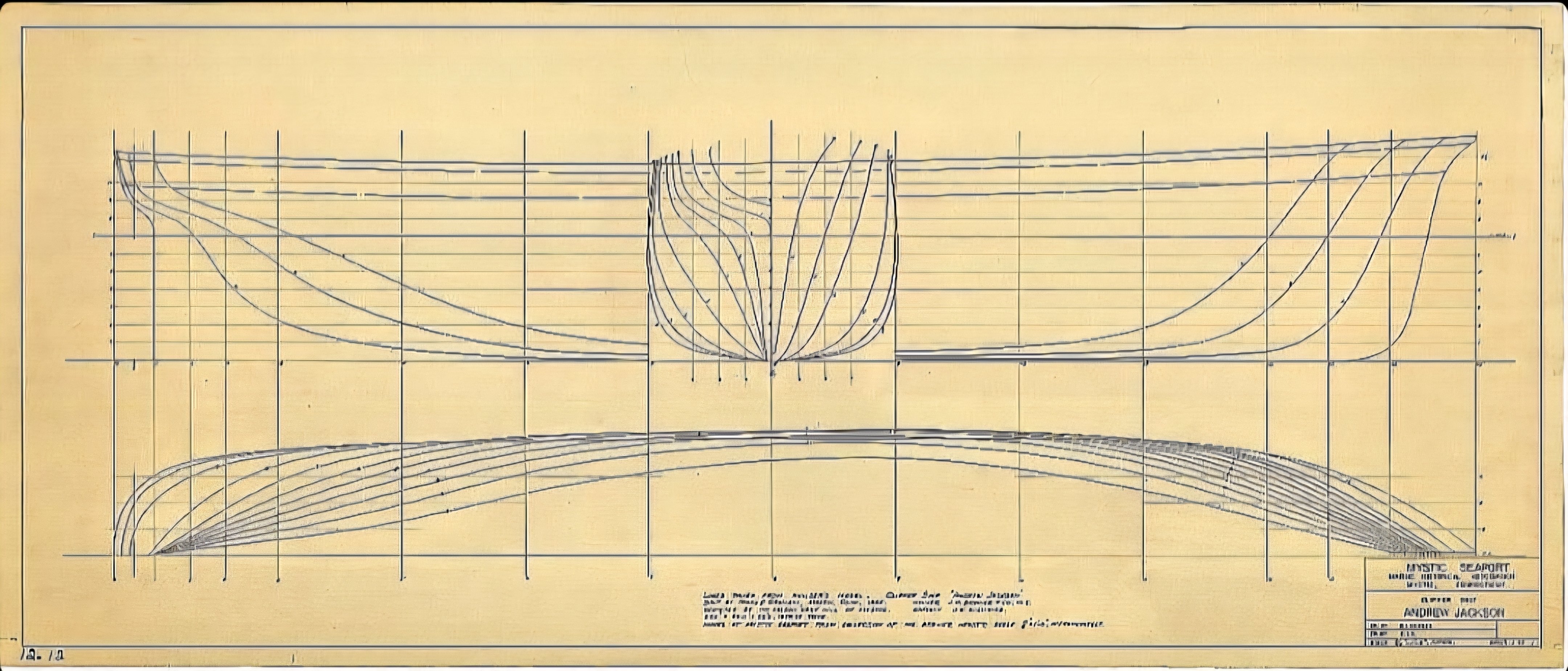

Rob, I've read that same conclusion too. Meanwhile 1851 Flying Cloud McKay's second extreme California clipper twice set the record anchor to anchor from NY to San Francisco which was never surpassed by another three masted vessel. In 1859-60 the 1855 Mystic, CT built Belle Hoxie renamed Andrew Jackson beat her time NY to the Farallon Islands, entry point to the San Francisco Bay in 89 days, 4 hours. However, lack of an available pilot boat resulted in her anchor to anchor time being longer, resulting in 89 days, 20 hours. Since Flying Cloud twice set records anchor to anchor with her fastest complete passage being 89 days, 8 hours anchor to anchor, that standard applied to all other ships. Her record stood for 135 years until the yacht Thursday's Child finally beat her in 1989. And yet, some nautical scholars still insist that the only extreme clipper Donald McKay ever launched was Staghound.

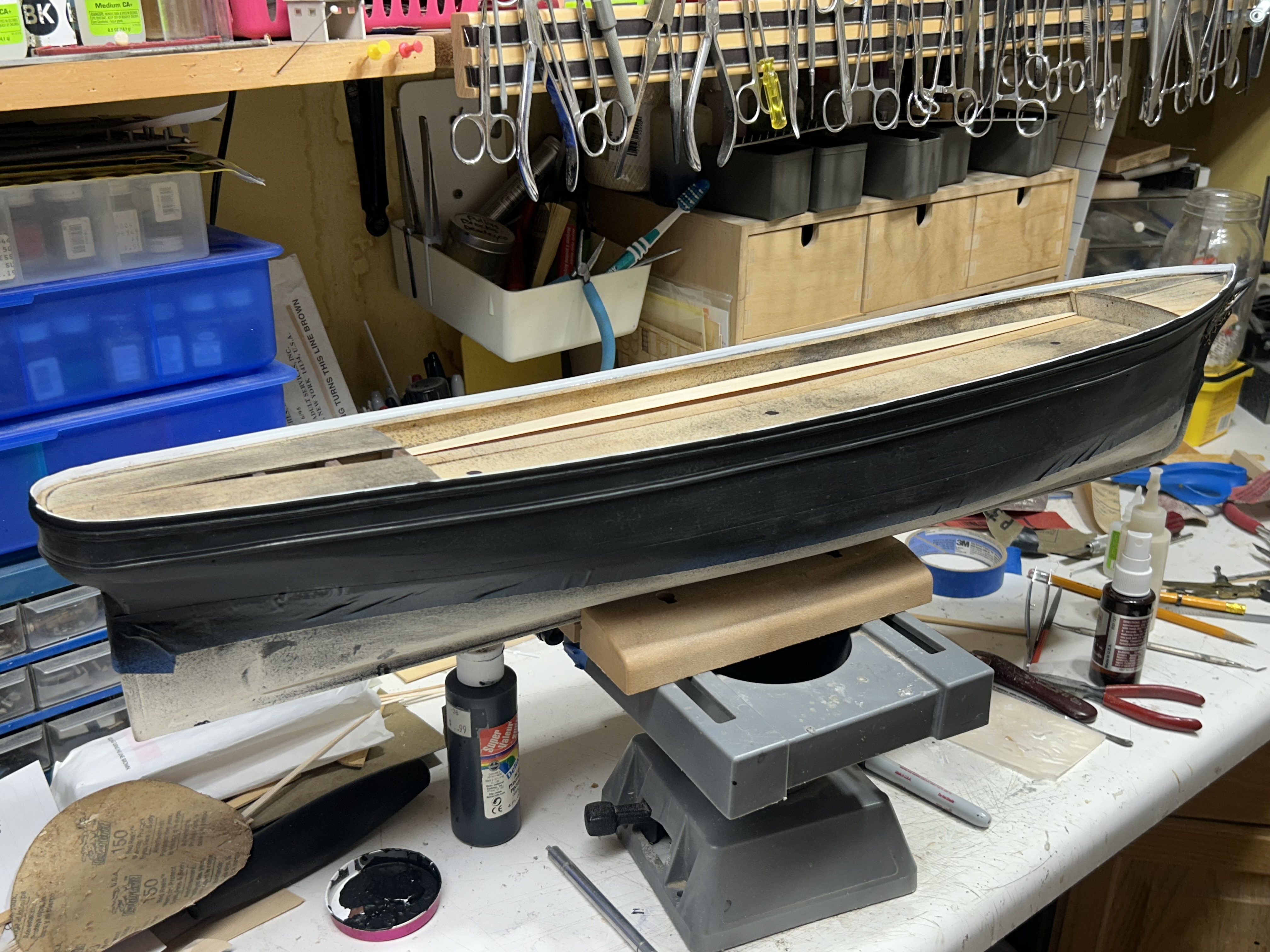

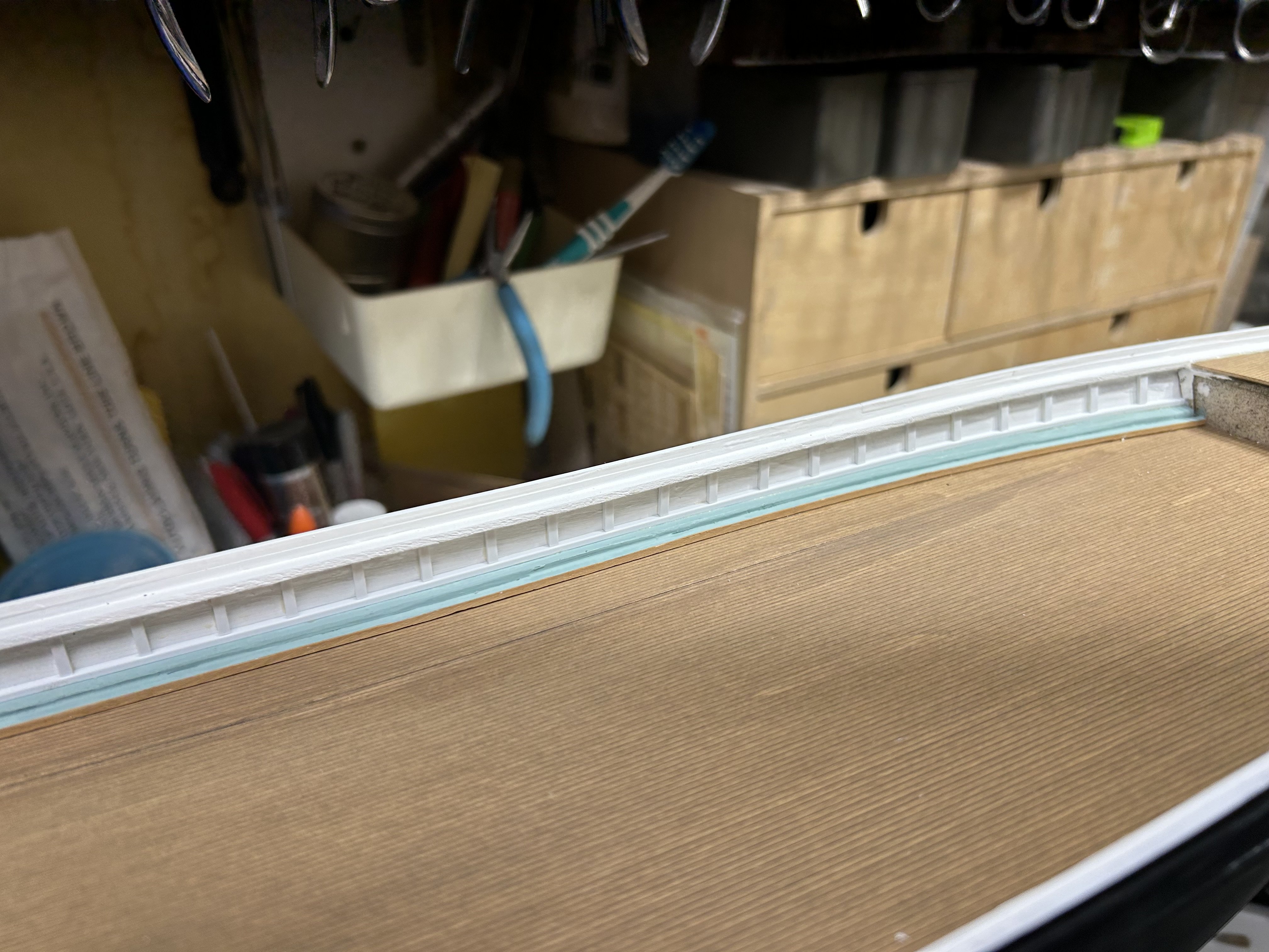

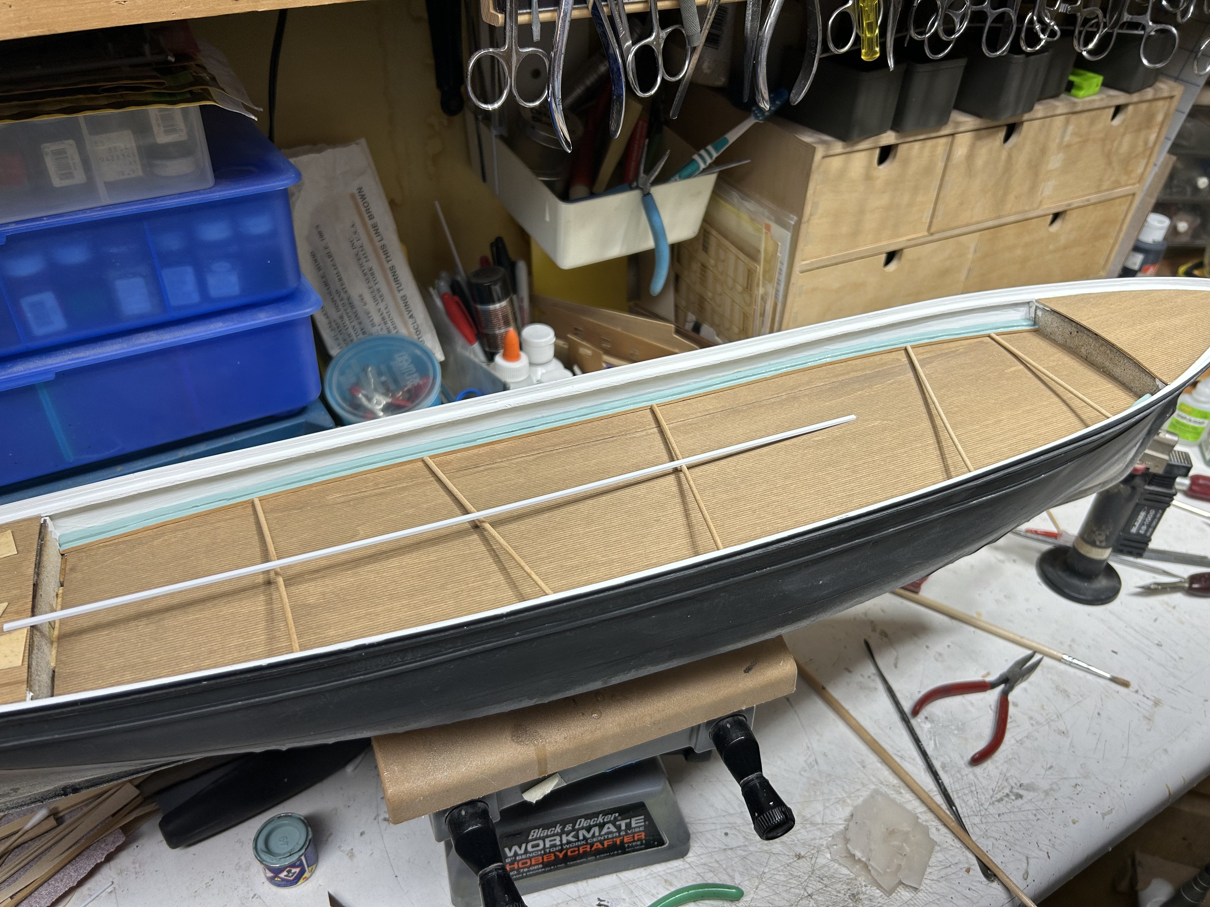

Worked on adding the monkey rail.   I’ll weather it after it fully dries.  The onto the decking and bulwarks
Rob

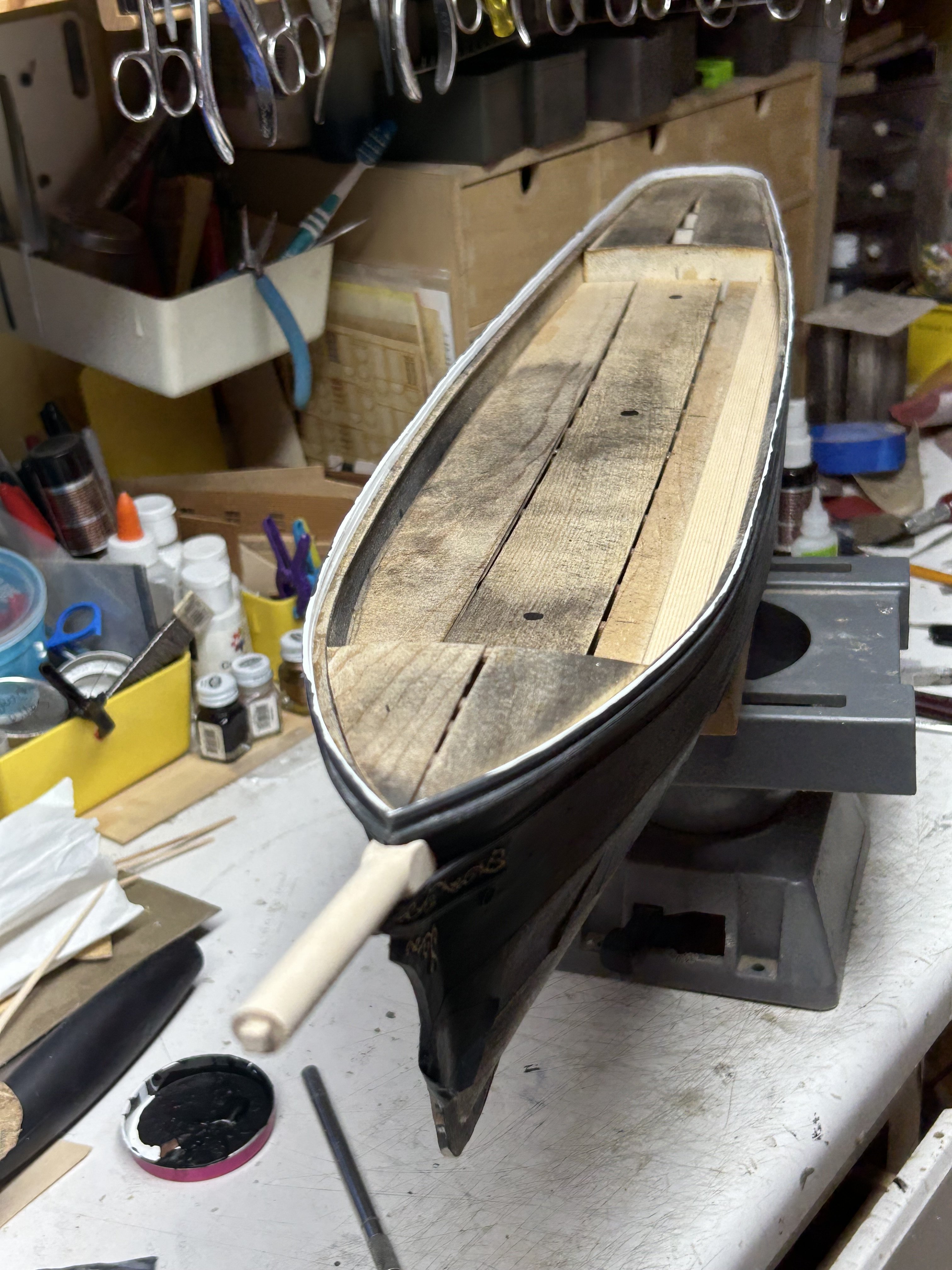

First coat of primer white.  Before I install the stanchions.
Rob
Rob
Rob,
It continually impresses me how rapidly you work. Staghound is shaping up to be one beautiful clipper.
Thanks Rich.  I've been out of commission for a couple of days due to kidney stones.  I think(Pray), I'm all over it now...still a bit tender.
I work fast, but, not as clean as I used to.  I cut the main waterways for each side and will install them after the deck is placed.  I want to sand and add another coat of white paint before....so when the stanchions go in on top of the painted waterway, it will be clean.   The decking, must be stained and glued down first.   I intend to finish the bulwarks and decking...before I flip her over and begin the coppering.
First things first.
Rob

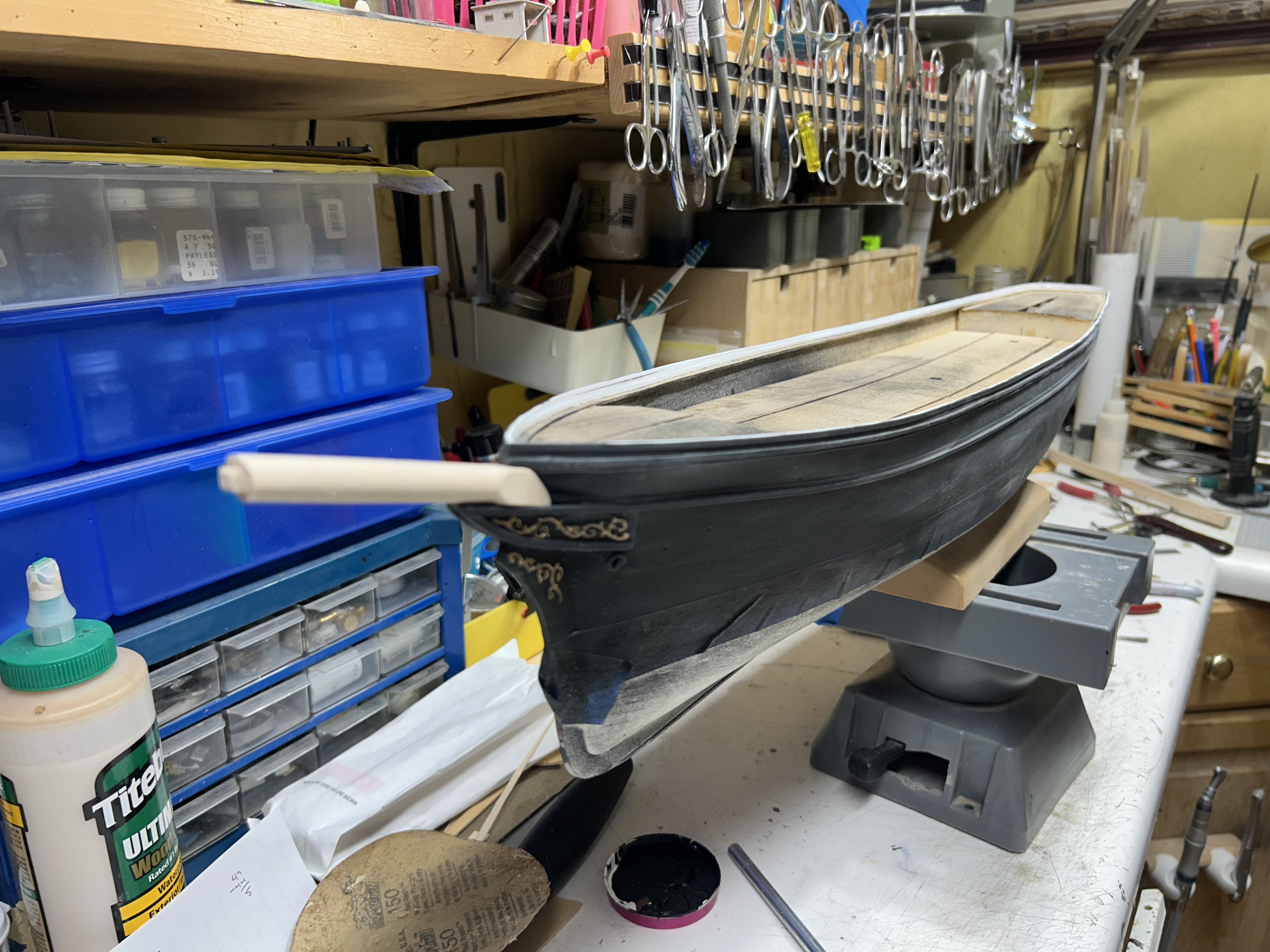

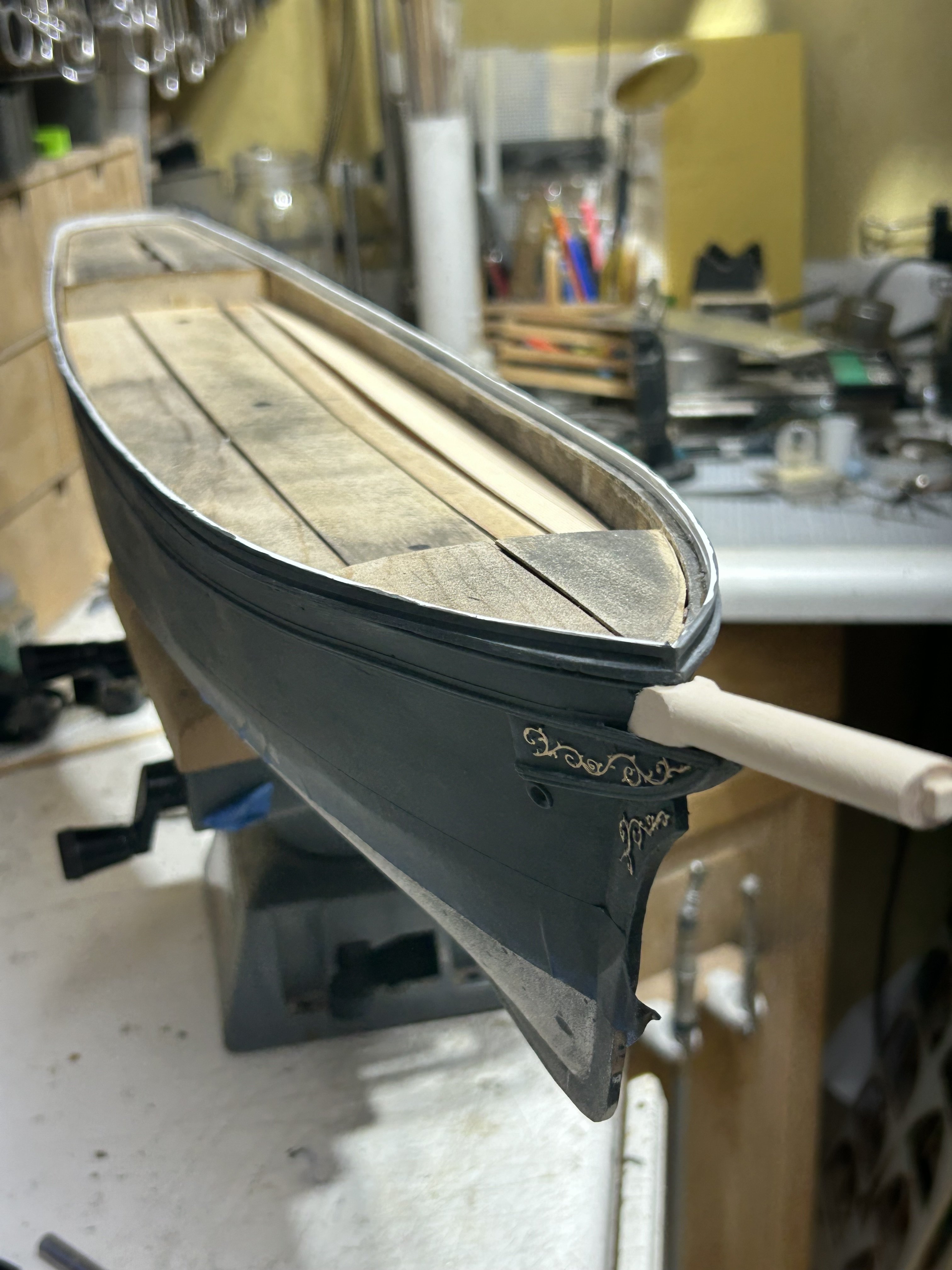

1 hour ago, Rick310 said:
Rob, that was supposed to be very nicely done! Love the trail boards! Just love AutoCorrect!
I always new I might be a little treacherous...when it comes to my depictions....but traitorous?🤣
Thanks Rick.  Still need to cut the poop decking.  In my mind it will all go together quite quickly, once I get the decks installed.
Been a bit sidetracked with pain lately....
Rob

@Rick310 not to be curmudgeonly but just to set the record straight for everybody Staghound had neither headboards nor trailboards. What your seeing are navel hoods. They're also different from naval hoods which apparently were intended to protect wooden hawse holes before the advent of wrought iron ones made them unnecessary. Navel hoods are actually an extension of the ship's hull while naval hoods do not. Earlier in this build there's a picture of the bow of clipper Seaman's Bride from below. You can clearly see how her headboards and trailboards leave a lot of open space while Donald McKay's design is solid.

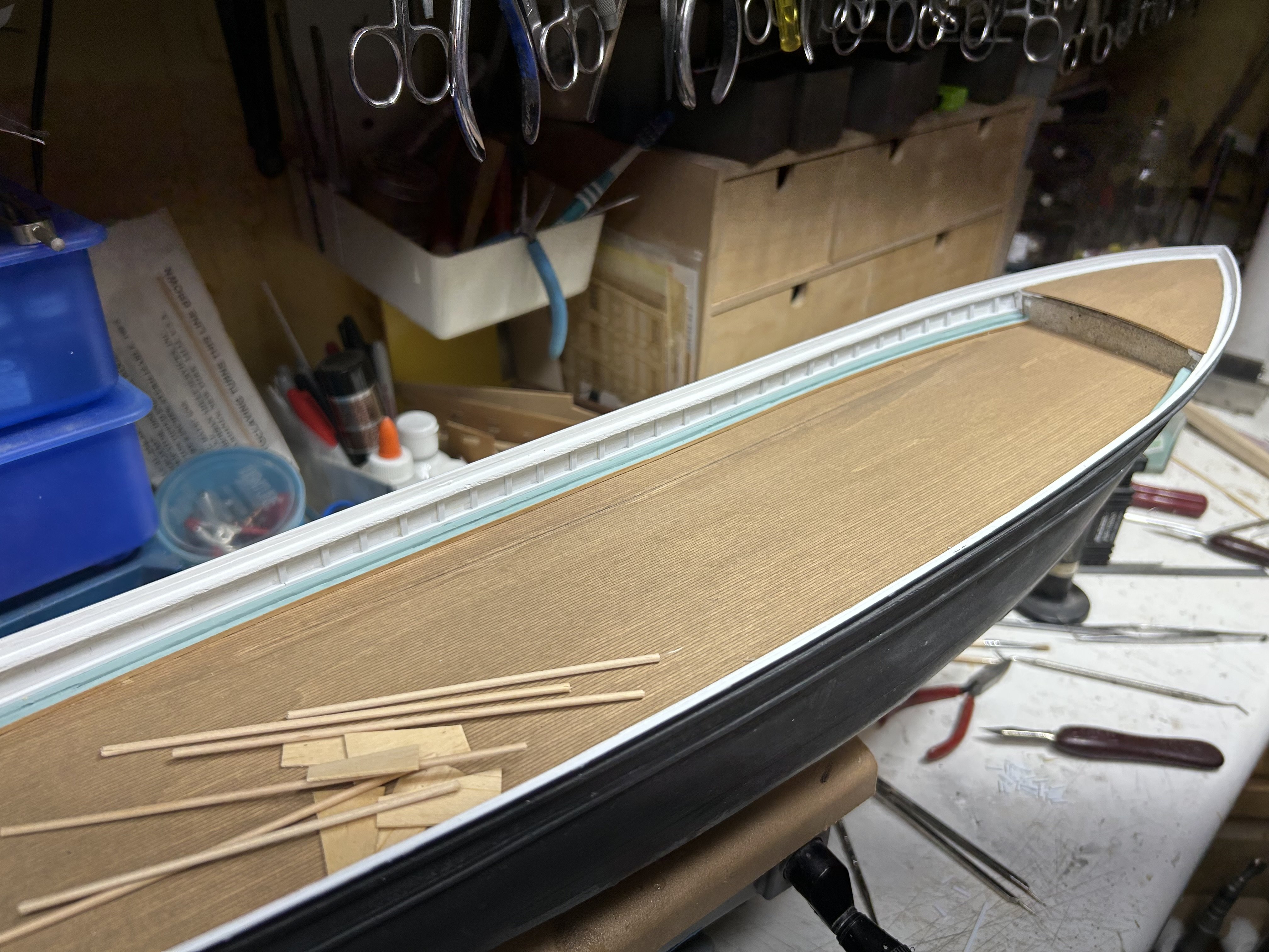

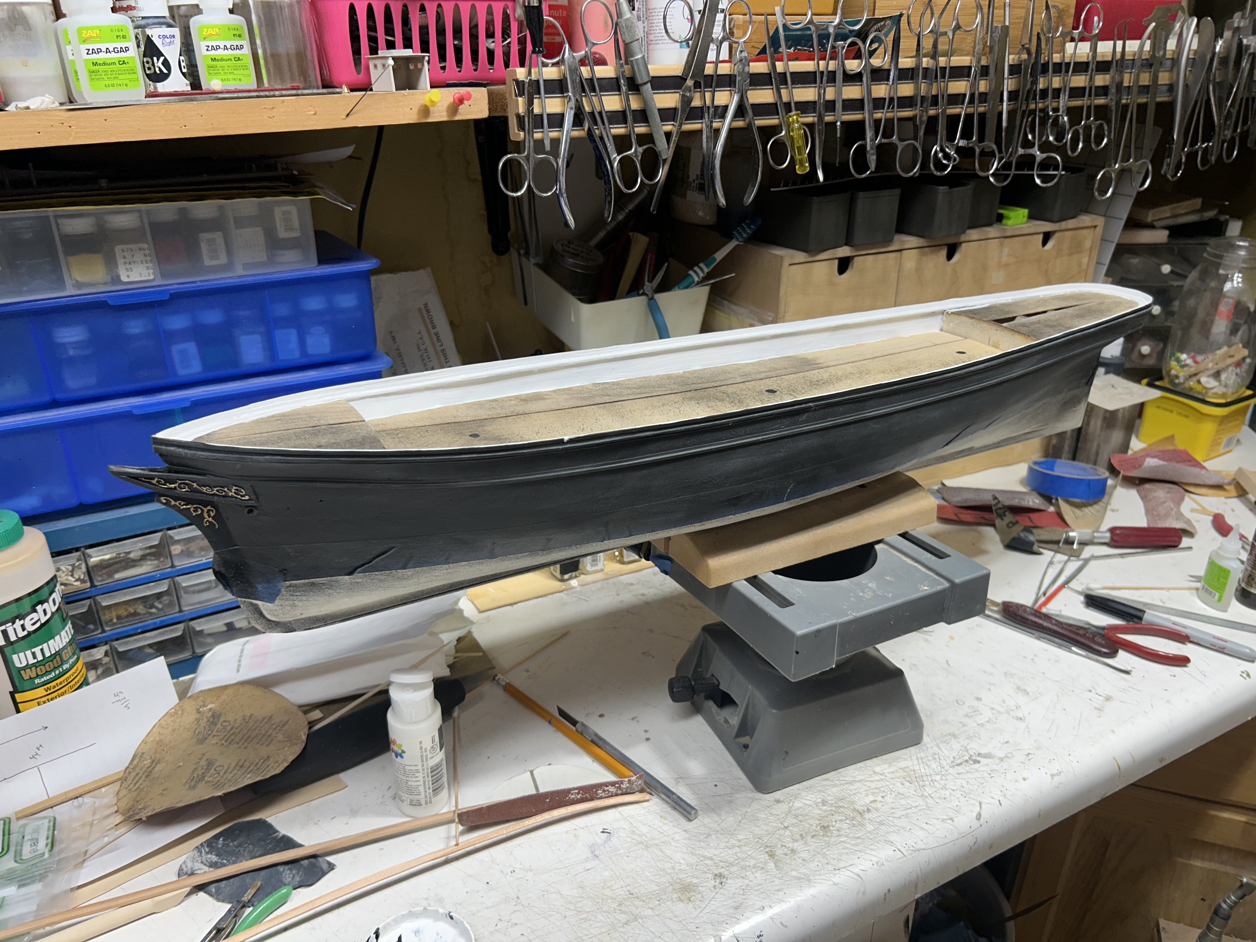

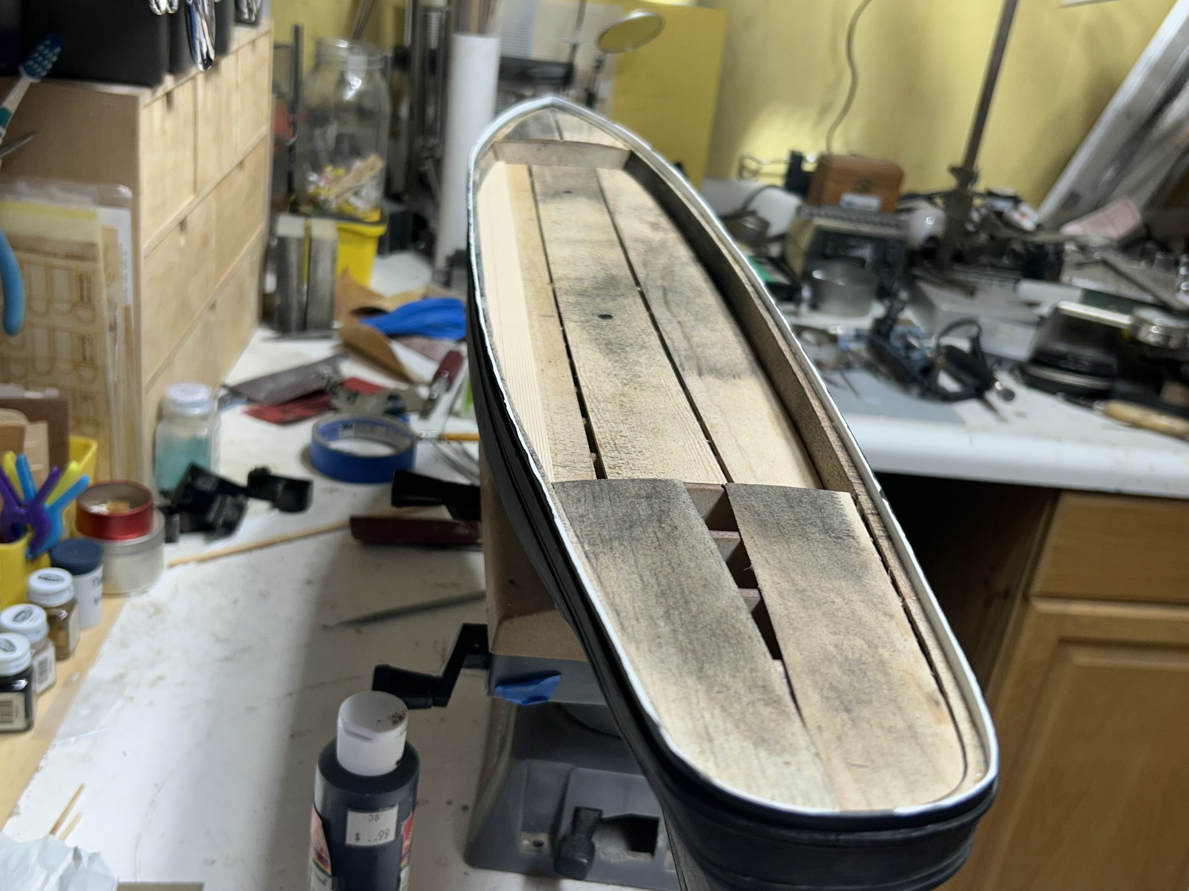

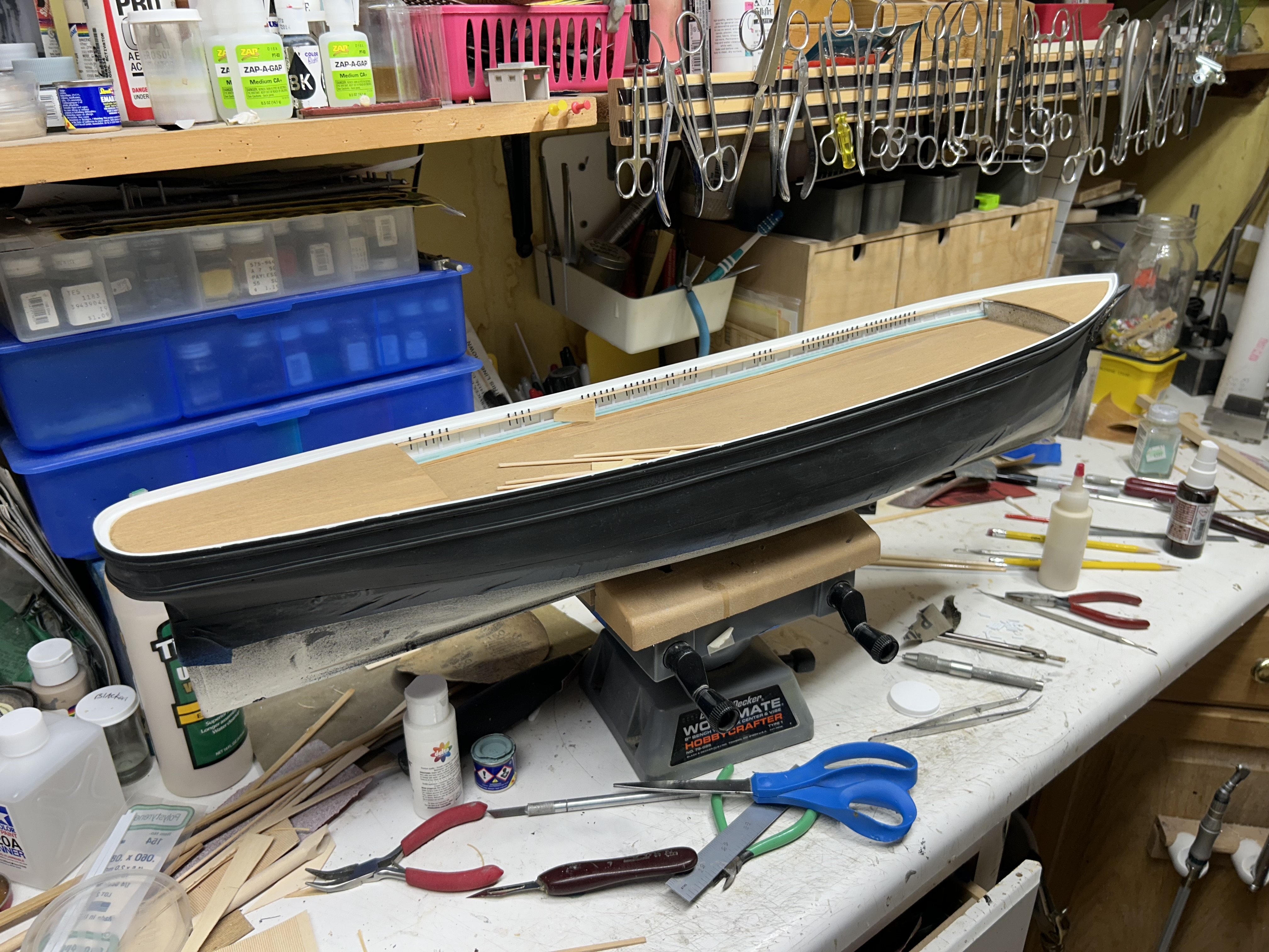

Finished adding the stained decks.
Rob

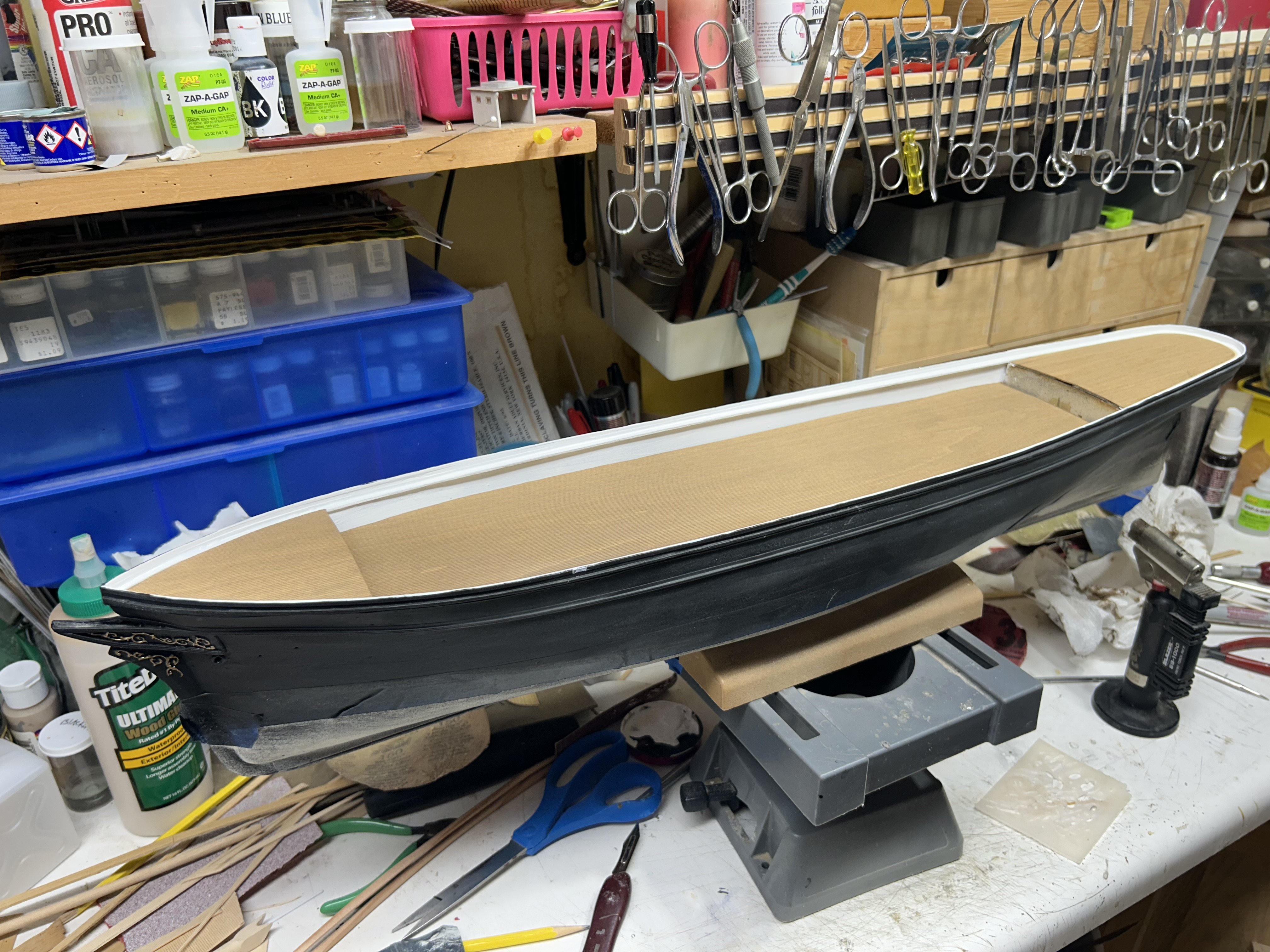

Rob
Rob, I gather you're sufficiently recovered from your kidney stones, which is a relief to learn. Peggy took one look at your Staghound hull and said that's a pretty ship! Of course, she's right.

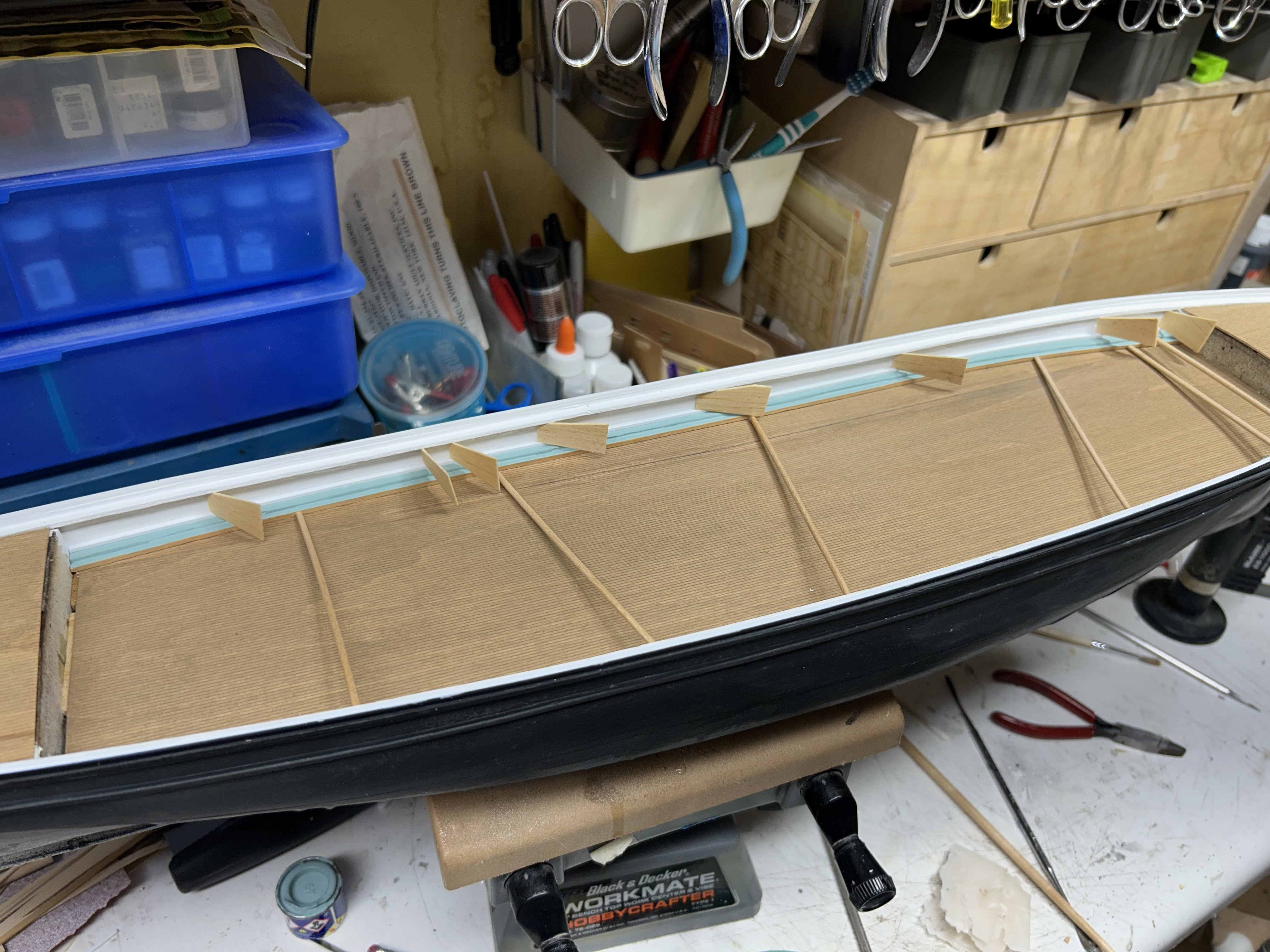

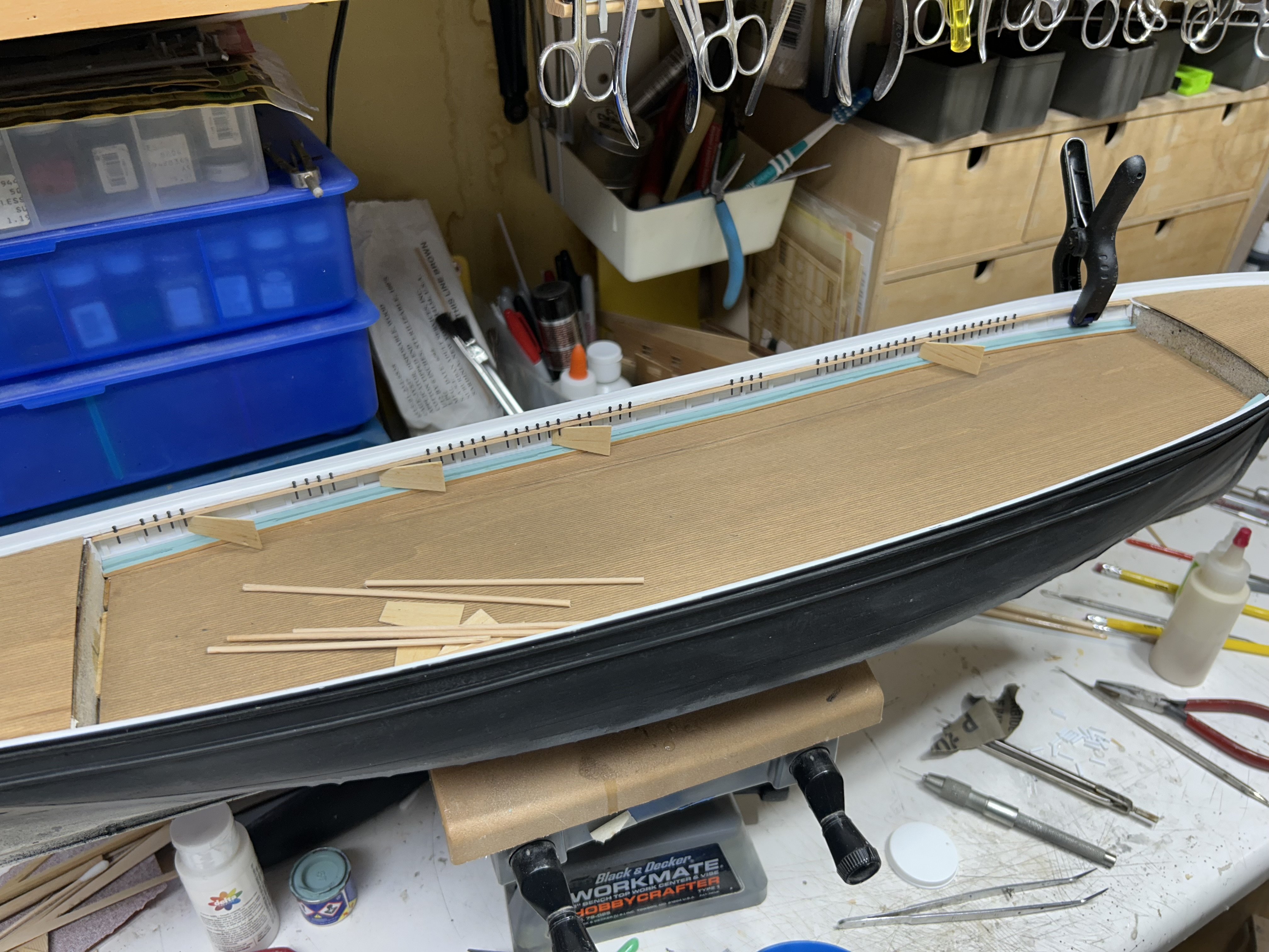

Began the waterway and stanchions on port side.   Adding support.
Rob

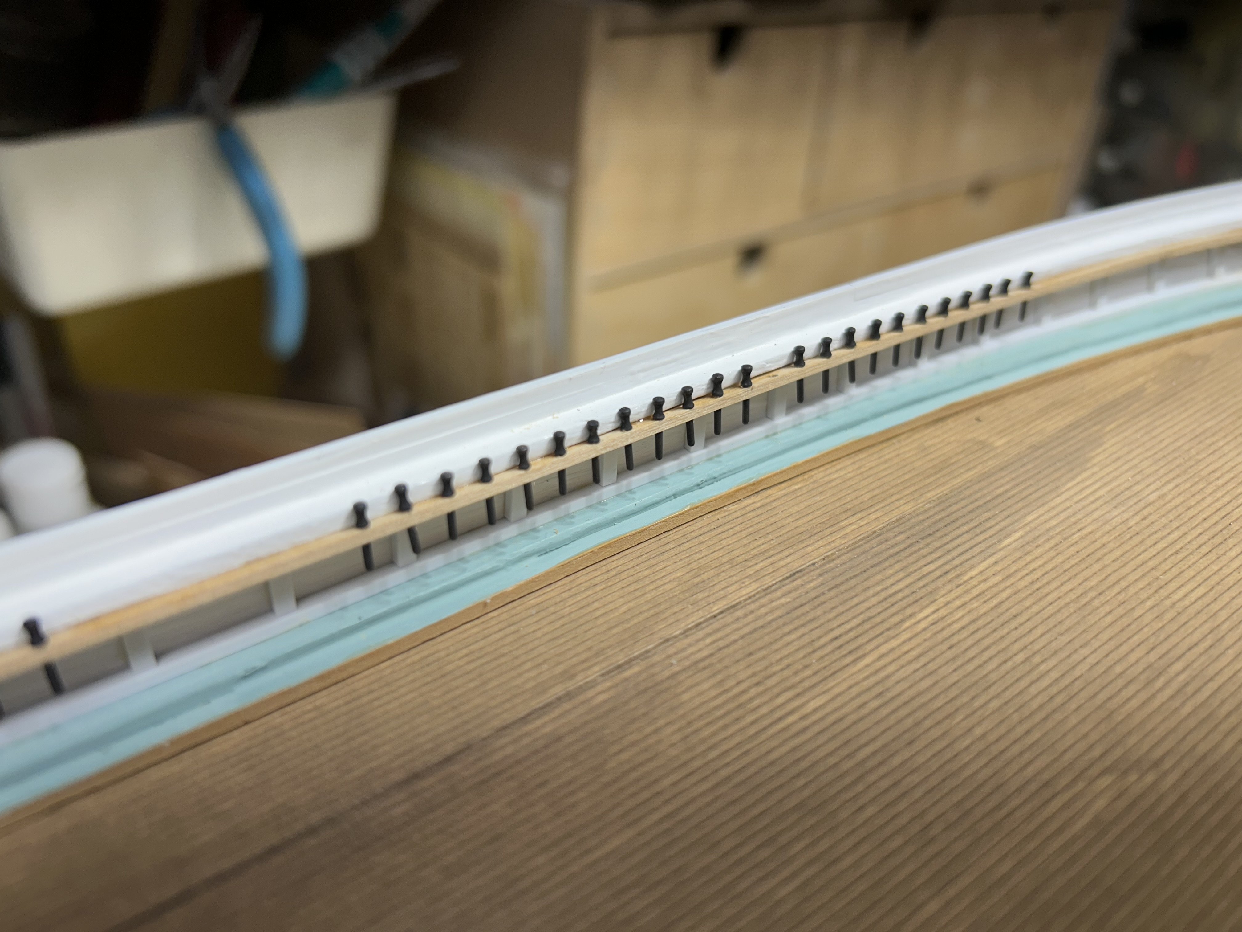

Adding the stanchions.
Rob

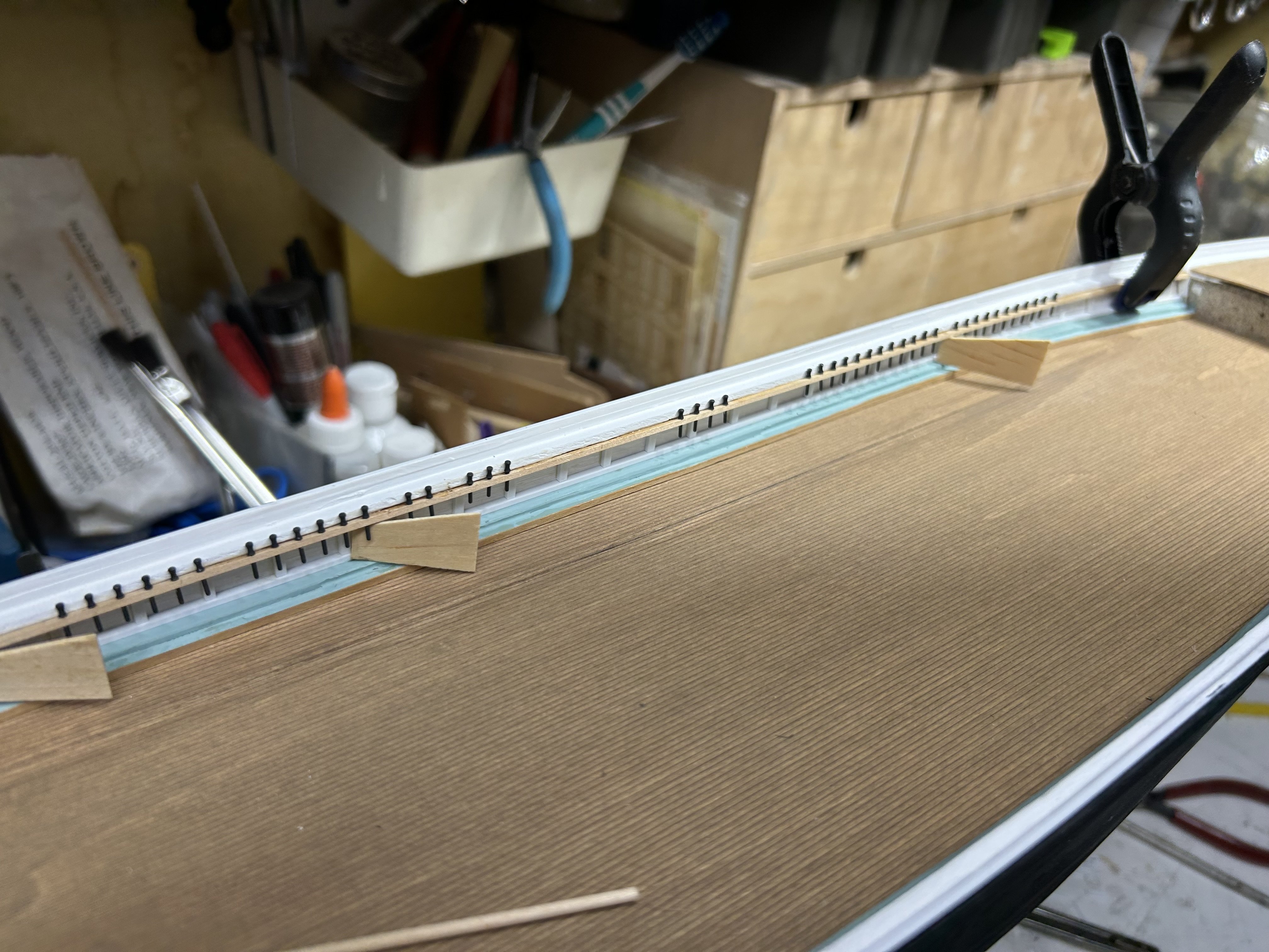

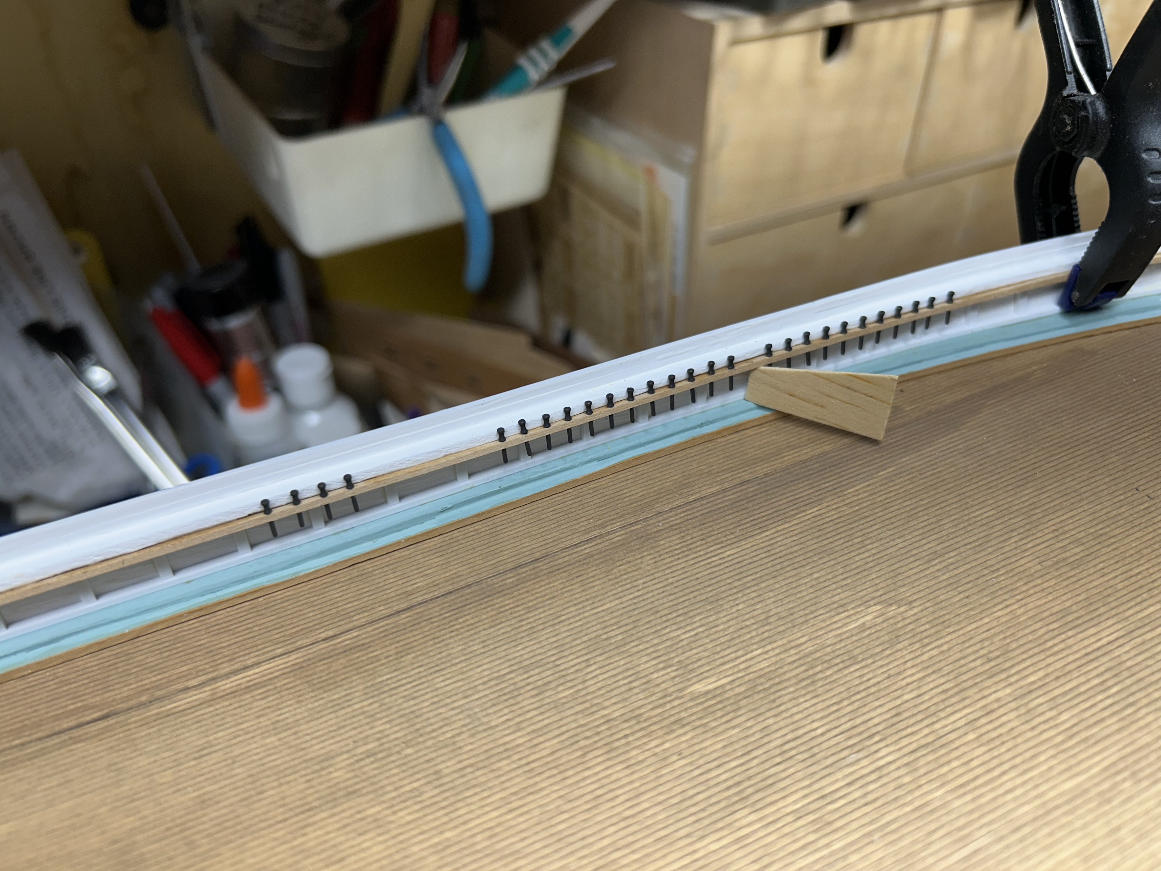

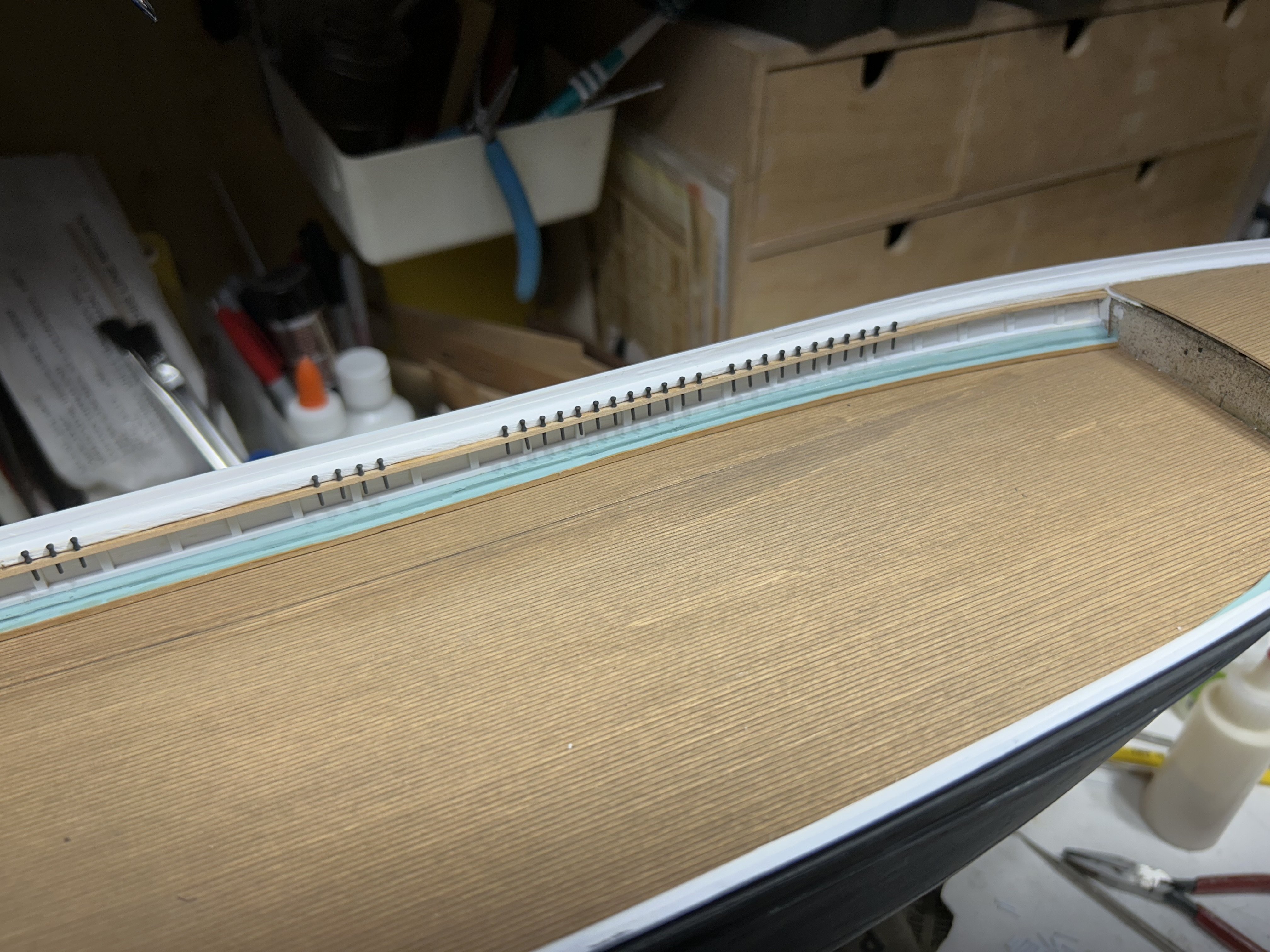

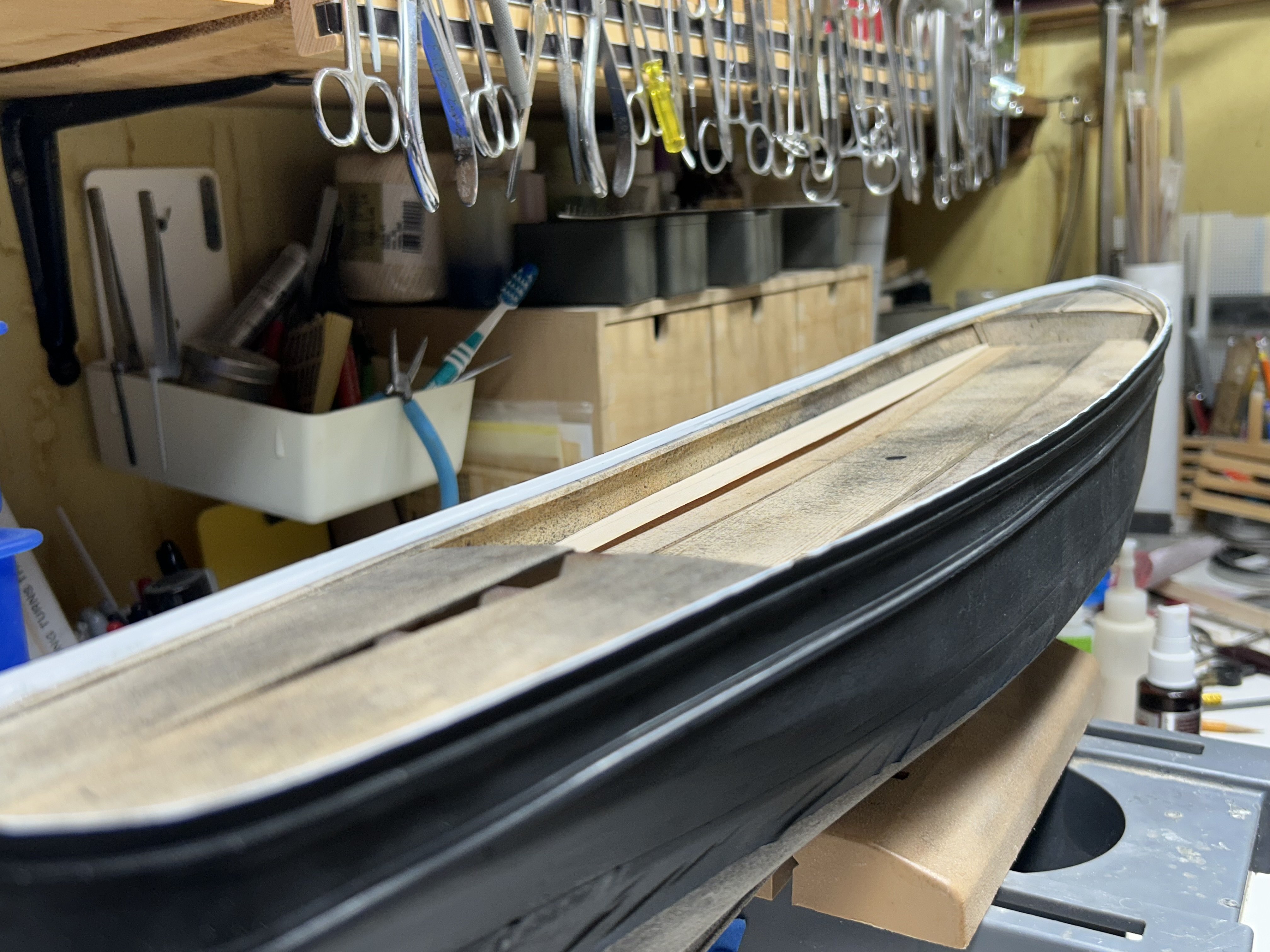

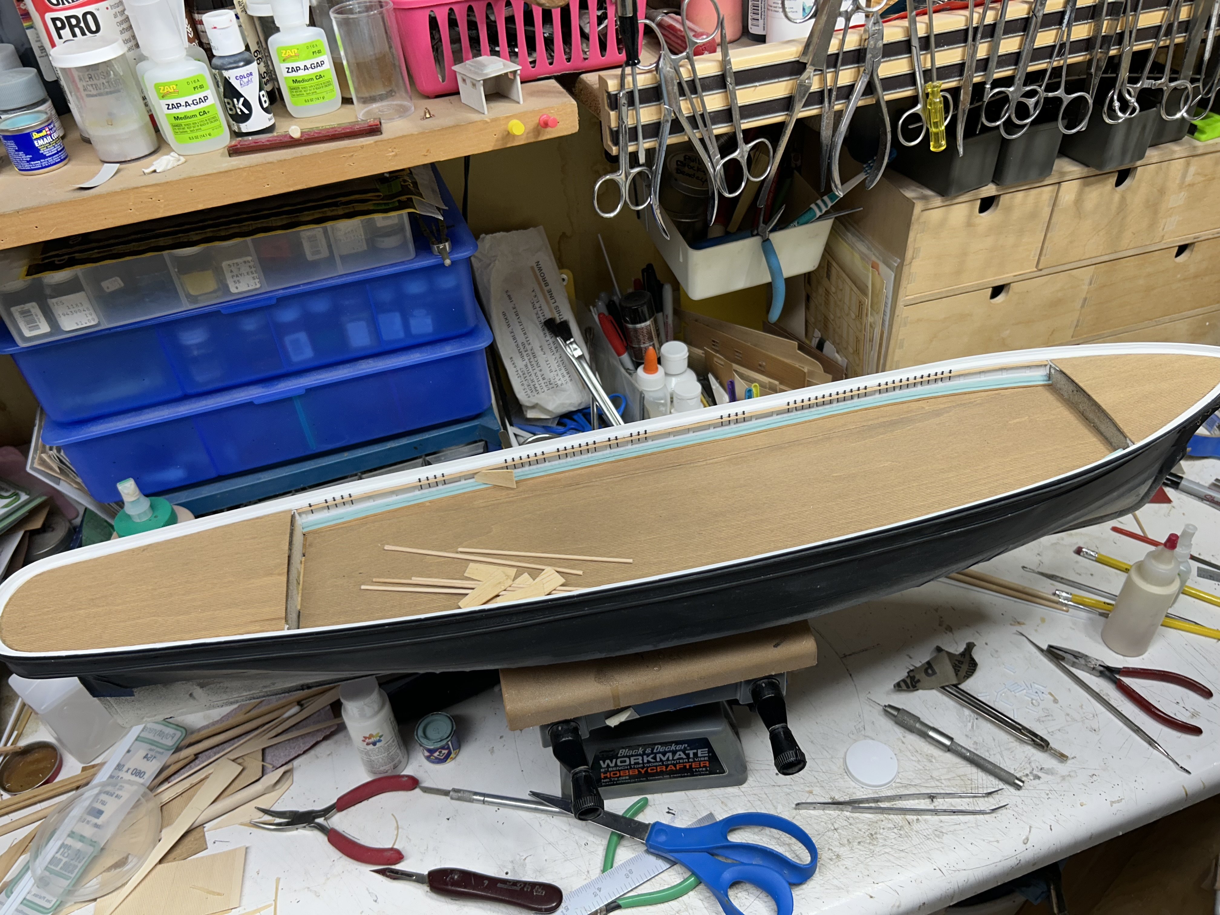

Finished up the port pin rail and pins.
Now it’s time to tackle the starboard side.
Rob

11 hours ago, druxey said:
That is rapid progress!
I try to section off the model into small *projects*...to make it progress faster(in my mind).
Preplanning pays of in great dividends.  Once I know where I'm going and what is next.....I plan for it, and then execute it.  Still have to add the venting between the stanchions.  But moving along to the starboard side.

@rwiederrich Rob, she's coming together quickly now that you're recovered. Even though it's years since I've done any model building, I appreciate you sharing your step-by-step building procedures with accompanying photos. I think I know why there's a forecastle splash rail. As we saw on Glory of the Seas there appears to be a similar waterway installed on the forecastle. The splash rail adds bulwark protection.
I have yet to add the splash rail to the forecastle.  I want to protect that area while I upright the hull to lay the copper plates.  Less uneven surfaces to break off while upside down makes me feel more comfortable.
Rob
Rob
Rob, I didn't mean to suggest adding the splash rail early. I was simply thinking of an answer to a question of another observer who was questioning the need for such an extra rail only at the forecastle.
