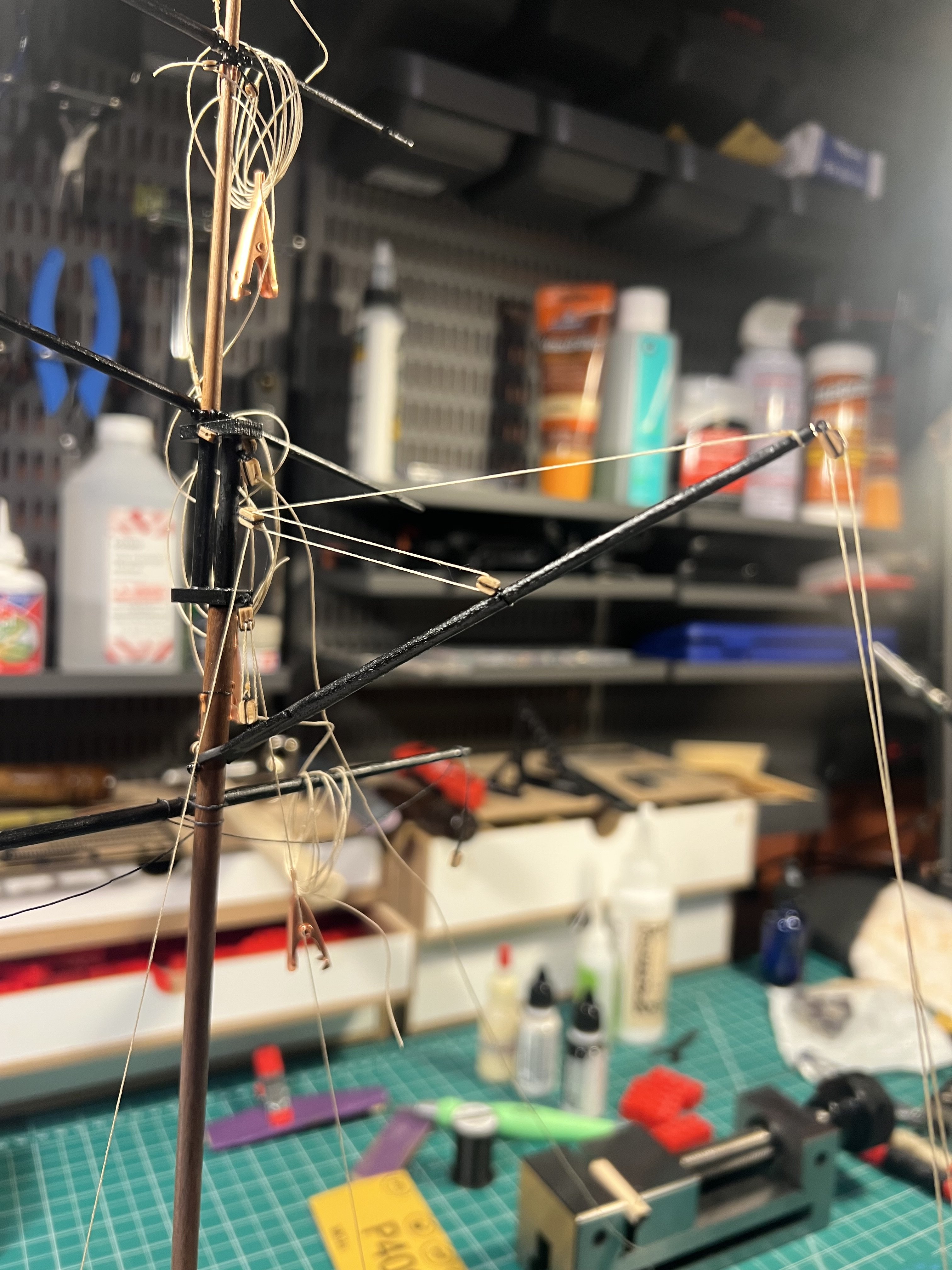

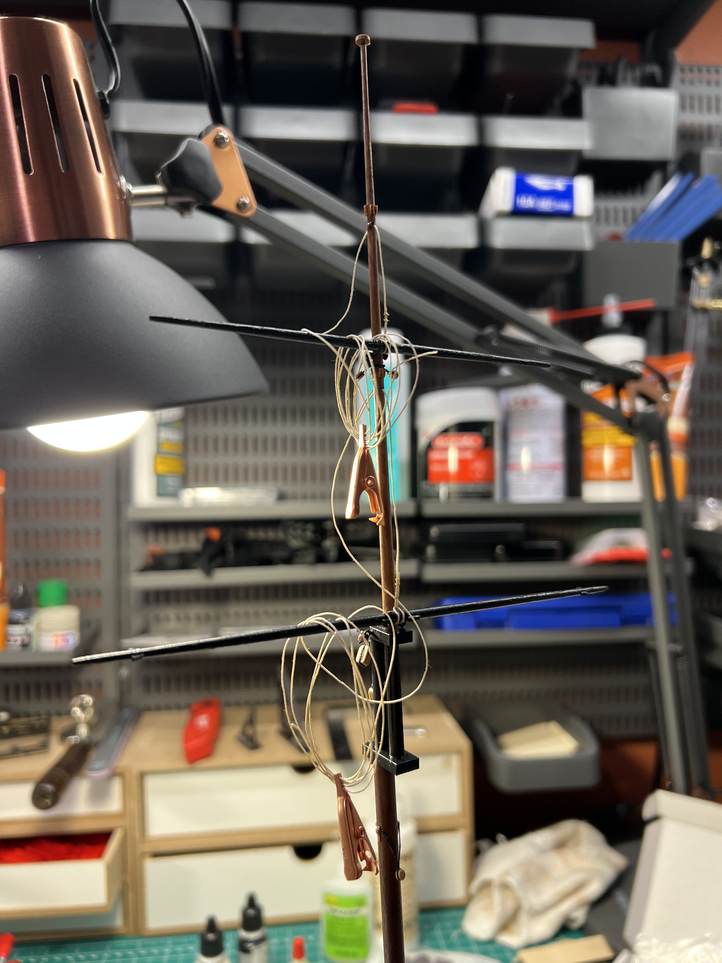

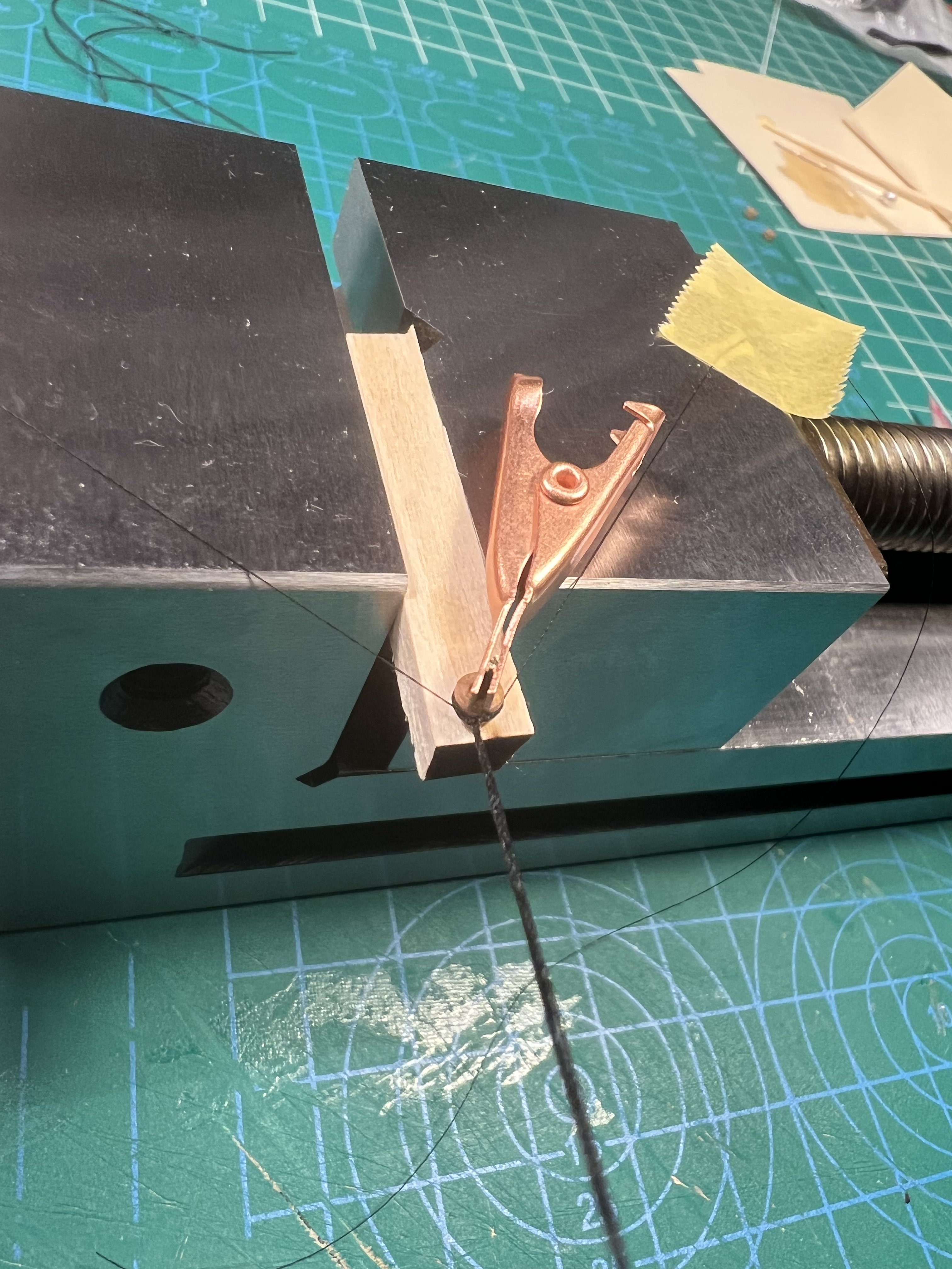

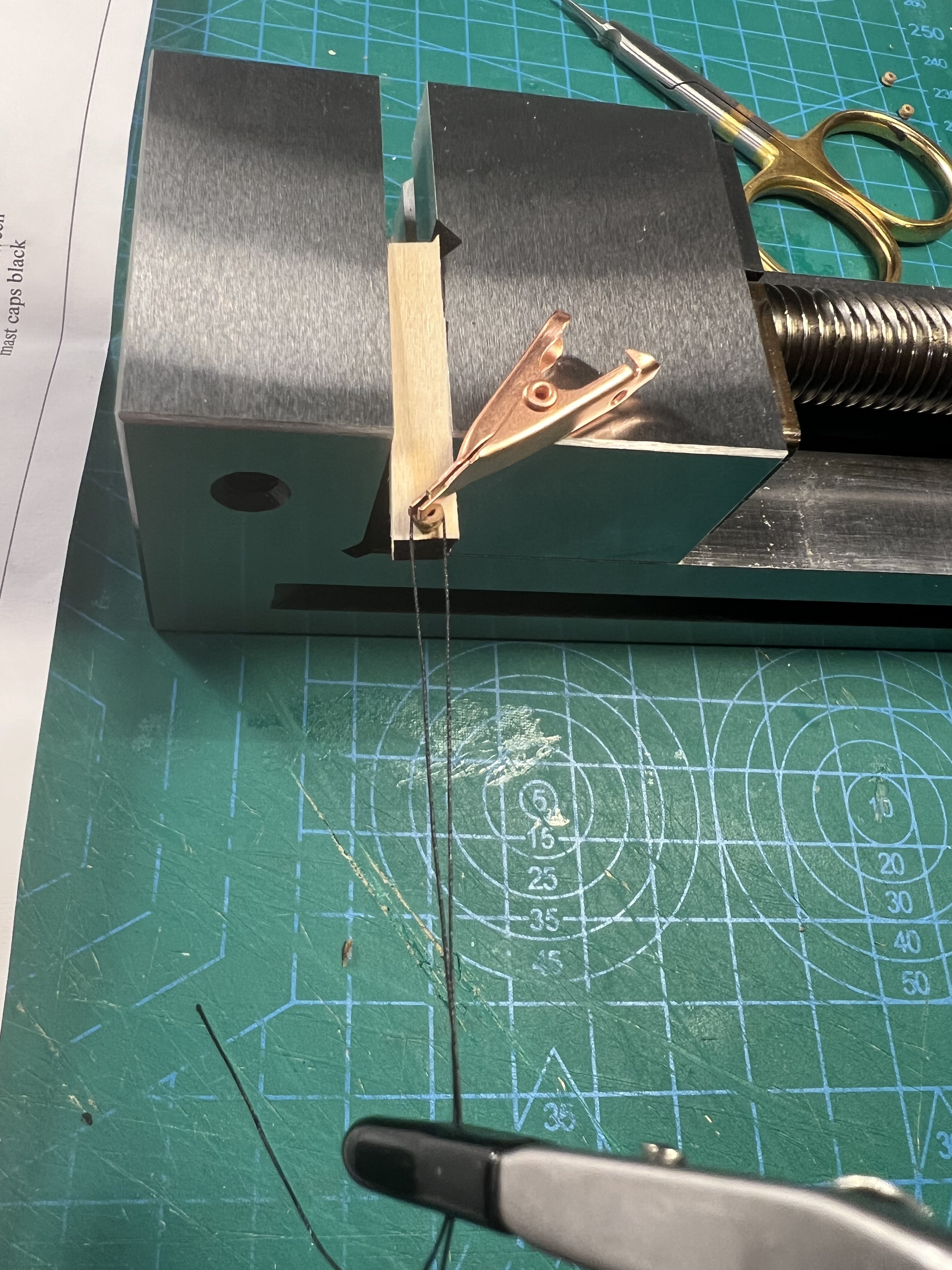

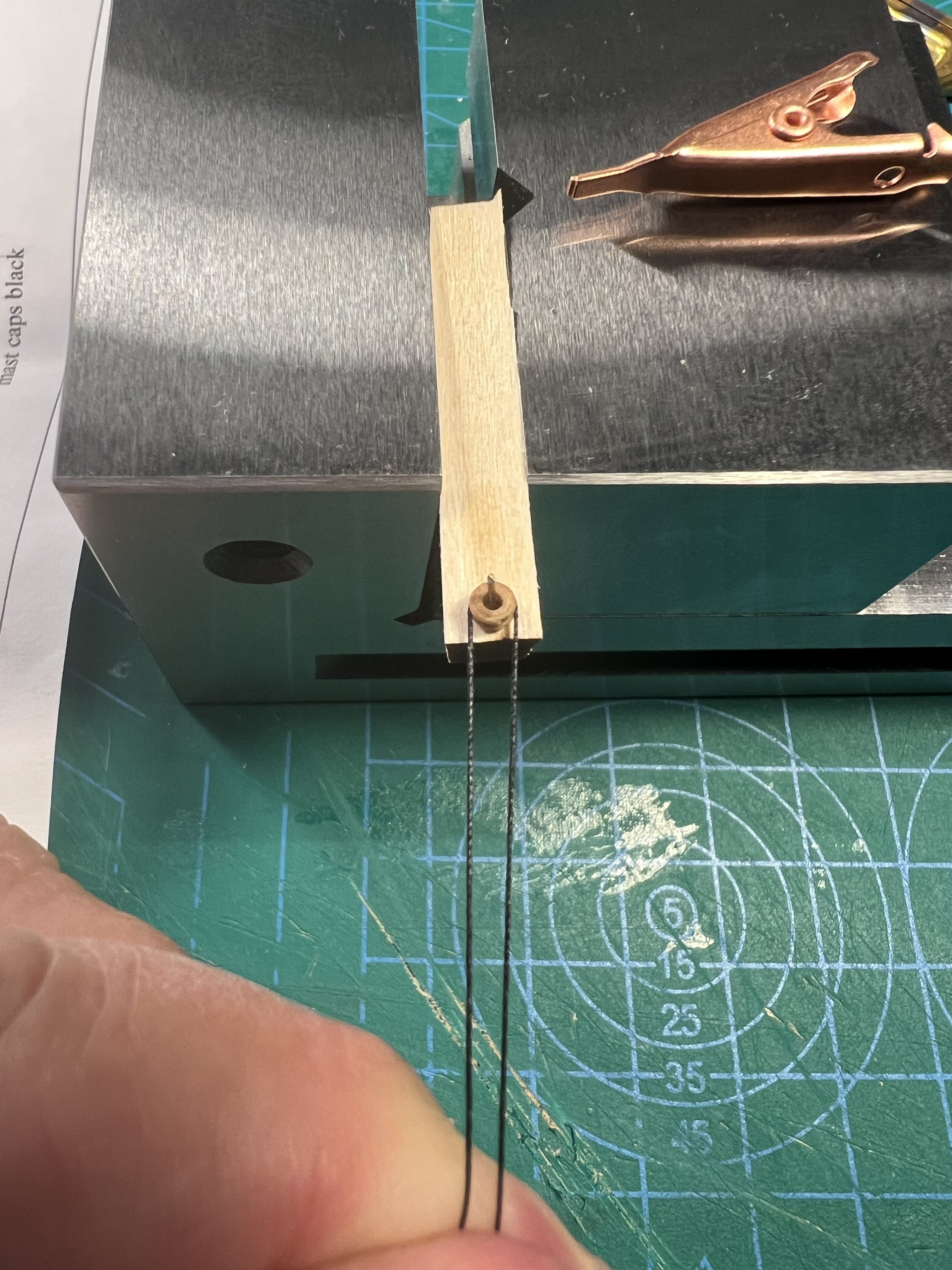

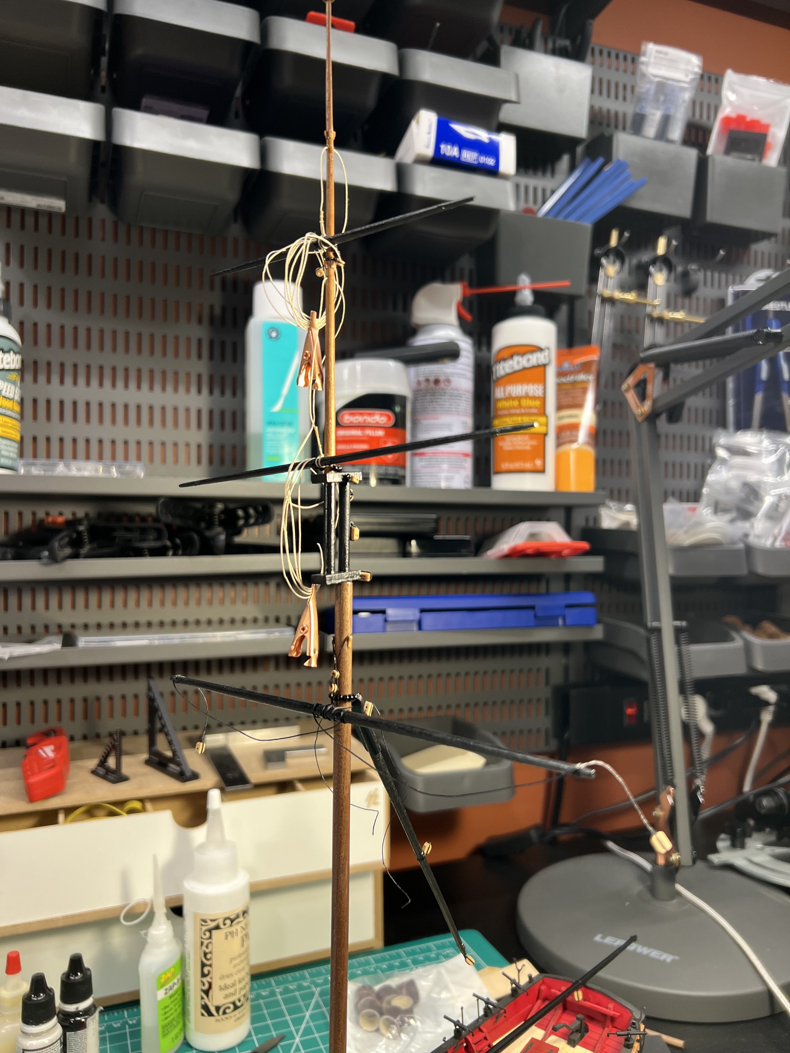

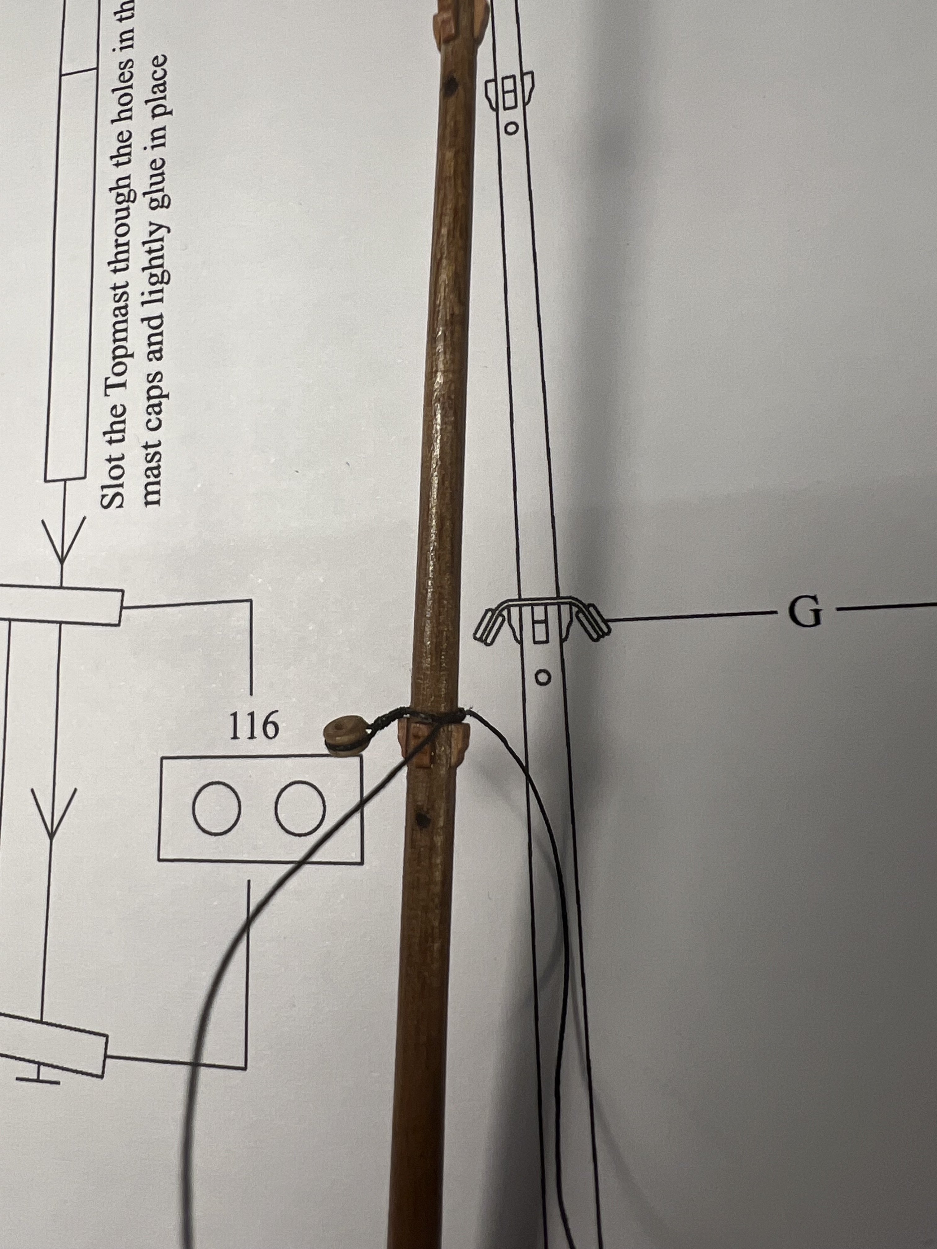

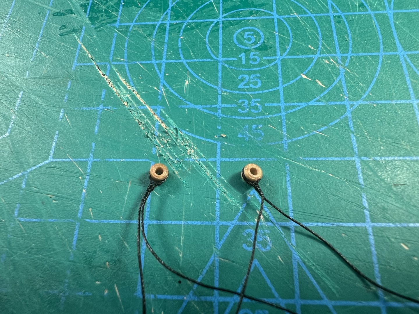

Working on the thimbles. The plans show one line that connects both thimbles. I can’t easily see how to do that. So like the Modelkit Stuff build, I’m going to do two separate lines.
I was able to do the thimbles and add a bit of seizing. I think it’s going to be easier when the thicker seizing thread I ordered arrives. This 16/0 is tiny and hard to use. It’s hard to see (even with a magnifier), hard to tie, and it moves all over with the slightest breath.
Edited by palmerit

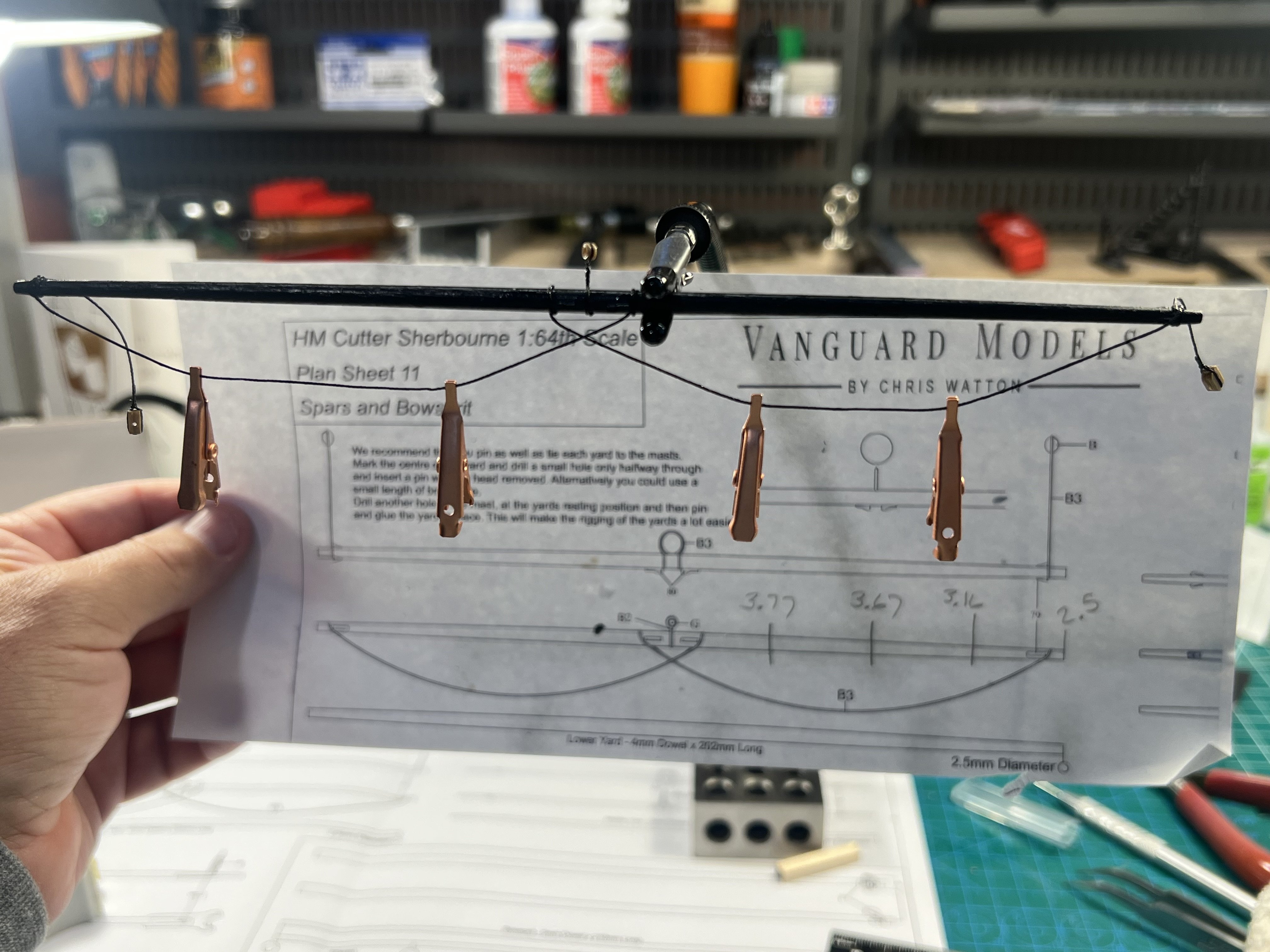

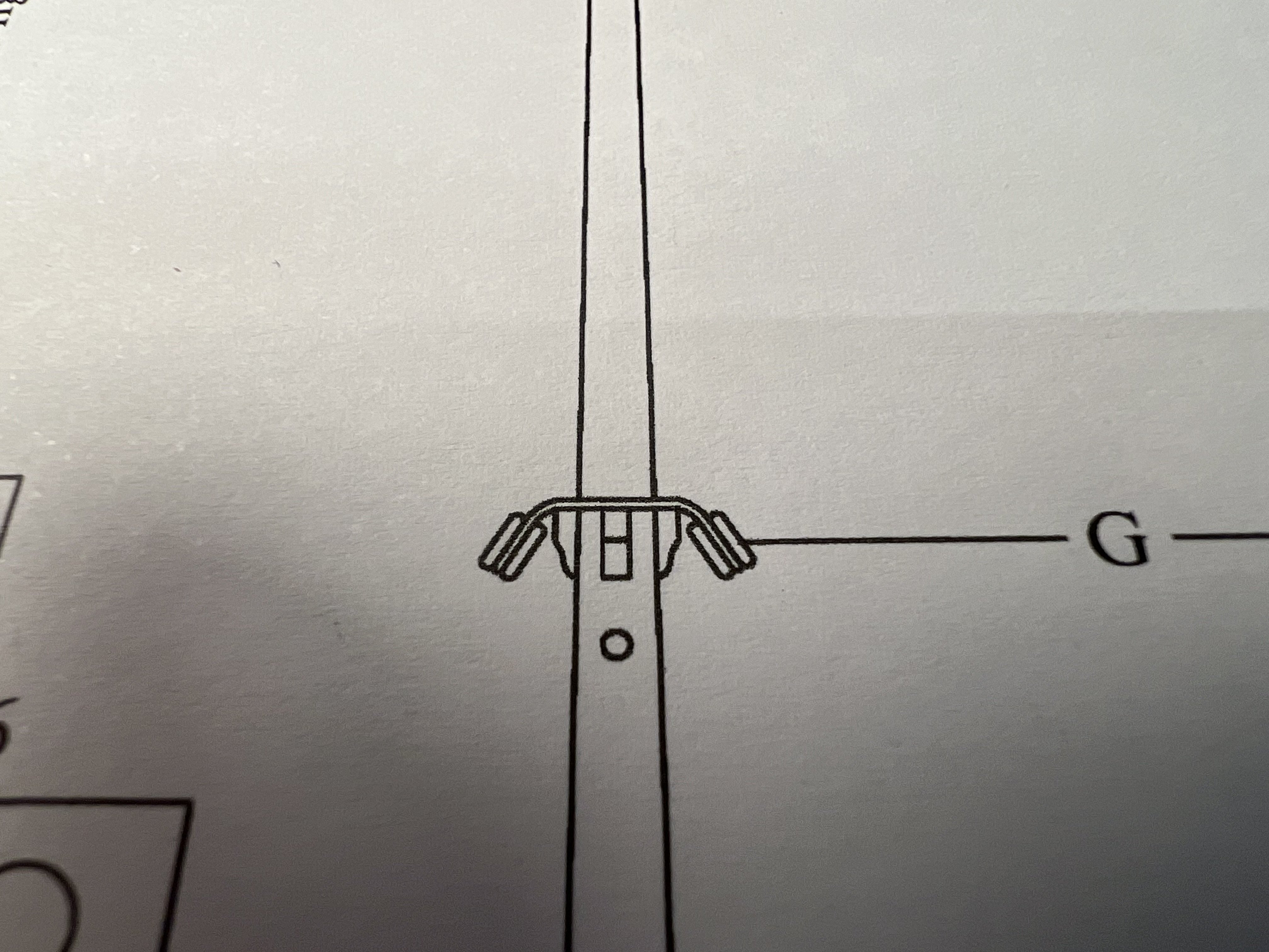

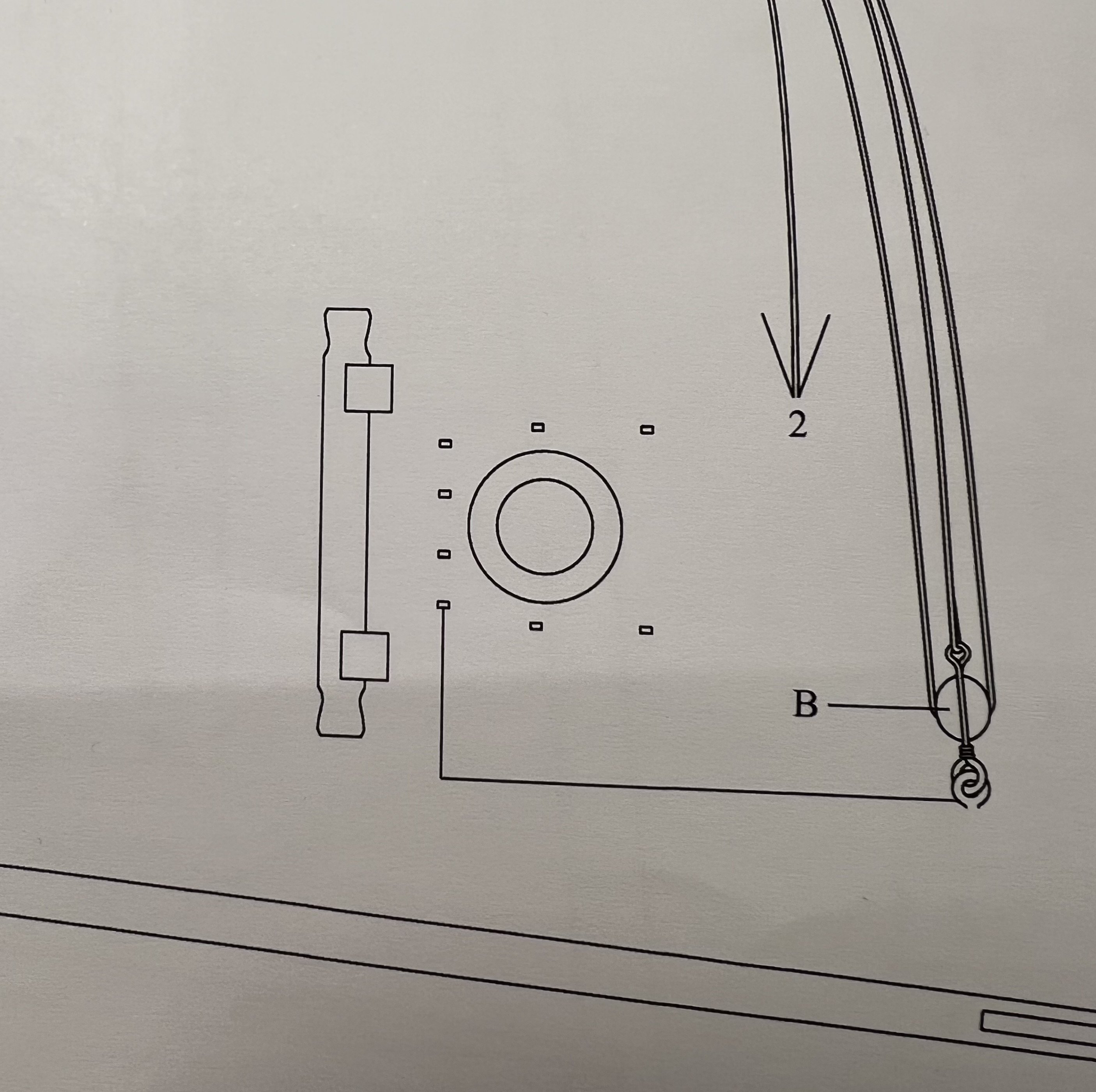

This is the next bit on the plans to do. A bit more complicated. I’m showing a drawing from Lennarth that Modelkit Stuff showed in Video 19 of the Sherbourne build.

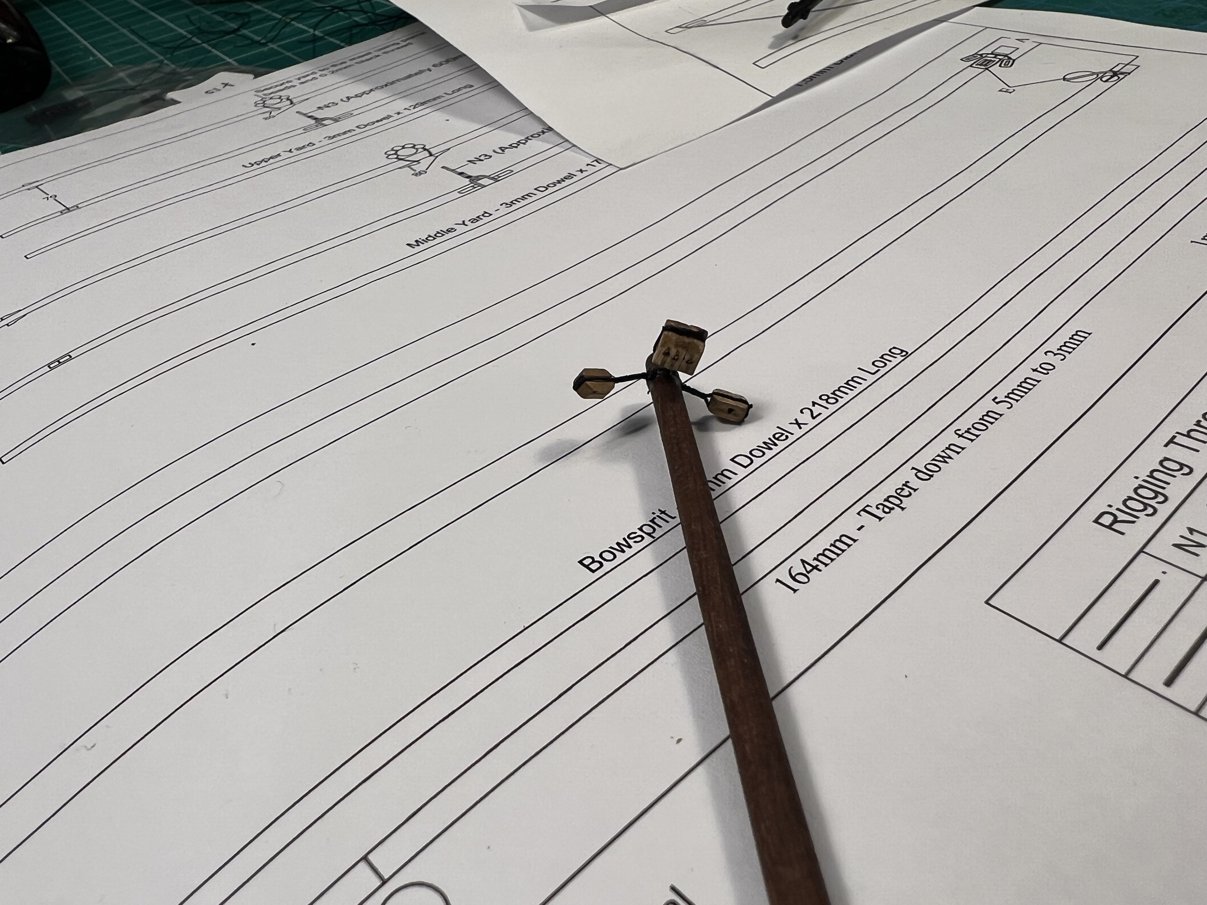

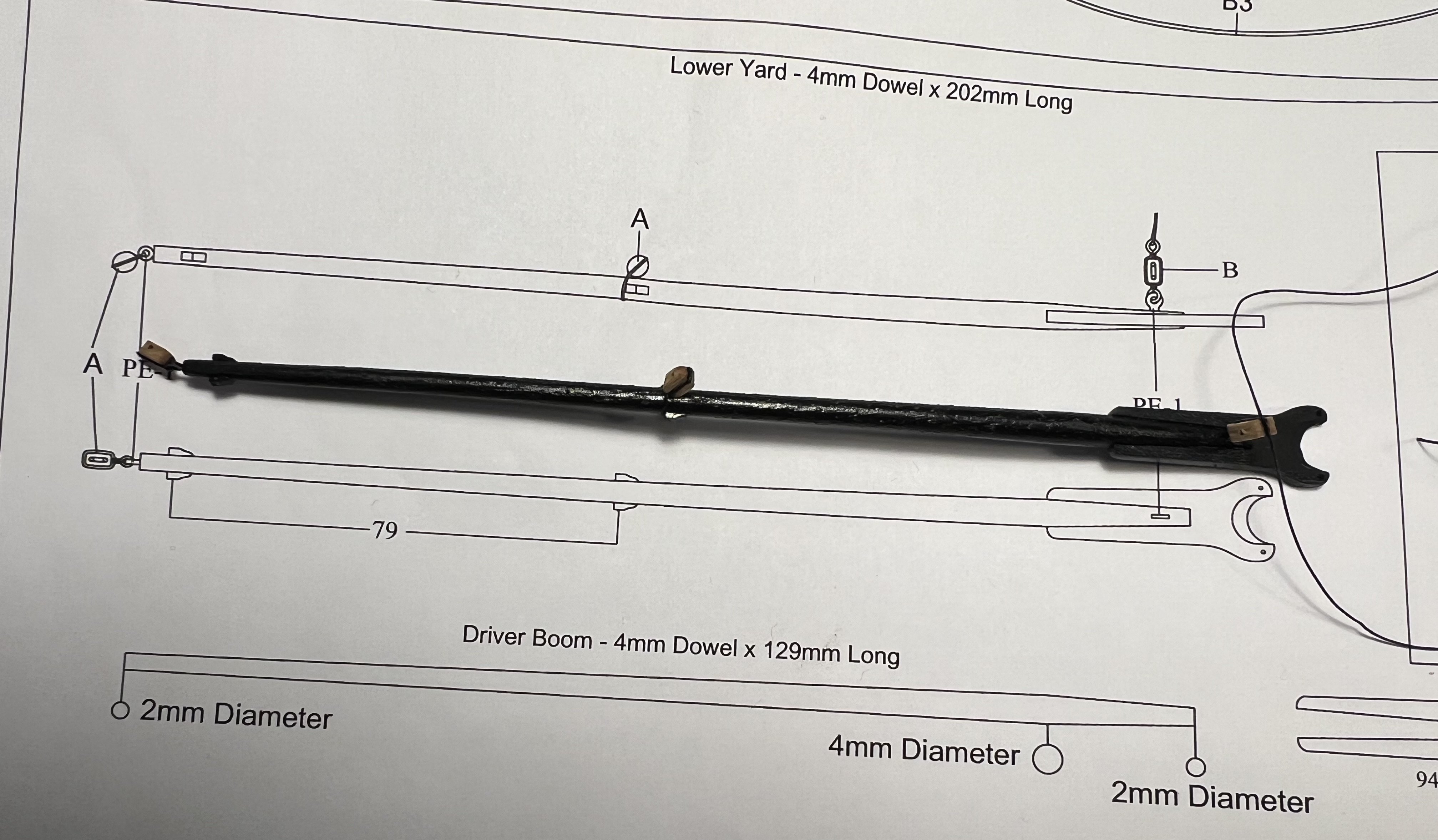

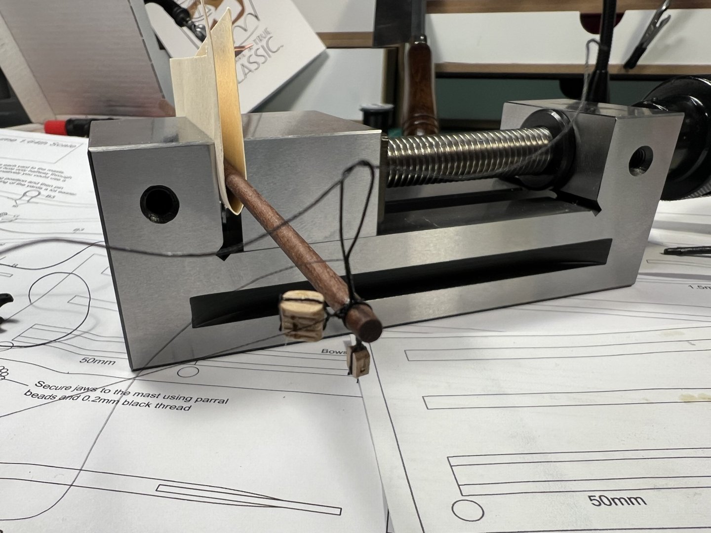

Added blocks to one of the spars and to the bowsprit.
One of then blocks attached to the spar will have a becket (loop) at the top but I’ll wait to add that loop until I attach the running rigging it attaches to.

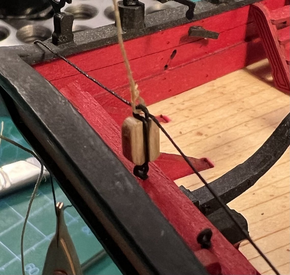

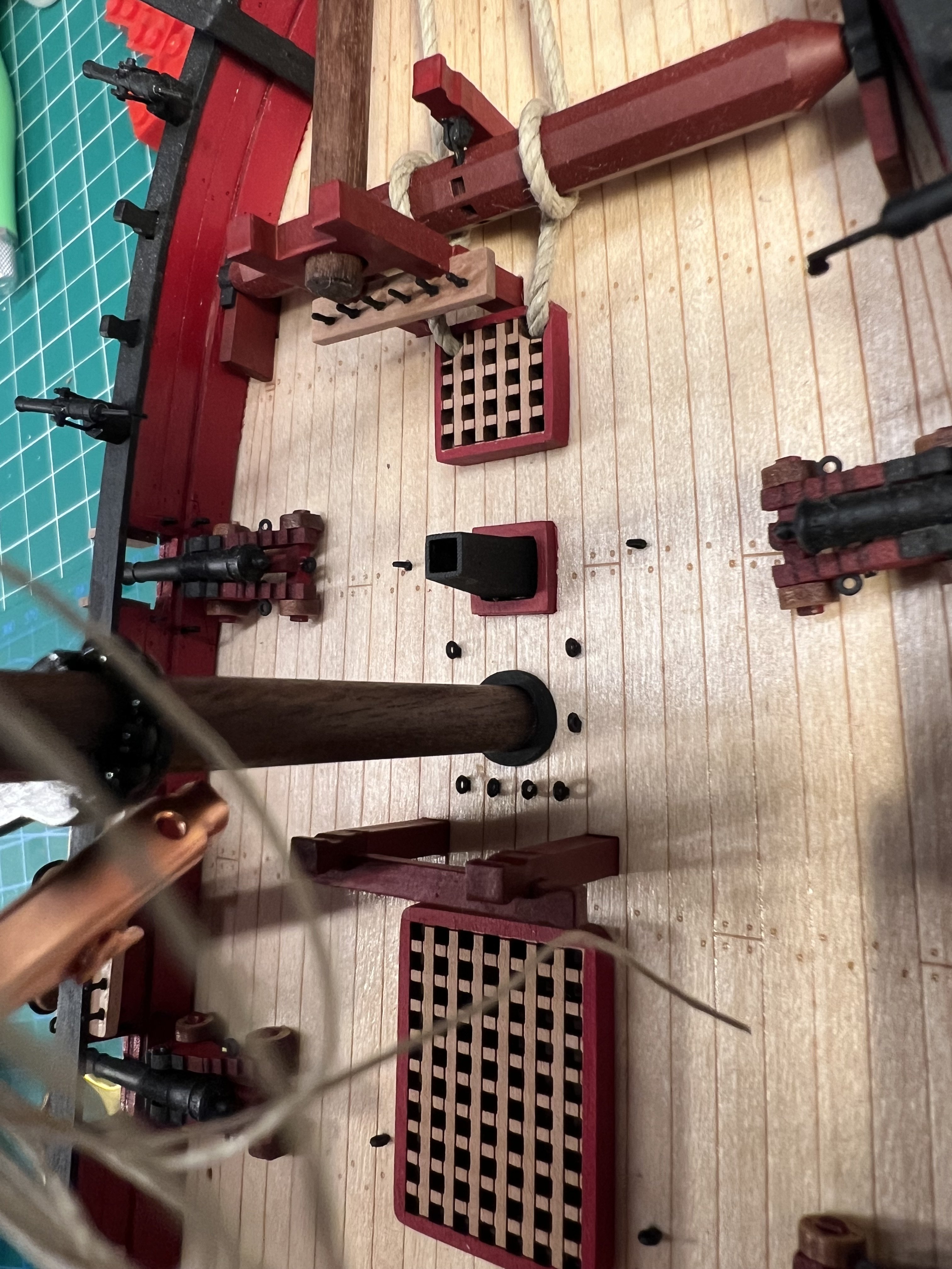

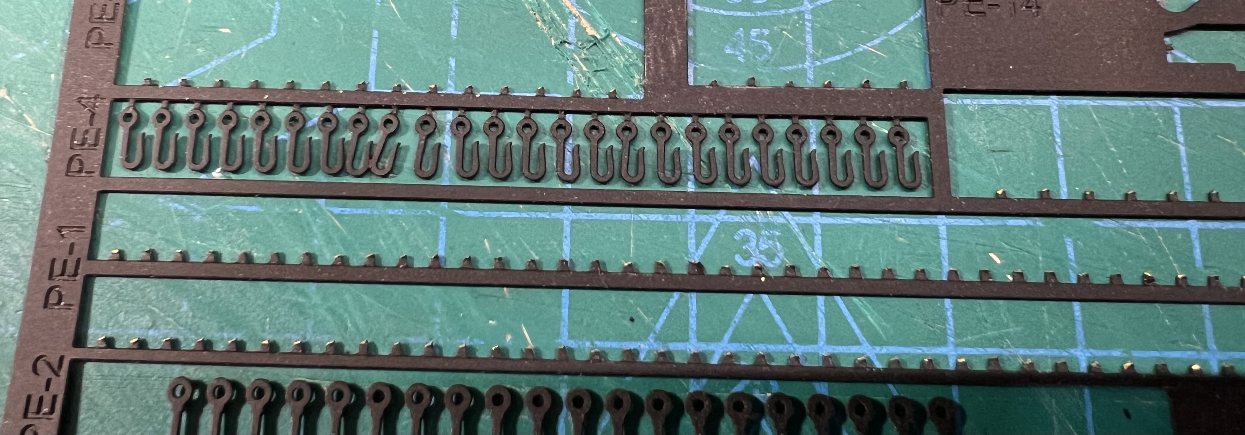

@chris watton @James H I noticed small hooks PE-4 in the kit but I didn’t see where they are used in the model or on the plans. I scanned them but could have missed where they might be used. I’m still new to rigging. Are they just not used (or did I miss where)? Or could they be used in some places where a block is tied to an eyebolt? If so, is there a principle for when one of these hooks might be used or not?

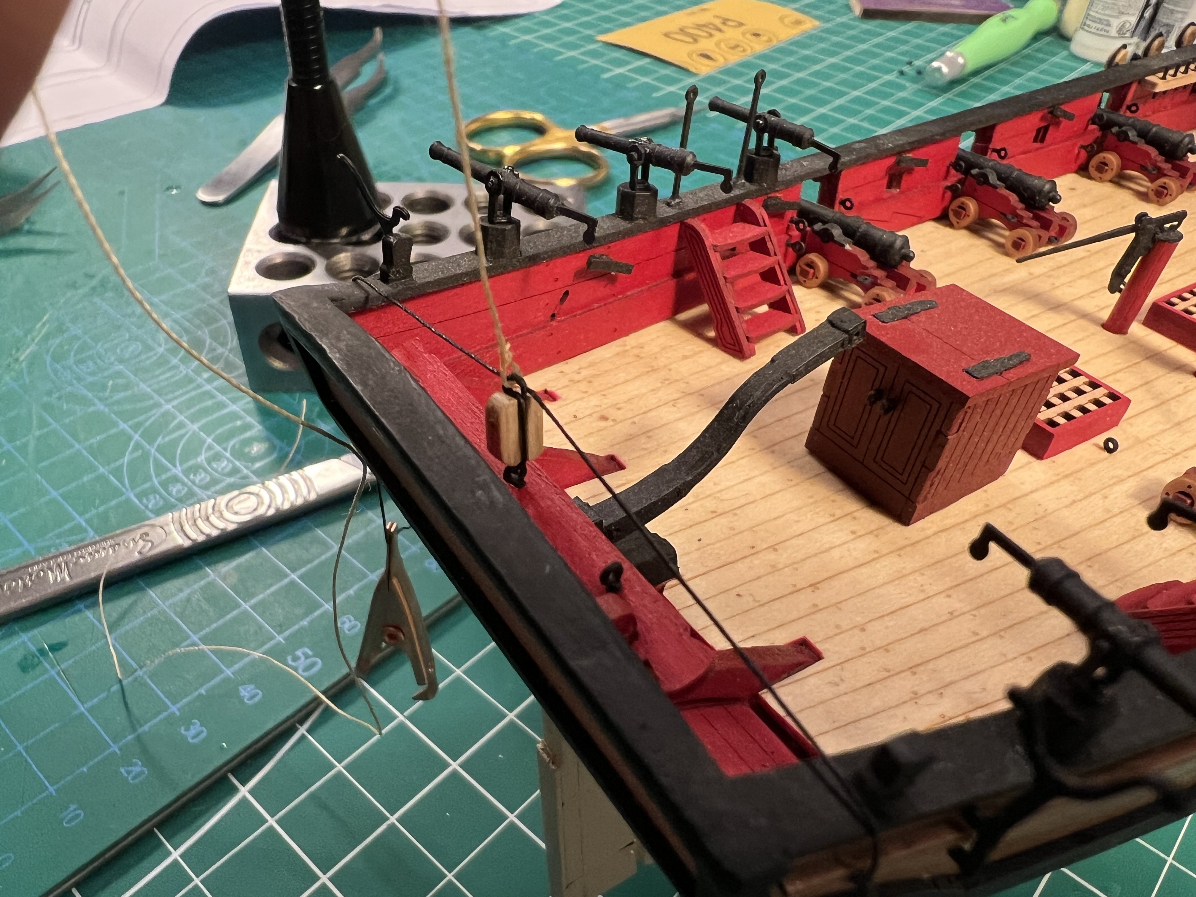

There’s a place where a block needs to be tied to an eyebolt in a pretty tight spot. I’ve pasted the spot in the plans and where it would go on my model. Would this be a good place to use one of those hooks?
I've seen that hooks are used when rigging cannon, but cannons are not rigged on this model (I know they could be).
I know I can do whatever I want. It’s my model. But I’m trying to get an idea of what might be realistic.

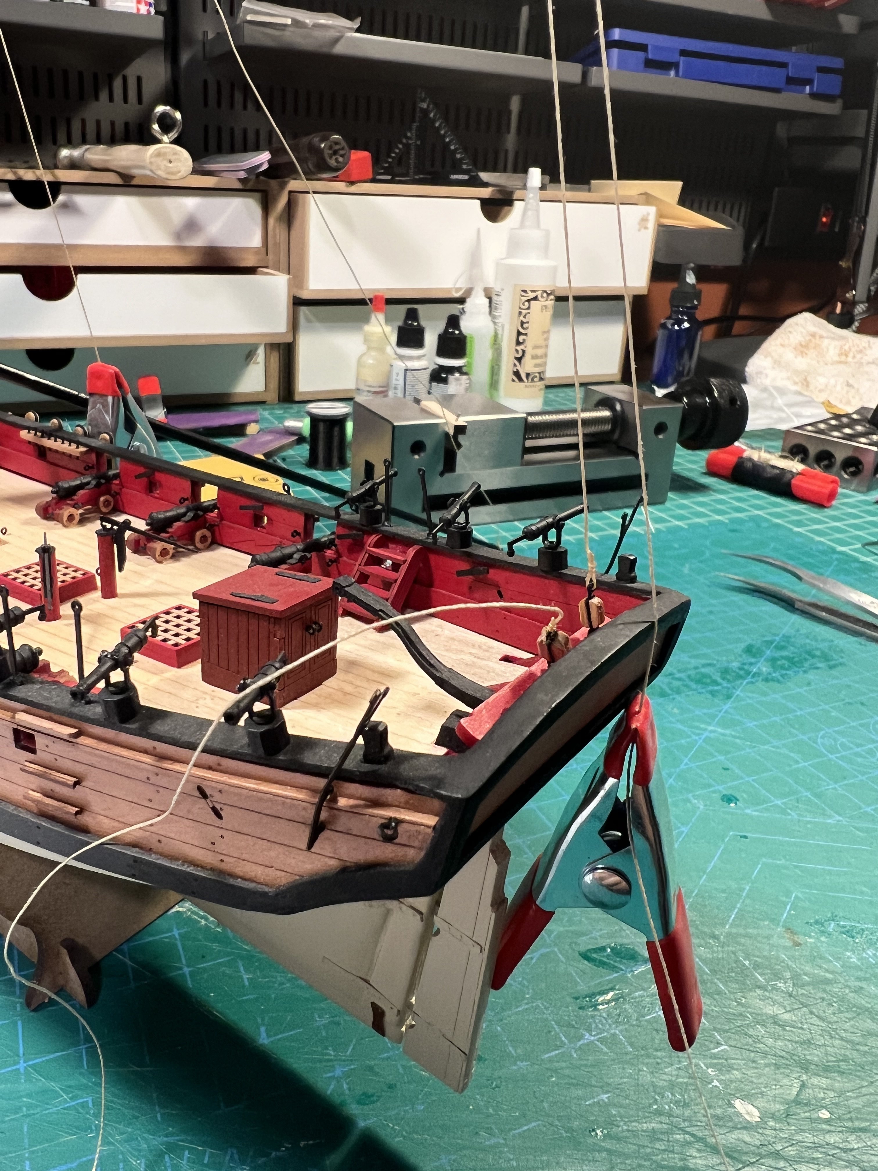

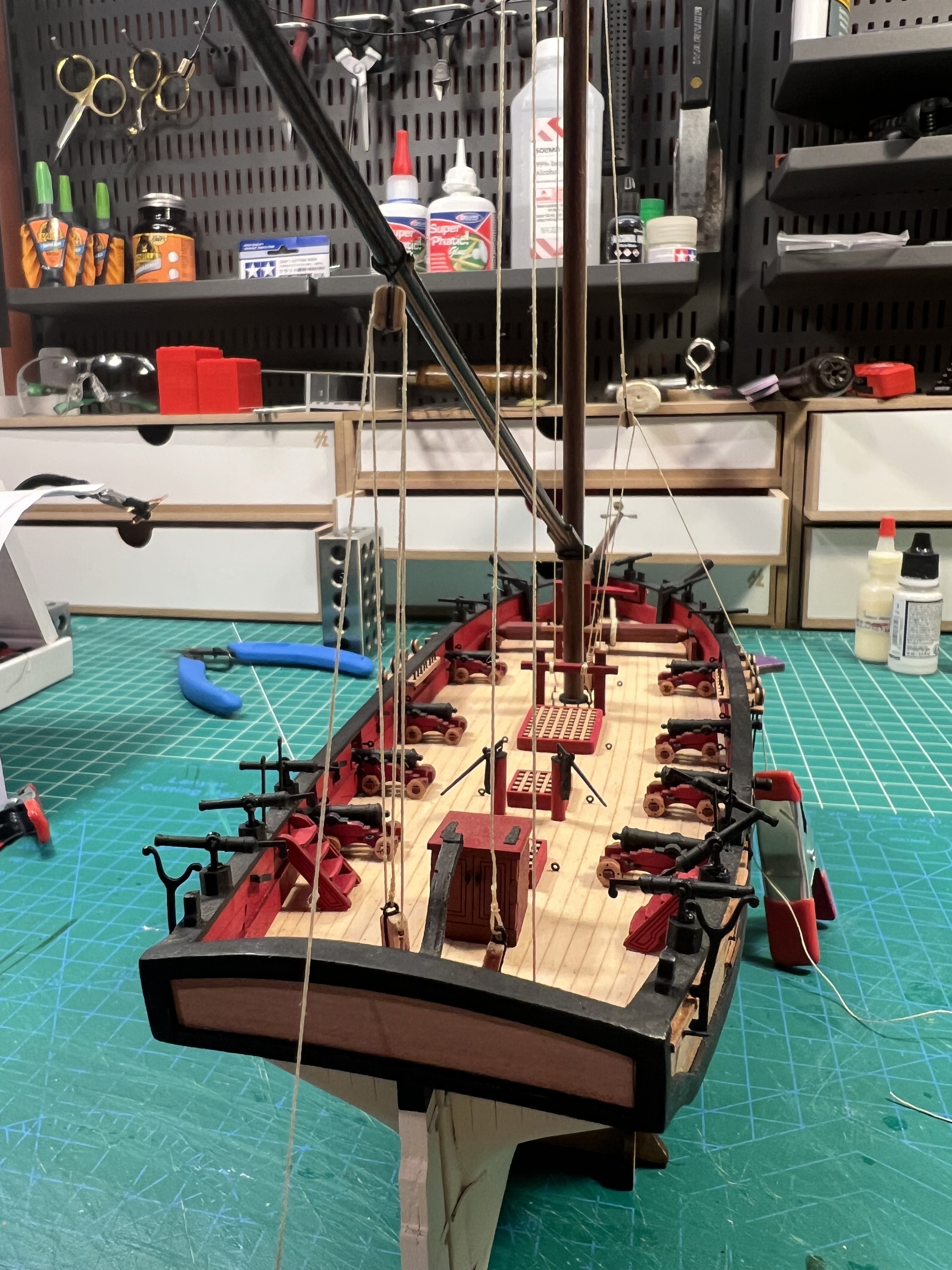

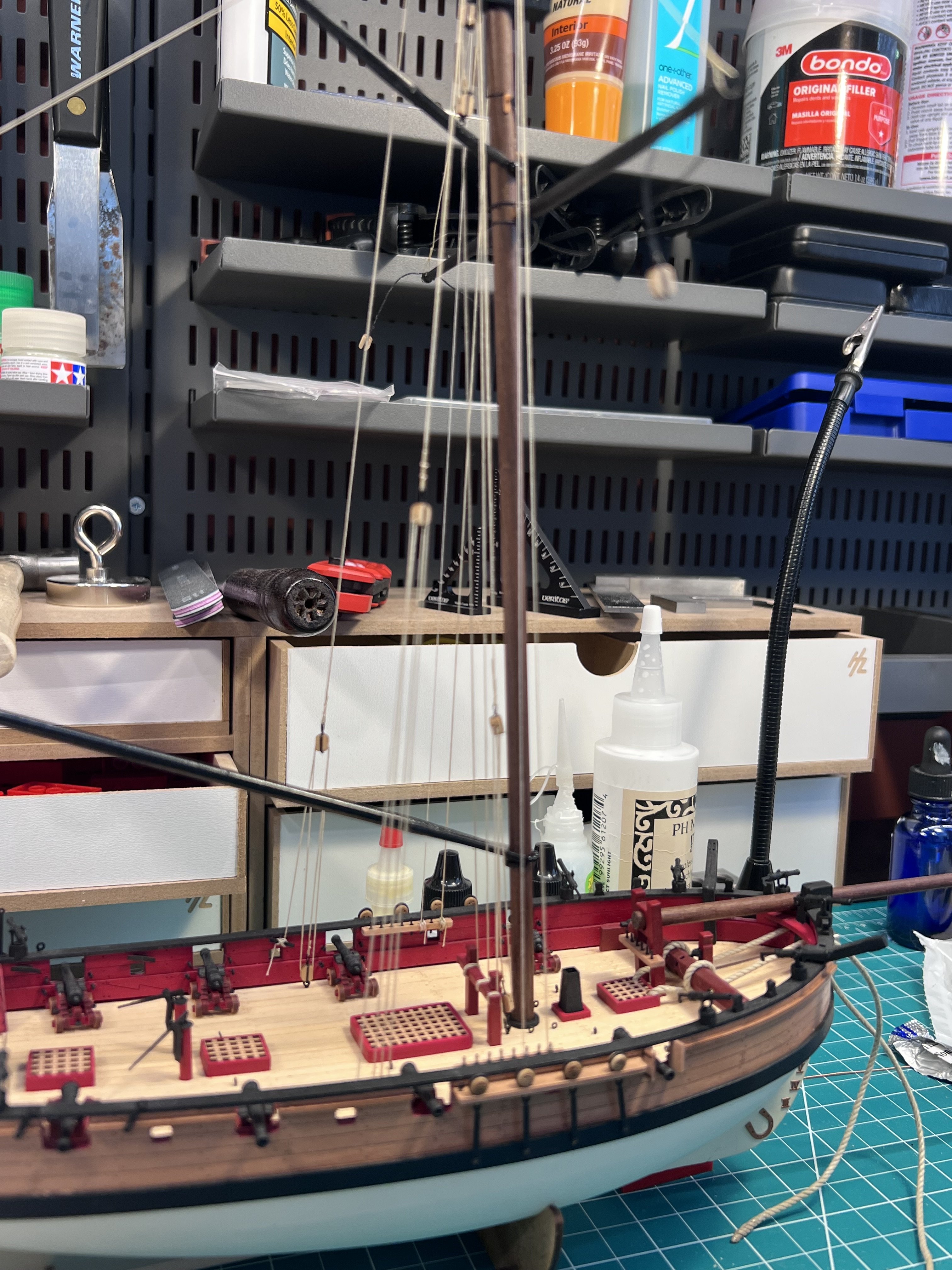

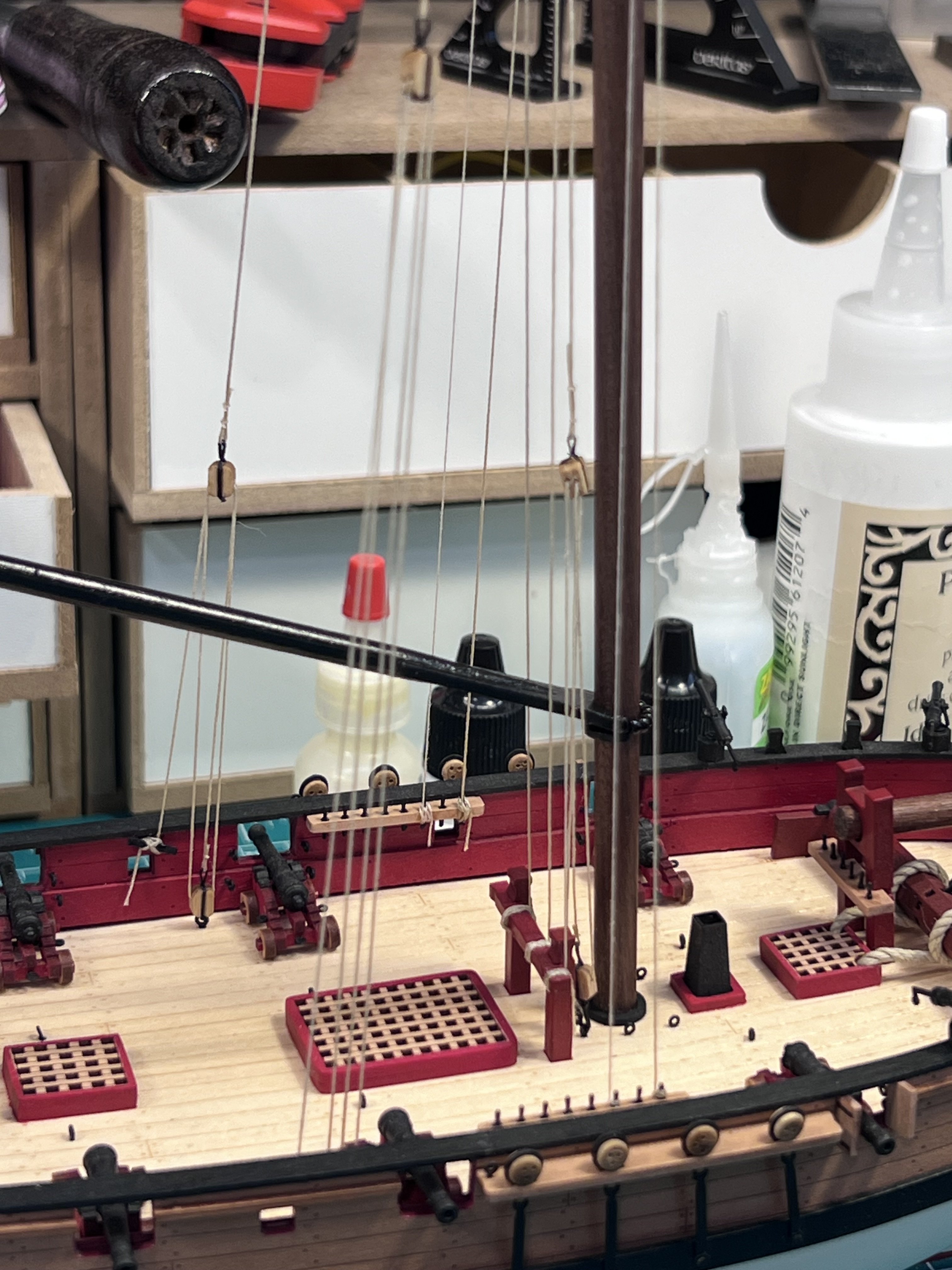

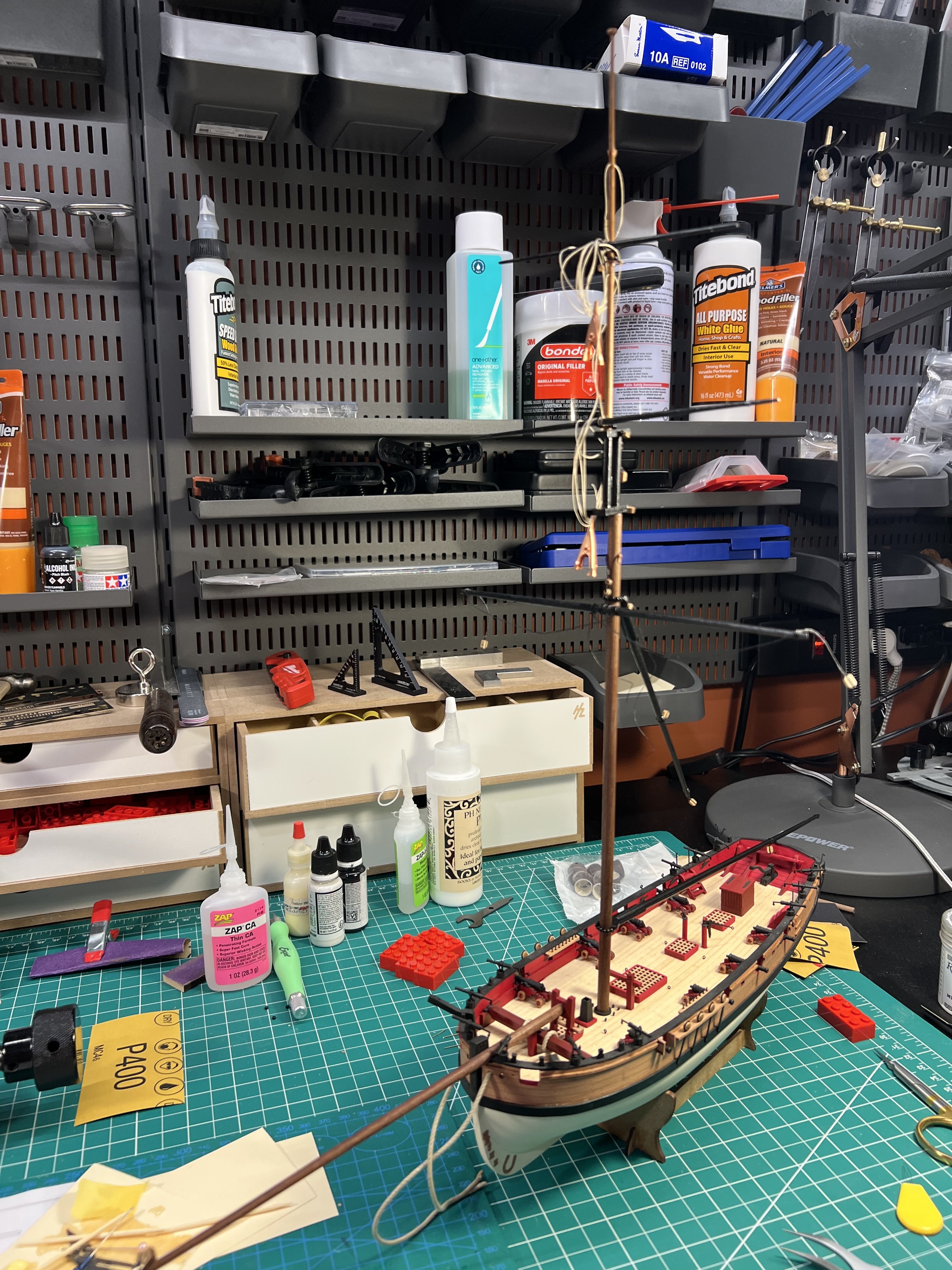

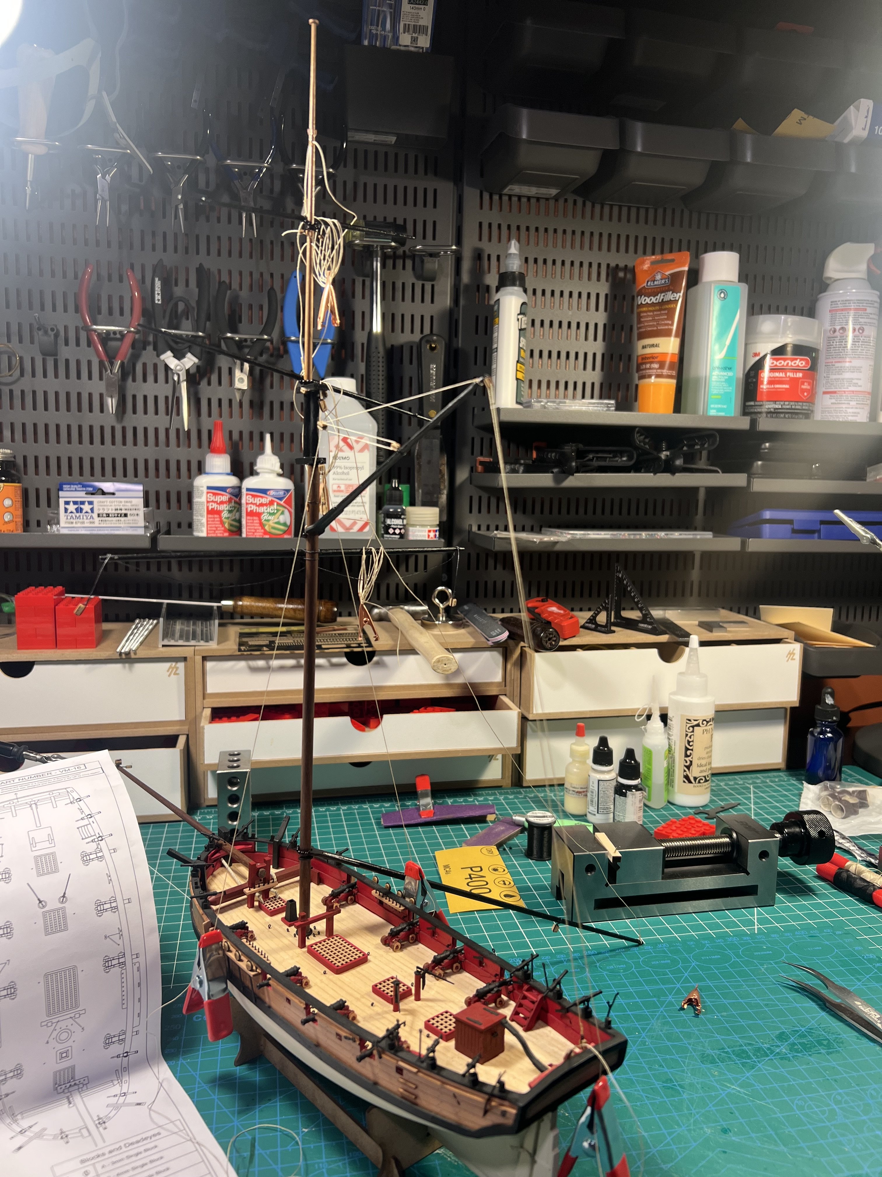

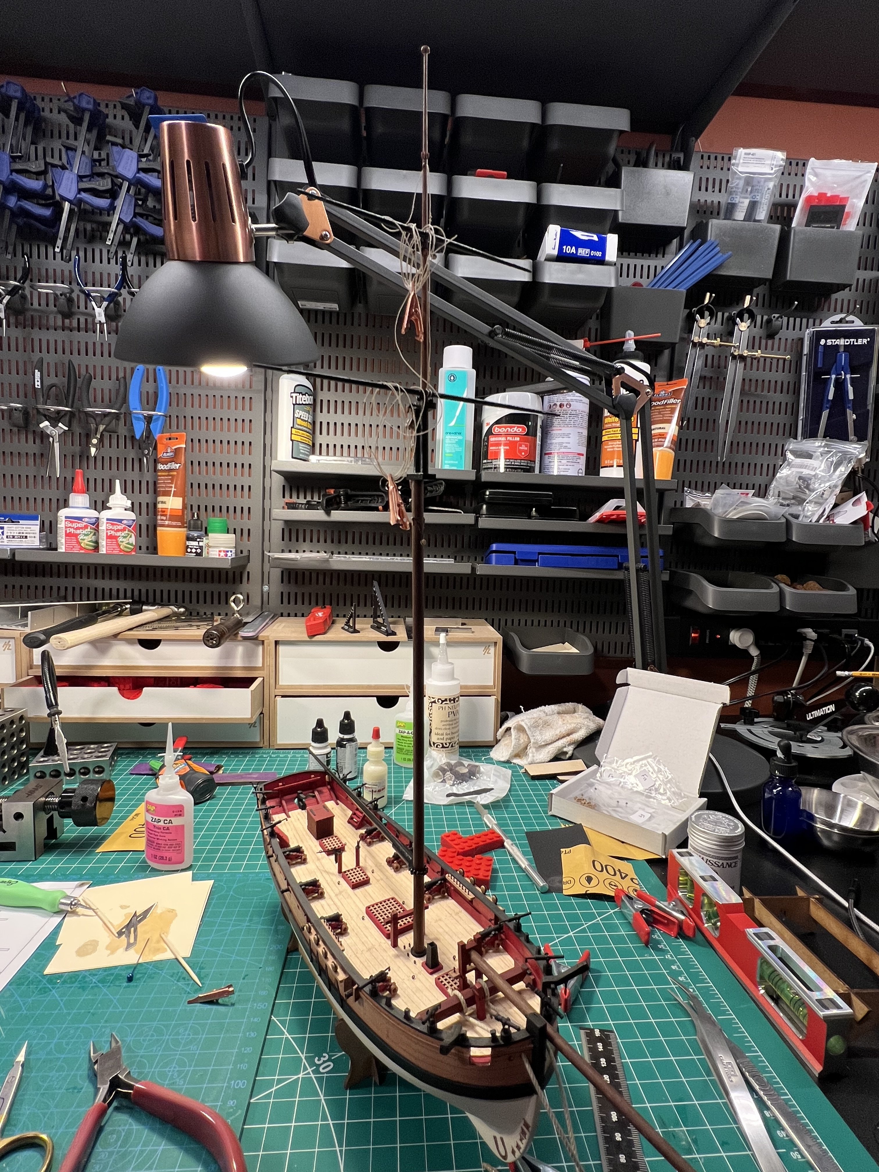

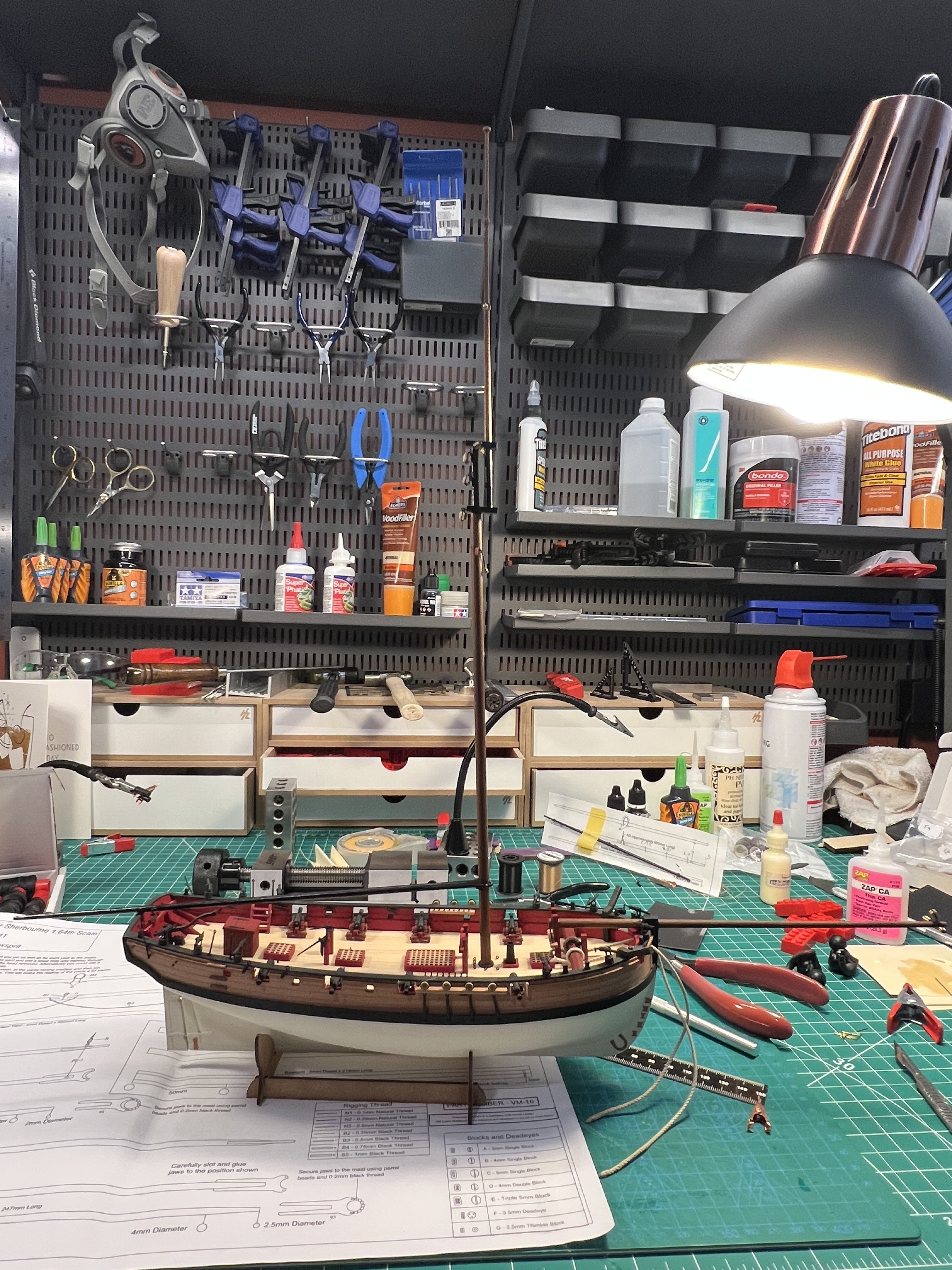

Continuing to make progress on my rigging. Takes patience and researching at every step, learning along the way, plenty of mistakes and do-overs. While I did a bit of simple rigging on the Pram and Smack, this is my first real rigging (on what is technically my first model - first started).
