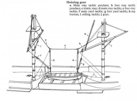

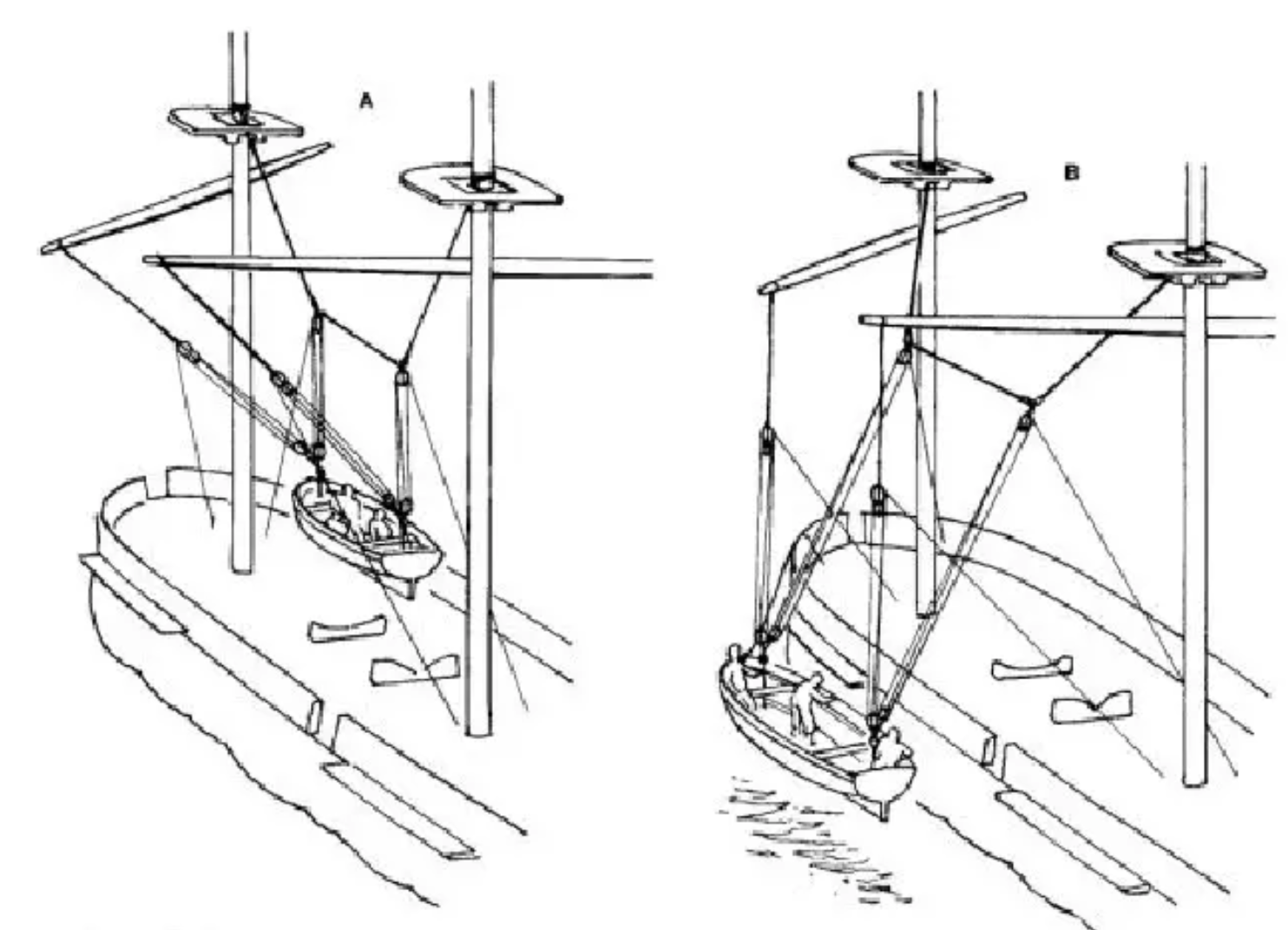

Here are two images that illustrate the yard and stay tackle operation to launch a boat (I don't recall where these illustrations came from).
Here is the detailed rigging:
Note that there are eight tackles for lifting and moving the boat, and four guys to control it while it is moving. The top burton and rolling tackles keep the yard horizontal. They all have to be handled in coordination. One capstan isn't enough. All of the falls would have been handled by teams of sailors.
Here is the process: LaunchingBoats2.thumb.jpg.9d288809faf2dd8b2d715ce7ae52fab0.jpg
The stay tackles lift the boat from its cradle. The yard tackles haul it outboard. Then the yard tackles are let out to lower the boat, while the stay tackles are slacked so as to not interfere. Bringing the boat back on board is the reverse of this process.
The distance between the stay tackles is varied by setting the length of the triatic stay, longer for longer boats and shorter for smaller boats. The lower block of one stay tackle can be hooked to the upper block of the other to make a rig with just the second tackle lifting while the first moves the rig fore and aft between the masts. Adding a yard tackle hooked to the object being lifted allows using the rig to move objects around on deck, fore and aft and side to side. This type of rig was used to move cannon and other large objects.
Just about every imaginable combination of these basic tackles could be hooked together to handle whatever needed to be moved. Anchors were fished up to the rail with the fore stay or burton tackles, and could be moved back to positions farther aft with the yard tackles. A winch or capstan could be used for these operations using only one lifting tackle at a time.

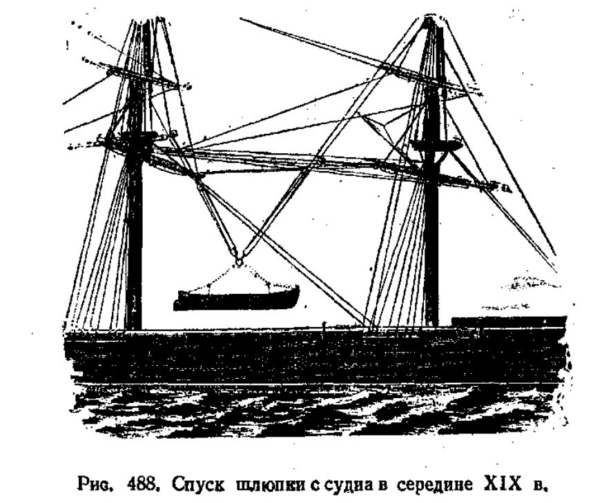

Hello everyone. Give me some advice about the rigging of the boat. I found two different diagrams on the internet. Which one do you think is the most appropriate (HMS Beagle ship)?
Could you provide the sources for each figure please.
I've only seen the one on top, not the one below.

I found the first one in Seamanship in the Age of Sail pg 283
below are images from pgs 284 and 285

I found the second or lower of your images on Pinterest posted by Niko Henrichs.
No details or attributes for the scanned image.
Without that information I would hesitate to make a decision.
I await input from someone with the knowledge.
Alan O'Neill
The top figure employs the more modern style of rig (relatively) with the falls suspended from the mast tackle pendants and a triatic stay. The second figure shows the older method of employing a mast pendant and guy assembly (1600's to early 1700's, I believe).  (Note the round tops and the tye and halliard arrangement for the yards).

Sagrado,
Since the HMS Beagle was a British Royal Navy ship you should look for information about how the Royal Navy was rigging the lifting tackle in the first half of the 1800s.
I would bet on the rig shown in your first images from "The Age of Sail."
However, keep in mind that there were probably as many ways to rig these tackles are there were ships, Captains and Bosuns. If you cannot discover exactly how it was done on the Beagle (and did the method change over time?) you are free to do whatever you want so long as it is reasonable.

About drawing b): i found a model HMS Beagle with rigging based on this pic. However i'm not sure if it accurately represents the actual ship and the era. One of the books that heavy cargo (provisions and cannons) was loaded onto ships this way.
This model does not include the rigging of the boat. This is the author's idea. And I am trying to find out how close it is to reality.
