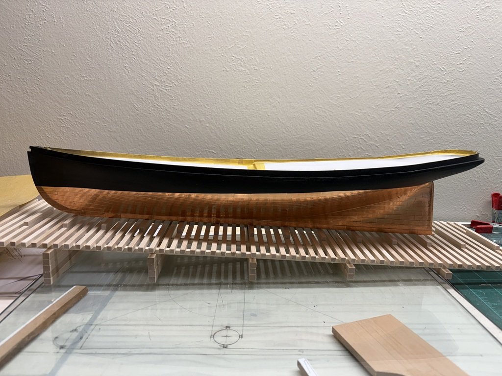

Here is the top of the slipway in its finished state. I had gone to Seattle for a few days and hoped that all the slats would have been in place when I returned; however, the slipway fairy clearly did not show up - so about 50 copies of the same strip over the last day or so!
Next step is to get this sloping to just the right angle so the hull can be mounted and the waterline can be drawn to match.

I've spayed the hull several times with black paint. I thought it was ready to varnish, but upon closer inspection, I found two locations where the paint could be smoother. So I am going to sand those regions a bit and recoat before moving on. As you would guess, the areas that need attention are above the water line - everything below, where the copper will go is just fine!
The ironies of ship modelling.....from the photo any imperfections are completely invisible!

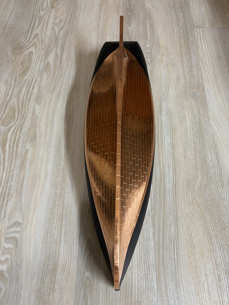

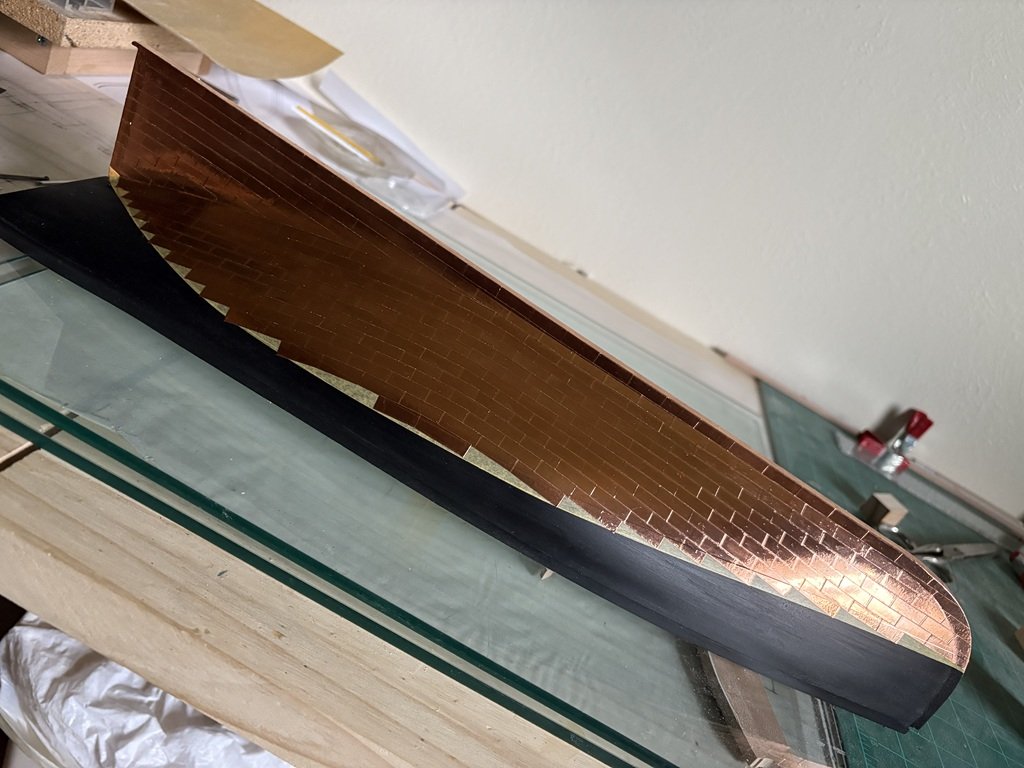

I've started to copper the hull. This is only the second hull I've tried to cover in copper foil - my 1/96 scale Phantom was the first, back in 2007. I hope it doesn't look too bad when done! So here's what I've done on day 1:
Keeping the detail level - no treenails in the hull planks (nor deck), so no fasteners in the copper plates.
I marked off the first belt with Tamiya tape and plated the first belt so that it overlapped the tape. After making sure the copper foil was burnished quite well to the hull in a way that I could easily see the tape edge, I used a new scalpel blade to cut through the foil and pealed off the tape. Ready now to start the second belt.

Looks great!

The plating looks really fantastic - once it weathers up it'll be even better! Am now seriously considering this model to replace the 1:96 one that got destroyed...

Hi Greg, Your coppering is fantastic! Your use of Tamiya tape to define the gore line really results in a clean edge.  I need to remember that tip.  Fortunately, my next few models will not have copper bottoms.  (It least that's what my plan is now)
Beautiful work!
